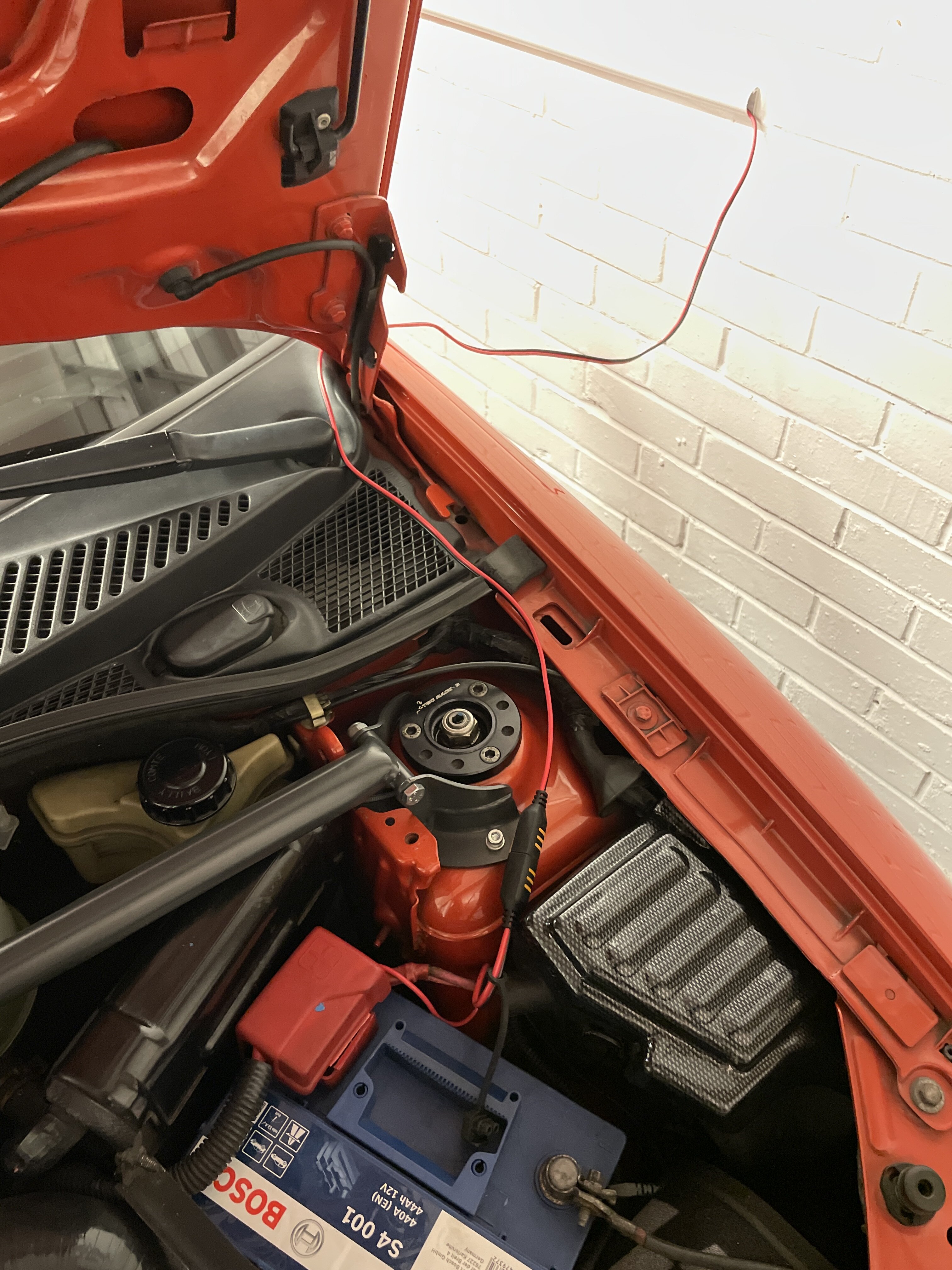

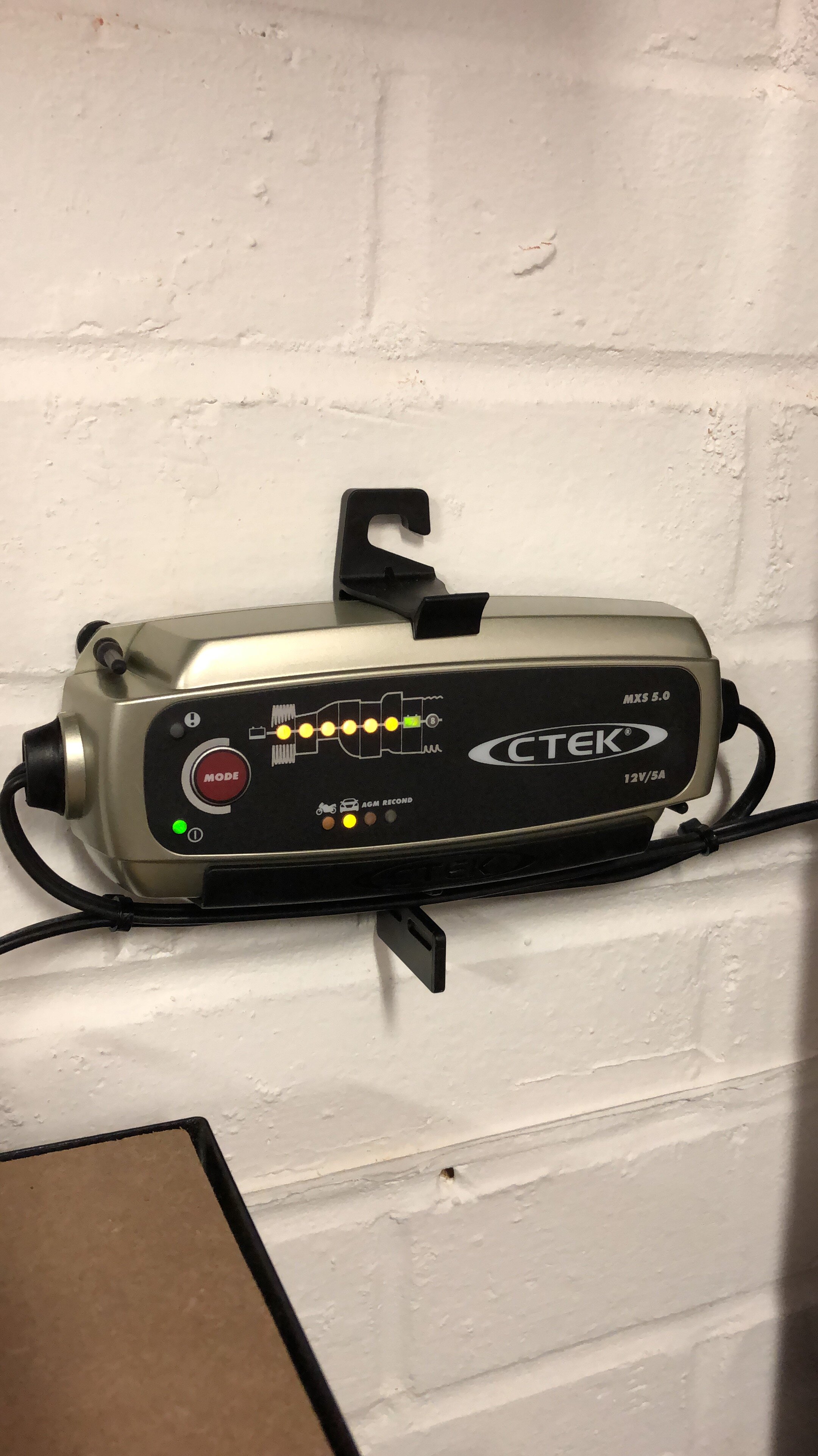

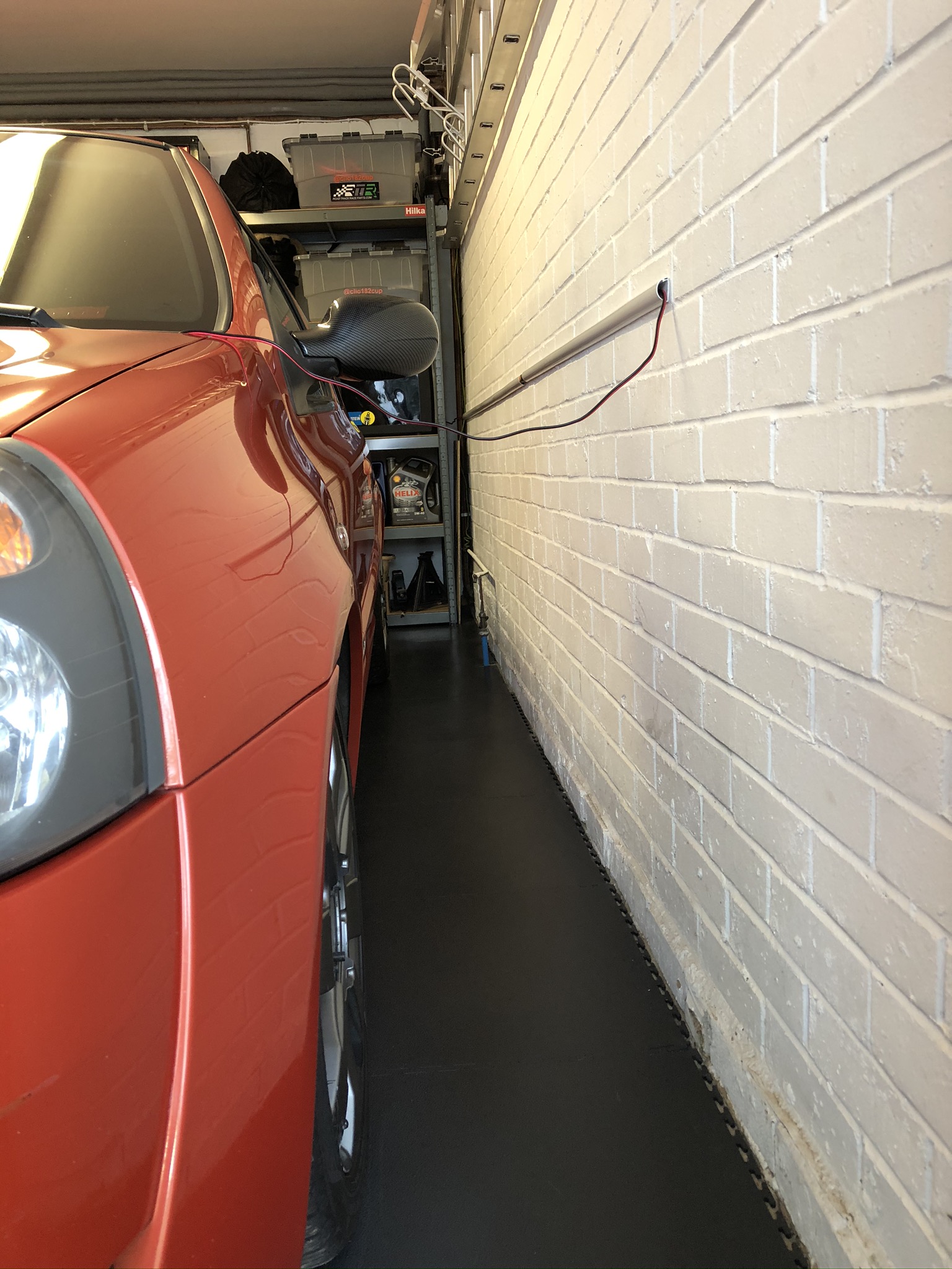

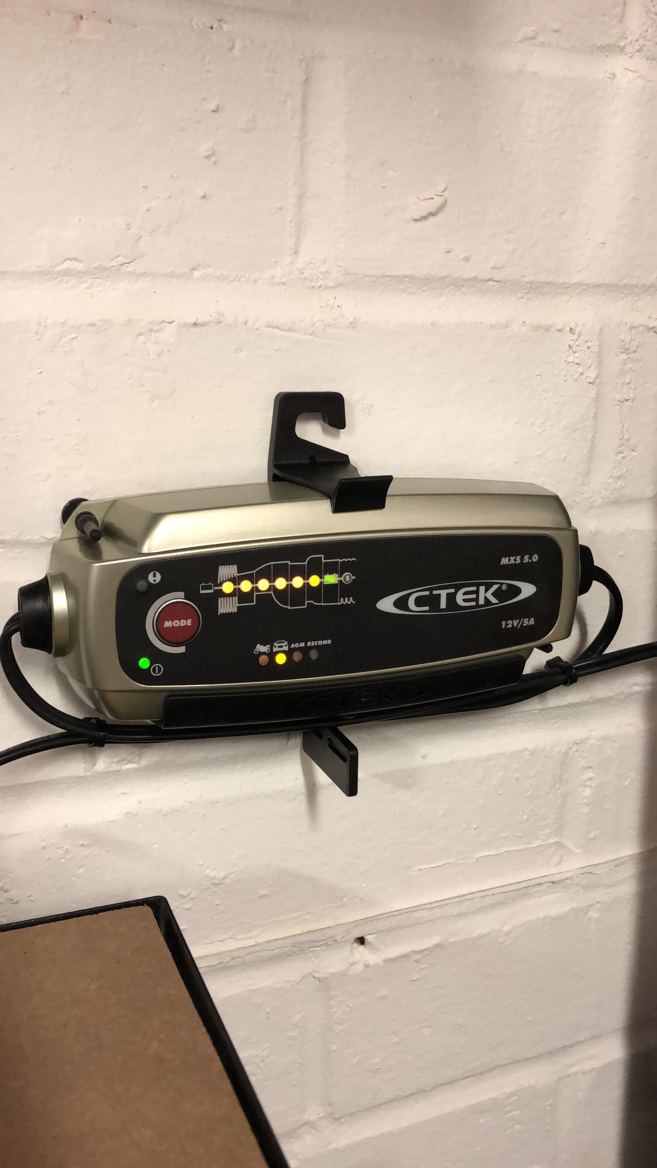

Granted I’ve got a garage to use solely for the Clio, but my socket is at the back, so I mounted the CTEK on the wall and bought two of the 2.5m extension cables and plugged them into each other. To keep
It neat I stuck some cable trunking to the wall and ran it though that.

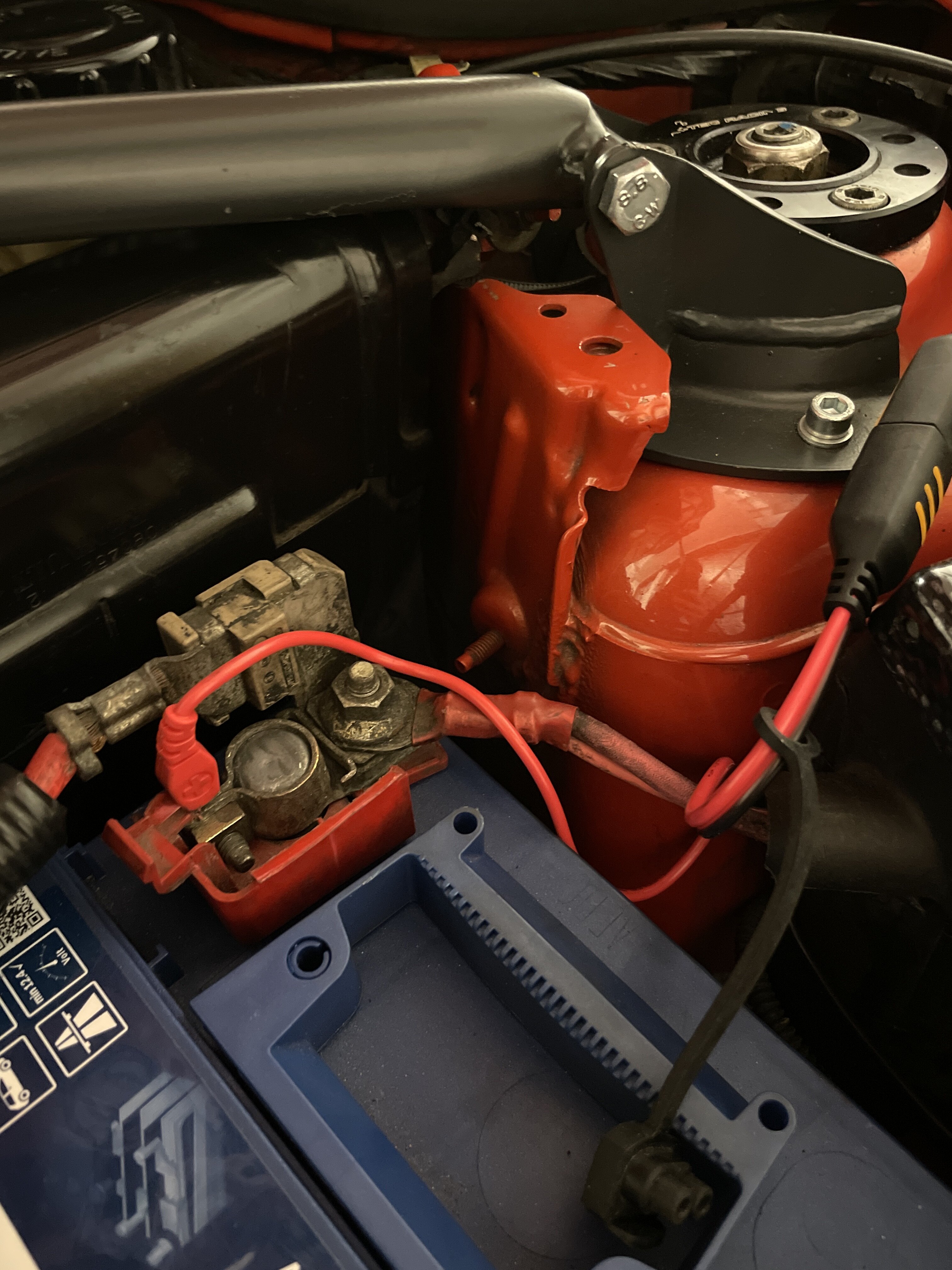

Then on the Clio I bought the “comfort connect” which is a permanent attachment to the battery terminal but allows you to plug and unplug really easily. You just feed the cable from the CTEK under the bonnet, connect it up and close.
That is a fantastic looking set up!

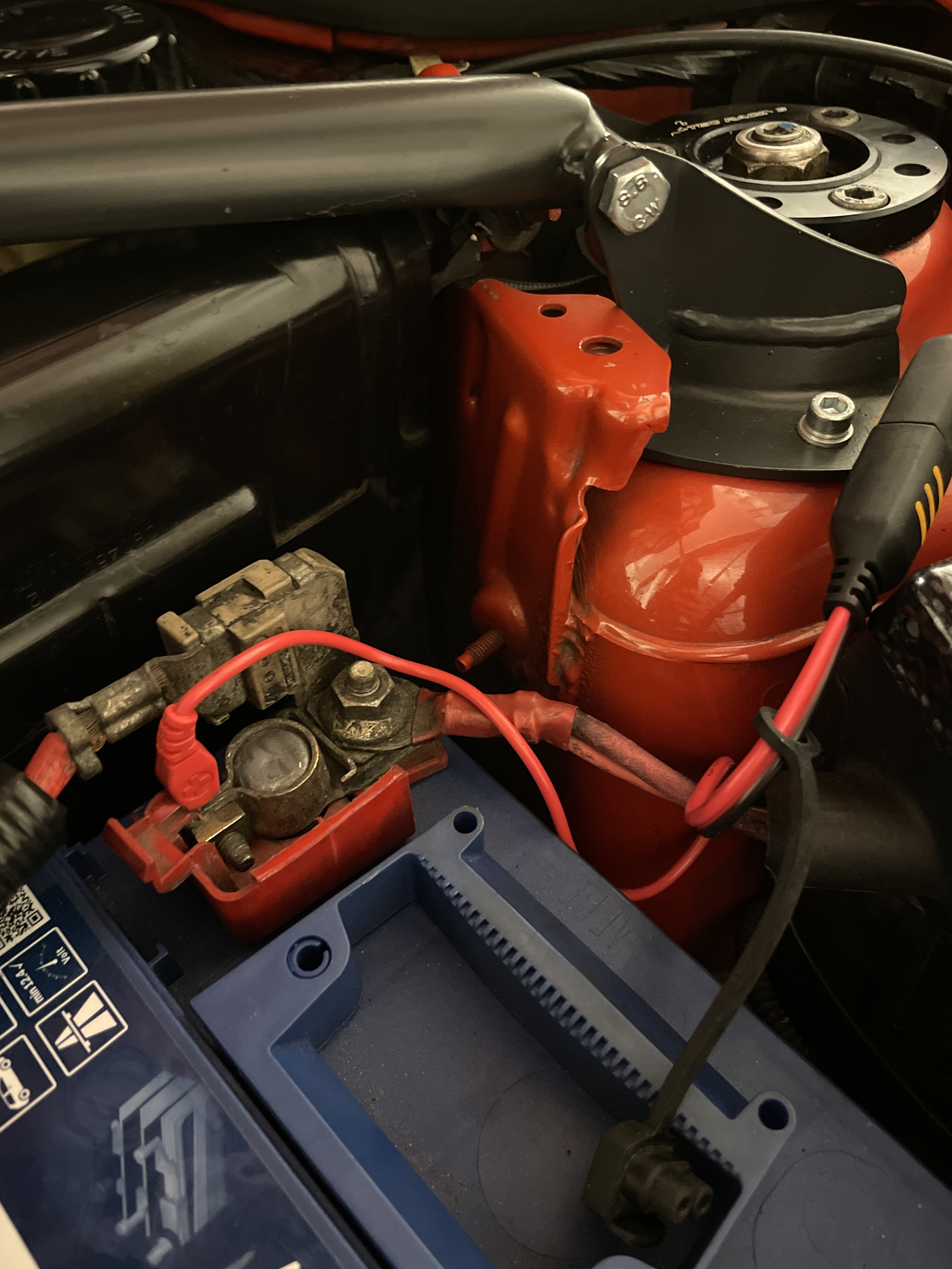

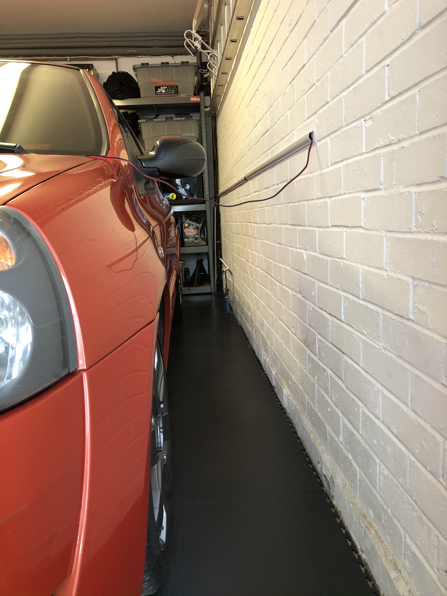

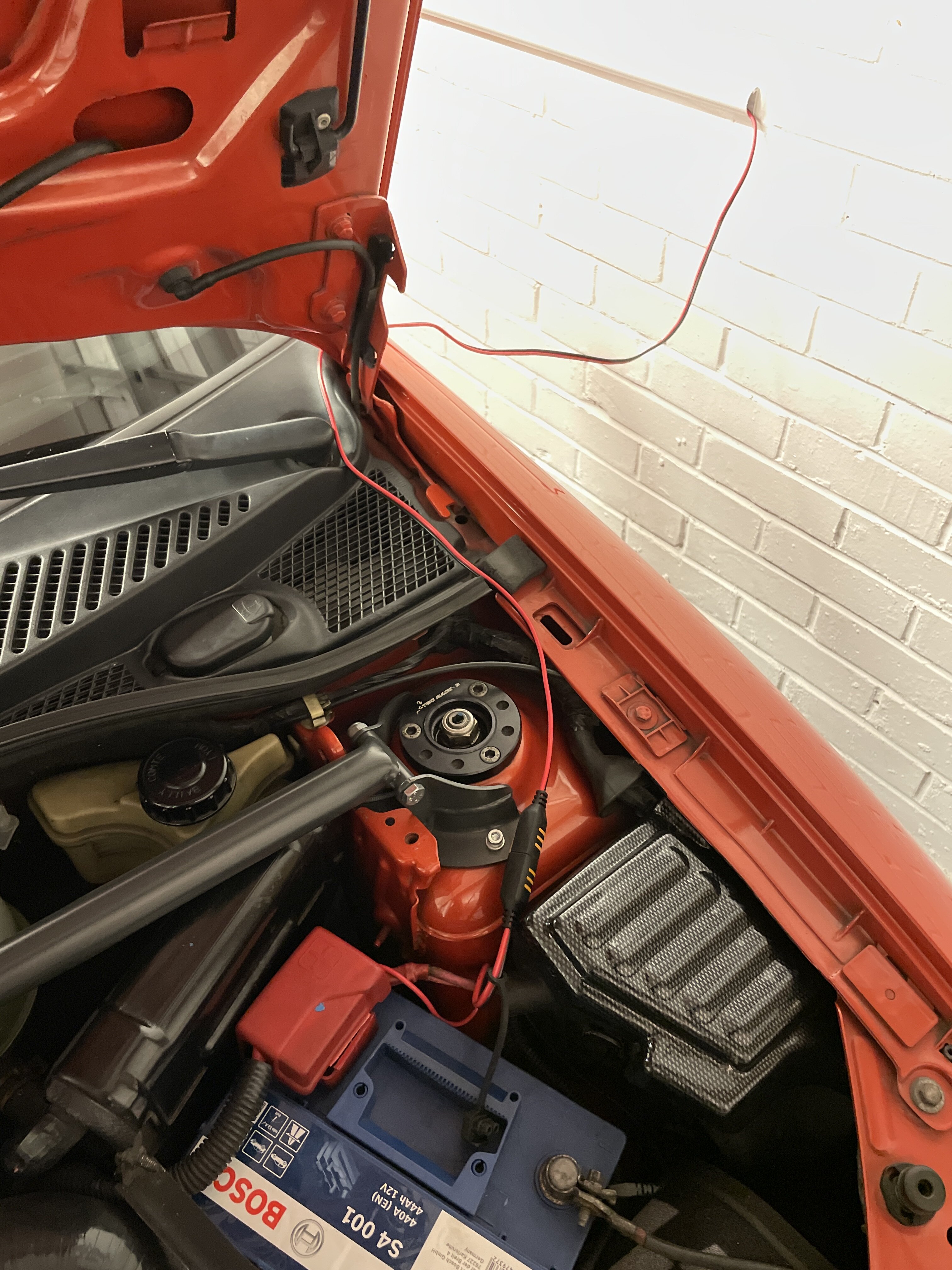

Thanks very much for the pics. Does that give enough room to shut the bonnet and let the wire out through near the scuttle panel / wipers?
Is that the standard positive connection on the battery?
Where have you connected the hard wire negative cable?

Thanks, that’s what being furloughed does to you, time to invest in the man cave 😂
It gives enough room to connect it though the scuttle panel and under the bonnet and there’s also enough slack to move the car forward/backward inside the garage without having to unplug it.
The comfort connect has the same connection on the negative as the positive, I’ve only taken a pic of the positive for reference... The cost all in, including the wall mount, comfort connect and 2x extension cables along with the charger itself was somewhere around the £150 mark, but given my use of the Clio is fair weather track days, it makes a lot of sense.

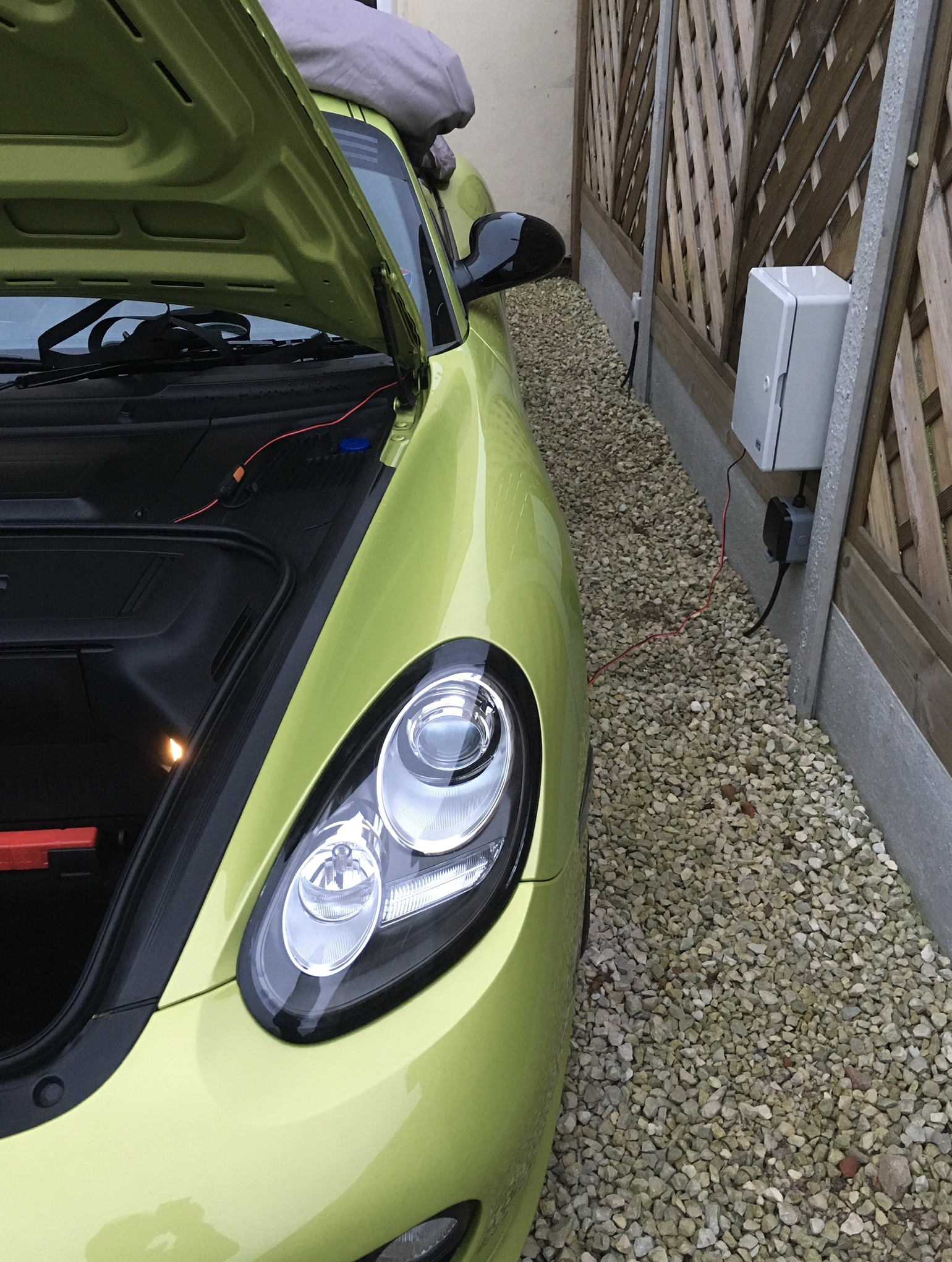

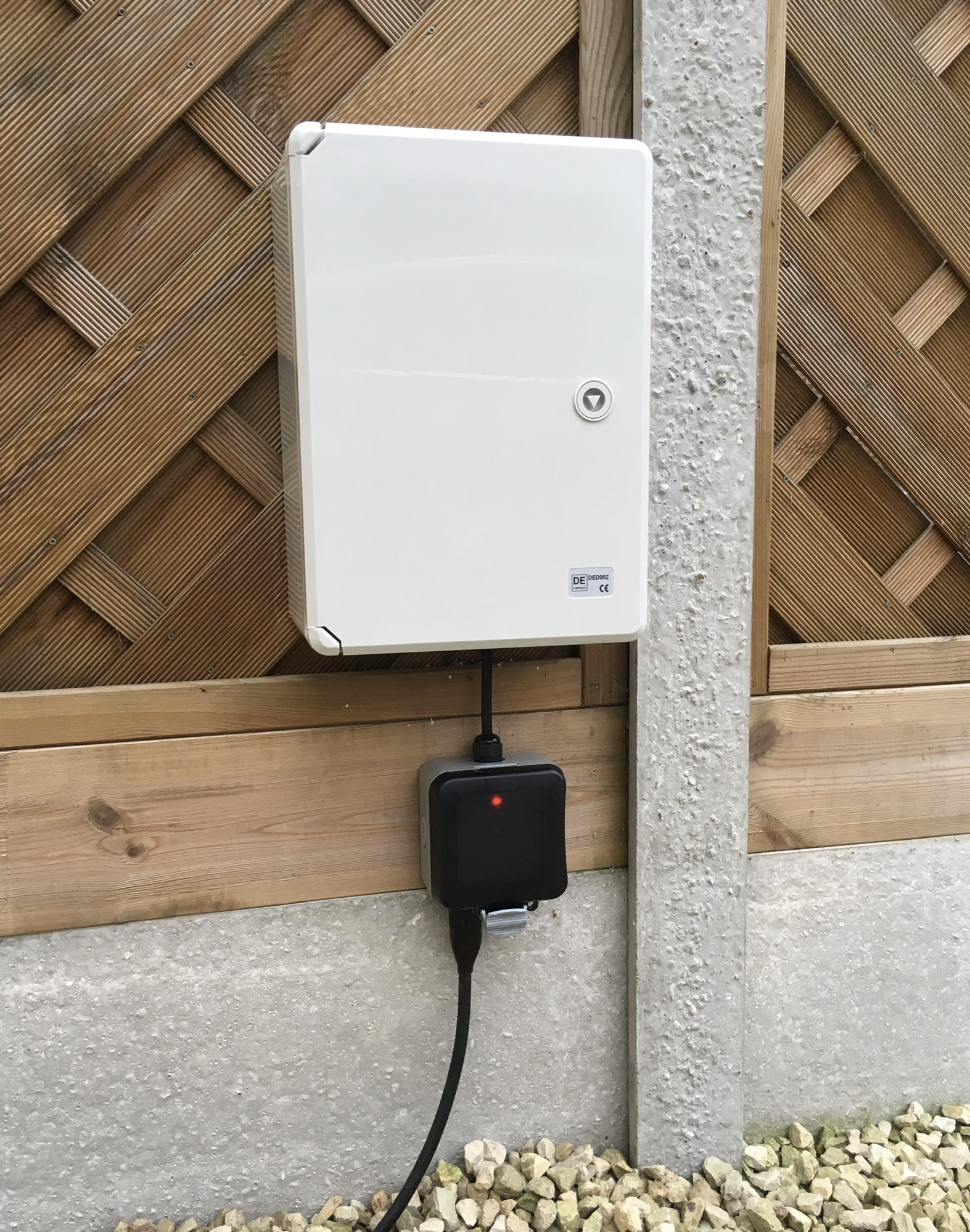

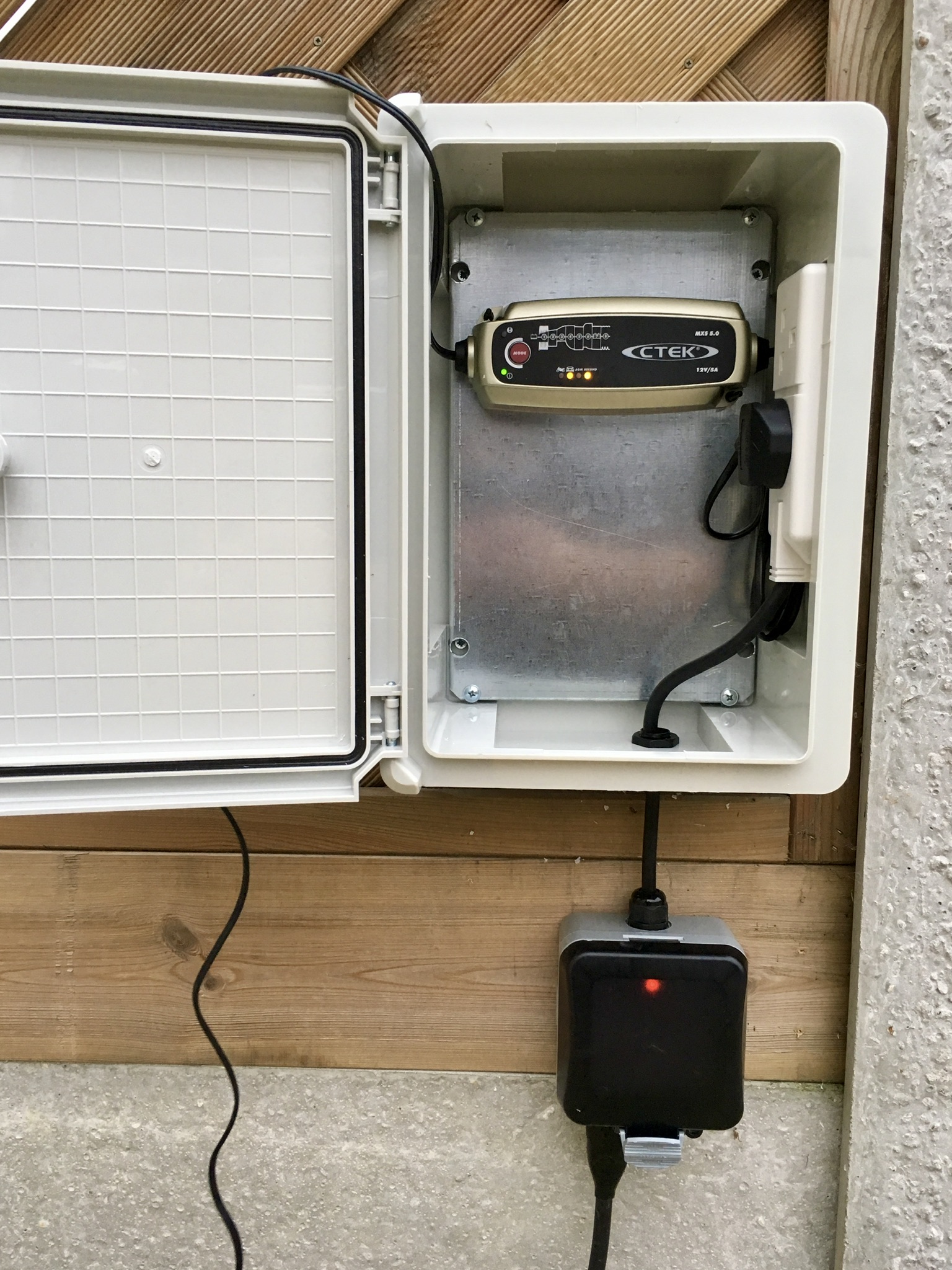

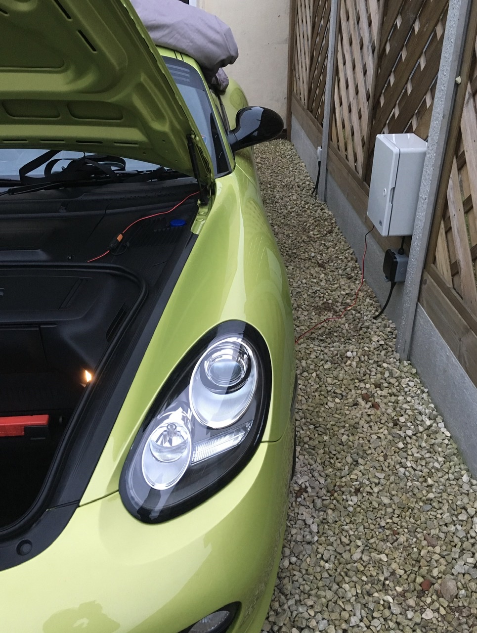

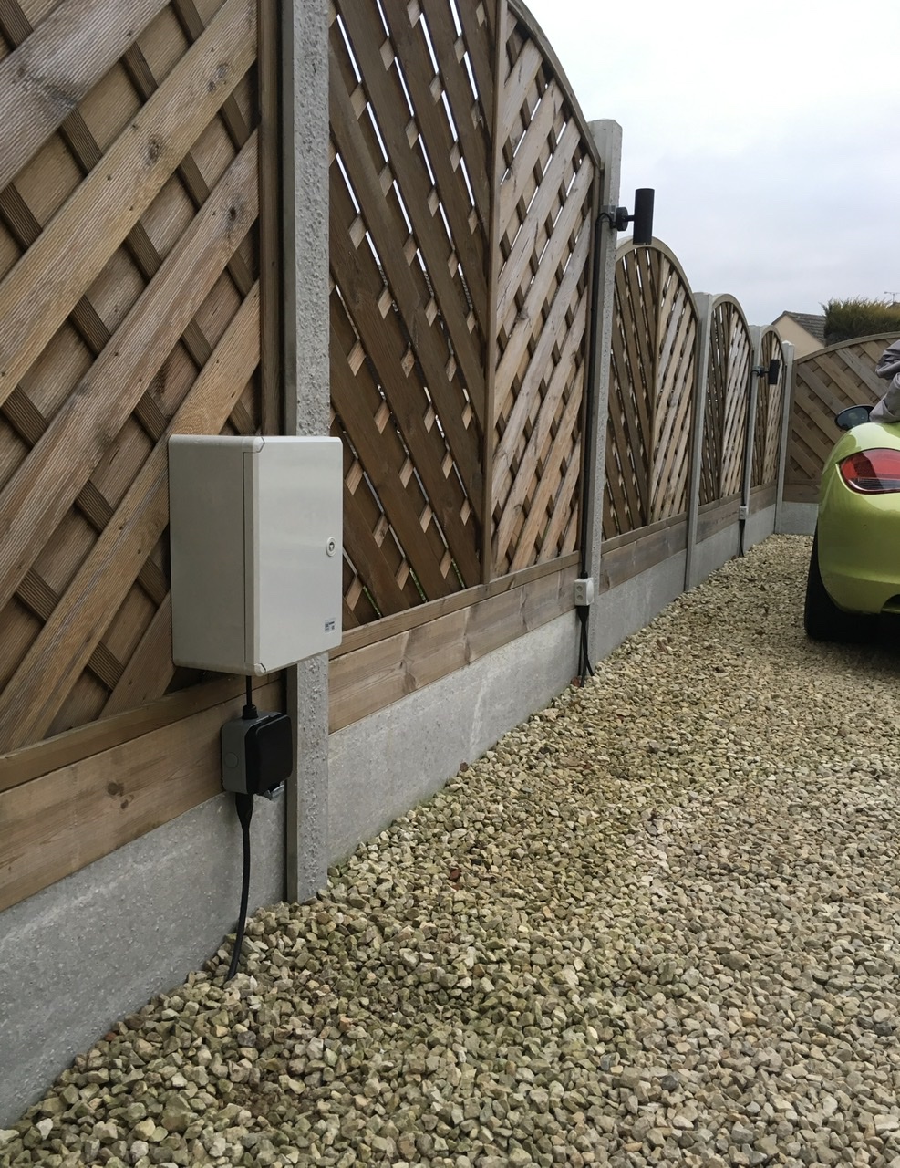

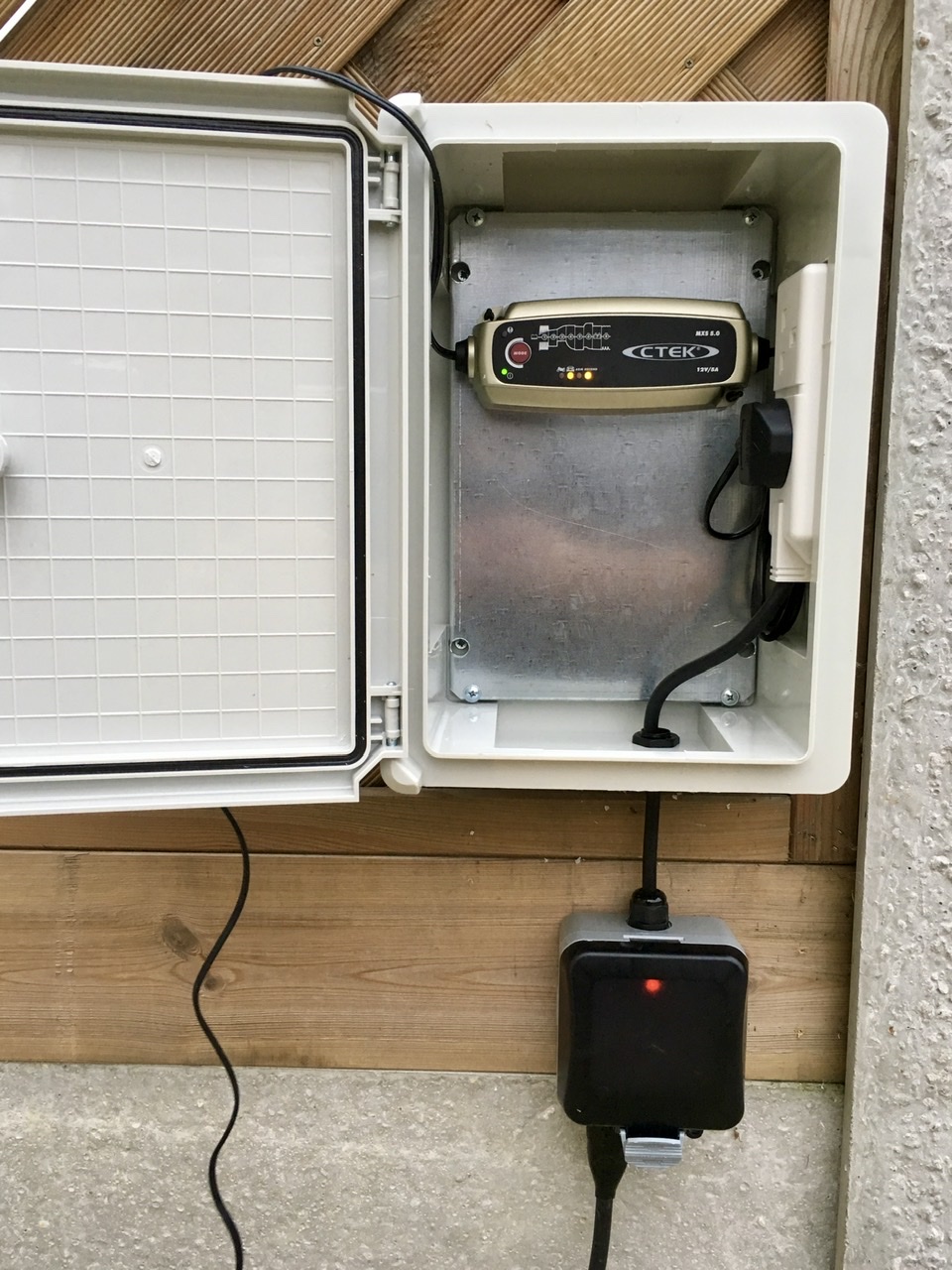

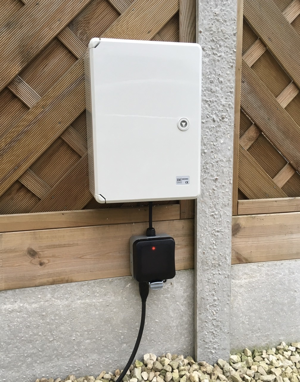

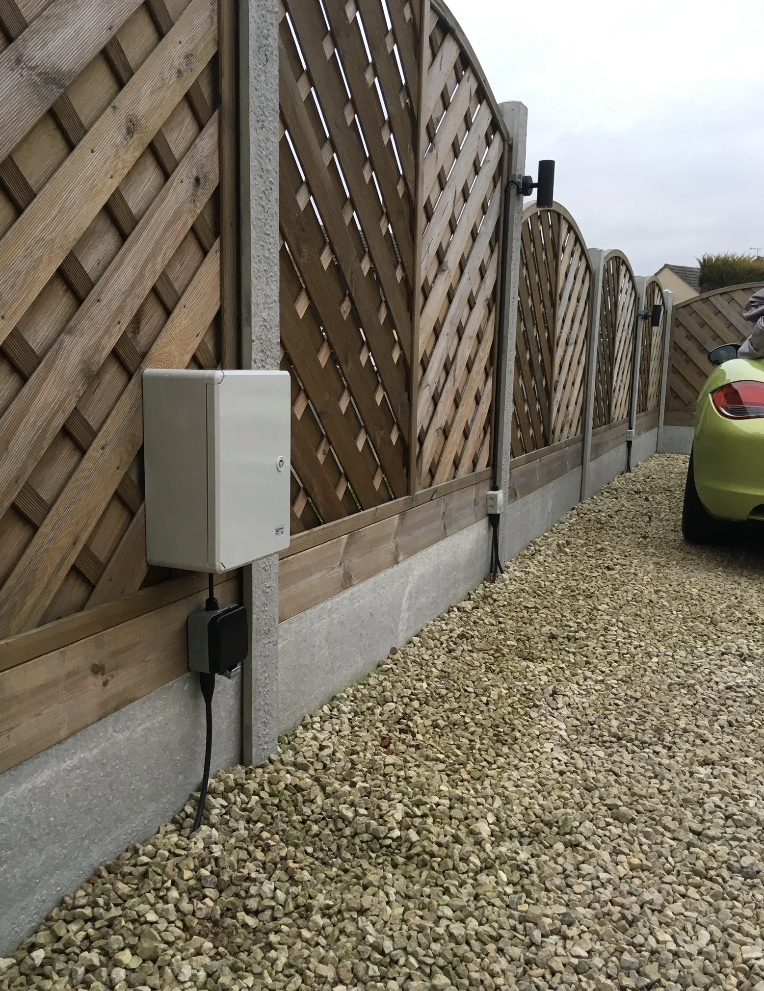

If yours is outside you could still connect it up and make it weather tight. I’m pretty sure @frayz has a nice set up that’s outdoors...
