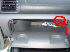

- Where's the best/easiest place to route the iPod/USB cable - glovebox or elsewhere?
My AUX cable goes through the top of the glove box and out the side, its hard to explain so I have created an image (I could only find a picture of a PH1 glove box, but I'm sure you will understand as soon as you look in yours)

I never bothered disconnecting the battery when installing my headunit and had to run the microphone cable under the dash and around the steering column aswell.
As for the aux lead, as already said mine is routed through the glovebox. Gives you somewhere to hide it away aswell when its not in use.
