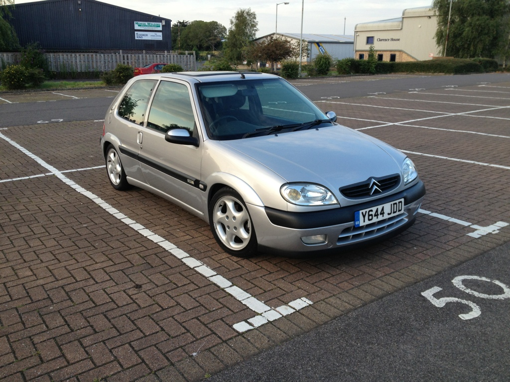

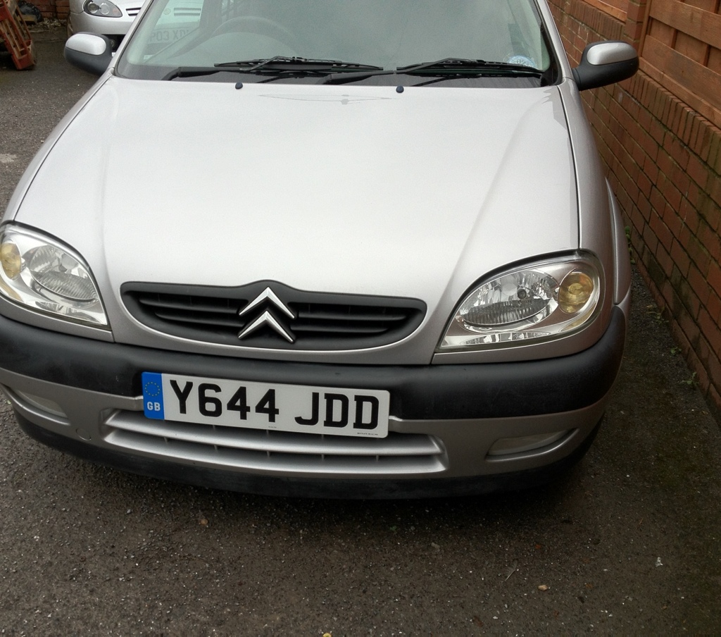

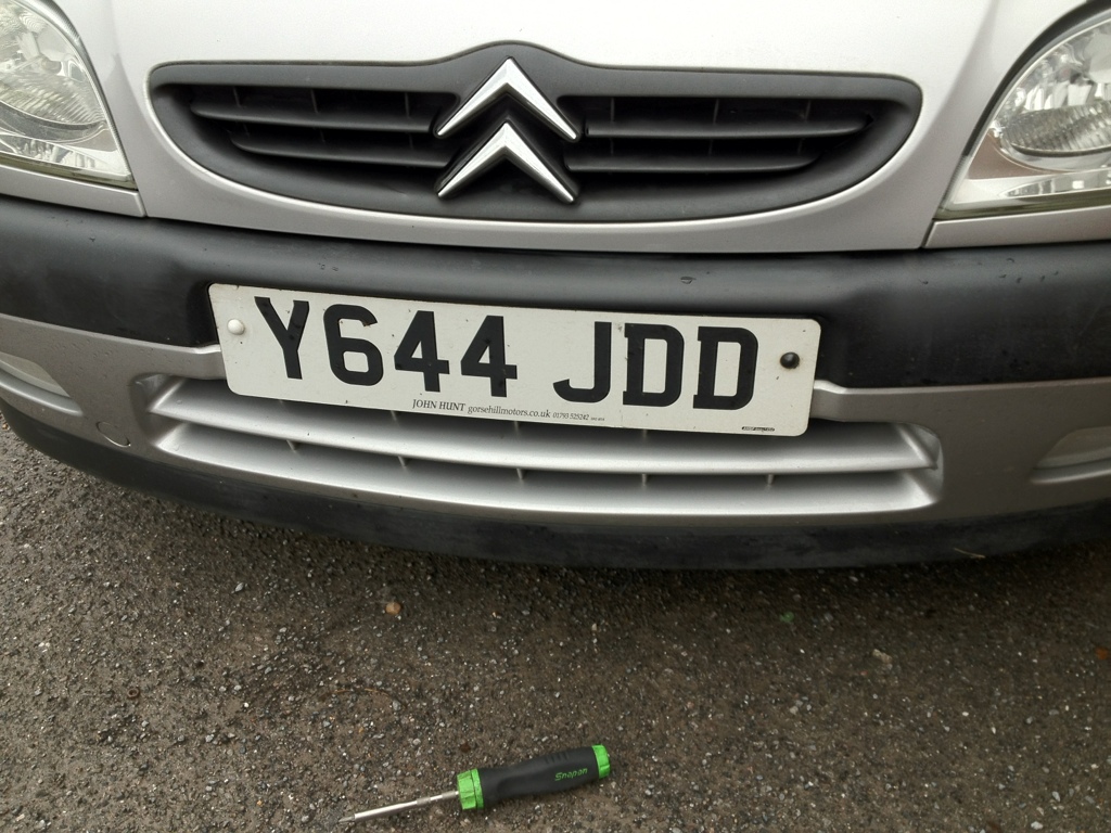

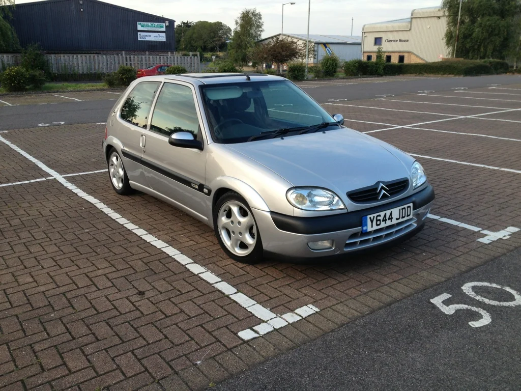

1st job - Number plates.

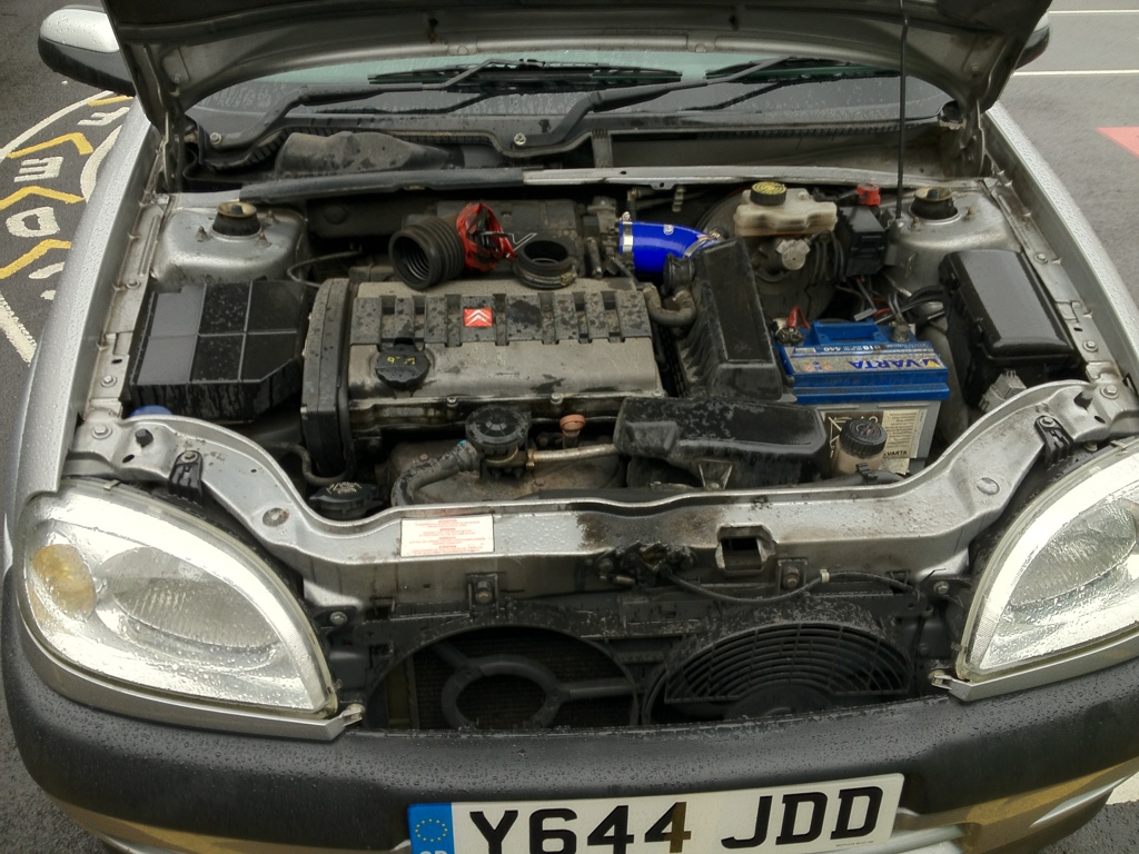

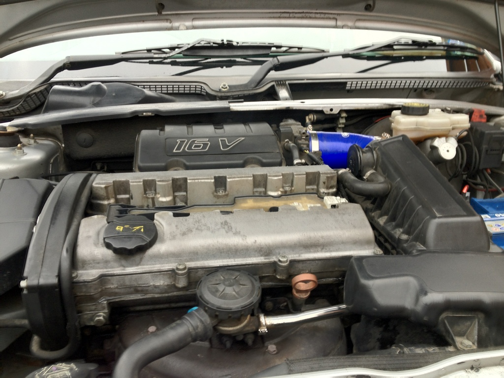

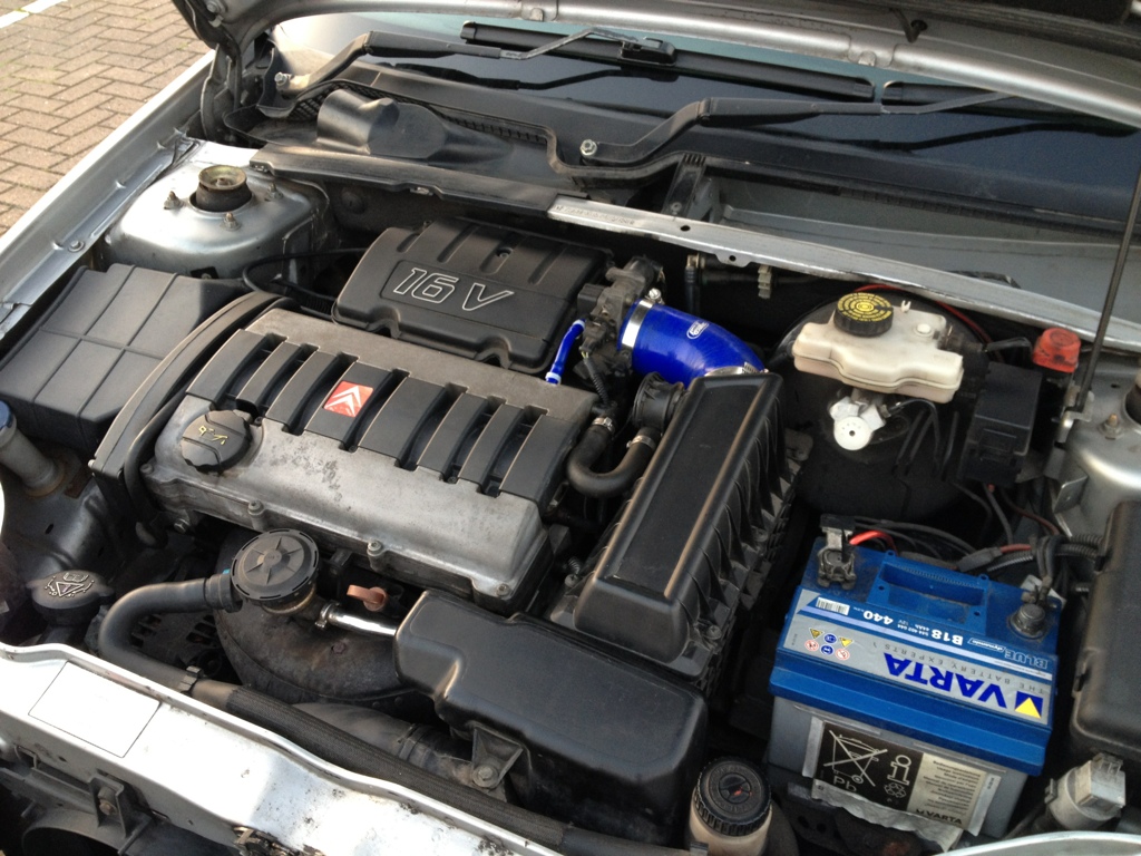

Next up was to replace the 'torn and taped up' induction hose.
Managed to find a suitable piece of Samco hosing in a mates shed...
The bay was dusty/oil ridden and general untouched. As usual, the rocker covers were leaking which was the next job. I also did a spot of cleaning.
Working for a Peugeot dealership, I can usually source genuine parts for a very good price.
Spark Plugs, 5 Litres of Total Oil, Oil Filter, Fuel Filter and Air Filter all sourced for £30 :approve:

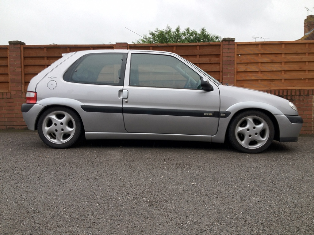

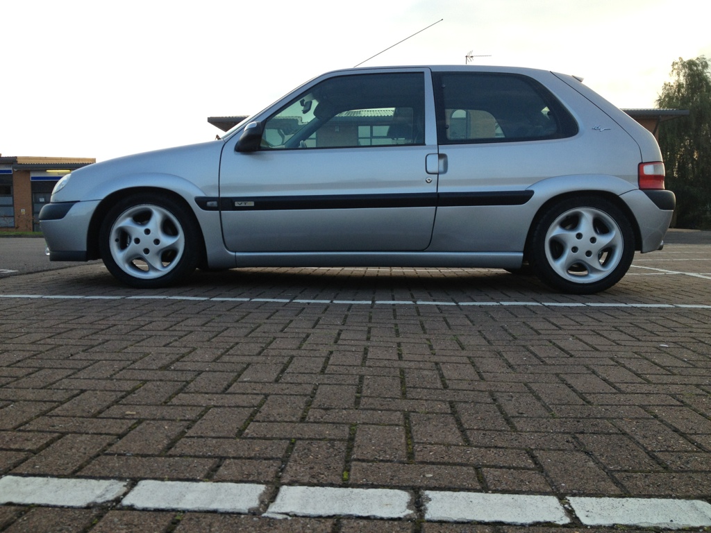

I didnt really fancy the 4x4 ride height, after Umming and Arrring over lowering the car, I managed to blag some New Eibach Springs for £50.
I also replaced the droplinks for £12.
So, here it is after an afternoon of scrabbling around on the floor, combined with alot of swear words and the odd bit of blood (Bloody torsion bars)
Total for parts - £92.00
Saving on insurance for the month - £44.00
There's no real additional plans for the car bar fixing what breaks. Tyres possibly in the next few months.
I've got to say, although the 182 is better in pretty much everyway... this little saxo is hilarious to drive!

Little updates on the Saxo.
I've owned the car for about 2 and half months now without any real wallet opening issues.
I've done odds and sods here, cleaning and generally tidying the car up for its eventual sale.

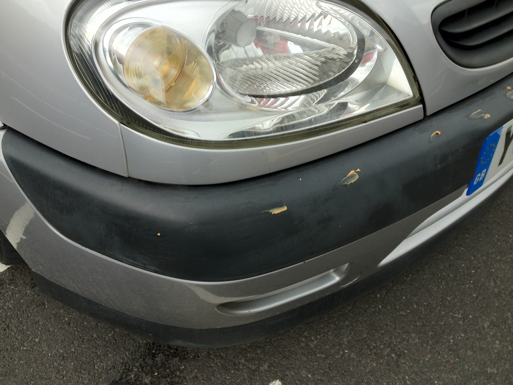

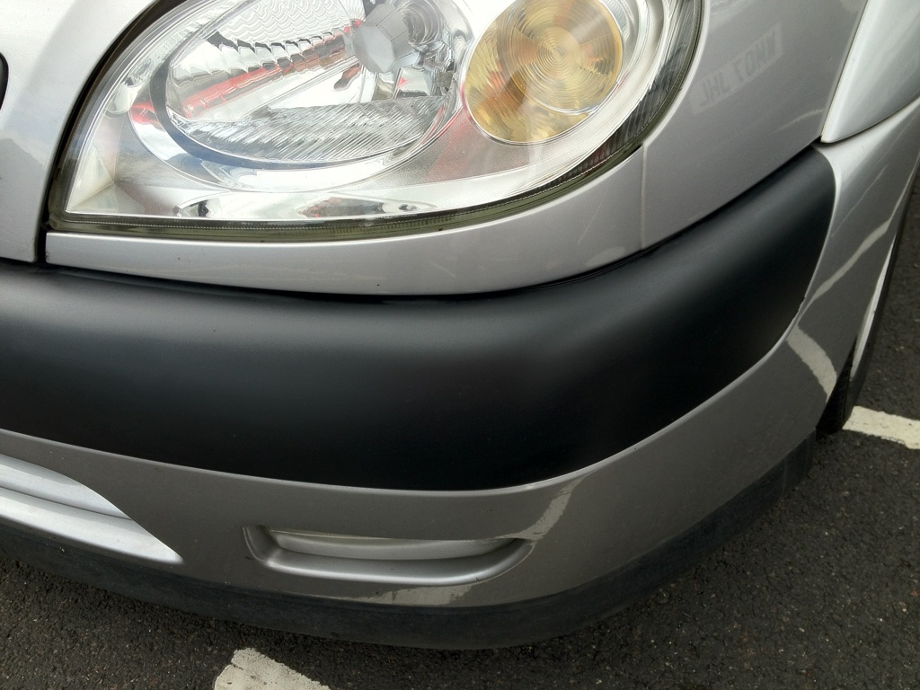

I wanted to freshen up the black trims that had faded.
Cue the 'Smooth Peanut butter' tactic.
Bingo...
Next up, The front brakes had an annoying squeel under braking.
For the cost of nothing, I cleaned and re-greased up the sliders on each side - Fixed.
I also got handy with some caliper paint that I blagged.
Here's some pics of how the car stands after a dash of peanut butter and water!
Note: Another split standard hose replaced with a yet another blagged piece of blue silicone piping lol.

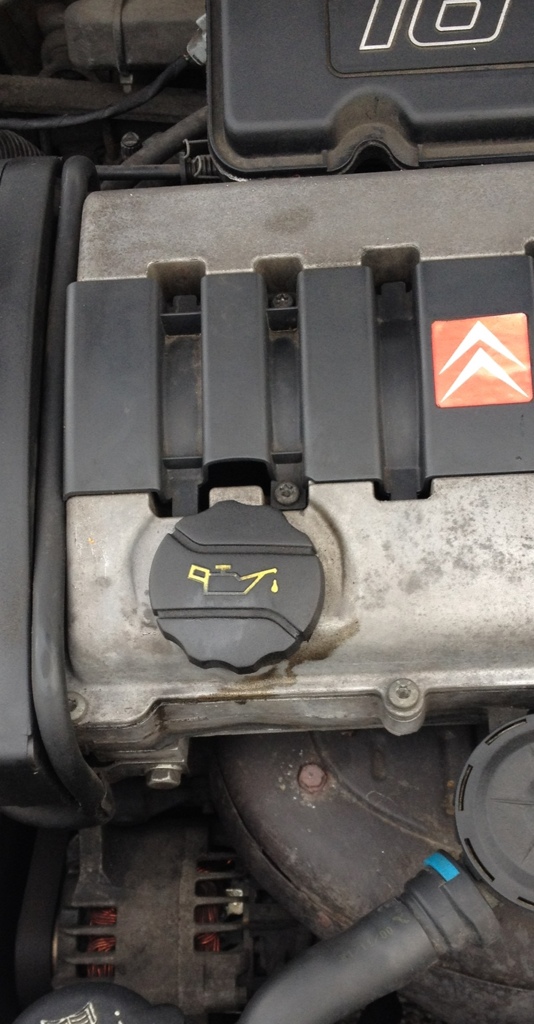

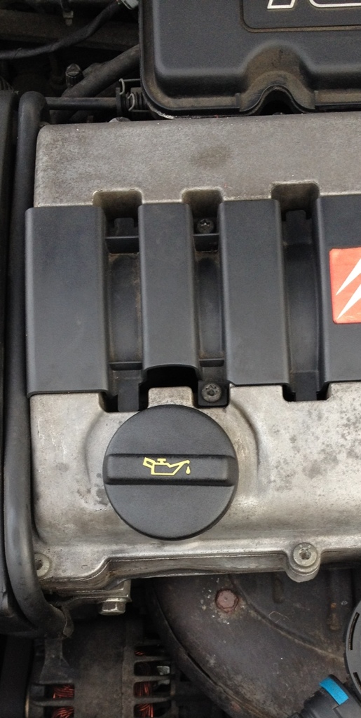

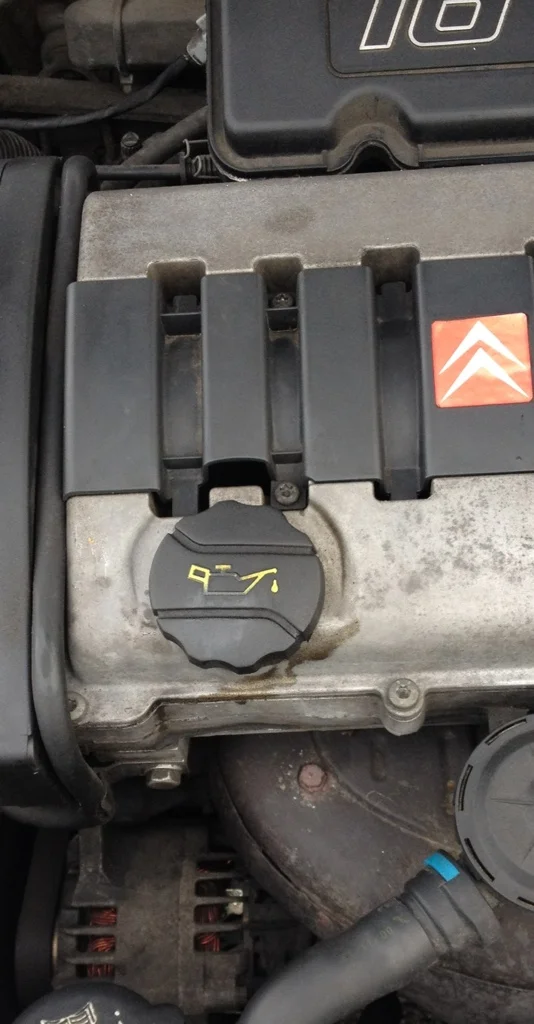

The oil filler cap has been weeping for a week or so and today, through meaning to remember time and time again, I finally replaced it.
Total spend this month - £12 max (Filler cap, Flat wiper blades and Tesco's finest Peanut butter)

I'm going to try that peanut better trick on my rear bumper insert,
struggling to get it out then give it some satin black is just too much effort.

Where did you get that little silicone breather hose from? They are often prone to seeping on the 106s and Saxos.
Good move on the new oil filler cap too, once I changed mine it never leaked again, must be an improved design.

The silicone hose used was a piece from a universal kit that I cut to size.

Can someone enlighten me with the peanut butter on the bumpers please? I gather by the pictures it brings them up?

Little update on the Saxon Martin...

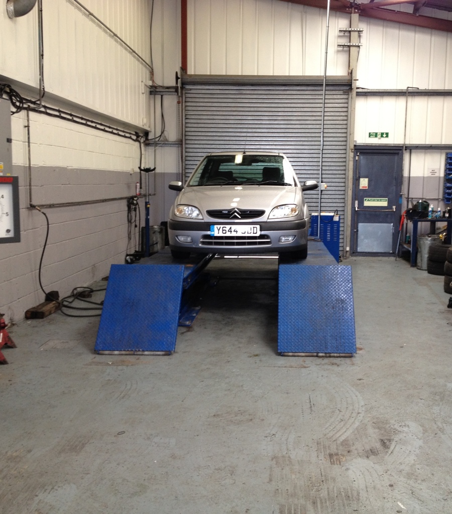

MOT time.
I was quietly confident that it would pass without any major issues tbh. It failed... On 2 tyres! Which in my eyes is a win.
2 Tyres later and it now has 12 Months ticket :approve:
It had one advisory which did frustrate me a little though... Yes the commonly problematic Rear trailing arm bearings!!
I was in two minds as to wether I could be arsed to sort it or not. The main fact being a dont intend to own the little beast at this point next year?!....But, the main reason why I chose to own the little Saxo in the 1st place was due to me working for a Peugeot Dealership (Parts cheap as muck and alot of spares, contacts etc)
Needless to say, a week later and shes now rocking a 106 Gti Rear beam that was refurbed approx 2 years ago, with only 8k since! Result for the cost :eek:
Total cost of the MOT, 2 Tyres and Rear Beam - £146.84

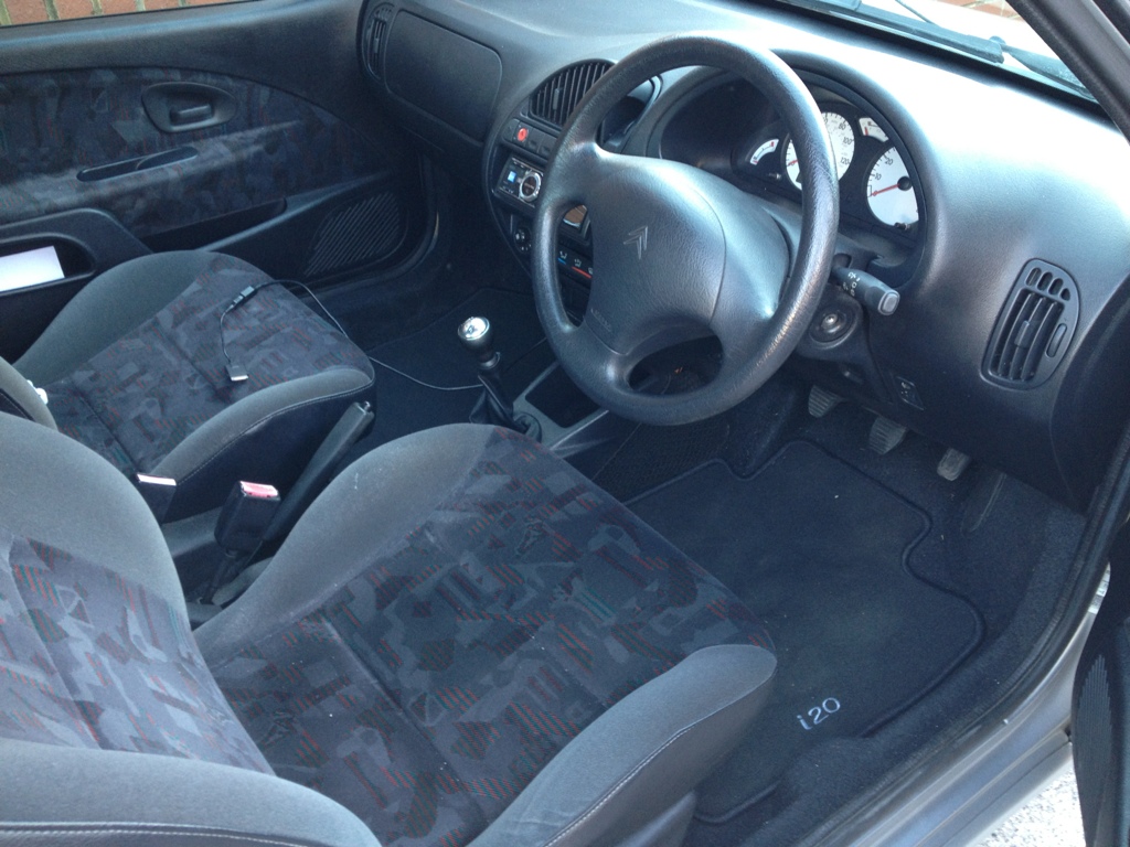

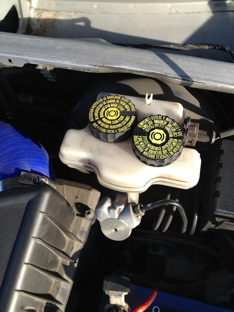

I'd also scabbed a set of Hyundai i20 mats (It had none before) and a new brake fluid resevoir cap (lettering was starting to wear off) for free .

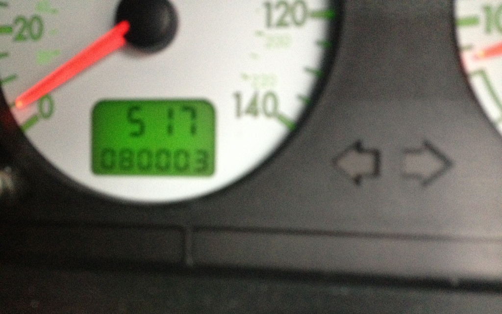

And then today she reached a mini milestone...
Thats all for now :eek:
