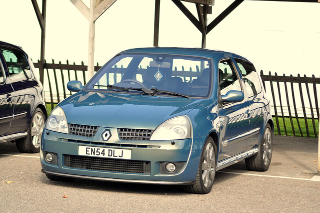

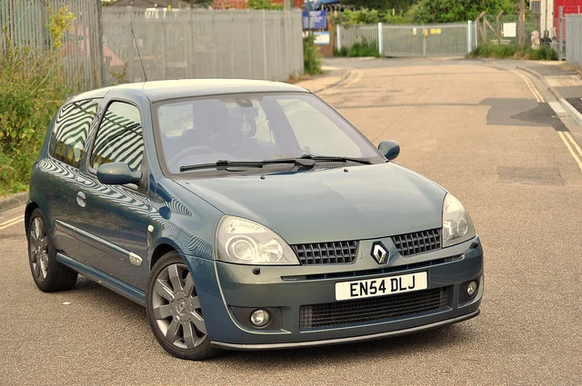

So got the bumper back yesterday from my mate. He took 6 attempts to get the colour right ! He also sanded down the carbon splitter and lacquered it for me, we spent 10 mins building it back up and then fitted it. Spent the rest of yesterday cleaning and polishing the car ready for some sealant today.
The match is pretty much bang on but not 100% These photos are not doing it any justice as they look darker on the bits hes painted but when taking the photos they looked a lot lighter. When walking round the car in the sun you cant tell the difference at all.
For £40 im not complaining 😂

The match between the wing and side of the bumper looks spot on to me.
Hope so...... He didn't spray that bit :)
I should of elaborated a bit more. He only blended in the bits of the bumper that were damaged when i dropped it. So its the bit under the drivers headlight and the bottom of the bumper where i did my best Dukes Of Hazard jump. It would look massively different to the original colour if he had done the whole bumper.

Love how the colour changes so much depending on the light, looking at the pics the match looks pretty consistent. My bumper needs a good tidying up, problem with Nimbus it looks a PITA to get the perfect colour match to the wing and doors etc...

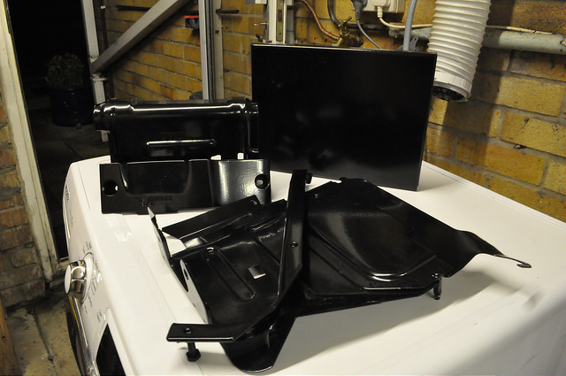

Need to get down to the guys that were powdercoating the last bits of the metals for the engine bay as they have had them for the best part of 3 months !!!! Also at the end of the week il be ordering some new AD08'r for my fresh set of wheels.

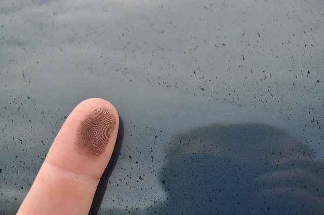

She scrubbed up quite well considering this was covering the back.

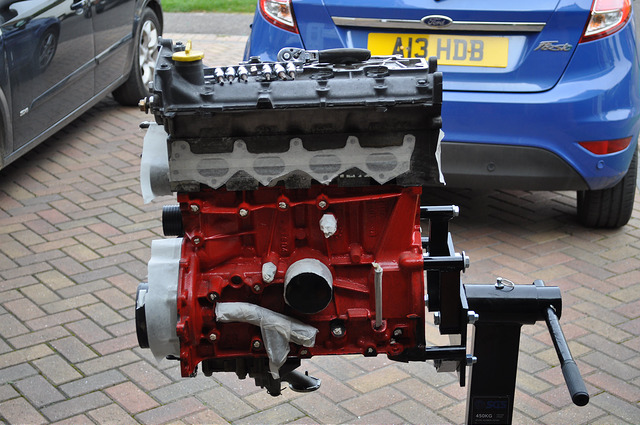

Iv had the last week off as im staring a new job come Tuesday :smile: I planned to get the engine and also at the very least get it on a stand ready to work on. I picked the new engine up on Thursday and yesterday after trying to get a stand off my mate a SGS Engineering one turned up in the post. Me and the old man got it out of the boot and on to the stand yesterday. The first job is to replace the rod bolts with some ARP ones to strengthen it up. Then will be painting the red block a nice standard silver. Where we go from there is anyone's guess. There is no time limit to get the PB back up and running so as said will be taking my time and getting it just so.

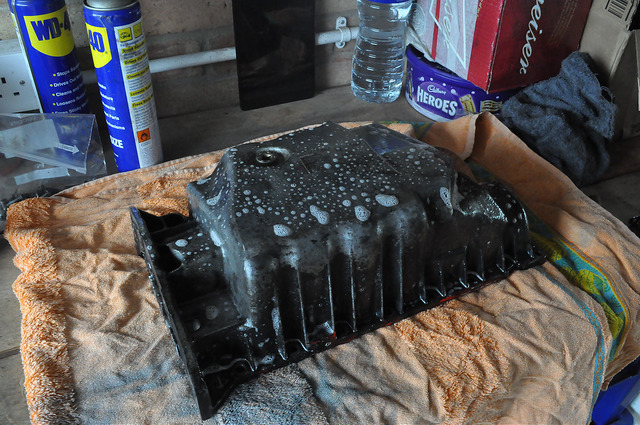

Got the sump off today and gave that a quick clean, will be cracking on with the ARP's next weekend.

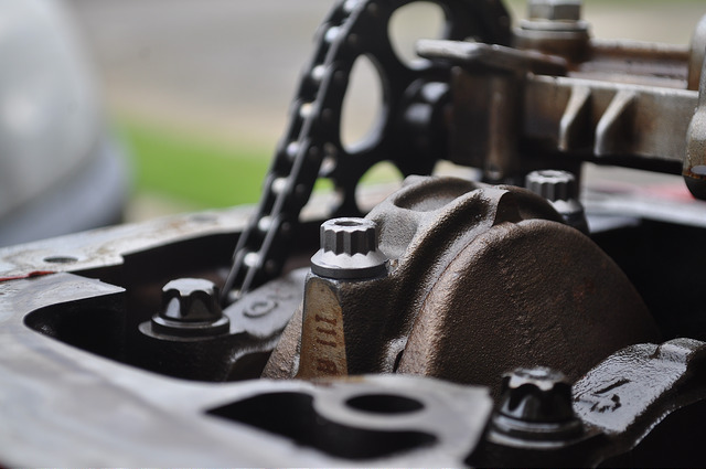

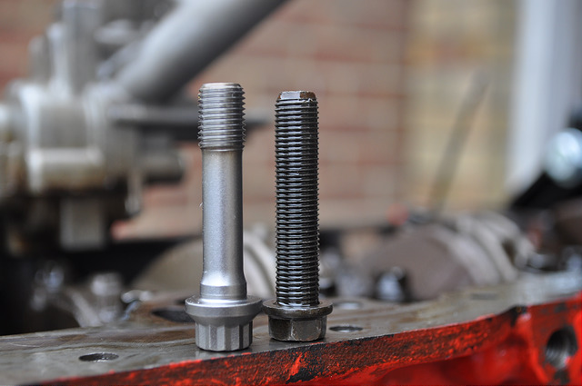

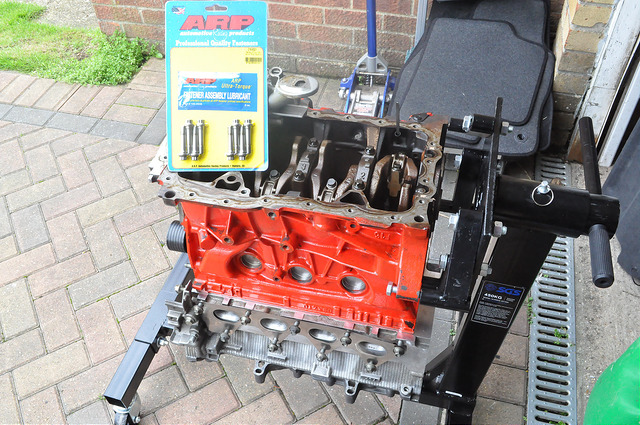

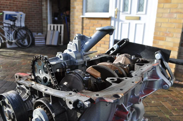

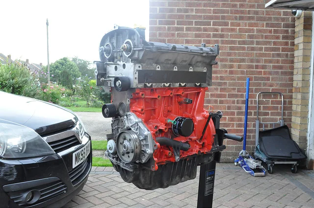

With the weather being pony i got on with the ARP bolts today in the garage. Took my time and got them all changed over, had to hunt around for the correct size sockets though. For the original they were 7/16th and the ARP's are a 3/8th 12 point socket ! Got them all torqued to spec but will be checking them over again with my mate just too make sure.
Old v New
Job Jobbed :)

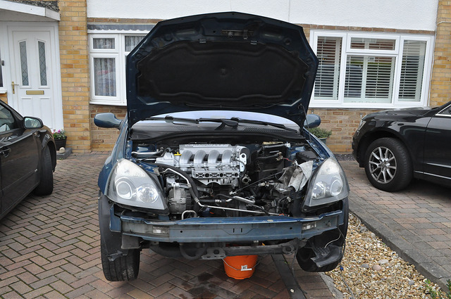

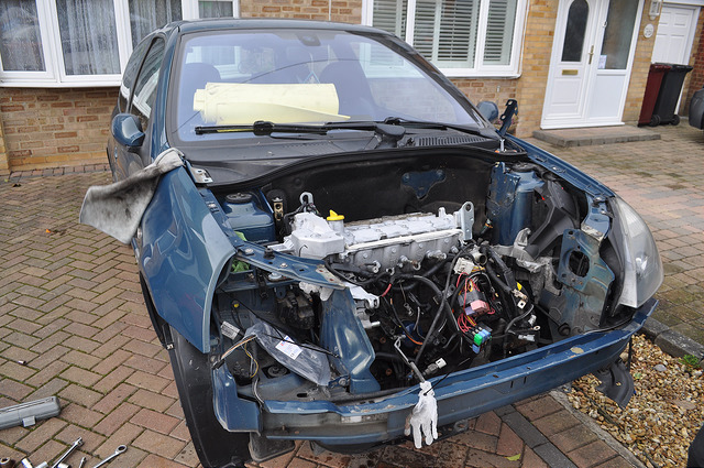

Thought this deserved a little update. Been taking bits and pieces off ready for the engine to be lifted out. These pictures are from a few weeks ago so there is even less in the bay now. Just waiting for a free weekend when my mate can come by with an engine crane and we can lift it out.

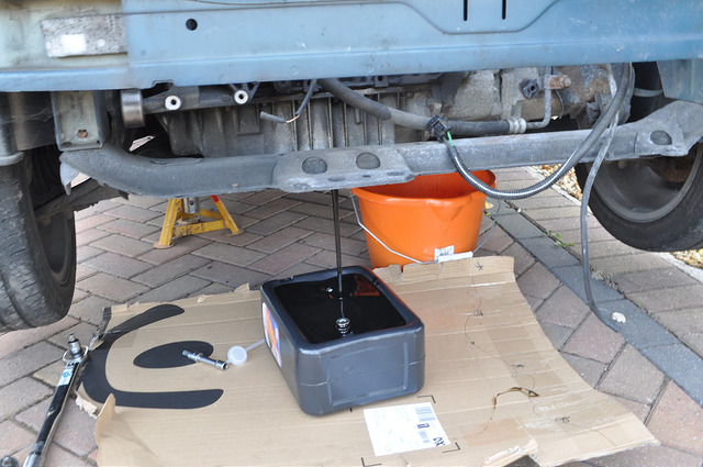

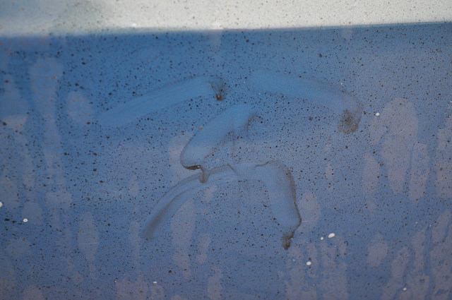

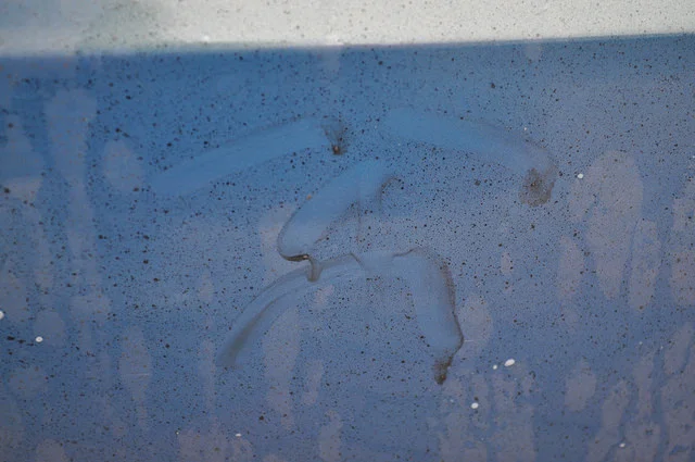

When taking the oil out you could see how badly it was contaminated with fuel. Not only did it smell you could see it separating on the tray!
Since then Fletcher and Tim came over and we removed the gearbox oil, and had planned to take the drive shafts out but didn't have the correct toolage . Waiting on some bits to turn up to start putting the final touches to the other engine. Then its send the gearbox off :smilingimp: and get some other parts off to be powder coated and start to think about freshening up the bay itself.

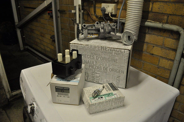

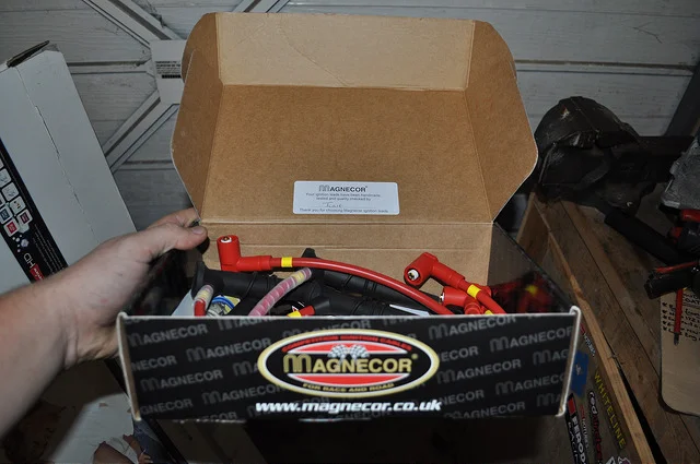

Been getting some of the small bits together now for the engine. Thanks to @Russ_16v for supplying the Clutch, Ignition parts and the new oil pump. Also finally collected after 5 months my ECU brackets i had powder coated ! Also got a 172 inlet to fit to the engine that will need powder coating...I just wont leave it for too long this time :)

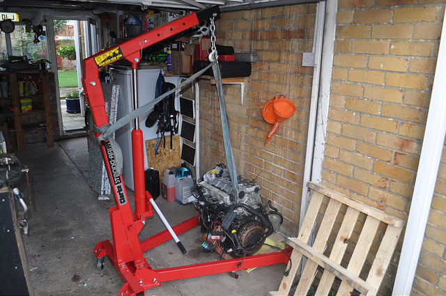

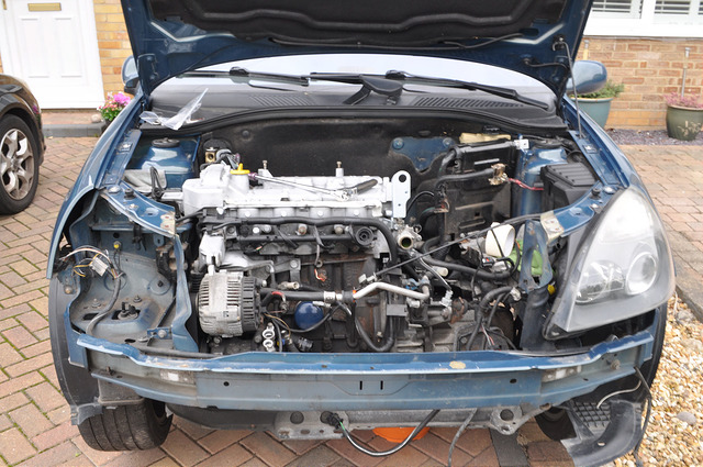

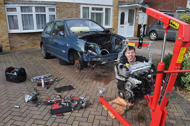

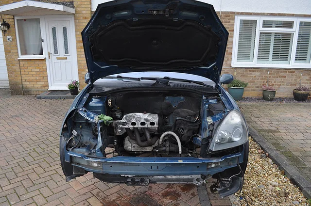

And so yes the engine is finally out :)

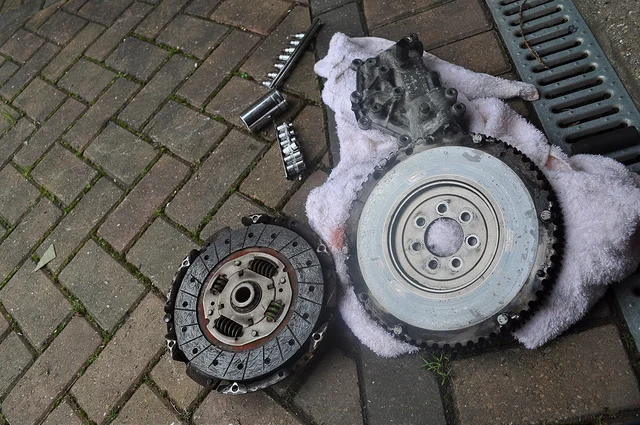

Started by taking the bonnet off for easy access, then the PAS pipes, loom then the mounts. Quite simple really when your best mate is a mechanic :) I was chief tool passer 😅 Came out with no drama's thankfully. Took the gearbox off ready to be sent for its new Diff :) Il start removing bits off the old engine as and when and migrate them over, then when the box is back it will all be thrown back in and trailer-ed down to Dan@SJM.

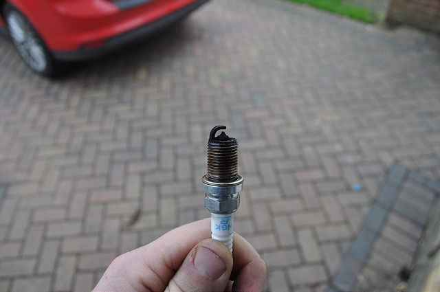

Took out a spark plug to see the damage :frowning:

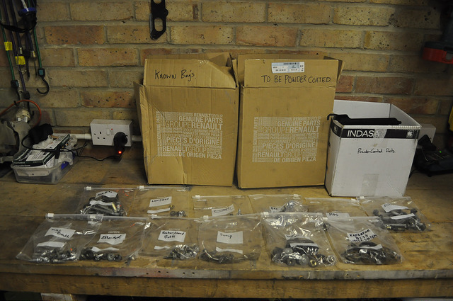

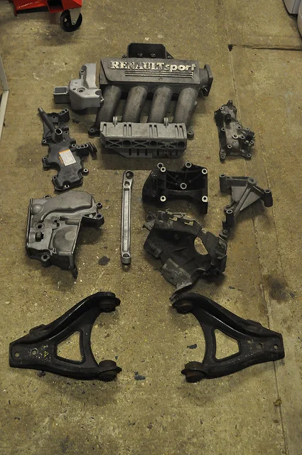

The past couple of days iv been sorting out all the bits and pieces iv removed and sorted through all the bags of bolts and fixings ! Hope i can remember where they all go.

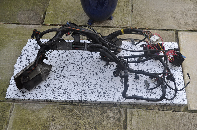

Also been removing all the bolts and brackets off this little lot, ready for powder coating.
Will be ordering some new solid engine mounts and a full set of Powerflex bushes soon. As the engine is out it seems only right to sort all this stuff out now.

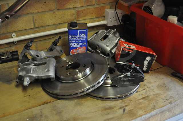

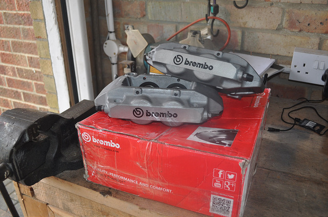

Been a productive weekend on the car front :) Finally dropped the box off to Mark, was meant to be last weekend but i came of my bike in spectacular fashion and was crippled of the rest of the week. While i was there i picked up these beauties.
They aren't painted and are just the standard alloy finish. Thinking about keeping them looking standard. Got the pads and some 300mm discs. Just waiting on some bracket and lines then they can go on hopefully before Christmas.

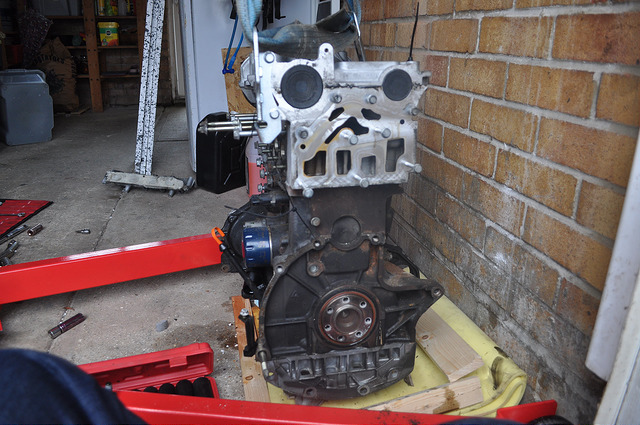

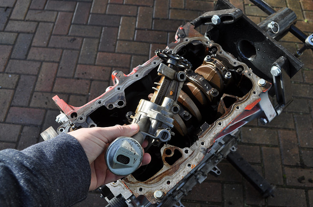

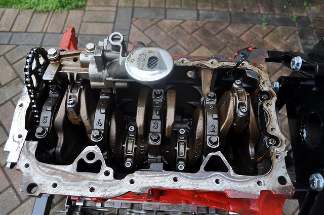

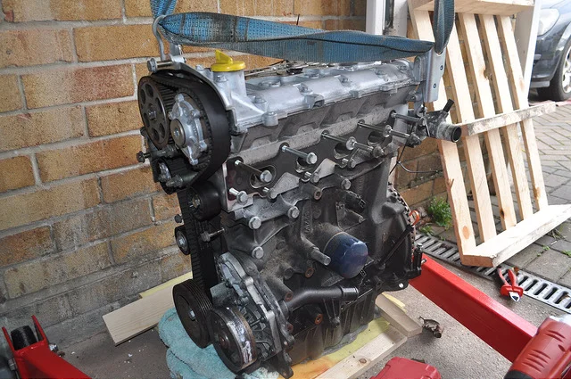

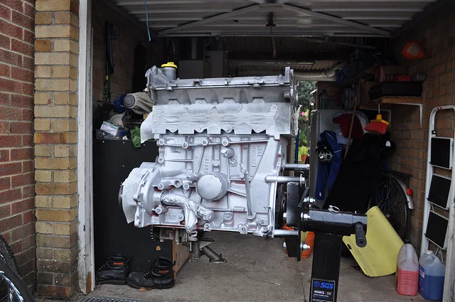

Then this morning iv been stripping the old engine down.
