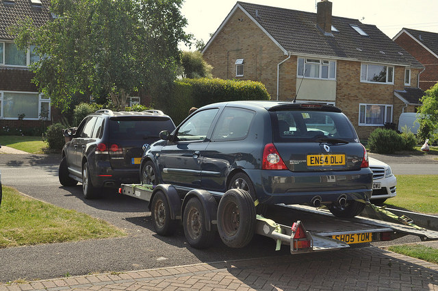

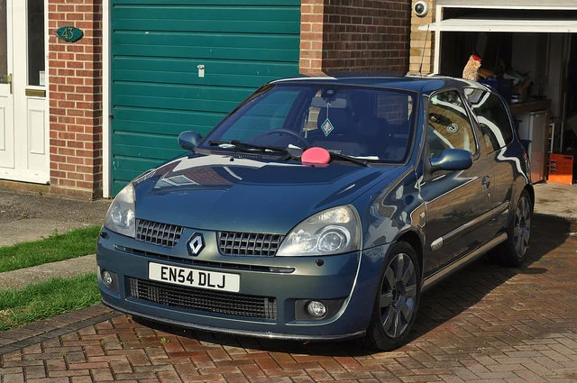

This weekend coincided of getting the car washed and polished ready for @tom172cup to come and pick it up to drop off to SJM.
Saturday i tidied all the last little bits and fitted the bodywork back on and Sunday was wash day.
Christopher.
South Central-South Coast
I last drove this car nearly a year ago !!! Just 2 months shy in-fact !!!
SHES BACK :)

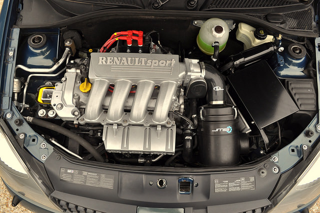

This is the current Spec.
Engine
- 182 Head, 172 block, rocker cover painted silver, block painted black.
- INR Fast Road Cams
- V6 airbox with SFS silicone bend
- Forge Motorsport hose kit
- Magnecor Leads
- ARP Rod Bolts
- Standard Mounts with Powerflex insert
- KTR Ultra Performance exhaust
- Powdercoated inlets, fuel rail guard, and ECU cover/brackets
- Bosch S4 battery
- New Coolant and Power Steering fluid bottles
- Zinc plated bolts
- Mapped by Dan@SJM

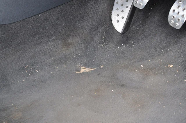

With OrigneRS just round the corner i want to get the PB looking its best, with a priority of getting the interior sorted 100%. Need to source some new Mat's and could really do with a new front carpet as original has a hole in it. Also would like some new seats. Have had Trendlines before and wouldn't of minded another set. Not the most supportive seats in the word but in the PB i think they would of set the car off quite nicely. Finding a set of theses before ORS would be a tall order.

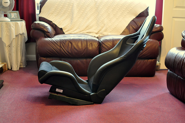

So next weekend im collecting a pair of Sportster CS from @dablk :grin: Perfect for what i want, Supportive, looks awesome and will add a bit of individuality to an already rare car.

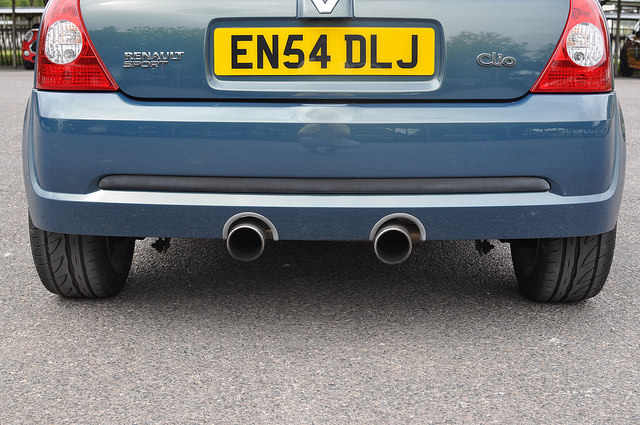

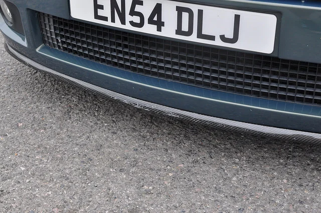

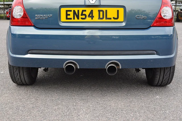

Also need to sort out a new splitter is iv cracked and scratched the Carbon one :( Will probably go for a Fabia one. Also really need to sort the exhaust alignment. Looks like it needs new mounts. Whats the opinion on them these days ? Do powerflex now do something ?

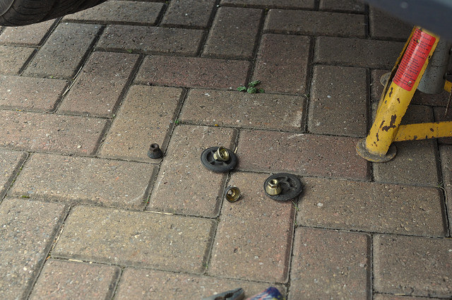

Photos of the bits that need addressing.

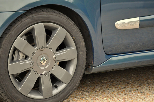

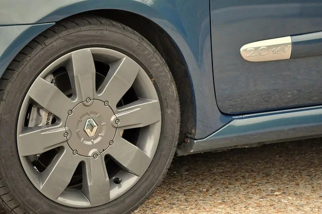

She is scrubbing up well so far, Been keeping on top of the bake dust on the new alloys. Needs some protection on the paint to mask all the small scratches. Also need to sort the minor dents it picked up when being off the road. In the long term a lot of the paint will need addressing, but that is some years off yet.

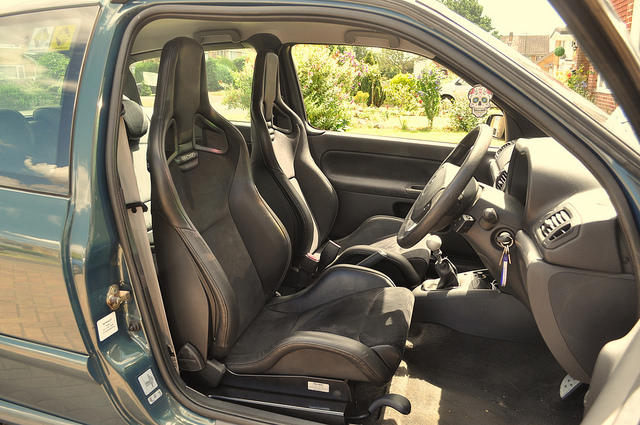

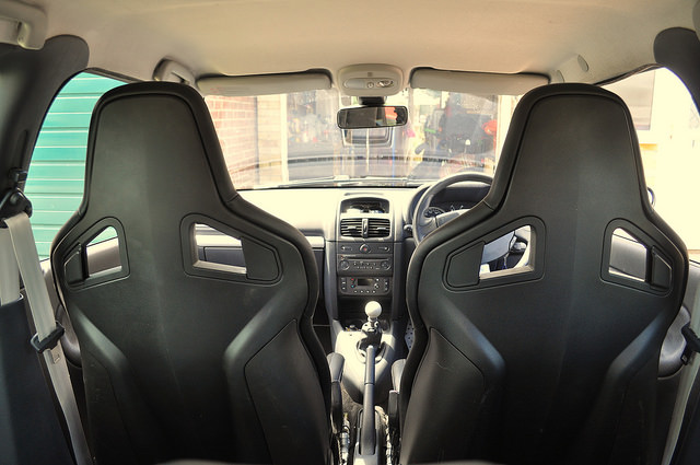

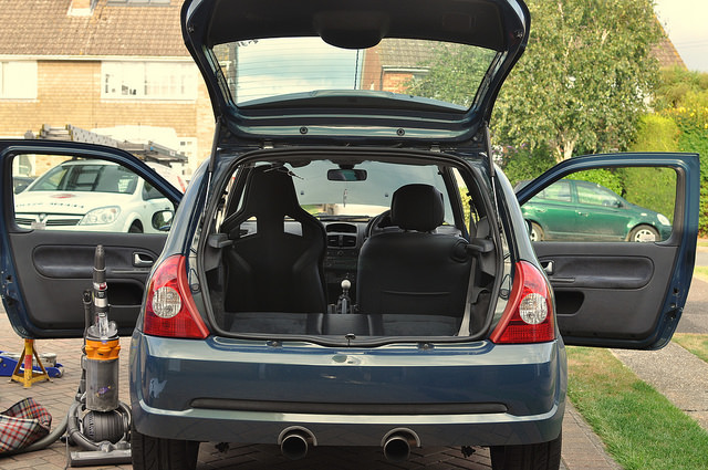

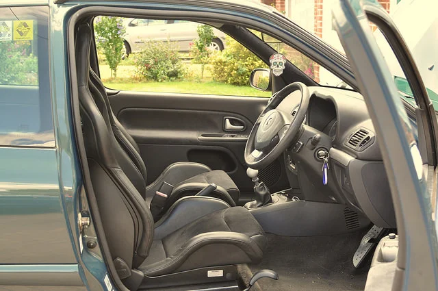

Yesterday started off with picking my co-pilot up at 4am and making our way up to Haydock to meet @dablk and collect the seats. No traffic on the journey up thankfully and only need to make 1 unscheduled stop as the washer fluid was empty. Got the seats nicely fitted in to the back and headed back sown South. Stopped off at @Tim. for a quick catch up and then too the back roads back to mine. Nice drive back again no traffic :)

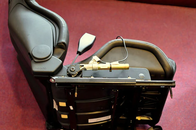

Got them home and had not planned to fit them until next weekend. Couldn't wait that long so started on the passenger seat. Started by fitting the JonFoz frames and getting the old seats out.
Bolts removed from the original seats all ok. Have had nightmares with doing other sets before and was dreading it. All came out without any issue thankfully.
Got the Pretensioners fitted along with the rails first off, all fitted on nicely with no problems. Great design the lower adapters, Well recommended.
Got it fitted in but as you can see its tilted off to one side slightly. With being up since 03:30 that morning and considering it was 7pm i called it a night.

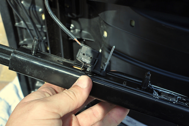

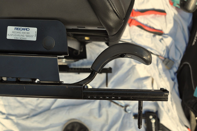

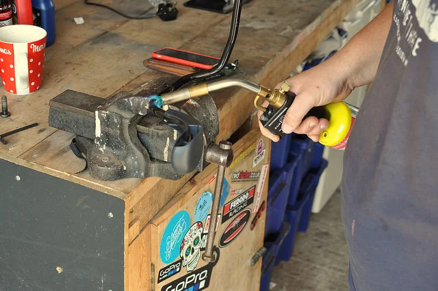

Enlisted the help of @Fletcher this morning and set about leveling the passenger seat off and also 'Modifying' the slider rail handle as it hit the bottom of the seat as locked the seat in one position. Fire fixes everything.
Turned our attention to the drivers side and found this with the pretensioner. Had to drill off the old rivet to remove the rail so refitted with a nice black one.
No level adjustment really needed on the drivers, just removed both spacers on the tunnel side and used a washer. There not 100% level but its hardly noticeable.
All in all there an amazing seat, the driving position in absolutely spot on now. Feels a lot more comfortable and secure. Going to be taking the car the Rentec soon so Mike can swap the steering wheel and give it an oil change in preparation for OrigineRS.

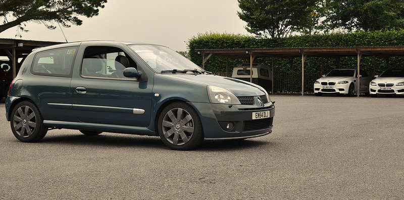

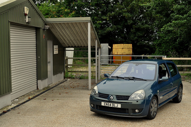

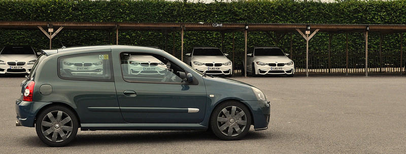

Had this all pretty much spot on for ORS yesterday. Had sorted the exhaust, cleaned it up nicely and put some finishing touches to the car. As it was going out on track fro the first time also i gave it a good check over last weekend and also Friday night. Topped up the coolant, topped up the oil and doubly checked over the car.
Arrived at Goodwood with plenty of time too spare. Got setup and signed on. Passed noise testing at 94db and went for the drivers briefing. Was second out on track with Tim leading. By the 4th corner he had gone :) Took it steady the first lap and then onto the second. Felt amazing, diff doing its job perfectly, engine pulling very hard through the corners, felt great about the following sessions.
Came out of the chicane on the second lap on to the pit straight in 3rd. Foot down and already a noticeable drop in power, 4th its really really not liking it. Before i know it the engine in tapping around 2k. Immediately get it on to 5th and coast the rest of the lap. Limp it back to the pits :(
Unsure what has happened but seems like it got starved of oil. Not happy as i had planned to get it to Rentech for Mike to give it a oil change before ORS..... How im regretting that now :rage: Will be getting it to Mike ASAP to see whats the damage. As you can probably see i hae sunk a lot of money into this in the past 3 months so it might be off the road for a while. Especially if it need major works.
