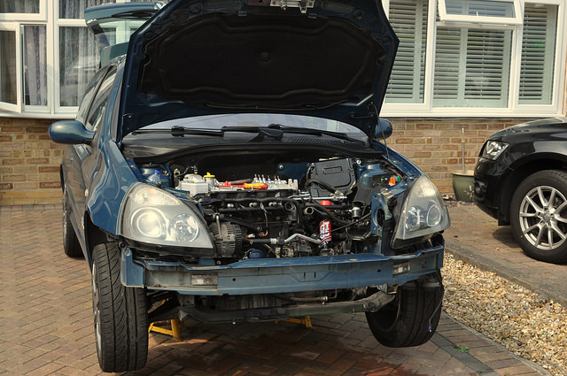

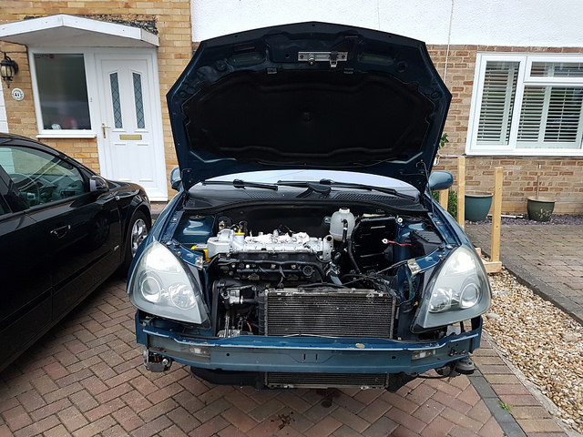

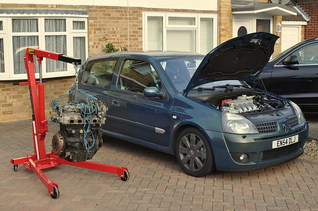

Will hopefully be at the point of taking it out this weekend. Tidy up the new one, Swap bits over, Get new one in.
Christopher.
South Central-South Coast
Haven't really done much with it this weekend, Have lost all enthusiasm now.
Anyone want to volunteer to come remove the old engine and put the new in ? Once its in id like to take it to Rentec to get finished then decide what to do with it.
Christopher.

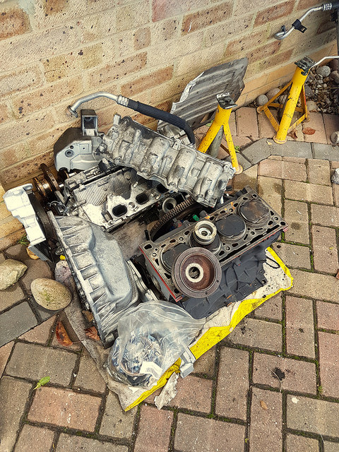

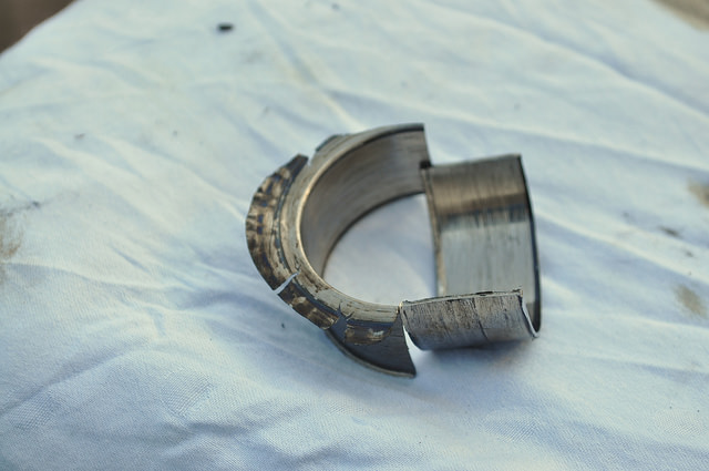

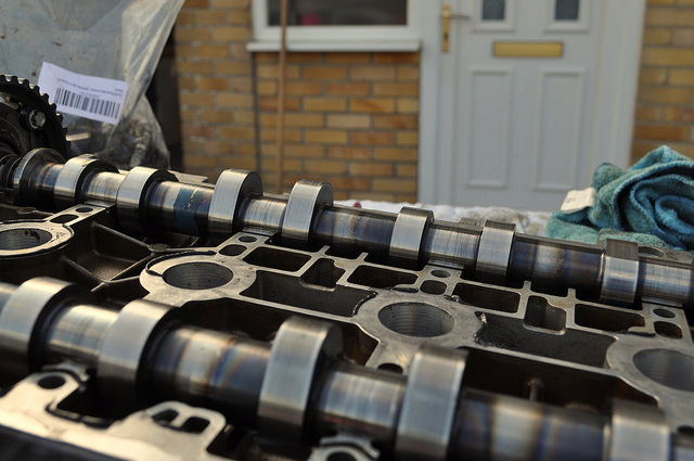

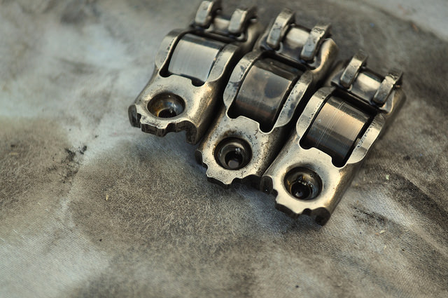

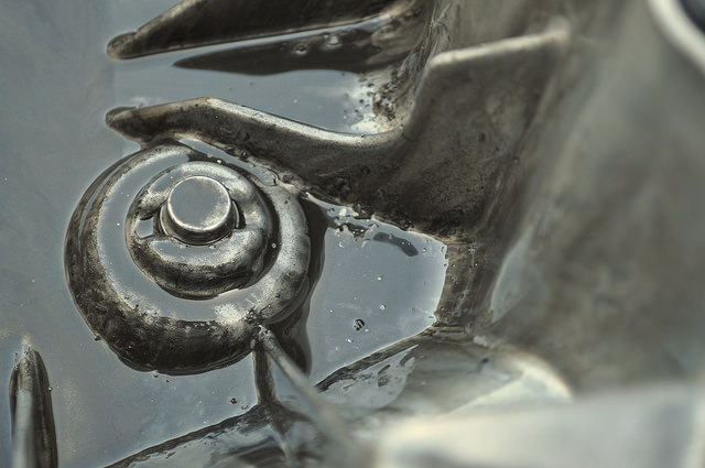

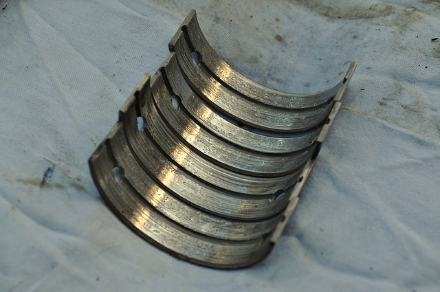

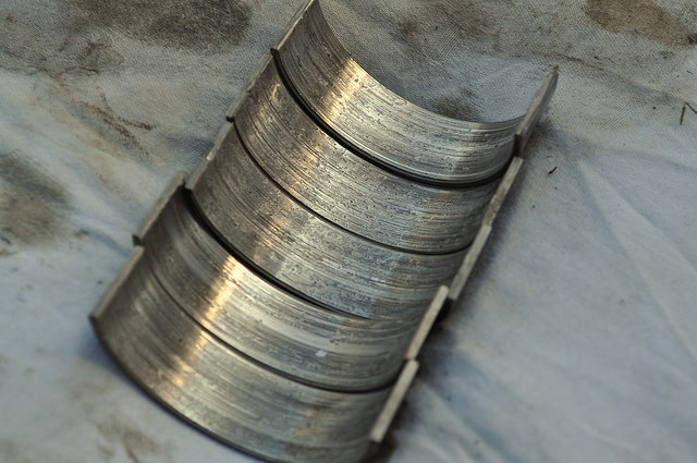

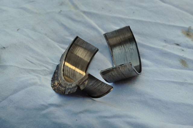

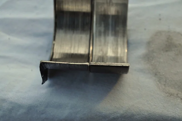

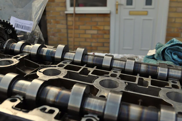

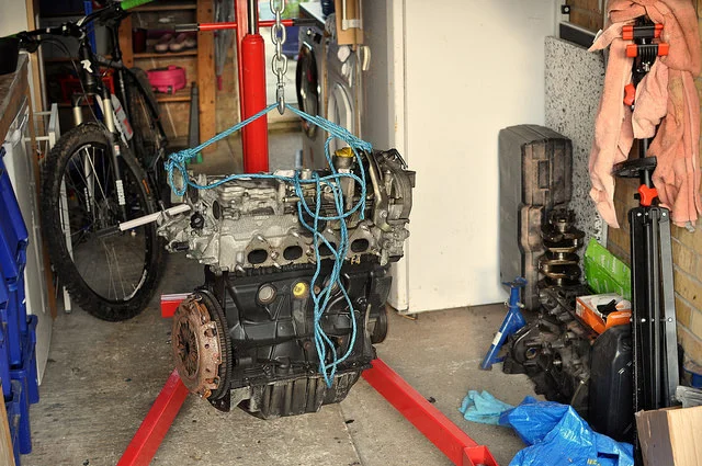

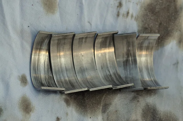

Old engine is out, new is in and we stripped the old one to inspect the damage. Only pictures of the damage today. Will be getting it all put back together tomorrow.
Tiny bit of metal floating around in the sump.
Doesn't show but the cams have some light scoring.
Pitted and scored
Propper job.
A not so goosed one for comparison.
The bores were very slightly scored but a lot of pitting in them. The remaining oil in the sump was grey.

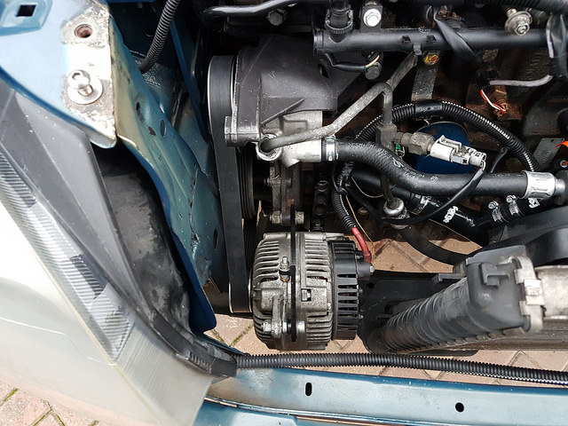

Just the driveshafts left now, then all the fluids and on Saturday it will be fired up :tired: Got hold of a PMS Ac delete kit and fitted that last weekend with everything else.

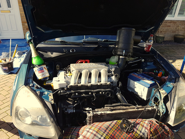

And for the Second time..... Shes Back :sweat:

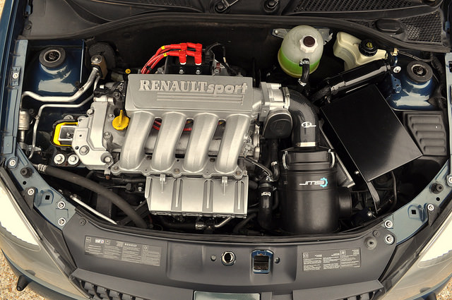

Mate came round to button up the shafts while i sorted all the fluids out. Whipped inlet on and she fired right up :) Sounded a little rough for the first 5 mins but then soon settled down. Got the rest of the bodywork back on along with the wheels and took it out for a little test run up to the test triangle and back. Car felt Aok, gears selecting well driving fine. Came back and pulled up to a horrid smell, Coolant dripping ! One of the Forge hose had come loose on the firewall. Done it back up and double checked all the other clips and filled it back up. Ran it up to temperature again and then took it for a little 5min spin.
Then this morning we took it to Goodwood Breakfast club for its proper maiden voyage. She ran perfectly. Took it back out for a longer run earlier and took some pictures.
It will be getting a full on detail next weekend, Will also tidy up the engine bay as it looks terrible compared to what it used to with the 182 inlet.

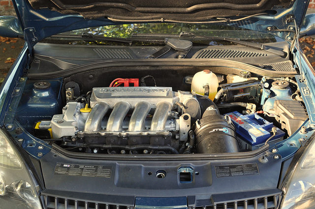

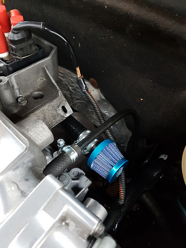

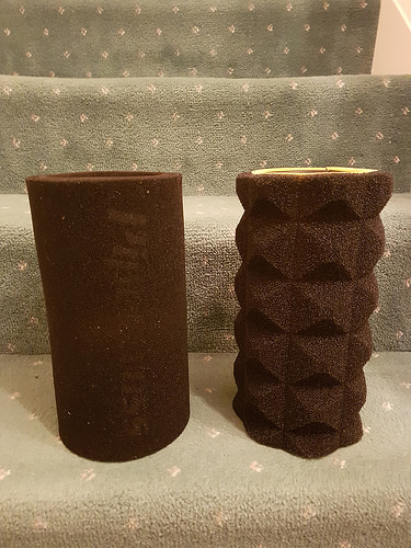

Have sorted out some of the little bits in the engine bay last week, New Airfilter, New Breather filter and sent the 172 inlets away to be powder coated.
No picture of the inlet but it will be a darker version of the old one :) Should look good once its all put together.

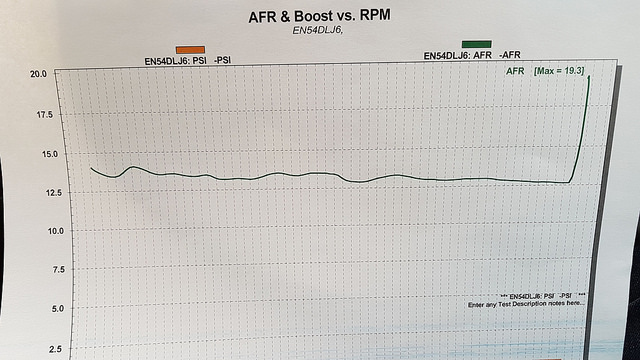

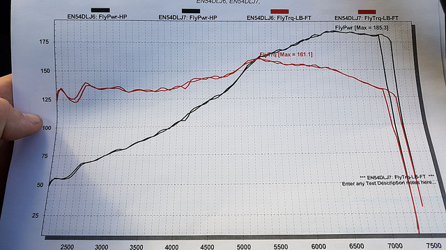

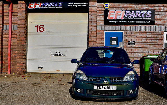

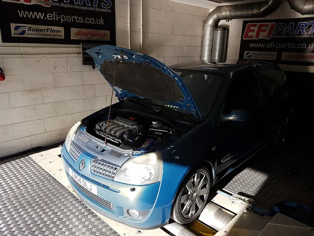

So early yesterday i set off to EFI. Got there all ok no issues coming from the PB thankfully. Met Chris and he went straight to work fixing the EML light by soldering on a resistor to the old carbon canister wiring. After logging the old map he went straight in to a pull on the Dyno. Made 182bhp straight away :) Later explained the top end mapping was spot on and a credit to Dan as the AFR only needed tweaking slightly. In the mid range it was a bit all over the place. Tidied it up a bit and did another run. 184bhp this time. Some more little tweaks and she finally ran 185.3BHP :) Really chuffed with that result. Chris was a little disappointed he couldn't get any more from it but i was happy. He did some more pulls to check all was Aok.
Chris then deleted the Airbag and service light that was pulled up when swapping to the Recaro's. Got it off the Dyno and handed me the keys. Took it for a quick test drive and it felt great.
Can't recommend Chris enough really. Absolutely top of his field.

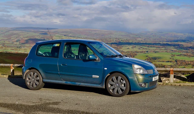

Had been wanting to do at least once decent driving trip this year !!!! With having to replace 2 engines and all the time taken this year iv driven my car......... 1079 miles !!!!! I thought it was a little more but iv really lost track of how long we were working on it ! After spending the night just out side of Welshpool i had a plan of where to go and just headed out towards the Elan Valley.
Was a little cold in the morning though.

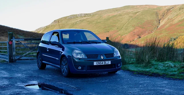

Headed for the Elan Vally and came down the road through Cwmystwyth stopping off for some photos along the way. The roads were a touch icy where the sun hadn't been so was taking it relatively slowly.
Had previously headed down at the top of the reservoirs but this time headed straight for Rhayder then down towards Brecon.
Spent a little while driving round the beacons and really started enjoying the car. The smoothness of it now is lovely, Diff working very well and the tyres playing there part quite nicely. Have noticed the rear shocks are on there last legs though. Hitting a bump mid corner would send the back out a touch, nothing too bad but enough to make me quite weary of pushing on. Will get them sorted asap. Took a couple more pictures and then headed home :)

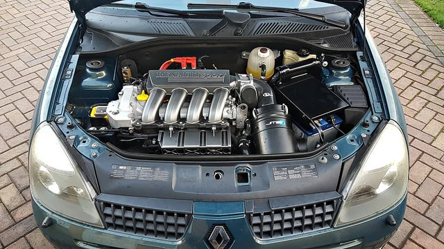

Engine
- 172 Engine
- V6 airbox with SFS silicone bend
- Forge Motorsport hose kit
- Magnecor Leads
- Standard Mounts with Powerflex insert
- KTR Ultra Performance exhaust
- Powdercoated inlets, fuel rail guard, and ECU cover/brackets
- Bosch S4 battery
- New Coolant and Power Steering fluid bottles
- Zinc plated bolts
- Mapped by EFI Parts. 185.3bhp/161.1lbft

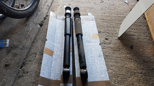

As previously mentioned the rear shocks needed replacing. I did think about doing it after Christmas but after a drive out last week the car was all over the place when pressing on. Going over a slight depression in the road would unbalance the car a fair bit, then the diff would lock and pull wildly in any direction the wheels were turned. At one point the car felt like it jumped into on comping traffic !!! Ordered a new set from Russ (£40 cheaper than Ktec) and then fitted them this weekend. The cars now back to its predictable self :)
The old set wouldn't even compress

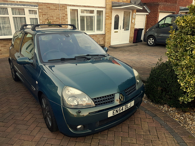

Cleaned the car and as it was quite bright i went out to grab some pictures.
PB really shining through :cool:

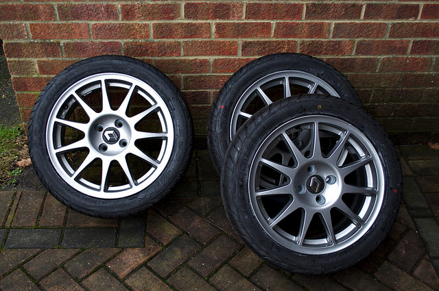

Since it came back iv ordered a new set of DS1.11 and new discs. And also some Federal 595RS-R. Got the rubber fitted at my mates but he messed one up so iv got 3 facing 1 way!

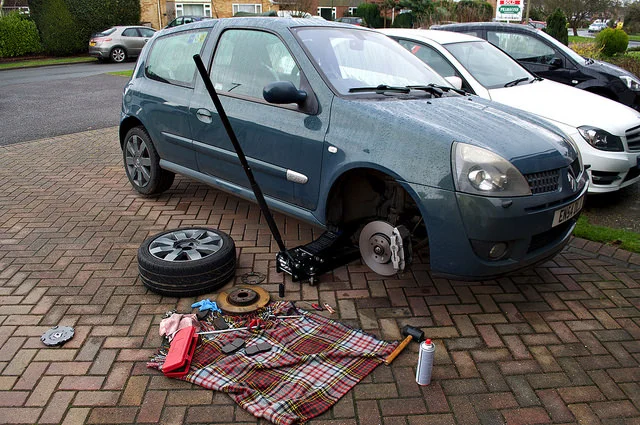

Also set about fitting the discs and pads today along with the front wheels. All went alright.

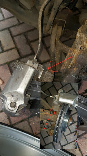

Once i finished i noticed the passenger side wheel was spaced out more ?? Took a while to recognise whats happened.
When the brackets are fitted the passenger side was back too front. Instead of correcting the wrong one i went to the drivers side and swapped that round too.. Thinking id get them both spaced out too eliminate possible clearance issues. Thankfully Tim pointed out to me they would drag the Pads and cause problems with releasing the disc correctly. Will swap them back next weekend.
