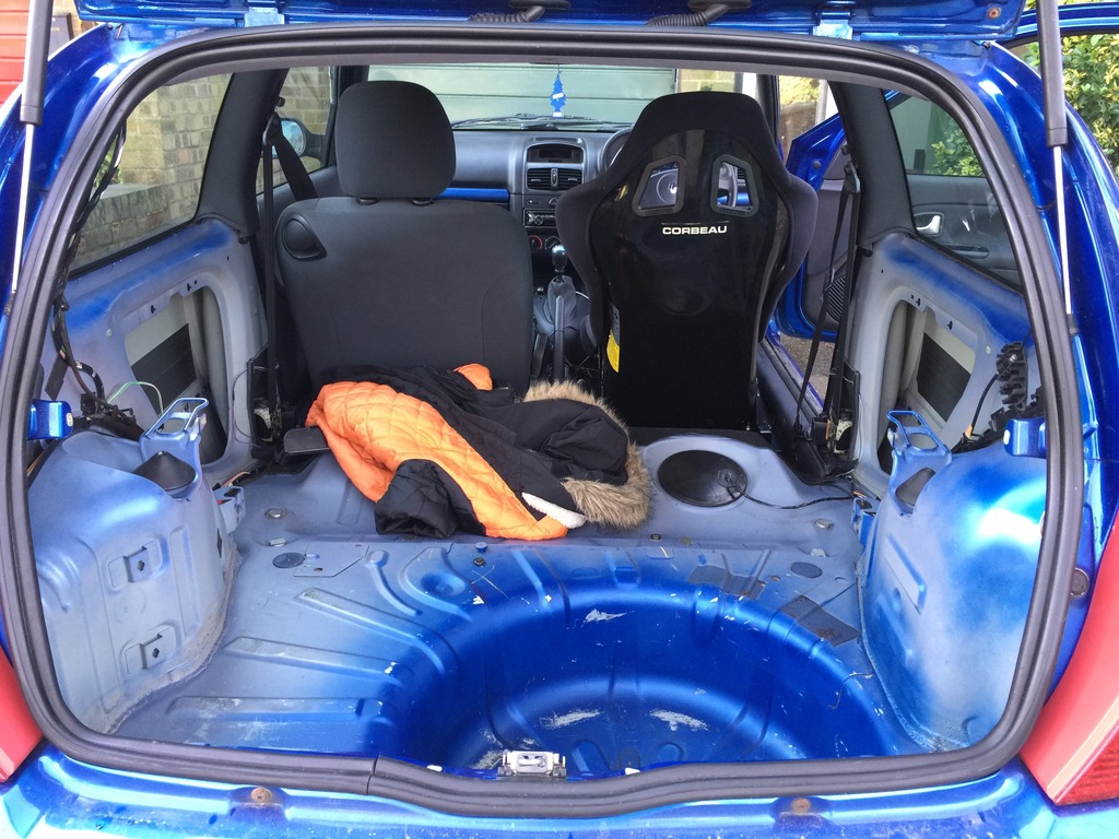

So this happened recently... fully stripped at the rear except for the roof lining. I was debating about it for a while, but given that I can keep the interior stored away in the shed for now I thought i'd try it anyway.
It's now extremely loud as everything is amplified and I love it. I weighed everything that I took out (not including standard seat) and it came to 35kg. It could just be the increase in noise/vibrations but it feels a heck of a lot quicker now.

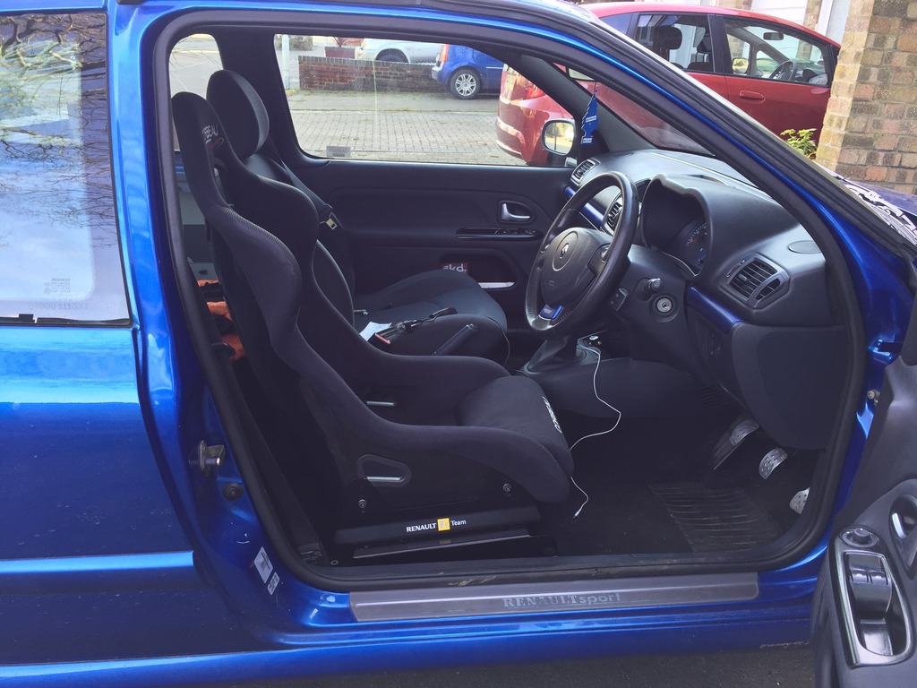

Also managed to get one of the bucket seats fitted that I got from @masekwm :up:. Pretty tight fit for me but they look spot on.
Will get better photos at the weekend.
Got a Renault F1 sticker off of Ebay and stuck it on the sidemount, thought it looked kind of cool.

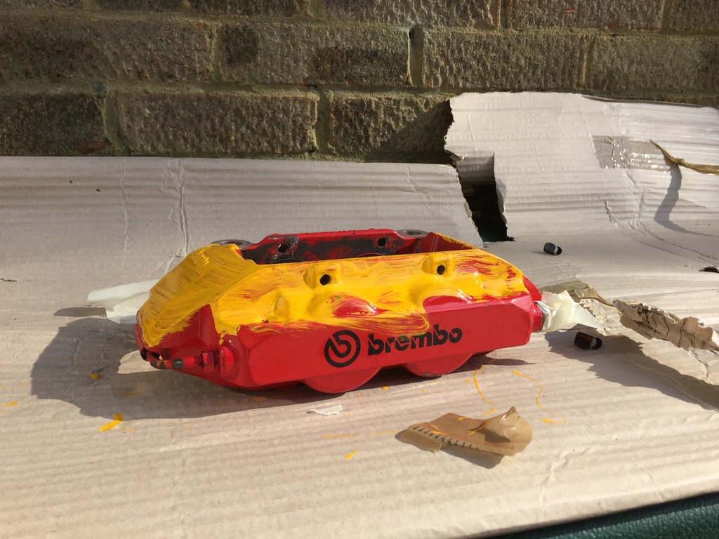

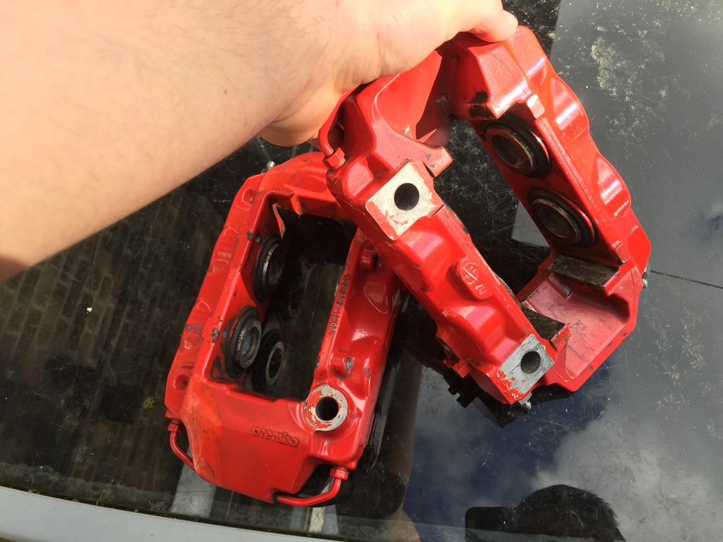

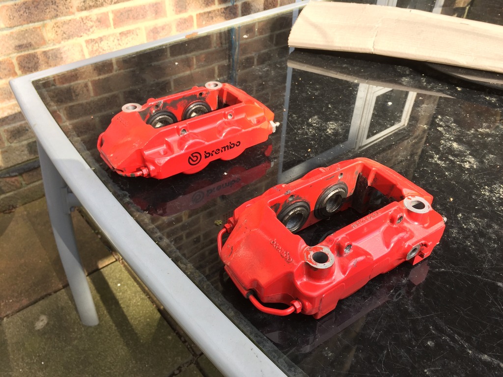

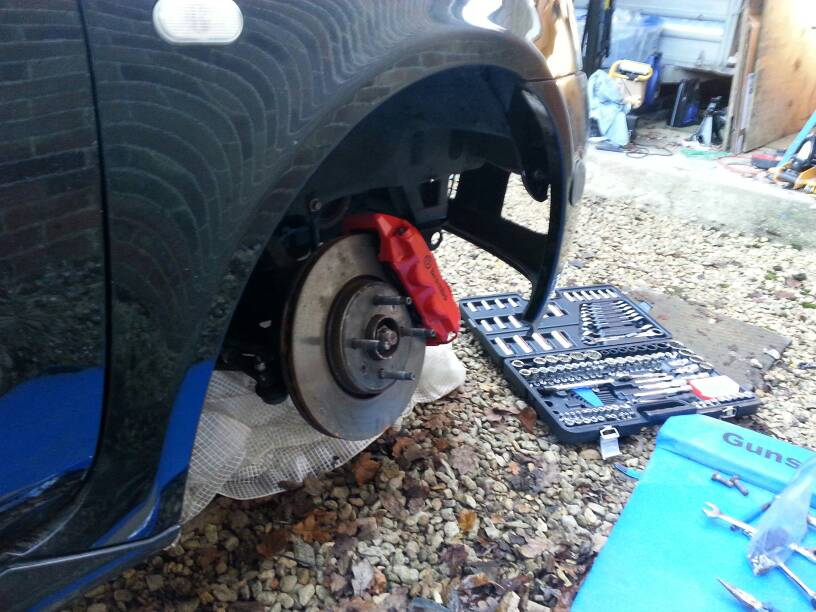

Had a little go at cleaning up the new brakes earlier before giving them a couple of coats of paint. I've gone for yellow because they looked best in my Photoshop attempt (pictured below)

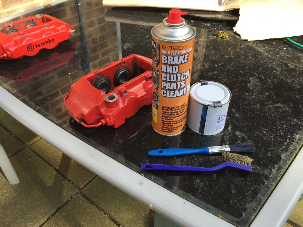

Got the E-tech caliper paint kit as i've seen some impressive results on YouTube. They look a bit crap in the picture after their first coat but i'll get more when they're complete!
No mixing required with the paint and it leaves a decent enough finish.
Here they are :tongueout:.

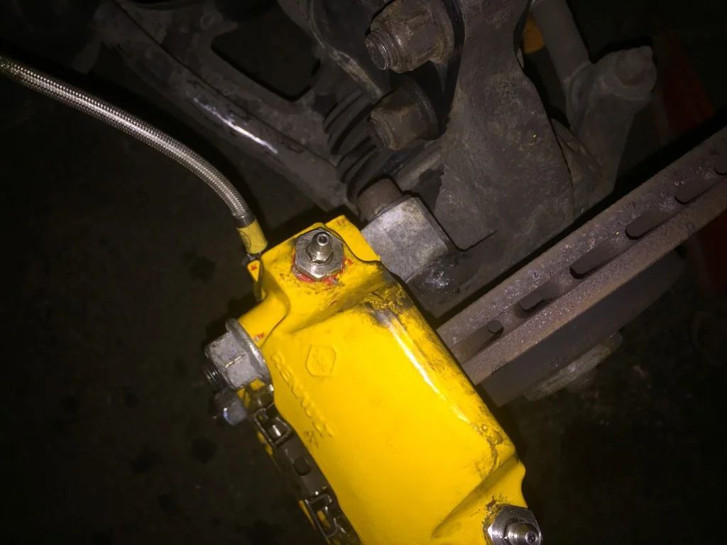

Started to paint them.

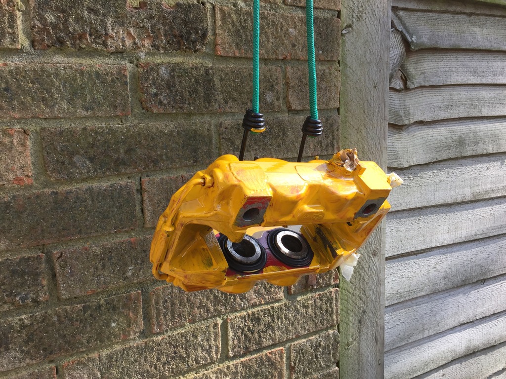

Was starting to think I could get a sponsor from McDonald's if I leave them like this...
Also found a unique way to hang them to dry in the back garden. Can't wait to fit them before Blyton :grinning:

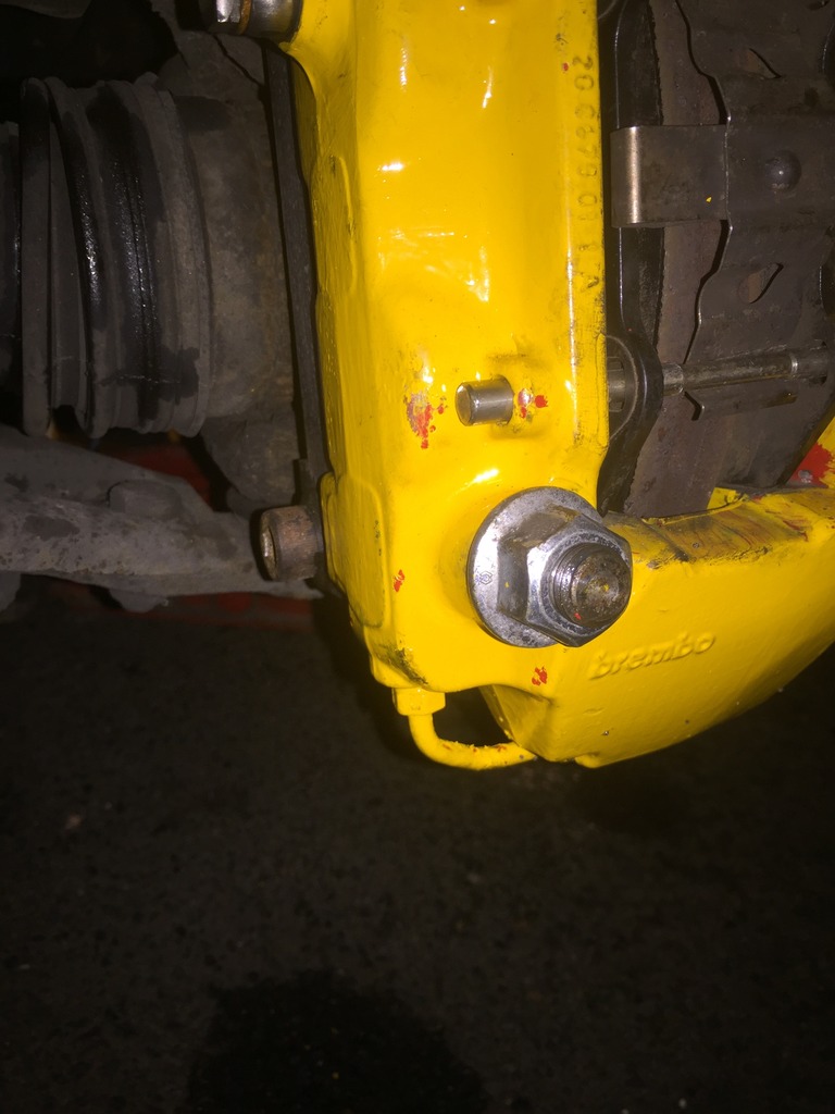

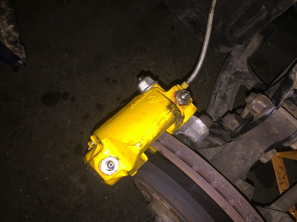

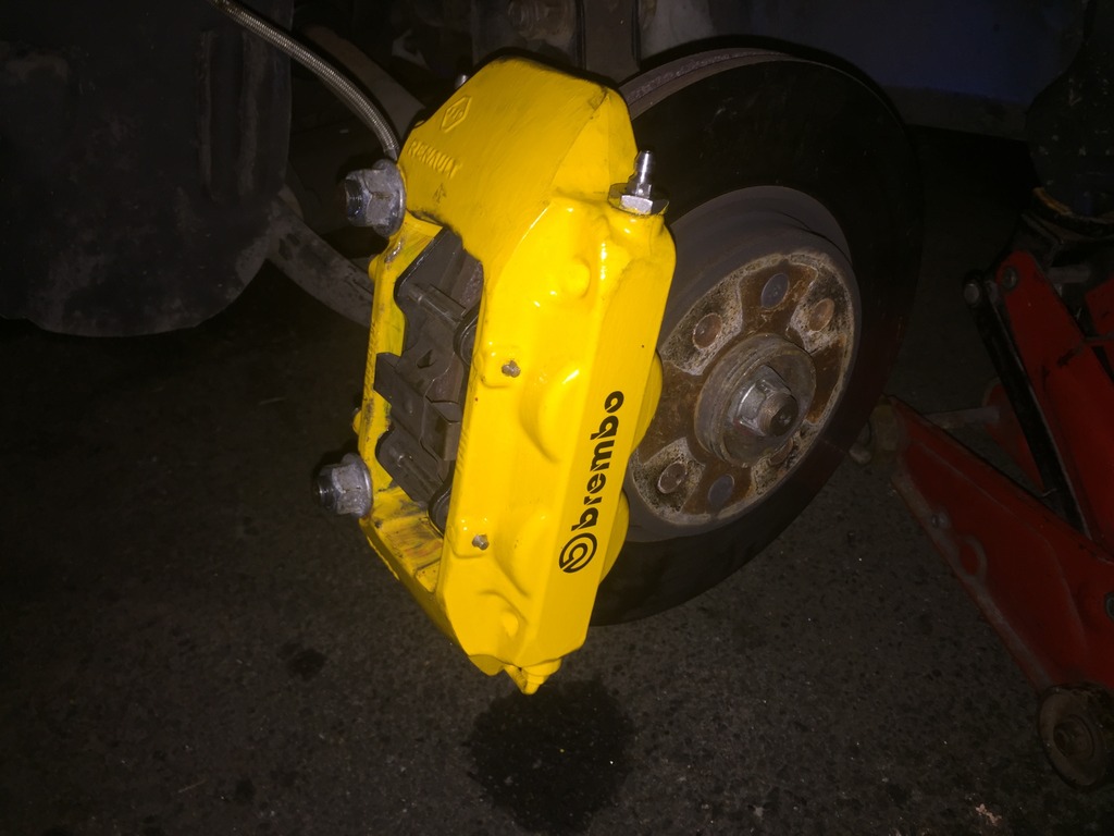

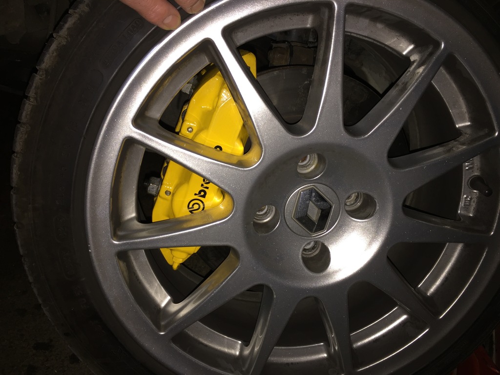

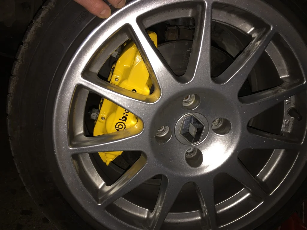

Finally got round to having a go at fitting the Brembo's today only to be stopped in my tracks because they don't clear the wheels!
I was under the impression you could run meg calipers with 280mm discs and cup turinis without spacers but apparently not.
This means the Brembo's will be put on hold until I can afford the money for the PMS stud conversion and 10mm spacers. Bit of a downer tbh.
Perhaps I don't have Cup turni's after all? who knows...

Where is the caliper fouling the wheel? I understood they'd fit fine with Cup Turini's

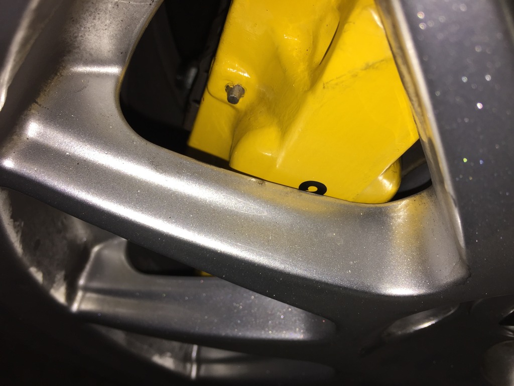

Literally the only place that it's making contact with the caliper is on the face where the Brembo logo is. It looks as if the caliper will clear the inside of the wheel easily.
If I hover the wheel over the hub with about a 5mm gap (eyeballing it) it looks as if it will just about clear it.
Which brackets you using mate? Surely if it's not touching the wheel then it's fine? Even if it is 2mm clearance
It could be that I've mounted them wrong, I'm handy with a spanner but hardly the world's best at this sort of thing. Initially I did get the brackets around the wrong way and only realised after the pads wouldn't fit lol. Changed around and everything fits fine.
The wheel is sitting on the face of the caliper mate so would literally hit it/get stuck by the looks of things. No idea which brackets i'm using as I got the lot from @Mash but believe they are for 280mm discs.

What's happening, the spokes of the wheel are hitting the face of the calliper did you say? If so sounds like the wheels isn't spaced enough
Yeah I think there's something wrong in the install. 280 should clear the cup turinis without a spacer.
Exactly this mate. The spokes are making contact with the face of the caliper. Perhaps I have gone wrong on the install but god knows where.

In the most recent pictures are the brake pads in? as if you can get the pads in, that means you have the brackets the right way round, otherwise if offsets the calliper and it's noticeable that the discs isn't In the middle of the calliper.
Well yep can safely say they need spacing 5mm, answers to the above about cup turinis etc etc I have no idea.

It doesn't look like you've installed them incorrectly. I really hope spacers aren't required as I bought them on the premise that they would fit without spacers
Looks good mate!
yep they're set correctly, it's purely down to the offset of the wheel in question.
£10 and they're yours, will pm you later in the week when I won't need them :)
Your issue is that you're running 280's mate. On a cup turini the spokes are fatter at the base, so this means that because the caliper is sitting lower it interferes with your spokes. Make sense?
I'll be running 295's and my turinis are now very close to the spokes - on 300's there's plenty of room. The 16" superleggeras are not feeling it at all, so I've re-engineered the bell to give me (hopefully) enough clearance without needing spacers.
