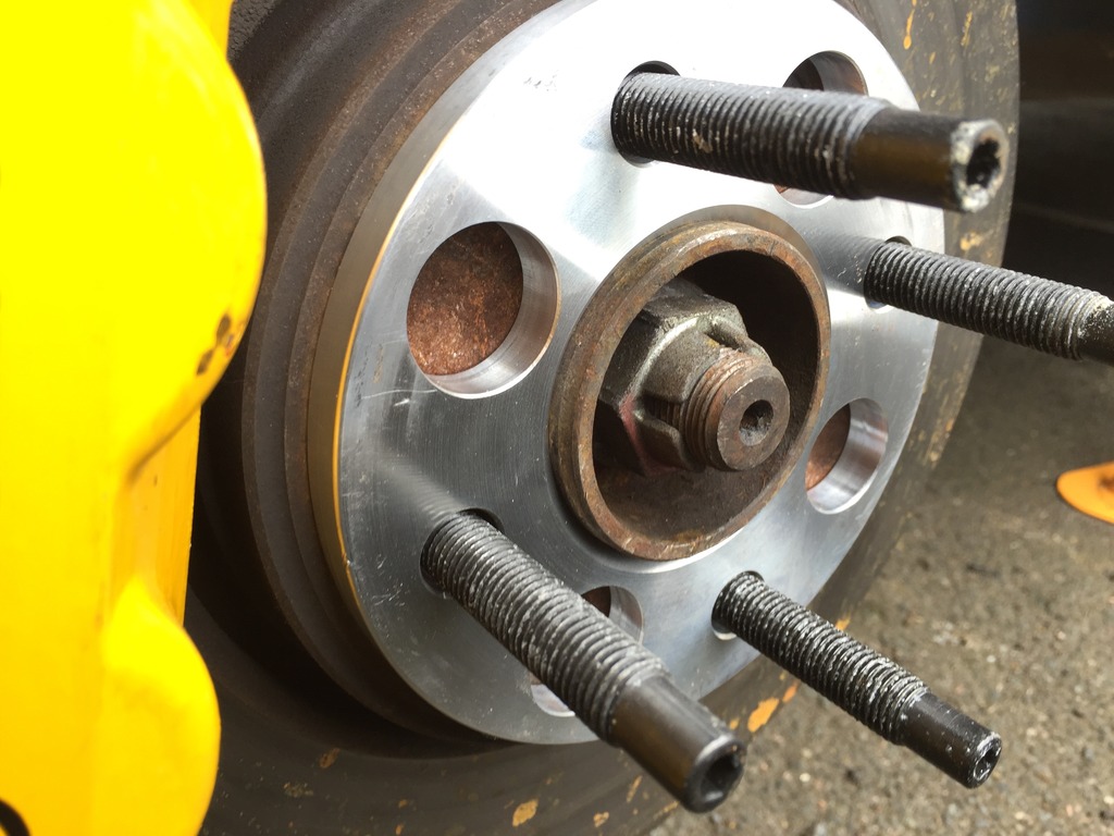

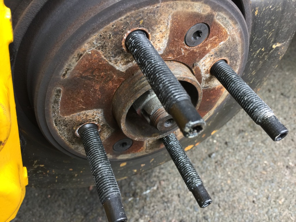

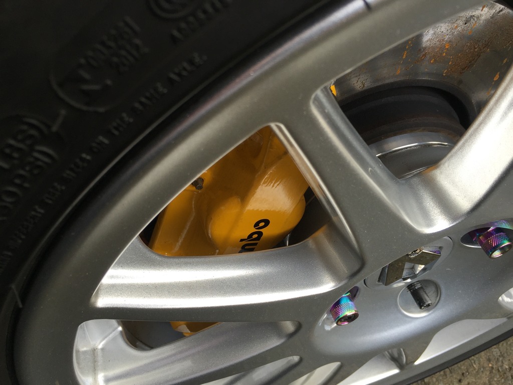

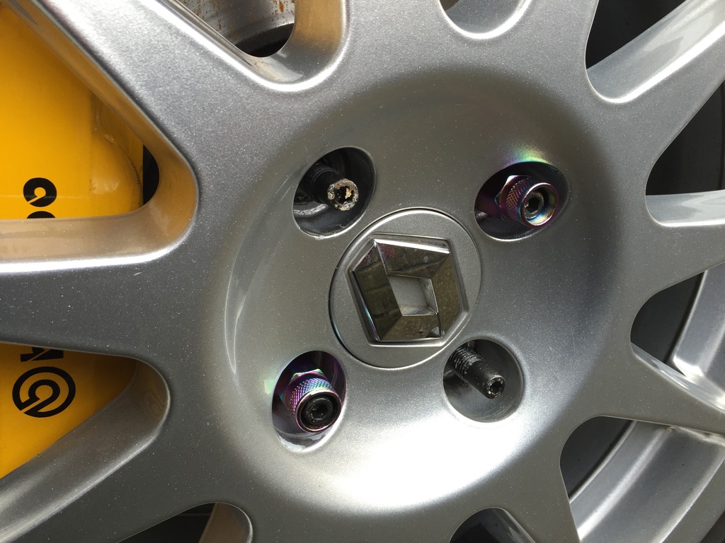

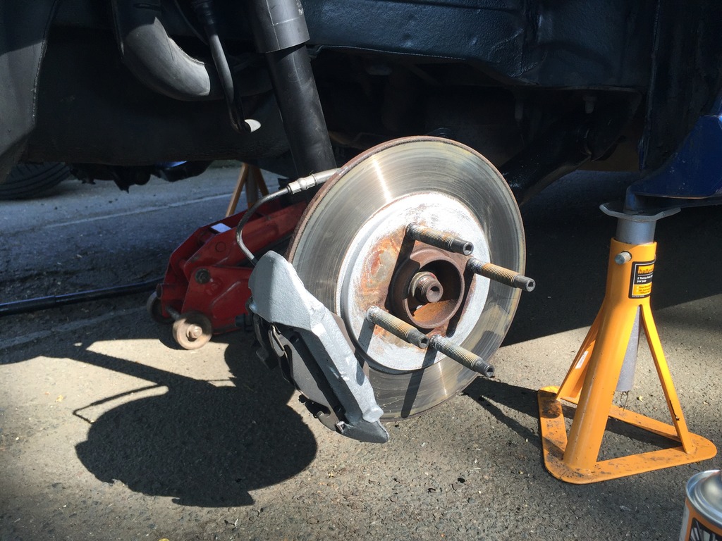

Some goodies arrived today in the post. 16 x M12 50mm studs from Driftworks and some Neo Chrome wheel nuts. Spacers from Pure Motorsport also arrived. Trial fitted to make sure everything fits ok and now just waiting on the 271 Loctite in the post :smiley:
Studs seem to fit fine... felt a little lose but only hand tightened them.

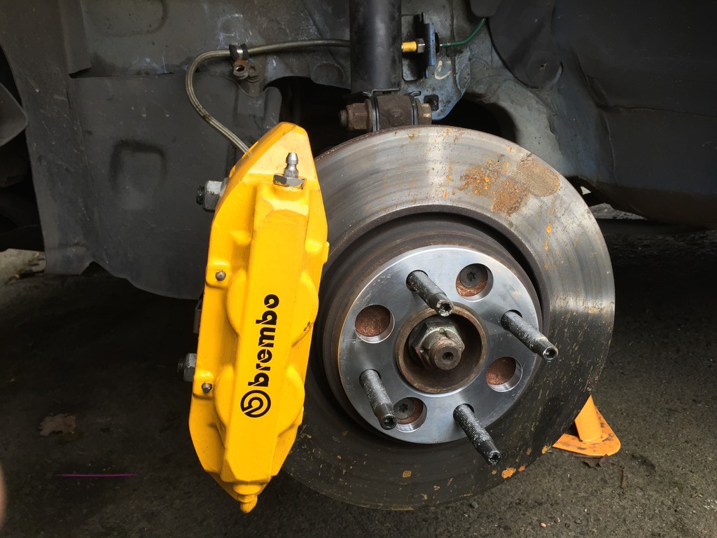

Spacers on (are they the right way?)

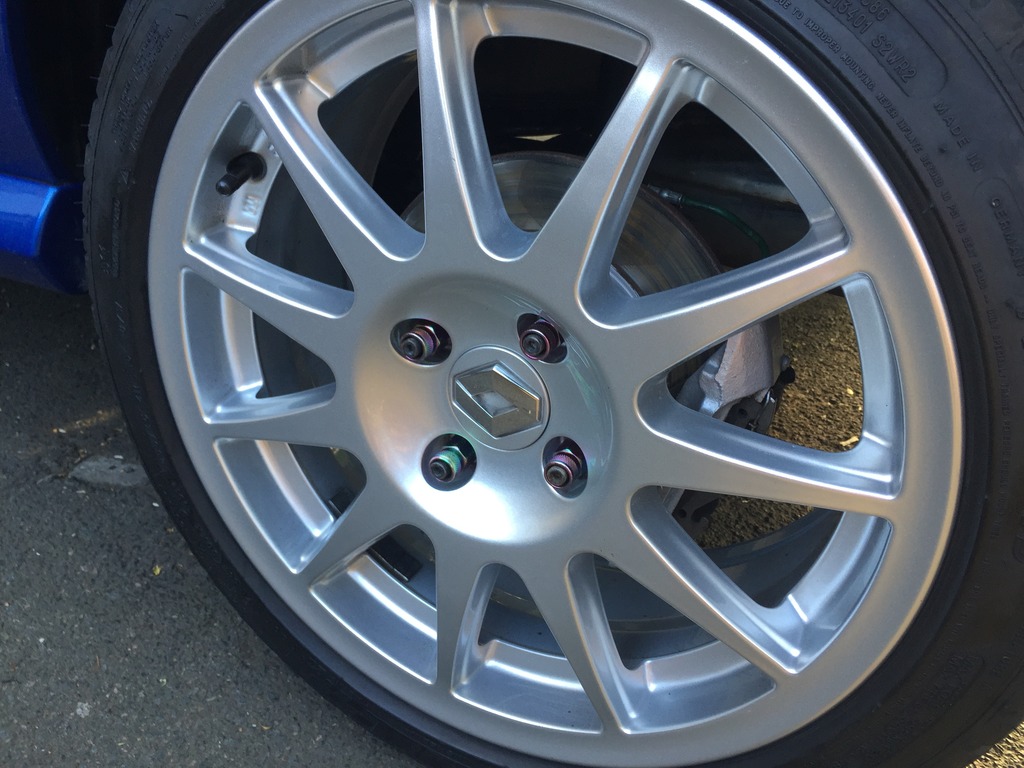

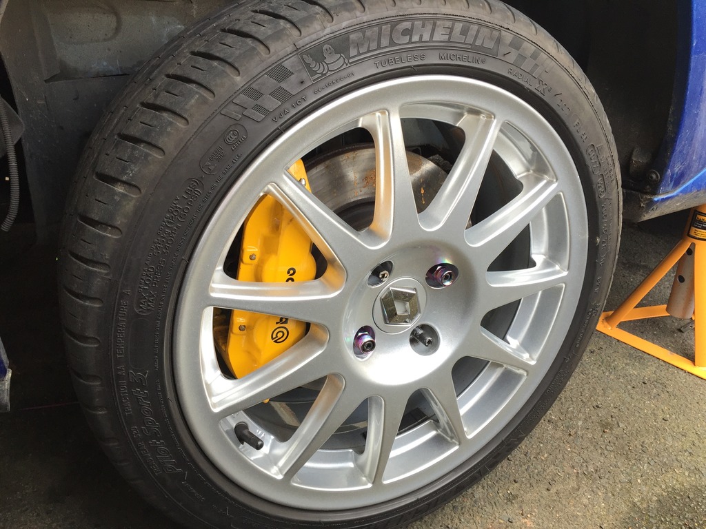

Finally wheel on with Neo Chrome bolts
So much room now...
So much room now...

If the spacer has a chamfer on both sides of where it passes over the spigot, then yes they are fitted correctly. If not it needs swapping over so the chamfer is on the face of the disc.
^^^^in fact scrap that! Lol it's only applicable the way I've stated it on the rears.
Love the look of this car, and the changes.
Makes me want a Cup again. :cool:
Thanks mate. Seen a fair few decent spec Cups up for sale recently, just saying :tongueout:.
Still very useful info as they actually only have a chamfer on one side. I'll flip them around when fitting. Thanks pal

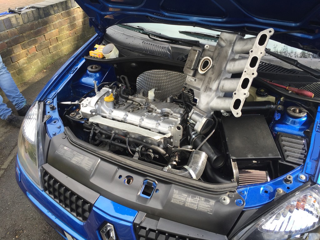

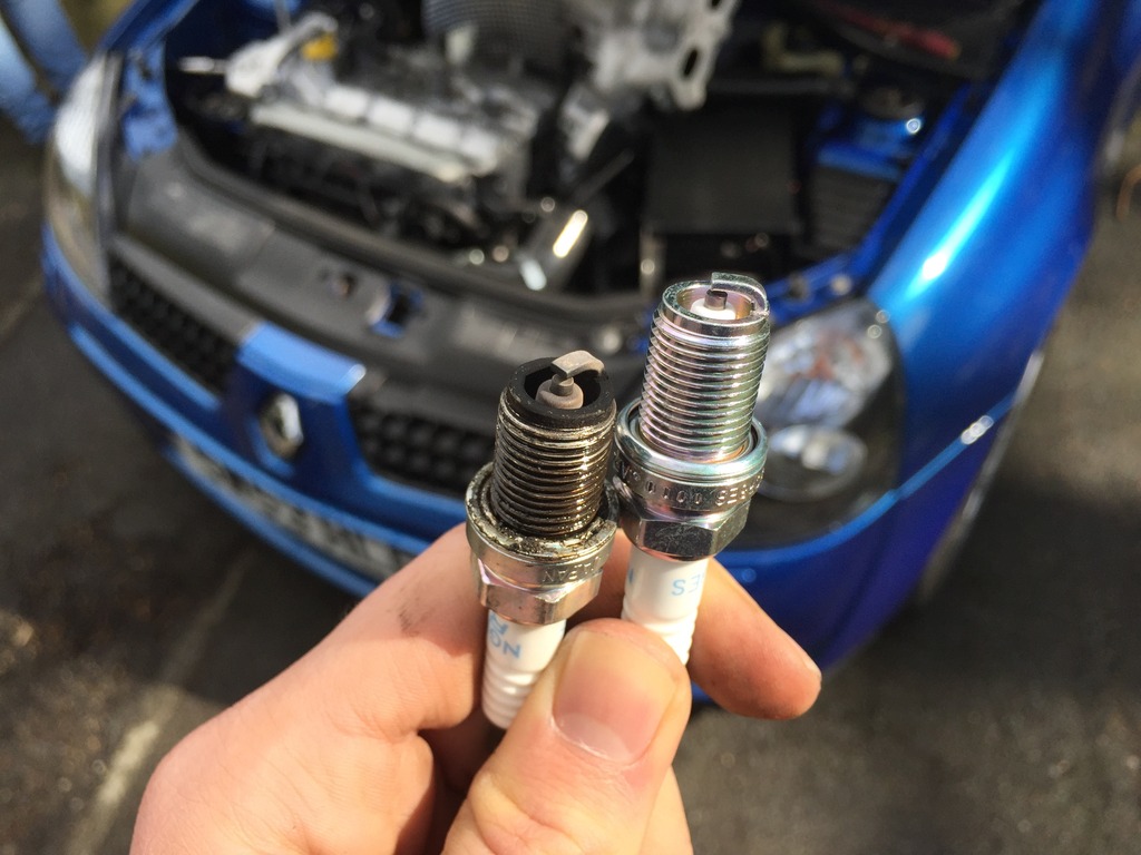

A little update and finally a few shots of the interior. Misfire sorted thanks to some new spark plugs. Apparently the old ones look fine but it seems to have got rid of the flat spot. Cheap fix at £11.40 :smiley:. Gaps on the old ones were probably off but not sure.
Too lazy to unbolt throttle body etc lol

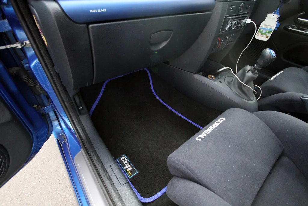

Gave it a good clean this bank holiday and finally fitted some new matts with the Cup logo that I got as a gift at Christmas!

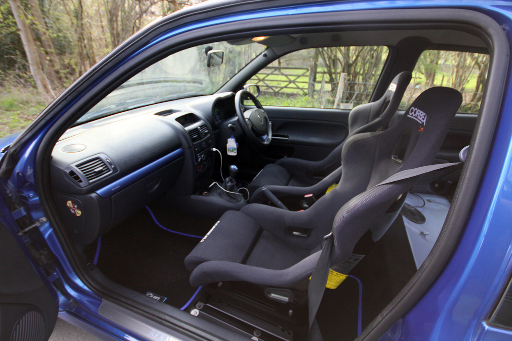

Some interior shots of the world's tightest bucket seats. I'm not exactly huge but there's not a lot of room but at least they look the part 😂.
Also fitted all the rear interior again except for the rear bench. Stripping it out was an experiment but it was starting to look like a tatty shed.

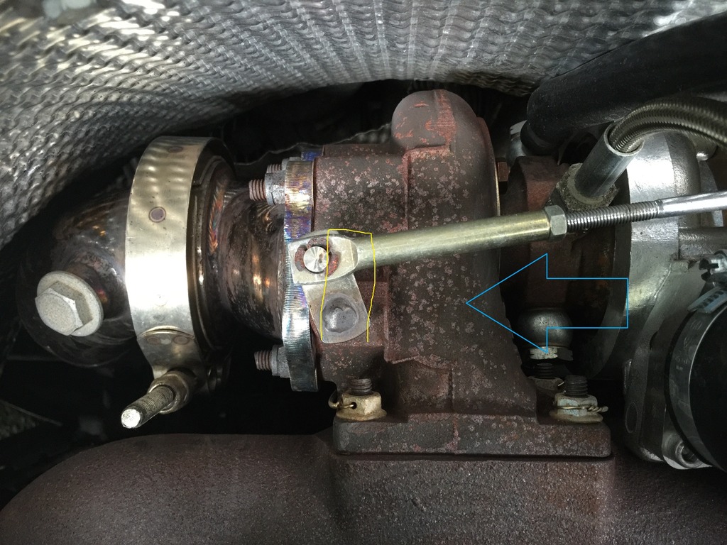

Was going to go for a drive with this lot (none as quick as the Cup may I add) until on my way there the car lost all boost. A phone call and a few emails later to ED and it turns out the wastegate was stuck open. The fix was simple enough - pull on the rod to the right until in released and closed.
Here's the offending cause of no boost. No idea why it was stuck open like this. Yellow marks the position it should be in. I've been assured that if it happens again they'll have it in to take a look.

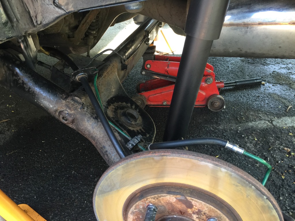

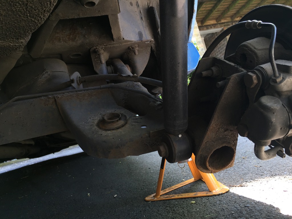

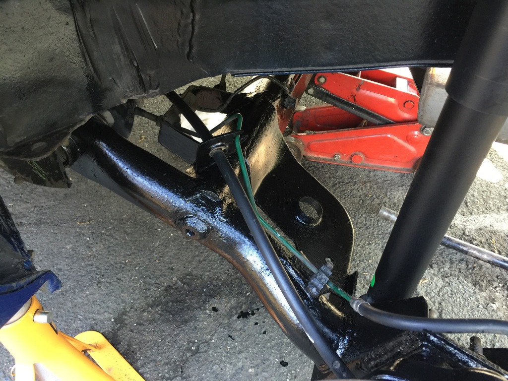

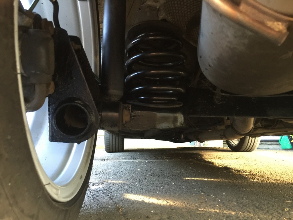

Then I decided to paint my rear beam. It looked rusty and tatty and although it's not the best finish in the world (far from it) i'm happy enough. Some before and afters:
After:
Some paint on the rear calipers whist i'm there.

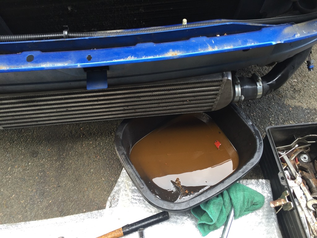

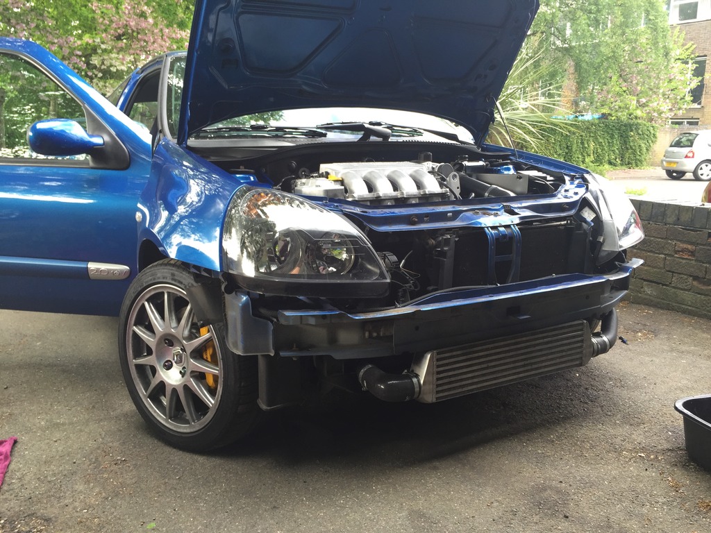

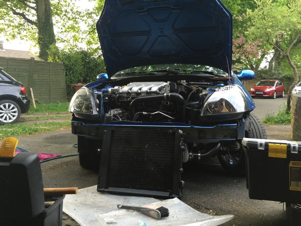

Now on to the coolant. It was absolutley horrendous. Decided to pull the radiator out and flush it with a hose etc which was quite fun taking things apart.
Cheeky intercooler shot.
Coolant was awful.
Coolant now clear, but not got any pictures as of yet. Cheers for looking. Still not sure if i'm going to bother with FCS now :confused:
