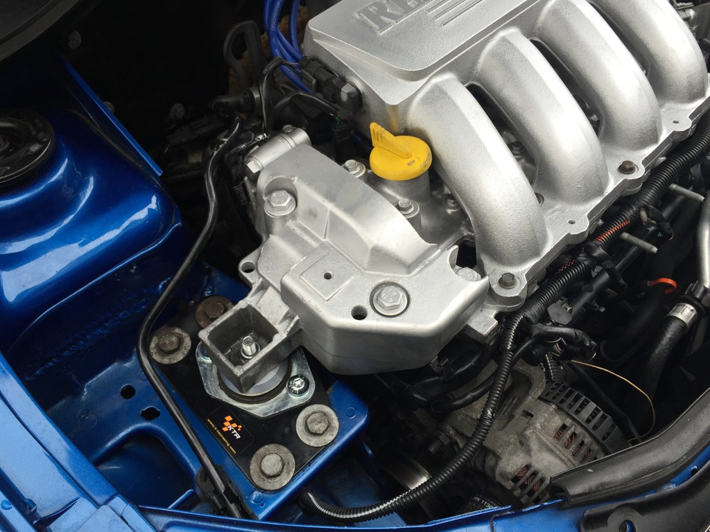

- Fitted uprated Ktec upper gearbox and engine mounts and now the car feels a lot better to drive, if not a little more rattly at idle.

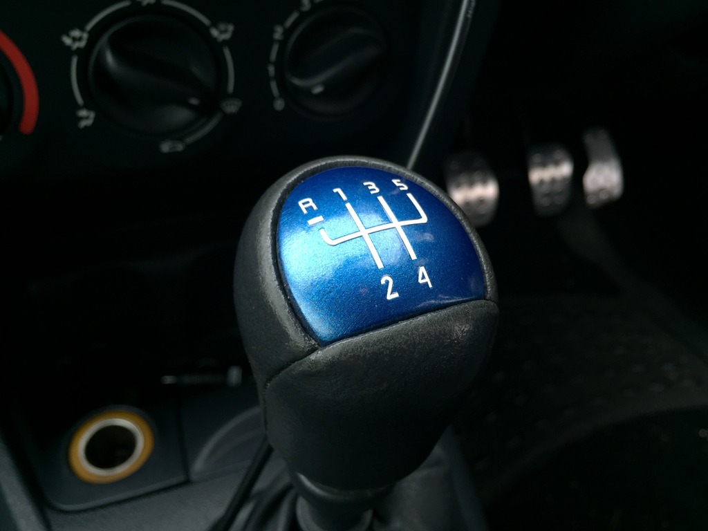

- Gearstick was worn down to black so rubbed it down, primed, sprayed and then added a sticker brought from Ebay. Lacquered after. Really happy with the result, it's one of the best but simplest things i've done so far:

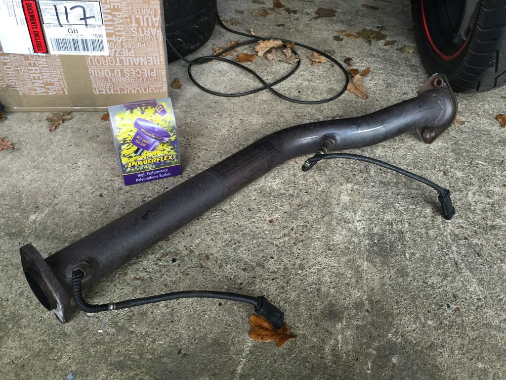

To fit:
- Powerflex dogbone bushes
- Decat

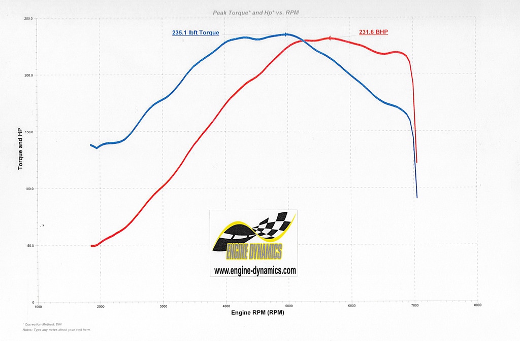

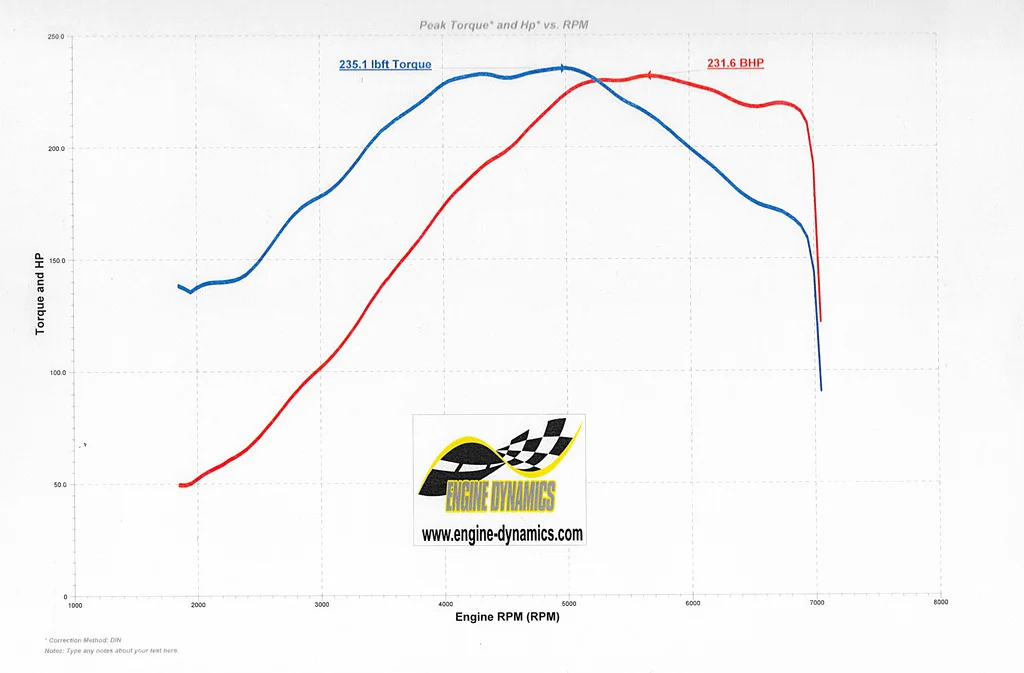

So the car is now back from Engine Dynamics and wow, what an awesome kit it is. Not many photos of the car since it has been done but here's a few. The car made 231.6 bhp and 235.1 lbft, strong figures that you can really feel in the car. Absolutely loving the noise too.
First up, the power run. They had some problems at first with the car on the dyno. It was because I had put cheap supermarket fuel in the car (95 ron) and filled it right up. Luckily Andy drained the tank out and put the fuel in some canisters for me and then filled it up with some Tesco Momentum 99.

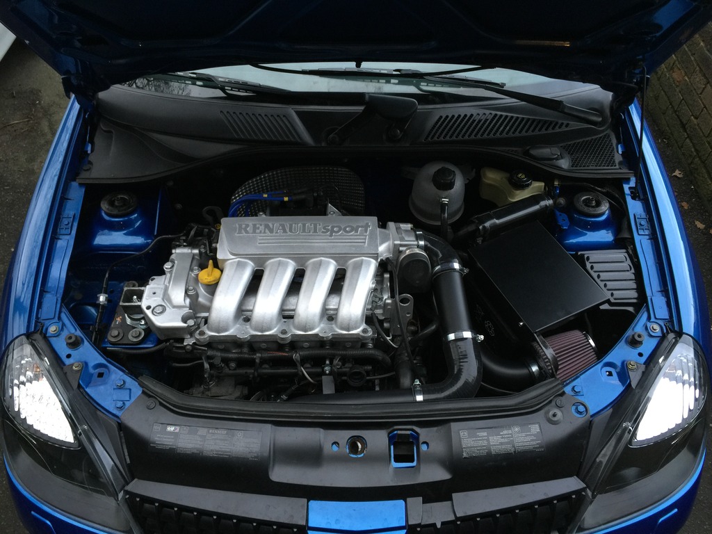

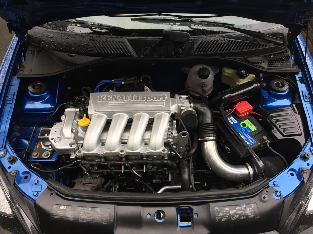

Then there's the engine bay which now looks epic. That awful carpet is gone and replaced with a nice shiny heat shield. Actually really liking the all black pipes. Still looks fairly OEM and quite classy... for a clio lol.
Cheeky bit of intercooler on show. Pretty noticeable in silver and will probably leave it this way. It's discreet and most people wouldn't even give the car a second look let alone notice the intercooler, only those that are into their cars might notice.

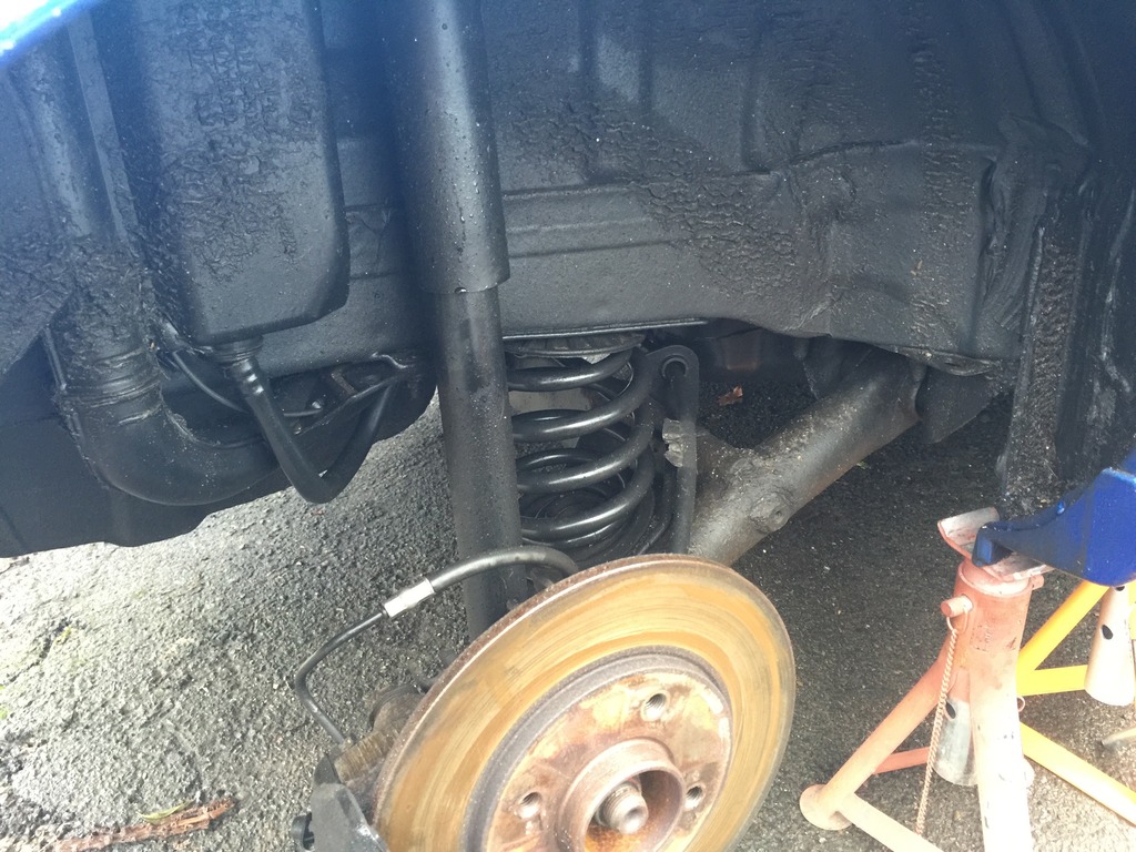

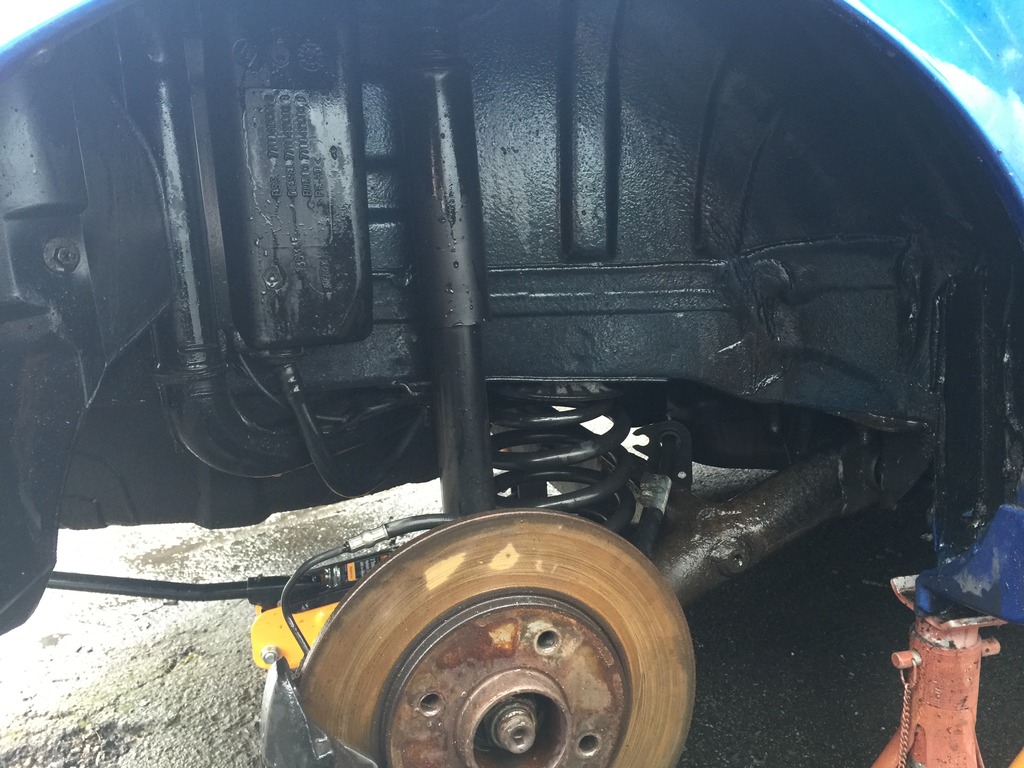

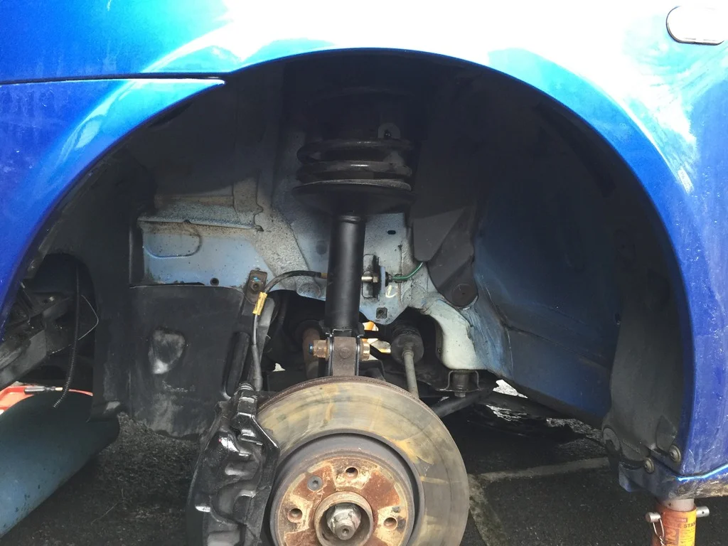

Fitted new cup shocks all round and cleaned under the arches the amount of crap that was under the rears especially around the fuel cap on the inside was shocking!
Here they are before:
And after:

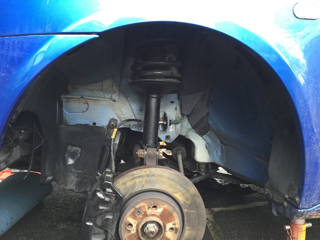

No before and afters of the fronts, but here's the new shocks in with the Eibach Proline springs. The car is far more eager to turn in now and is less crashy on bumpy roads.

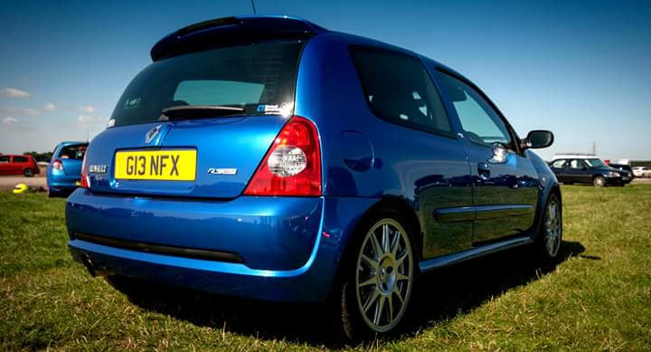

Think I've found my perfect car. Mine used to look like that a long time ago
Cheers mate, it's always been my intention from day one to keep it looking almost standard
Looks lovely mate .What silver were the alloys refurbed in?
Thanks mate, I had the wheels refurbished by Lepsons. They did them in a colour they call 'Bright Sparkle silver' which was their nearest match to the brand new Turini centre caps I showed them. The match is pretty much spot on.
