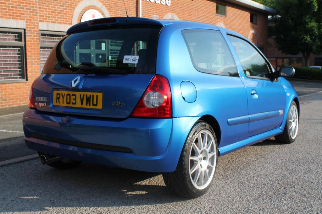

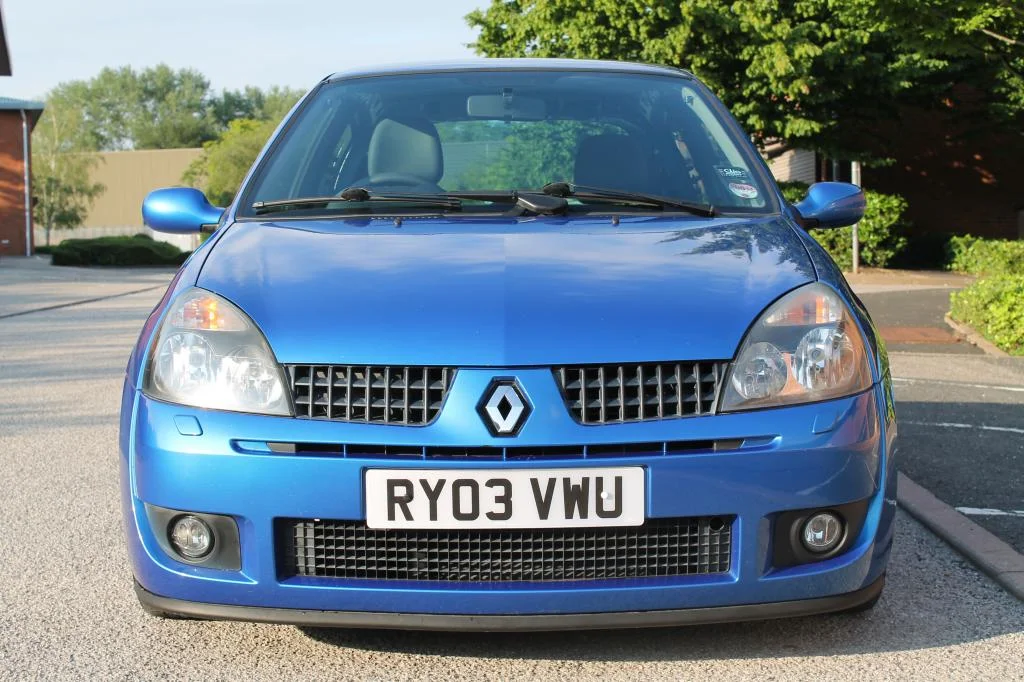

Hi all,

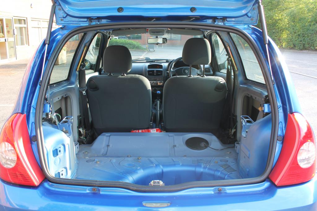

Picked up my new toy last night, a 2003 Clio 172 cup, Interior has already been stripped out and has been fitted with Cooksport springs. Plans are to get it nicely prepped for some track days. Currently has a Race Yozzasport exhaust with Decat which sounds awesome but a little too loud for me.
Last few previous cars have been VAG due to working at Revo Technik, Best being my 370bhp Stage 2+ Leon Cupra. This was sold due to very high fuel costs as you can imagine.
Currently sourcing some bucket seats, nice steering wheel, RARB, bush kit and a nice brake setup. May be a long build, trying to see if any of our suppliers can help me out on some things.
Anybody have any other tips on what may help?

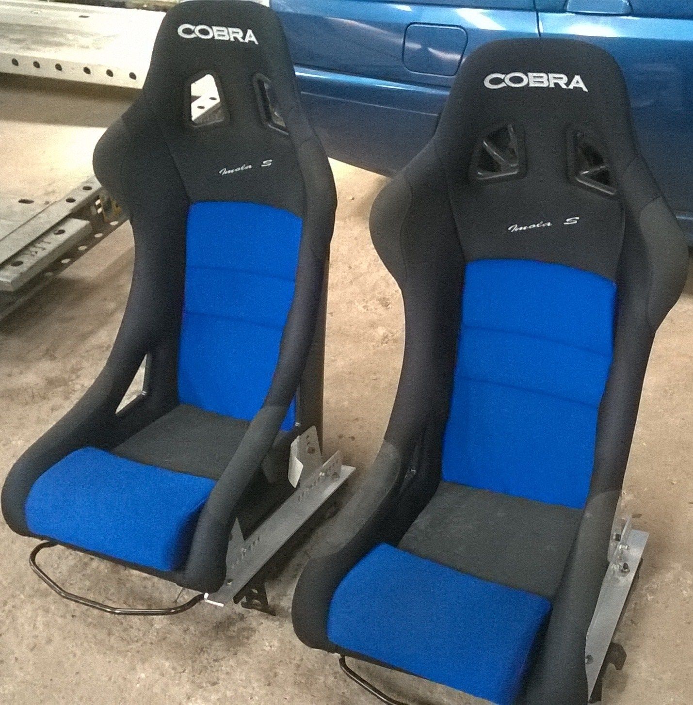

Rally design to some nice seats for cheap. I paid £275 delivered for a pair with sliders and bought some OMP subframes, the seats are essentially the same as Sparco Pro2000 and weight 7kg each.

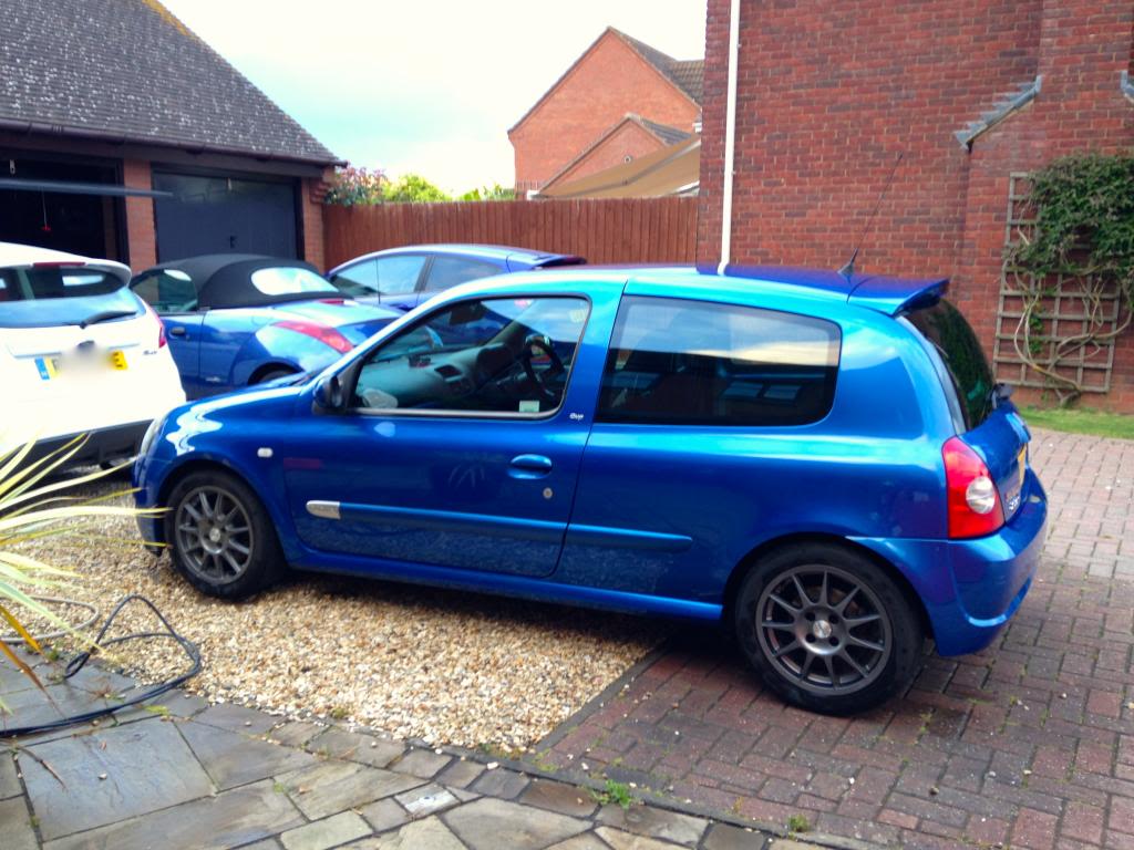

So, last nights journey brought me these...

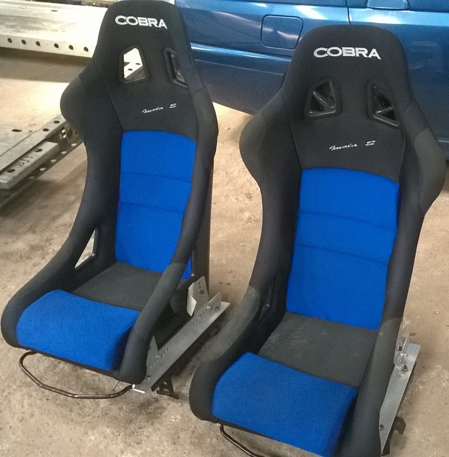

Fitted my rear brakes tonight, will be fitting the fronts and lines all round tomorrow or weekend. Also ordered myself a wheel, boss and subframes which should all be here tomorrow.

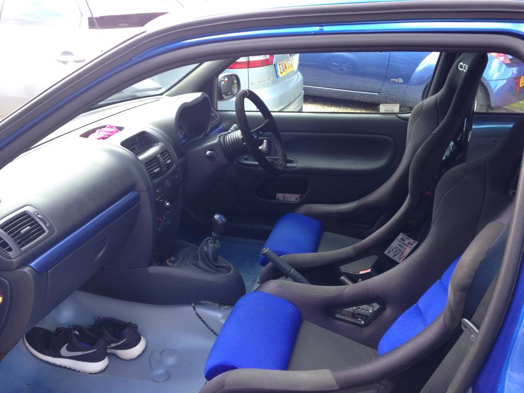

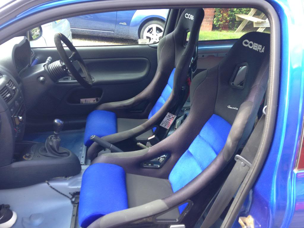

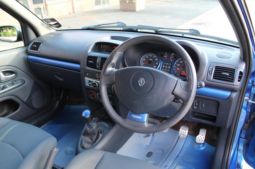

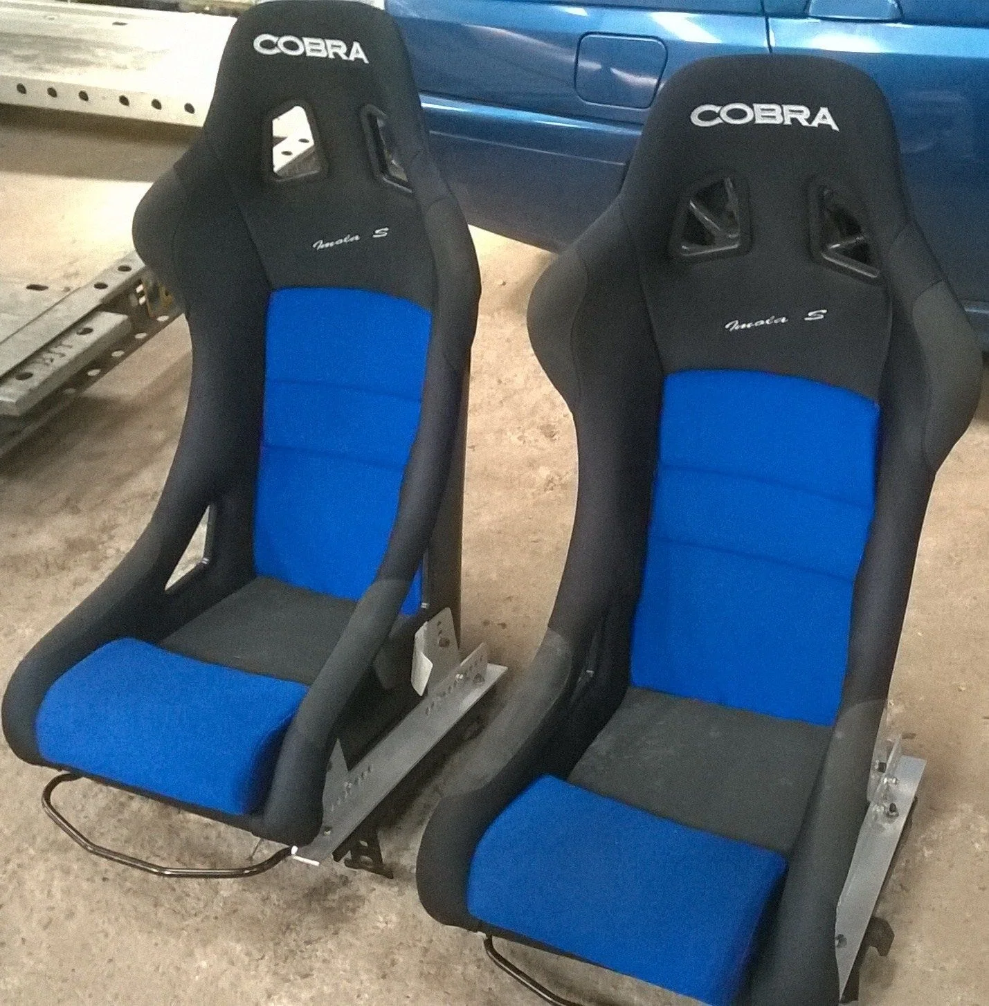

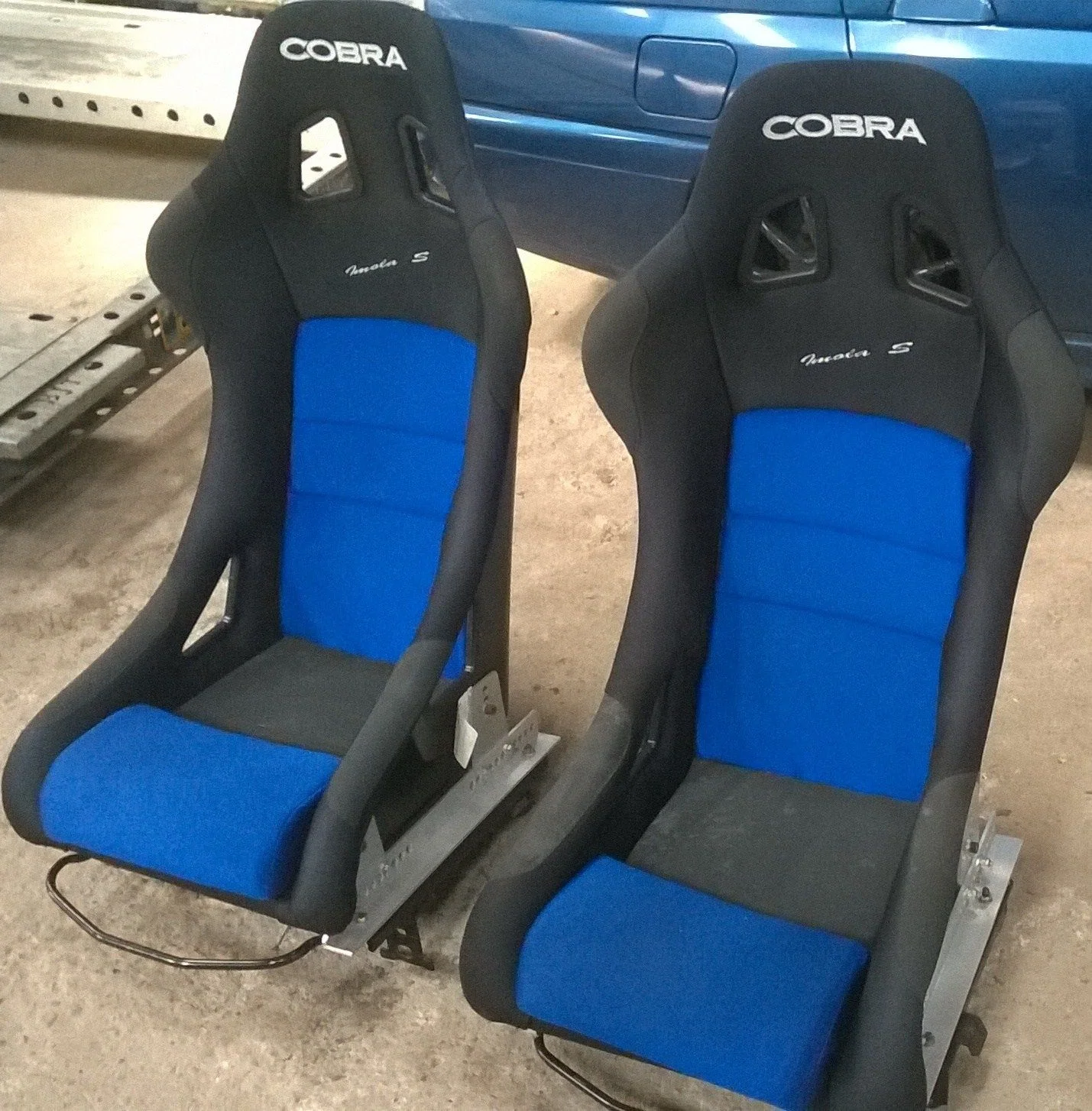

So managed to fit both seats, will be changing the side mounts soon as they are sh*t. Connectors for pre-tensioner had been removed and just soldered so i need to figure out how to get the airbag light off. Also fitted my 350mm steering wheel which makes world of difference, so nice to drive now.

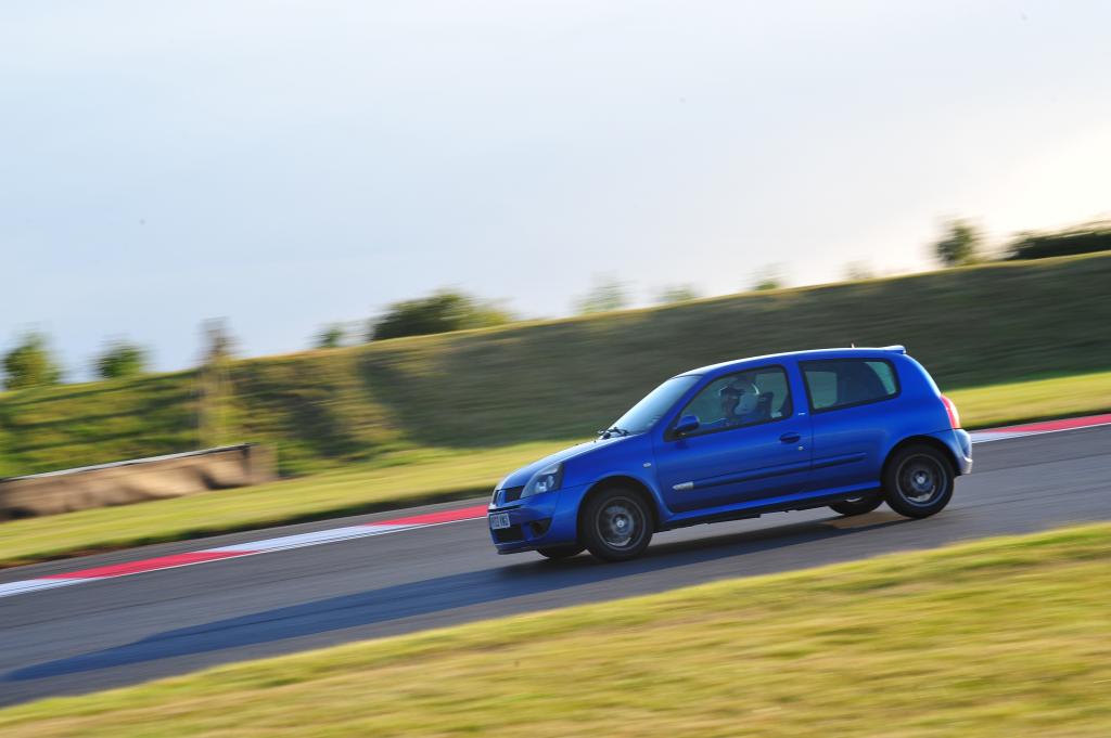

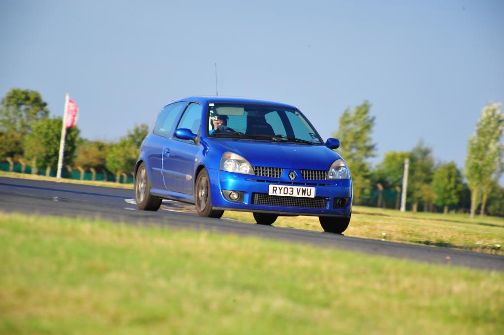

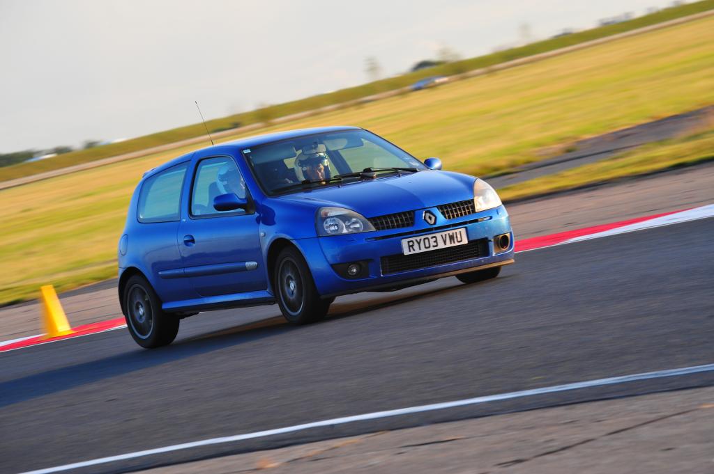

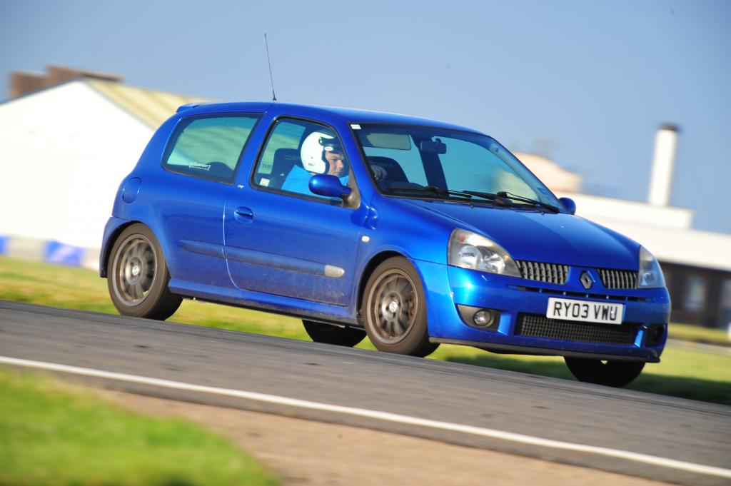

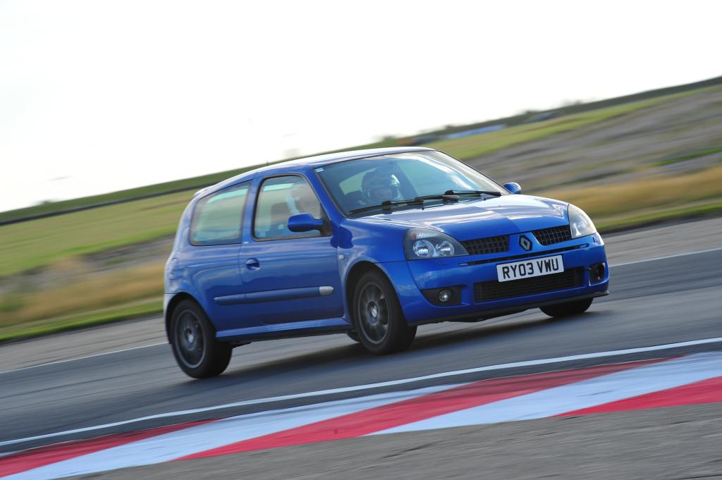

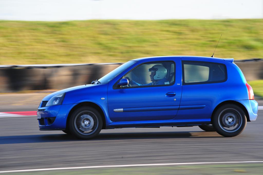

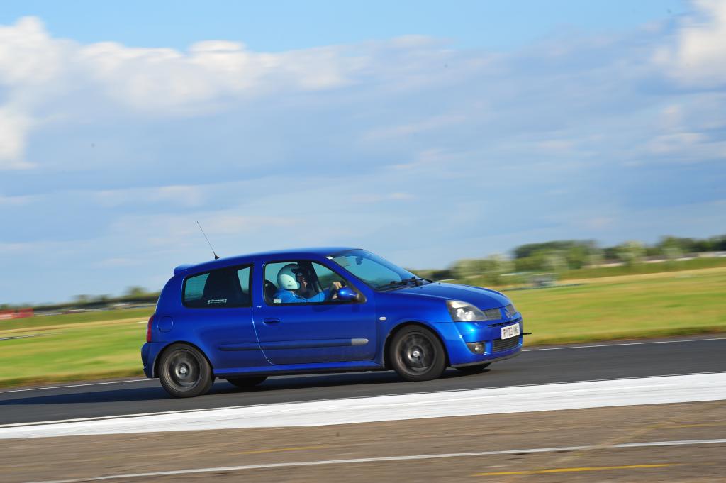

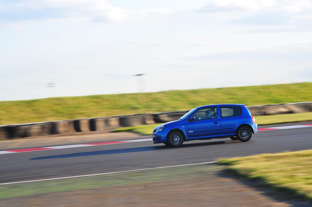

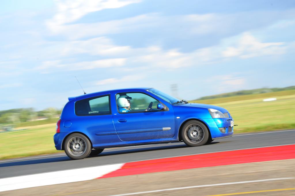

So i had my first trackday in the Clio at Bedford, was performing well. The car was on T1R's and were a big weak point. I will be getting a spare set of wheels and tyres for track. Really happy with my brake setup, no fade whatsoever.
Here are some images, ignore the undersize helmet.

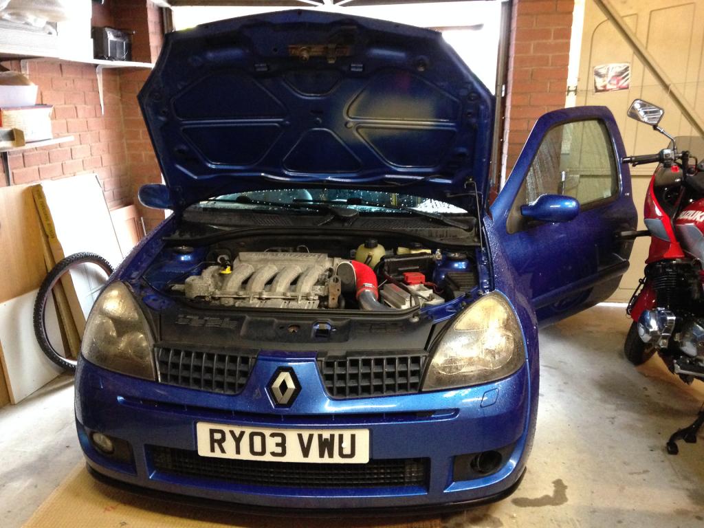

The car is also now running a home made intake with cold air feed along with the 98ron map from RStuner. I am currently looking at some new seats, engine mounts and a roll cage.
