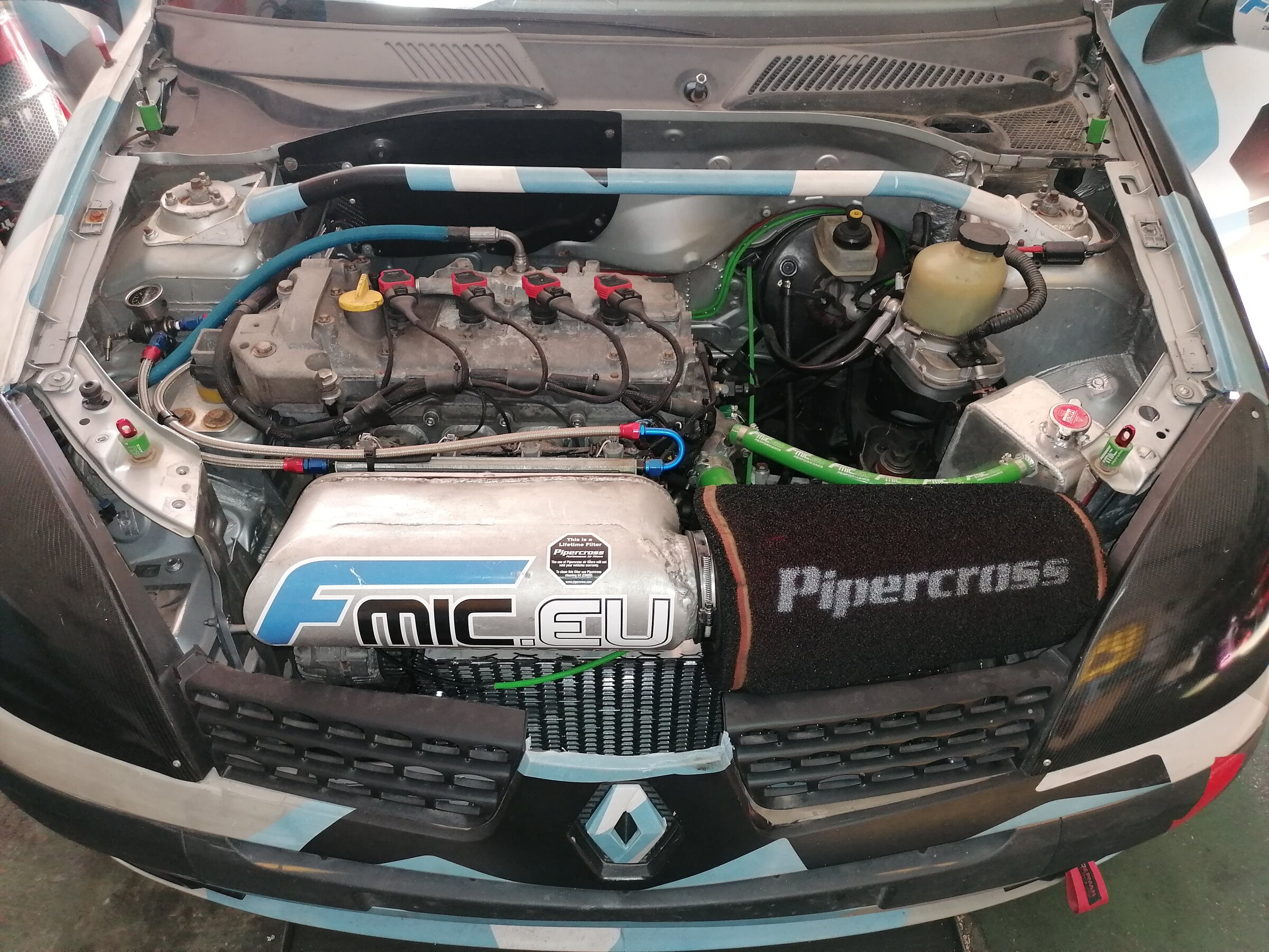

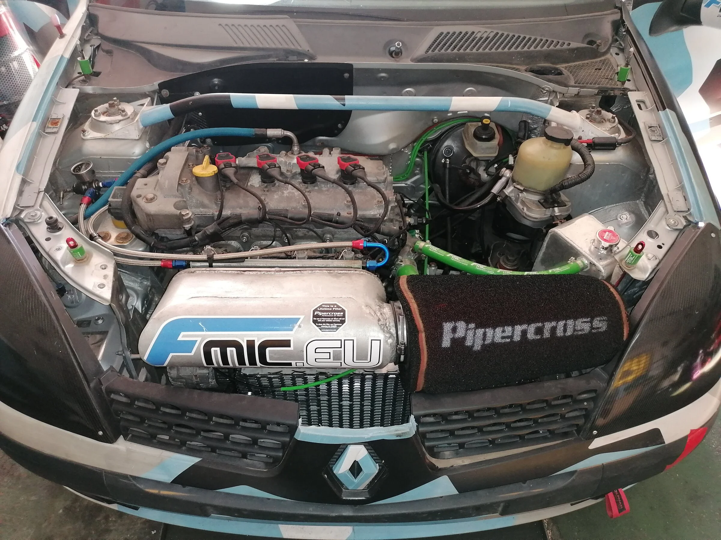

Evening all! Looking forward to joining the 172 ownership club very soon, with this absolutely honest and mint 52 plate, fanatically cherished by a RR Engineer, completely std 2 owner car. However, whilst it’s an awesome chassis already, I’m thinking it needs 250 BHP+ Ideas welcome lol. 👍👍
  Clio RS ph2
cheap best itb from Kawasaki zx12-r motorcycle and injectors are enough for 250 hp
