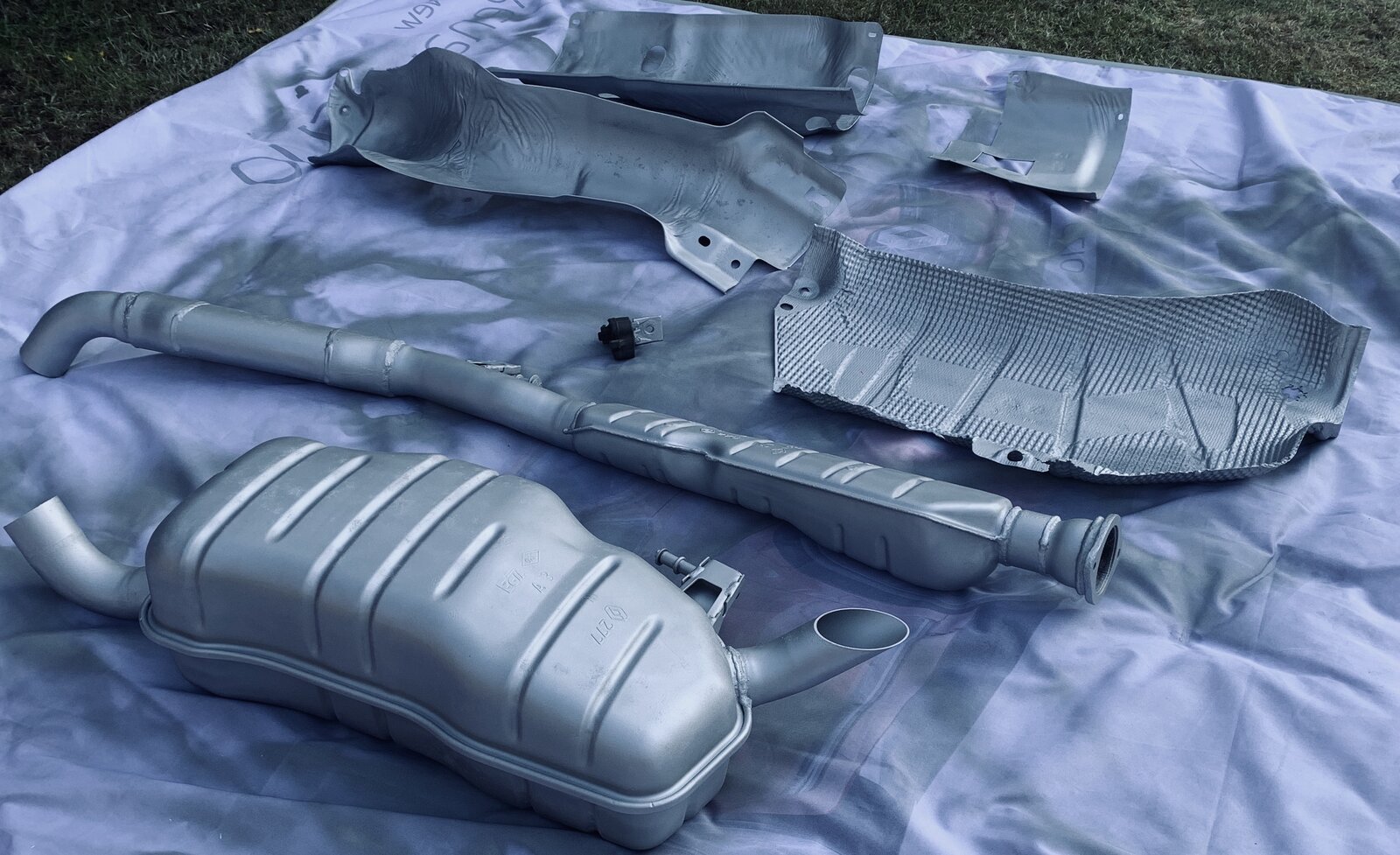

Proper inspiration. The results from the deep clean are excellent. Can't wait for the exhaust updates.

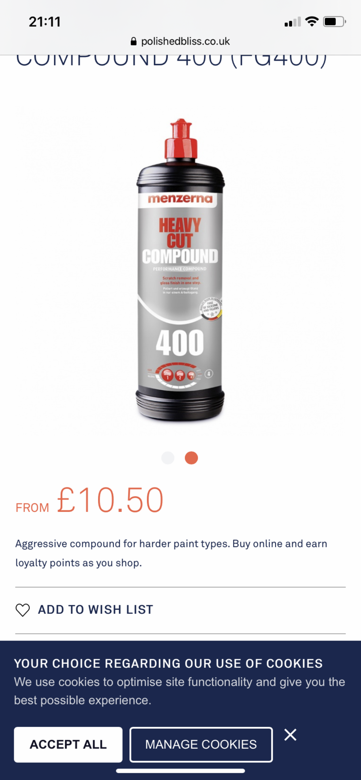

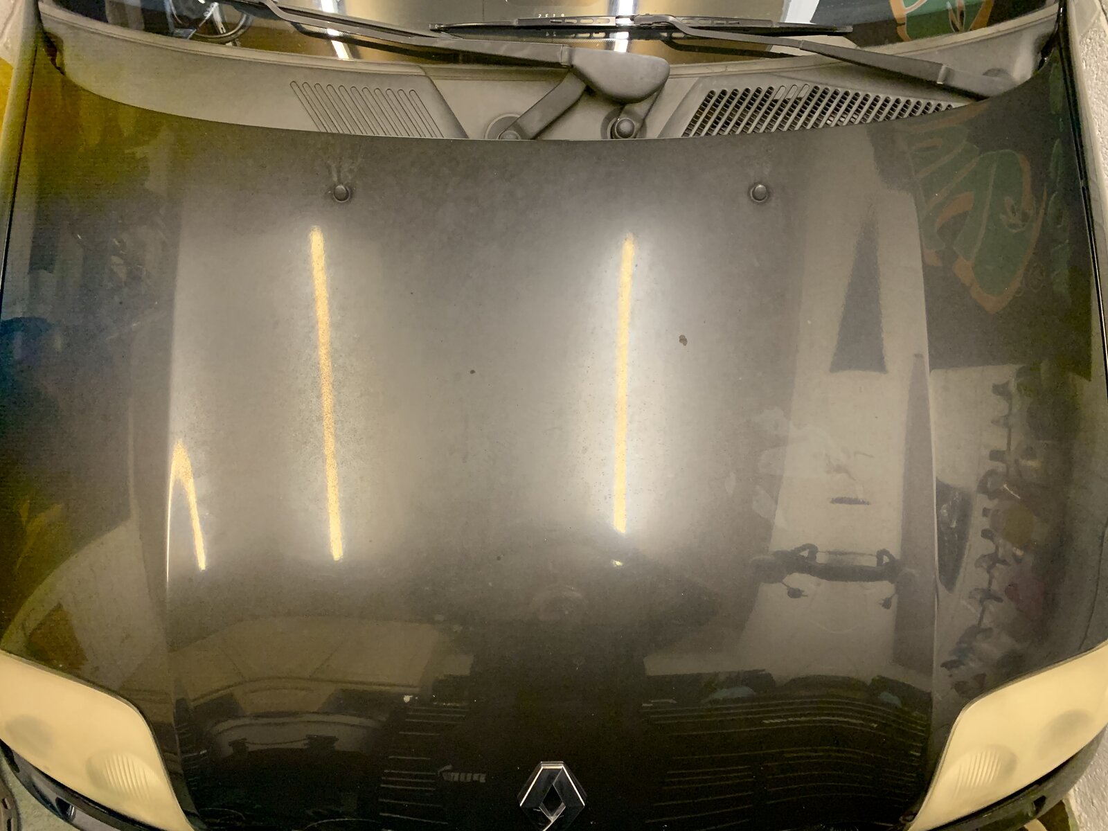

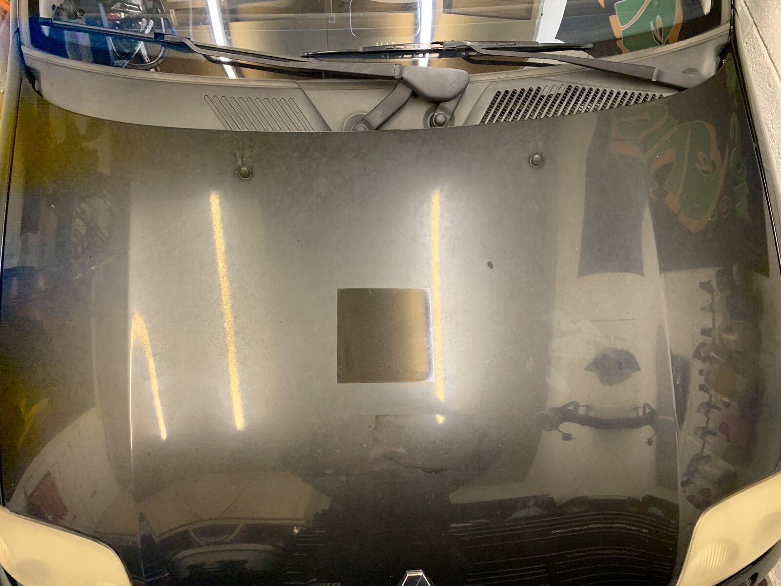

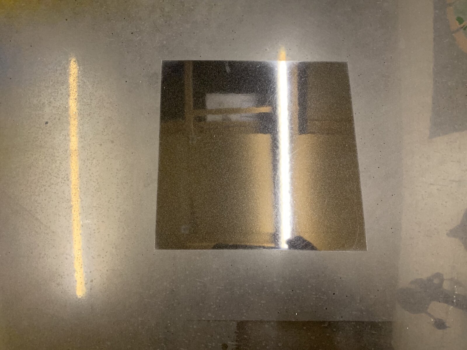

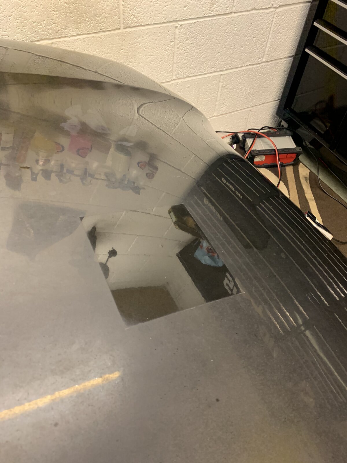

What products did you use to get these results ?? My Exclusive has never been done and I'm looking to try and brighten it up a little ..looks great
It’s some old Menzerna coarse cut I’ve had for years, along with a DA, I think this is its replacement...

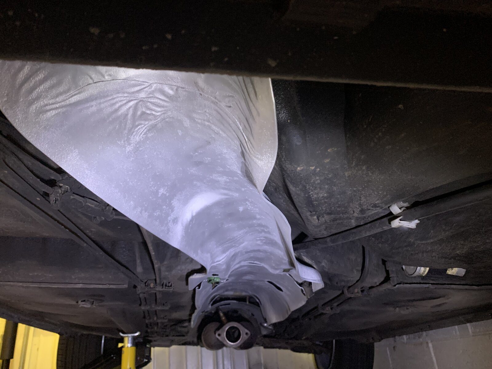

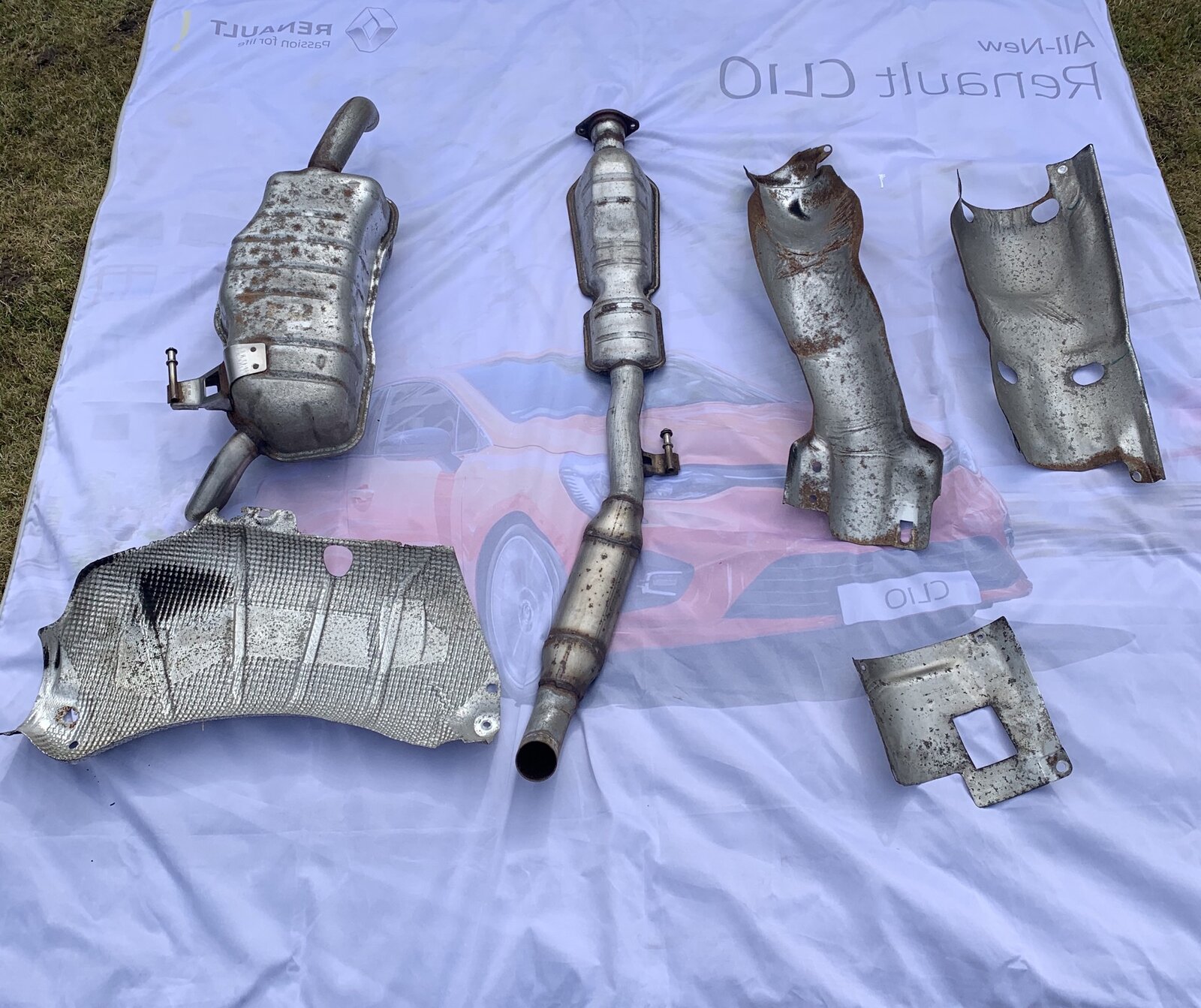

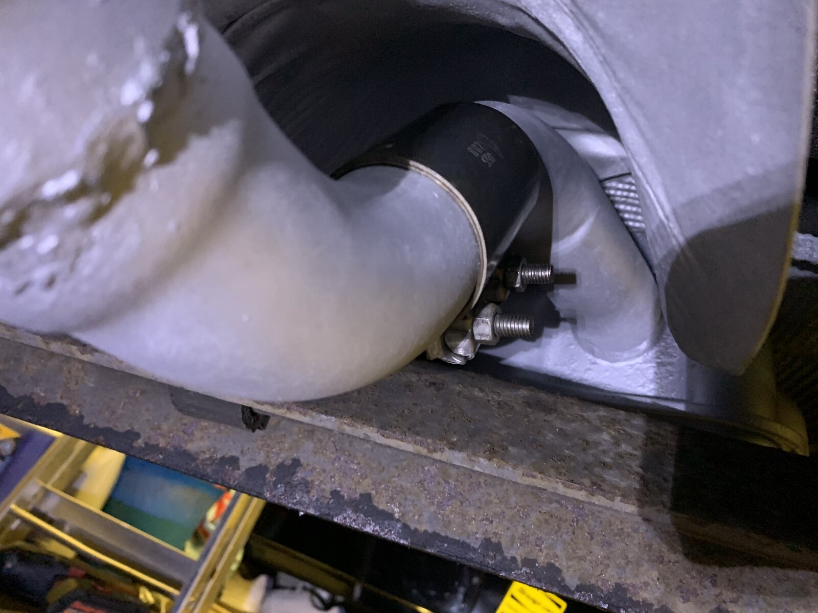

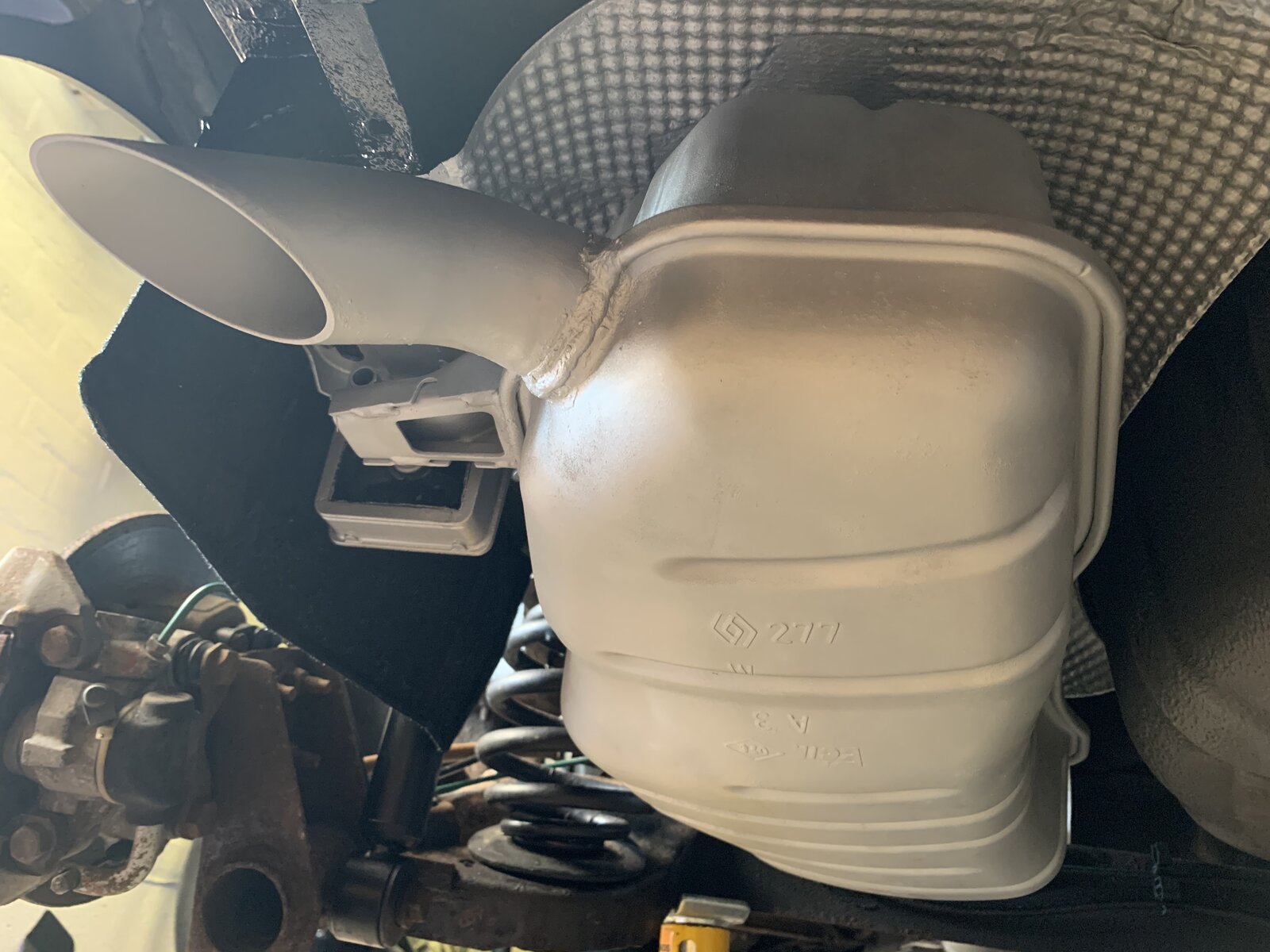

It had a replacement Center section and back box in 2009 @ Renault so it would have come in two pieces.
from factory it would have been complete.

With the Menzerna polish, do you just use the heavy cut compound? I've used their stuff before but have then used the medium and then the fine compound after, but not sure if that was a little over kill. I am looking to do mine again this weekend (as there is nothing else to do).

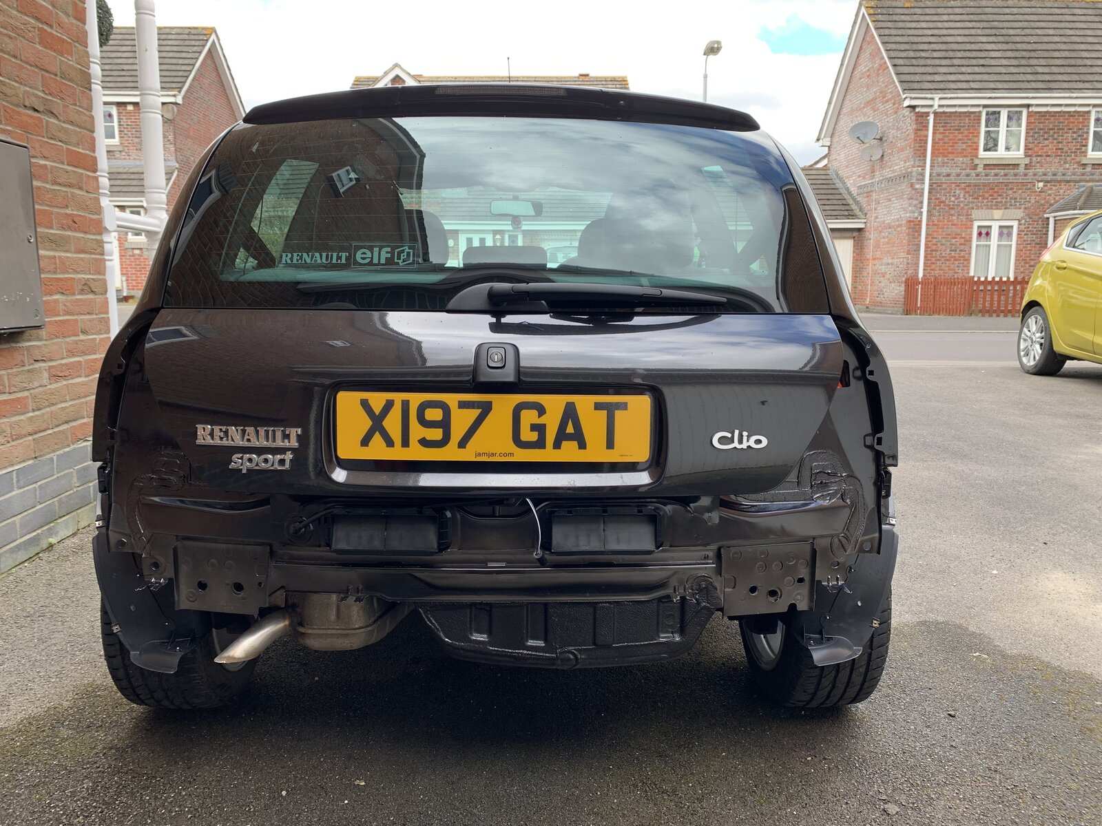

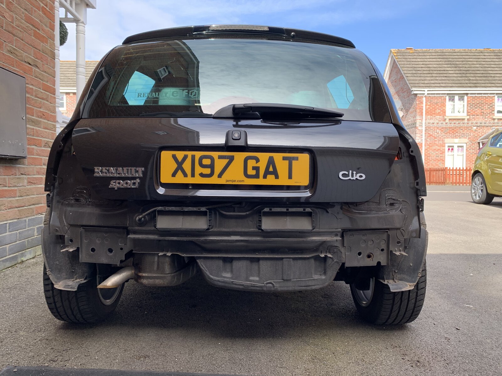

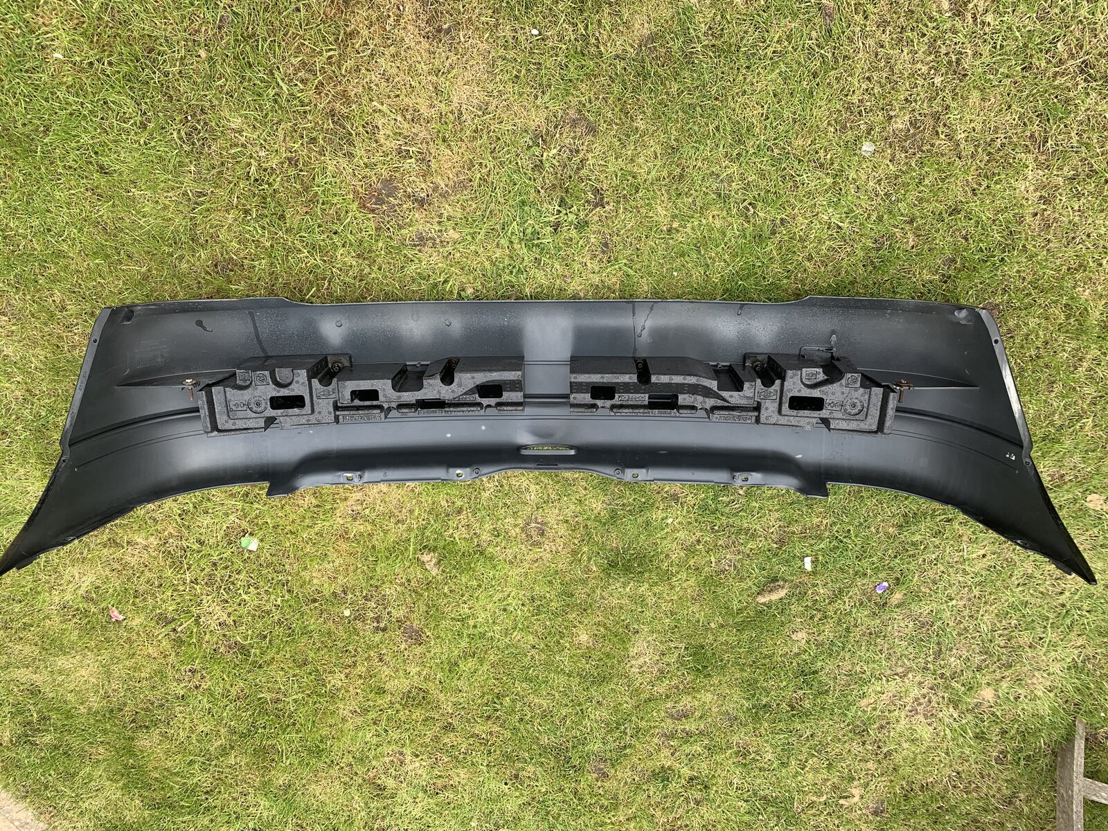

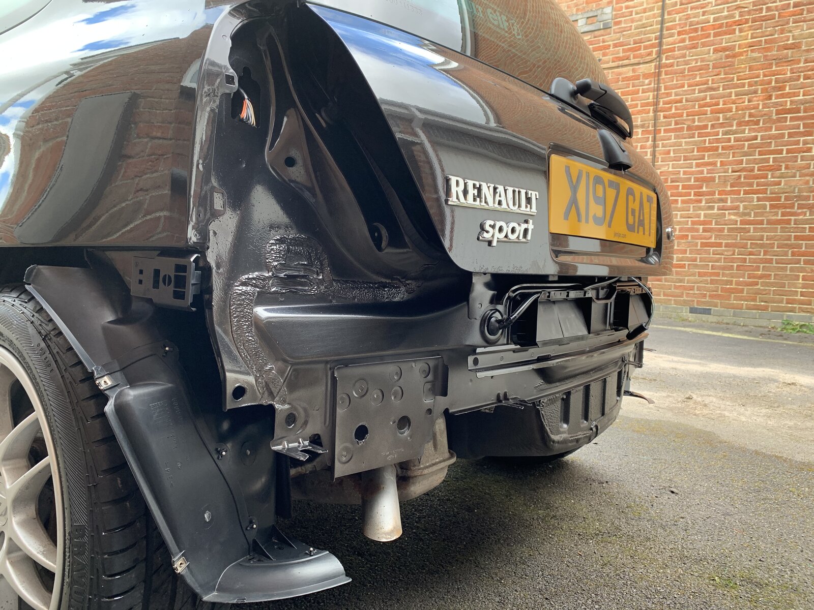

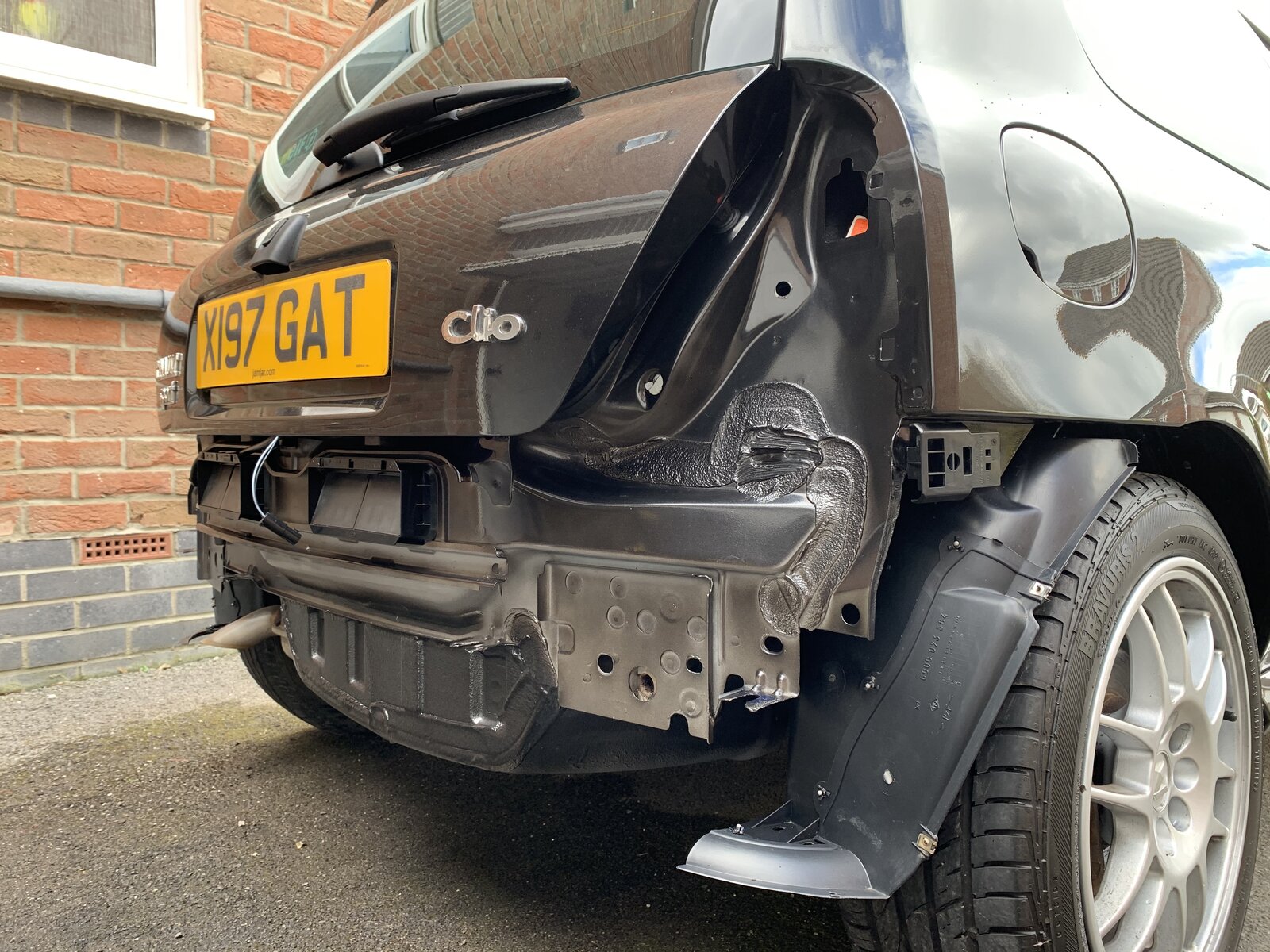

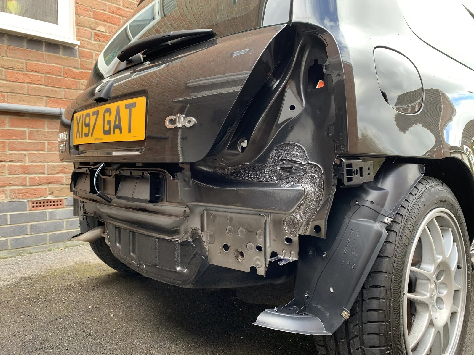

Another job ticked off, bumper and lamps removed to clean all the crud out.
I had the rear bumper off my E34 over the weekend to do this, my neighbour said "have you really taken the bumper off to wash it" in a really condecending manner like I was an idiot. I do it becauce my 30 year old car is in better condition than the brand new Ford Kuga you drive.
Martin_172
Yep, rear beam off next and scrub all the underside.
There's a seller on eBay that sells febi bilstein rear beam bushes that come with new nuts and bolts for under £30, I bought a set purely for the nuts and bolts as Renault had them in back order and the bushes look fantastic quality, just as good as OEM. Doddle to change too
Yeah I machined it’s with heavy cut as the paint was so dull and flat, I then went over it with auto glym super resin and collinte 476 wax to finish off.
Yeah neighbours probably think I’m mental constantly working/cleaning an old Clio 🤣 some people walking past stop for a chat sometimes.

Did you use a DA to apply the Autoglym stuff? I’ve got a bottle of that too and only ever applied it by hand.

Yea used a DA for the auto glym, then went over it by hand afterward :)

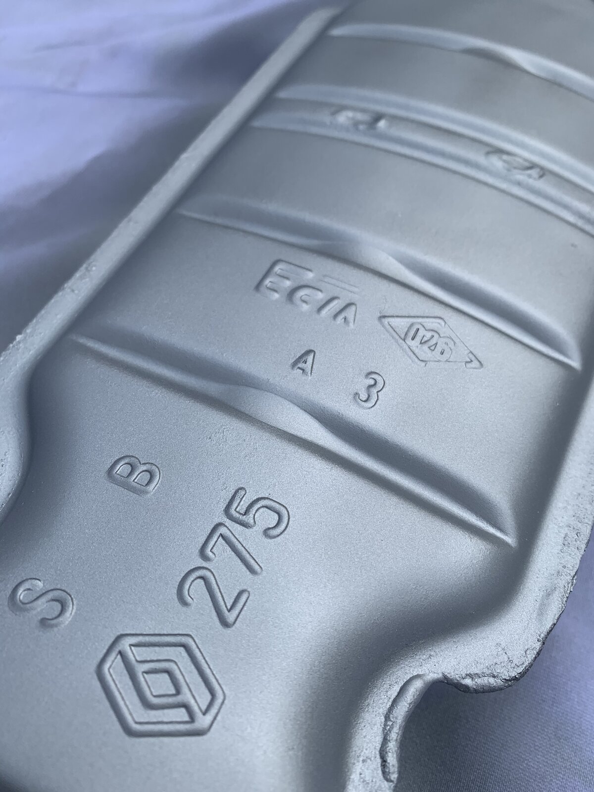

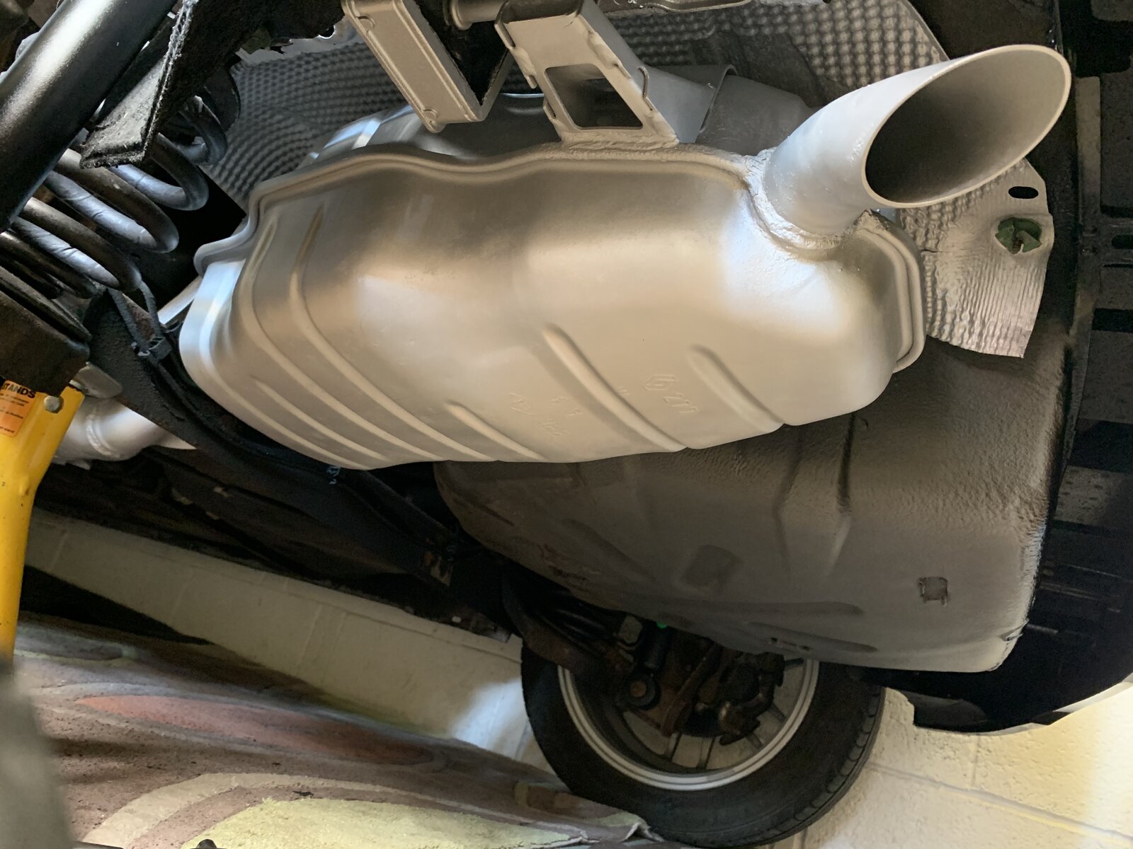

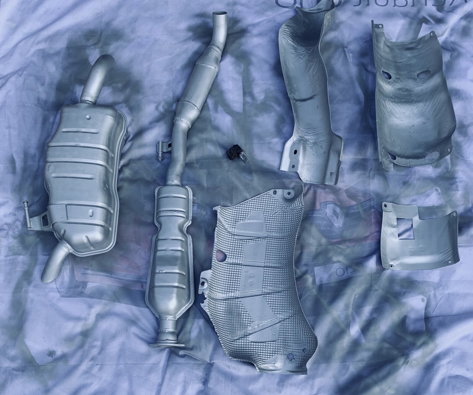

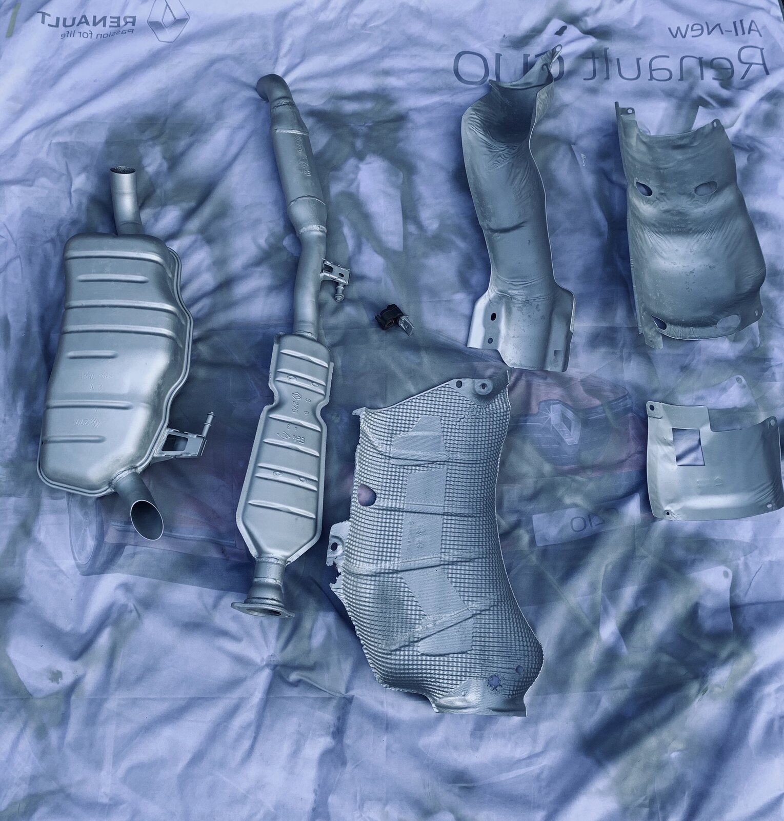

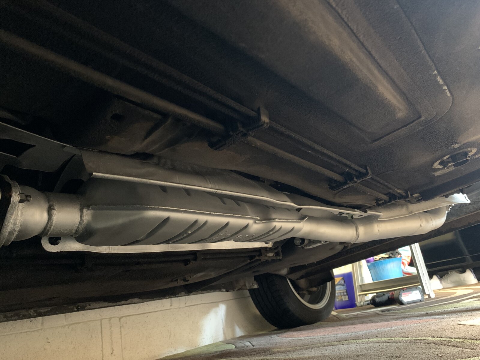

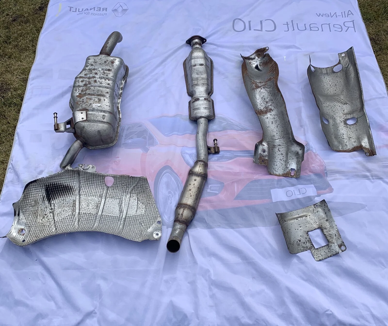

Cracking job with those heat shields / exhausts. I had to laugh at the guys FB comments last night about why you were wanting to use the OEM system :ROFLMAO: #matureowner
Alastair.
  986'S 172ph1+182FF

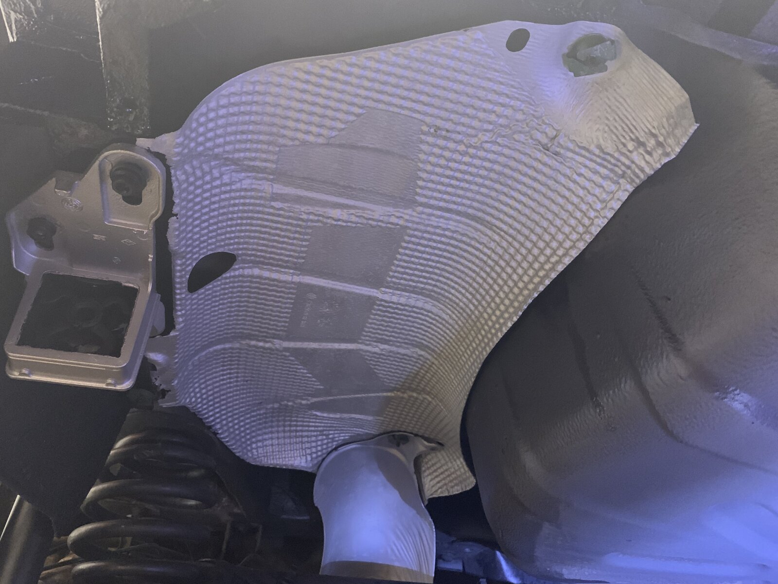

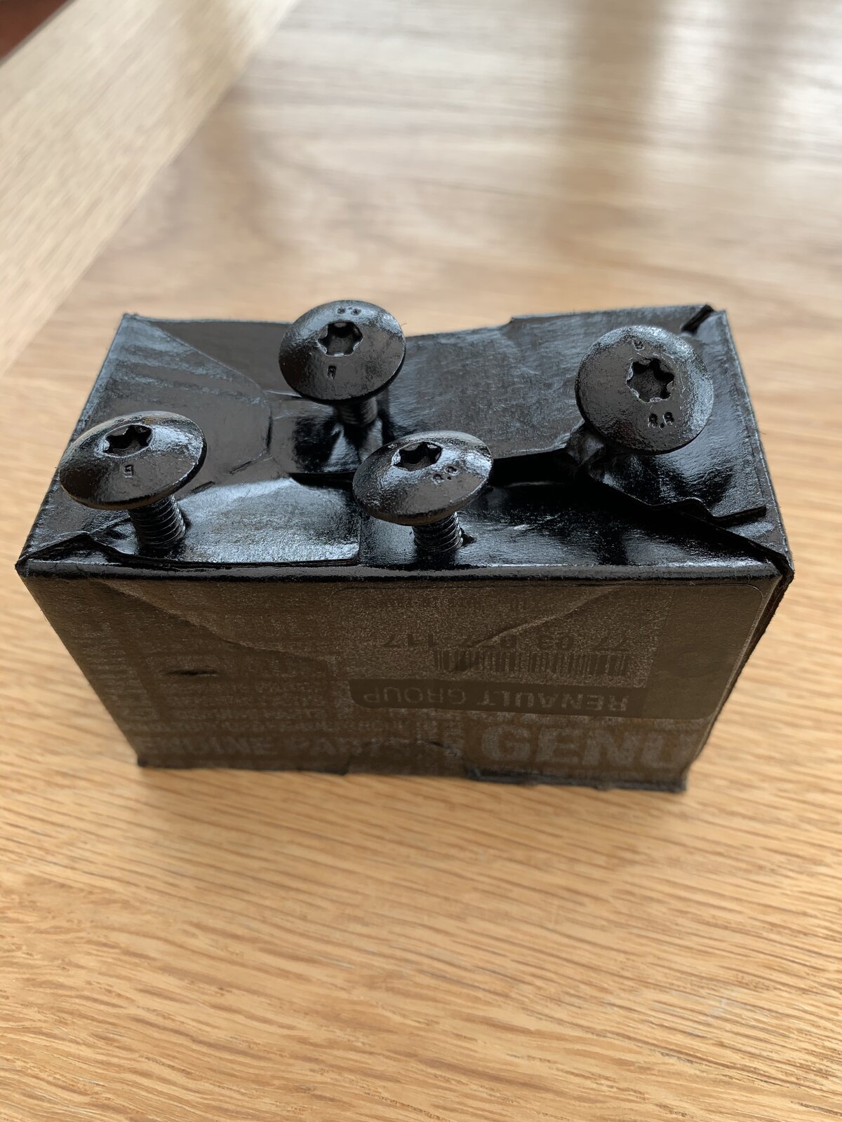

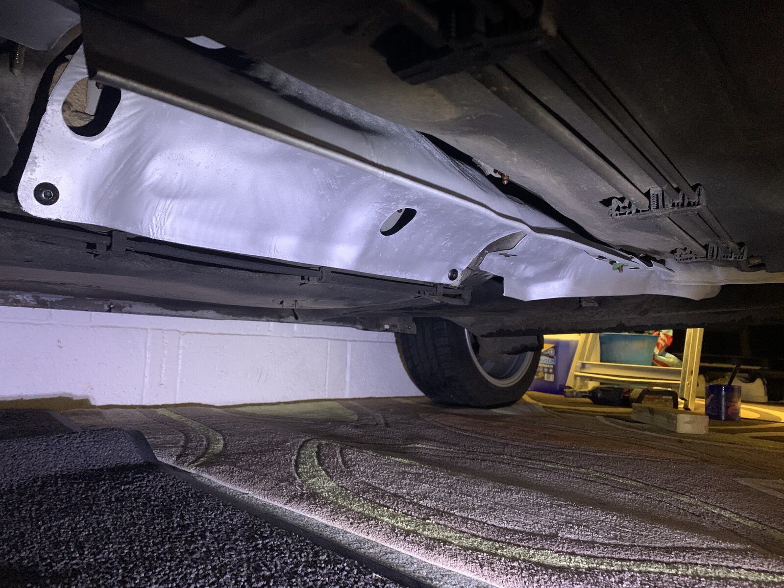

im calling you out on the exposed heat shield bolts not being OEM ha
They are OEM, wire wheeled them and then spayed them all black 👍
the heat shields clips are also original, cleaned them up, painted green from factory.
  172 Sunflower
even those that fit the offside ? not those that install into the chassis but the crap design with the exposed threads
