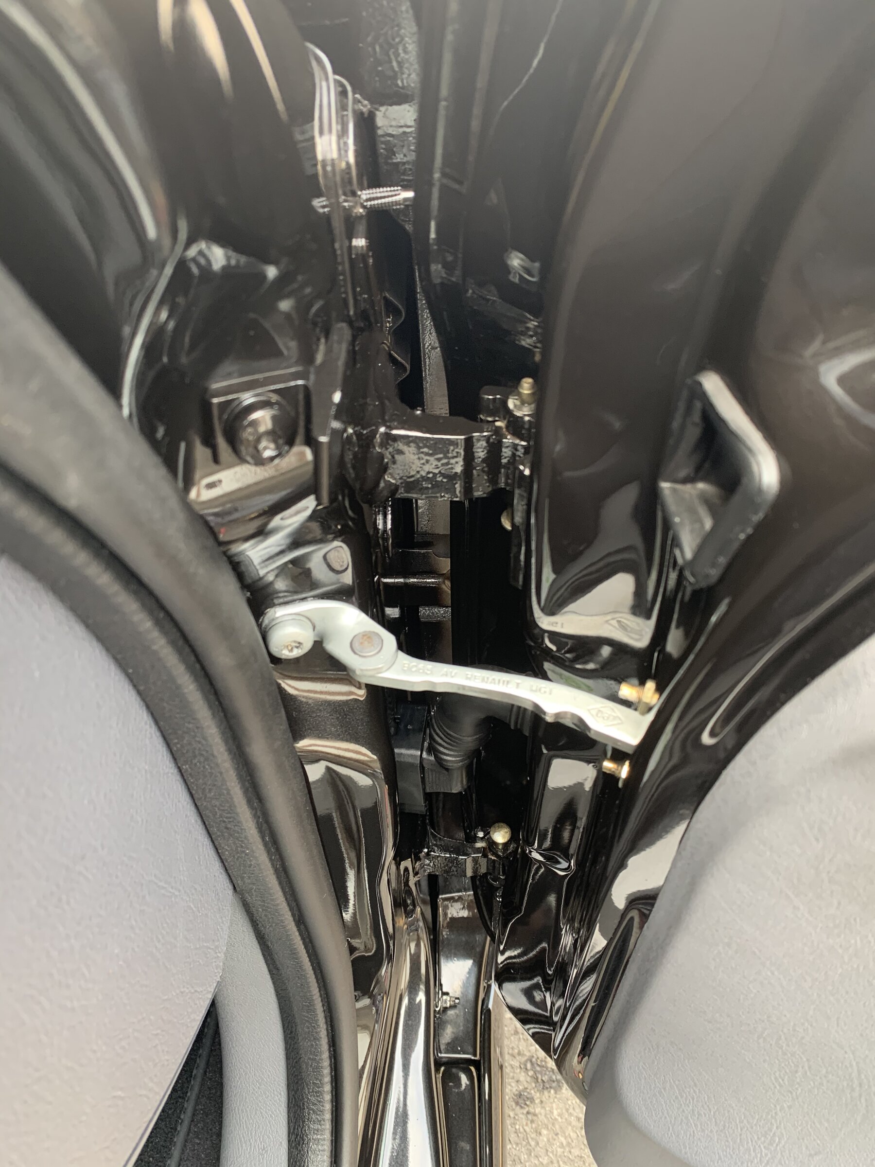

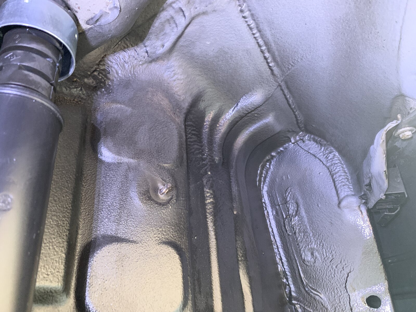

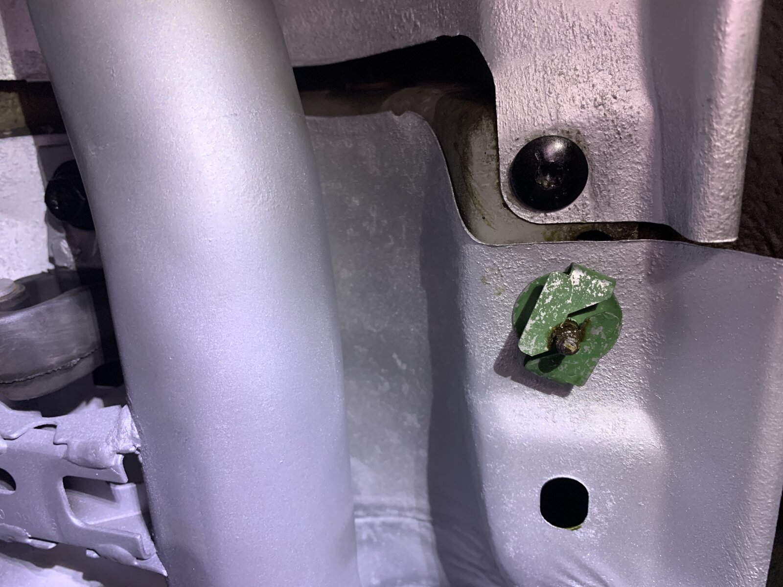

even those that fit the offside ? not those that install into the chassis but the crap design with the exposed threads
you talking about these?

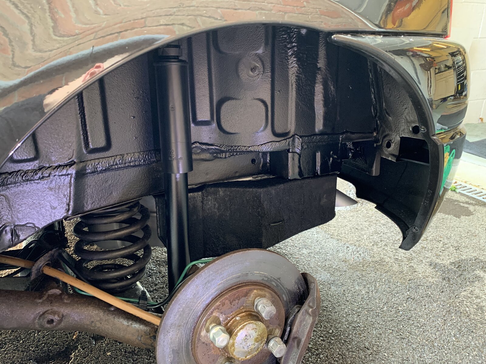

i am a little concerned about the metal work around the area of where the rear beam mounts against the chassis on the passenger side, i do hope it doesnt need plating. I think i need to drop the beam and see what i find, how do you go about dropping the beam ? are the bolts captive ? i see Renault have fitted the bolts upside down leaving threads exposed ?

the other side where the shields connect together with an exposed captivated nut, i had to grind them off and will redrill when i can find a sharp drill !
lol I’m not really sure which bit you’re on about? Screen shot it but u can assure you all the nuts, bolts, caps etc are original.
Hope and pray the nuts un do I suppose, I’ve been spraying mine down regularly in the hope they’ll come out.

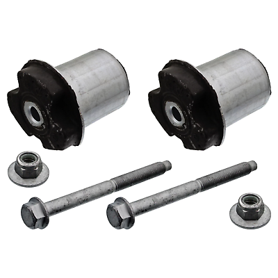

There's a seller on eBay that sells febi bilstein rear beam bushes that come with new nuts and bolts for under £30, I bought a set purely for the nuts and bolts as Renault had them in back order and the bushes look fantastic quality, just as good as OEM. Doddle to change too
Could you link me to the item, just what I need!

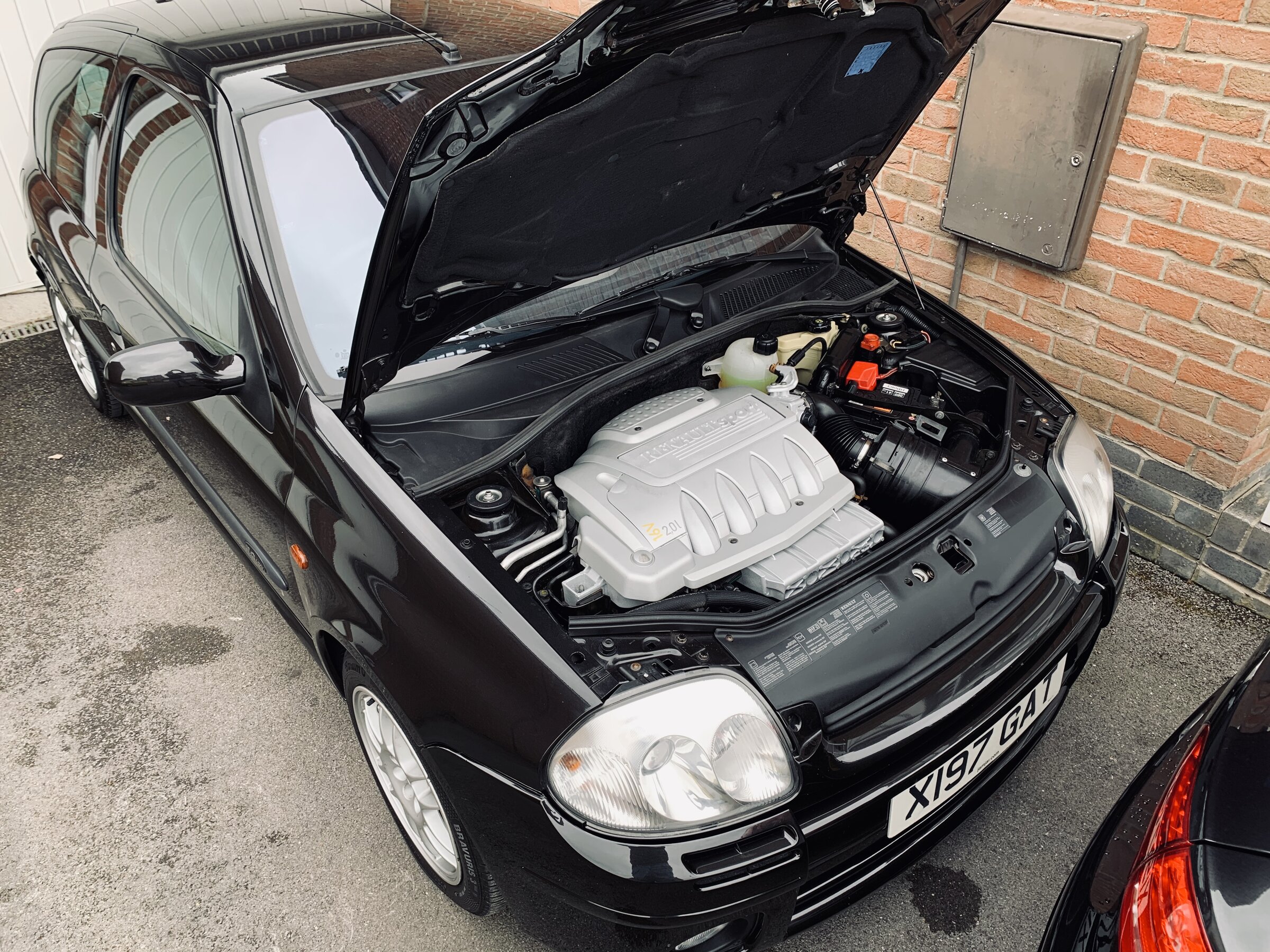

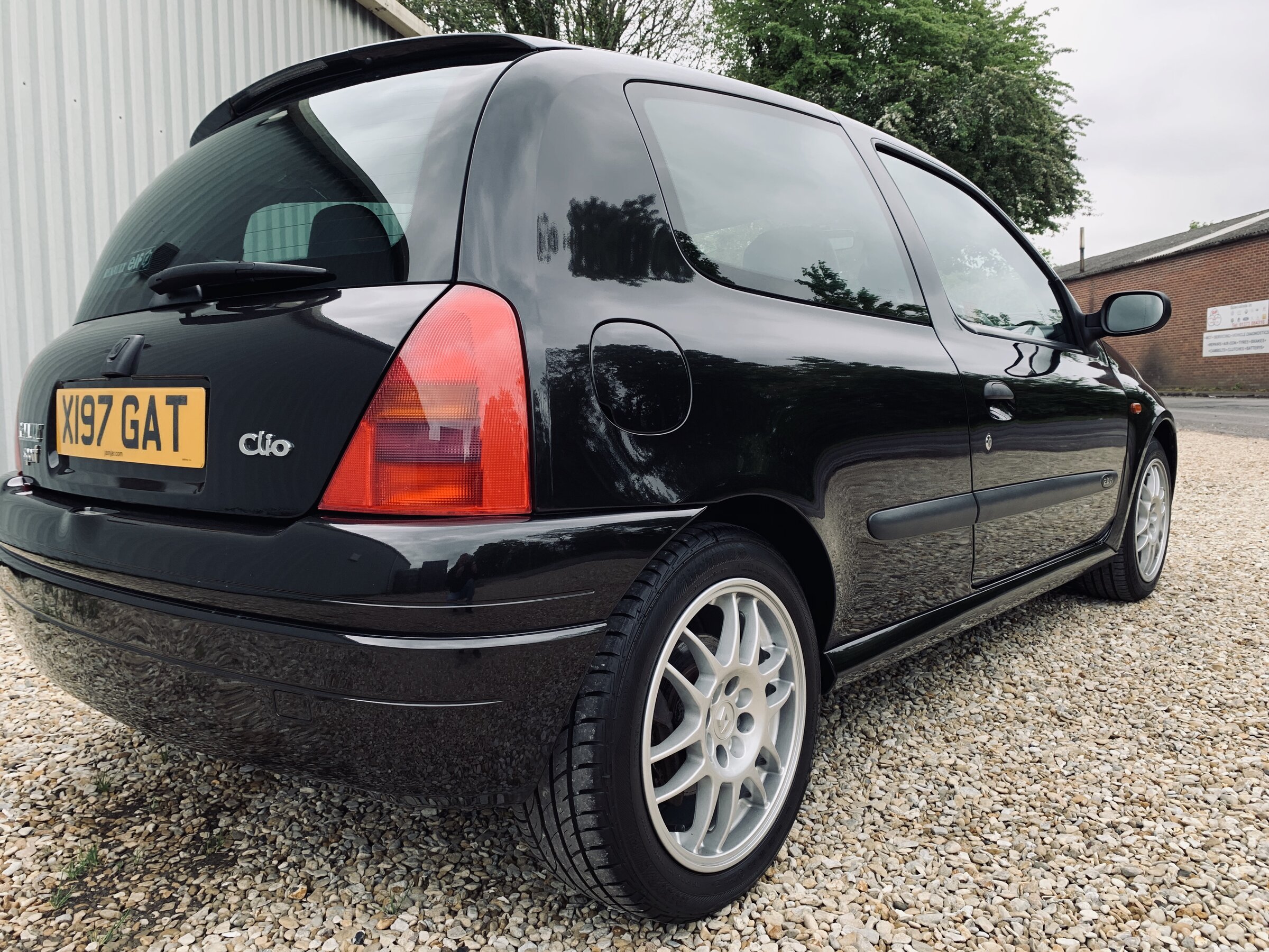

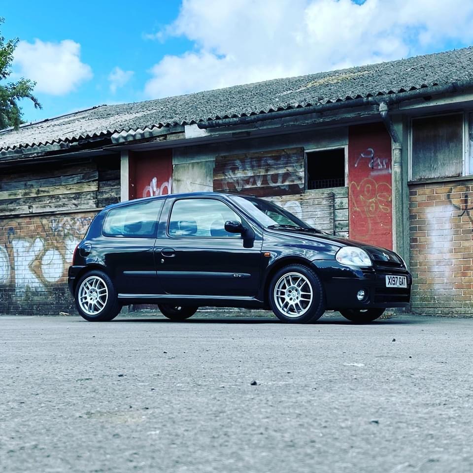

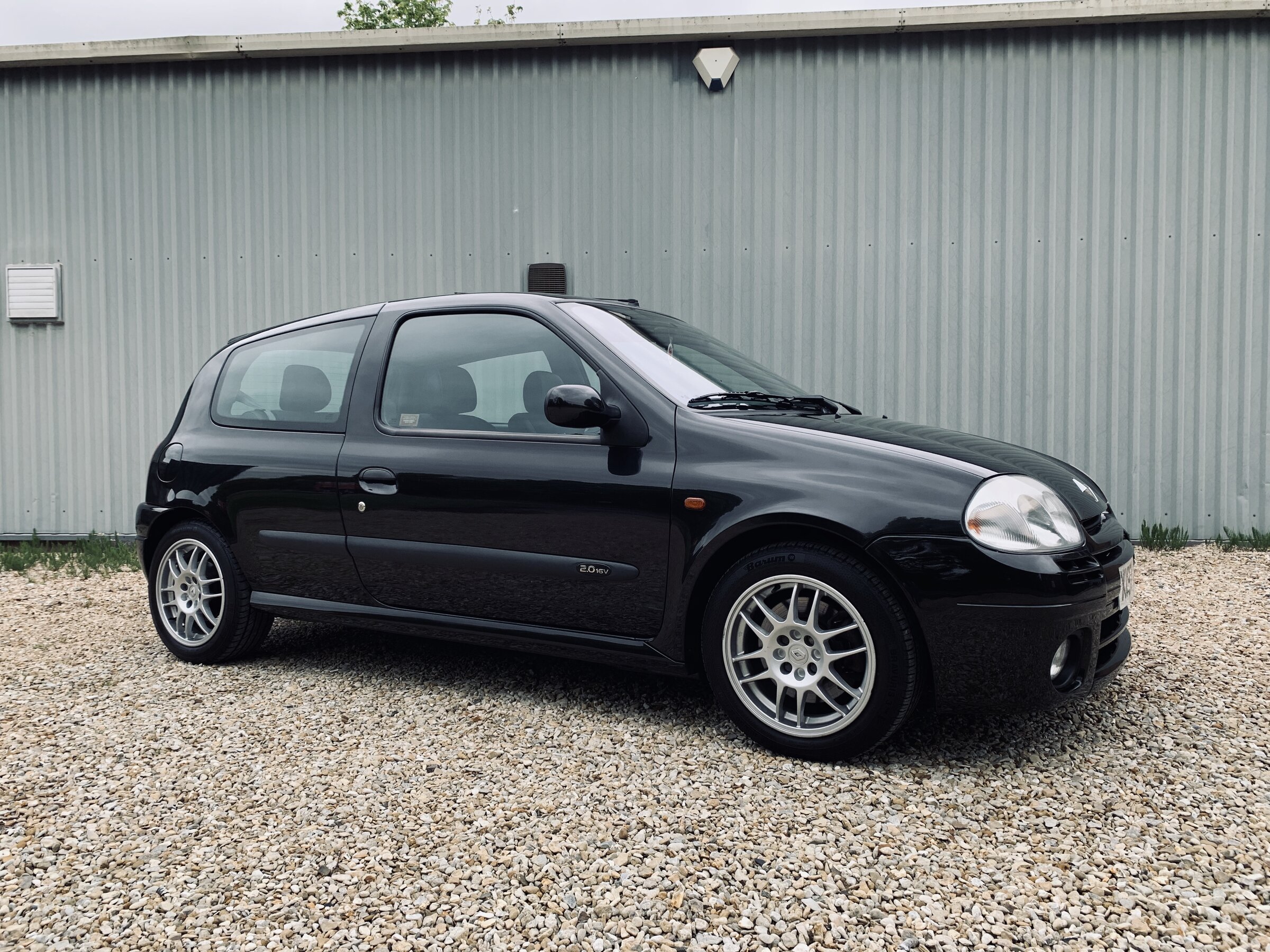

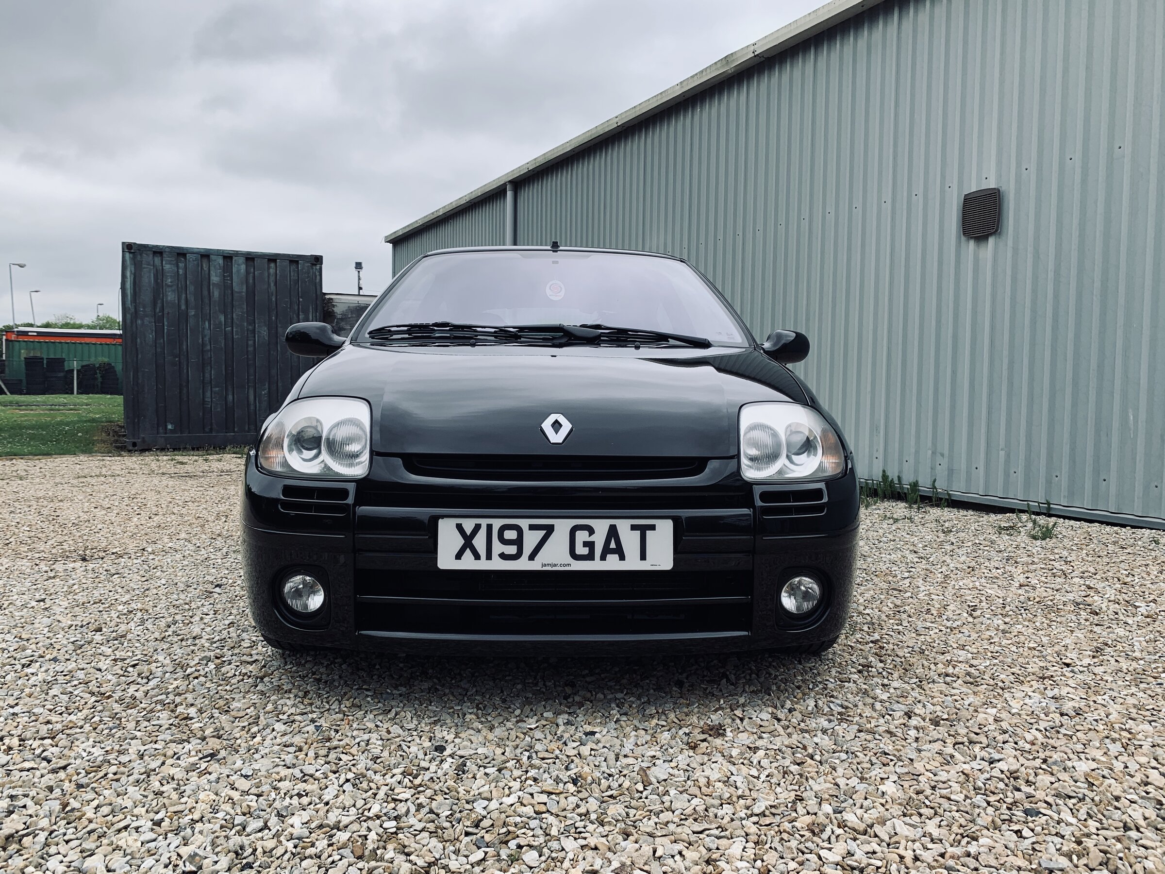

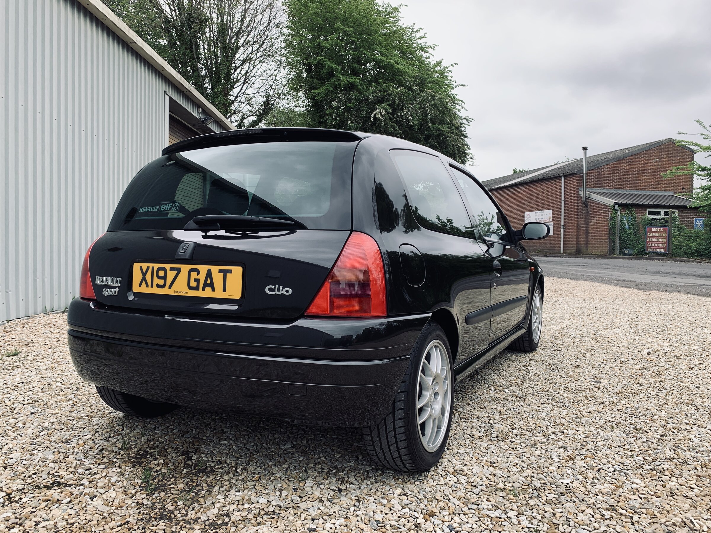

Taxed the ph1 today, first proper outing since I got it last year. Cracking drive, engine is super strong throughout the Rev range, gearbox is perfect.
Im sure the phase 1s were built better than the phase 2s, virtually no rattles etc.
Really pleased with this little car :)

Love it!!!
What’s next for it??
Get the wheels powder coated
Paint rear beam
Thats the main bits done then.
In time I’ll replace the lower arms, steering arms, track rod ends and probably all the cv boots, nothing wrong with them all just old.

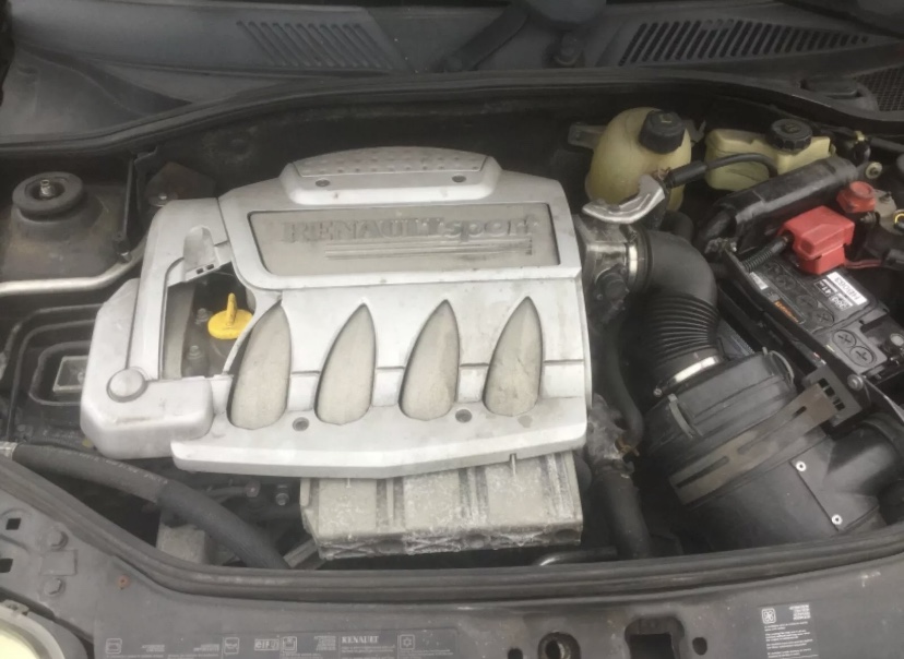

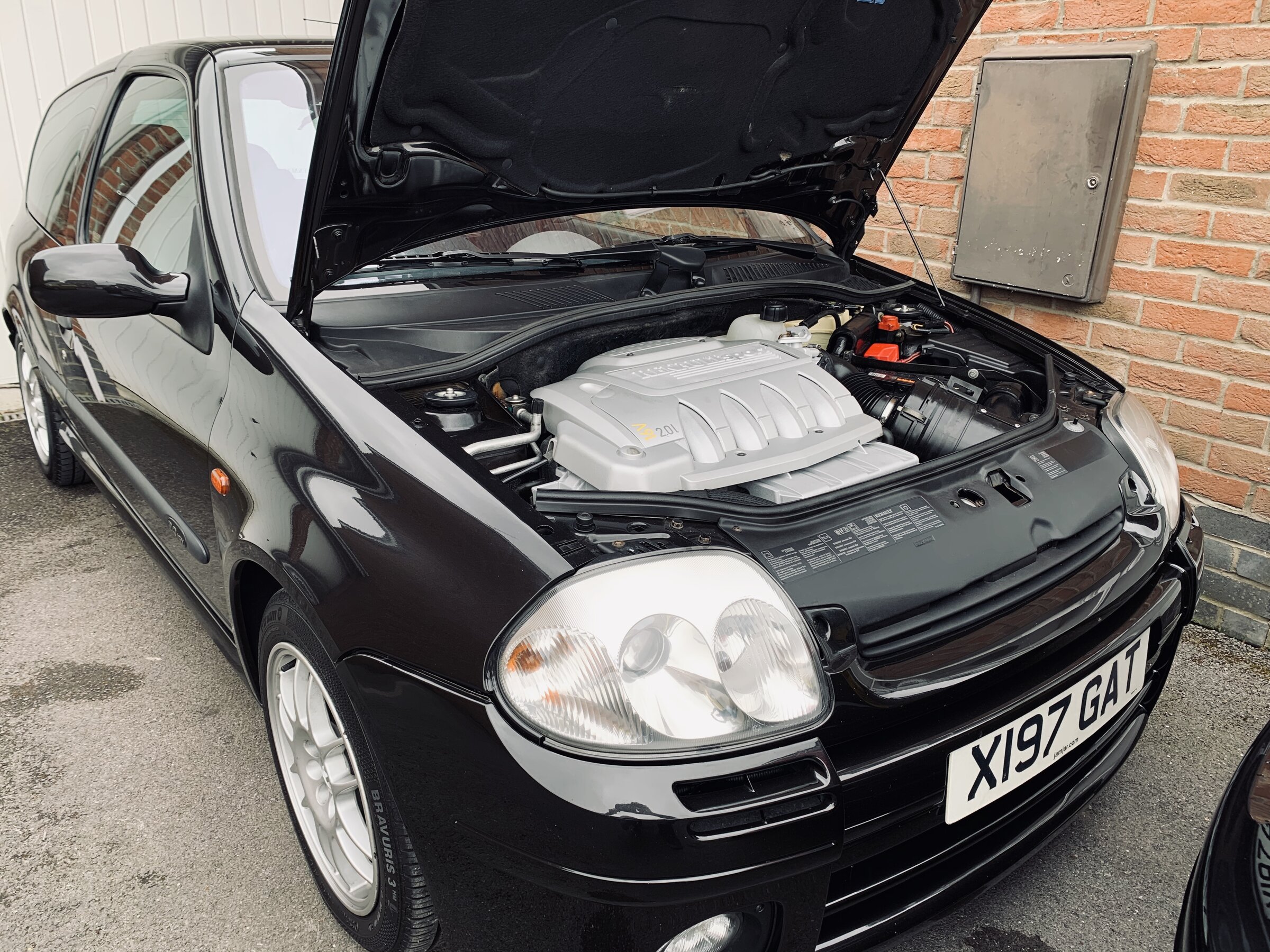

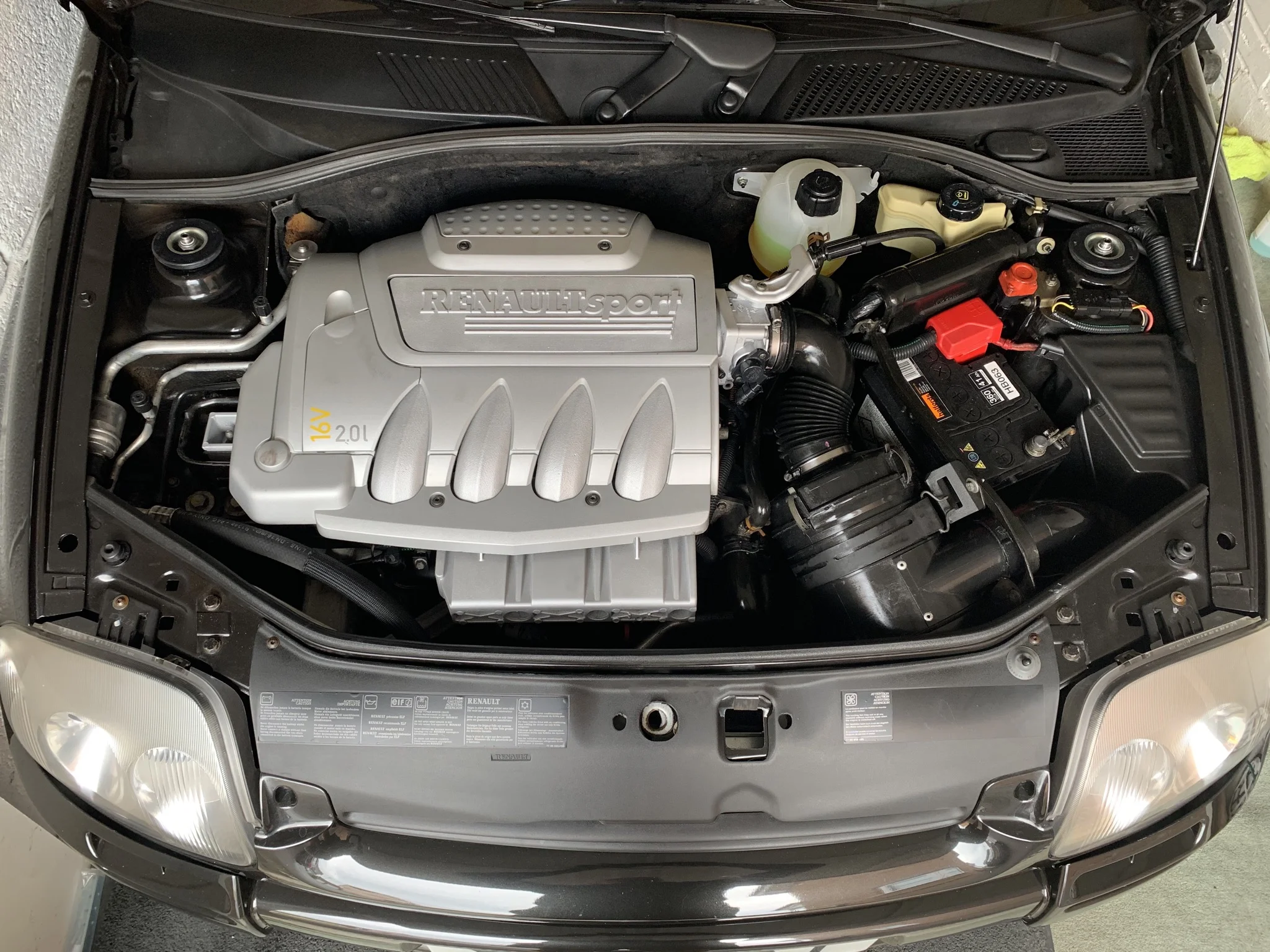

What did you use? Came out perfect!
Wish I took a before picture now!!
You’ll laugh but this is what I used.
Wet wipes to get all the crud and grease off.
Sprayed and wiped down with wd40 to clear any remaining grease
Washed down with fairy liquid and a paint brush
Dressed with auto smart dash dandy and buffed up with a clean microfibre.
Think I spent about 1.5/2hrs in total doing both sides, but they’re pretty much spotless now.
