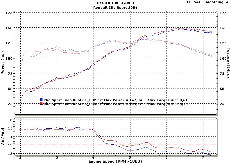

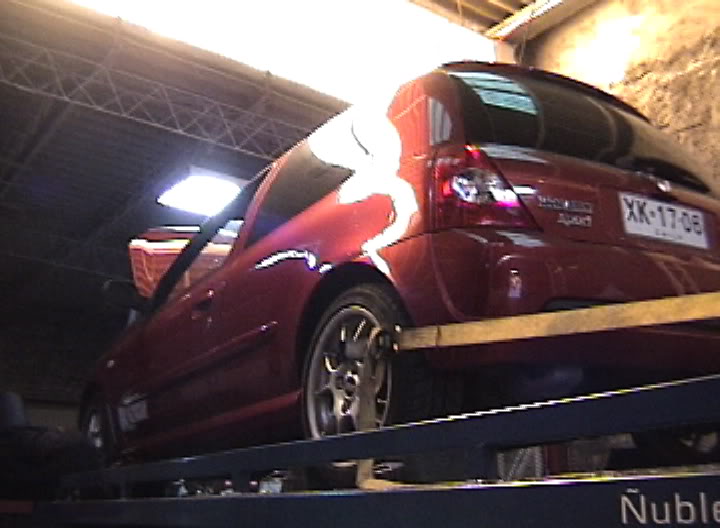

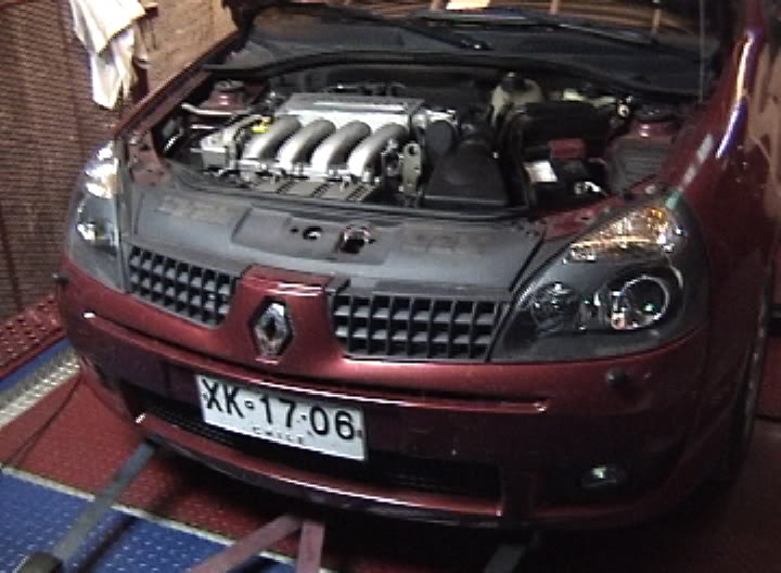

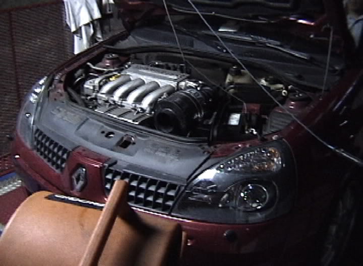

OK, yesterday I tested my car in a rolling road. I wanted to test the true hp gain (hopefully) with the BMC CDA filter. In the graph below, the blue line corresponds to the car in it standard condition with the original airbox. Red line represents the car with the BMC filter fitted. Two large fans were used for the air supply. Notice the BMC filter position in order to receive the fresh air from the fans.
RESULT... Disappointing 2whp and 3 ft-lbs gained with the BMC CDA filter. PLEASE DO NOT EXPECT MORE!!!
147.34 whp (100% standard)
149.22 whp (with BMC CDA filter)
PS: Picture quality is not the best, in fact they are screenshots of a digital video tape.
Additional info:
Dynojet 248 Mobile Chassis Dyno
SAE corrected
Temp: 24.5ºC
Humidity: 35%
Alt.: 500m
Renault Clio Sport 2003 (late), 18.000 km

surely with it being positioned as it is, it is going to give better gains? bonnet open too? can hardly drive it like that? i think if you positioned it properly and shut the bonnet you could probably say goodbye to your 2bhp.

They usually have a blower at the front of the car when on the rolling road and as said bonnet up so you are not going to do better then that.
It is a good representation of how little a filter gains even an enclosed one.
What does the air fuel ratio show obviously it is leaner but is it to lean? How much would it benefit from being mapped?

Should have positioned the filter as it would be under normal driving positions - not a true test IMO

Yep, there were 2 large blowers at the front of the car (actually in front of the filter). For sure

Do someone have a conclusion from the A/F graph?? I think it's too lean below 4000rpm.

With the bonet down, I bet you've lost 2hp. lol
ou've got the filter sticking up and an out and have the fan pointed at it!!

exactly my point!!

Its a shame its not been fitted properly for a fair test. Mine feels as if it has more midrange when fitted correctly - and the noise is worth it alone.

The idea was to test the "best case". I'm sure, that with the filter "properly" fitted and the bonnet down, results would be worst. Anyway, the 2 blowers will never simulate the actual driving conditions.

My Conclusion: I can expect at most ~2 whp for just using the BMC filter. That's all!

BTW, the absolute value obtained (147.3 whp, 100% standard) is what I should expect for a 172 mk2???
