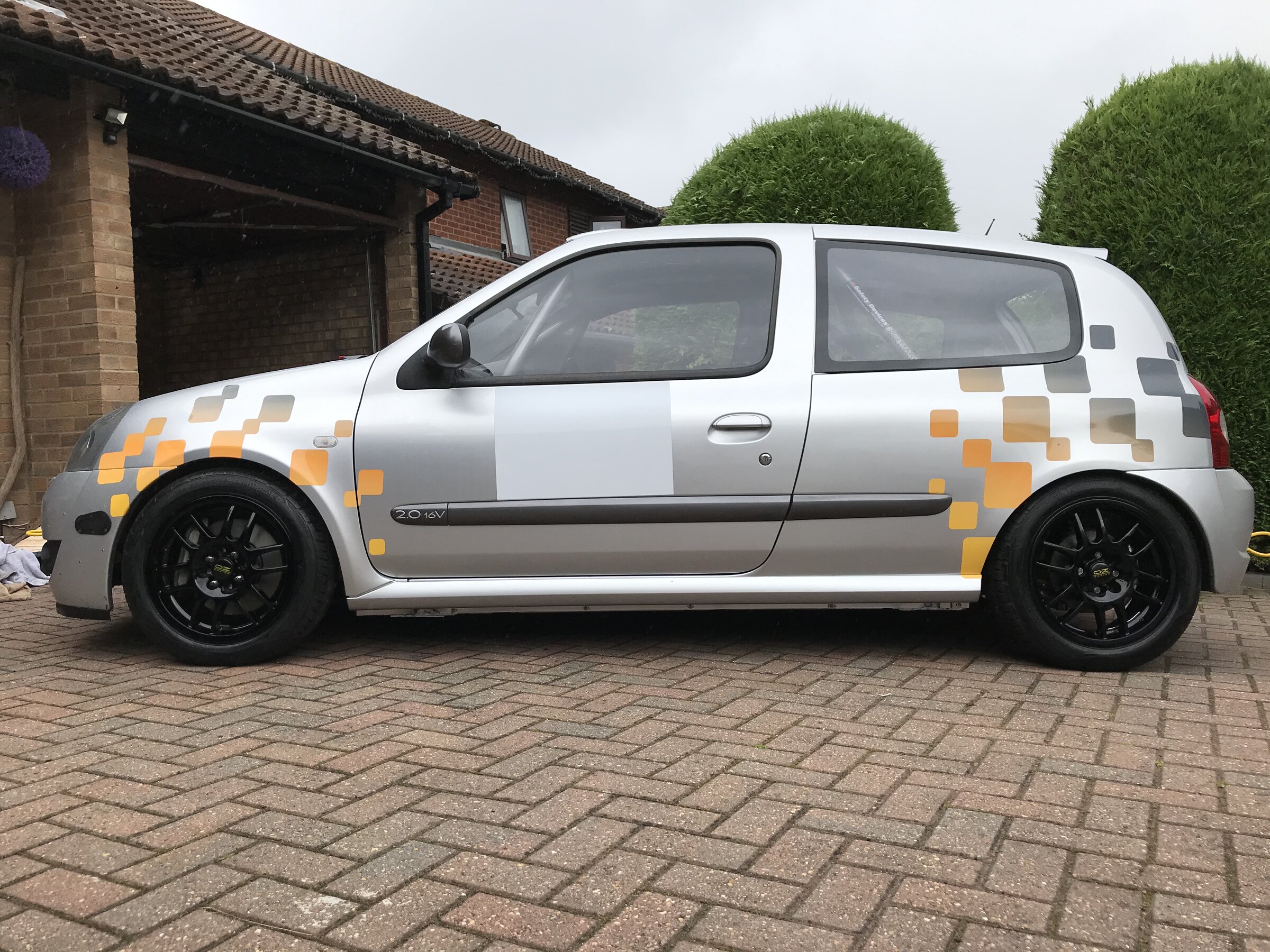

Great to see this come back together so quickly, it feels so positive when it is back down on its wheels doesn't it.

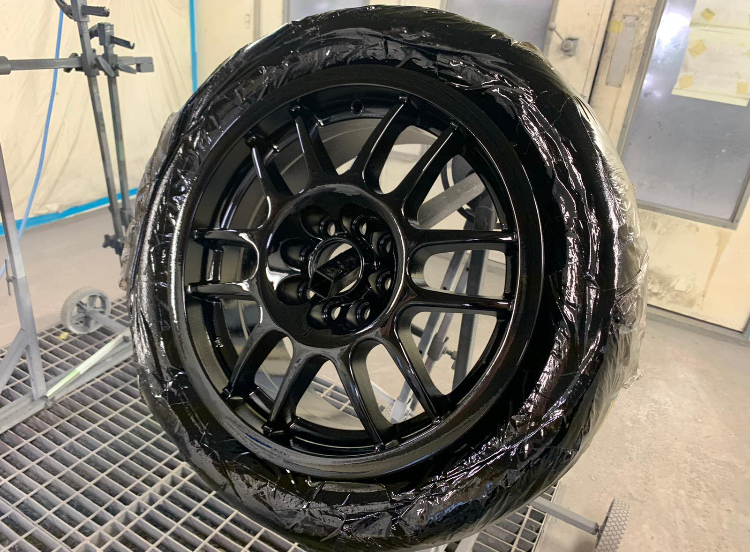

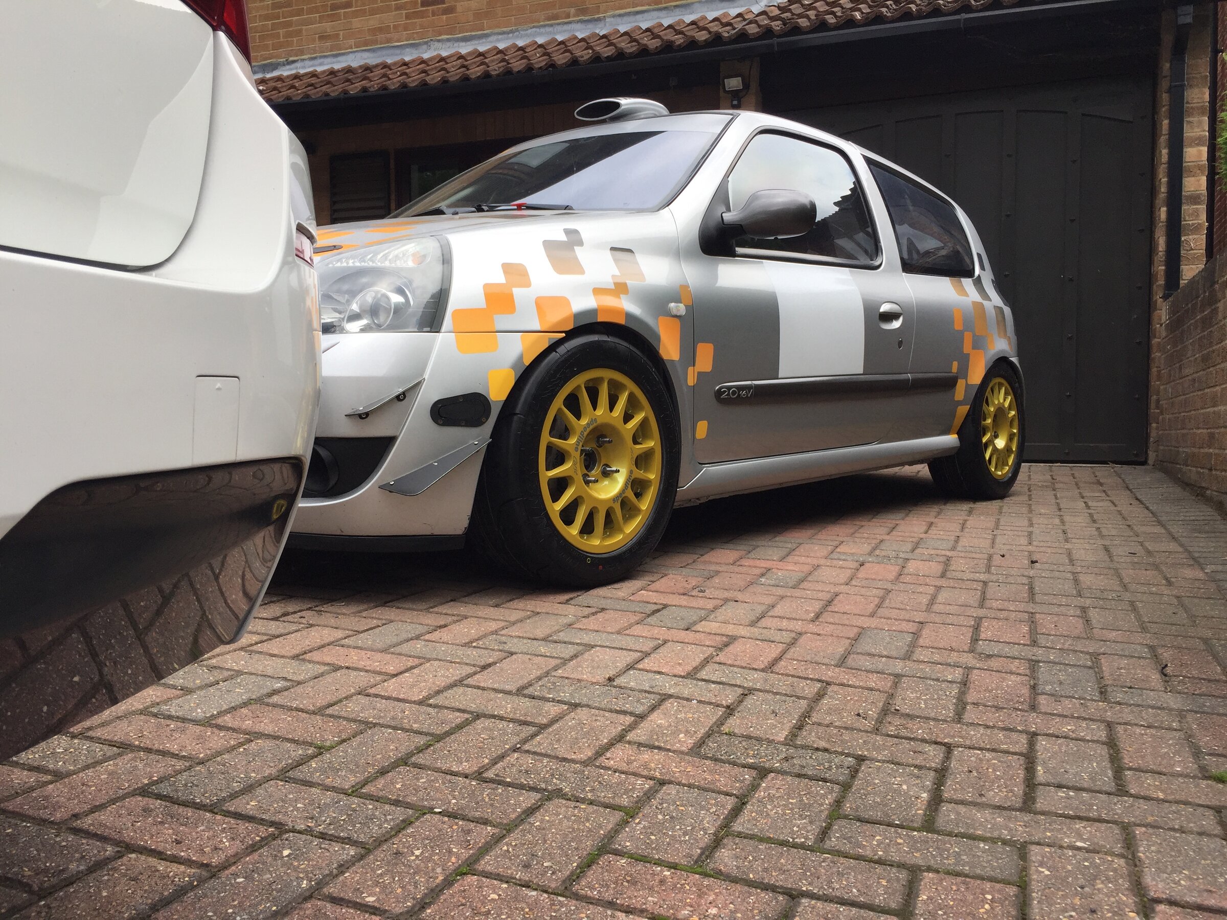

Love the look of it on the TD's, they sit so well in the arches.... the colour of the 2118's thought is spot on...
Hyperhatch
  182

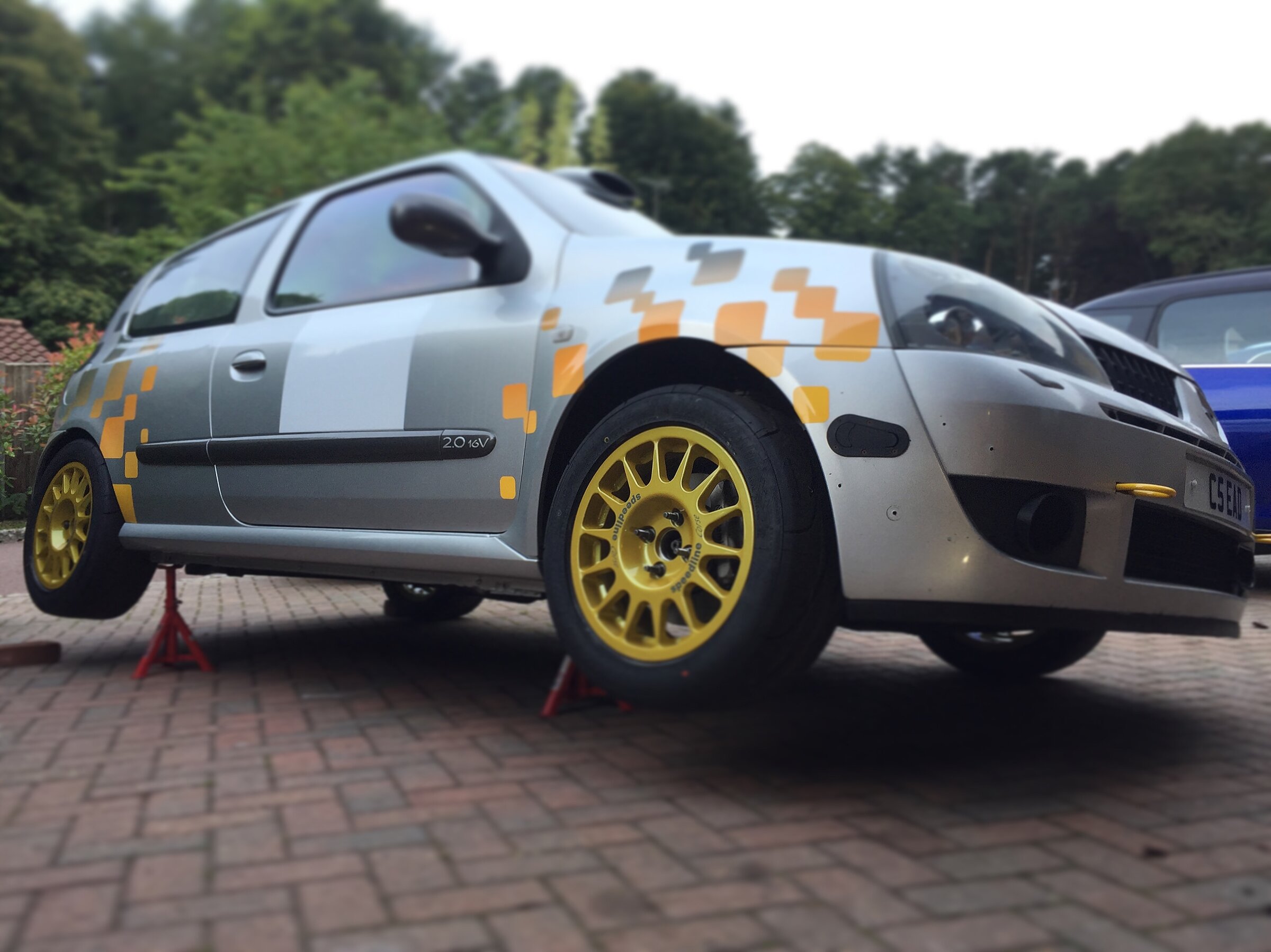

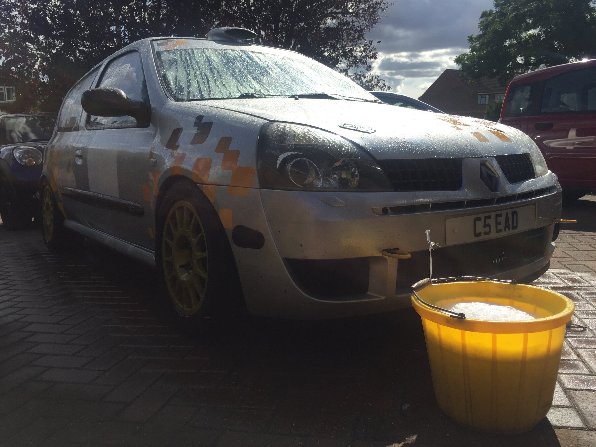

Cheers! Yeah now it’s looking like a car again it definatly re lights the desire to get it finished.
I was a bit worried about the 2118 colour but it’s a track car so colours are allowed?!
Nafoff

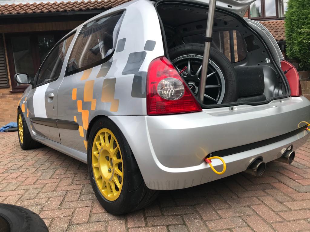

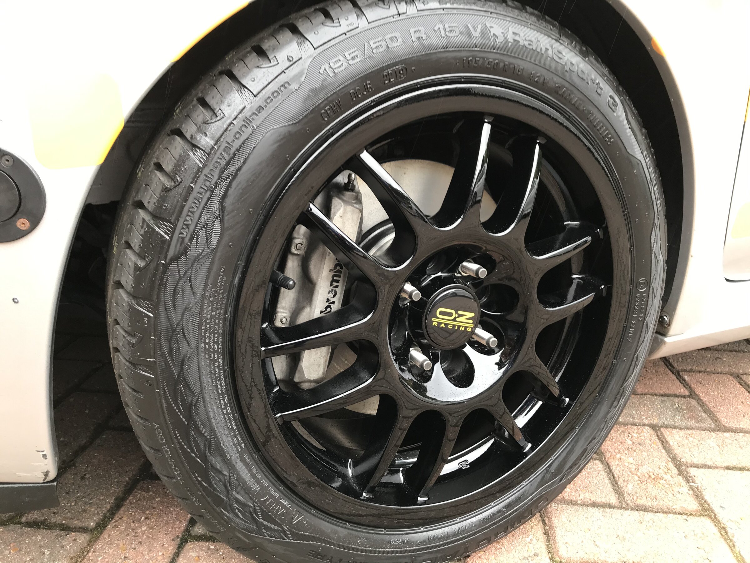

Agreed... personally way prefer the TD's though. What the sizing/offset on them? - they fit so well
Hyperhatch
  182
I don’t know the offset without looking tbh. They’re 16’ and off of the blue car I raced. I bought them off of Russ who owns the blue car. They look big at the front atm as the 20mm spacer is still on there from the 15’ wheels.
Nafoff
I thought they might be 16’s. That will be why they look like they are filling the arch. A 20mm spacer on mine caused rubbing.

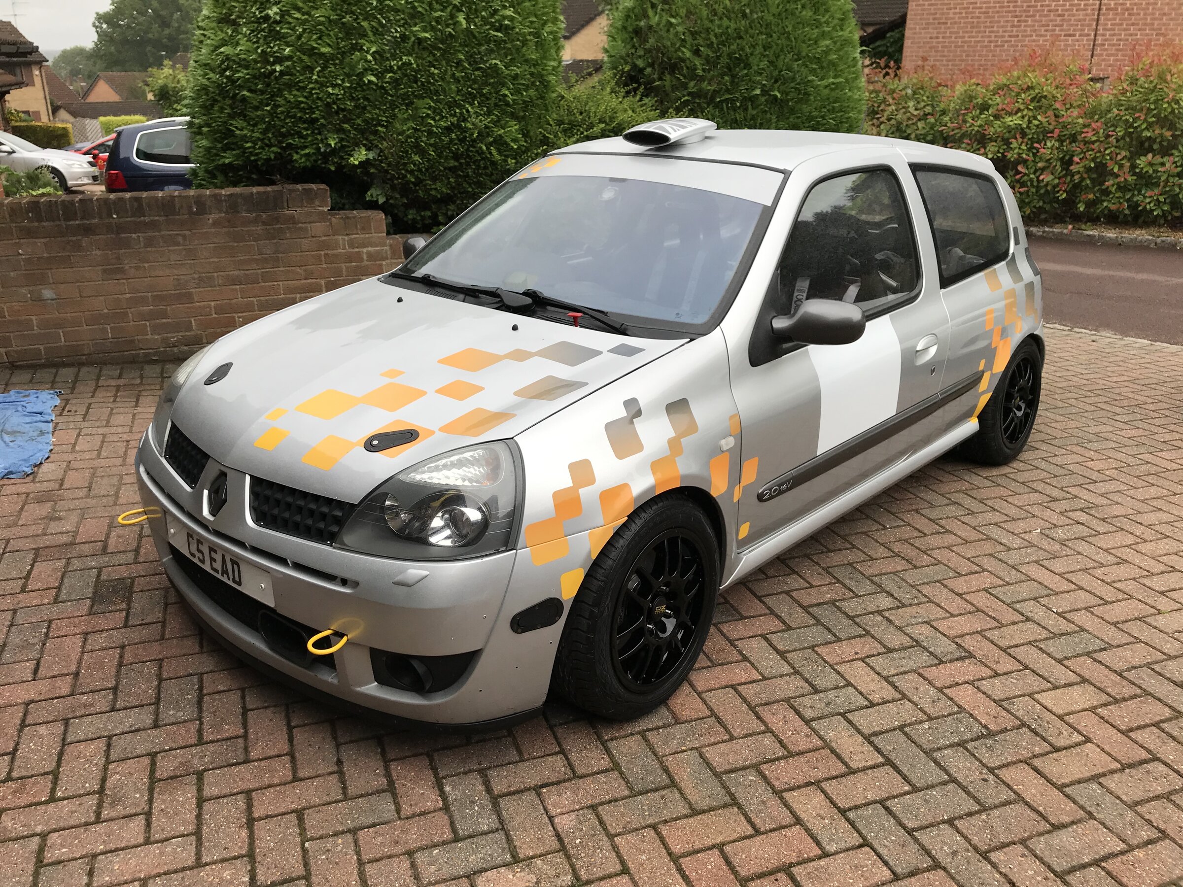

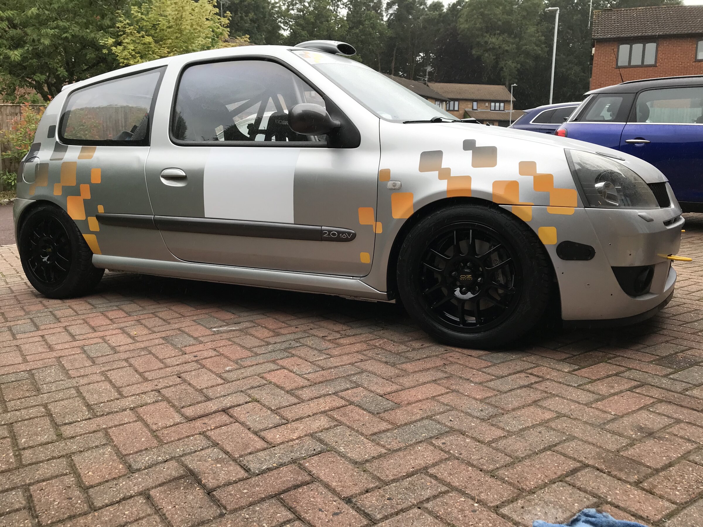

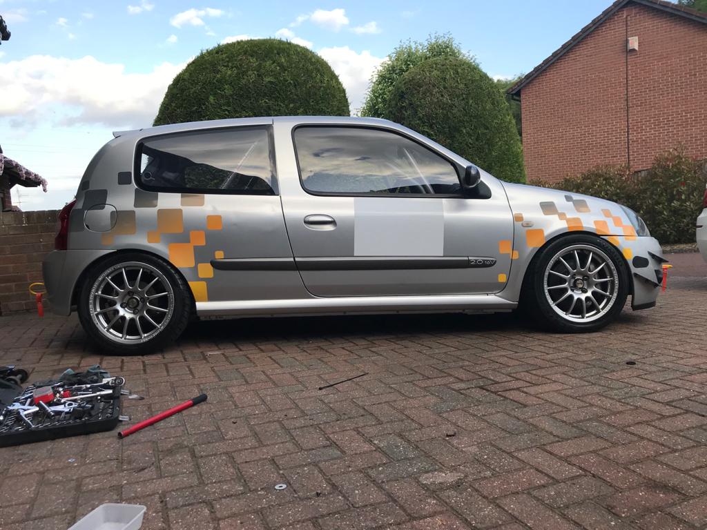

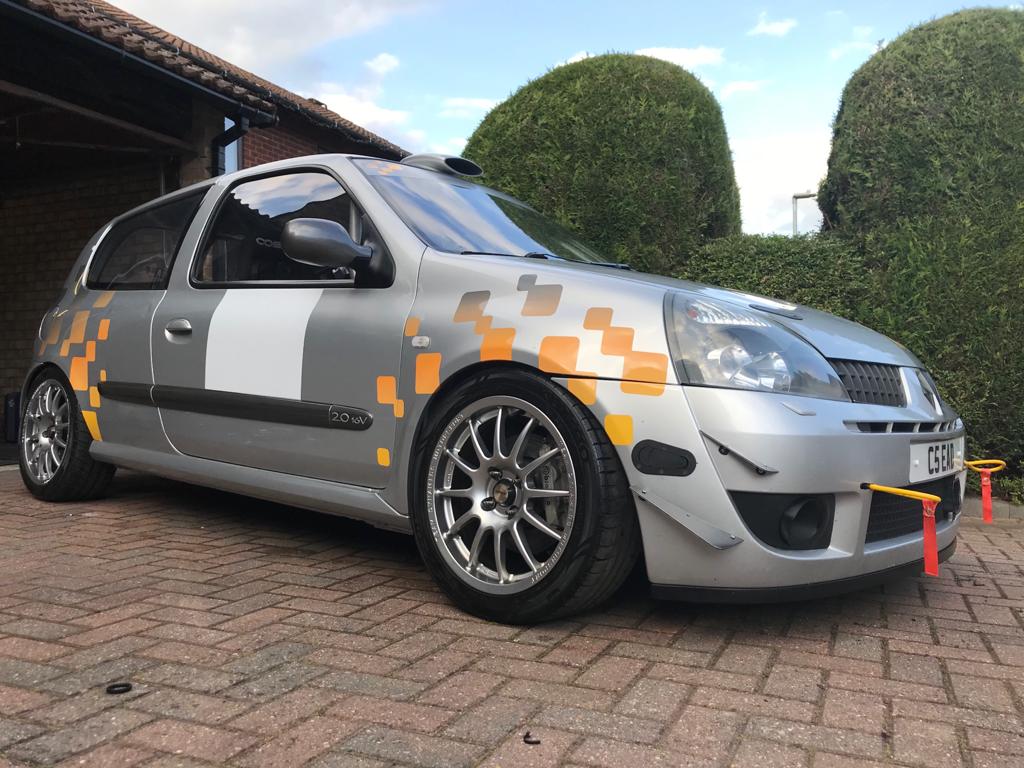

A couple of updates but no progress with the actual Clio of sorts. That hasn’t moved but...
The silver 16’ TD1.2s are sold. This wasn’t planned but the intention was to put some rainsports on them. A set of Oz F1s came up having just been refurbished and with brand new rainsports on them so a deal was done and an exchange will happen shortly.

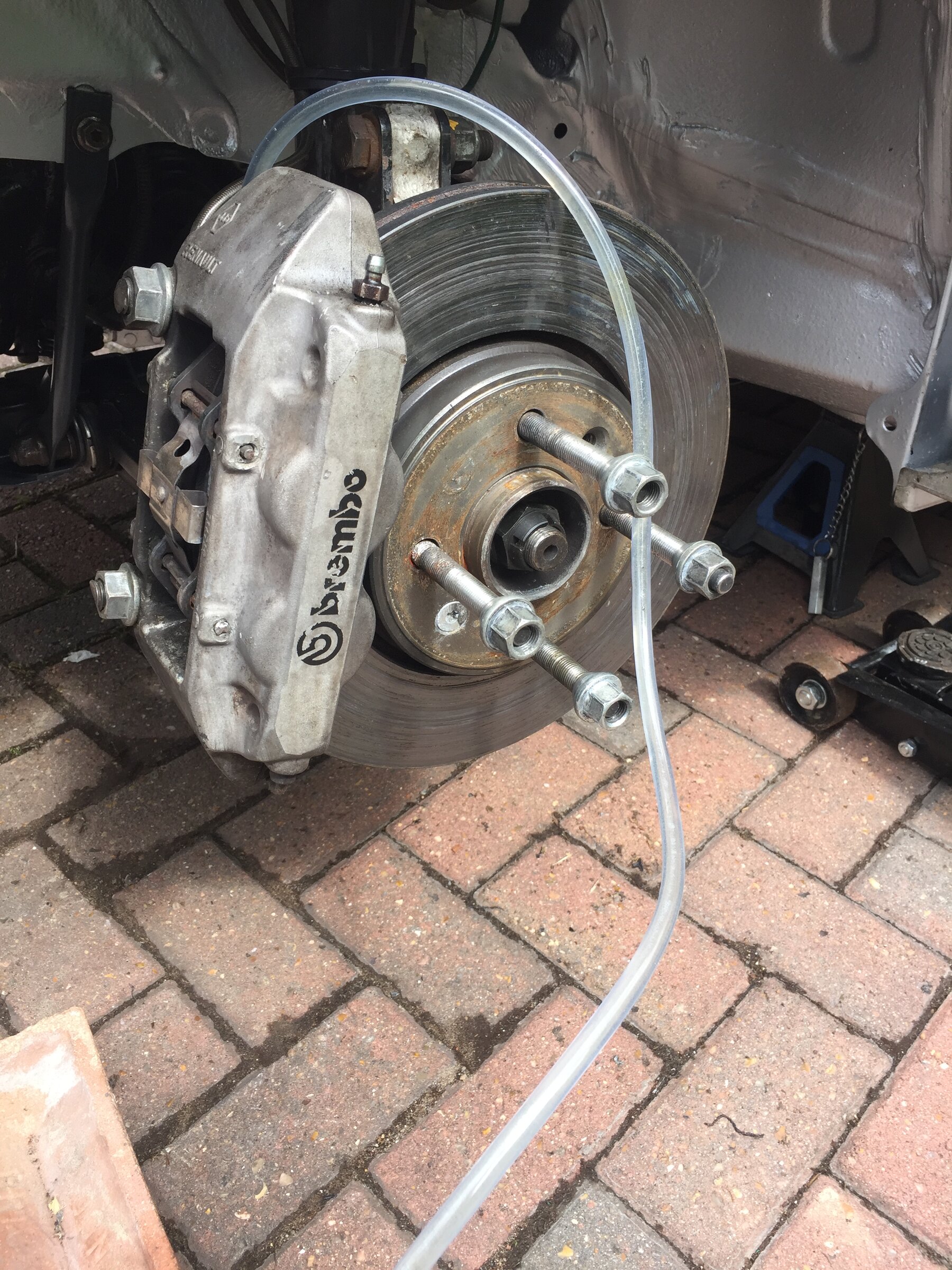

Next up the brake bleeding issue. Rightly or wrongly I’ve purchased a brand new RS Tuner with the ABS and airbag module. A couple of reasons why, I will need to trigger the ABS again in the future not just this time, I don’t have an old enough laptop for clip and there are a few other reasons. Sadly it’s taken a few weeks to arrive but it should be here this week so I can prep the car for MOT.

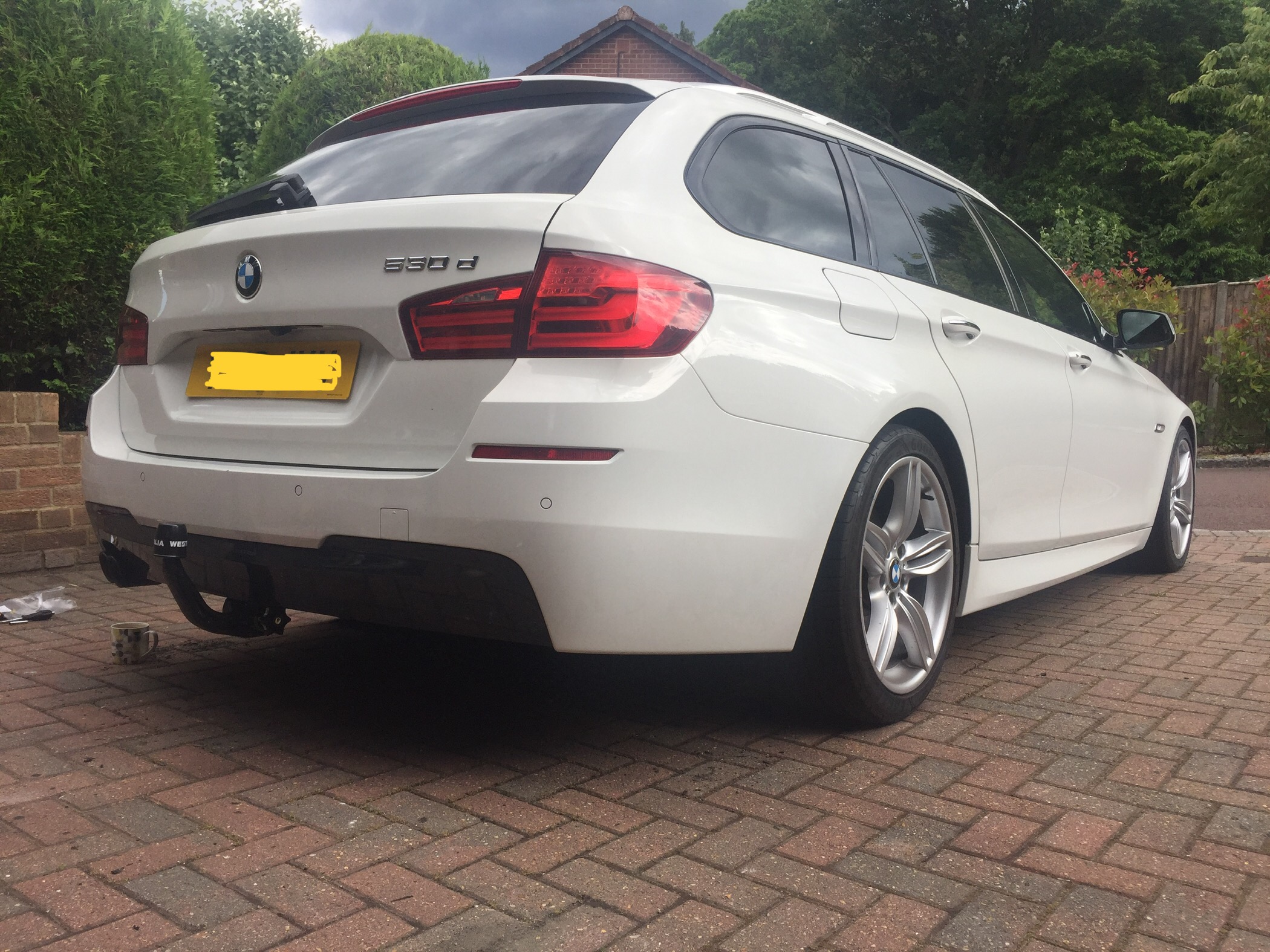

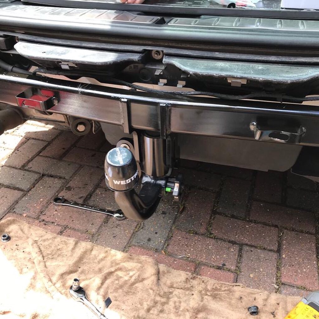

Lastly the tow car has a tow bar! Spent today fitting it. It wasn’t cheap but is fully integrated. I have no issue working on the Clio but it was nerve-racking working on a newer more expensive car 😳.

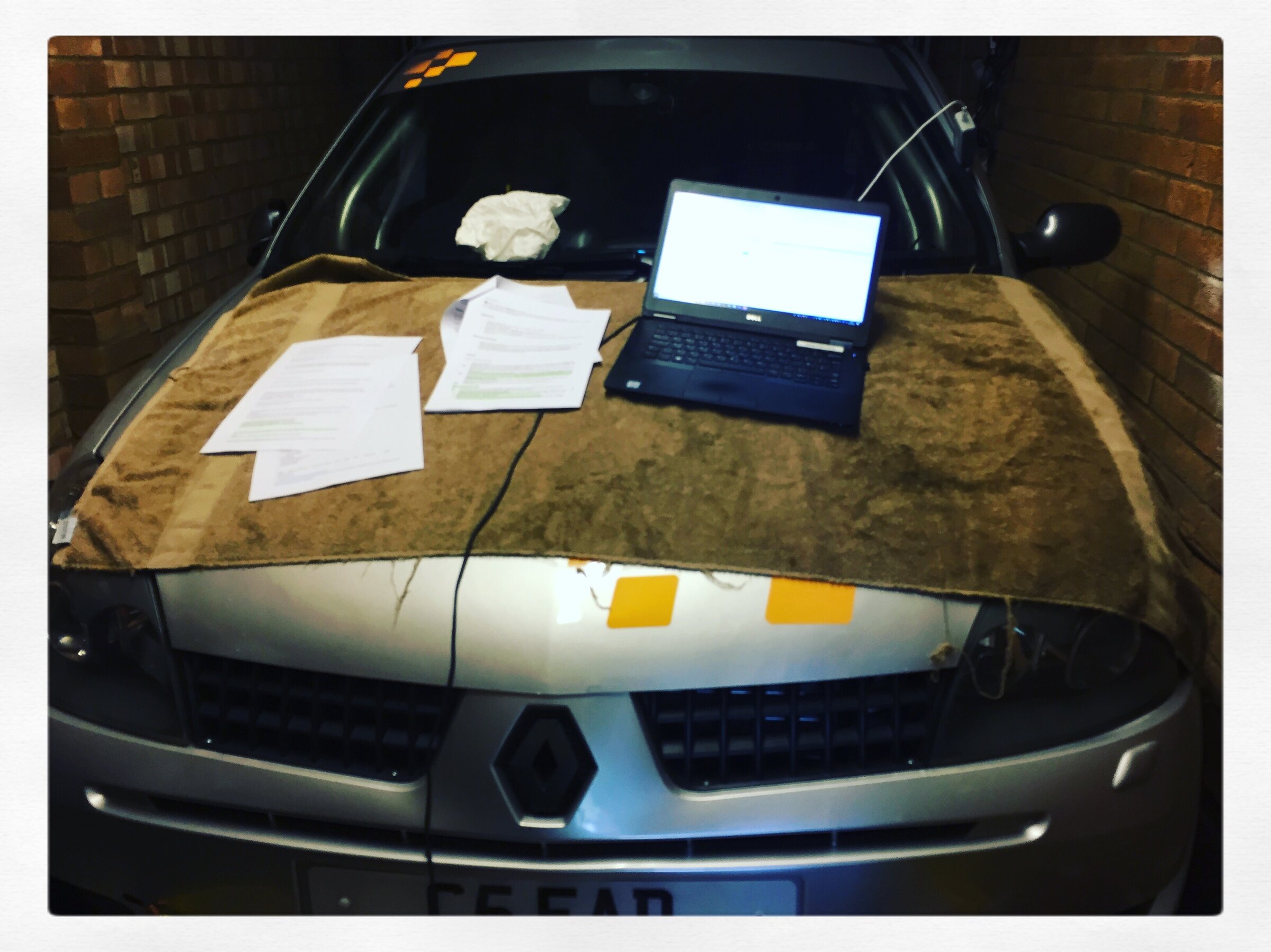

RS Tuner arrived at long last 🙄 But the good news is it’s exactly what I needed. With the wife in the car activating the solenoids and pressing the pedal and me outside collecting the fluid the bubbles gushed out! Now I have a very firm brake pedal 😀
With the car then on the floor I only drove it for the first time in a year! Just turned it around at the end of the road. Videos on Instagram @CS_182

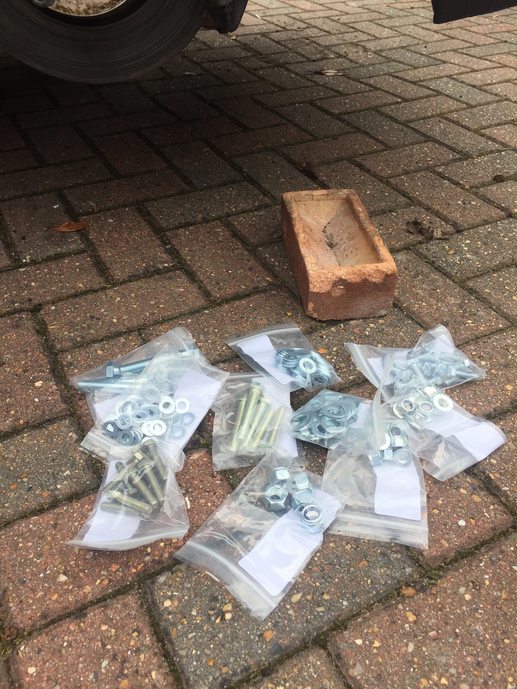

So there’s lots of little jobs including swapping out the remaining bolts I want to change....

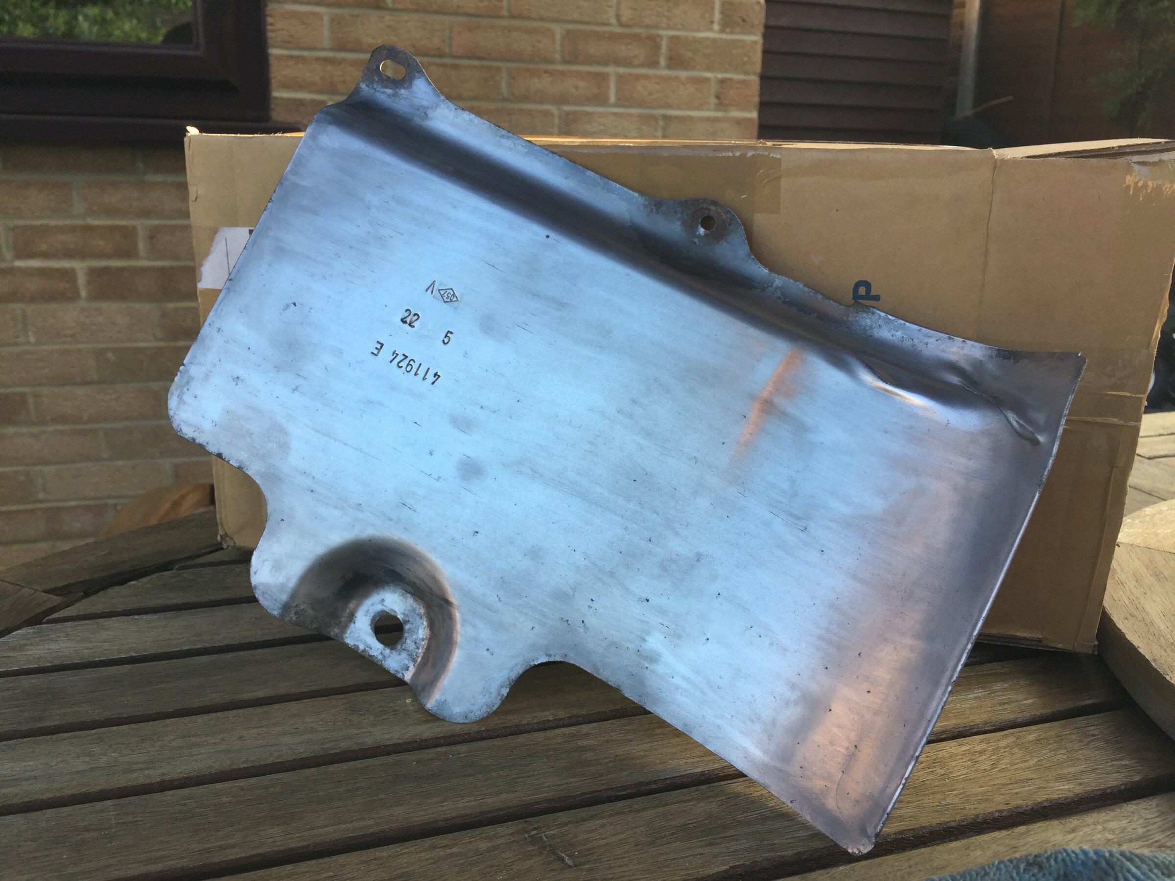

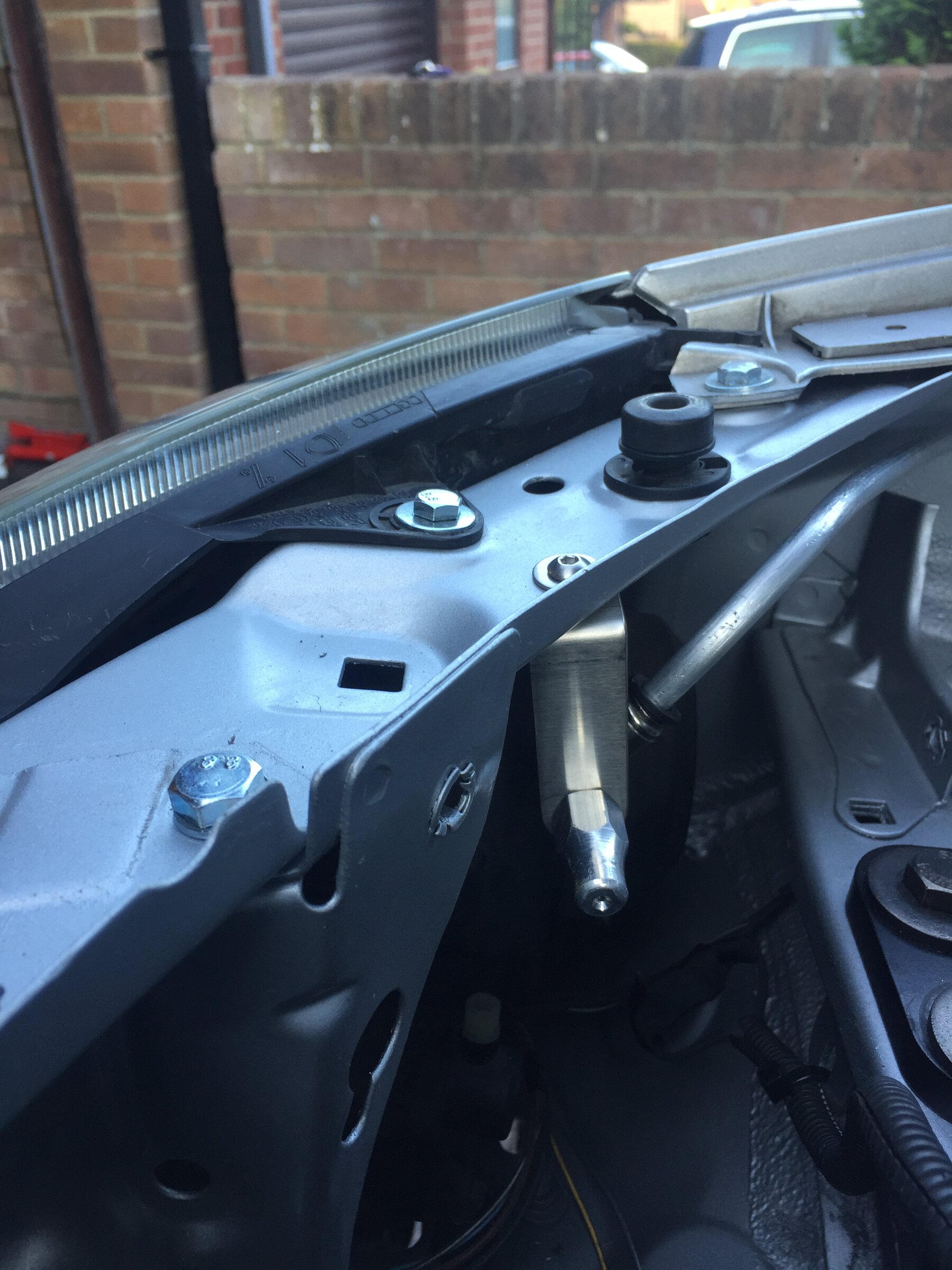

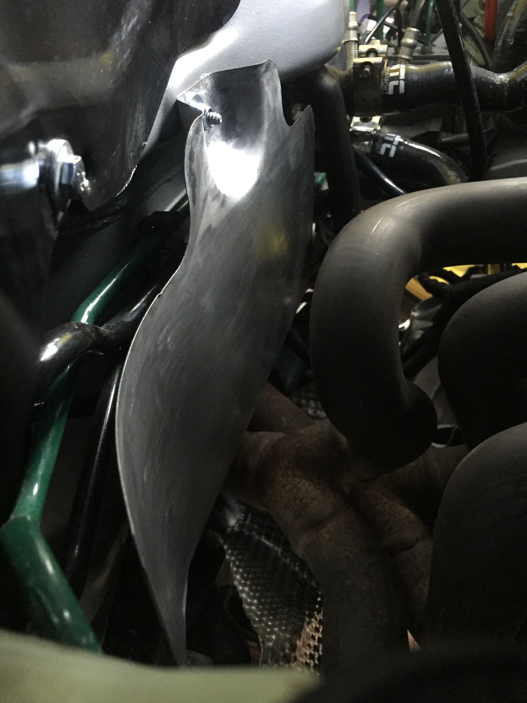

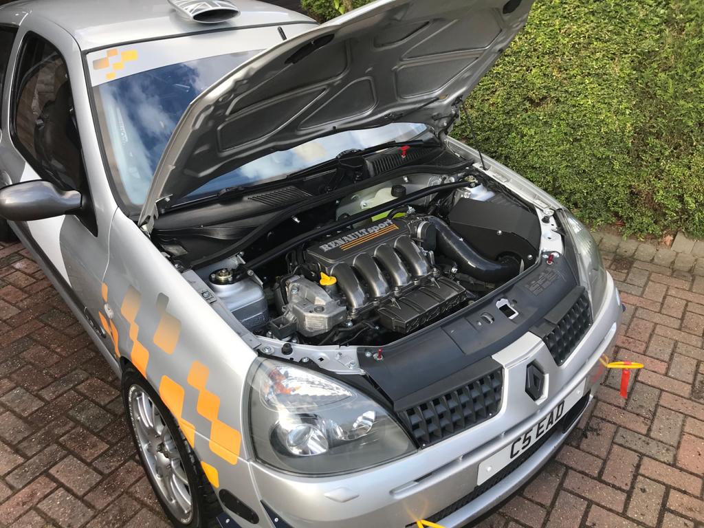

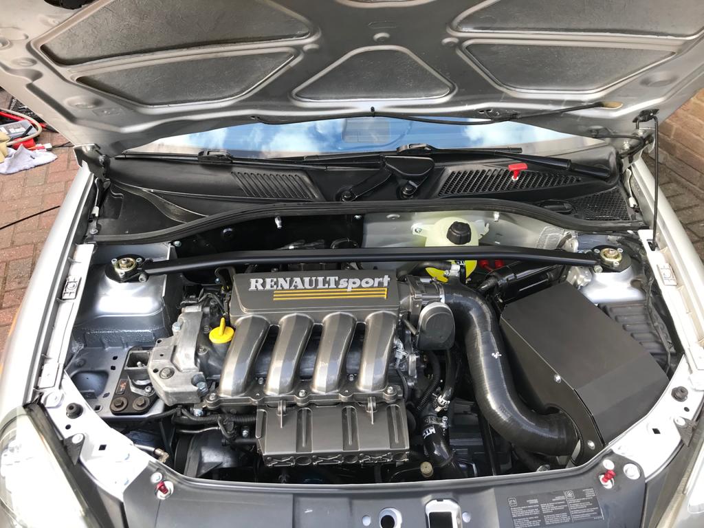

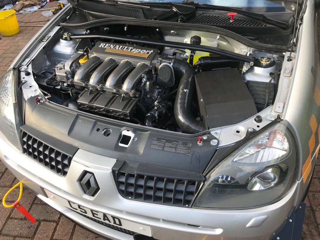

Still busy with the Clio. The new heat shield is now in place

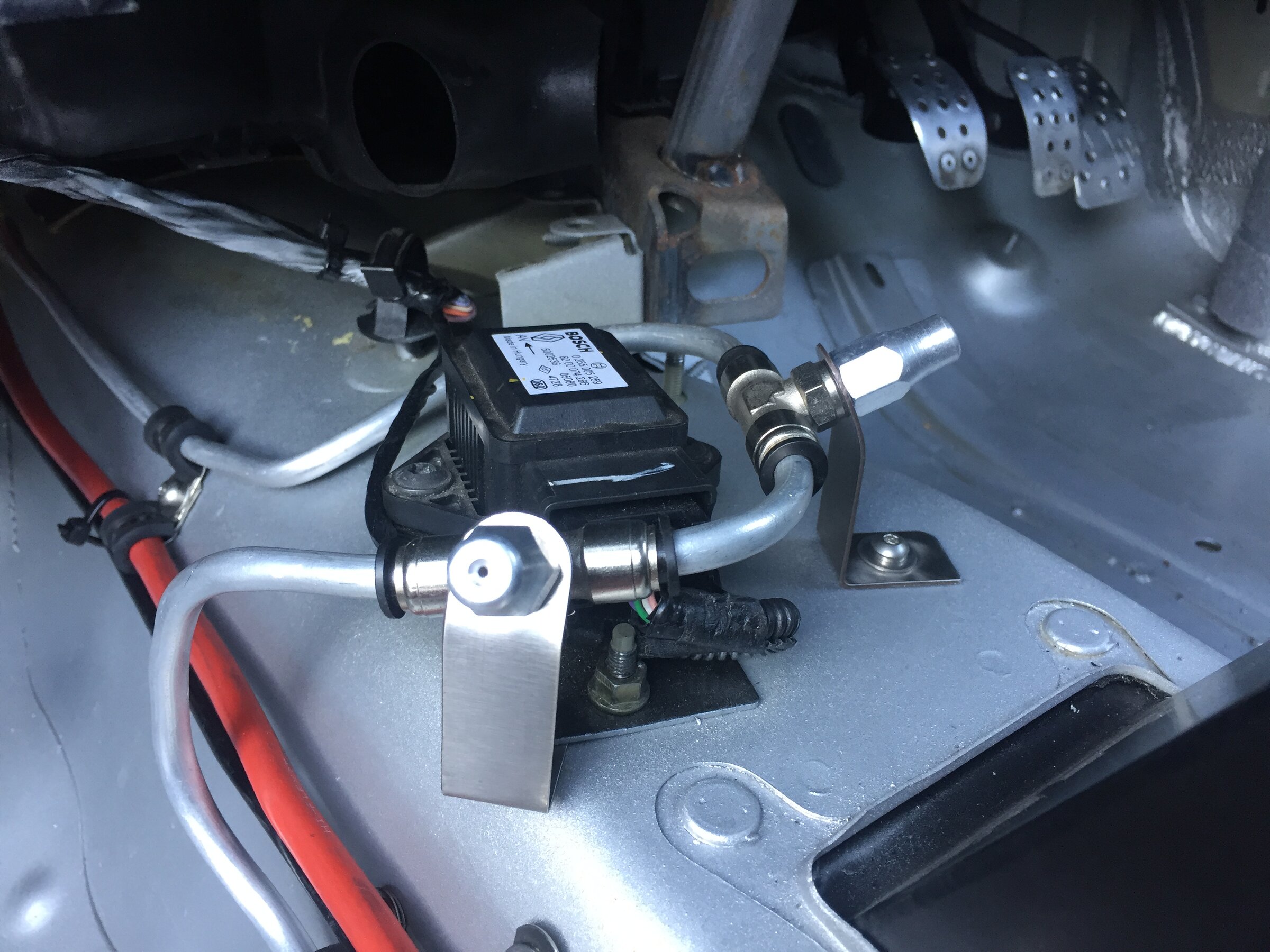

I had some ST steel brackets made for the fire extinguisher nozzles so they’re all finished now

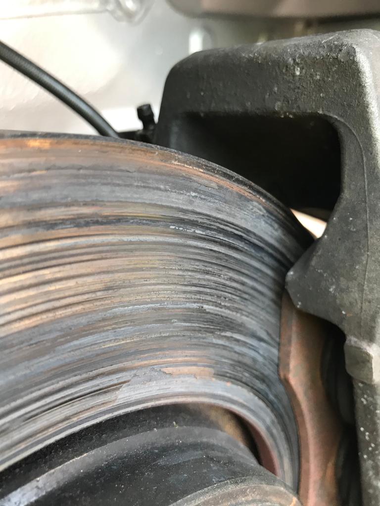

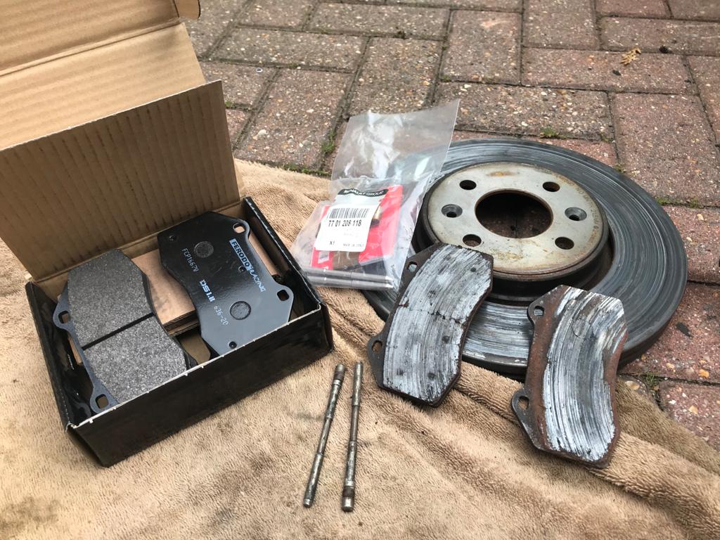

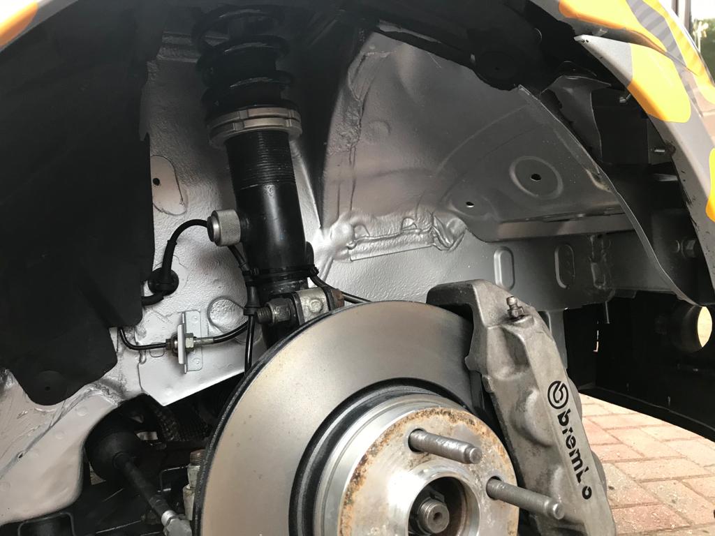

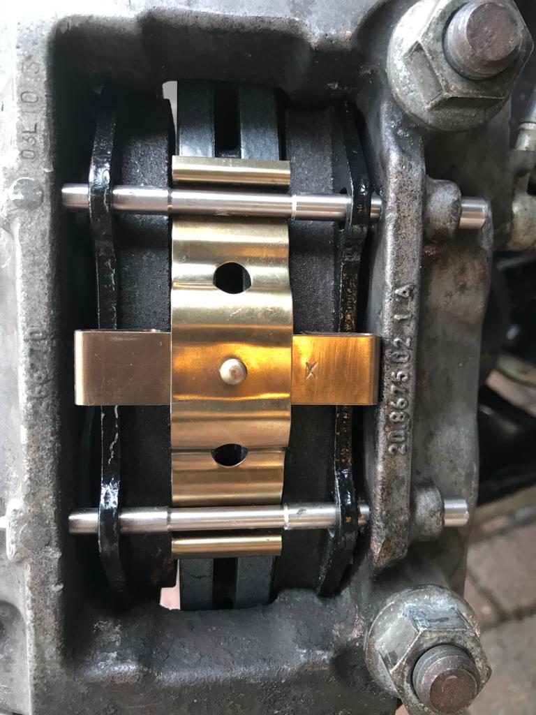

I’ve changed out the front brakes as the old ones were pretty worn....
I went with DS1.11s again as I rate them and they lasted well. I’ve also changed the pins and sliders.

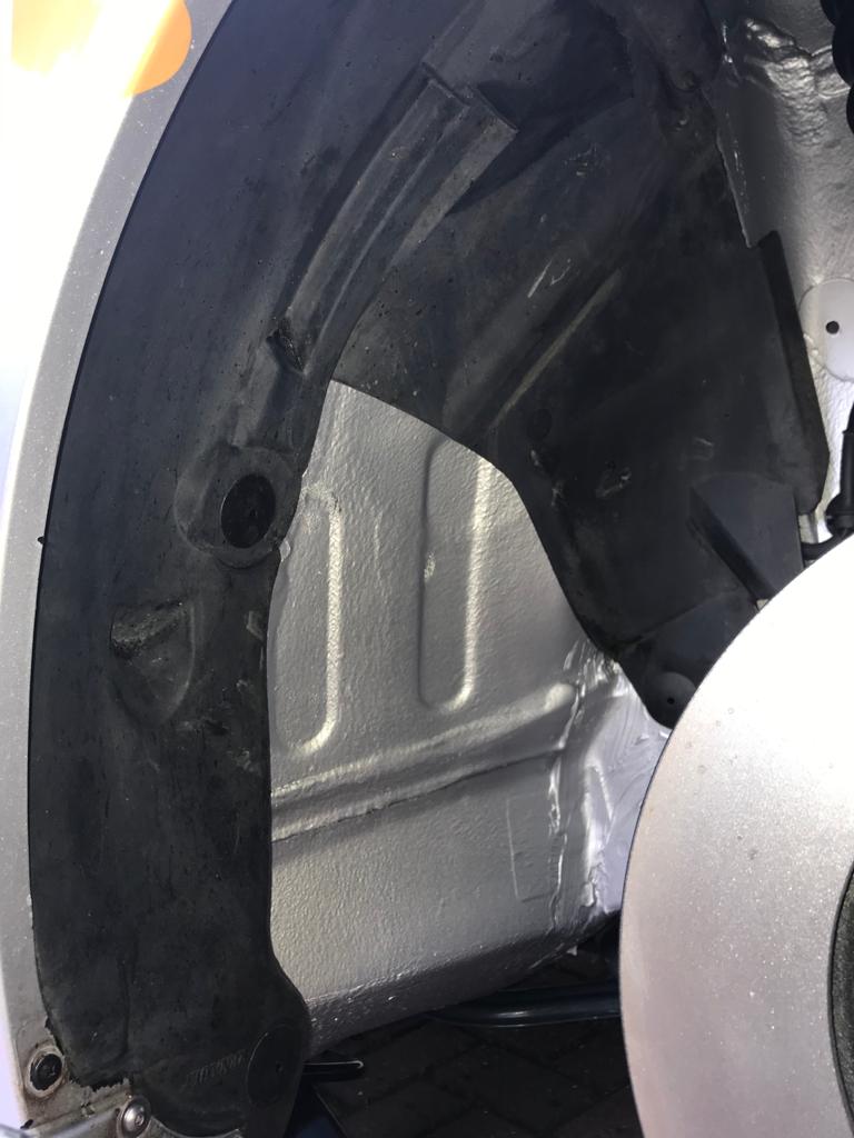

I’ve also started fitting back the plastic wheel arch liner guards as well

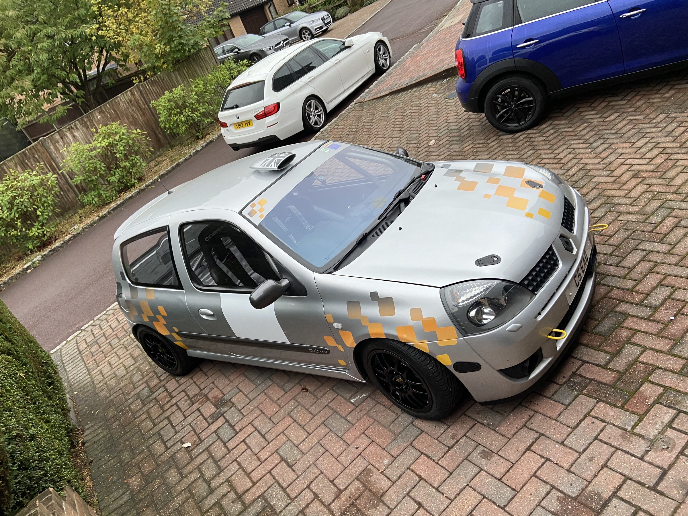

Ticking the jobs off the list ready for the MOT.

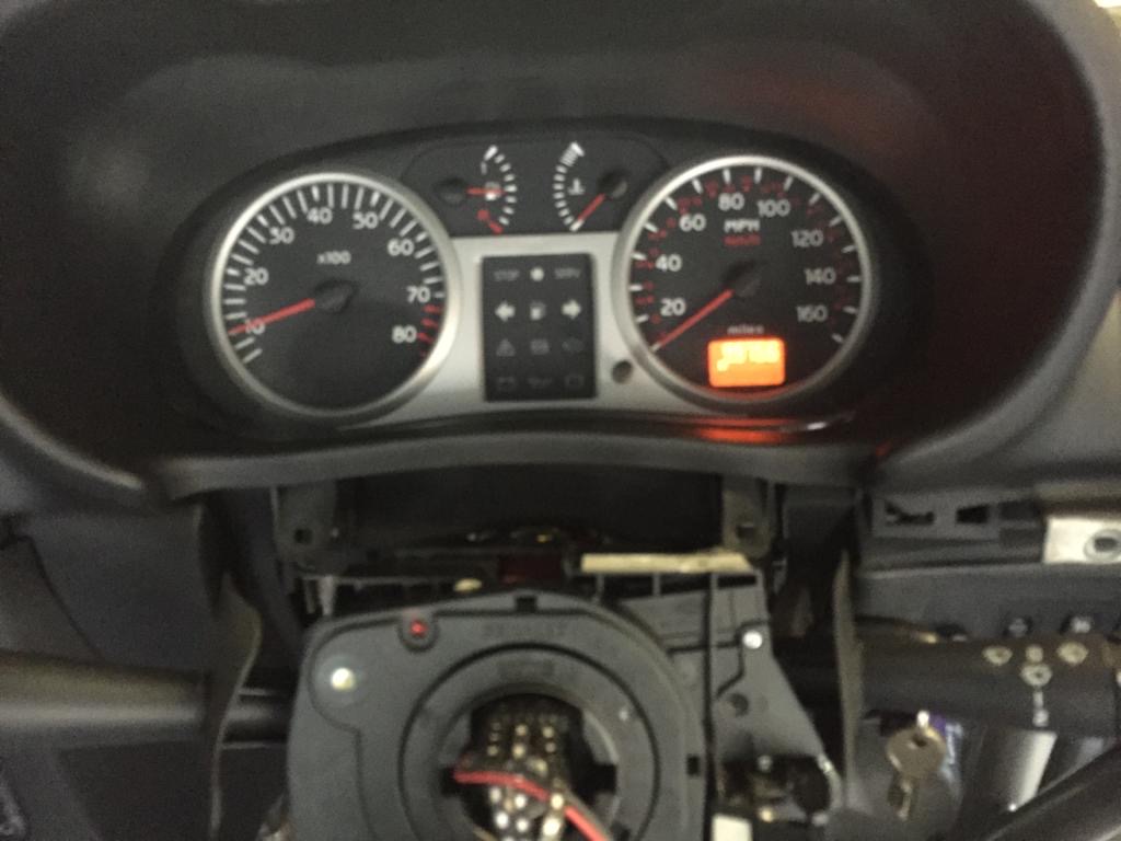

First up I now have no airbag light on because I’ve obviously got all the airbags working.......

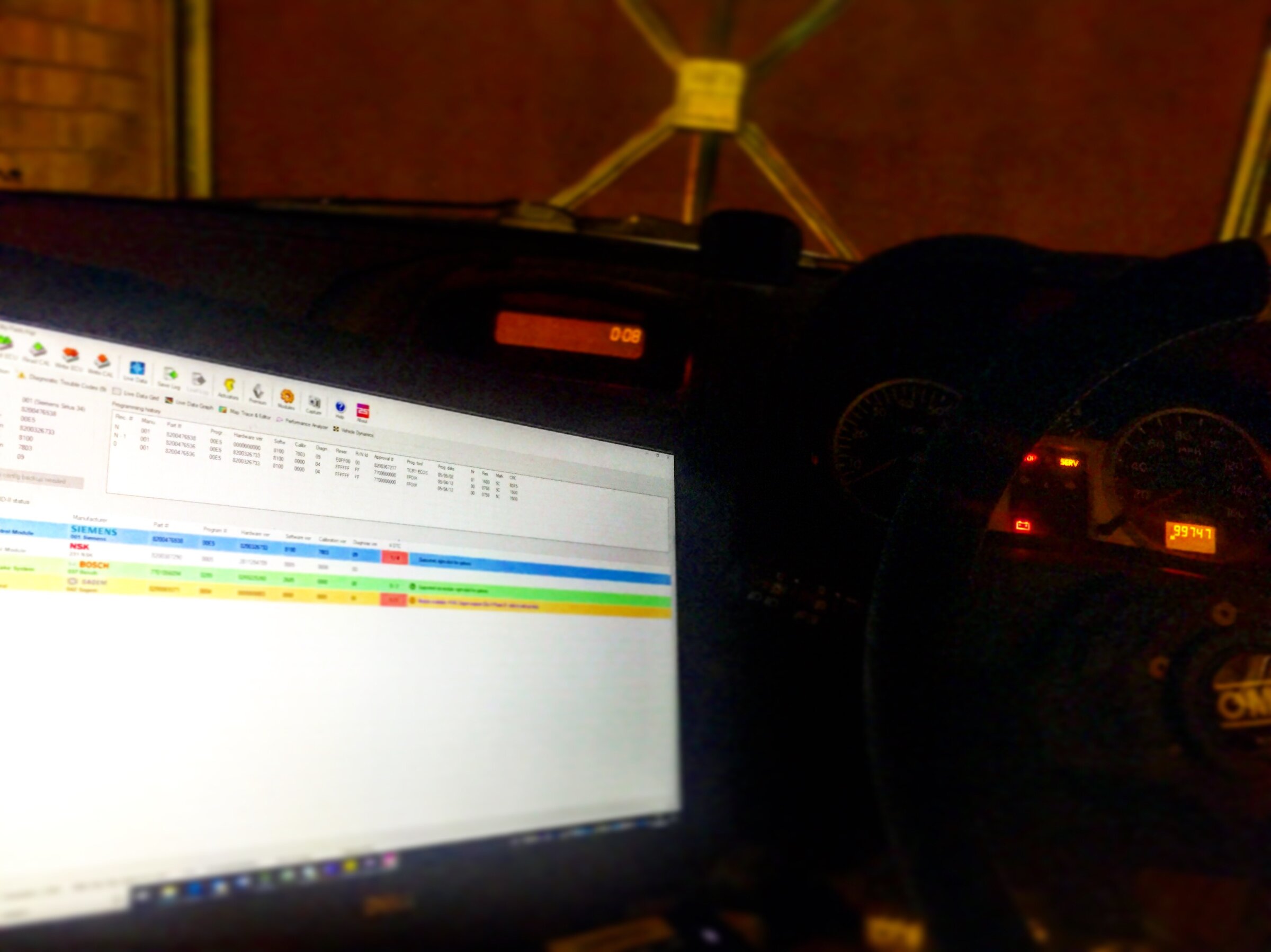

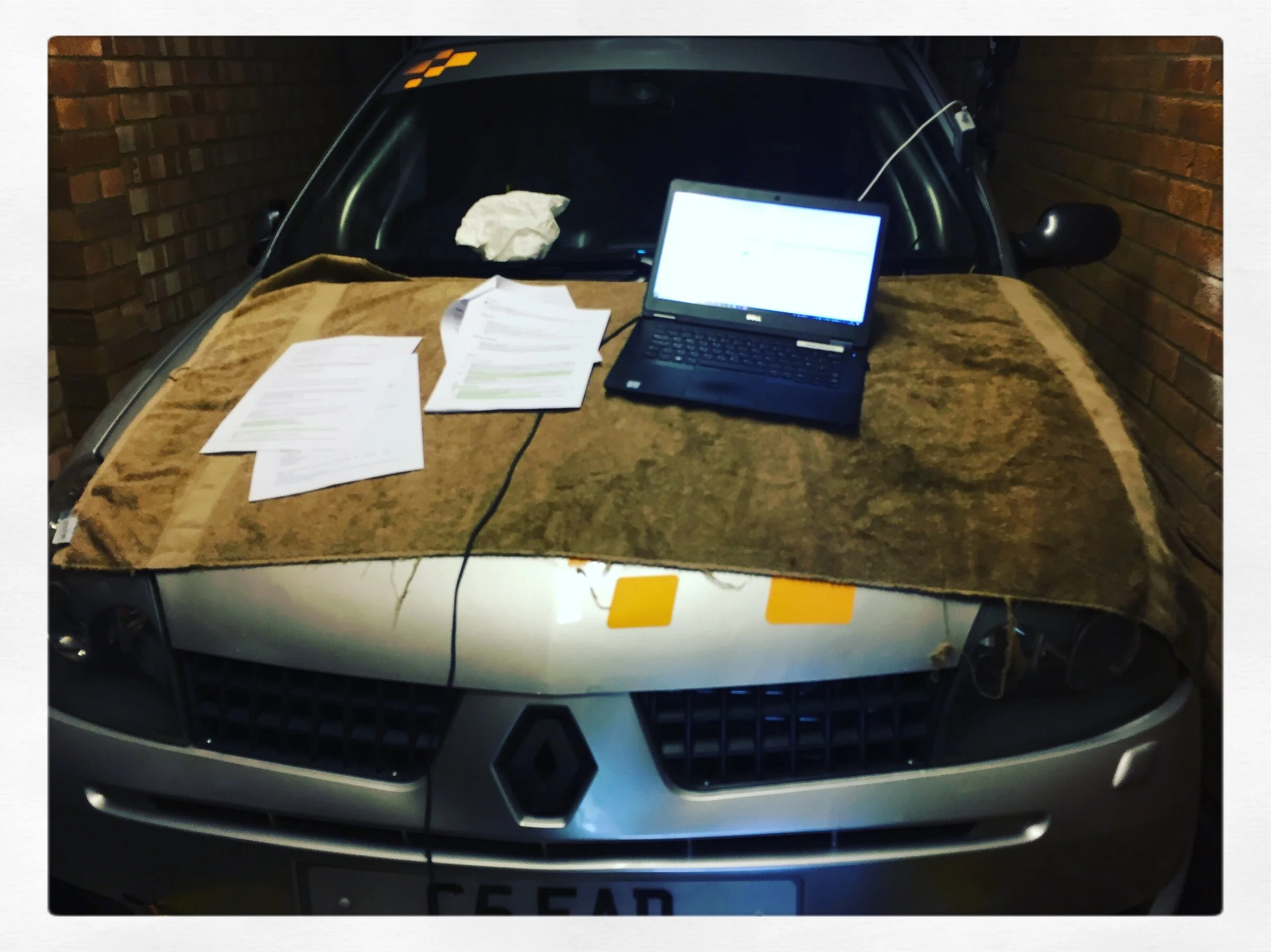

Next up I remapped the car with RS tuner. Must say the cold idle is massively improved.

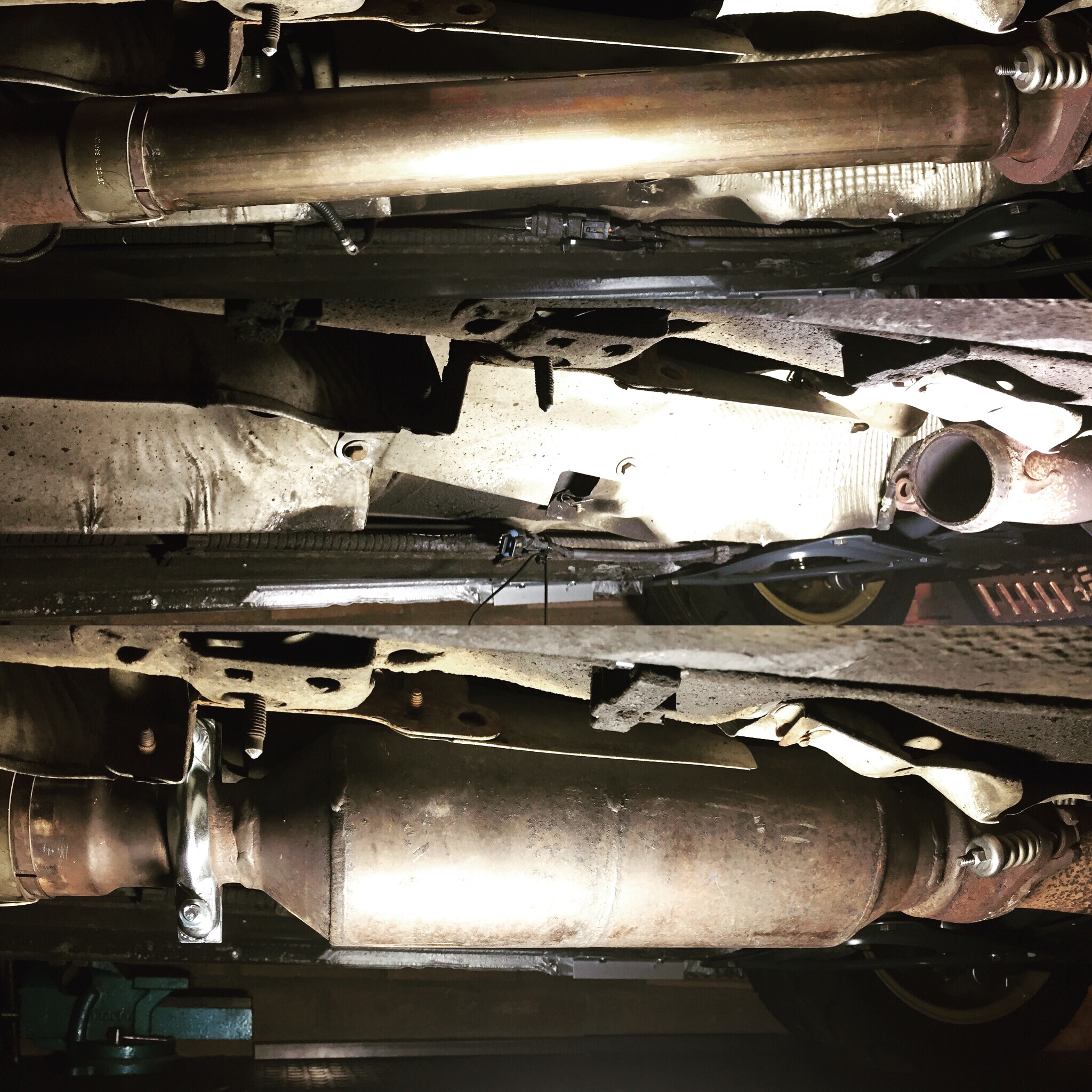

The cat’s back in ready for the MOT.
The windscreen washer is back up and running for the first time in 3 years.

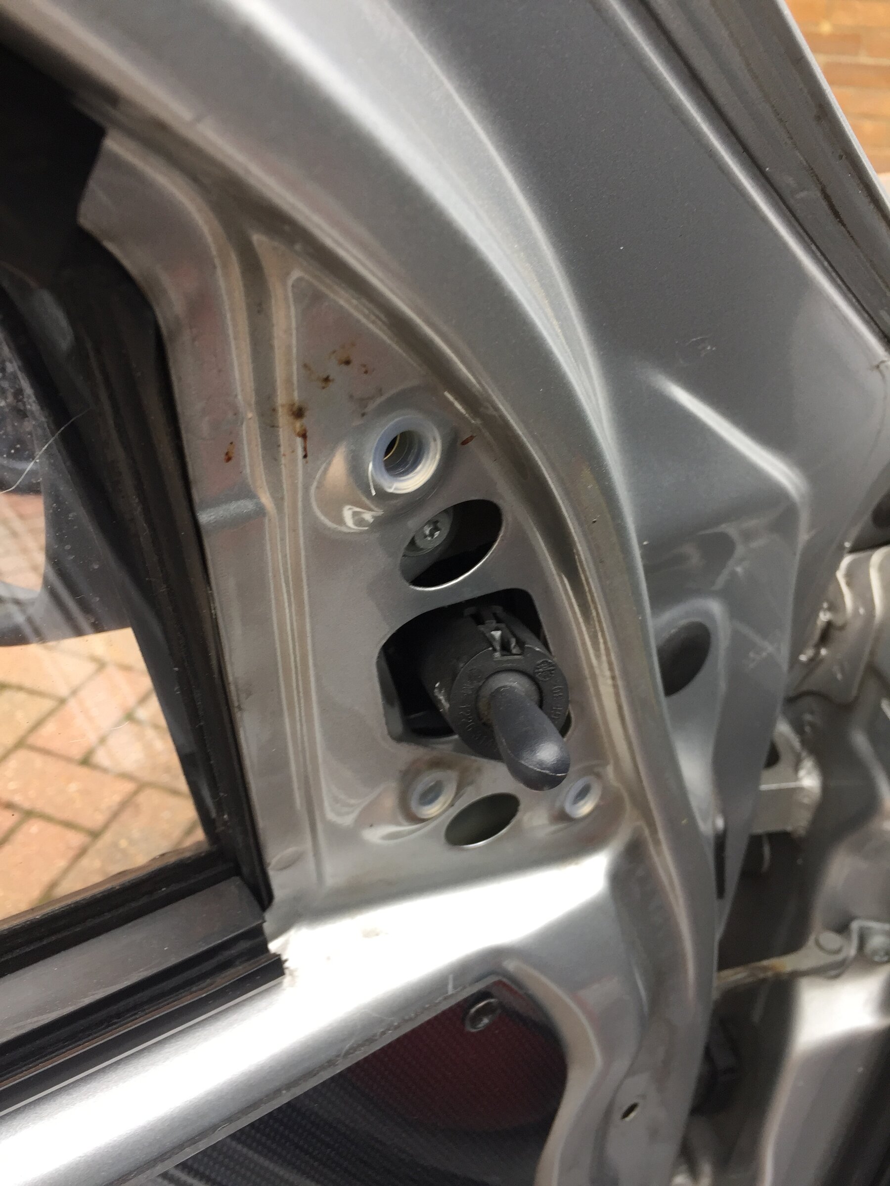

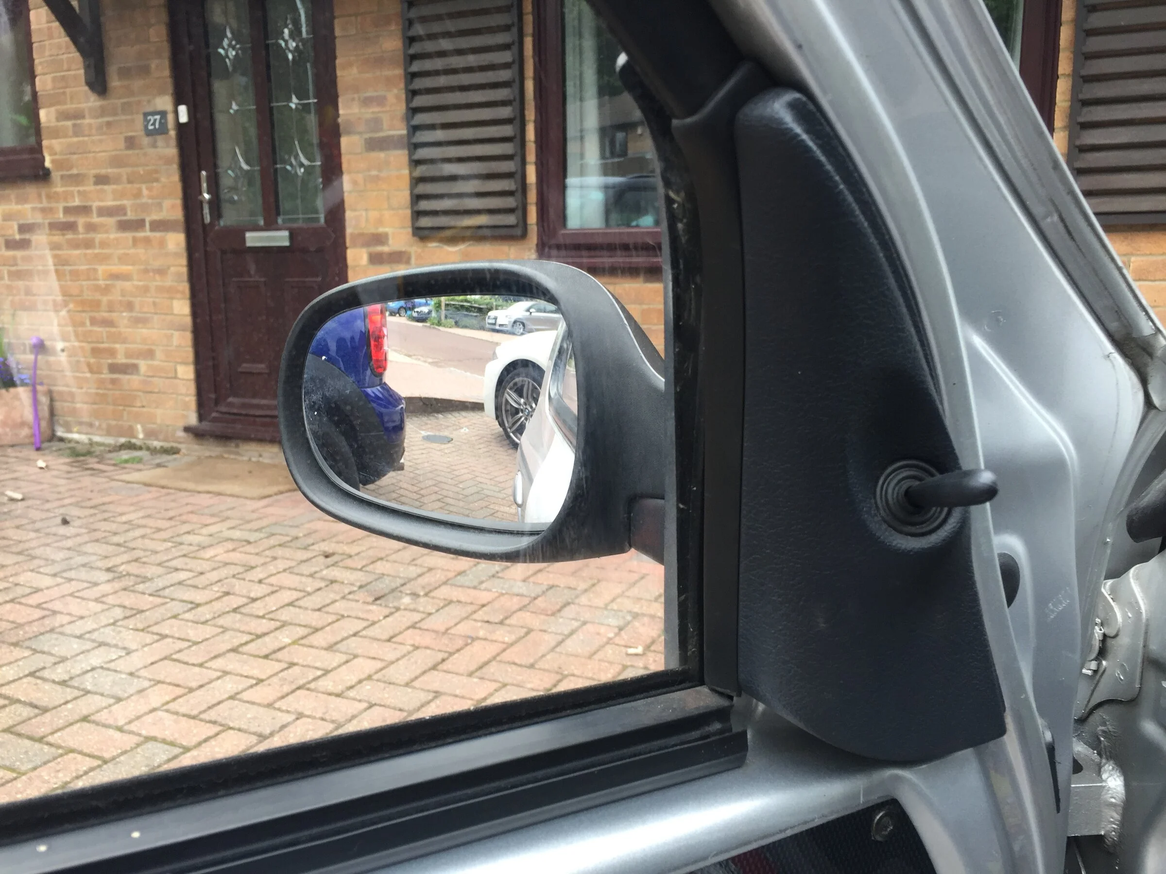

I’ve finally got around to fitting the manual mirrors I’ve had for a year.

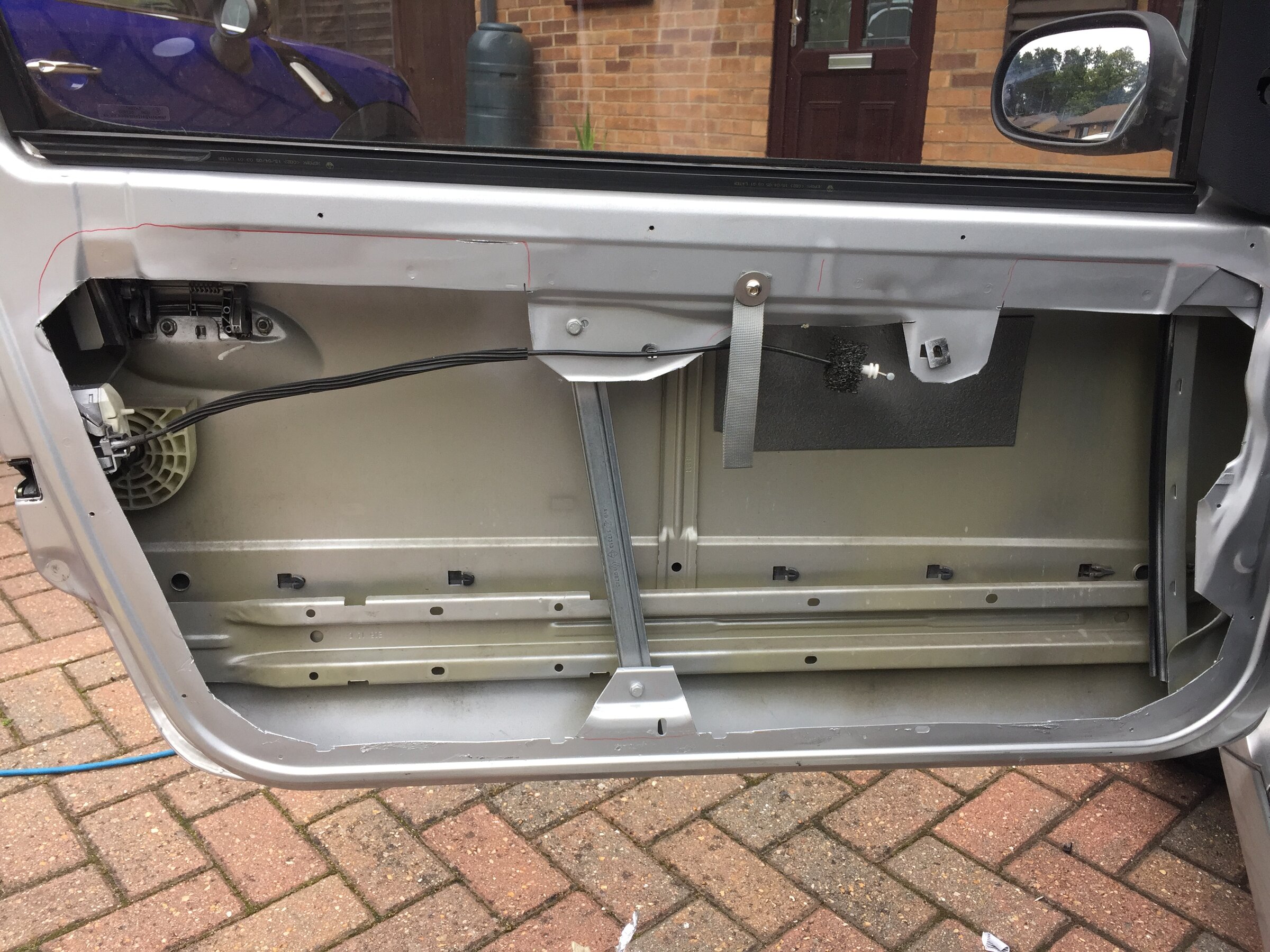

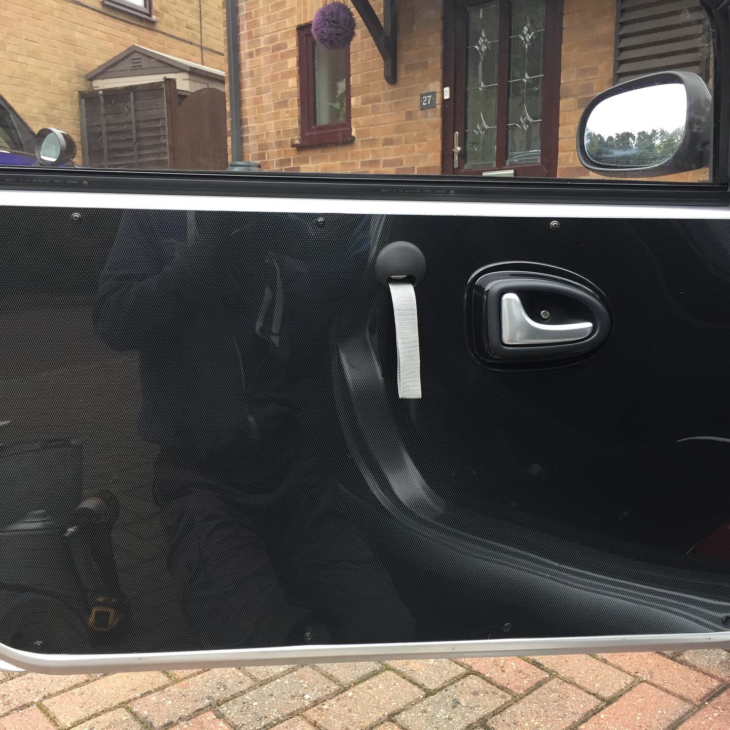

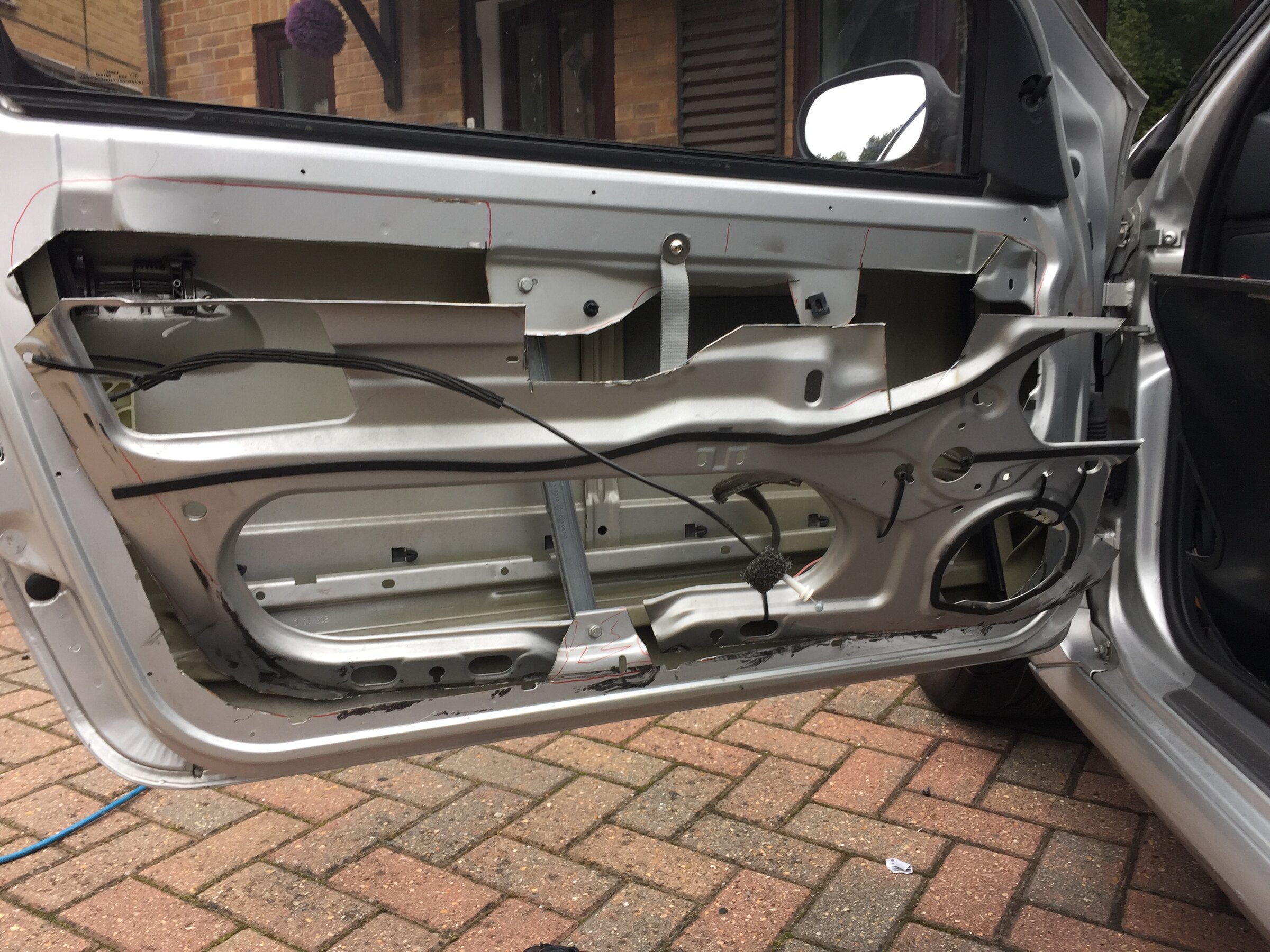

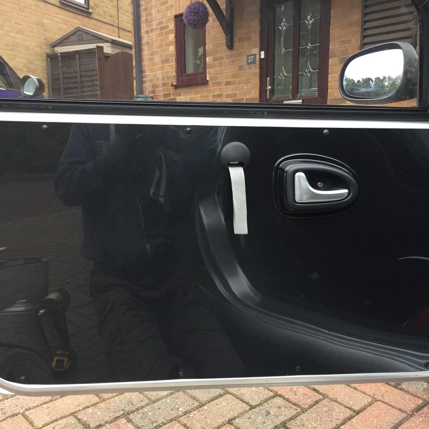

Spent some time today removing all the internal material from the doors.

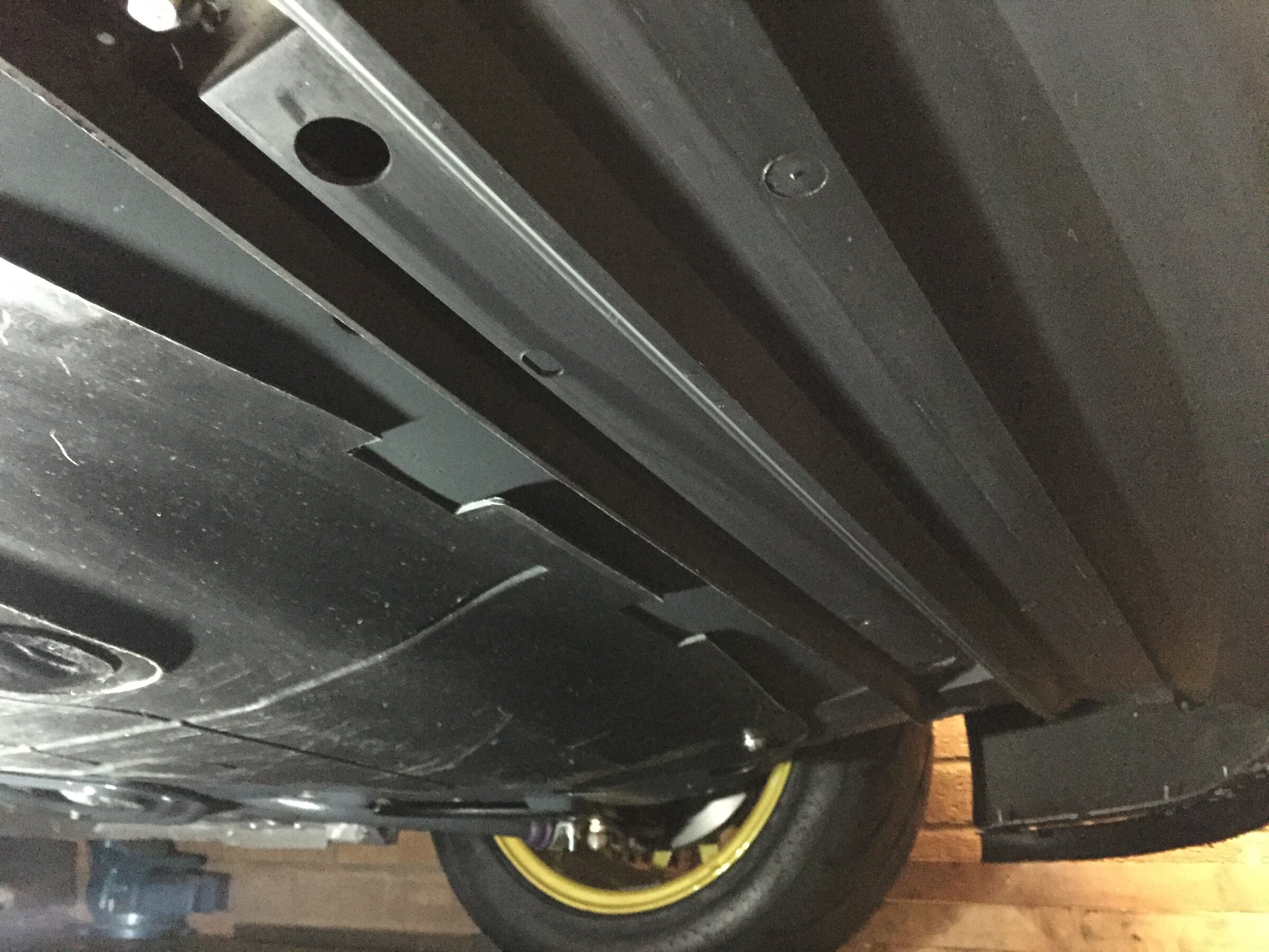

The under tray is back on. It was always teck screwed on since I’ve had the car. I’ve put fresh clinch nuts in all round. I’ve also purchased some 75mm bungs as my cap was missing.

There is still a good amount of weight in them doors to come out! I have managed to get 10kg out of each of the Twingo ones.
I like your work it's clean and tidy (y)

This week i’m fitting and checking a few little things ready for the MOT. I’m working through a list in preparation. I think it’s all ready 🤞
I’ve sourced some internal covers for the manual mirrors to help keep the interior tidy.

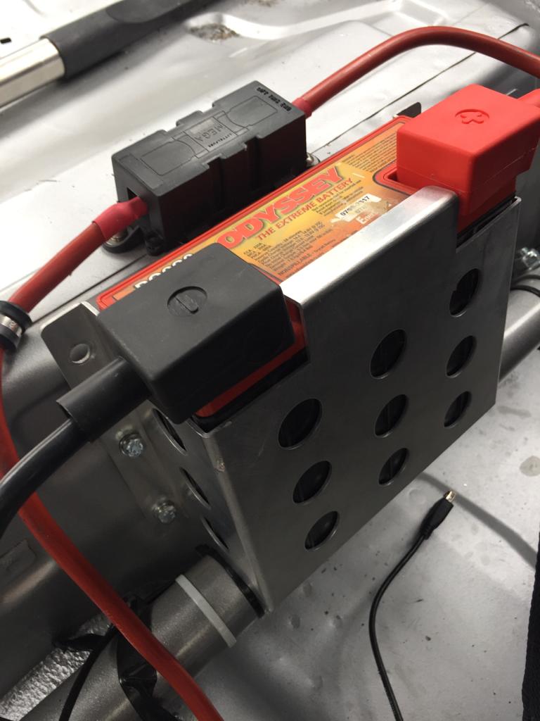

I’ve managed to source some terminal covers for the battery at last incase anything falls on it.

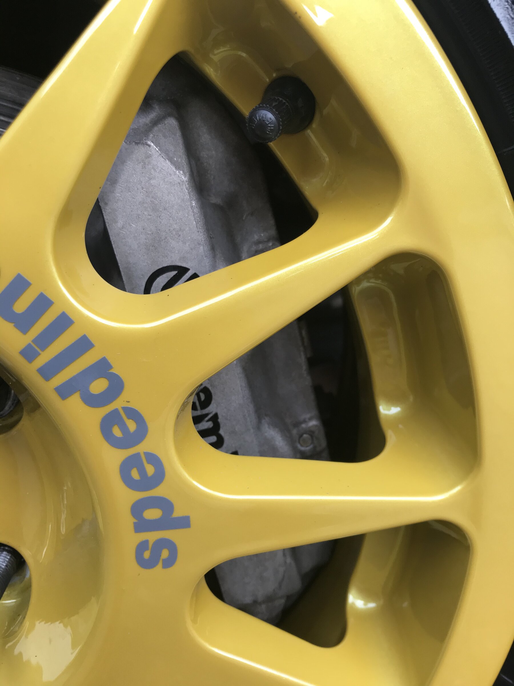

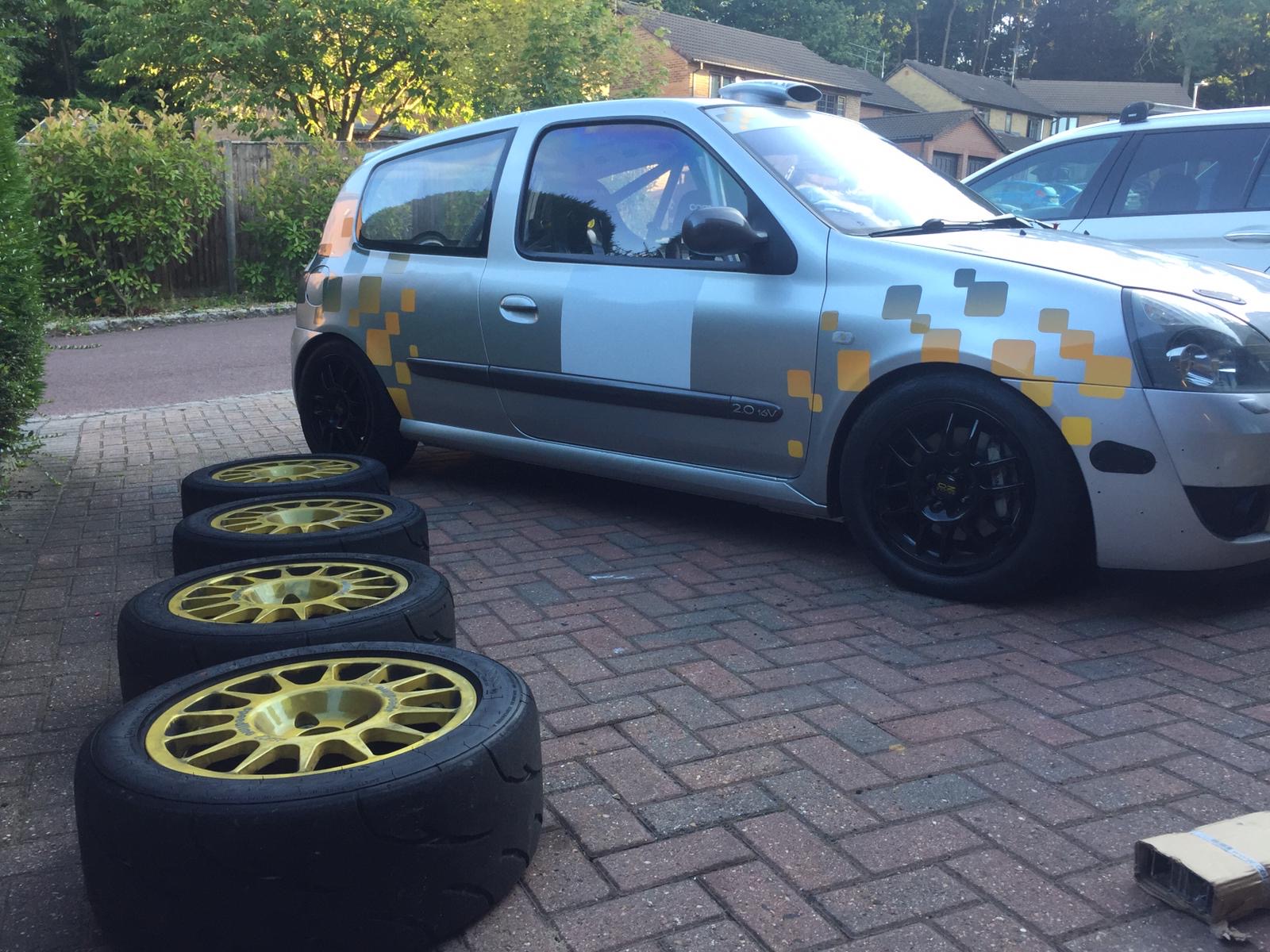

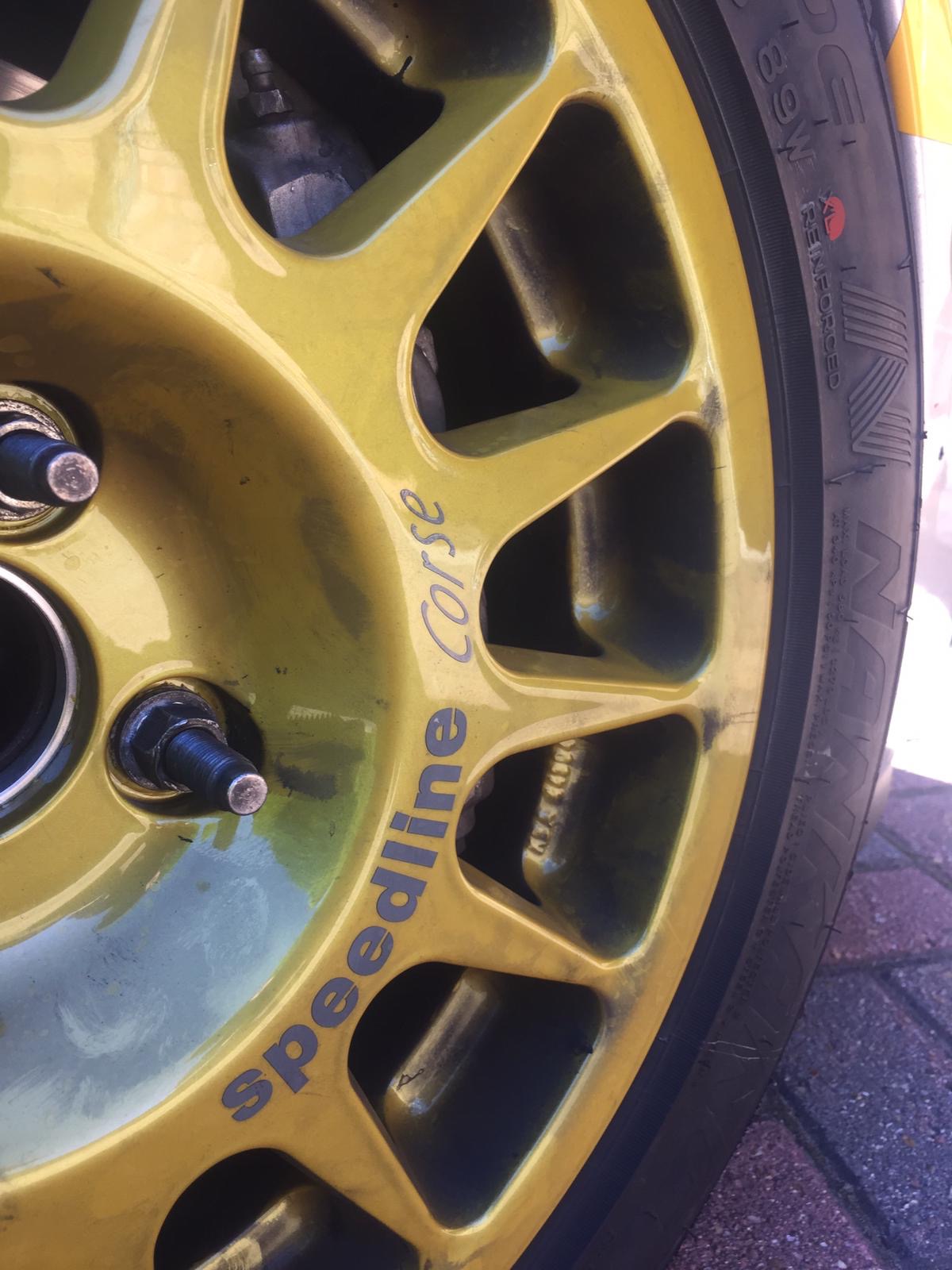

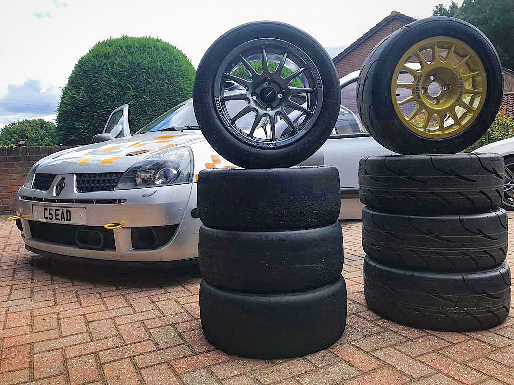

Next up I finally picked up my third set of wheels. These are the wet/road wheels. They have brand new rainsport 3s and have just been refurbished in gloss black. I’ve managed to source some black centre caps with yellow writing to match the car.

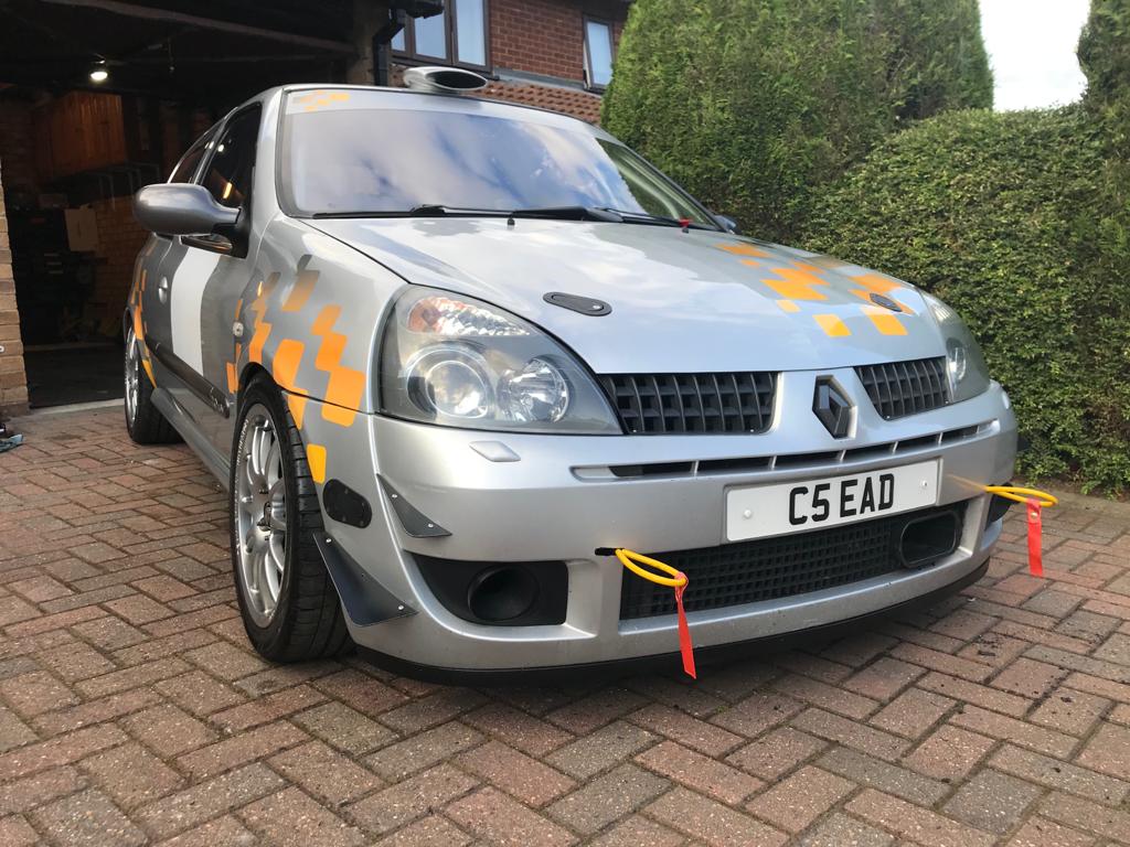

I drove the Clio today and....
It only drove absolutely spot on!
No rattles, no banging, went in all the gears, idles, stops, it even goes in a strait line after having all 4 corners removed, happy days!
EPAS is working well atm which is also a relief.

ABS light & service light - I incorrectly installed the steering wheel angle sensor so on the first proper trip it broke it. A second hand next day delivery item fixed this.
Airbag light & yellow service light - Massive thankyou to @GrahamS who sent on a new airbag ECU which was configured to my car so the airbag light works to pass the MOT.....

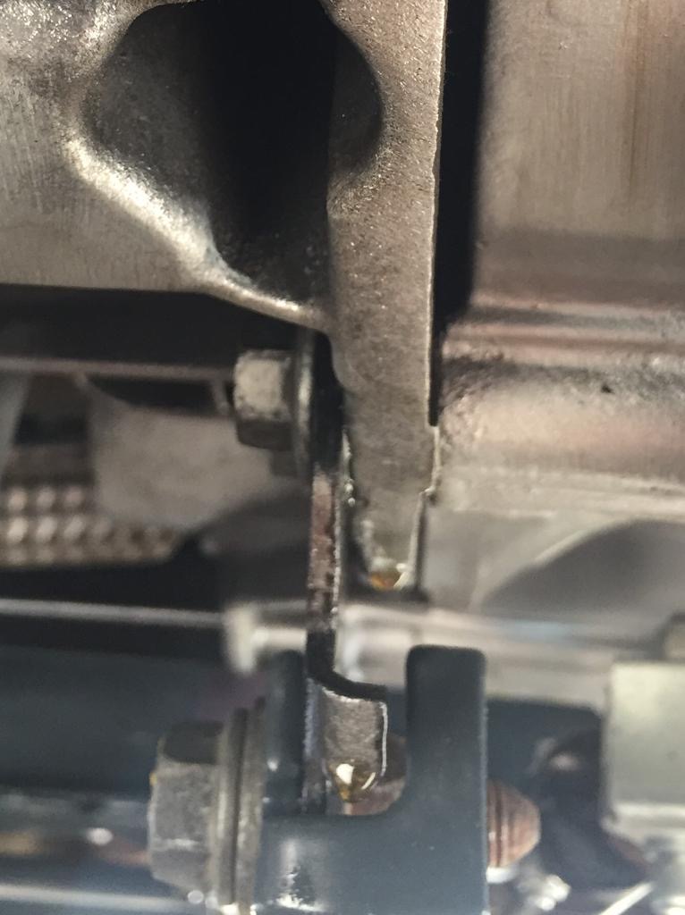

The big oil leak........... turns out I'm an idiot and didn't seat the new sump gasket properly. The sump was taken off. A few mods were made and then it was refitted. There is no leak on the main seal. What a relief!!!!

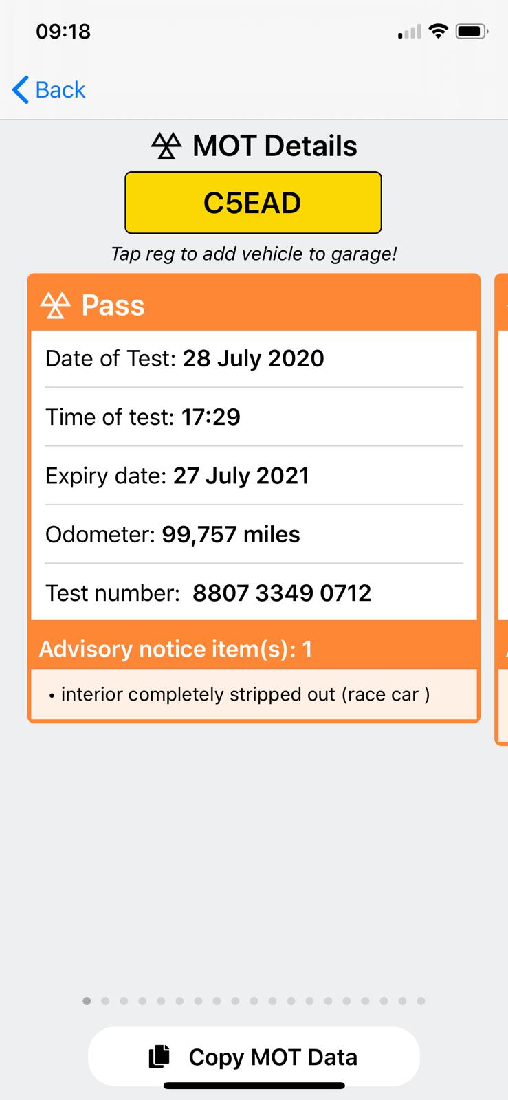

So after a couple of sleepless night the Clio went for its MOT and only passed!
I've now had it back a couple of days have managed a few miles on it. It's feeling good, still a terrible road car as its too stiff! Battery is working, Diff is working, EPAS is working, touch wood everything is working!

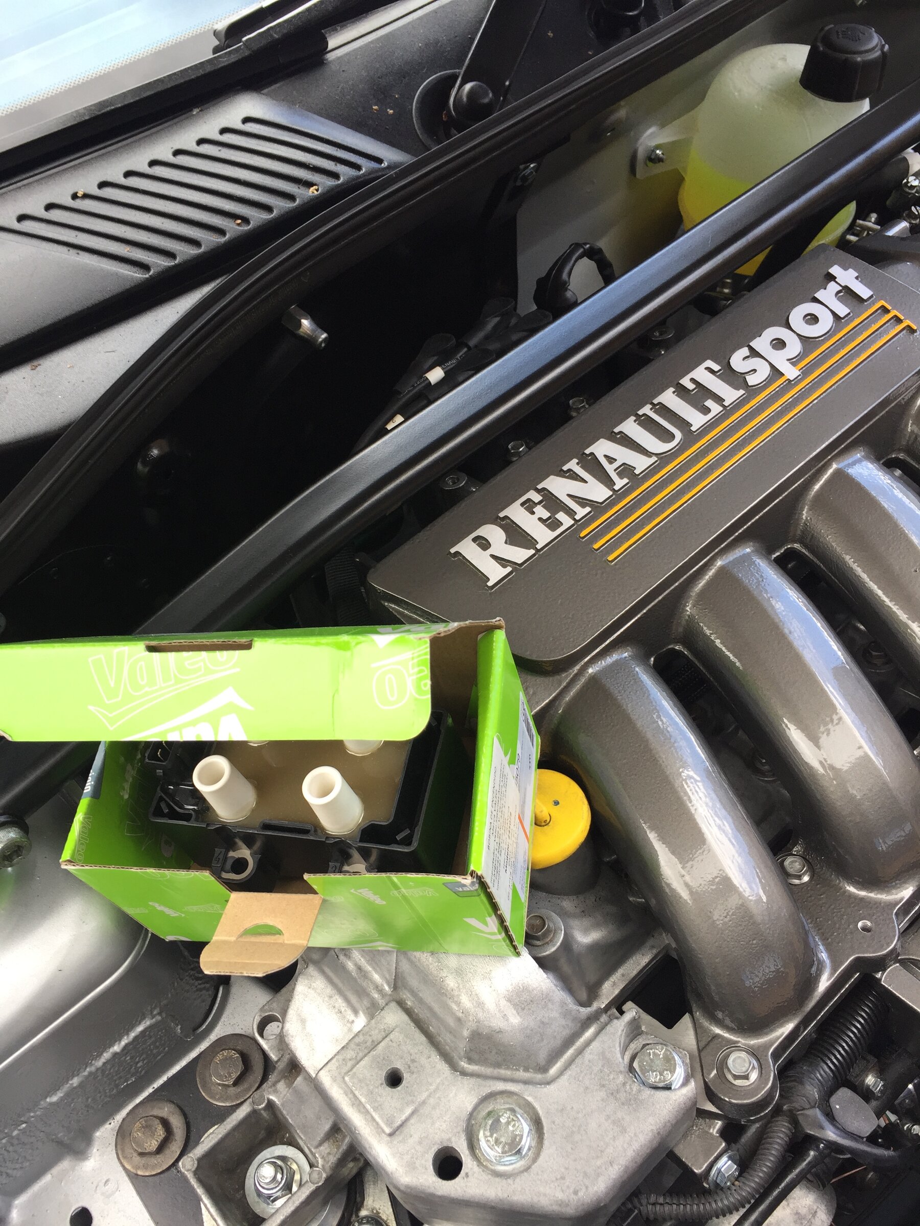

I’ve changed out the coil pack as a preventative precaution. I’ve got to say the car is idling better

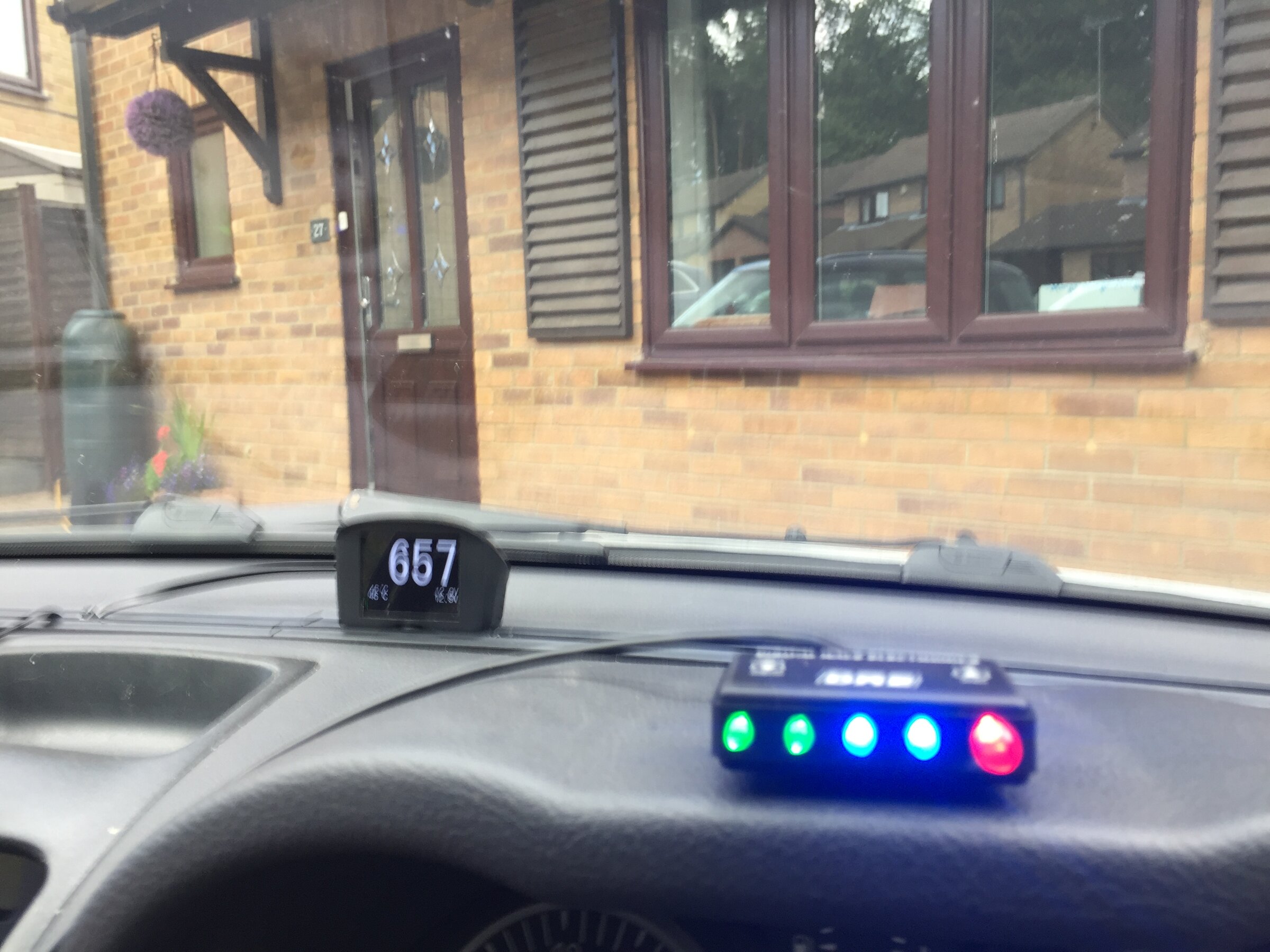

Nice final mod to make was the addition of a shift light. It was simple to install and simple to adjust. I’m well impressed. Hopefully this video works....

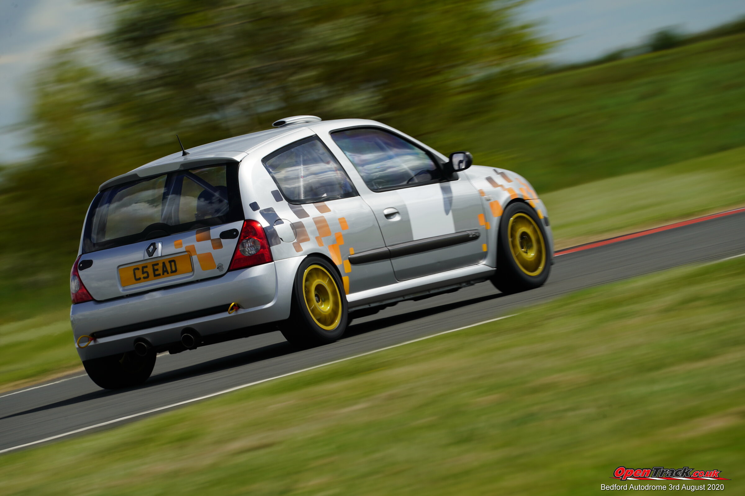

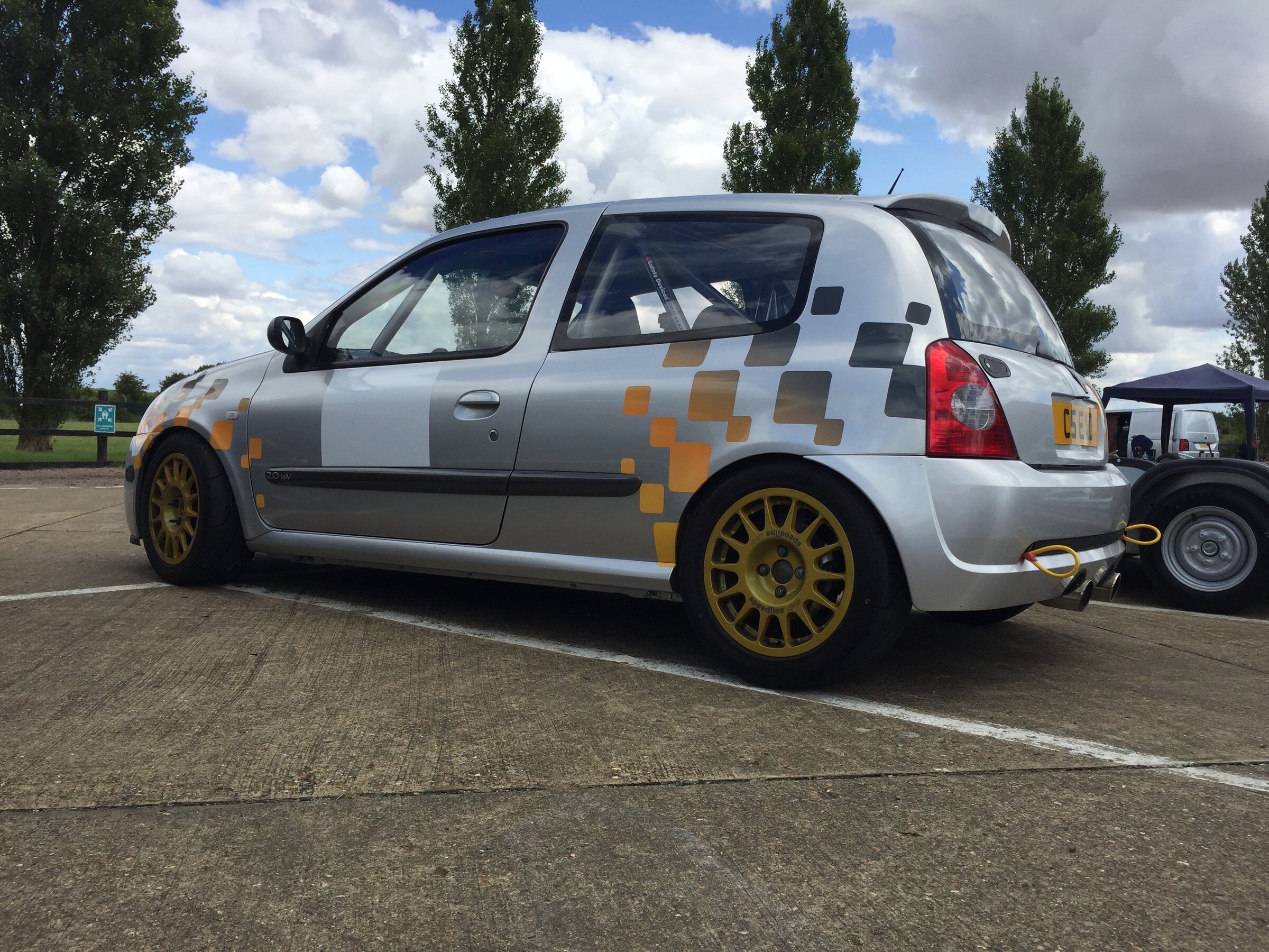

I even got some photos from opentrack, which was good going as I only did 3 laps...……………………..

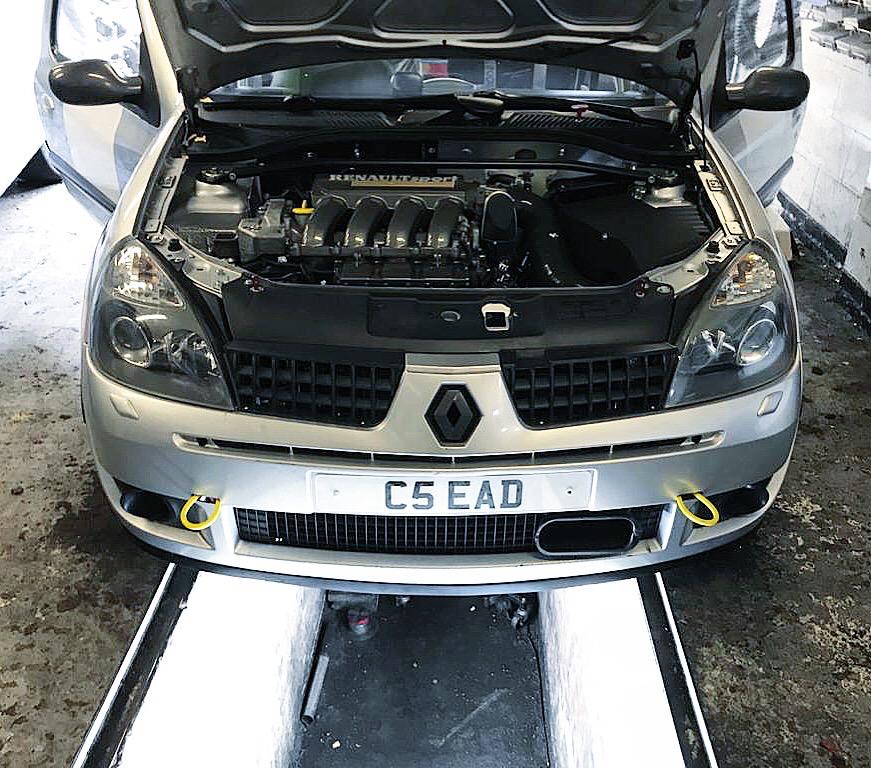

Looking very good sir! Where did you mount the front tow straps? I'm still working out a plan for them.
TBH I can’t remember. I thought I had a photo but I don’t. I’ll have a look when I get a min. Mine are a little to long. I’ve kinked them slightly and cables tied them so the hoop is just hanging out of the bumper. If I need to use them then they will snap as they’re thin ties.

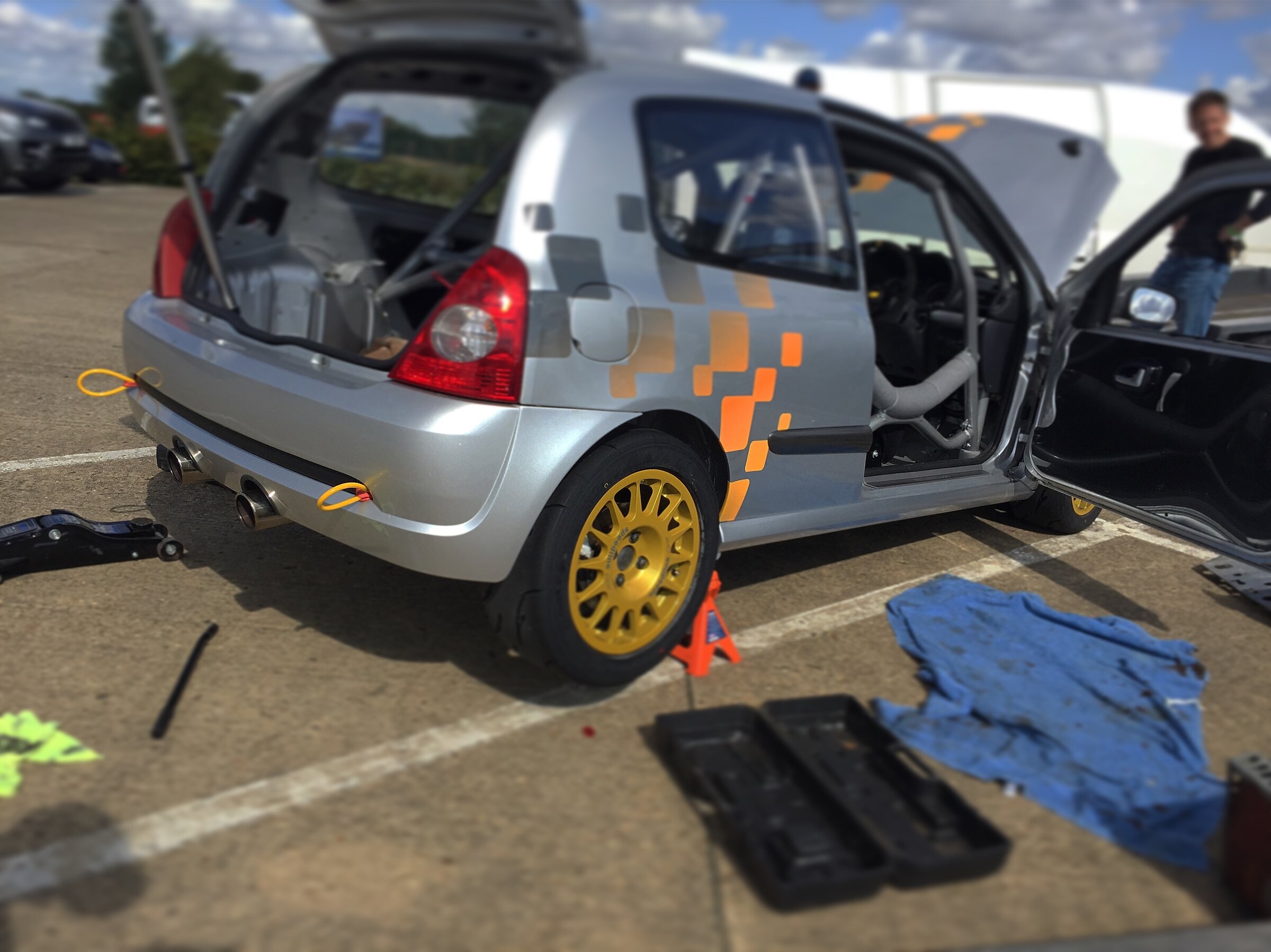

Bedford 3rd August - the bad...
Note - I'll always be honest even when it goes wrong (It has taken a month to write this!). Hopefully people can learn from my mistakes as I've learnt from others
Without doubt the worst track day I've done and that includes the one where the engine blew up on the first lap!
As mentioned above I made my way up from only 6 miles away which was nice. Missed the sighting laps whilst prepping a few things. Once I was ready I went out on my first laps with a lot of apprehension and at the first corner the back tried to swap ends with me. A little confusing but I put it down to the new set up and cold tyres etc. Got to the hairpin onto the back straight and it happened again.
I slowly drove the car back to pits where I was met by another driver saying liquid was gushing from the back of the car. Didn't take long to work out this was fuel!!

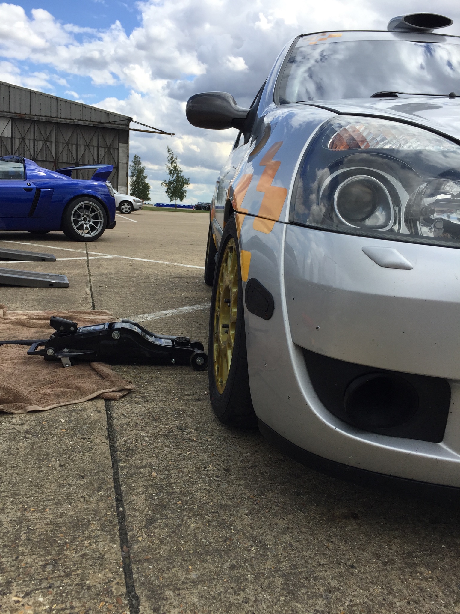

I took the car over to the trailer area and jacked it up to find fuel everywhere. This puzzled me for 1 minute...…. until I took the fuel pump cover off and found a puddle of fuel above the fuel pump. I tried to remove the pump but didn't have the right tools. Fair play to the MSV mechanics in the big warehouse who lent me some massive grips. Turns out for some reason I'd left out the rubber O ring. I don't know how this happened but it did. My mates with the race cars had brought the race van so the only option was to silicone the cap in and let it dry (obviously I didn't have a spare O ring). This took time and with pretty much the whole morning gone I ventured back out.
Excellent the Clio now was handling as it should do...……….. for one lap when the front wheel arch liner bracket started fouling the wheel. Another trip to the pits and this soon got bent out the way.
Third time lucky and low and behold the Clio worked fine for the three laps mentioned above, happy days!
I only did a few laps as I wanted to check everything after the morning issues and the fact this car has literally been rebuilt. All look well so we had lunch and I looked forward to finally starting to turn some proper speed around the track in the afternoon.
Lunch done and out we go. The Clio's feeling good and we're warming up until braking into the hairpin at the end of the back straight when during heavy braking the Clio lurches right and the steering drops to the left.
Driving the car back it felt horrible. I got back to the pits and I'm met with the two front wheels pointing at each other. The other wheel is straight in this photo

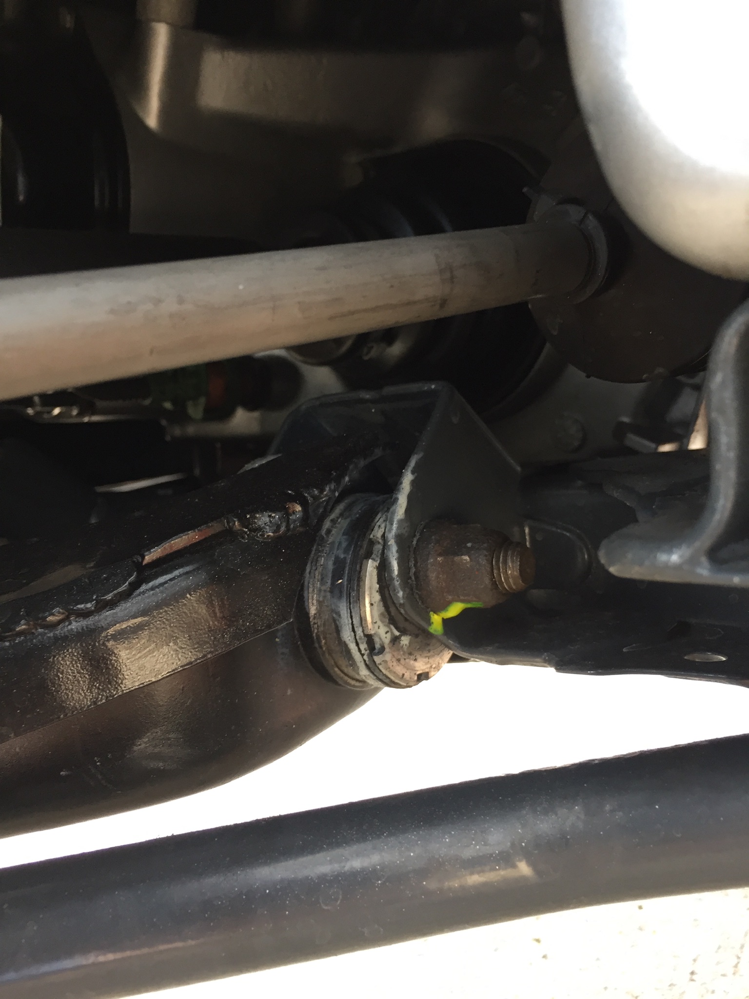

I'll abbreviate a lot here but basically the rear camber adjustment bushes I run had moved. I couldn't move them so to combat this I shortened the steering rack arm. Not ideal but I need to drive the car home remember!
To the eye it looked good but I know ultimately it's not ideal. All this messing around left me with 30 mins of the trackday left. Remembering the car is out next at the Ring I took it back out just to put some miles on it remembering it had a new gearbox, clutch, etc etc. One more gentle lap and guess what...….. same again!
Toys out the pram time and I packed up and went to the in-laws for dinner. After dinner I drove it home gently and parked it. It drove like s**t.
After washing it the following day I pretty much knew what was wrong. Remembering i'm not a mechanic, race car builder etc I didn't clear the powder coating off of the subframe etc where the suspension mounted. School boy error!
