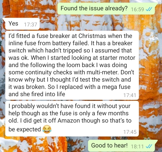

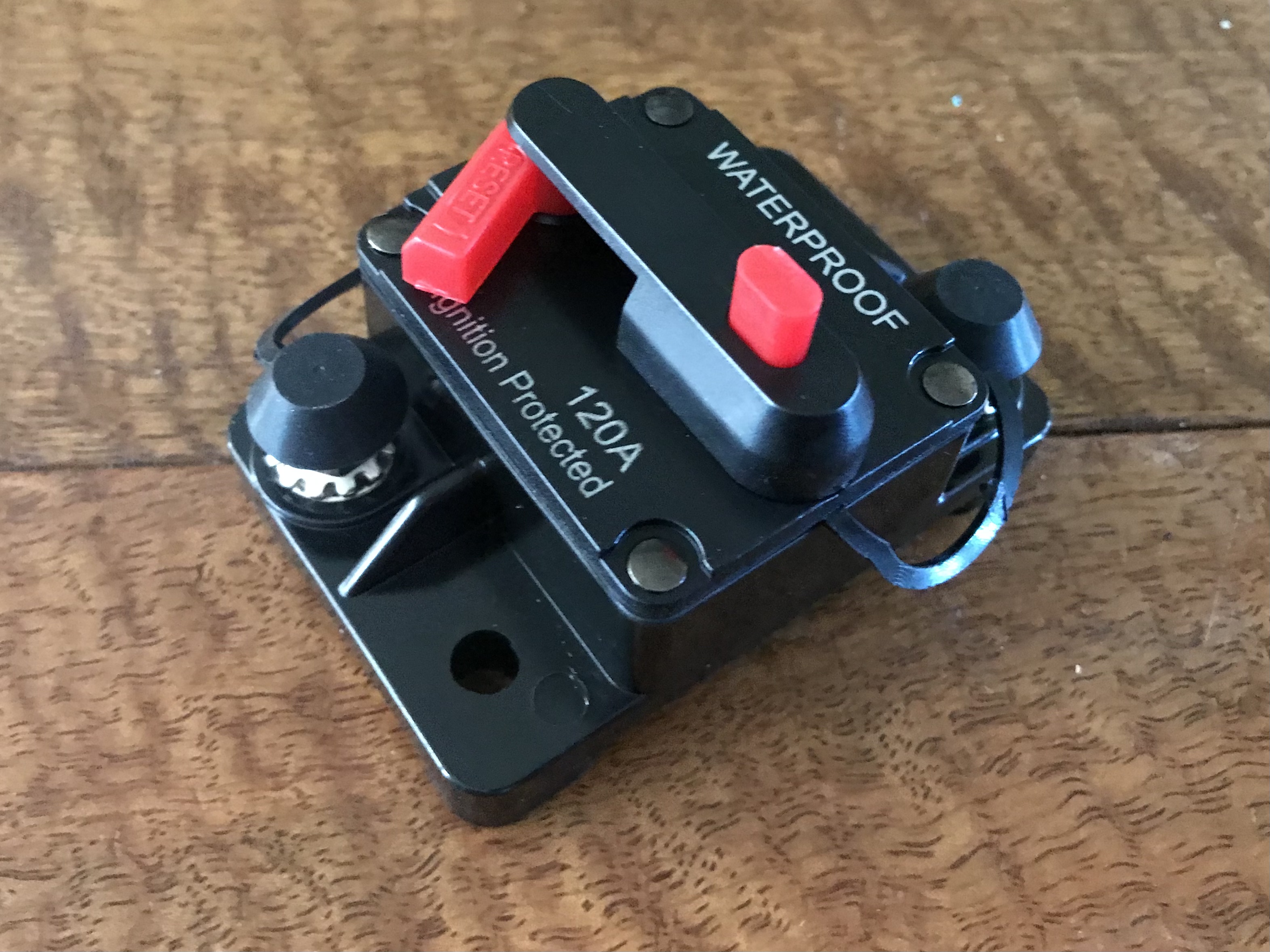

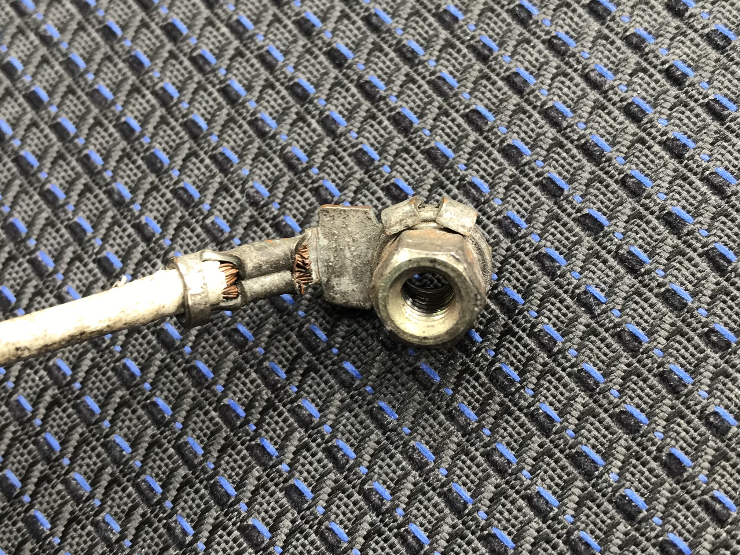

He found the issue!
Verstuurd vanaf mijn SM-N950F met Tapatalk
So a dodgy breaker switch from Amazon, less than 4 months old, appears to have been the cause of my frustration.
Anyway at least I know how to take a UCH out of a Clio now 😂
I also noticed the female spade connector on the solenoid was pretty loose. I think this has been at the heart of most of this cars problems from the day I got her.
So much so I ended up getting a new starter motor fitted when I probably didn’t need to.
Again, another reason why I’m learning to do jobs myself so I know they’re done properly.

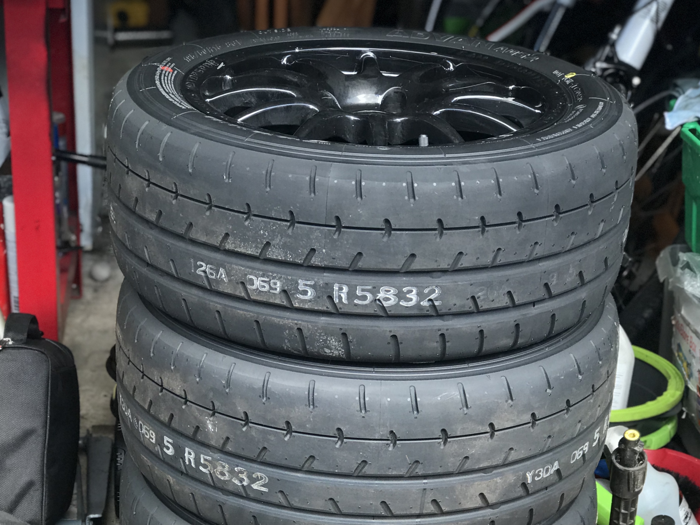

Finally managed to source a few more Yokohama A052's after searching all over the place. Plenty of deals about but no stock.
Luckily enough a good mate tipped me off to a local supplier who was keeping them for a lad who races in tin tops, but doesn't need them right now. Mixed reviews on them. They certainly grip, but are a bit on the soft side so wear out pretty quickly. My last set lasted 2 trackdays.
My preferred choice would be A050's but you can't get them now, so might try the A048R's next.
If anybody reading this is using the A048R's on the their track car i'd be interested to get your feedback.
Of course there are other tyre brands out there but i'm a Yokohama fanboy, having pretty much used them without complaint for 4 seasons.
My mate, who races in the trackday trophy, has gone through the expense and pain of other brands, before finally settling back to Yokohamas. I guess it's a trust/superstition kind of thing.
Convince me otherwise!

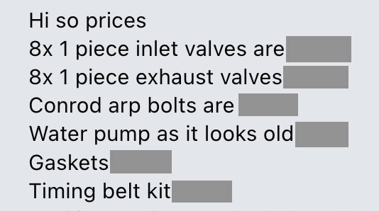

Update on the track car engine. Not the dephaser - didn't think it was that anyway - but the valves.
When i think about it, it's the same issue i had when i first bought the car. I guess after 4 track seasons and several thousand hard track miles, it's gotten a lot worse.
Going to replace the 2 piece 182 valves with 1 piece versions aka 197.
Might as well change the belts as well as that's coming up 4 years in September. Water pump wasn't changed when i booked into my local Renault 'Specialist' for the timing belt kit, even though i supplied it, but that's a whole different story :mad: So we'll do that.
Might as well change the Crank pulley to a lightweight one, as that's looking a tad on the rusty side and put some ARP bolts in too.
Not a cheap repair but at least i didn't blow the thing up 😂 and she'll provide me with many more trackdays to come.

197 valves are 2 piece still, atleast in my experienced it has been. Maybe Supertech is a better bet. And be carefull with the lightenend crankpullyes. Mine snapped on me.[emoji29].

I was under the impression 197 valves were still 2 piece as well 🤔
@NorthloopCup will know.
They are 2 piece mate yeah. Even supertech ones are. But the friction welded join is higher up the stem so less chance of failure.
Only other valves I know of for the F4R are Sinus (sp?) but not sure if they’re 1 or piece.
Lightweight pulleys are fine, providing you have the entire assembly balanced.

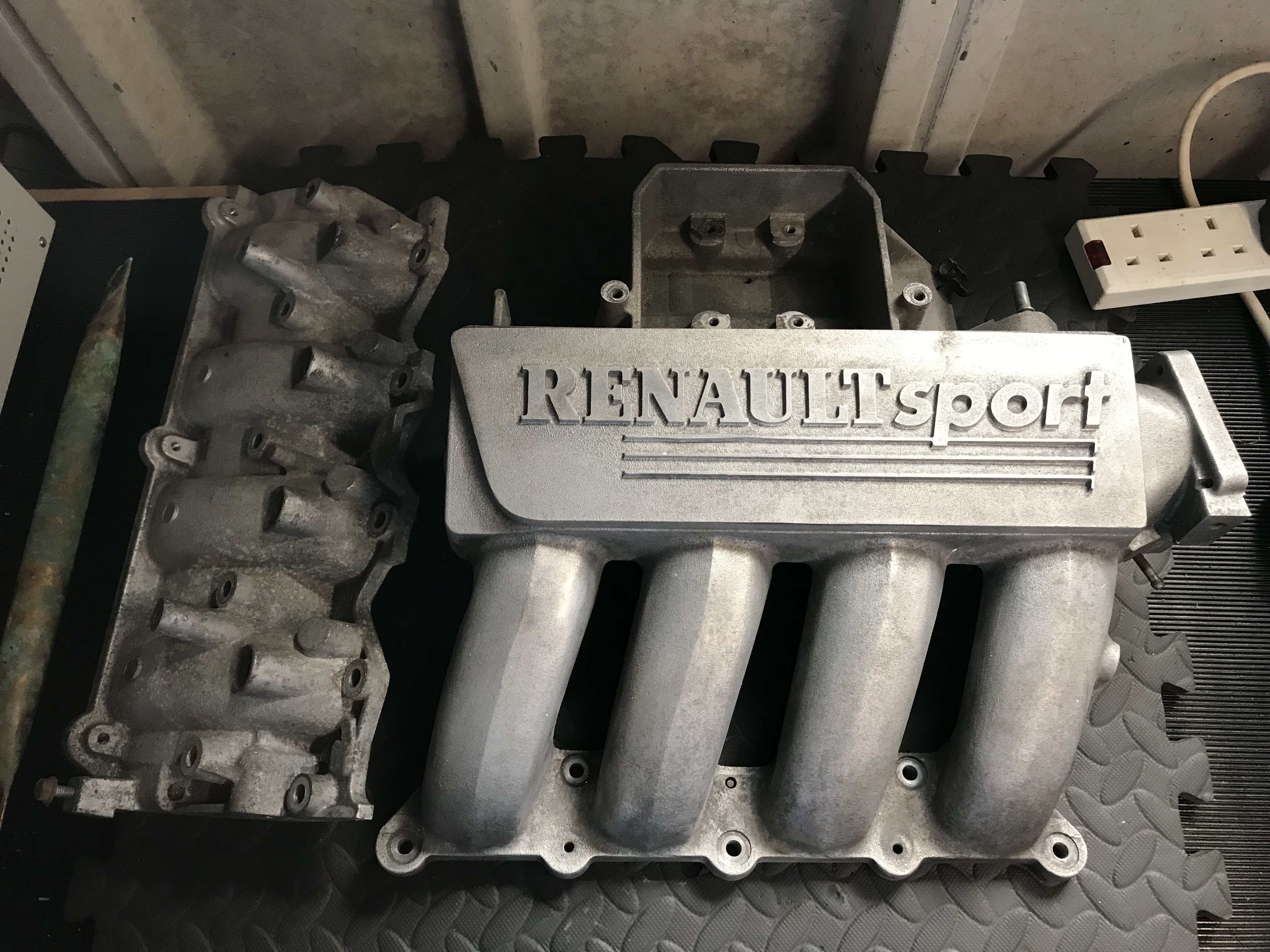

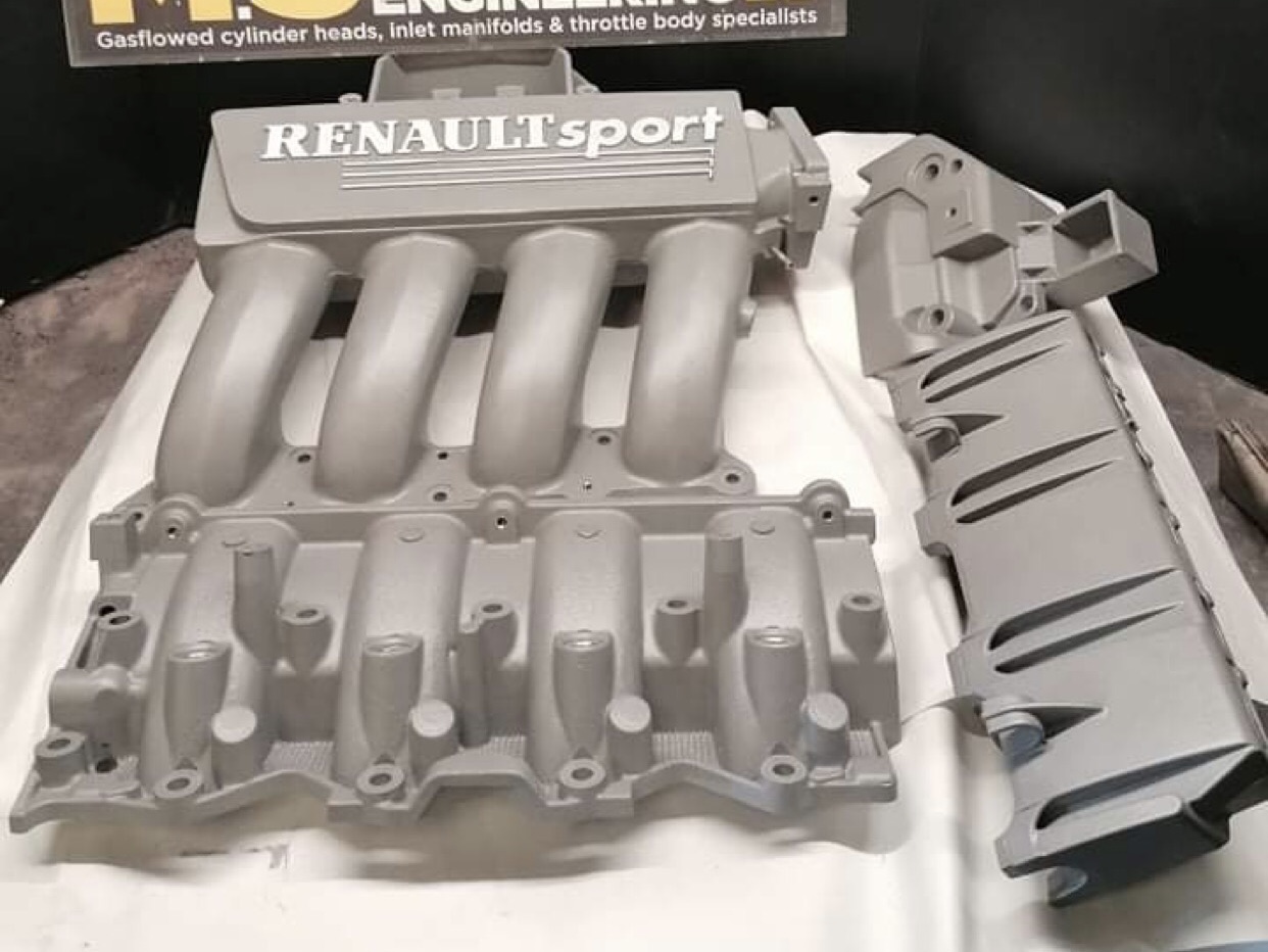

Now the weather’s starting to cool and the nights drawing in, it’s time to start getting some more work done on the Clio’s.
Managed to pick up a cheap upper and lower inlet from a local lad. Then get it off to Max at MS Custom Engineering.
I’ve heard good things about this lad and he didn’t disappoint. Once I’d made comms with him everything went really smoothly and I’m super happy with the way these look.
Can’t wait to actually see the finished results when they arrive. Just not sure whether to put them on the daily or track car.

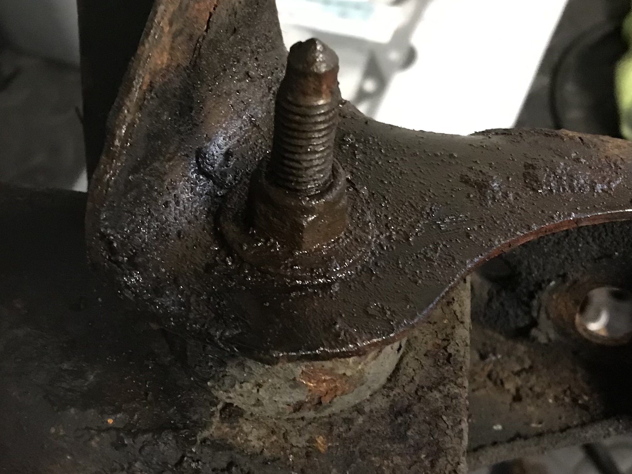

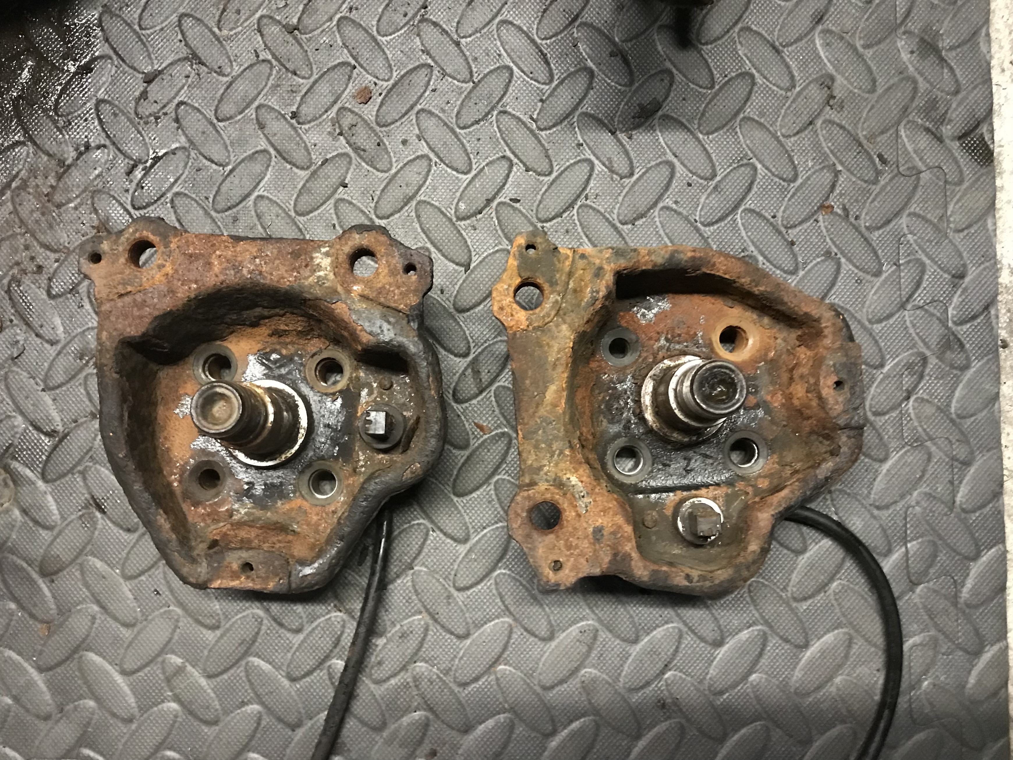

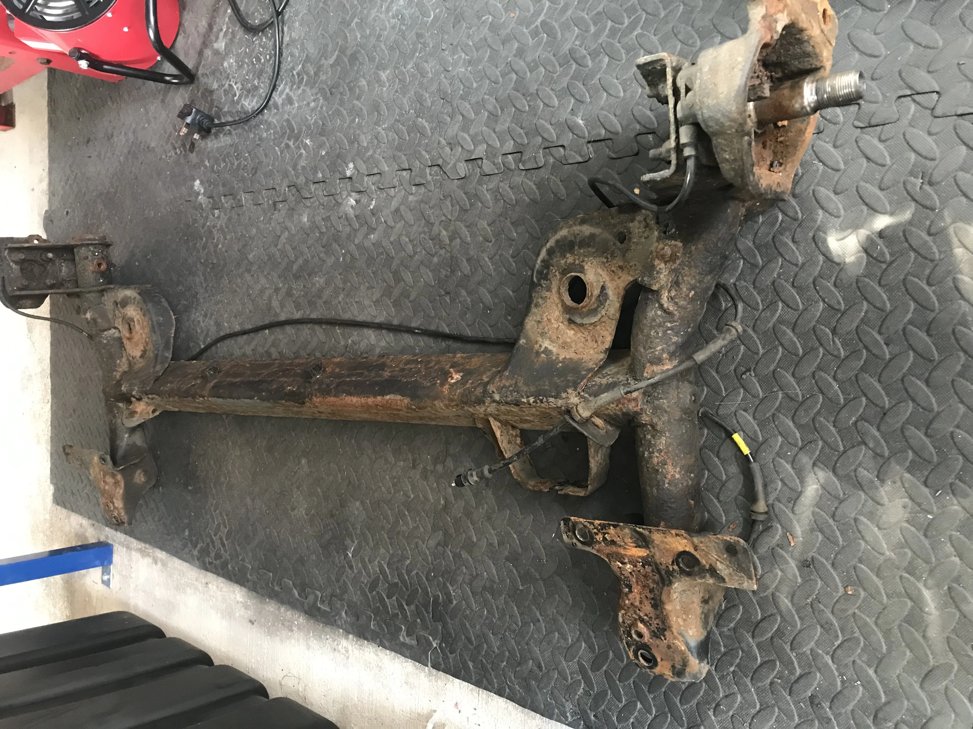

Next up is tackle my old rear beam off the daily.
I managed to get another rear beam last year and have it powder coated. Then replaced this one with the refurbed one.
Trouble is it’s already started to rust, so I’m going to do this one myself as I think I can do a better job.

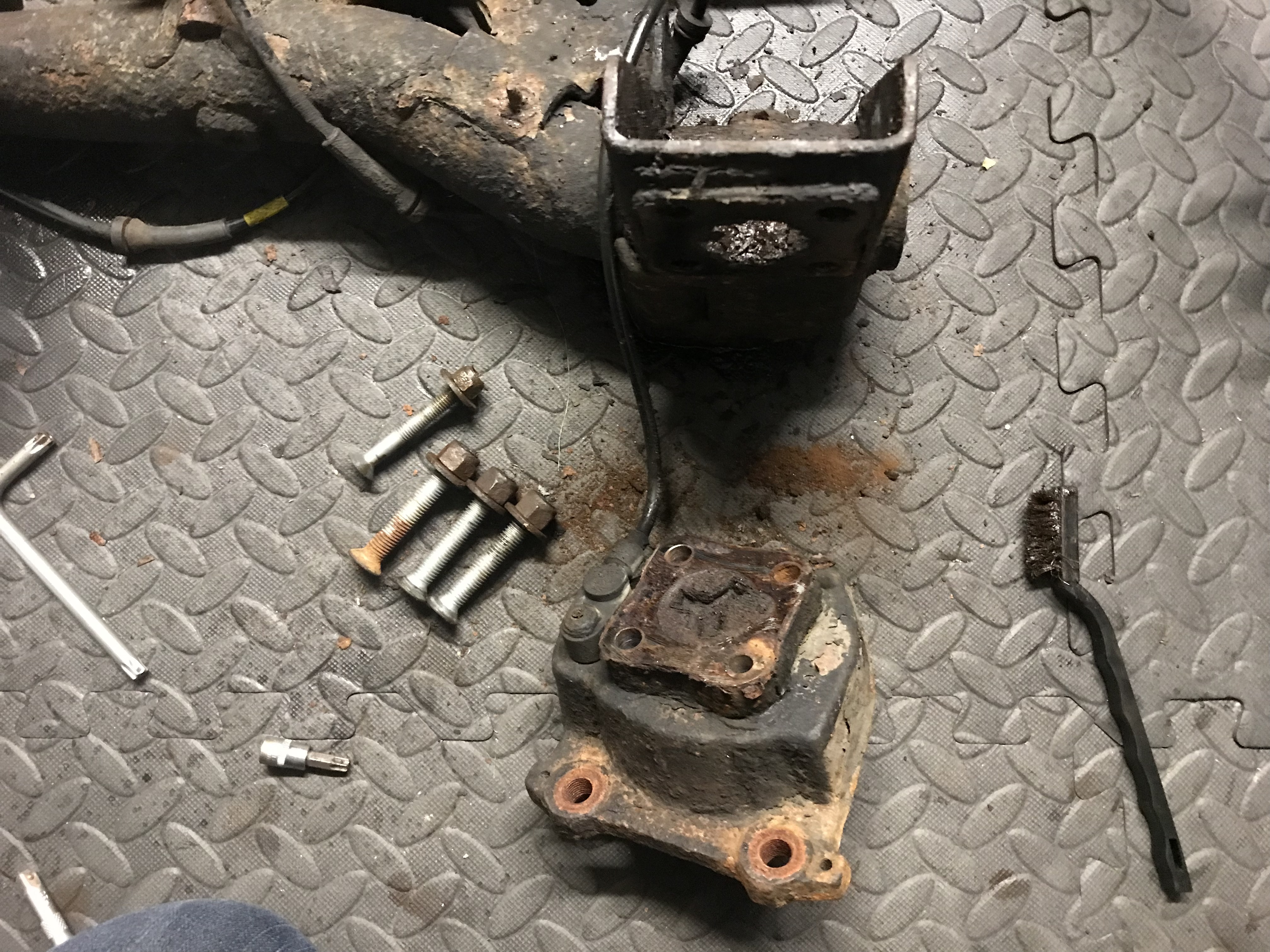

First up is to get the rear hubs off. They didn’t put up much of a fight baring one bolt.
Tomorrow I’ll be tackling the brackets and then remove the bushes.

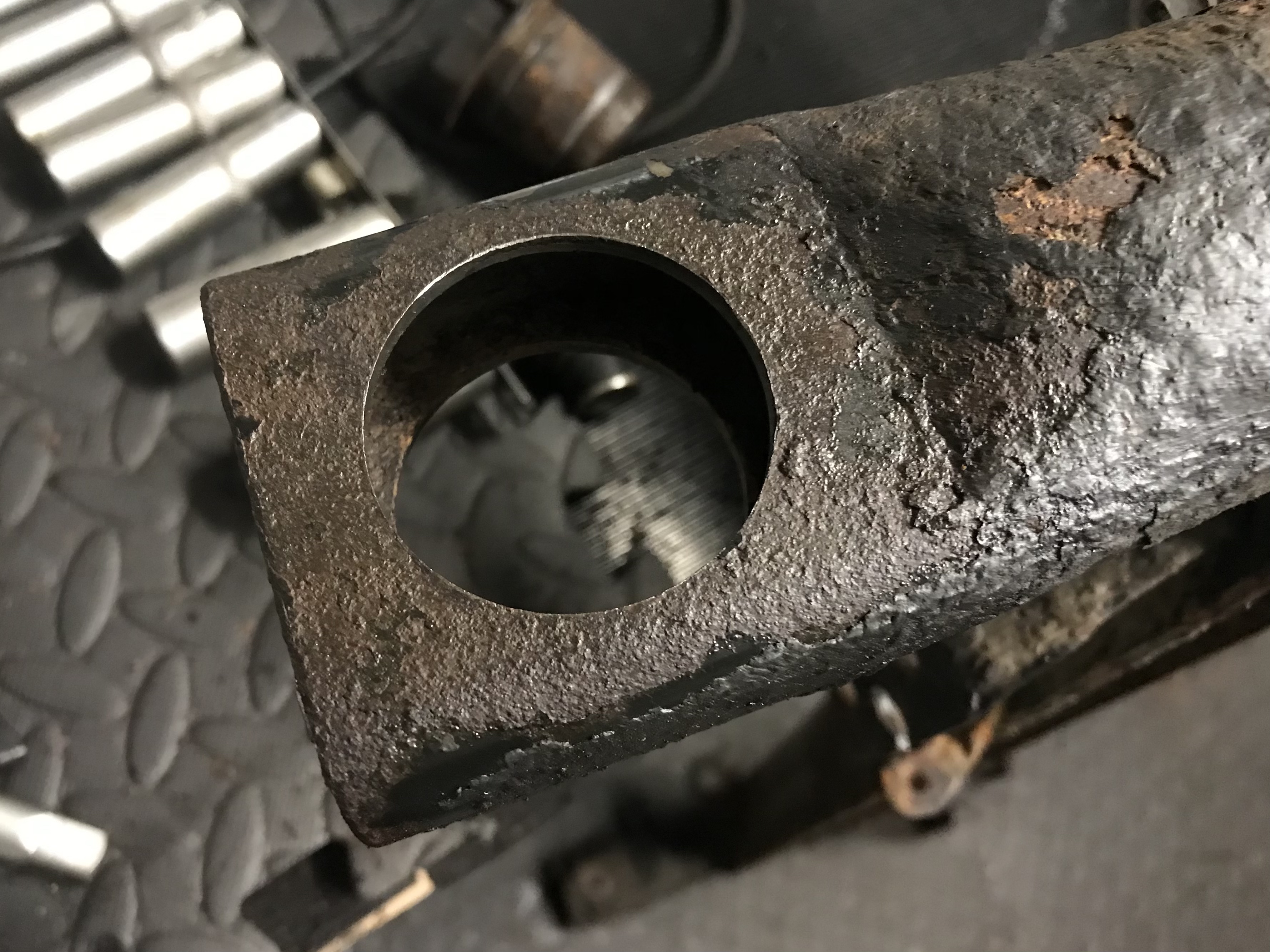

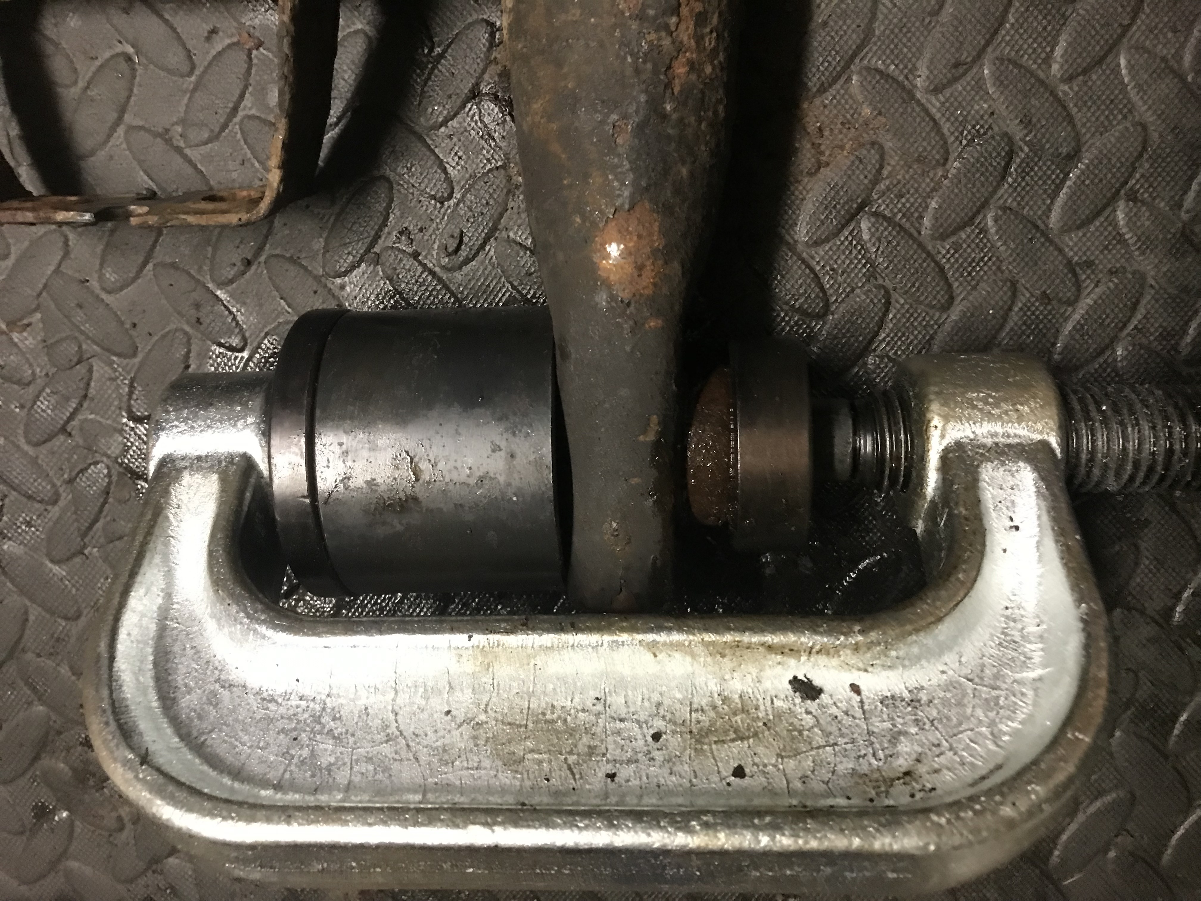

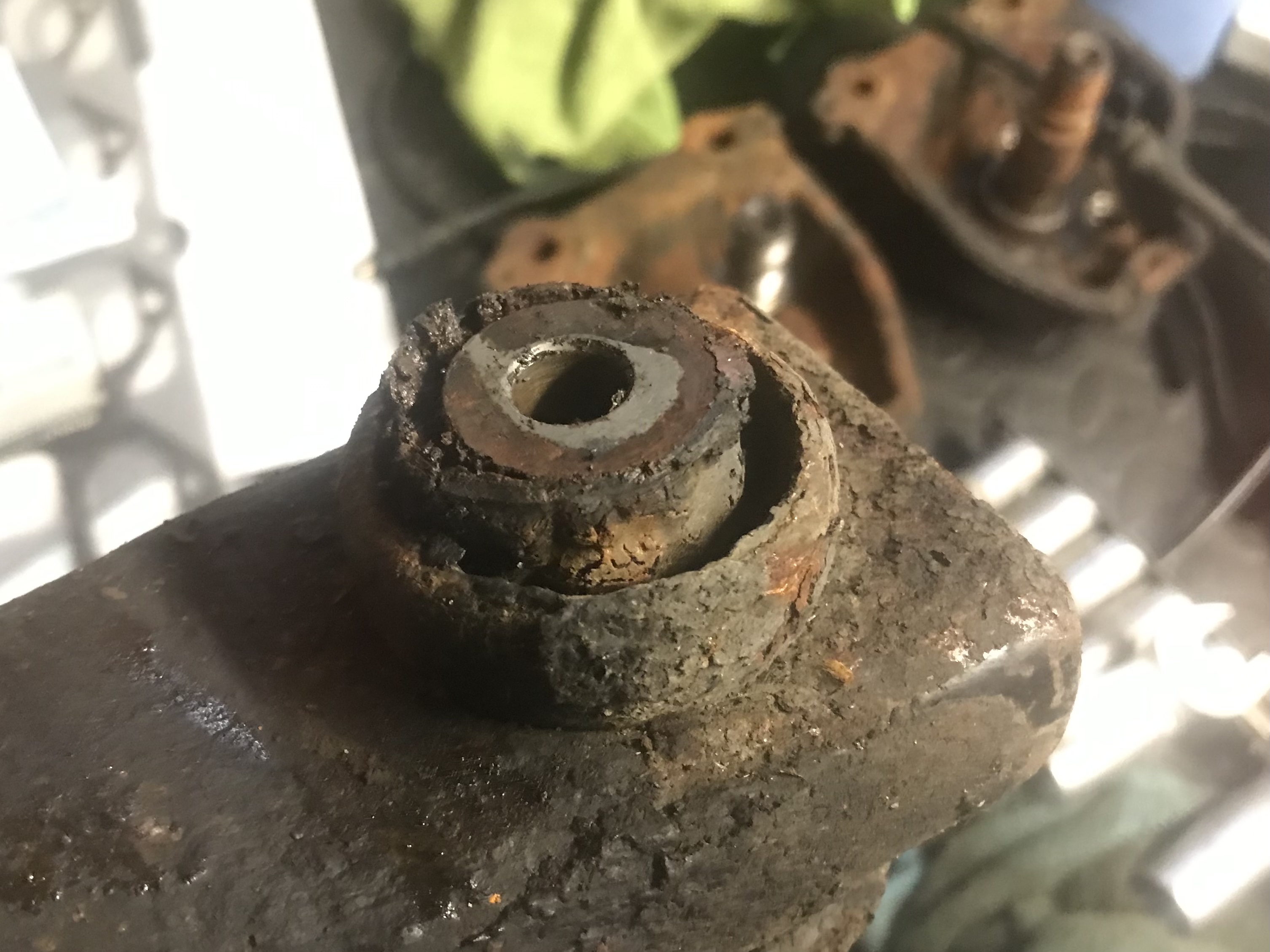

Time to finish disassembling the rear beam.
Bolts on the brackets came out pretty easily and look like they could be refurbed - we’ll see.

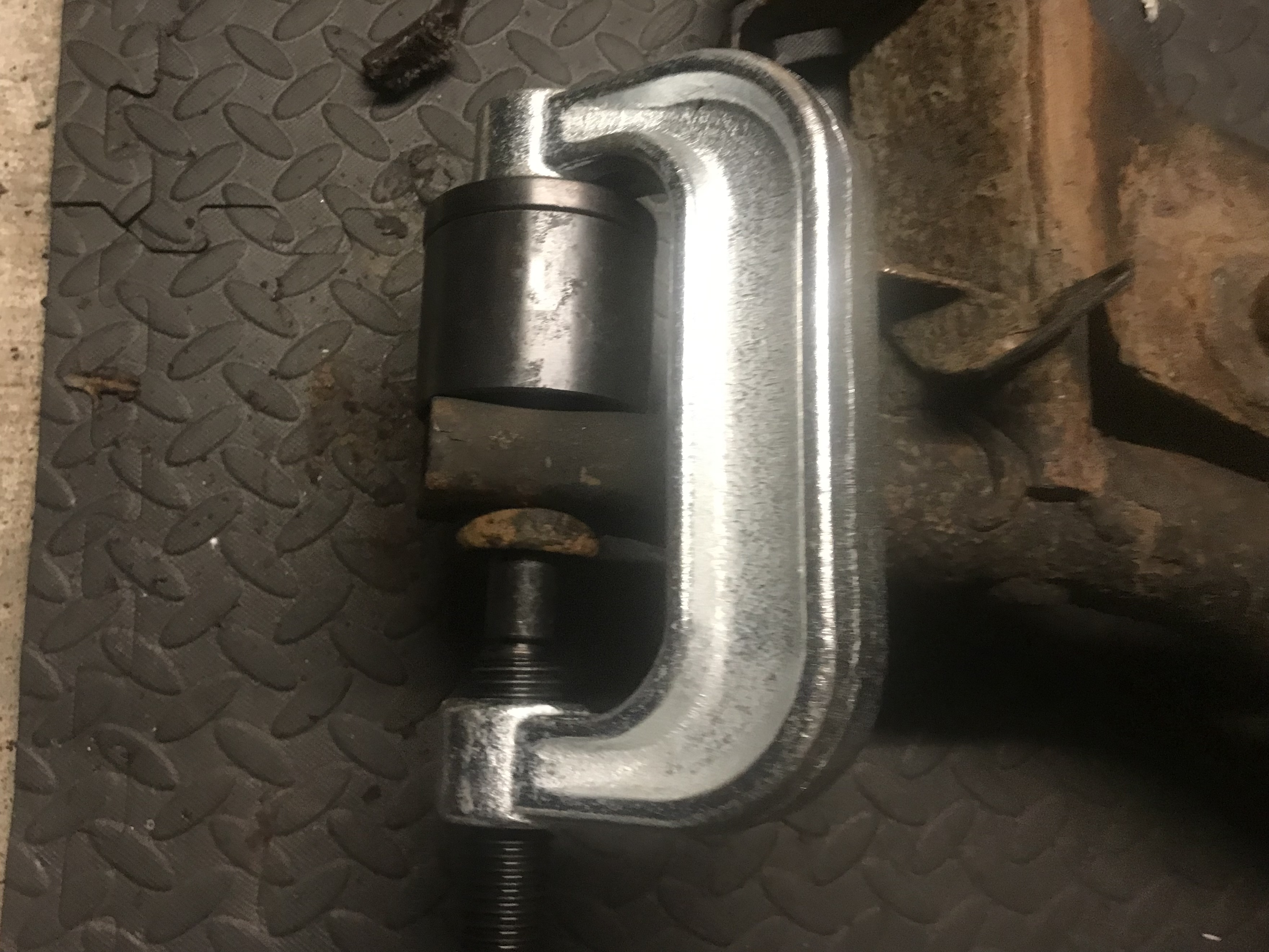

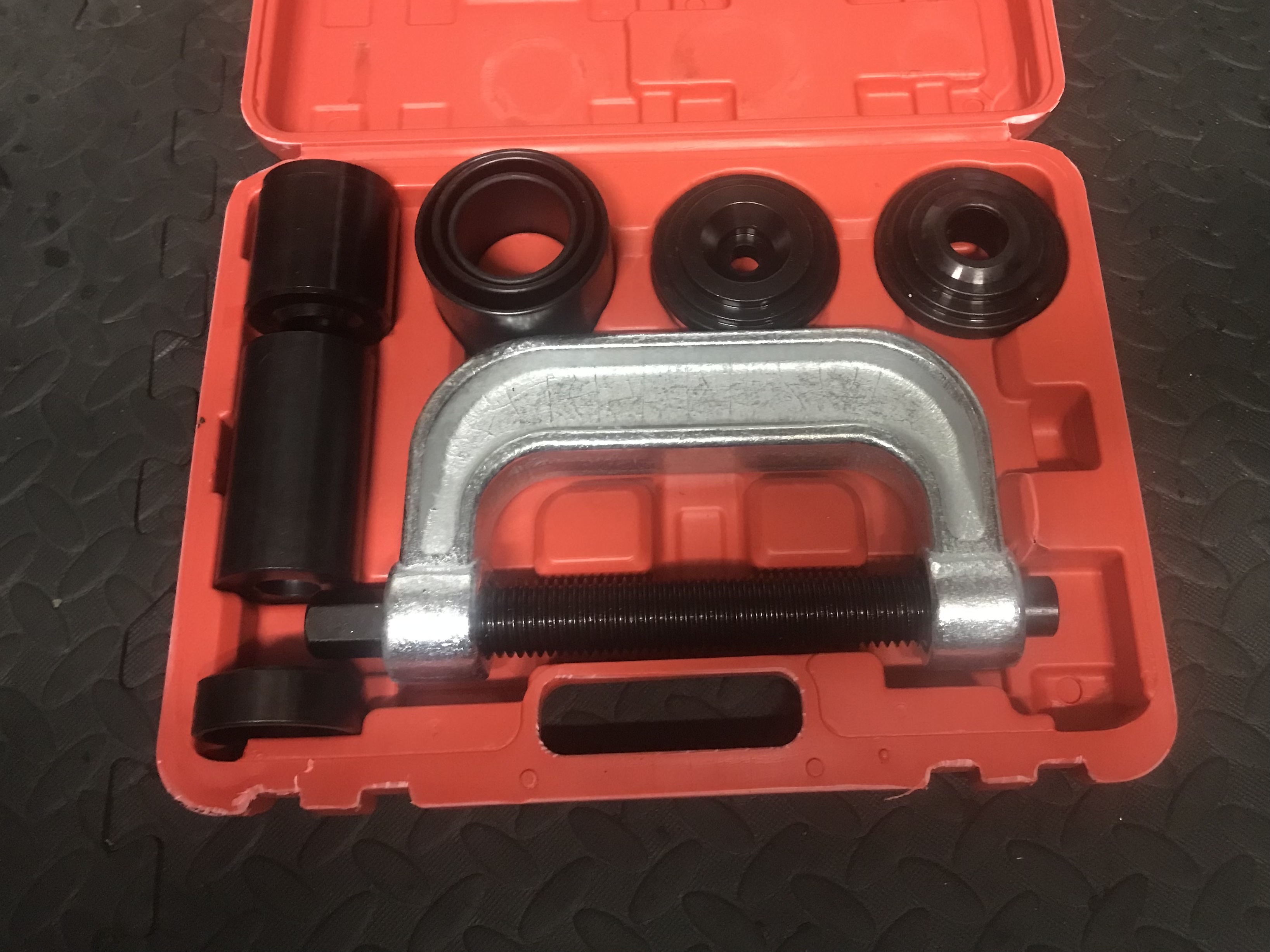

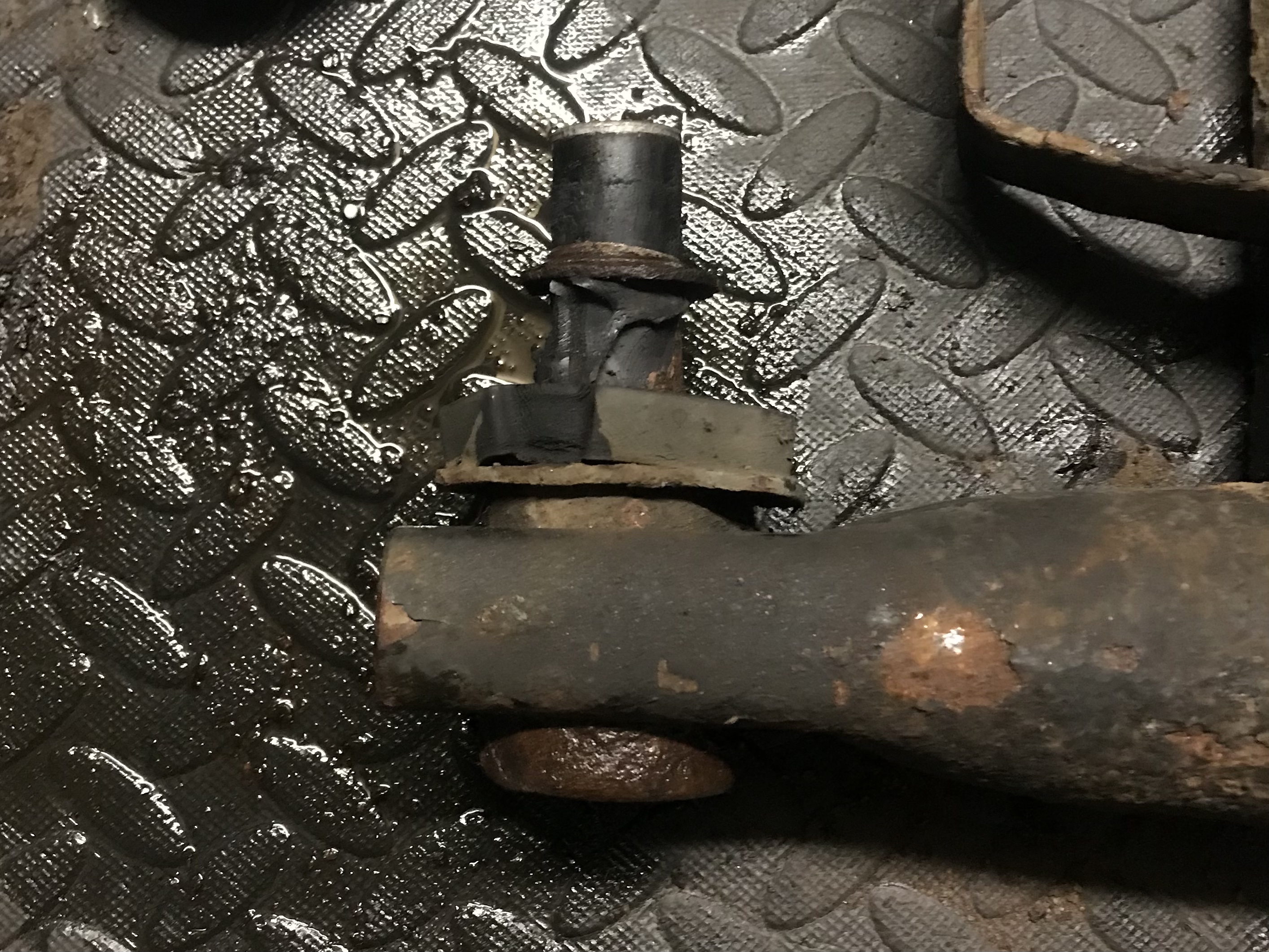

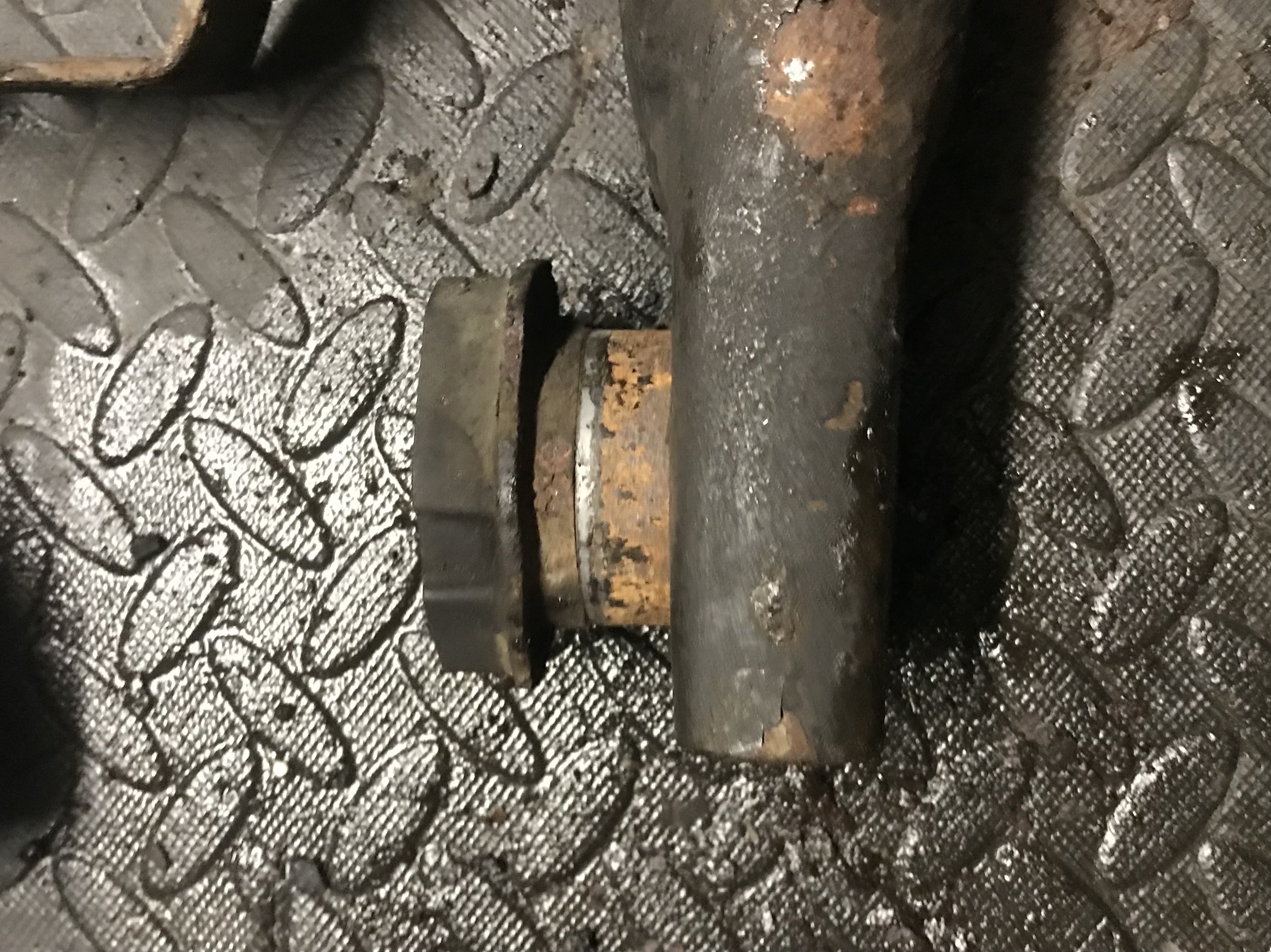

Next it’s on to the bushes and this time I bought the proper tool - a 4 in 1 frame press kit off EBay for £24.
Seems a little extravagant just to remove some bushes, but the last ones I did my tools comprised of a blowtorch, hacksaw and a big hammer.
Almost melted my shoe, choked myself to death on the fumes and burned a big hole in my rubber flooring. I guess Kids shouldn’t play with matches. Lesson learned. 😂
To make removing the bushes a little easier I first pushed the centre out of the bush, then went onto the outer part. It took a fair bit of pressure but eventually it cracked off and came out without too much drama.
So with the beam dismantled, I’ll start removing the crusty bits and begin the restoration.
