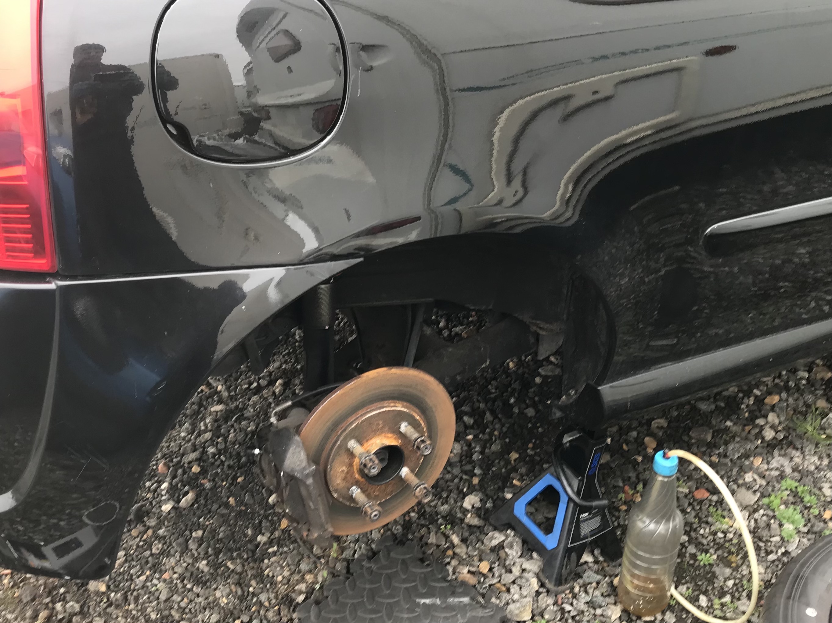

Finally made a start on the RB. Off all next week so hoping to get the beam switched over and then give the back end a good clean, cavity wax and underseal.

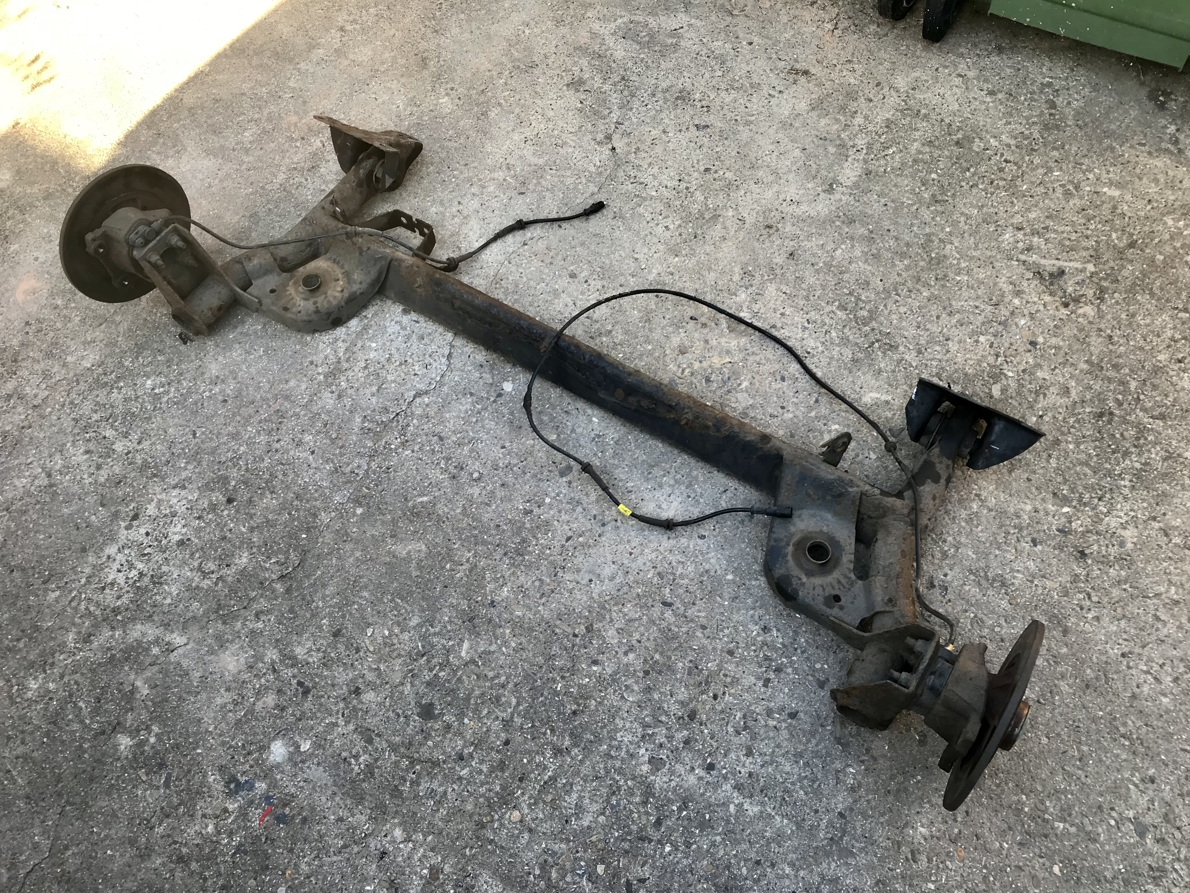

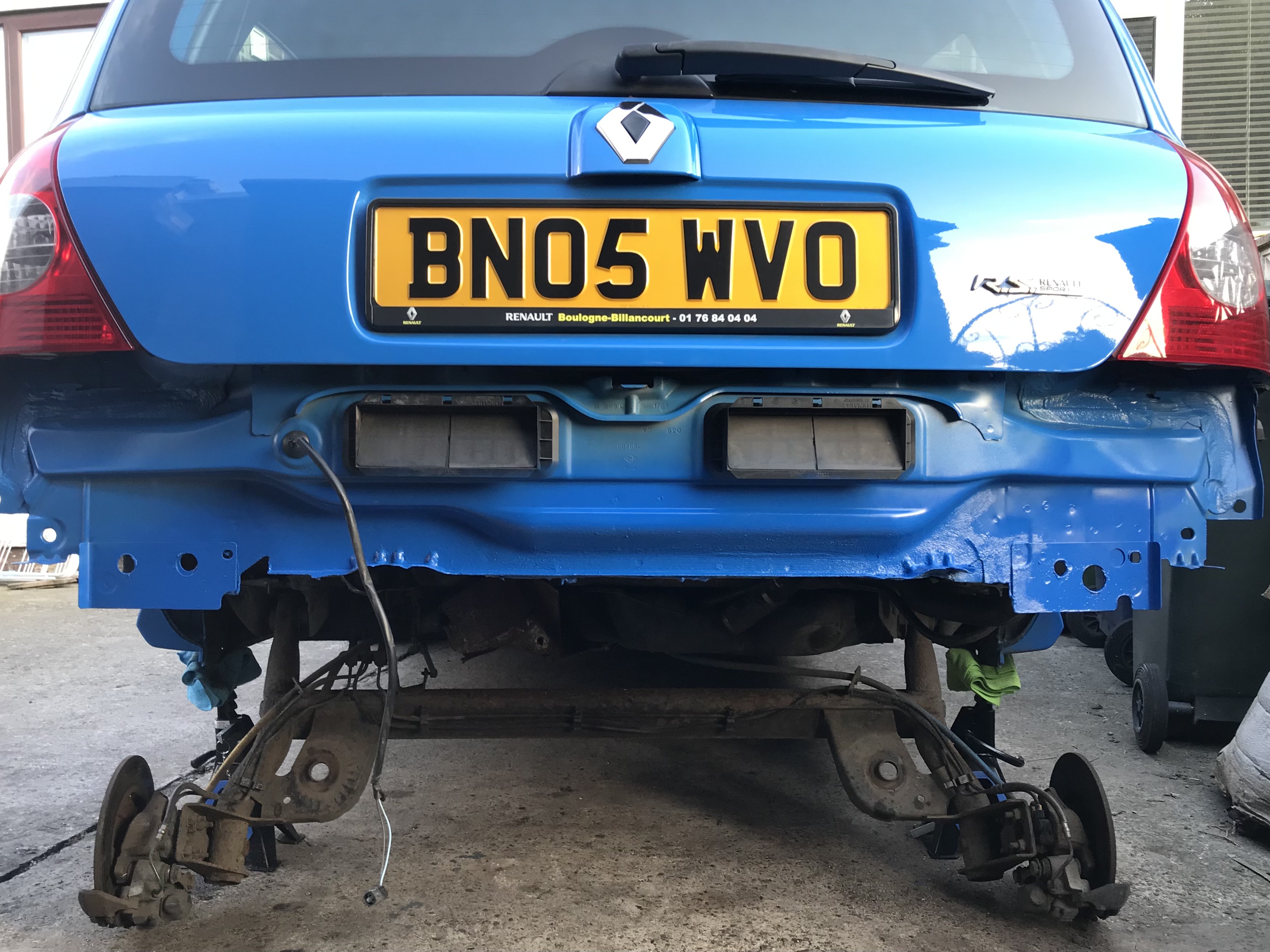

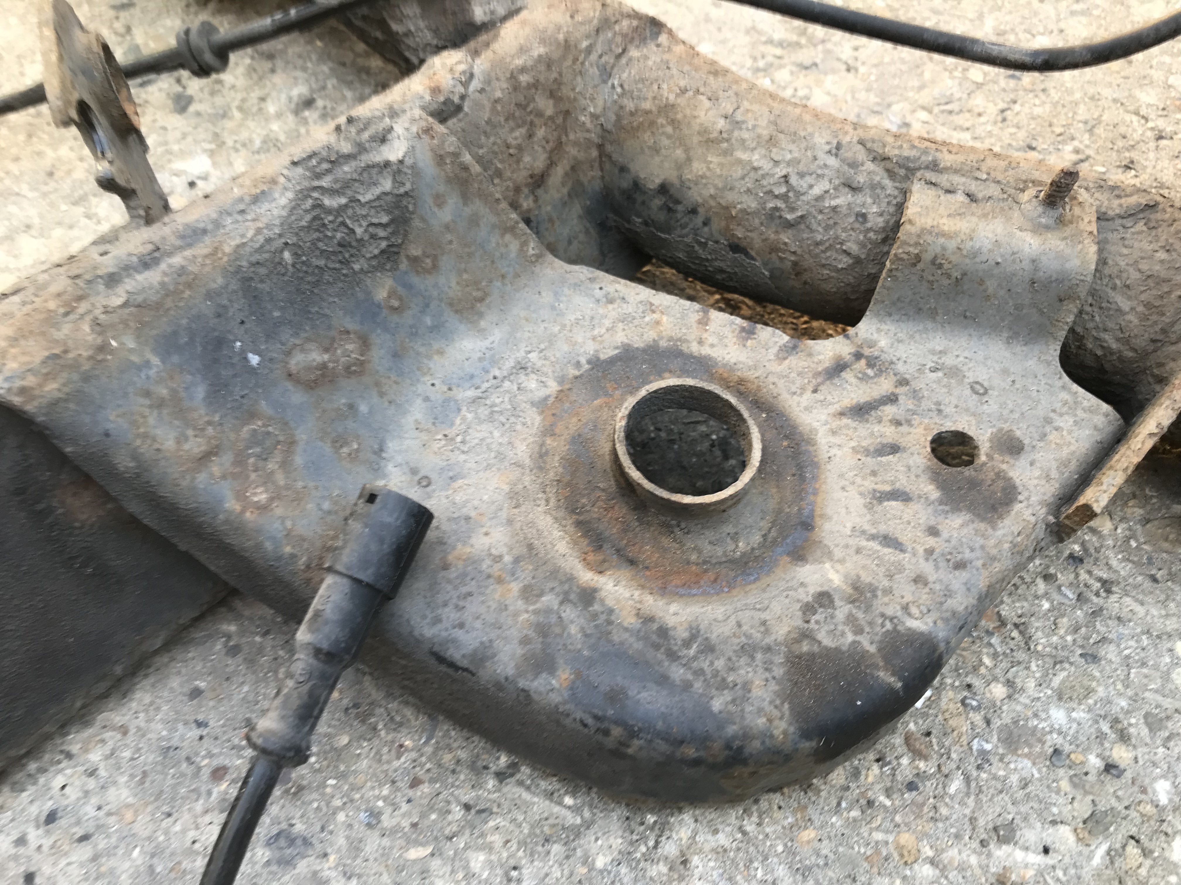

A few hours today wrestling with the rear beam. Finally got it out and it’s not in bad shape.
Managed to get a good look around underneath and there’s not a massive amount to do, although the heat shields have seen better days.
I’ve now started the cleaning process which will be a few days solid work and also began adding some zinc primer to vulnerable areas.
Just debating whether to take the tank out or not. From what I can see there’s nothing of any concern, but I’m always curious to see what’s lurking underneath 🧐
Mr Underhill

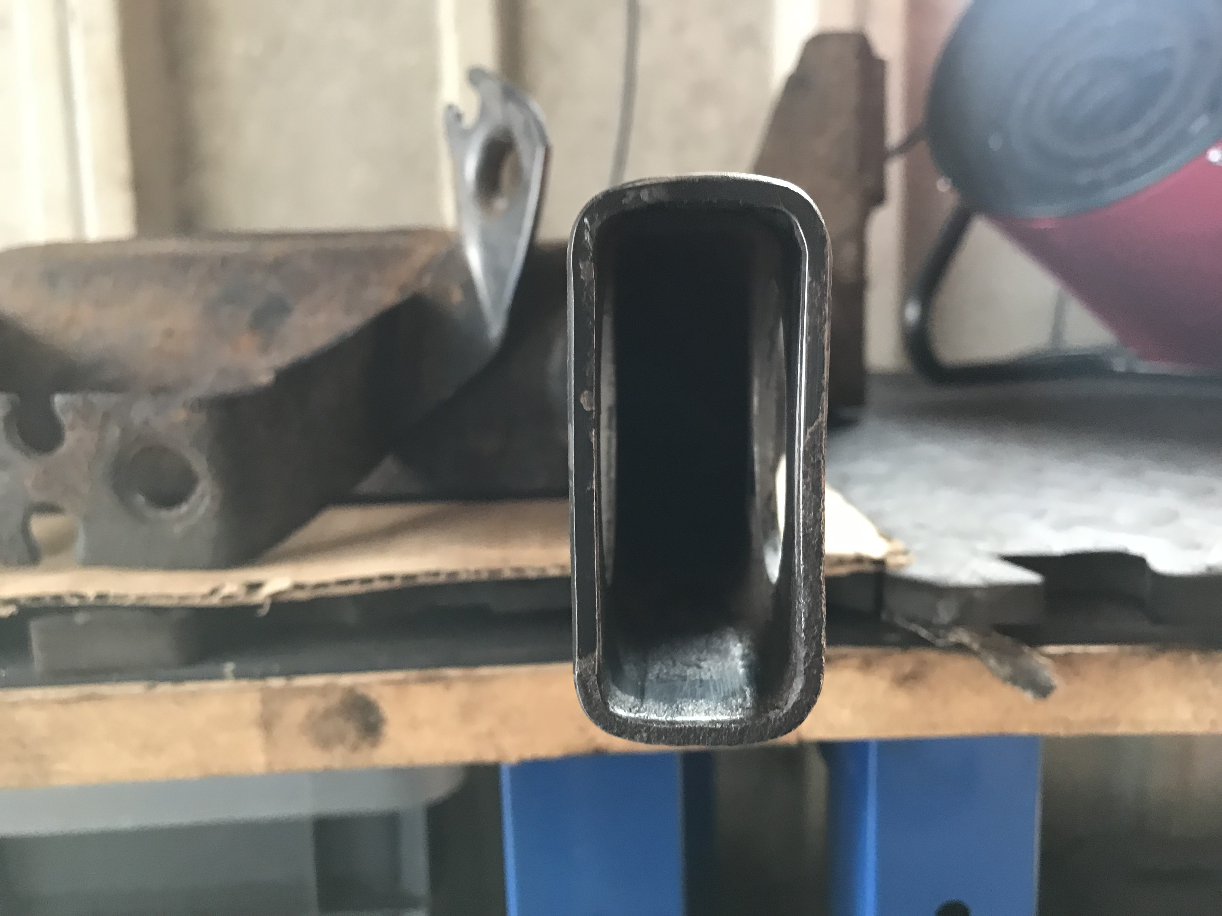

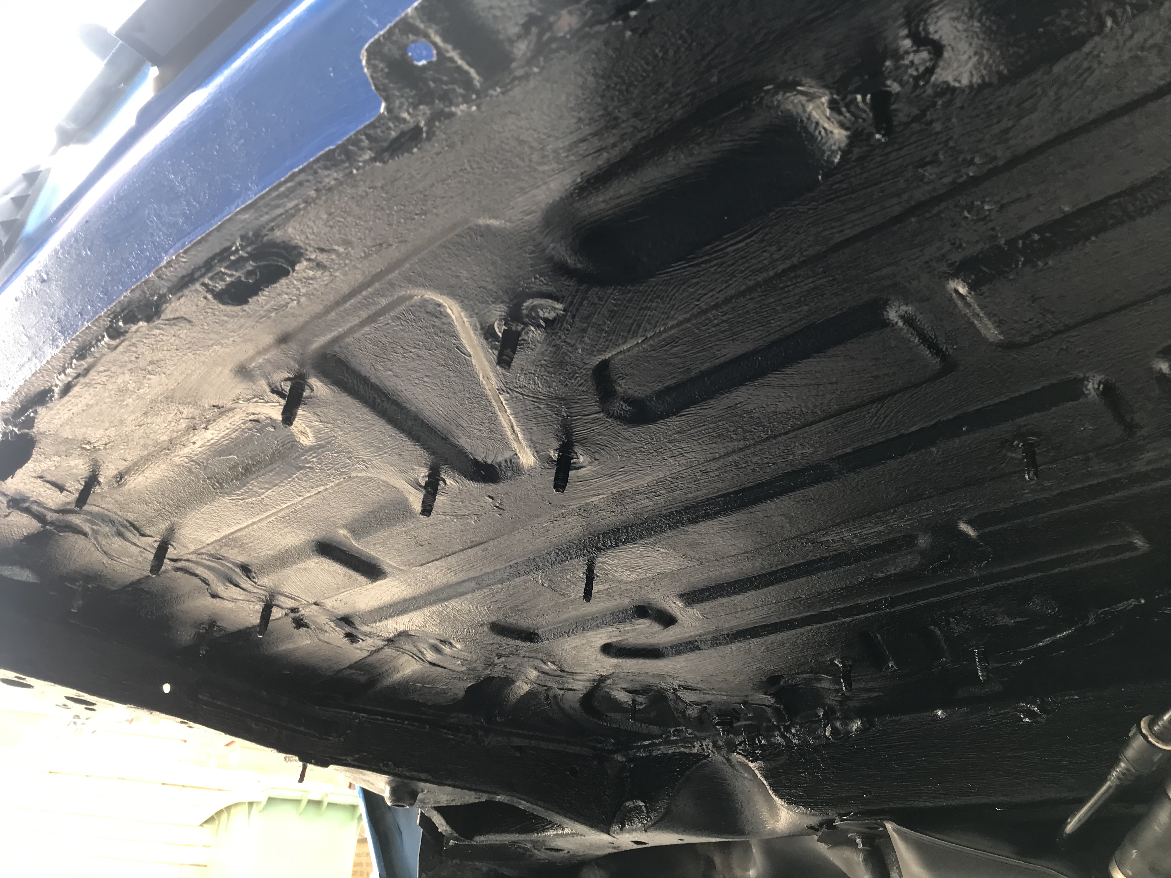

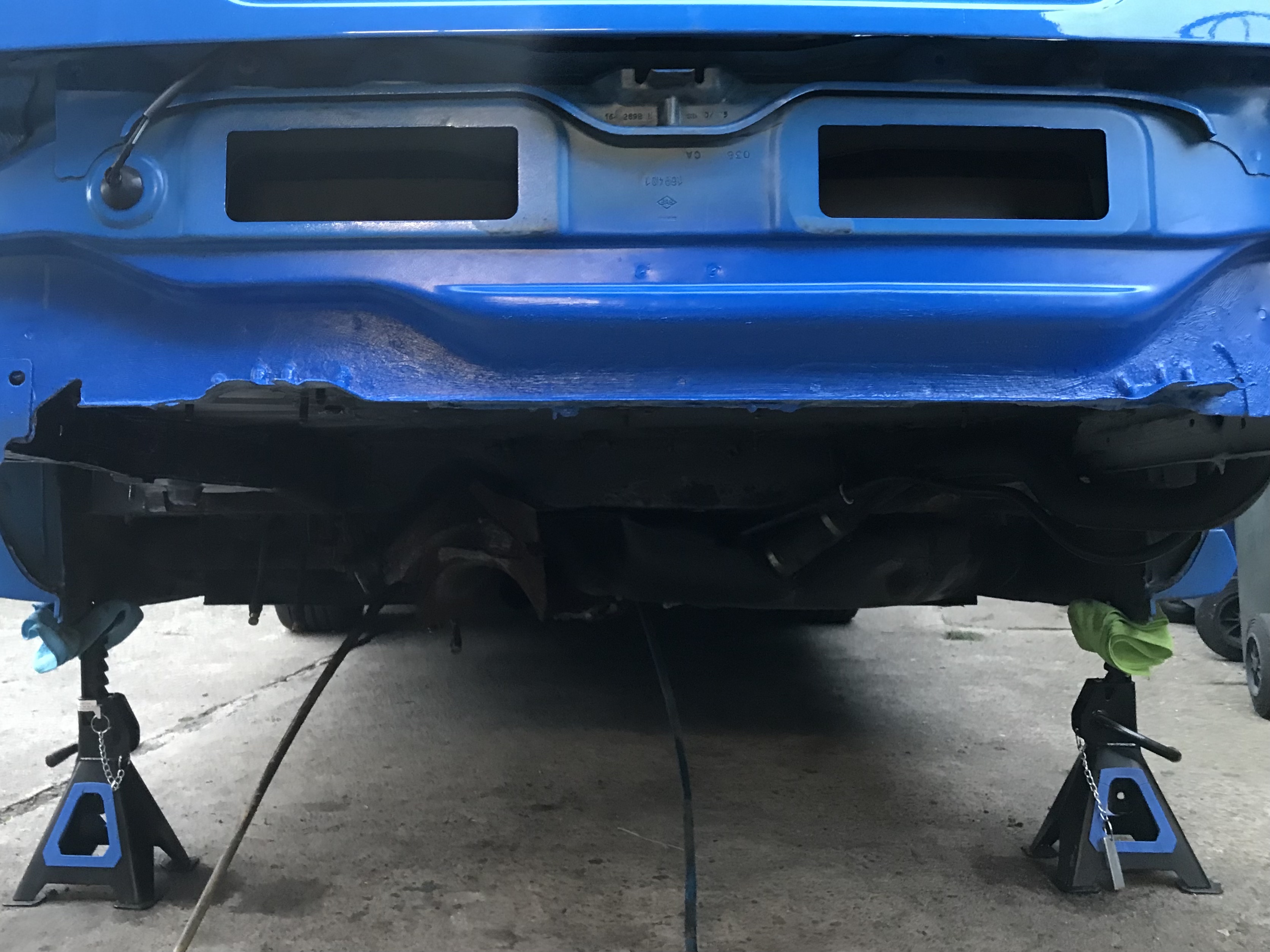

2 solid days attacking underneath the rear. Not a lot of corrosion, which I noticed on inspection before I bought it, but it’s still a relief when you start to take things apart.
Apologies for the photos as there’s either light coming in from the east, or behind the house or from the west. Everything looks dark.
It’s not pretty but it’s nice and clean and ready to build back up. It’s horrible dirty work and I’ll say here and now this is my last Clio project 😂 Body repairers of the world, I salute you 🖖

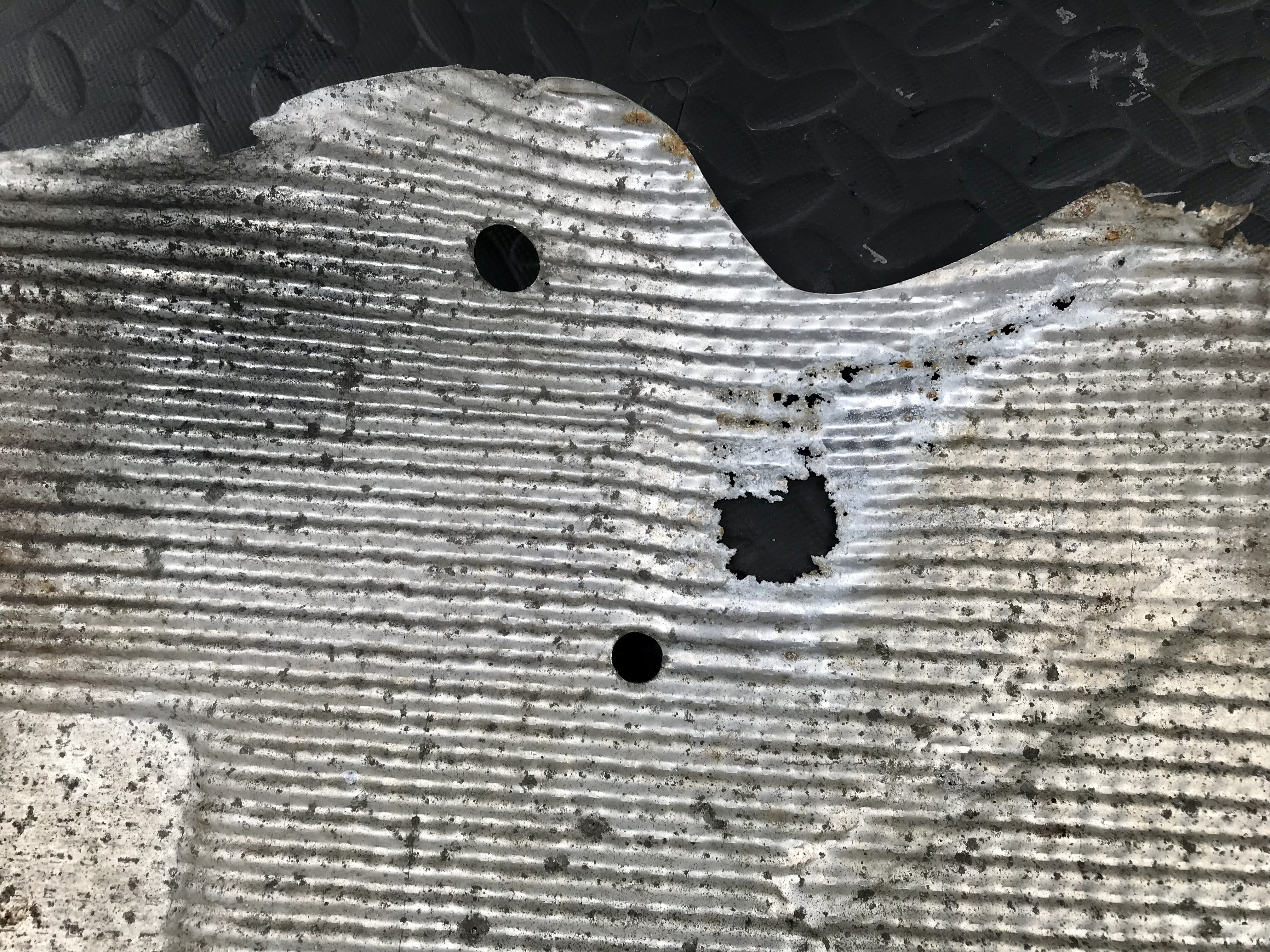

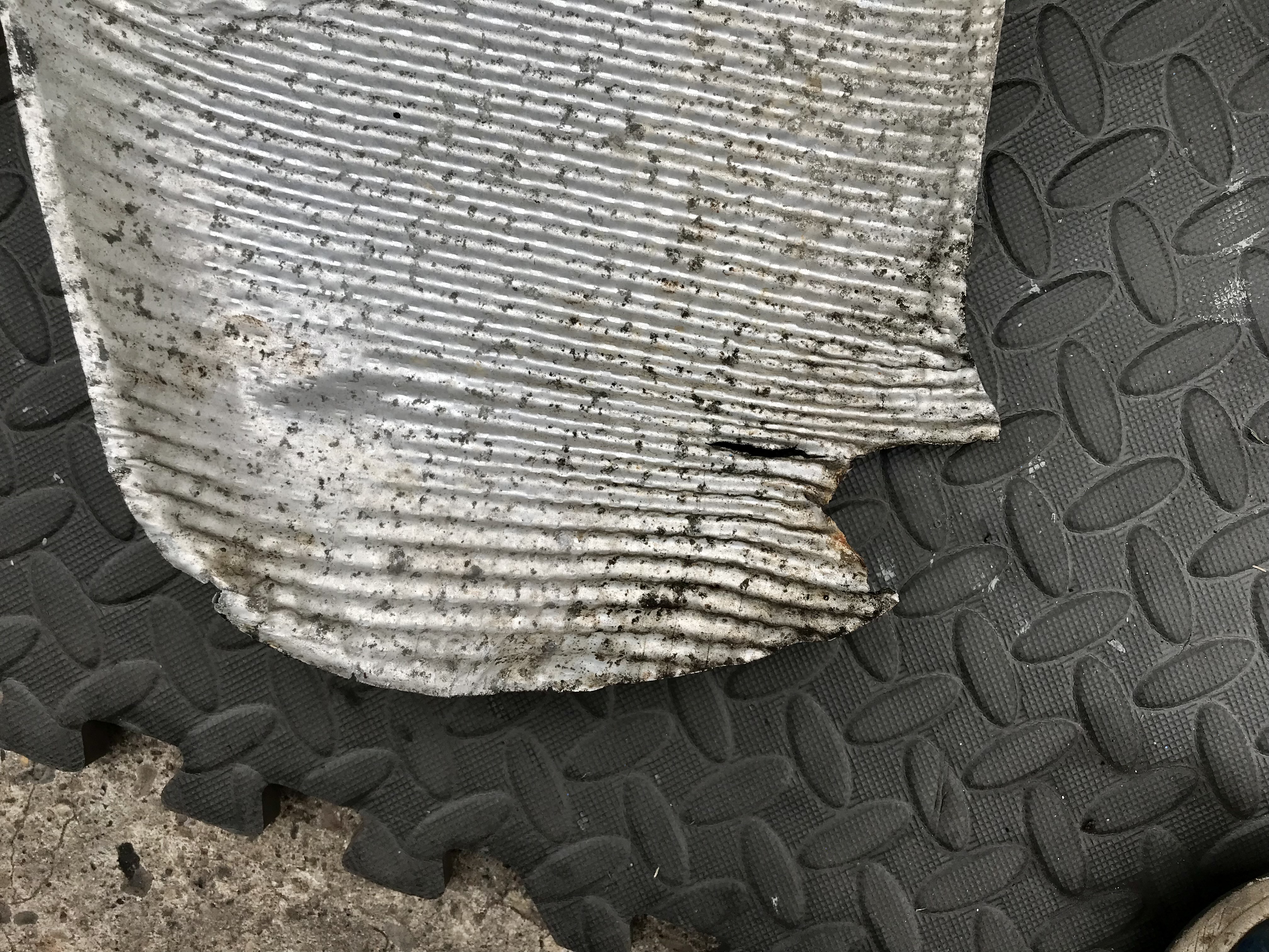

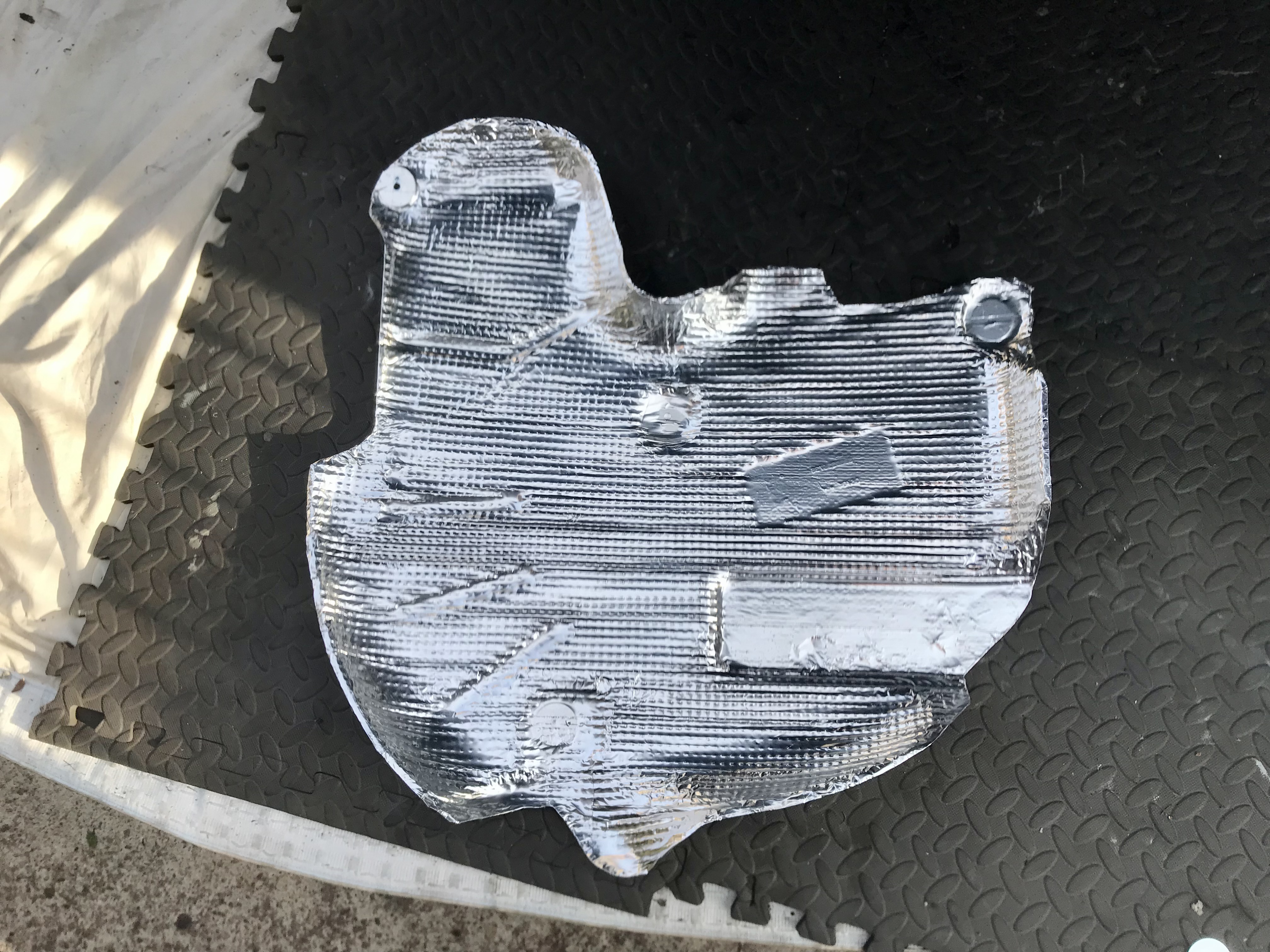

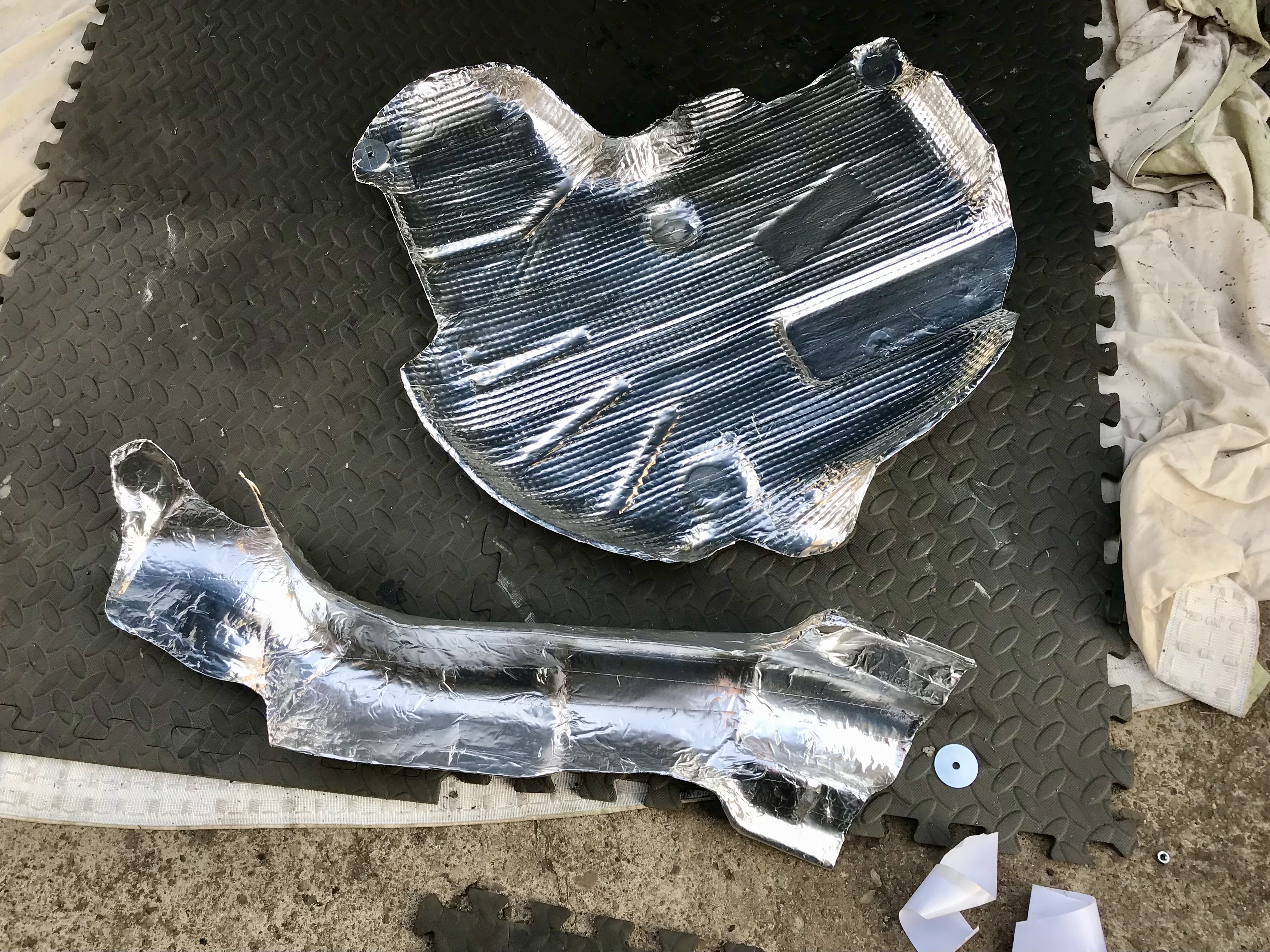

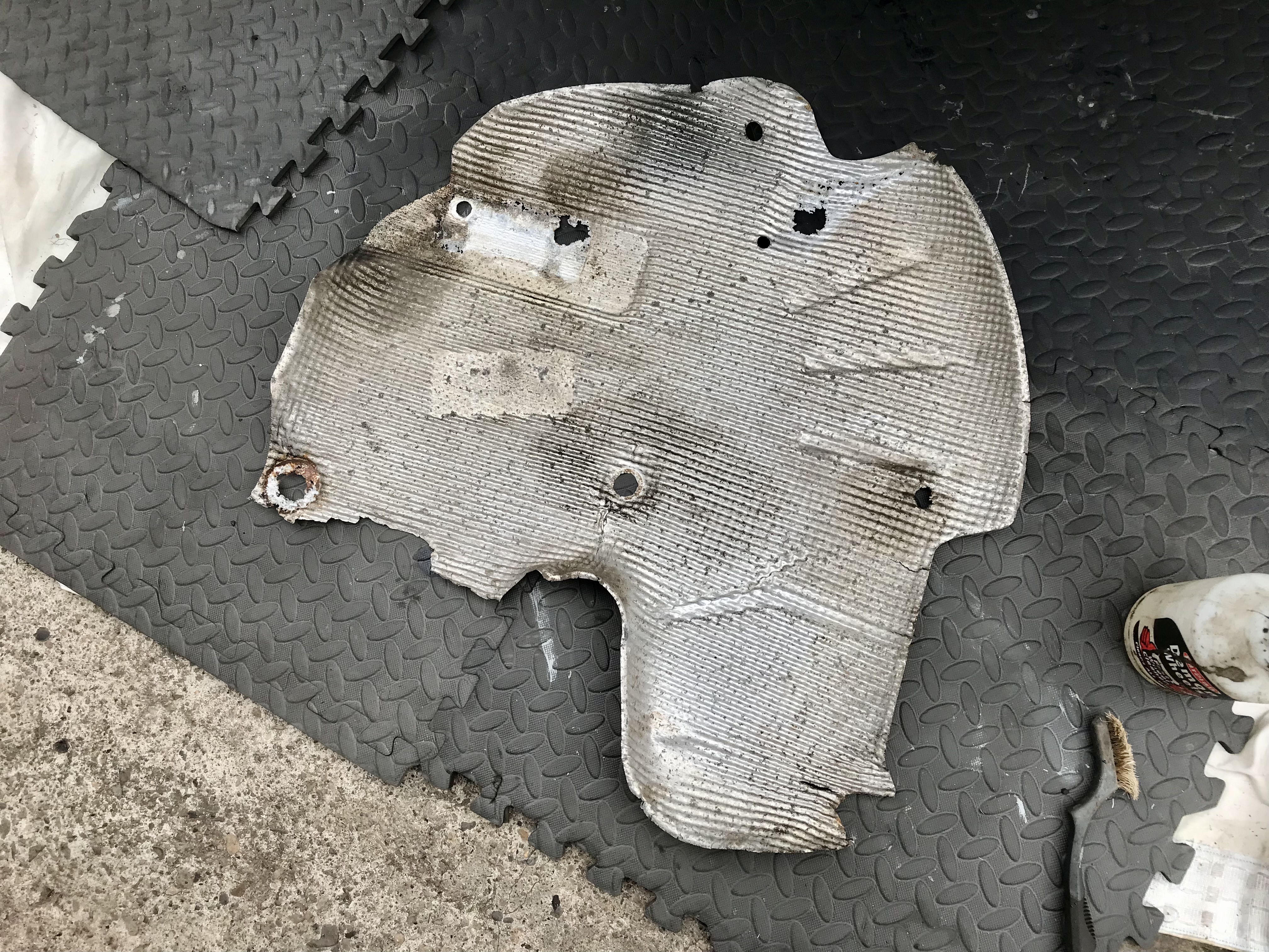

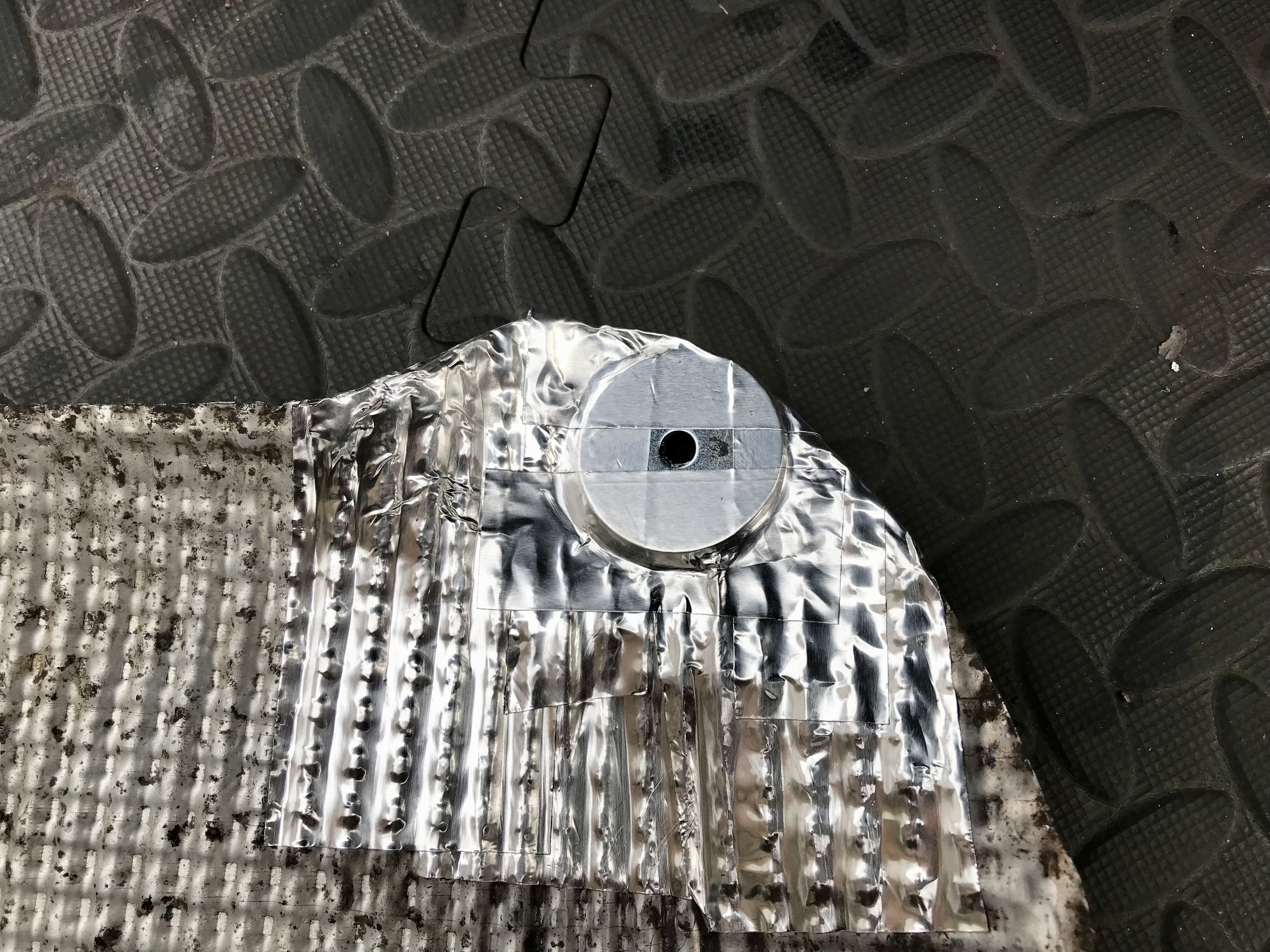

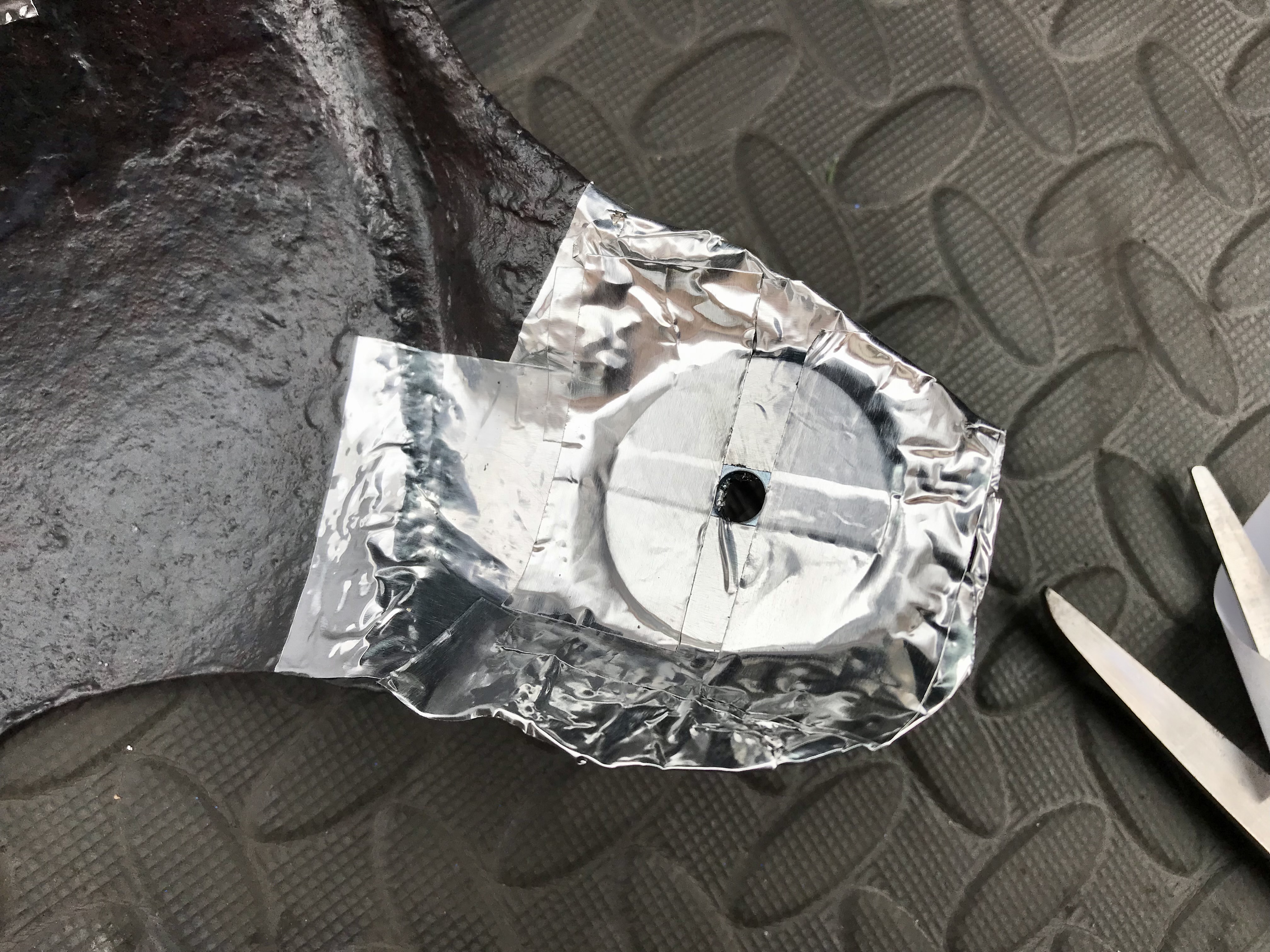

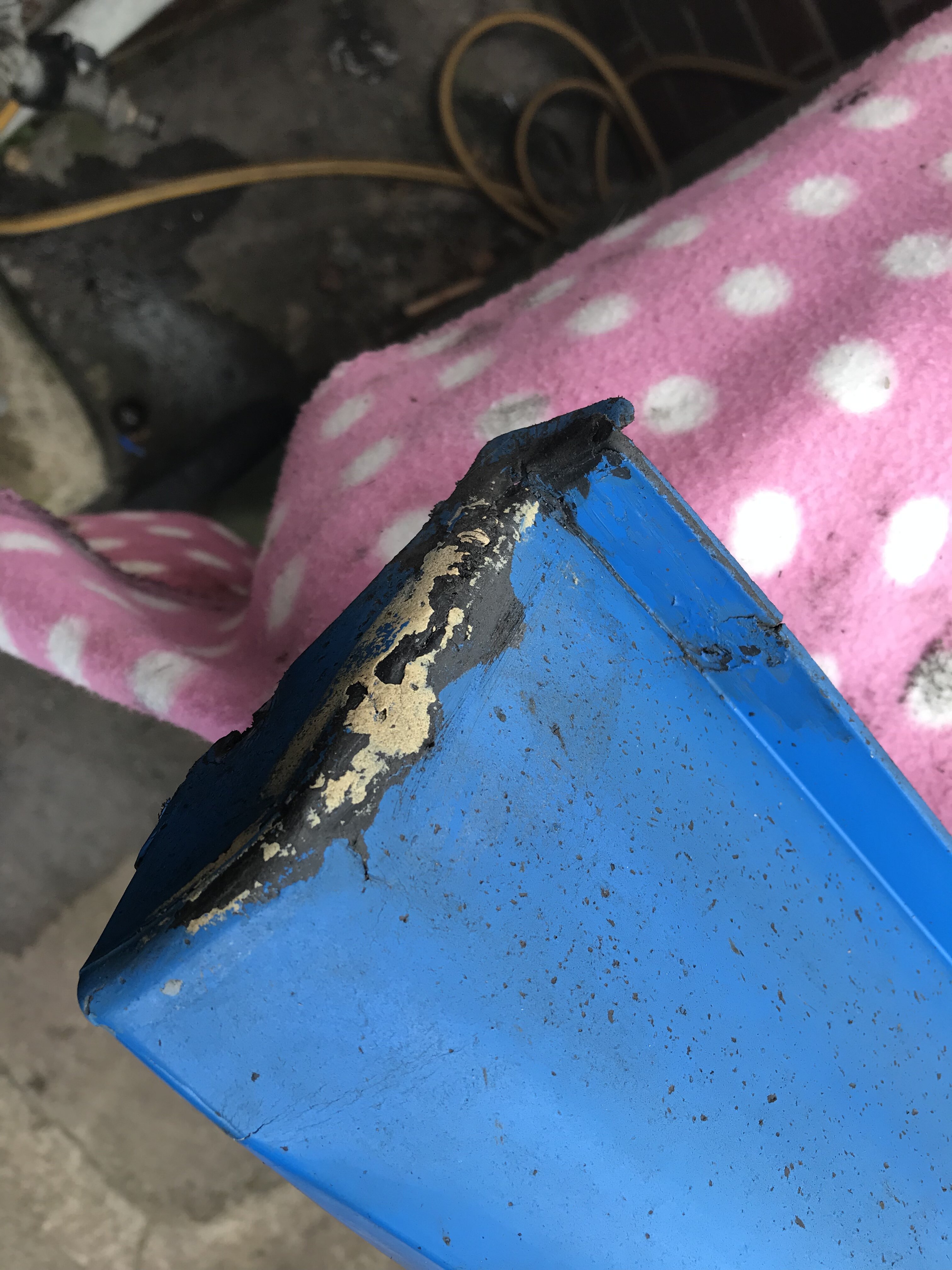

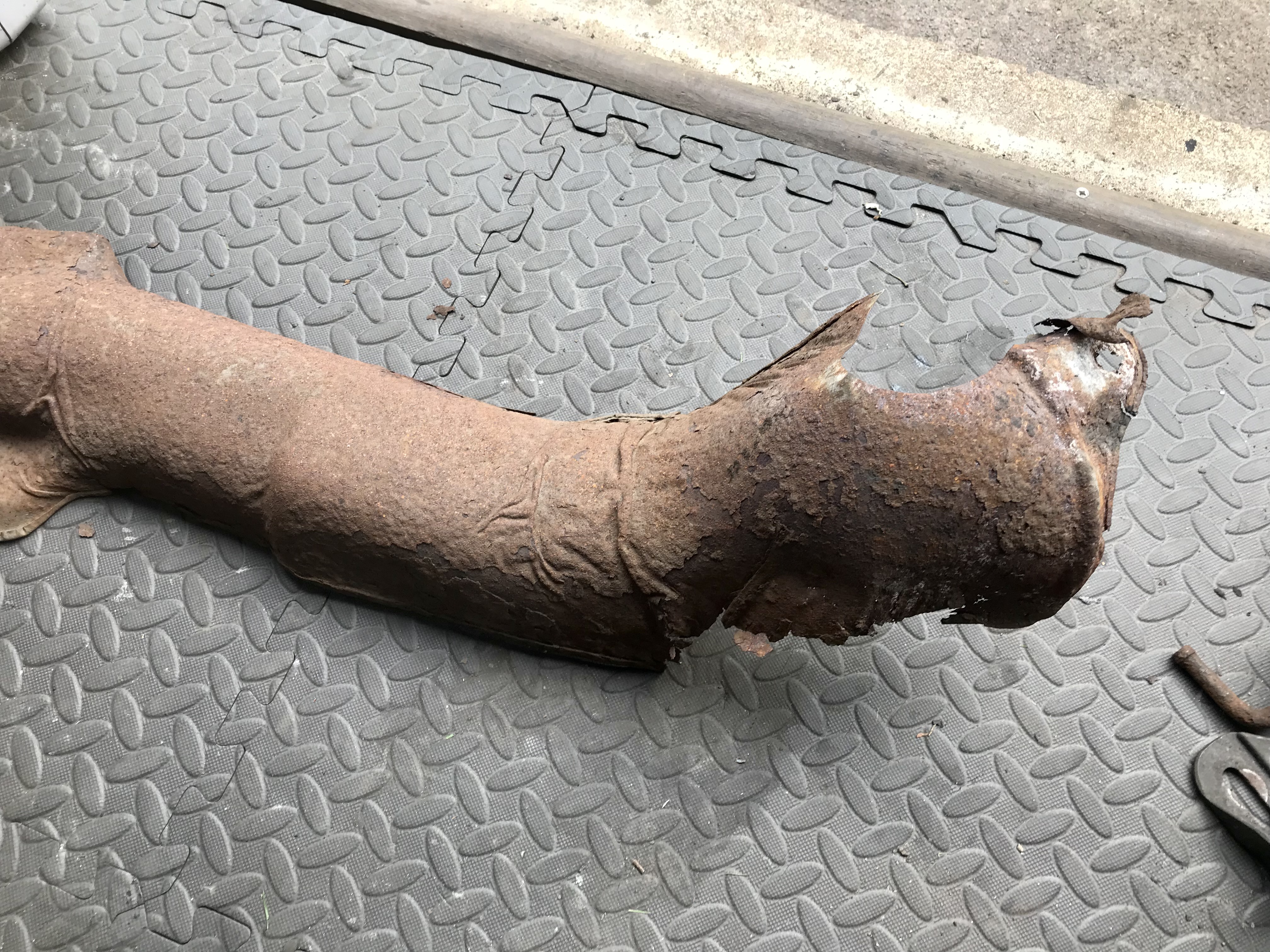

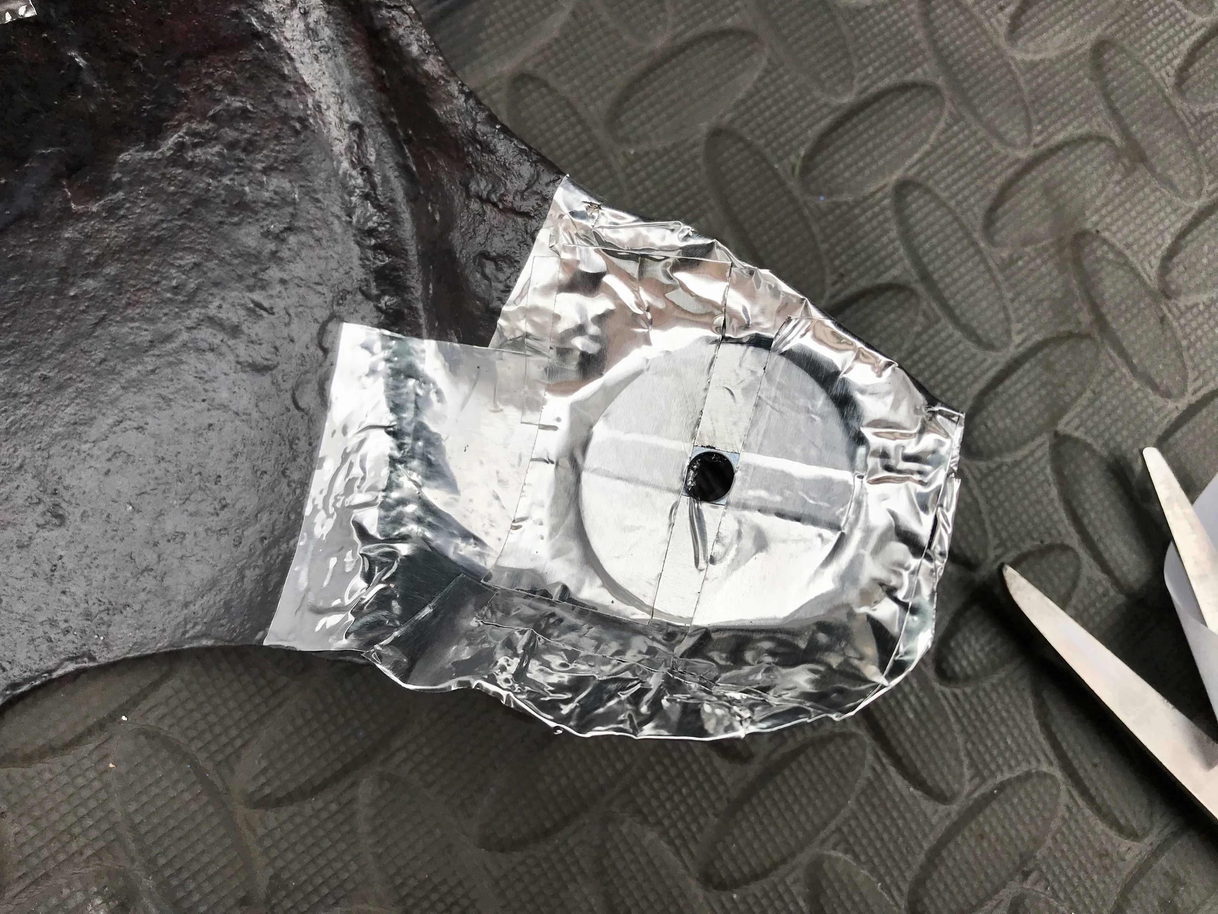

I then turned my attention to the heat shields. Crikey 😂😂😂 what do I do with these. Sadly I can’t buy new or find any decent second hand ones, so will have to try and repair for now.
The weevils have definitely had a feast. Still, I’ll do what I can.
The really rusty one was so crusty I didn’t dare take it off as it would have completely crumbled. So I gave it a few good coats of hydrate-80 which put a nice sticky skin over it and also made it feel a bit more solid.
Got some heat tape and some penny washers to rebuild the ends.
Ended up looking like this, which will have to do for now.
Tomorrow I’ll start to build it all back up.

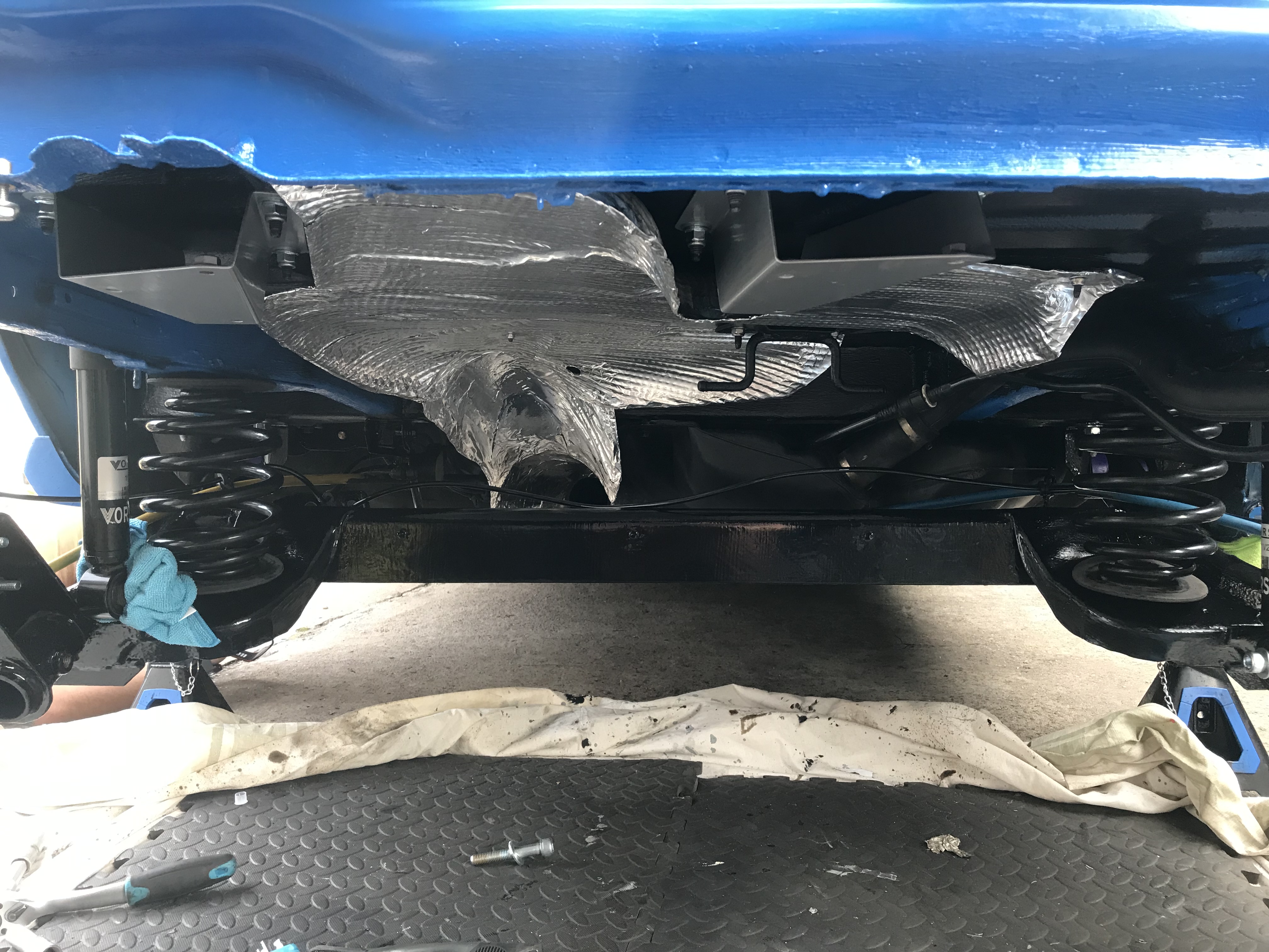

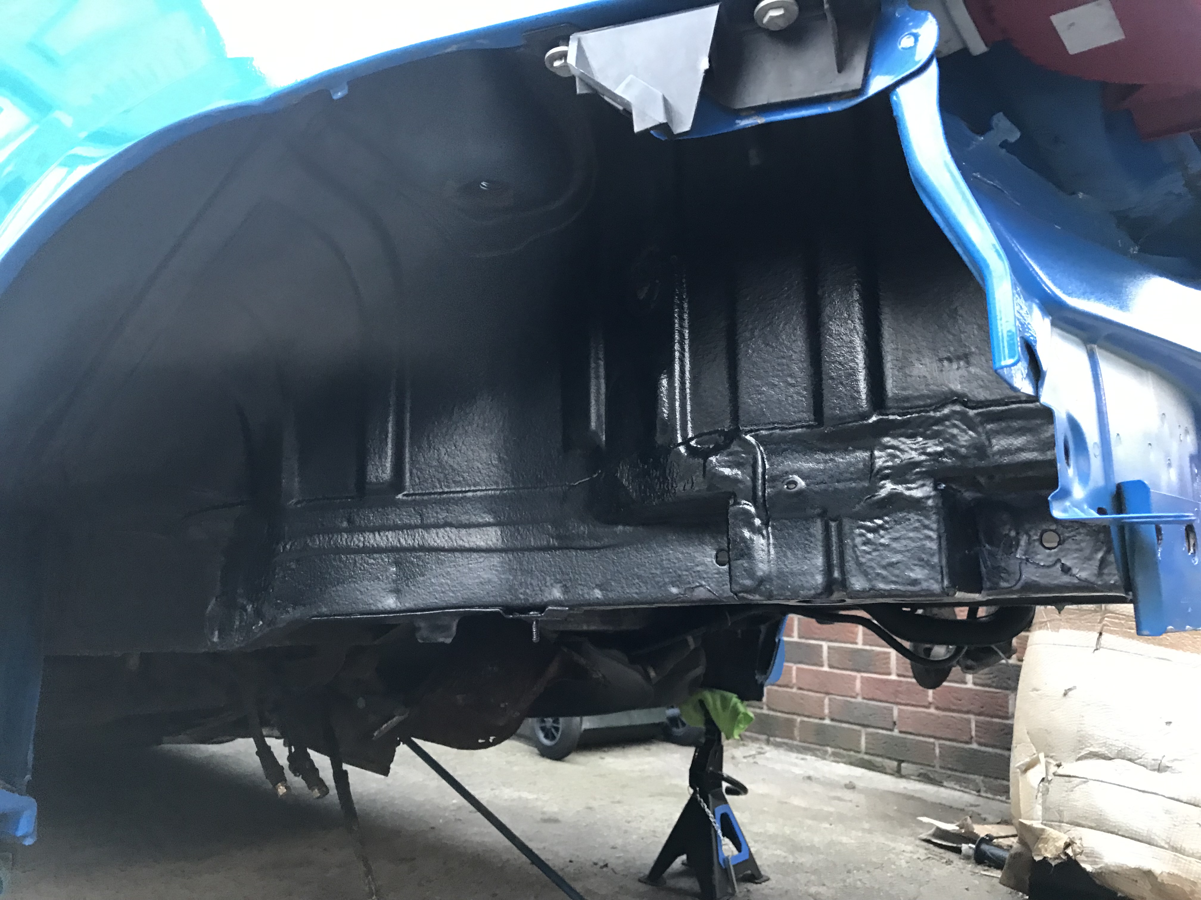

Another day of building everything back up and fixing a few issues along the way.

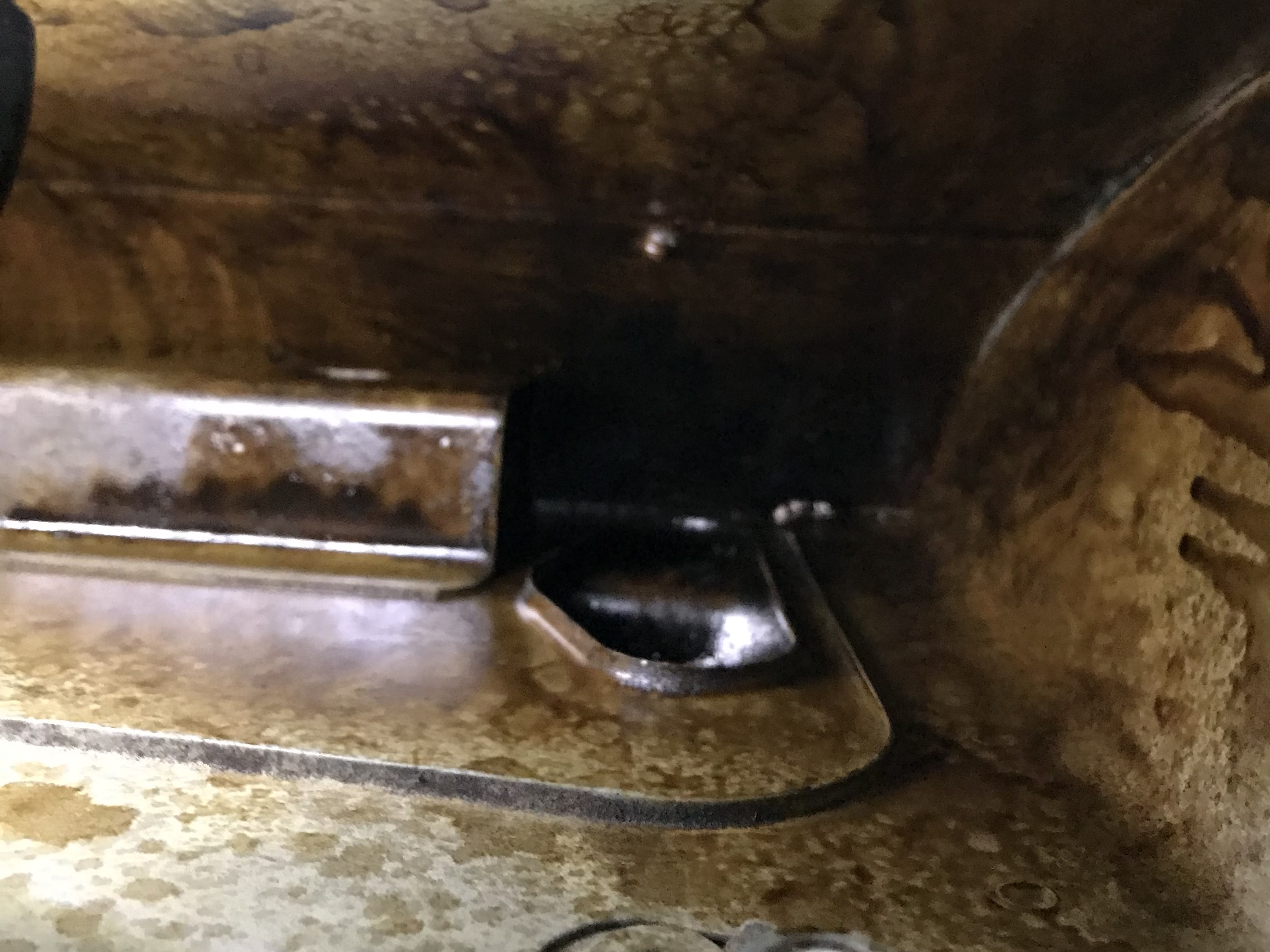

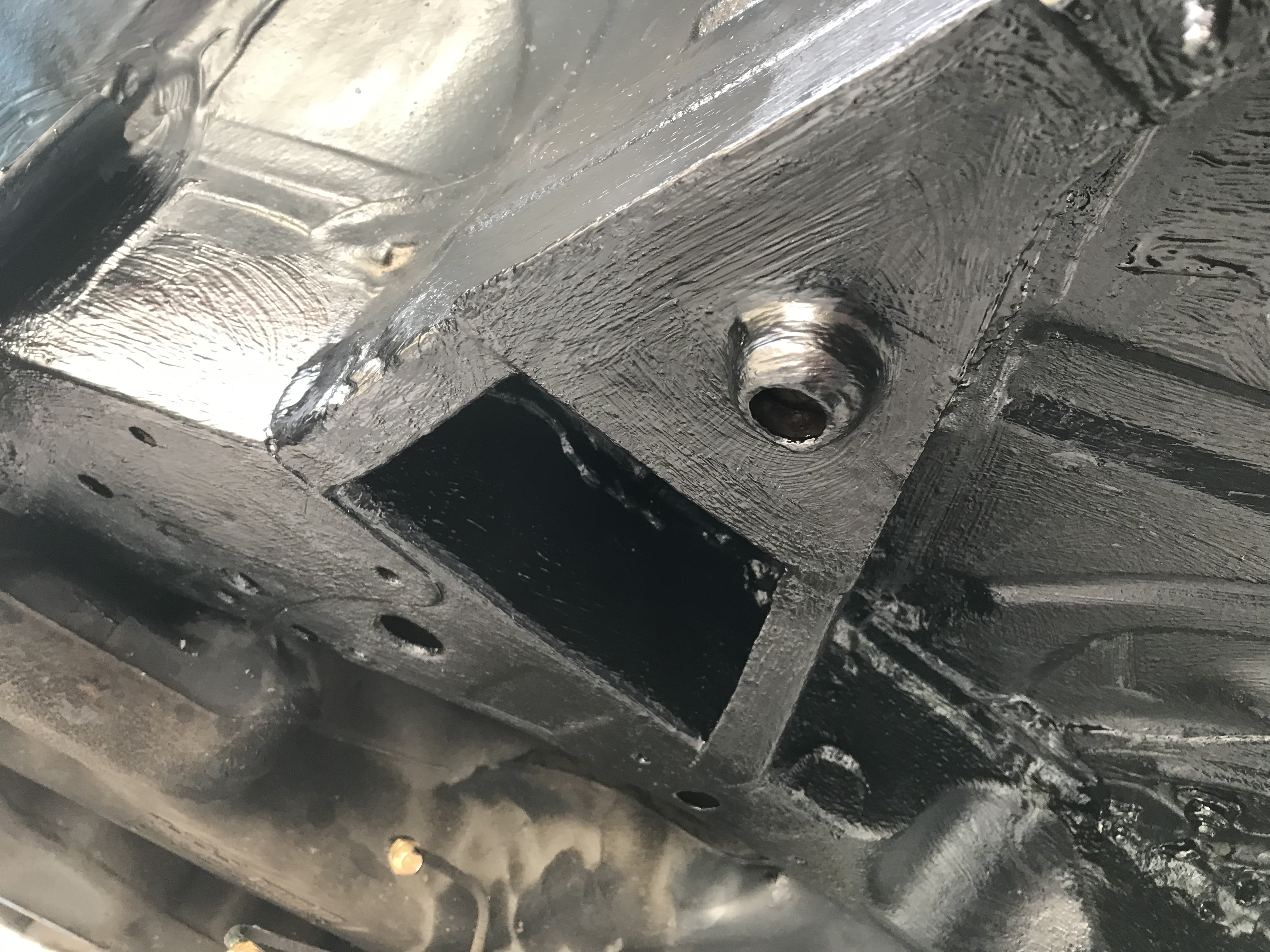

First job was to fill the cavities with Dynax-S50. Doddle to do but its messy stuff if you’re not careful.
Finished up by resealing with heat tape.

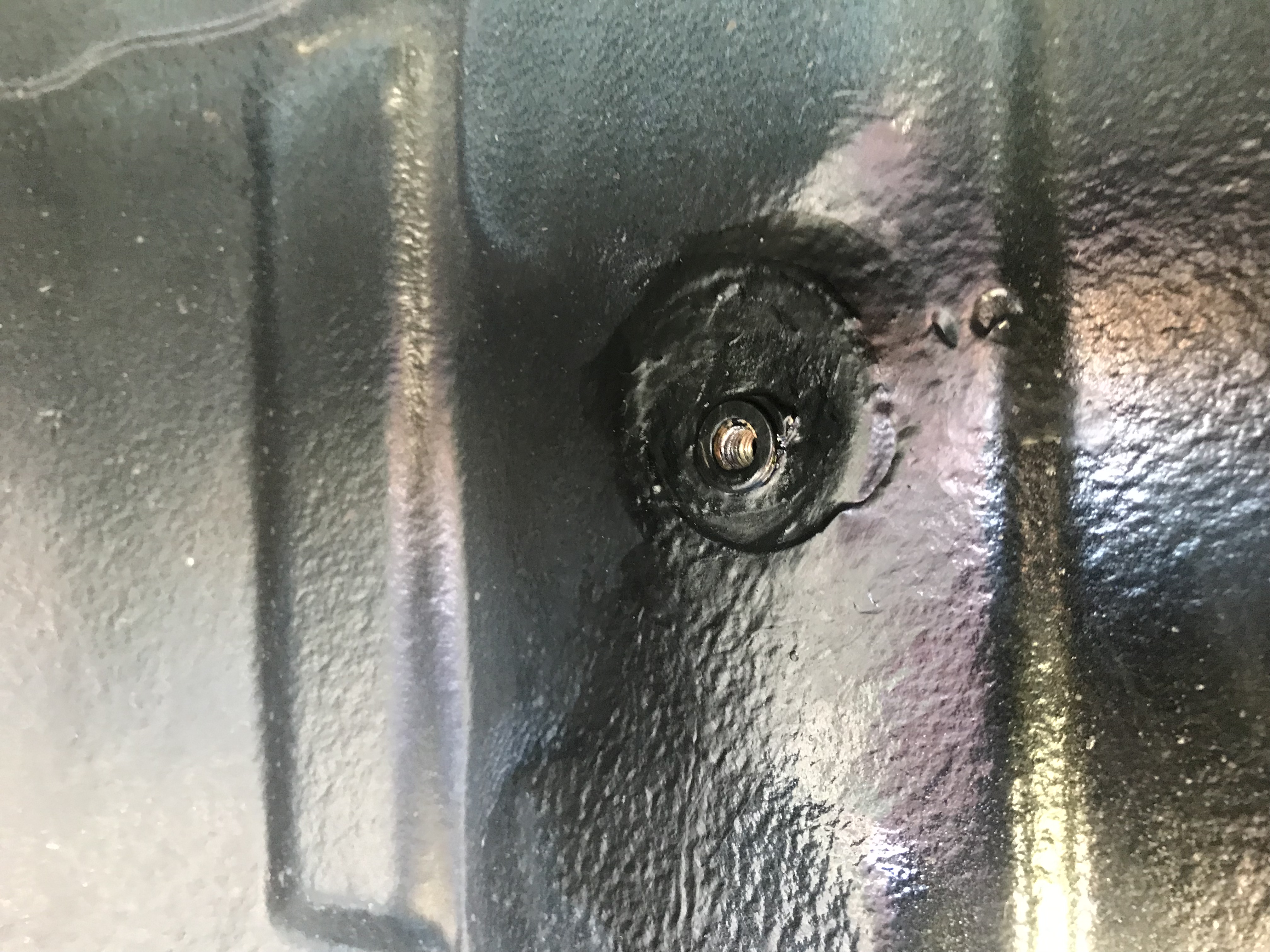

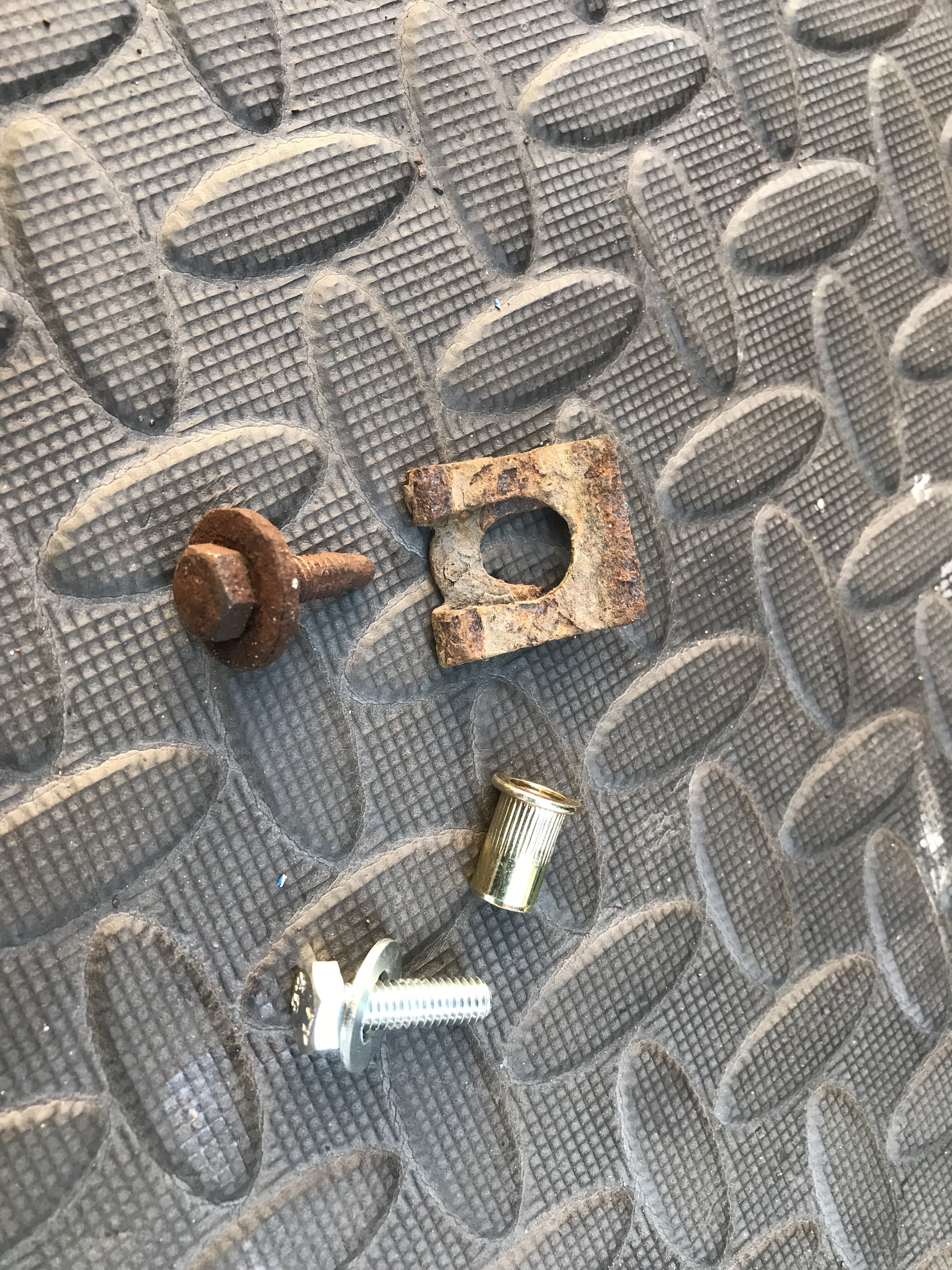

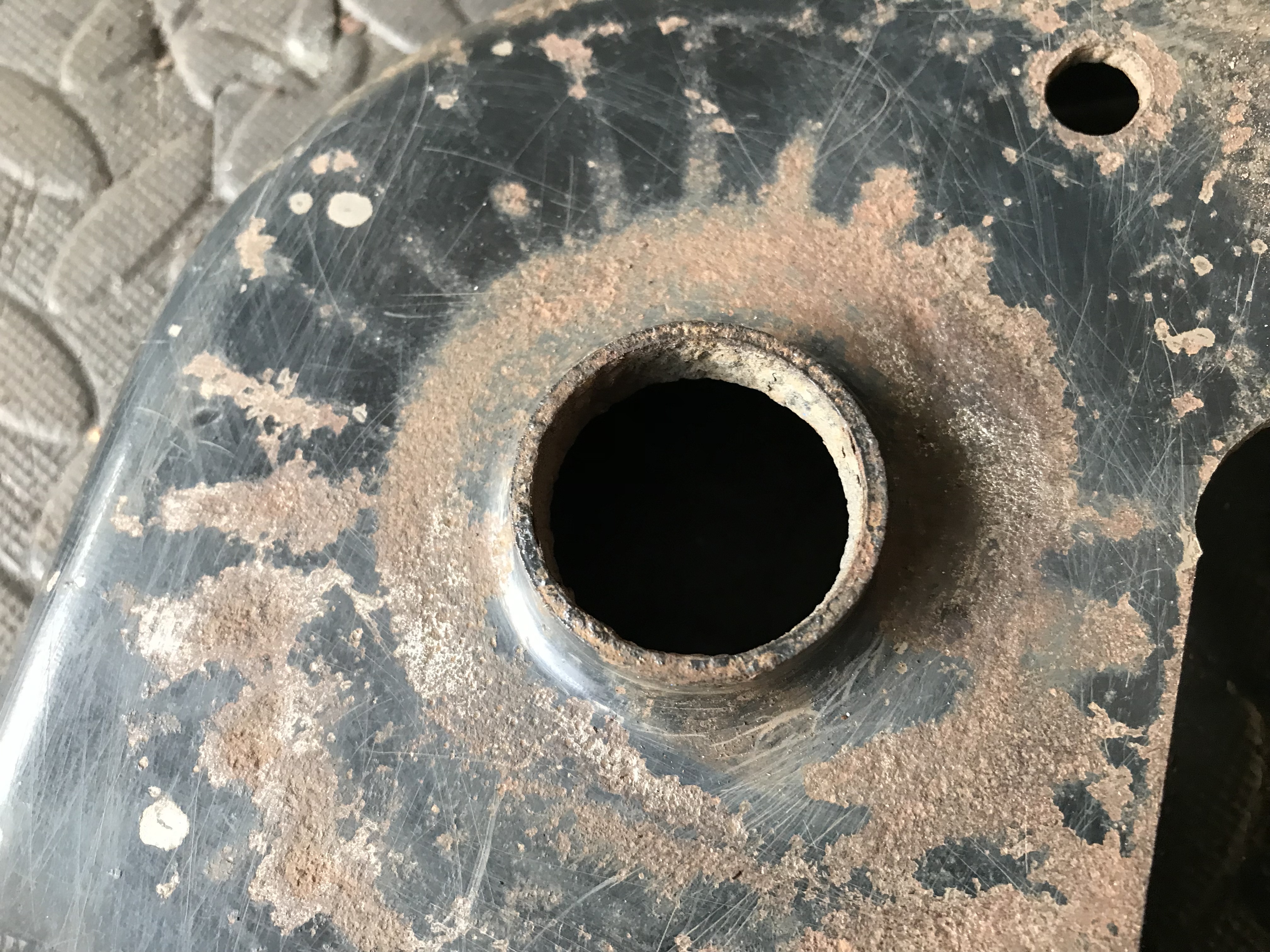

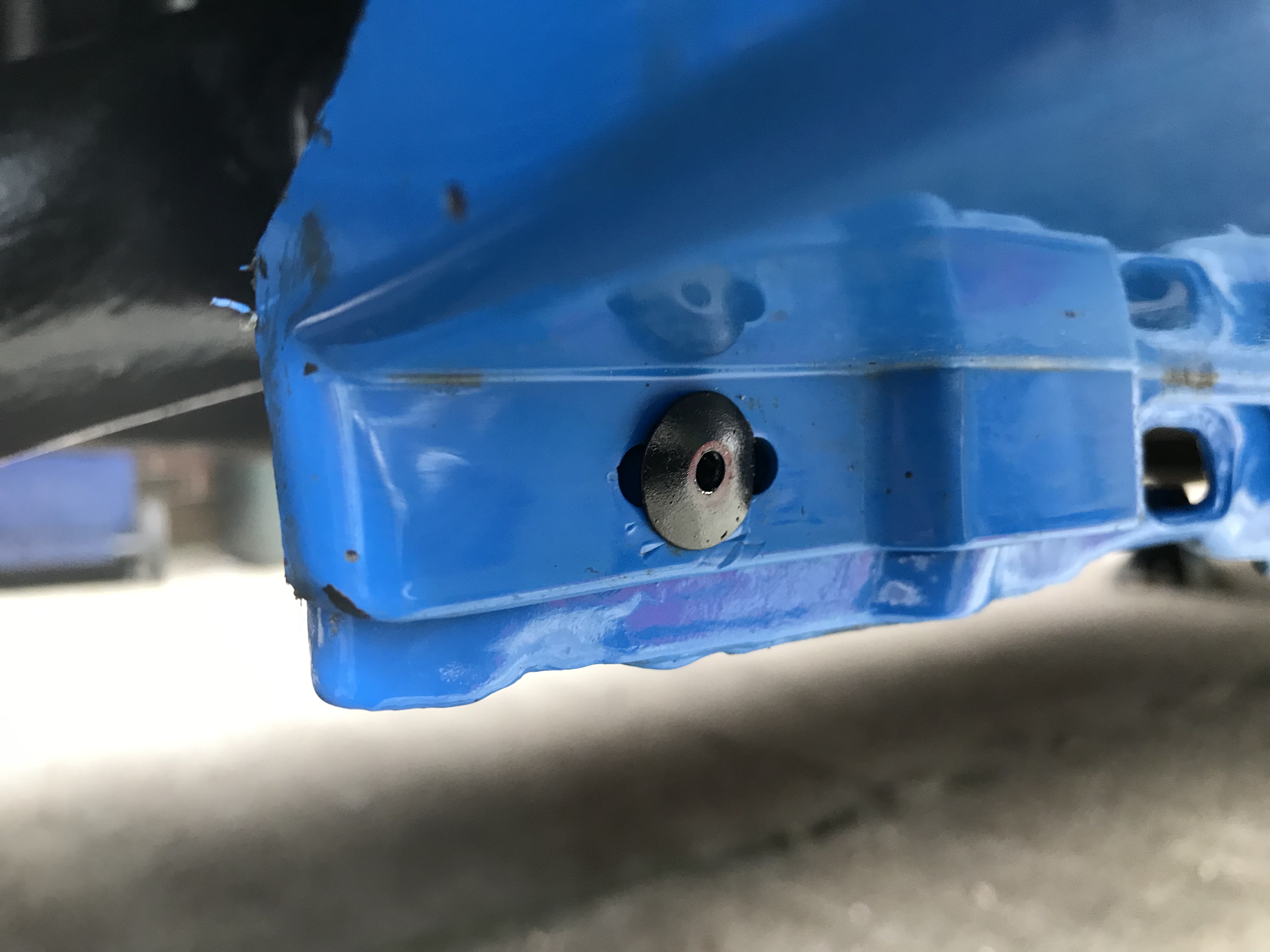

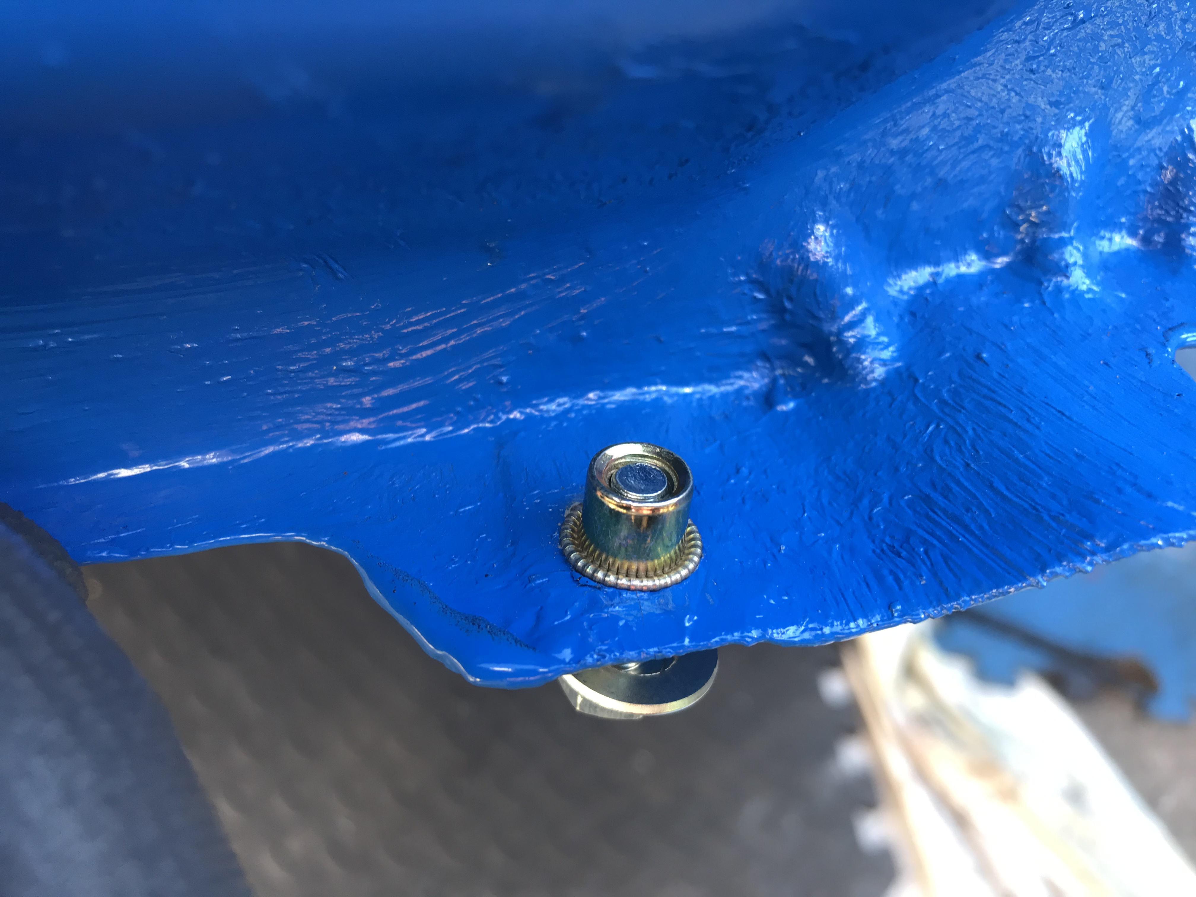

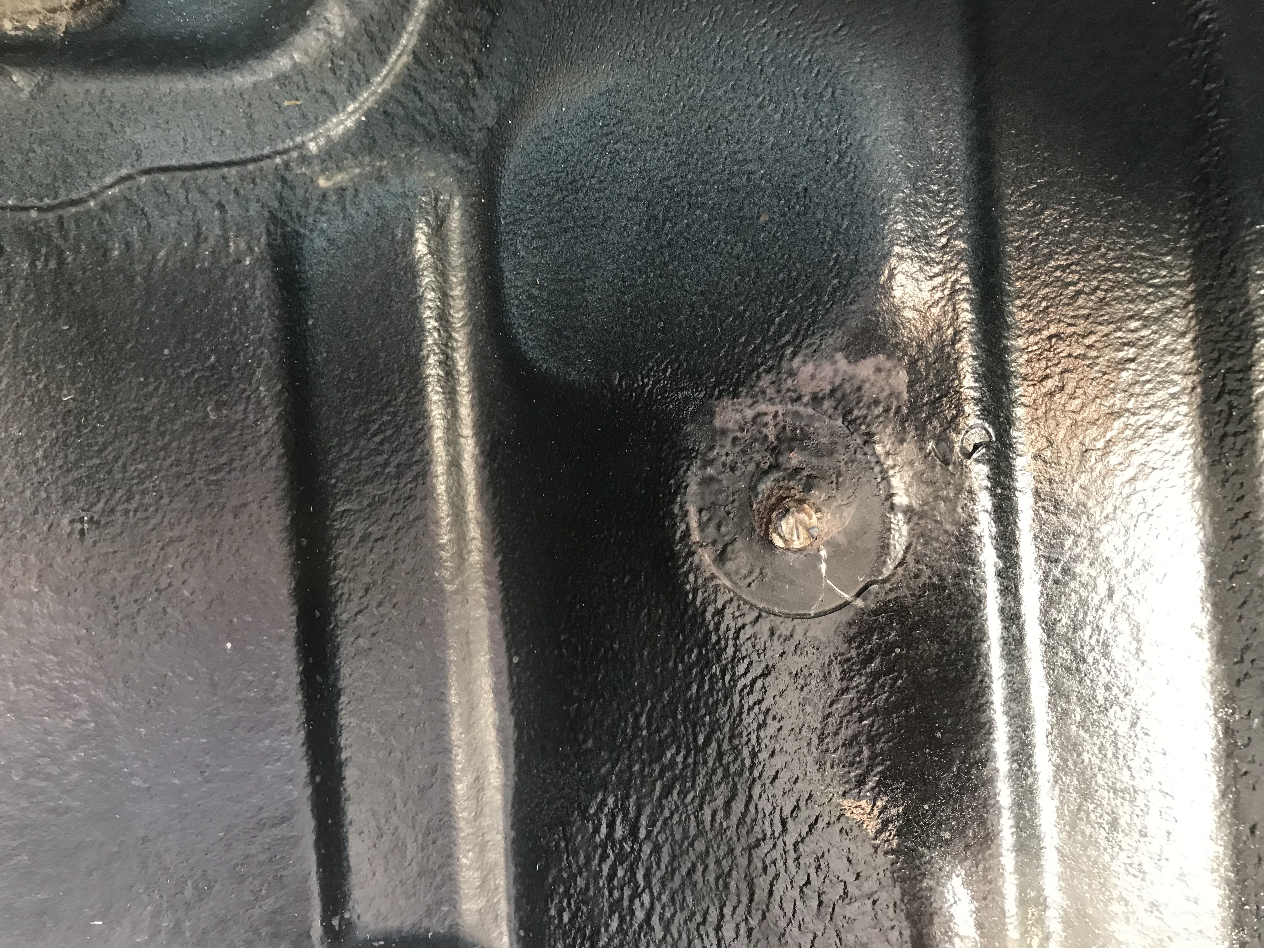

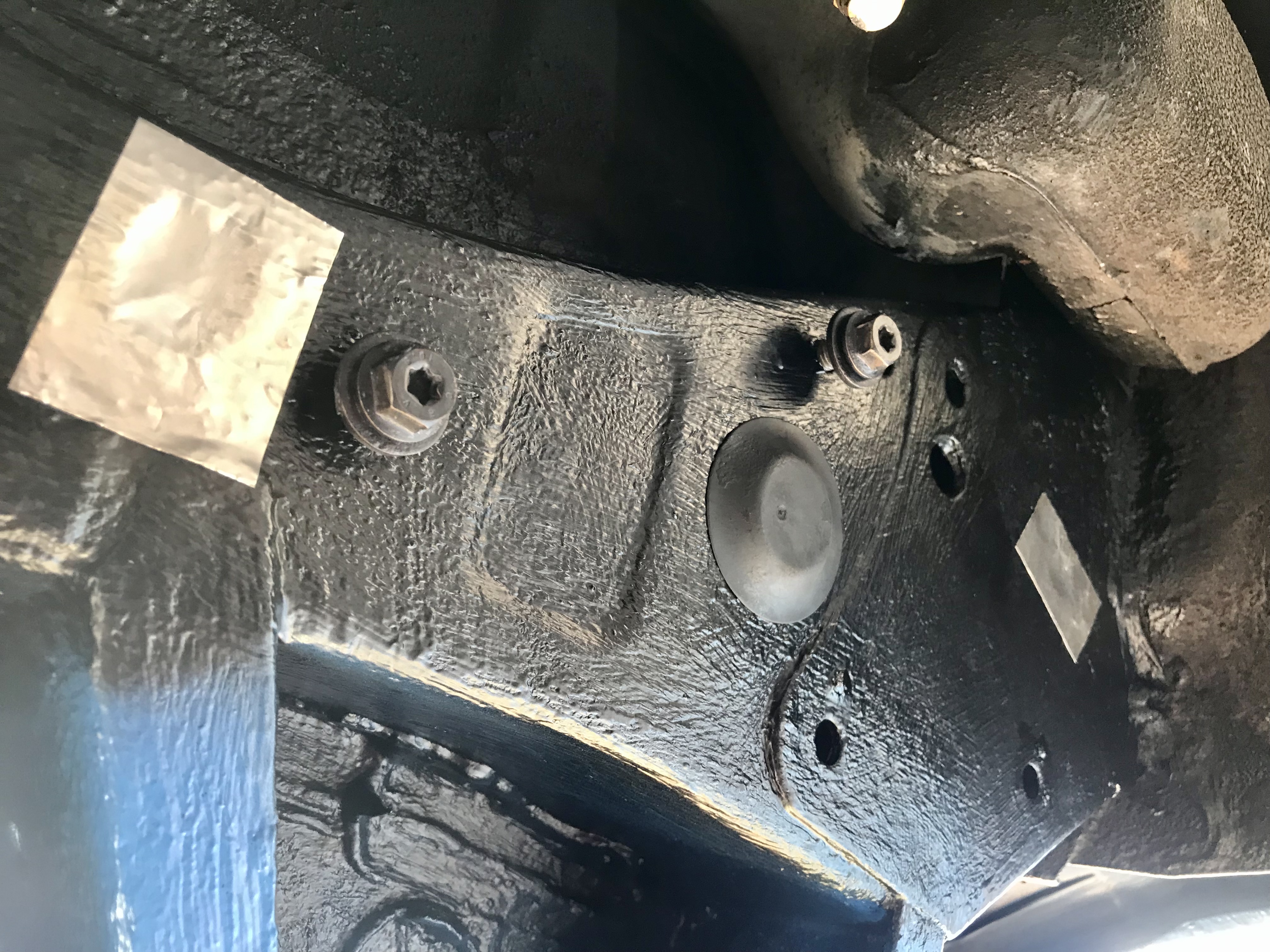

Next up was to repair the stud which holds the rear inner arch liner. It invariably snapped when trying to remove the nut.
Ground the remaining stump down and stuck a rivet nut in. Job done!
Whilst I had the rivet gun out I stuck a couple more where the rear bumper affixes as the old clip was shot.

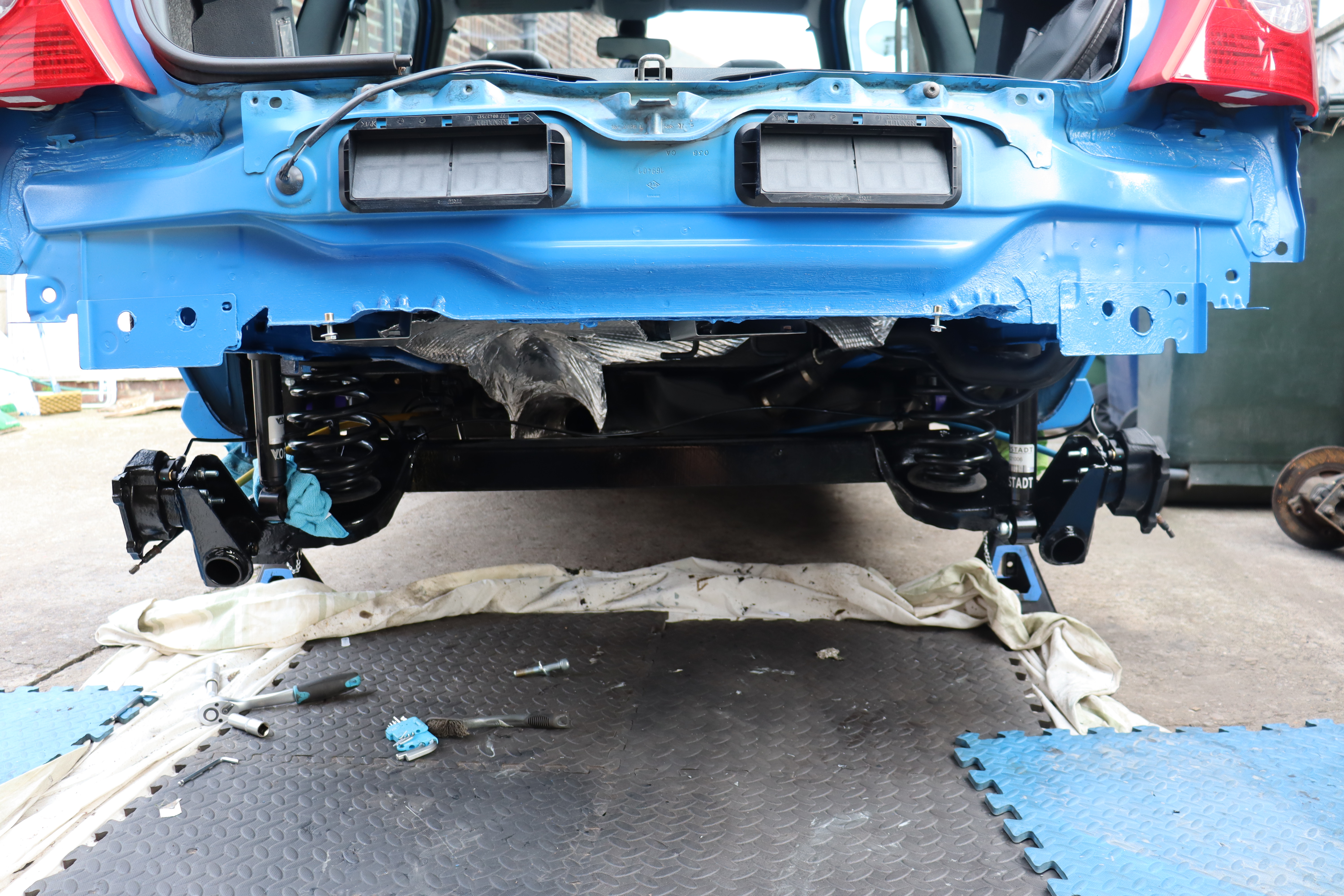

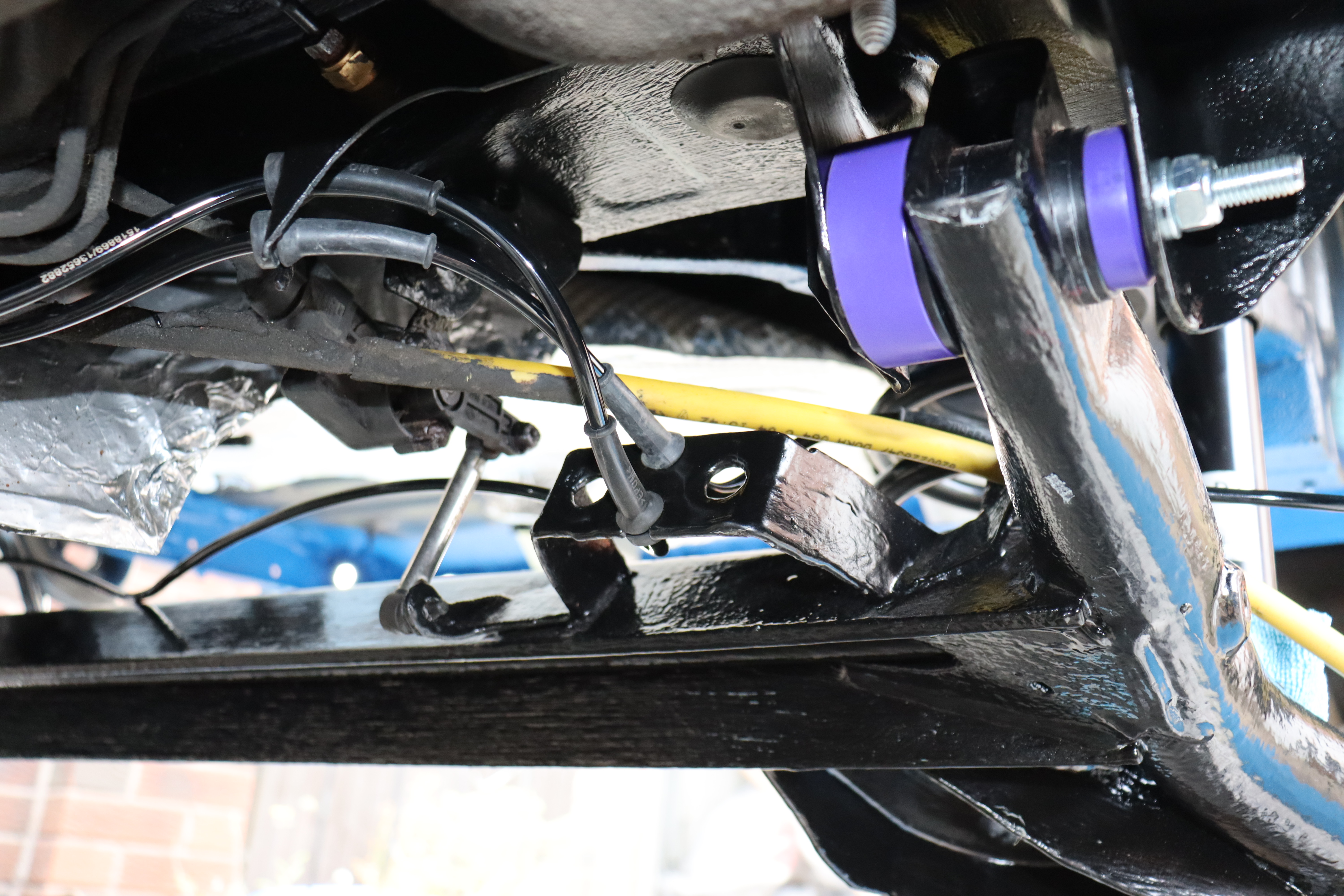

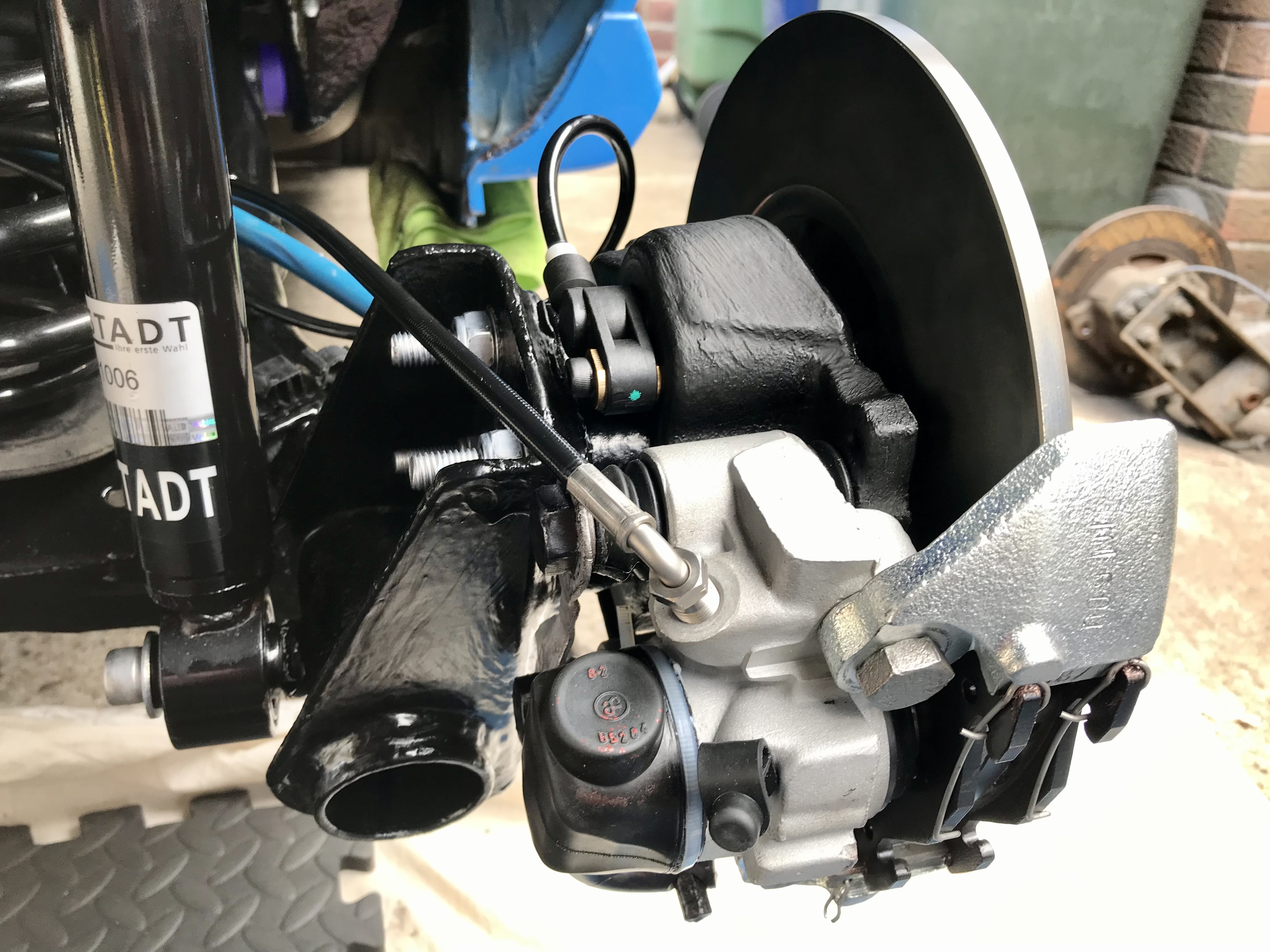

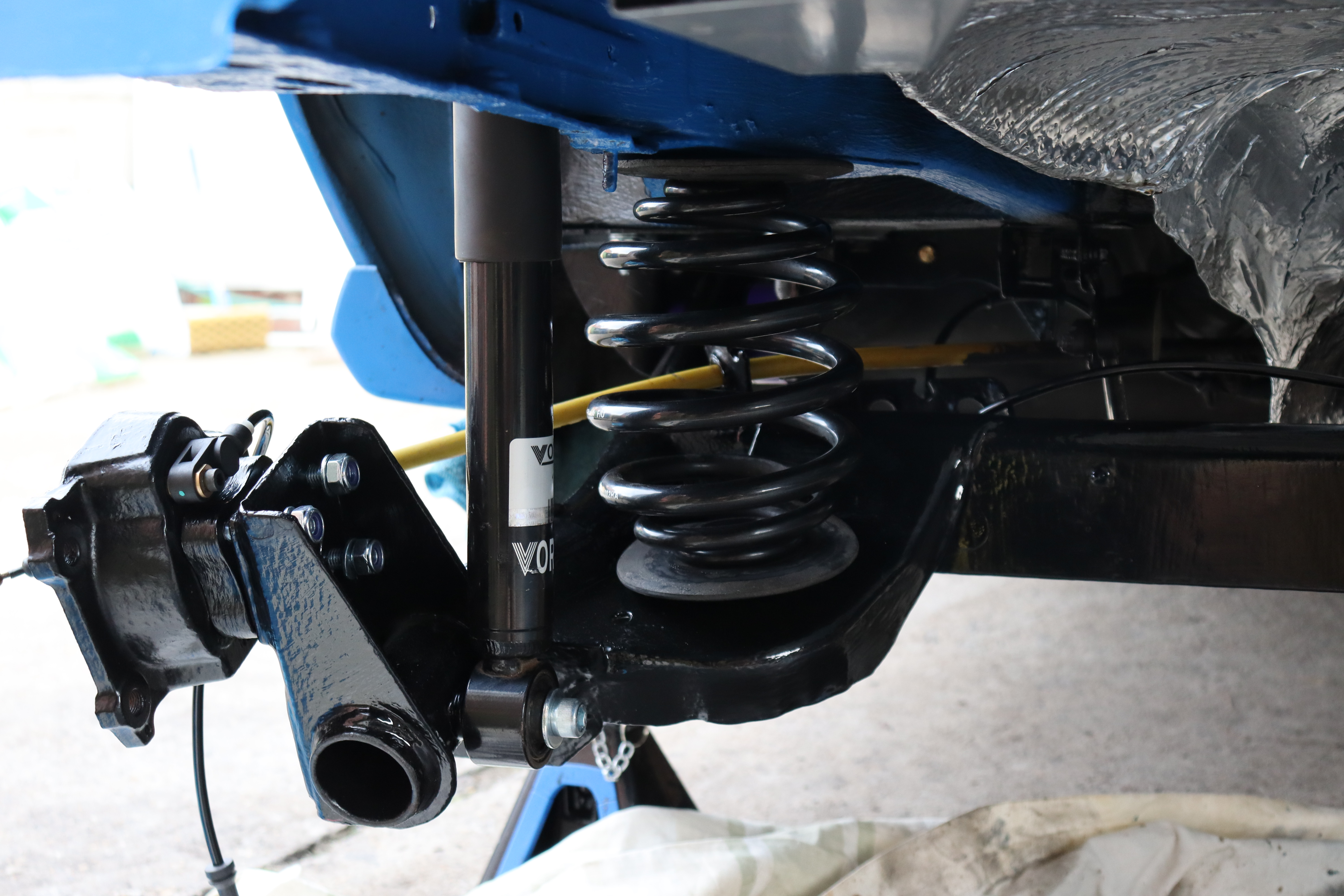

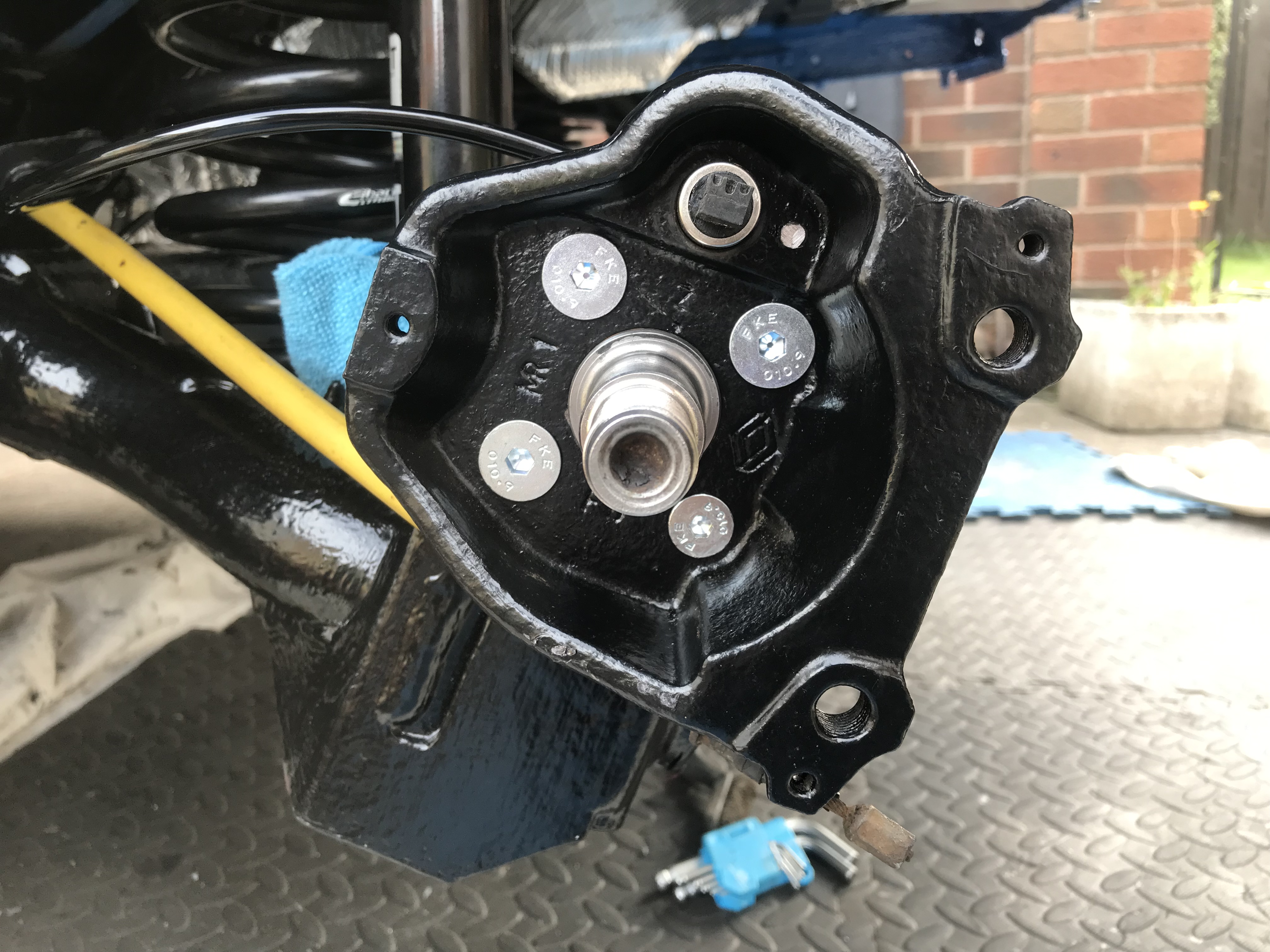

Got the refurbished beam back on, exhaust hanger brackets, hubs and ABS sensors.
The springs and dampers are being replaced with Cup versions as I don’t like the ride. Just waiting on a decent set of front springs, then I’ll refurb those then put it back to OEM.
Just the discs, pads and new brake lines to fit then just needs bleeding up and that’s it for this year.

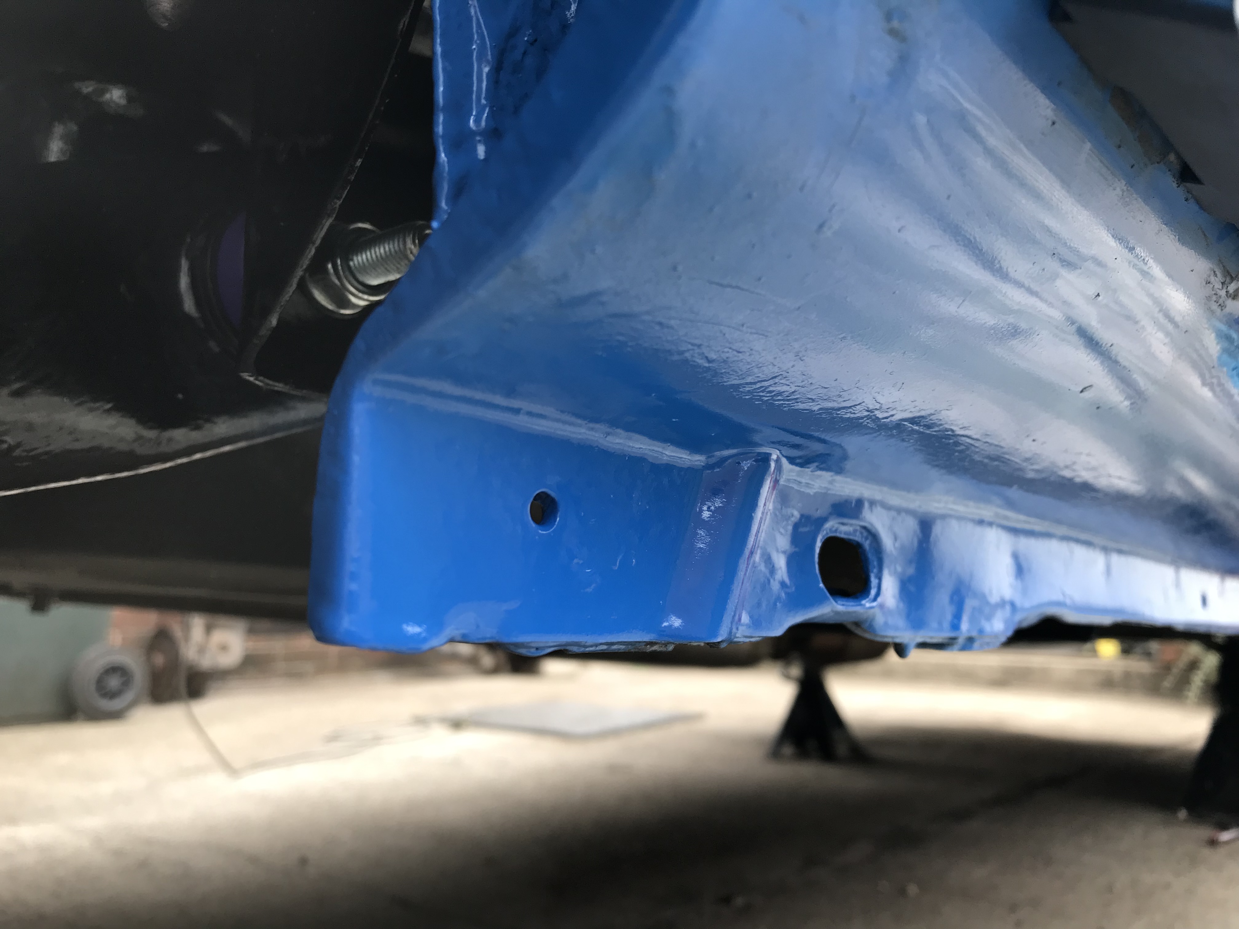

With the rear end now sorted I thought I’d take a quick look at middle section and see what I’m up against.

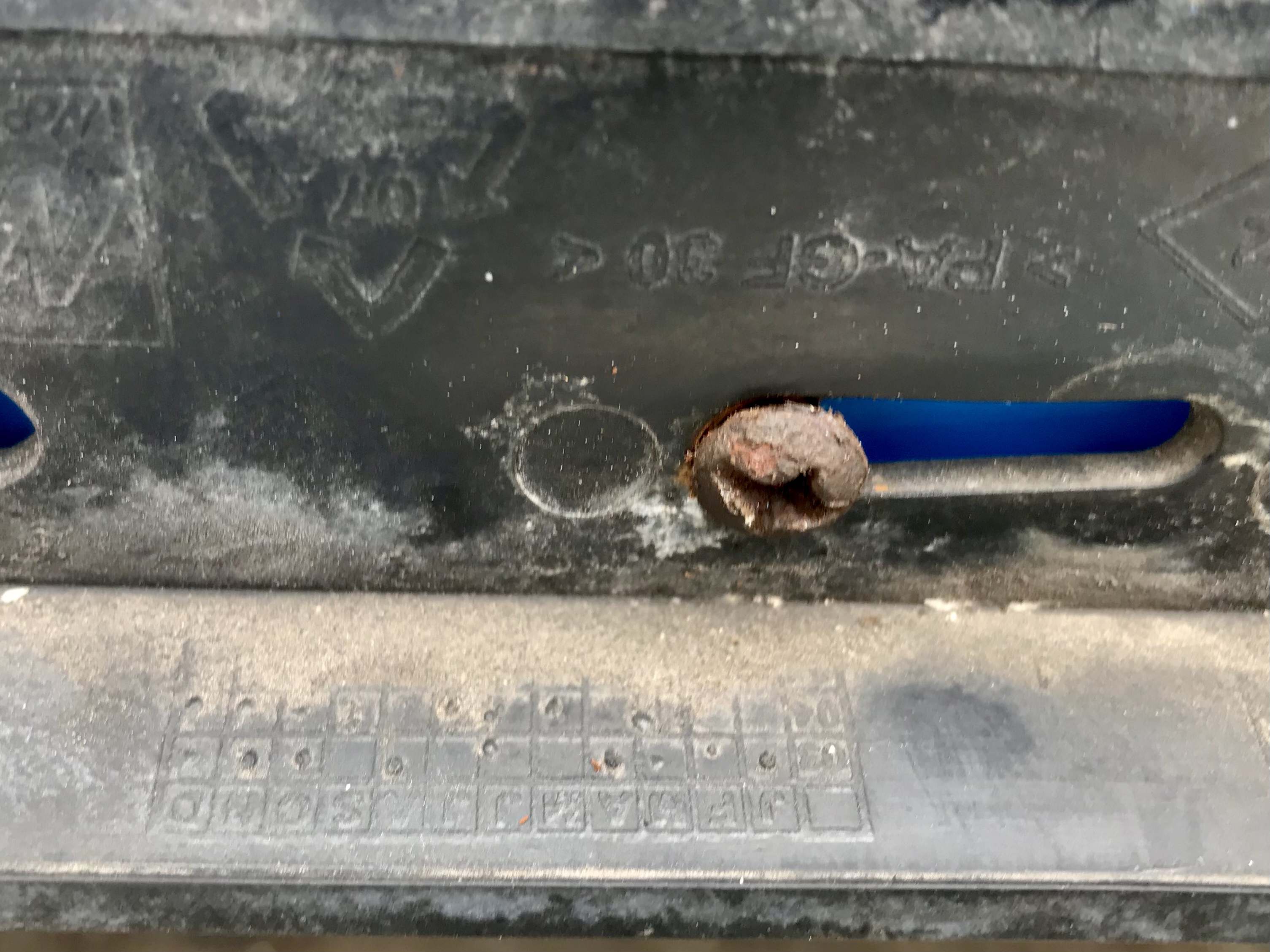

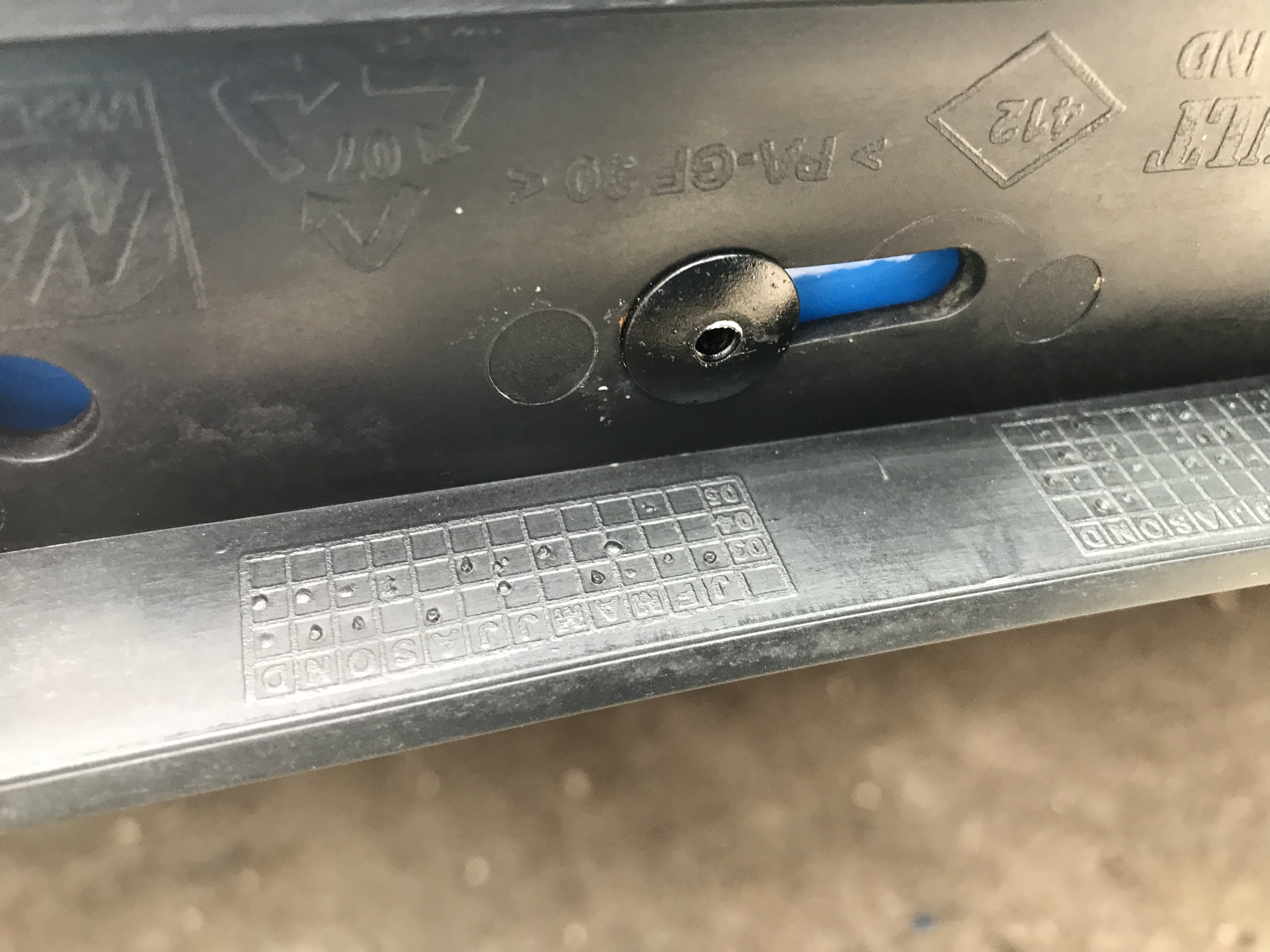

Started on the drivers side first. Hmmm might need a new side skirt by the looks of things.
It also looks like somebody’s been here before as the panel and bracket were held on with self tappers. The other side has original pop rivets. 🧐
We’ll soon fix that.

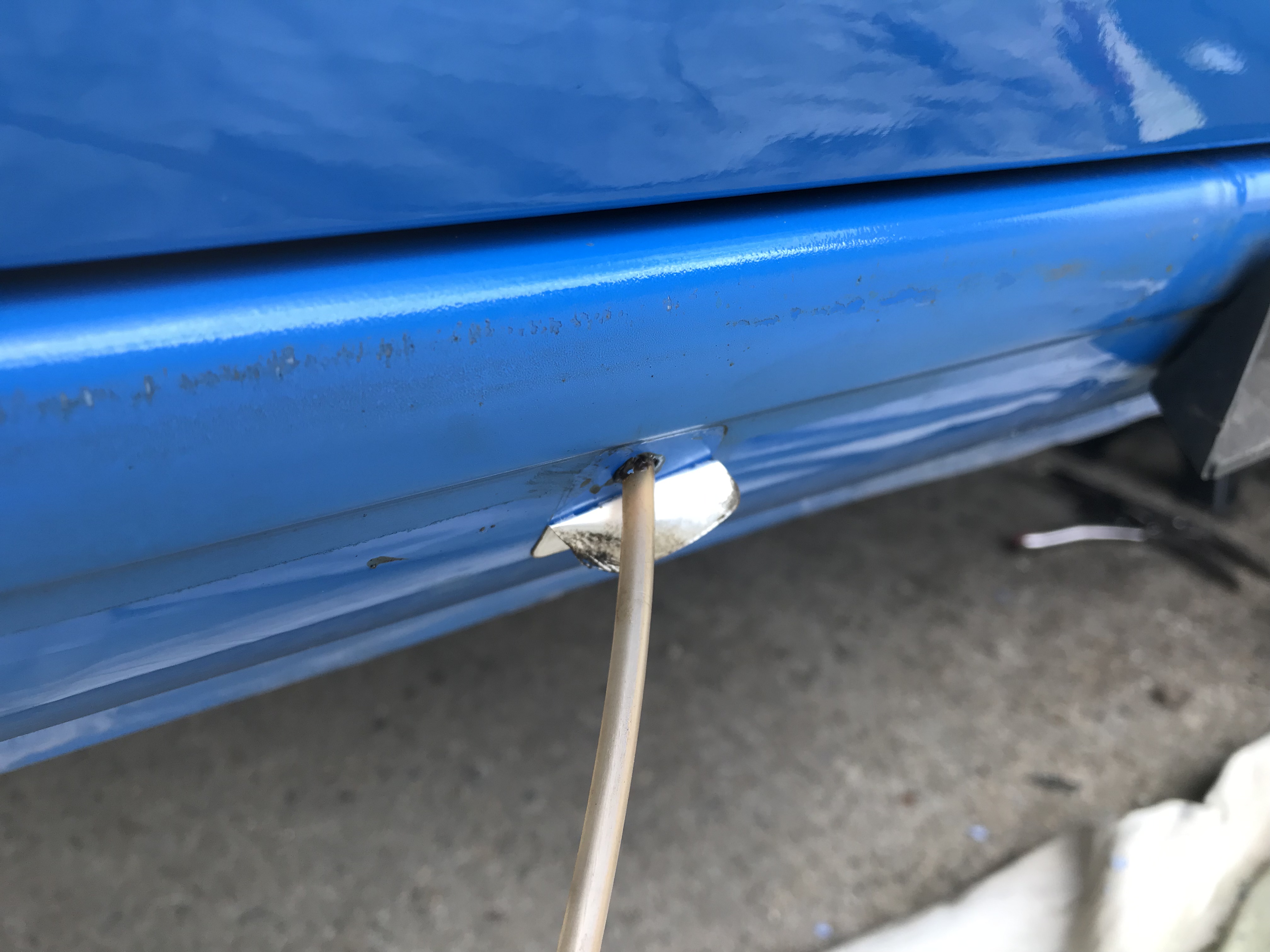

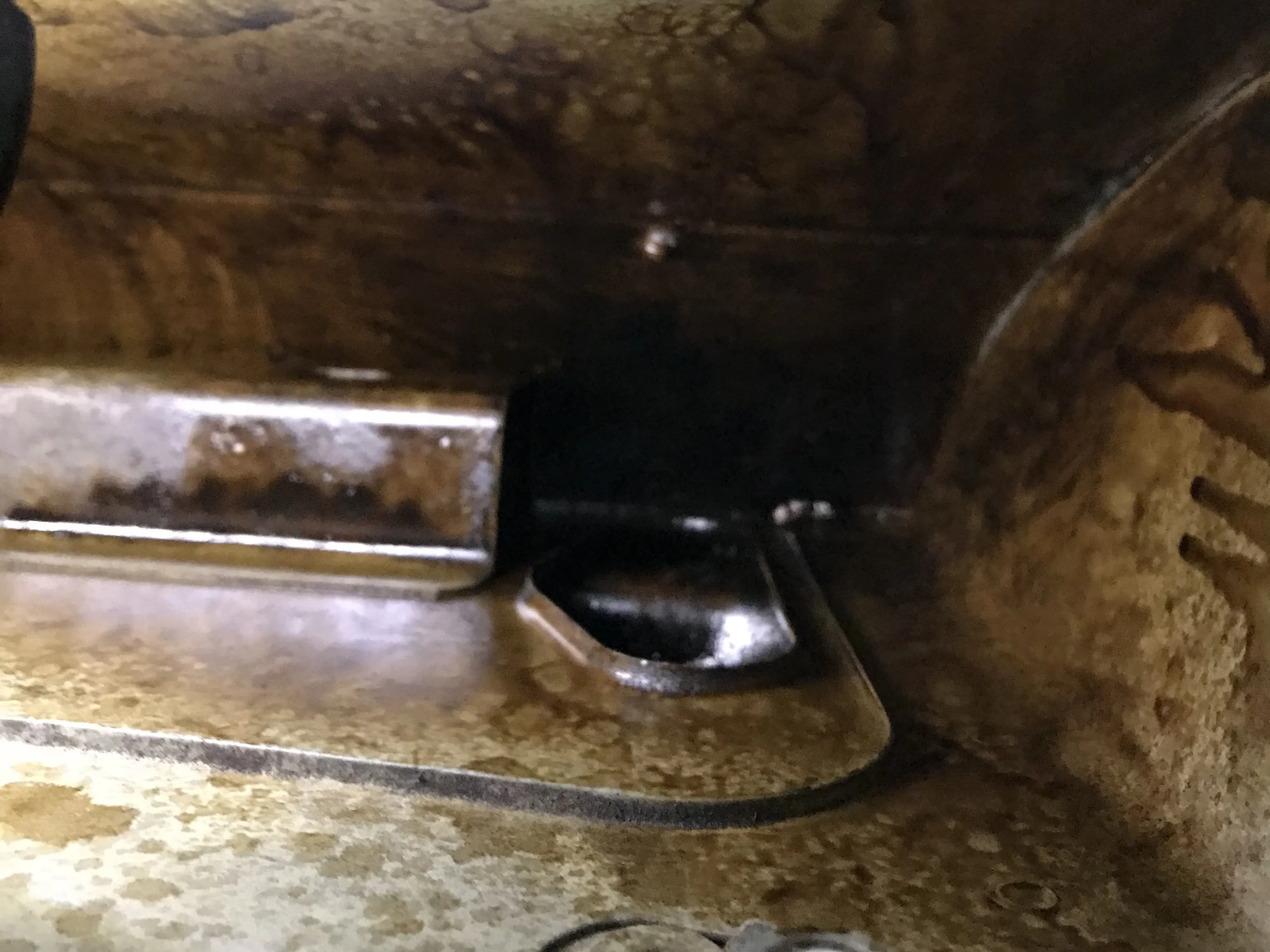

I gave the inner sill a good blast of S50 before realising I hadn’t checked inside the rear quarter panel.
Too late 🥴
Oh well. The panel and lower sill didn’t look that bad anyway and everything looked solid when I had the beam out, so whoever had the skirts off before must have done a good job.
I gave the rest of the lower sill a good clean up and a lick of paint to tidy it up. And put some proper pop rivets back in.

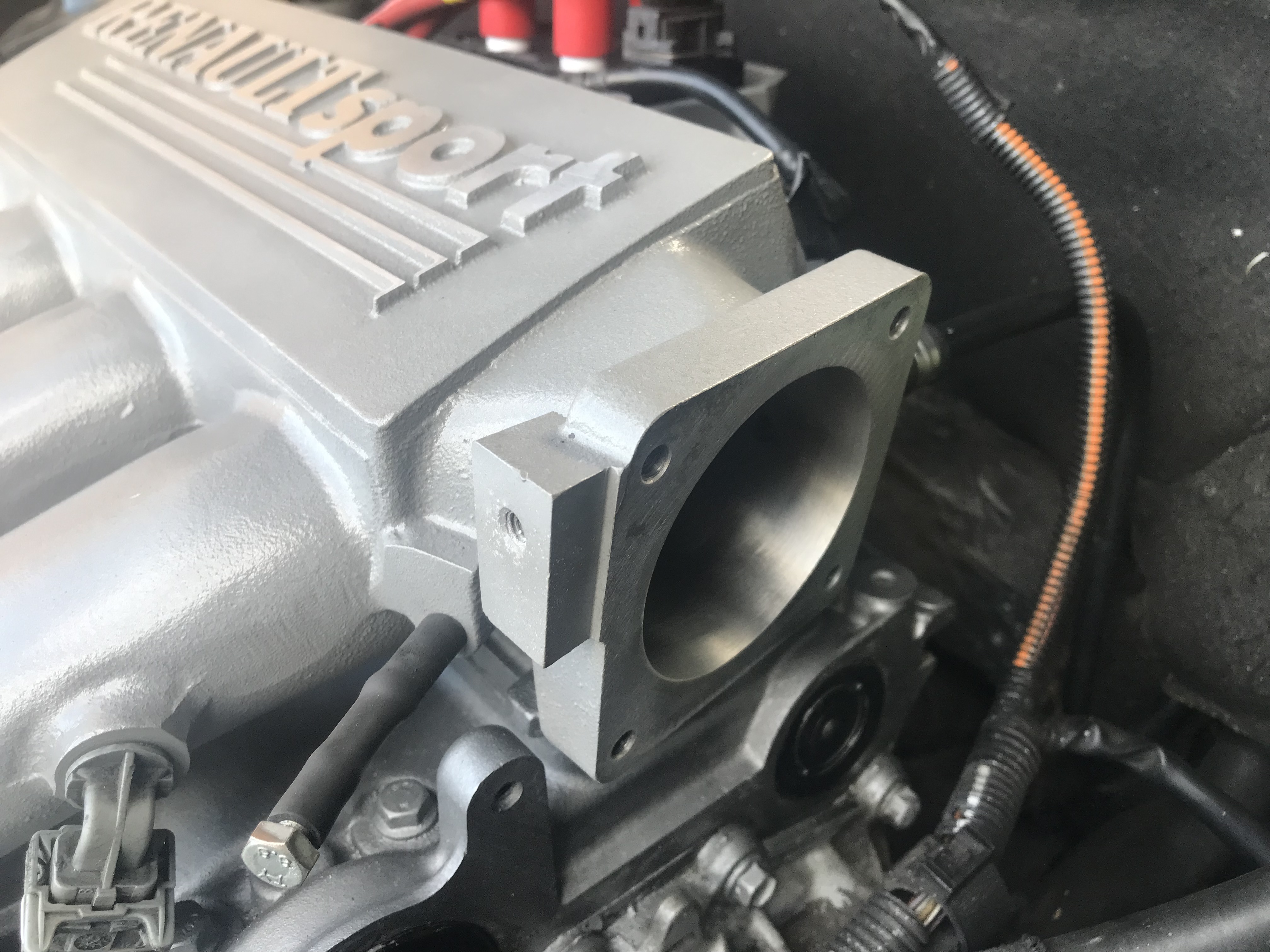

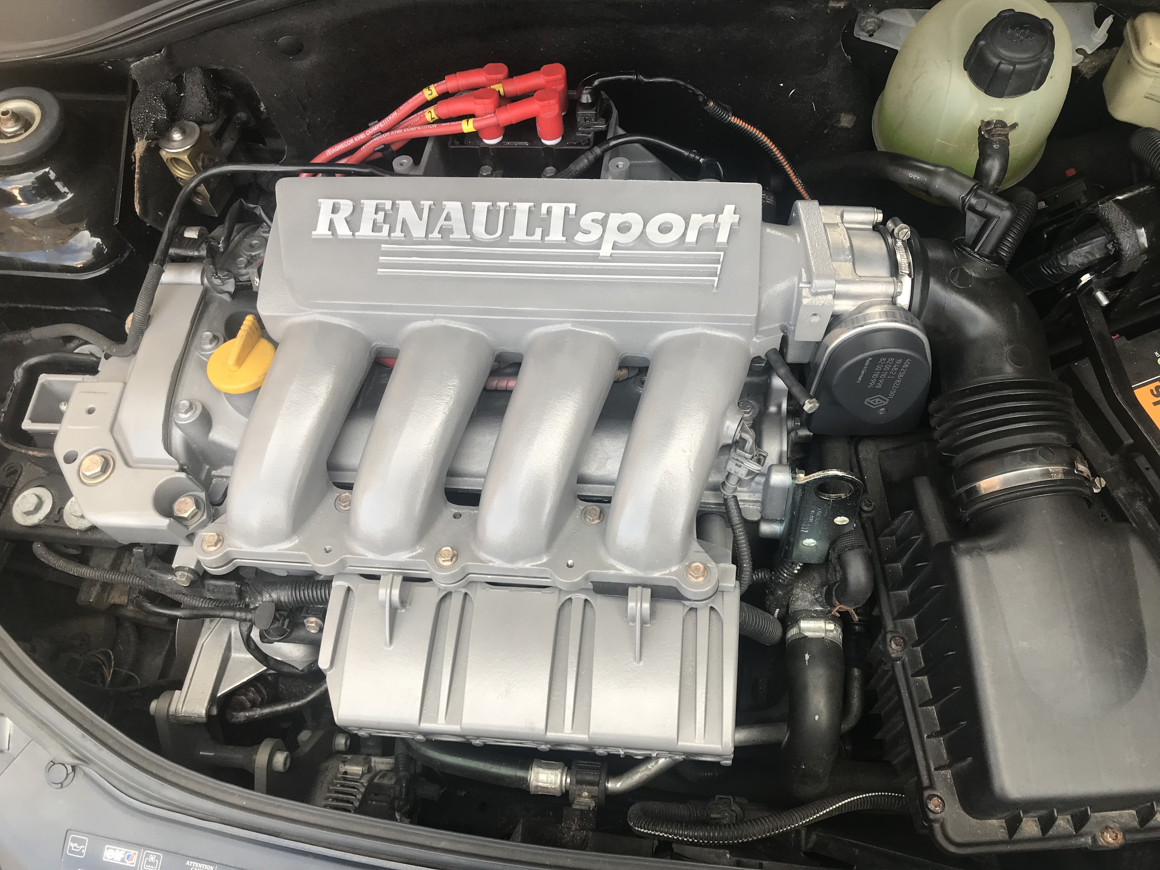

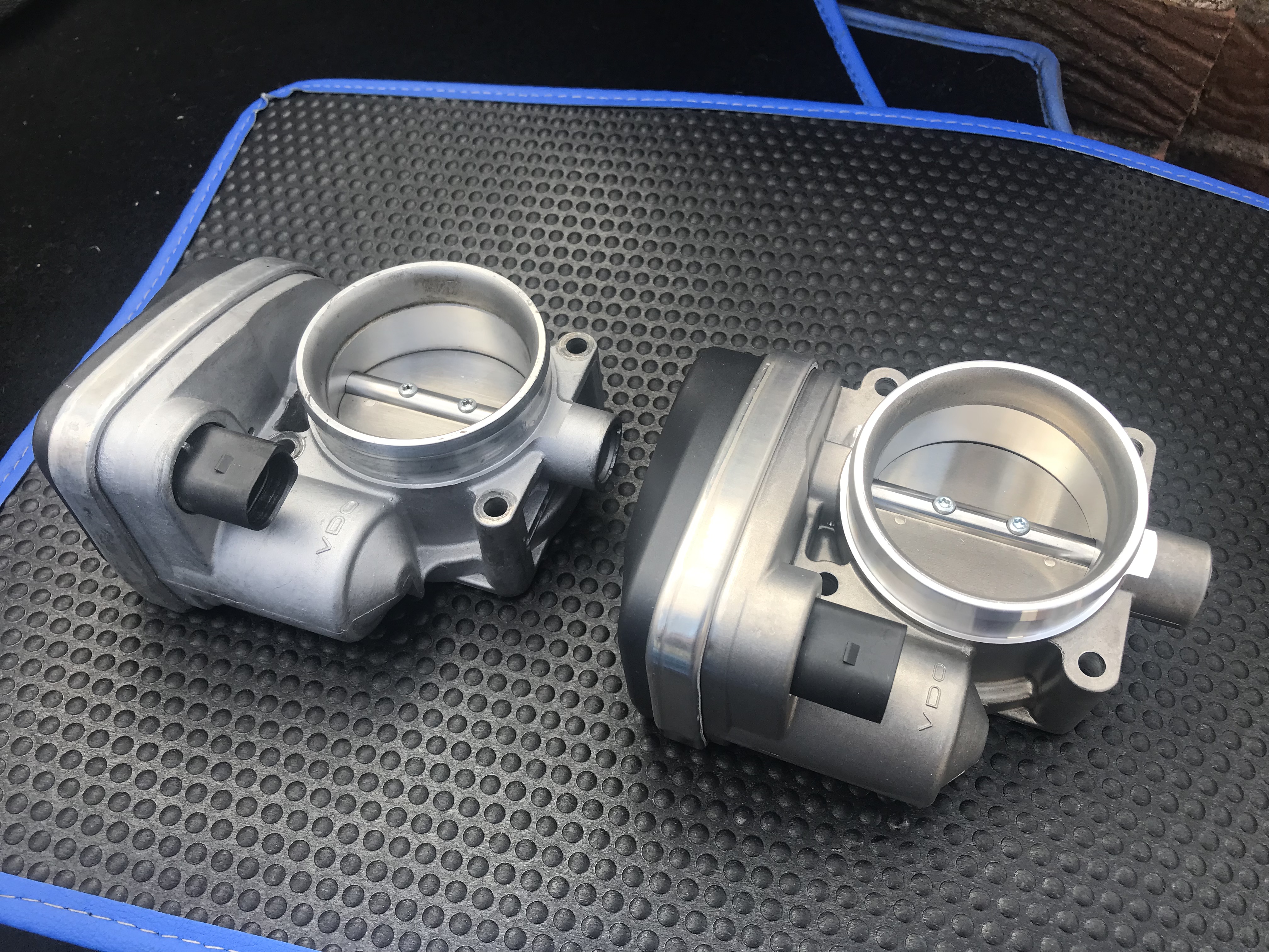

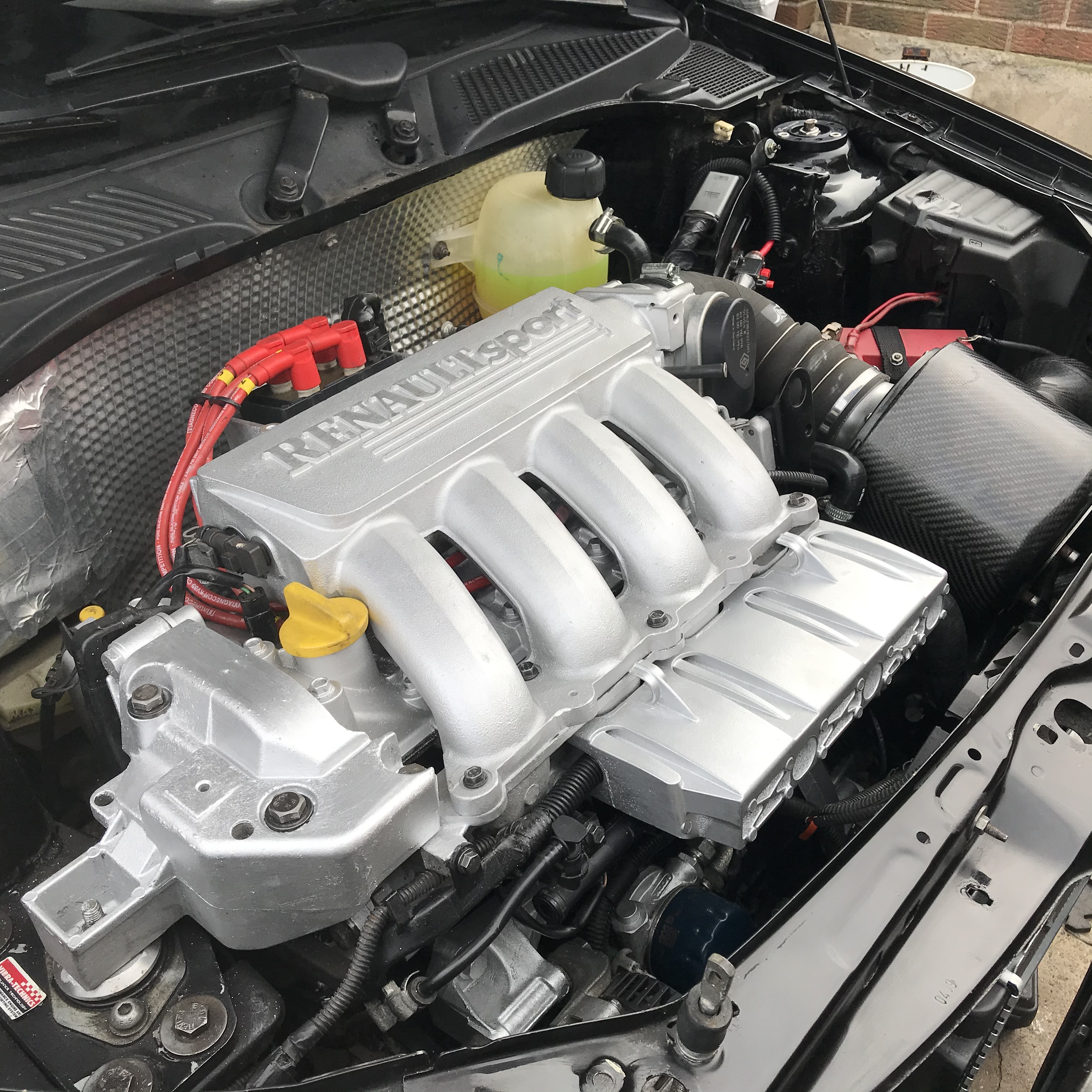

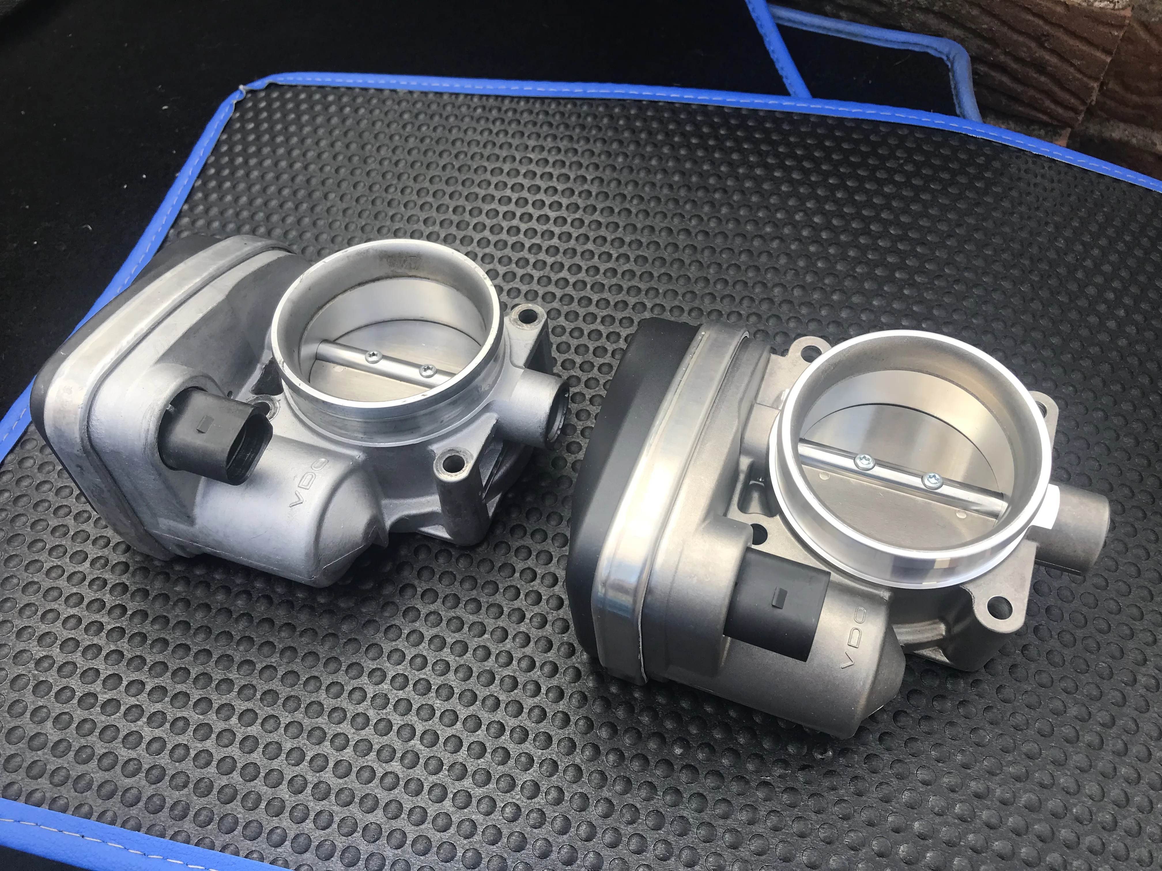

Last job on Clio’s this weekend was to change the throttle body on the BG daily.
It’s a bit of a luxury purchase but KTEC Racing had £100 off the price so I took the plunge.
And it finishes the intake off nicely which got refurbished a few weeks back

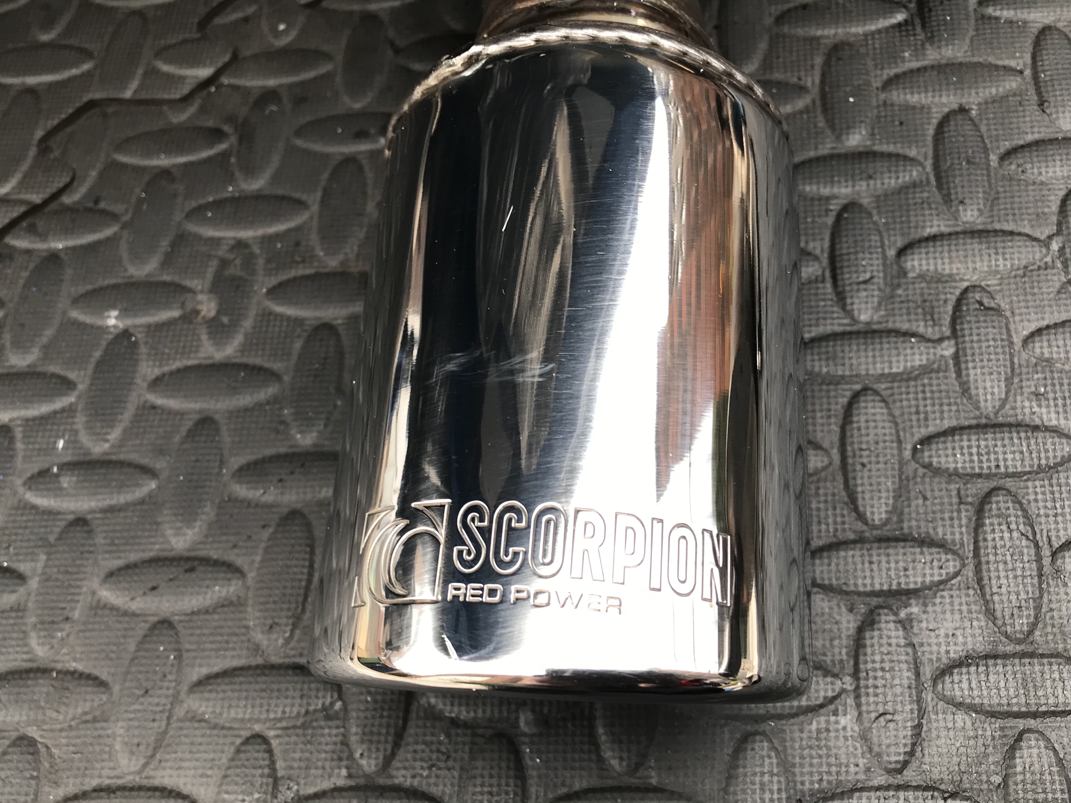

  • Cup springs and dampers F&R. RB has brand new Eibach springs but i don't like the ride. Rear dampers on the RB are brand new but non CUP.

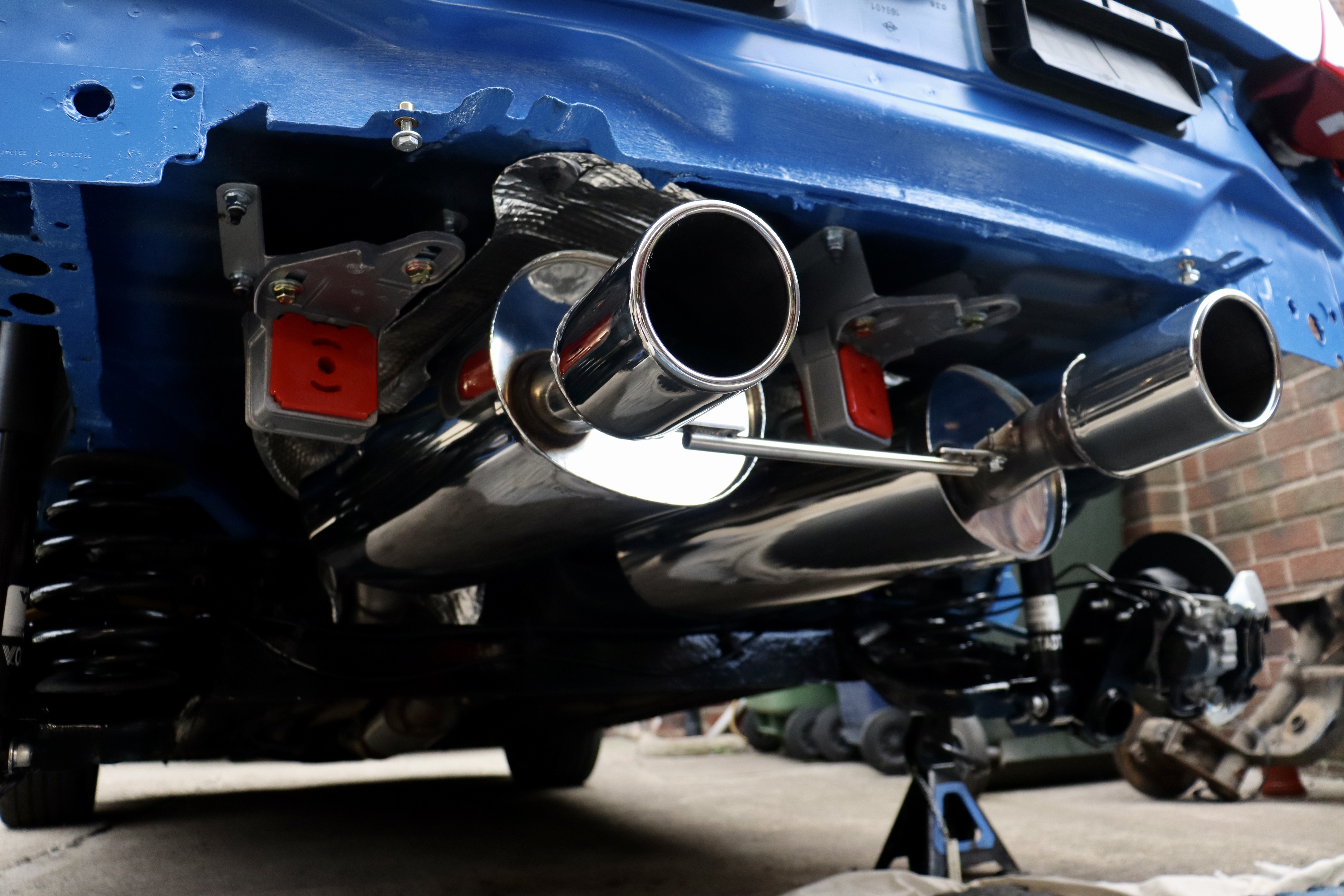

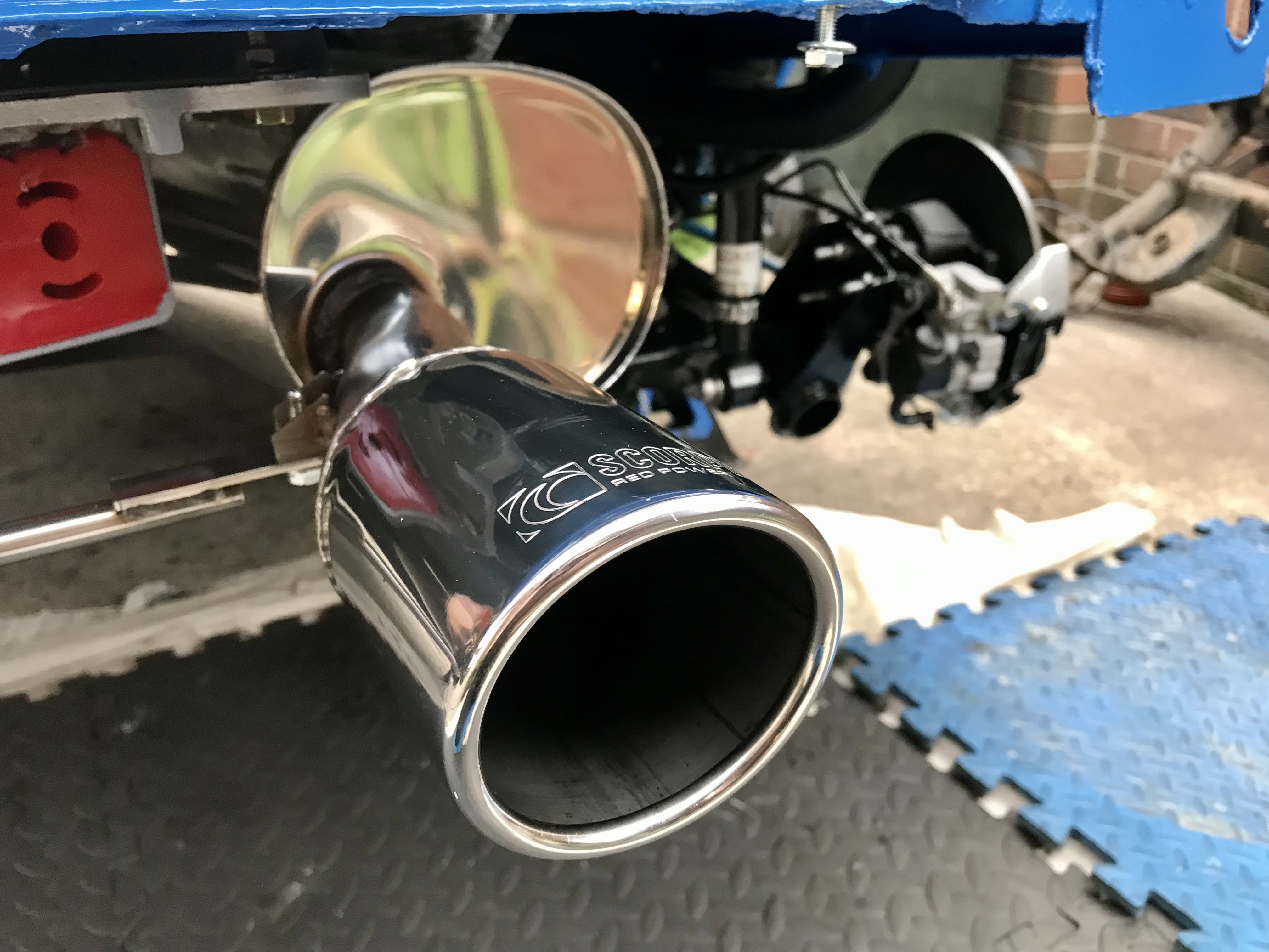

  • PMS Exhaust - Again RB has a pretty nice shiny new Scorpion system, but i like the PMS

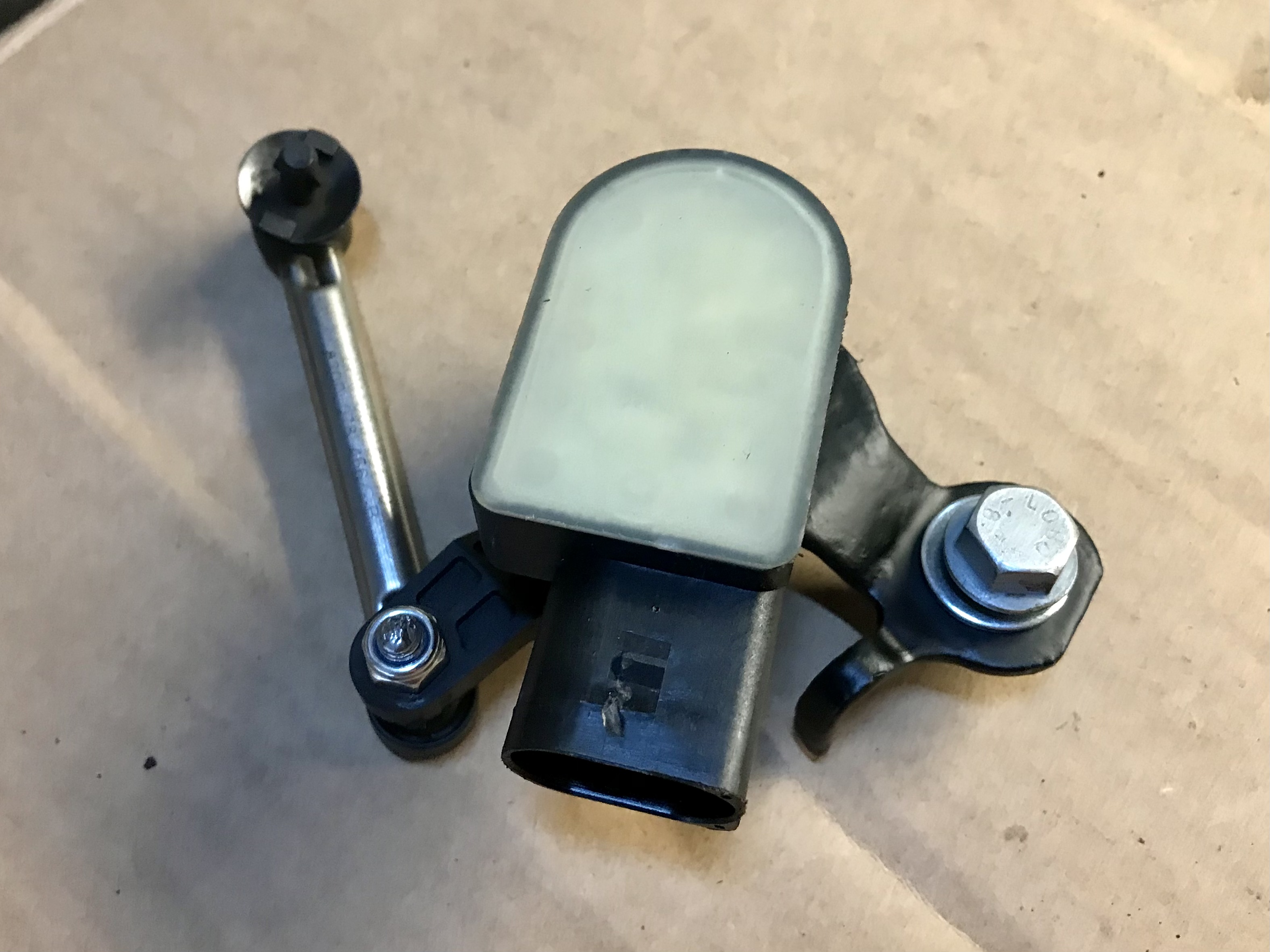

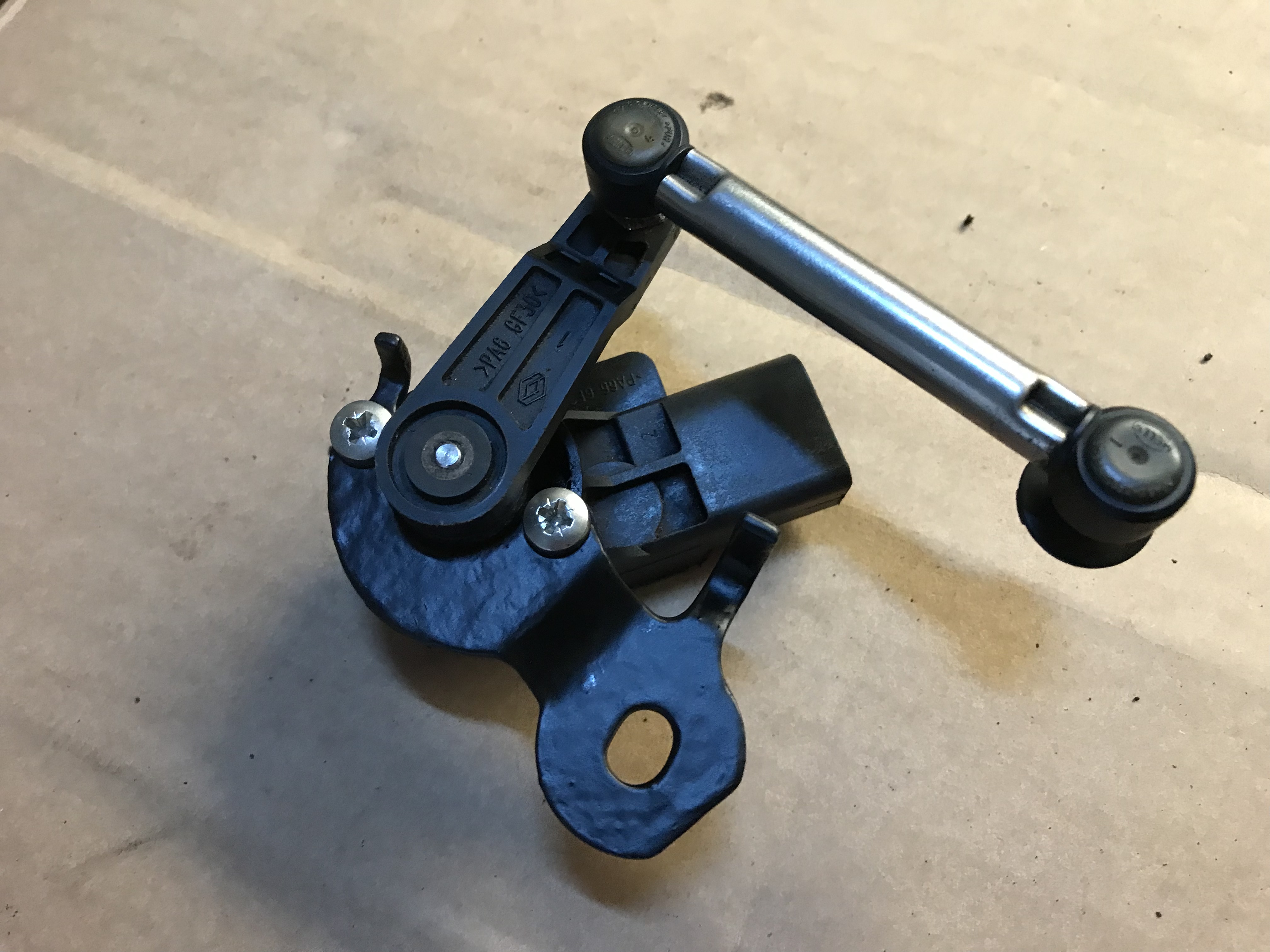

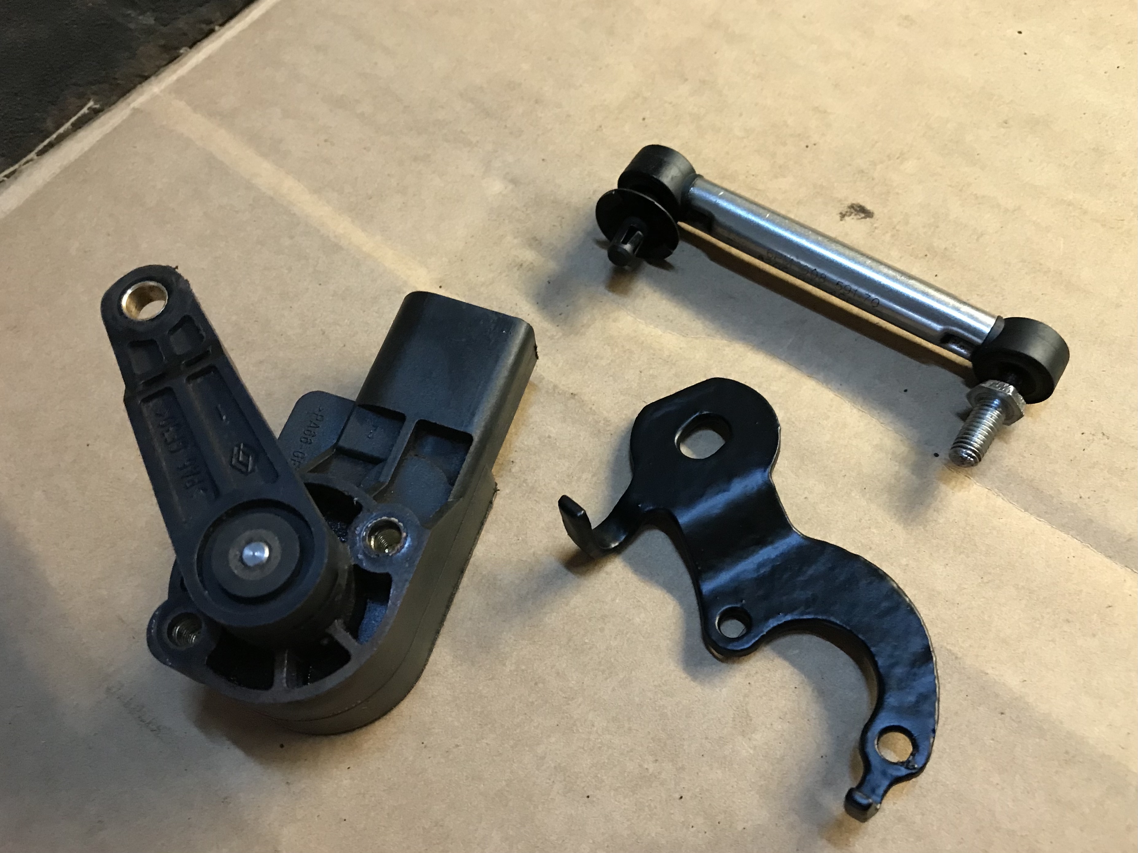

Booked the Black Gold daily in for an MOT on Friday and the bleeding thing failed on the rear Xenon level sensor 🤬 I thought I’d checked everything but failed to notice the small plastic clip on the end of the arm - the part that fixes to the rear beam - had snapped.
Of course they’re obsolete and there’s no aftermarket alternative.
As fortune would have it, I got my track car back today and that has no headlights. So took the sensor off that - although it was crusty as hell - and managed to refurb it to a decent standard.
Car should be ready Monday with a full ticket and ready for a parts transplant and eventual sale.

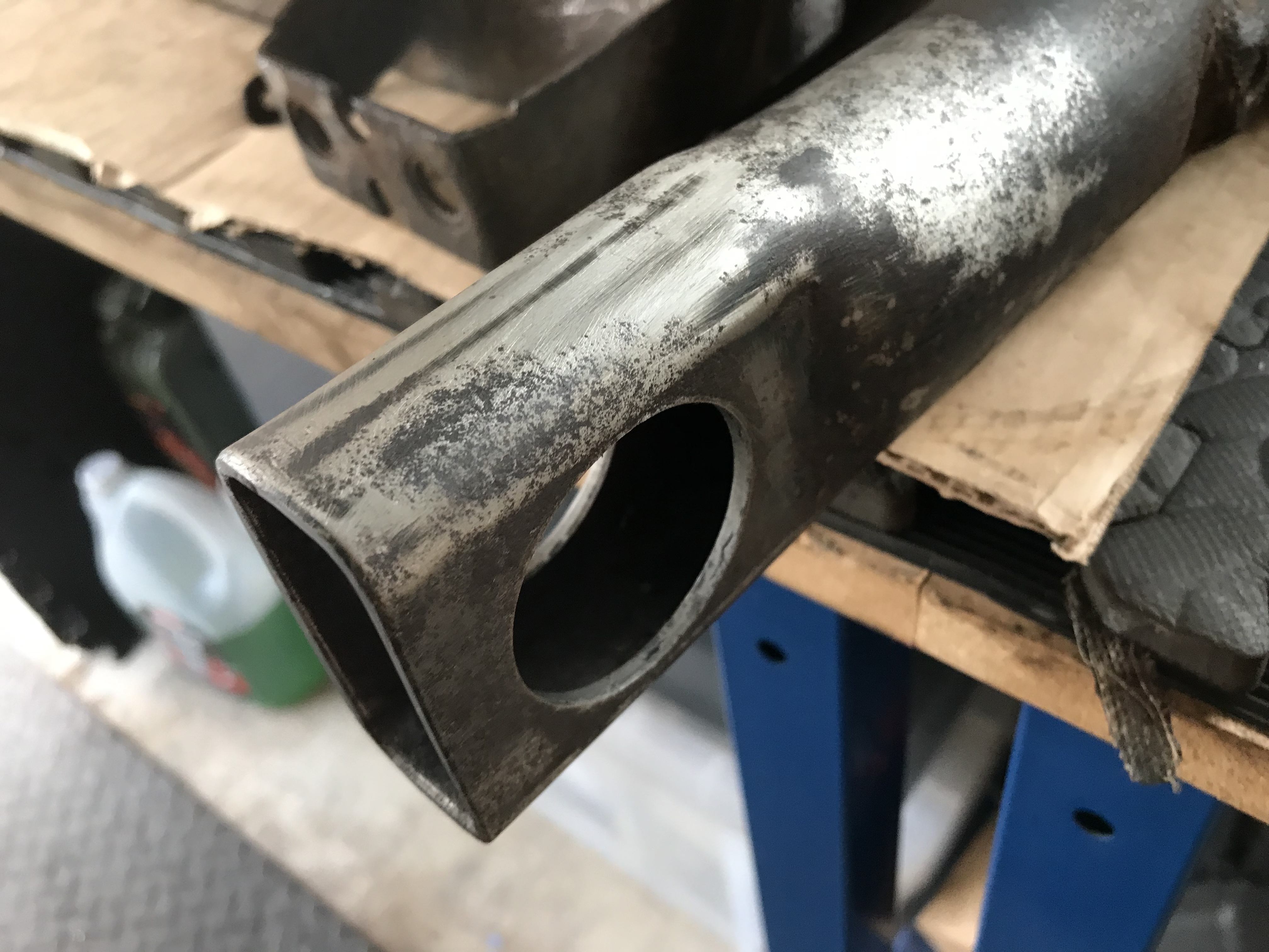

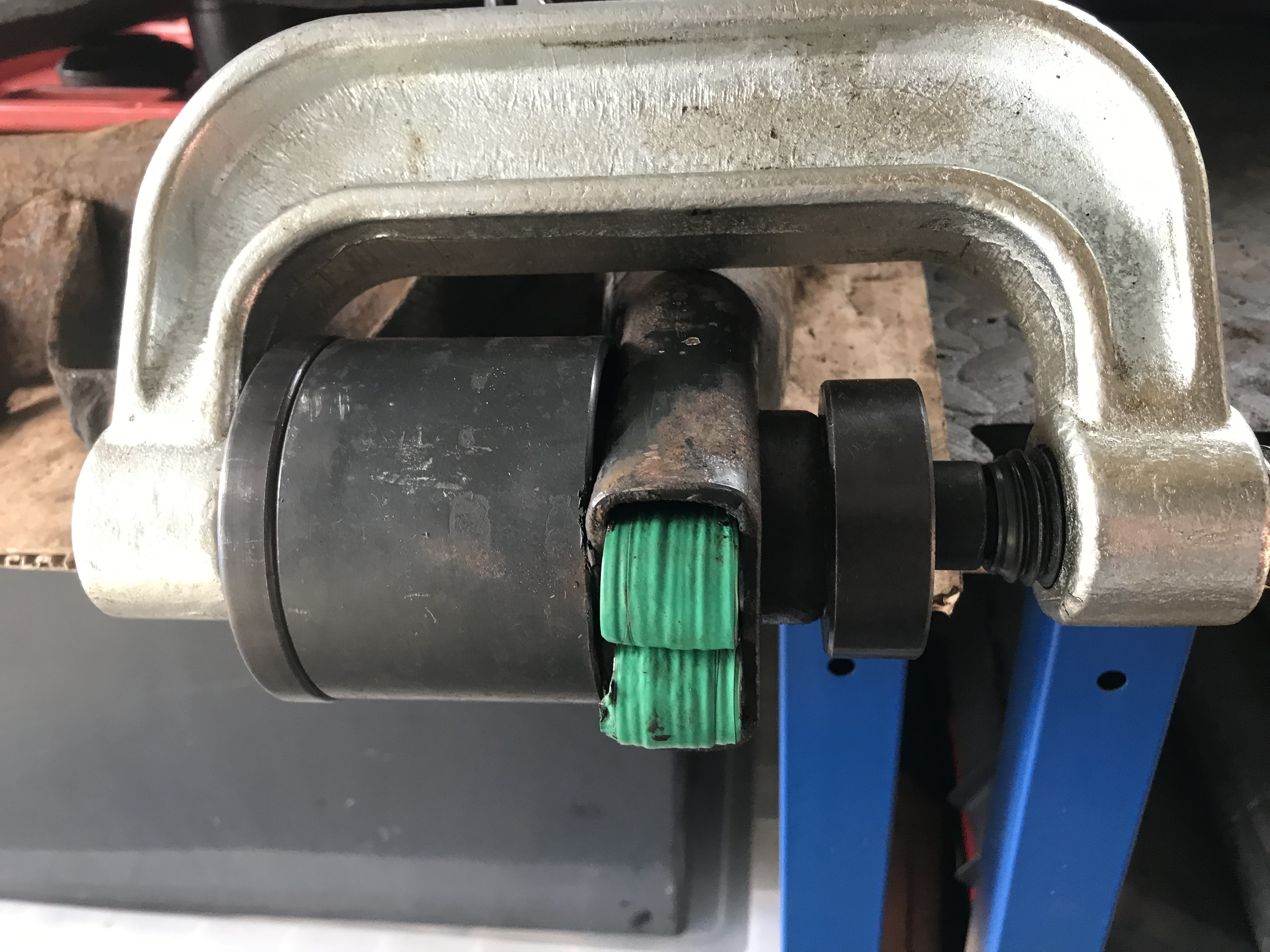

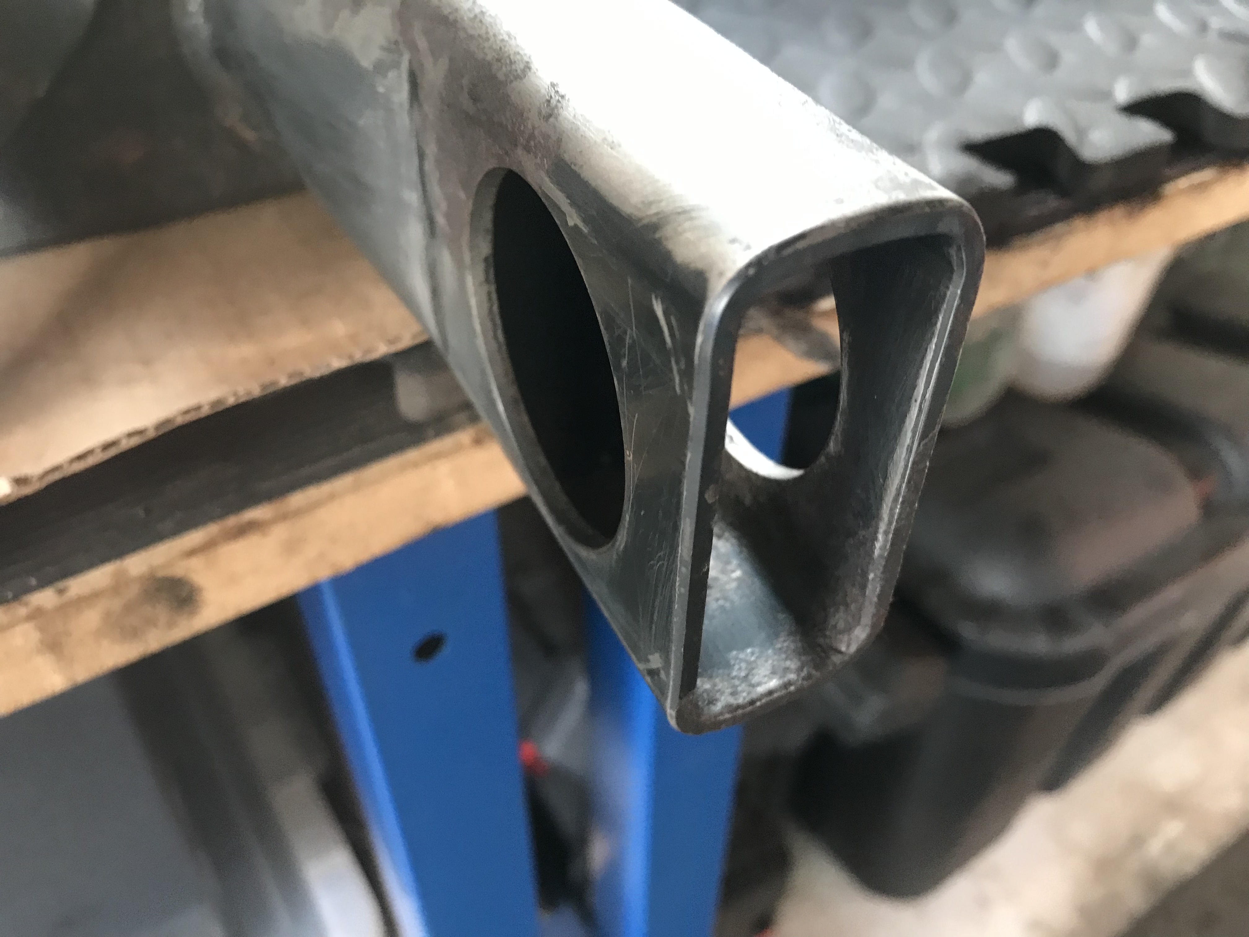

I always vowed never to restore another rear axle beam yet here I am again 🤦🏻‍♂️
This one is particularly nice though with very little pitting around the spring area.
On this occasion though I’m going to get it shot blasted as I think it’ll come up beautifully.
The plan is to then strengthen it with a PMS stiffening kit and then fit spherical bearings. Perfect for the track car.
One tip I’d recommend when removing the bushes is to support the ends so it doesn’t warp the steel when pushing them out.
I use 9 x M12 steel washers wrapped in tape and I find it stops any bending.

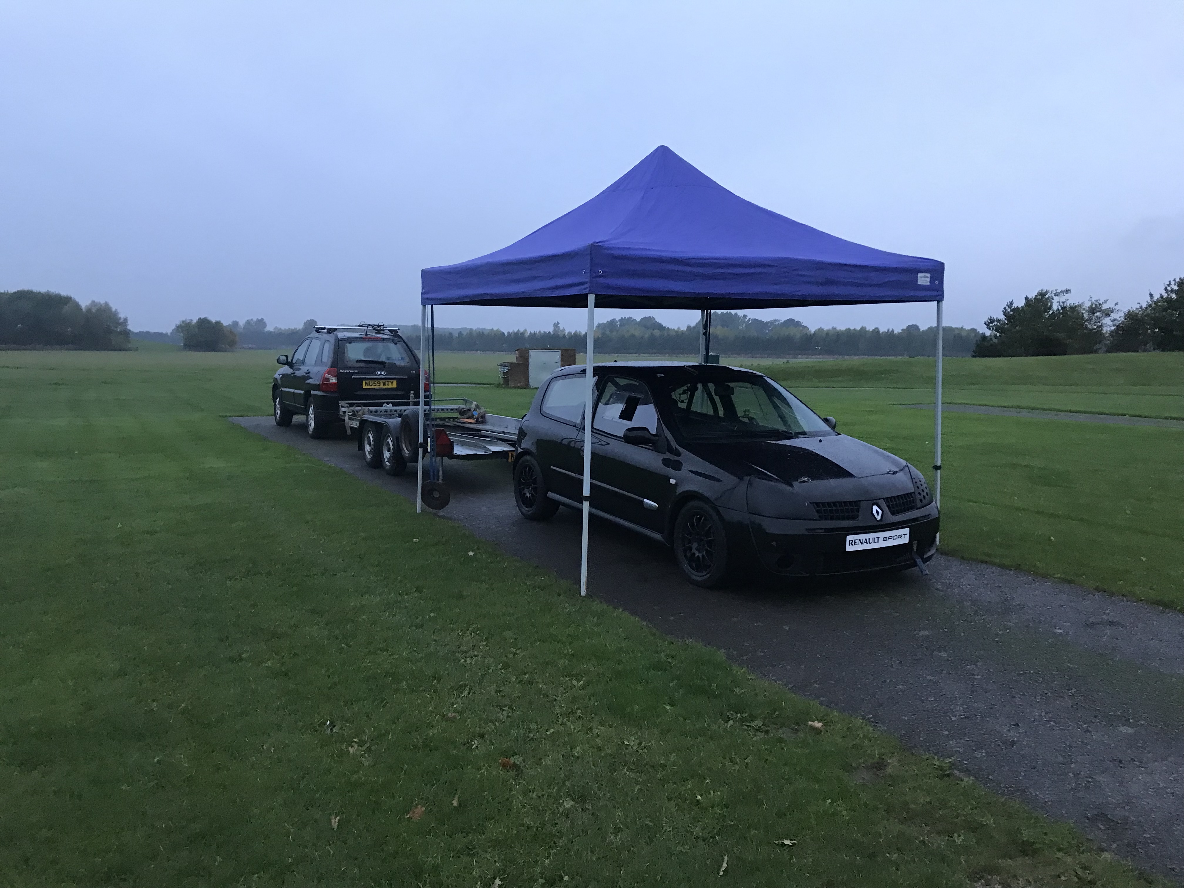

Busy weekend getting the track car ready for Croft on Tuesday.

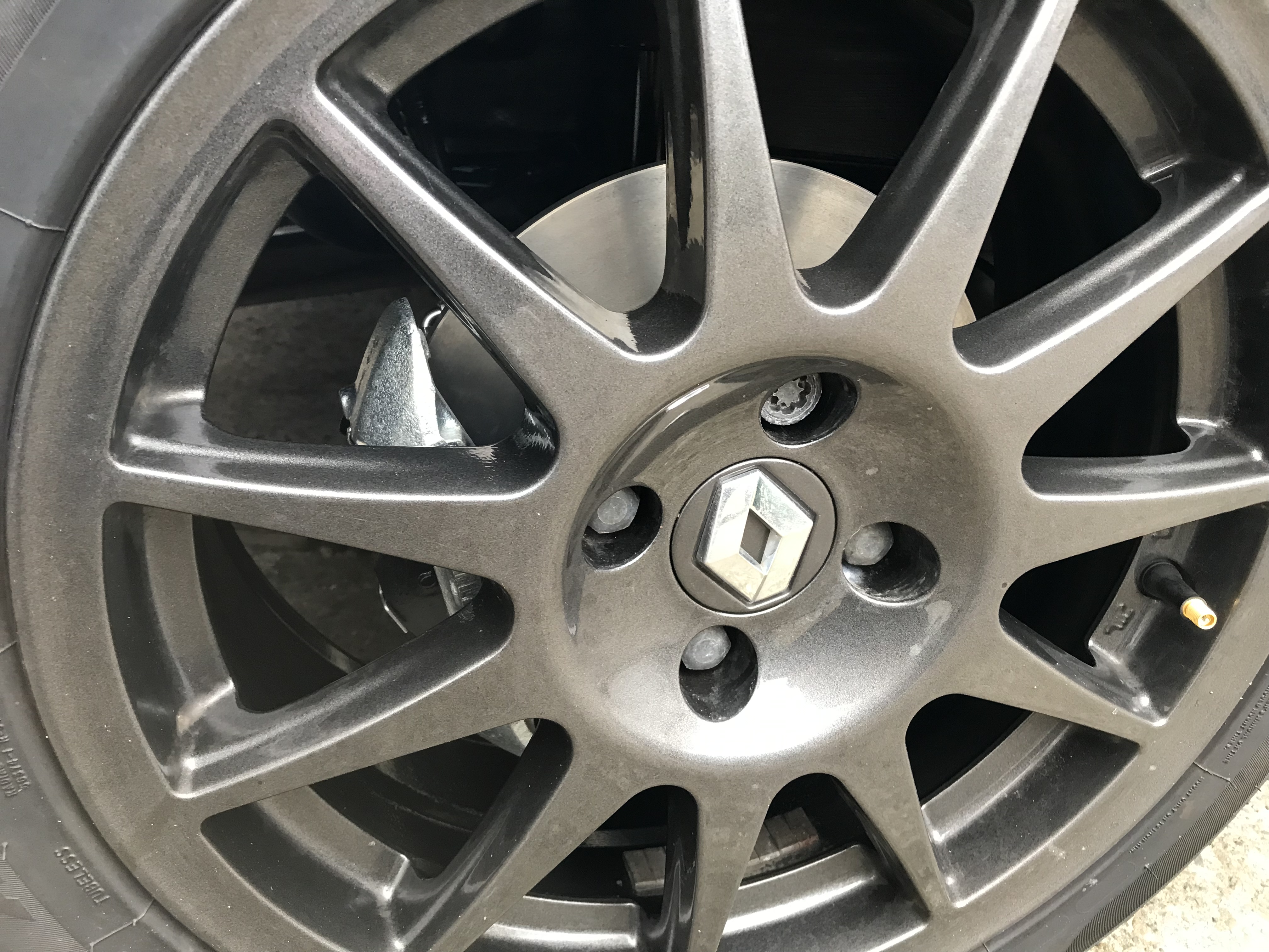

Needed to clean/bleed the brakes and sort a temporary battery out after those clowns working on my car dumped it outside for 2 months with no cover or care. 🤬 They’d also tried to jump start my lithium battery and fried it in the process. Completely ignored my instruction to disconnect it while waiting for parts.

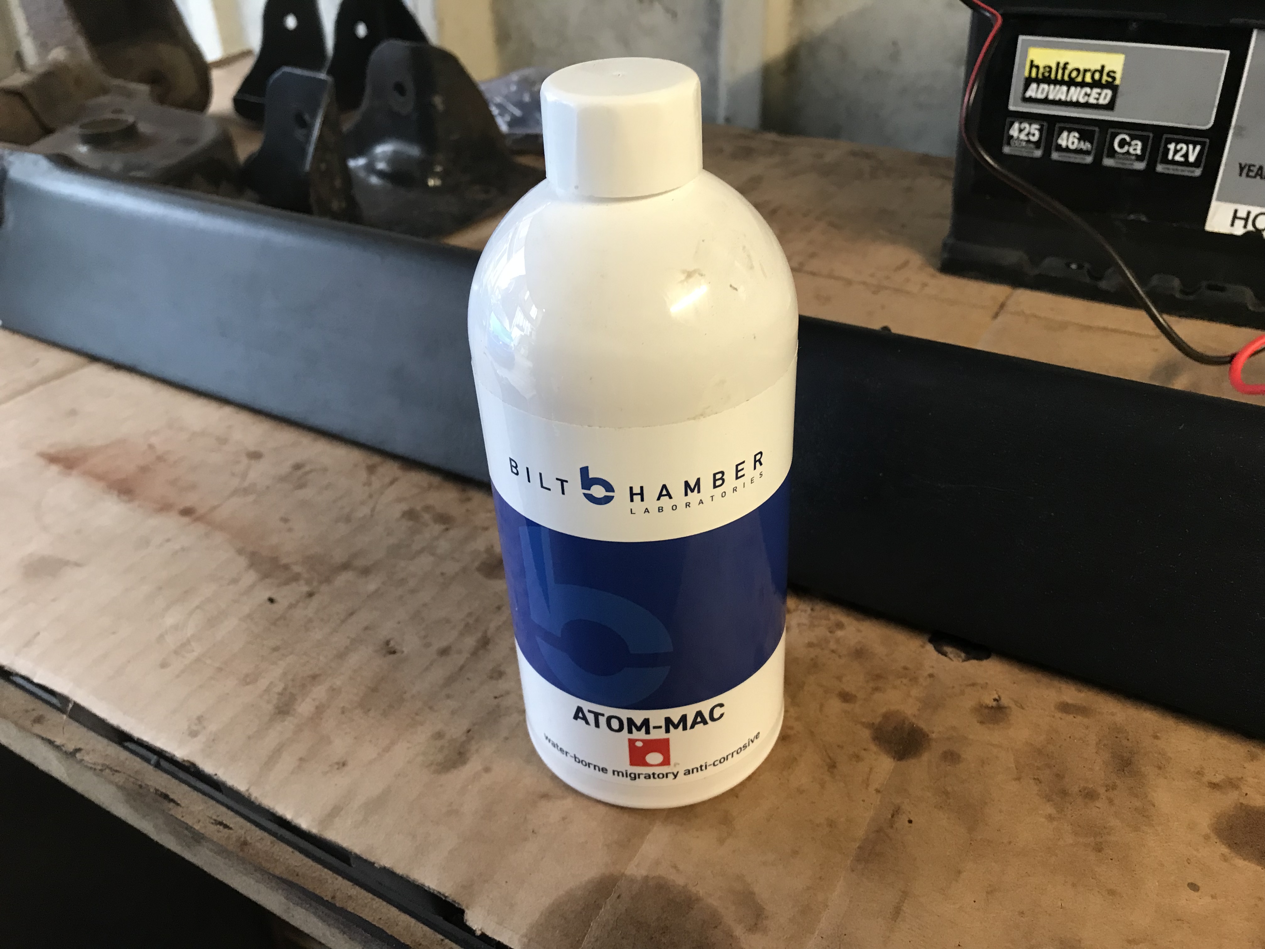

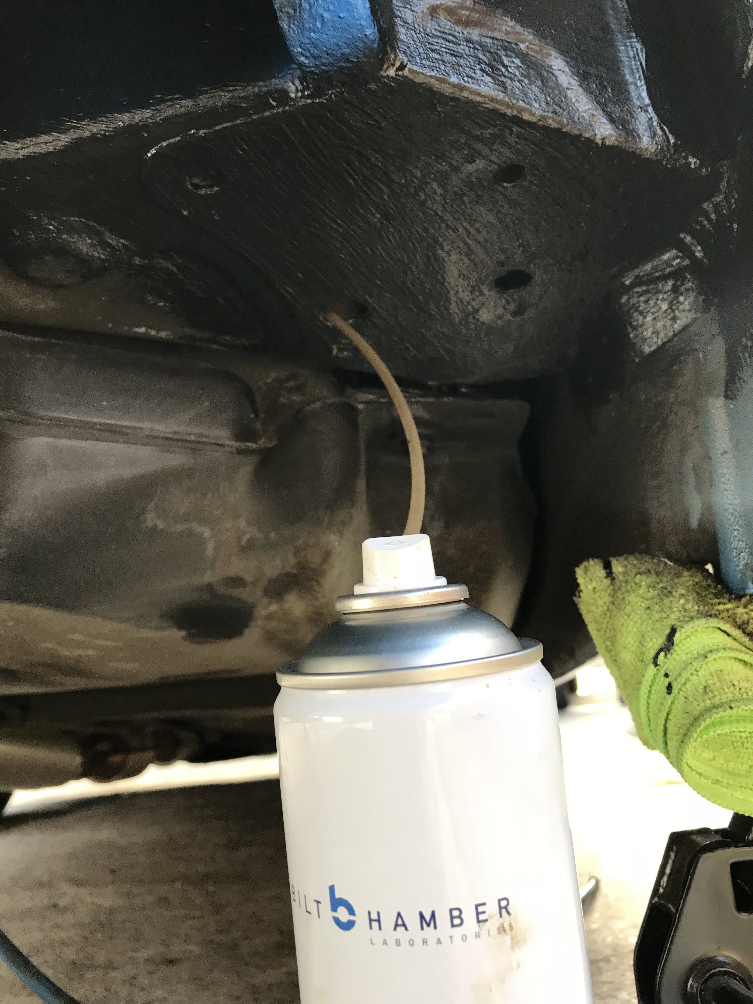

On a happier note I uncovered Project RB to find the discs are rust free, thanks to Bilt Hamber’s awesome Atom-Mac.
It’s been sat outside the garage for almost a month now. Can’t recommend this stuff enough for preventing flash rust on discs or road salt biting into components over winter.

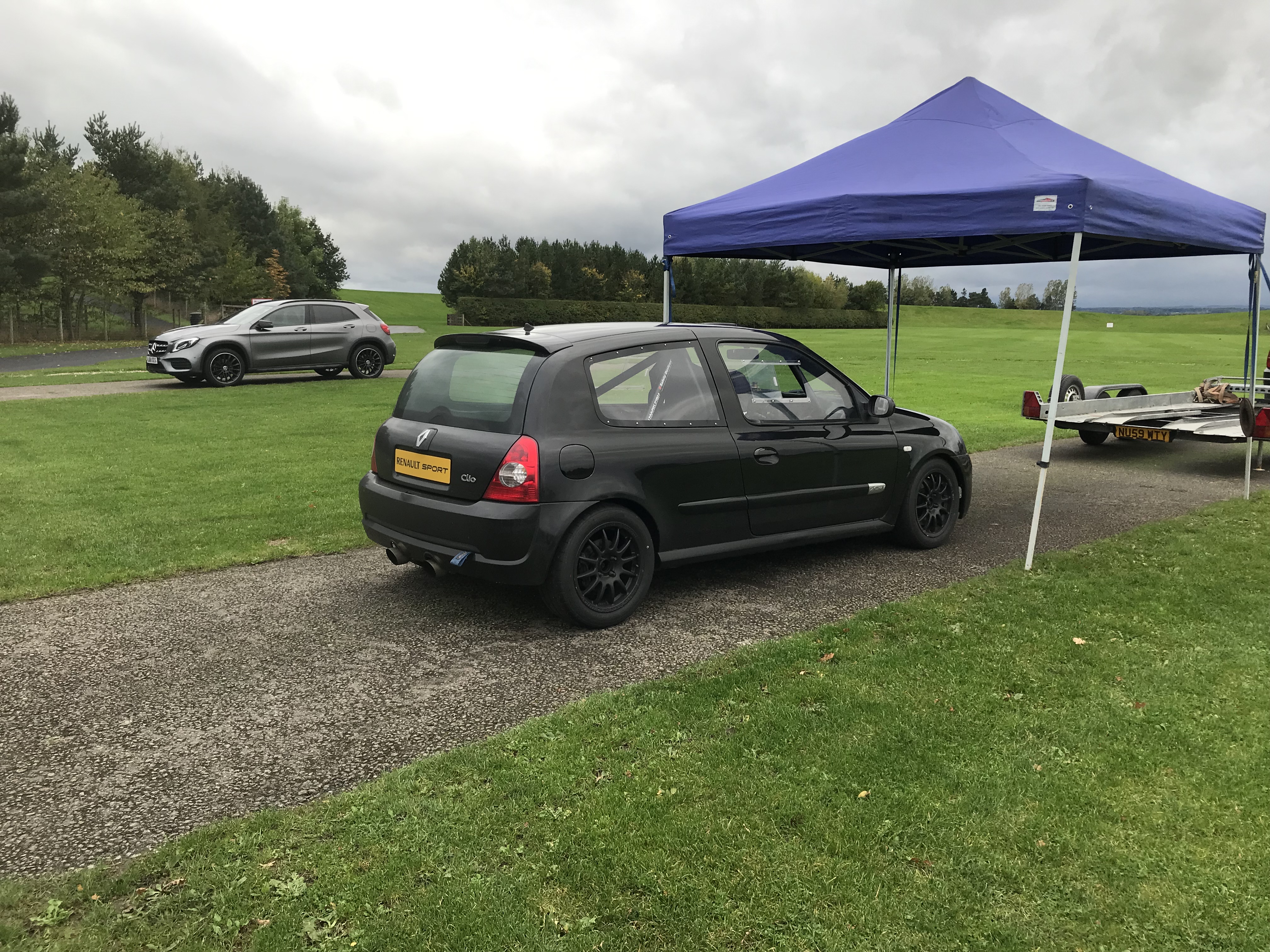

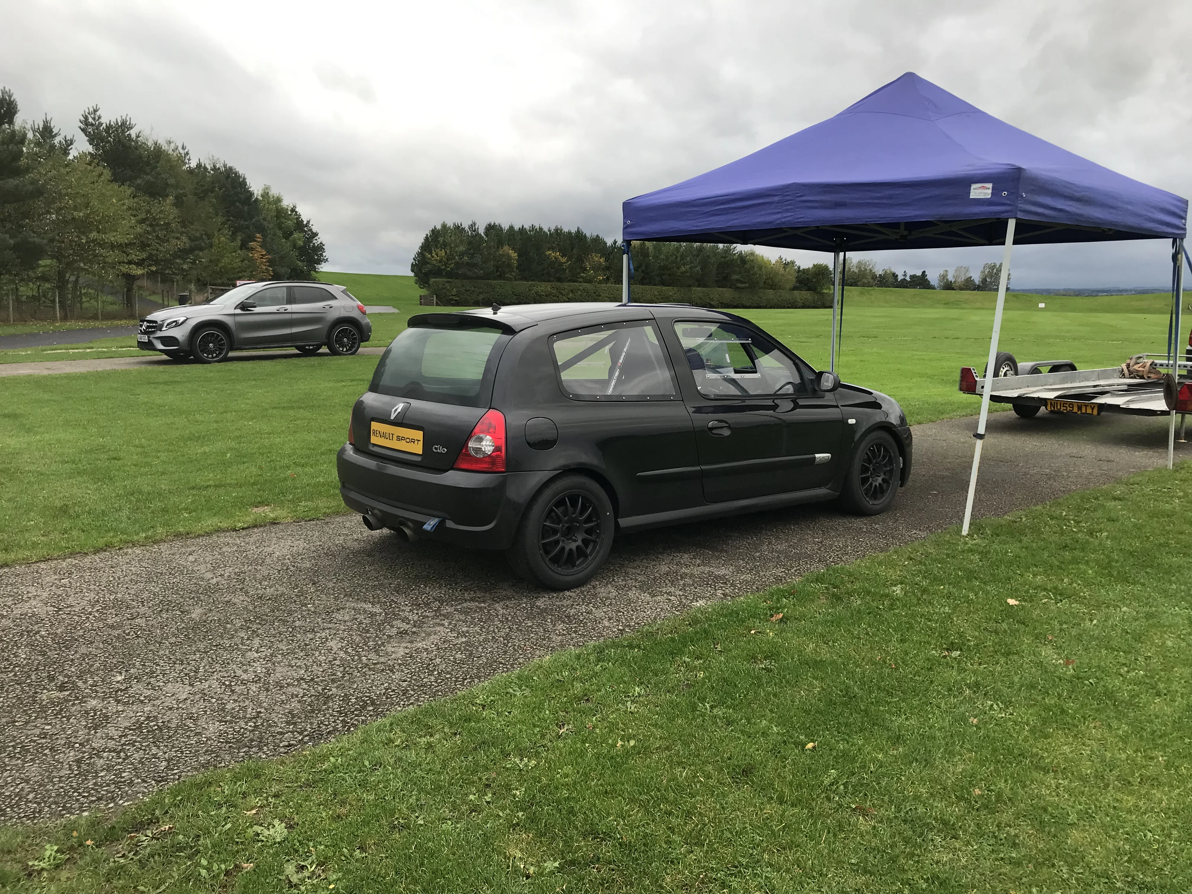

Another great day at Croft in the old girl. Car’s not running perfectly as needs a remap. Sat out the morning session due poor visibility - as in I couldn’t see out of my windscreen 😂
Finally joined in just before lunch when things settled down a touch.

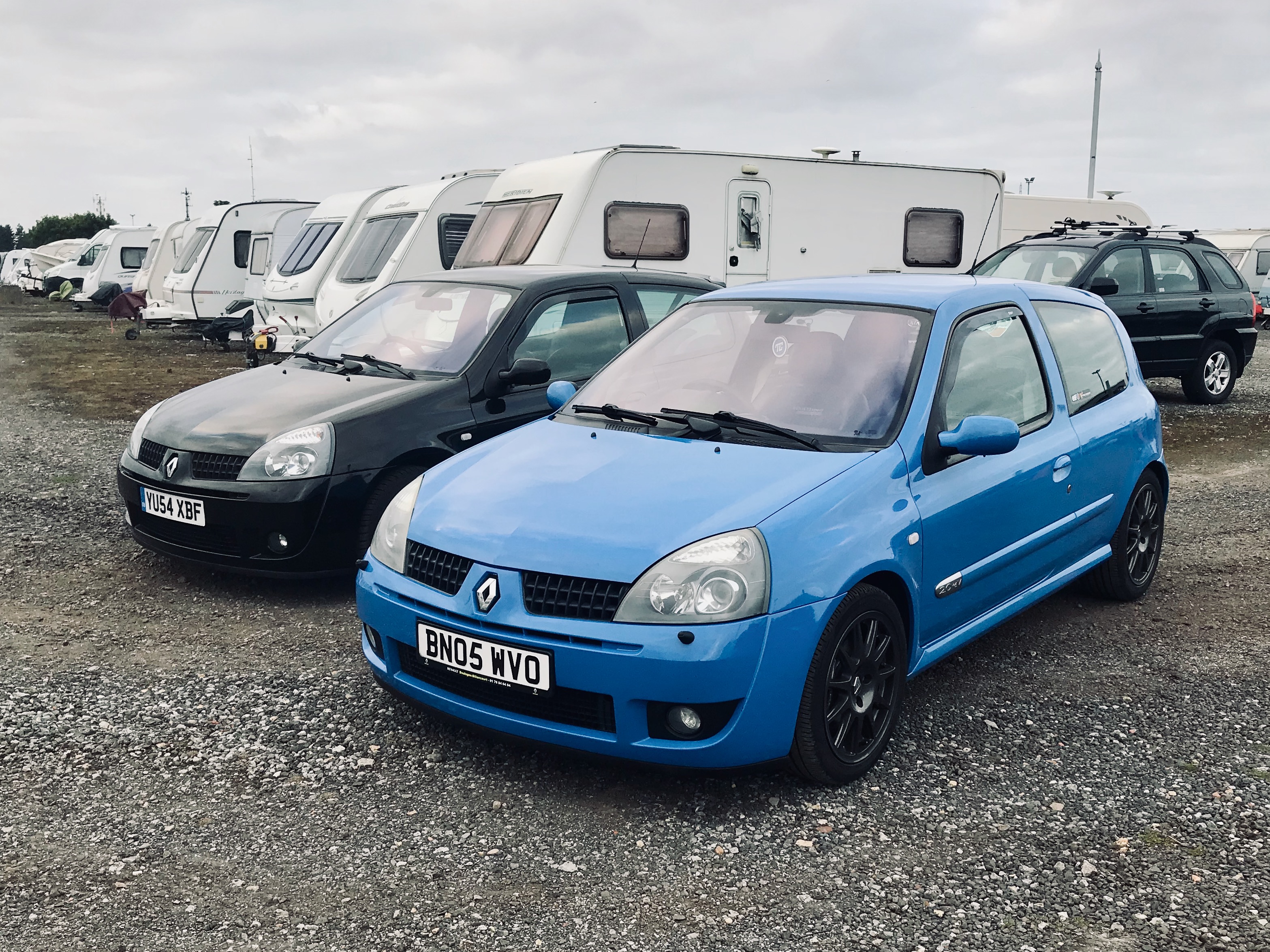

Met up with Fred and James and their stunning 182. Great to go around circuit with another race Clio. Really nice lads too although a lot younger than me 😂 Isn’t everybody!

Really enjoying this thread. Thanks for the heads up on the Atom Mac. I'd never heard of it but will be ordering some before the winter starts!
Thanks Dave, much appreciated :)
I couldn't bear to uncover the car after a few months only to find those horrible pad marks you get on brand new discs after lack of use. Certainly seems to be working.
