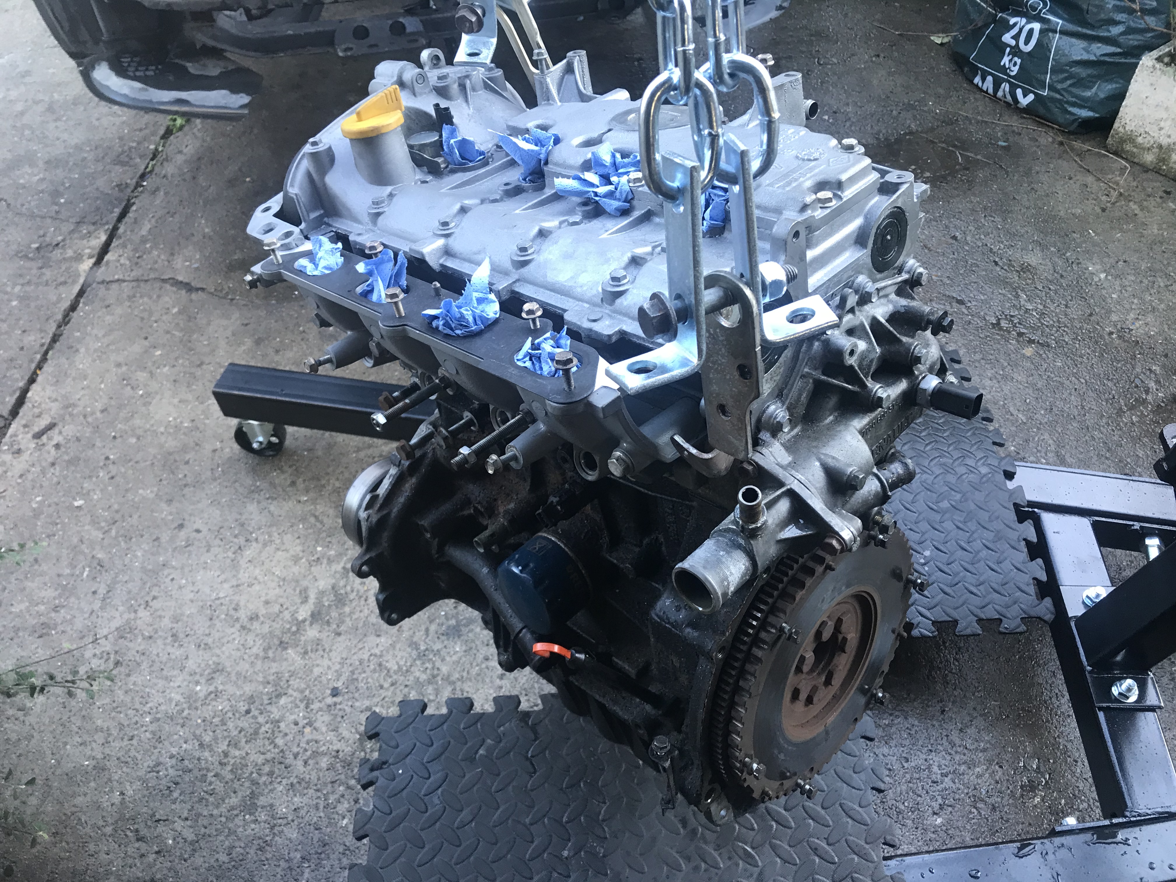

Began the process of stripping parts from the engine. Not sure how much I should remove but I figure the lighter, the better.
I’ll nibble away at it each night so hopefully by Saturday it’ll be pretty much ready to come out.

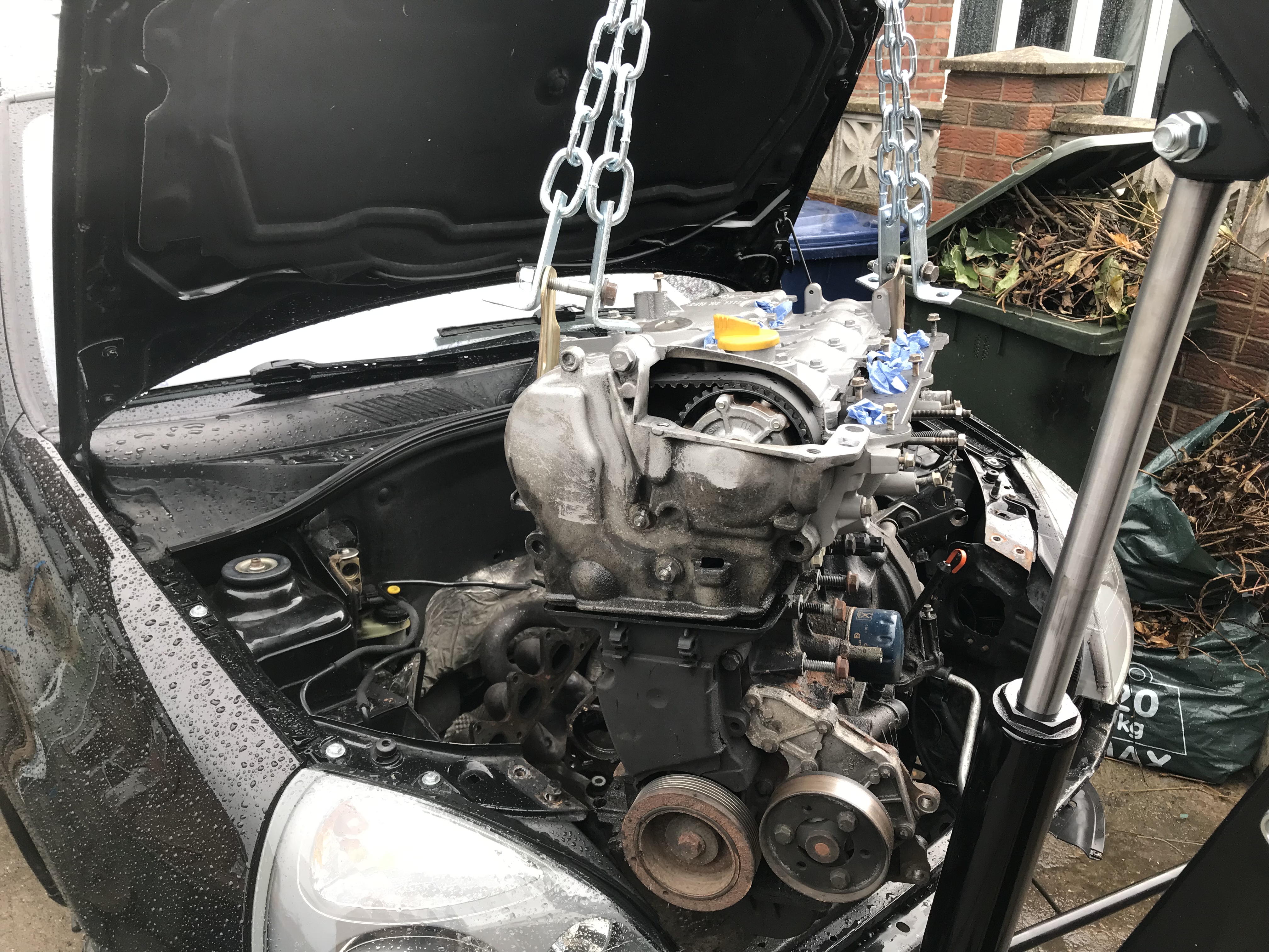

Half a day preparing to remove the engine and box. Just need to assemble the engine crane and it’s ready to come out.
No major dramas and everything seemed to go to plan.

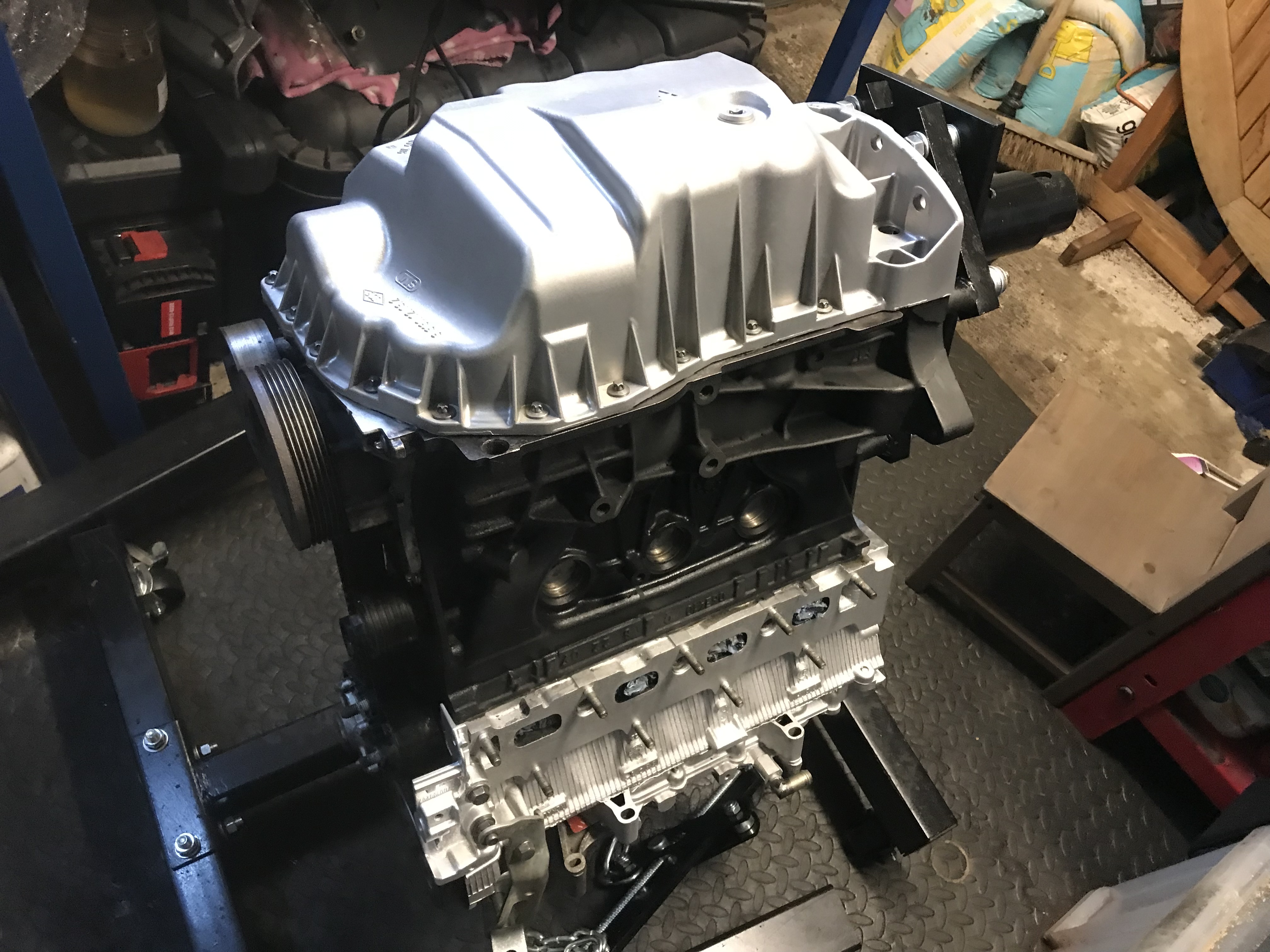

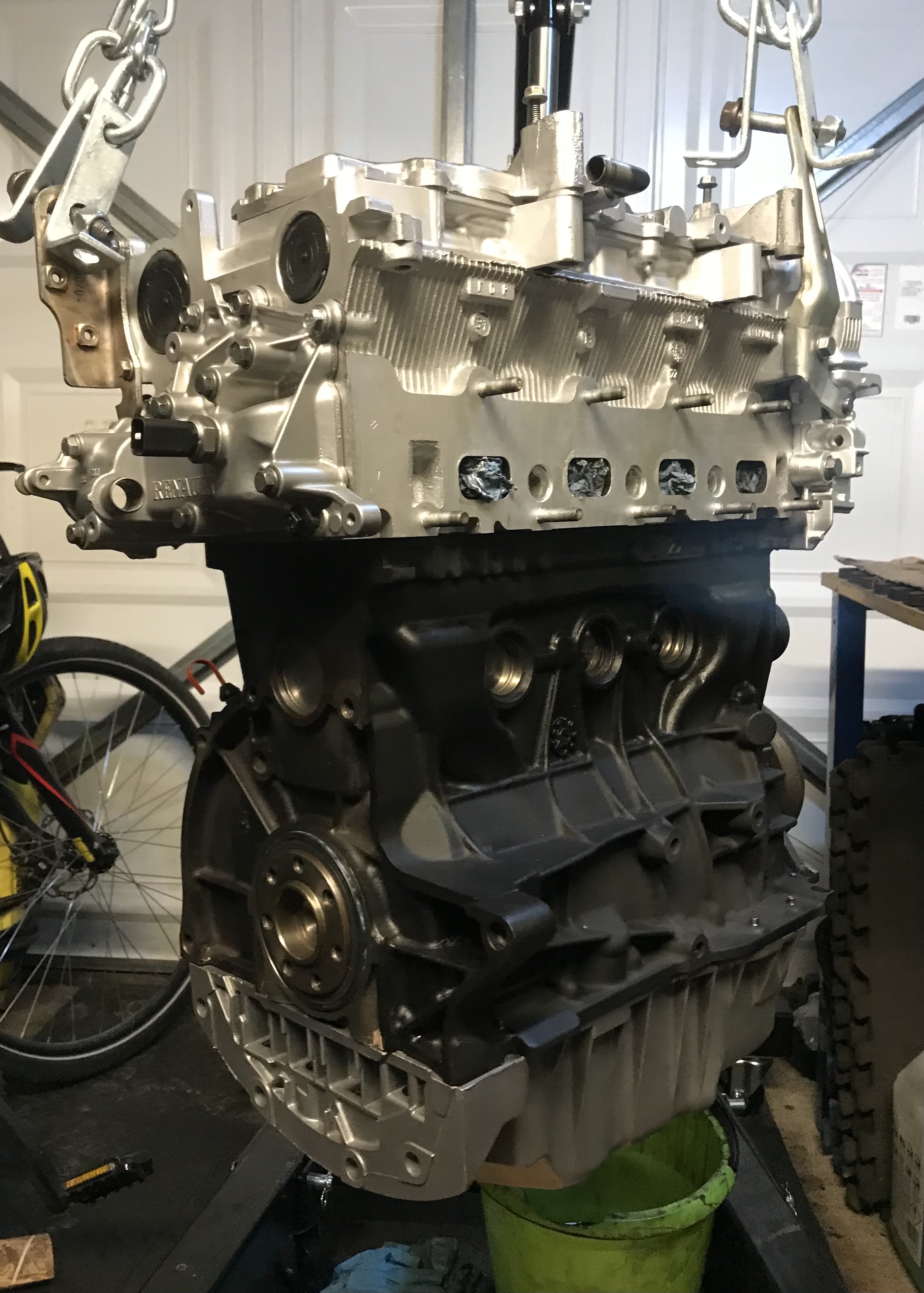

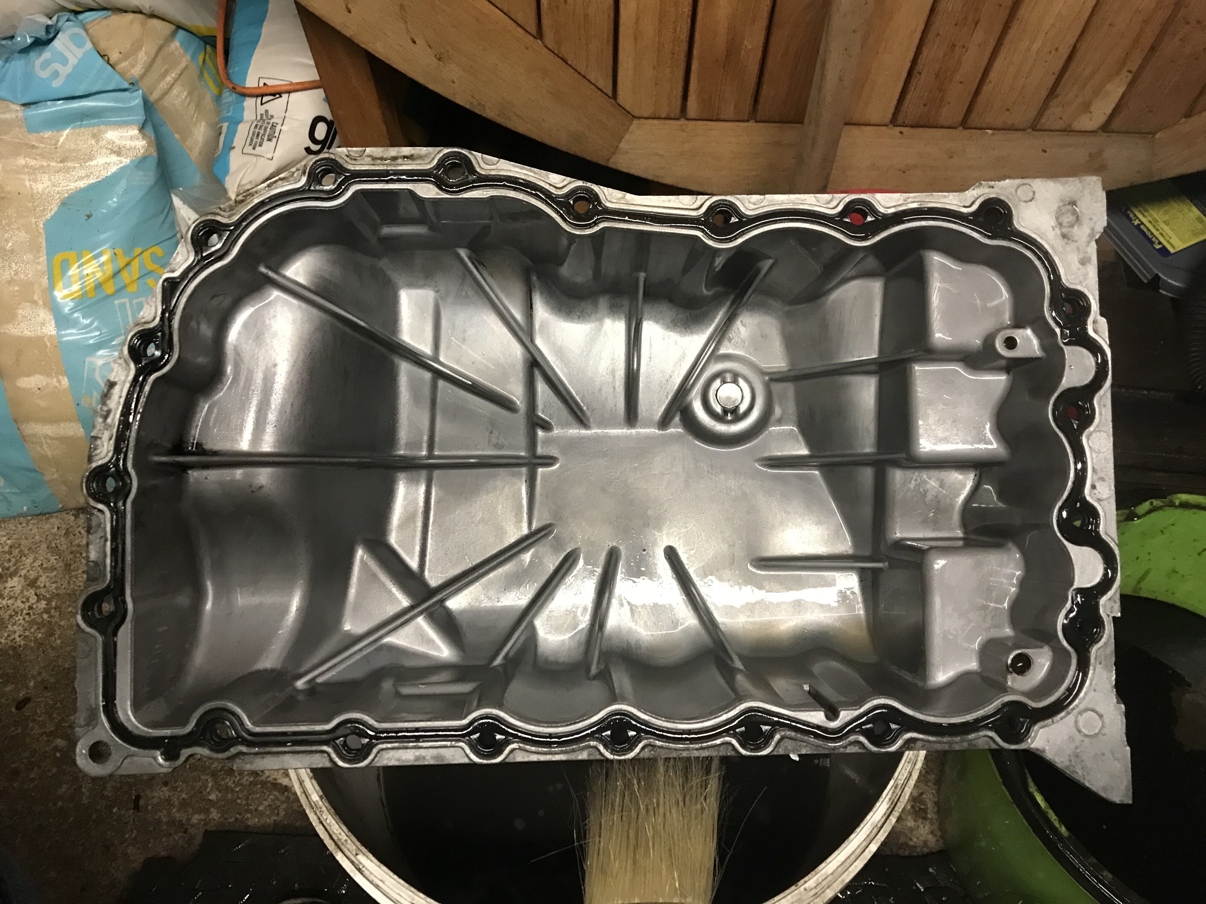

Began stripping and checking parts from the engine tonight.
A bit of cross threading going on with this gearbox bolt. Thankfully still available from Renault.

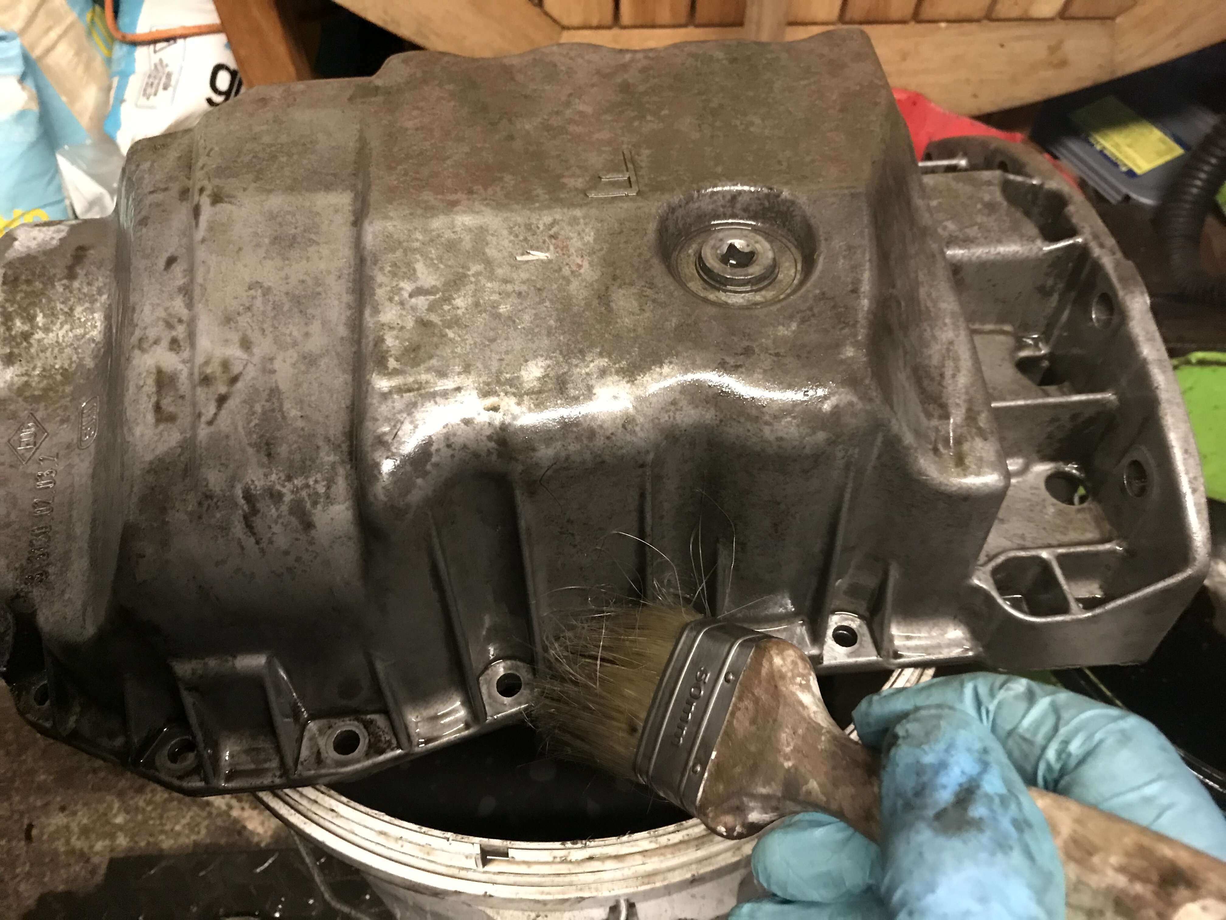

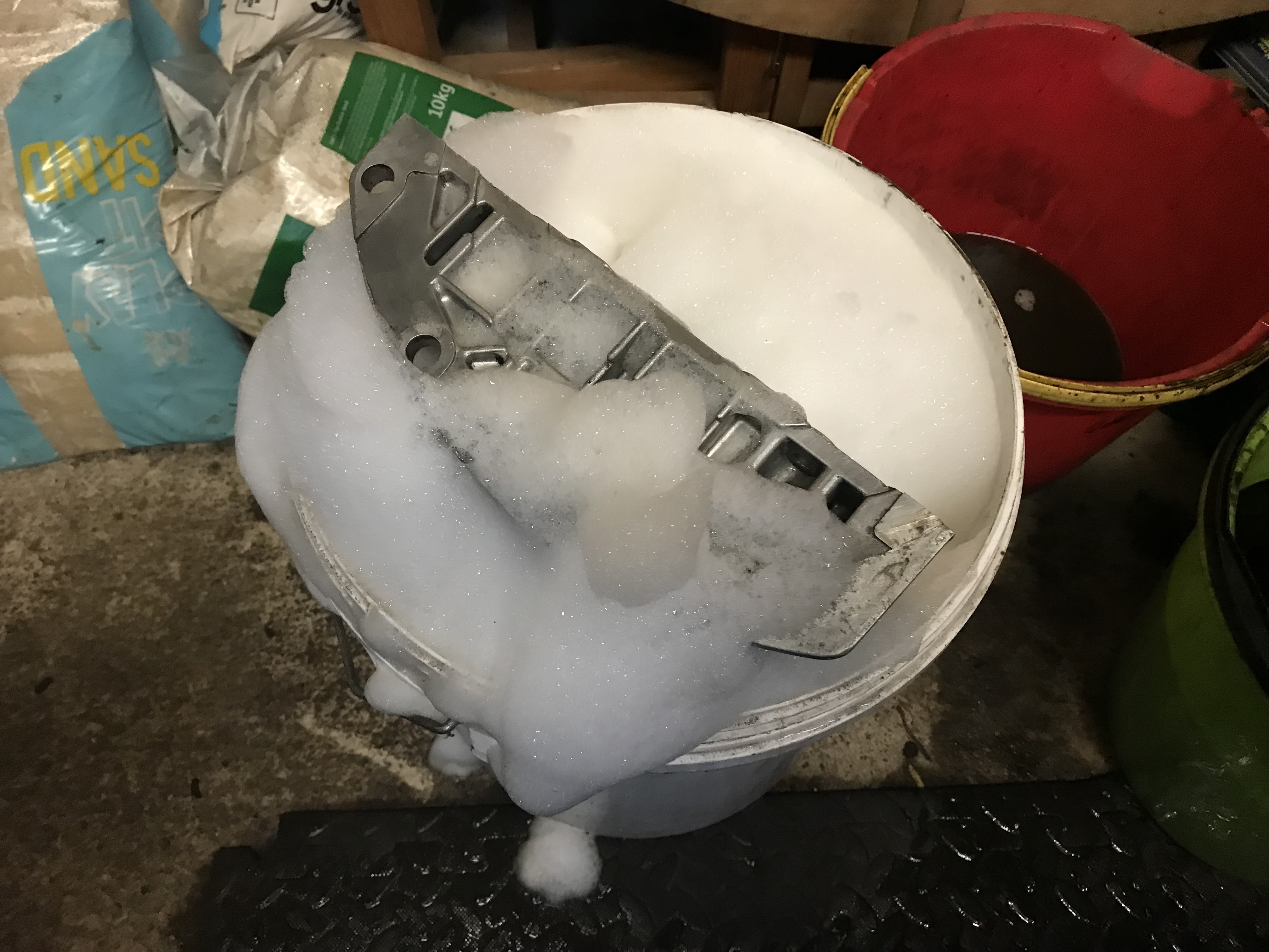

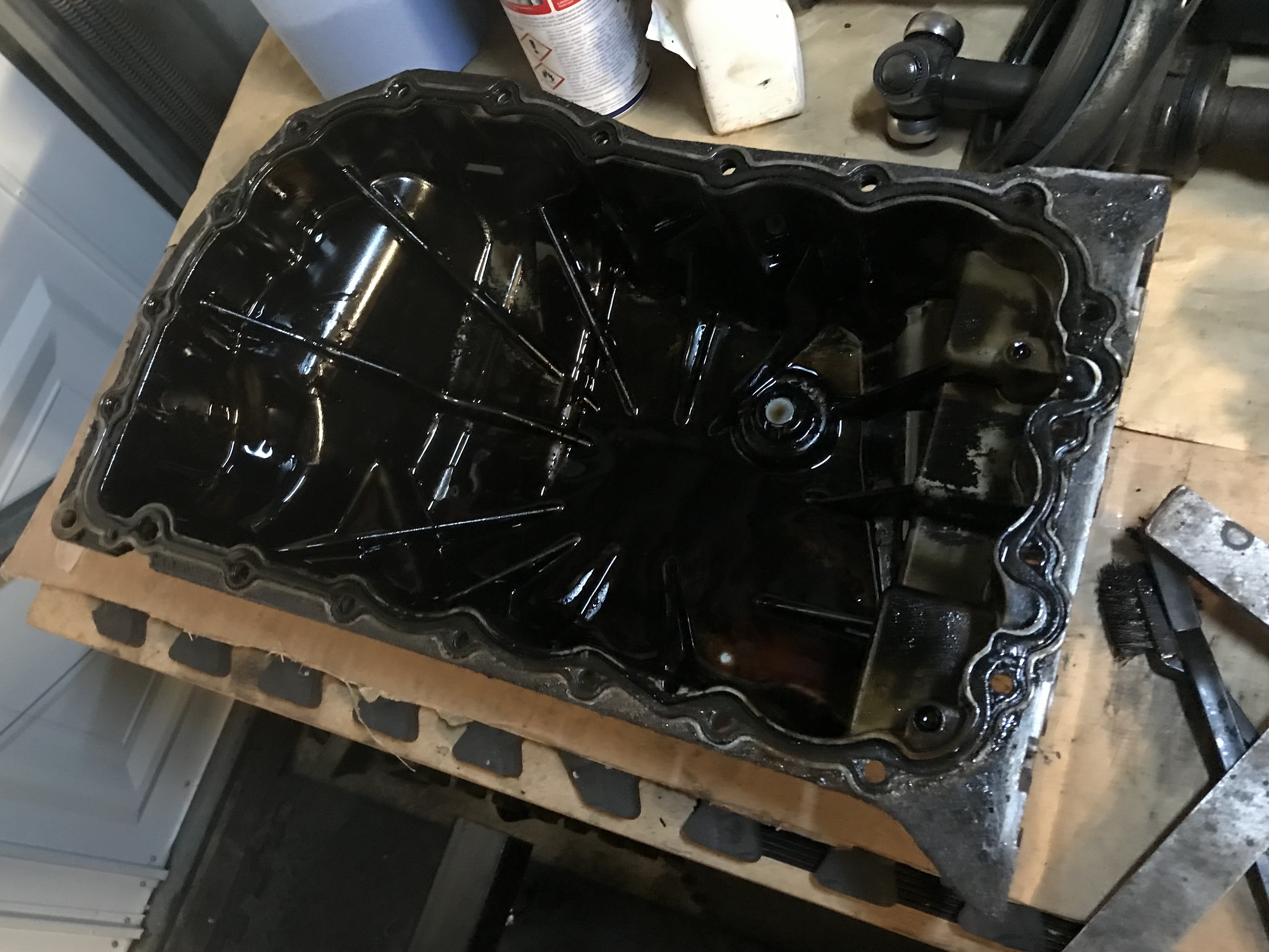

Whipped the sump off as it would be mad not to and began cleaning it up.
Agitated it with a stiff brush and some B&H surface HD degreaser to dissolve the crap.
Sadly 17 years, road salts and 131,000 miles have taken its toll on the external part of the sump. I’ll probably just paint it and avoid aqua blasting as I can’t trust they won’t blast the inside and where it seals.
Leaving it to soak overnight in a mild detergent and warm water.

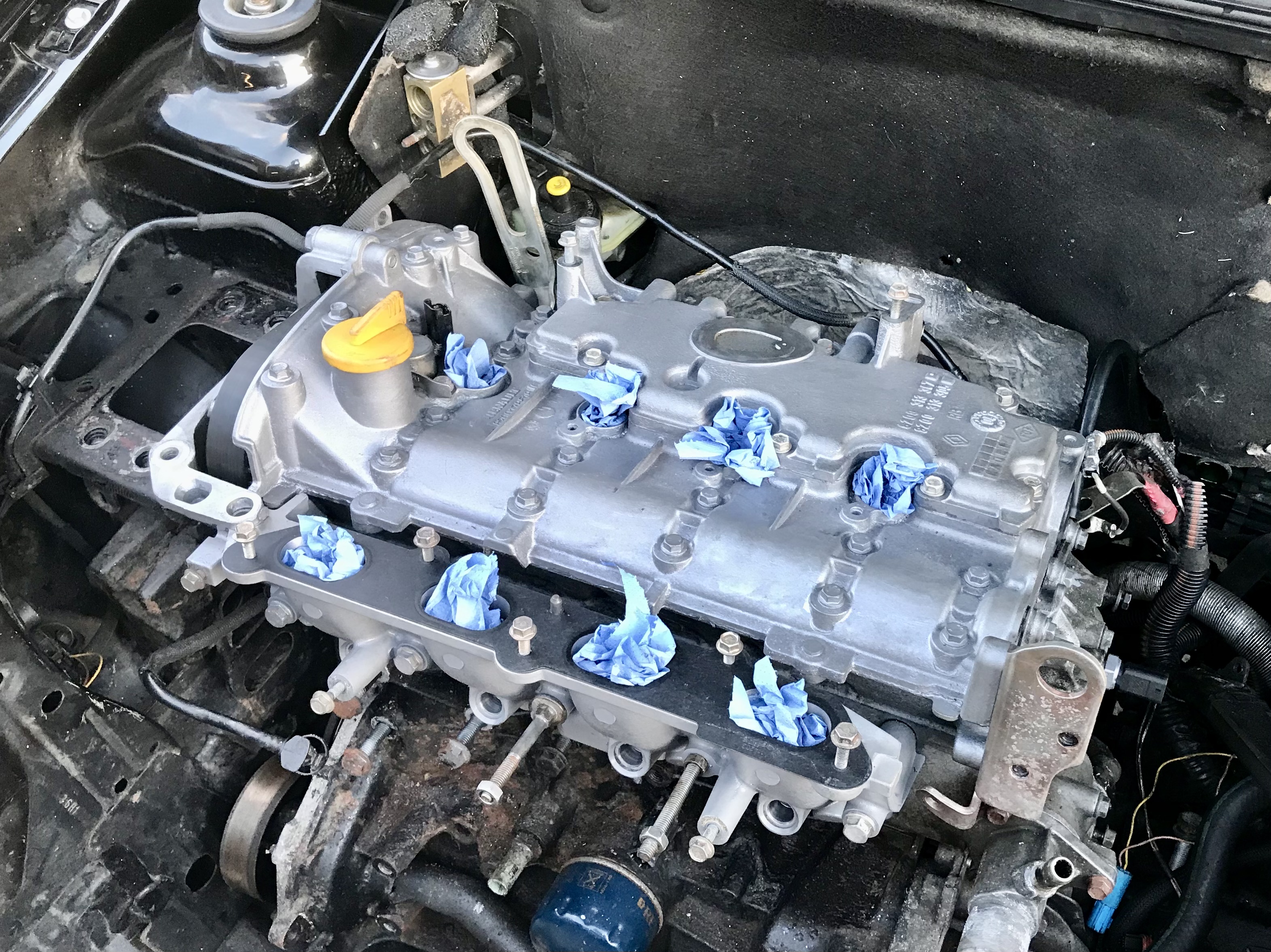

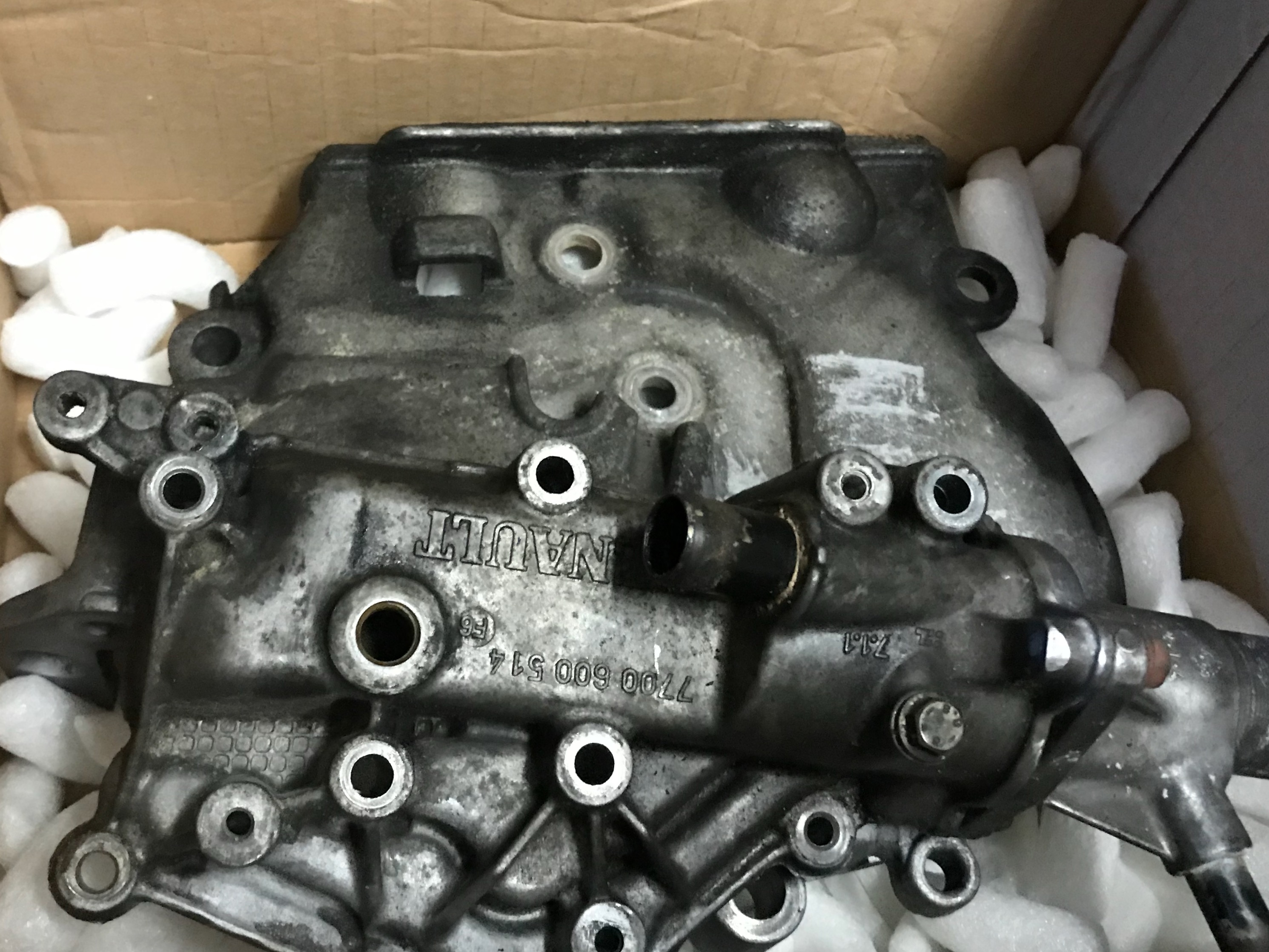

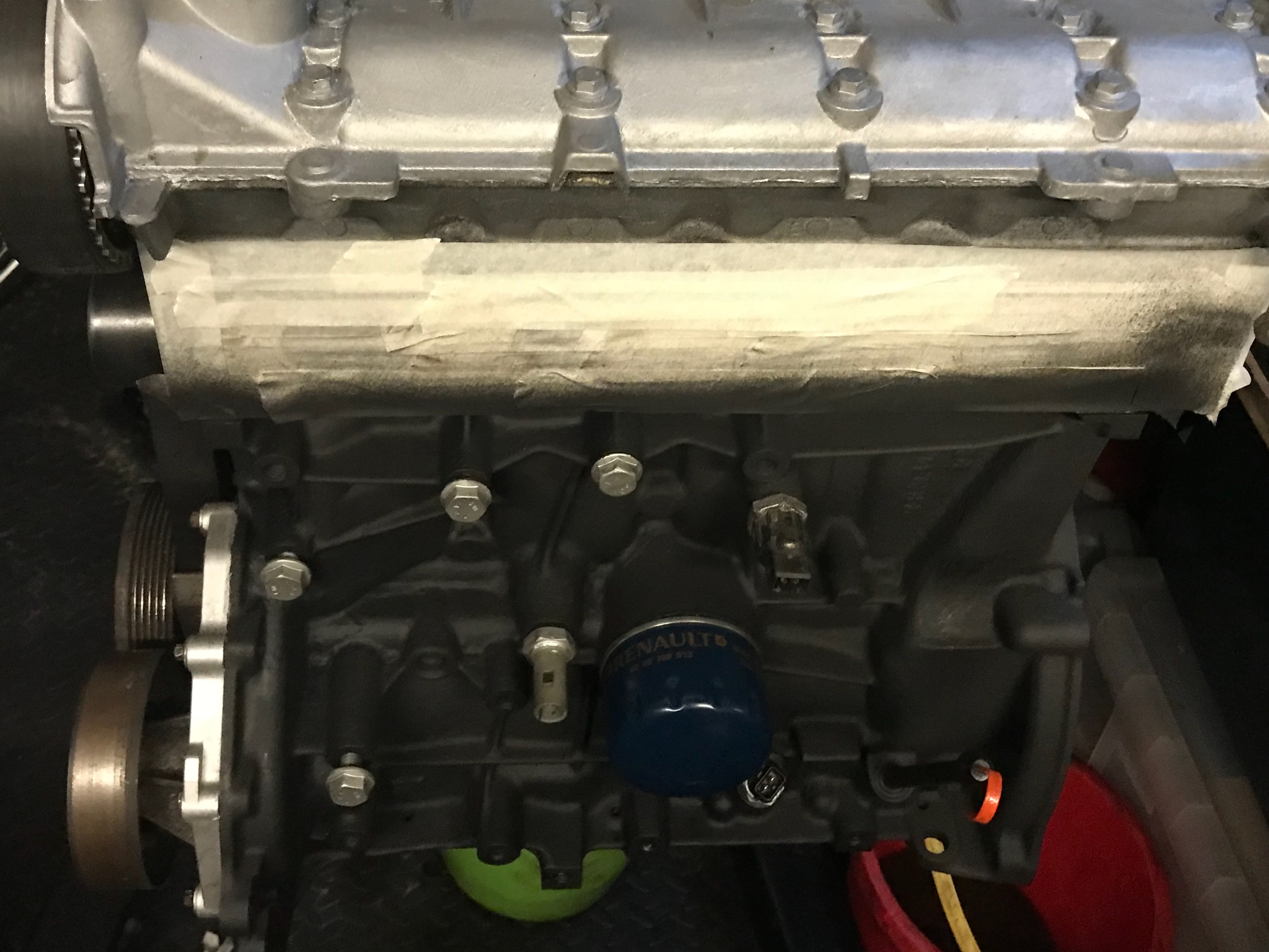

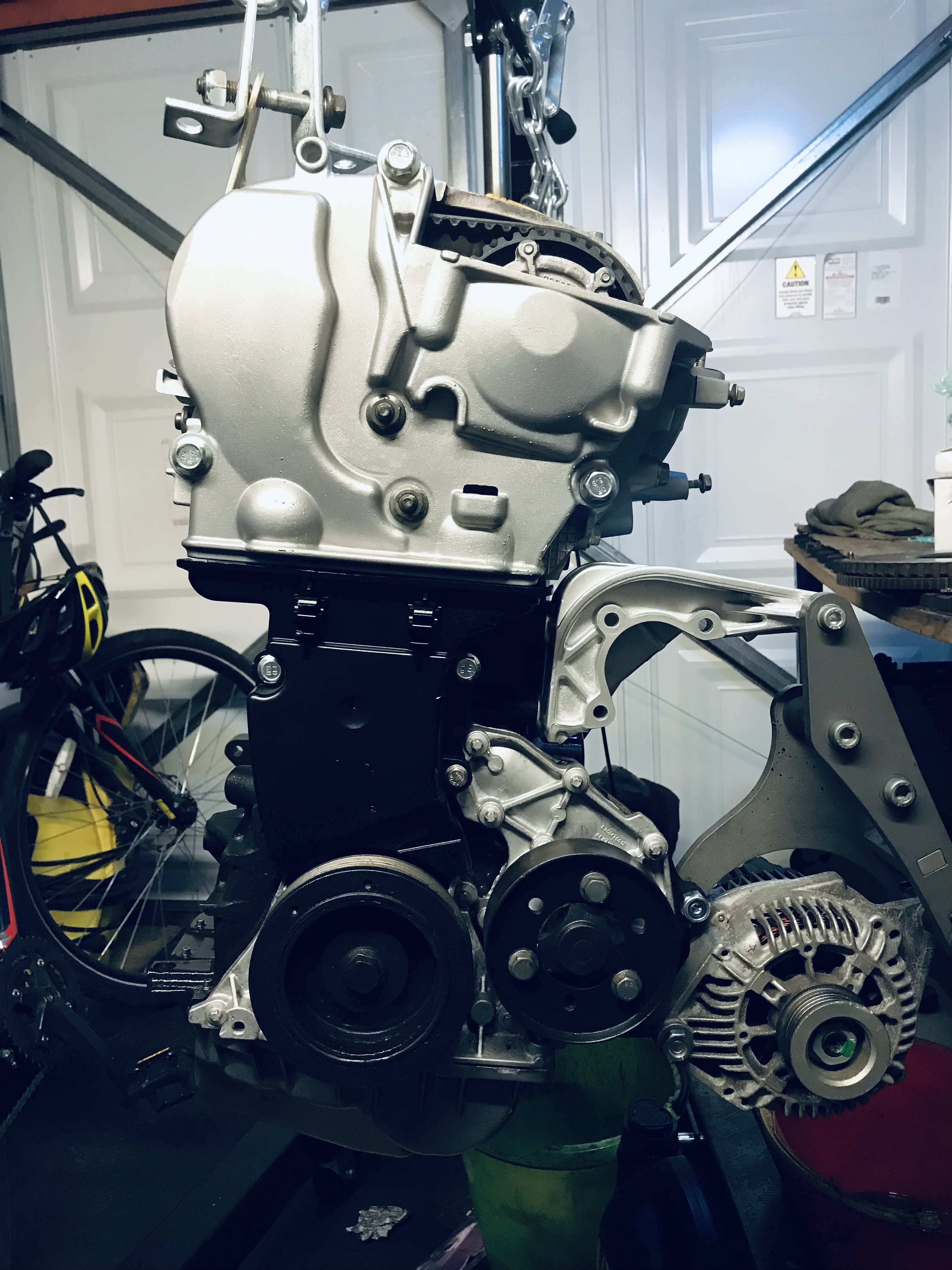

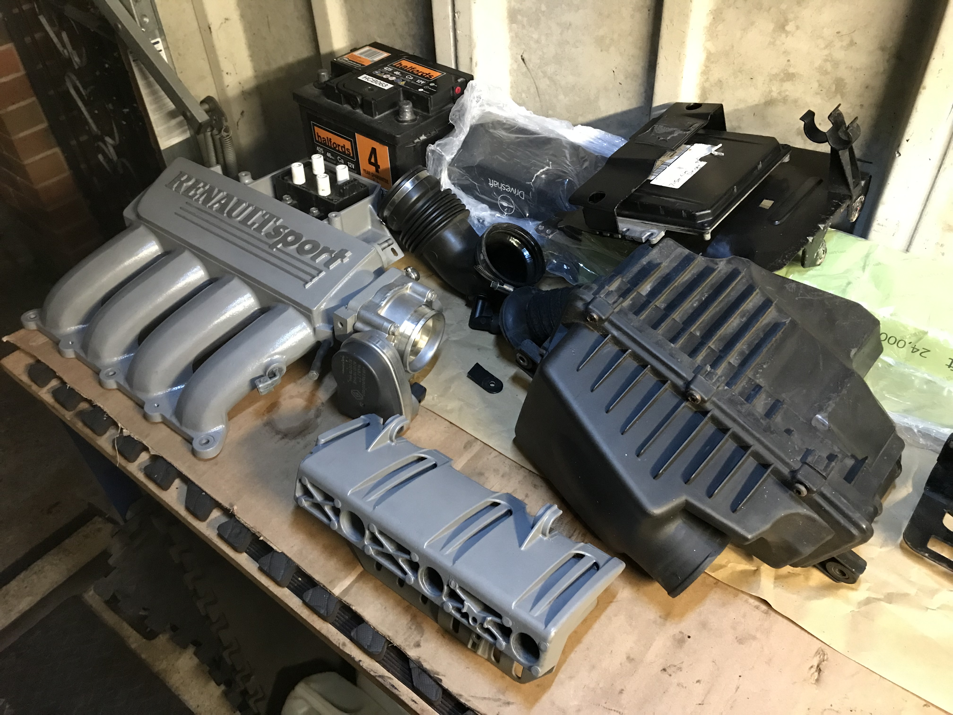

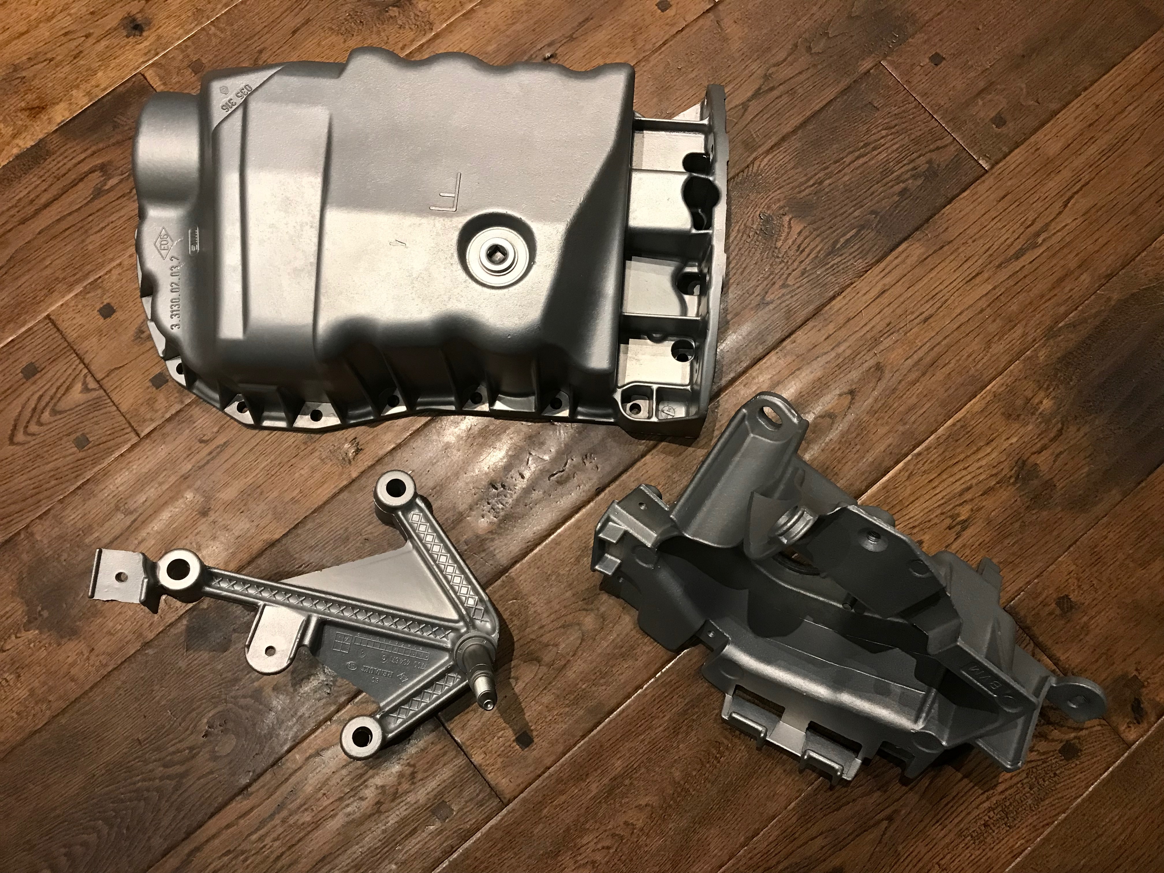

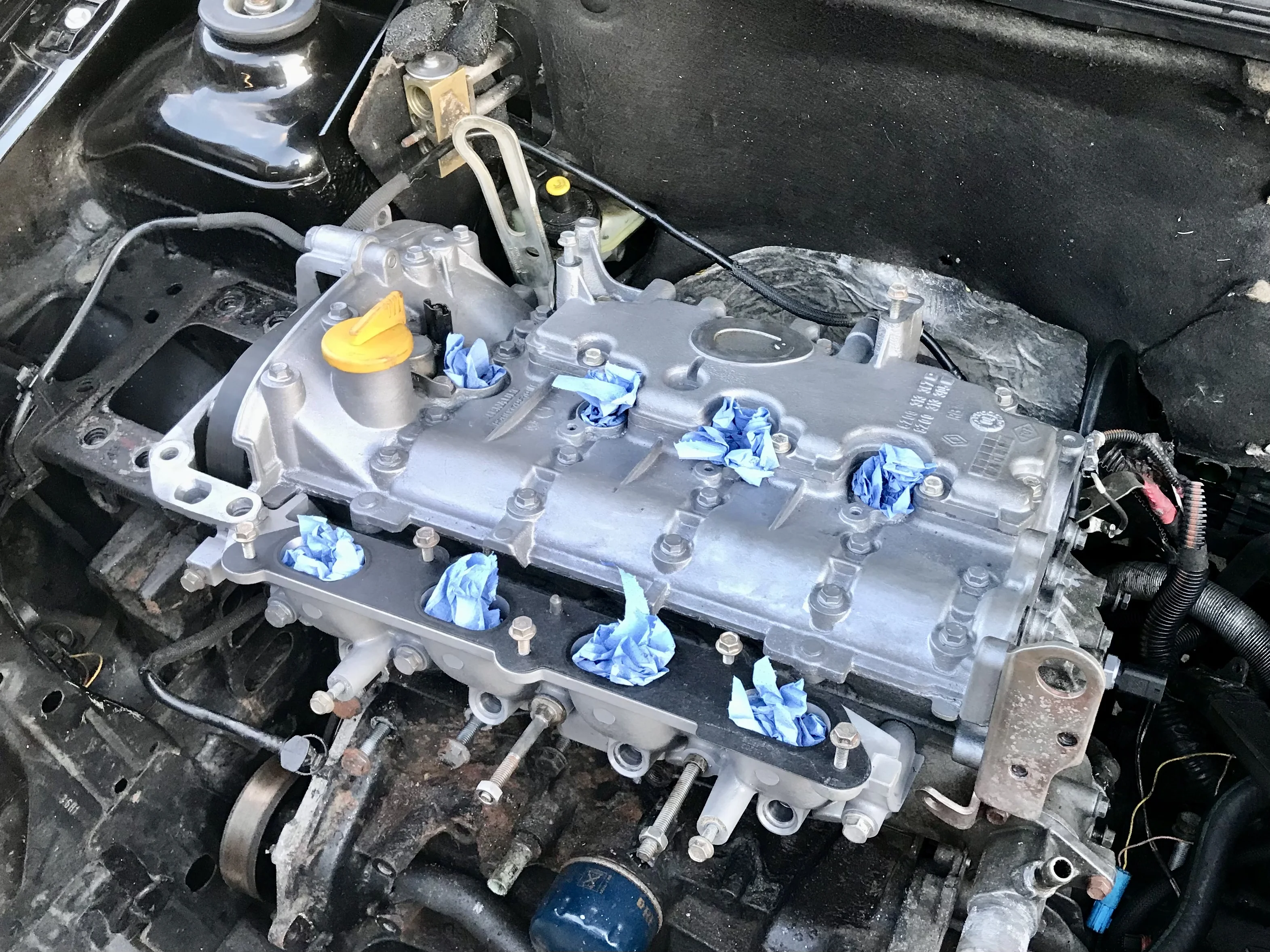

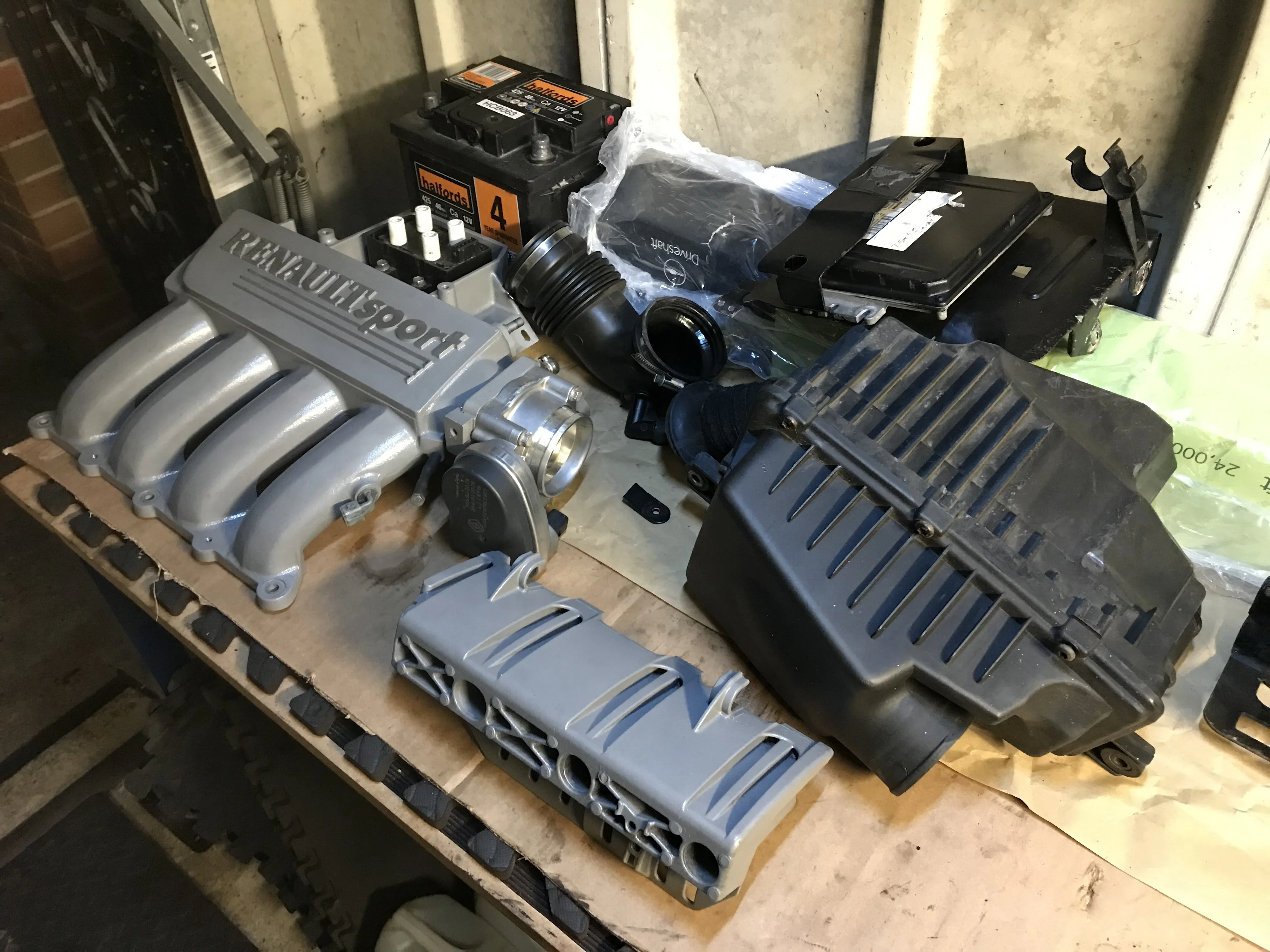

Began cleaning up the engine and brackets this week. 17 years of filth and grime right there 👇
Actually taking the engine and box out has been a real eye opener for me, more on that later. Super happy with how these turned out though and can't wait to see it all back on the engine and car.
Had a good think about engine paints and how i was going to approach cleaning it up. It wasn't overly rusty, more oily and dirty, so set about degreasing and removing any corrosion with DEOX-C. I'd have loved to have shot blasted it but i haven't got one of those, so just wire brushed as much as i could.
I went for a charcoal matt finish in the end to try and get as close to OEM as possible. Pretty please with how it looks and it'll really pop once the top end is cleaned and alloy parts are refitted. I hate those refurbed engines with a Black shiny gloss finish that you can clearly see the rust coming through underneath. This one should stand the test of time ;)

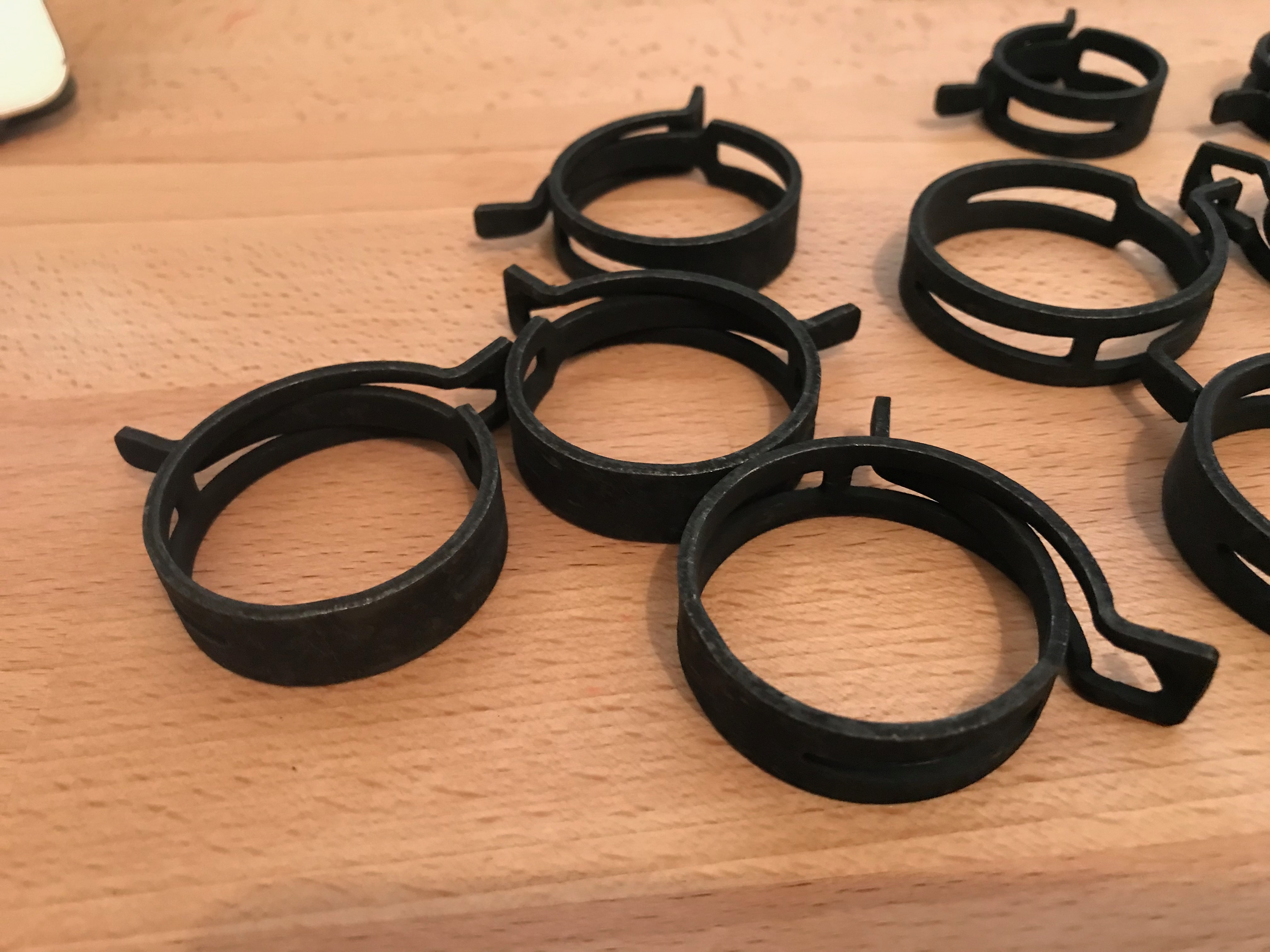

New radiator and coolant pipes also arrived as well as some Mikalor Spring Band Clips. Again, trying to stay as close to OEM as possible. These will rust as soon as the damp weather hits them, so i'll be preparing them against that prior to fitting.
Tons of other things going on with the car which i'll update as i go along. This could never be about fixing a few oil leaks. I just can't help myself :ROFLMAO:

Your sump just done with detergent and water overnight?? Looks great!
If only Fred. The detergent soak was to soften the grime as some of it was proving difficult to remove. In the end i couldn't get it all out and the pitting was pretty bad in some areas. So i went back to my guy to discuss aqua blasting it. He's a top notch bloke - check out aquablastinguk.com if you need anything doing - and he was super careful not to touch the inside.
Was going to say. Looks brand new. I’ll take a look. Going to pull our engine out to rebuild it in the next few weeks so will be seeing what’s what and deciding if we are going to get stuff cleaned up or not. Looks nice though!

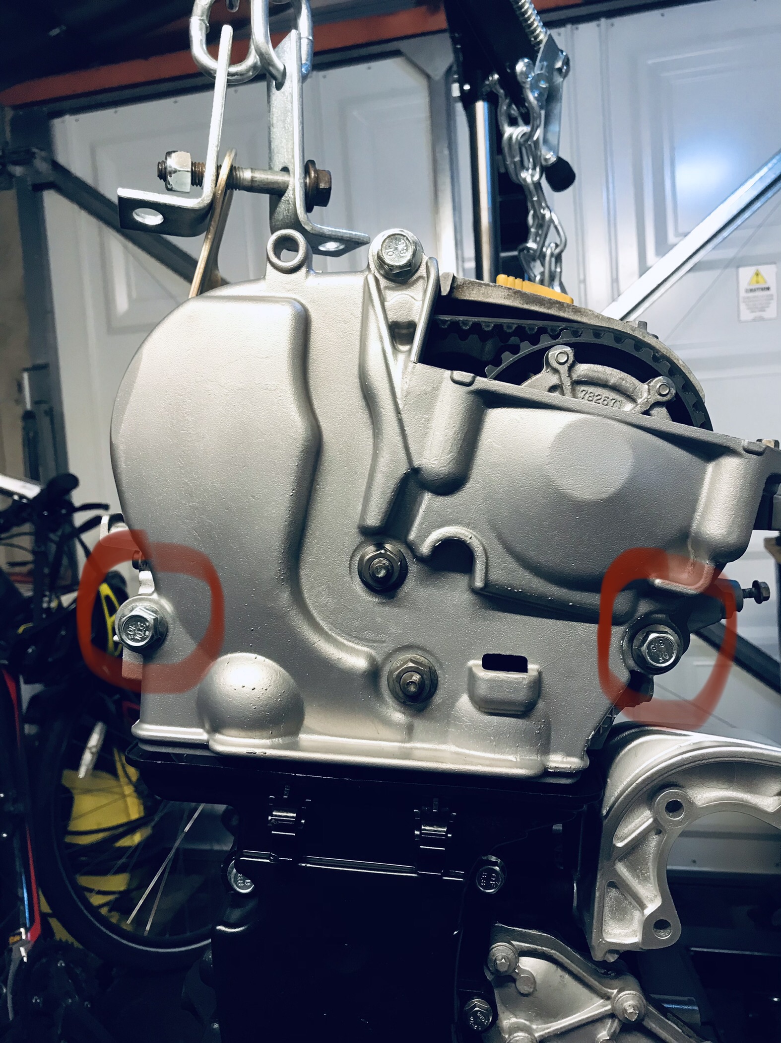

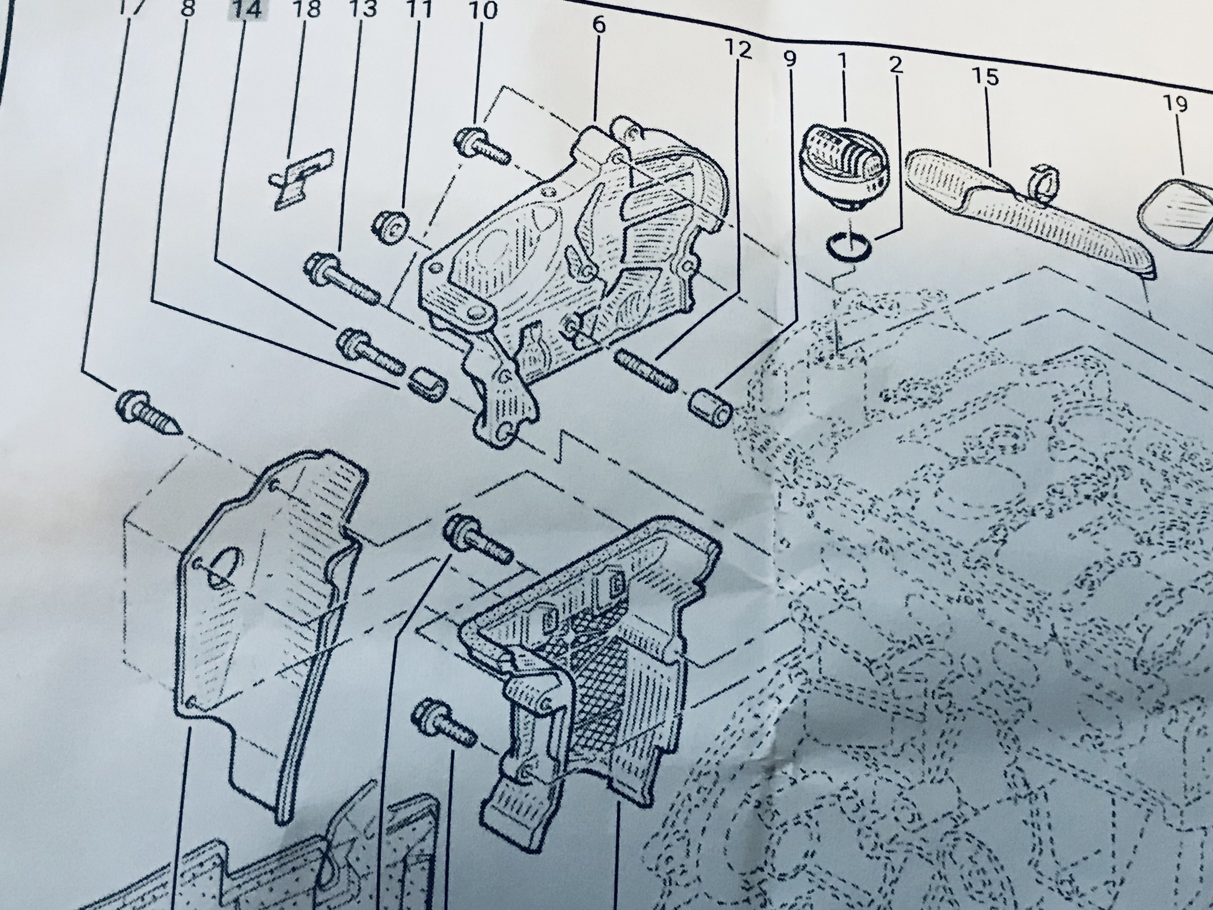

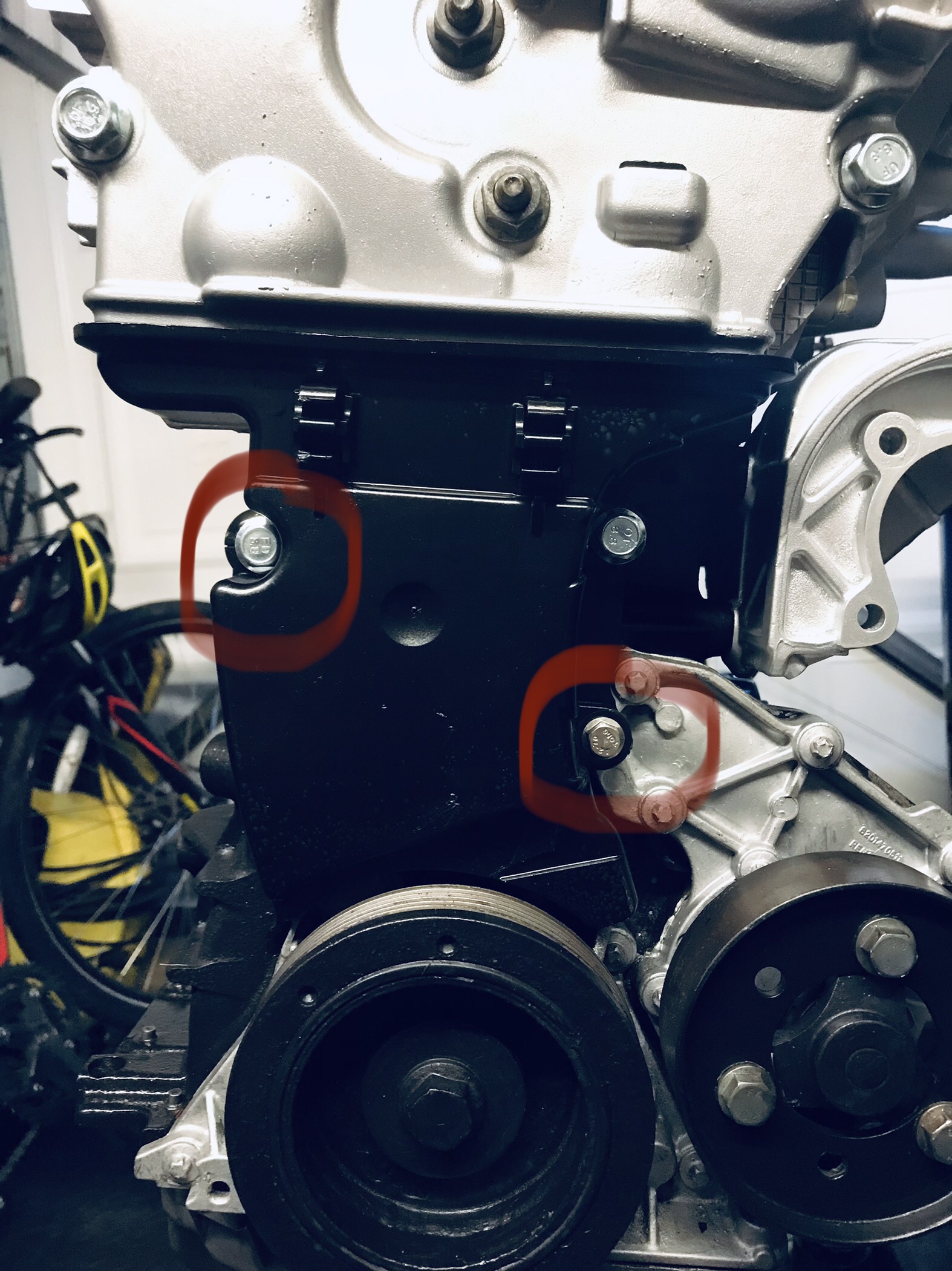

A few satisfying jobs tonight correcting a few bodges/incompetencies from Renault “specialists”. I dare say there are very few.
So when I pulled the engine I immediately noticed a few missing bolts on the timing covers. How I never spotted it before is beyond me, but it is a little tight down there oh er 😐
Circled in red are the replacement bolts, which I managed to get from my local fasteners. Thanks to Paul at RMB for his print out which gives you the bolt sizes.
Top cover
Lower plastic cover
So effectively these were missing 5 bolts out of a possible 7. They were tight and haven’t caused me any issues but more worrying is the car went in to get the timing belts, dephaser done at a local Renault Specialist.
Now I can’t say for sure if it went in like that or not but I’d expect a specialist, or any garage for that matter, to have a duty of care. A quick call to say Jon there’s 5 bolts missing, would you like me to sort, would be the minimum I’d expect.

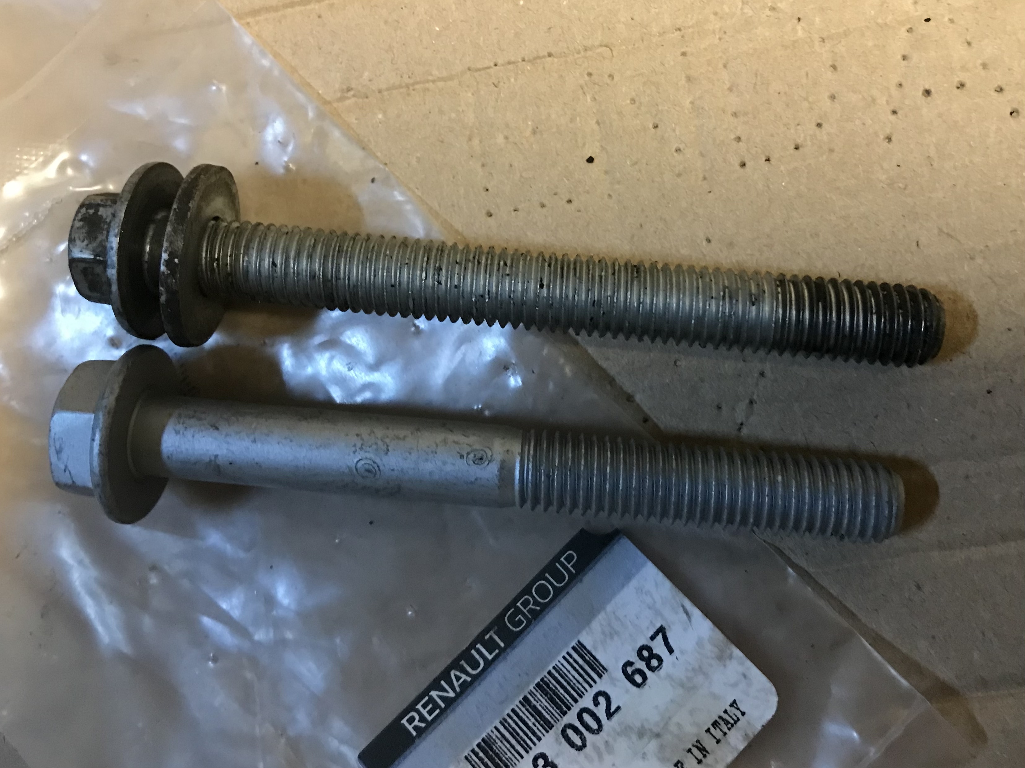

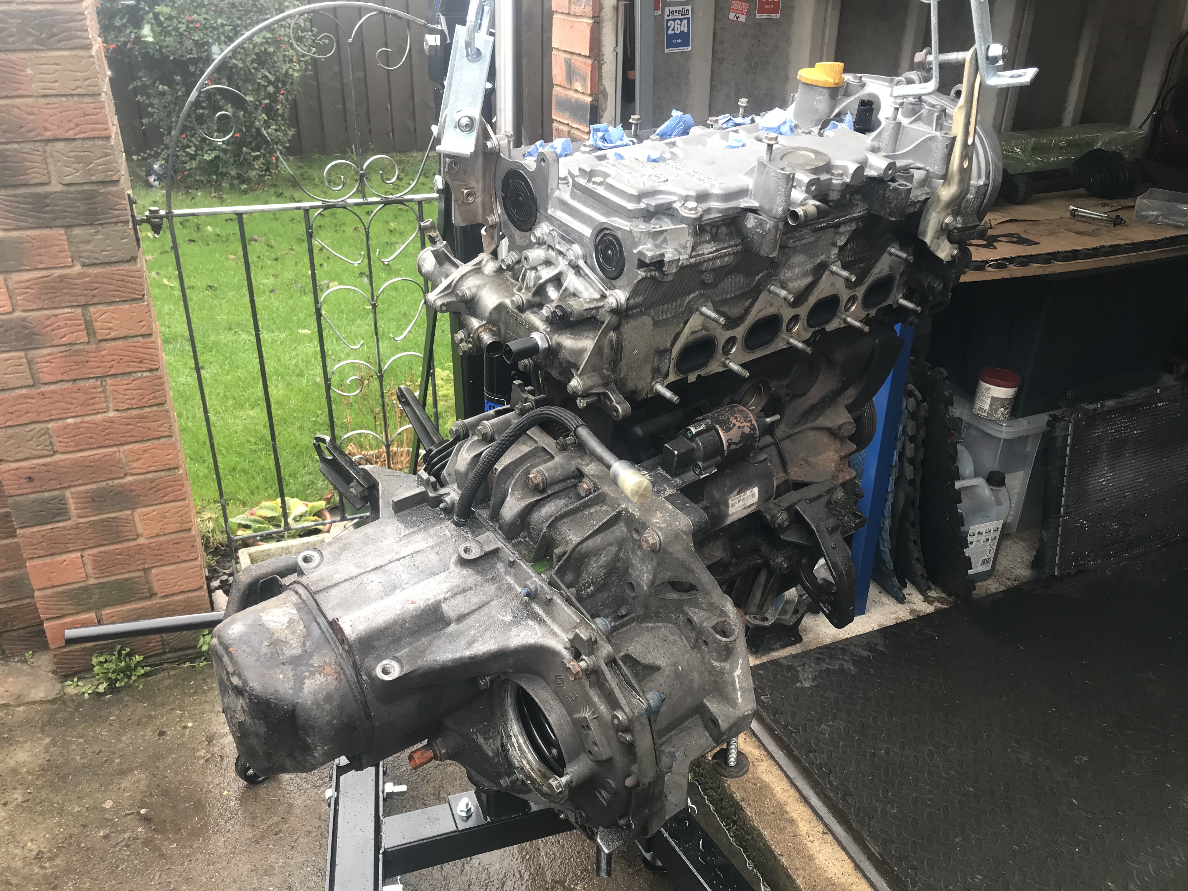

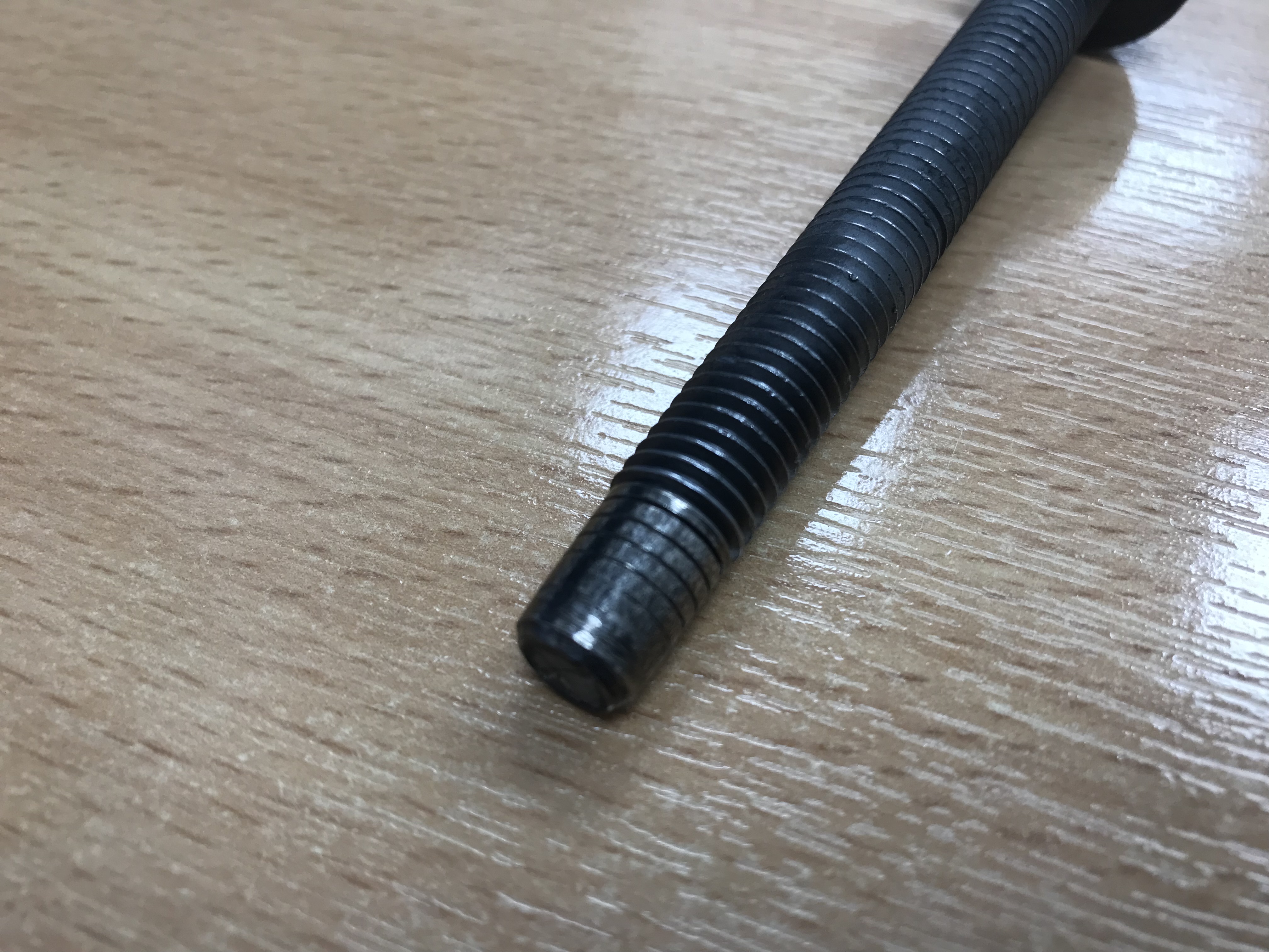

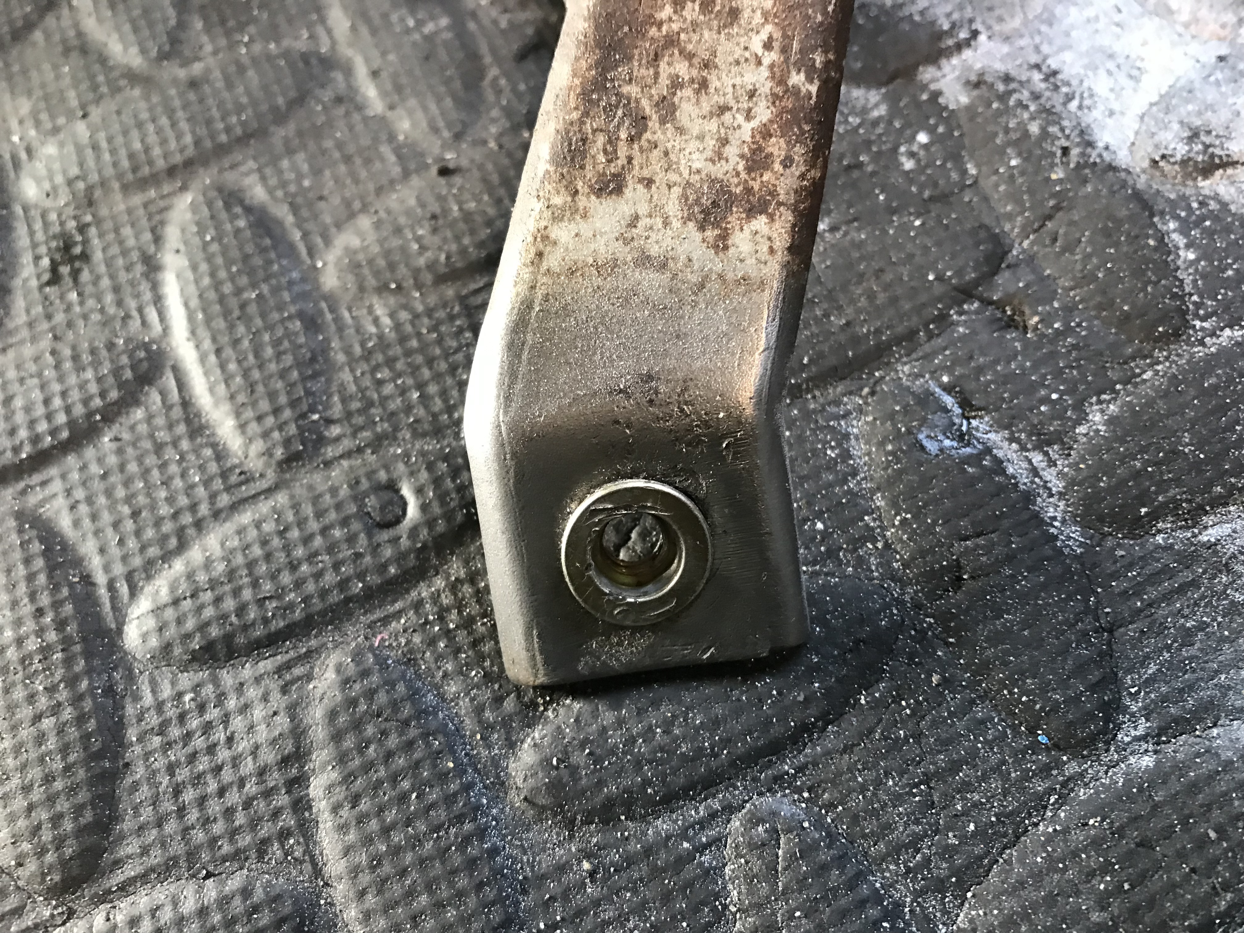

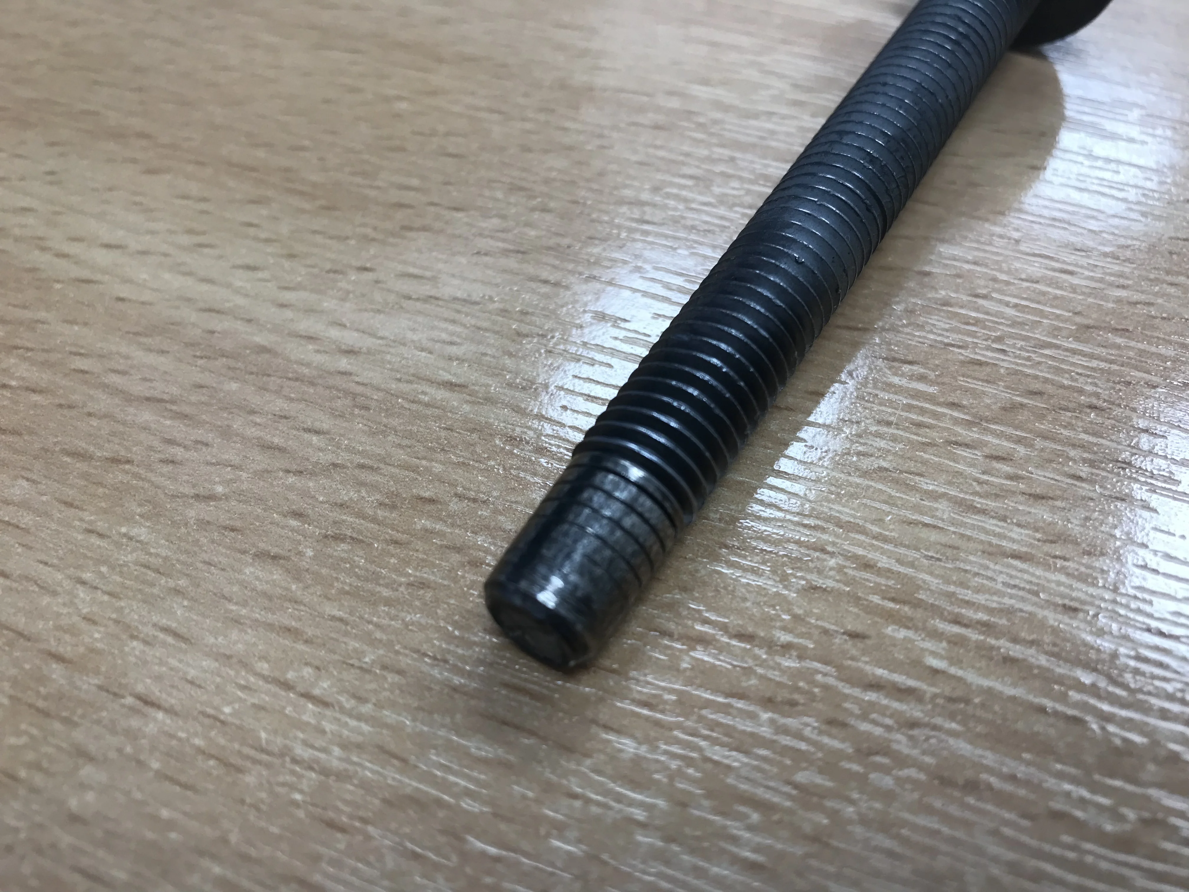

Anyway on to bodge 2. This wasn’t done while the car was in my possession and not by my local specialist, but by one not a million miles away has since gone out of business.

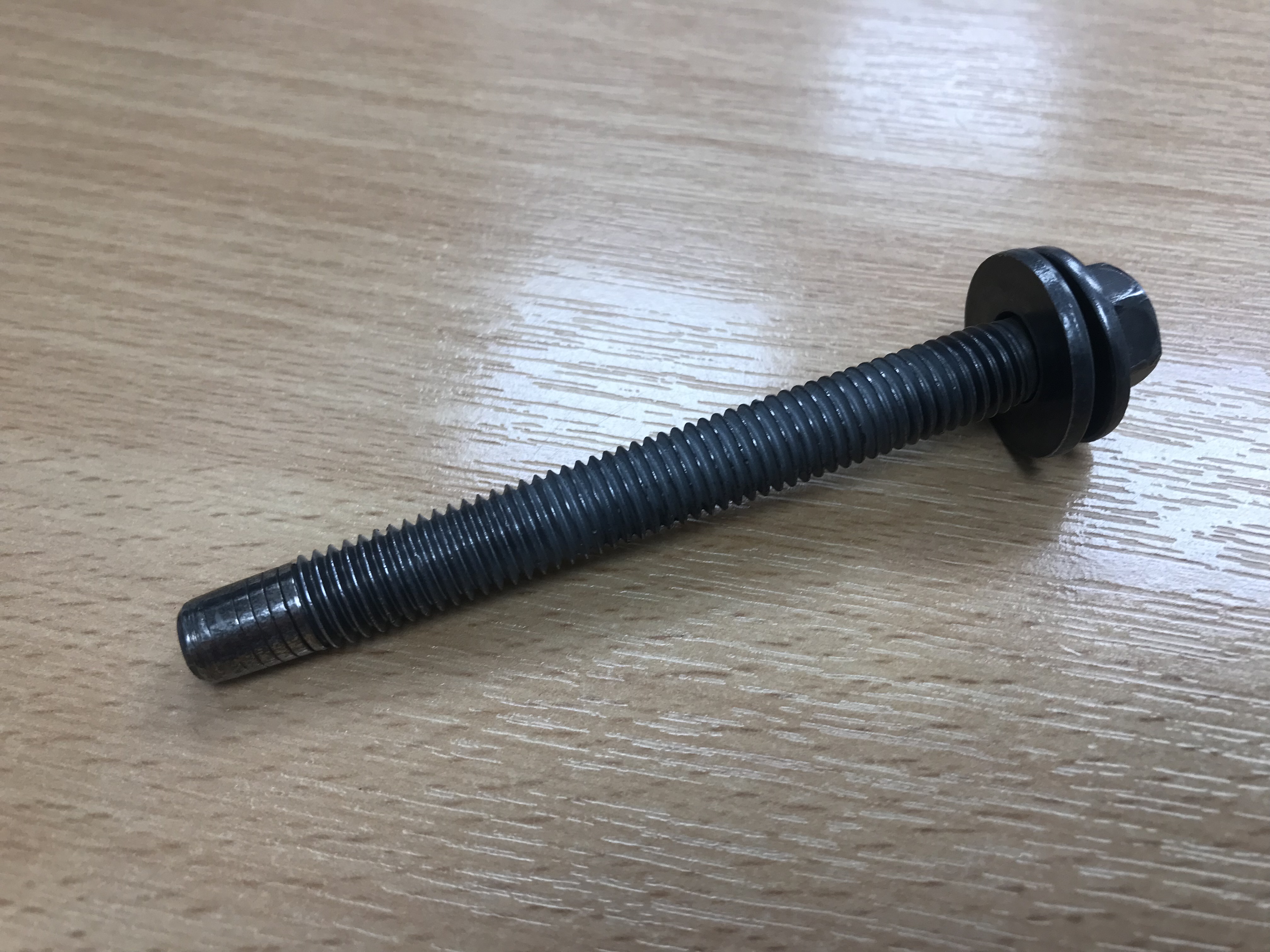

When I removed the box from the engine 2 of the 3 upper bolts were loose. One actually pulled out by hand thanks to the cross threading.
I initially thought they’d been over tightened until I went into my local Renault dealers to see if I could get genuine ones. Luckily you can.
Mechanic - that’s not a gearbox bolt mate it’s off a garden gate or something like that 😂
Tha gearbox bolt.
The garden gate bolt is slightly longer, so the chimpanzee would have found the bolt wouldn’t quite tighten as it’s touching the engine block. A few extra ugga duggas would of then stripped the threads.

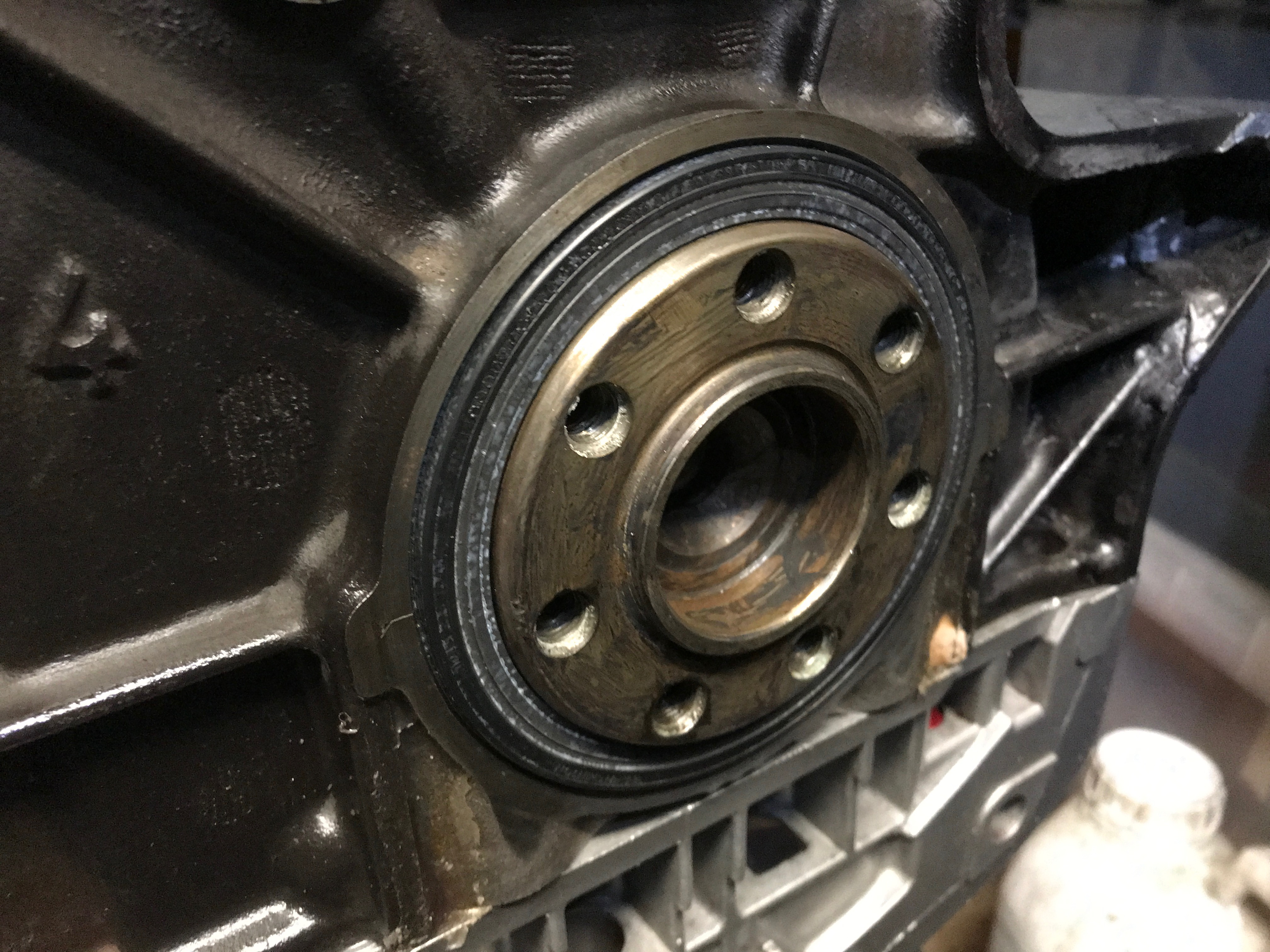

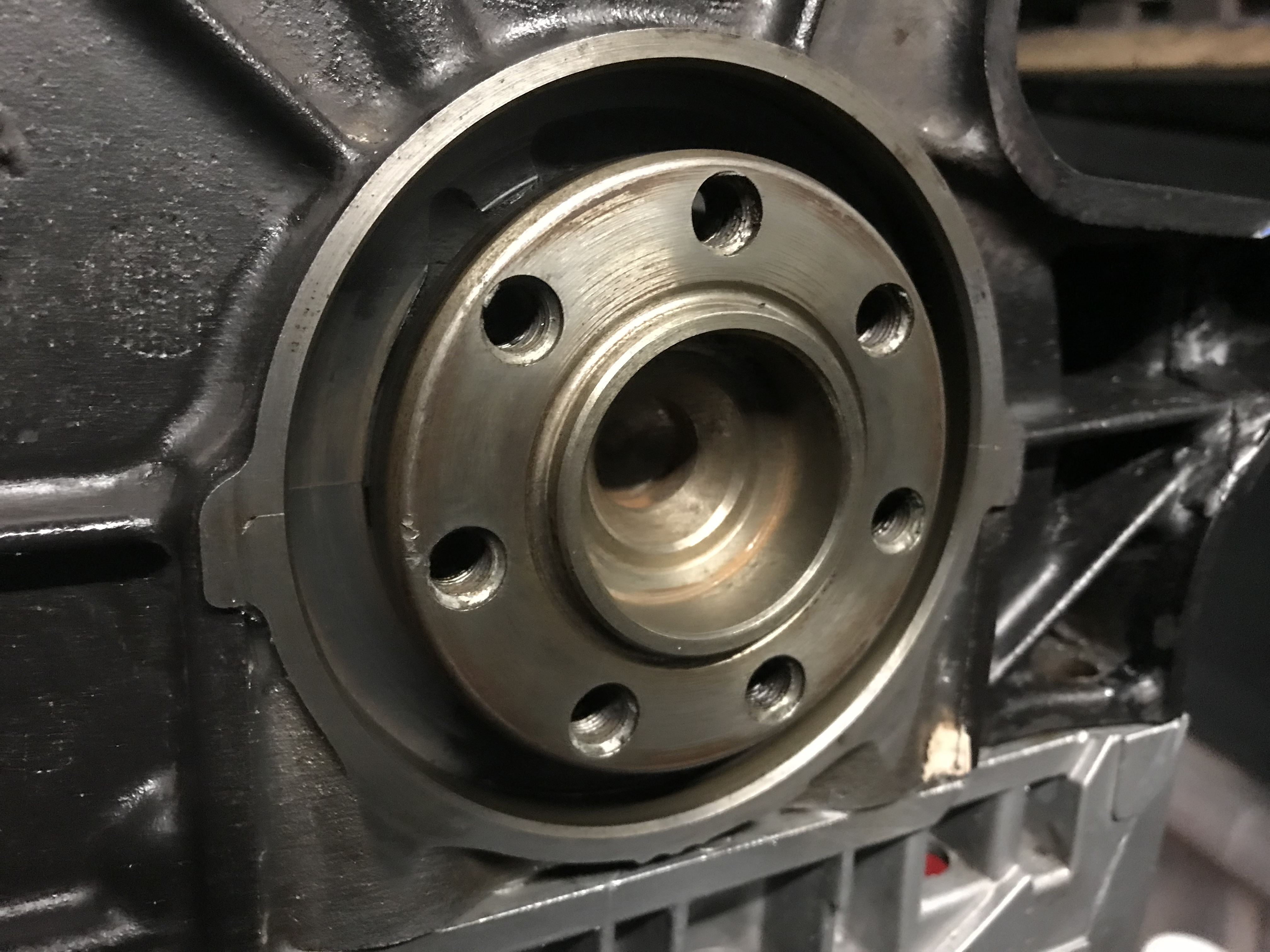

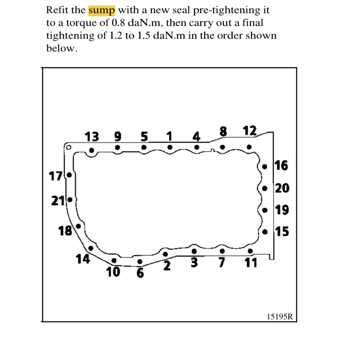

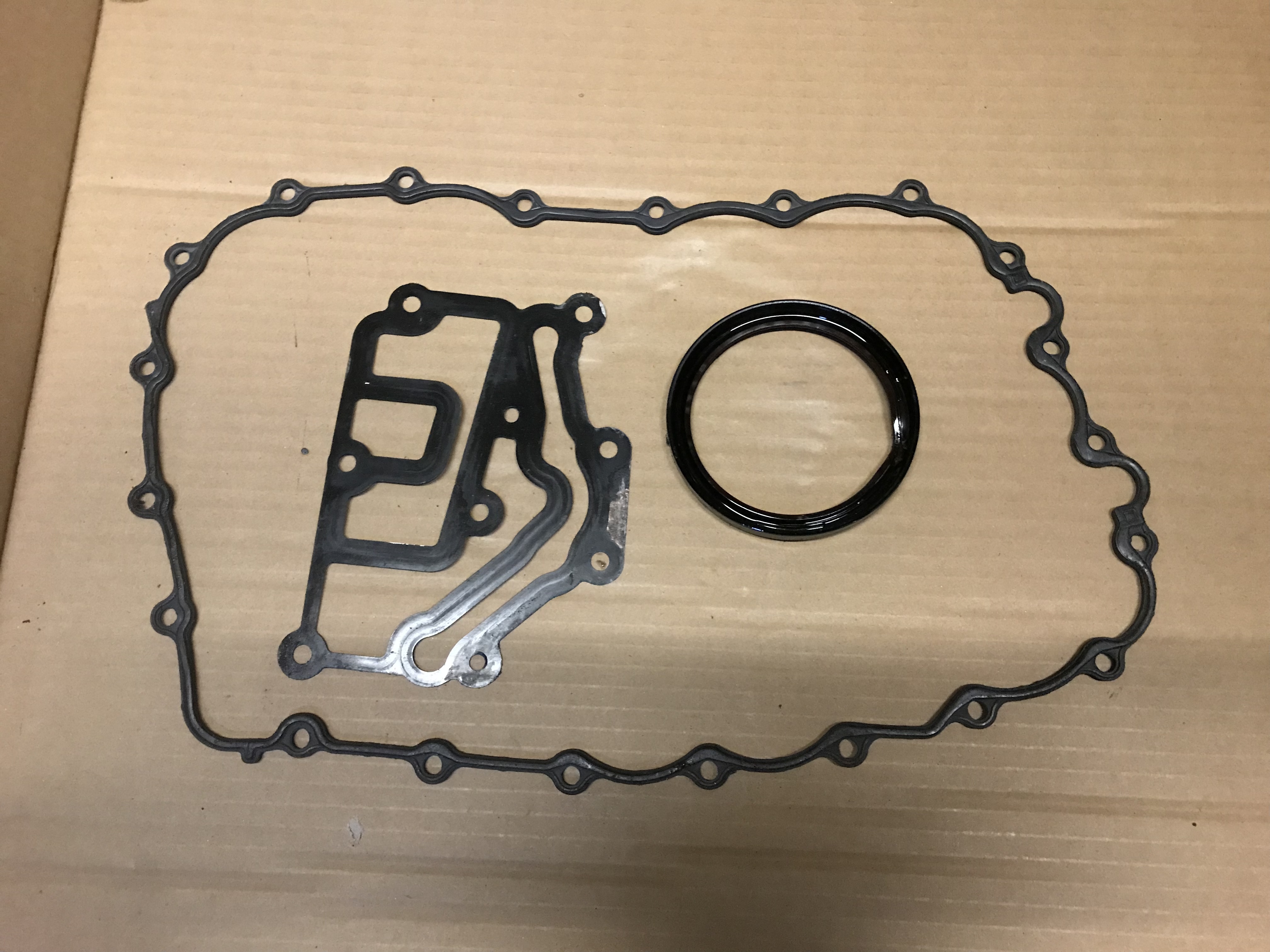

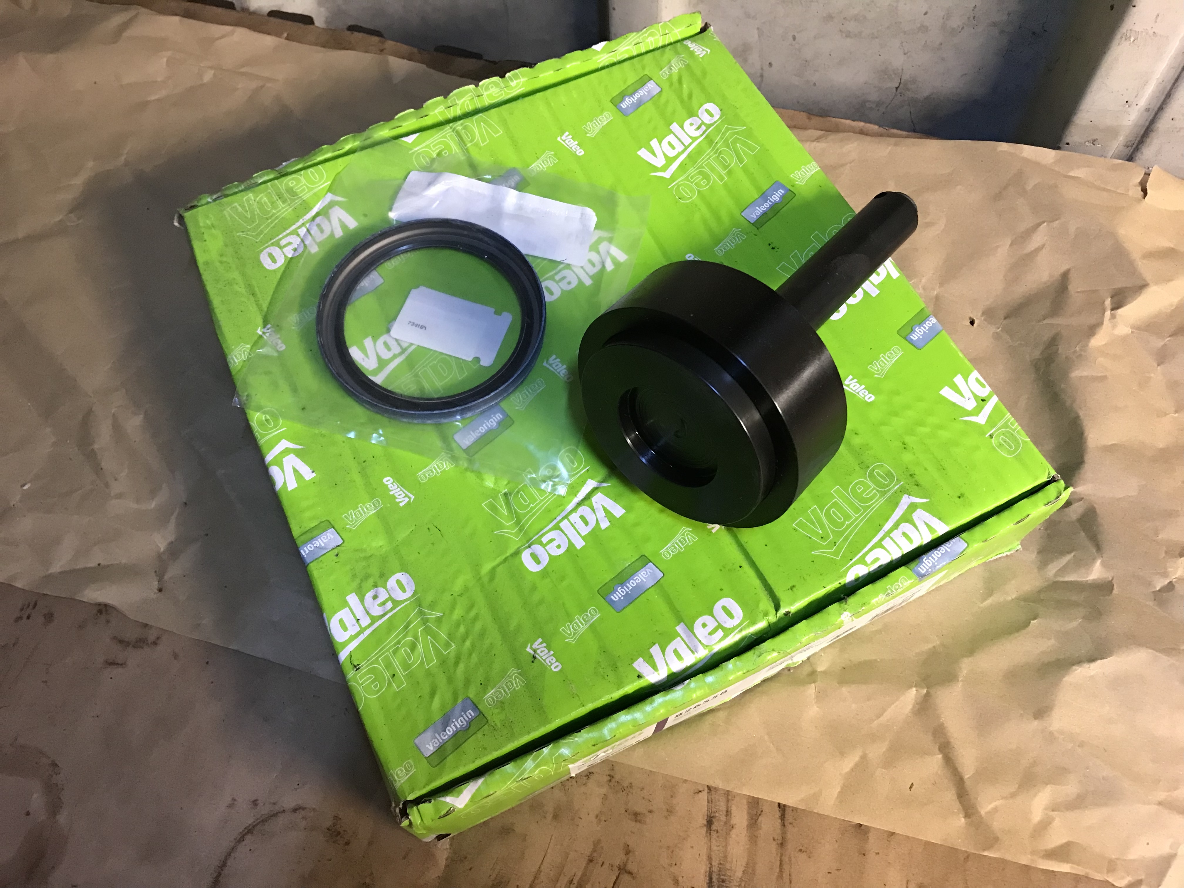

Ended up replacing 3 gaskets as a precaution including sump, thermostat housing and crank oil seal.
Sump was easy thanks to an online workshop manual.
Thermostat housing not too bad once I tilted the engine back to stop a small flow of oil seeping from the block.

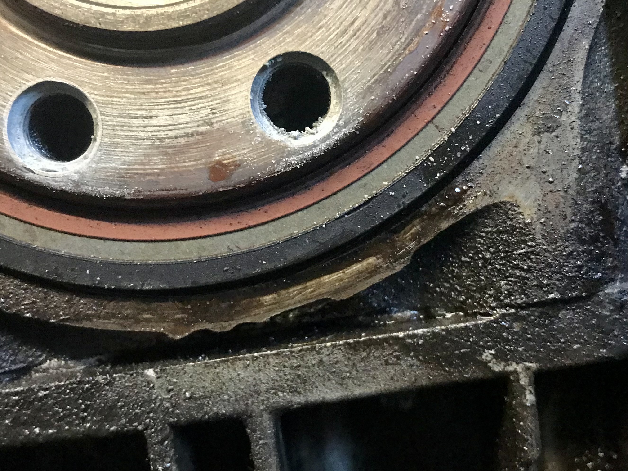

And finally the crank oil seal which I managed to put in at the wrong angle, despite using the correct Renault tool 🤦🏻‍♂️
You can’t see it from this angle but trust me it’s not even 😂 I’ve had the engine on a 45 degree angle for 2 days and It’s not leaking. But I dare say that’ll all change when the engine’s spinning at 7,000 rpm.
Removed it, bought another one and will have another attempt tomorrow 😅

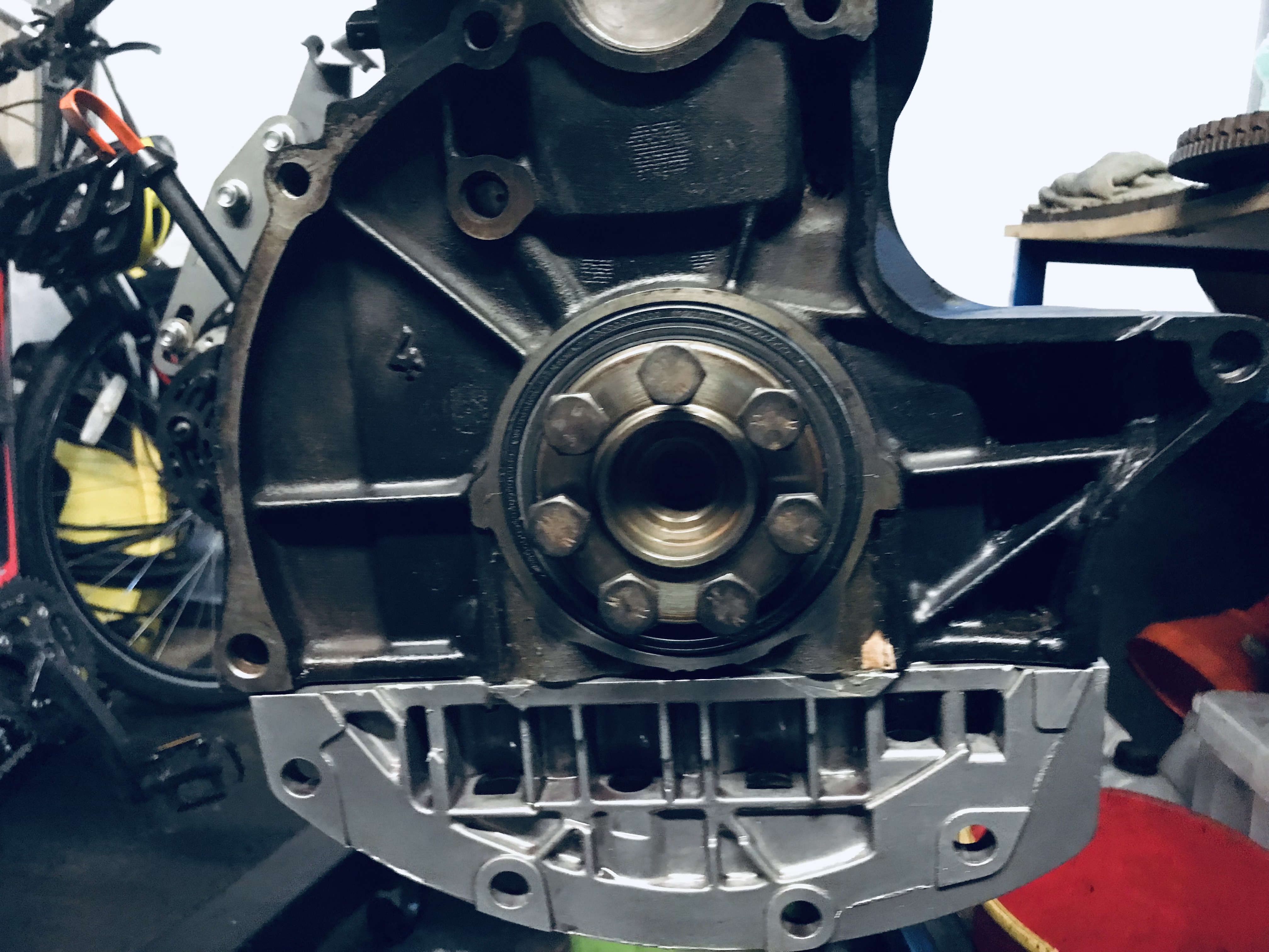

Slow progress over the last few days but progress non-the-less.
Current gearbox looking a bit weepy, which is to be expected at 131,000 miles so it's going off for a rebuild. In the interim i'm going to use my spare gearbox from my Black Gold track car, which i removed at 79,000 miles when i had a Quaife diff put in. Just needs a clean up and it'll be spot on.
At the second attempt i got the crank oil seal in. At £41 per seal it was an expensive c**k up on my part, so i made sure the engine was flat on the floor so it couldn't move around. Looks spot on now. How people put these in without the proper Renault tool is admirable.

If you want to do your crank seal, let me know as I have the proper Renault tool which makes it a doddle-ish 😅

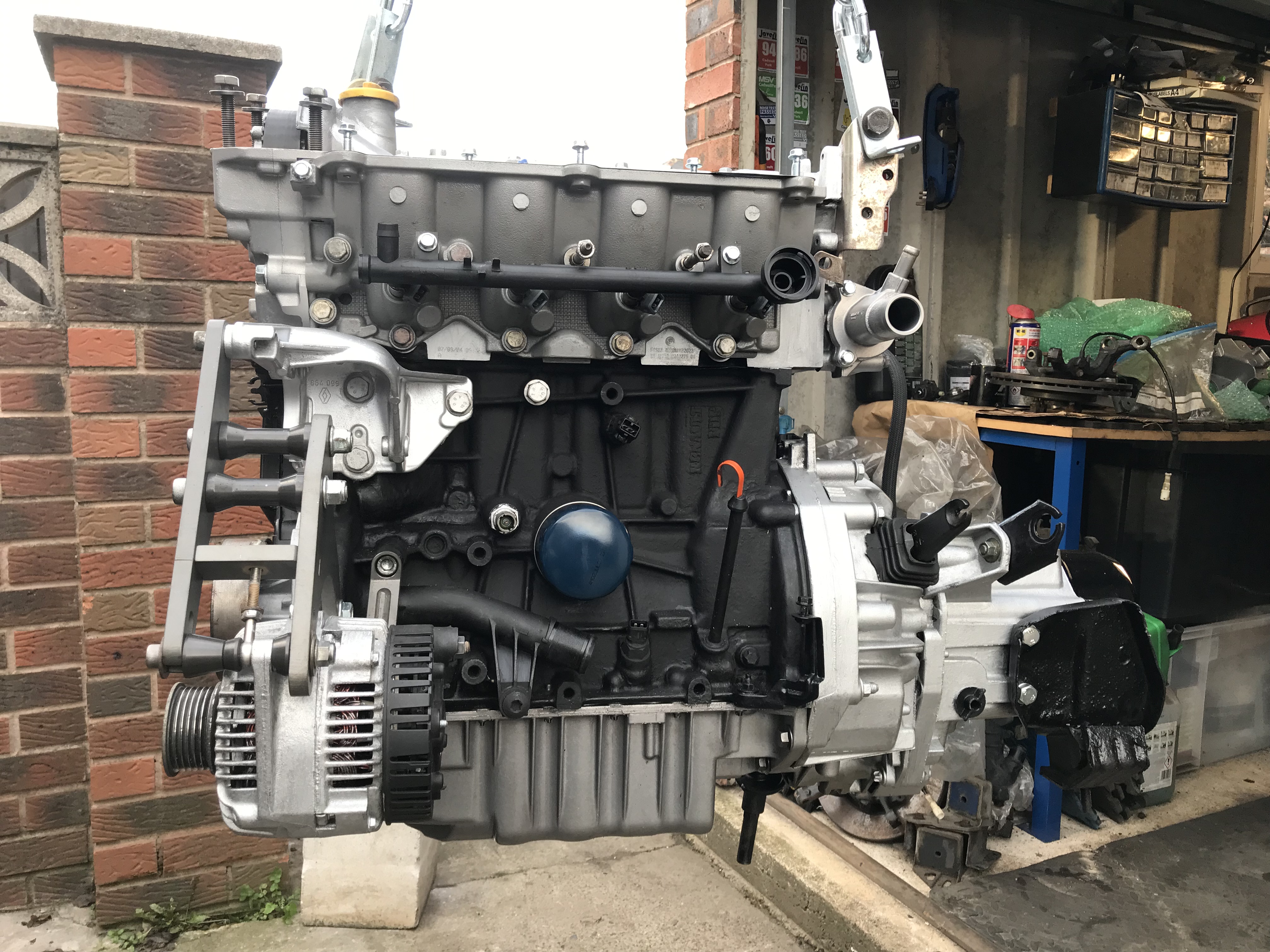

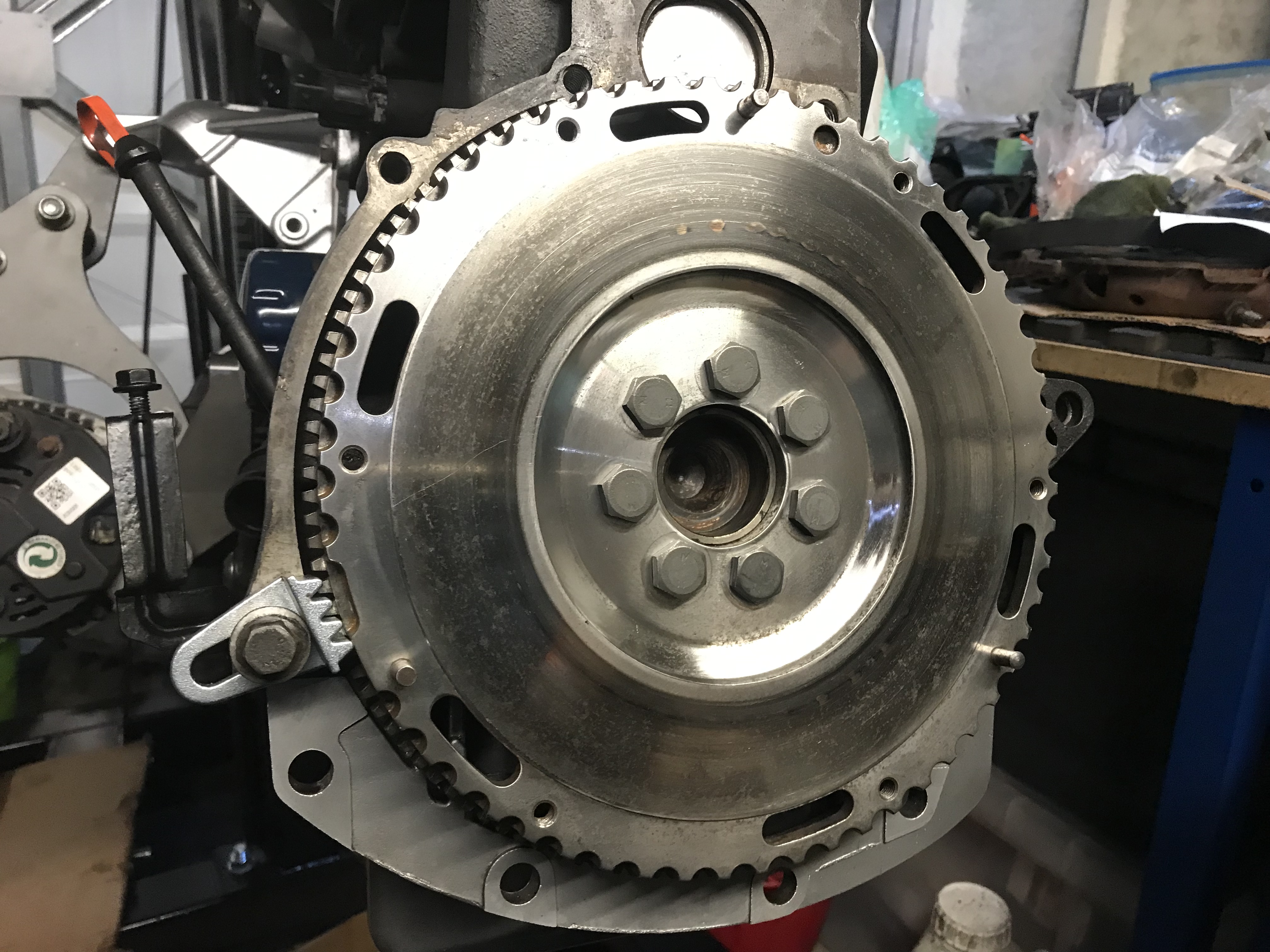

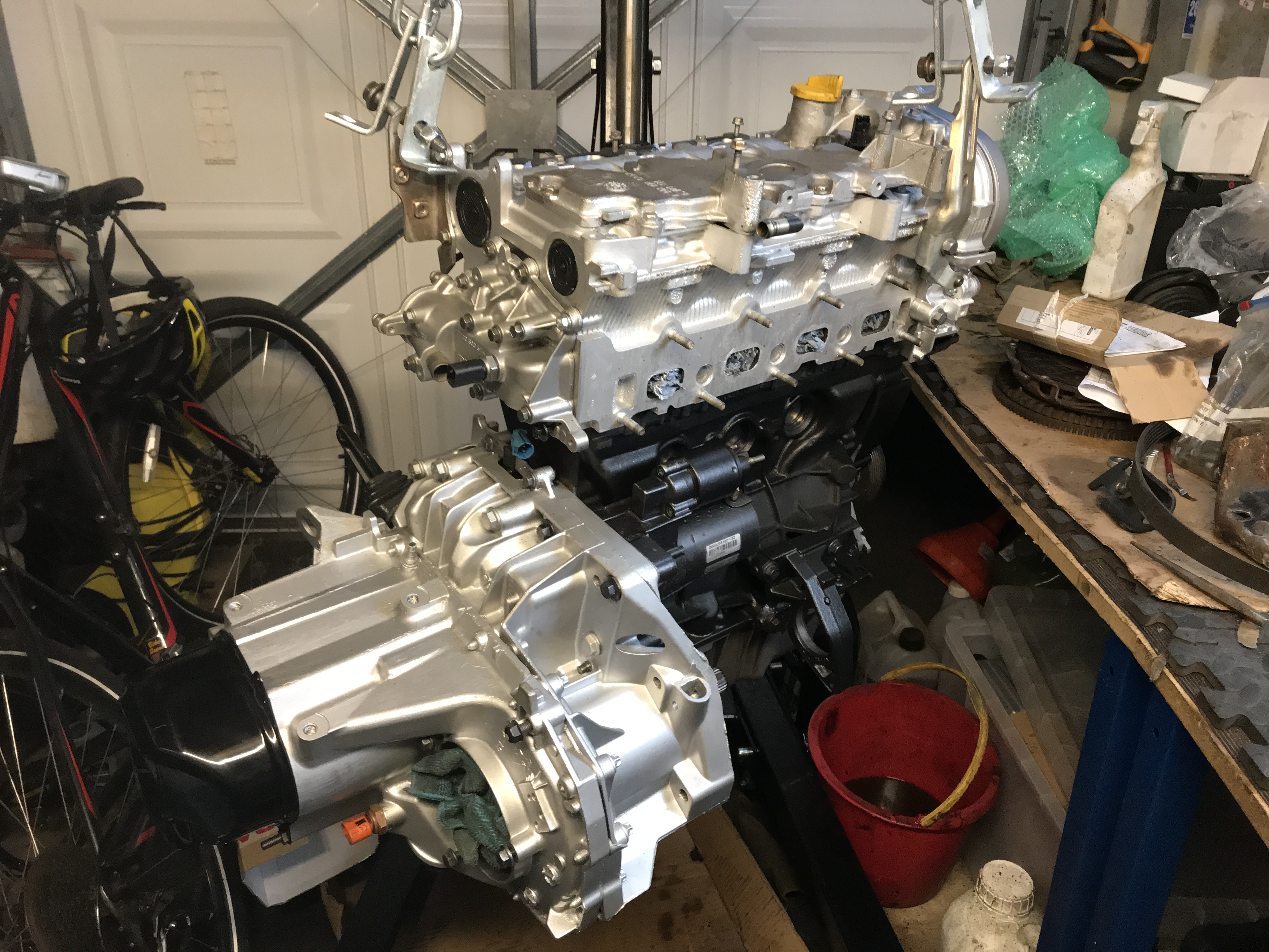

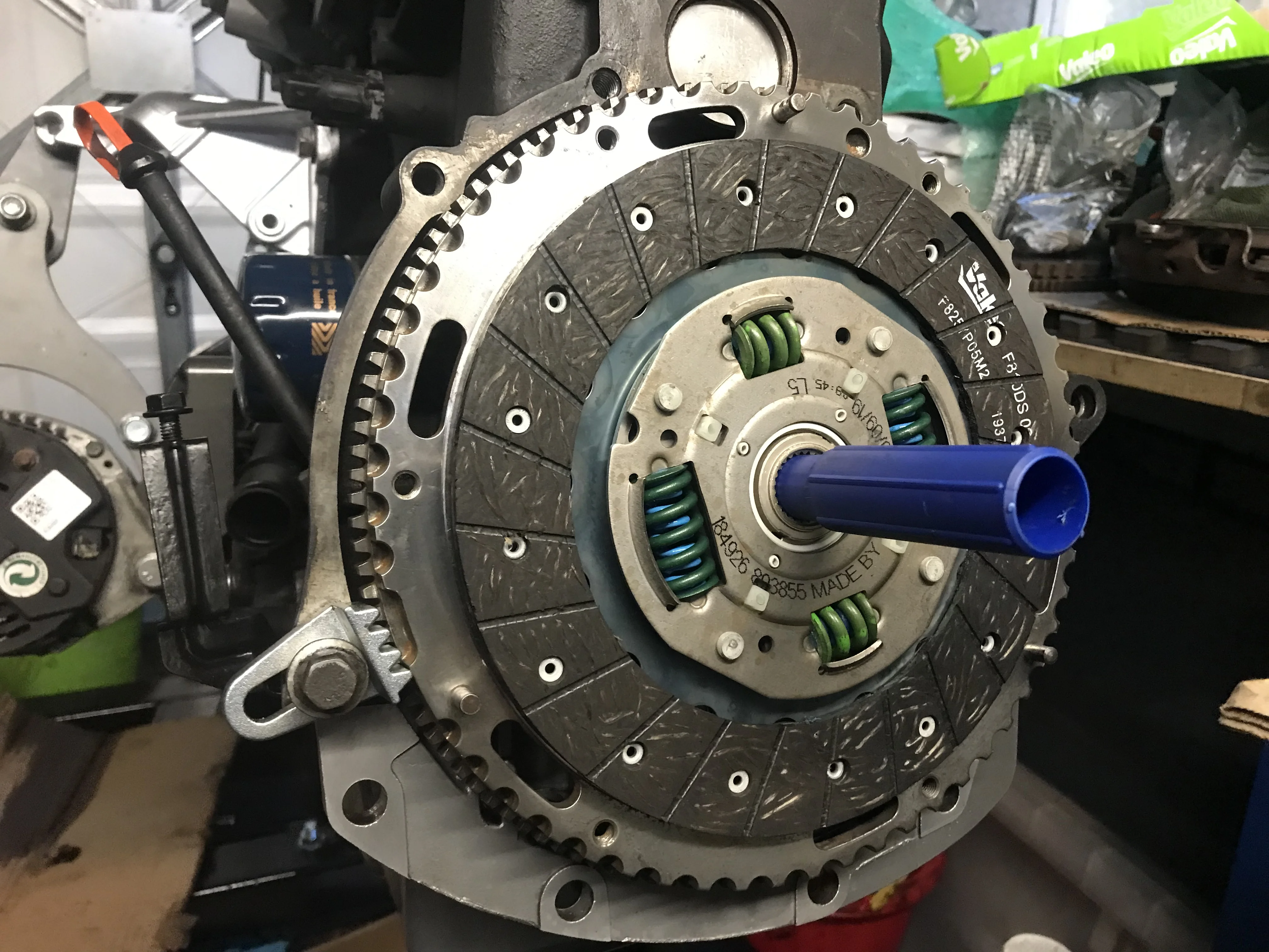

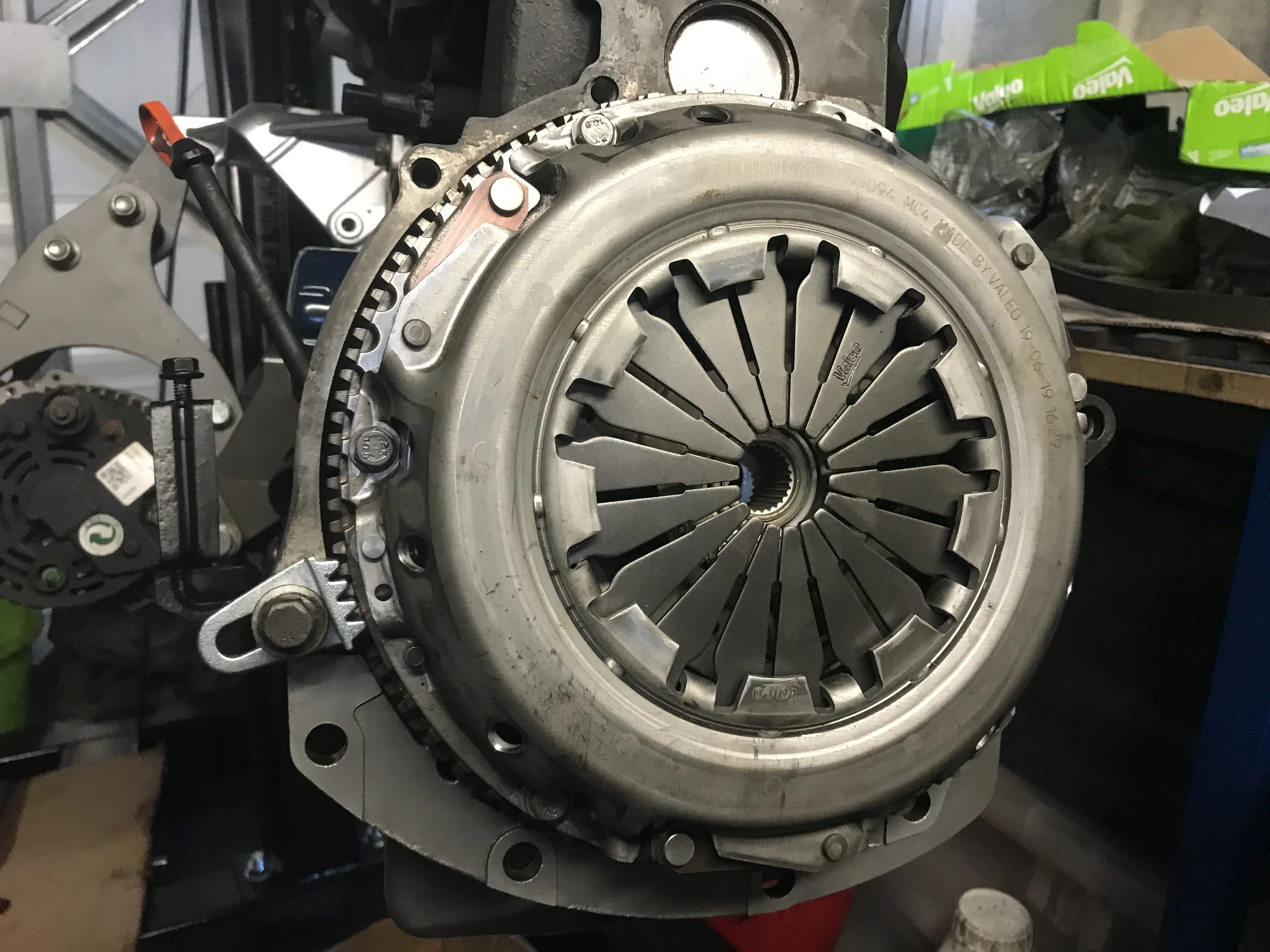

Last bit of work on the daily before I focus my attention on the track car and Croft on Monday.

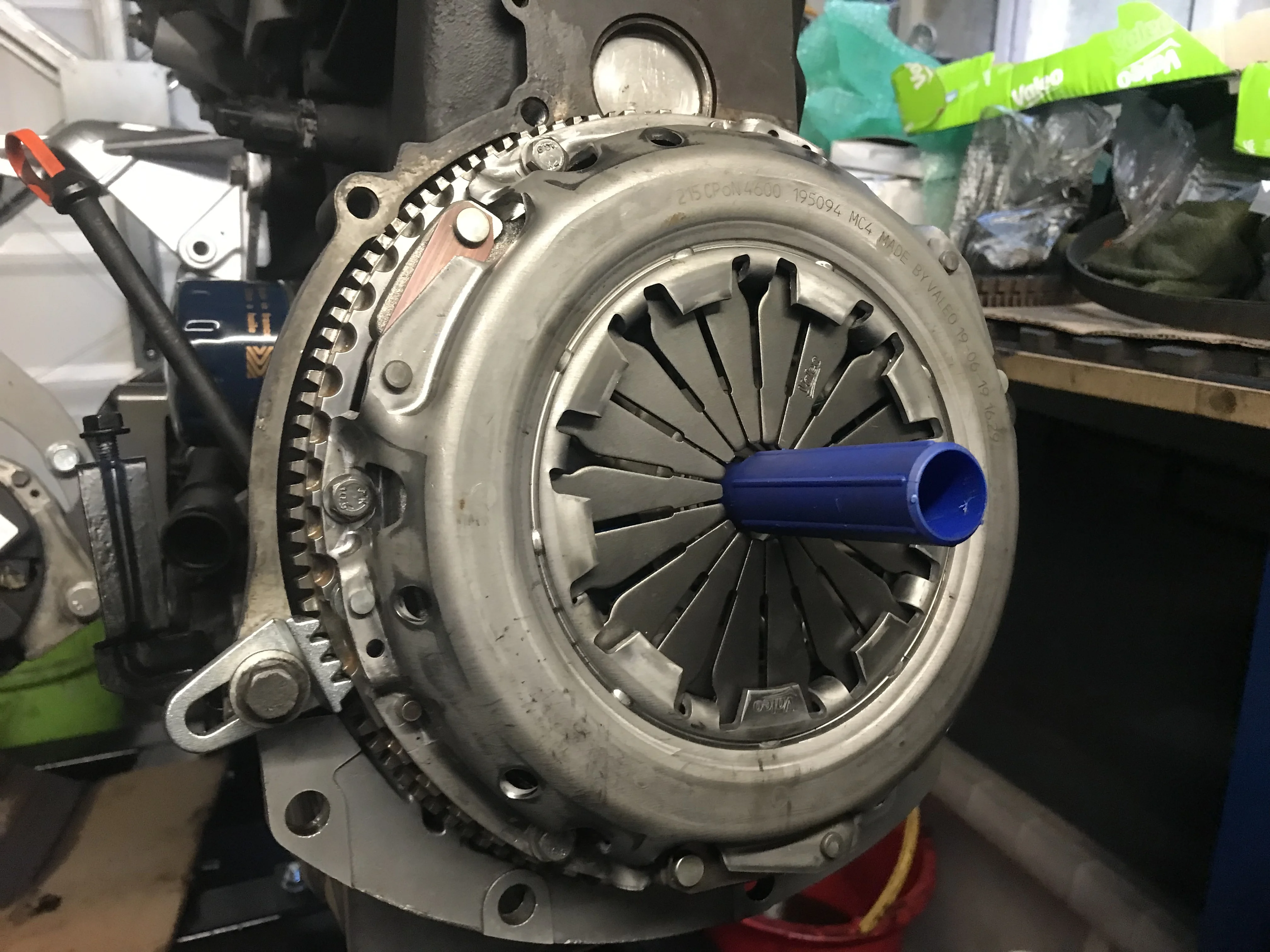

Got a really good TTV Lightweight Flywheel off a good friend who races in TDT. He fitted it, tested it at Donny and didn’t like it. Karma in action right there.
Got it fitted - new bolts of course - then fitted the clutch and cover.

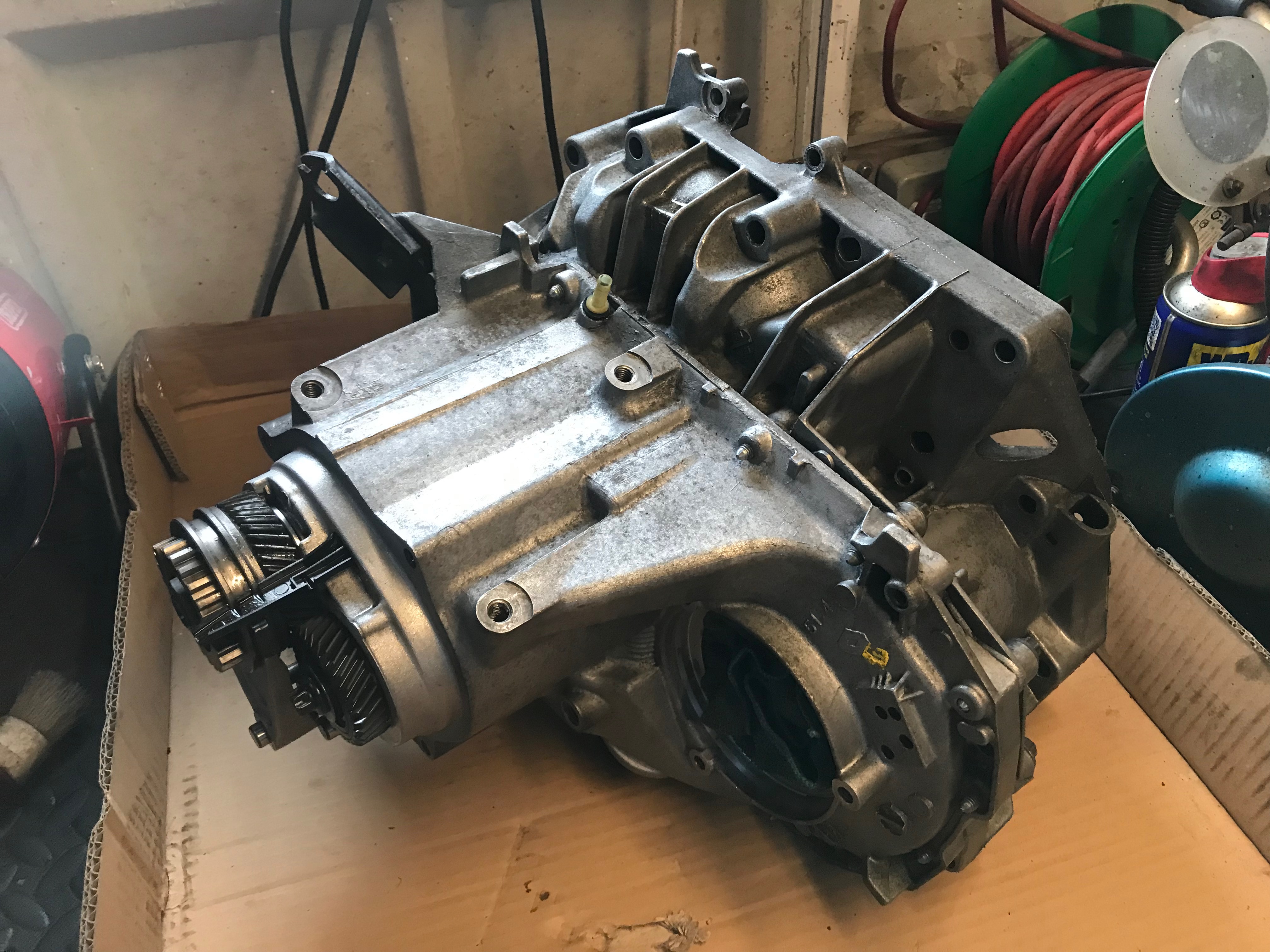

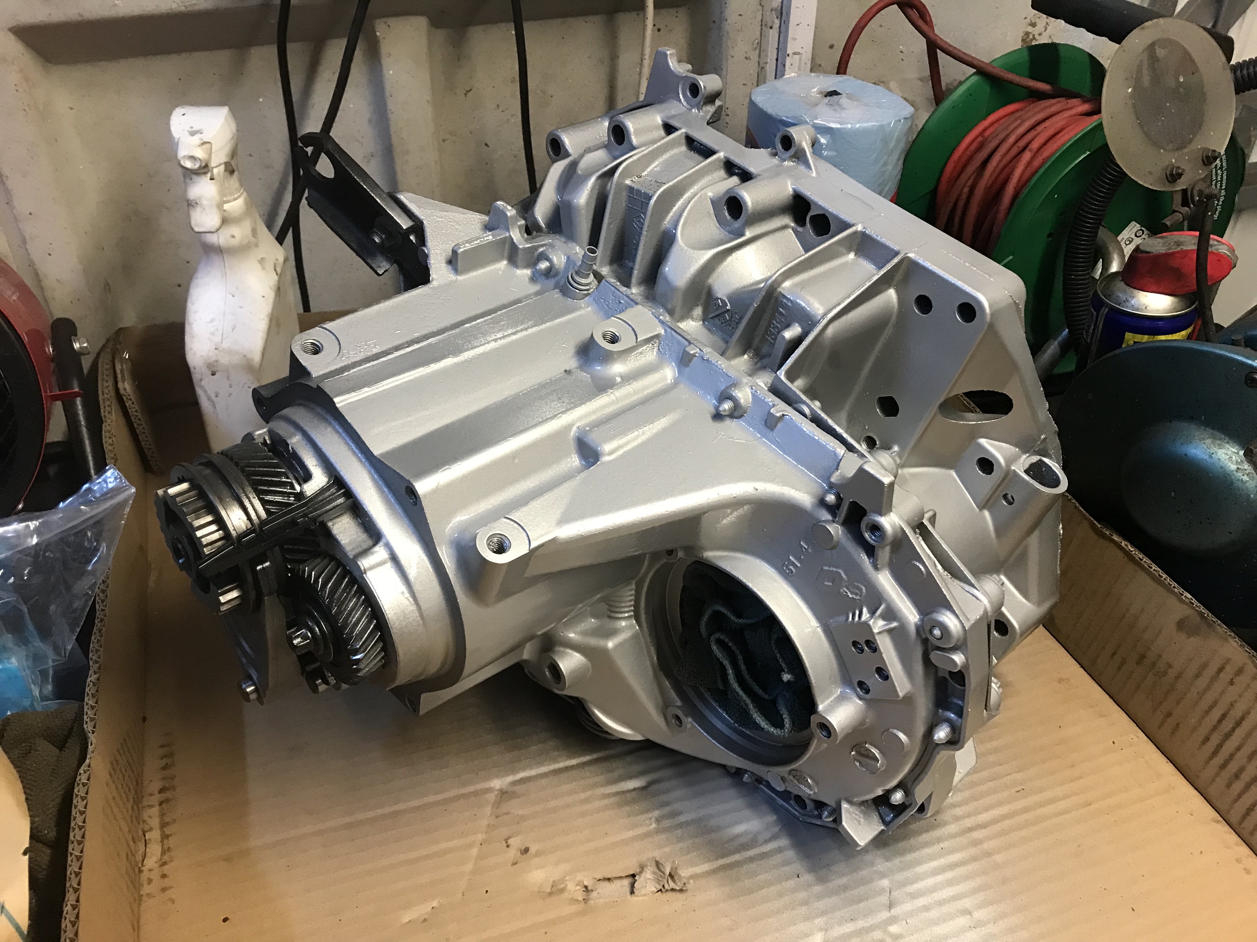

Ran out of time but made a start on the gearbox. I’d love to take it apart, have all the casings aqua blasted then reassembled. But I know it would never work again 😂
For now I’ll settle with degreasing it and giving it a lick of VHT paint.

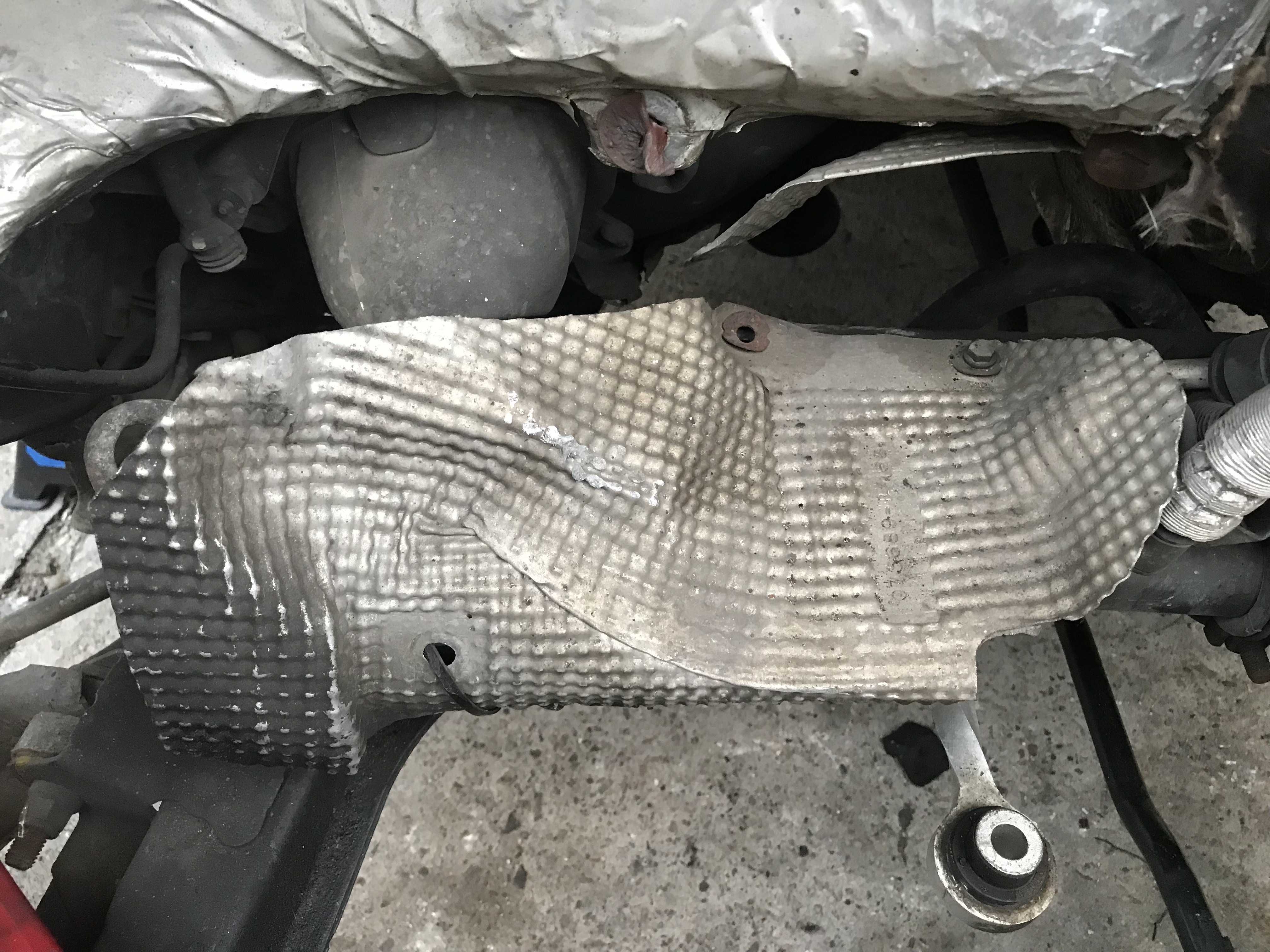

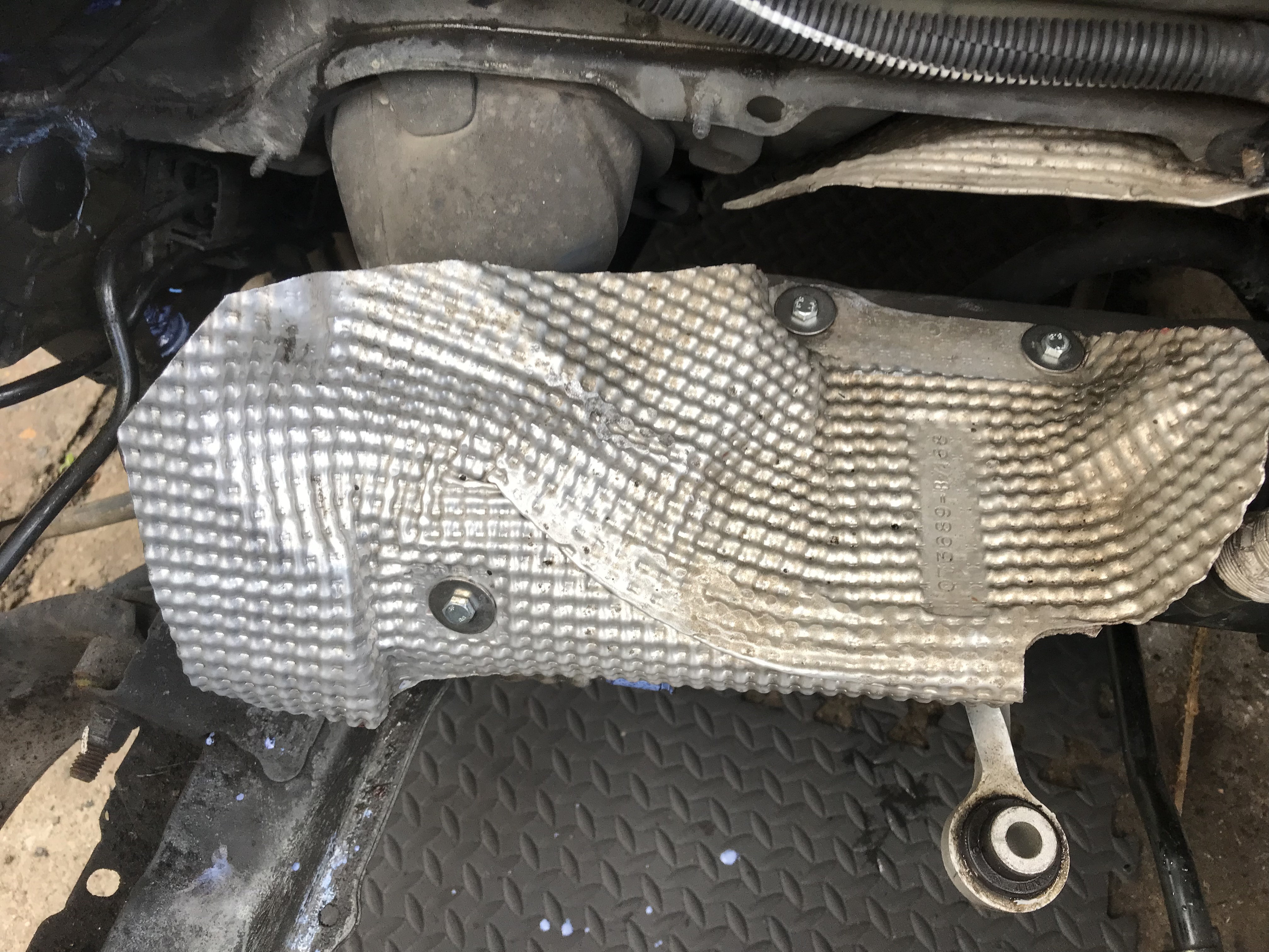

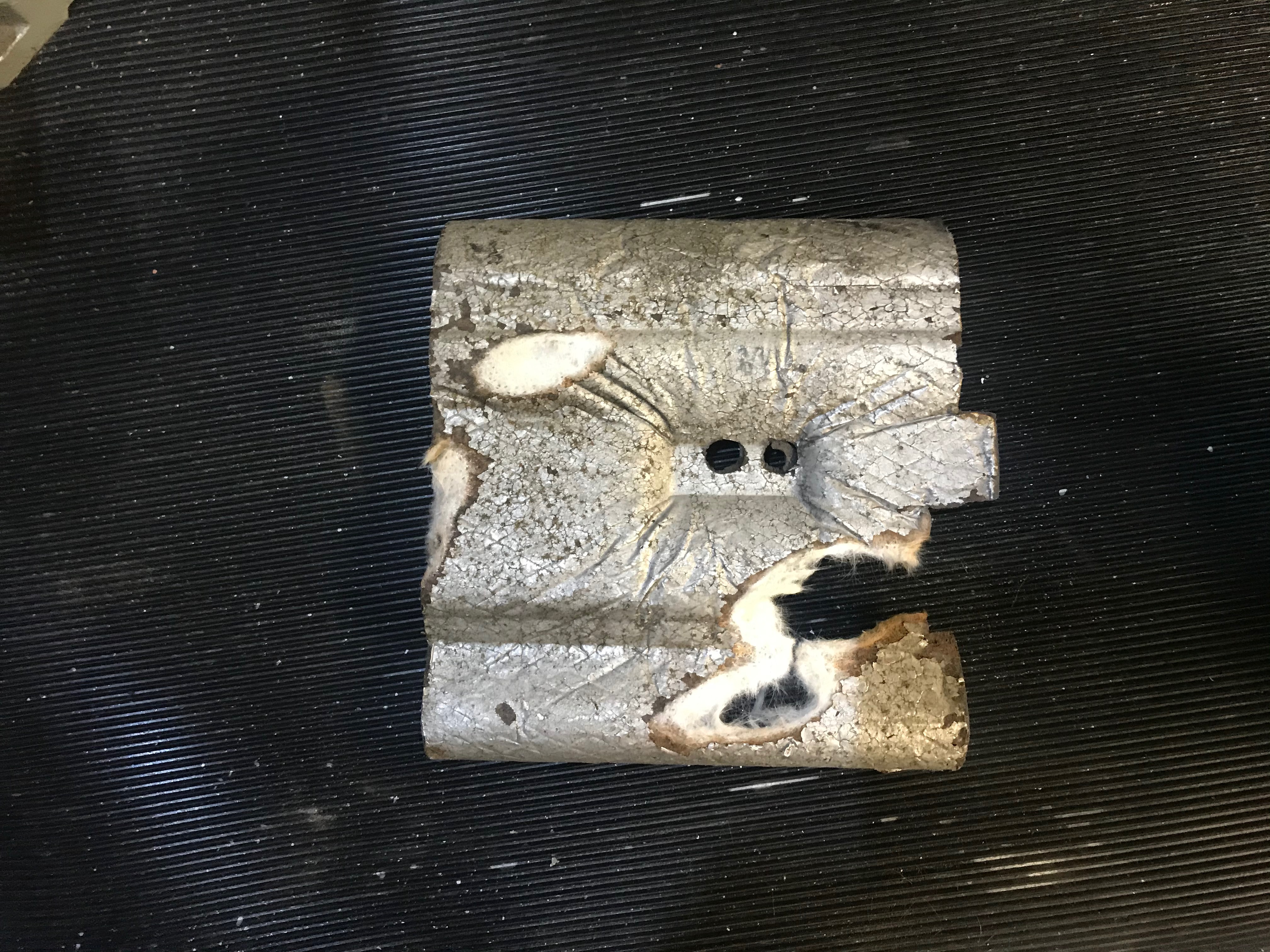

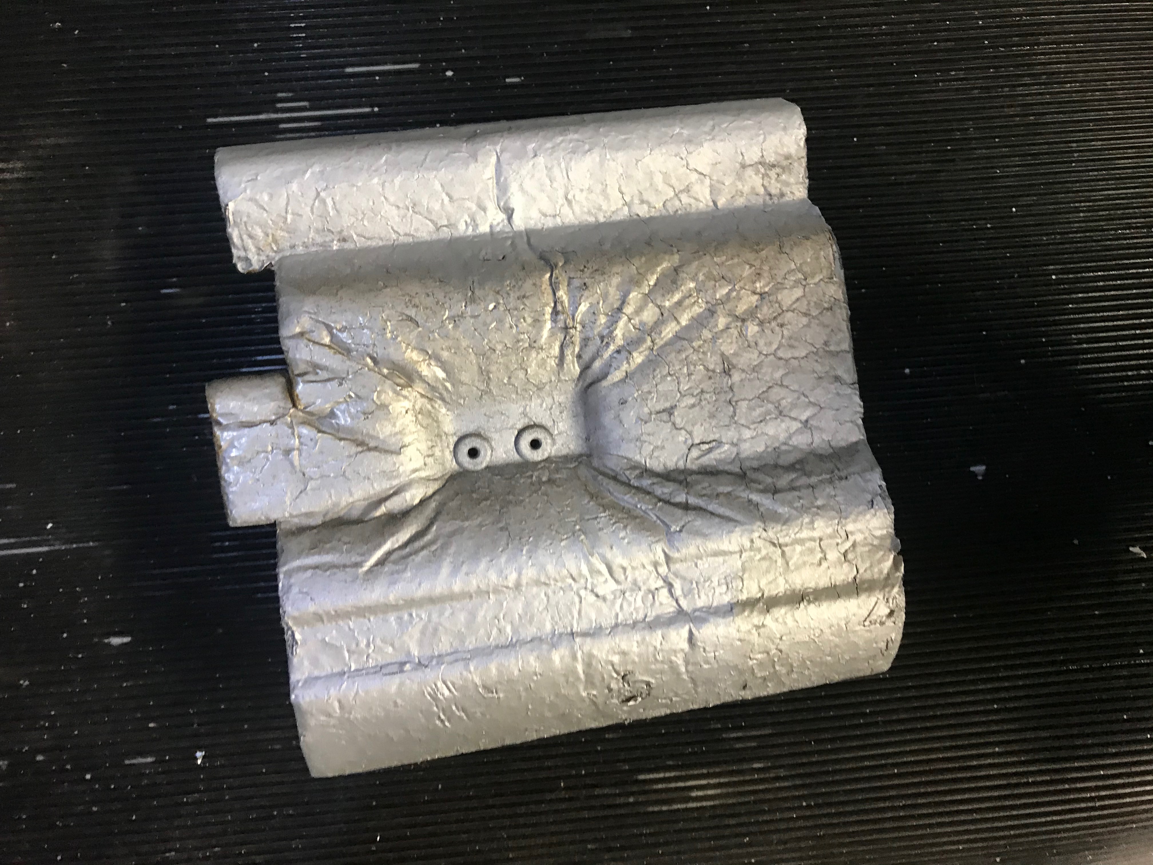

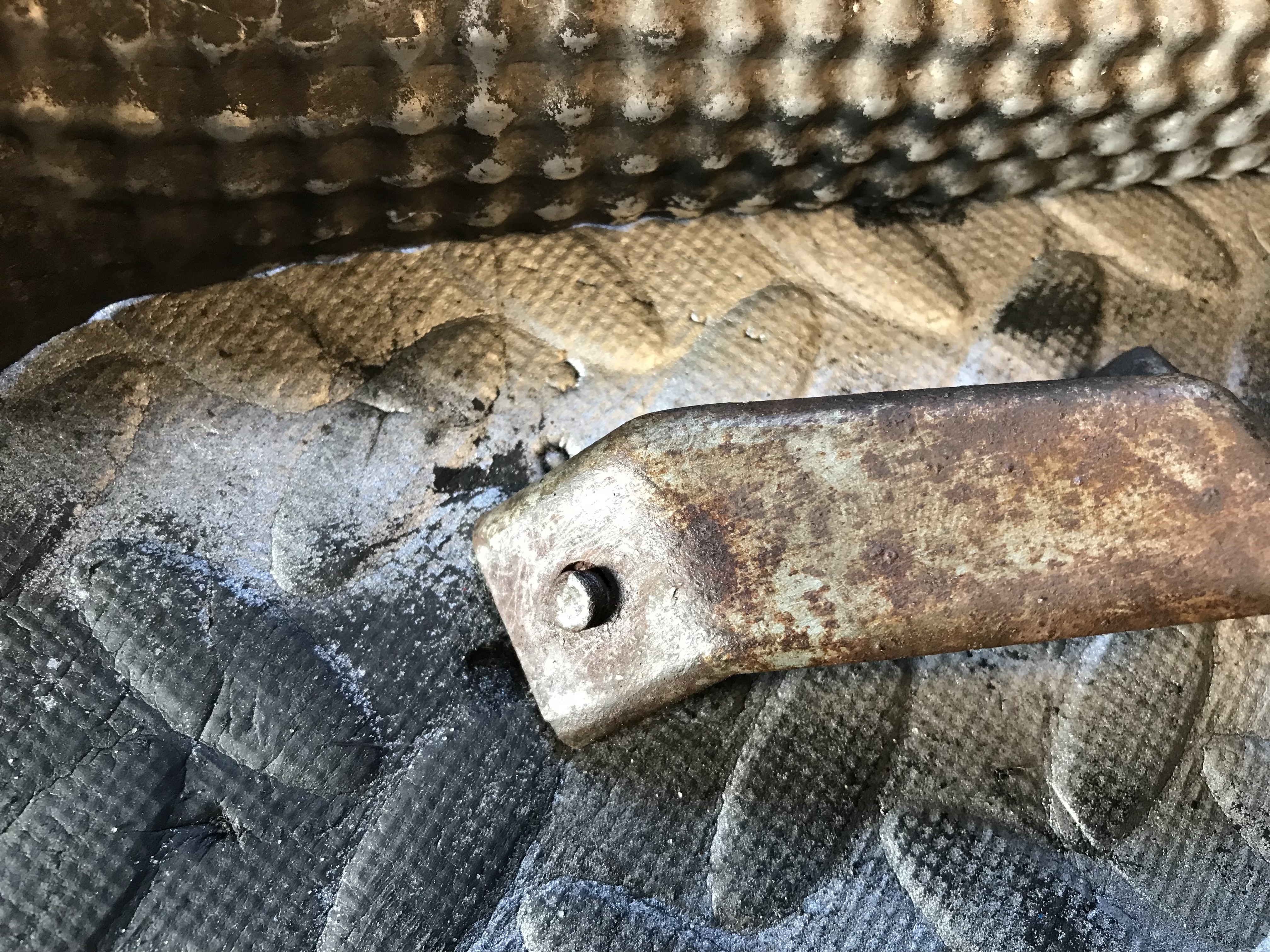

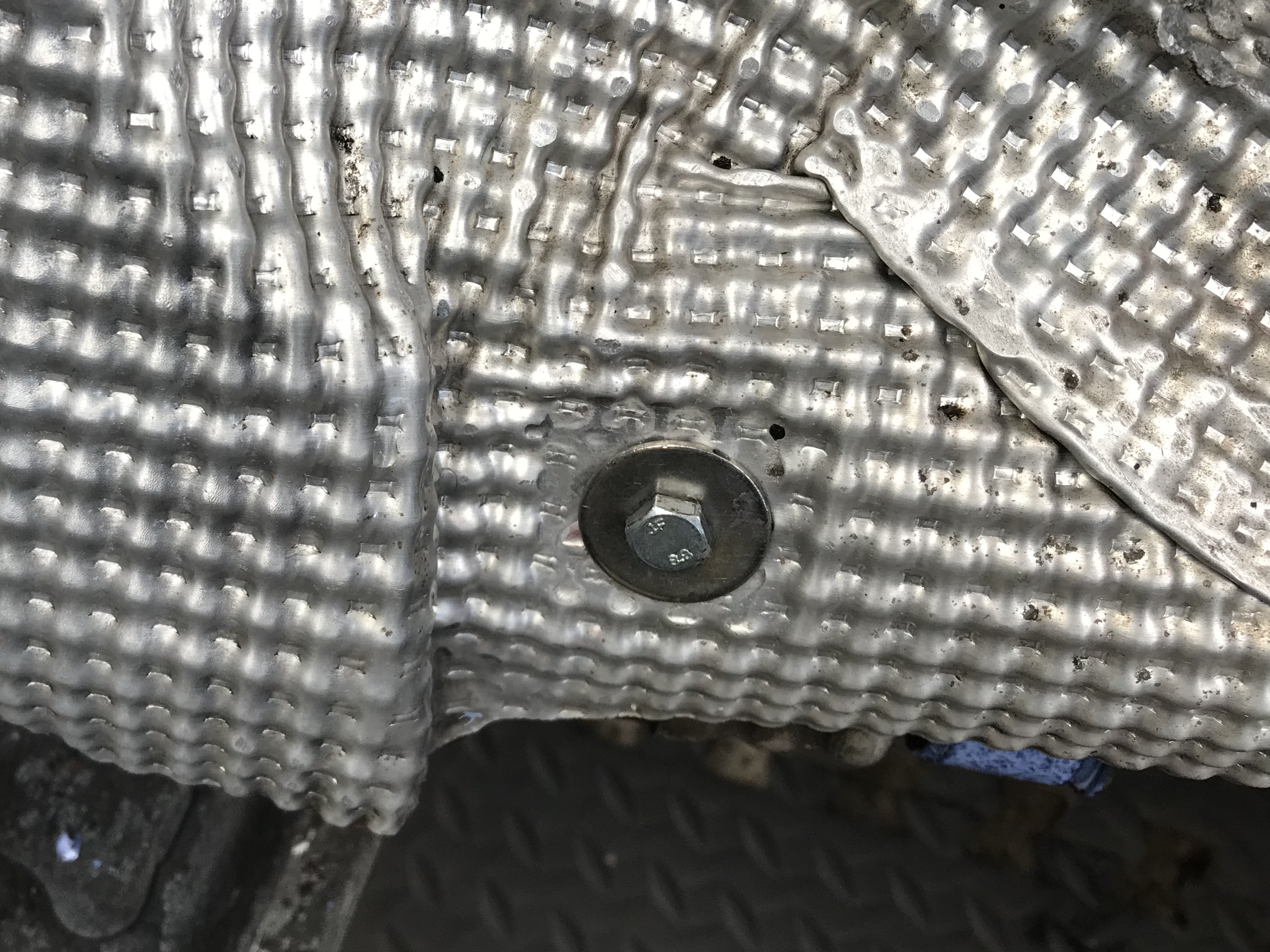

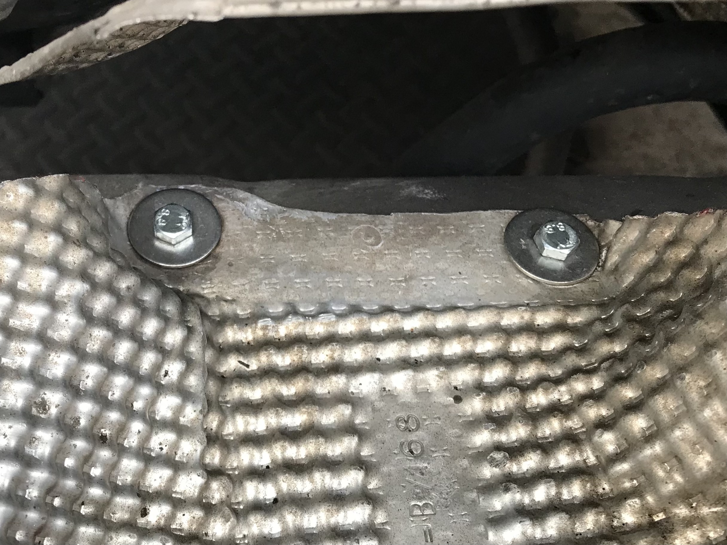

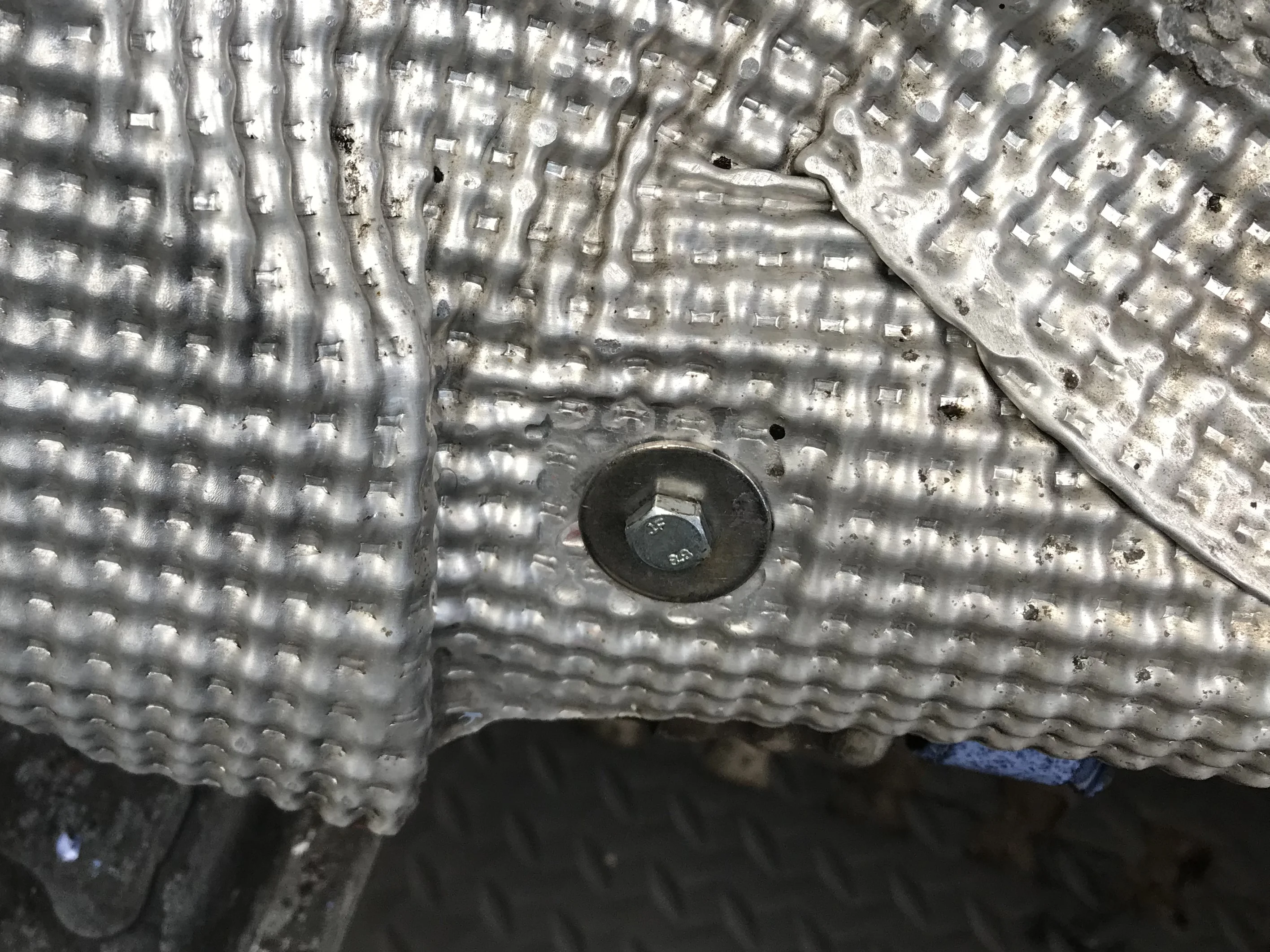

A couple of hours spare this morning so tackled the heat shield beneath the exhaust manifold. I knew it was an issue as I’d spotted it a few years ago when doing my ARB bushes, but it’s pretty hard to locate and fix.
Held on by one bolt, which was loose, and a cable tie by previous owners. It used to vibrate on hard acceleration so this should be a good fix.
First job was to fix stub on the small bracket which had a snapped off. Easiest fix was to grind it off, pop it out and fit a rivet nut in its place.
One of the captiv nuts on the subframe was also missing so I stuck a rivet nut in, gave the shield a little clean, then refit with some M6 bolts and penny washers. Job done!

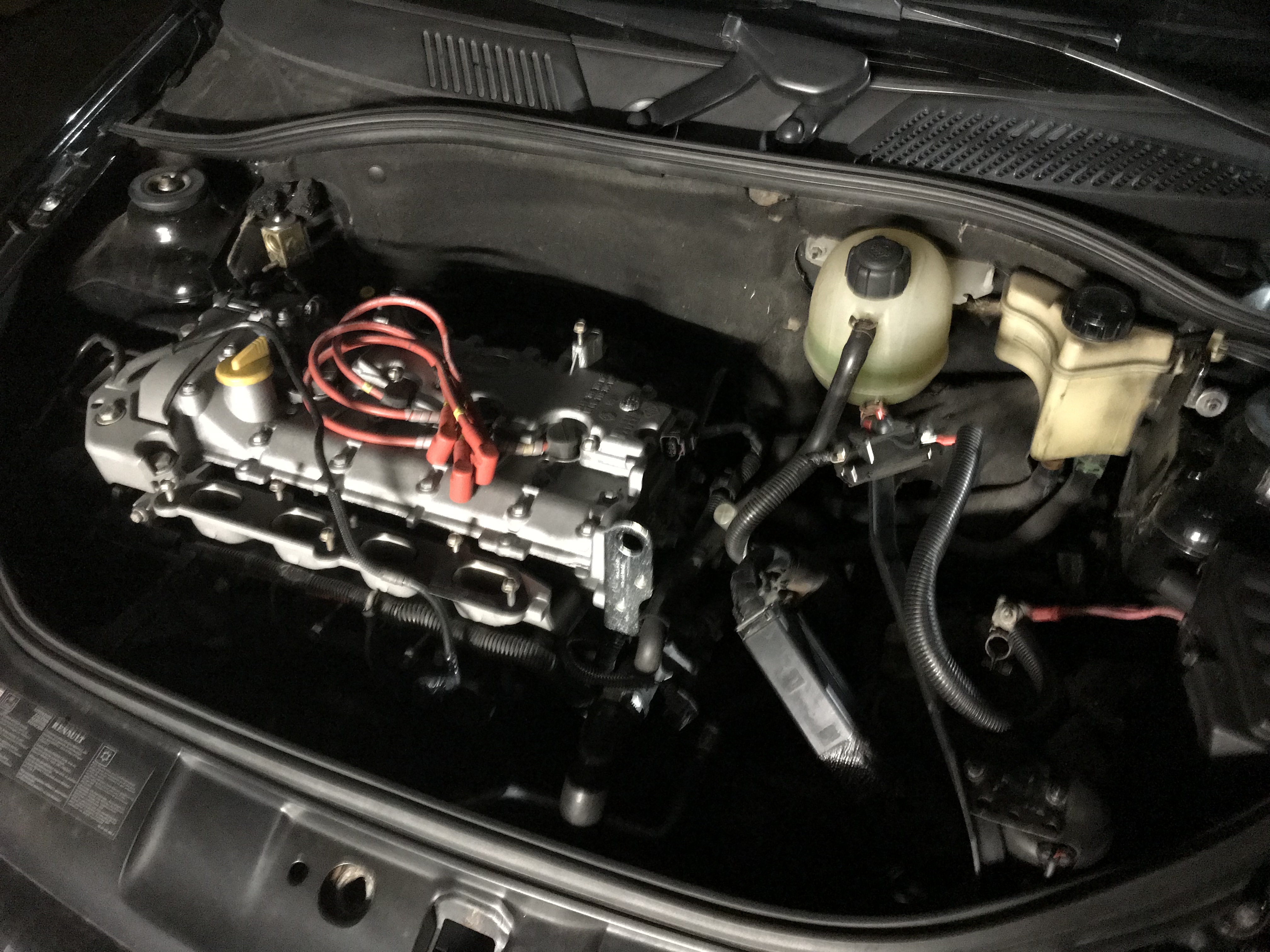

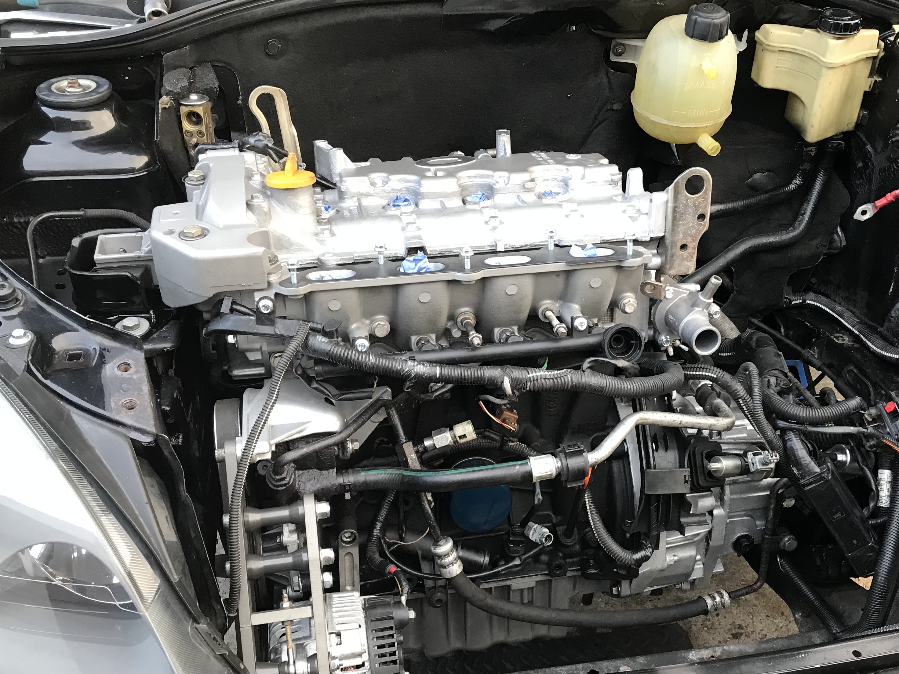

Up nice and early to start putting the engine back in.
Took a couple of hours to get to this stage, then a couple of hours trying to get the auxiliary belt onto the bottom pulley of the alternator. What a flippin carry on.
Called it a day after that. Just the hoses, radiator and gear linkage to set up now, then it should be ready to go.
