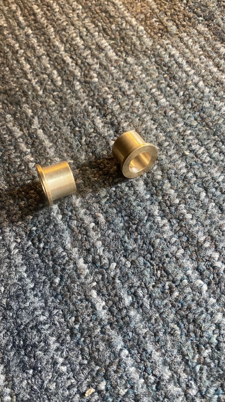

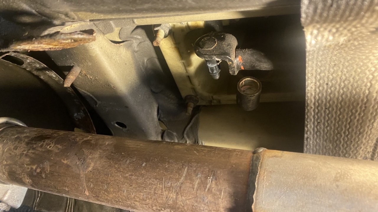

I’ve had some brass shifter bushes sat in the garage for a while that I’d never got round to fitting. I read @Louis ’s thread earlier and it prompted me to pull my finger out. I gave them a quick rub with Emery cloth before fitting as I really didn’t want them stuck like a few people’s have been
Heat shield came off without any arguments, selector separated without any arguments and they fitted straight in. Couldn’t believe the spiteful french t**t didn’t make my life miserable.

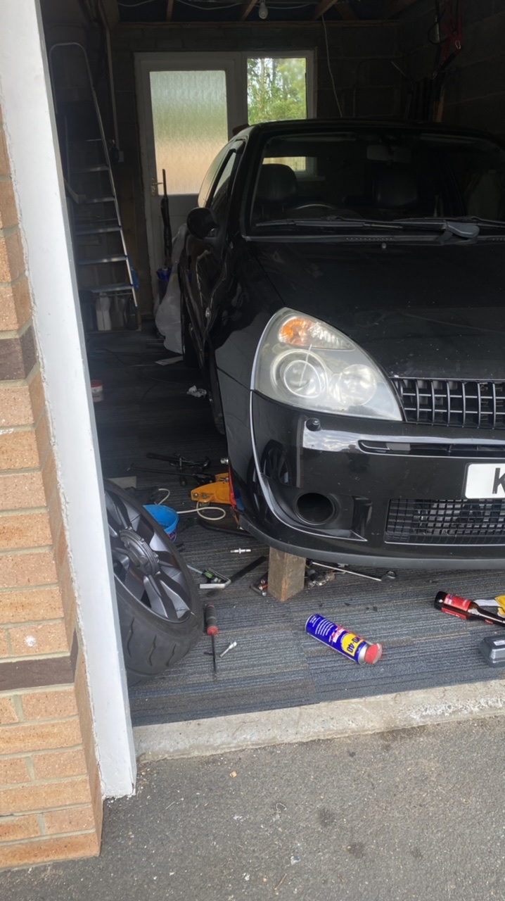

I was going to go for a drive to celebrate but still only have 3 wheels on my wagon. I sat inside, made some car noises, all seems well so called it a job well done. This is how it’s still sat

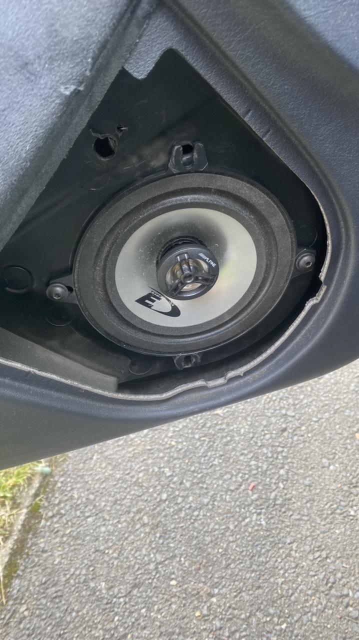

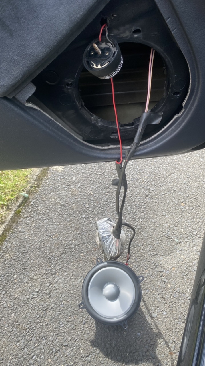

Messed about with another few bits today. My front door speakers have died so all I’m left with is the shitty tweeters in the dash at the front so any music sounds terrible. I popped the dash top off and binned the tweeters. I’ve got some old alpine speakers so thought I’d throw them in the doors.
Popped the caps and it turns out there were already aftermarket speakers in there. Absolute Halfords special of a wiring job and another set of tweeters in the door. What sort of monster wants that much trebe
Binned the lot of the s**t and got the alpines in. Still sounds terrible cos it’s old and french and rattly but significantly less terrible than it did.

Did you bin the speakers? Look like infinity components which were very alright a few years back, wonder if it was the god awful wiring which had failed rather than the speakers.... either way, improvement over non working dog s**t installed speaker (y)
Edit, with crossovers rattling about in the doors by the looks of it!

They are indeed and they were good back in the day! They are totally shot. The crossovers were in the bottom of the doors in a plastic bag which is a genius idea if it wasn’t for the fact doors get water in them and the bag traps the water on the crossover. All that was left was a bag of rusty s**t and ancient water 😂. The speakers themselves probably won’t come back to life. The connectors have gone brittle and snapped off and the coils are corroded too. One works with the wires held onto it and the other just sounds like a wet fart.
The alpines aren’t great but the sound is always nice and crisp with them. I really need a little under seat sub so I can put a hpf on the speakers and let them play in the range they are happy with. I’ve got a massive 12” vibe sub in the loft at my mams. Was half tempted to get it yesterday but then quickly remembered I’m not trying to pull 16 year olds and it’s not 2007 😂

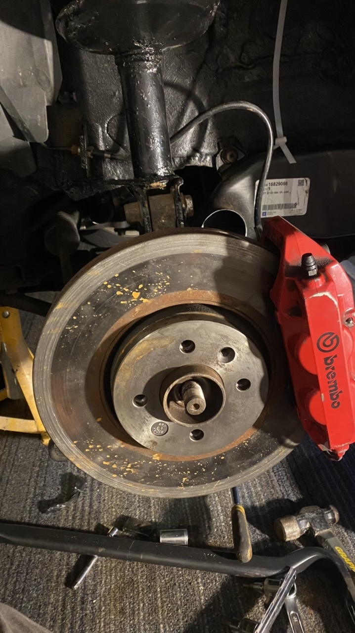

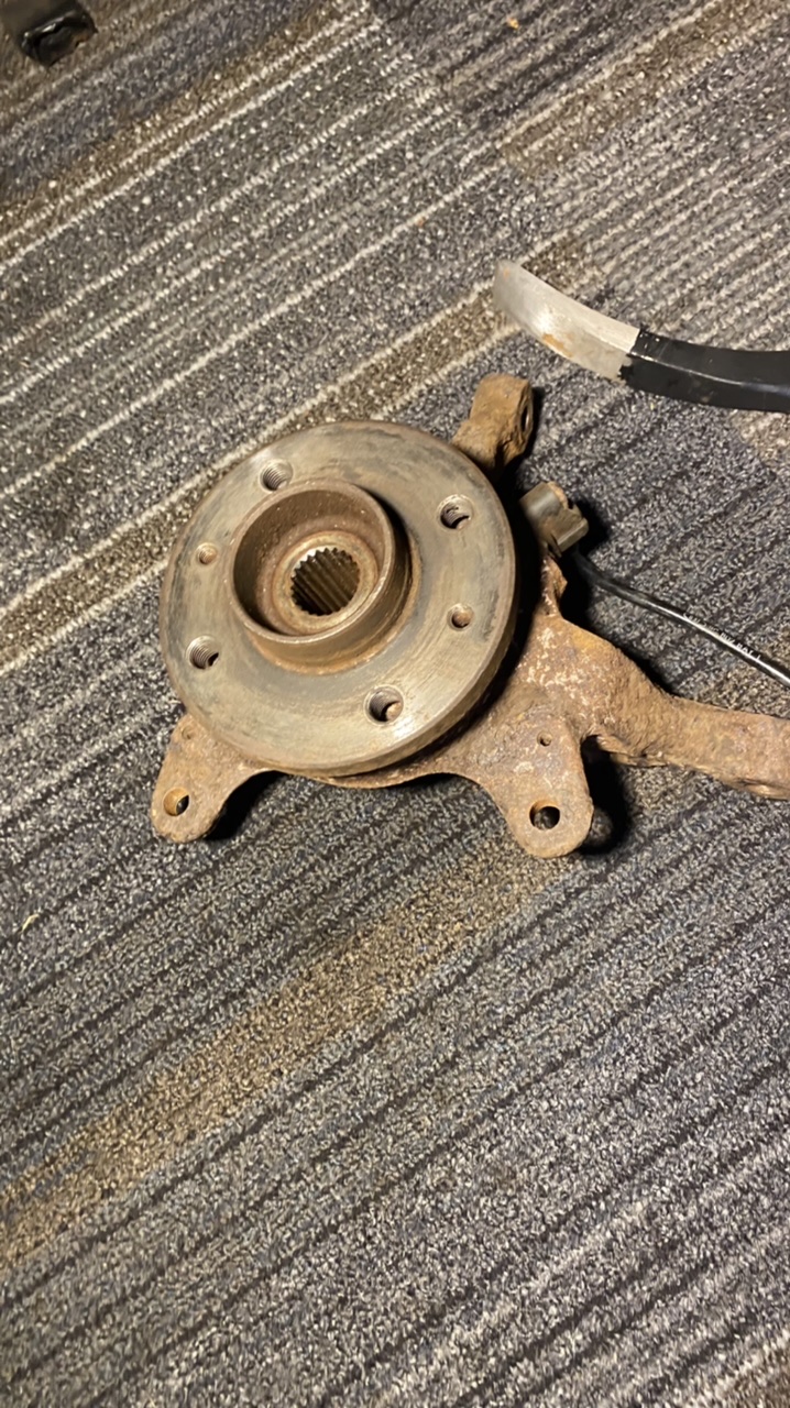

The Romanian Yorkshire rescue hub arrived today so got it on tonight. He said it had been in the sea but to be fair it’s in better condition than my original.
All fitted up and as if by magic the brakes don’t catch. The bearing is stiff but freed up nicely with a few turns and best of all the retaining screws haven’t snapped so I can still use them.
I totally destroyed the bottom ball joint bolt swapping them over so a £7 euro car parts special is on the way to get a new bolt. It’ll all be sorted in the morning.
The Brembos need a bit of a spruce up too so when I change the box over the winter I’ll get them sent off for a refresh.

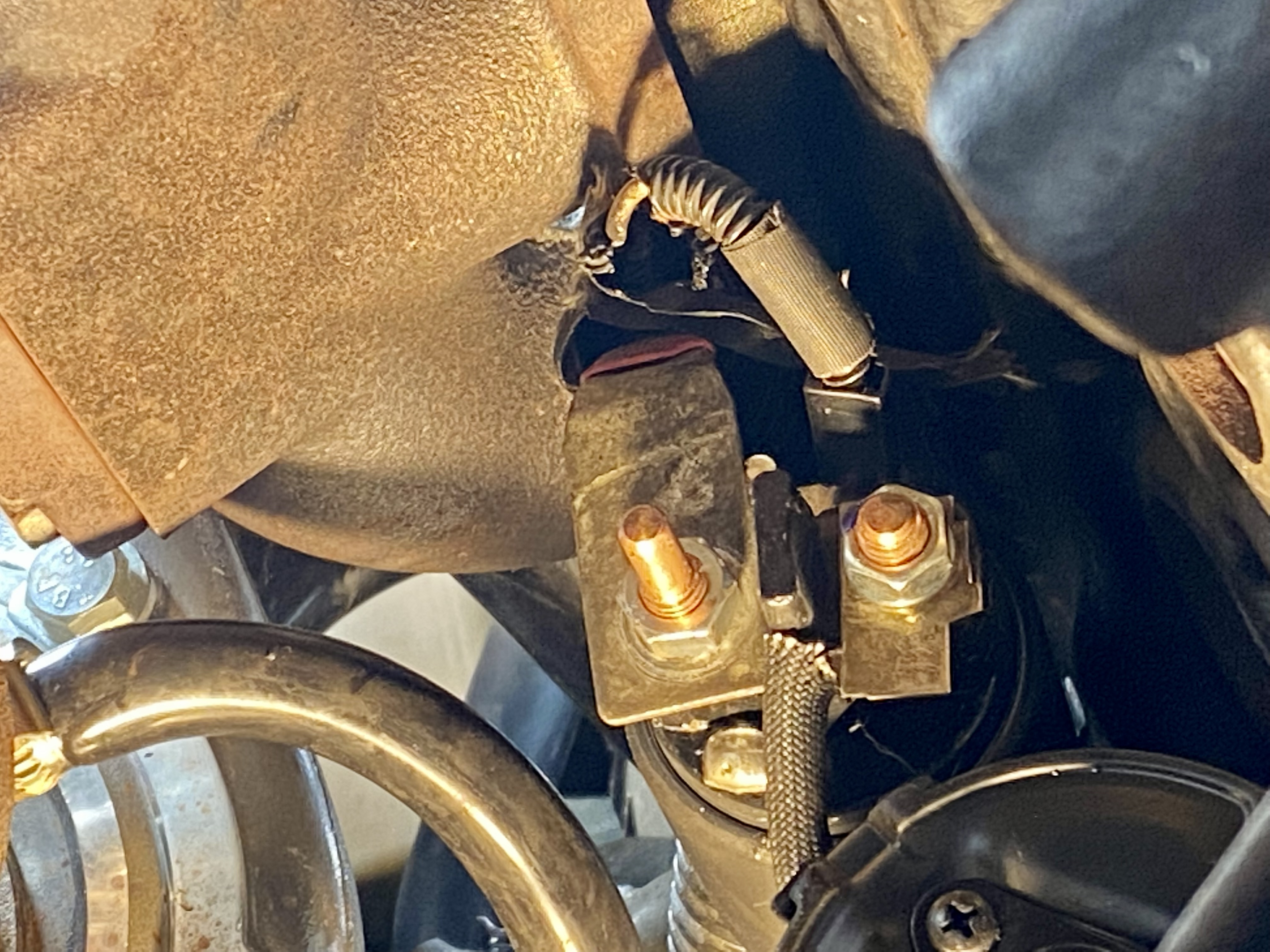

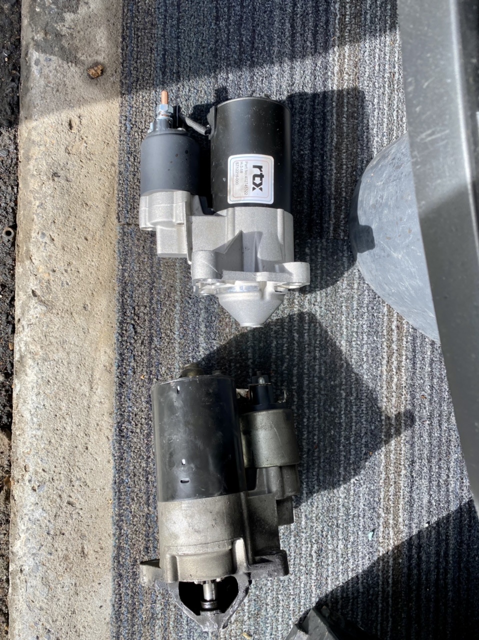

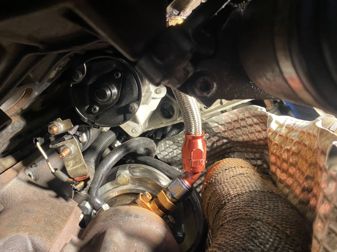

The starter motor has decided to play up again. It’s been sticking after long drives and last week decided just to not work at all.
I started by shifting the mountain of crap out the way to try and get some access
It came out pretty easily in the end. The bolts are all a chew to get to but once they were out it pulled straight out the drivers side wheel arch. It looks like having the turbo made it simpler with there being no manifold in the way.
Old vs new
I got it all bolted back up, put back together and as soon as I connect the battery it started cranking. I must have managed to short it on itself somehow. On this pic it looks like I’ve maybe got the big L shape connector just off square and it might be touching on the other connector. Either way, couldn’t be arsed to sort it today so I’ll have a look again during the week.

Got the starter sorted today. As soon as it was tightened it kept shorting because for some reason the prong on the top of this one is miles longer than the original. I tried it with a couple of washers and was no good so just span the connector 90 degrees which has worked fine. It’s a bit close to the turbo so I’ll sort that when the engine comes out over the winter.

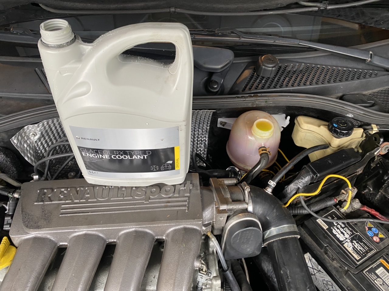

I changed the coolant and the oil when I was on. I went full forum fan boy and bought some of the proper type D stuff. Not that you tell cos the orange slime that was in there has already stained the new coolant bottle

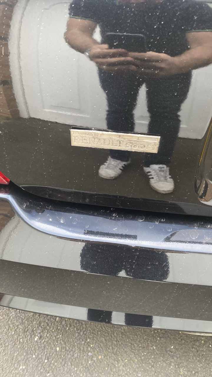

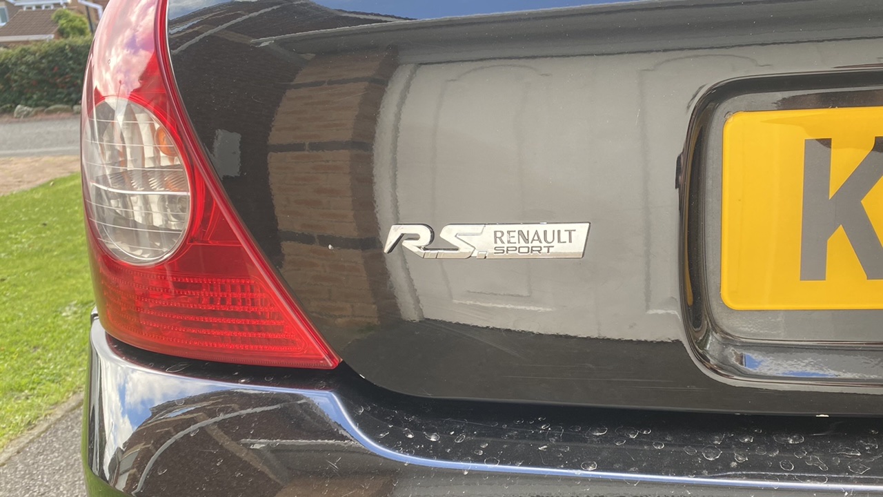

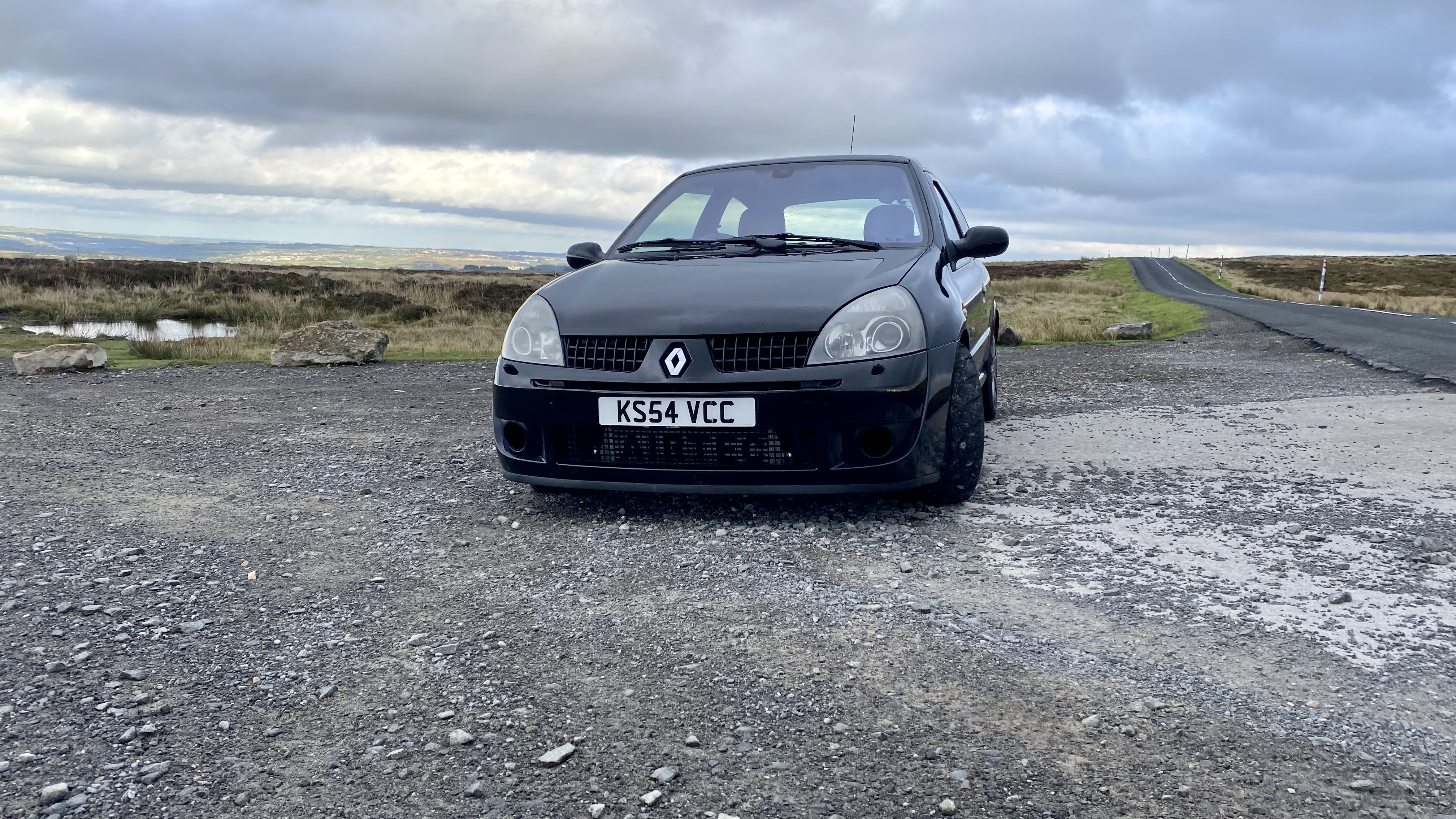

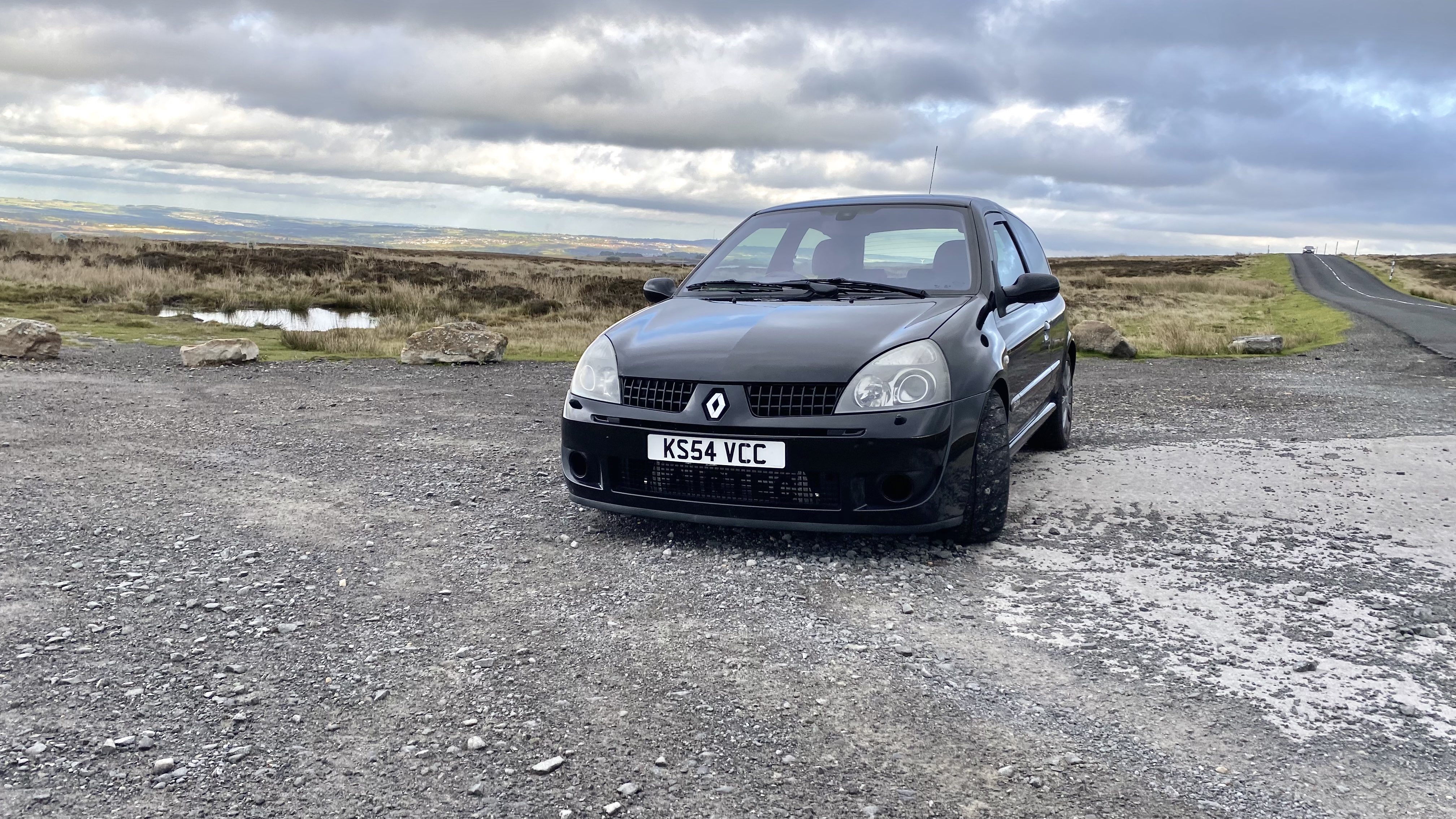

Couple of small updates. There was a random Renault sport badge on the boot that was starting to look a bit shabby so pinged that off.
I had planned to leave no badge on there but the doofus who pulled the original badges off has done it with something sharp and took loads of chunks out of the paint. Stuff like that annoys me so much, there’s just no need. The original badges look terrible so after much random build thread stalking to find the best option I settled on the new style rs badge
I also replaced the original orange indicators with some silver bulbs and tried for some white sidelights instead of the yellow ones. That plan didn’t go well and the new ones are still very yellow so if anyone has any recommendations that aren’t cheap eBay s**t then please fire away.

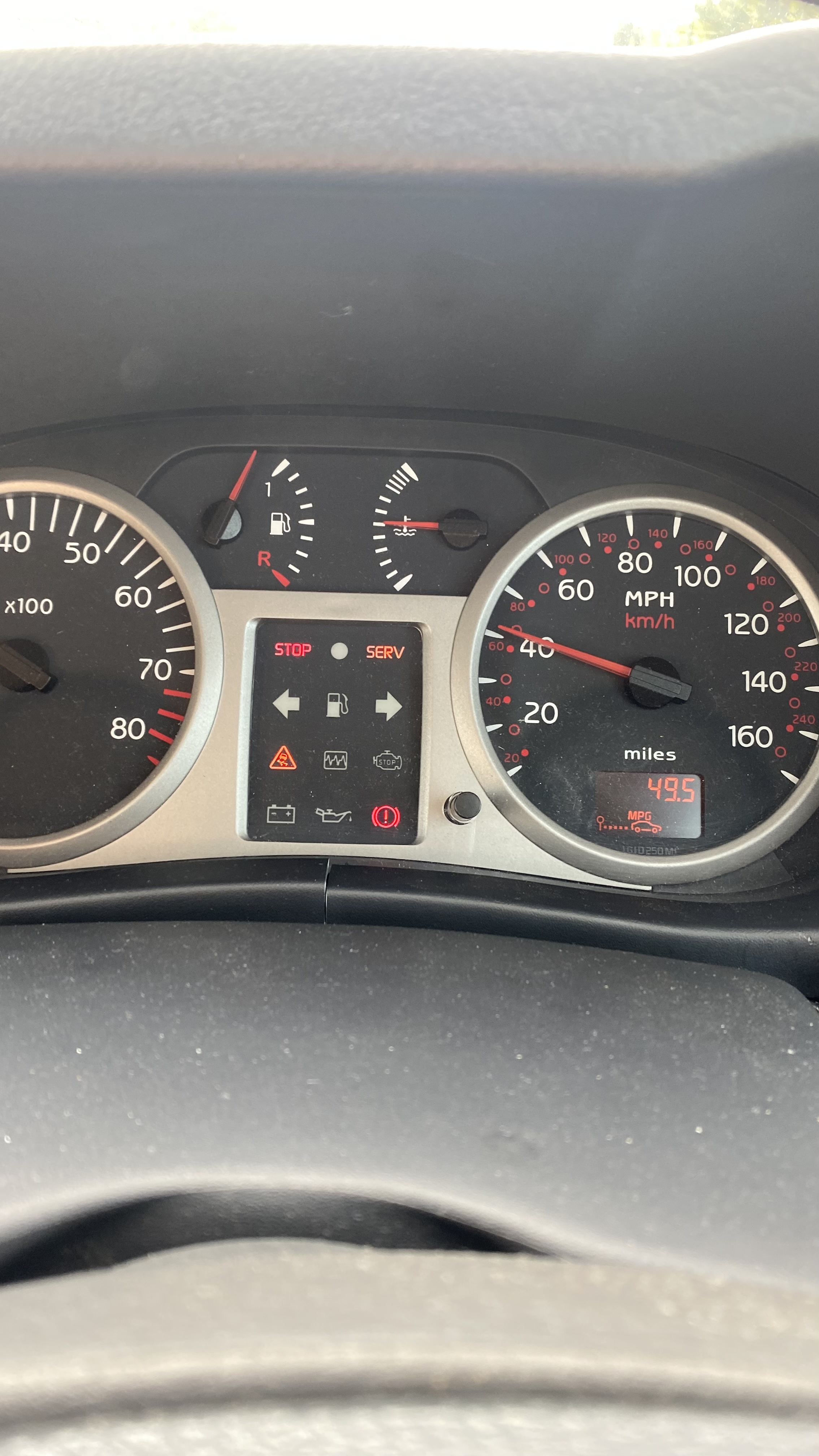

After that it was time for a drive. Fuel gauge and mpg seem legit 🙈.
I headed up into the sticks and had the chance to give it its first proper B road shake down since it’s been turbod. It was brilliant up there today, just miles and miles of empty roads with nothing but the odd Volvo estate to overtake and stray sheep to dodge.
The car was great. Handling is fantastic as it always has been and the r888r’s stick to the road like warm s**t. They really do give so much confidence when pressing on. The brakes are cracking and showed no signs of fade even on the long downhill stretches with some serious abuse. Gonna take credit and say that’s all down to my brake ducts 😂. The engine is absolutely on point. The extra power pulls it out of the corners so well and I love the noise of the turbo fluttering away and the odd cheeky bang here and there. I’ve not had that much fun in a car for years. Anyway, some pics

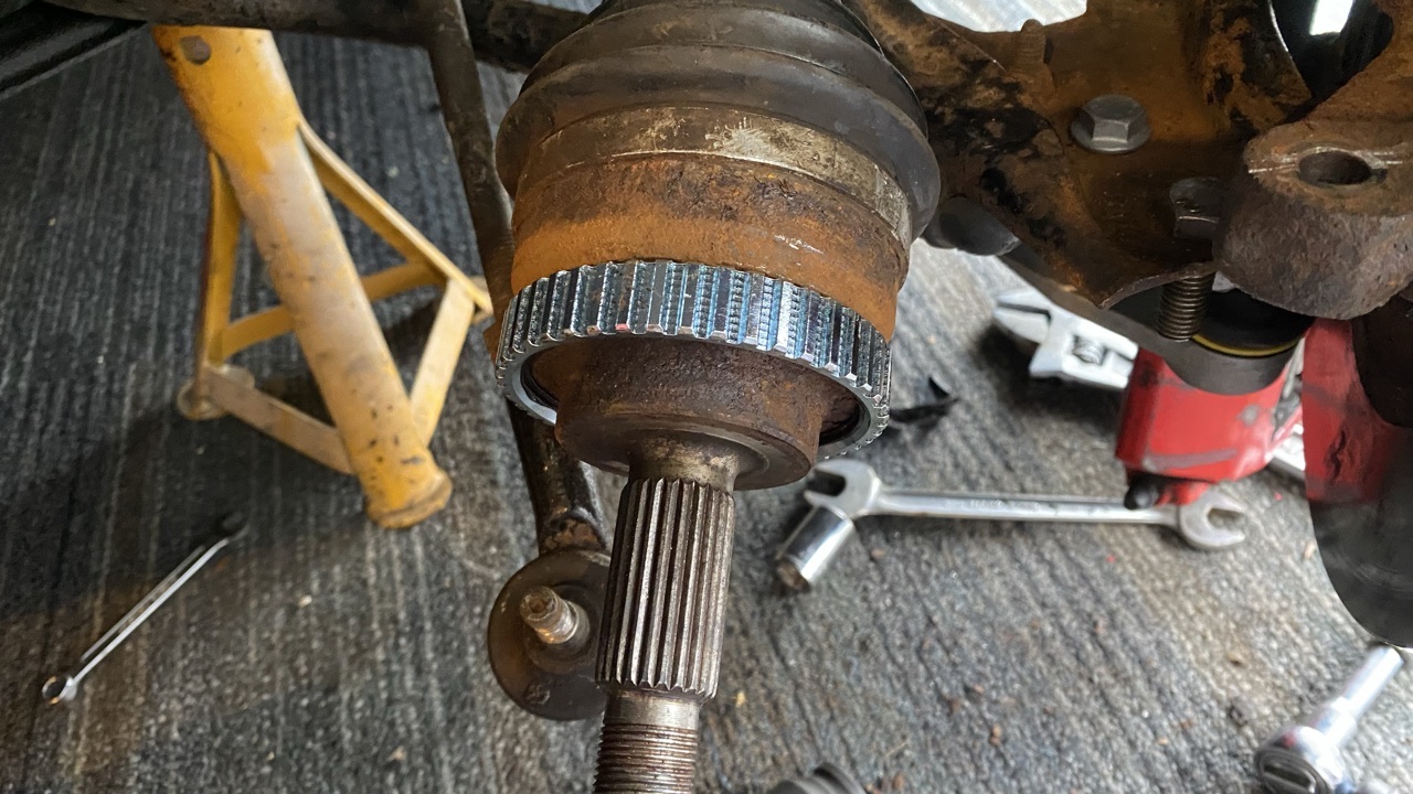

I’ve been chasing an abs fault for about 5 years and got it down to the front right. The old abs ring looked a bit suspect so swapped that over as I had one spare
It made zero difference so must be the sensor. I’ve got one ordered so hopefully that’ll sort it. When I was on I spotted the bottom ball joint was a bit sloppy so popped a new one on. As if by magic the knocking over bumps at the front has stopped.

Couple of small updates. There was a random Renault sport badge on the boot that was starting to look a bit shabby so pinged that off. View attachment 1563634

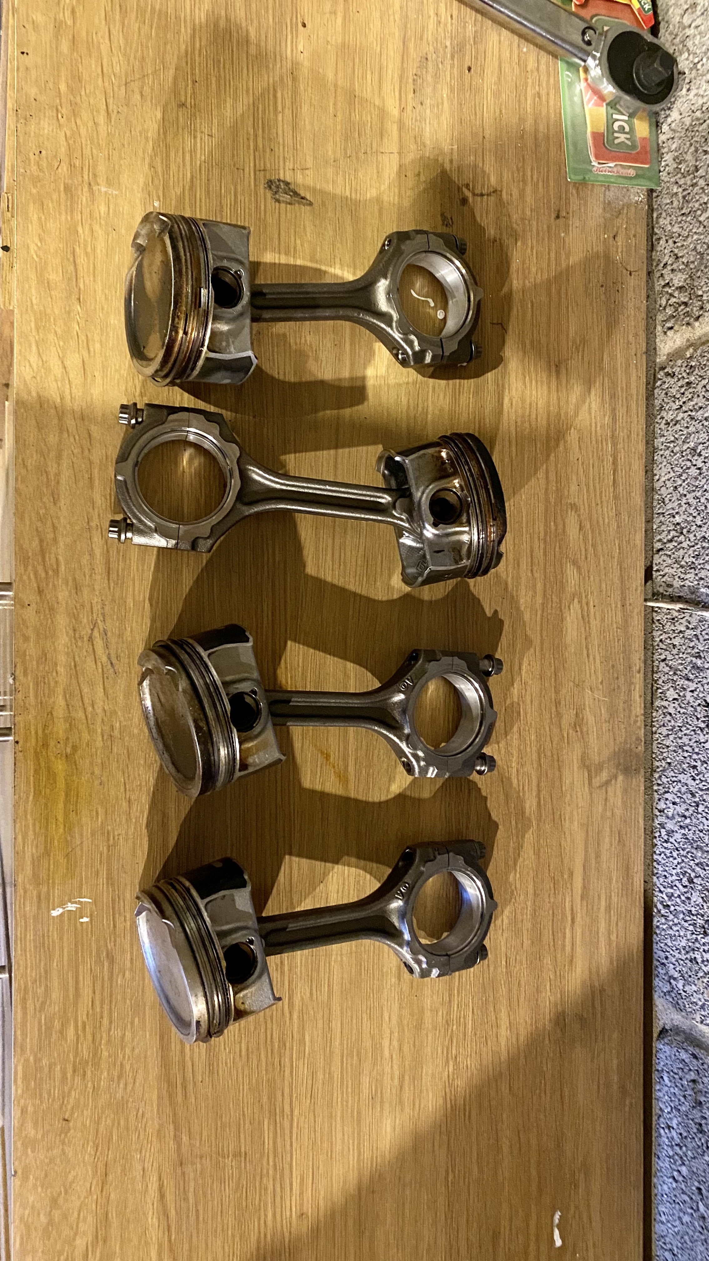

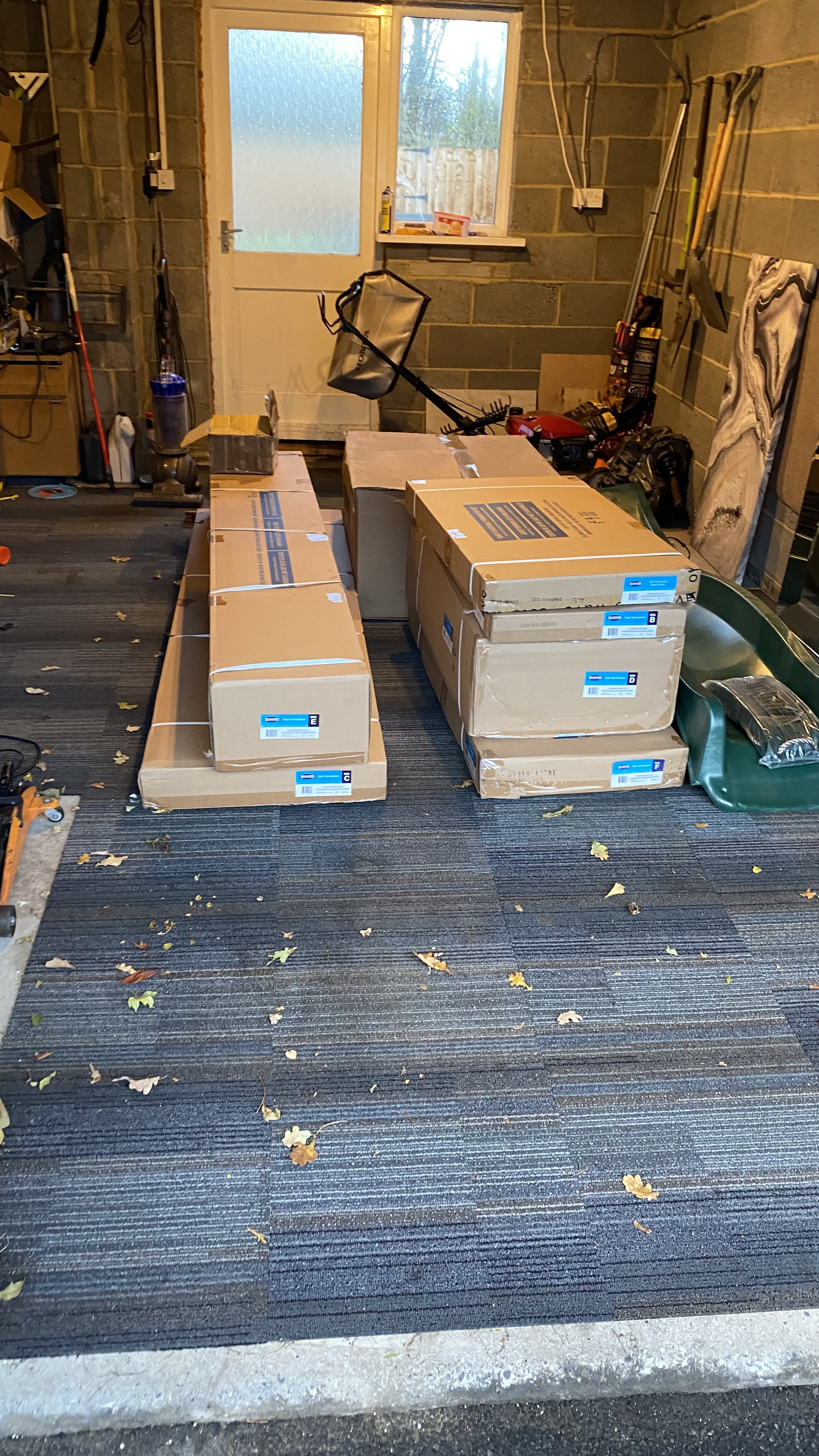

Why do things always have to escalate? I’ve decided I want more power so toyed with the idea of forging and decided I couldn’t be trusted. Having read incy-spiders build and seen his results (370bhp or so) using Meg 265 pistons and rods I’ve decided to go down that route instead. They aren’t a 100% direct fit and need pockets machined for valve clearance and the rods notched to accept the correct bearings but they are essentially an oem solution. The only issue is you can’t get bigger rings so need a decent block to fit them to. Mine has done under 60k so should be bang on.

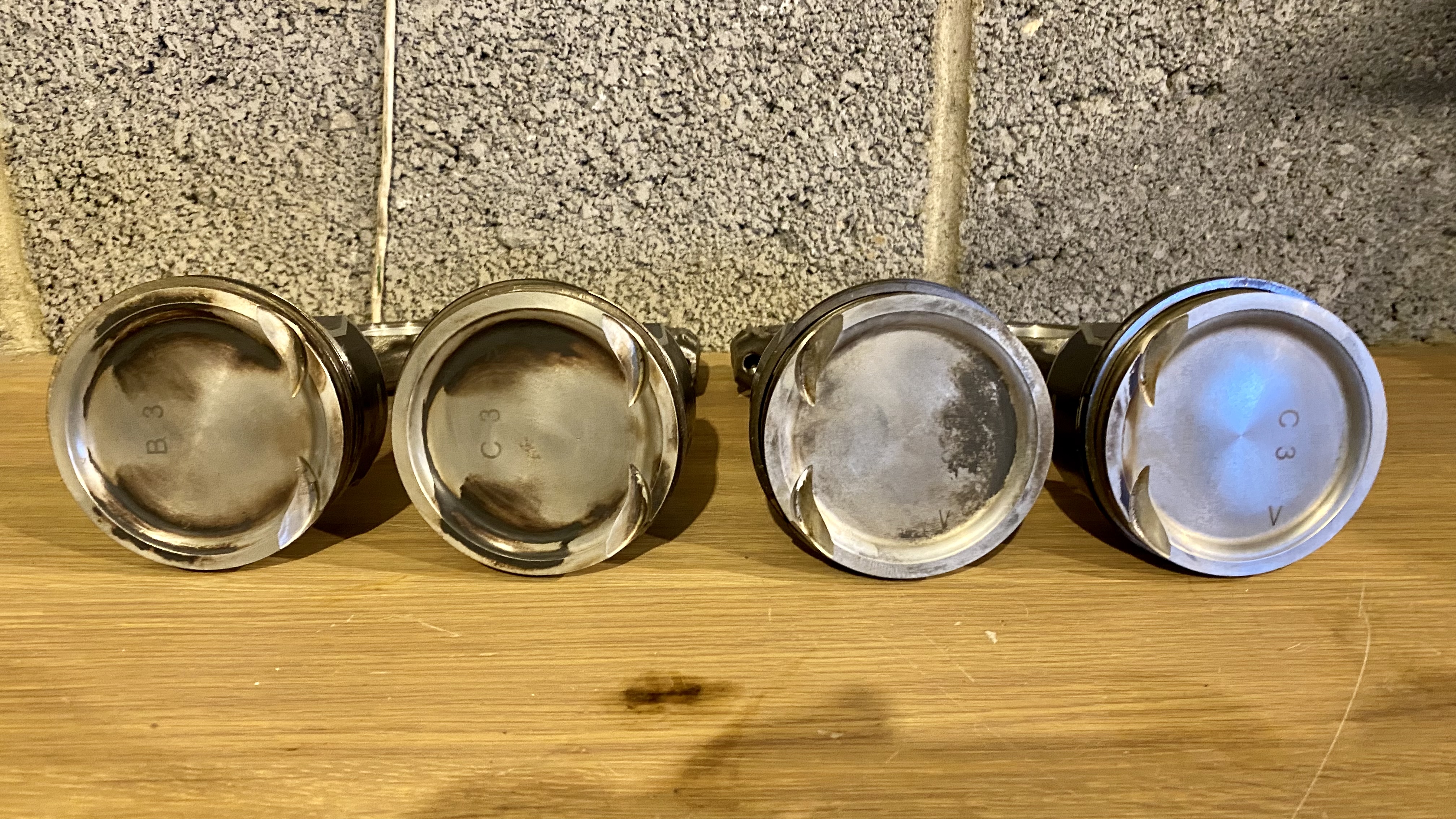

The pistons arrived today. They are a matching set and all seem in decent condition. They’ve arrived with bearings and rings which will obviously be replaced. They need a good clean but not point given they’ll be machined
The plan was to get cracking asap but the Clio has been evicted in place of the parts to build the worlds largest climbing frame so it’ll have to wait until the new year
Power wise I’ll be limited by the EFI boost control module and the standard head. Hopefully I’ll be able to go with a decent high boost setup and see at 280-300bhp. At the same time I’ll fit the dci box and see what it’s like. If it’s any good it’ll be coming back out for a rebuild and a diff fitted.

Nice one mate.. Check the rods are 100% straight also make sure the ring groves in the pistons have no tight spots from being potentially knocked around during removal, storage etc.
Incyspec v2 [emoji106][emoji106]
Cheers! I’ll check the rods out properly. Already had a fiddle of the rings (as perverse as that sounds) and they are all lovely so more than happy! It’ll be some way off your power too but should still be suitably silly 🙃

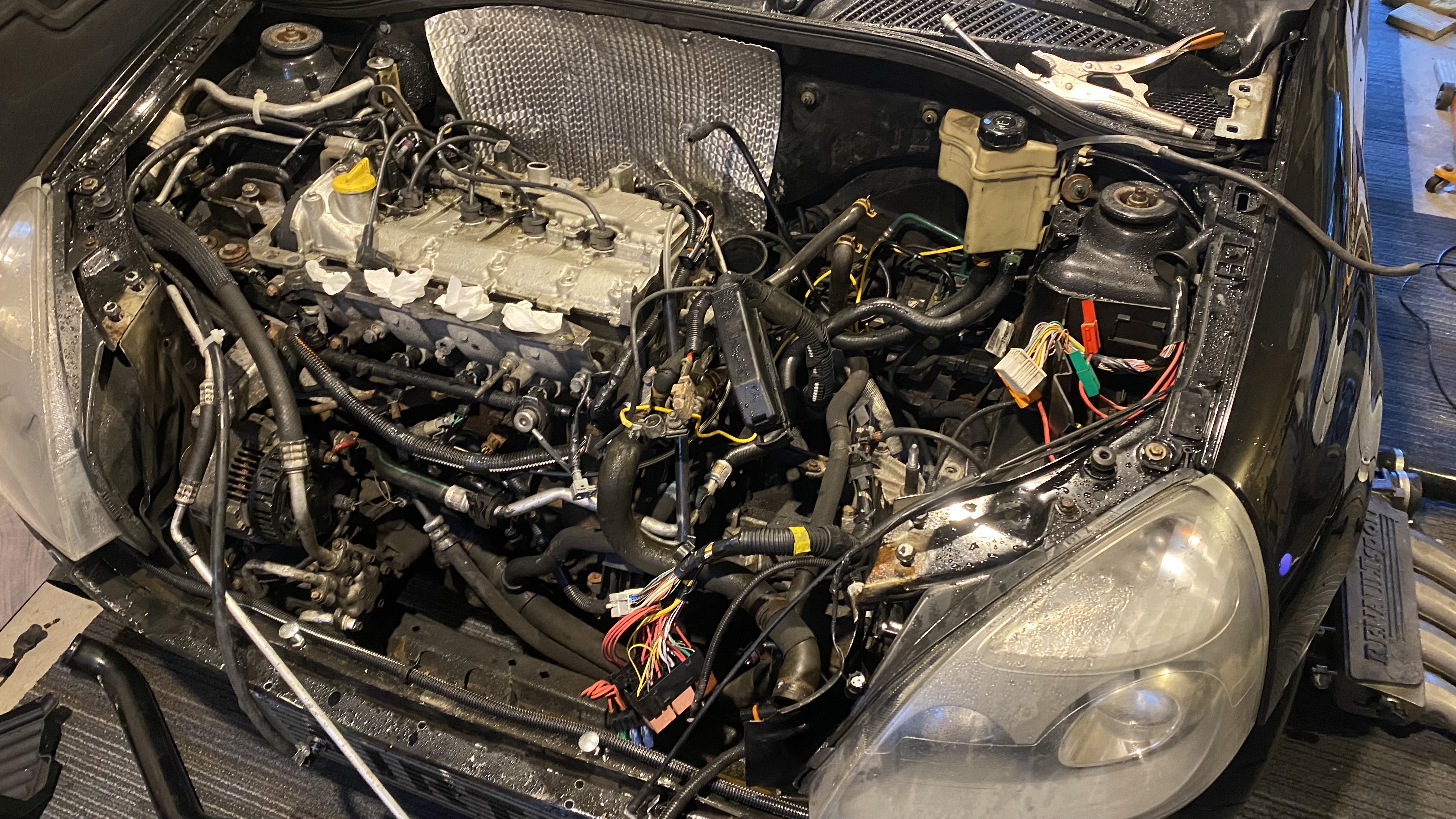

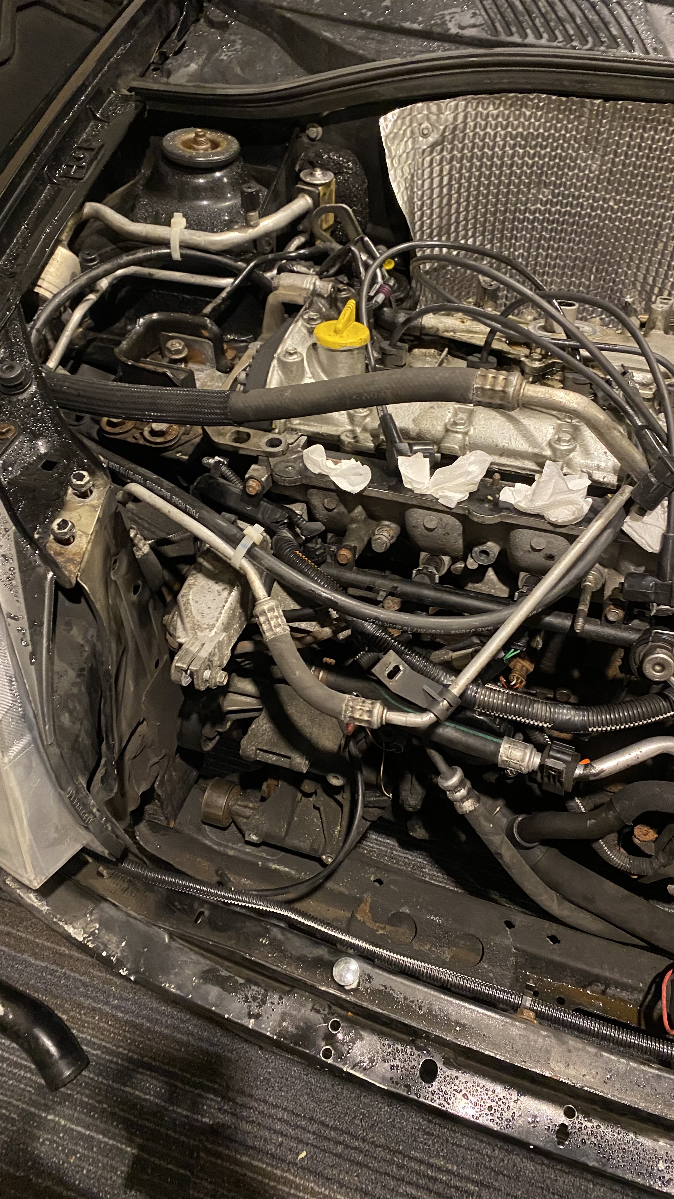

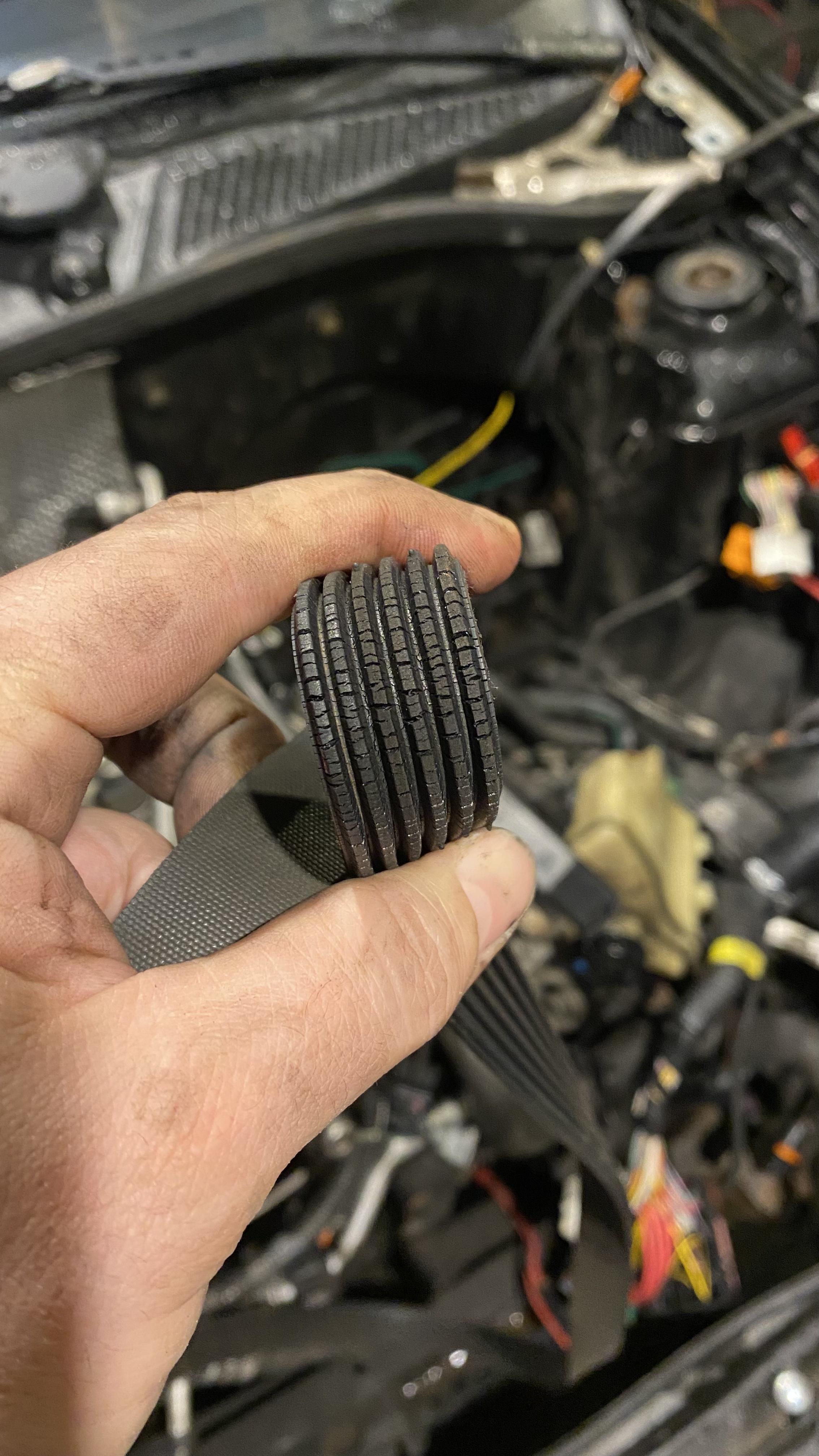

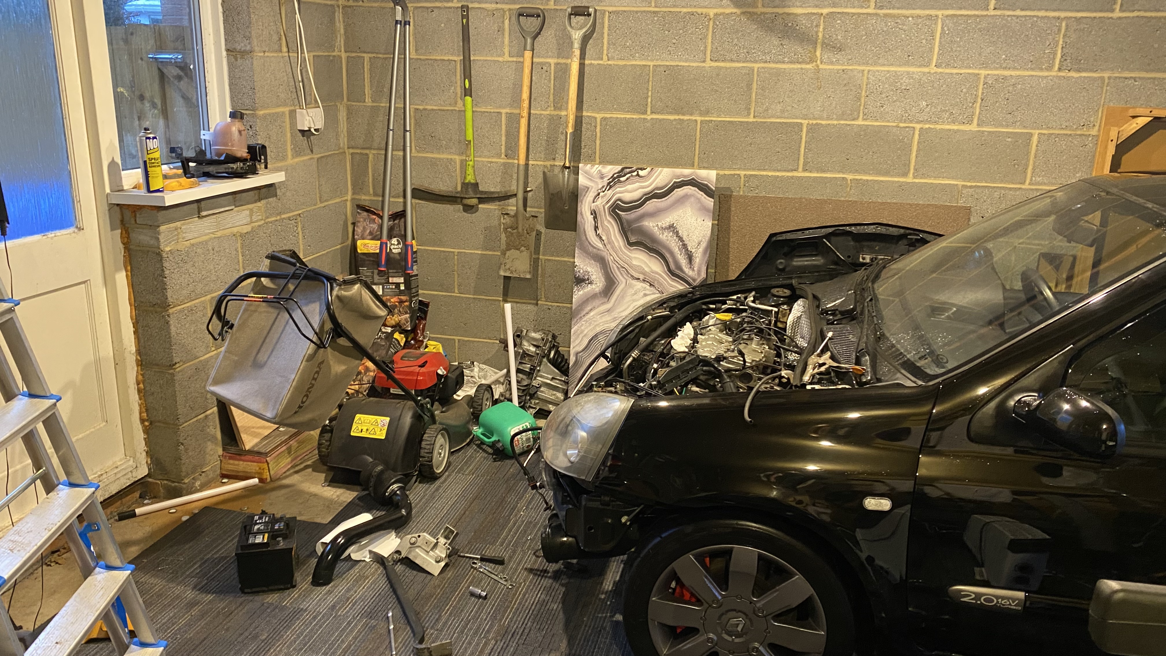

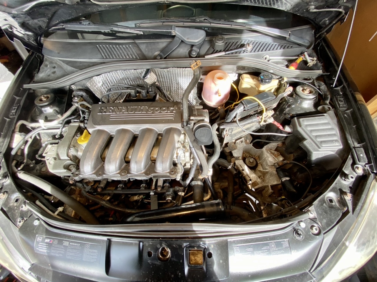

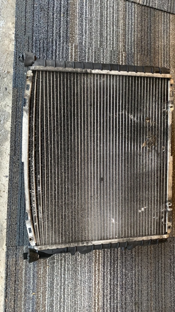

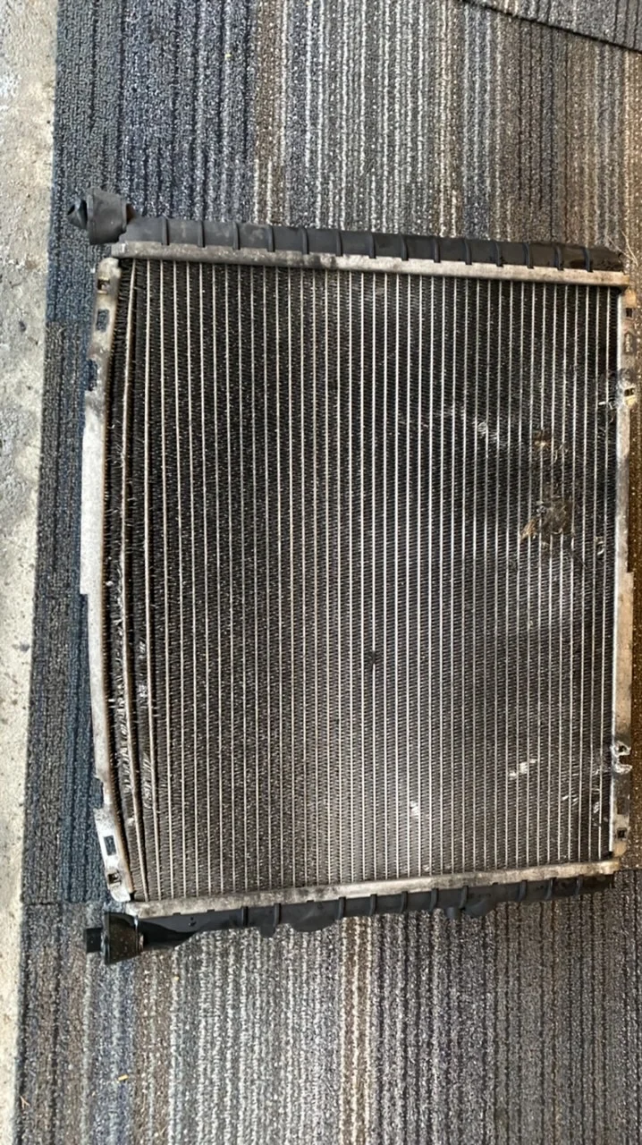

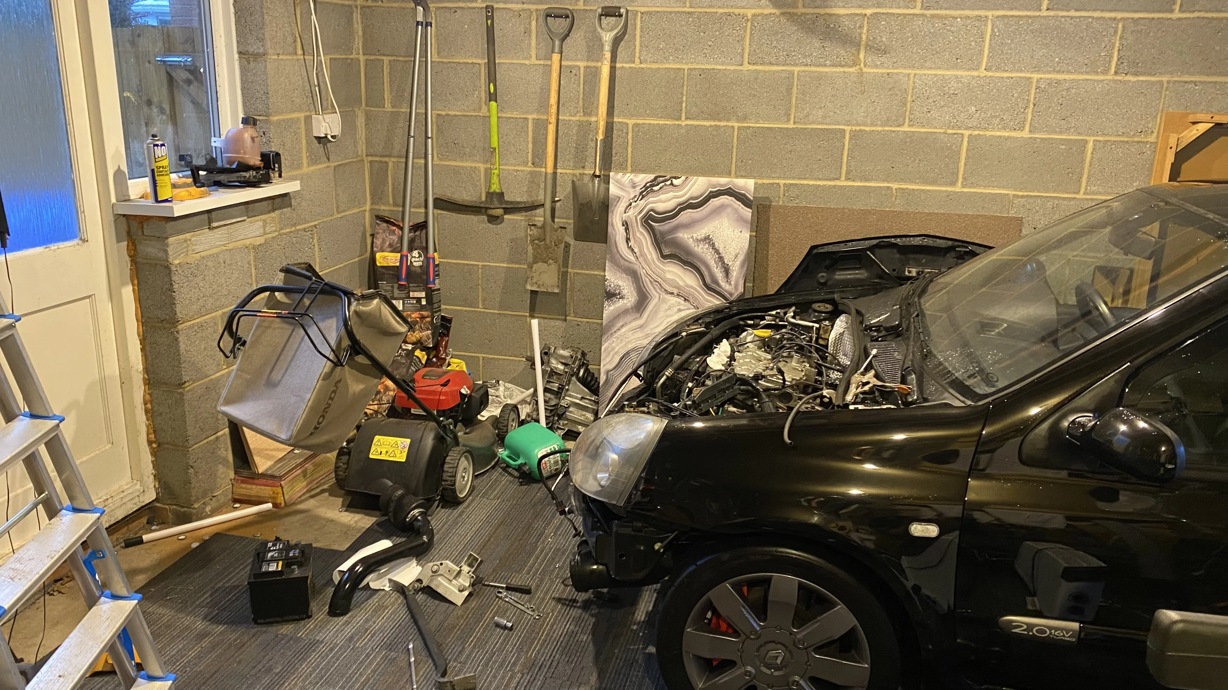

I made a start on the Clio today. It had been banished to the drive whilst the bits to build this were in its usual parking spot in the garage
Now that’s out I was able to crack on. It’s been outside for a fortnight so started with a wash
While it was outside I dropped the coolant, took both rads out, slam panel and bonnet off. Guess I can add a new rad to the shopping list. Also snapped a bolt on one of the ac pipes too so I’ll replace that as well
With the soggy bits out I pulled it into the garage and continued. Upper inlet off, battery and gearbox mount off, upper engine mount off, wiring engine loom separated and ready to come off
Should hopefully have the space to get a hoist in the gap in front of it once all the s**t is shifted. I can’t have it the other way round or the garage door would get rid of any headroom. Hopefully it’ll swing out without having to take the turbo off but we will see!
Can I pull the shafts out of the box and leave them in the hubs on these or do they need removed first? Last engine I pulled was on an Astra and you could just pop the shafts out the box. Would save a chew on of stripping the suspension off again.
When I removed my engine, both shafts came out.
You might be able to leave them in place, but it's so tight for room in the engine bay, I removed as much as I could to make life easier......was still a ball ache though!
Mines out again in the new year to fix the leaking selector seal and put it the RTS clutch I've just bought as the OE LUK clutch I fitted is having a s**t fit at dealing with the extra power 😏
That’s a shame. I’d take them out of the box but leave them in the hubs if I could so I can keep it on it’s wheels and on skates to move it about.
Shame about the clutch, there’s a few use the oe ones without much bother so maybe you’ve just been unlucky but a better one won’t do any harm 😊

Missed these earlier. Removed the ac compressor and alternator to get as much space in front to swing into as possible.
The aux belt is also significantly past it’s sell by date 😂. The tensioner puts literally zero tension on it and I pinged the belt easily by hand. May have dodged a bullet there….
that’s it now ready to come out. The downpipe to turbo bolts are a total t**t on for access so I’ve unbolted the turbo from the manifold and cable tied it to the wipers to keep it out the way like any normal sensible person would do 🤷‍♂️.
Just need the shafts out, dog bone off then that’s it. I’ve had a small brainwave and when it’s out I’m going to cut the cross member so I can bolt it on/off then once I get access to replace the shagged captive nuts on the subframe it’ll mean that going forward I’ll essentially be able to drop it onto a trolley and wheel it out. That’s the theory anyway!

Ok, so because I’m a total mong I decided to cash in and sold my 5 series. I made £300 more than I paid for it nearly 3 years ago with a further 20k miles added. Absolutely mental 🤷‍♂️.
The plan was to get something reasonably s**t for a few hundred quid until the wife’s new car eventually turns up and I’ll pinch her 5 series off her then. Had a quick search and everything for a grand or so at the minute is total utter dog s**t. I went to view a few from marketplace (the home of the reptile). All were being sold by rancid messes and the cars stank of weed and all had a plethora of warning lights on the dash; despite the owners claiming they are “a1 condition bro fam”
As such, the Clio is coming back on the road and into daily duties 😂. Engine is back in exactly as it was, most the ancillaries are back on, exhaust is on, I just need to decide what to do with epas as a dci rack arrived today.
New plan is to buy another bottom end, get the Meg pistons fitted into that and then when I’m ready whack the current lump out, swap the head over and put the whole lot back in one weekend. Nothing is ever simple!
