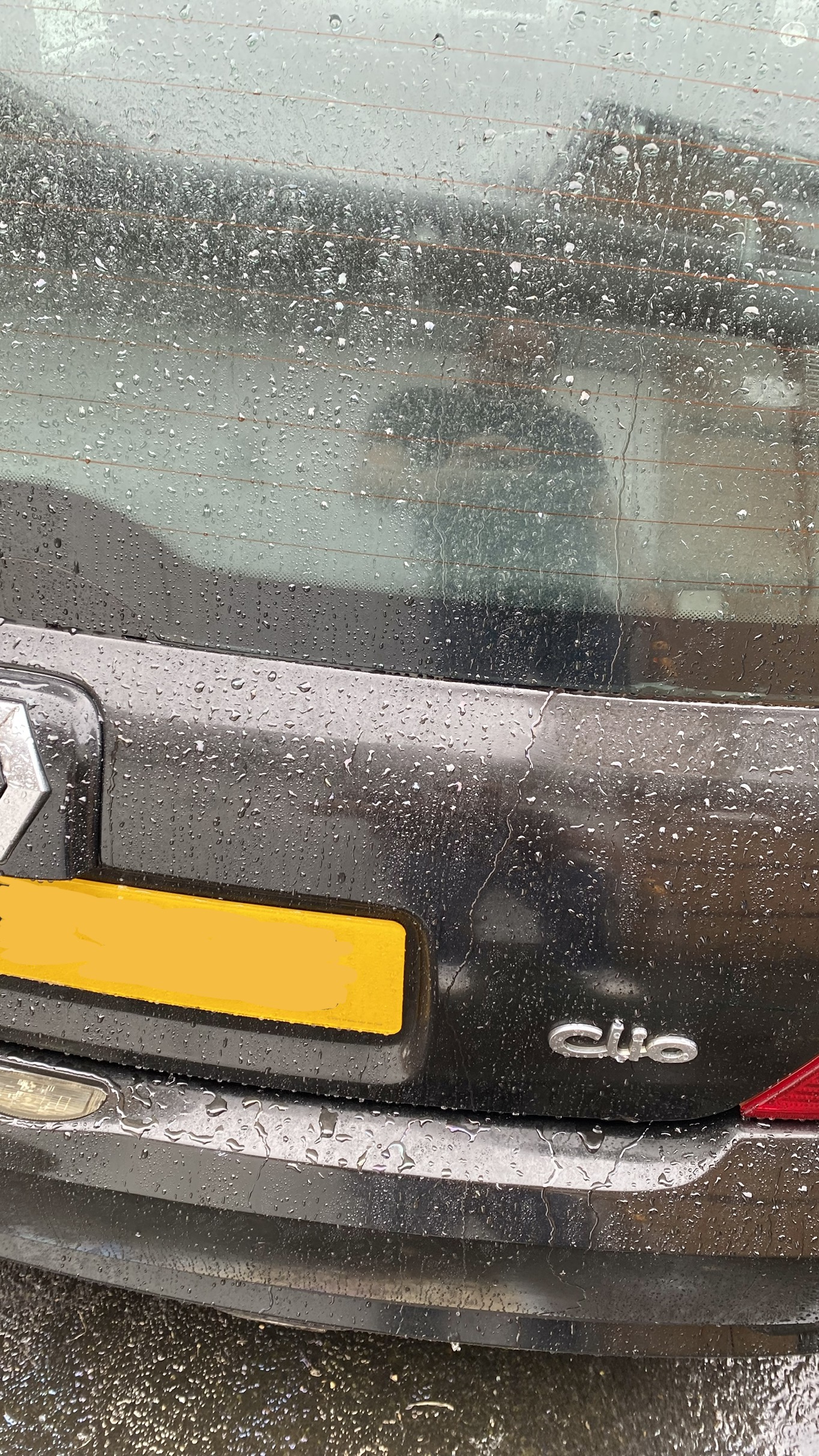

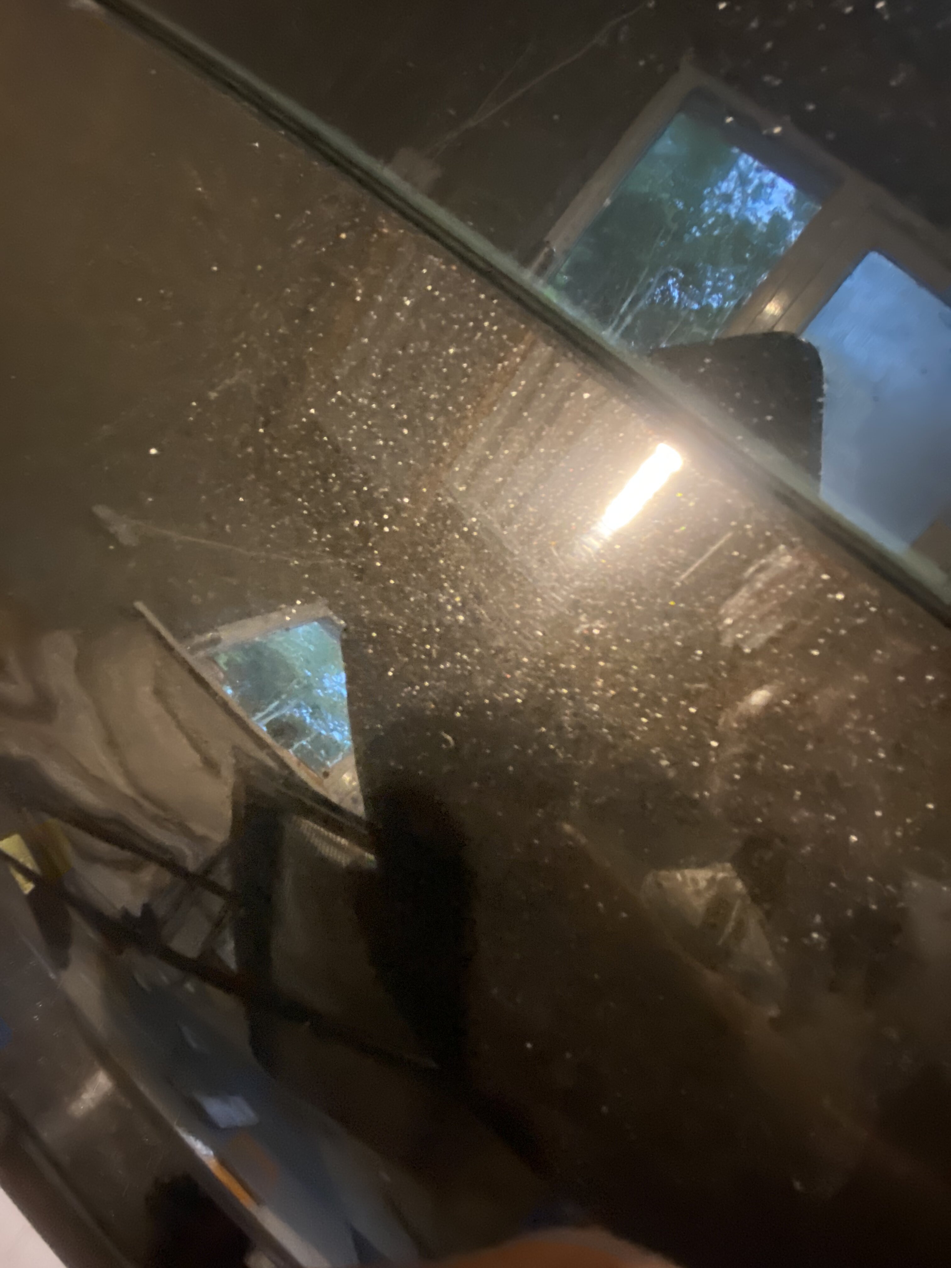

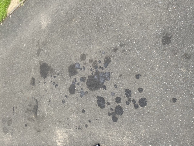

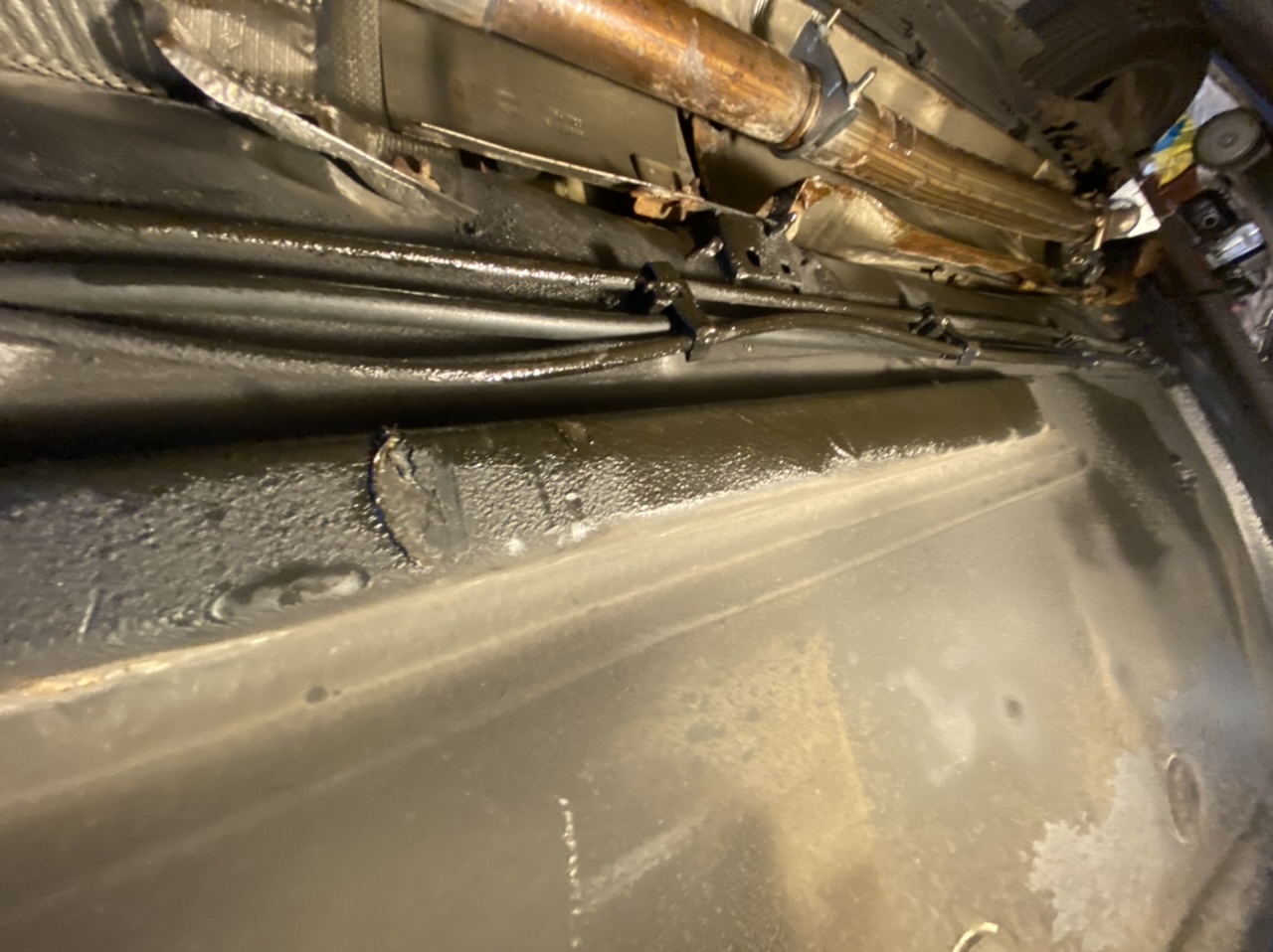

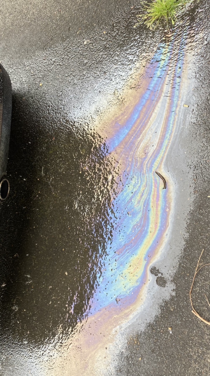

Clio has been running well for about 10 miles or so then had lots of blue smoke off throttle. Jumped out for a look and it’s developed a slight oil leak
The drive has a drip or 2. The wife predictably will be unimpressed so used some man logic and parked her car over it. Thinking is she’ll never see it cos she reverse parks 👍

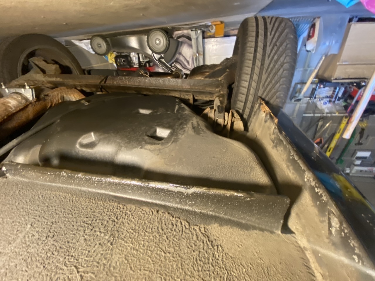

back of the car is covered 😂
and the underside is literally dripping
good news is it’s not the oil return. Bad news is that means it’s something else. Top of the engine looks dry so hoping it’s just the sump gasket. That’s where it looks like it’s coming from at least 🤷‍♂️

Unfortunately it is very uncommon for the sump gasket to leak like that in 10miles.
That aux belt is too old.
Keep us posted mate
Keep us posted mate
yeah the belt is a bit worse for wear. Believe it or not that’s covered next to no miles and isn’t due another change until December.
That was my thoughts to be honest. There’s a s**t load of oil everywhere. Even if the sump wasn’t bolted on properly I still wouldn’t expect it to fling that much out. It’s the only place it can be coming from though I think. The engine is dry once you get an inch or so above the level of the sump and the front of the block is totally fine. I must have nicked the gasket fitting it somehow and ended up with it not sealed. I’m not sure how I’ve managed that given the bolts go through it but that’s all I can think of

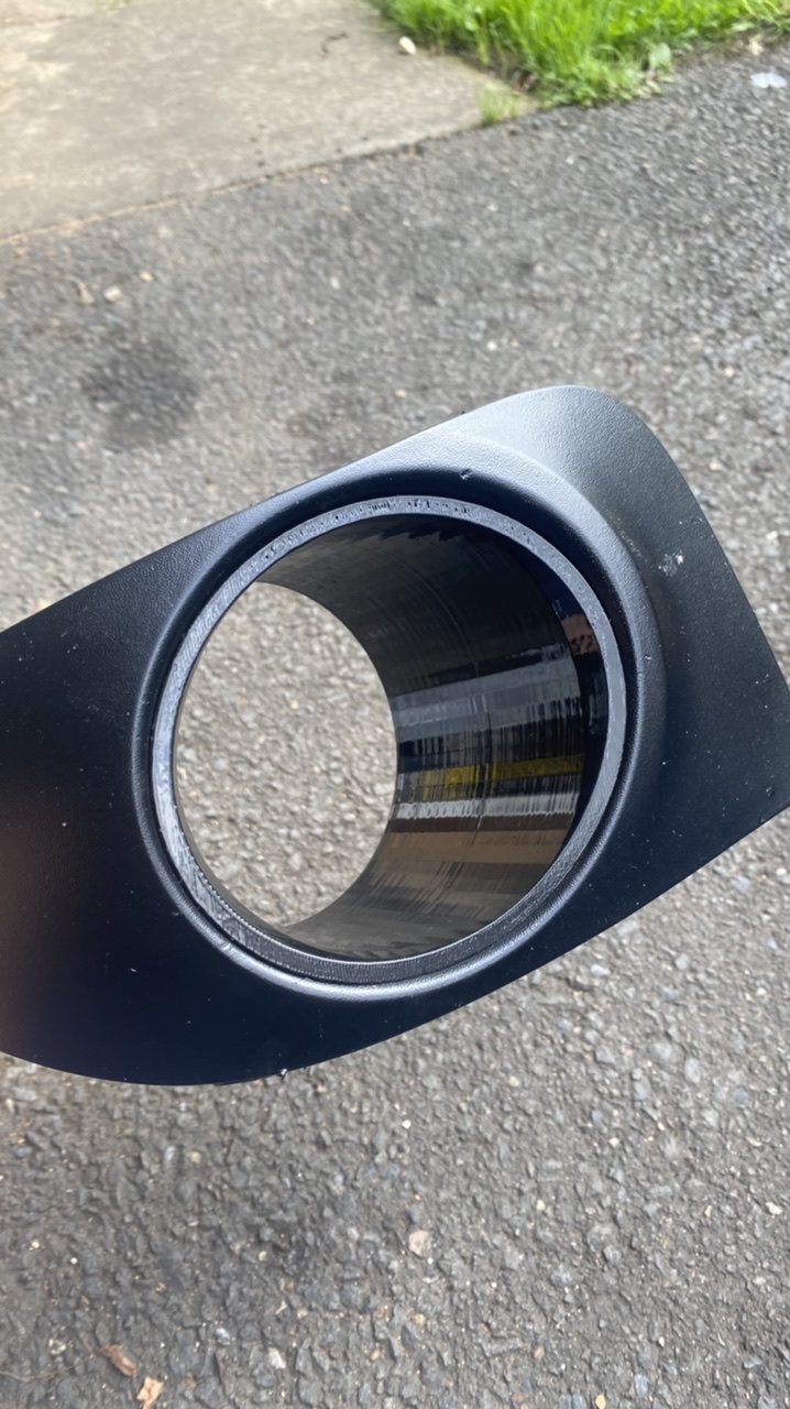

I was going to address the oil leak today but halfway into it my spotlight ducts arrived courtesy of Simon (@04-182 ). I’ve been after some for ages but never seen any that don’t look terrible and/or don’t fit properly. These link up with corvette ducts to form an almost oem solution.
The fit in the surround and quality is absolutely spot on
And in the car they look bang on

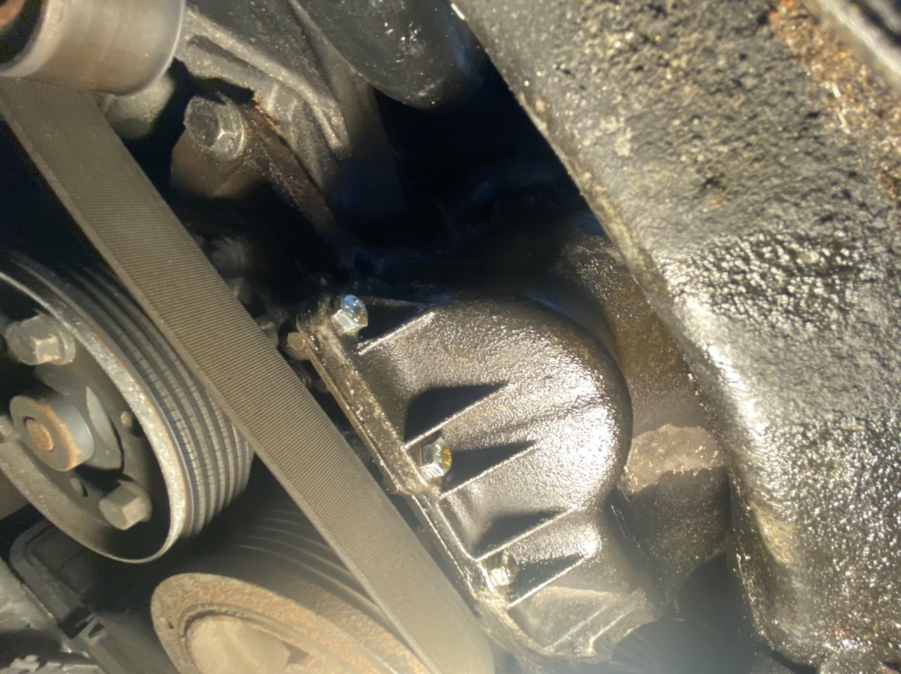

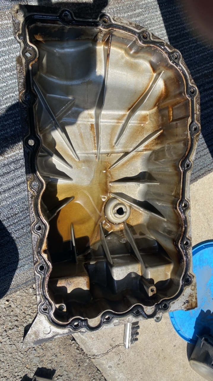

Spent some time on the oil leak today. Got the sump off and the gasket actually looks ok on the most part. Looking at the underside of the block there’s a join that isn’t quite flush and that’s where the leak appears to come from on both the front and back. I’ve scraped the excess sealant off to make it flat so should do the trick. The original gasket is below
I’ve added some silicone gasket marker round the outside so along with the new gasket hopefully that’ll do the trick. I was going to tighten it all up but it was hot and beer was much more interesting 👍

If it does it again and you need to re-apply the tube sealant i'd recommend taking the original gasket off and get a blowtorch on the mating surface to remove any residual oil. The problem with ali castings is that they are DIRTY. Ali is a dirty material as it is, the casting process makes it even worse.
It's what has to be done before welding ali castings to remove any surface impurities.

I’d put the everything back together and threw in 5L of Halfords cheapest best oil to see if I was still leaking. Good news is the sump now appears to be sealed so all is well there. The oil return is also leaking. I used a barb on the bottom to allow for some more movement and the clamp doesn’t quite seem to be nipping tight enough. I’ve ordered a much beefier one so that should do the trick.

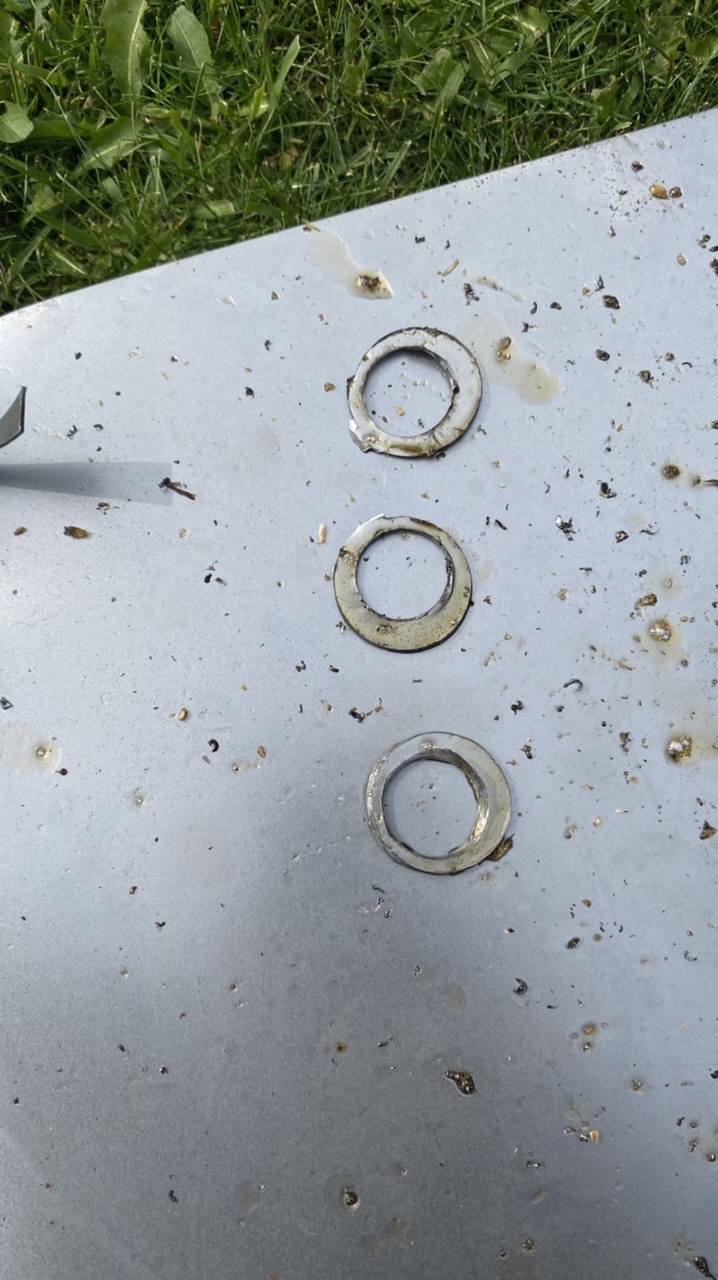

Sorted the slight leak on the oil return today. I decided I needed a washer on the fitting that goes into the block to spread a bit of pressure and let me get a gasket in underneath it. Couldn’t find anywhere that did m22 washers so made some. Hardly precision engineering but they work and work well. Ran up to temp and not the slightest of drips from anywhere 😁

Unplugged the catch can and all is well in the world 🤷‍♂️. Full boost, no smoke, all is happy.

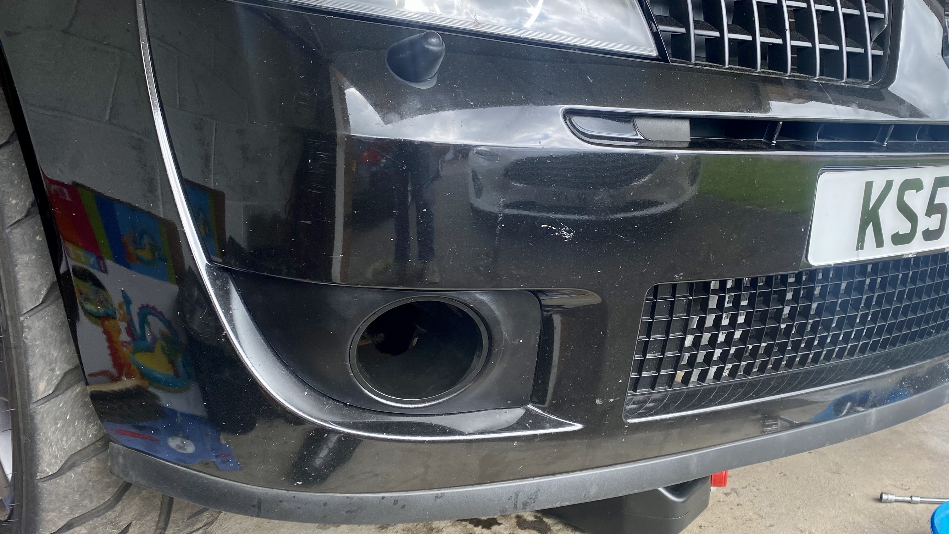

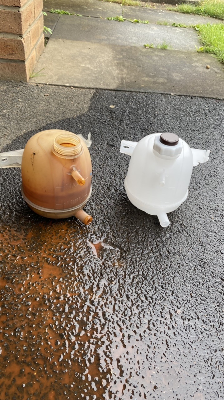

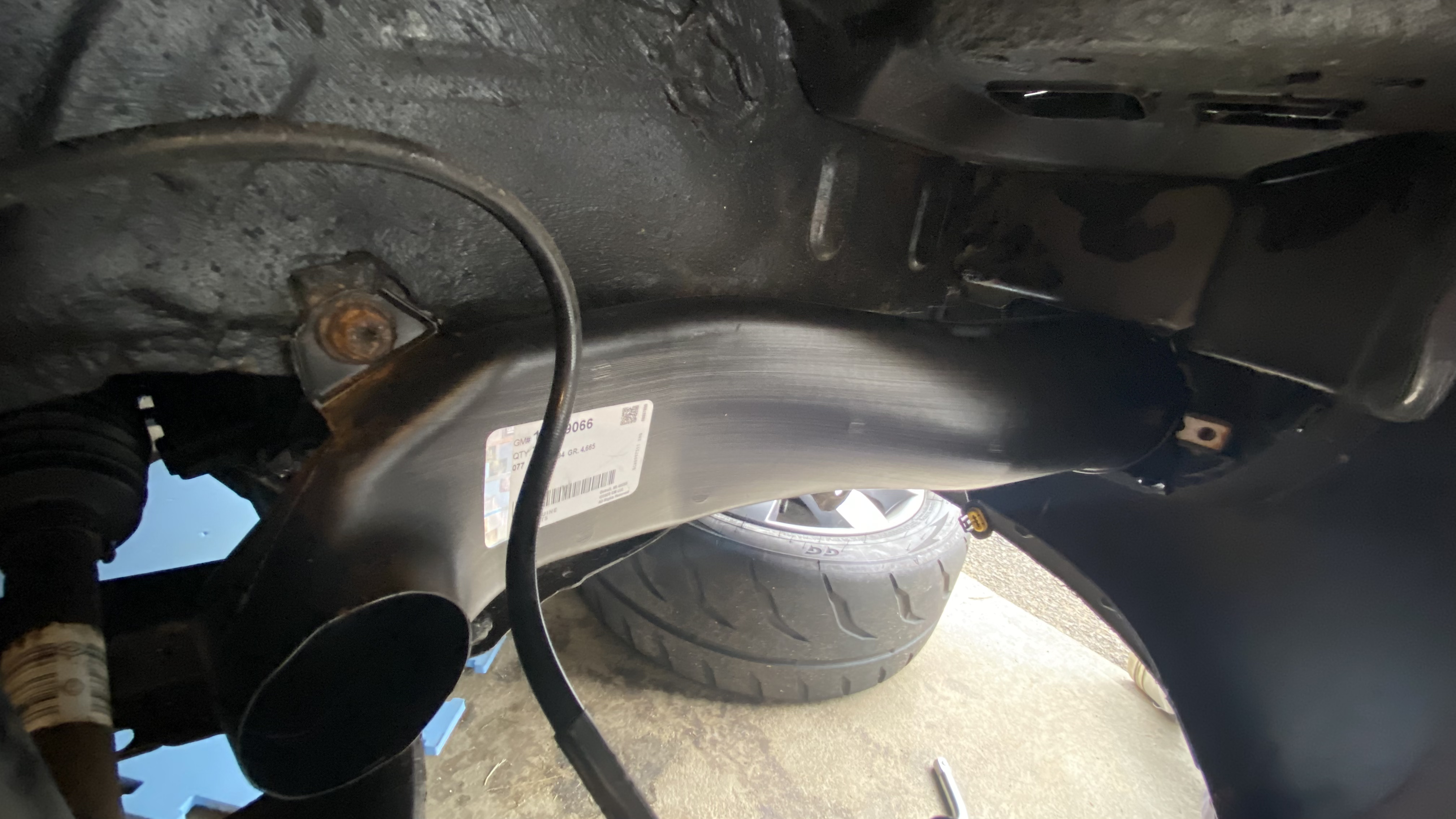

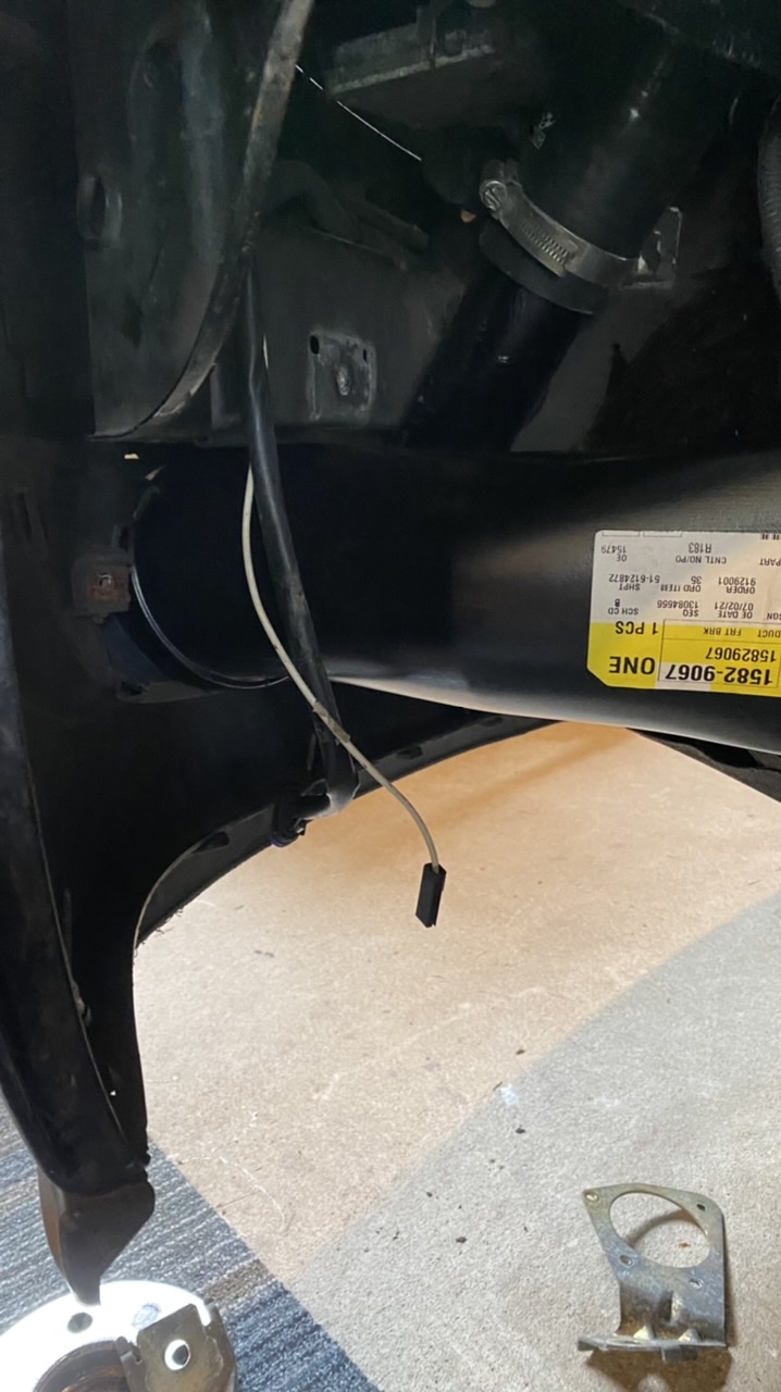

The corvette brake ducts arrived this week. Drivers side fitted without any issues but the passenger side looks like it’ll be a bit more work with the horn in the way. My Covid riddled brain couldn’t work it out so sacked it off for the day.

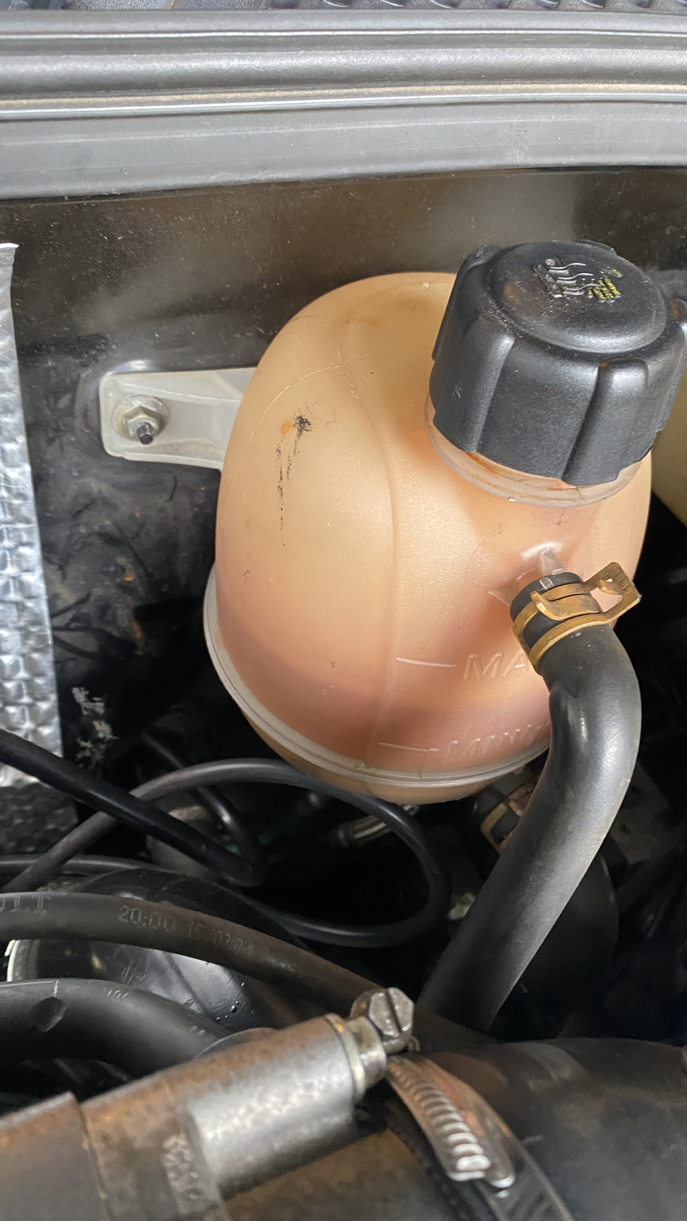

I’d also received a new coolant bottle as the original is looking a bit scabby
Popped the coolant hose off. Looks like it’s been stabbed
old vs new

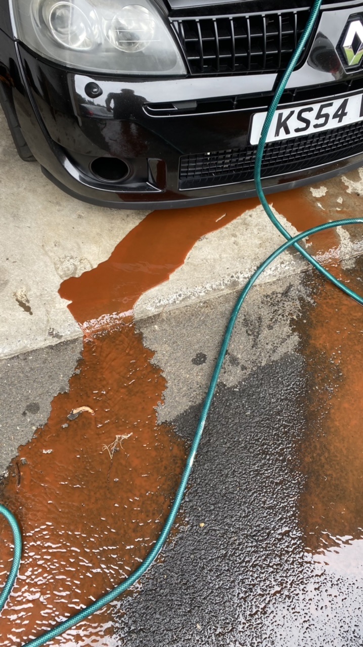

I stuck the hosepipe on the bottom rad hose to clear out the old red stuff. Ran it up to temp on council pop to clear it all through and will drop it all again and refill with the glow in the dark Renault stuff.

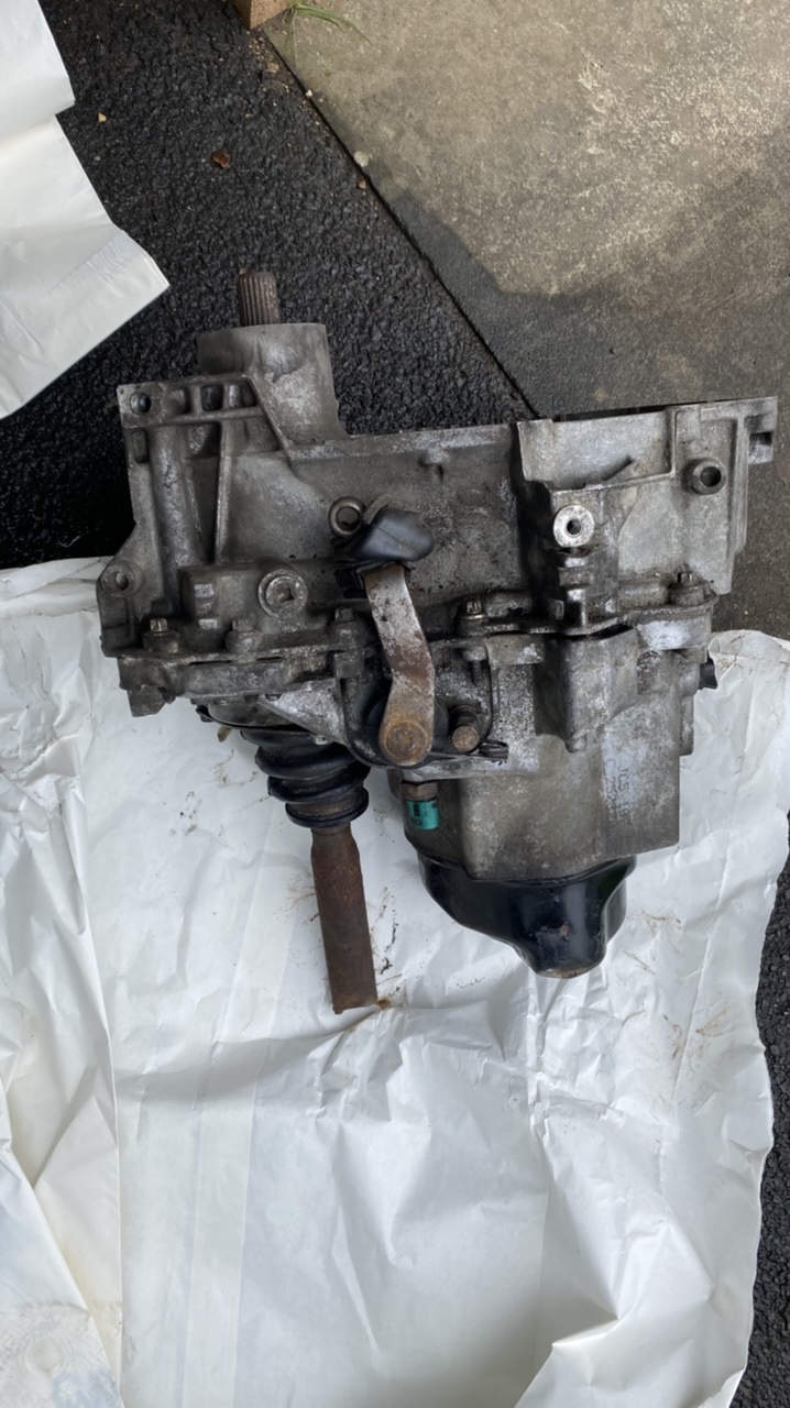

New box arrived too. Will be a while before I bother fitting it but at least I’ve got it now. It’s a jc5-107 so hopefully the ratios are a bit better

Make sure you fit the old cap to the new bottle

Can you share the part number of those ducts? Smart looking!
15829067, 15829066?
Yeah they are lovely! I thought they’d be terrible for the price but they really aren’t. Clearly manufacturers in the states don’t rip us off to the extent that the guys in Europe do!
Link for the ones I bought is here:
https://www.ebay.co.uk/itm/281605705202
They use the eBay global shipping program so all the fees and import taxes are paid upfront so there’s no messing about having to pay to get them unstuck from customs when they arrive. Delivery was around 4 days from posting.

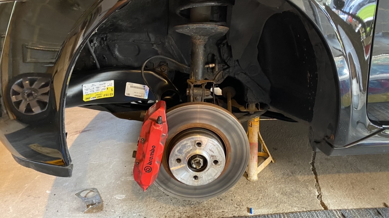

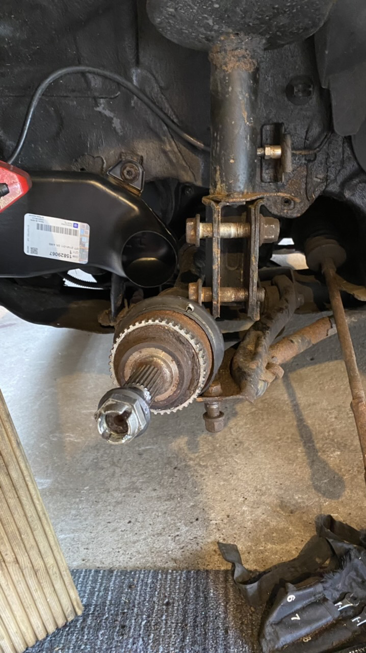

Had some free time today so decided to fit the other brake duct. Jacked the car up and did my usual check for play… think I’ve found the source of my issues 🙈. Bearing has def seen better days! With the wheel off the disk is flapping about and essentially rewinding the calliper piston hence the different bite feel each time I press the pedal
Got the duct fitted first of all. I need to figure out where to put the horn but I think I’ll just be able to put the bracket on backwards and move it further up
Got the hub stripped off. I’m lacking in a press so I’ll drop that off at a garage on the way to work tomorrow

Wow, a "small" bearing play...
Those ducts are perfect!
yeah….. it’s well gone 😂. I knew there was a bit of a knock on that side but assumed it was a top mount or something. Don’t think I’ve ever had one that far gone haha!
I’m well impressed with the ducts. They’ll need a tiny bit of modding; they just catch the tyres on full lock but I think if I get a heat gun on them and push them with a bar they’ll move enough without any issues. It’s maybe only 2/3mm so only a tiny bit!
What wheel ET are you running?

Got the hub back with a new bearing in today. Got it all fitted up nicely. One of the biggest things that bugs me with these cars is how easy it is to pop the cv boot taking the strut off. Avoided that added mess this time though 👍
