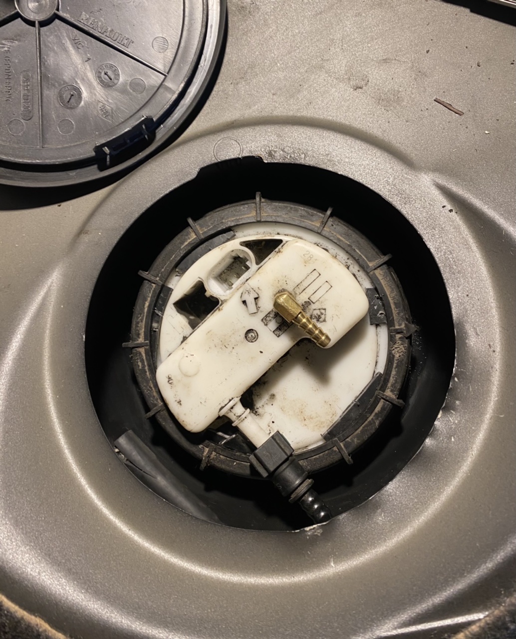

I picked up a new ring for the fuel sender yesterday. This one is genuine Renault and the t**t won’t go on either. Am I really that simple or is there more than one thread type and I’ve got the wrong one twice?
If you thread it more it could twist the gasket? Add some ptfe lube on o oring.maybe that help
I always have a problem with these, mine is leaking if I brim the tank on the Twingo. About once in the last 4 times I've done it has it properly sealed. Proper t**t of a job, hopefully someone pipes up here on the "correct" way to align and fit them.
I’ve lubed it up and everything. Just keeps cross threading 😡. The seal sits underneath so it’s not interfering with it
That makes me feel better that it’s not just me! Mine is leaking pretty badly from 1/2 a tank or so but the fuel is collecting and sitting on the rim that the sender goes into so it stinks in the car.
It couldn’t be the tank losing its shape or something stupid like that could it? There was only about £5 of petrol in it when I took the sender out so doubt that would be enough weight to deform the tank?
The only other option I can see is to go nuclear and drop the tank and kick the s**t out of it until it aligns and fits but that’s a massive ball ache for such a little job 🤦‍♂️
there is a tool to do it with but I'm convinced there's a way to line it up before starting to wind it on, just not found it yet. I tend to lube it up a little, then place the ring on whilst holding the sender down. Turn it the wrong way until it drops back onto the thread and then do it up.
I could be assembling it wrong though. Does it go black locking ring > o ring > sender or locking ring > sender > o ring ?
Yeah I’ve seen the tool but surely it should still finger tighten enough. Mine is just having none of threading on at all. Even going backward and letting it drop in it’ll only bite on one side
When I took mine off it was o ring then sender then locking ring so been attempting that to refit. I’m not sure if that’s the way it should be but I’m assuming the pump and sender have never been out before now. I tried it the other way round and it made no difference. The ring won’t even finger tighten onto the tank with the sender out completely.
It’s doing my head in 😂
just checked mine, o ring under the sender to the tank. it looks like it goes on to start with by hand then goes tight for me. iv tapped it around will see if it still leaks on the next fill up
hopefully that sorts it for you 👍
I had another go at mine this afternoon. It’s got no intention of grabbing the threads straight. I tried a jack under the tank to see if it has sagged or anything but made no difference. I then decided to try boiling the ring to see if heating it up would make things easier which is did slightly.
It’s now sat like this. I’ve wedged a couple of plastic shims under it to see if that’ll seal it. The smell of fuel is gone so that’s got to be a good sign. I’ve ordered one of the tools for it so I’ll force it a bit tighter to see what happens. If all else fails I’ll have to drop the tank. I can’t have it leaking fuel

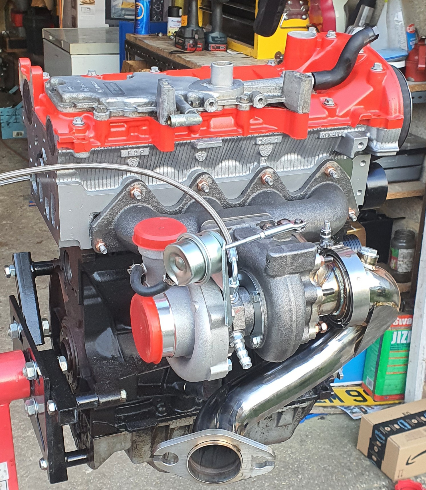

🙃View attachment 1538320

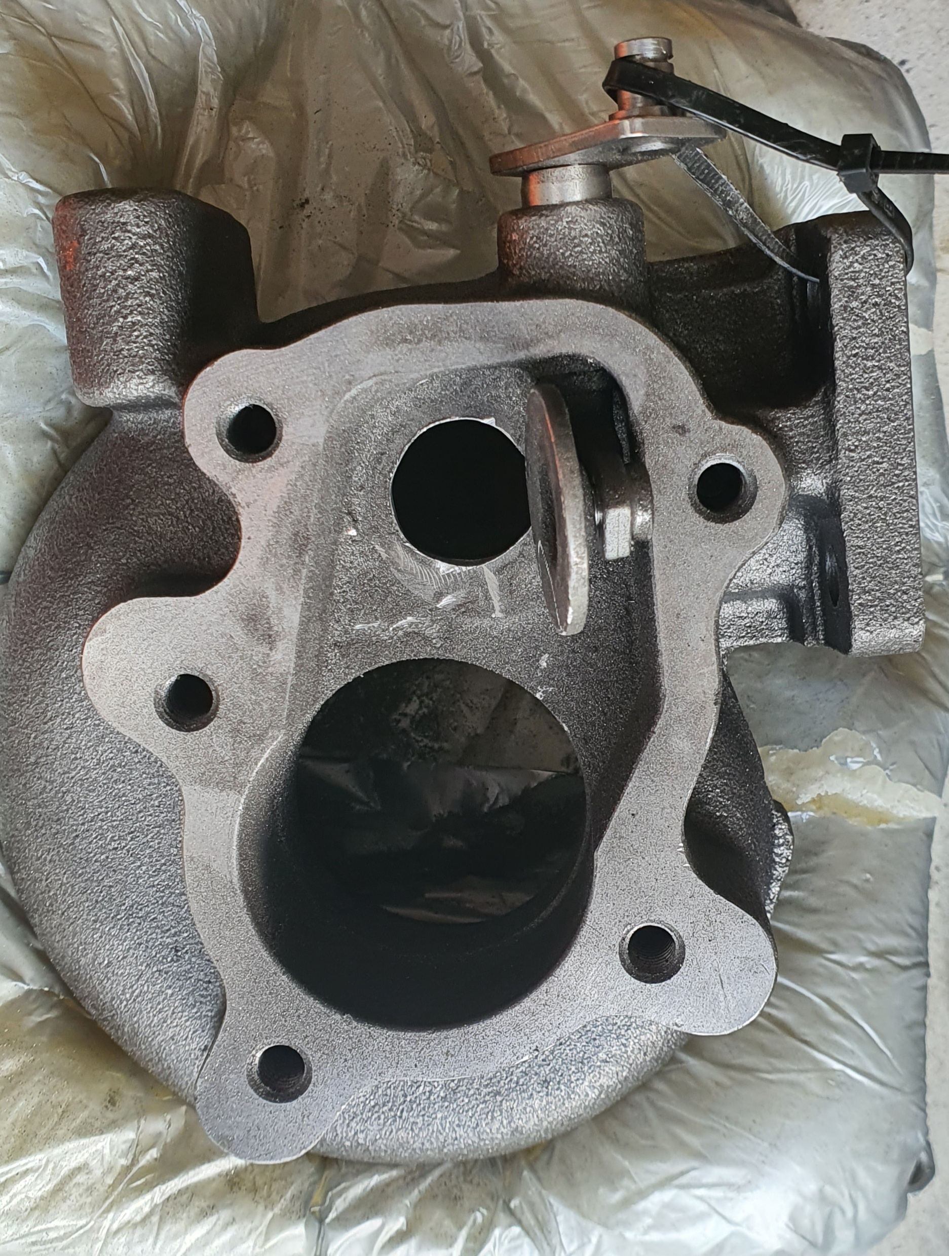

Mine is a gt2860 replica special from Czech Republic. Chris said similar to be but the lag isn’t bad to be honest. I’m seeing boost at about 2.5k which is more than acceptable. In an ideal world I’d like it a bit sooner but they are revvy engines so it’s not a problem. I’ve been used to having to mash the limiter in every gear to make it move so it’s not bothered about being up the revs.
I considered the gt25 size but I’ve used them in the past and found they’ve either started to tail off or the boost has dropped at higher rpms. This one is holding 8psi to the redline with no fluctuation at all. I’d sooner lose a bit of low rev boost for that given it spends no time at all under 2.5k rpm.

I got it from Maxspeedingrods after watching an independent review on them (worth a watch)
It's got a claimed exducer size of 71mm over the 60mm on the gt2860, which could make it a bit more laggy, but I guess I'll find out once it's all bolted in and running and tbh, I've not measured it. It's defo a chunky monkey though lol!

Ah thanks Steve, that's good to hear that the lag isn't too awful, although mine is a bit of a larger turbo so I'd guess boost may come in a little later than yours, but we will see!
Agreed on tbe 25s running out of puff, though if I'd been able to lay my hands on one for reasonable money it woukd have been my preferred route.

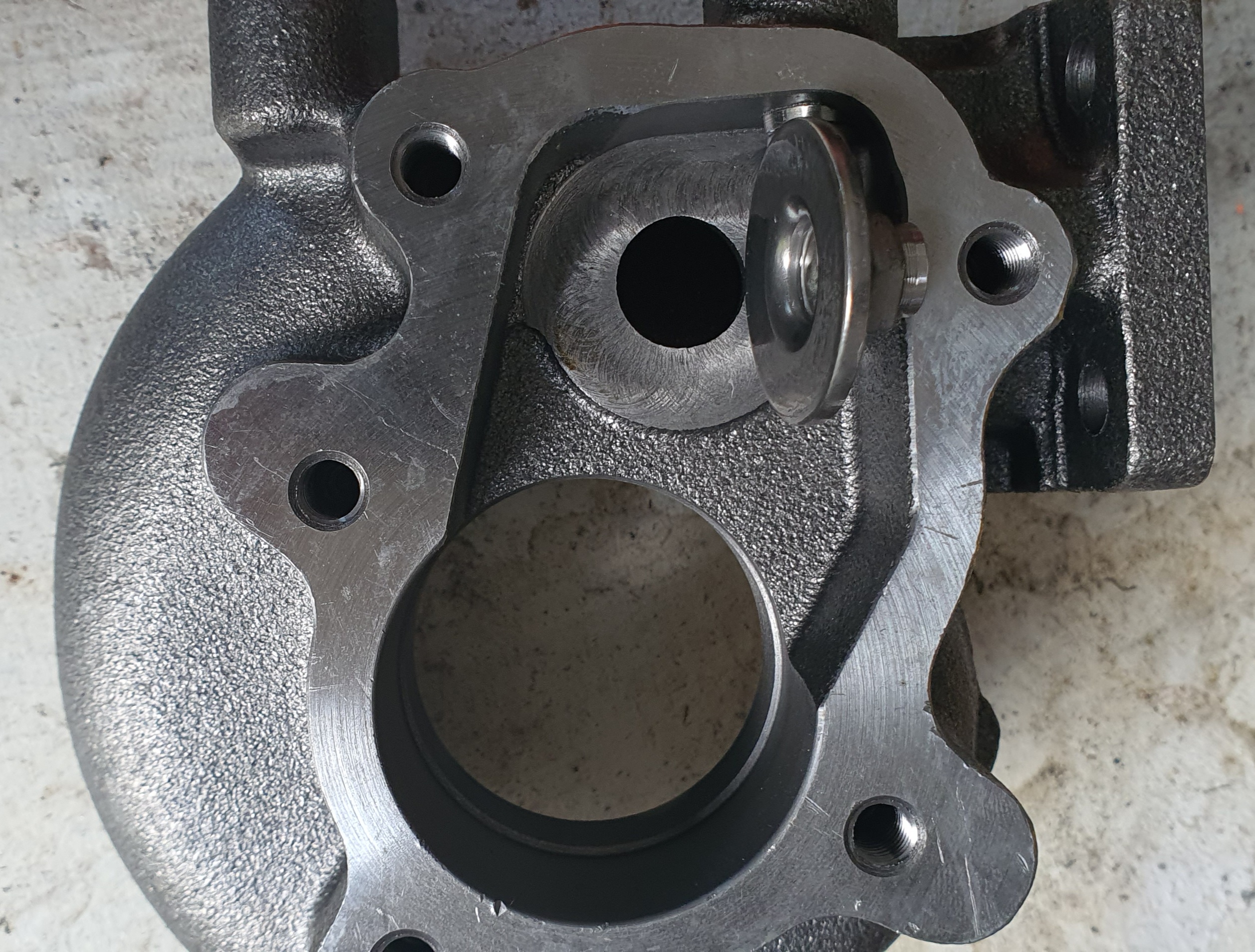

I did also port the wastegate on mine as it was tiny and likely to induce boost creep and make the boost come in even later up the rev range. A dremel and 15 mins of grinding sorted that bad boy out lol. (See before and after pics)
I'm also fitting an adjustable wastegate with a 5psi spring in conjunction with a manual boost controller to further reduce any wastegate creep.
Hammer and a big flathead screwdriver to knock it tight

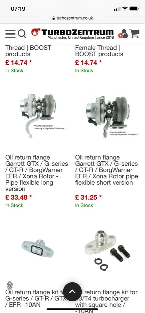

I've used Engine Dynamics oil return and though the engine isn't in yet......it does look like it may run pretty close to the down pipe!
I'm tempted to wrap the pipe to give some protection
I use the flexible pipe from these guys, I modified the end with an insert instead of the AN fitting. It’s much better than a silicon pipe!
yeah it’s probably not a bad idea. The original silicone version was maybe 5-10mm from the downpipe at best. The new one I’ve put a 45 degree fitting on it that points towards the passenger side of the car then bends back towards the engine from there. It’s still very close but hopefully should be a bit less melty.
That could be a good shout if I have bother again. It’s a ptfe steel lined hose I’ve used which has temp rating of up to 350 degrees internally and the outside “should” shield and withstand 800 which is way above and beyond what it’ll ever have to deal with. Time will tell though!
Fittings wise I’ve used an10 to jic coming off the hose, then adapters from jic to 1/2” bsp to fit the turbo outlet and the thread into the sump

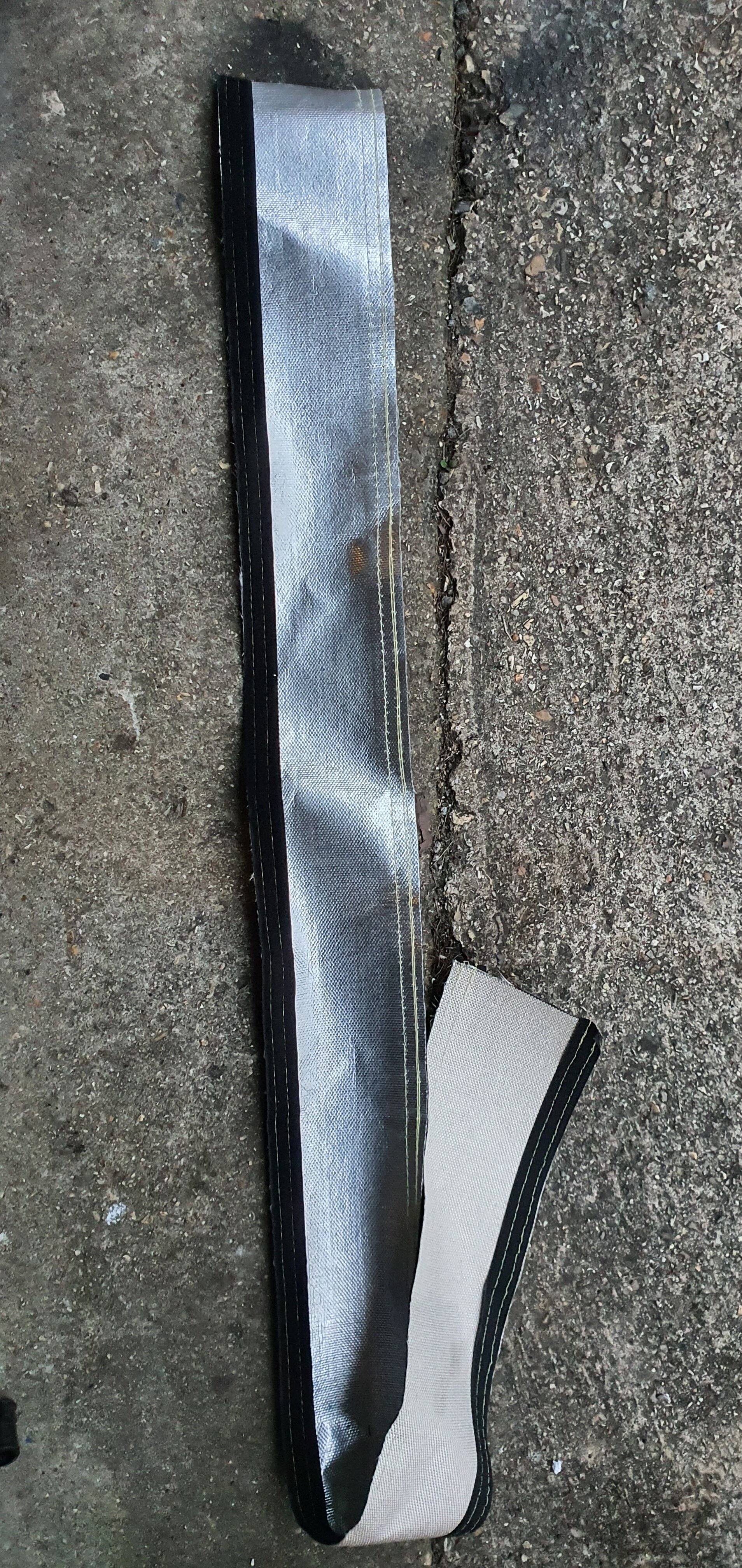

So, I've just ordered a hose heat protection wrap around blanket thing. That should fix it

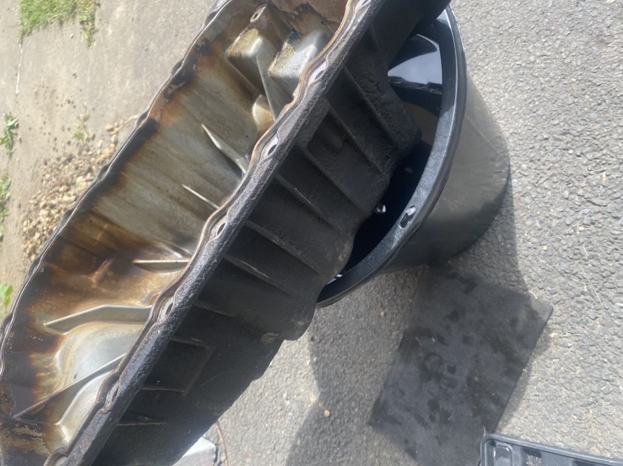

My oil return continues to piss me off! Since upgrading from silicone to braided it’s dislodged the pipe to the sump and it’s now leaking oil from there instead. Lesson learned, do it the way everyone else does and tap the block.

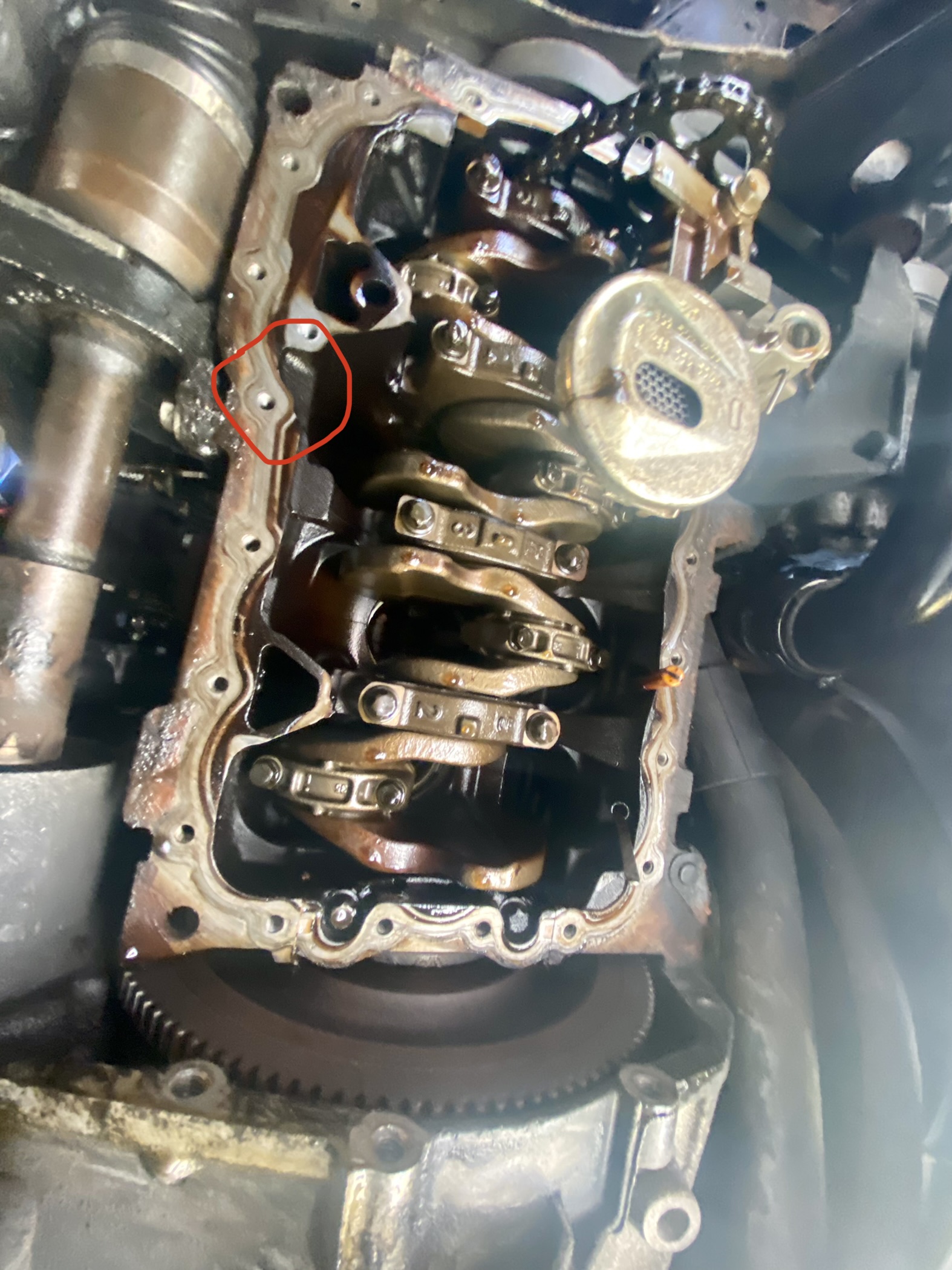

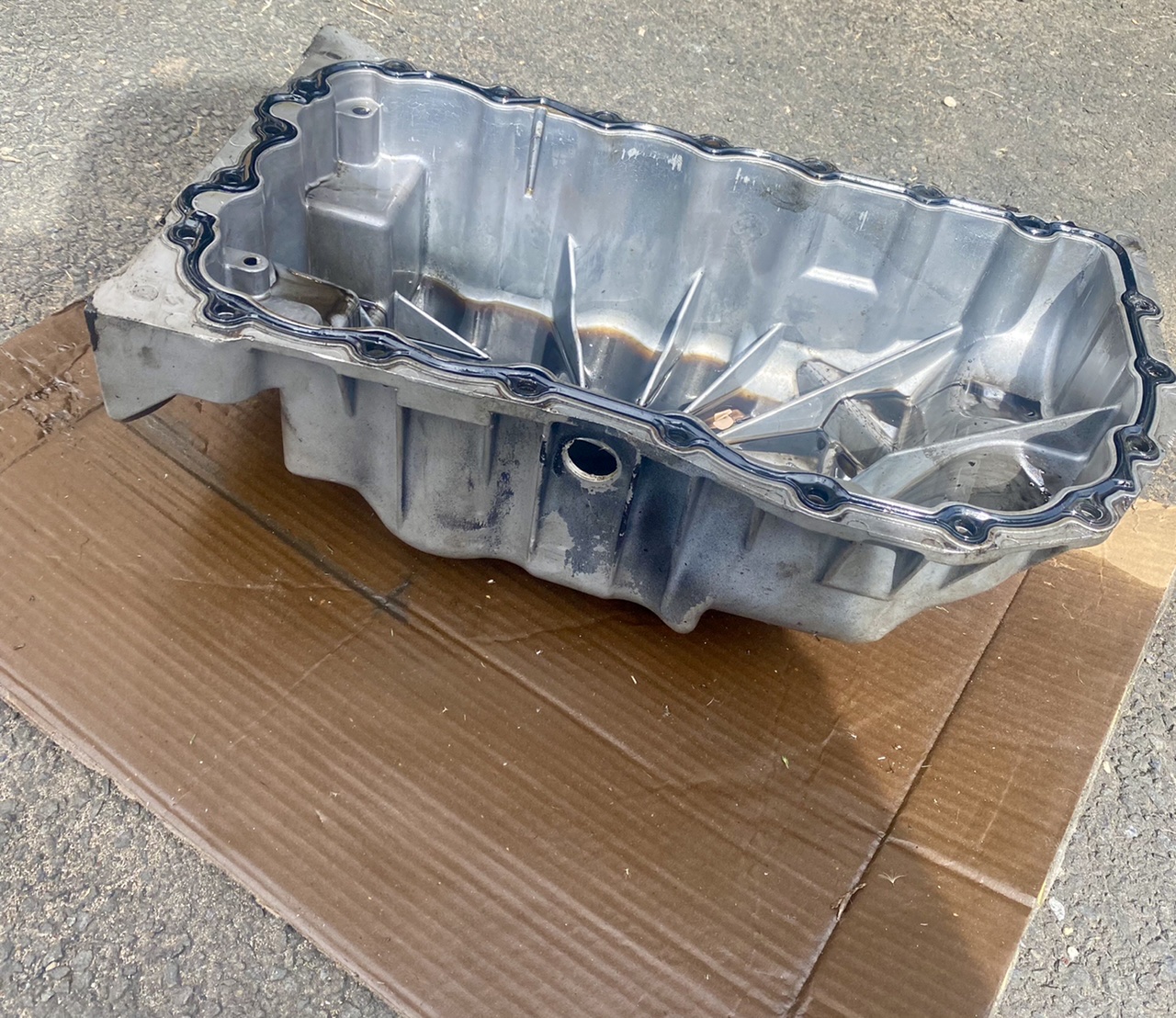

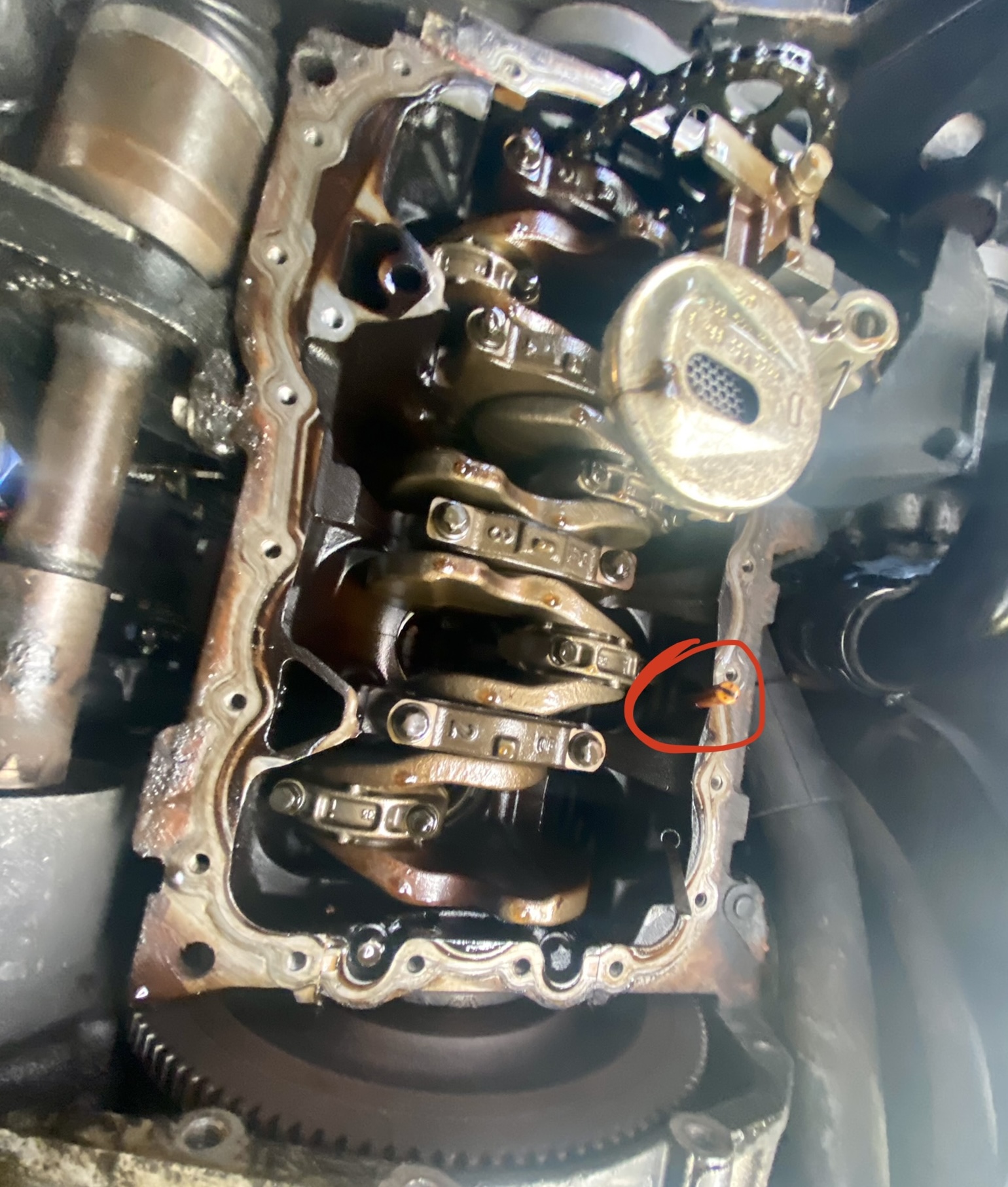

So sump came off again for the 152683636th time. Record time, 15 minutes to remove 👍. Shame to throw it out cos it was nice and new and pretty. Hey ho.
I still had the old one sat in the garage, even though it is a bit shitty. 2 cans of brake cleaner later it was gleaming (no pic)

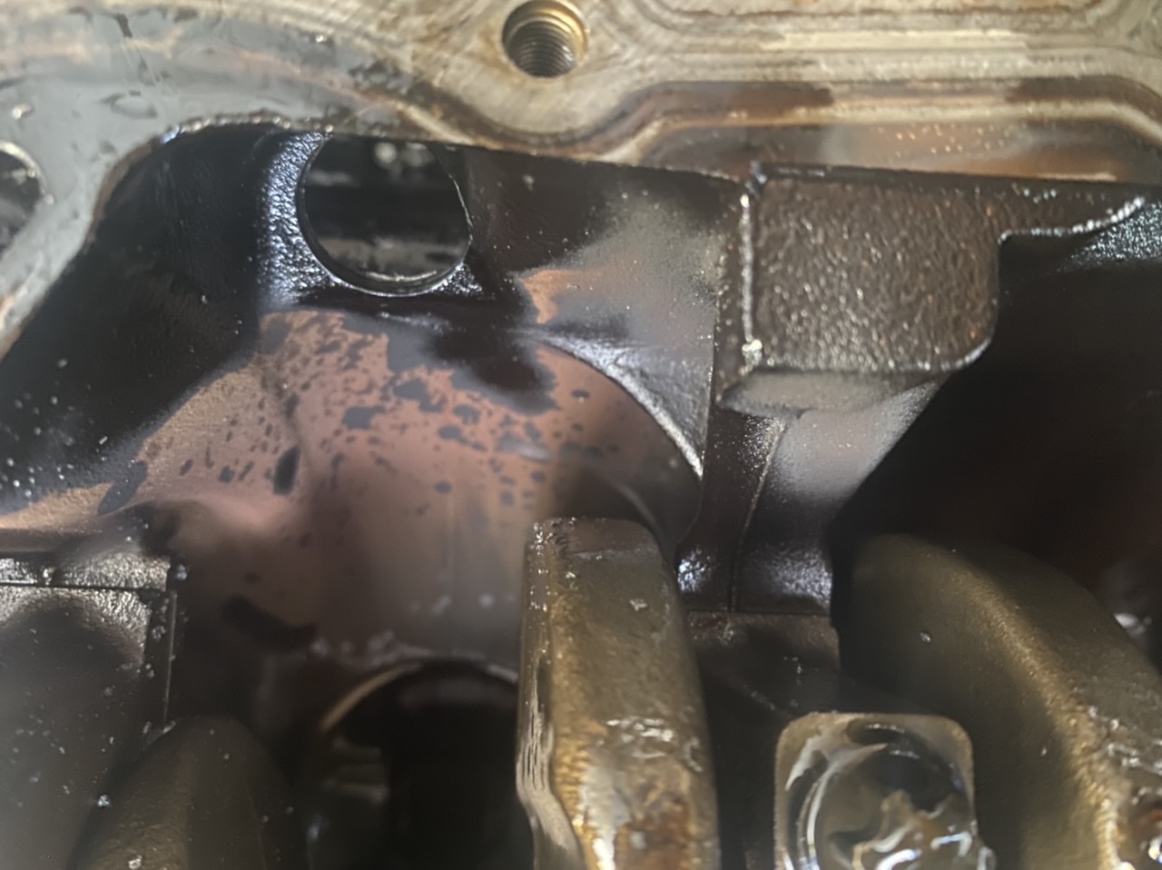

The circle marks the spot for the return to go into
I was then ready to pop the hole in. I didn’t have a 3/8 hole cutter or tap but did have a 22mm one and a m22 x1.5 tap. Some quick man maths later and a m22 to 3/8 adapter is cheaper than a 3/8 hole cutter and tap. Very soon after said maths there was a 22mm hole in the block 👍. Adapter should arrive on Tuesday then I can stick it back together again
I've used wrap around heat shielding on my silicon pipe. Looks like it'll do the job.
Got loads left over if ya want some to use on your silicon pipe? Happy to put a length of it in the post to you 😀

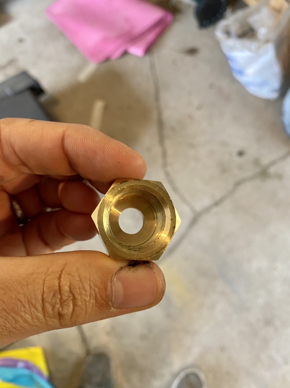

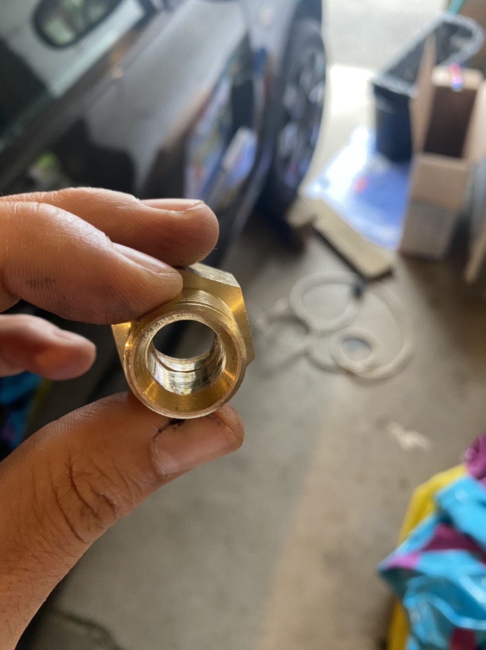

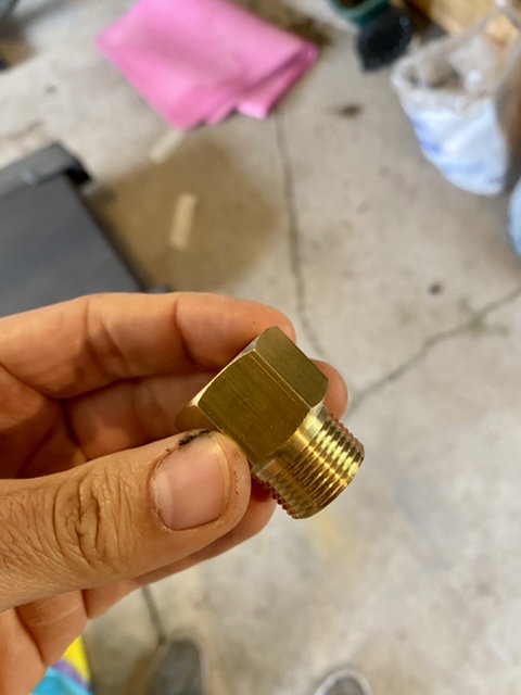

My m22 to 1/2” bsp fitment arrived today.
For whatever reason it’s got a restrictor in it
not any more…

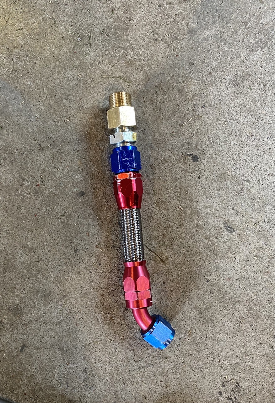

And it links up nicely to the oil return. I need to shorten the hose by about 20mm to get it to fit with no stress on any of it
it’s all ready to go but the tap wrench I’ve got for the m22 x 1.5 is too big to spin in the space available and the extension bar I’ve got only does up to m14 🤦‍♂️. New extension is ordered so hopefully that arrives before the weekend and I can get it all back together 👍
