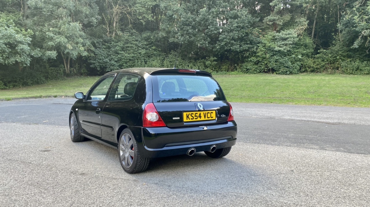

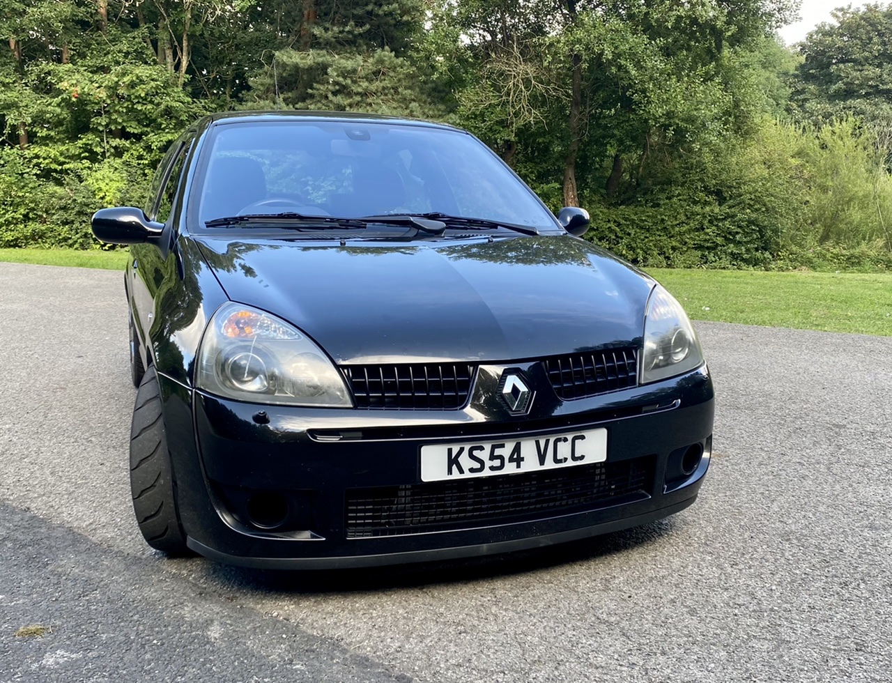

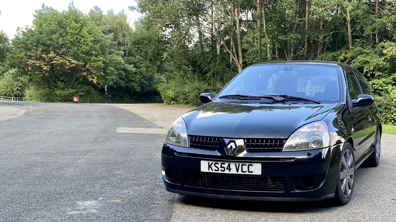

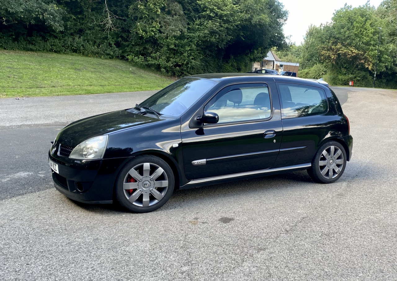

The car made it off life support today and had a good run out. Ran really well with no issues. I’m managing to get fuel cut on hard corners which I’ll have to address at some point. Brakes feel fantastic now too. Pedal bite is consistent and predictable. It’s amazing the difference a wheel bearing makes 😂.

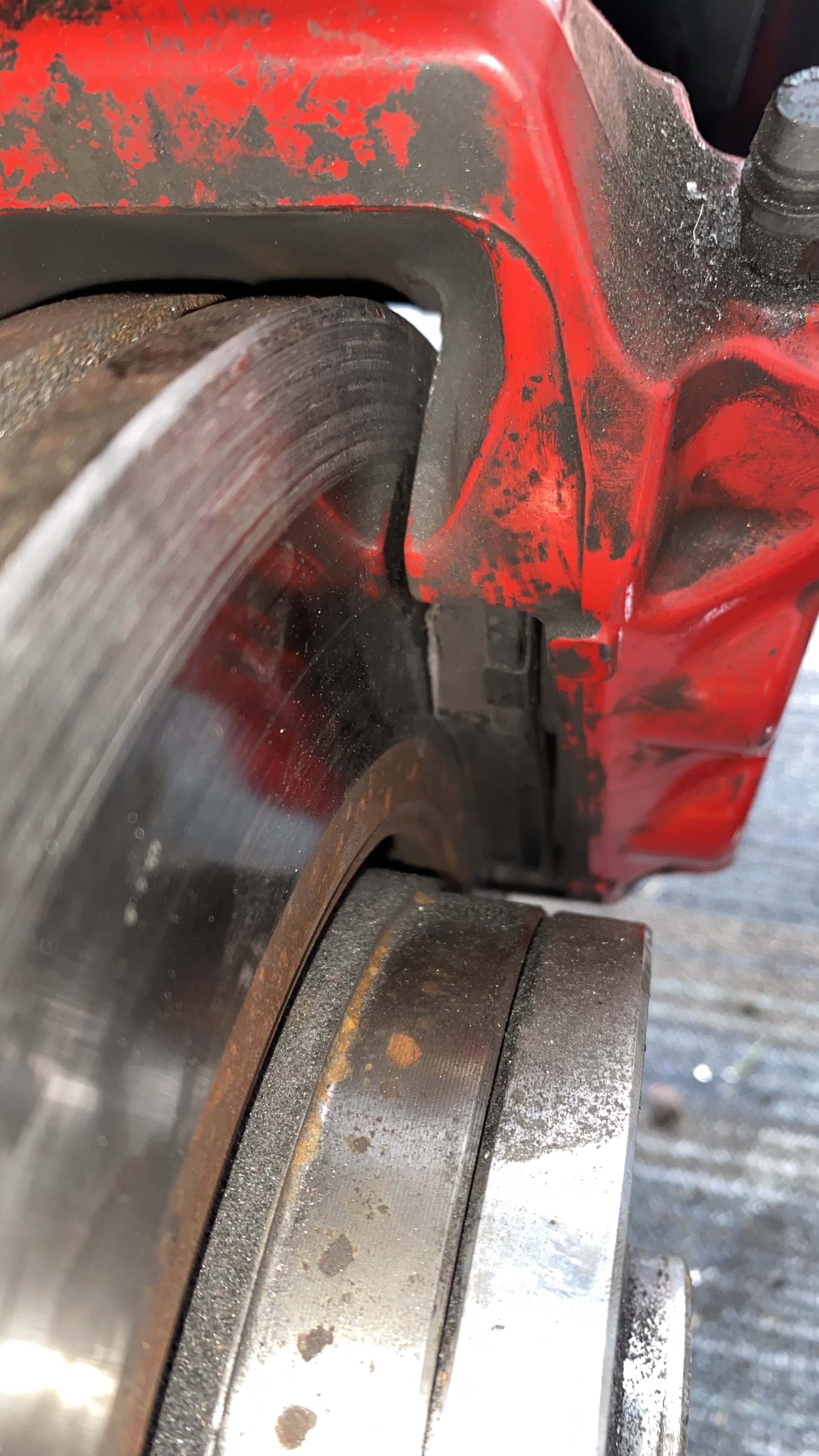

The brake ducts need a tiny bit of work too. They are only just catching on full lock. Solution for today was to not use full lock but I’ll get the heat gun on them over the weekend to bend them in ever so slightly. The R888rs have got fairly chunky sidewalls compared to the RS3s on the back so I think they would probably clear them.
Anyway, just to prove it’s actually been out here’s some pics

I applied a little bit of heat onto the brake ducts and they now clear the wheels. I could see the marks where the tyres had caught so was very easy to see exactly where needed moved. It too about 5 mins each side and I’ve moved them no more than 5mm each and they are spot on.

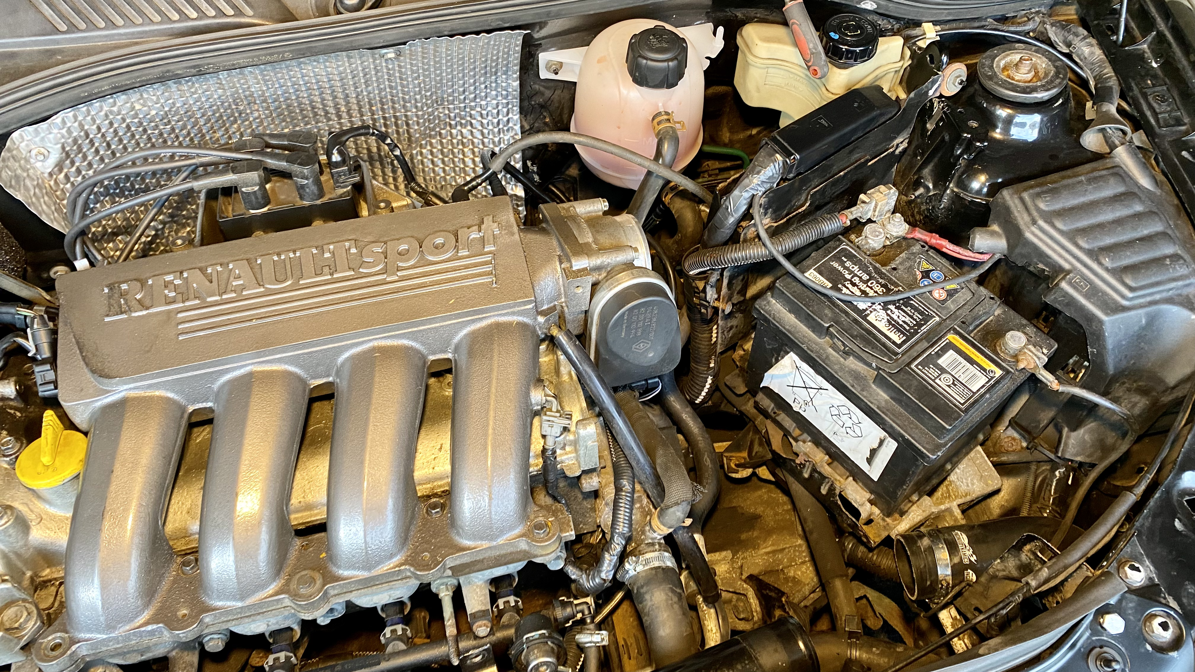

Tried to go for a drive tonight and the miserable c**t didn’t fancy it and wouldn’t start. It’s got electricity, the fuel pump primes, turn the key and nothing at all. No clicks or anything. The red light on the dash is out too.
Please tell me it’s a fuse? If it’s the starter motor I’ll cry. Can’t even see it never mind get access to it past the turbo and boost pipes 😂

Have you tried the battery terminals, I had similar the other week. Took the positive terminal off, gave it a good clean with a small wire brush. Put it back on and started first time.

gave that a go but no luck. This is what happens when it tries to start… literally nothing. Battery is fine too. Had it on the charger and it started my 5 series without an any arguments. It’s just an arse hole lol. Any other suggestions? Don’t think it’s the starter cos whenever I’ve had them die in the past I’ve at least had some clicks, this does nowt!

Wonder if it's a wiring problem if it starts your 5 series OK. Certainly looks battery related though. Have you tried jumping from your 5 series to see if it helps?
Yeah, tried jumping it from the BM and it’s still in the huff. It often runs out of electricity when it’s sat but I either get clicks when it tries to start or nothing lights up at all.
I’m thinking it could be wiring related. I’ve checked every fuse and they are all fine. Tried with another earth from the engine and box to make sure it’s not an earthing issue and still nowt. The turbo has probably cooked something important down there 😞

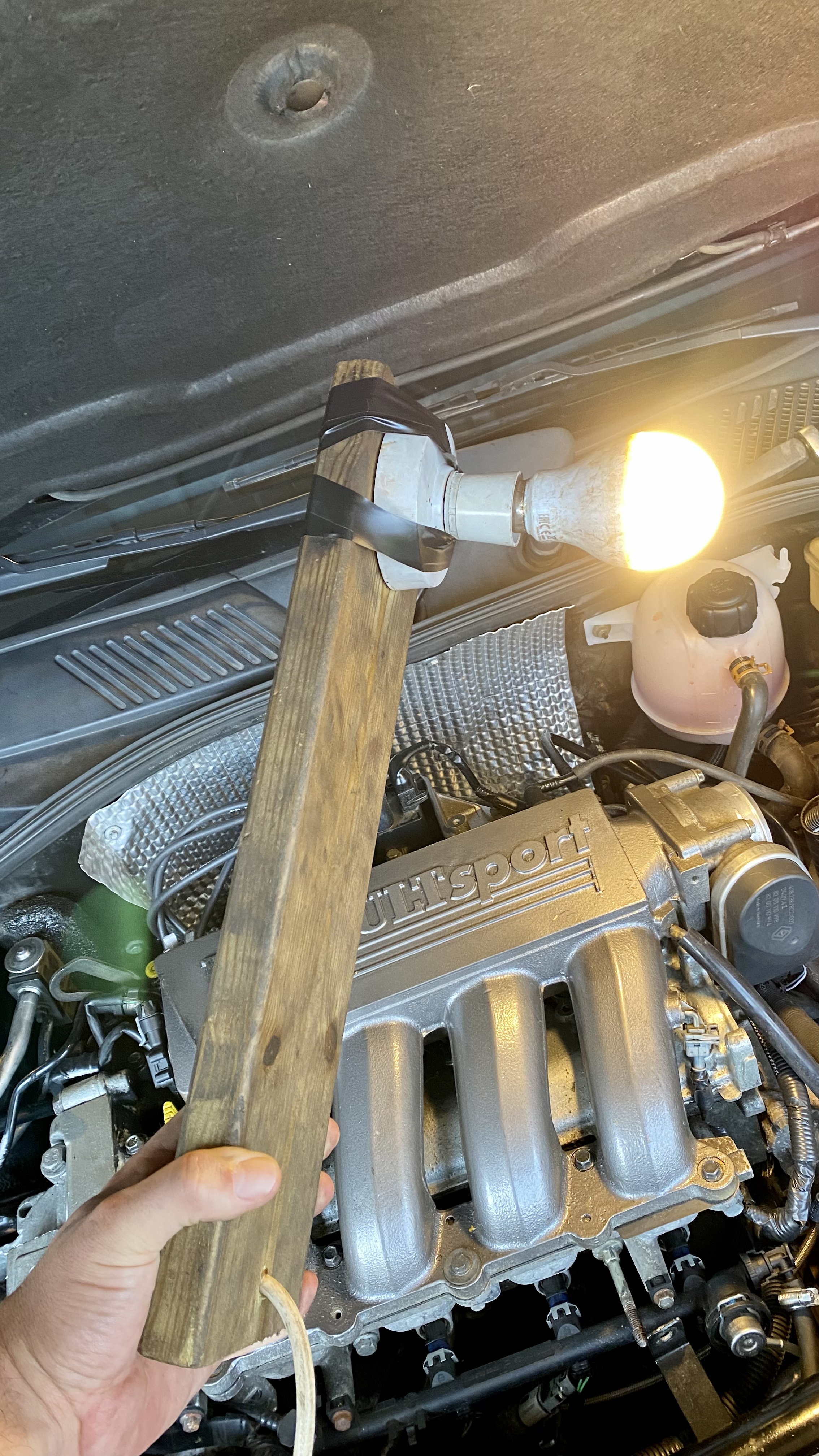

Checked the EFI module and all was ok with that so started the hunt for broken stuff.
Out came the trusty problem finder light
Boost pipes stripped off which is such good fun

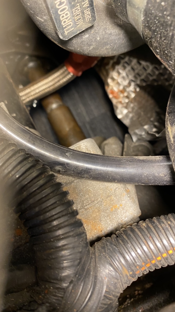

And somewhere hiding down there is a starter motor
Checked the connectors and all seemed ok. Went old skool and whacked the starter with a tiny little hammer that would fit in the gap and as if by magic it now works again. Never had one so stuck it did nothing at all! Who knows if it was the starter or just fiddling with everything that sorted it. I’ve got a spare starter on the new box anyway so if it goes again Ive got one to swap in. Just need to make sure I always park on a hill in case it breaks again 😂

Honestly, the light is a feat of engineering genius. Best inspection light I’ve ever had by a million miles. It came into fruition at 9pm one Sunday when I decided flinging my current inspection light across the garage was a good idea and then realised I couldn’t see a thing and couldn’t buy a new one.
This one light mk2 though. Mk1 was a normal 100w bulb that got a bit hot and melty. The led powered v2 is excellent and a bit less of a fire risk. All the usual issues with standard inspection lamps don’t apply. It doubles up as a hammer, pry bar, persuader, wheel chock, basically everything. Best of all, the fact that it backs onto a deck board means it never blinds you like a normal light and the grooves are ideal for putting sockets and stuff on and they don’t roll away. I’ve had the same 10mm socket and not lost it for nearly a year since starting to use this.
Only downside really is that it’s not great in confined spaces but seriously, once you go deck board and random light fitting you’ll never go back 😂

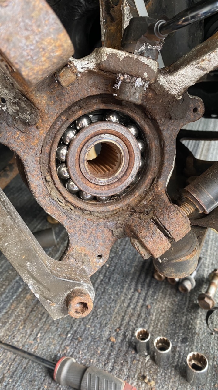

I took the hub off earlier to take it to get the bearing replaced. Safe to say it’s totally dead 😂😂. It started making a grinding noise about 4 miles from home and I’m pleased it wasn’t any further cos I don’t think it would have made it!
It’ll get a clean and a paint before it goes back on and jobs a gudn. For the price of them I’m going to change both the back ones too to be safe. I just don’t think they’ve liked covering 12 miles in 4 years.
