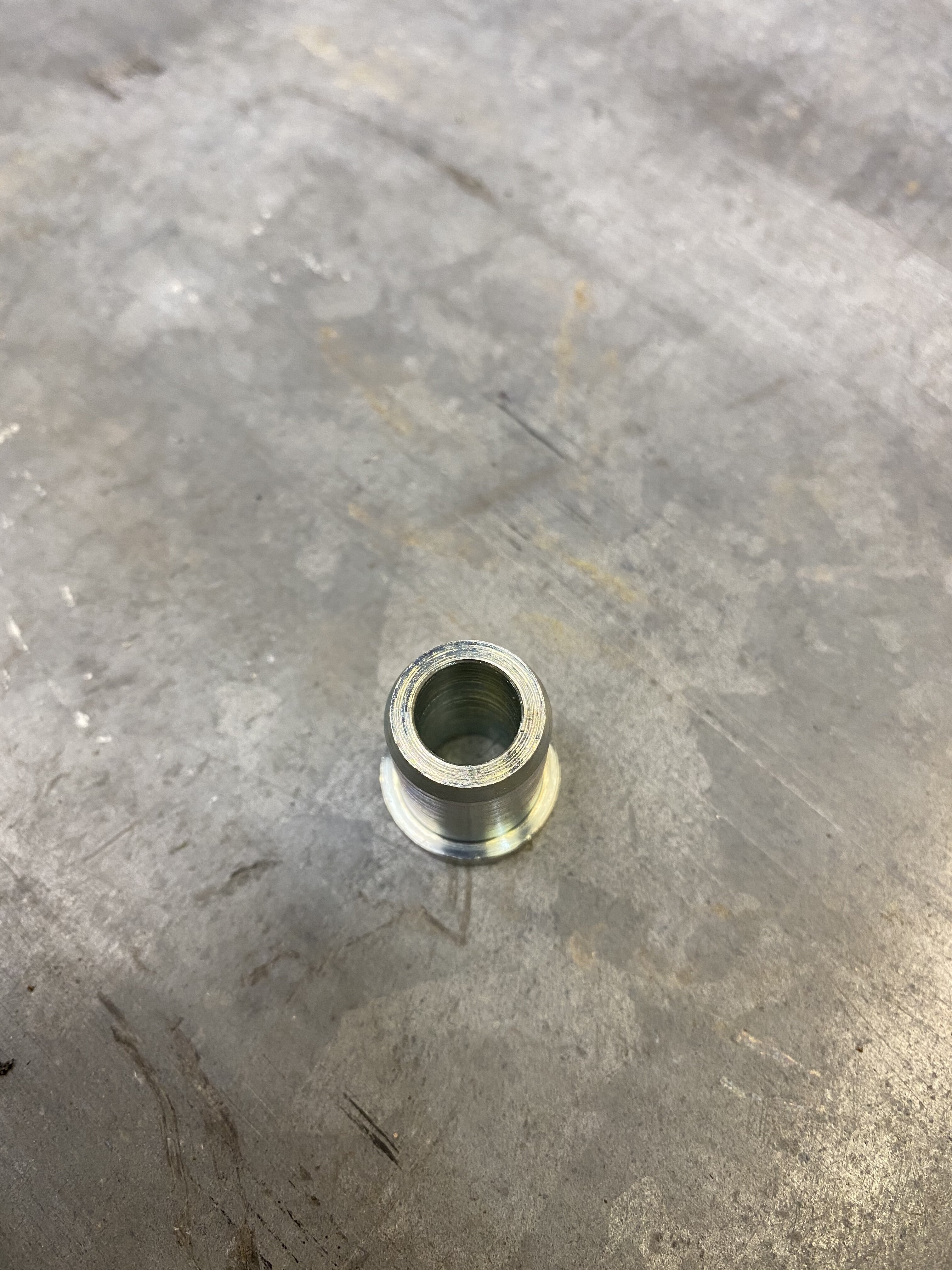

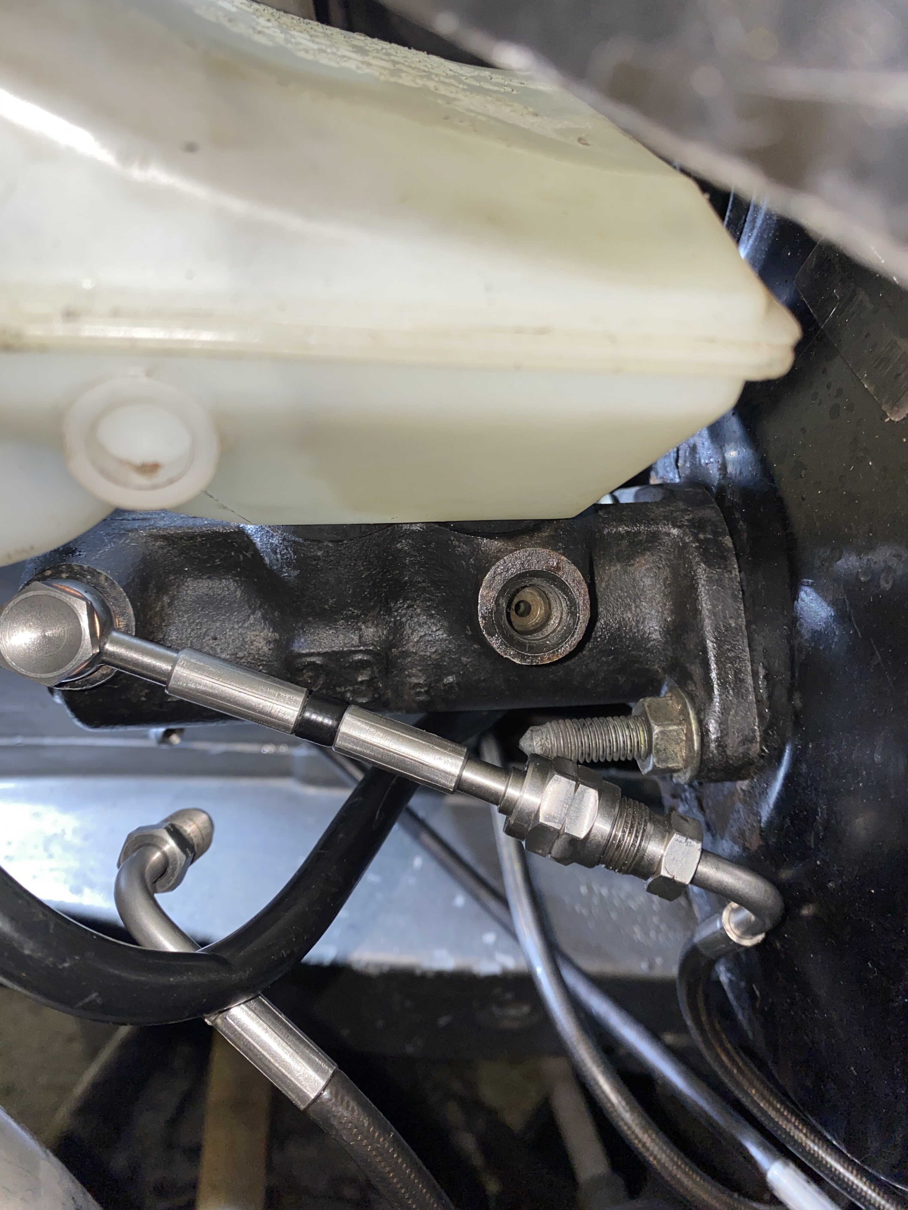

Tried a few different panel boxes and mc set ups to get the pedal feel a little harder and I’ve gone with the cup racer 23.8mm mc. I had to get some adaptors made up because the mc was m10 all the way round

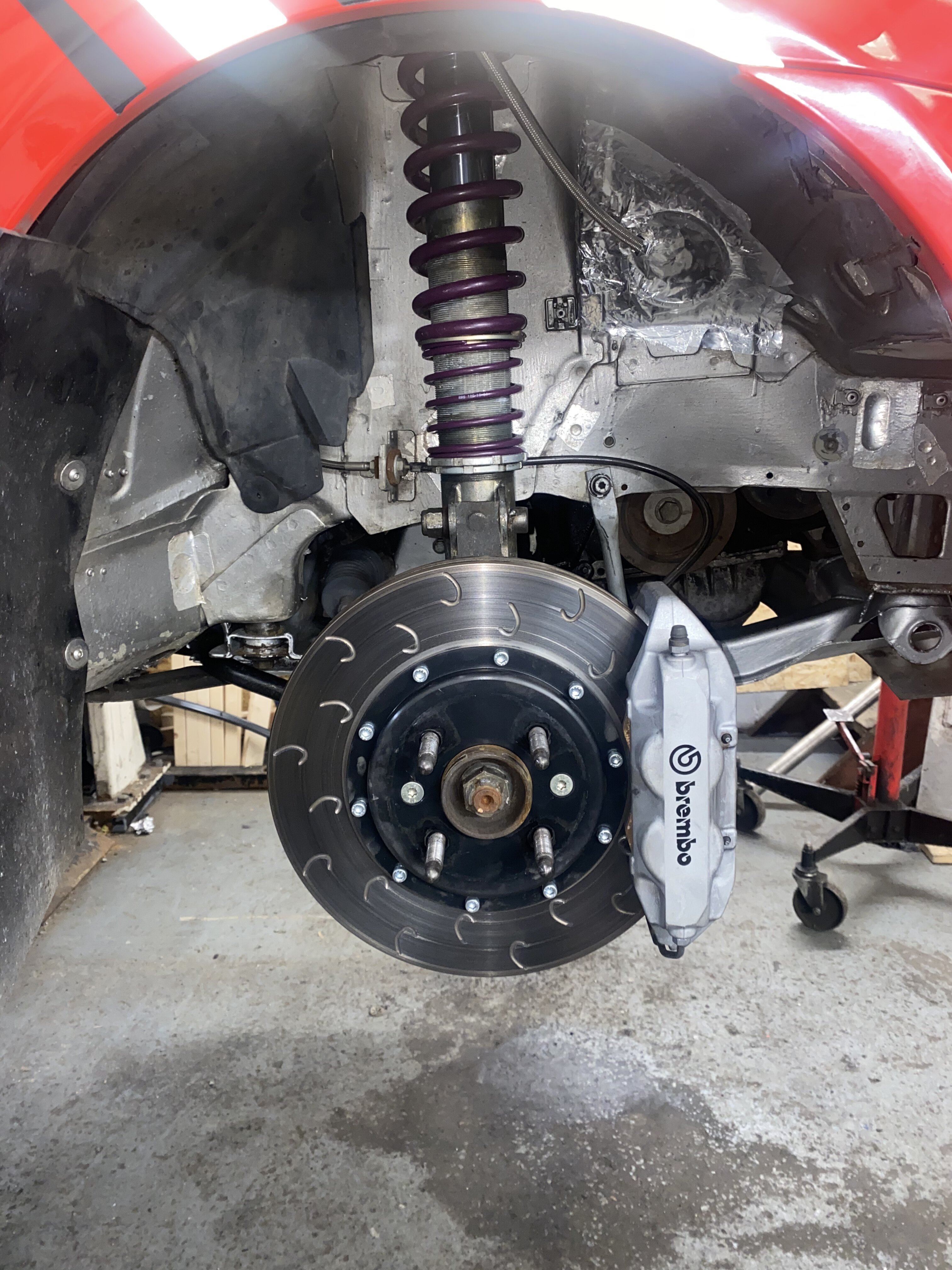

That was going to be the next step if I couldn’t get it how I liked but one of the issues was also my calipers. I was getting no brake then fully locking them up with just a tiny bit more travel on the pedal.
I tried my brothers brembos on earlier will the same pad and the brakes were back with no lock at all.
Do you run a servo on yours , when I first put the AP kit on mine it was either on or off , no feel in between , so I disconnected the servo and ran it like that ever since I rallied it , needed a good push to lock up , but plenty of feel before it did lock up
Yeah I run servo, but I did on the old car too and it took a lot to lock the brakes.
On this one with my brembos it was literally on or off and locking every time.
The ramp angles on the diff don’t help either though so I’m sure your car will be even better on the new box.
I’ll rebuild my calipers and try again, but servo disconnect or even a tap in the servo to give a little bit of assist
@Nathan Evans Ive just tried to remove the pistons out one, 1 piston moved easy which was brand new when I rebuilt them a while back, the other 3 which were original and showed no signs of wear are pretty stuck. All I have is a small electric pump which is maxing out, needs a proper air compressor. This is probably whats been causing the pedal problem.

It was the ramp angles in the diff generating 90% of the issues mate.

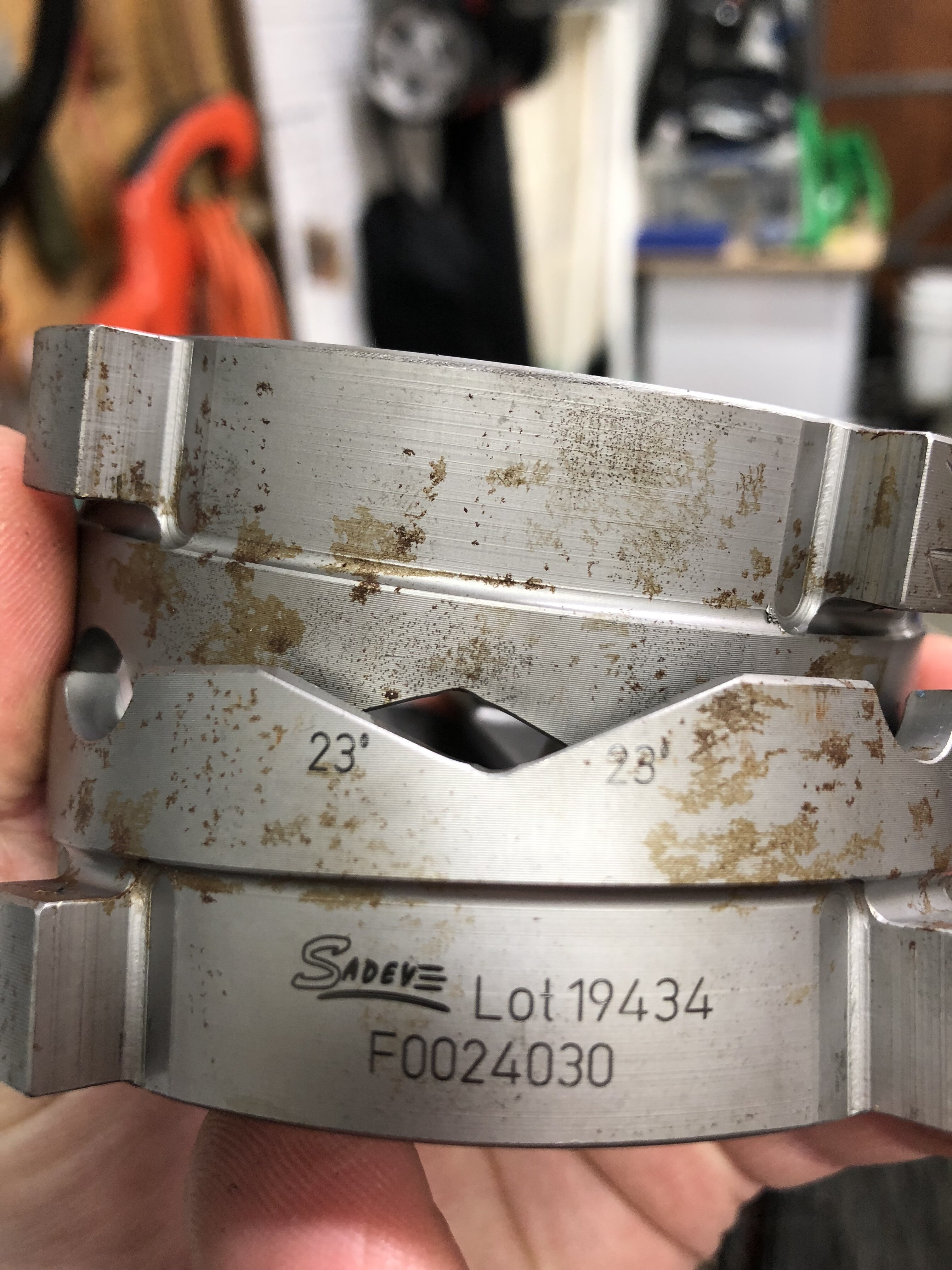

New 35/90 diff plates fitted which has transformed the car ☺️

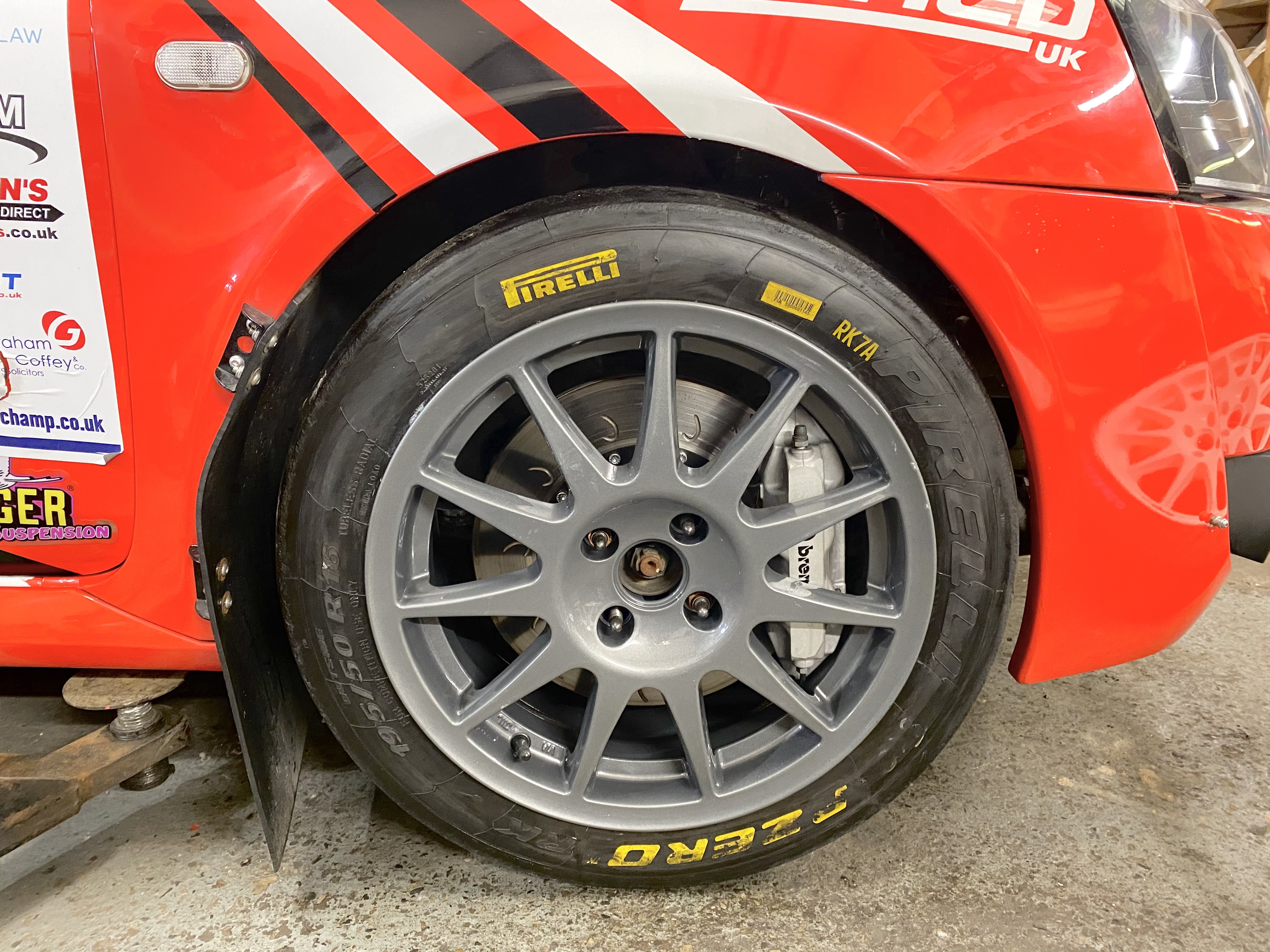

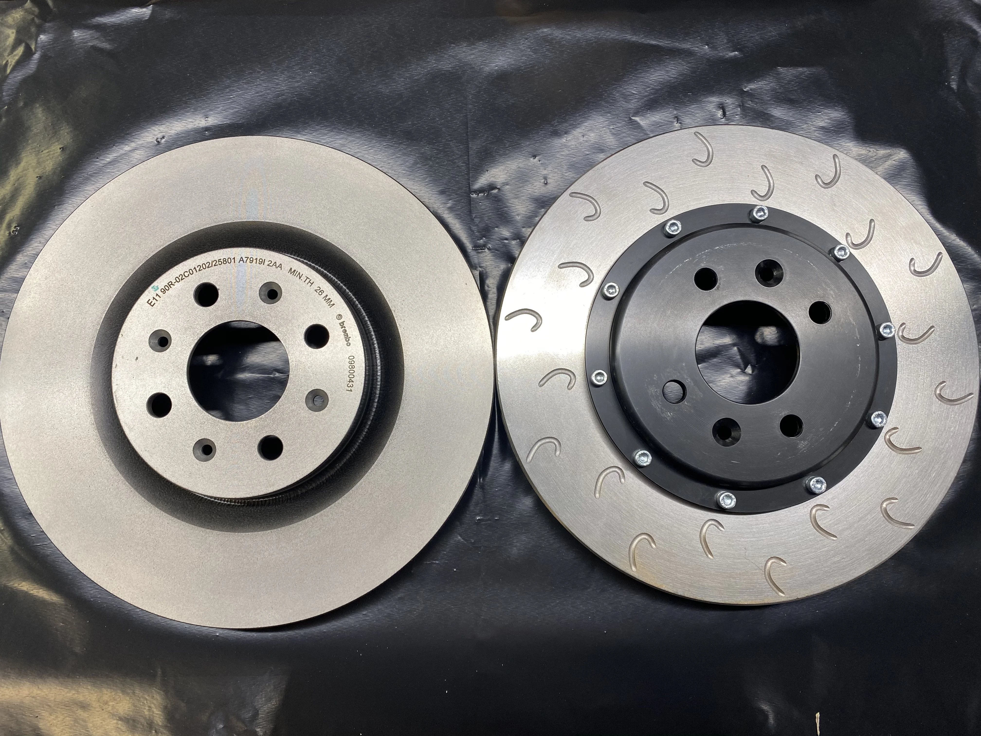

I’ve now gone for 300mm brakes as I’m running 16” due to the final drive set up for 16” and you can get better tyres in 16” due to R2 cars being more popular as I don’t think there is a holomogated rally car running 15”.
So more development is spent in the 16” tyre.
I did try a 305mm Punto brake disc which fitted the caliper brackets better but the offset is 0.7 mm different and on new pads it was binding

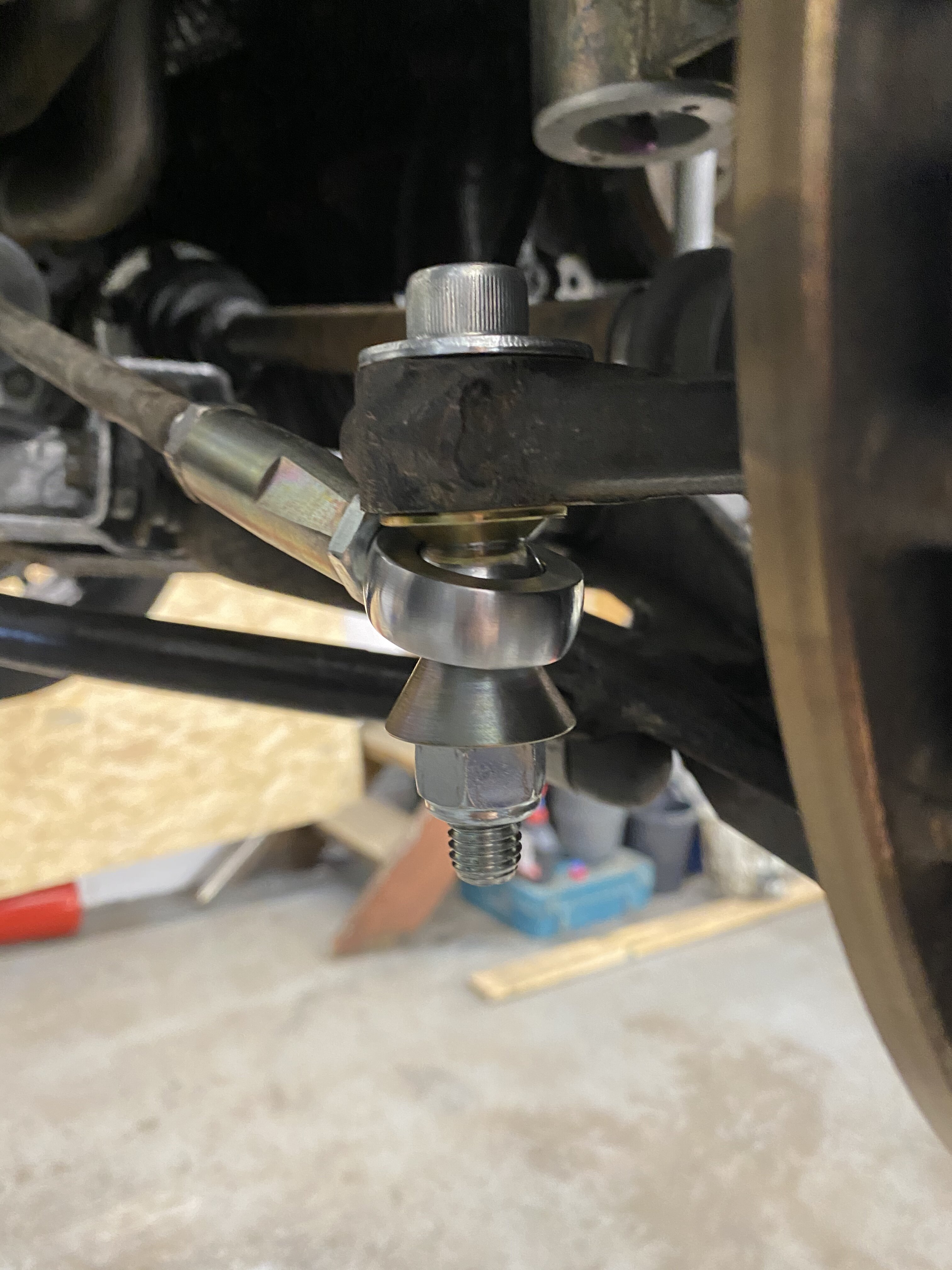

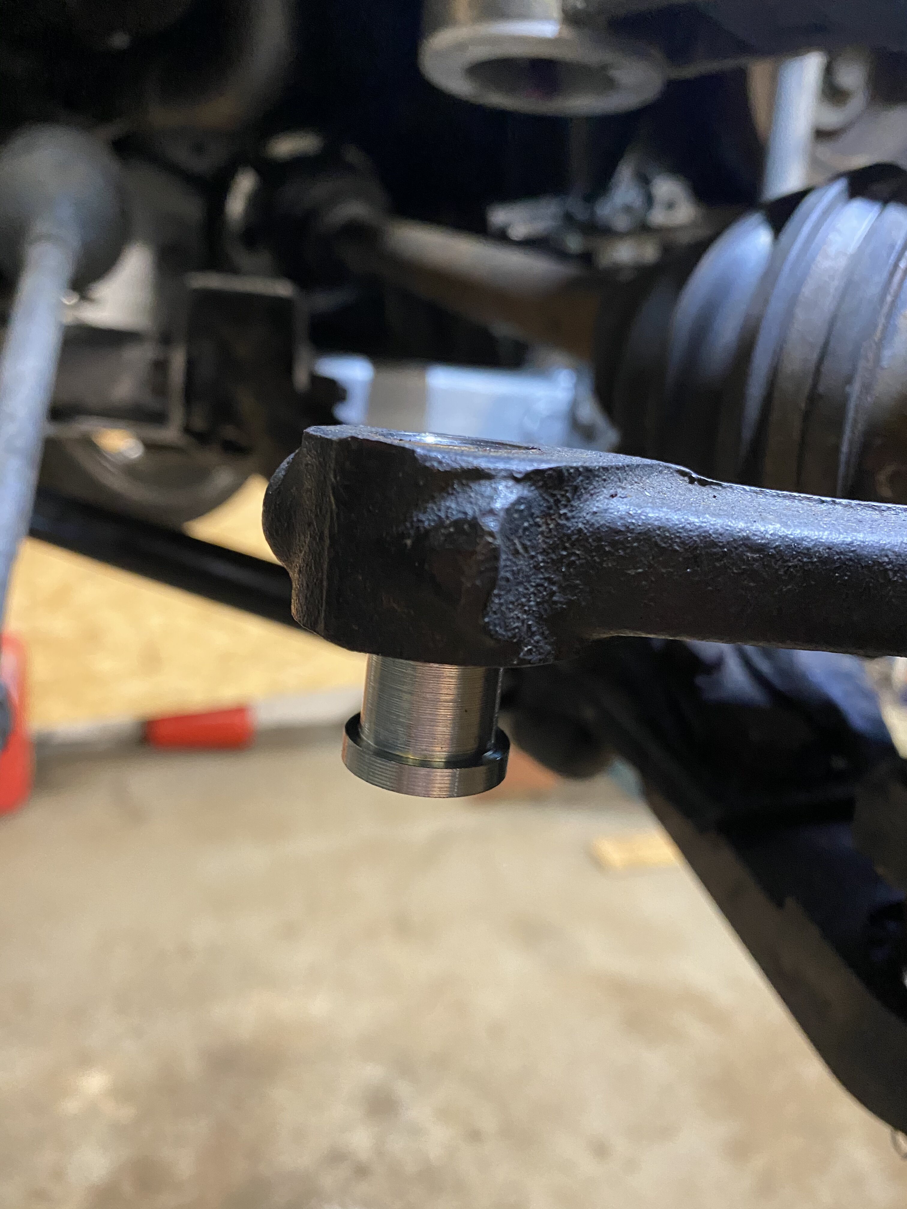

Another upgrade is the bump steer kit. The Cup racer tapered insert was removed and fitted with one from France, a lot better idea than drilling the hub 12mm like some do and still having a taper.
Due to the cup racer hubs having a lower steering arm attachment I had to fit the spacers upside down as I needed to higher the steering arm not lower it.

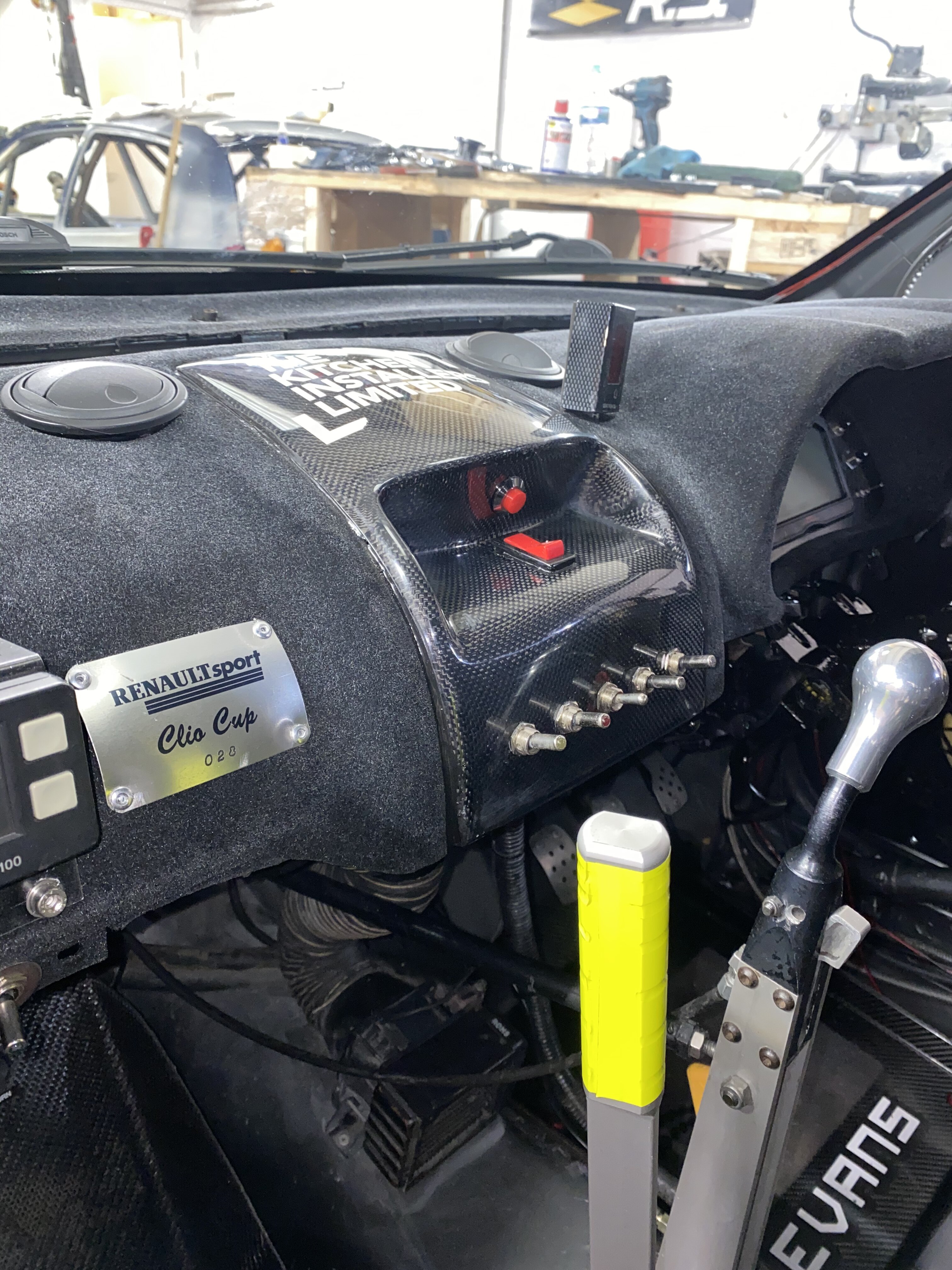

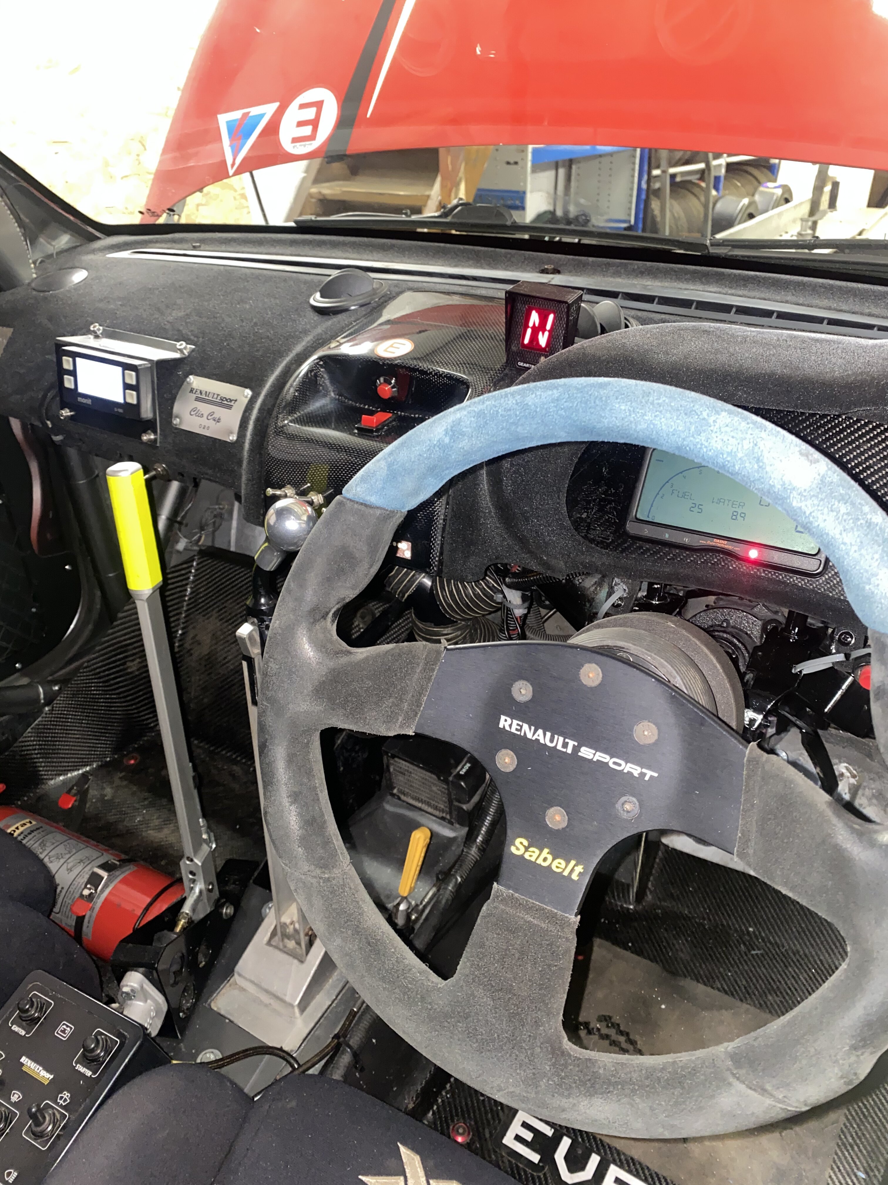

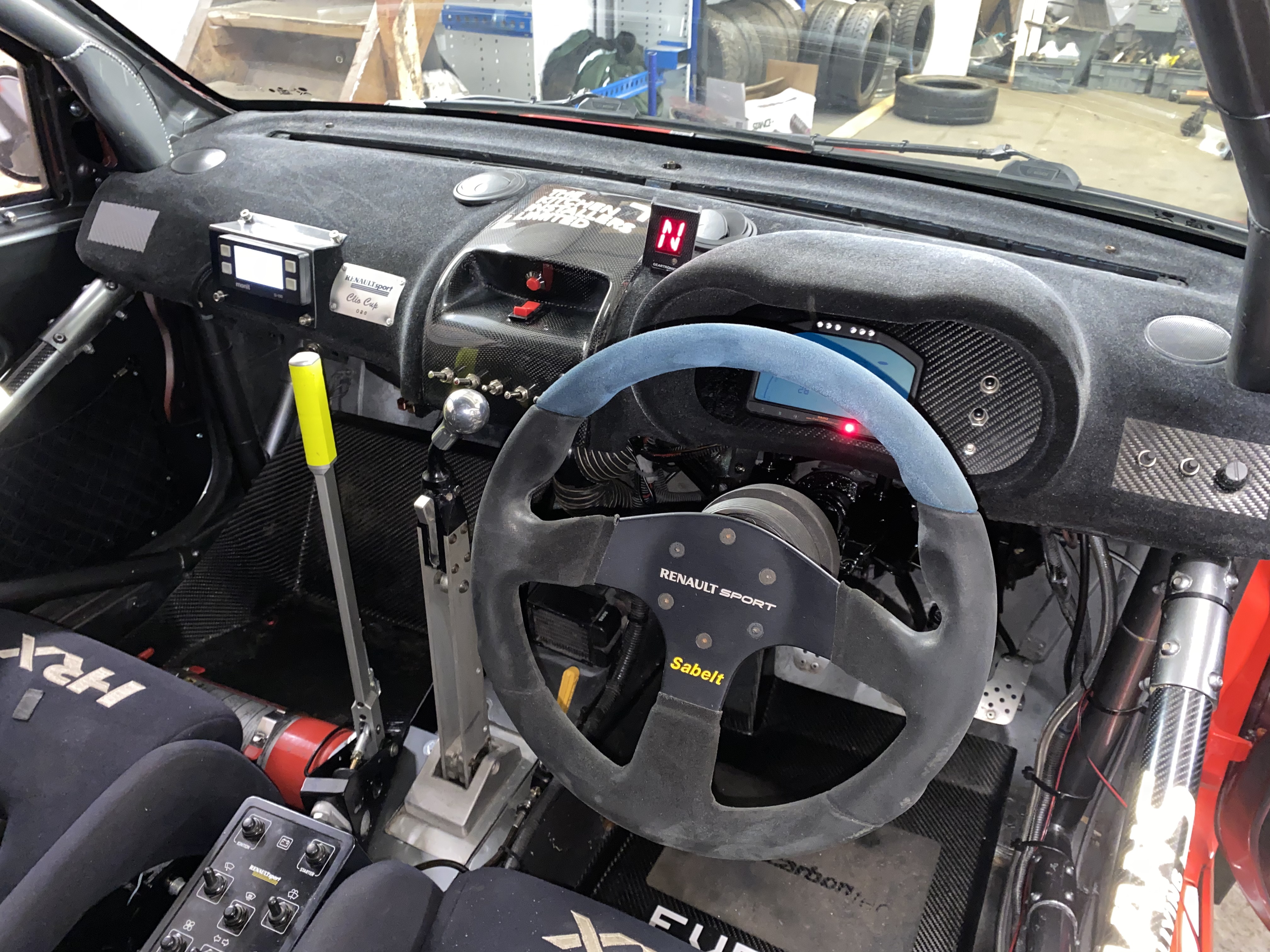

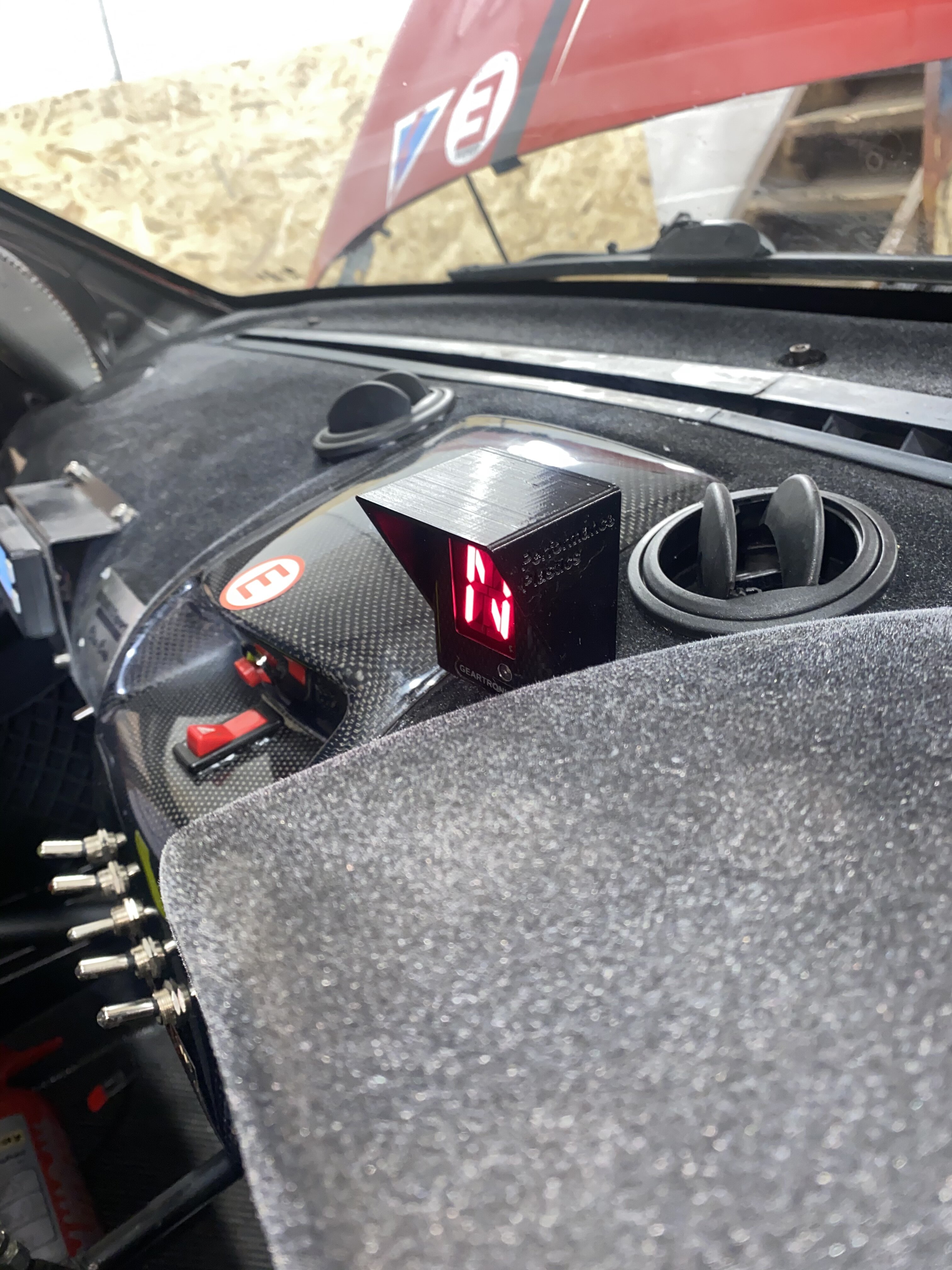

I’ve also fitted the dash I’ve had for a while, I was waiting to do this and the steering controls at the same time but the rough old dash looked horrible, haven’t bothered with the wheel controls yet and not sure if I’ll fit them.

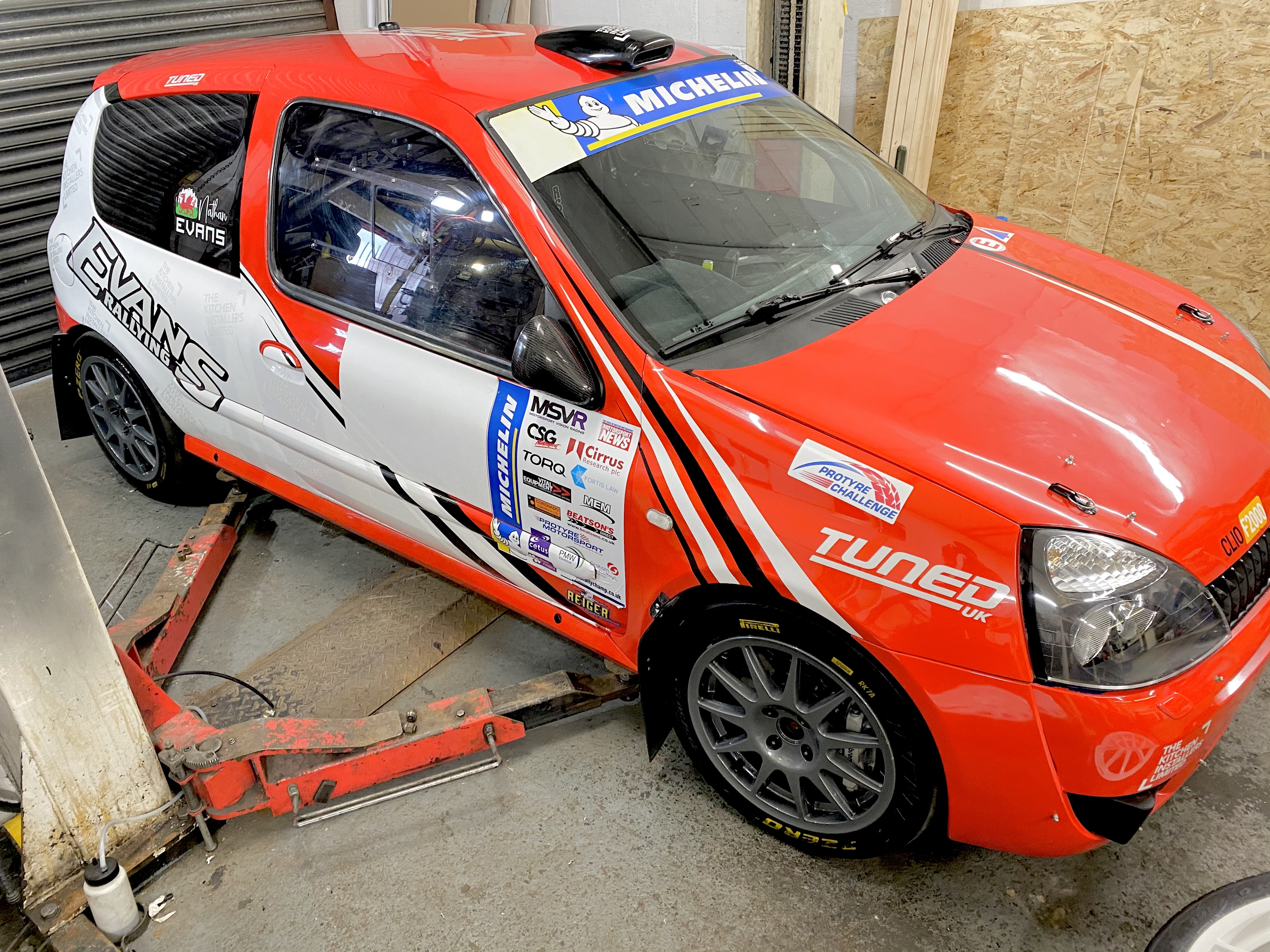

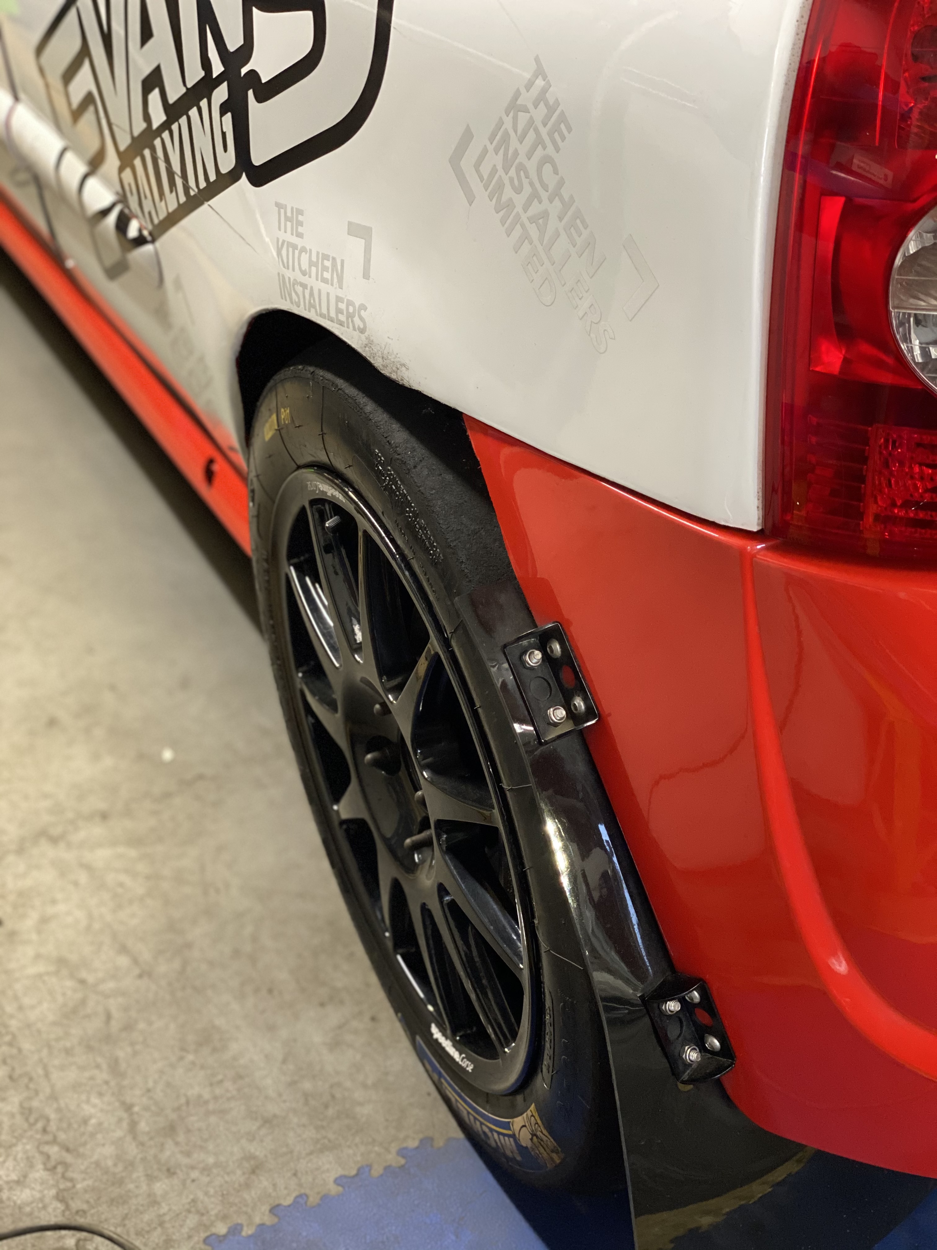

Rear beam needs moving over on the mounts. We fitted new bushes before the test with a toe shim to get the geo how I wanted. As we done it in a hit of a rush the beam is pushed over to one side and the tyres been touching the arch.

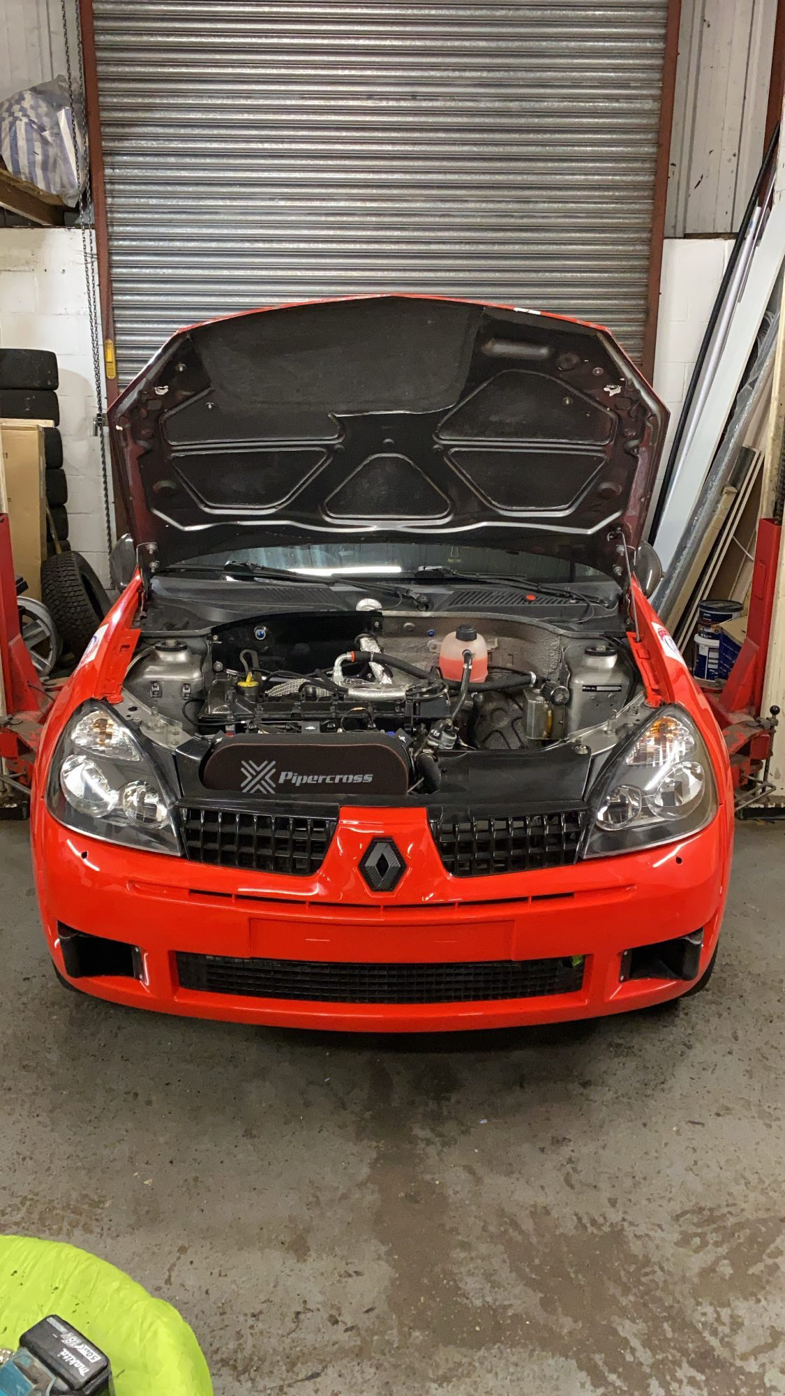

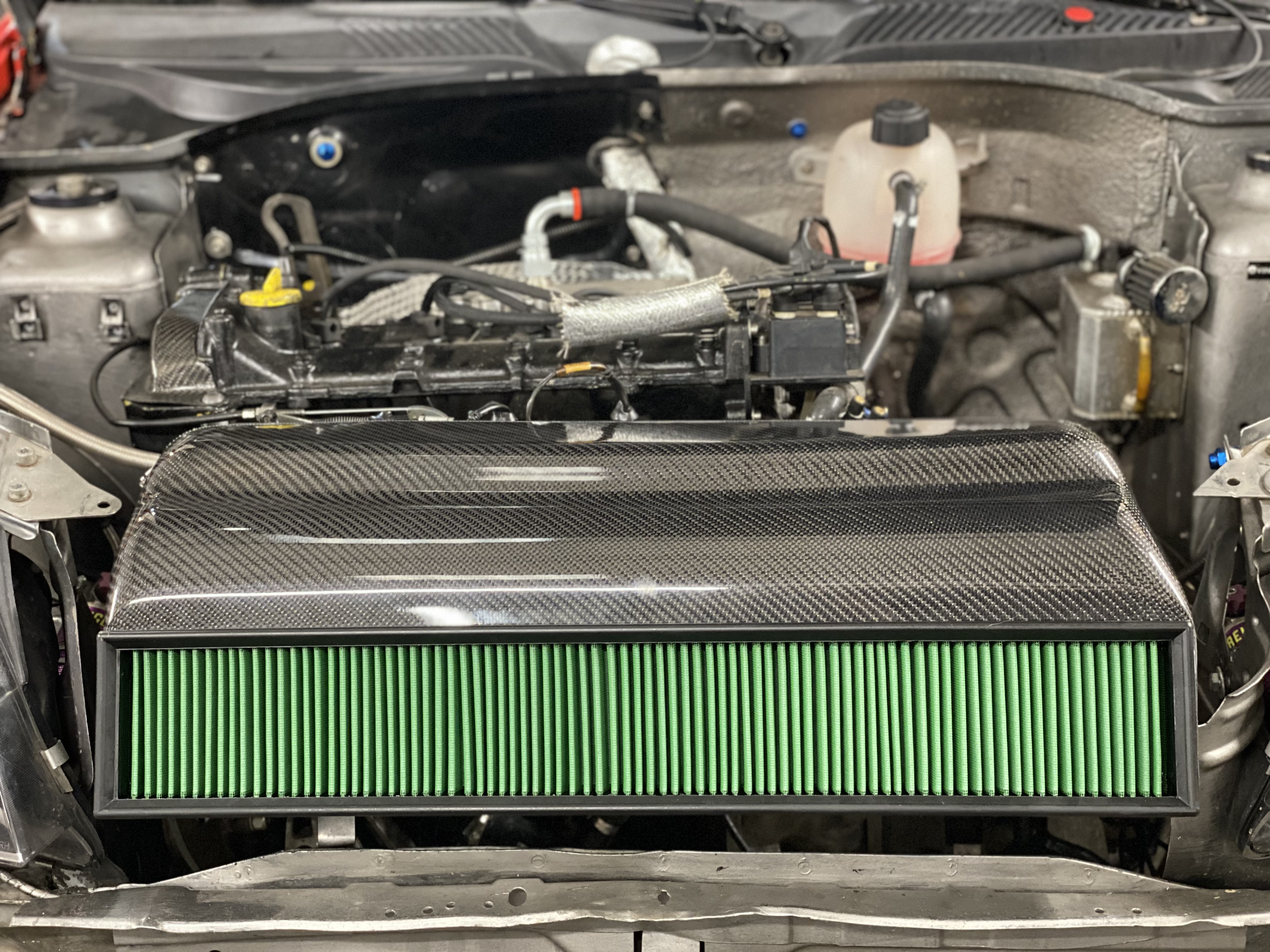

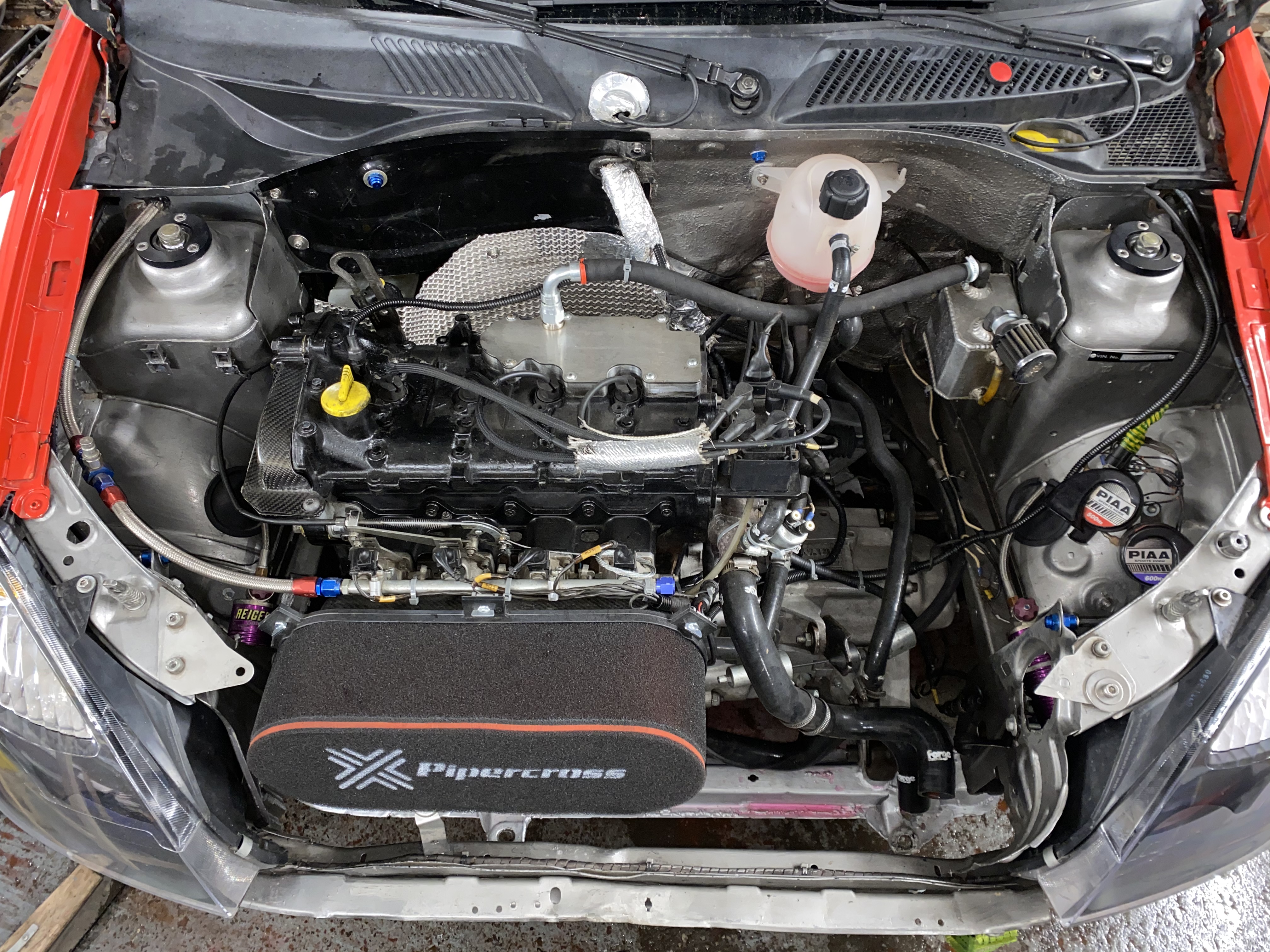

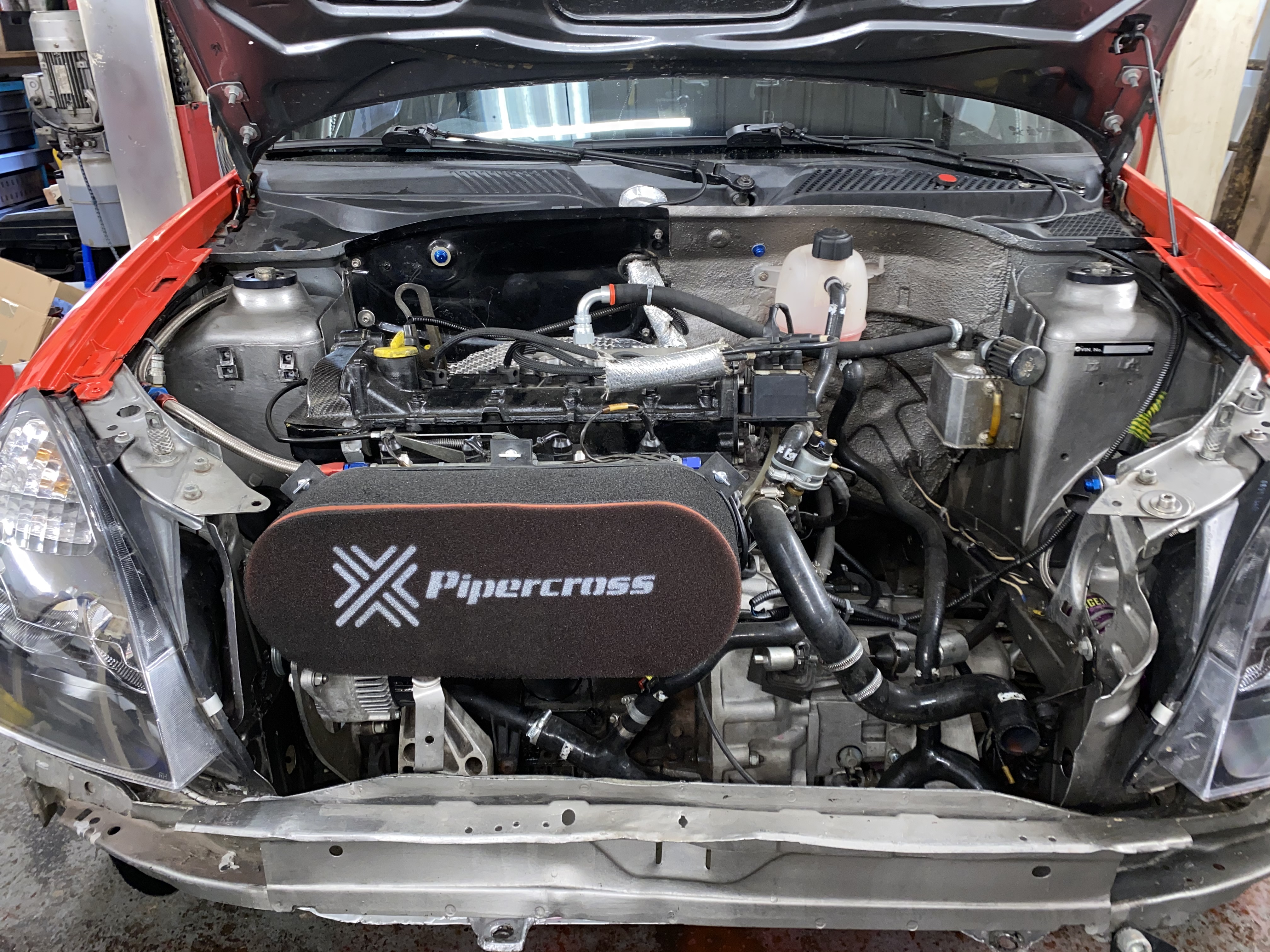

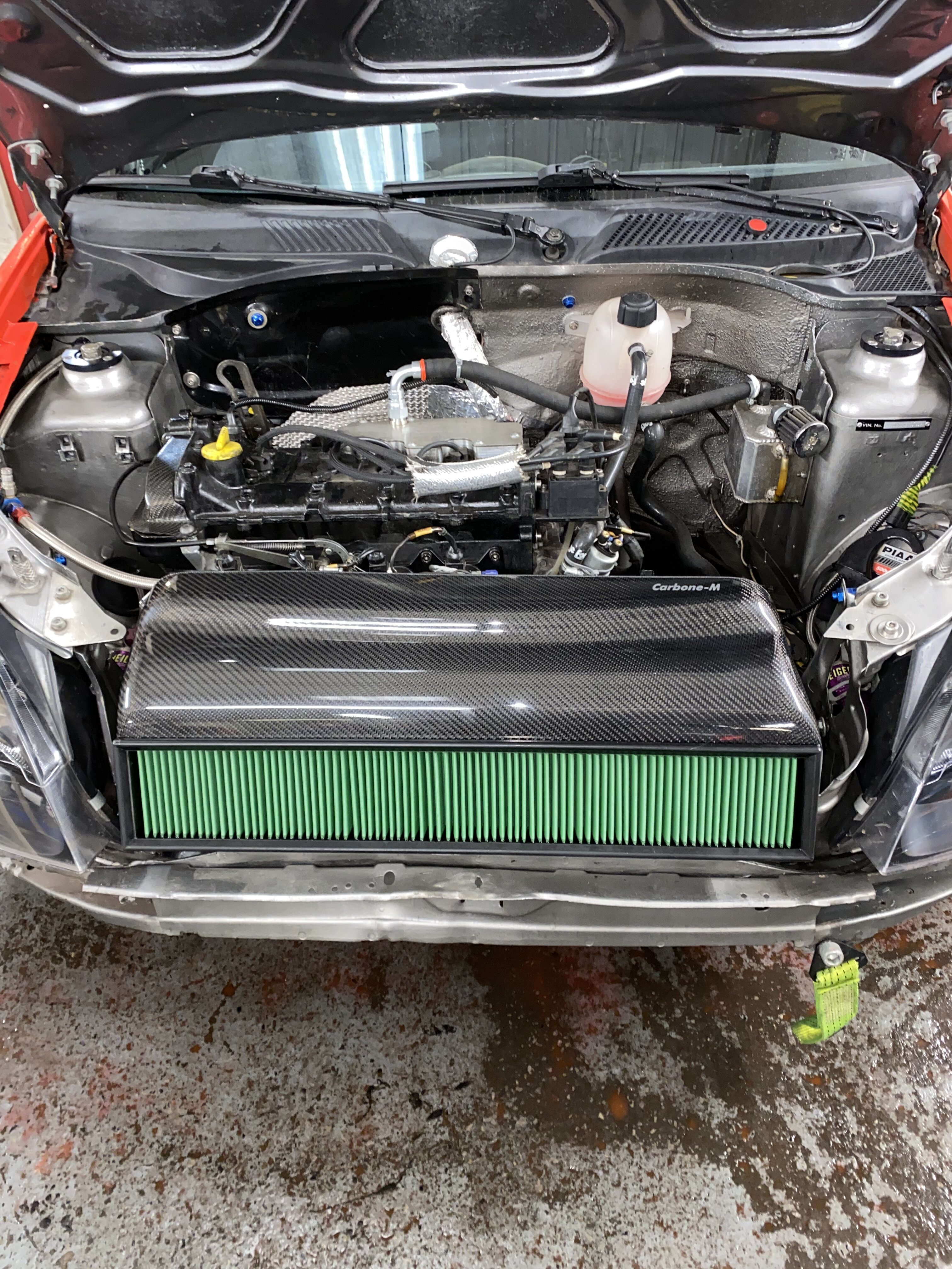

The new carbon airbox came today and it’s unreal. I’ve had carbon parts before but the quality is mega. This won’t be fitted for the rally as I haven’t got time to alter the map. That can be fitted after the event when I’ve got a little more time
A little comparison on the air filter vs the air box

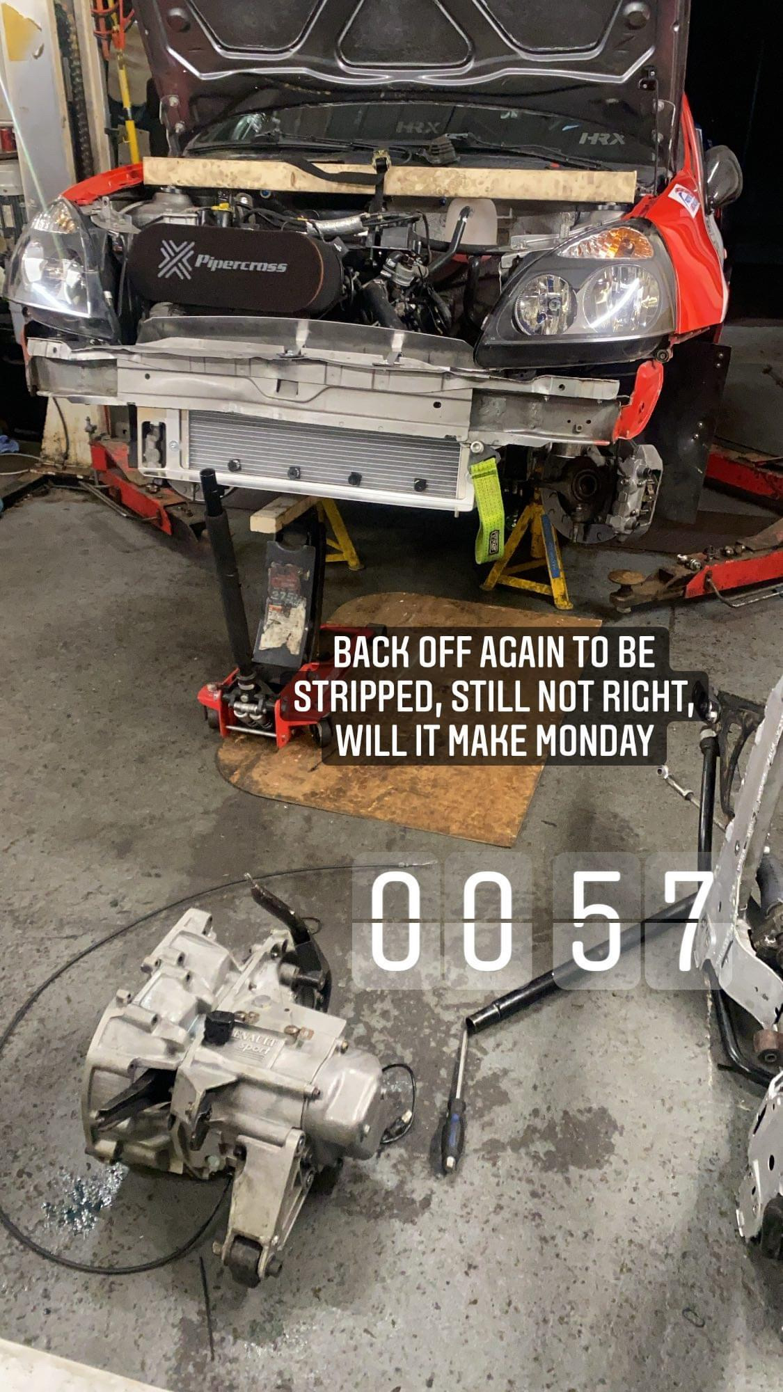

Some last minute gearbox issues weren't there?
Well, yes and no lol. The main thing is, all areas of concern were identified and rectified mate. But there was a lot of head scratching going on in my garage on sunday morning before the culprit was found - and it wasn’t even the actual real culprit of the issue in the first place 😂
I’ll leave the rest of the details to @Nathan Evans
Not sure where to start with this one but all I can say is @NorthloopCup is some man
I’m not saying he will do this for everyone but who can you drop a gearbox off to at 11pm on a Friday night, have it stripped by 12 and picked up the next day, for then you to call him at 12:30am asking can it be dropped off Sunday morning at 9am with a separate issue 😂 what a legend,
I got home with the box at 3pm on Sunday and was at oulton at 5:30pm with a running car 😂

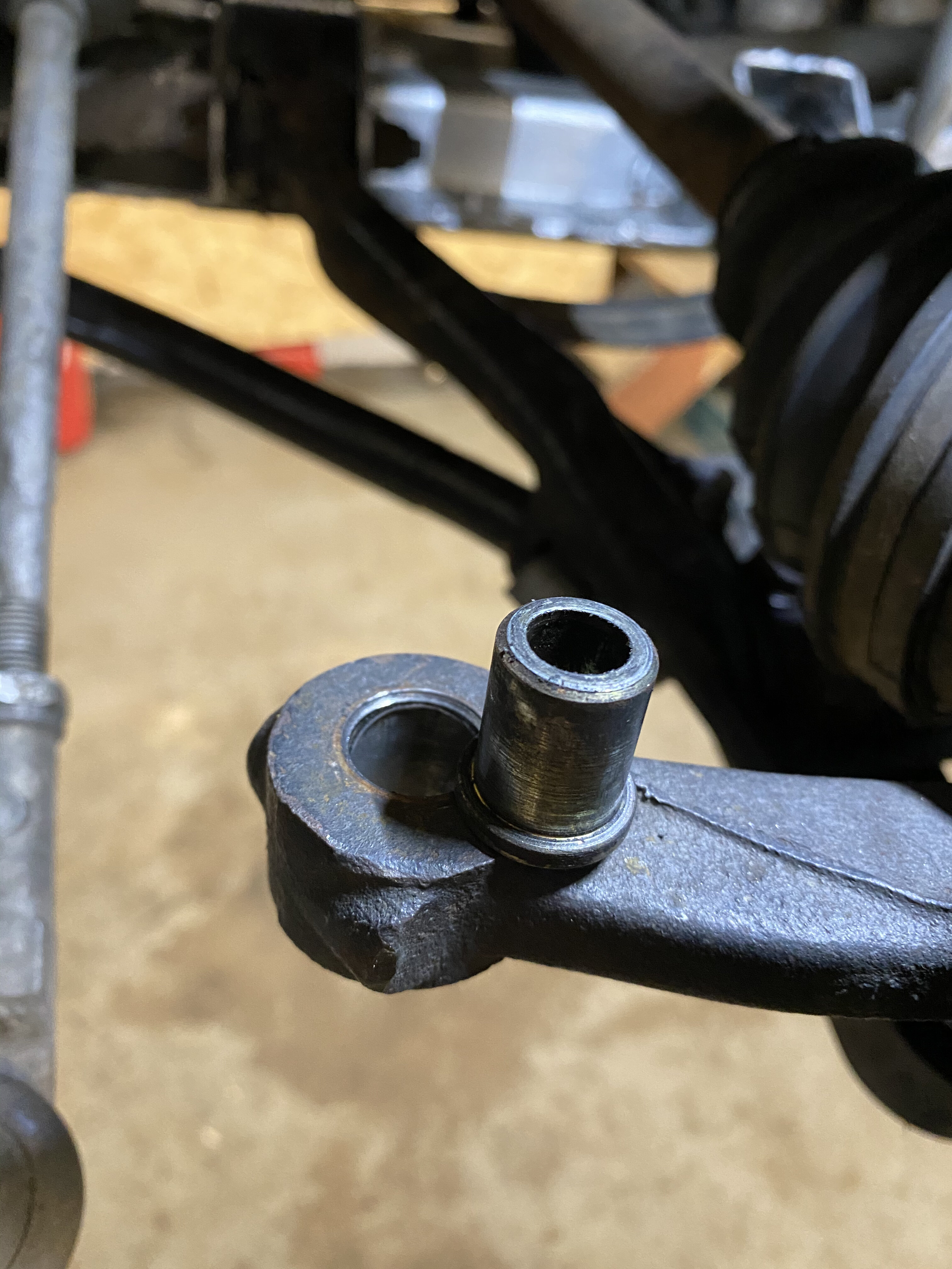

All this work to find out what was casing the issue was loose bolts through the ball joint to wishbone, but on the ramp moving the wheel there was no play at all. Only when I tried a spanner on them the real culprit emerged 😳
