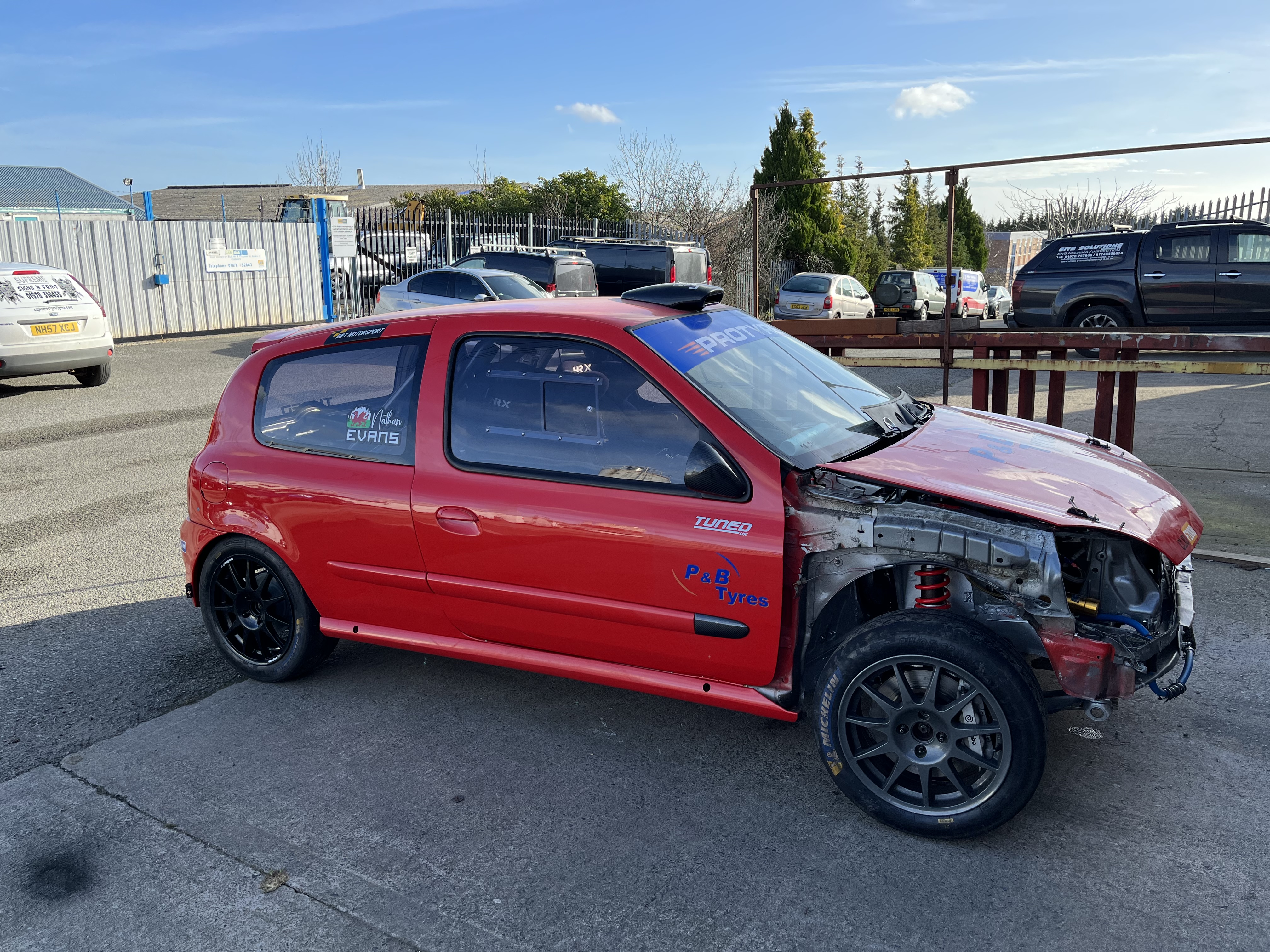

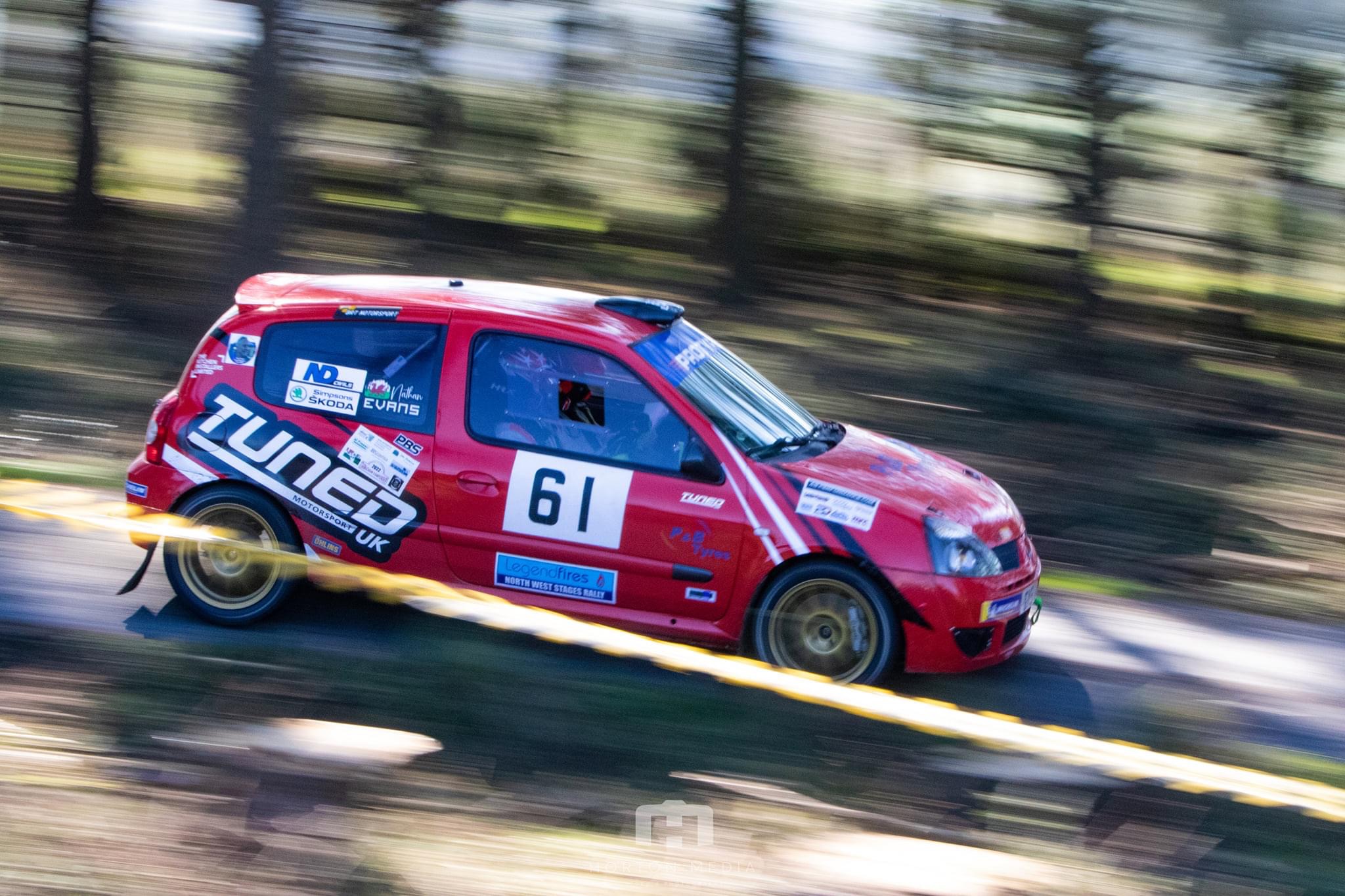

I haven’t updated this much but I managed to do another 4 rallies after oulton
Argyll 2nd in class
Mewla 4th in class, lost out to 3rd with a snapped shaft half a mile from the end of the last stage
Three shires, off the road 😬
Tour of epynt, 6th in class, not the best result but car wasn’t working at all

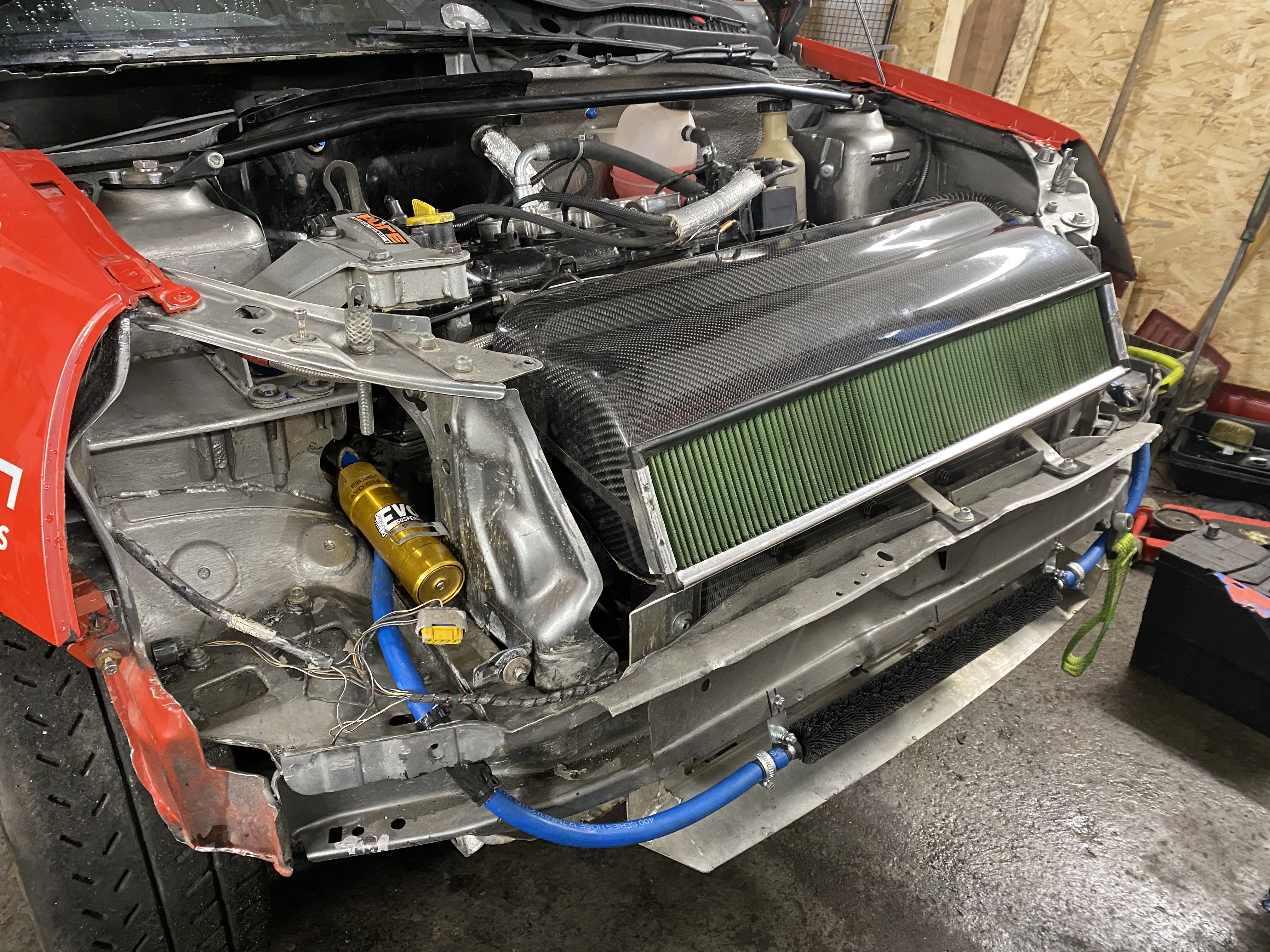

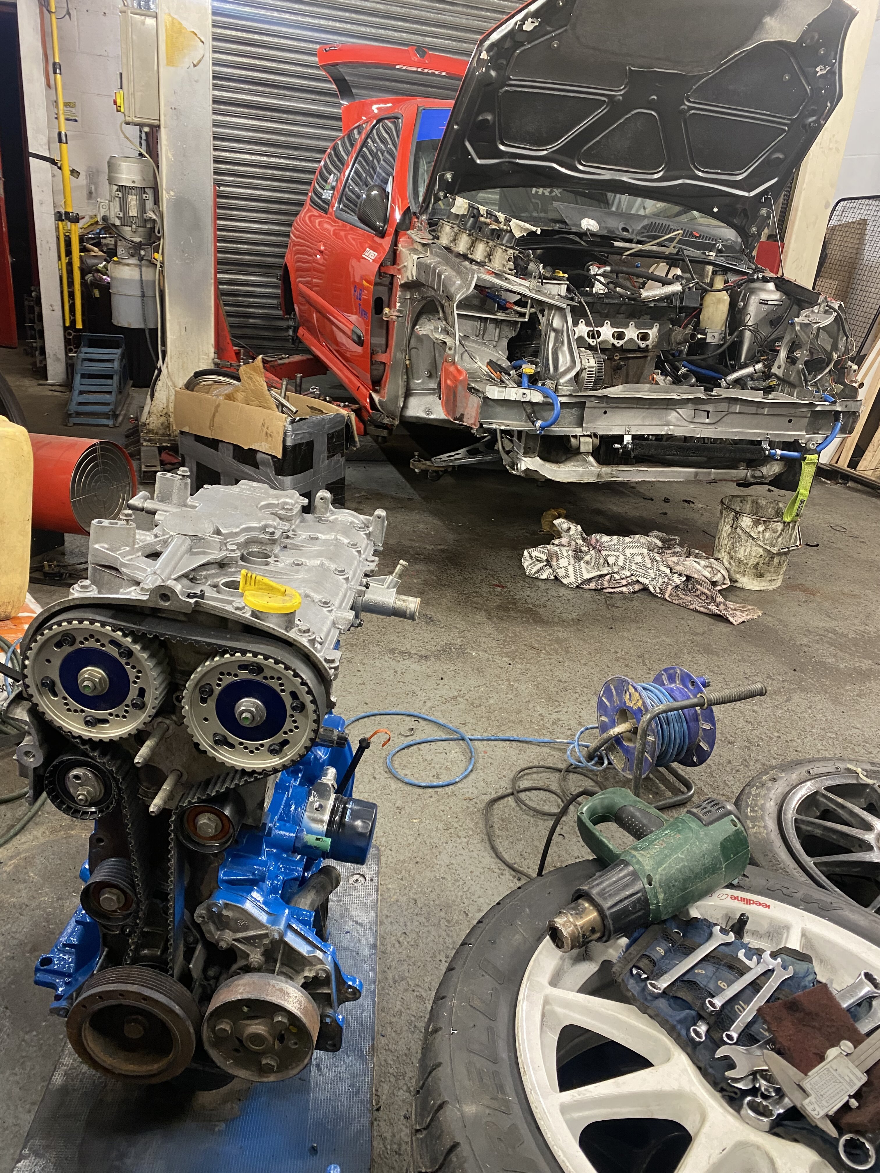

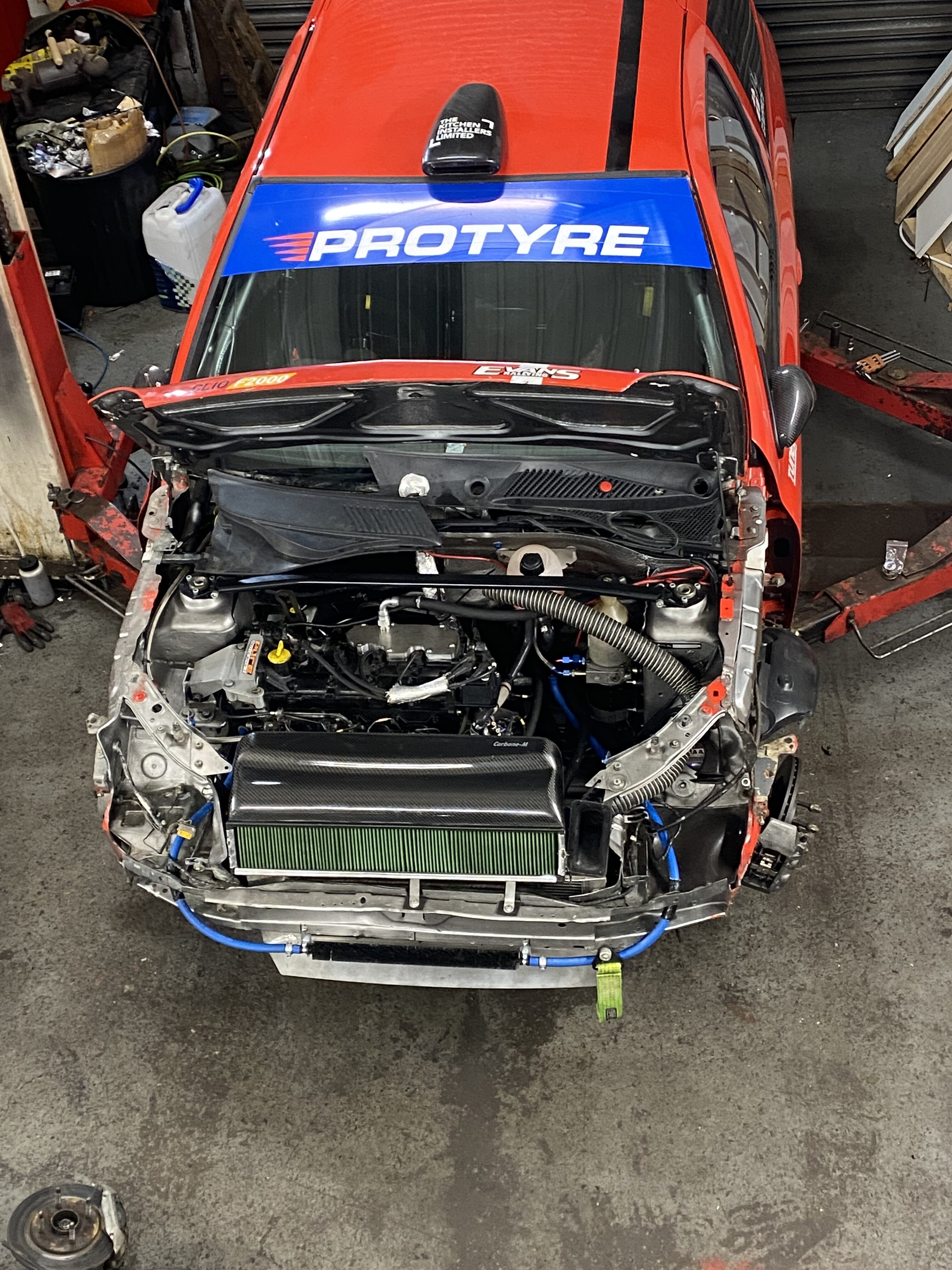

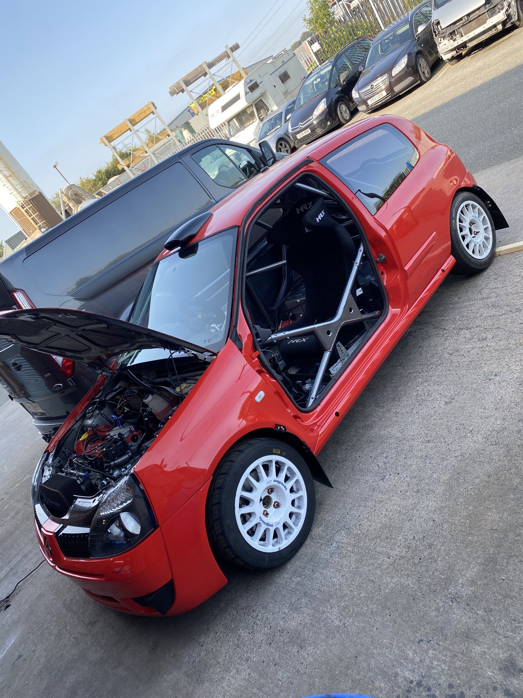

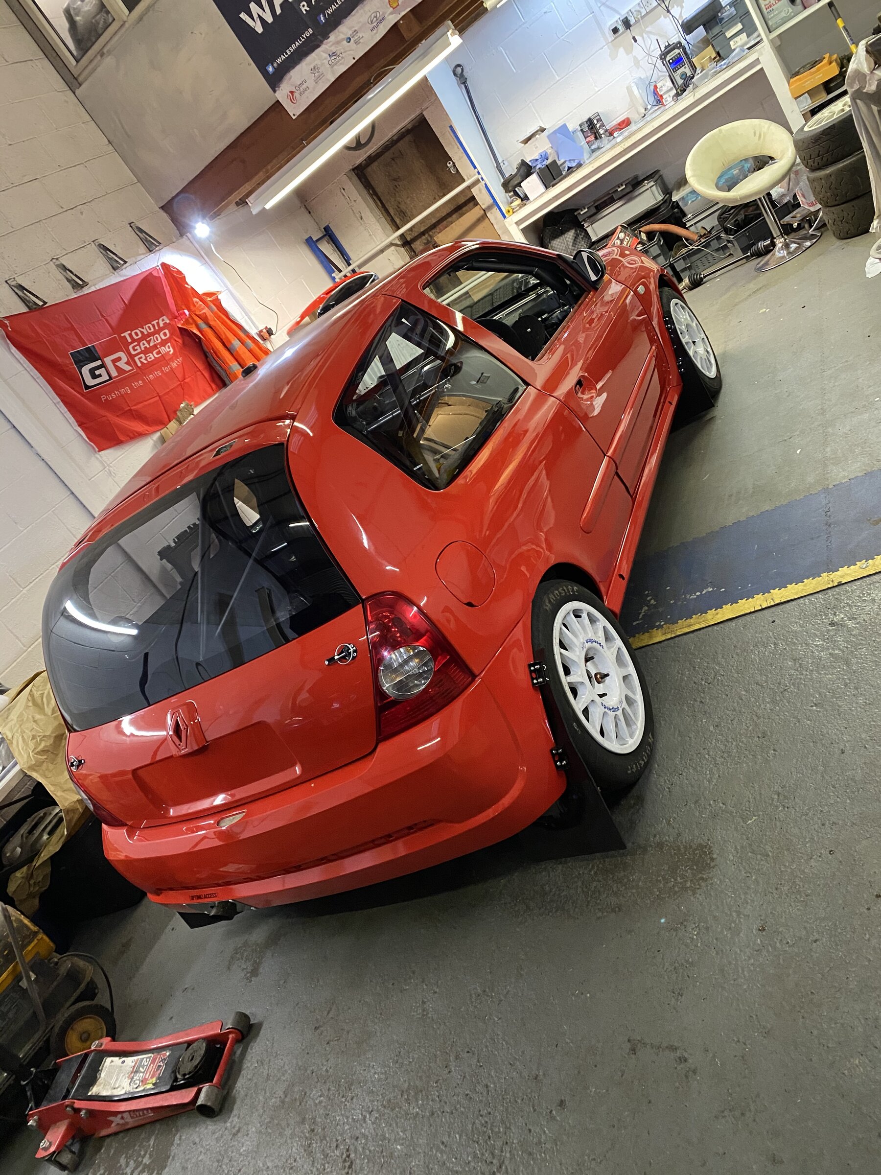

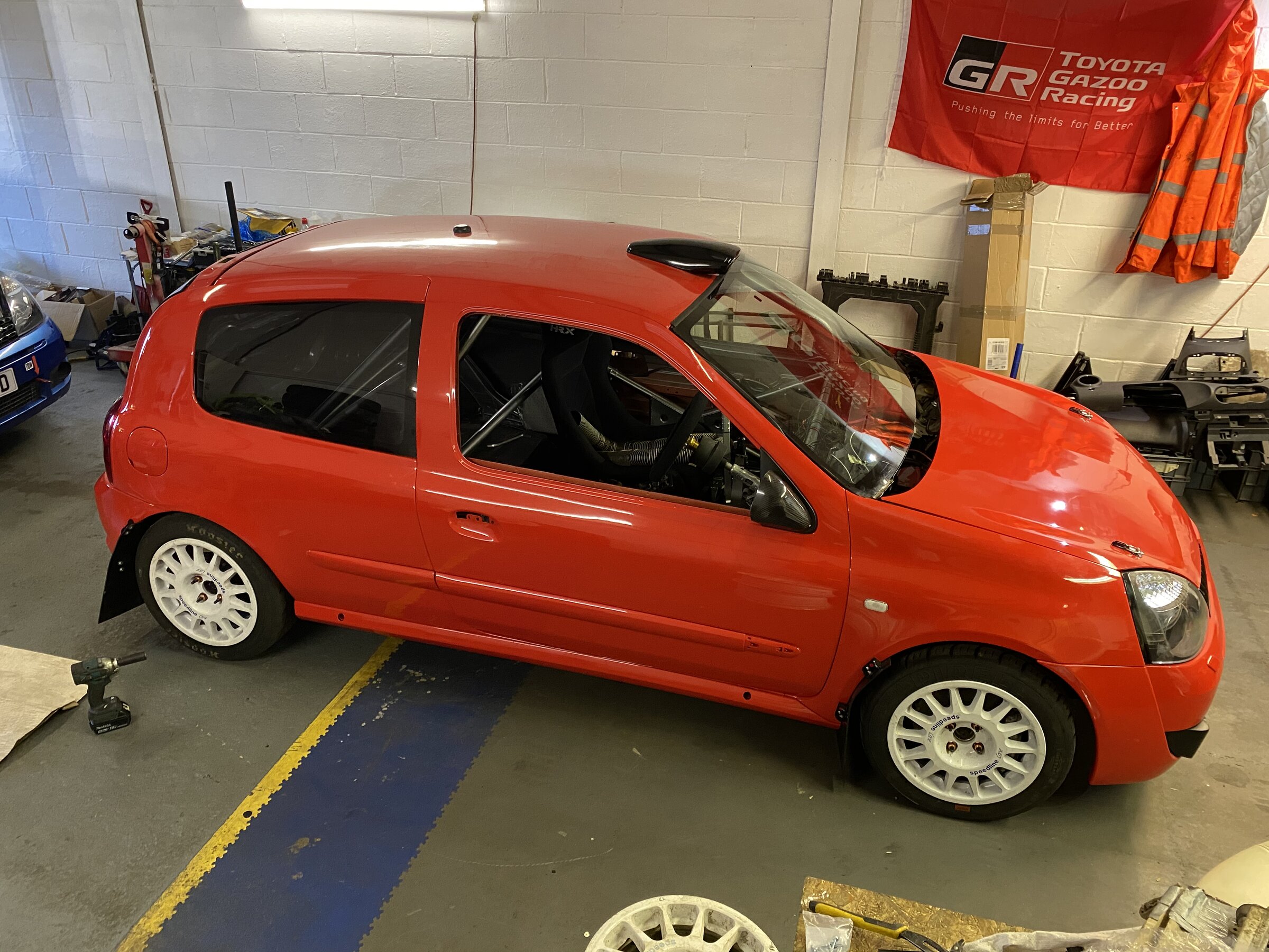

Now for upgrades that I’ve done/doing for next year
New engine is ready to drop in, hopefully 240bhp 🙌🏼

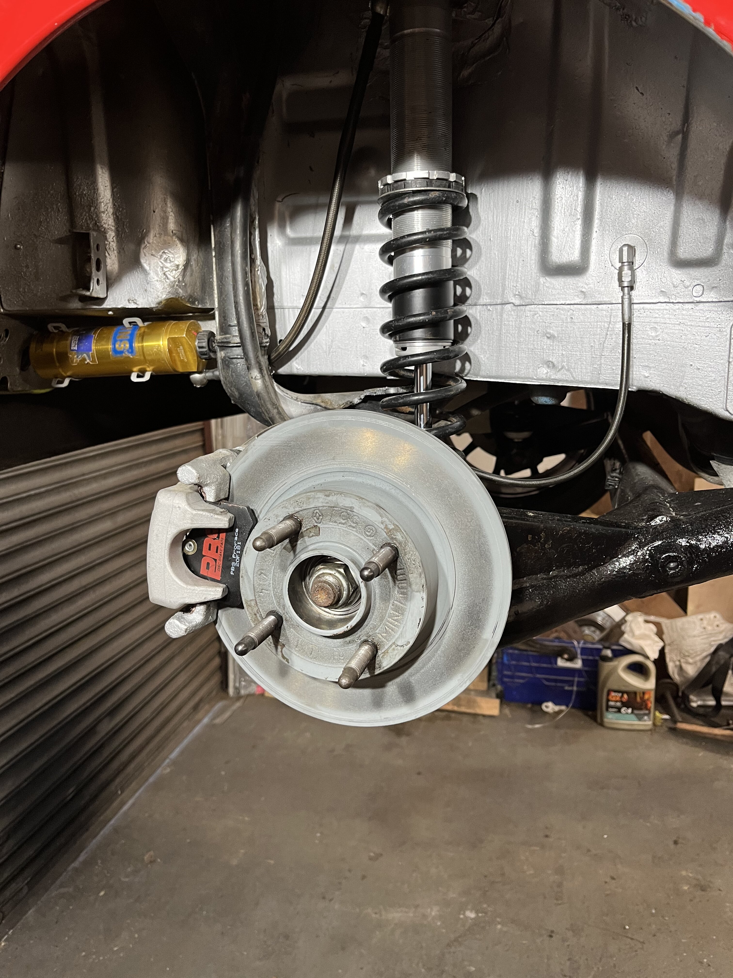

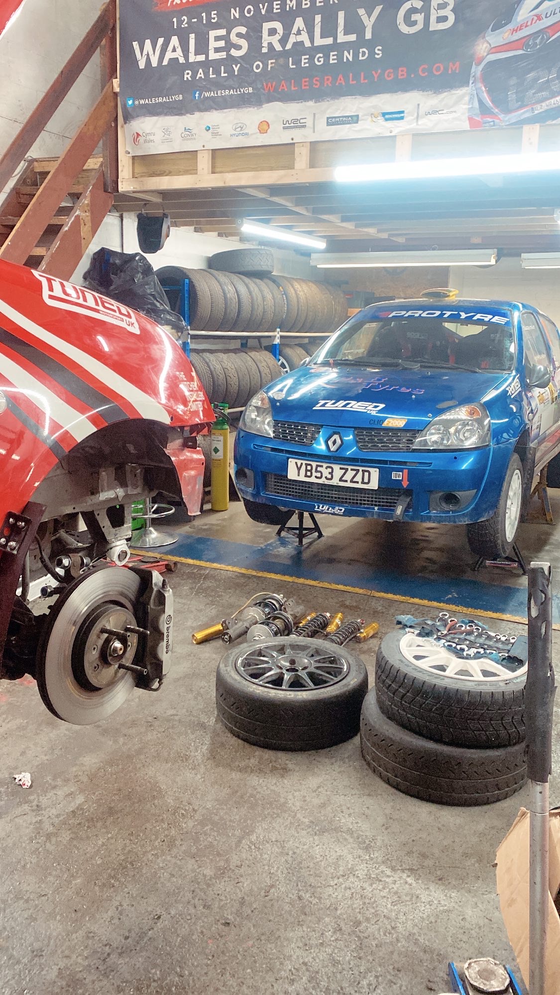

Reigers have been removed along with the cup racer hubs and I’m now on ohlins.

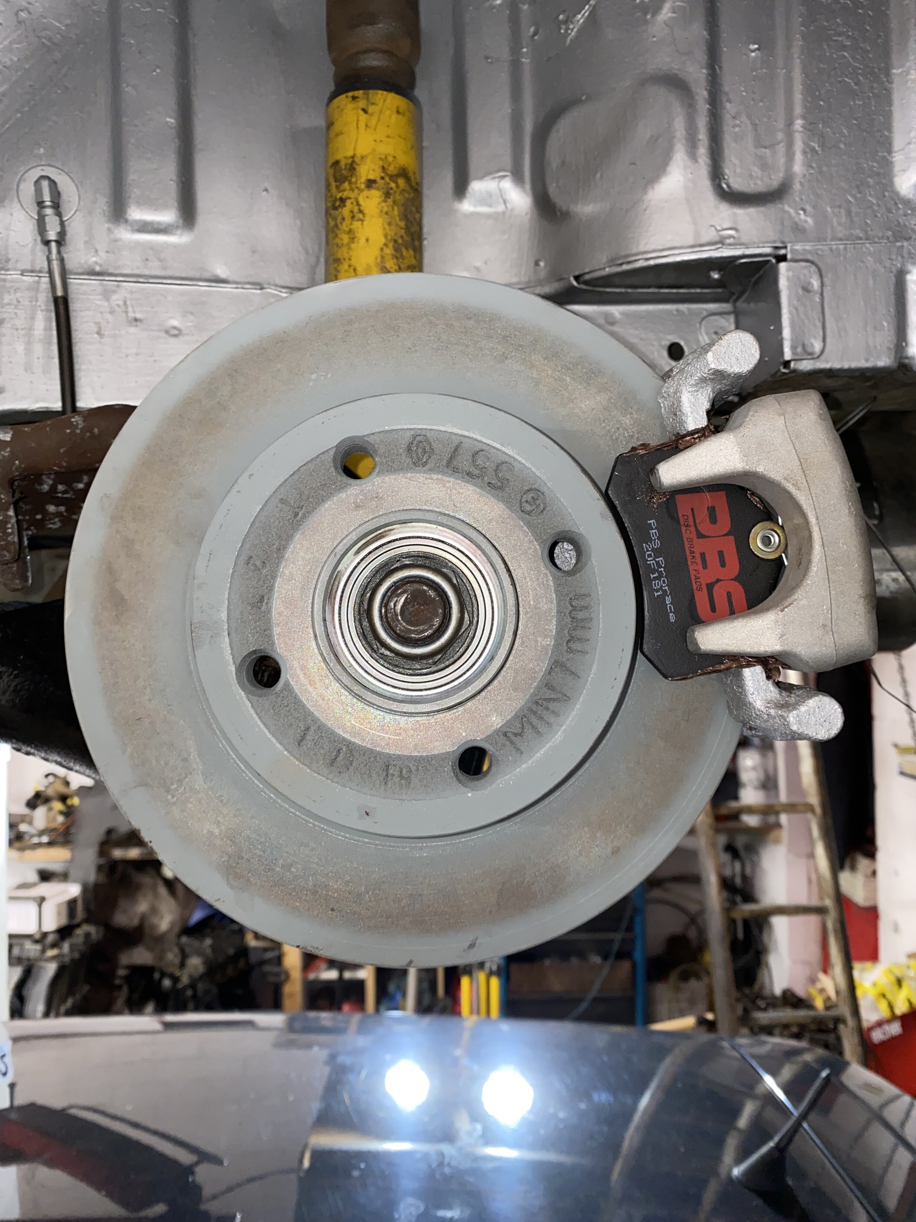

Clio 197 rear calipers and swapped to 197 mc after trying many different sizes in the year but could never get the braking right still

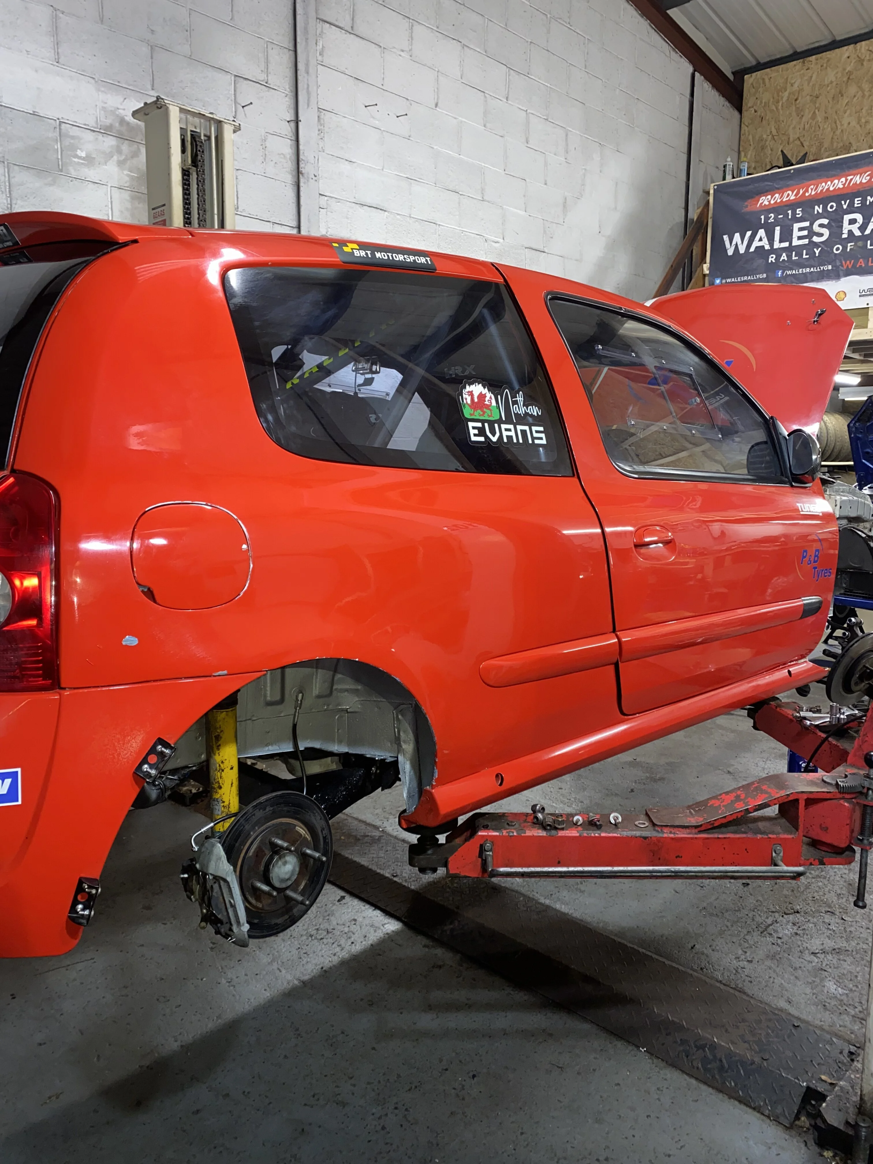

Full year of rallying in it and I didn’t enjoy one as it was so hard to drive, this mainly down to the suspension. The car never felt planted on the closed roads or braked anything like a rally car should. Hopefully I’ve sorted those issues now

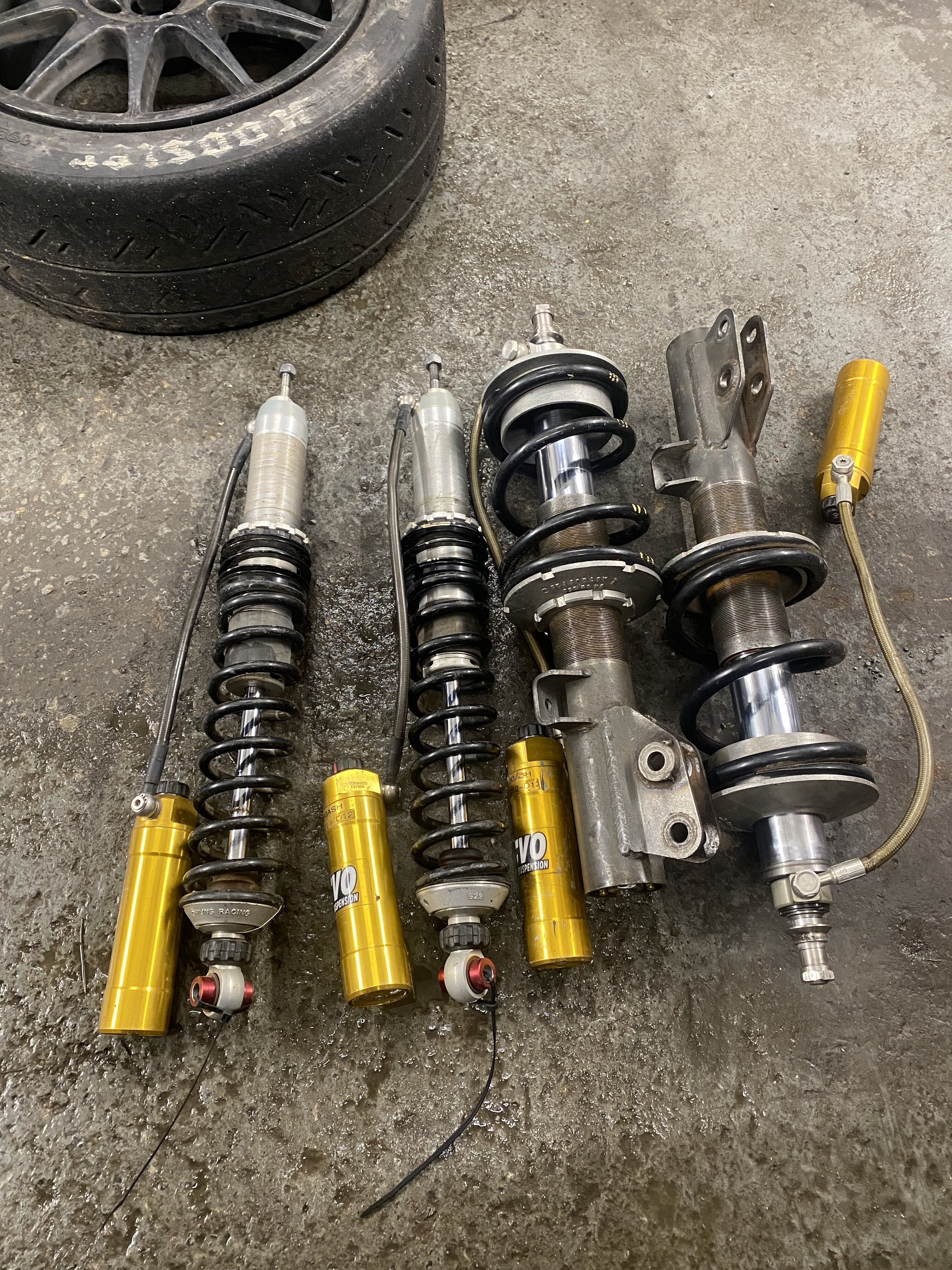

What's wrong with the suspension? It's the main concern for the Twingo.

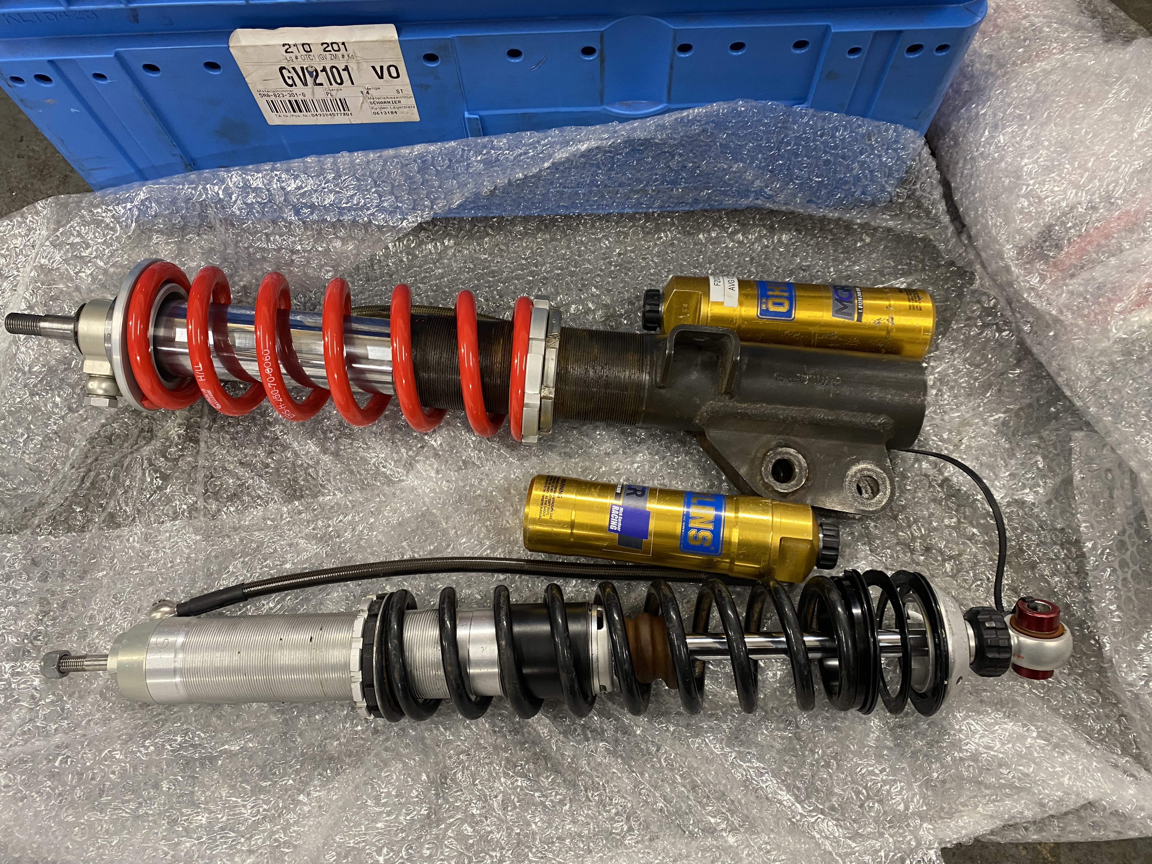

There shouldn’t be concern, Twingo r2 ohlins second hand and job done. That’s what I’m on now and I know 2 others running the Twingo dampers on a clio.
Very easy to get hold of
Personally the reigers weren’t the best, too soft handling wise then wouldn’t take a bumpy road. Zoltan at Reiger did try and help but wasn’t to interested in changing my valving.
So I’m back to ohlins with people who will bend over backwards to get them working correct.

The ohlins will be out of my reach financially unfortunately as they will be mega money to me. I found avo really helpful when I ran the Puma and have the avo rears I got from you to try unless there are ohlins kicking around for a grand lol.

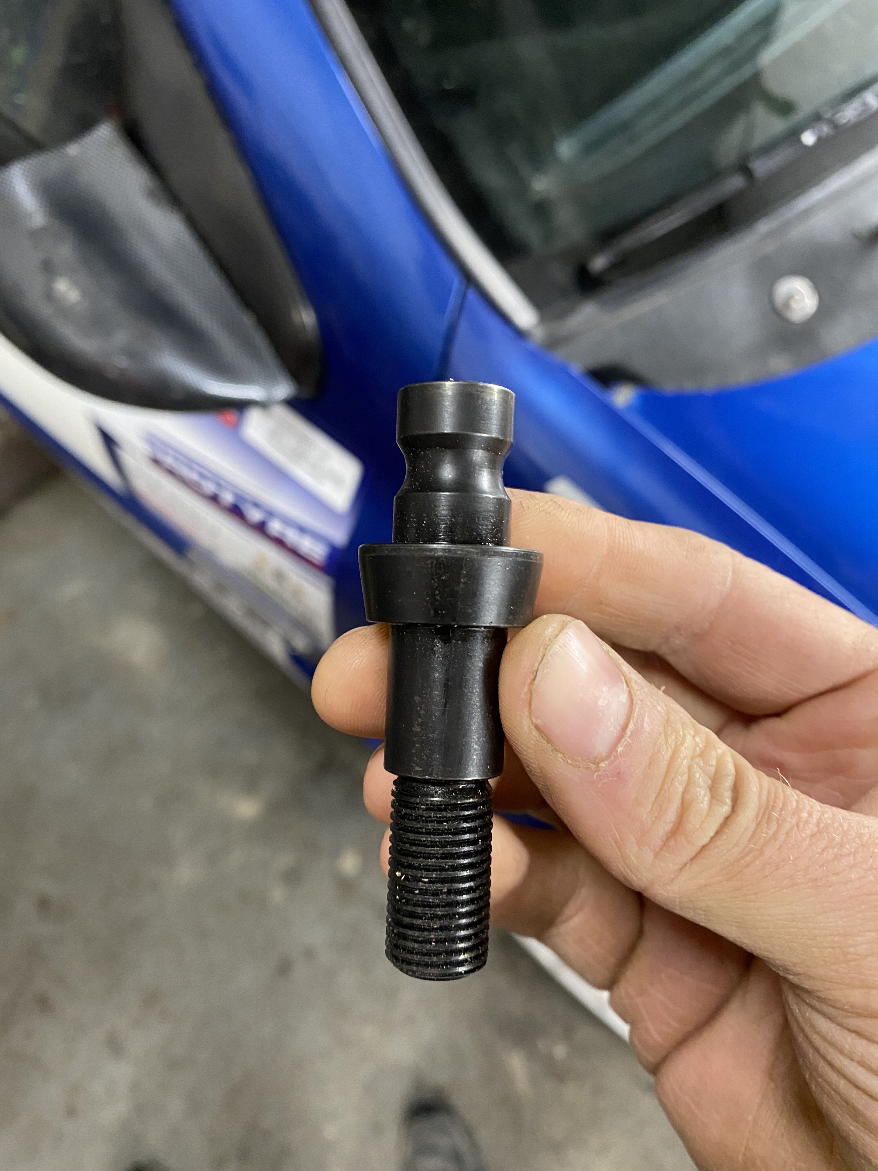

Yeah so it runs 172 hubs now, cup racer ball joint and custom pin
Good updates, yes as massivewangers said why go back to standard clio stuff ?
The closed road rallies look far far better then the circuit based stuff, do they cost a lot more to do ?
Why go cup racer should be the question really? The hub isn’t designed on a clio to be ran at rally height
I managed to get it working ok spacing the steering arm up and having some custom pins but you can’t fault a standard hub running standard ride height. A lot with clios think if PMS sells it then it’s what’s best
