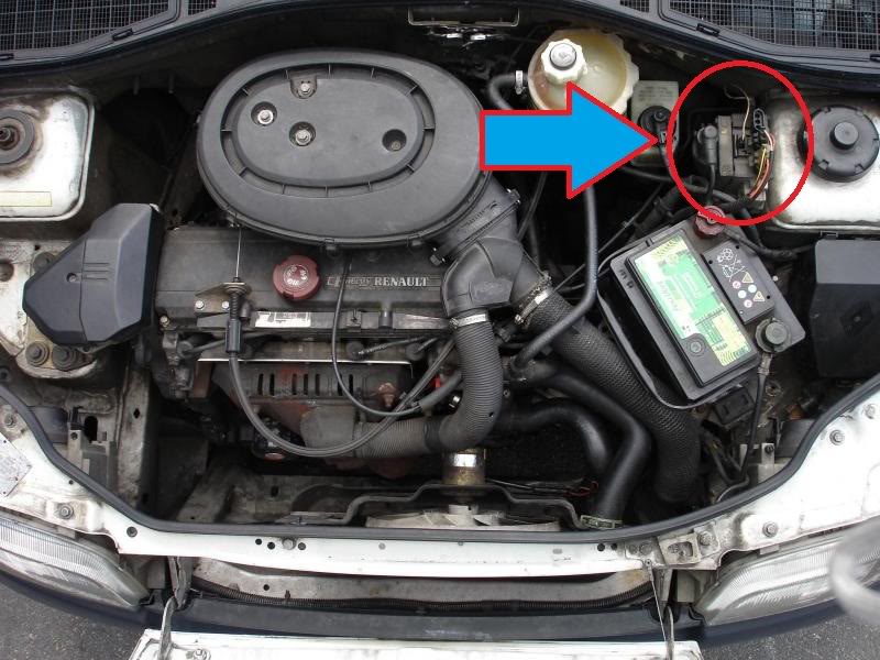

Hi, Today I changed sparks and ignition leads, both seemed like they were ready for changing. but I left engine running while i was trying to figure out what the problem is.
As soon as i got a drop of water on the bit highlighted in the pic below, it cut out and wouldn't restart.
I removed the plugs from it, cleaned and WD40'd them and put an old butter tub over it. And it started first time. Lets see how long it lasts :)
Thats the coil pack mate!
there is usually no cover for these that i know if so im guessing yours is getting water on it somehow when its raining.
Prob be on the safe side to renew the dizzy cap and rotor as this is directly related to the coil pack.
