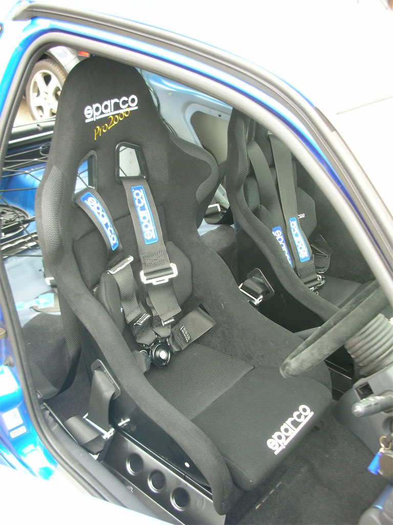

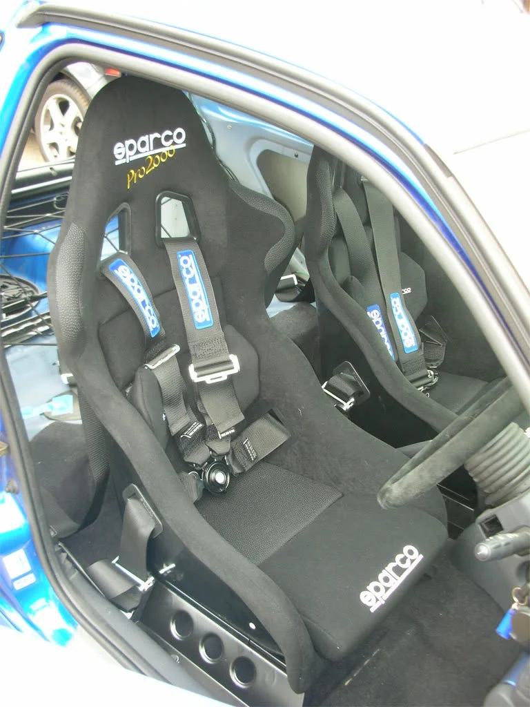

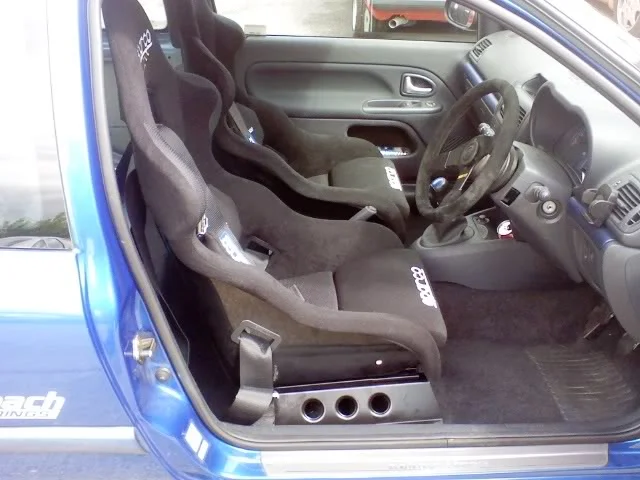

Then I ended up with an issue regarding the seats - it didn't seem possible to get the car going any quicker as I was having to brace myself between the OEM seats and steering wheel. This was completely knackering over the course of a full day's track time - so something needed doing.
So the car now has

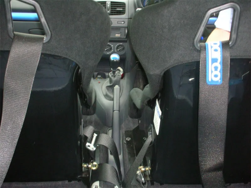

  • Sparco Pro2000 seats with 4-point harnesses

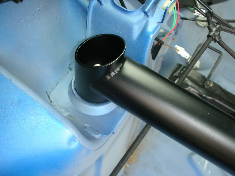

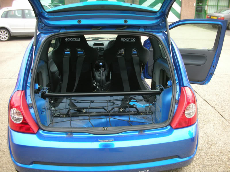

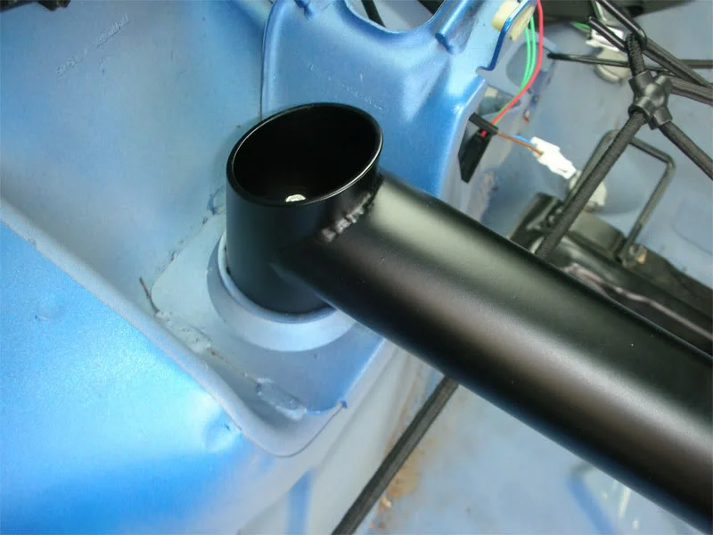

  • Custom rear strut bar between suspension turrets
  • Removal of all interior behind B-pillar

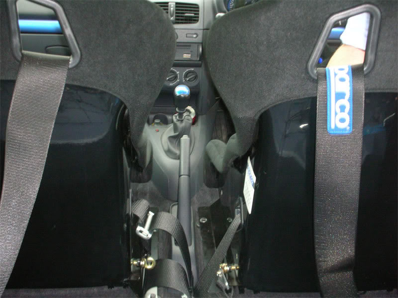

How do you find the seating position? I was considering Pro2000s as i already have a pair of sparco base mounts. I really didnt want them mounted to high though.

seats are mounted on slider frames on top of the Sparco base mounts.
Do the Sparco mounts fit straight in without any modding as i am interested in some sparco recliners for my 182, just need to find somewhere that sells them so i can try them out.
