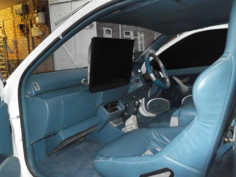

Small update. This weekend i've been doing a lot of cleaning up as the interior was a right state after all the bodywork over the last few months. At the same time i test fitted the 19" screen which still fits and works well on the PS3....Just needs to fit the suction cups that attach it to the screen at the top to stop it leaning.

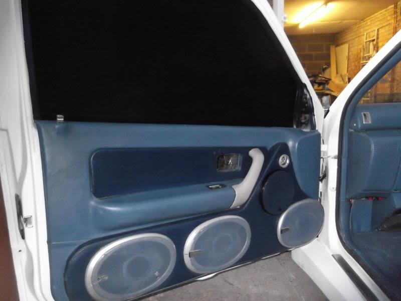

I'm also in the process of changing all the speaker grills, door handles and dash bits to black instead of silver and a darker blue mesh as it looked a bit cheap before The Pioneer 6x9 grills are being changed as they are battered from when it was used before.

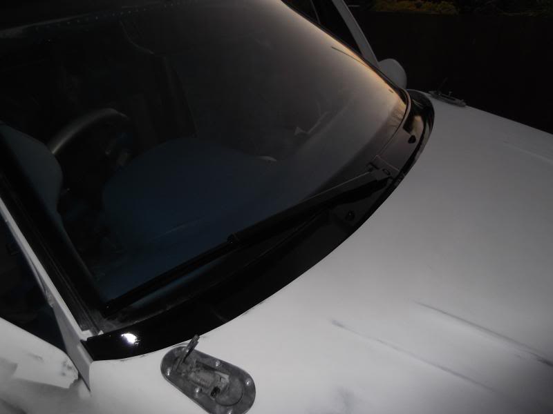

I've also painted the scuttle panel gloss black to match the car and it looks much better. I also did the wiper (including blade) and the washer jets to match.

It is wider. Its a 19" screen. It is removable and slots in the top of the dash. When removed a leather covered panel fits over the hole to hide the cables etc. The original panel actually broke so i'm in the process of making a better new one.

Oh right, thats all a bit manual, I just assumed it would slide up and down electrically or something not that you had to start lifting a tv about, lol.
  Clio Widearch
haha..i'm not sure where a 19" TV would fit to slide around in a clio dashboard. I wanted the biggest size i could so a manual option was the only 1 i had. It fits nicely in the enclosure port or behind the seats when not in use. I only ever take it out on show days.
The old one was 15" but this one is much nicer looking and better quality. It also picks up freeview which is a bonus when you want to watch the F1 or Touring car on a Sunday at a show (Thats been done before)...lol The built in laptop and cordless keyboard and mouse etc work with it also.

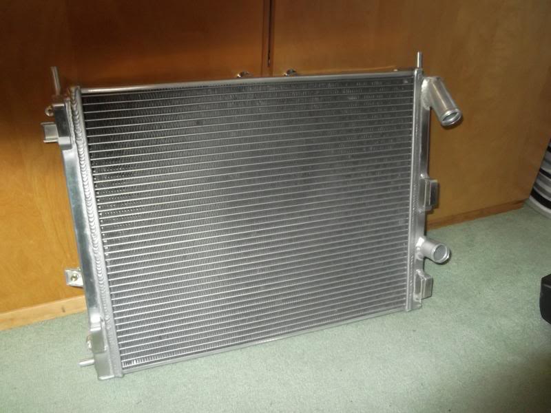

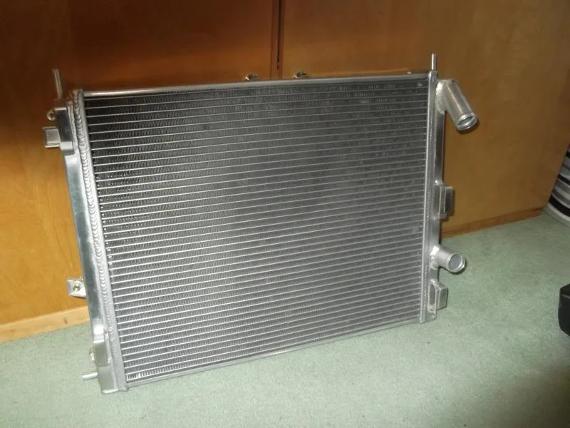

new larger radiator is here. A nice Direnza all alloy 40mm core clio 182 race jobbie Brand spanking new and won from a shop on ebay for a measley £70 delivered...bargain
Just need to buy the 16" 120w fan to go with it...oh and will require some major mods to the subframe and repositioned power steering bottle to make it actually fit

Chip - They sell them for £159.99 normally but they have some auction ones on there too. I picked one and put a max bid on of £120 as i was prepared to pay that. There were some bids going on towards the end but when they kept being outbid automatically i think the other people bidding just gave up so i got the bargain deal..lol. I won it for £62 + £9 delivery which pleased me no end.
Since the auction i've ordered a 16" slimline fan, 6 speaker grills and should be able to get all the water pipes in silicone all inside the £120 budget....happy days

I just tried placing a bid on one of their rads and it went straight to 62 pounds as well, I wonder if perhaps they are getting someone else to place that amount as a big against all their auctions as a free way to get a reserve on the basis that they end up "winning" it so rarely that it works in their favour compared to paying a reserve?

There are a few sellers on ebay selling these rads. The one i won was at £41 for most of the auction but i ended up winning in a fair way i think. The first 1 i was bidding on from someone else got to the last day of the auction at a low price and was mysteriously took off ebay..hmmmm that was very dodgy.

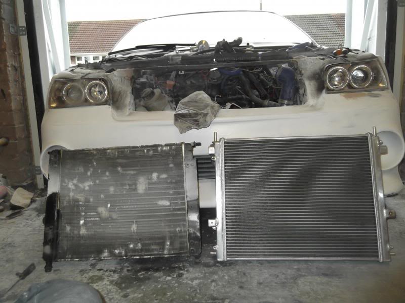

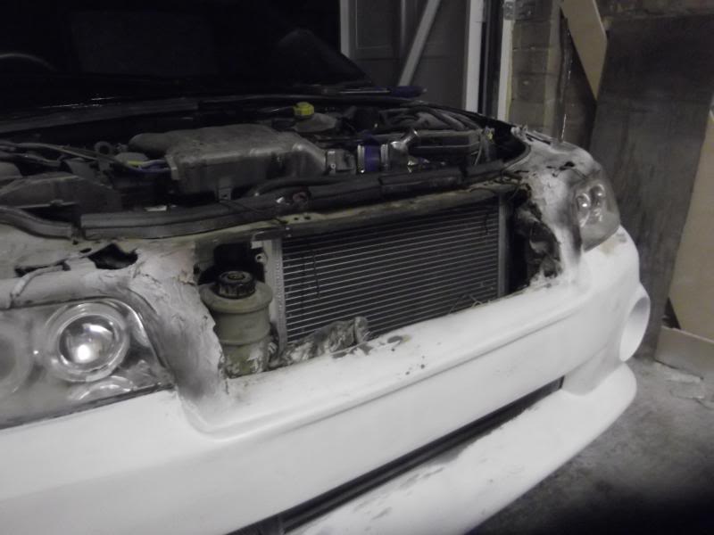

Was going to try a test fit today but it became a permenant fit instead (was quite easy in the end and no subframe mods required :) It is now in after about 5 hours work messing about with pipe fitments and leaving enough room for the fan etc
Here's the 2 side by side
And here it is fitted. Just needs top and bottom hoses joining up now and a couple of bits of metal and silicone pipe purchasing so things are nice and tight. The bonus is i don't even have to move the power steering reservoir as it was there anyway and fits well :)

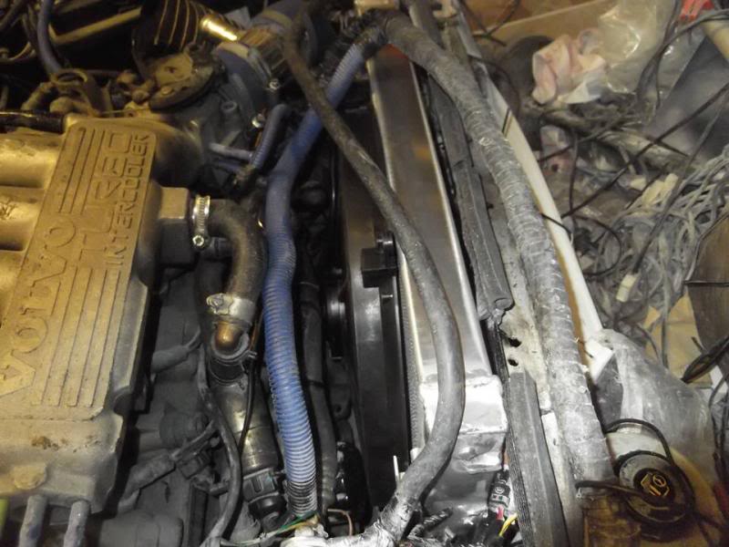

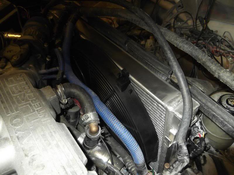

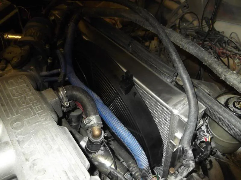

Not much room in here..what a ballache getting this 182 radiator fitted in the end .
The original plan was to run it upside down but then realised that the bottom hose wouldn't fit on if i did that. Now its running the normal way round with a 16" fan on it (still needs attaching) Just need to buy a metre of 32mm silicone hose to attach the bottom and top hoses and its job done but needed to chop some mounting points off the rad and modify intercooler piping etc to get it in this way.
The fan is that close that i've had to break some of the guard grille so the clutch cable can operate..lol Happy with the results though as long as the overheating issues go now. The test will come over the weekend

oh and......the overheating problems have now gone. :)
