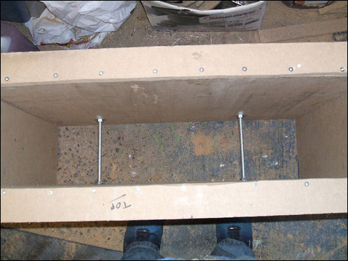

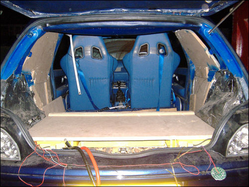

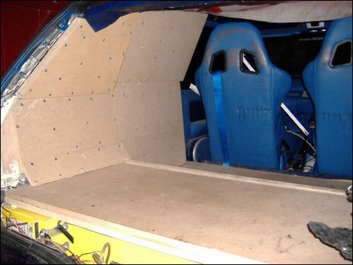

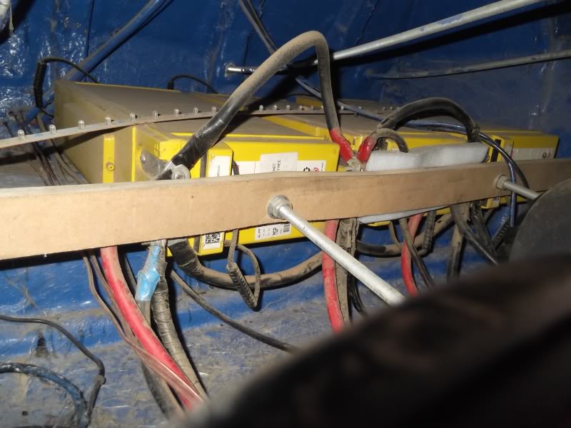

4x Batteries in the boot covered with MDF (They fill the entire boot area and more)
3x Batteries inside the enclosure (You can also see the steel rod connecting the front and rear of the box to eradicate flex. There is zero flex in this box as it is built to the car, 54-108mm thick around the whole thing and covered in 2 layers of fibreglass....its going nowehere...lol

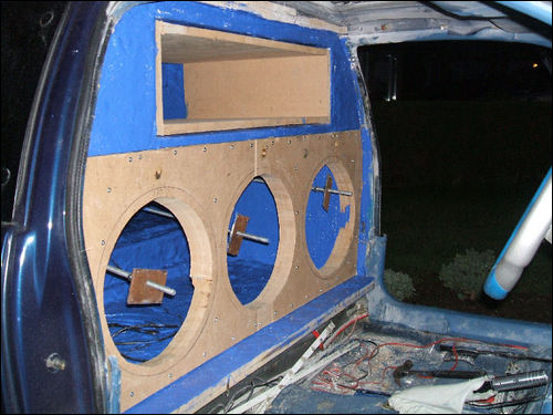

Start of the wood going in

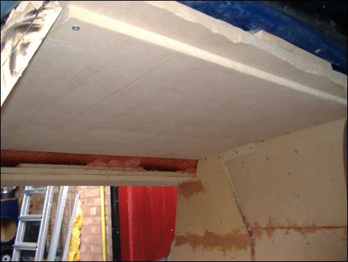

Roof of enclosure in

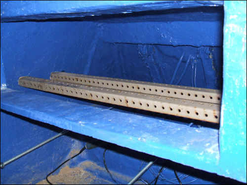

Looking into the box with 2x2 and metal strength supports and part way through the fibreglassing

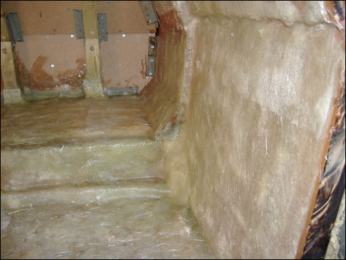

Fibreglass almost complete
Port strengthening
Port steel supports

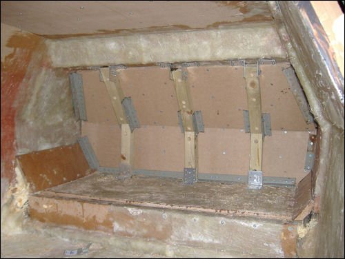

coming together now

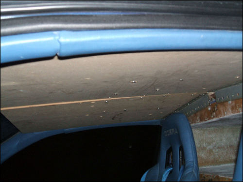

MDF roof in
This part took about a year to put together back in the day and that was before any subs went in...lol

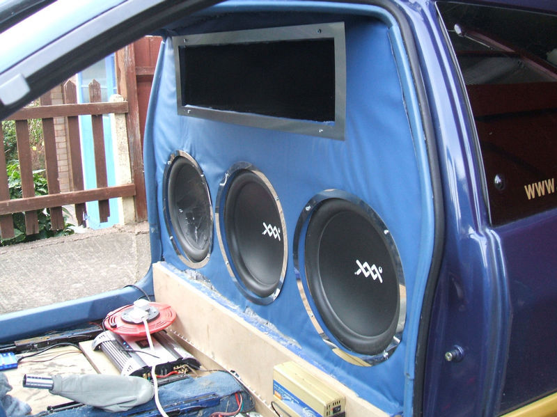

Old RE XXX 15" subs in enclosure with stainless trims

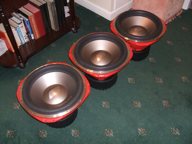

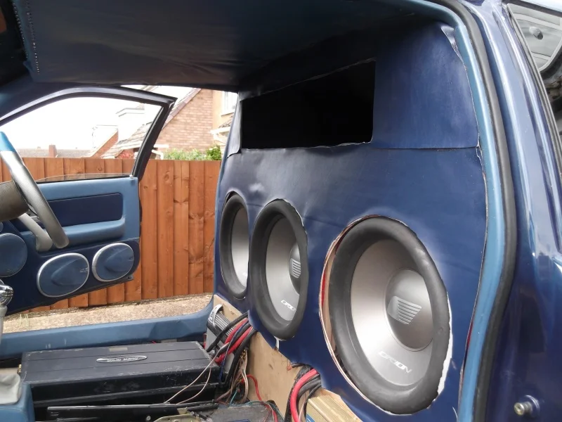

New Orion HCCA 15.2 subs

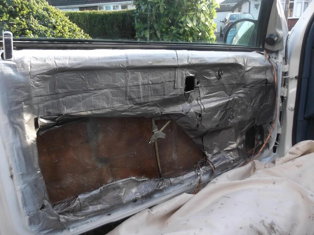

MDF and fibreglassed Sound deadened doors

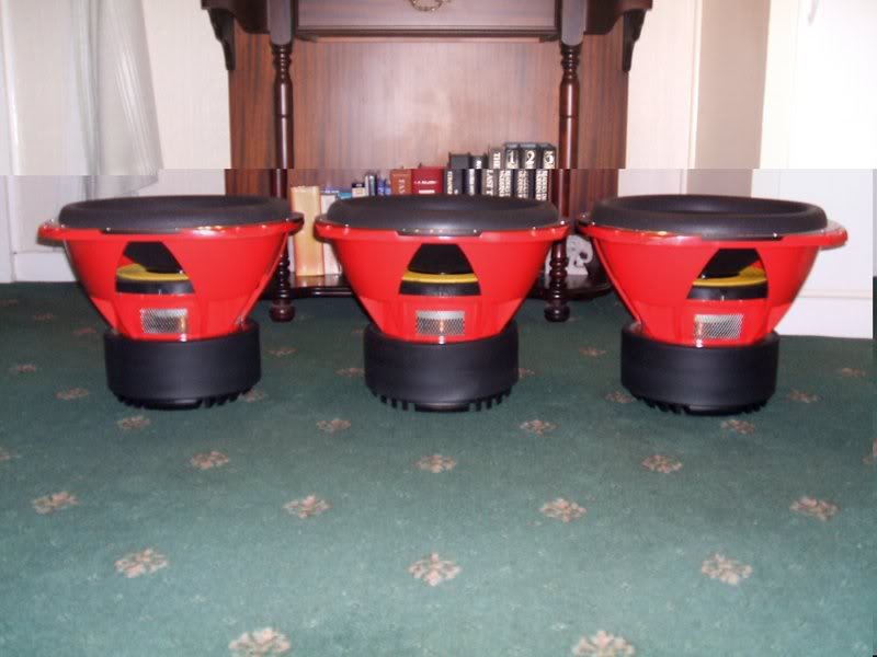

New subs at home
  Clio Widearch
I can't wait to get them fired up and running. I had to charge the rear bank of 4 batteries as they were really flat after sitting there for 5 years or so. It took 3 days and nights to charge 4 batteries on trickle charge...lol
