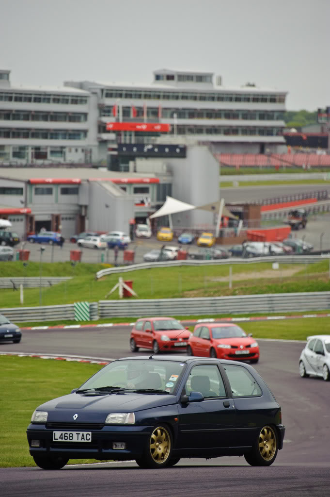

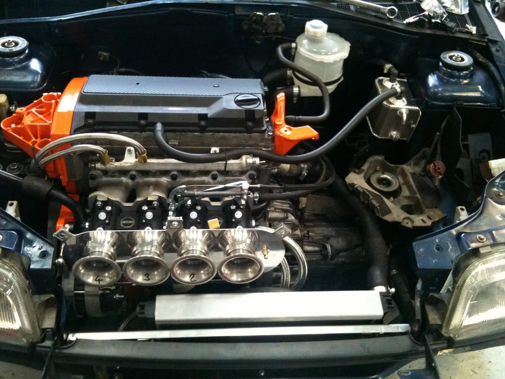

This is my long term project and, currently, my daily hack as well.
It currently is specced thus:
Powerplant:
Jenvey 45mm ITB's
2225 Cat cams & Verniers
13 Row Oil Cooler
Walbro uprated fuel pump
APD Megane 714 ported head
Supersprint manifold
Oreca Grp N straight through exhaust system
Suspension & Divetrain:
AVO coilovers
AST adjustable solid top mounts
Powerflex polybushes
Camber adjustment bolts
Gripper LSD
Shortshift gear system
Brakes:
K-Tec big brake conversion running braided hoses and Mintex 1155 pads
I have a High Comp. 12.5:1 bottom end from Hillpower going in as well next month, along with some more aggressive cams. Circa 210bhp expected after a remap.
I hope you like my efforts and my little car :)

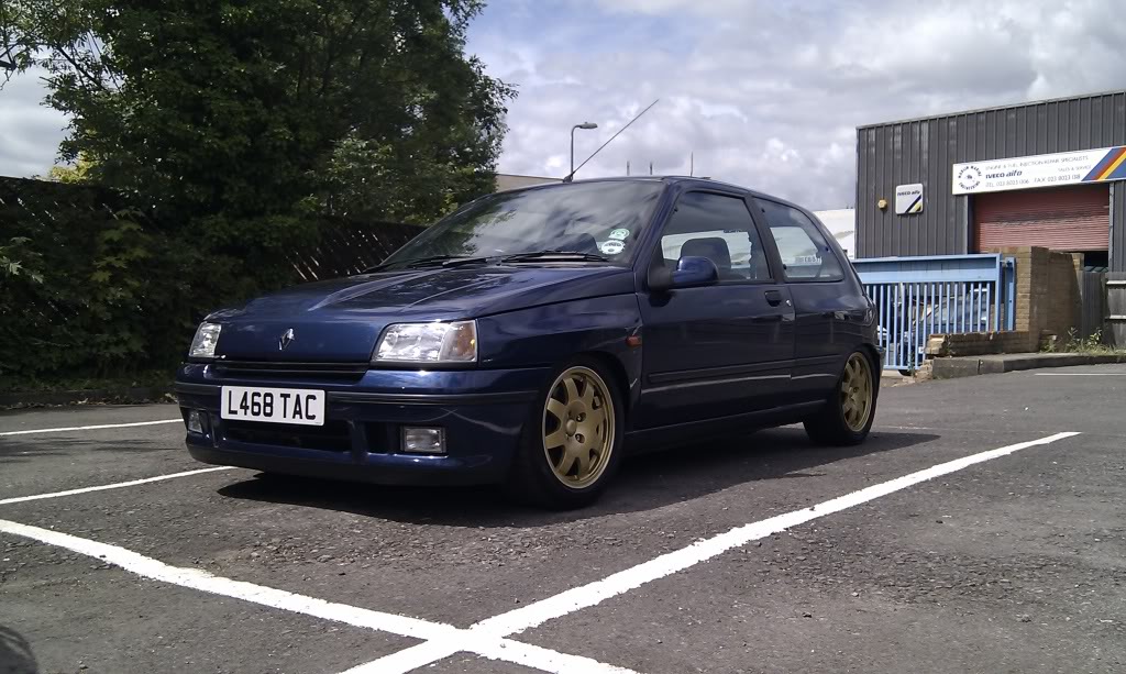

It's not the best and the winter has taken a big toll on poor 0217's bodywork :(

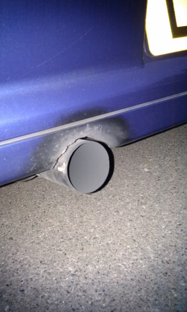

Add to that a couple of drunk lads ripped the passenger wing mirror off and smashed it into the car too, it needs the dent removing and wing mirror bits repainting. The rear bumper has melted from the flames on overrun from the exhaust as well and I should really replace it.

Even with diagnosing a poorly bottom end, its a mental road machine. The level of grip with reasonably sticky R1R tyres and the mechanical LSD sometimes just blows me away. It's quieter now than it was but the pops, bangs and crackles are amazingly funny. It does not flame anymore though, had that mapped out :)

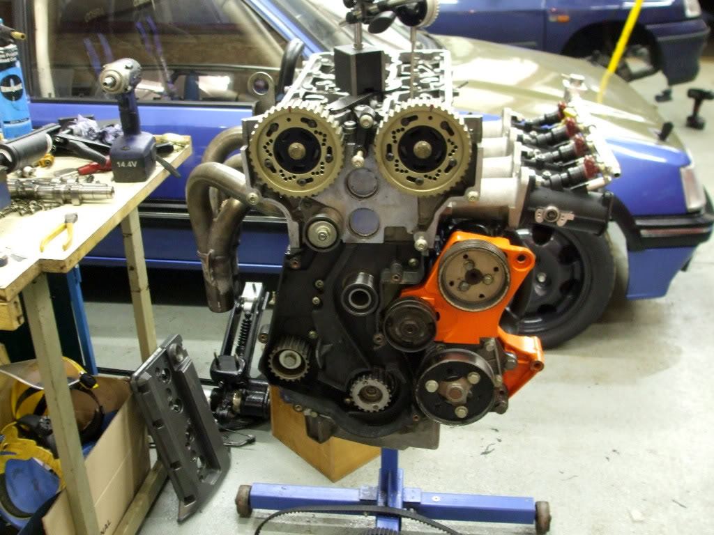

I do have a lot of pics of a lot of stuff that's been done :) There is very little that I have not removed, replaced and bolted back in with this little car.

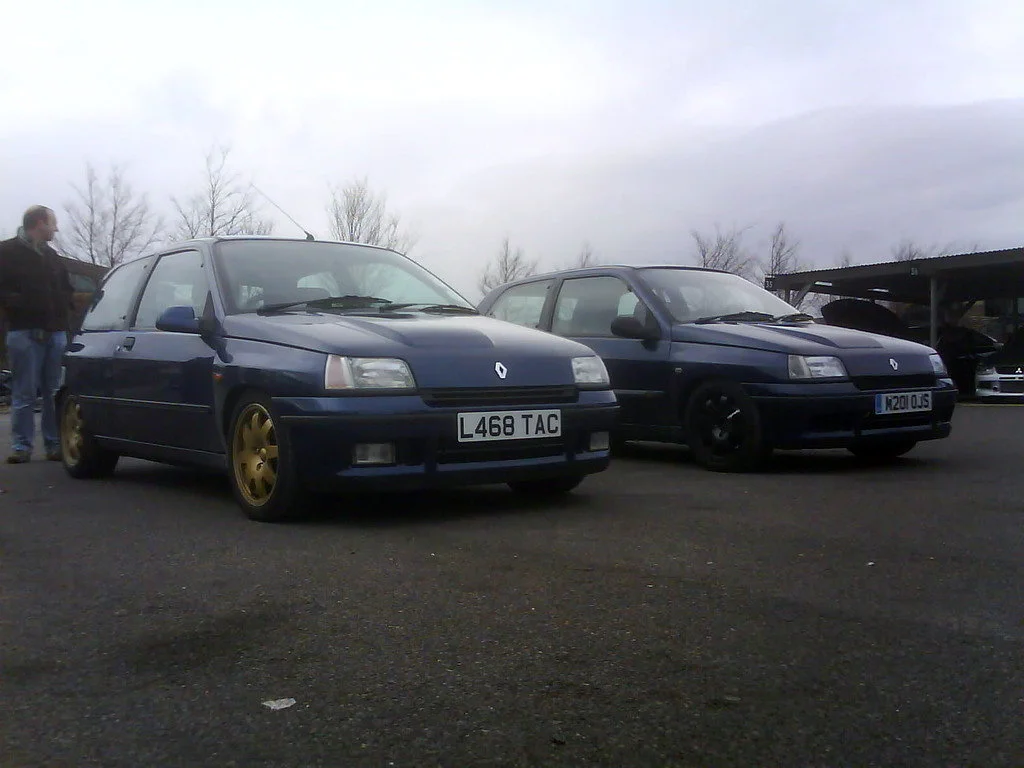

Nice car mate. Think iv seen you at goodwood a couple of times with another Williams that's been striped out and plastic windows?
I've been to Goodwood with another mate in a Williams, on a Pistonheads morning run once :) This was taken there back in 2009, before most mods were done:

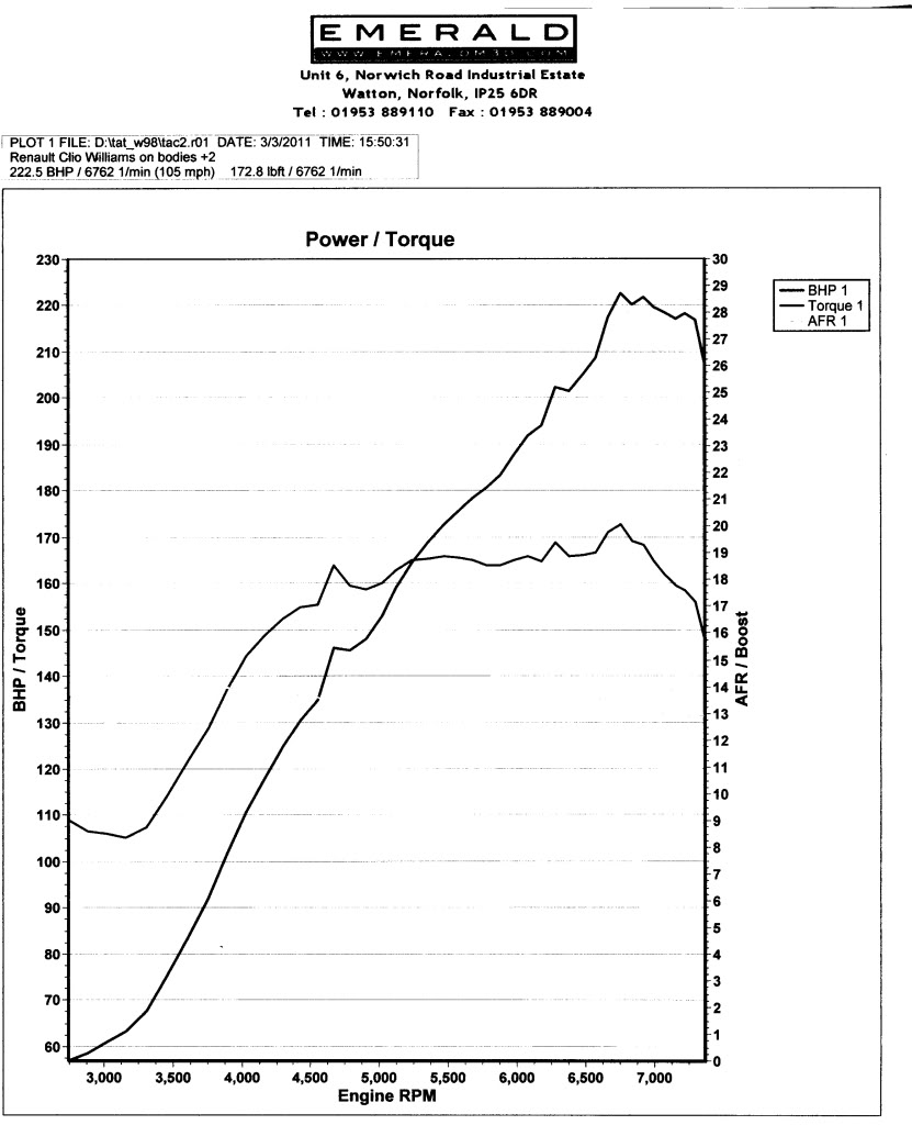

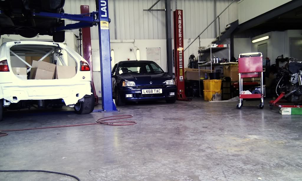

Just thought I would update you guys as I have now had the Hill Power engine fitted, with different cams, by danny at 519 Automotive. he tweaked some other stuff too. Will write a 519 review on other thread soon.
Mapped by Dave Walker:
All I can say is: fuking hell.
