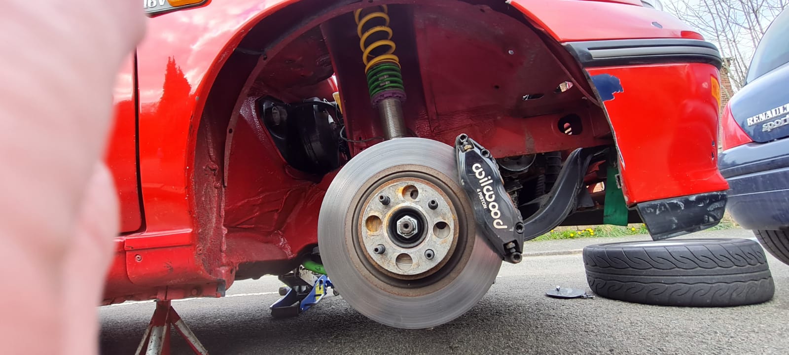

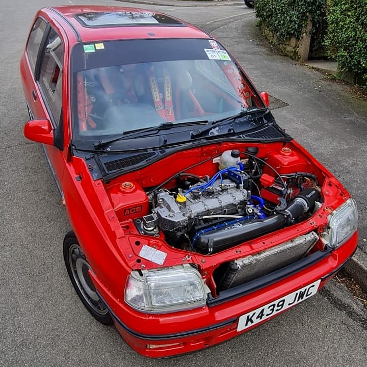

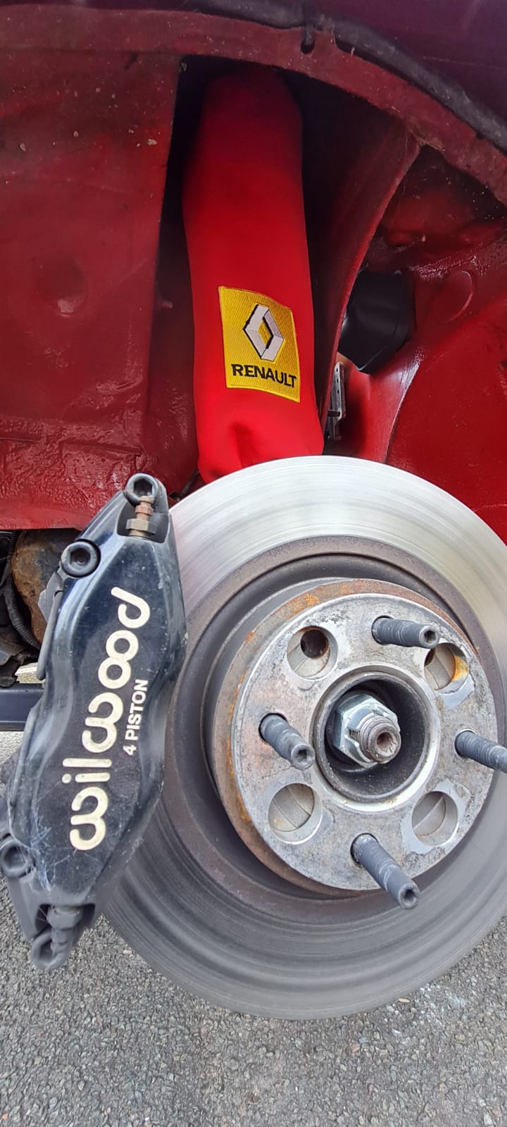

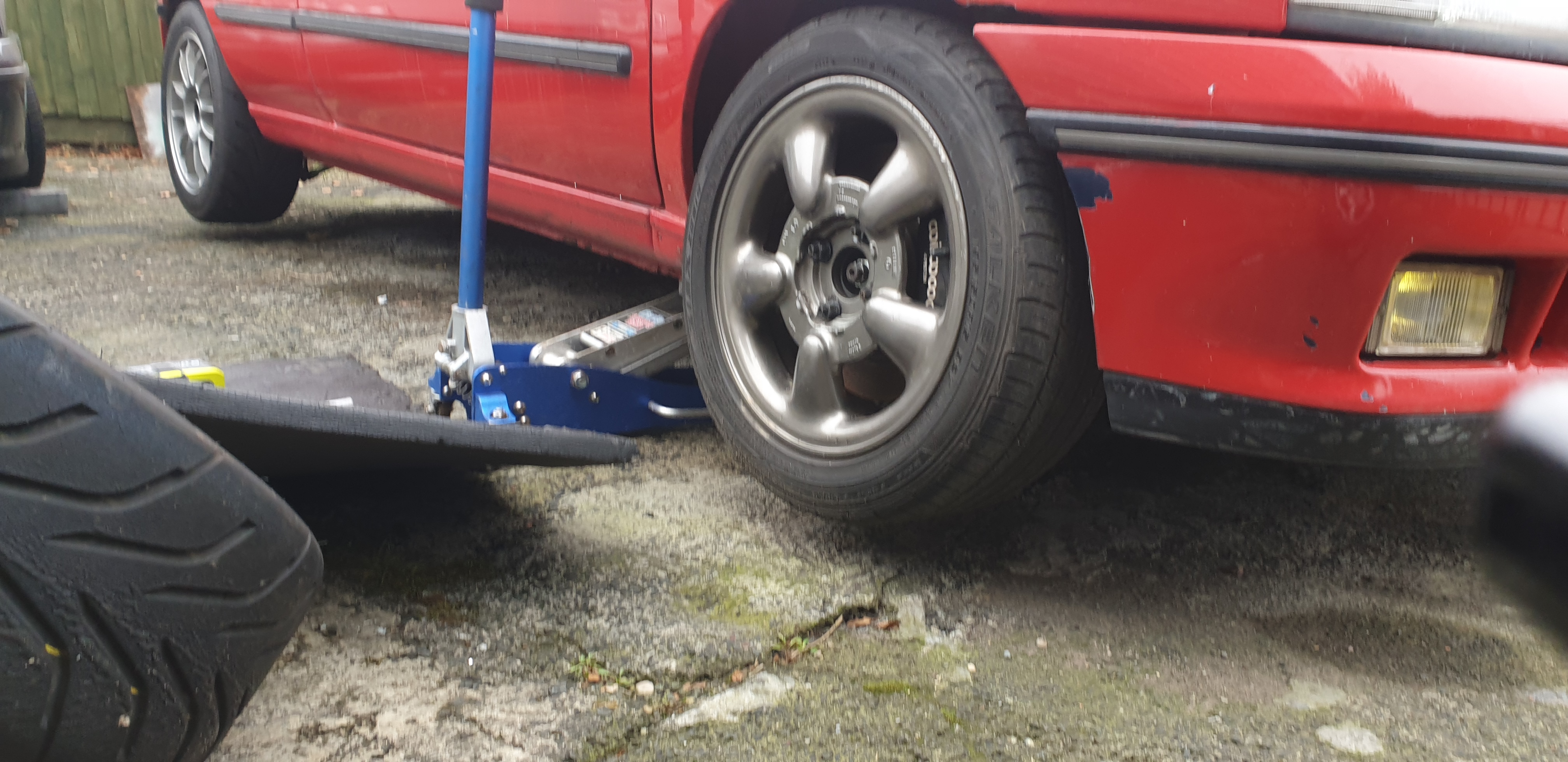

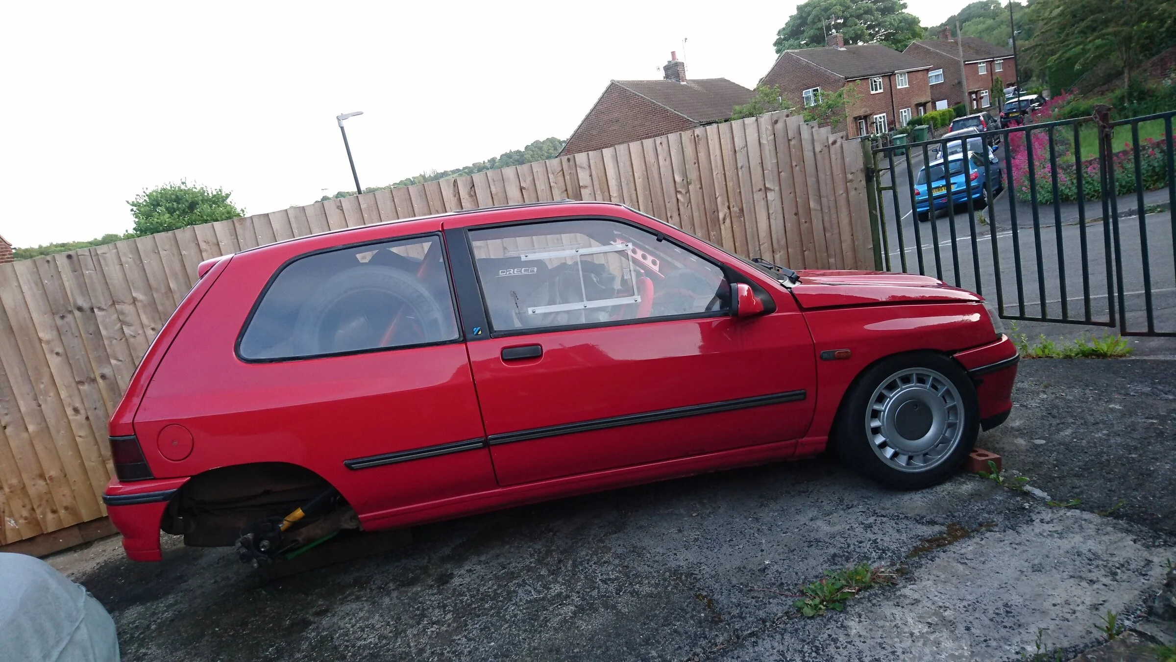

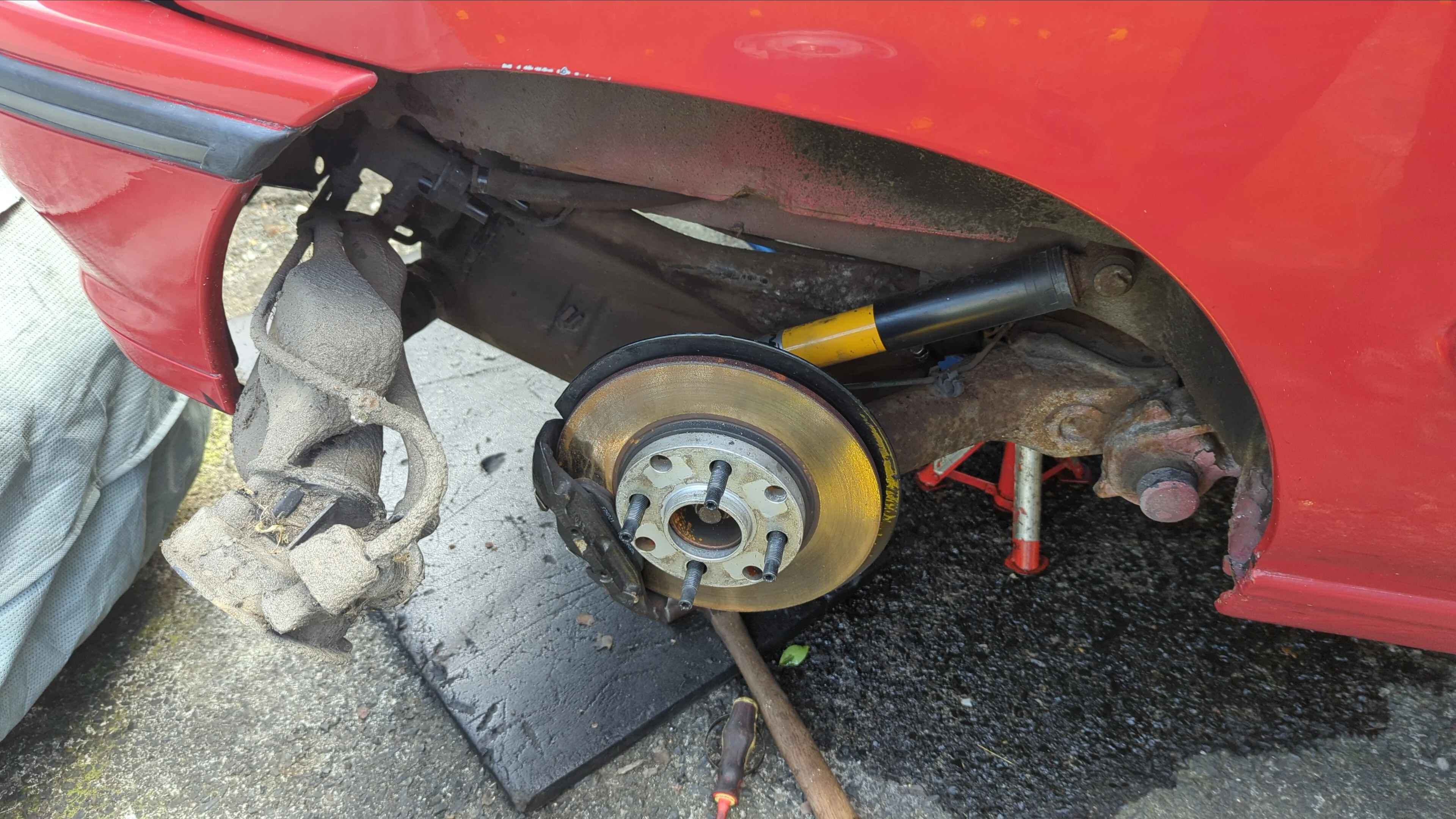

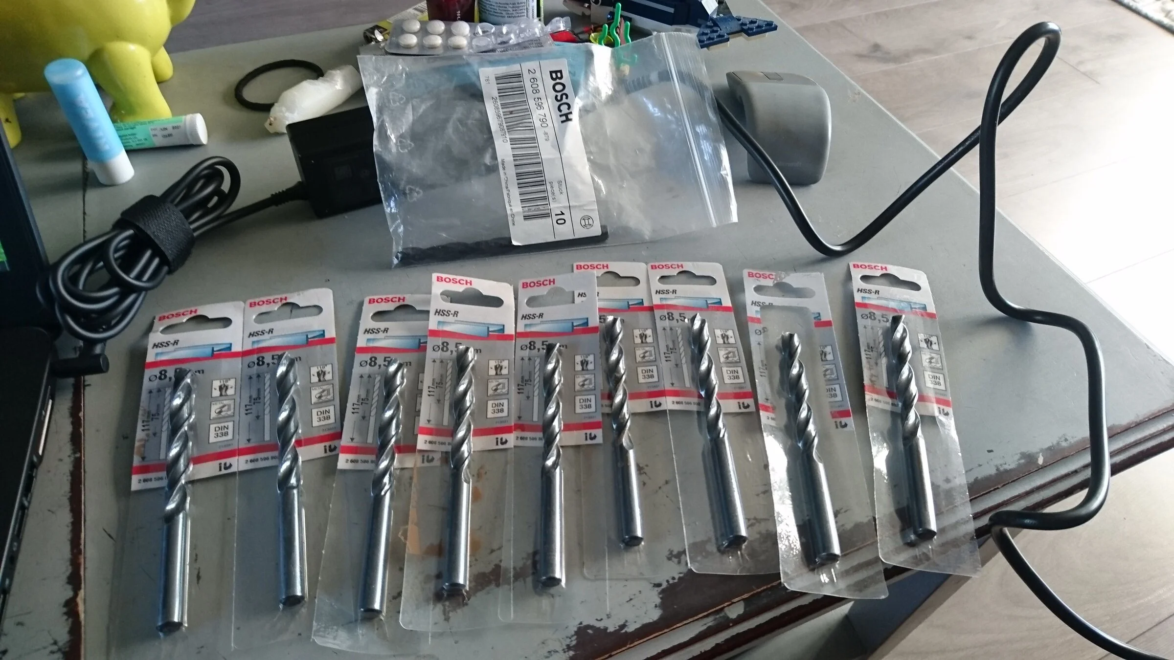

Cars currently in pieces on rear end to perform the hub conversion, managed to get all four bolts per side out to remove the caliper brackets. So next task is to chop that old stubs off, flatten the mating faces then drill out the bolt holes to 8.5mm and tap to m10 1.5 thread for the mk2 bolts.
May of overdone the 8.5mm drill bit purchasing....
More to come soon

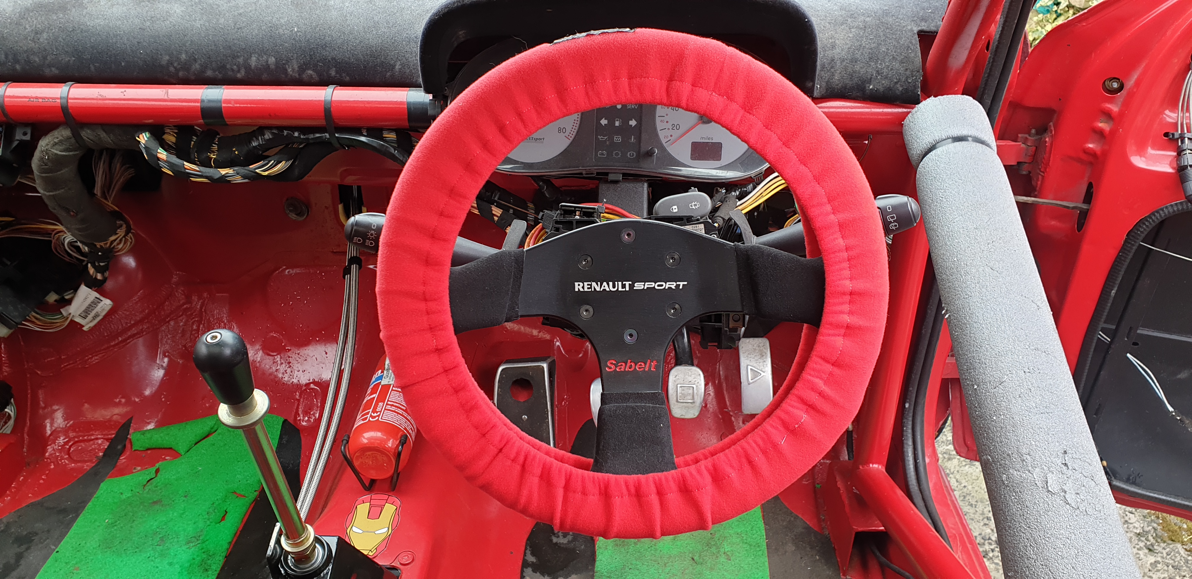

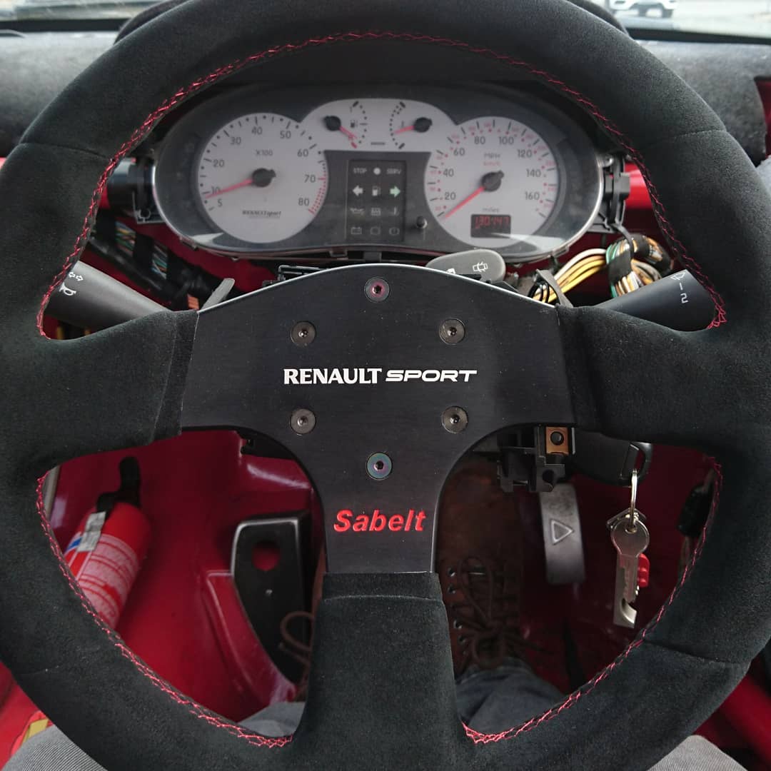

Fitted superleggera with R888's and new red themed sabelt wheel and she's ready for exhaust tweak and MOT soon.

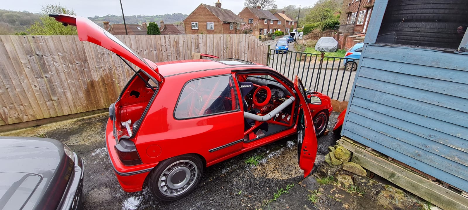

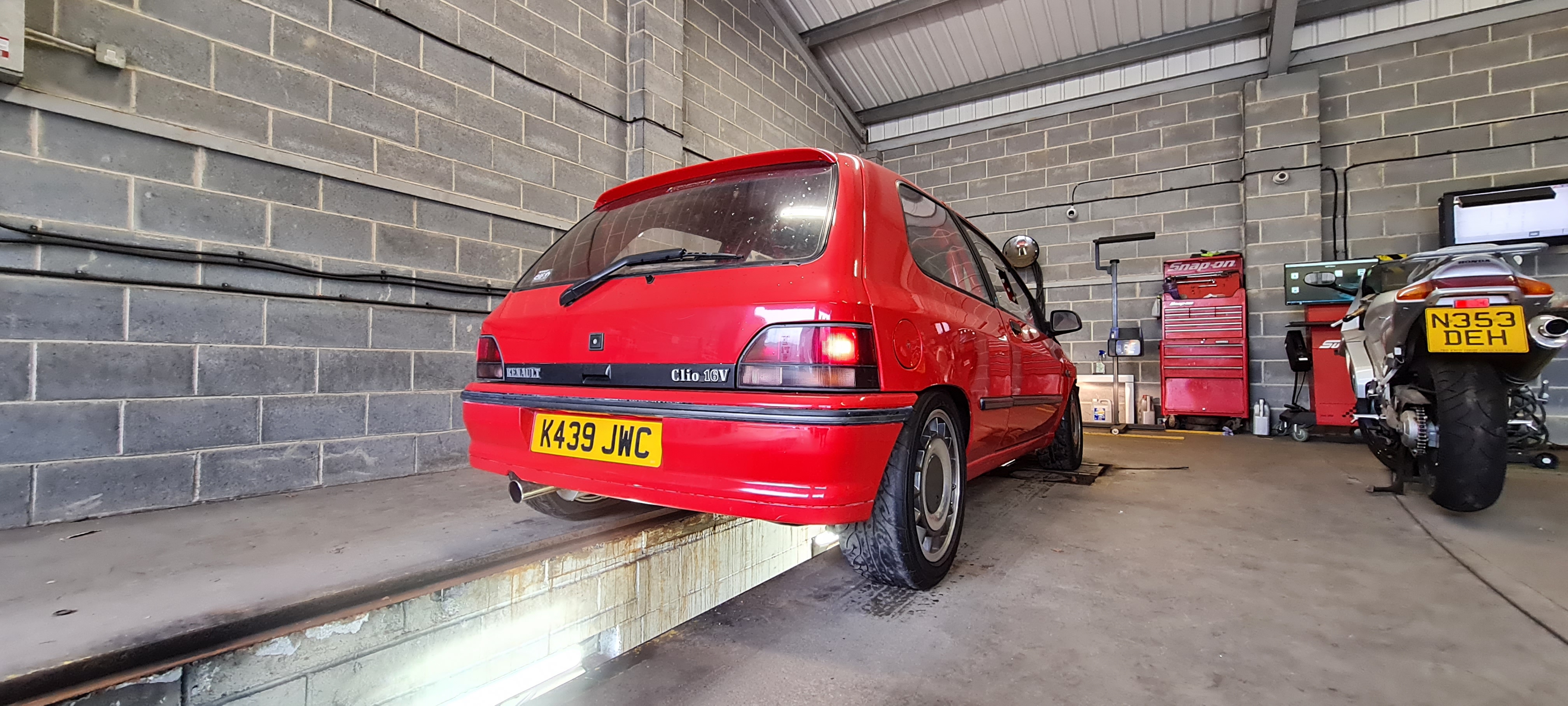

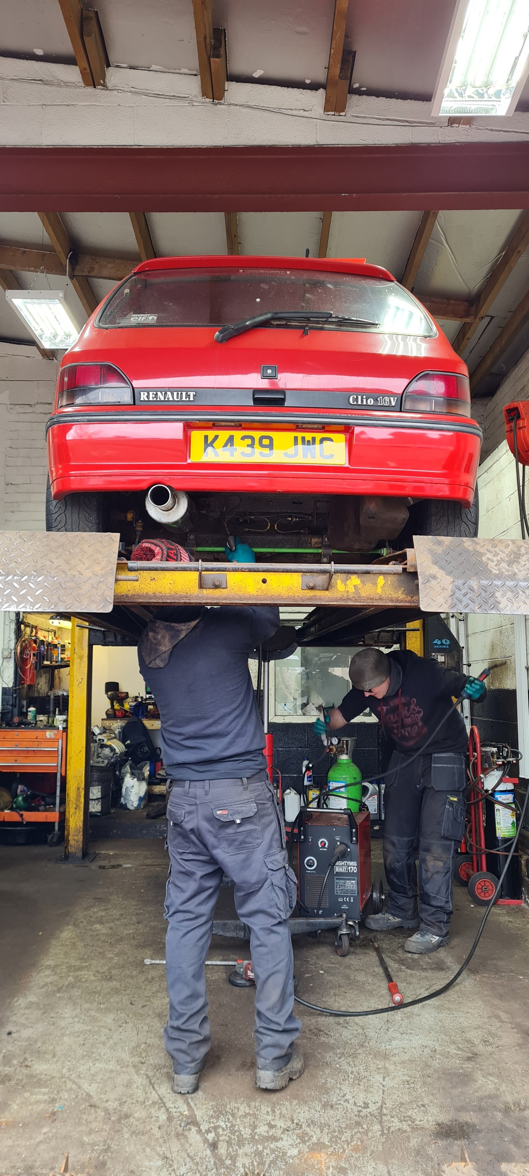

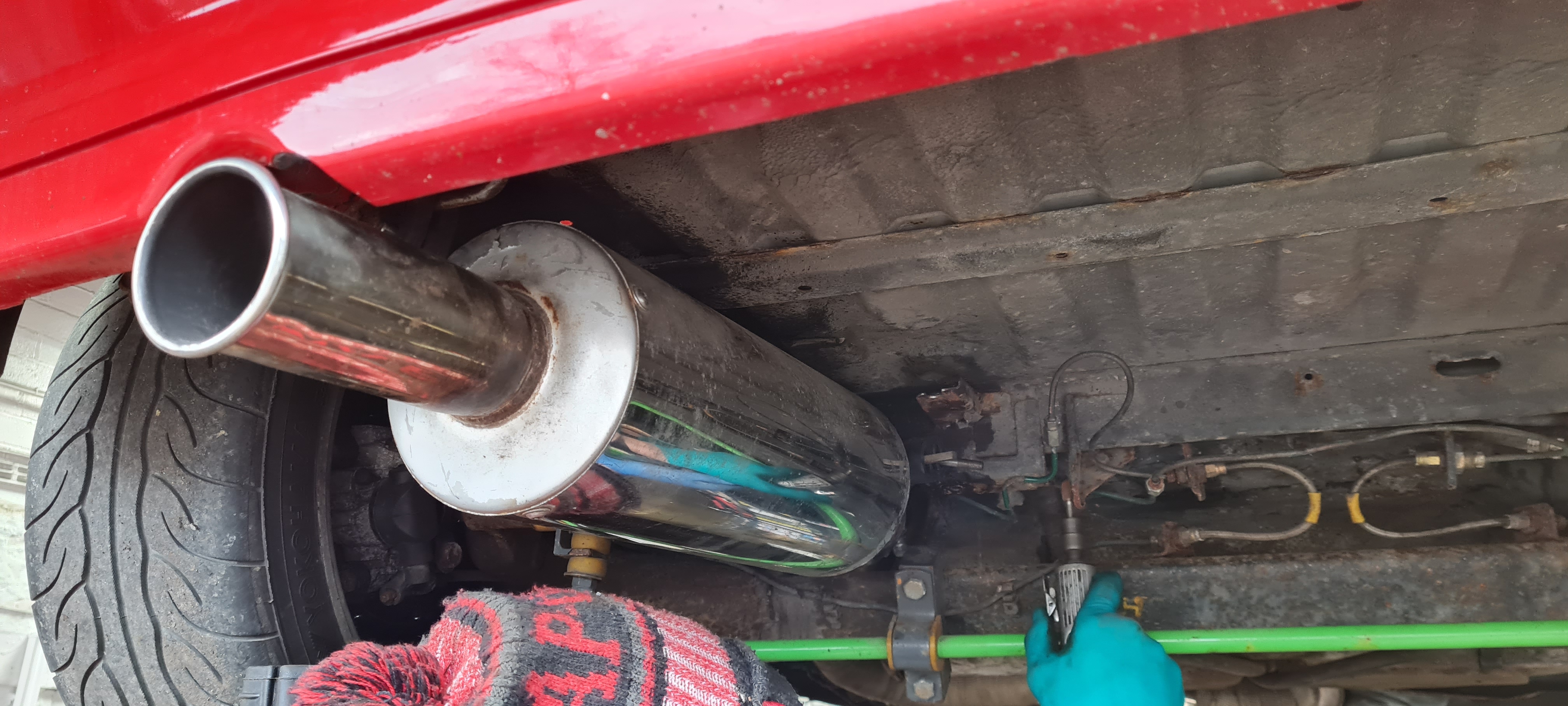

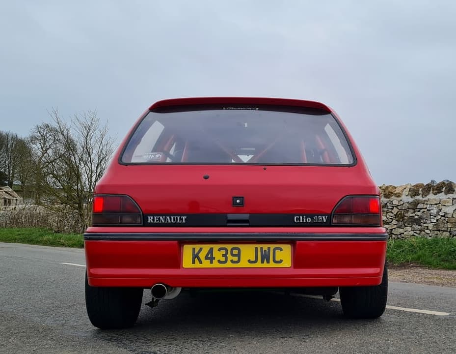

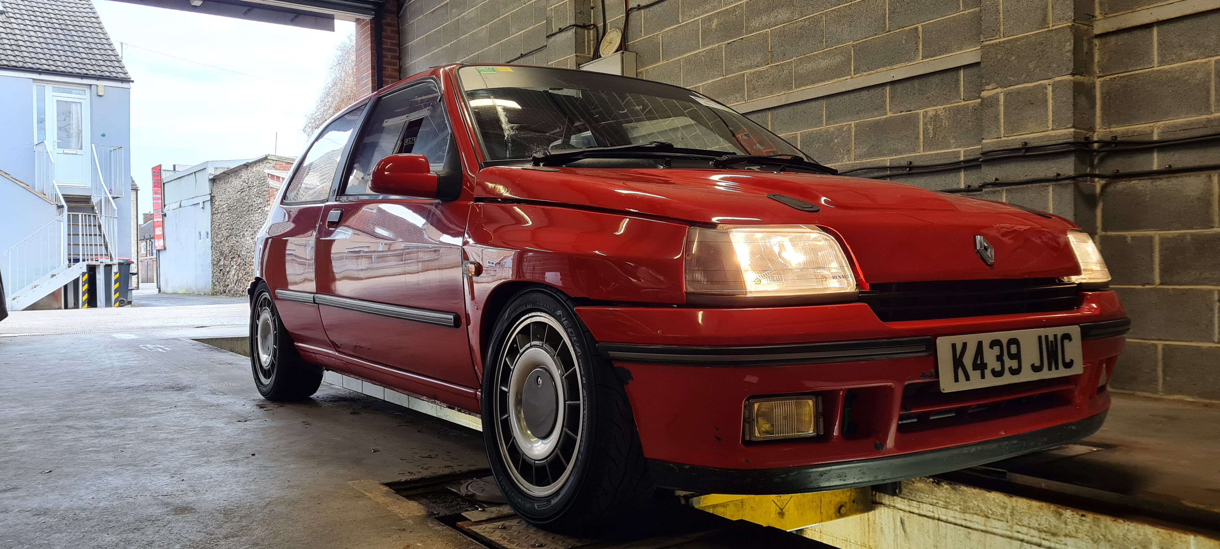

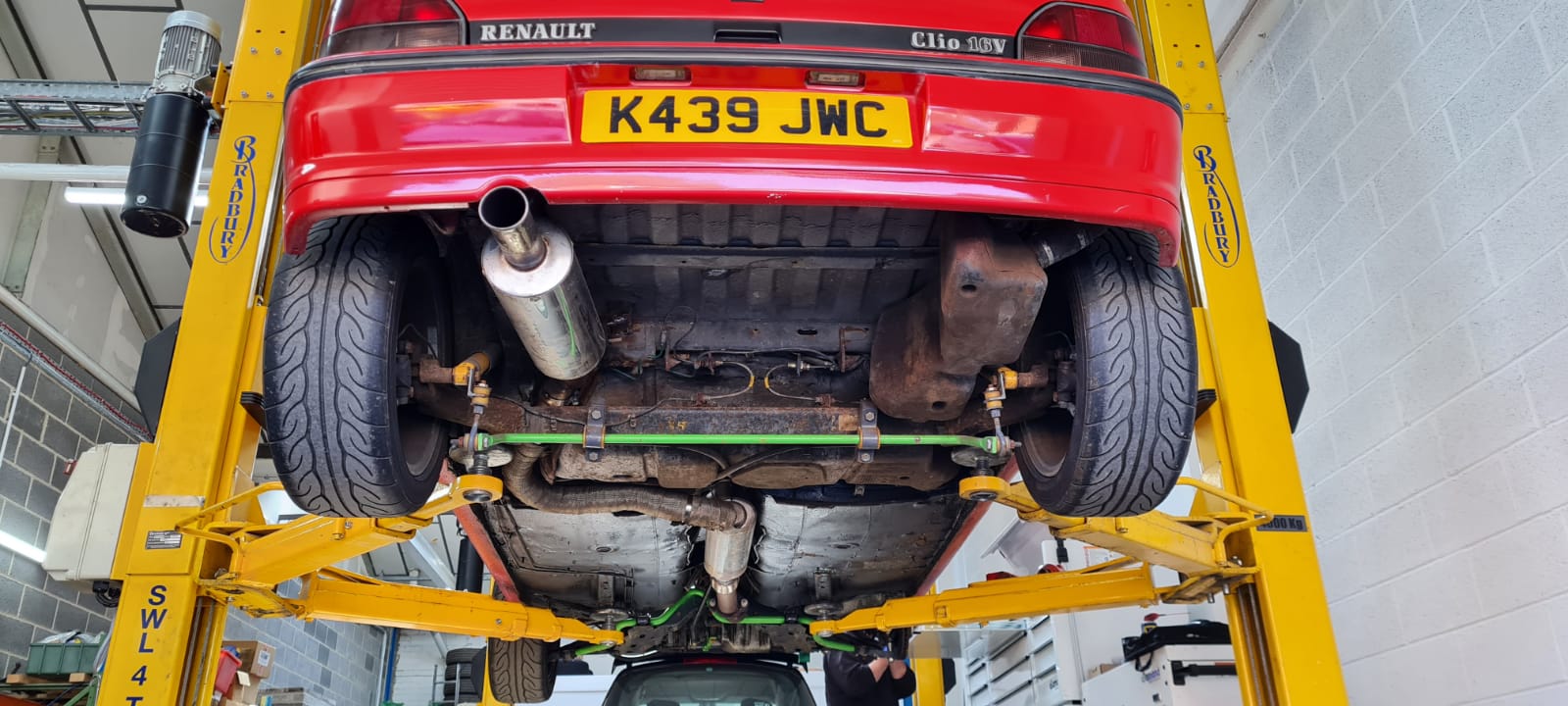

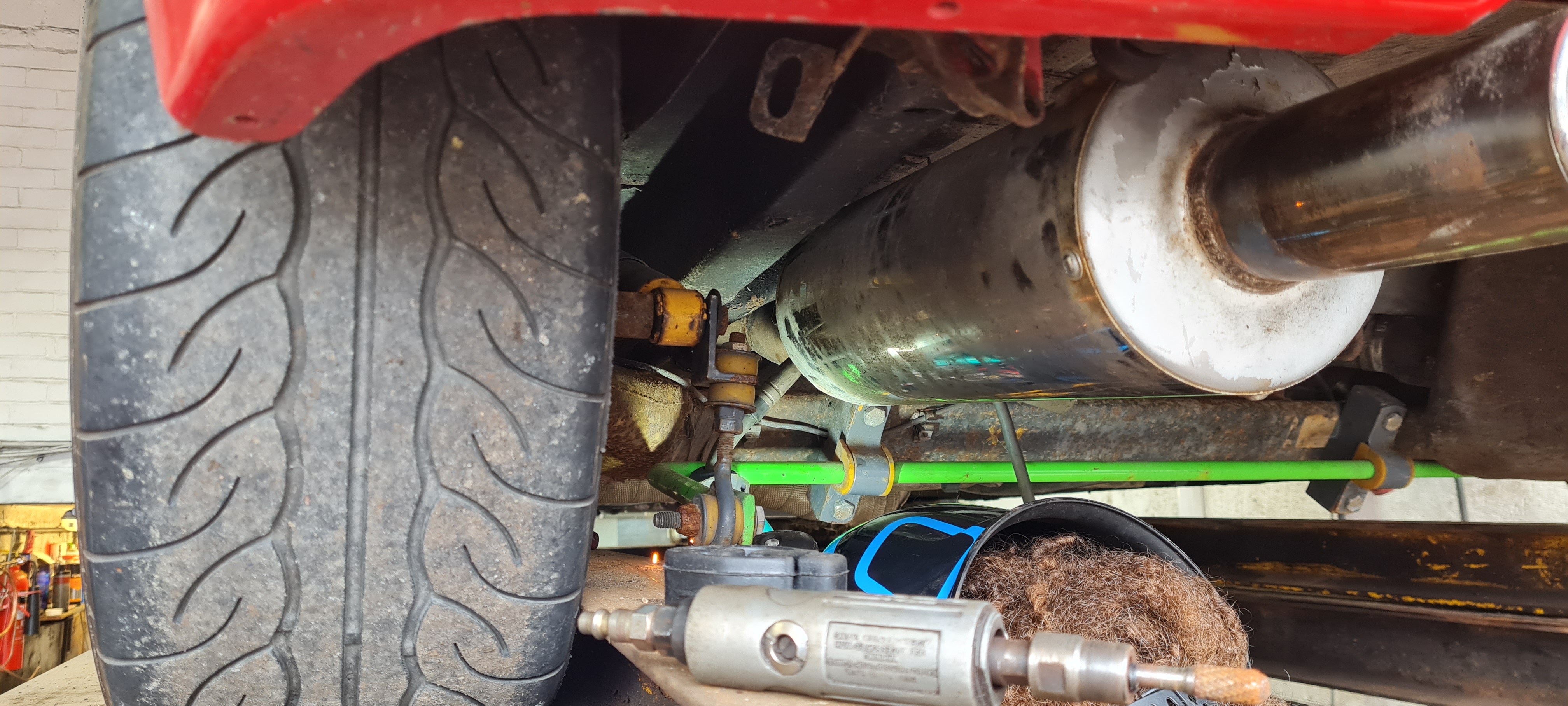

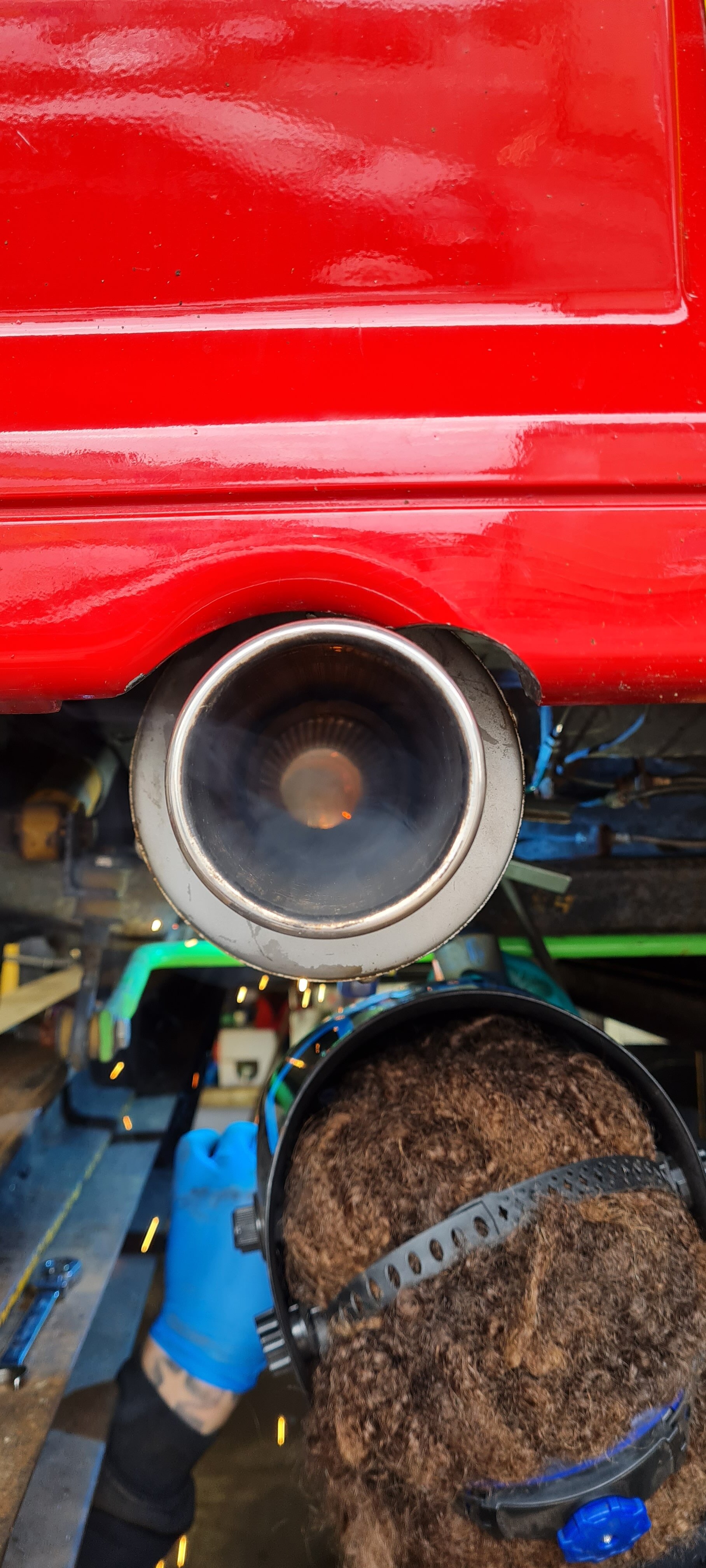

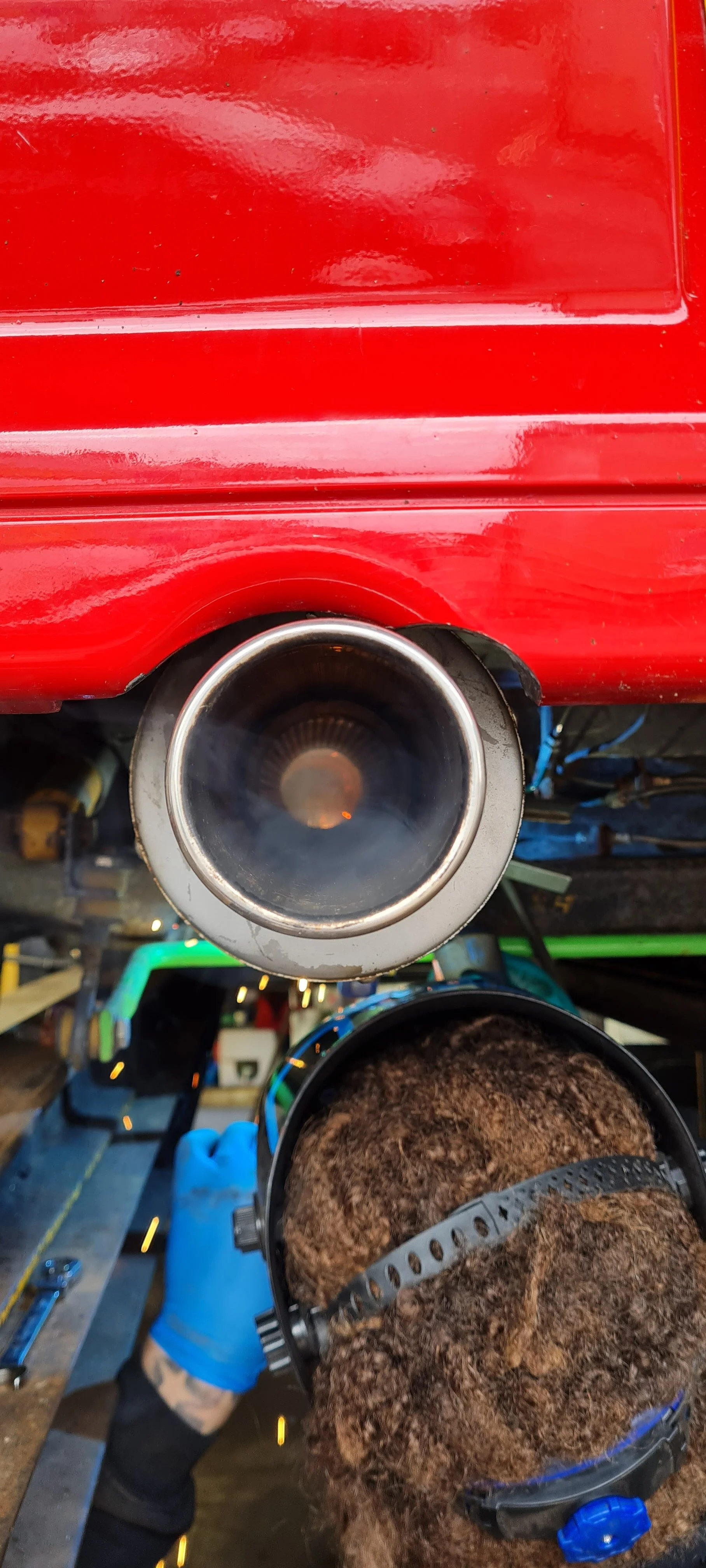

Exhaust fixing day today, the current system is much quieter than the old mongoose but had never fit right.
So hour or so with the gringer and welder and mate Dan had it fitting much nicer, it'll do.

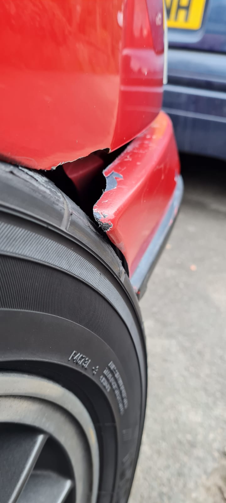

Bumper is melted from where it twisted last trackday so that's yet another battle scar to the smorgasbord!
Geo next to remove some camber and toe it dead straight I think initially and see how she goes.
MOT passed so all good from that side too.
Felt great to be back it in the car and after driving nothing but stock f4r's for months and months, this thing is f**king lively! Roll on Mallory Park in May!

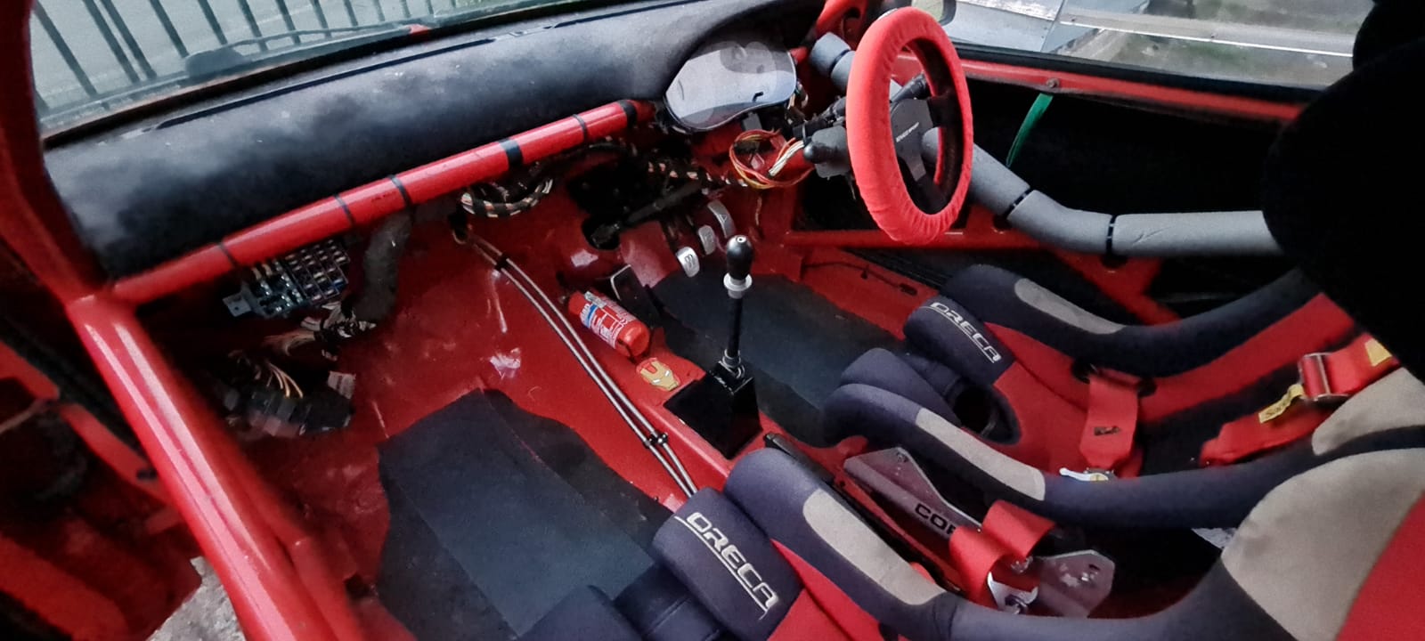

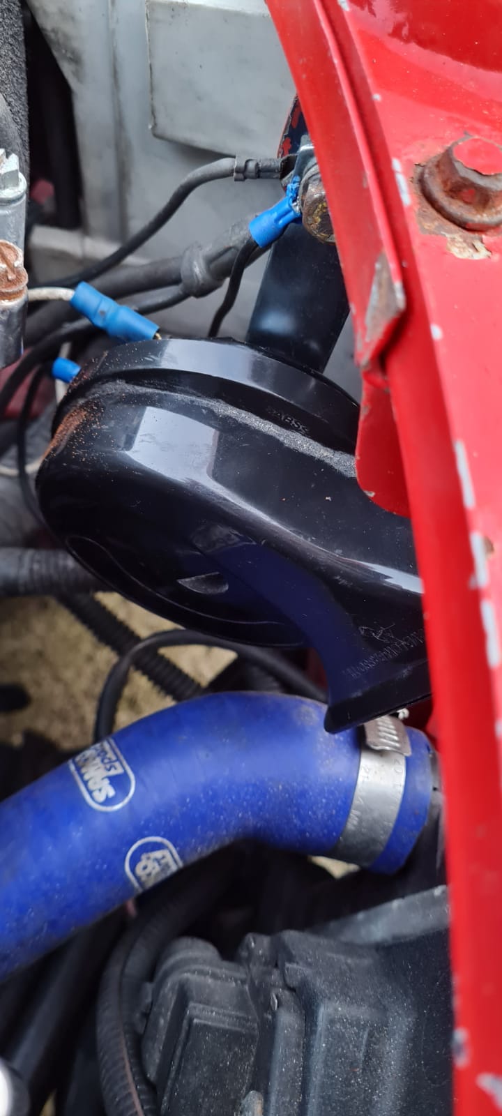

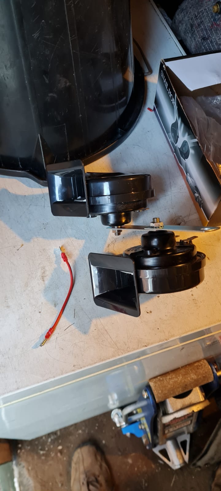

Couple more niggles ticked off, carbon sleeve fitted to the PMS shifter, mat centres replaced with dark grey over the green (so 2012) and new horn fitted to headlight area instead of in wheel arch

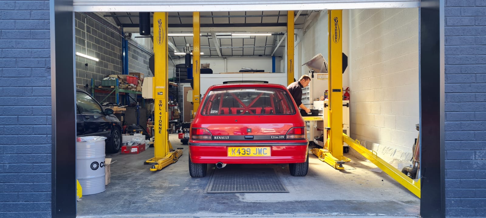

Geo booked at a local place for 7th
Coops Mk1
  Lots of Scrap...

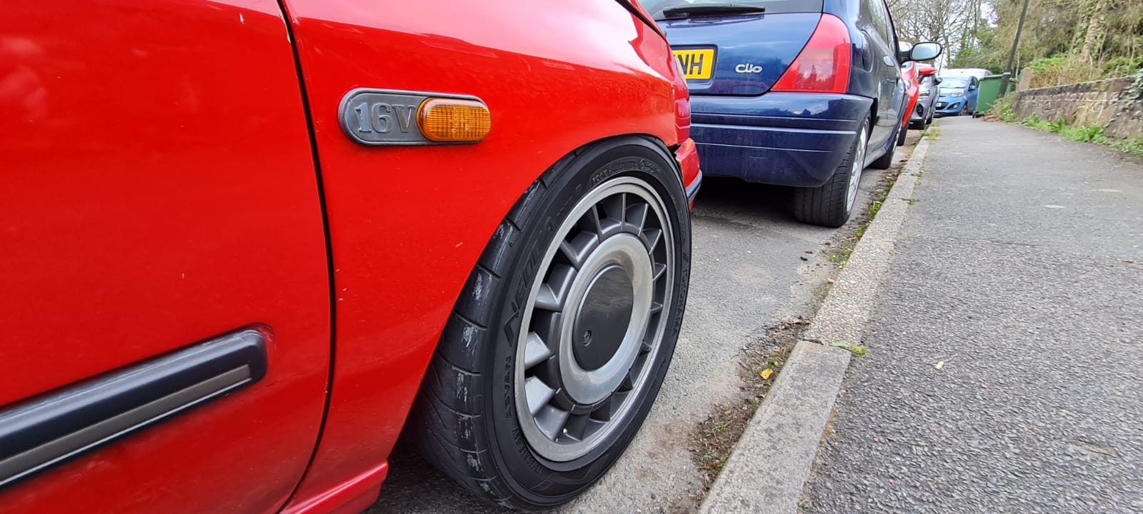

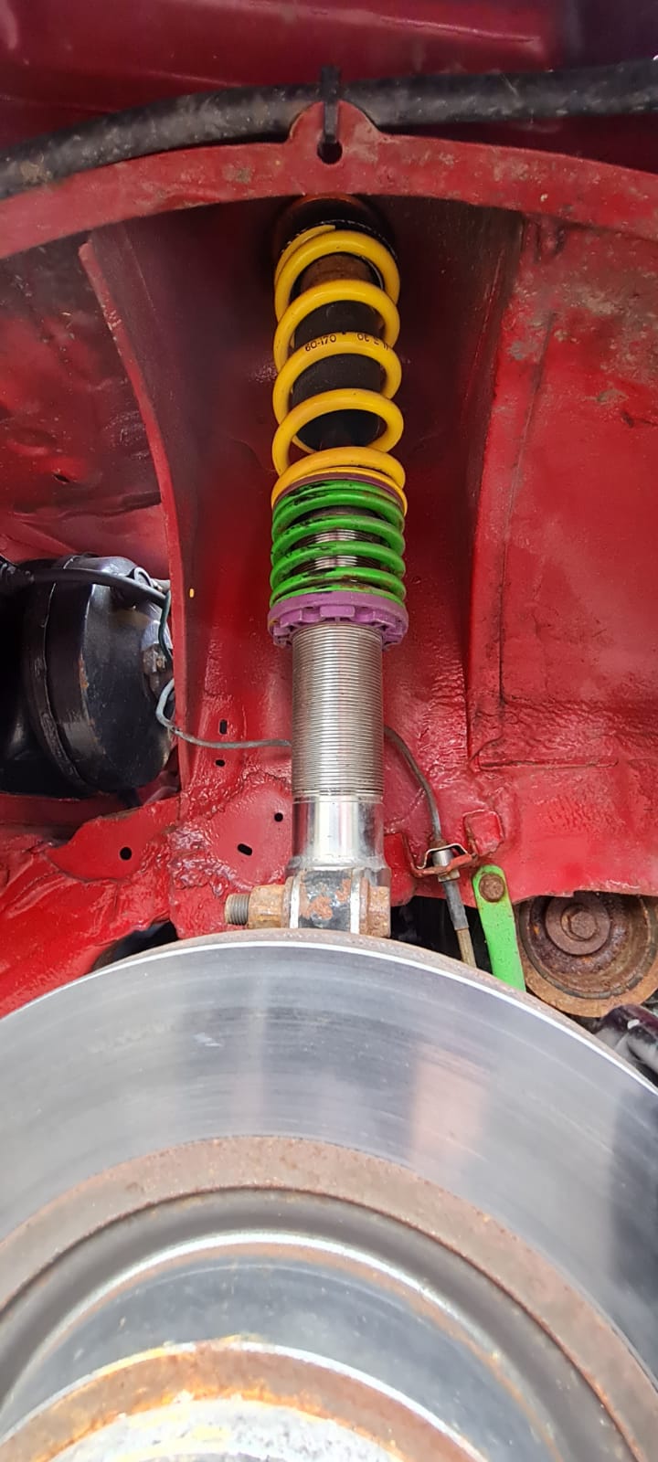

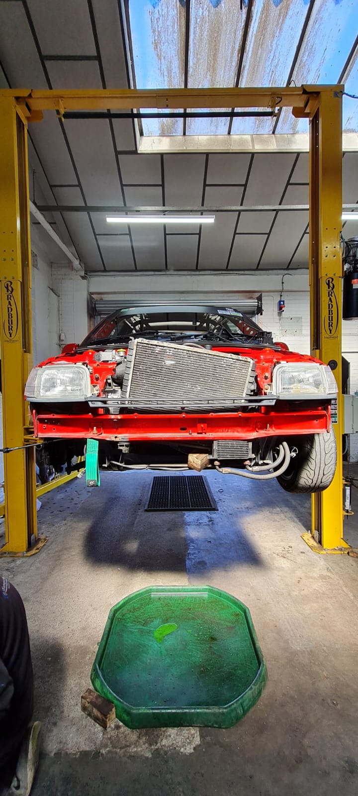

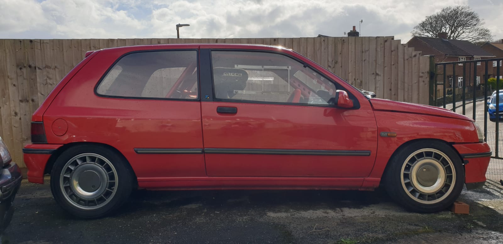

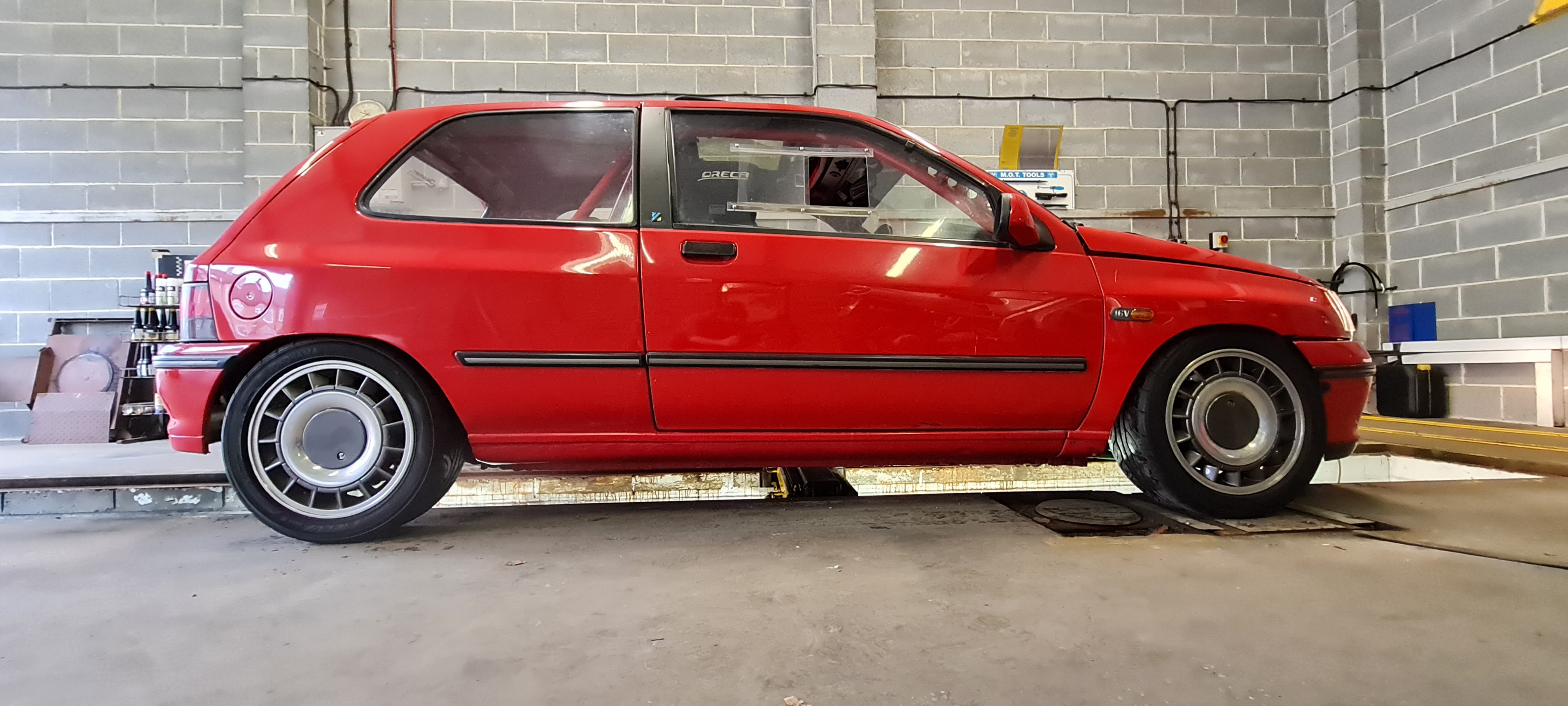

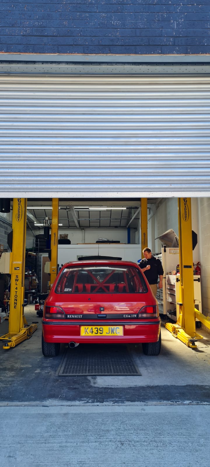

Raised the drivers side by 10mm to level it across the front axle and then sent to local place for geo.... Bit of a fight with it as my dremel spec coilover bolt slots weren't exactly analogue in their adjustment plane.... But all good, got 2 degrees neg and 10 mins toe out dialled in up front and rear was within standard spec so for none adjustable axle all good.
And now it doesn't try to kill me when I drive it which is nice

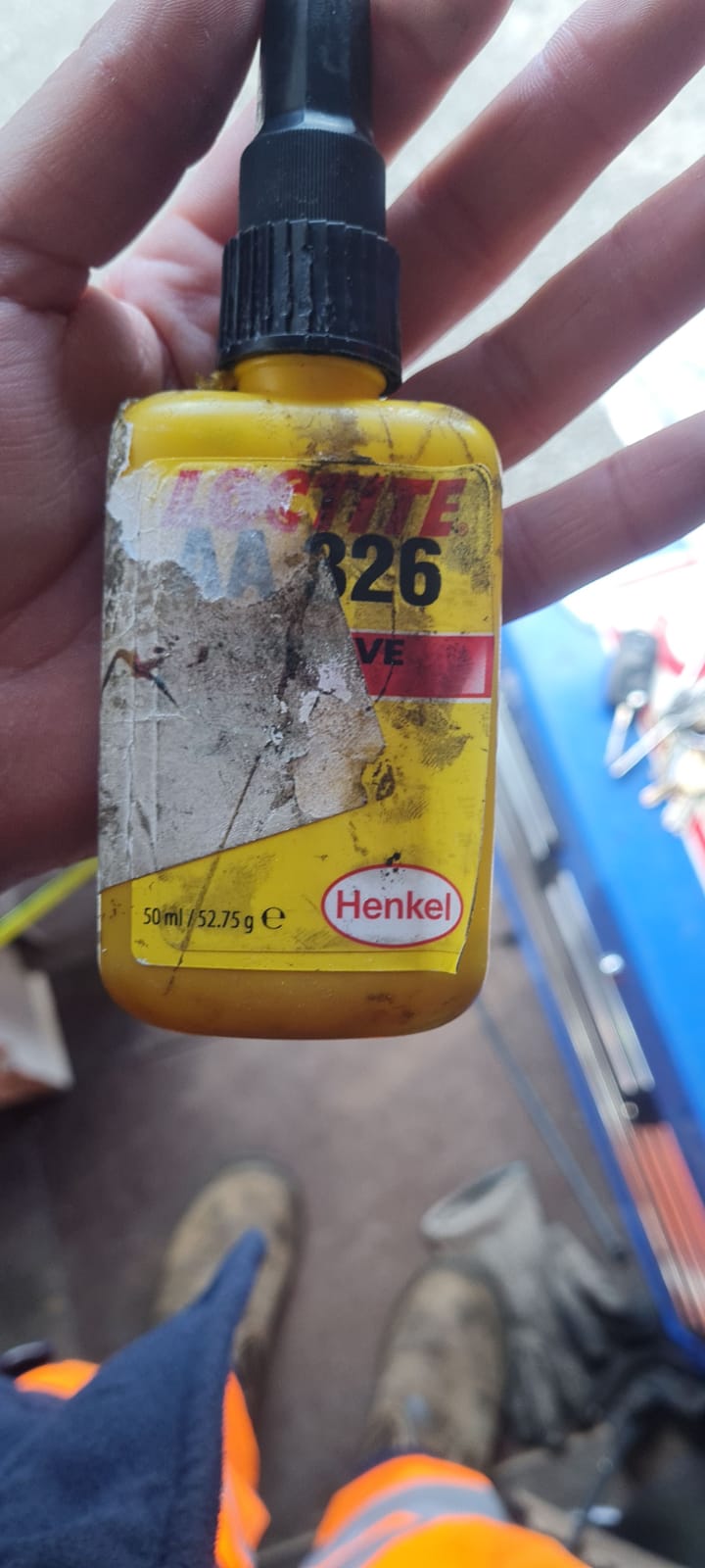

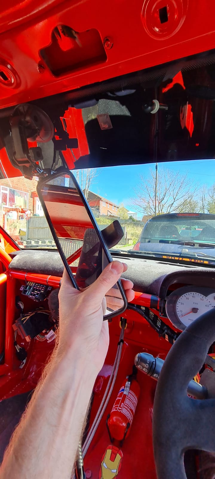

Also had small fail on the rear view mirror so that's having the bracket re glued overnight tonight with some loctite 326.

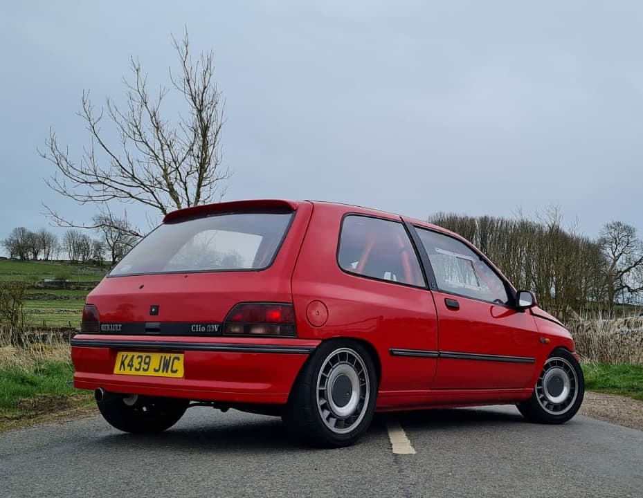

Just been using the car really now, so odd to look back over the thread and always a big job to do or issues, now I'm just jumping in it to grab milk or run to the office on the days I'm in. It's just brilliant to be out and about in it.
Nothing major left to do before Mallory, fitted standard wiper blades... Oh wait one big job, aux belt pulley looks gopping so booked in with @MicKPM for new one to be fitted next weekend.

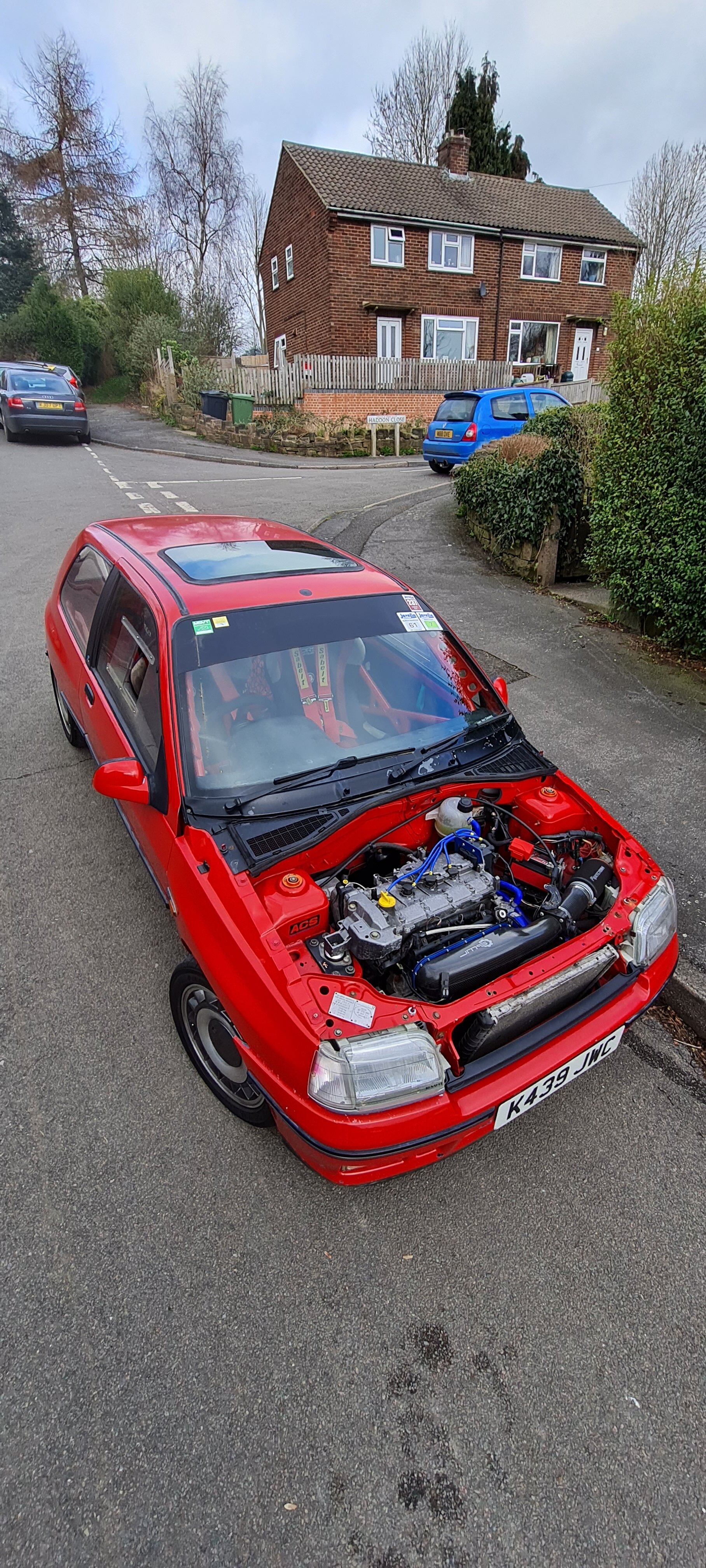

Anyway couple of pics of her looking imo the best she ever has, even if the bodywork up close is getting rougher and rougher. Insta ready though still and let's face it that's all that matters! 🤣

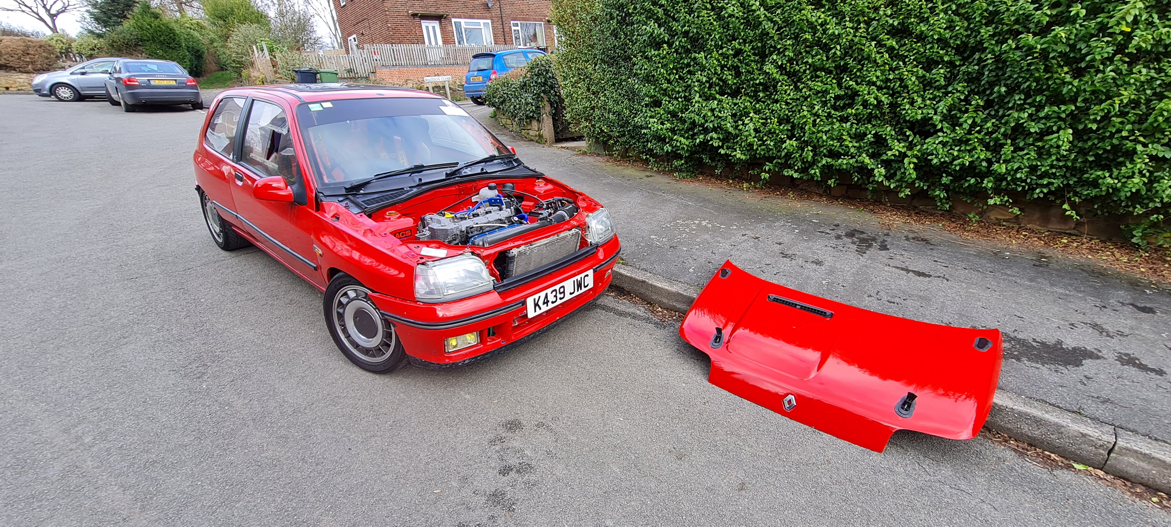

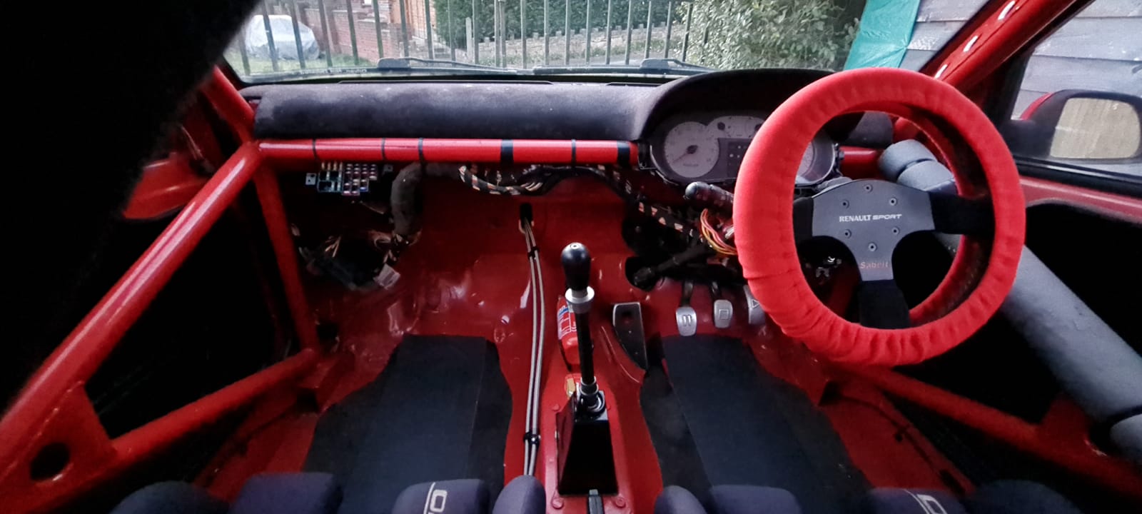

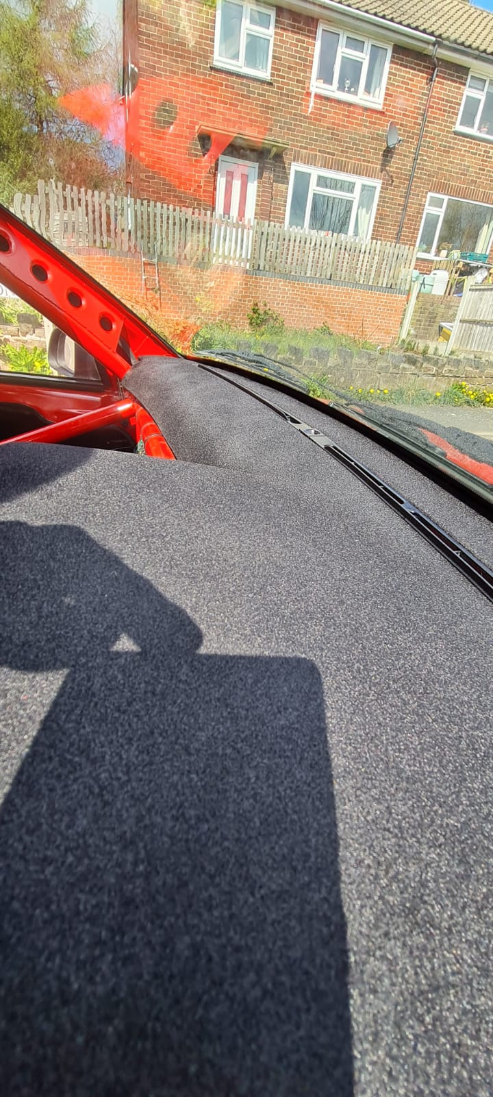

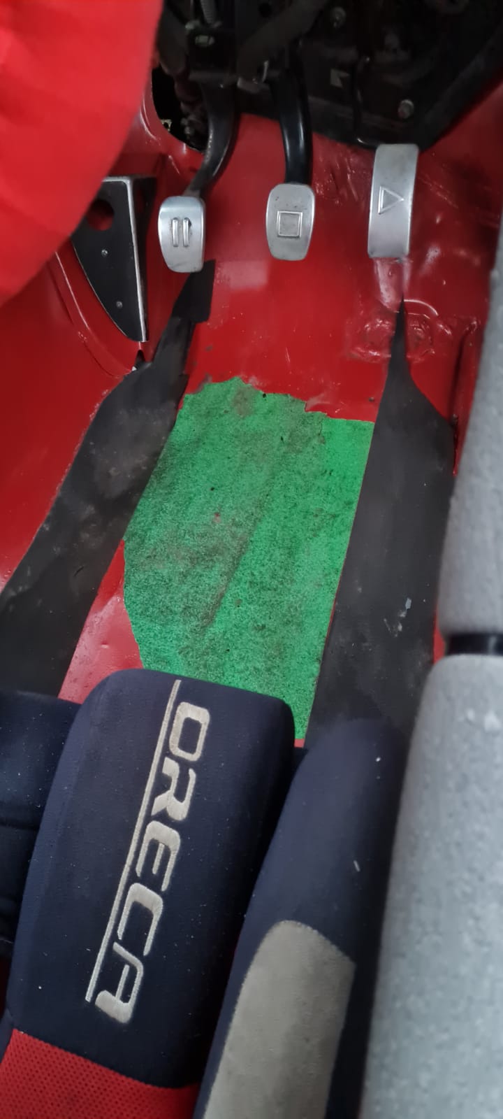

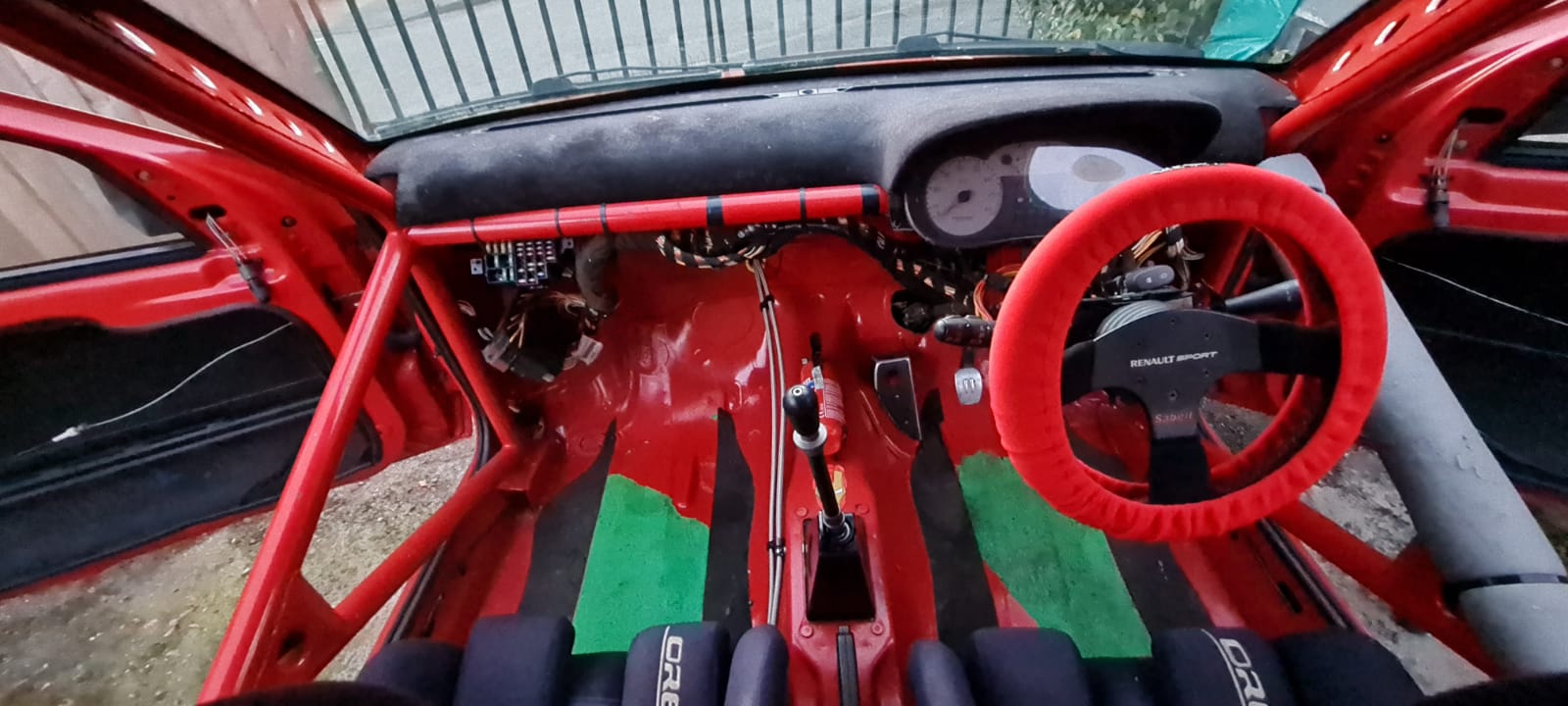

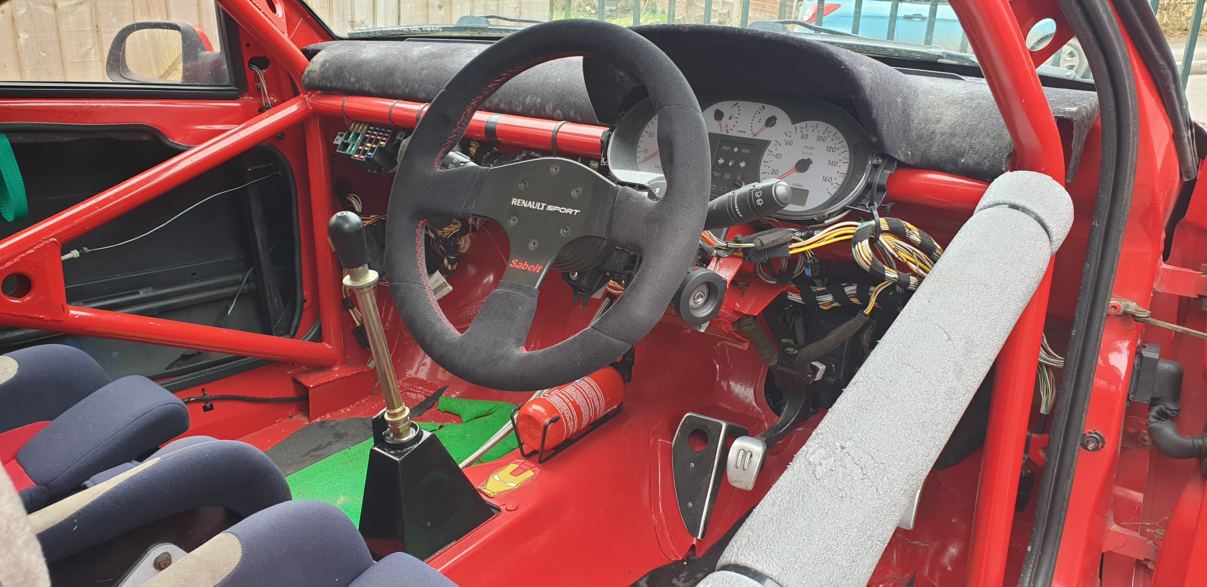

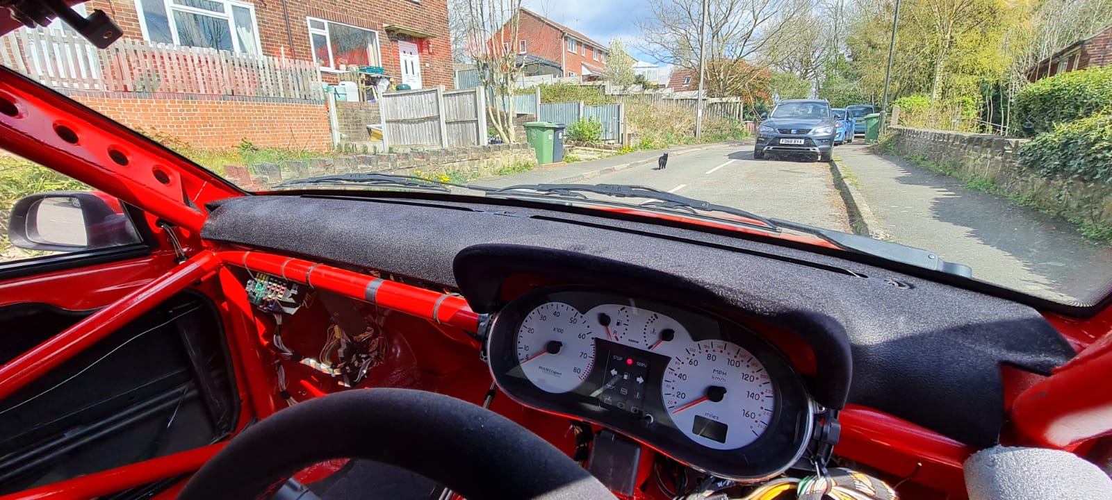

Fabric painted the flocked dash top as it was looking tired. Still patchy any needs doing again properly really but looks less terrible now.
Reorganised the wiring a little too, just made it all a little bit neater.
And now annoyingly it's developed a misfire so will be chasing that out tomorrow hopefully.

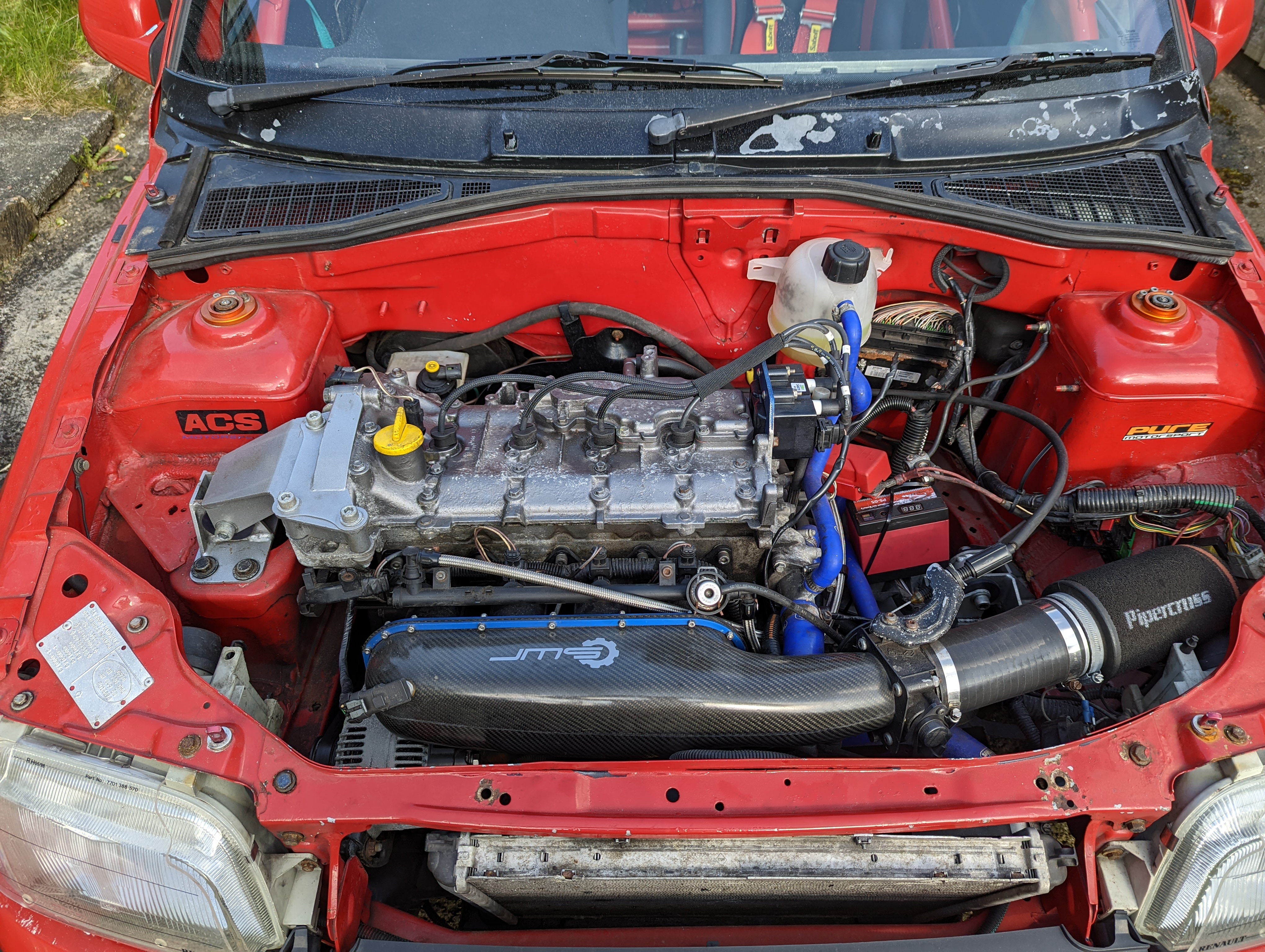

Misfire cured, was the crank position sensor so fitted a used spare for now. Ordered new blue style genuine one with the repair loom too though so will fit that when it arrives

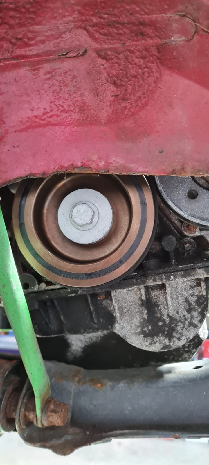

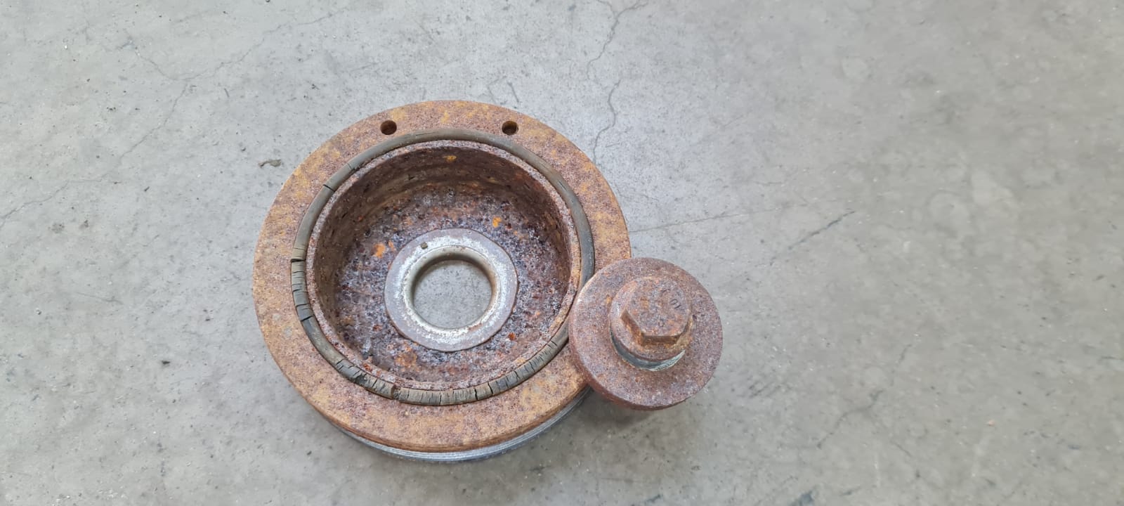

Up to Mick's today to fit new aux pulley as the old one has seen better days. They're seems to be some reports of these failing now as they're getting older so to be it's a no brainer to swap out for piece of mind.

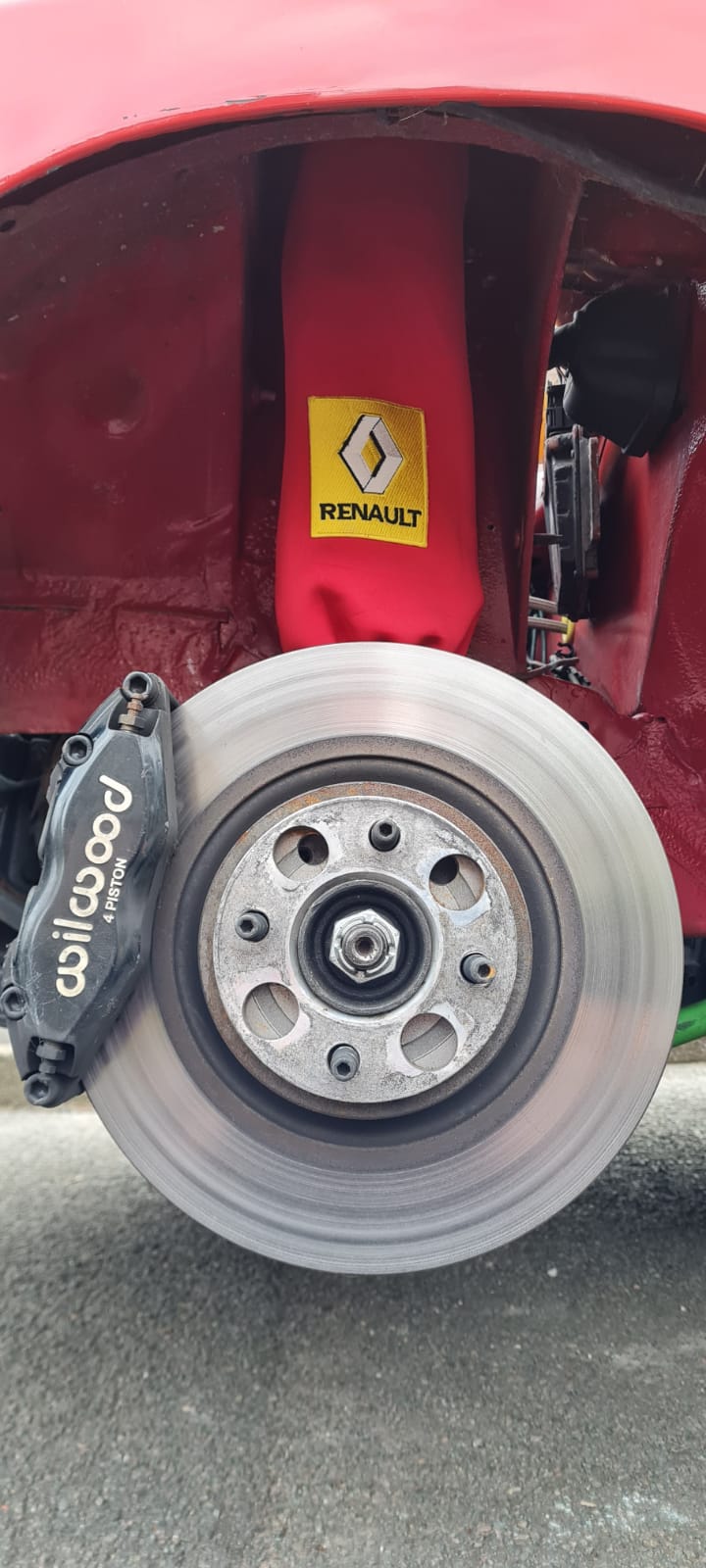

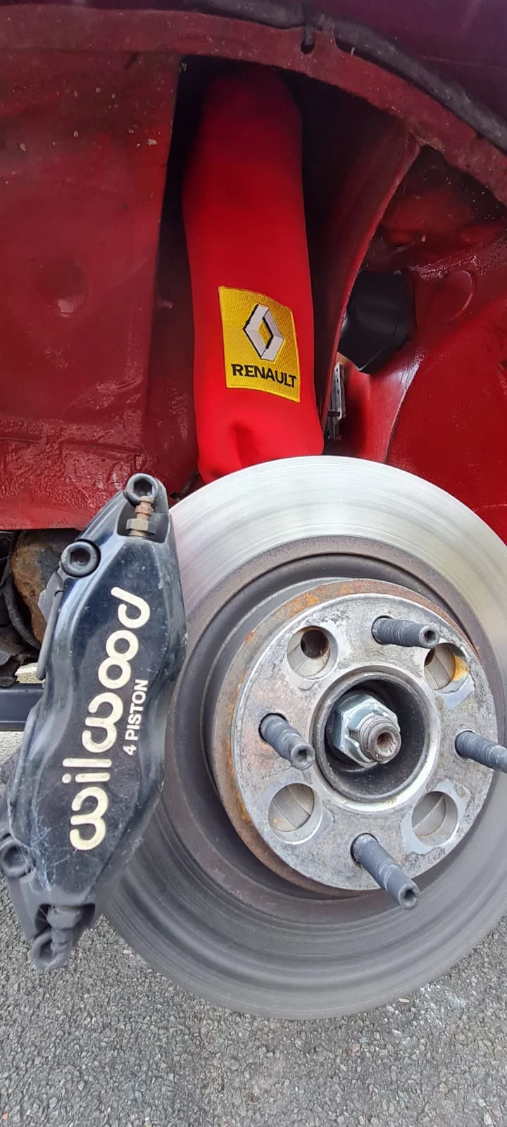

Brakes squeal like a bastid so I've ordered some Mintex 1144 for road use, hopefully that'll make it manageable.

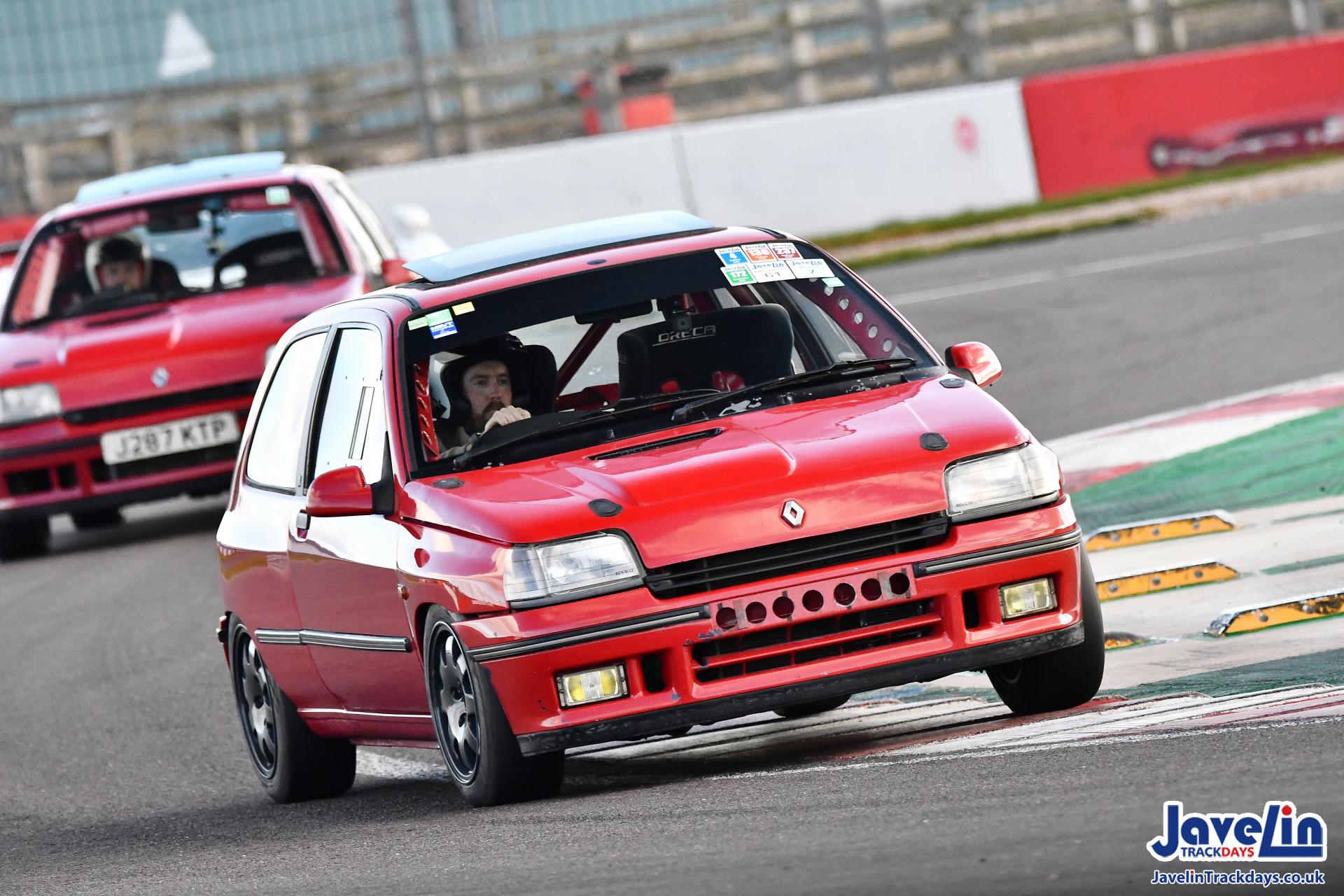

Epic day yesterday at Mallory, for now quick pic of the car in road and 'race' trim and link to YouTube video of a few laps including dice about with my mate Dan in his Red F4R powered mk1.
Car handled a peach, so happy it's back performing as it should. Just need to start trusting my brakes again and cure the little misfire. First time in ages used the gopro too which was nice to capture some footage.

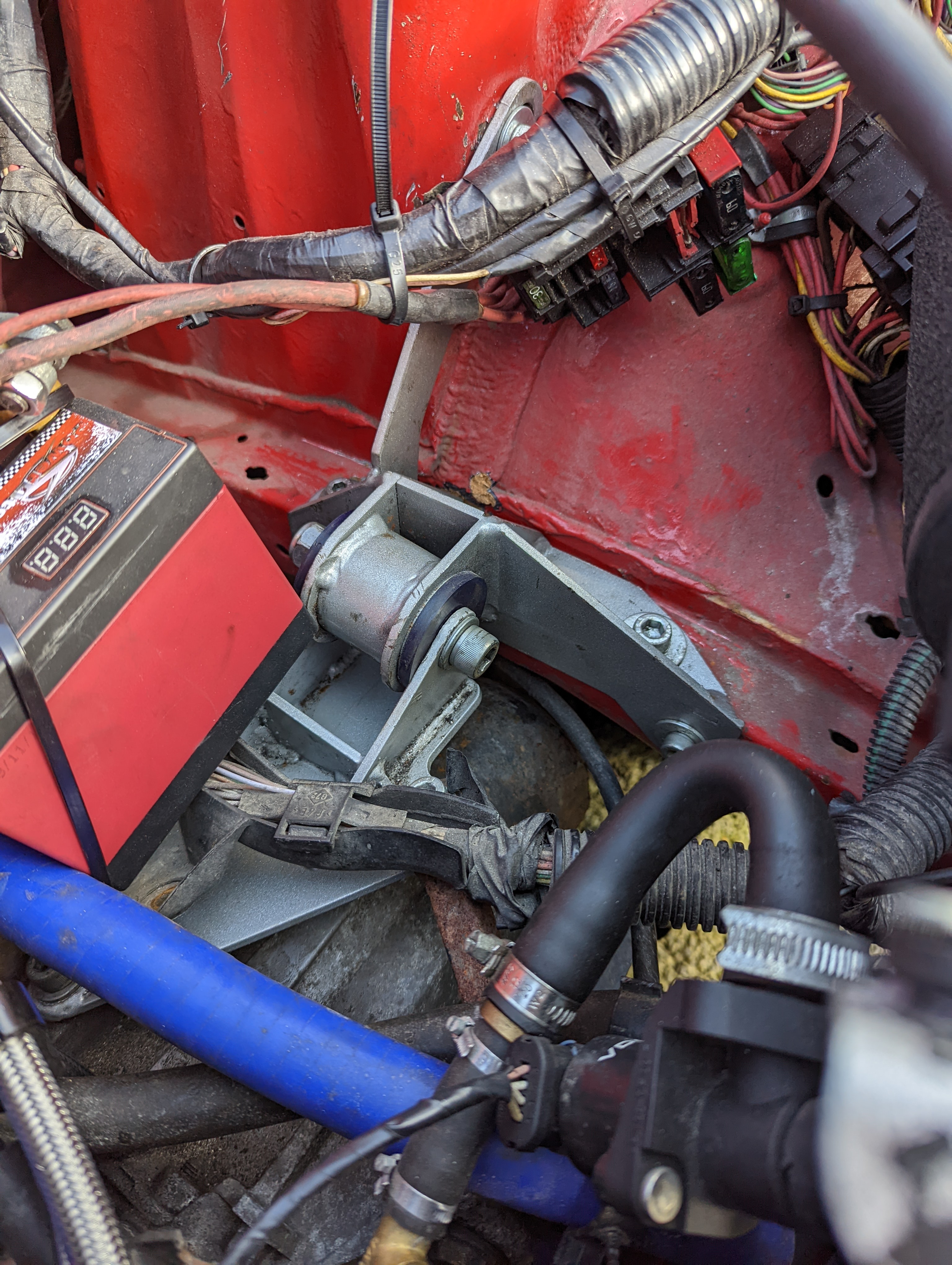

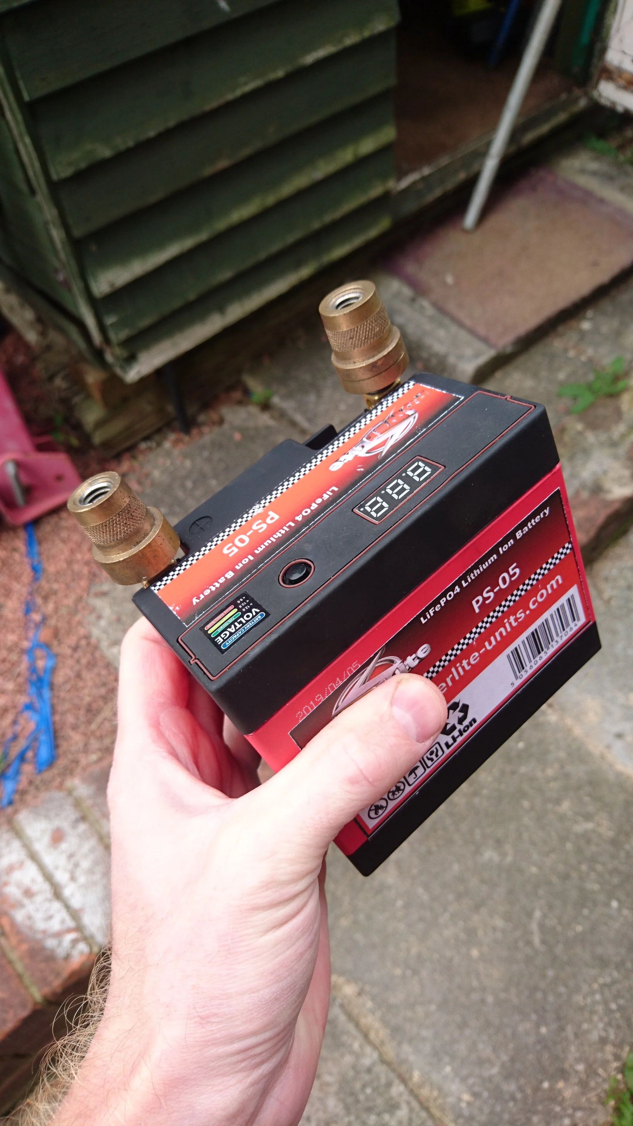

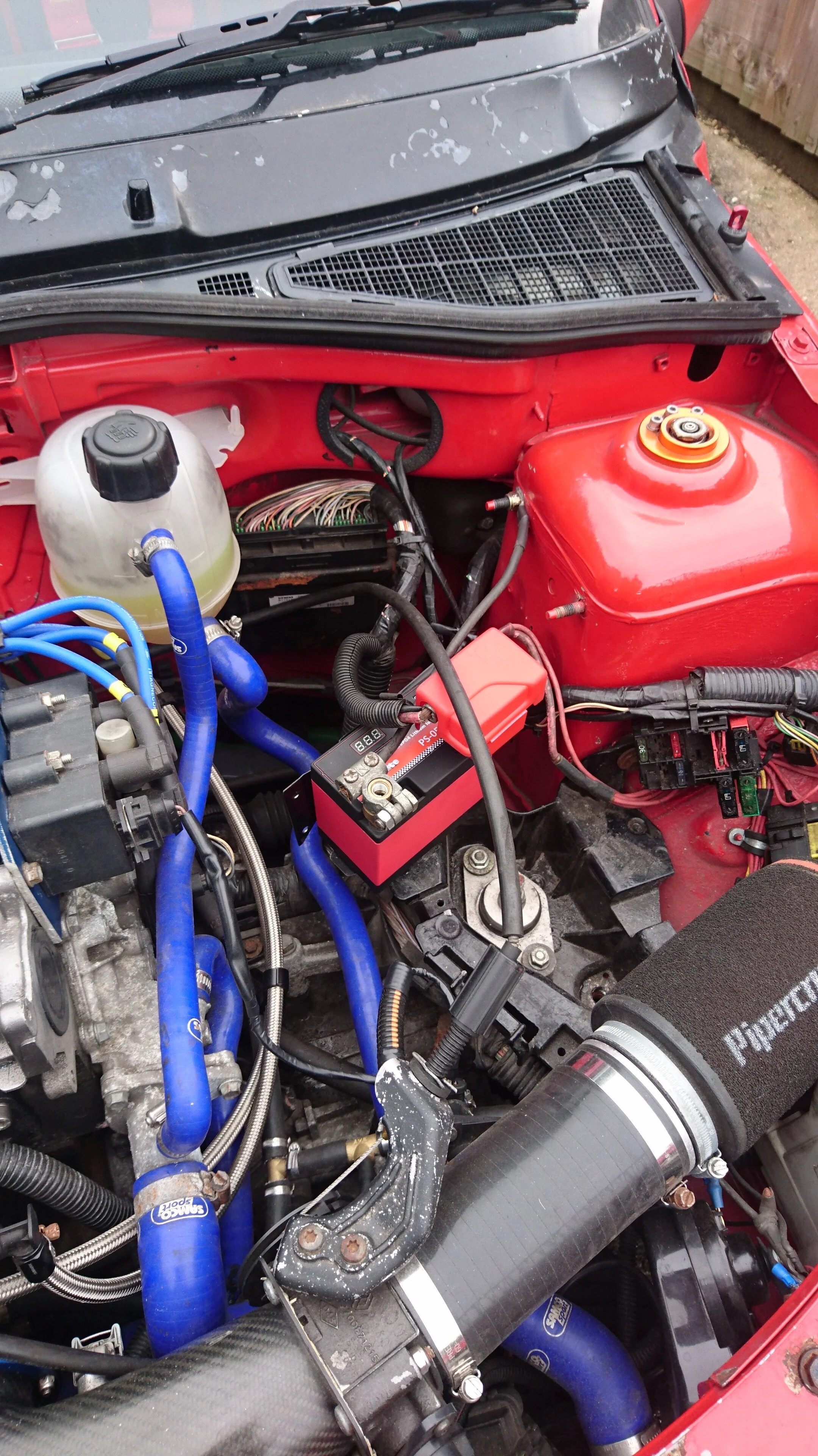

After my powerlite ps-09 died on me recharging off the car using the supplied charger about three months back I got a pair of replacement ps-05 under warranty from powerlite direct. They didn't have the larger battery in stock to exchange.
A note on customer services here, Julian at powerlite was superb throughout, honoured a warranty despite me sourcing the original battery through a reseller 18 months previously and went out of his way to ensure I got what I needed. Lesson here for many many other suppliers, that is how to handle customer service.
Anyway into the battery itself, the old ps-09 was fairly silly at 1.1kg in weight and pretty diminutive in stature, but this thing is honestly laugh out loud tiny. 700 grams it weighs and that's with the terminals attached which aren't exactly heavy but when we're talking such tiny numbers anyway they actually make up a bit of the weight and as you can see are comedy huge mounted to the little ps-05.
Looks even more amusing in the bay for test fit and fire up.
Car hasn't been started in about two months..... Cranked over like a boss and started instantly..... Absolute madness what a lithium battery can do.
I'll get a picture of it fully fitted with the cage, which is alas for the old ps-09 so will need to Heath Robinson it a bit to work with this ridiculous thing.
Cadwell park 24th so I'll put it through it's paces then and we'll see how it performs.

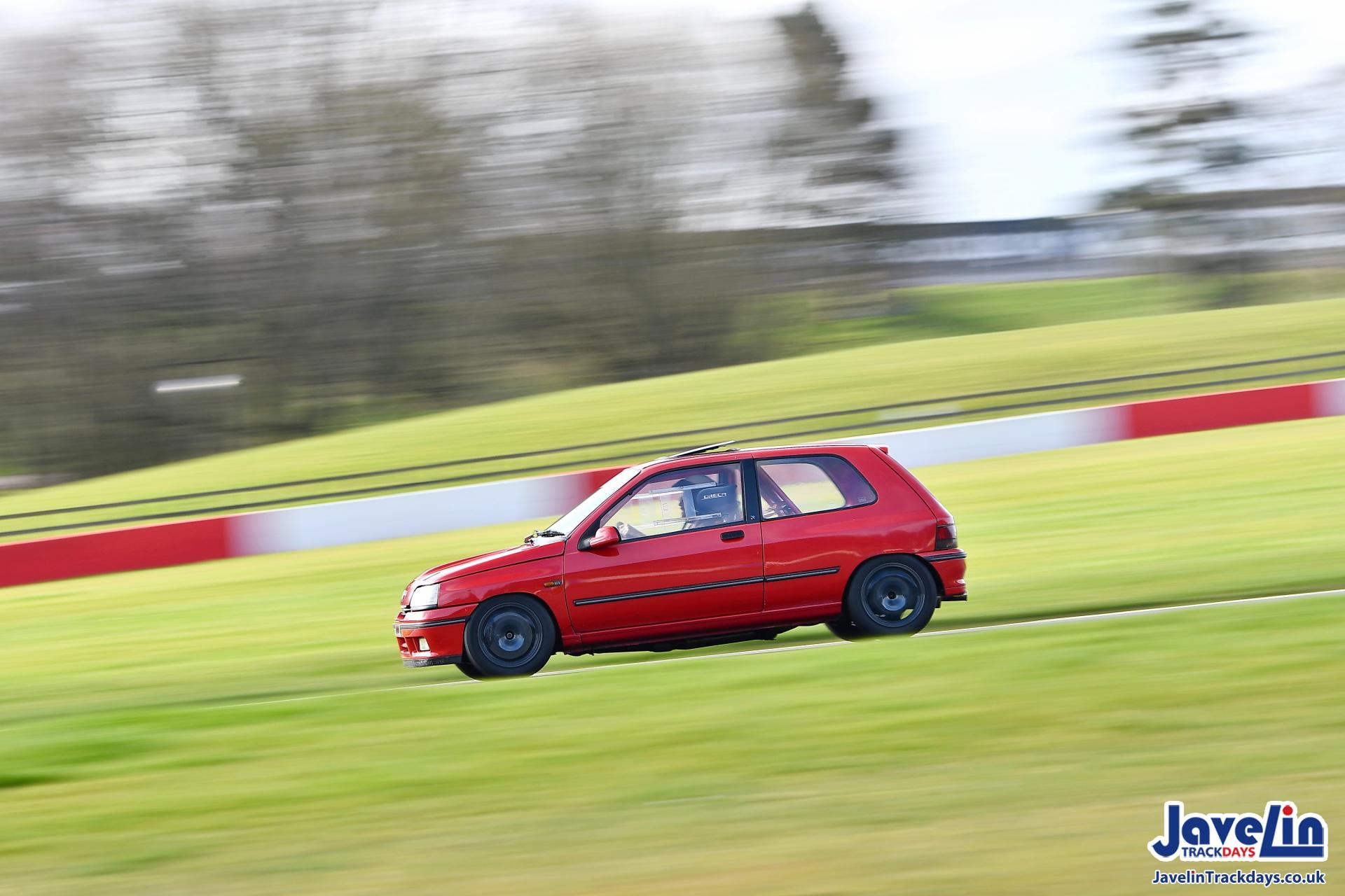

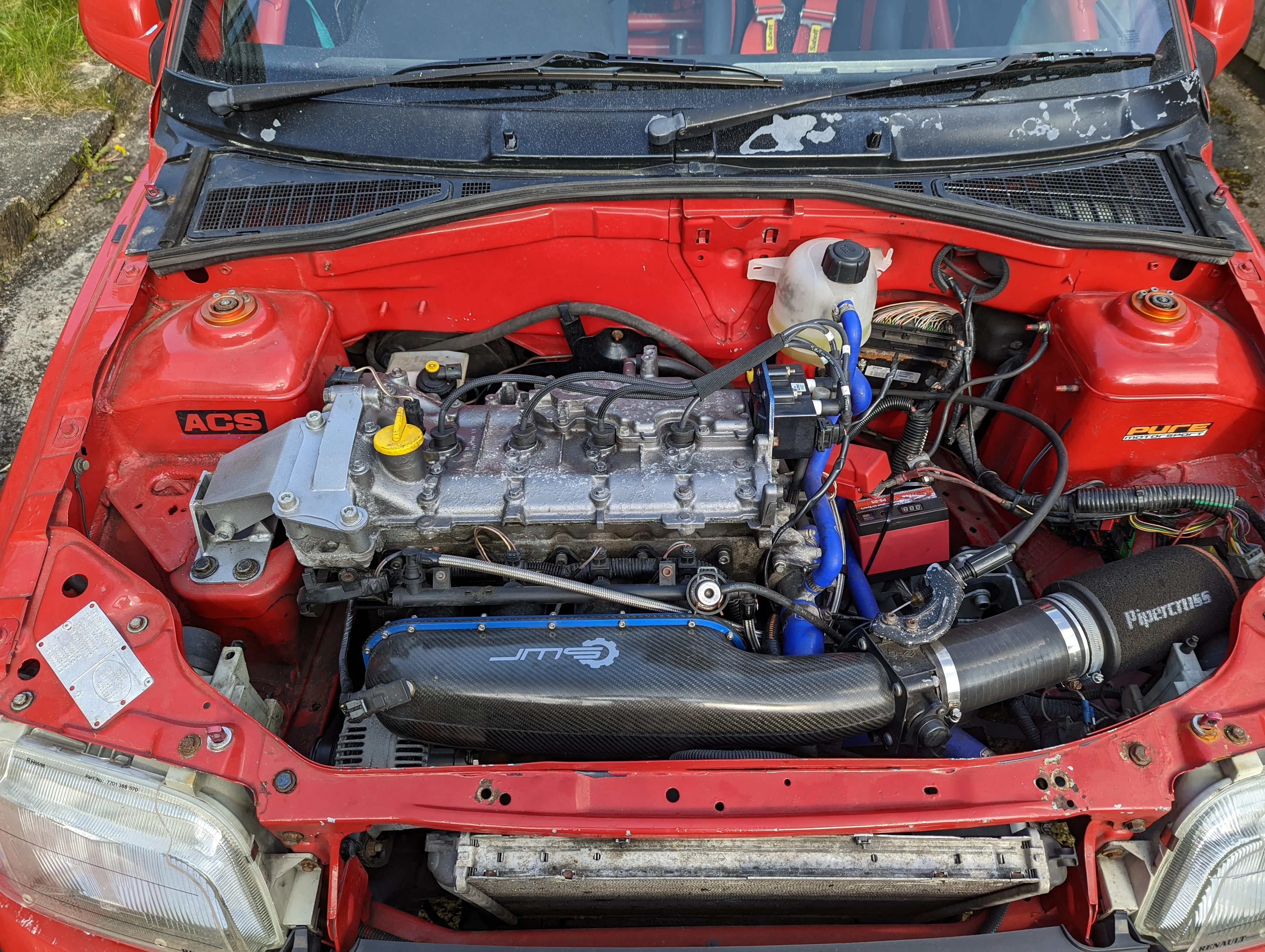

Okay quick update, already done one trackday this year and I've put the odyssey into storage to concentrate on using this thing more. So first one was Donington last month and car was superb, couple of niggles with brakes but since then I've flushed new fluid through and got new rc6 pads to fit for the next trackday.

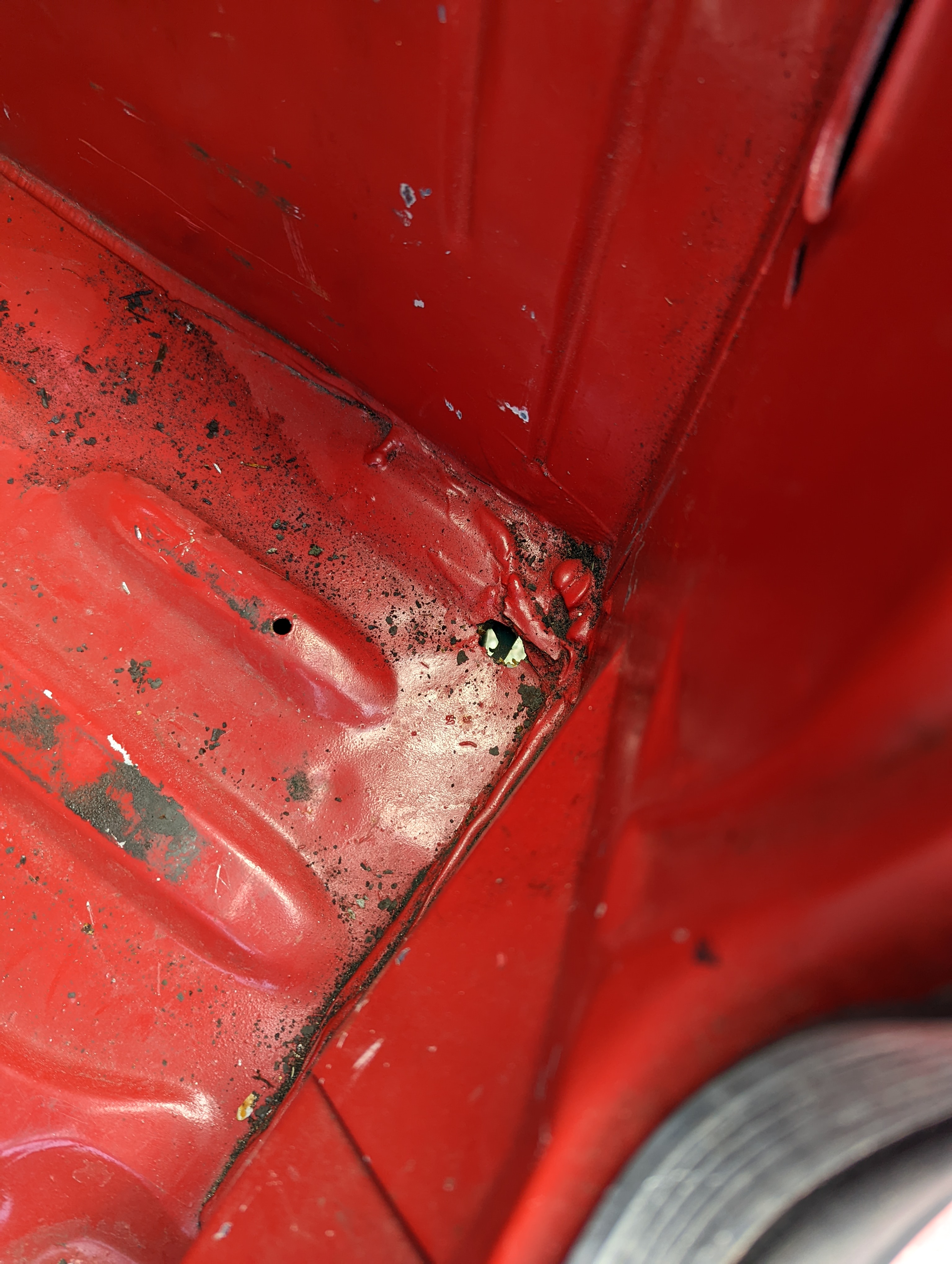

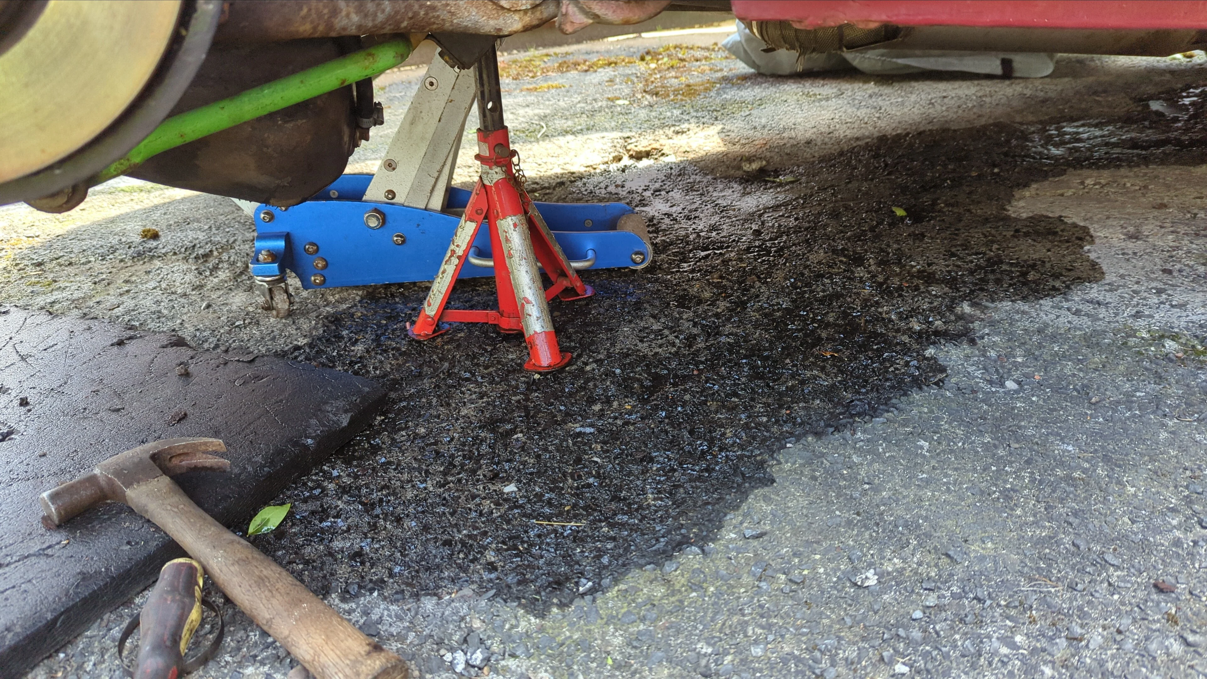

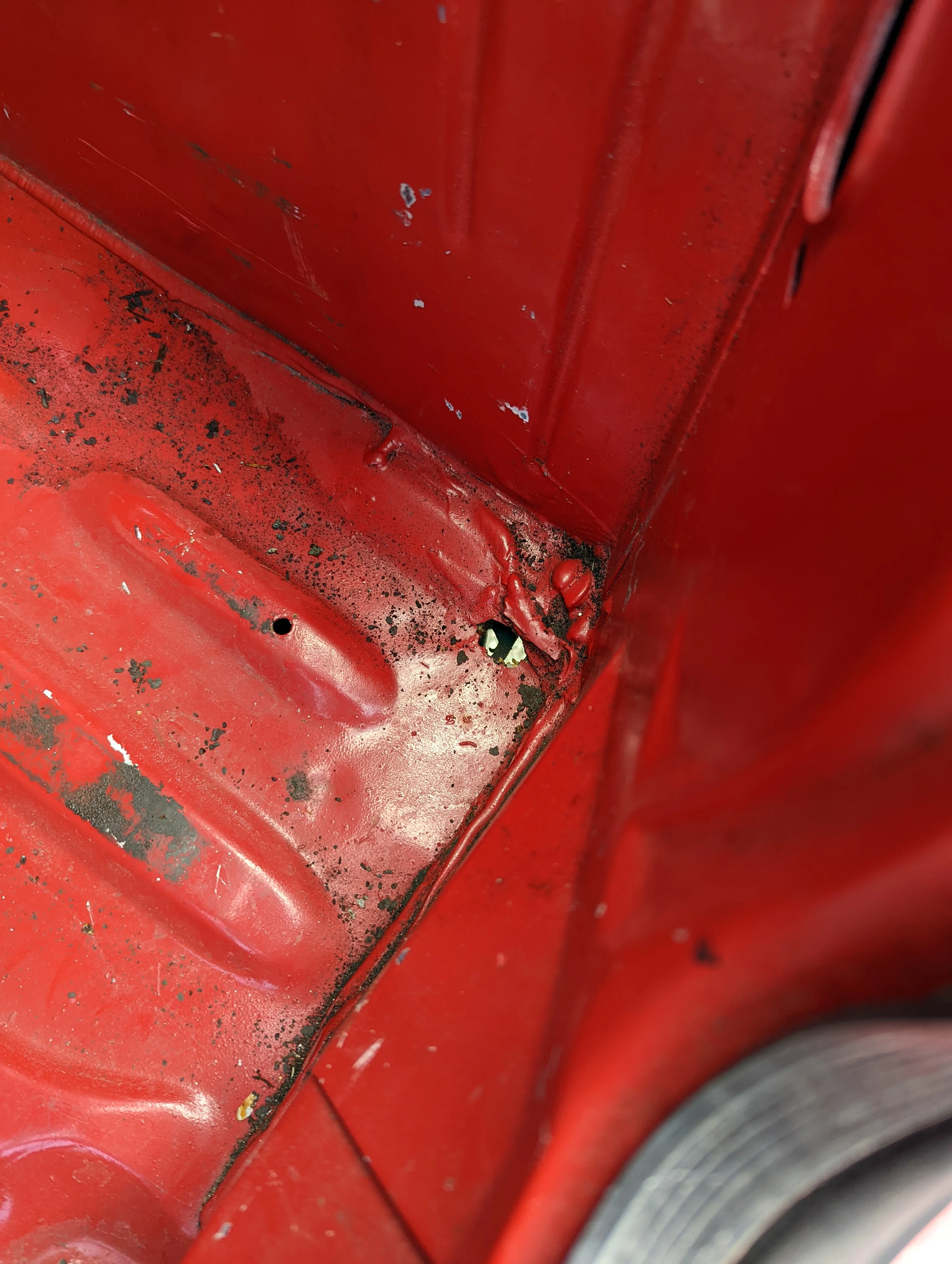

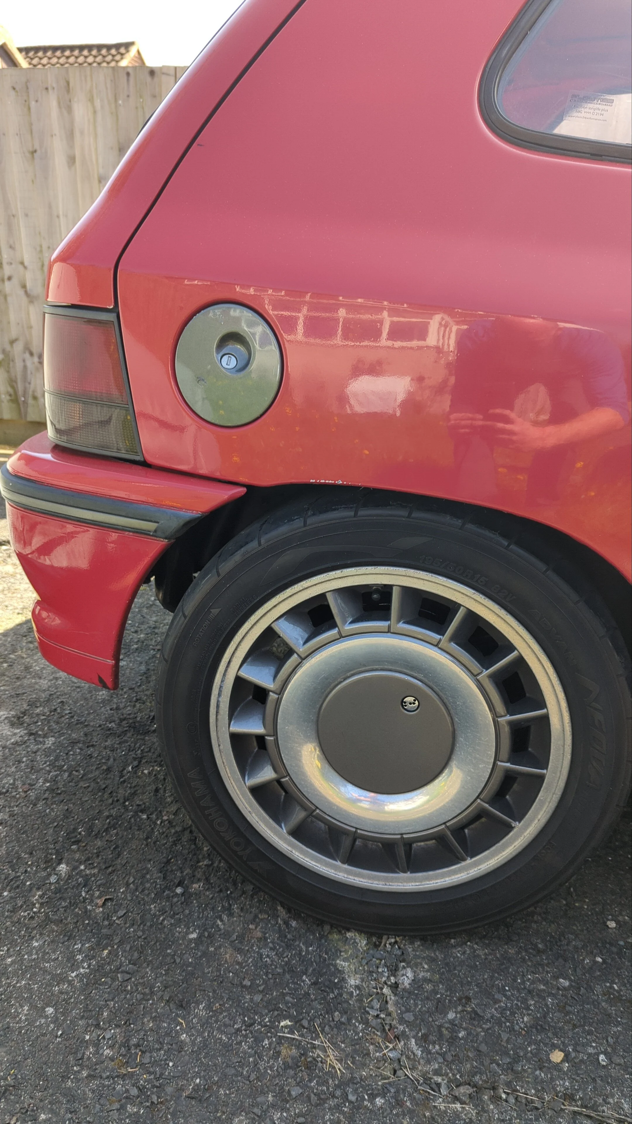

So to fix the fuel leak I've ripped the aux tank off, split fuel everywhere and found more rust, plus the cap is now the phase 2 one from the grey car as they changed the design between phases so I'll need to paint that at some point.
