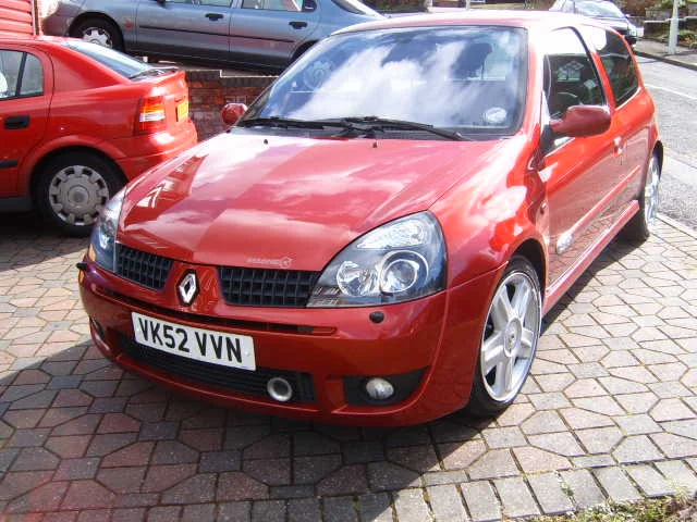

i have a CAF as you say conected to a BMC CDA (sim to a Maxogon).
run the pipe from the grill up behind the headlight and up into the e.bay then its connected to the filter. needed some of this http://www.venairsport.co.uk/index.php?cPath=49to do it as the tin foils type ducting rip to pices in five mins.

Cheers for your help mate. Where did you buy the round bit that fit's in the grille. I want what you have got but not silver!!!

in terms of connecting it up, i totally agree with you matey, the plan with mine was to keep the maxogen open at the end and try and get as much air as possible into the air space behind the headlight for the maxogen to 'suck on' lol
ive left the feed in which takes air from the wheel arch and added the front grill feed to try and maximize the air presence, i think it works ok as i checked that air was flowing up the feed when they put the fan for the rolling road in front of the motor :D
