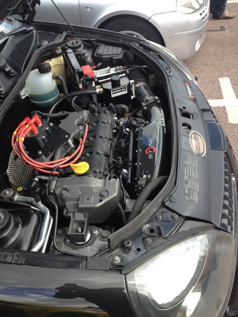

What are RS2's??
Its an inlet manifold mate this is the one on my mrs car:

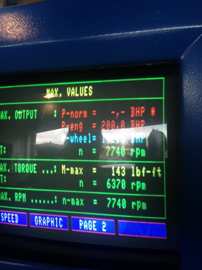

Screenshot from the rollers:
Big boy rpm to be making peak power at.
I genuinely believe if we could rev it a bit further it would make even more, but on standard valvetrain 7800 is about the limit really!
Good result that like. Bet it sounds mint when its going full steam.
Well that was the picture I've just uploaded. But as its been posted I won't bother. Ill post graphs up tonight, left them in my car when I picked a customers car up. Very pleased with the result, and tbh it was only an excercise to see if it'd make or break. I originally hoped for 185, when it sailed past that the target then became 100/litre. Big thanks to Chip for the mapping, Mike for the help on the cams. And TSR for putting up with "French crap" constantly at their rolling road.
