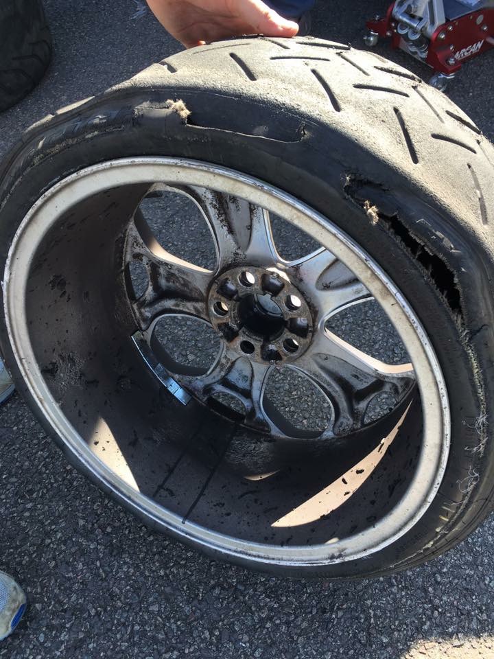

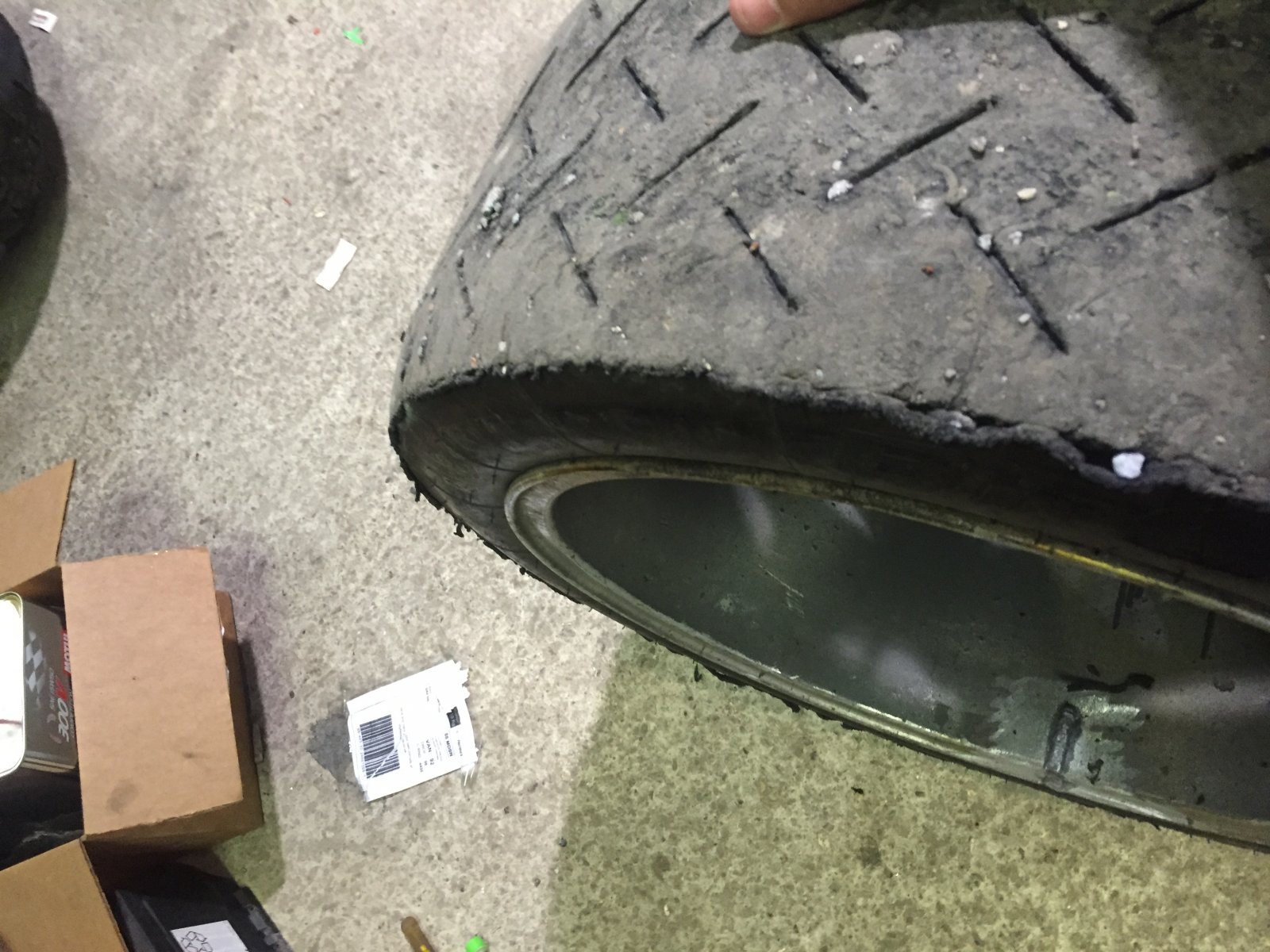

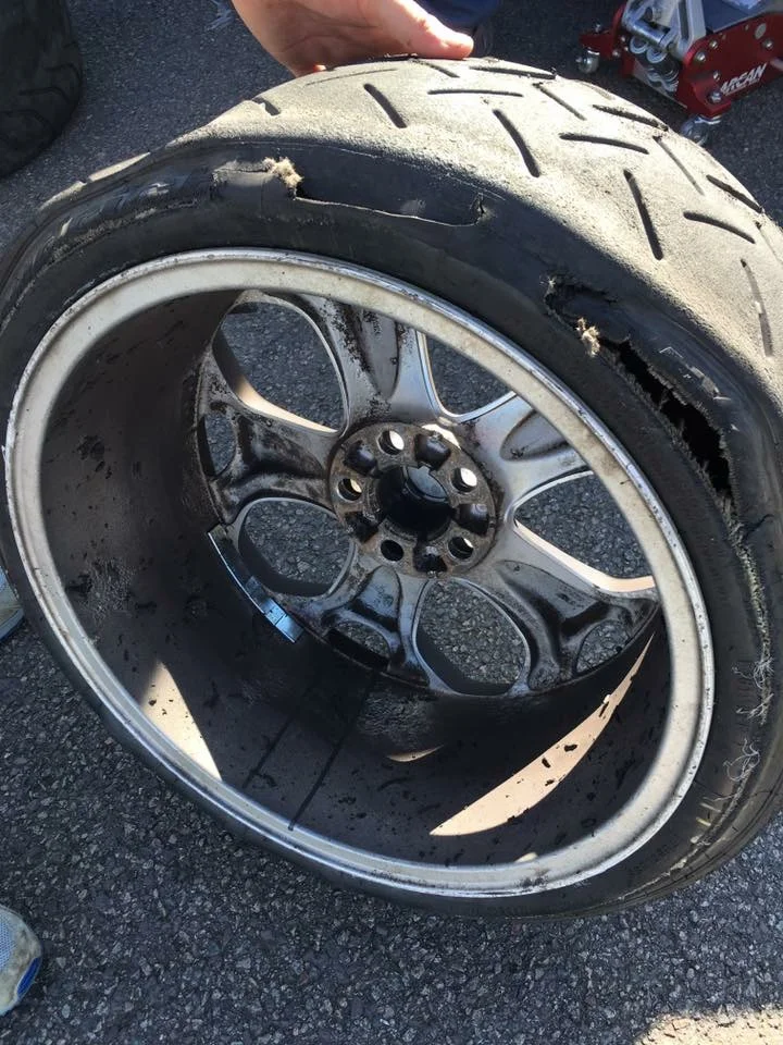

So went to ford fair yesterday took the focus out on some cut slicks I managed to get hold of, was good fun as ever with public track time it was full of idiots that couldn't drive made for some interesting moments! Spent most of my sessions chasing my friend in his 2.3 itb'd racing puma that is an absolute weapon so was good fun right up until a blow out stopped play!

Yeah luckily it went at the beginning of the last session so wasn't too bad timing wise

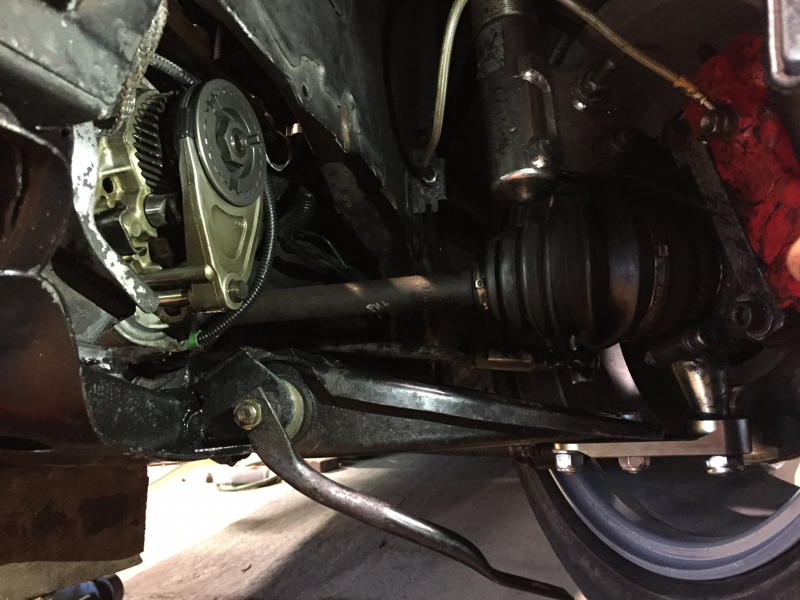

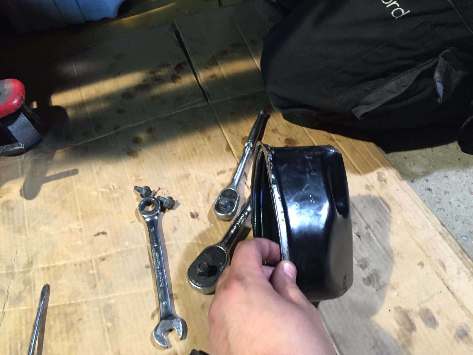

Well managed to get to the bottom of the gearbox leak from Bedford on Friday some of you might of seen it in the pits with oil pissing out of it!
The cap that goes over 5th was leaking I see there is a rubber gasket/seal around it can I purchase this part or isit a case of put it back with a load of gasket sealer?

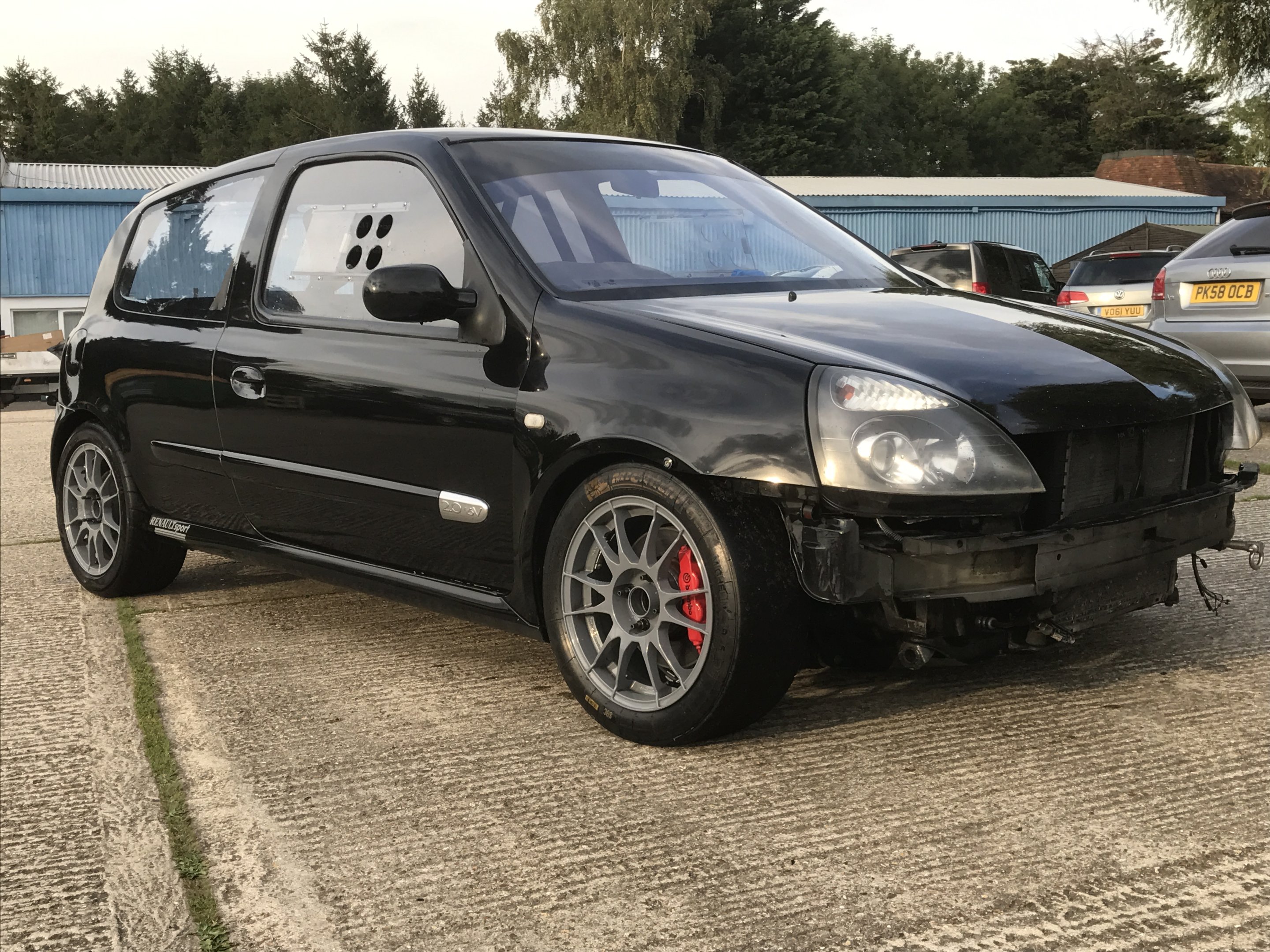

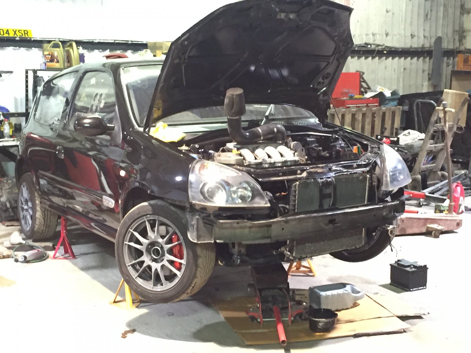

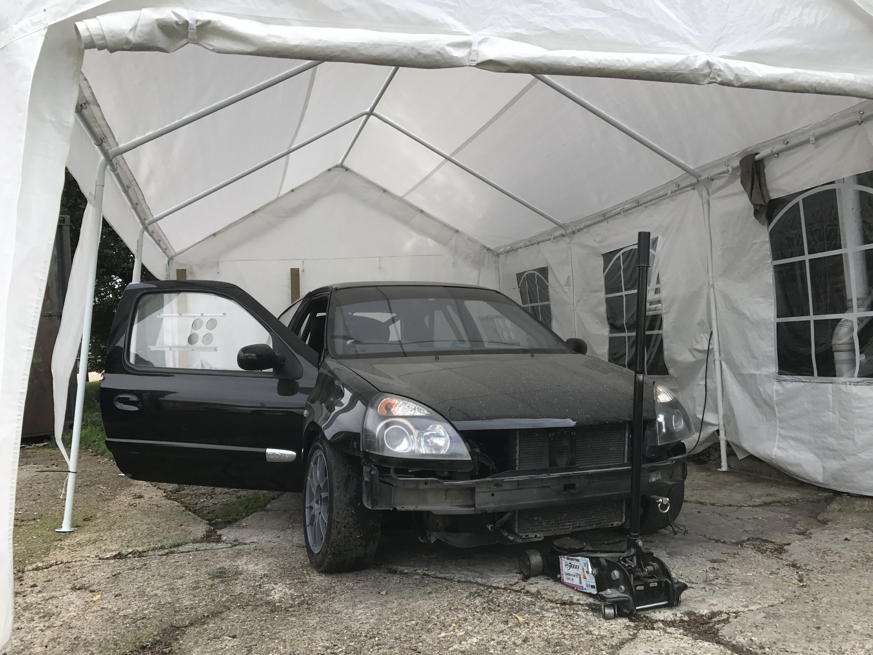

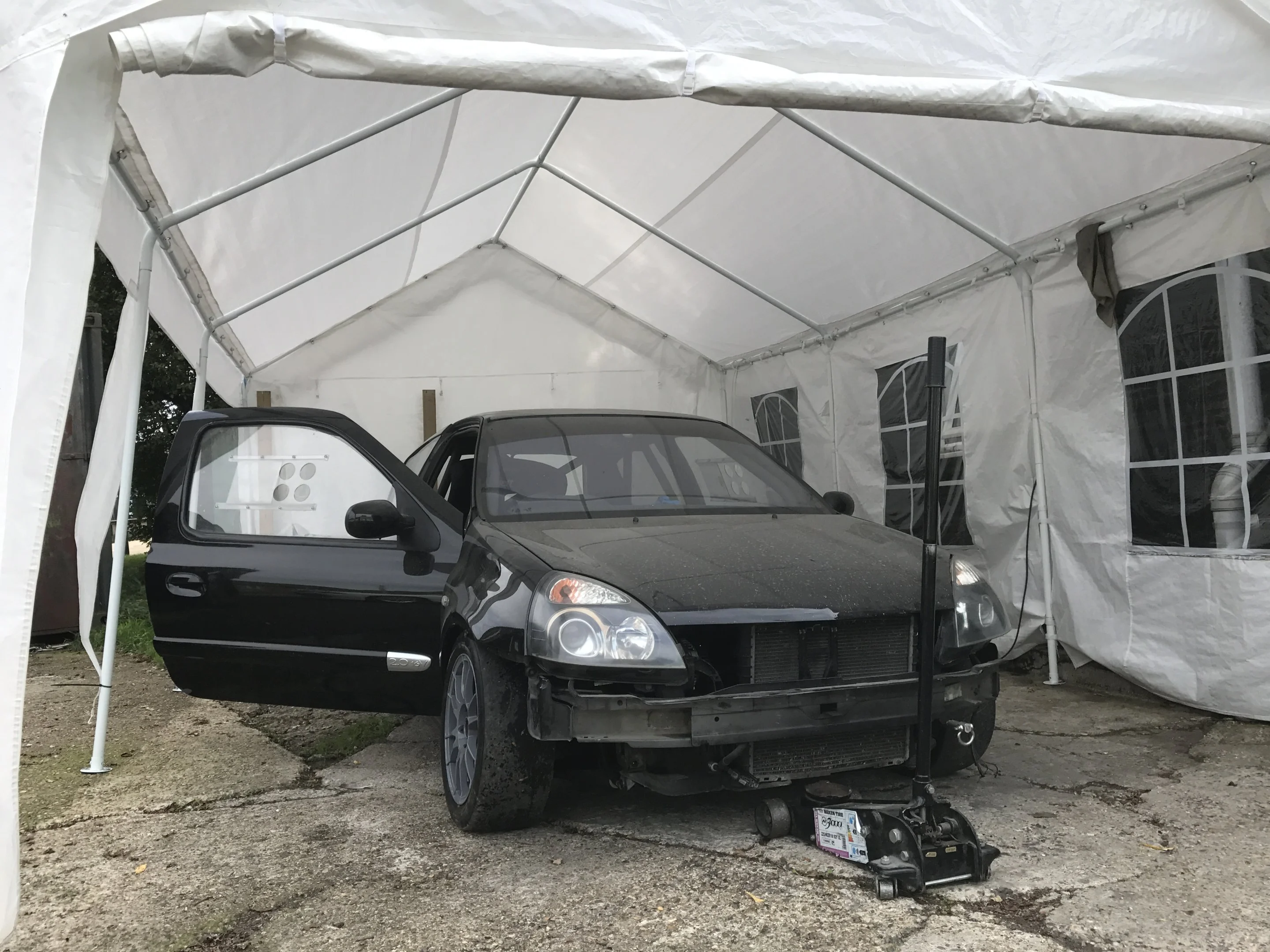

Quick pic of how it's going to sit whilst I can be bothered to go back to it, not sure how much longer I'll keep this car for to be honest...
Are the Brembos a straight fit on the 182 mate?
Hi mate no they're not you need to buy special brackets and if like me you want to use the standard size discs you need to get the calliper machined 5mm I believe on the mounting face so they sit lower toward the discs, you can get them under 15's with the correct spacers too
Well managed to get to the bottom of the gearbox leak from Bedford on Friday some of you might of seen it in the pits with oil pissing out of it!View attachment 162347
Is it me , the gearbox looks broken in the pic . ? Hope it is ok
As a general rule - the seal goes in dry , wipe clean and install . Normally get a build up of brass that lifts the seal . [emoji33]

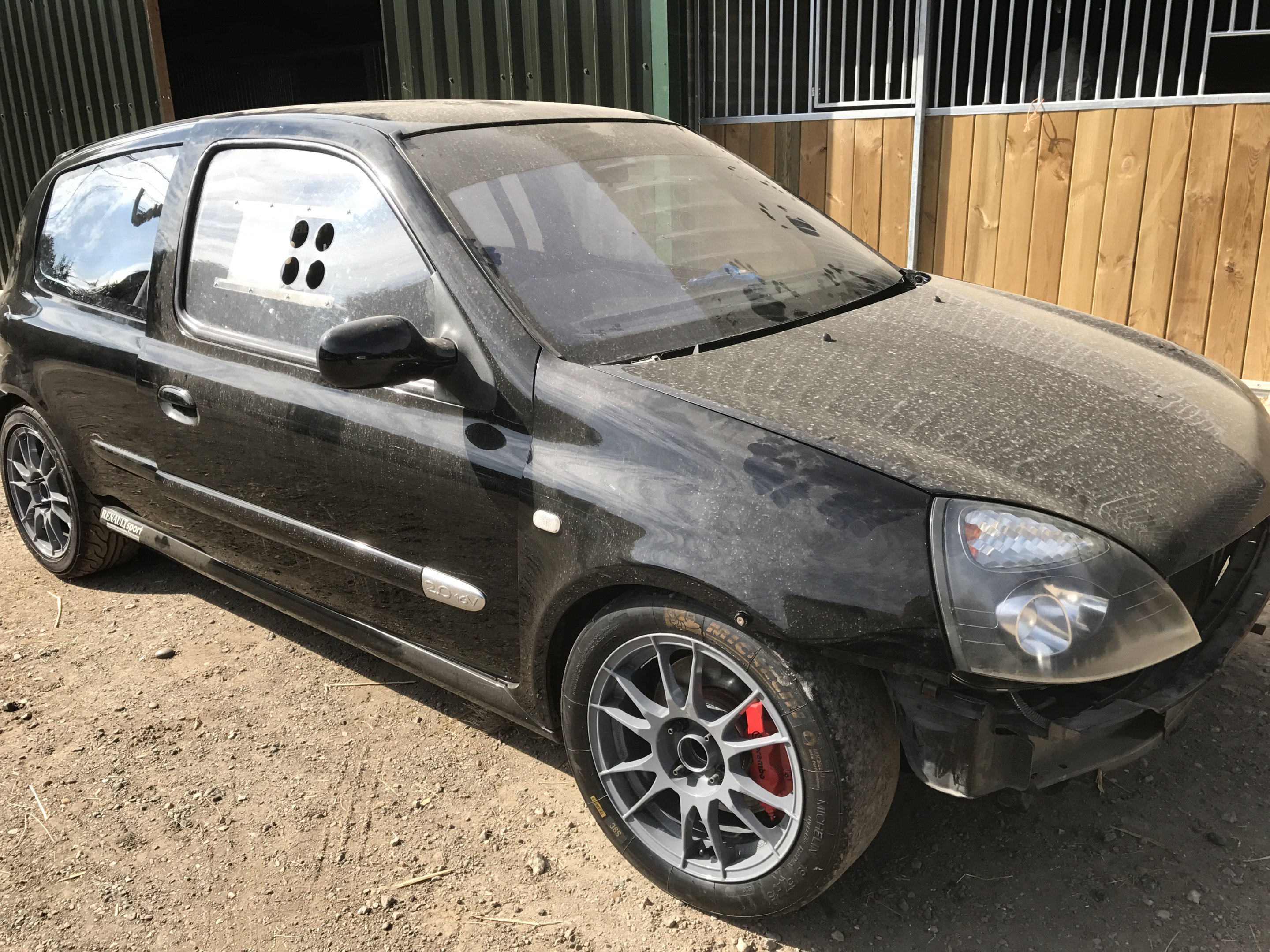

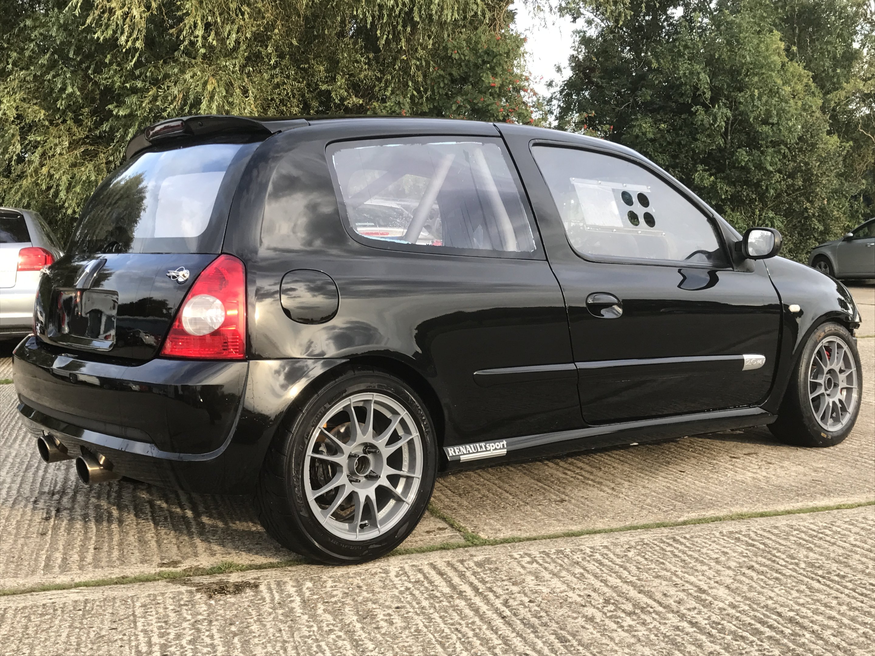

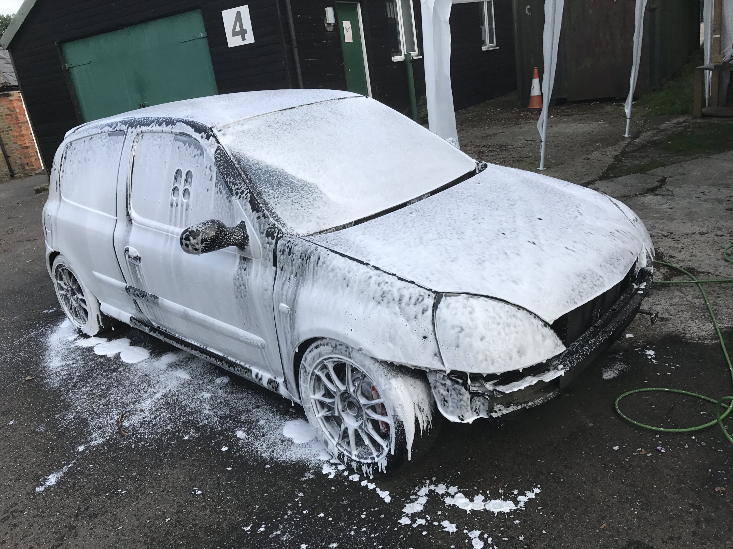

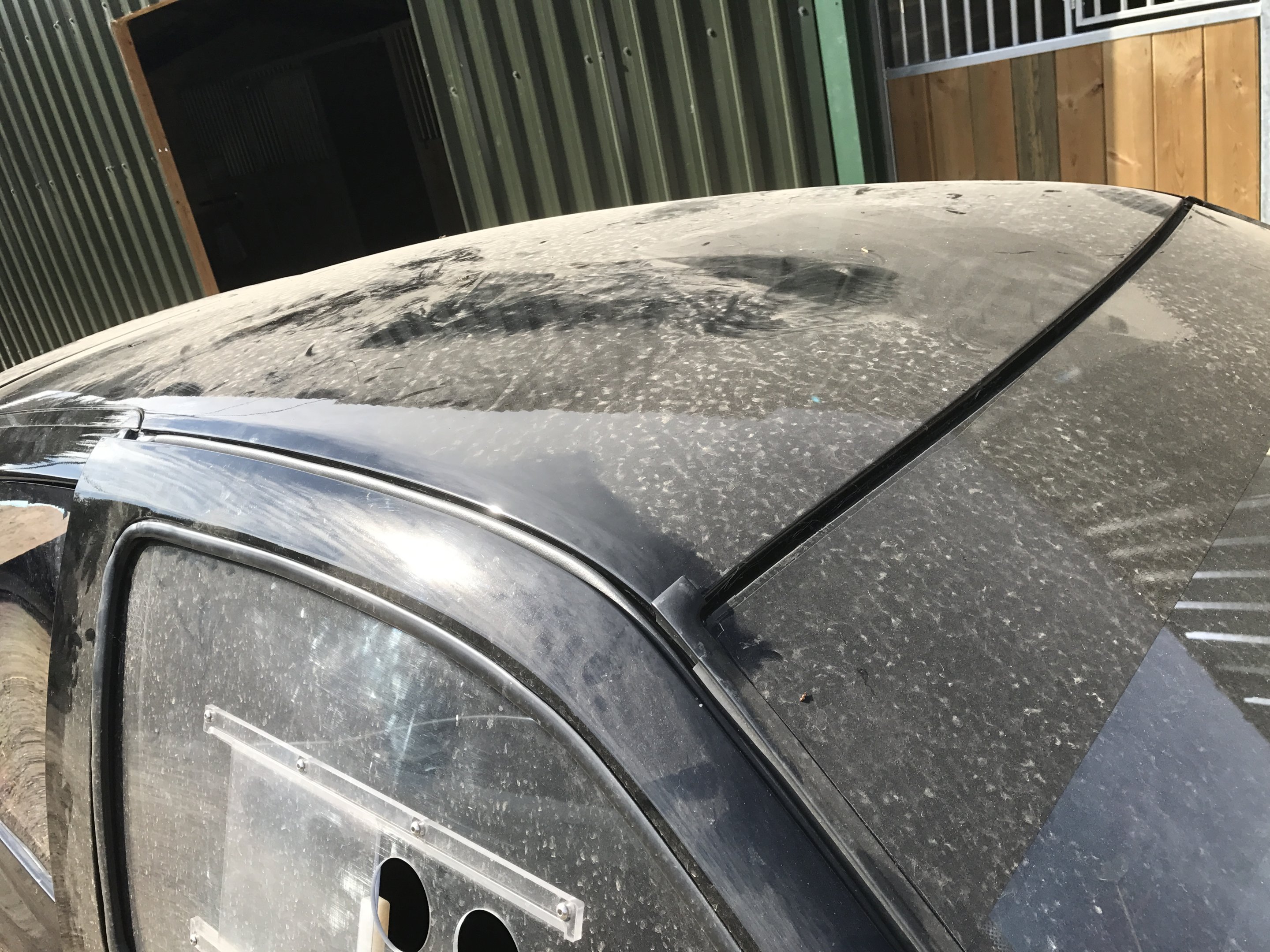

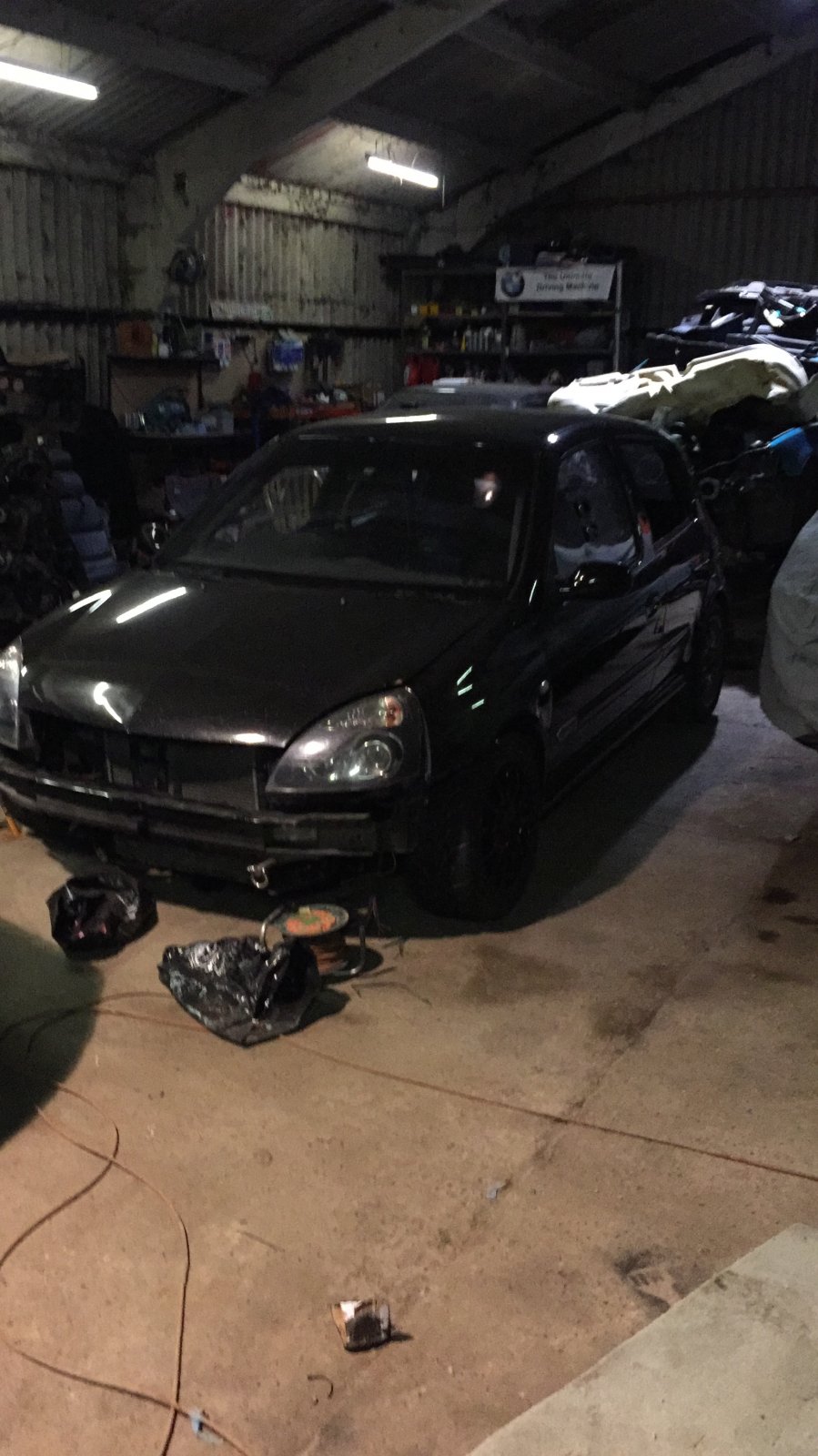

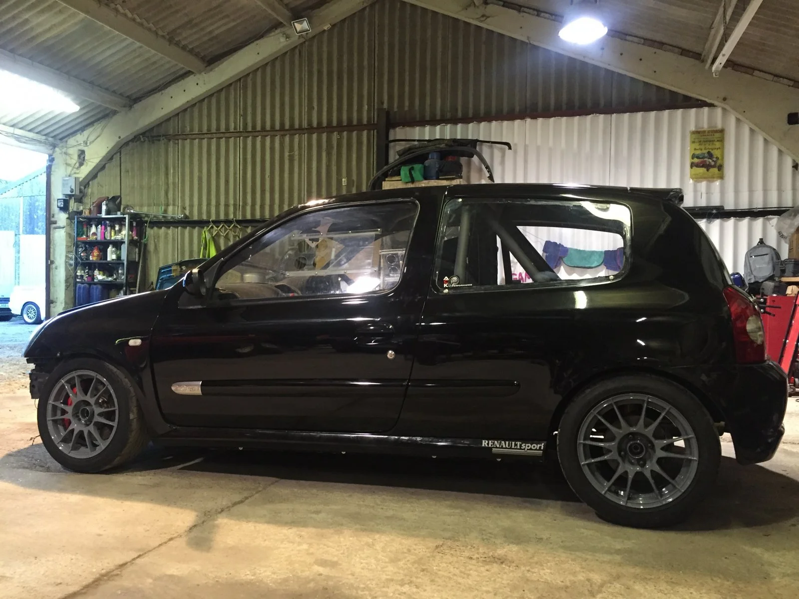

So a bit of activity infactt I think the most activity this year! But bought some slicks and booked a trackday and forced myself to go and work on the car, so fixed the gearbox oil leak, I stupidly fitted the seal wrong for the end case so re did that and then got the car out for a wash, as you can see from the photos my unit is very dusty and the car looked like a barn find!
Topped up the gearbox oil and no leaks so happy days! Then I gave it a well deserved wash and I think a little bit of love come back for it!

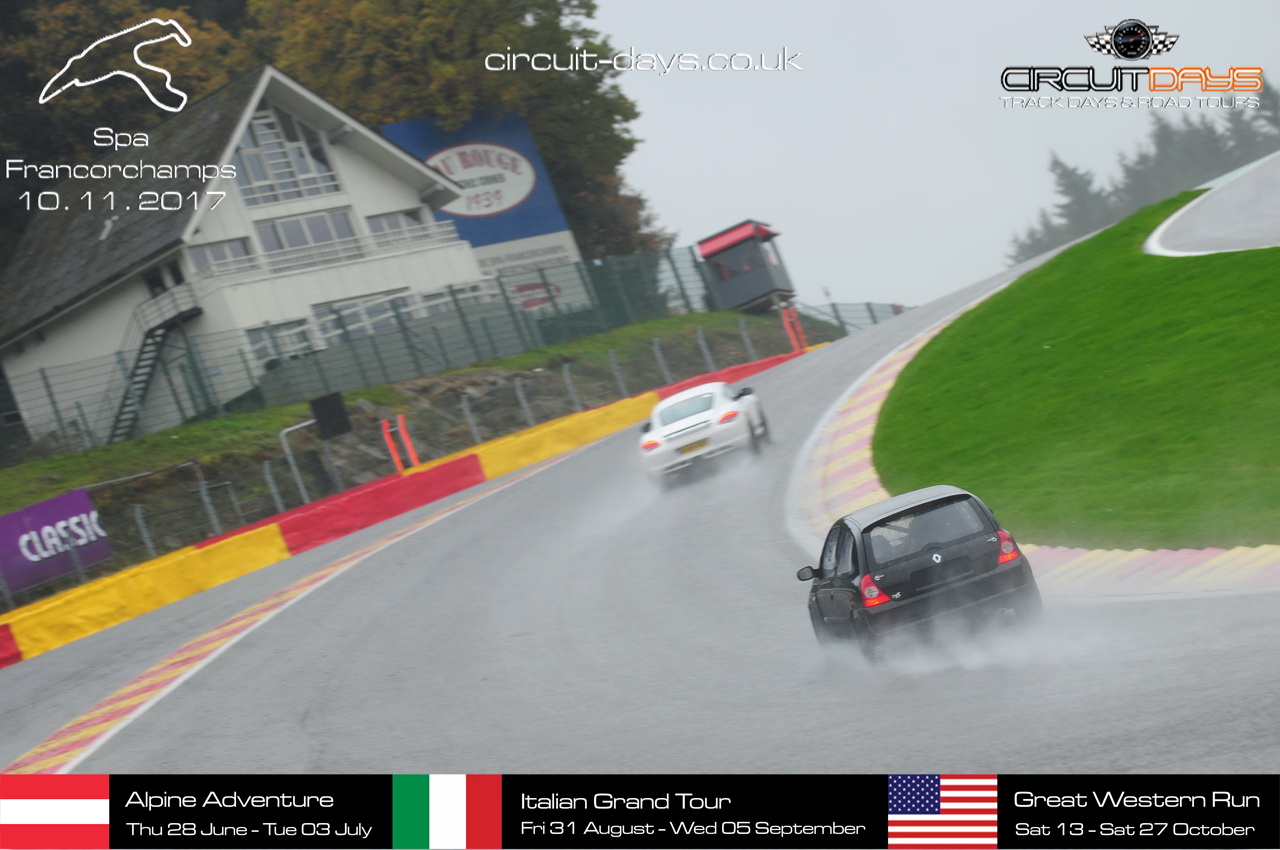

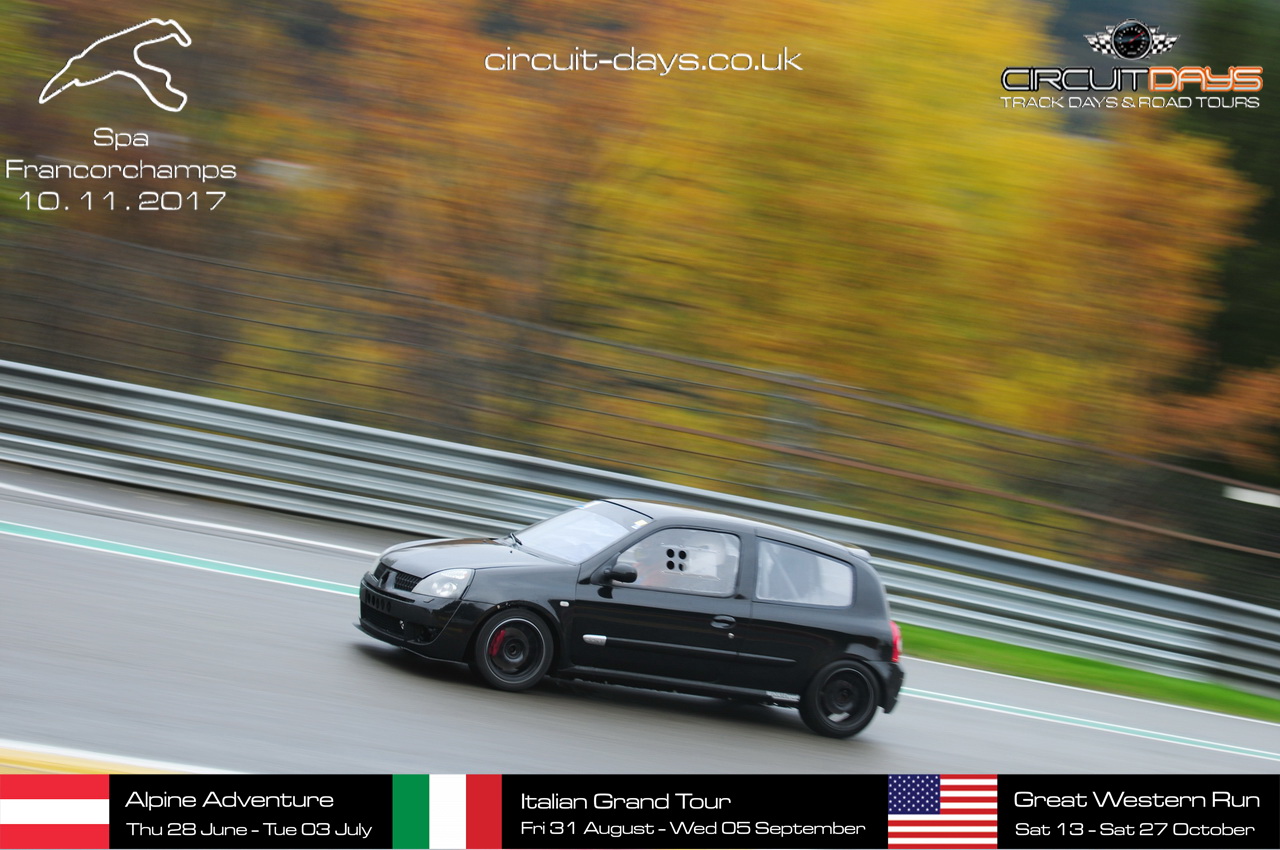

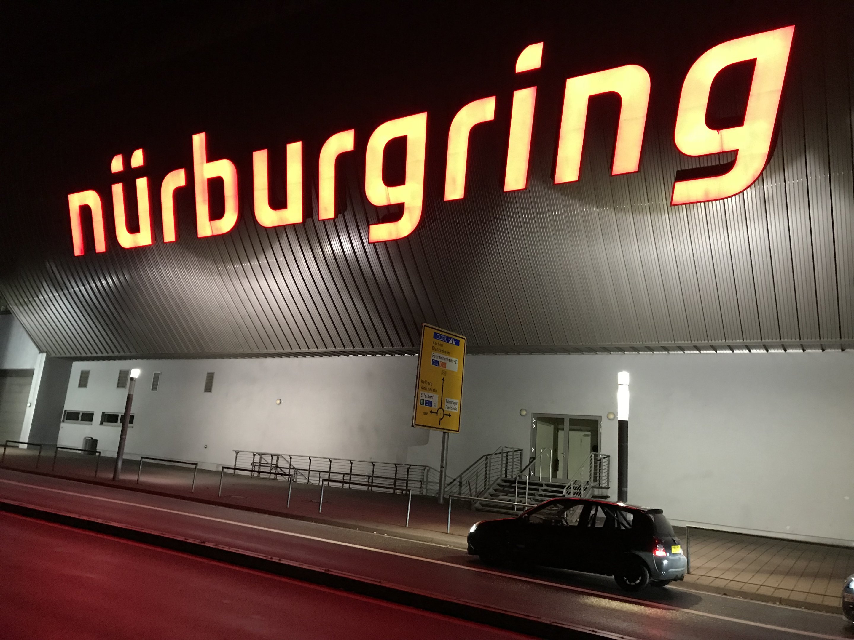

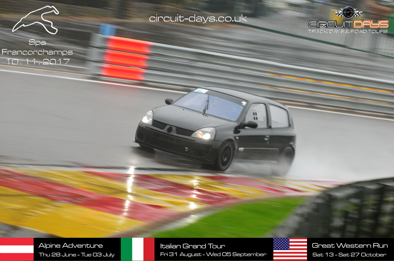

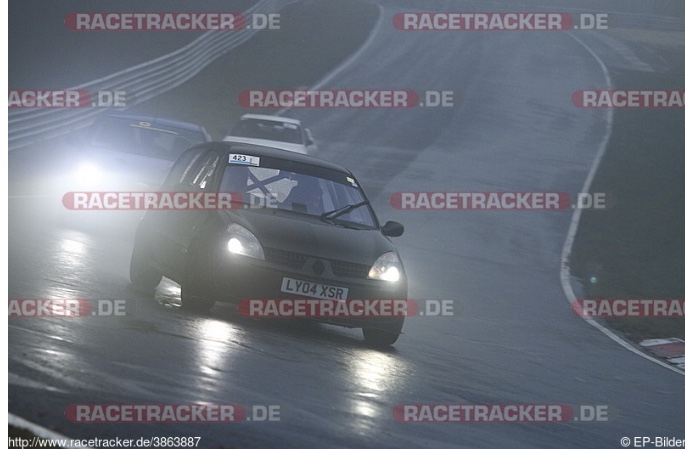

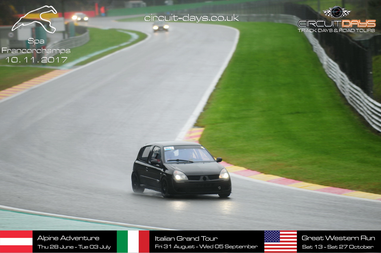

So took the Clio to the Nurburgring over the weekend and done a trackday at spa whilst we were out there, had an amazing time but the Weather was really against us! Absolutely pouring down for the most part of the day but was still good fun! The ad08r’s offered very little grip but had lots of side ways fun!
