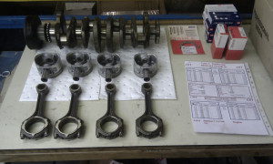

Copied from our website.

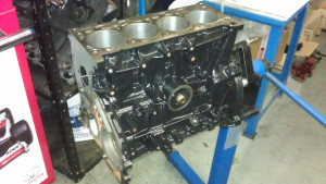

Balancing: Dan told us that experience has shown that the F4R responds well to dynamic balancing. As our engine was for racing it definitely deserved the best treatment, so a race tolerance balance was opted for. This engine proved itself to be a great base again, and the crank required no modification at all, impressive for a mass production engine!! The conrods, with new ARP bolts fitted needed a little work. They were all weight matched and end to end balanced.

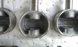

From this point it was a job of assembly and clearance checking. We decided to stick with the stock pistons for cost and reliability reasons so these were acid cleaned and came up like new. Piston ring end gaps all checked and adjusted where necessary in freshly honed bores. Main and big bearing clearances plastigauged, and crank thrust float measured.The bottom end was now fresh and solid.

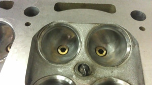

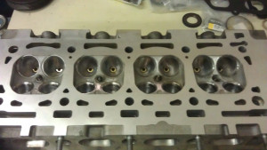

The cylinder head was an area we had spoken at some length about improving. The head was in poor condition but was able to be saved. The ph1 172 head as already mentioned is generally regarded as the best standard head for performance, so as we had this for a starting point we were very happy. Still room for improvement though, and a few hours of fettling later, a reworked head which should improve the breathing of the engine all round.

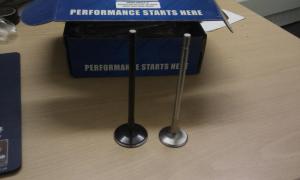

The stock valves on a Renault F4R are a two 2 piece valve with the head friction welded to the stem. This has been known to lead to failure in extreme cases. As our main brief to Dan was reliability we opted for a set of one piece Supertech valves. Inconel exhaust and nitrided inlets.
Cams: Another subject of lengthy conversation. We came to the decision that due to retaining the stock pistons, and thus limiting cam choice, we would use Catcams 421 profile. Dan reported seeing very good results from them with Throttle bodies. As luck would have it a low mileage set became available at just the right time. We have also retained the VVT/De-Phaser
So it was just a case of building it all up with new seals, gaskets, water pump etc and it was ready for fitting.
Having all the parts to hand, checked and ready made fitting the engine a straight forward job. It fired up nicely and after a sorting a few fuel and coolant leaks all was well. The fuel rail we have been using was the stock Renault item. Now the car is up and running again we are going to swap to an AT power rail for reliability and also run the fuel pressure a little higher. Lots of small jobs to do before it goes for calibration, once again at Tour De Force.

That info you pasted in is slightly wrong about the supertechs by the way. They are two piece exhaust valves not one piece. Still a big improvement though, same ones Lesley has in her clio since she rebuilt the head :)
  182/RS2/ Turbo/Mk1
I know, we have this conversation before Chip.
Ah fair enough, i dont recall that tbh, No worries mate, just didnt want anyone reading it and getting slightly the wrong impression.
Shame there aren't any sensible priced proper one piece to use, would love some for my turbo but had to settle for supertechs on that too.
