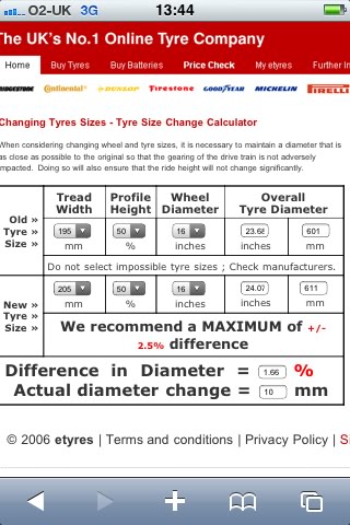

Surely the wrong profile is going to affect allsorts - speedo reading, oddometer reading, acceleration (worse I think), although you may get better fuel economy. Probably only slight differences, but personally I'd want them to be the correct size.
Yeah, I think 195/50 16 and 205/45 16 give the same diameter/circumference - so no probs. But not 205/50 16.
195/45 gives 87.75mm tyre profile
195/50 - 97.5
205/45 - 92.25
205/50 - 102.5
So for a 172 going from 195/45 to 205/50 would give you a radius increase of 14.75mm.
That works out about 5% so your speedo would under read by that amount.

Even so, of the two sizes used by Renault themselves 195/50 gives the larger diameter and 205/50 is 10mm more than that. So I still wouldn't use them.

Yeah that's what I was meaning, how would a 195/50/16 have a smaller radius then a 205/50/16. I thought only thing that would be different is the width on the tyre and the side wall would still be the same.
the 50 is a percentage so 50% of 195 is smaller than 50% of 205 thats my understanding anyway.
The sidewall can't be the same. The 50 is the height, as a percentage of the width. So 50% of 195 is 97.5 and 50% of 205 is 102.5. Different height = different radius.
