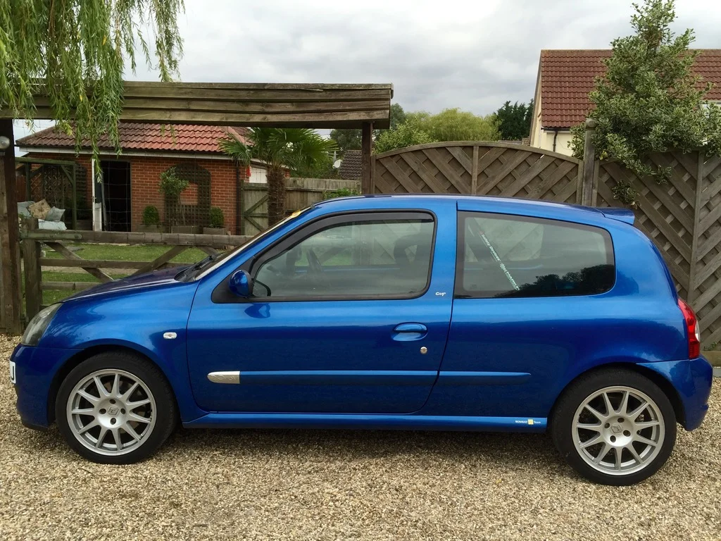

Here's the 172 cup, it's had a few owners so will more than likely be known on here. Has the cliosport stickers.

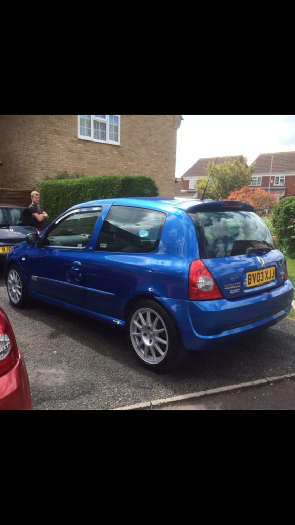

Pics.
eBay ad pic

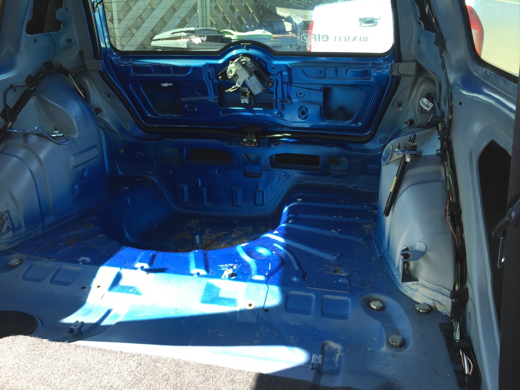

I will be removing the wiper and cutting out the boot lid liner fixings and this is before I fabric tapped the loom.

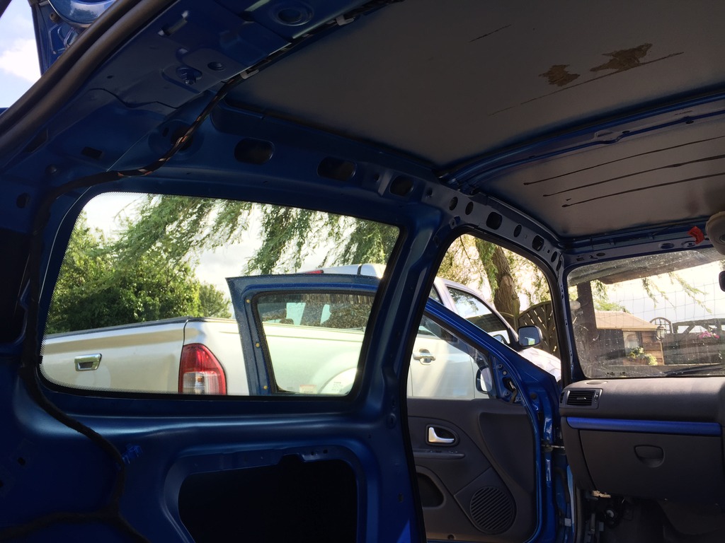

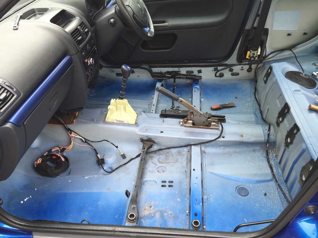

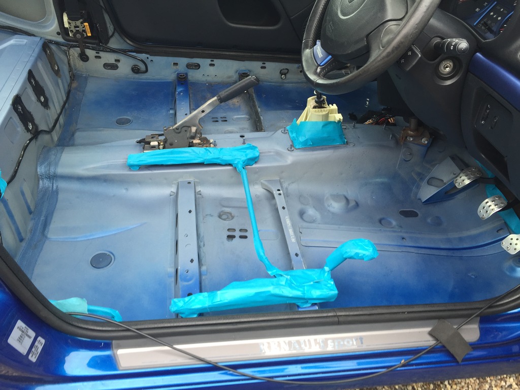

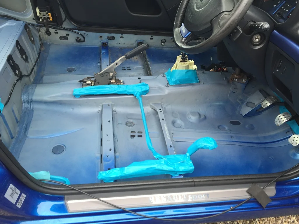

Well I've made some progress recently with the Clio.

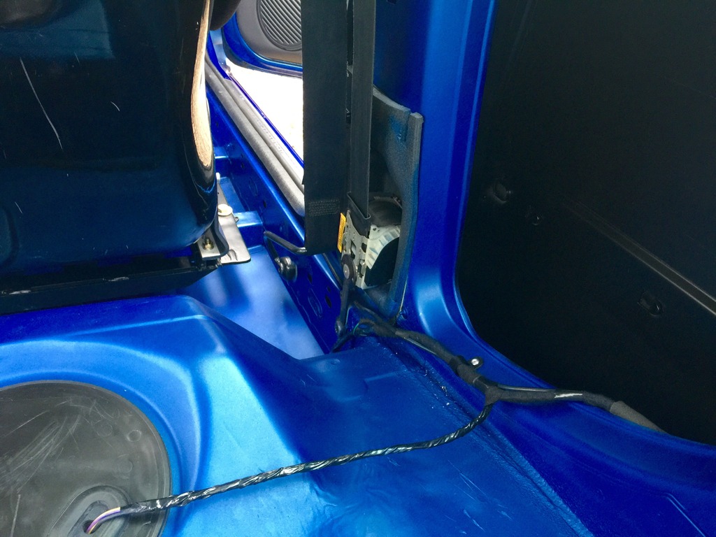

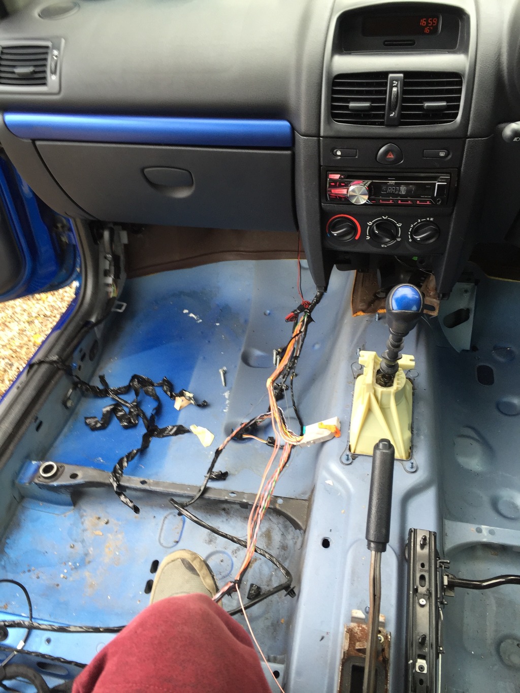

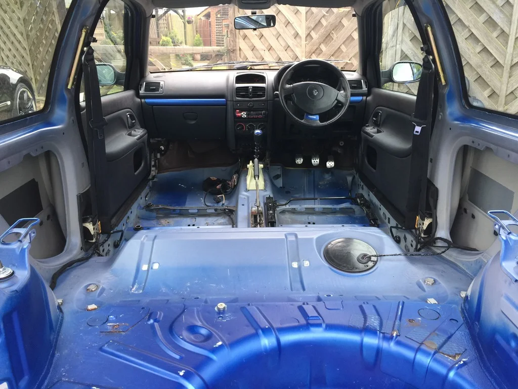

Mainly been ripping out everything I don't need but I need some advice regards the airbag wiring? Can I just cut it off or will that end badly, I've wrapped it up out the way and il be making a plate for the Ecu/diagnostics port and 12v so I can run fans or what have you.

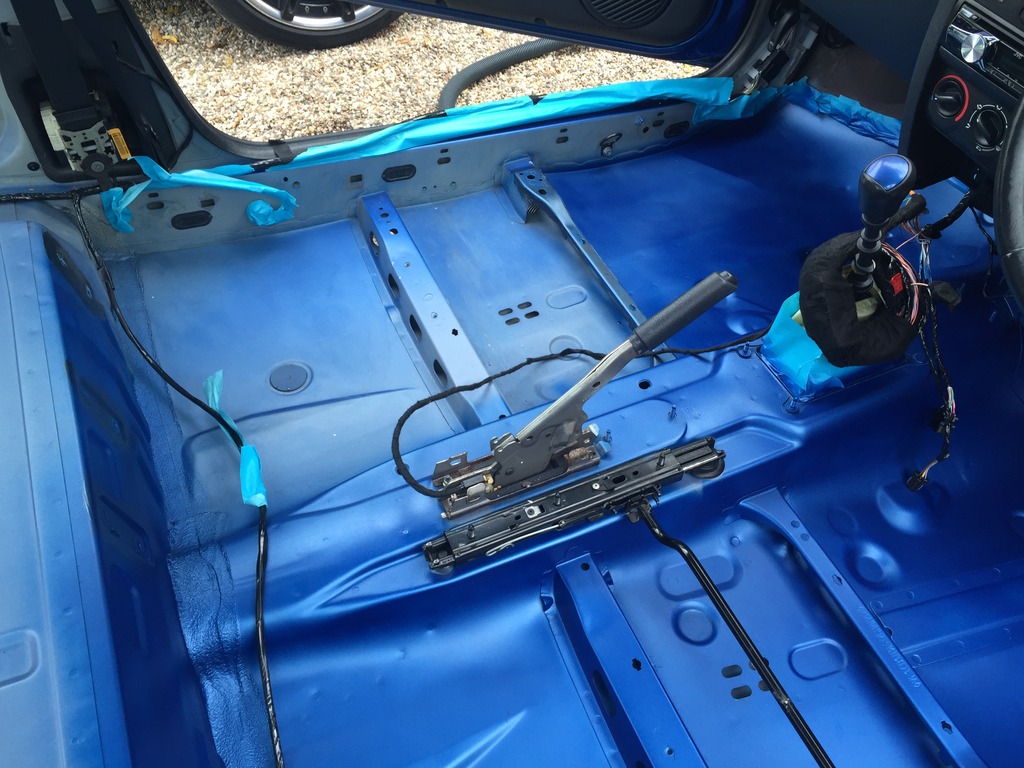

I spot weld drilled all the brackets off that arnt needed and il be painting the interior tomorrow and fitting my new bucket seat. The carpets weight so bloody much, and I have no sound deadening on the floor at all as its a cup? So just rear quarters and c pillars to get it off.
Also hide the drivers side wiring, can't be bothered to do the boot one just yet
  Audi A8 3.0tdi/172.

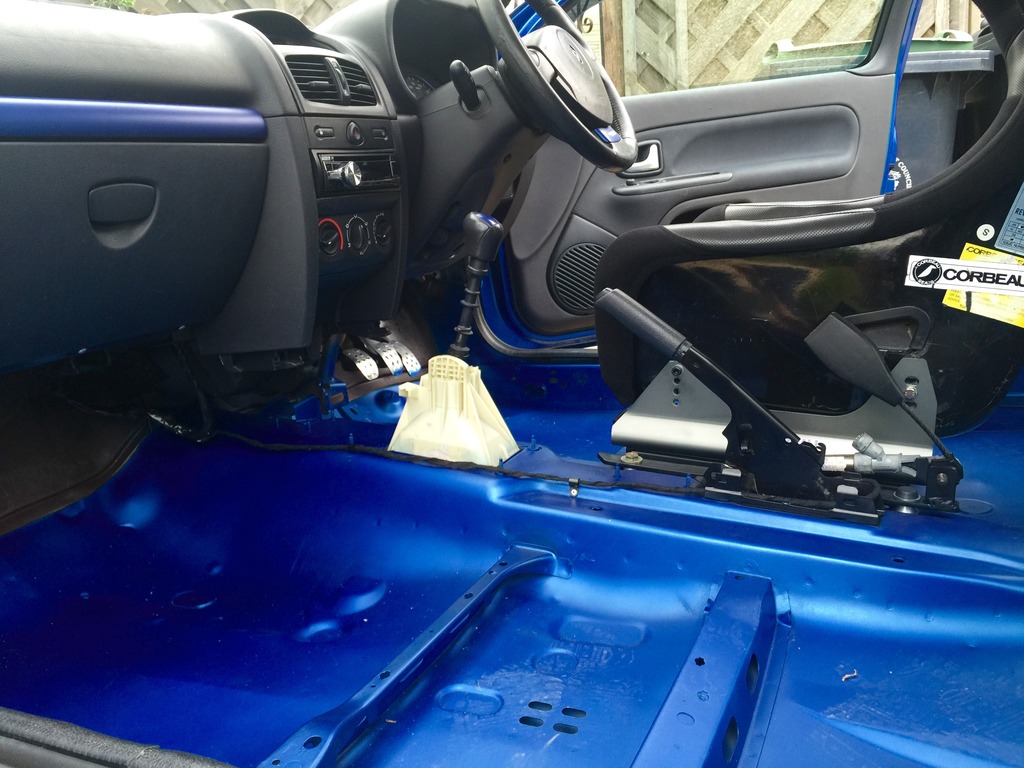

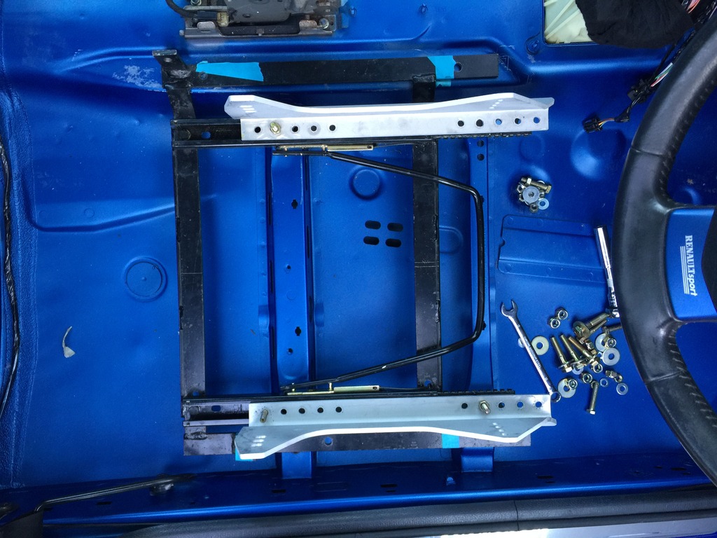

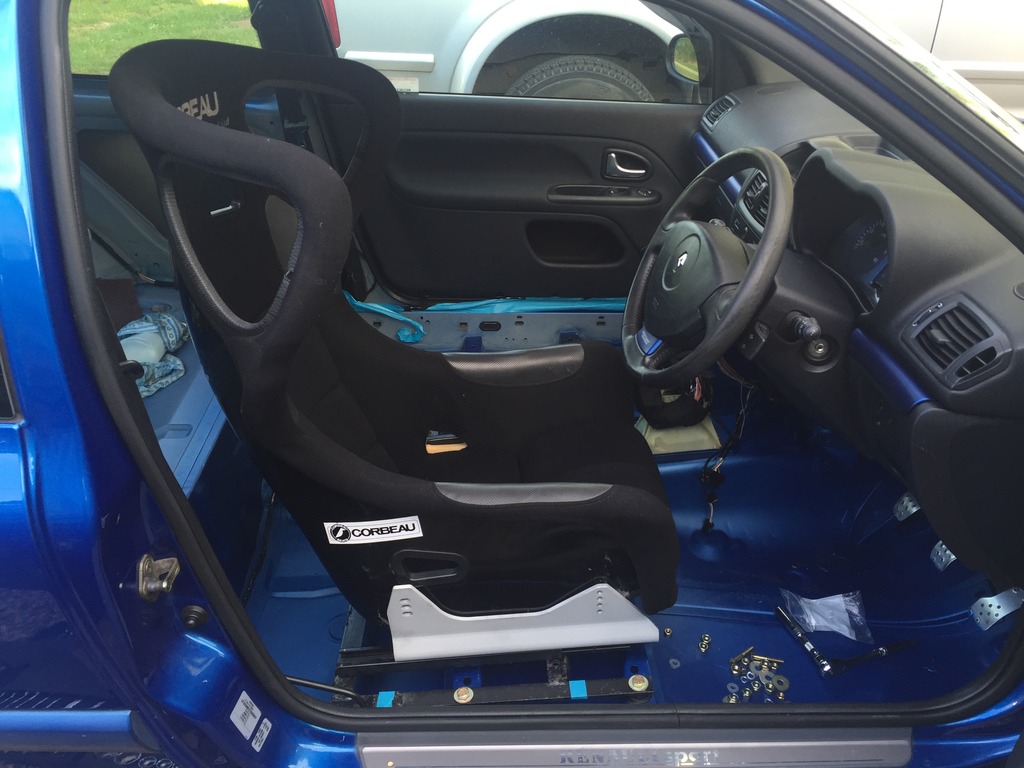

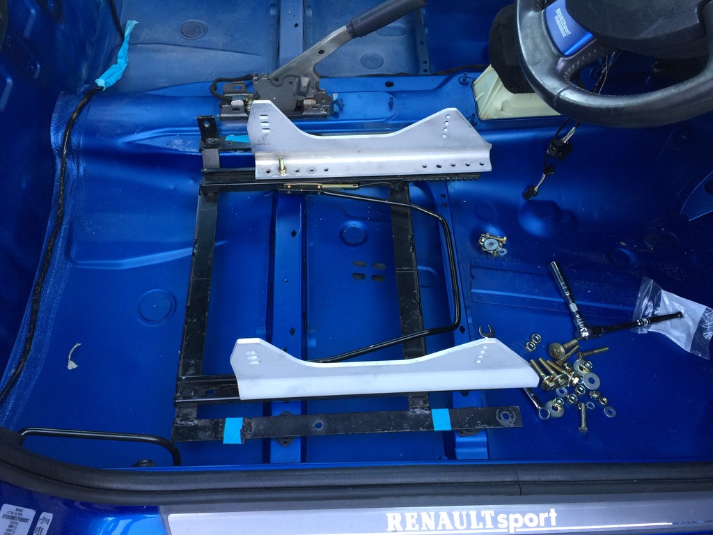

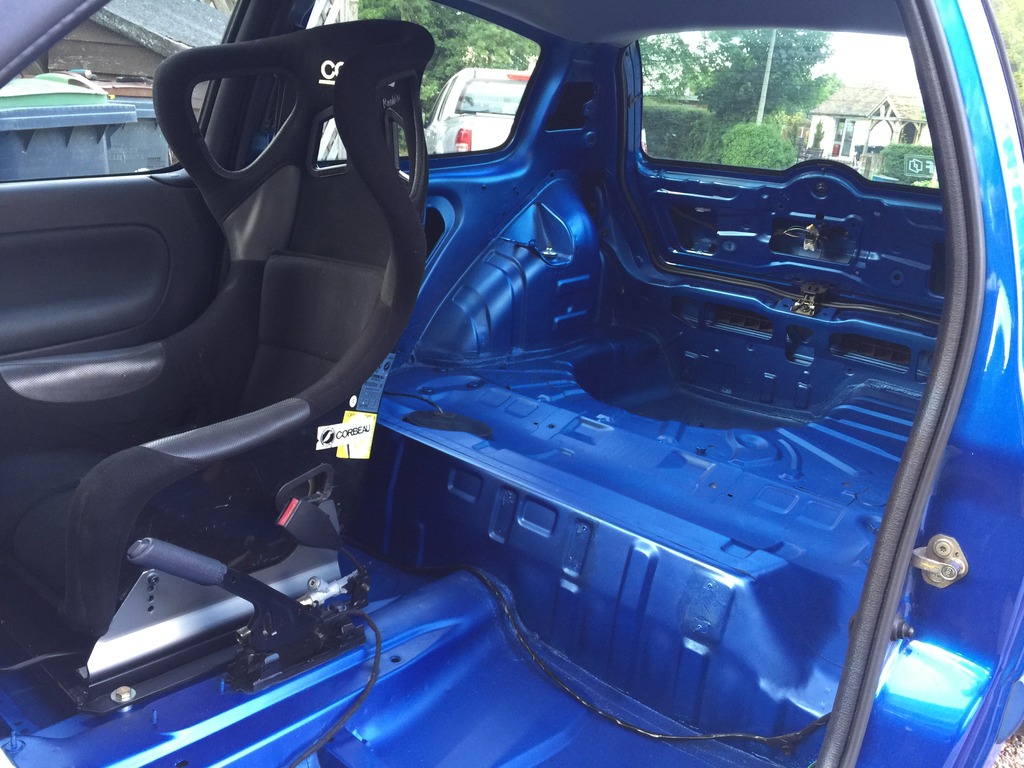

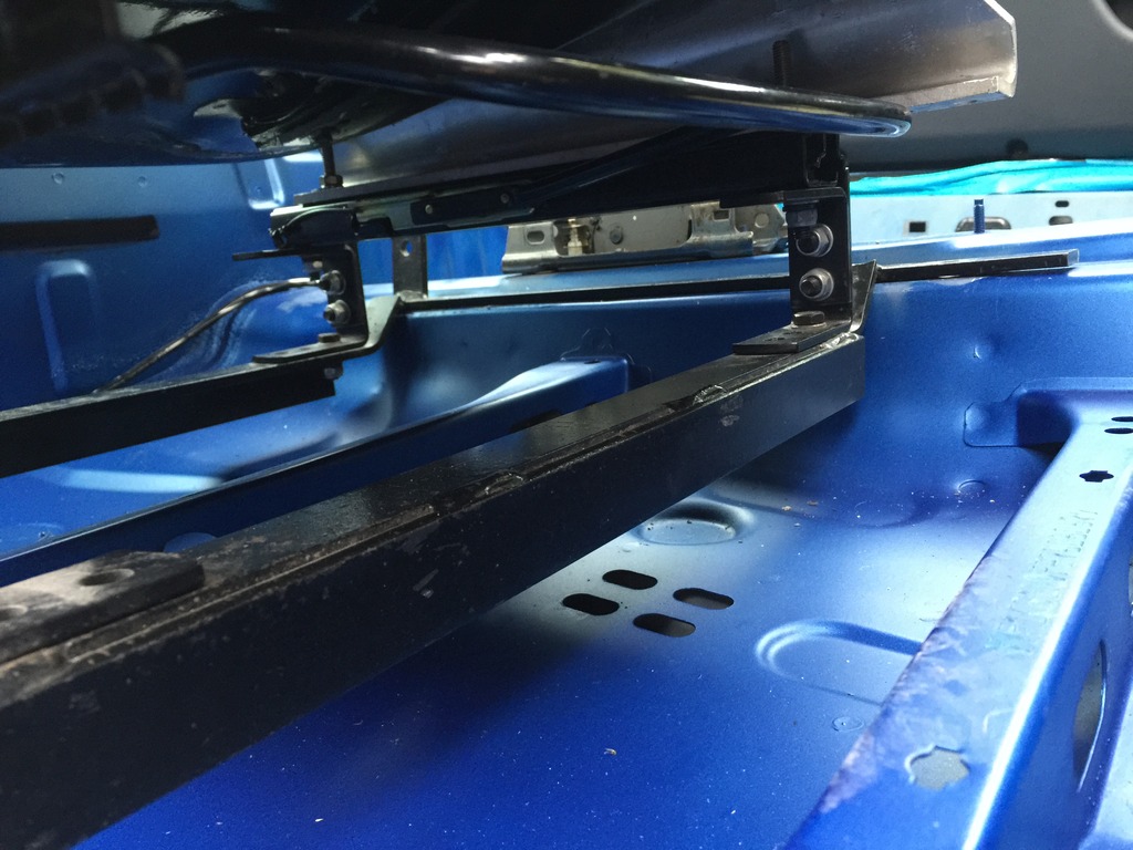

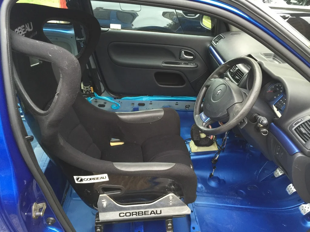

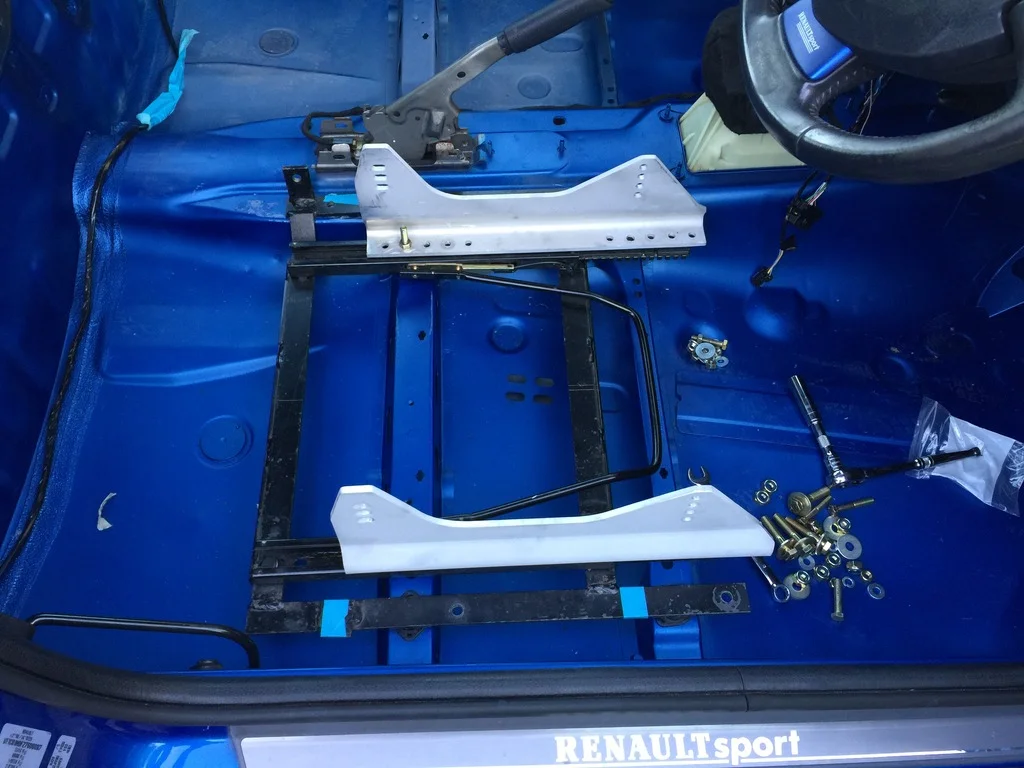

Drove to gatewick today to get my seat, came off a Clio but unfortunately the other guy was 6ft plus so il have to move the frame forward a fair amount but should be fine once done.
Also sprayed the interior satin blue same as the outside colour I had a can made up. I can provide these cans if need be aswell the colour is very good. Neatens it up so much.
Will have to repaint the drivers seat mount once I've fettled it and the floor where it mounts as its scratched now.

Nice work. Paint match looks great makes interior look much nicer
Rubicon_
  L110, RS6, Westfield
That's defiantly on my list it makes me sad every time I look at the interior :(
  Audi A8 3.0tdi/172.

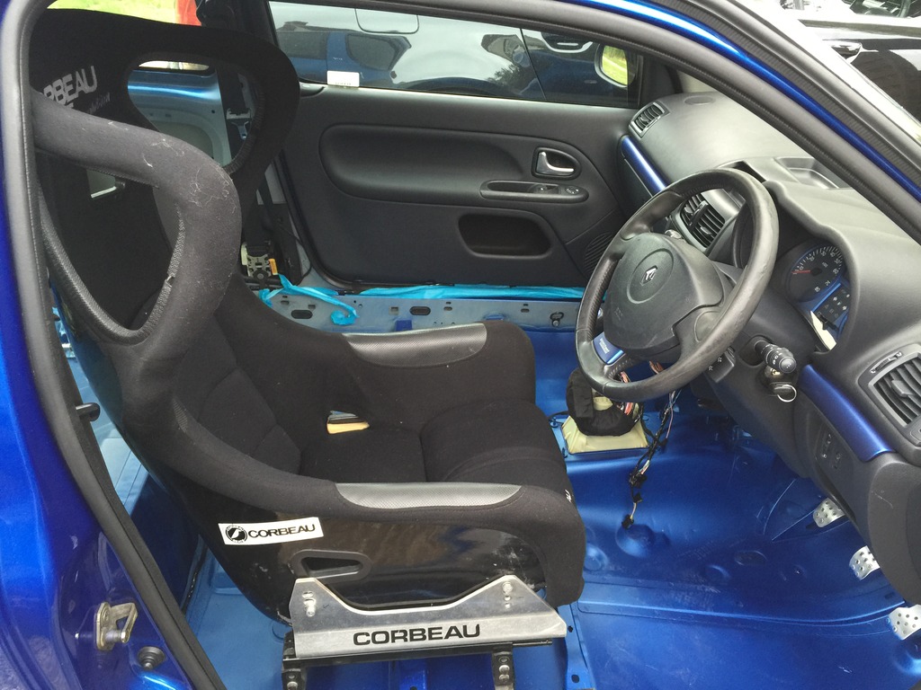

Cheers fellas, it's a must for me anyways being a painter, opted for a satin finish as I thought the glare from the gloss may be a tad much.

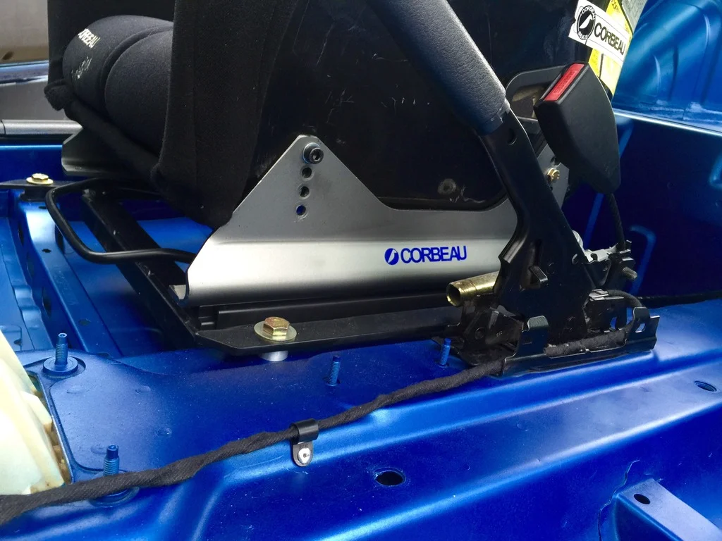

Finalised the seat positioning today so will cut the mount up on the gearstick side and relocate that bar back so I can go forward around two inches is enough. And I will be making the frame lighter by drilling holes in it as it weighs a fair amount.
Also sand blasted my corbeau mounts to paint up aswell.

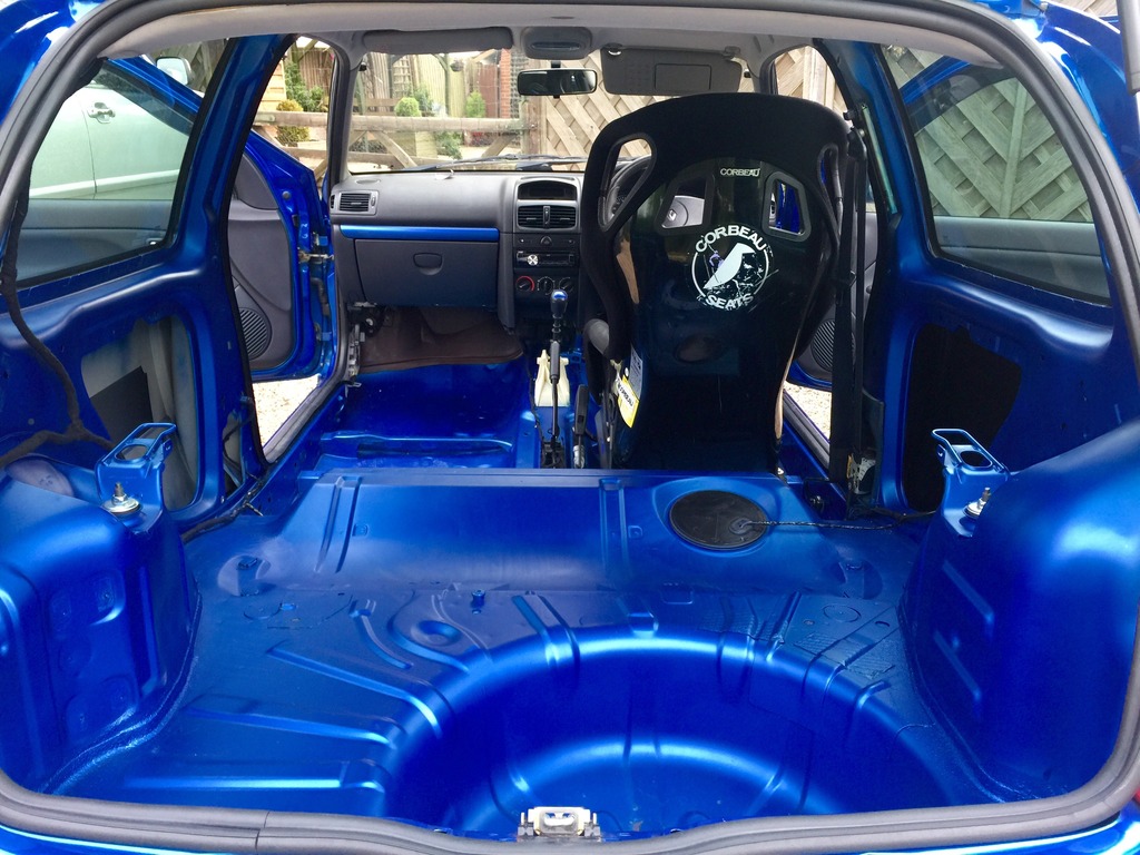

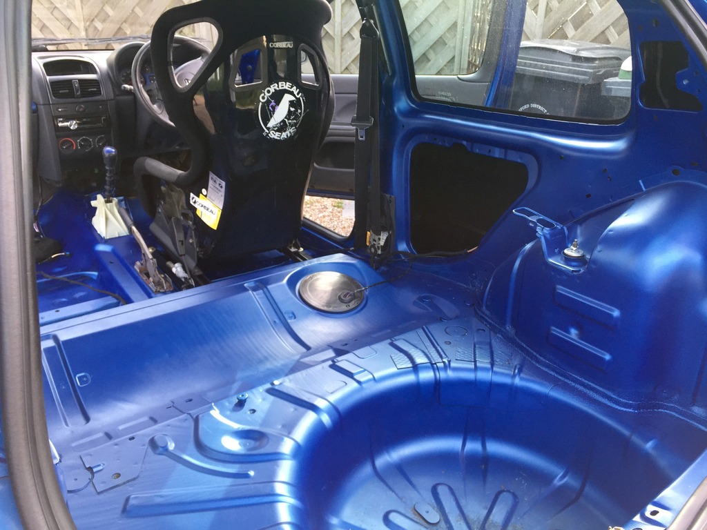

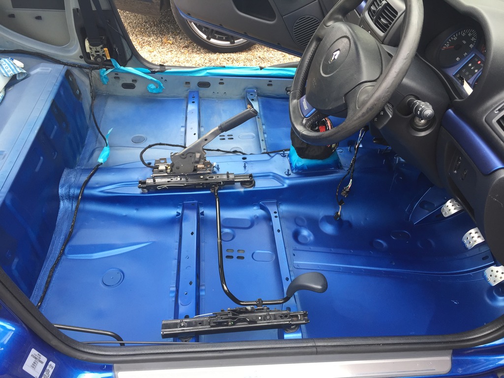

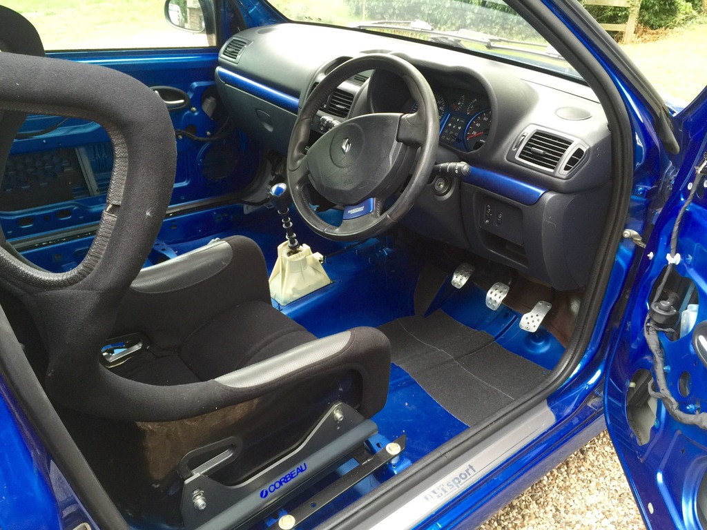

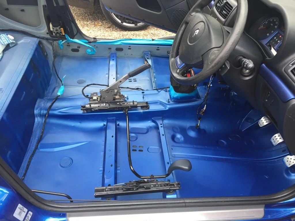

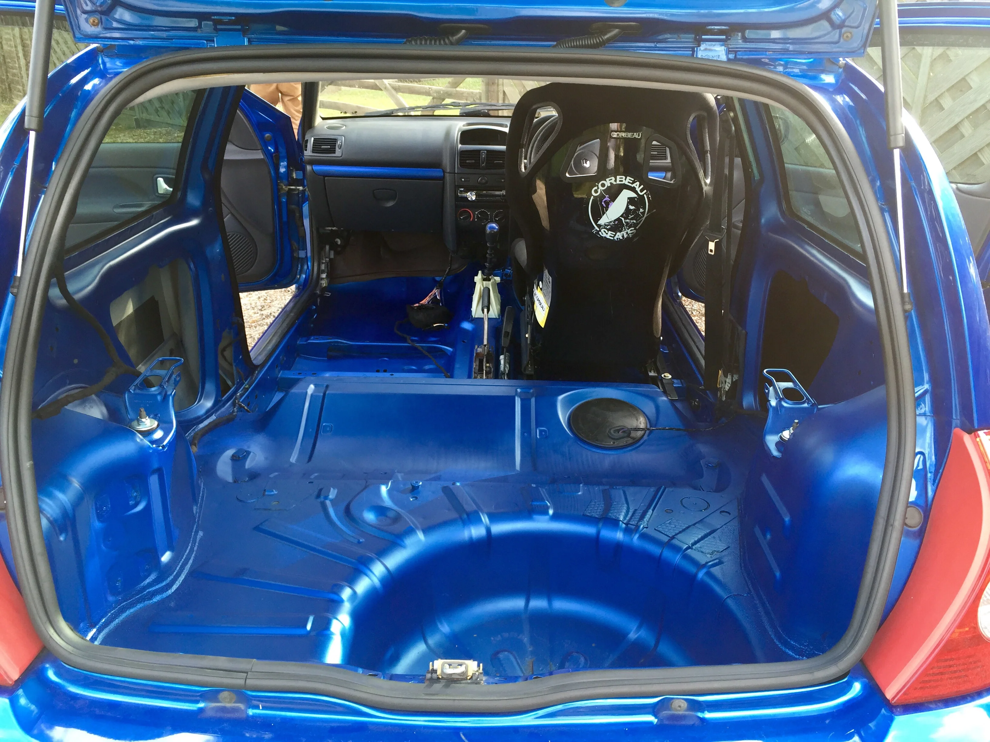

Did my interior at the weekend and sprayed it all up, satin blacked my inner quarters as well. Looks so much better. Roof and front doors next.

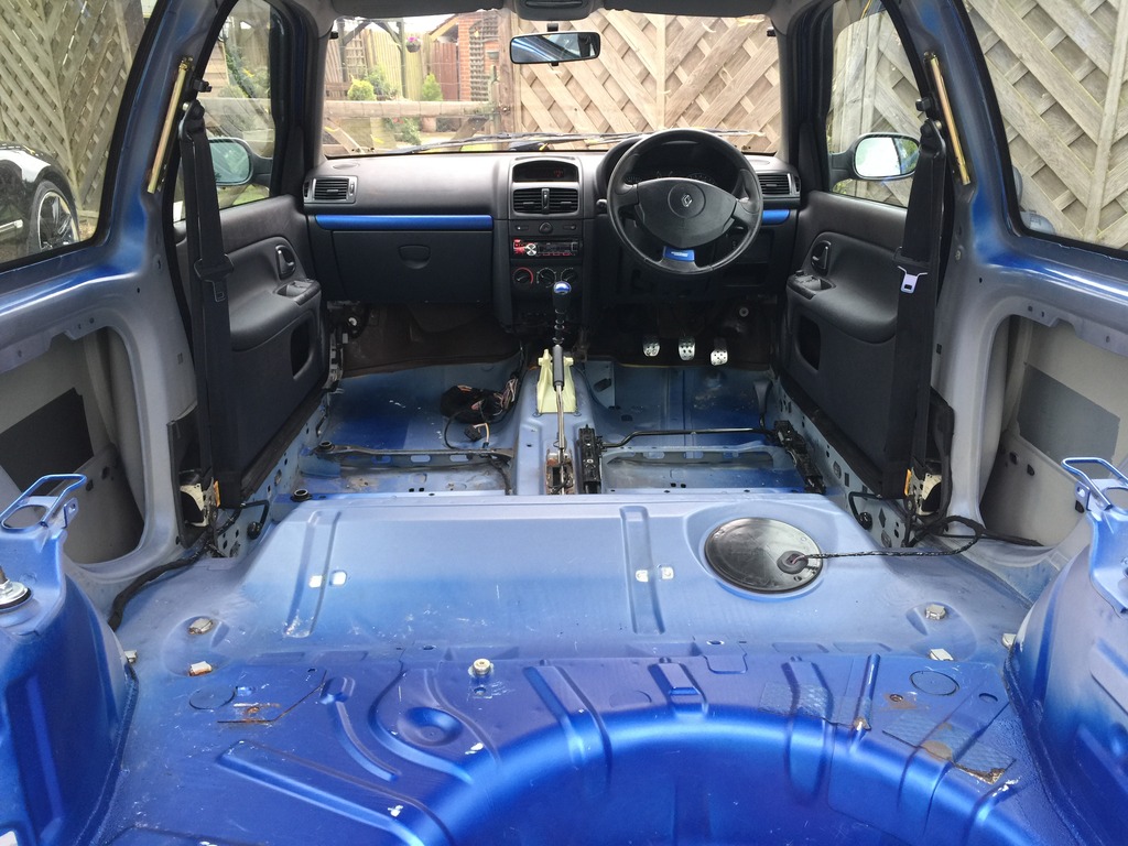

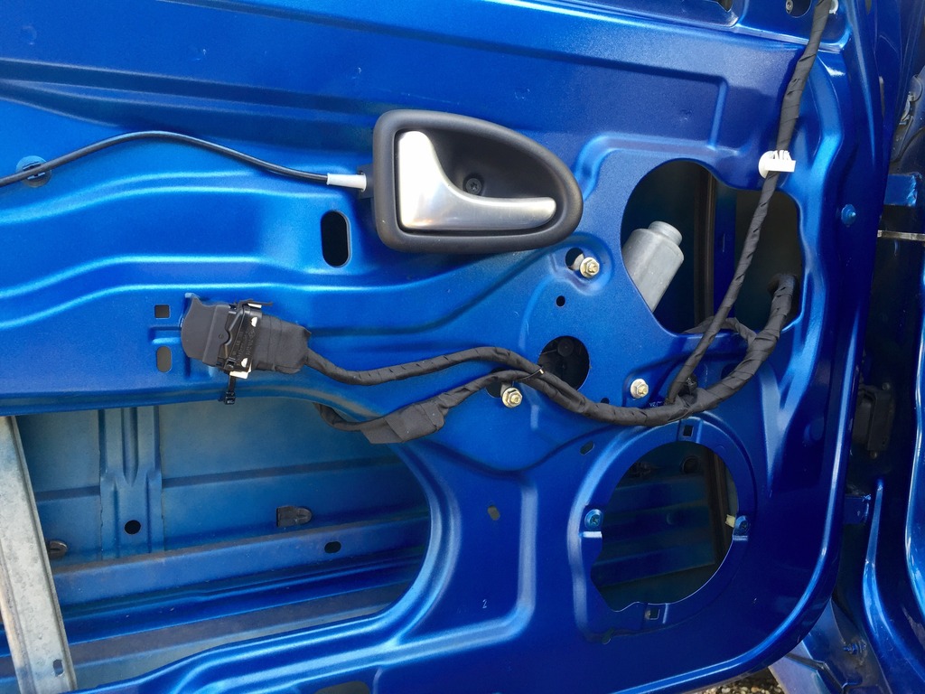

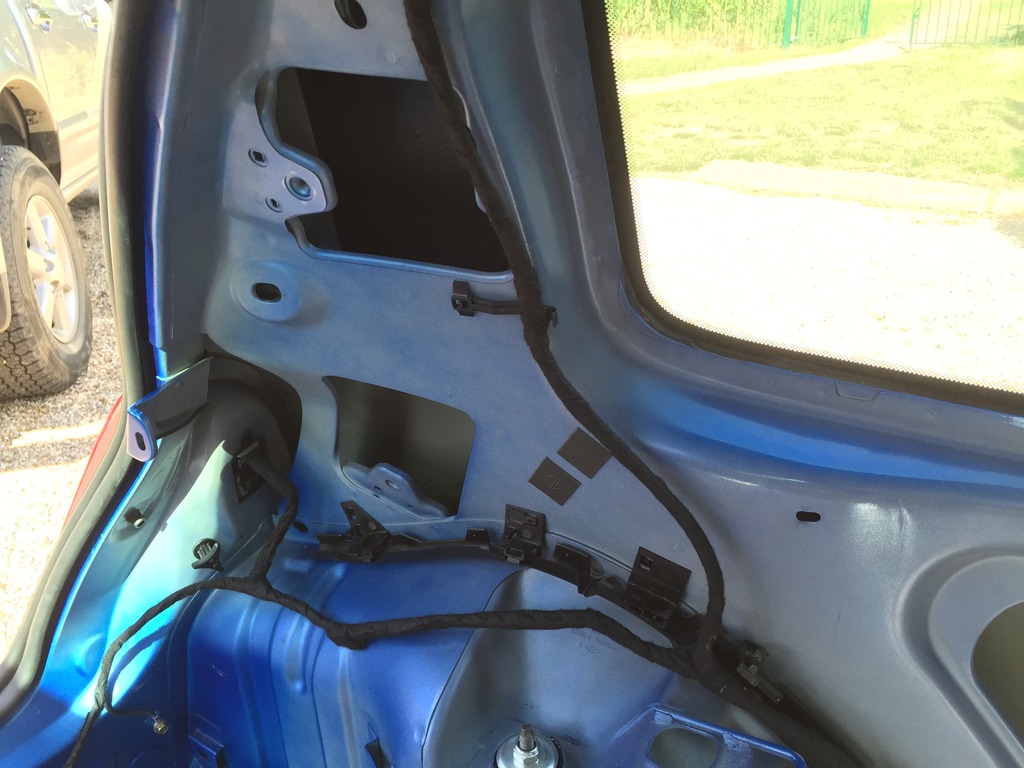

Few more tidying up jobs and securing the airbag loom out the way aswel as starting to strip the door cards down and possibly loose the speakers and head unit. Aswell as the steering wheel controls, how do they come off?
Got some stickers for my bases and it looks so much better. Grip tape next and that's it until my new rear brakes arrive, my decat pipe and top my brake fluid up with some decent stuff.

What have you used to wrap the wires? Looks good!
It's fabric rape mate, helps to keep the noise down when f**king away all the wires and that. Looks better than normal black insulating tape aswell.
Around £5 on eBay I think mate.

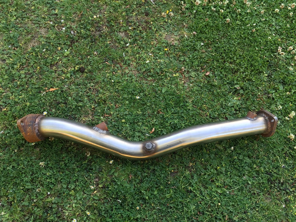

Also received my decat pipe, it's a brand new group N spec one so I sand blasted the ends and painted them up today and polished the stainless steel center.

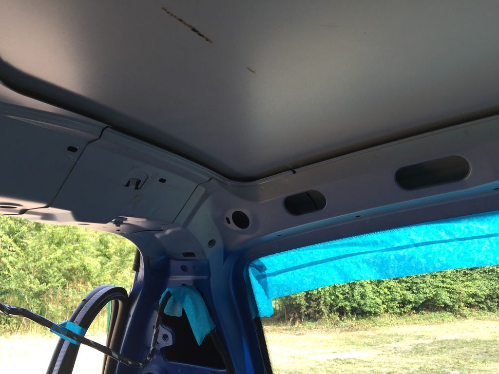

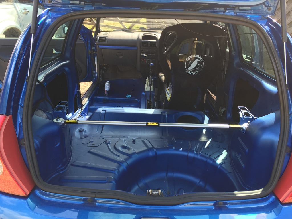

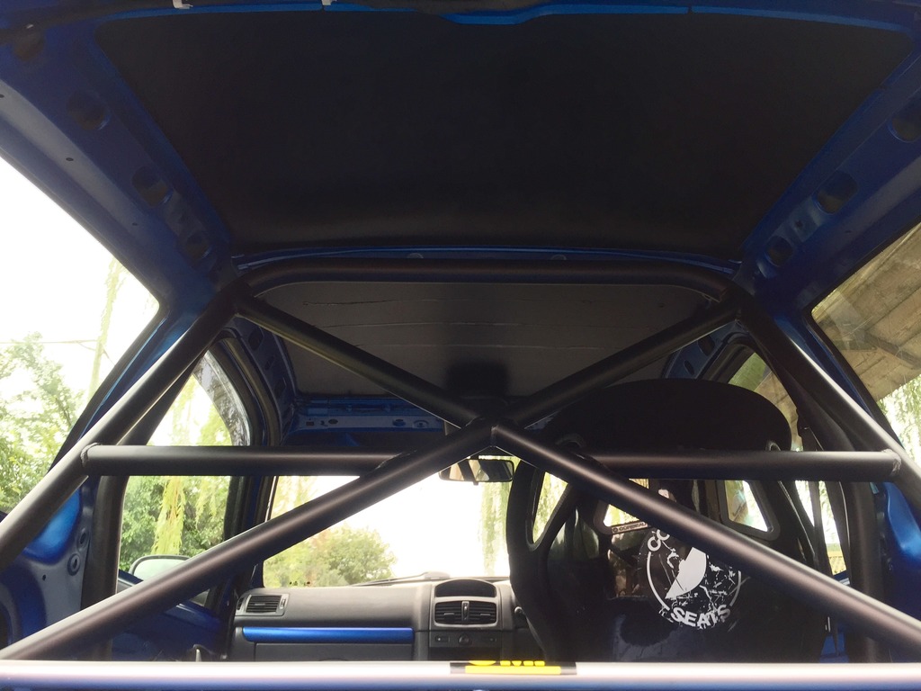

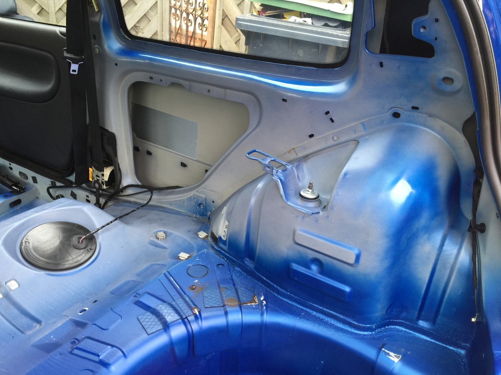

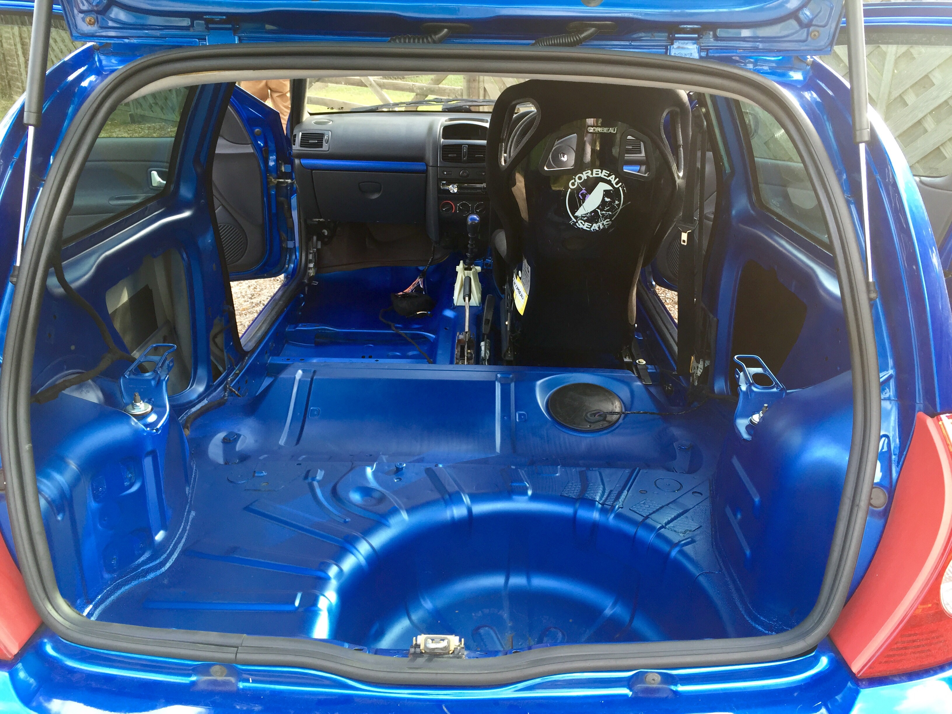

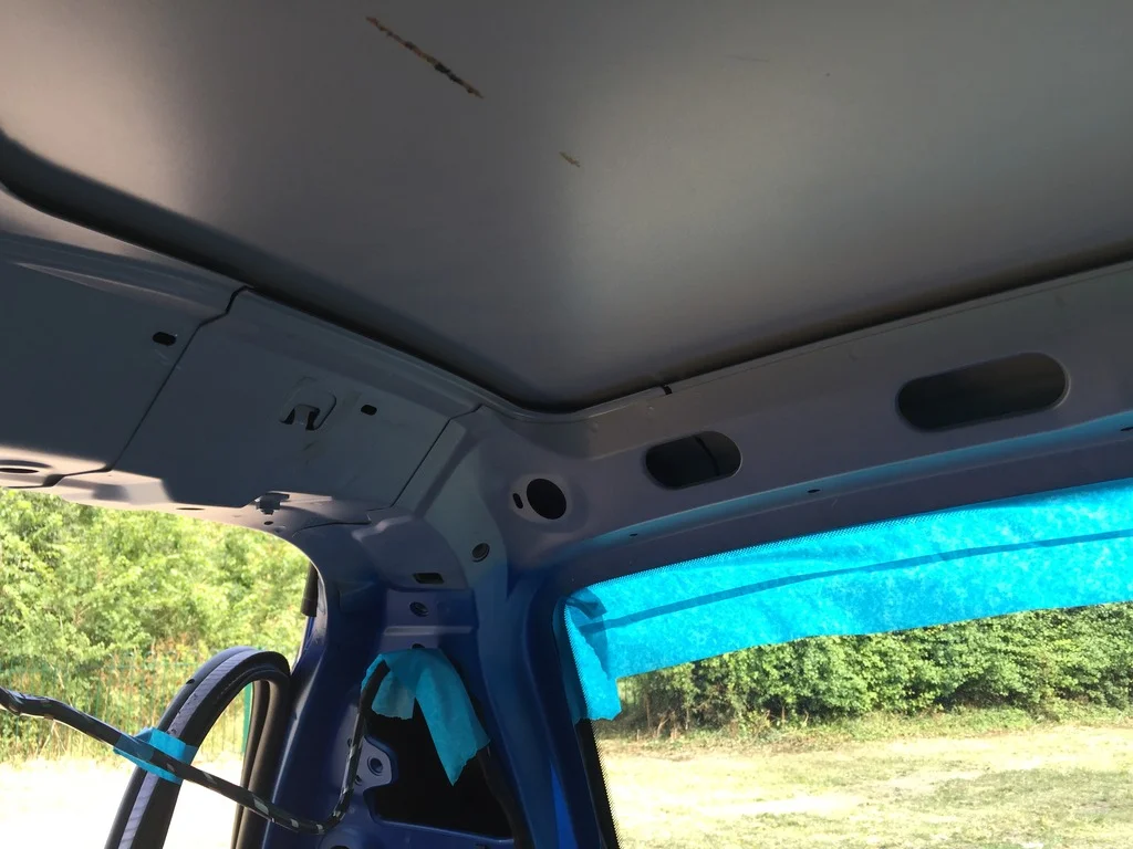

Finished up the rest of the blue today and will do the roof black when I get some more paint. Ran out last week and forgot to get some more.
Makes the inside a much nicer place.

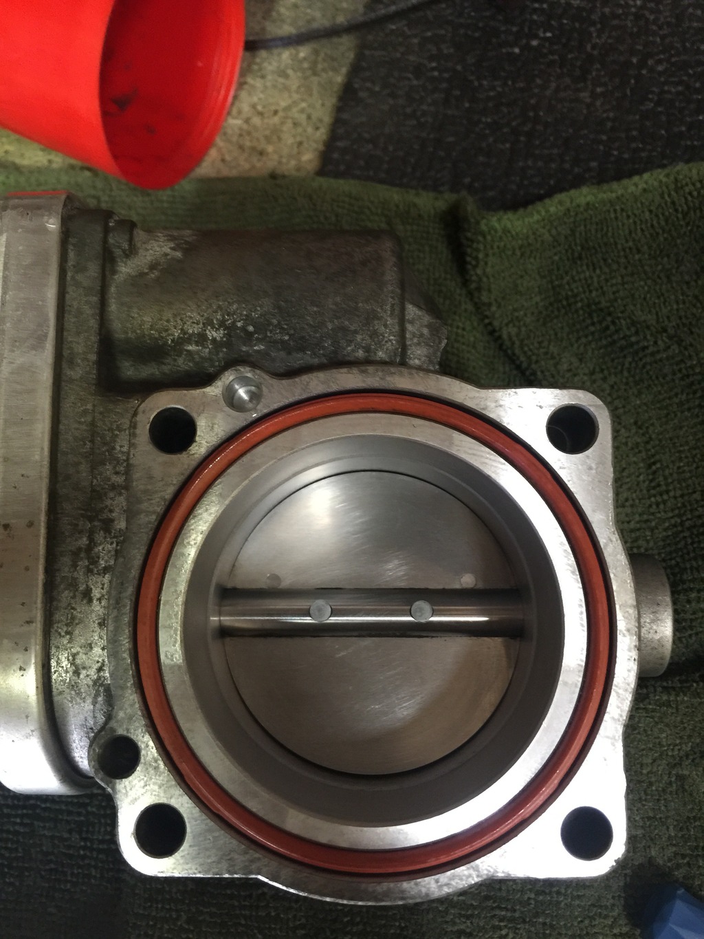

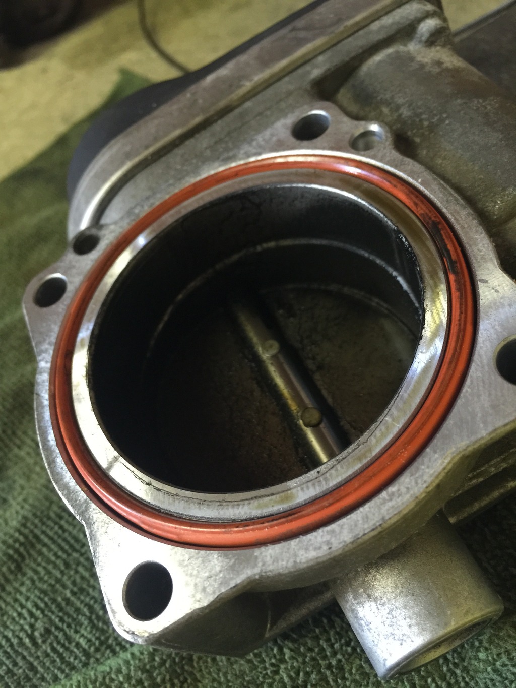

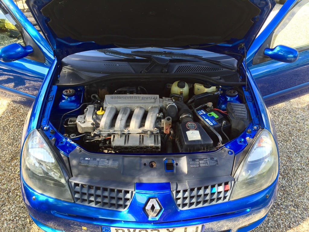

Cleaned out all my airbox and throttle body aswell as removing the acoustic valve and fog lights ready to fit my cold air blanks.
Removed my passenger airbag and fitted my new rear omp brace.
Definatley feels better and the car drives fine so will be fitting my new items soon. I have camber shims, camber bolts, rear brakes and fluid, decat and some cup wishbones to paint and fit new bushes in.

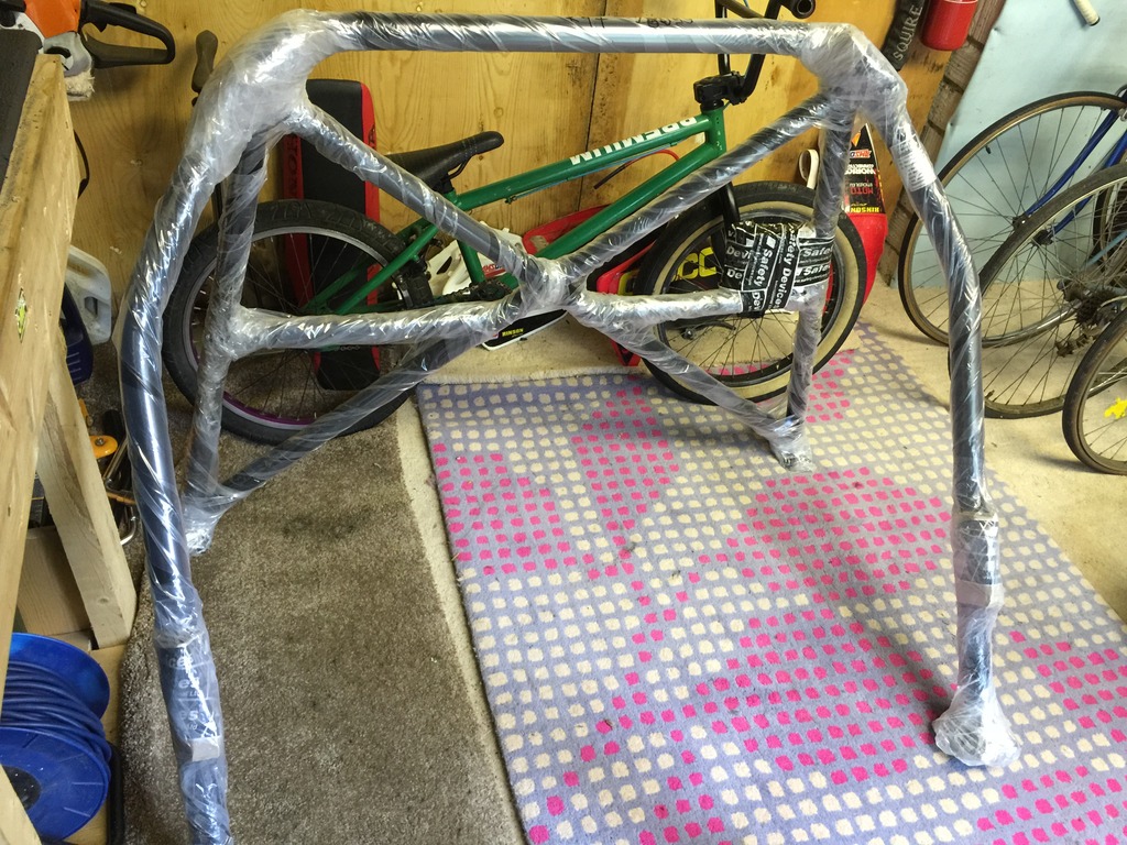

Been collecting and doing a few more essential items to the Clio.
Bought a safety devices cage.

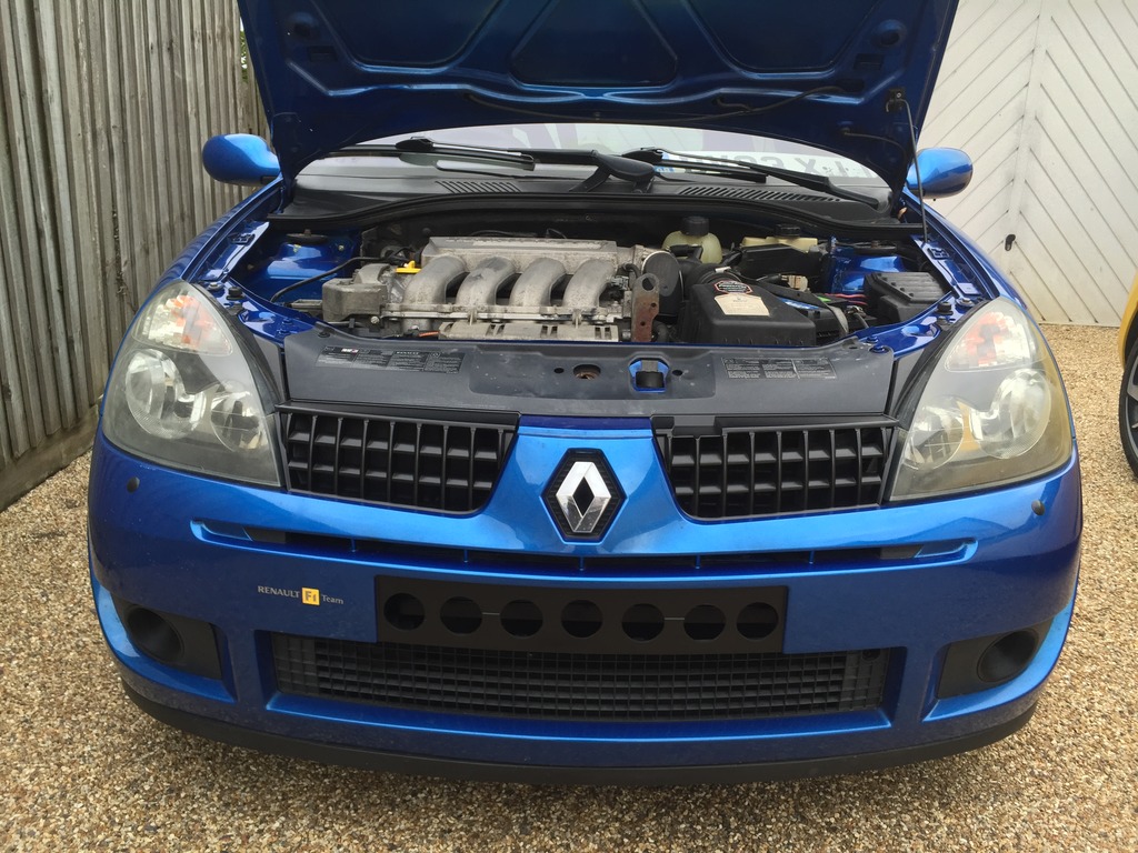

Removed the fog lights and fitted ducting to cold air feed.

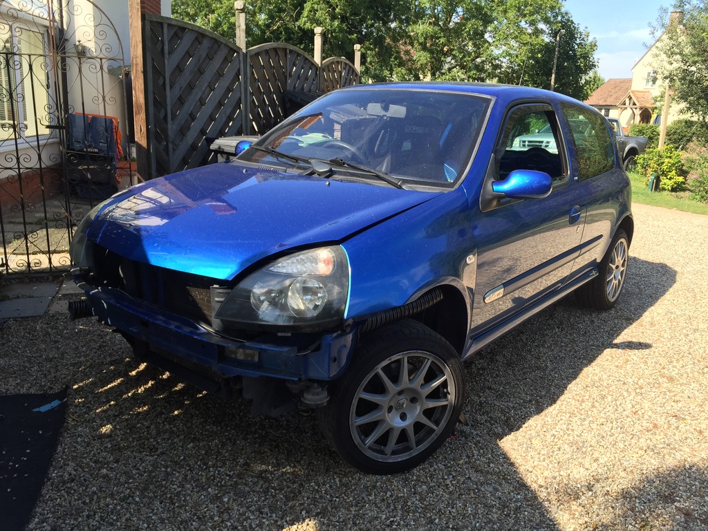

Inspected the cat D nudge up front and it's perfect, no structural at all just a slightly chipped crash bar and a new slam panel by looks of it, happy days.

Tapped in for transport to my work place so I can weld the floor plates in then drill and secure it.
Hoping to have the cage all done and brakes fitted with shims the weekend. Depending on work load etc.

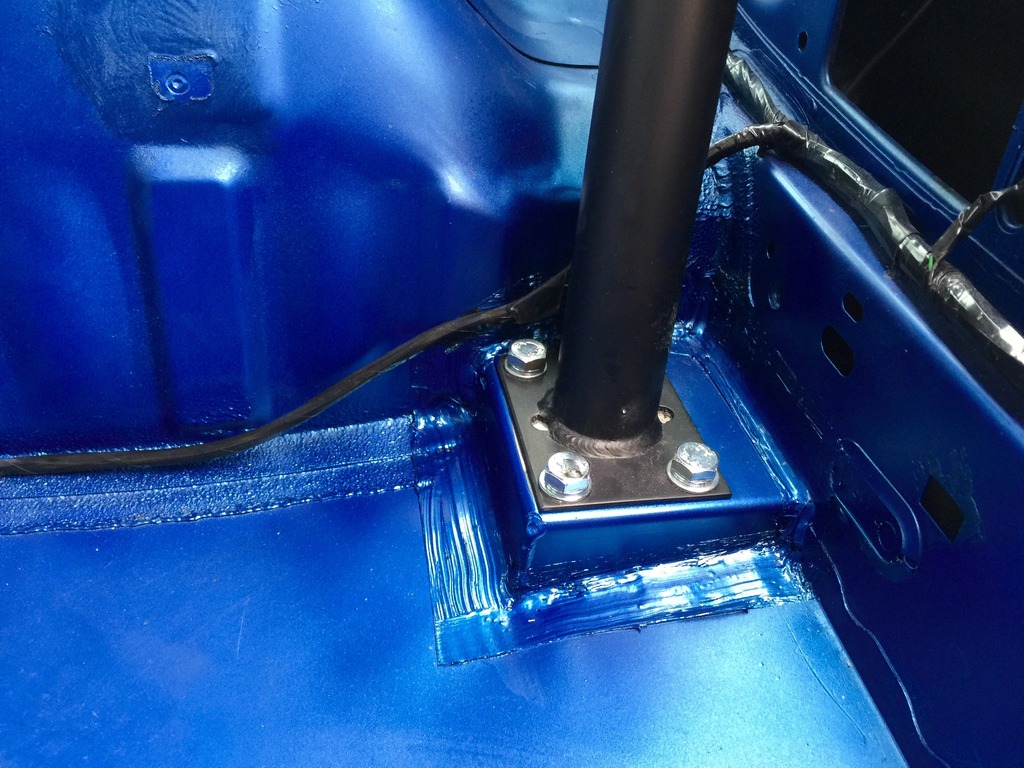

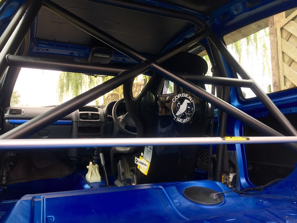

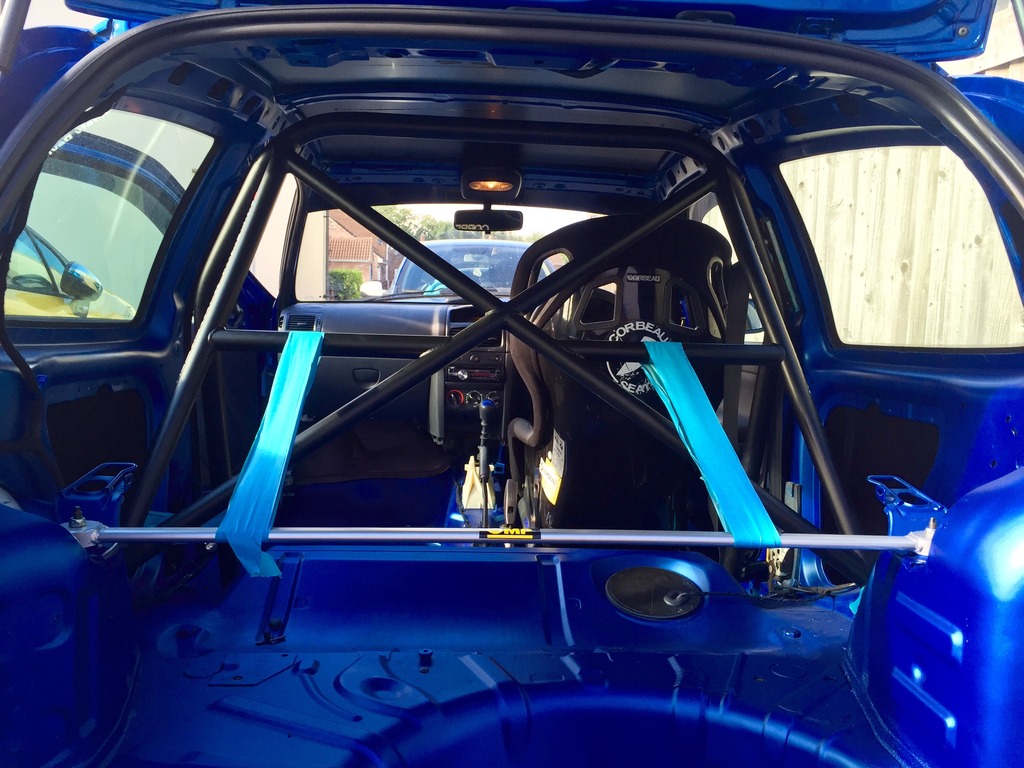

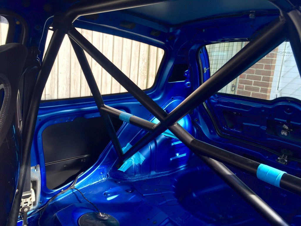

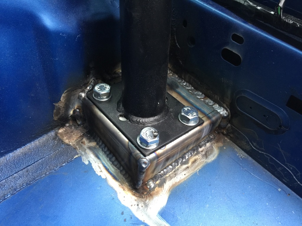

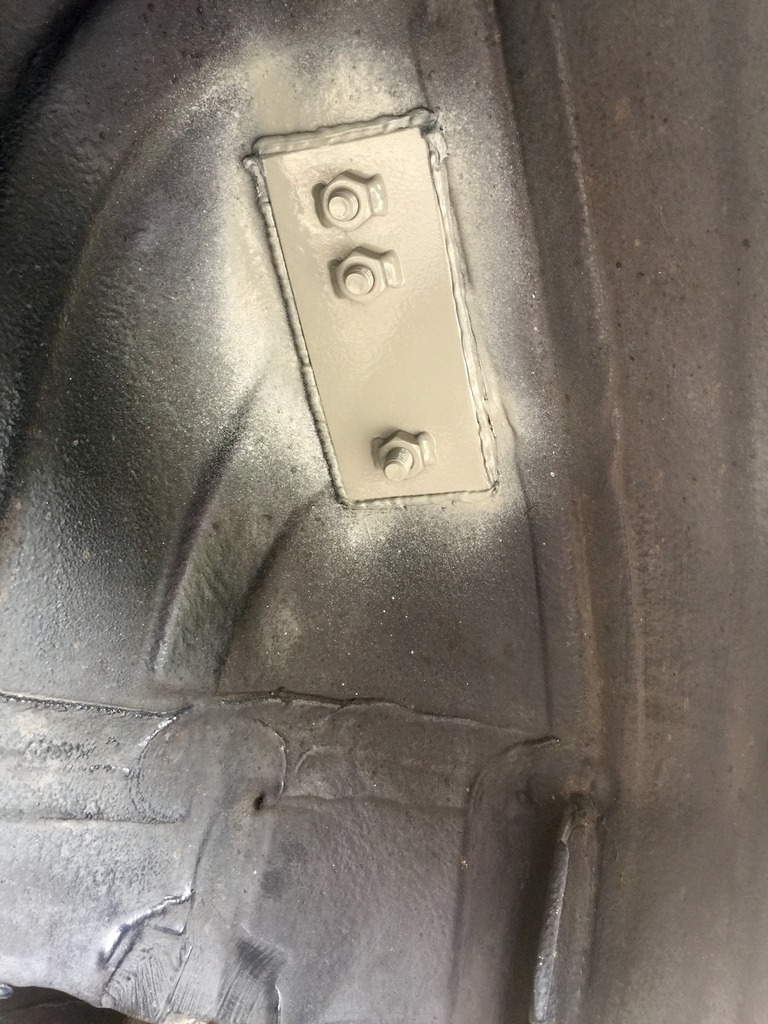

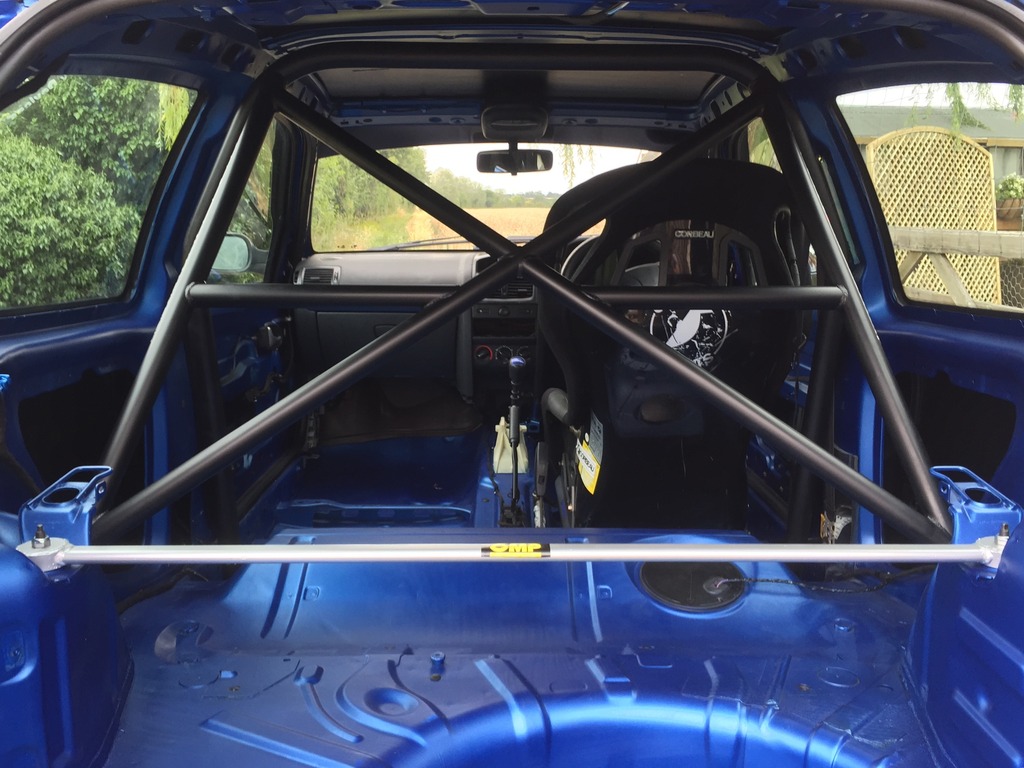

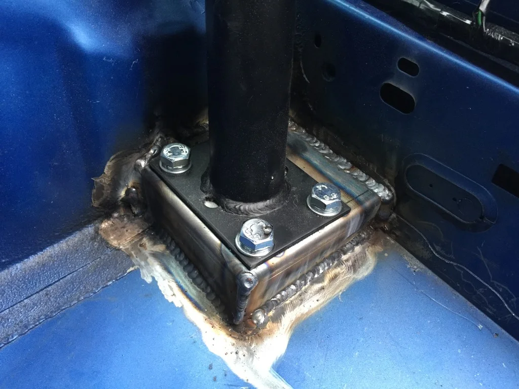

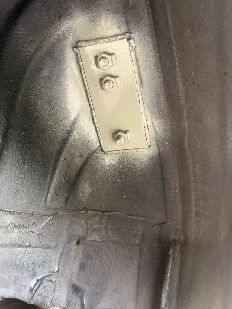

Finished welding the cage in and finalising the fitment.
Few pics of what has been done.

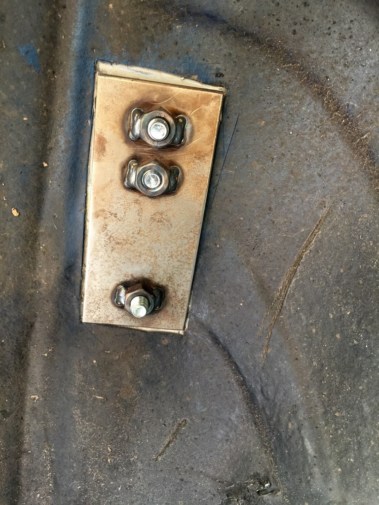

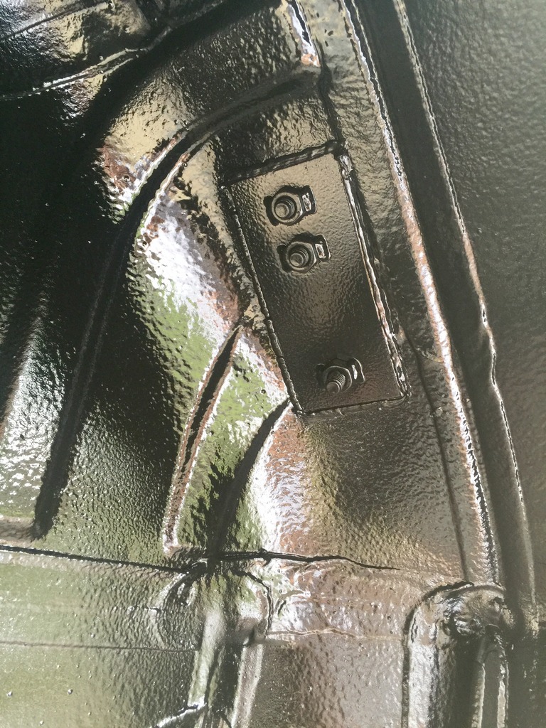

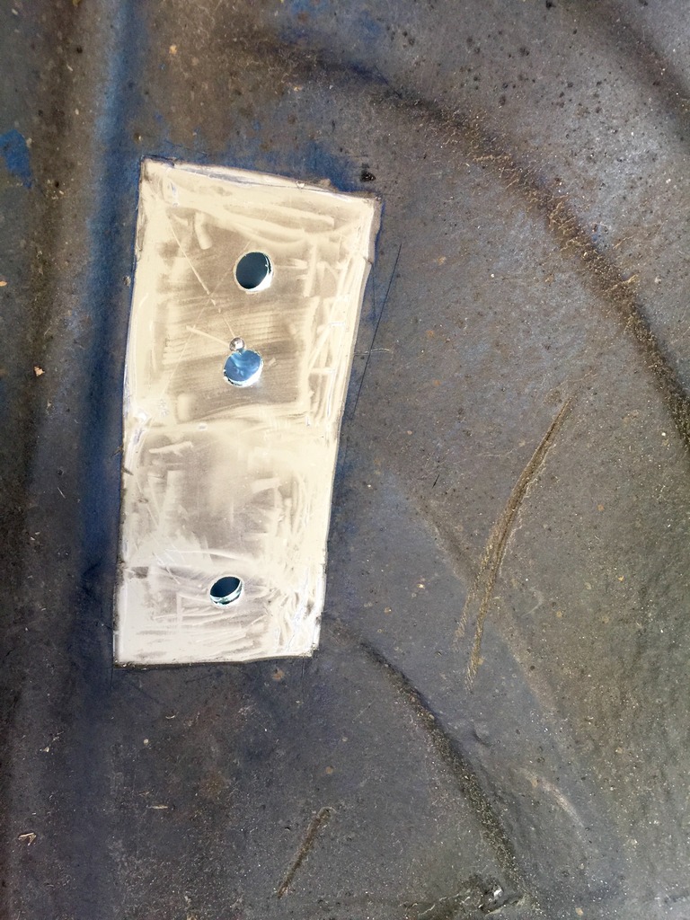

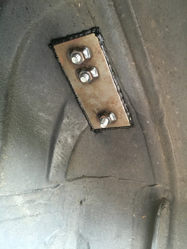

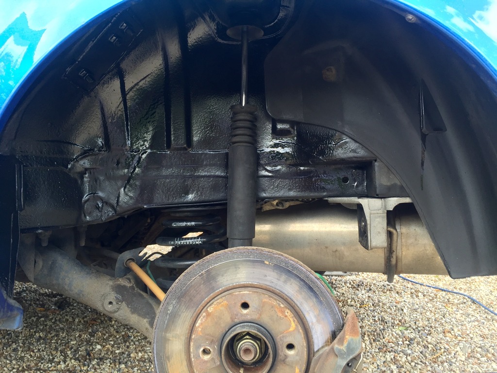

When I put the holes in for the rear I noticed the underseal/stone protection to be far to thick to clamp over so removed all of it, must be at least 5mm thick and obviously dangerous to bolt through, so marked up where needs to be removed and set about removing with a hot air gun and scrapper.
Bolted up nice and tight now, no chance of moving.
Then applied some sealer to stop water ingress.
Cleaned and then etch primed.
Stone chipped and cleaned the whole under arch to spruce it up some more.
Then seam sealed the welds over just so it looks nicer.

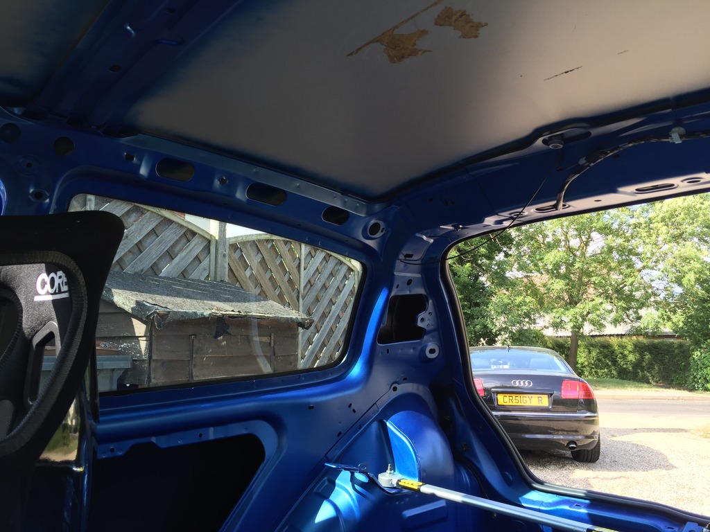

Then set about painting the rear roof section, removed the ariel, removed the stereo and speakers, few more parts from the dash and noticed I have a sniper alarm????
Grip tape is so nice aswell.

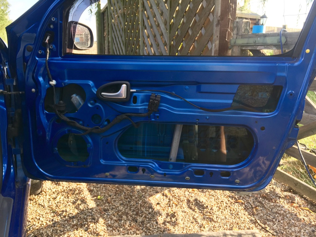

Door cards removed and wires tidied up.

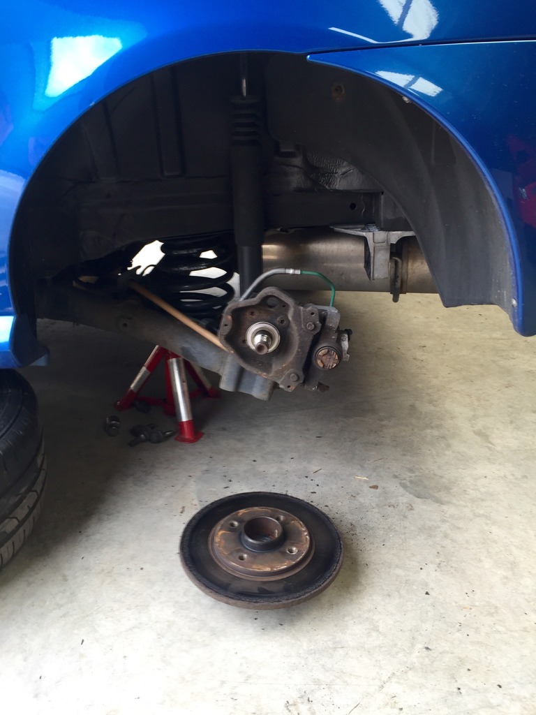

Bit of an update, fitted my rear brakes and pads, clean the whole area down and now she looks much better.
Found it nearly impossible to put the bottom pad holder back in, once it slides in the first pad that easy but it pushes it way off for the next pad, it needed de-buring but had no file to hand. But apart from that, all went well. Impact gunned it on as I didn't have a torque wrench so will check that when back at work Tuesday so all is well.
