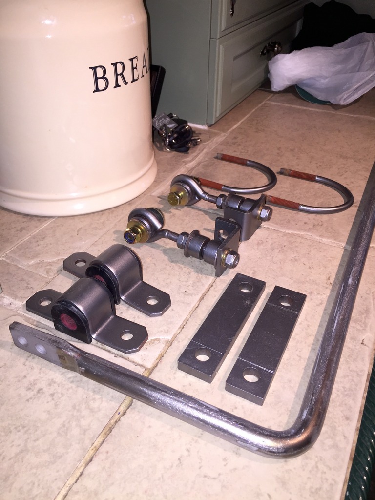

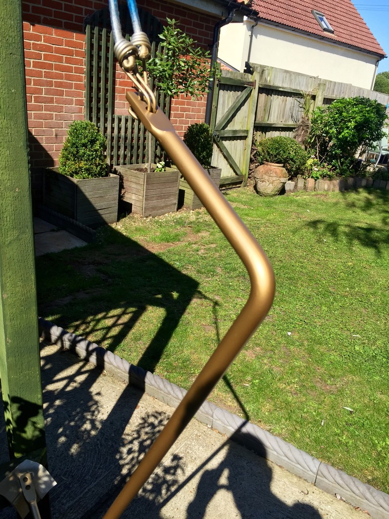

I've recently purchased a used Whitleine Rear arb and it was all rusty as you'd expect being used so sandblasted and painted it all up anthracite and put new bolts, washers and nylocks in. Much better than before as they were rust covered lol. Rear bar will be going gold as I have a fresh can in the garage.....

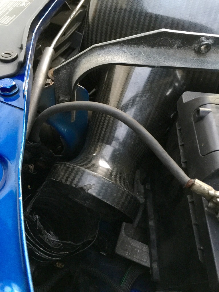

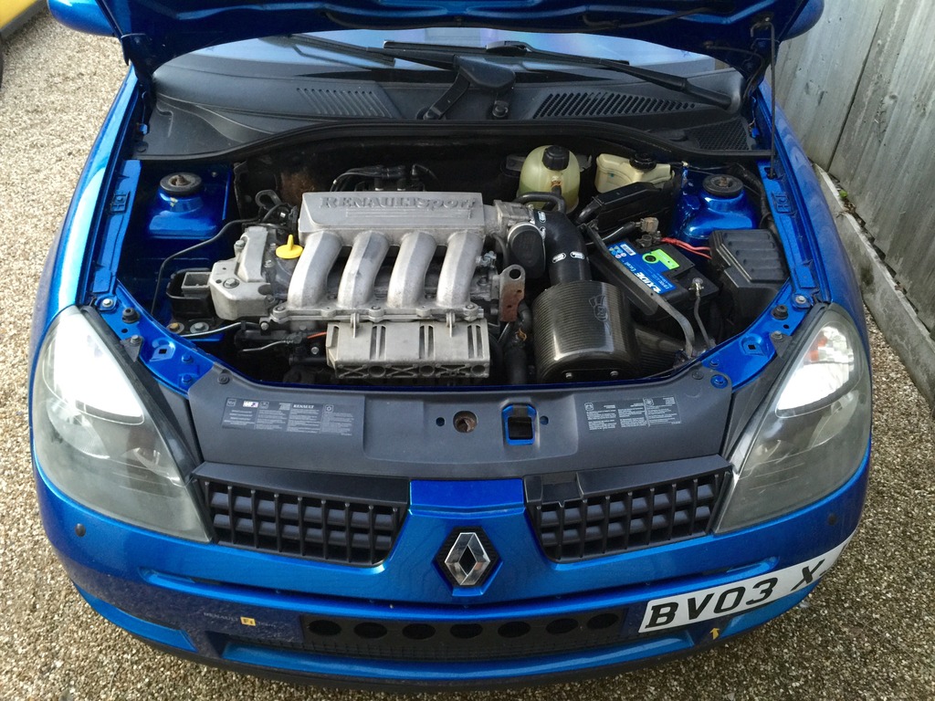

And I got a lovely piece of kit by the means of a new intake, questionably the best kit. The ITG Maxogen....
Cold air feed from the fog light duct placed until I can fit the other silicone 90* bend but I think this will be fine anyway. I have a carbon heat shield to fit also.

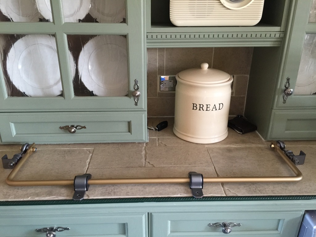

Pic of the rear bar assembled until I fit it up.

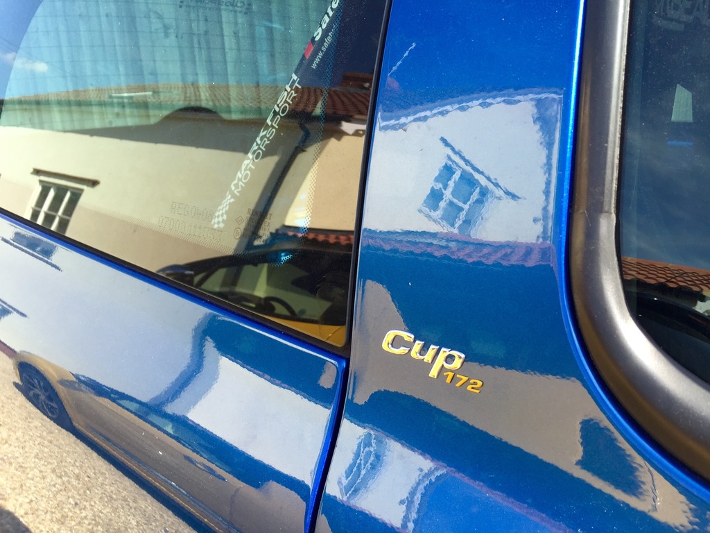

And my new side badges came today so had to put them on, £20 on eBay delivered. Can't say no.
