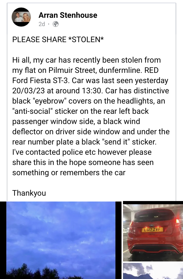

This pinged up on my FB feed the other day. Reminded me of this thread. A shame for the guy, but I did chuckle at a few things. The stickers in particular. Anyway…

Just buy an ST-1 so it doesn't have keyless.
It would be fascinating to see figures for how many have been stolen. I bet it's a tiny percentage in reality.
They had a go at my brothers. Got about 10m before the second immobiliser I fitted kicked in.

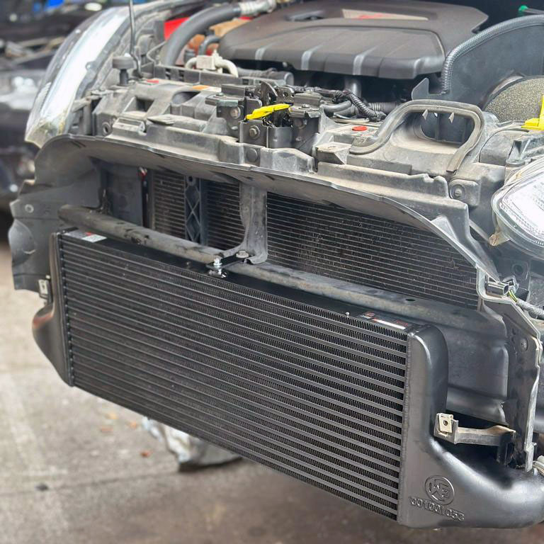

It's been a few quiet months, so time for some more upgrades. You'll be pleased to read that everything this time around is about performance rather than cosmetic, given the abuse I (quite rightly) received last time.
When I started modding the car I convinced myself that I was going to stop at stage 2(ish), i.e. keeping with the OE turbo, so when I went for the Collins CP2-E package, I opted for the Airtec Stage 1 intercooler. Predictably I've now decided I do want to go the S270 turbo route, which means upgrading to a full height intercooler, thus wasting money on extra labour and losing money on the Airtec (available for sale if anyone's interested...).

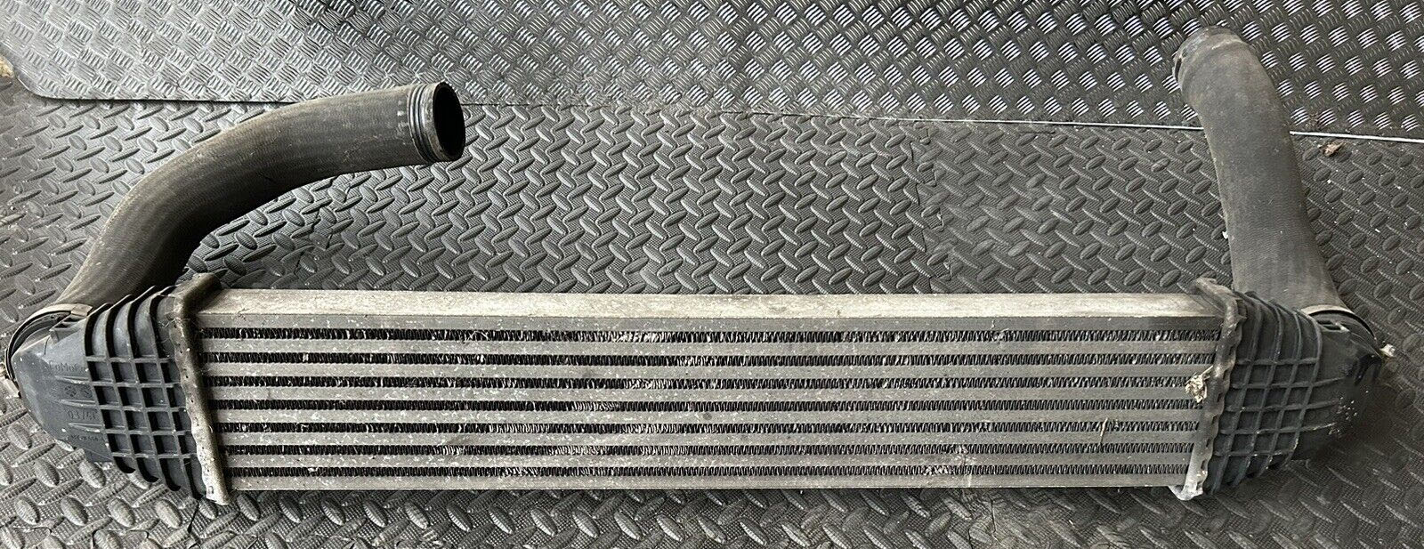

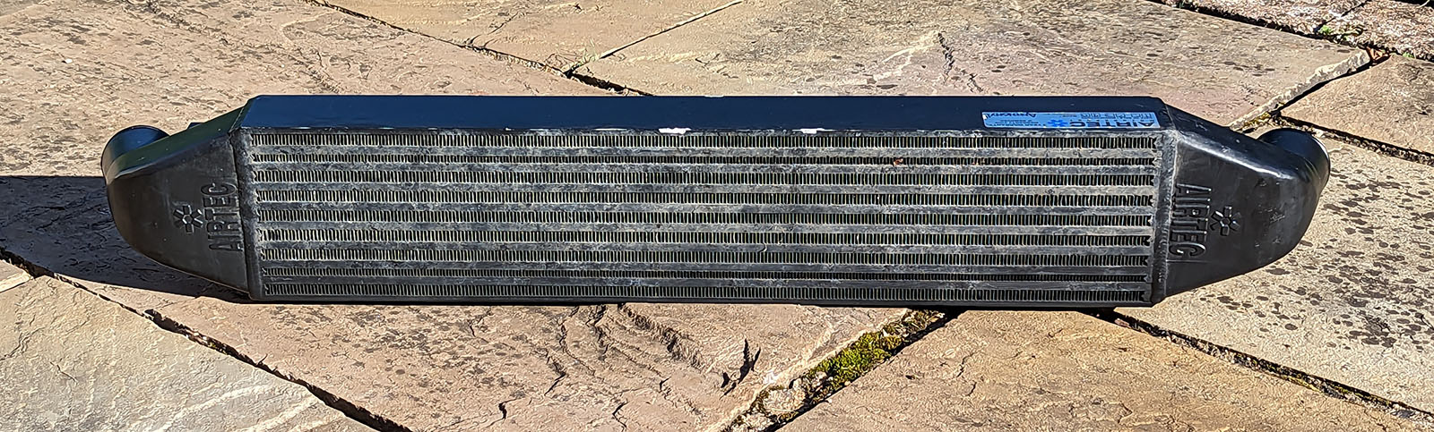

Original Intercooler:
Old Airtec Stage 1 Intercooler:
New Wagner Competition Intercooler: (With the death of Prigozhin, now a collectors item)
No noticeable difference in performance yet, but I'm still on the OE turbo and CP2-E mapping which wasn't limited by the Airtec anyway. Main thing is that it's another job out of the way ready for the CP4 / S270 turbo upgrade, probably in October.

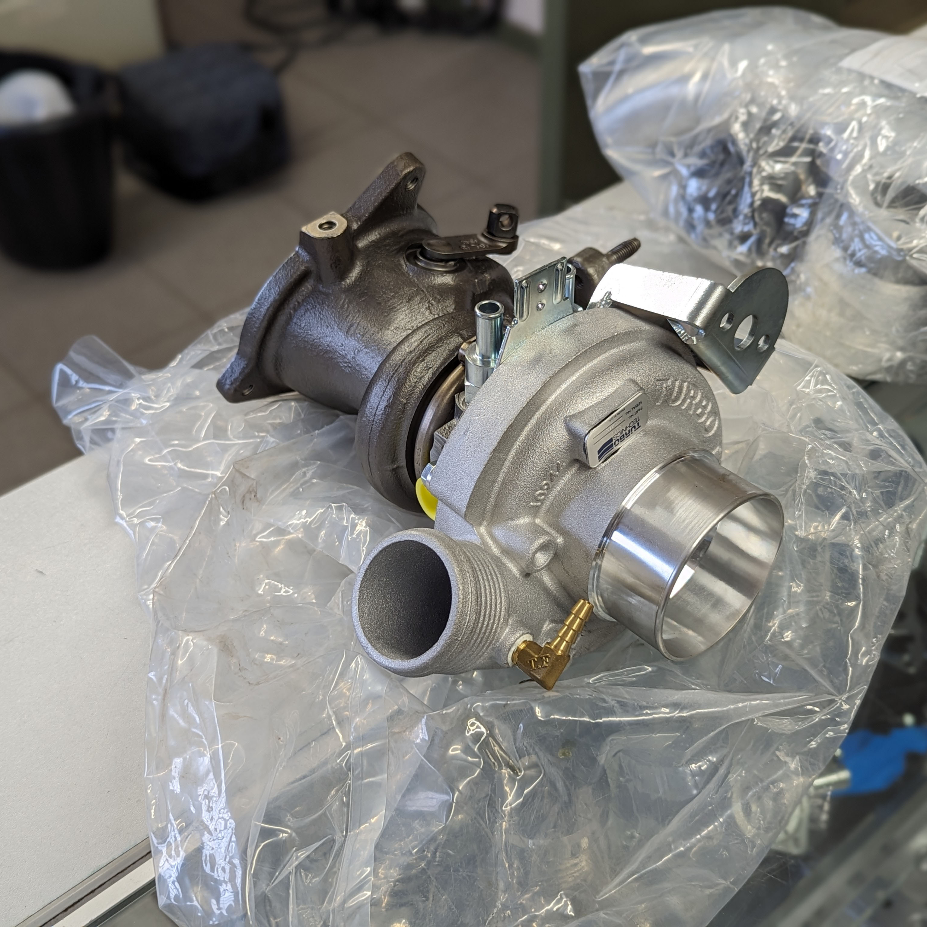

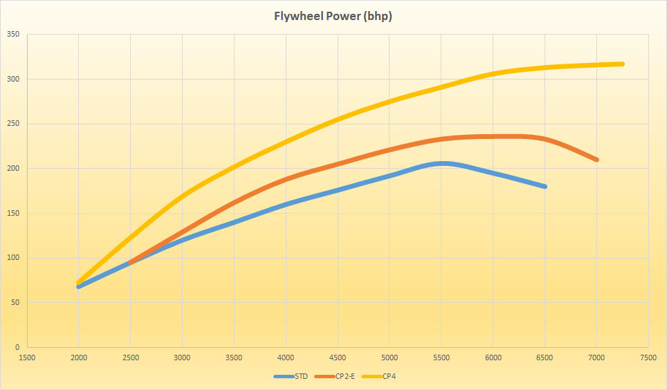

So, after the issues with insurance earlier in the year, and a few rescheduled bookings, I finally made it up to Collins yesterday to upgrade from their CP2-E tune to the CP4 (basically their hybrid turbo package). Gratuitous snail pic:
While it was up on the ramp I also took the opportunity to have some lowering springs fitted along with refreshed rear beam bushes. That brings the spec up to:
- Milltek turbo-back (sports cat)
- ITG Induction kit
- Wagner intercooler
- TT S270 hybrid turbo
- Eibach springs
- CP4 map

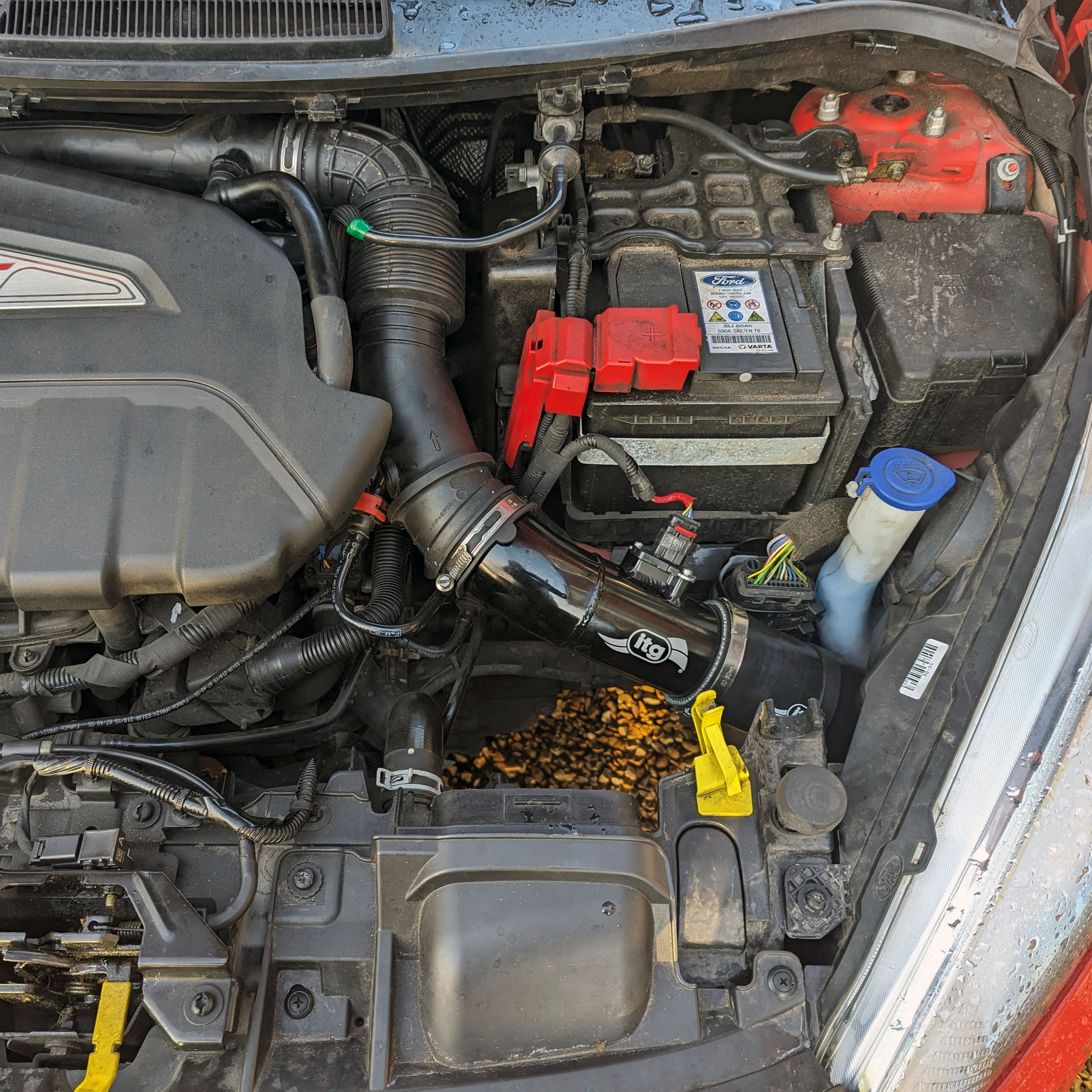

On Gary's advice they swapped my Revo induction for the ITG as their CP4 map doesn't seem to play nicely with other kits. Given the distances involved I couldn't really be arsed to chance it, only to have to get it swapped out at a later date.
Everything went on without a hitch, and when data-logging it was showing 225g/s of airflow which by their reckoning puts it at 317bhp @ 7250rpm, which is pretty much the top-end of what they see on the S270s and is actually within a few bhp of a low end S280 setup. Pretty pleased with that, especially as there were some initial doubts as to how well the Wagner IC would perform. Car has a great power curve now:
(not my actual dyno run, just lifted some other dyno graphs from their website and mashed them together in Excel for a rough comparison)
By my reckoning that gives the car a power to weight ratio around 290bhp/ton which (famous last words) seems plenty. The drive back was mostly just cruising along with traffic, but on the few opportunities I got to stretch its legs, it felt massively more powerful and so much stronger right at the top of the rev range. If the road is even a little wet it's spinning up at the top of 2nd and 3rd though, so it definitely needs a softer right foot than I've been using to date. Inexplicably it even apparently managed 50mpg over the 180 miles I drove coming home.
Being honest, I think the old CP2-E setup was probably the sweet spot for all around usability, but I really did fancy having something just a bit too powerful and this seems to tick that box.
