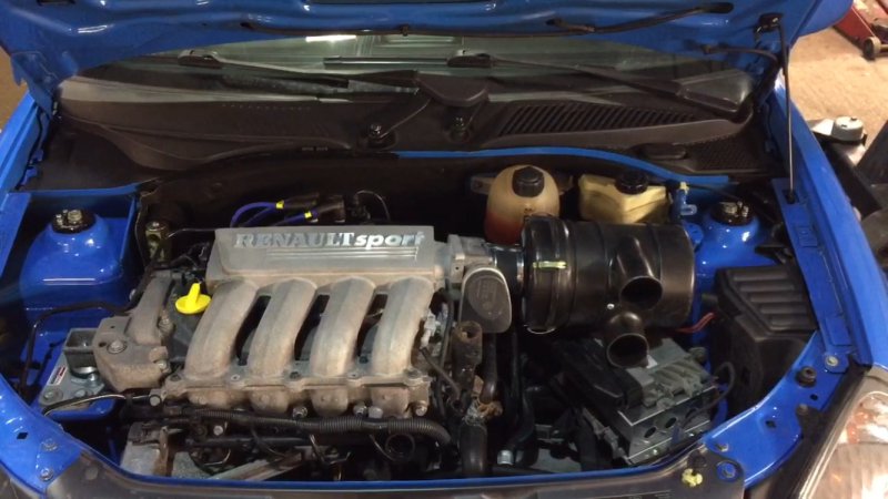

Battery mounted, ECU relocated, Ph1 airbox fitted, going to knock up some cold air feeds after Bedford next Friday, can't be bothered now, it's too late to organise some pipes.
You can also see the Magnecor leads in that picture.

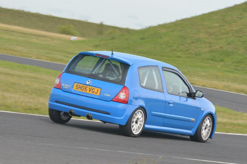

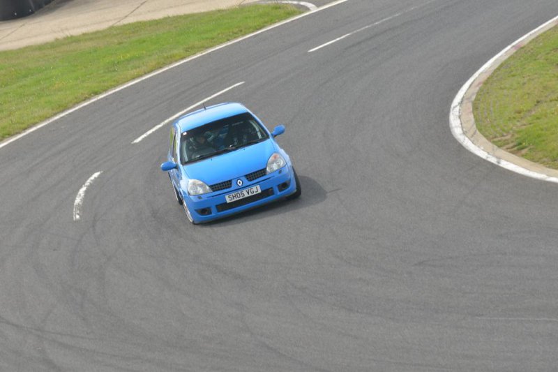

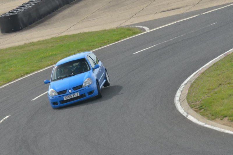

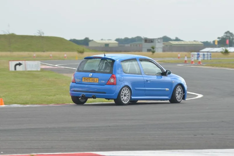

So, with that in hand, I drove to Bedford yesterday for the trackday which me and a load of mates had booked... got within about 5 miles and the snow was looking pretty bad, the mrs rang up and checked to see if it was still on but no, it was cancelled. A minor inconvenience for me and her, bigger problem for one of the lads who was at Corley services, after having driven from Liverpool!

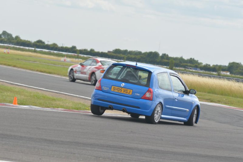

I've finally driven the car on track!
Every other time it's been the wife but this time, me, my mate and his boss went to Bedford.

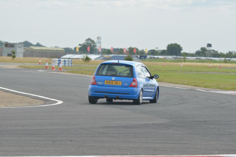

The car is awesome, I'm so happy with it, just need to learn to drive it properly now.
Few little things which need addressing, I had a power steering fluid eruption, so I need a cooler on that, the brakes overheat pretty quickly, think I'm going to knock up some ducting/deflectors to get some air to them.

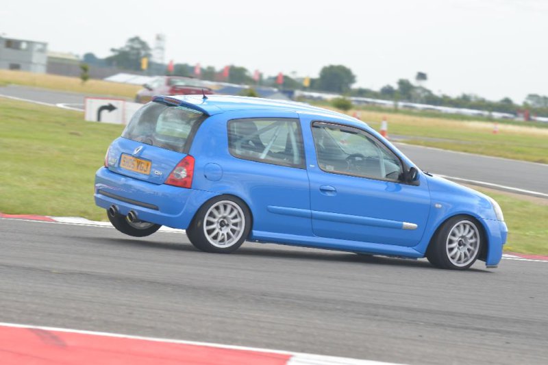

Also, the front springs are too soft, when you turn in hard the front pitches down and skips across the road as it rides on the bumpstops.
So much fun though!

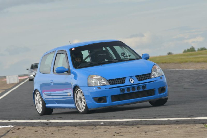

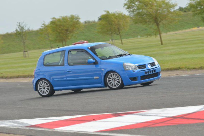

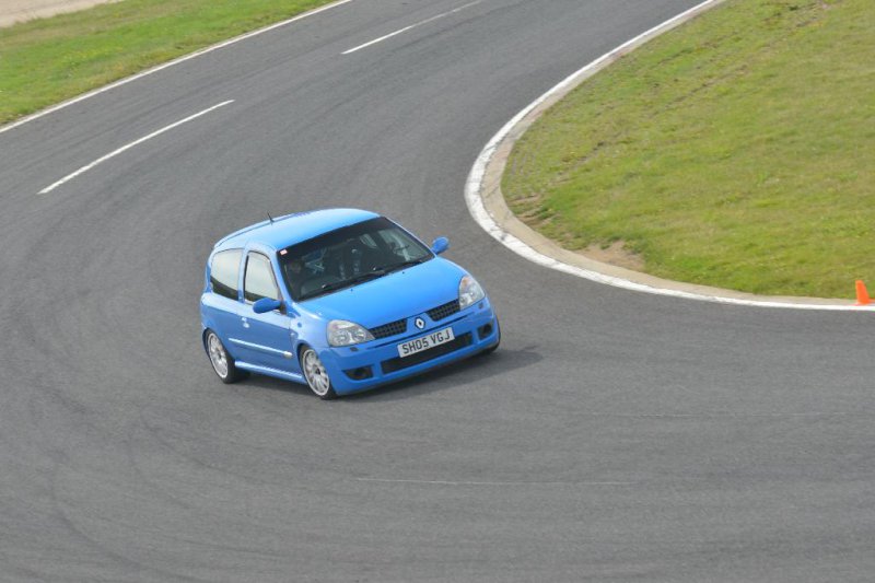

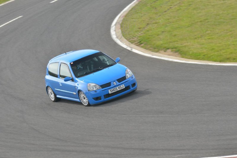

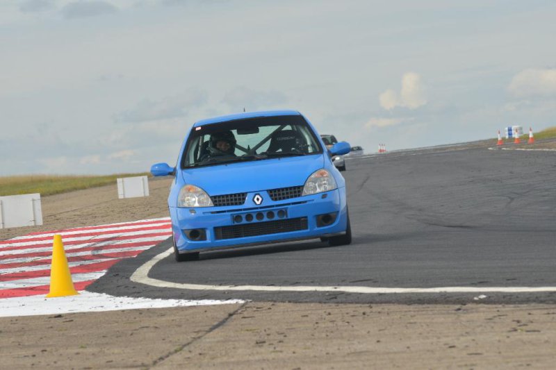

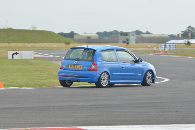

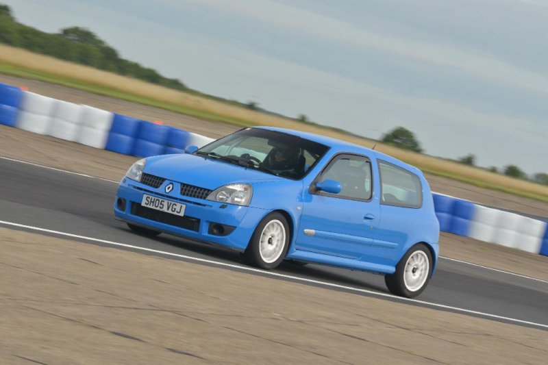

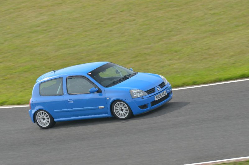

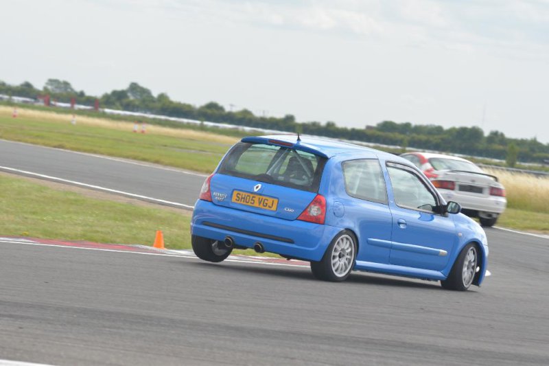

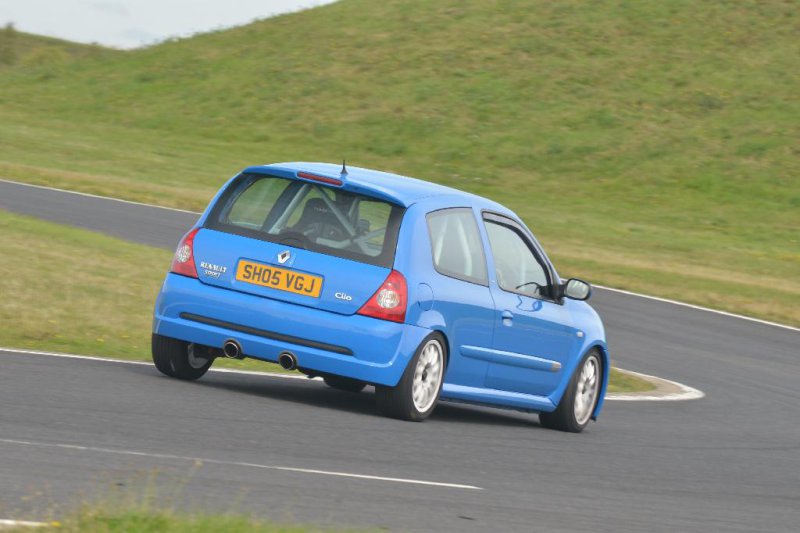

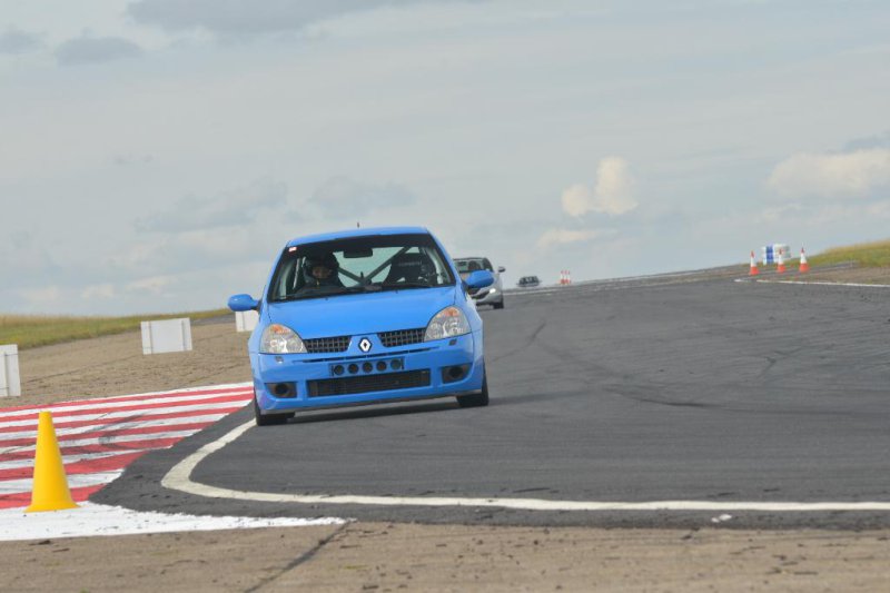

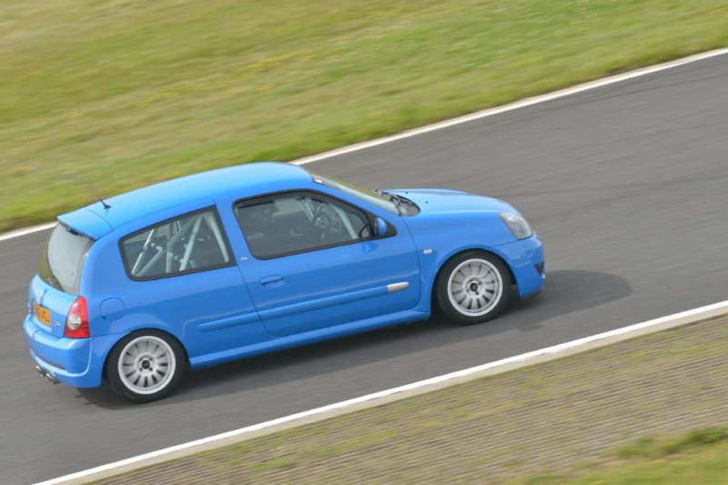

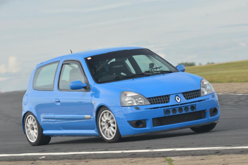

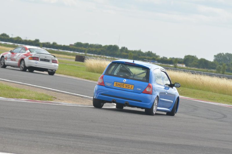

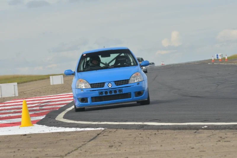

Got a few pics from Bedford from August the 1st, definitely need stiffer front springs!

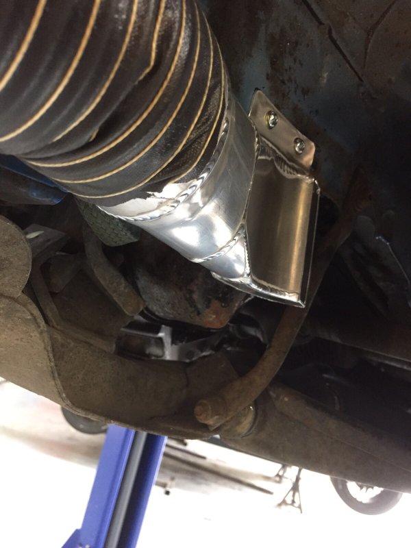

Fitted some of the eBay brake ducts which seem bang on, fit is decent and they look better than without fog lights.

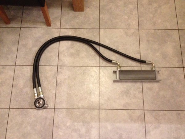

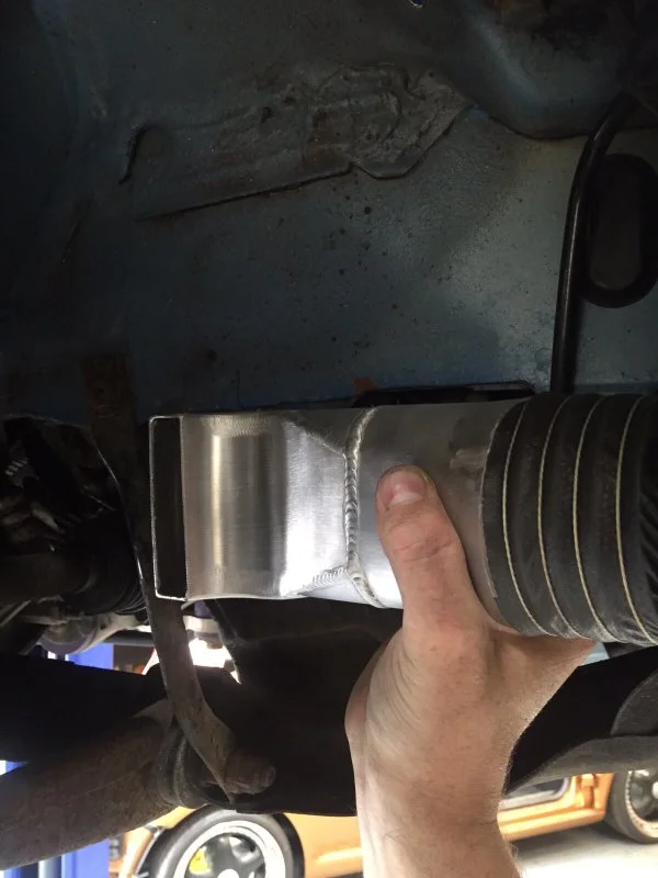

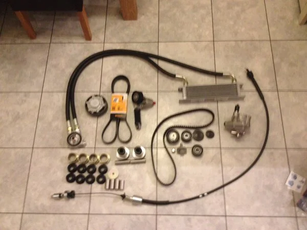

So the car is currently at JC Weldfab in Wellingborough having a power steering cooler fitted, the exhaust altered to remove the awful flange setup on the manifold which keeps blowing.

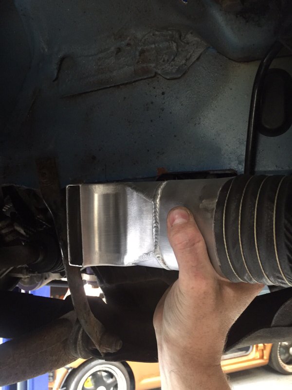

I'm also having them make me some funky brake ducts out of aluminium, pics to follow.
I'm liking the sound of the power steering cooler. I take it its to stop the fluid from boiling on trackdays ? Got any pictures ?

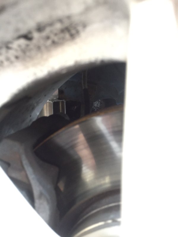

It's the room behind the spokes I'm concerned about but there's only one way to find out! (When this weather improves)

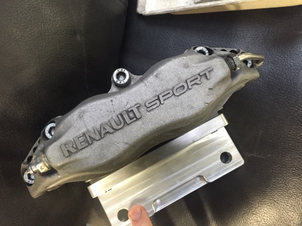

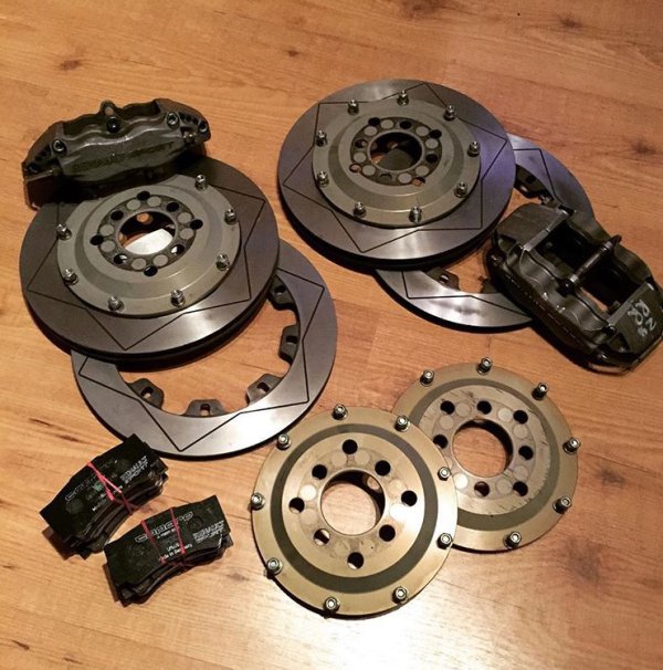

Well they look like they've got the same or more of an offset on the disc bell than the oe disc, so I'd be reasonably confident they'll fit fine.
I know the Meg brembos fit behind the team dynamics on 280's with a small spacer.
Mocked one up behind a wheel the other day and they do fit so it's game on!
They're currently back with JC Weldfab to have some new bells made up with the right PCD and centre bore, then the brackets will be made up and they'll be on
