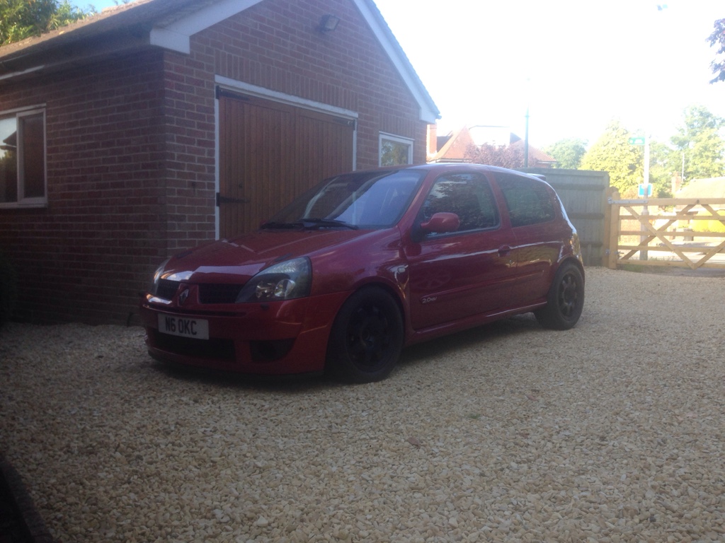

What spring rates have you gone for cubby bear?
I've got my ASTs fitted to the new car. I'll be at the Oulton Rs day in that.
Curtis got them to me in 6 weeks, they came from Holland so pretty good service really.
Ph1 Tom
The recommended 450/450 setup. But I've got an uprated front ARB to fit...at least I hope it fits, it should in theory! Breaking boundaries never before attempted
I opted for the double digressive pistons, Curtis hadn't tried them on a Meg before so they're a trial set really.
It'll be another 2 weeks or so before I get the car back home. It's getting a front end refresh, powerflex adjustable bushes, alignment and new exhaust mounts so it's ready to track this year.
Cub.
So, ASTs got fitted today and the car had its geo setup :) I've also packed for Anglesey and the power tour so looking forward to getting the Clio back on track and out and about. Been a while since it was used in anger.
First take on the ASTs - stiff, and not well suited to country lanes compared to the billies, but that is exactly the point!
The go pro is charging, sorted my insurance out so its all good to go and I'll hopefully have some vids of it to update next week :)

Spec update so I can keep on top of the changes made;
Engine
- 182 Engine, rocker cover painted white, block painted black.
- Rotrex Supercharger kit with associated boost pipes.
- Gen90 ECU
- Toyosport Intercooler
- Custom Roose Motorsport hoses
- Samco Coolant hose kit
- Magnecor Leads
- Mocal Oil Cooler
- Mocal Catch Tank
- ARP Rod Bolts
- K-Tec / Vibratec Solid Engine Mounts
- Matched Inlets
- K-Tec 3.5" Recessed Supersports exhaust
- Megane Injectors
- 102k miles, new cambelt, dephaser, aux belt, megane keyweyed pulley and megane crank bolt fitted and timed by Dan@SJM
- Powdercoated inlets, fuel rail guard, engine mount and brackets
- Bosch S4 battery
- Air con delete
- Nimbus heatshield
- Mapped by RS Tuning, Rolling Roaded at 248.7bhp and 220 ft lb.
Transmission
New Gearbox
- Gripper LS Diff
- PMS Race Shifter / Gear linkage
Handling
- AST 5200 Coilovers with custom spring rates
- Northloopcup / BIGASH Roll Centre Kit
- Whiteline ARB
- Eibach Hubcentric Spacers (16mm front, 5mm rear)
- PMS Solid Top Mounts and Strut Brace
- Eibach Camber bolts
- -2.5 deg camber at the front, 10 mins toe. -1 deg camber at rear
- PMS Stud and Nut kit fitted
- 15 Speedline Williams wheels with Dunlop Direzza 03g tyres
- Cup wishbones fitted
Braking
- Brembo 4 pots (Megane 225)
- Custom HEL braided lines
- Custom Chris Powell Brembo brake brackets
- ABS delete (incl. Loom), full Cup brake lines and MC setup fitted
- Ferodo DS1.1s, Ferodo DS2500s rear.
- Brembo grooved HCs (Front)
- Renault OEM Discs (Rear)
- ATE Super Blue Racing brake fluid
- Fog lights removed and no arch liners
- brake ducts
Interior
- 2x Sparco Evo 3 Bucket Seats
- OMP Subframes
- OMP 3" Harnesses
- Custom Oreca / Renaultsport 330mm Steering Wheel
- OMP boss
- 6 point Roll Cage
- K-Tec Rear Boot Mat
- Renaultsport Front Mats
- Sony CD Player with Ipod Connector
- White Dash Strips & Gear Insert
- Alcantara Handbrake Cover
- Rear Strut Brace
Exterior
Cup Splitter
- Trophy Spoiler
- Renault Sport 197 Badge
- Porsche 'Bee Sting' Aerial
- Lockable Aerocatches
