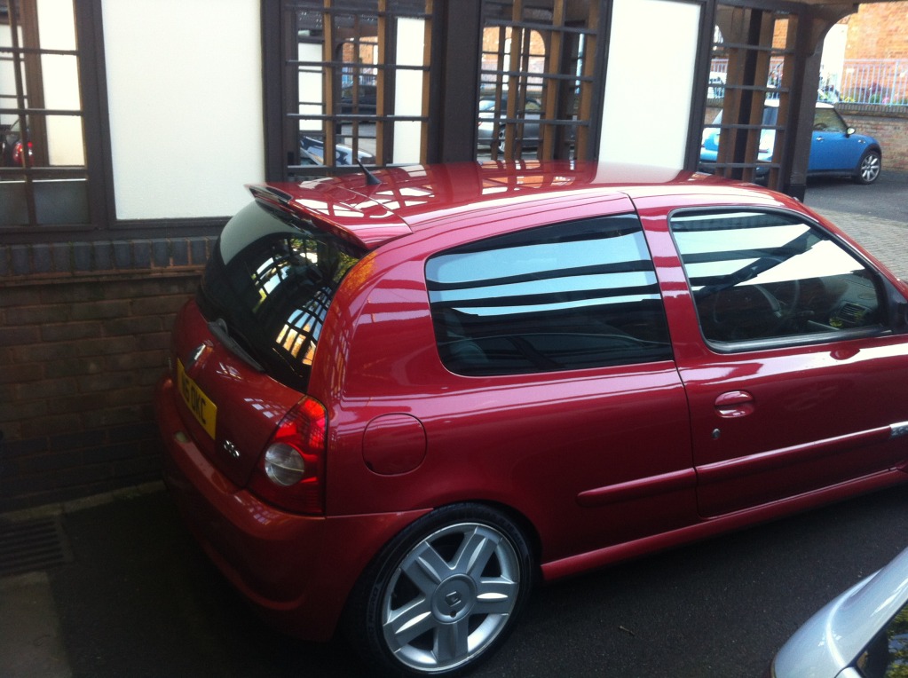

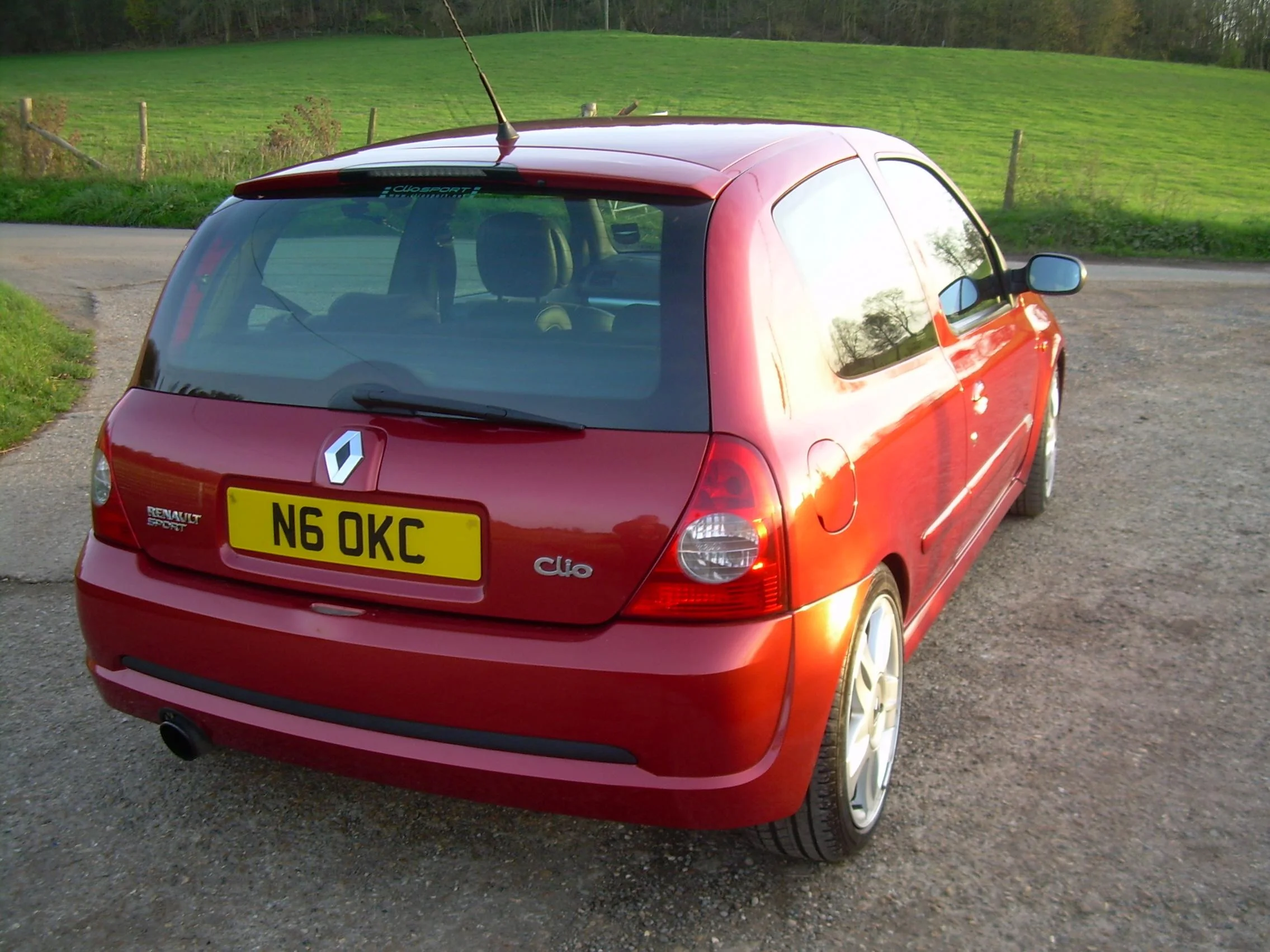

Had it about 8 months now, bought from JMS with a replacement engine and gearbox. I have a varied car background, from humble rover metro GTAs to a 911 C4S, but I wanted a 172 to be able to get my hands dirty(ish) and the plan is to make it a fast road / occassional trackday car and mod it accordingly. So, stumbled across the flamer and bought it. It had the exhaust on it and a JMS map, but other than that was standard. Since I got my hands on it it has had;
Grooved discs
Braided brake lines
Ferodo DS2500's
Bilstein B14 Coilovers
Eibach 15mm Spacers all round
Halfords badge removed, 197 RS badge on

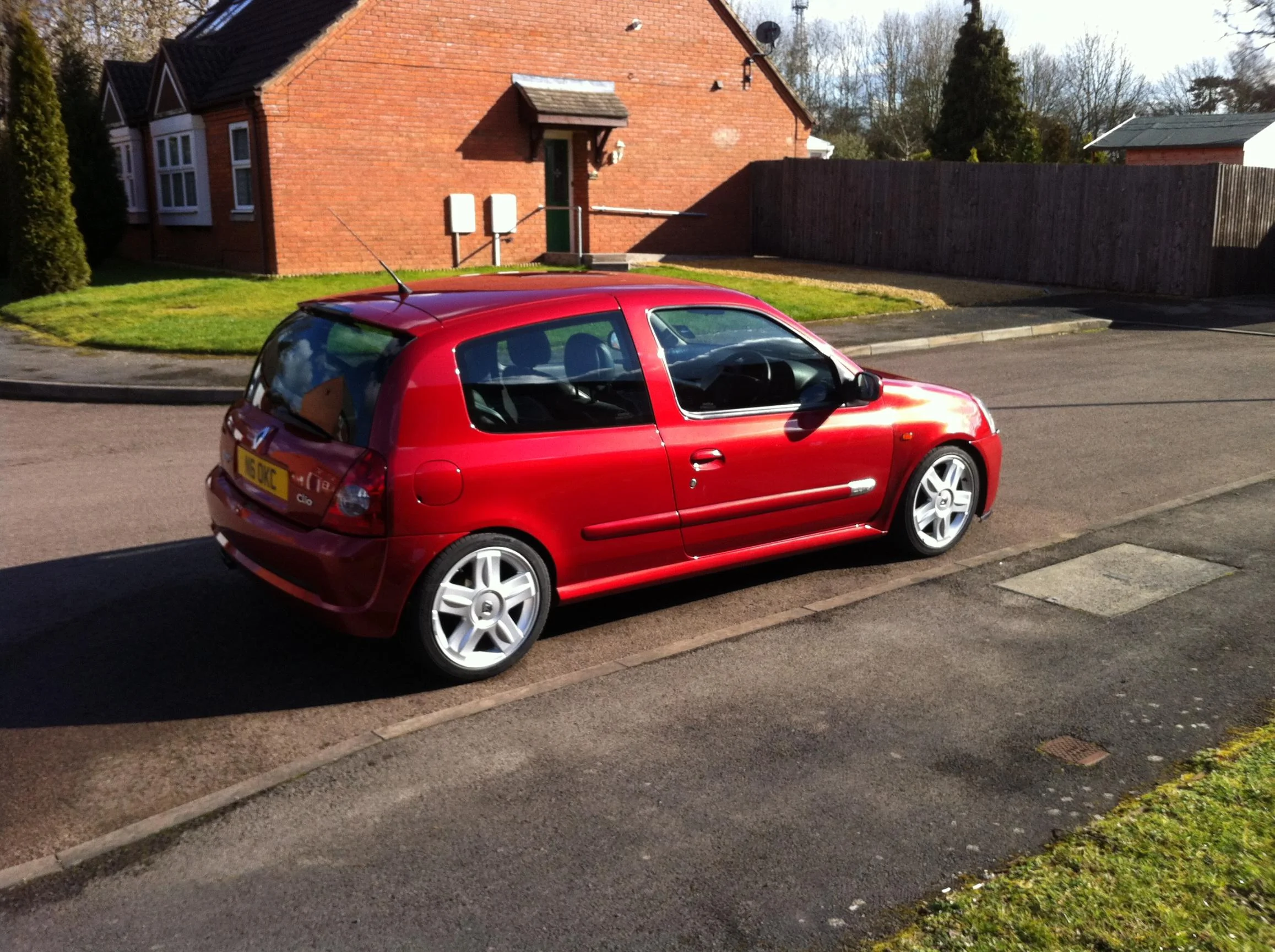

Currently looks like this;
More piccies have gone up in the media section. Plans in the new year are the following bits in the following order;
Bushes
Whiteline ARB's
OMP Front and Rear Strut Braces
Cams
ITBs
Strip out interior, bucket seats and a roll cage.
Considering getting the bullets in flame red, with yellow text. Whats the forum view on that? Hopefully see some of you at the south west rolling road day in Jan. Oh and it needs its dephaser done in Jan aswell.

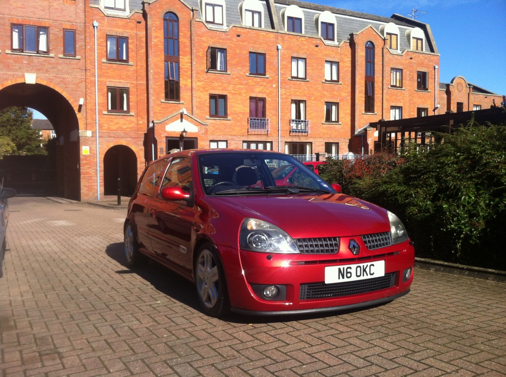

Right, a busy weekend spent on the flamer and a mates 68 Mustang notchback. Update time then, which means i'm going to re-order the to-do list on here and start scratching things off as I go along over the next couple of years. But of a lengthy post i'm afraid, but lots to capture.
General
On the whole running well, but its up for its first rolling road on 21st (southwest day on here) so we will see. I'm expecting it to be down and its booked in to stay at K-Tec for cambelt, aux belt and dephaser. Sounding like the dephaser needs doing and although the belts were done at 50k in the service book (its now on 80k) i'm getting them done again as i'm not wholly trusting of the service book. Piece of mind, and also, getting some other work done (more exciting) that means its a convenient time to do the maintenance.

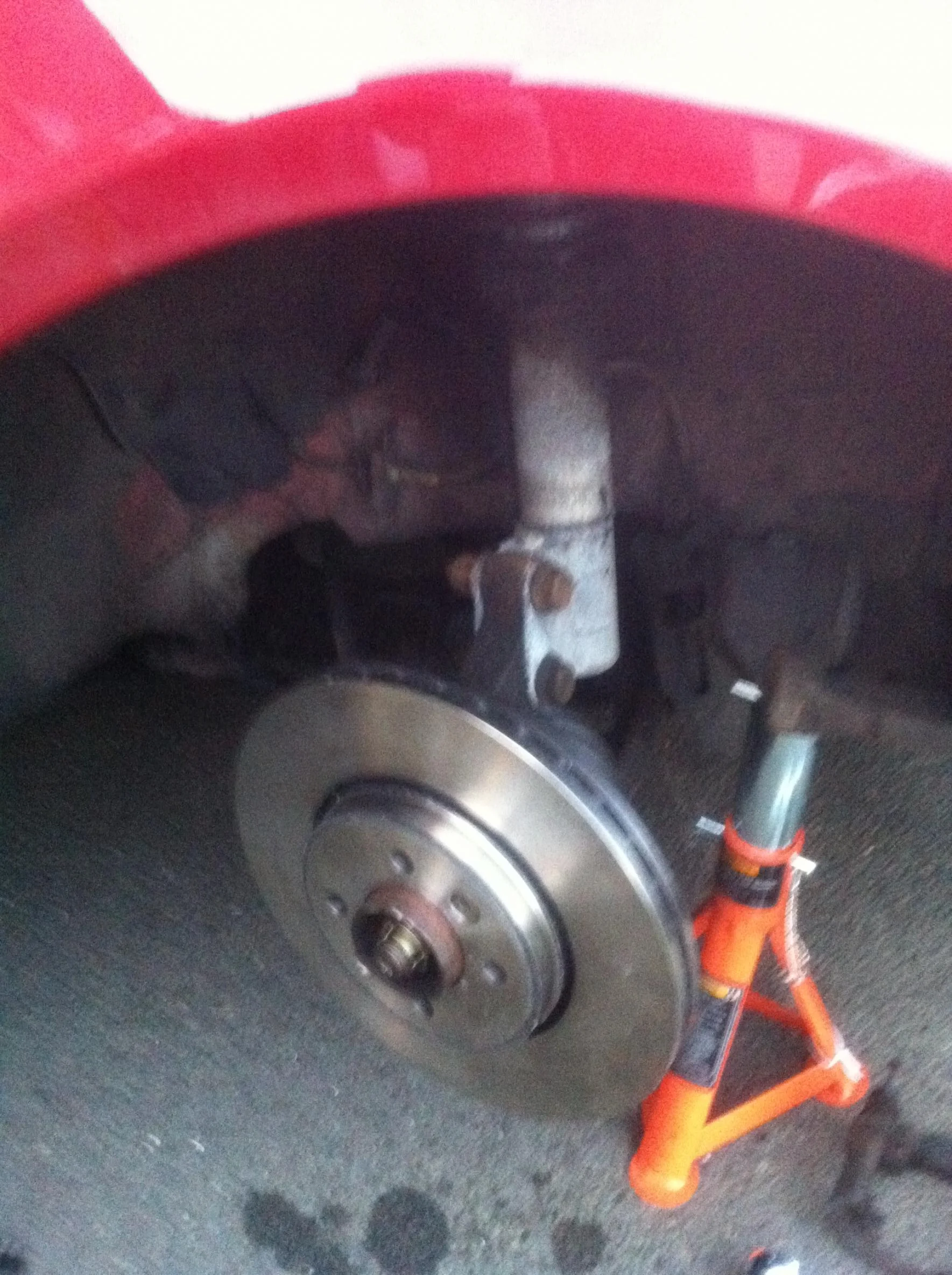

Braking
At the last MOT it didn't warrant an advisory but the mechanic advised the inside face of the Brembo Maxi discs that were on it were corroded quite badly on the inner face. Outer face looked fine still, but a PM to G 172 on here saw a pair of front Brembo HC's heading my way. The rears have brand new OEM Renault discs and I have recently put Ferodo DS2500's pads all round. So, this weekend saw me finishing the braking setup and generally having a sniff around the front arches. Sniffing around discovered the braided brake lines were Goodridge;
Then onto putting the new Brembo HC's on;
So, braking done until it starts looking like serious track work in which case a wilwood 4 pot kit and big brake disc upgrade will be heading the flamers way), and the system comprises of;

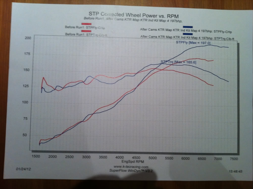

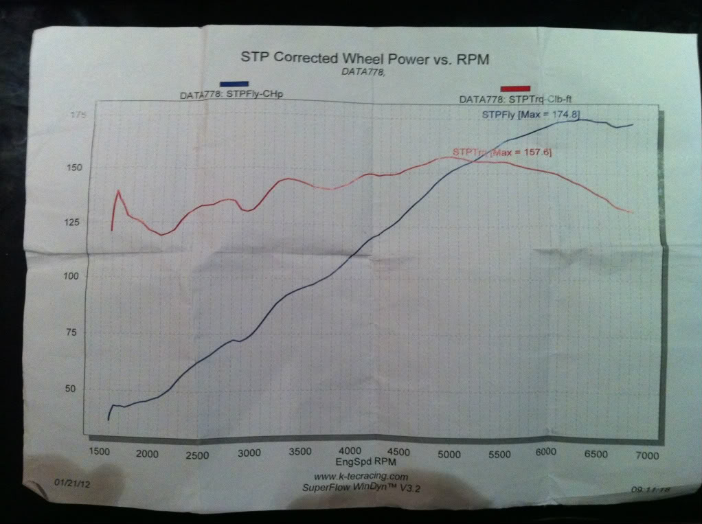

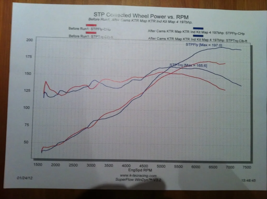

Right, update time. I took the Flamer to the South West RR day on Saturday. It ran 174.8 bhp and 157.6 lb ft. The graph should be below. I was happy with the figure as it was in need of some mechanical TLC (12K service, and cam / aux belt & dephaser).
I left the car at K-Tec for a whole bundle of things;
12k service
Cambelt / Aux belt & Dephaser
Group N Engine Mounts
Group N Gearbox Mount
Dog Bone bushes
An alternator bracket (mine had snapped off)
438 Cams
Full remap
Mike did a great job with the cams, and when Andy was mapping it, it quickly became clear that the standard induction and airbox was restricting the power. So, completely free of charge, Andy set about creating a custom induction set up using a universal breather filter and a K-Tec Megane II RS Induction hose kit, cut to fit. It was a bit of an experiment, but the effects were awesome. Great noise, and unlocked more power, and after some mapping wizardry by the guys and with all of the above done, we got a power run of;
197 bhp
165.6 lb ft
I'm well chuffed with both the overall increase (22bhp & 8 lb ft), but equally the whole feel of the car with the mounts. I love the lumpy cam idle, and with the induction changes the noise is unbelievable when you move past 4k rpm. The car pulls like a train, and feels completely transformed. Graph is below.

Re: Cub 172's Flamer Project
There seems to be a fair drop in torque at 3500rpm?
Cheers mate. Yep, i'm glad it seems to be a strong one, but even I was surprised it got up to the high 190's. Drives excellently, had a smile all the way home. Get saving for the ITB's now....
Yeah, the remap has sacrificed some lower end torque, but its not horrifically noticeable. I suppose i'll need to be hovering at 4k if I am in a mood to be making progress....plus it has pushed torque up slightly at 3k.
K-Tec Racing
ClioSport Trader
  172LBT-172HBT-197-R2
Its the cam profile that has made a small dip in the torque at 3500 rpm, in all honesty you dont notice it on the road as the response is improved especially at part throttle.
however when you want the power it just keeps pulling.
  182/RS2/ Turbo/Mk1
I would say that its not the remap, its the fact that the engines volumetric efficiency has dropped at that point in the rev range, and that you could have the best mapper in the world on the case and it sill wont match milder cams down that part of the rev range on the standard inlet.
Great results I think, for a car that you want to drive in a spirited fashion its got a really good spread of power at the points that matter on track etc, ie 5k plus.
Would be great to see the figures verified at the surrey rolling road day on saturday? As obviously everyone always takes "in house" rollers with a little pinch of salt as they have a vested interest in showing good results (not a dig at ktec, I just mean anywhere)
Clearly I've been educated that it's not the map and it's the cam profile causing the torque drop at 3.5k, lol. I have to profess, I'm no expert hence me not doing the work!
It does drive well, and the power comes through strong when called on. It was due to be at Surrey this wkd, but I have to go to Washington DC for work so had to cancel. I will see what my weekends are like when I get back, but I'll take it to Charlie at some point. Not because I distrust the k-Tec figures, because I am over the moon with how it drives and I'm more bothered about that than 'rolling road' bragging rights, but I have run cars on Charlies before so will be a good comparison.

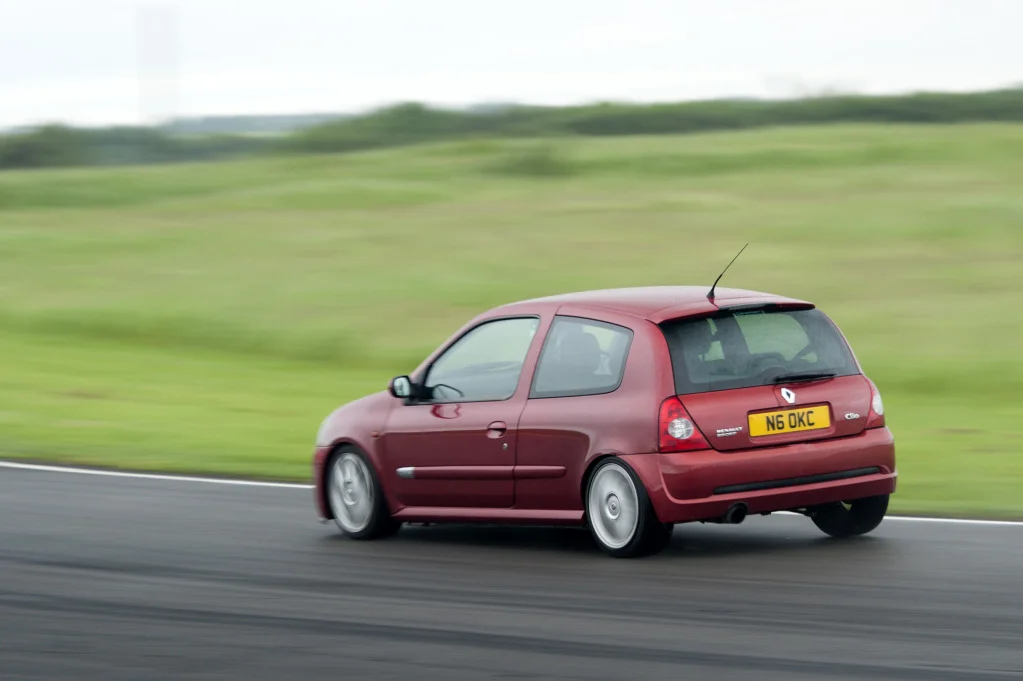

Right, been a while since I updated this thread, so whilst watching the footie I thought I would.
It came back with a nice new (used) reconditioned gearbox, with the Gripper Limited Slip Diff in. Took it off to the bodyshop to get the bumper sorted, and they did a great job. Returned the flamer in time for me to get fully re-acquainted with it before the Burpspeed Llandow trackday.
Travelled down to llandow with Tim (Trophy Claude on here) and the car was burbling along lovely. Pitched camp and met some guys off here, all of which were really friendly and a good laugh. Special mention goes to 2damnsly for helping me pitch the tent, Jay and Tony the burpspeed boys, James (BIGASH), Rhys Beal, Jamie 86, Daniel and Sam. Great bunch, and despite my ill health cheered me up no end.
Llandow was awesome, really enjoyed the day - more good banter, good to meet the failsport chaps, and the first time I got to put the flamer through its paces. It was my first track day and I was pretty nervous, but Jay (Burpspeed) came out with me for my first session and really helped - showing me the lines, and with great guidance on when to push the car and before I knew it I was settling in and really enjoying myself.
I was over the moon with how the car performed, didn't miss a beat, the LSD really came into play and it filled me with confidence allowing me to get quicker and quicker. The induction kit was certainly making me stand out as I went up the straight, such an addictive noise, and got some great comments from the guys watching as to how it sounds.
A few piccies from Llandow;
On the chase;
working hard in the wet;
Don't know why the pics may be coming out small. So, I was happy with the performance of the car, which makes me think ITB's are moving back in terms of priority. It had plenty of go for a track day novice like me, and I think i'd rather get better with the car in its current state then plump for ITBs so I can notice the performance improvement more.

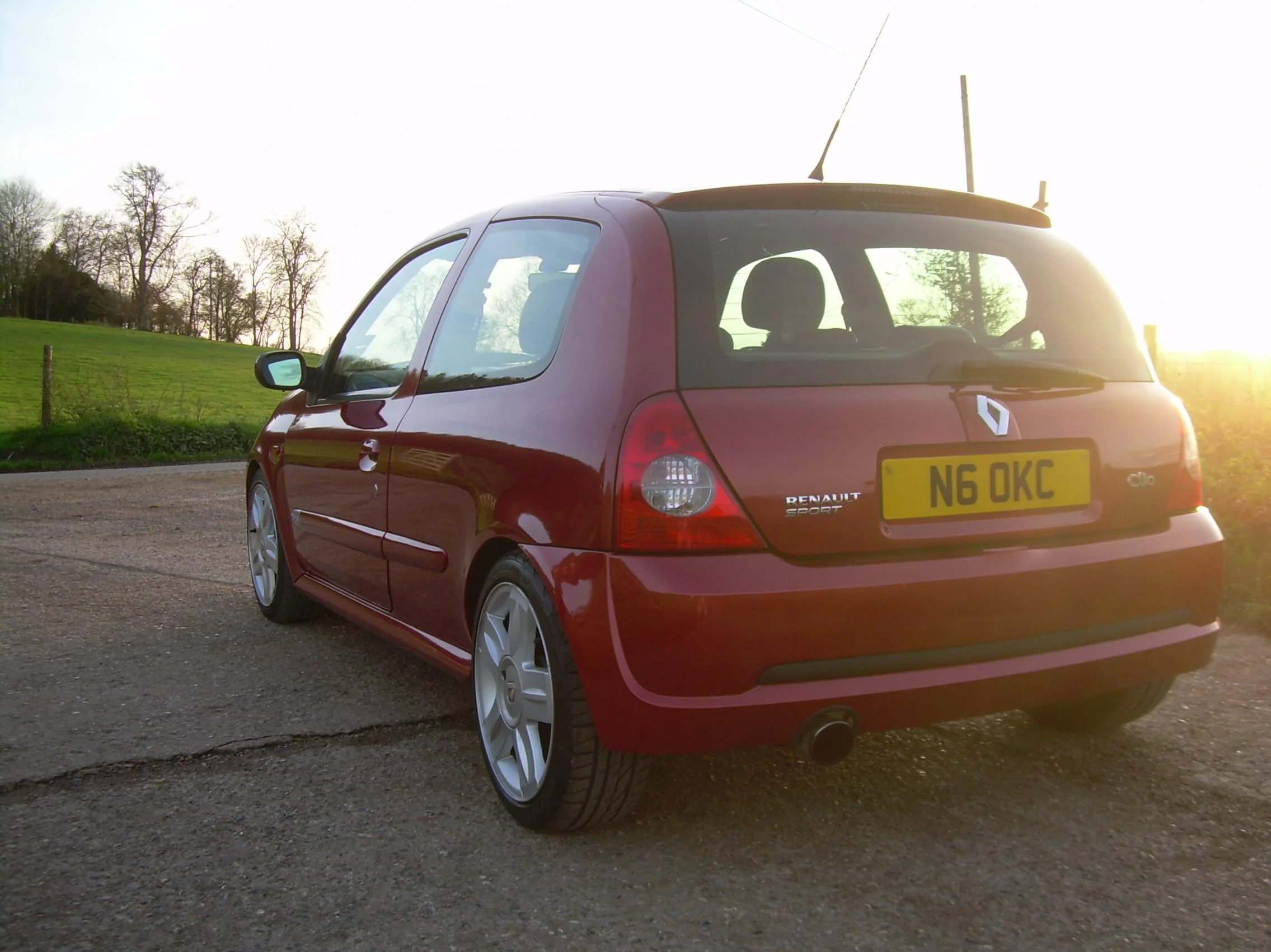

Right, small update.
In the run upto the wedding, only a few small bits and bobs were done;
- Whiteline RARB fitted, definitely a recommended mod.
- swapped the aerial for a smaller one (porsche). Theres an extra 5 bhp right there ;)

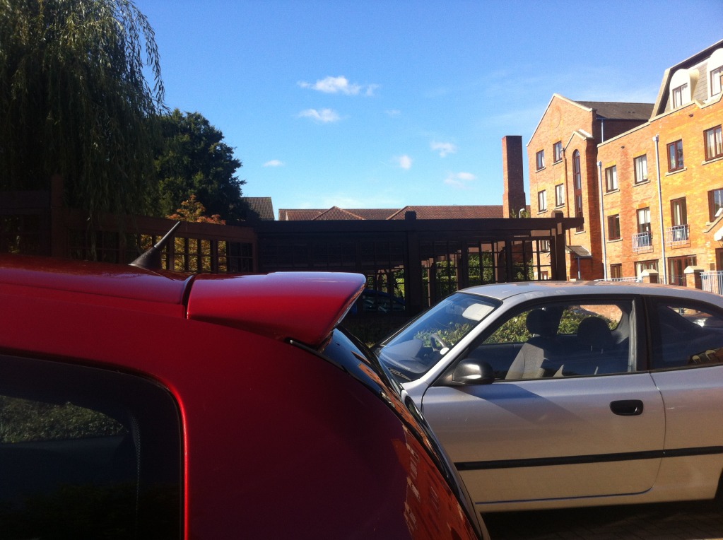

- Bought the spoiler off Lukes dead Trophy - RIP. Autocrash on here did a great job spraying it and helped me with the fitting.
- Developed a misfire and idle problem, which was solved kindly by Chip popping round, diagnosing it and then helping me swap out the failed injector. Top bloke :clap:

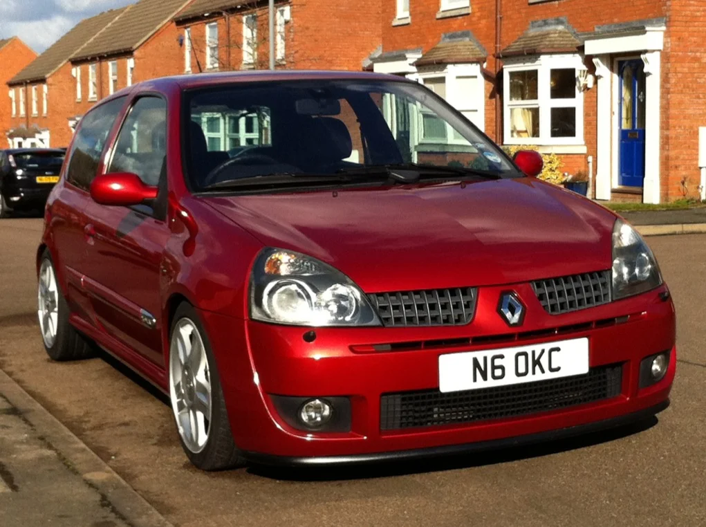

Few piccies;
As it stands now, running fine again :)
