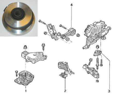

cup race car engine mounts
can anyone get hold of these at a reasonable price
renault sport part numbers are
A25671CL2 - no1
A25672CL2 - no2
A25673CL2 - no3

you can buy them from Reichard Motorsport but they cost 1259EUR or £858.22! Thats a bit more then I am prepared to pay for 3 engine mounts.
they're not cup racer engine mounts, they look more like grpN units
Heres the info in badly translated German.
These strengthened hanging up elements for the Clio2, 2,0l 16V R-S are racer-rehearsed in the Gr.N and in the Clio Coupe. They prevent effectively a tilting of the engine gear unit with the load change and when switching. Thus safe, accurate switching is possible (many damage to the engine results on interconnecting into a too low course) and also the negative load change reactions of the vehicle decrease clearly.
For all width sportsmen and drivers with sporty driving fashion we recommend the installation of the strengthened torque support. For the hard engine haven employment also the other strengthened hanging up should be used.

from that image you've posted (parts layout) all i see thats different is it has a mk1 172 dogbone, everything else looks stock to me
how can you tell how hard the rubber is from pics?
most of the time GrpN and GrpA stuff is standard design with stiffer rubbers, or metal in place of rubber.
