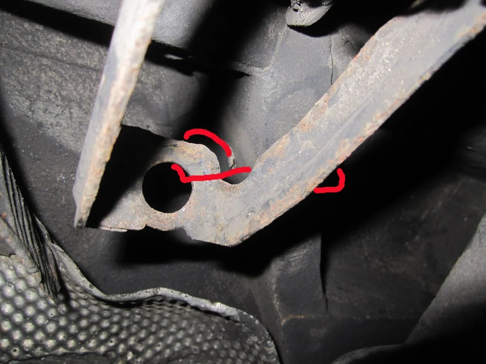

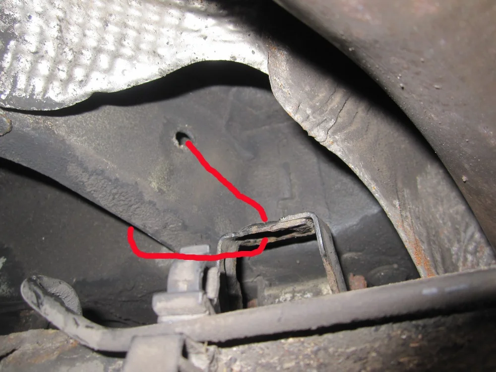

any chance of a cable tied up pic? my cup just failed on this not entirely sure what/where i should cable tie...

Here's some pics. I've drawn in where I put the cable tie.
i did this quick fix on my cup and from when it failed the rear brakes were register 0.1 with 6 month old discs and pads done about 500miles! and after i pushed the bracket right up (bit in the piccy on the left , you literally push it right up it pivots where the brake lines go in and out etc.) cabled tied it all up as marks pics and got it retested and they registered 1.1!!!!
I would not leave it like this though as the rear brakes do lock up when cable tied up so i plan on slackening off the cable ties quite a lot, and test until i cant get them to lock up :-D but the rear brakes get a little bit more than 'next to no efficiency'
