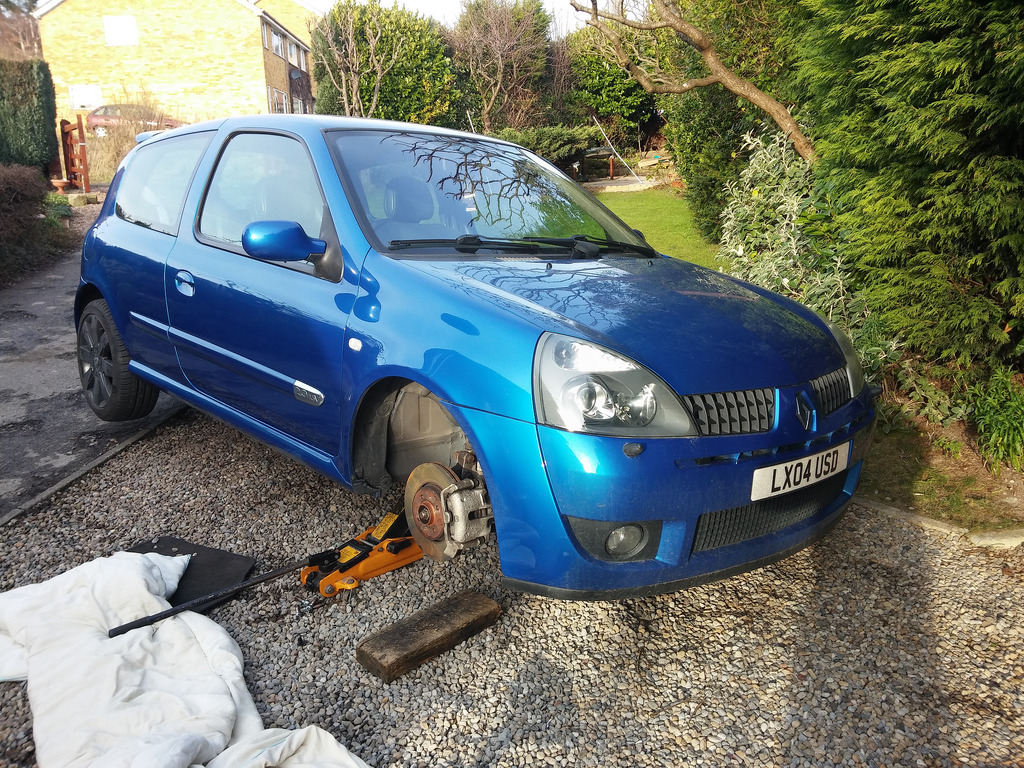

Today I sorted out a few niggles. Started out by removing the cat to fit the new fitting kit thanks to @optical here is a pic showing the before and after of the new gasket.
20150117_124738 by dann2707, on Flickr

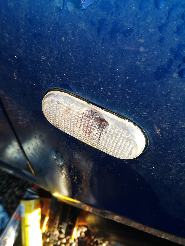

I then changed the side repeater bulbs to silver ones that flash orange. Really hard to get a decent pic after pic so he's a singular before lol
20150117_131619 by dann2707, on Flickr

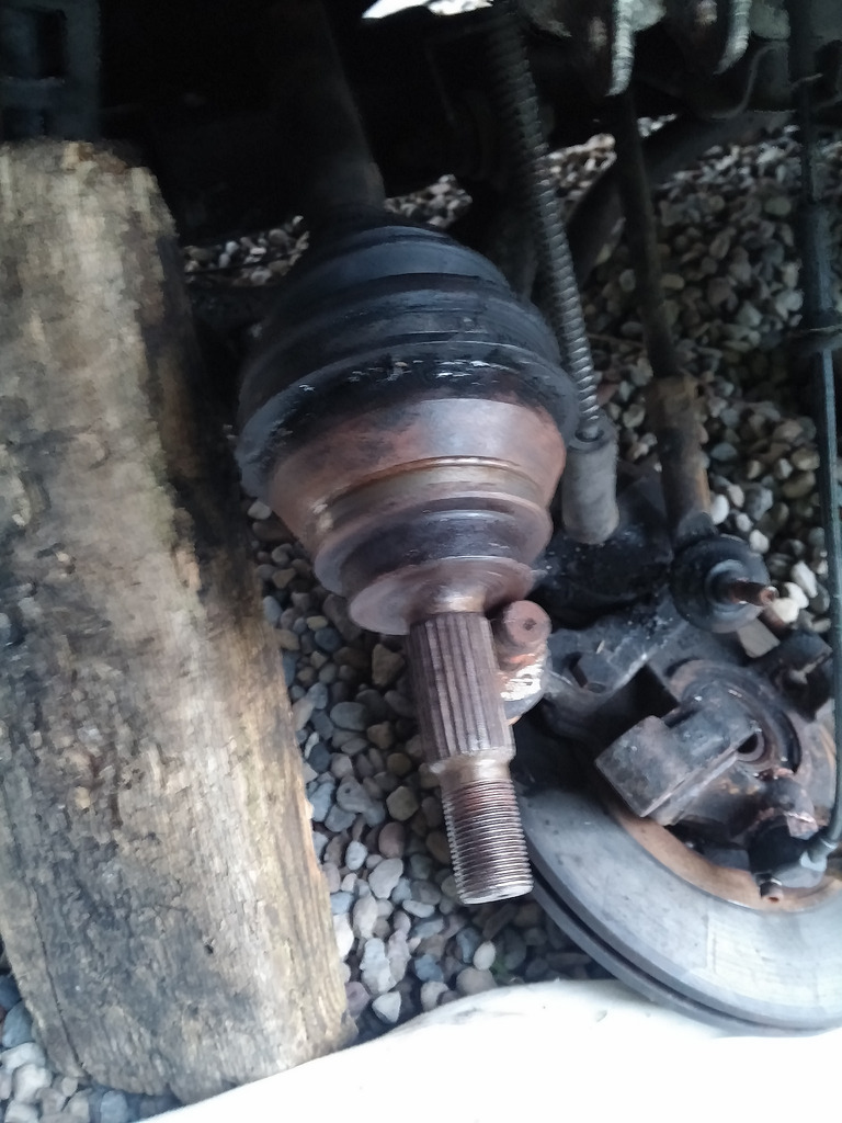

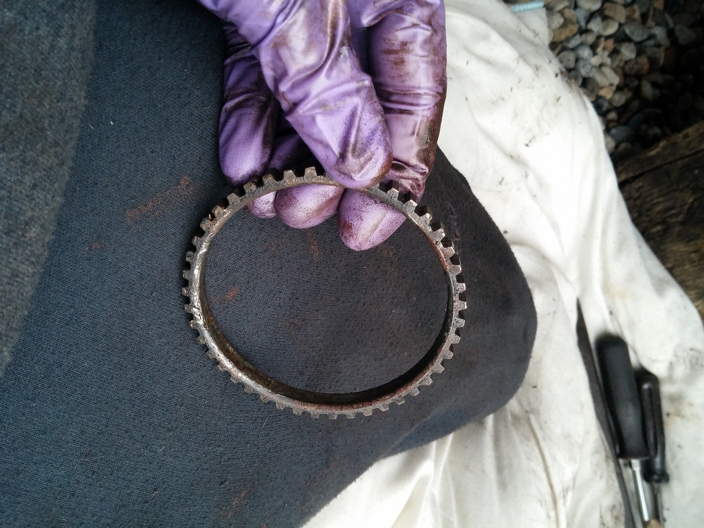

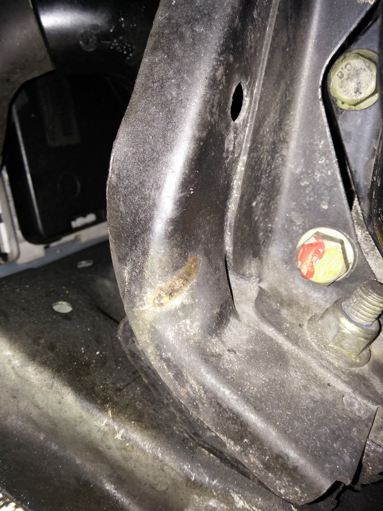

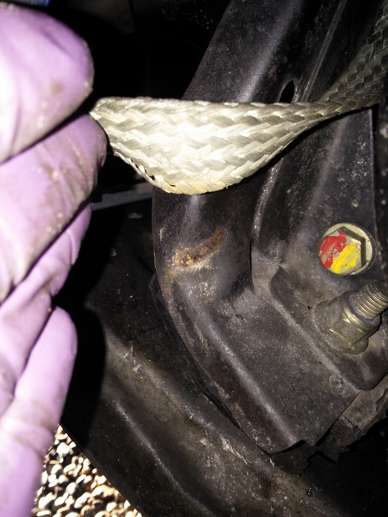

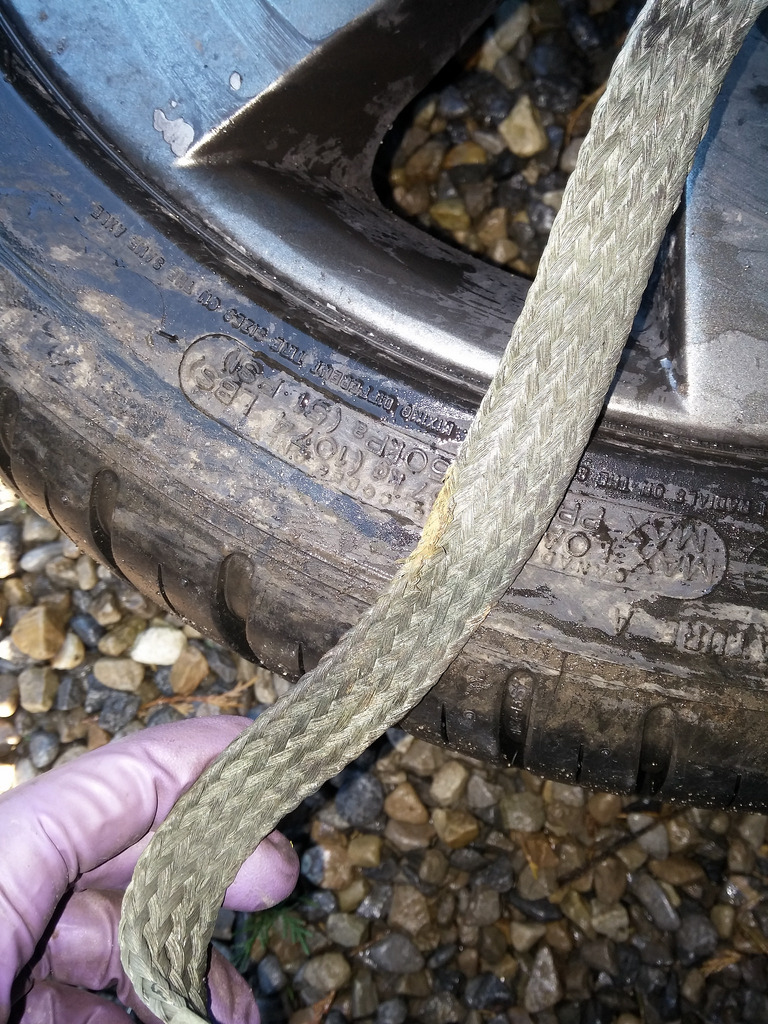

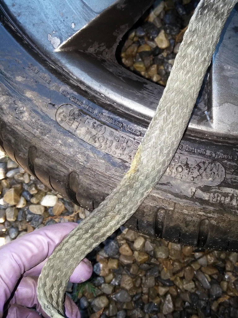

I then removed the nearside wheel to have a look at the gearbox earth strap to see if anything was up and I did notice that it's been rubbing on the chassis, it's gone through the paint and been rubbing quite badly as seen.
20150117_133013 by dann2707, on Flickr
20150117_134112 by dann2707, on Flickr
20150117_134130 by dann2707, on Flickr
I was starting to think this was my earth issue, I got the multimeter out and i got resistance when pressing the earth strap against the car where it has rubbed away so was thinking that was the problem but after talking to Incy we're thinking that wont be the rpboem as it's all earthed anyway :S I've insulated it and about to go for a drive anyway!

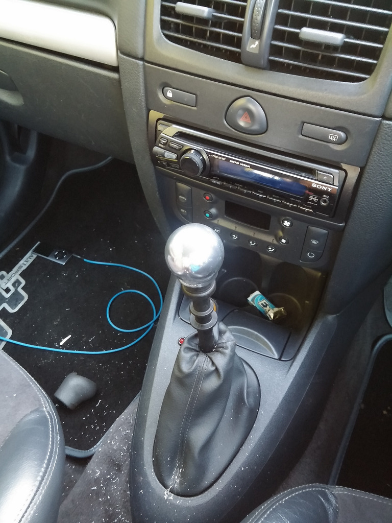

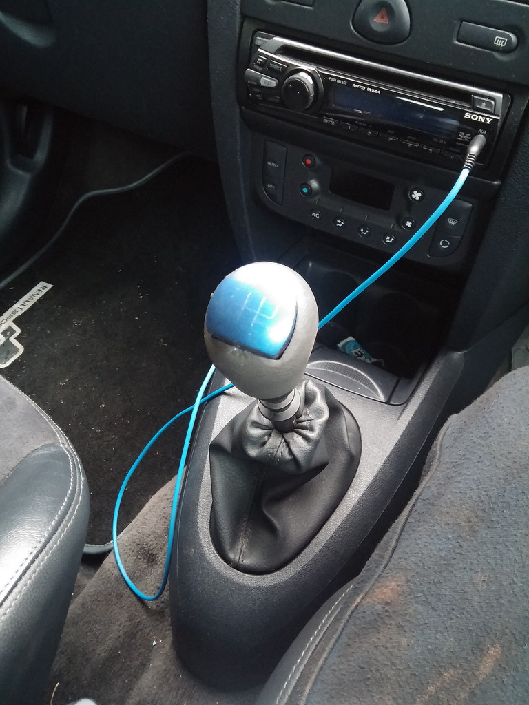

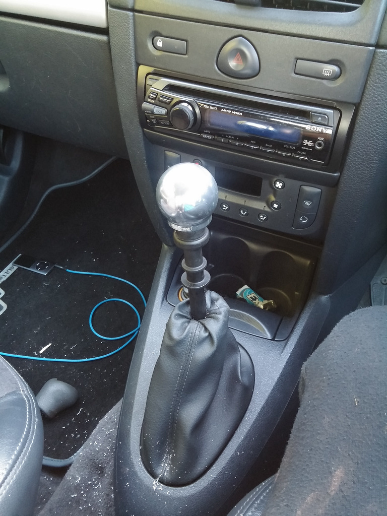

Old gearknob
20150117_143645 by dann2707, on Flickr
New gearknob!
20150117_150951 by dann2707, on Flickr
20150117_150957 by dann2707, on Flickr
Then cleaned it.
20150117_151103 by dann2707, on Flickr

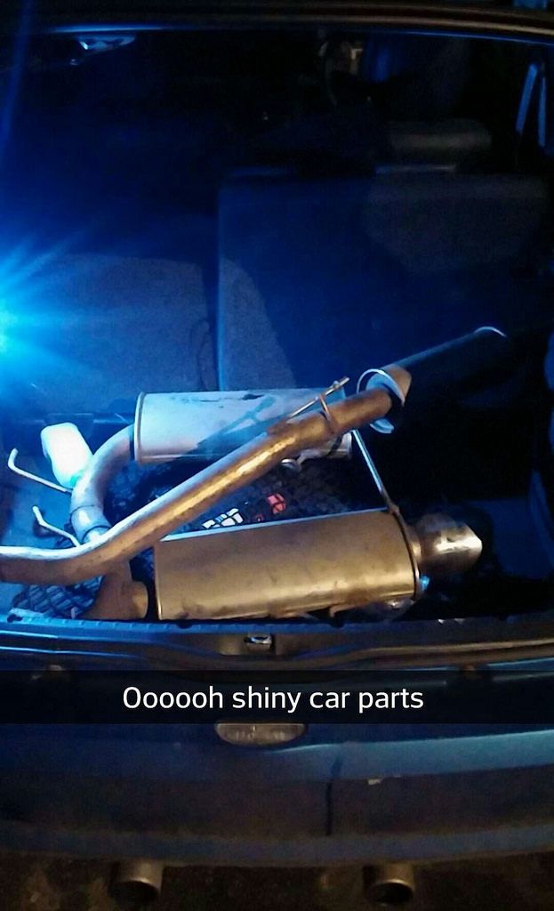

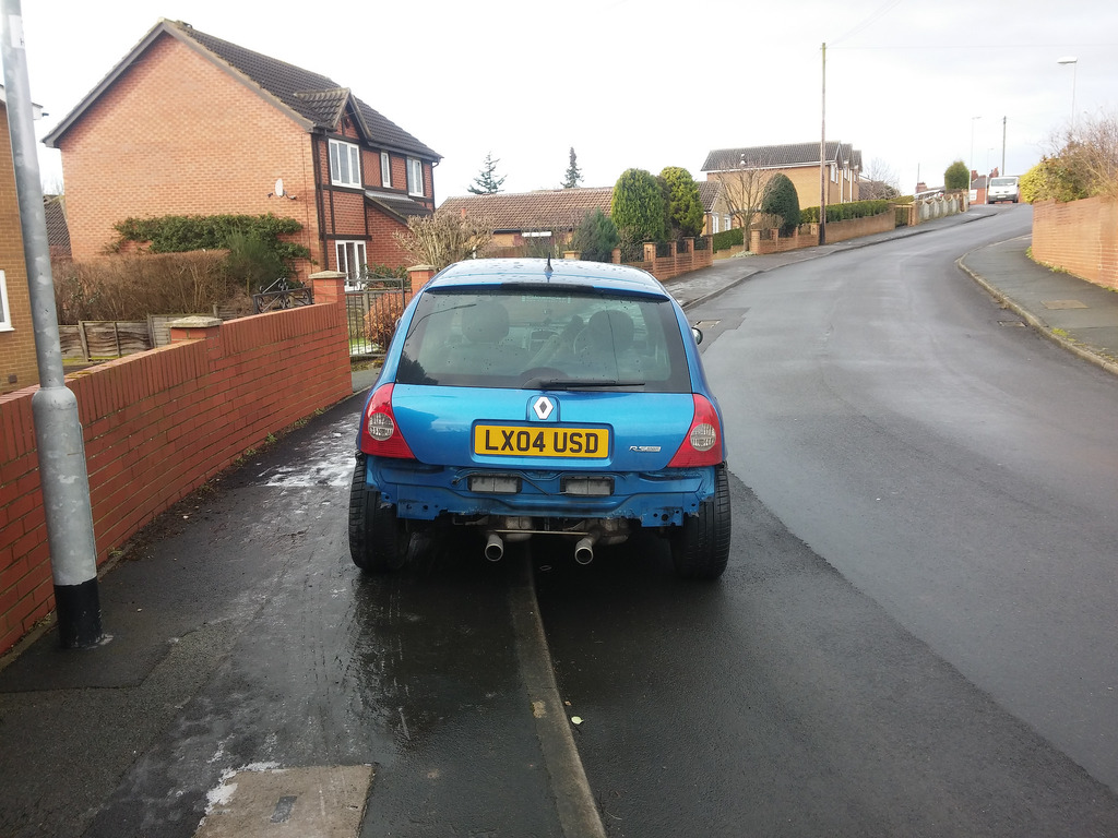

I'm so tired writing this right now - went straight from work with my mate who I know from college who is doing his PhD in the same building as me at work. Had such a laugh driving down, it really made the journey awesome.
We initially went from Leeds to Chesterfield to pick up the exhaust, then from there to Nottingham to pick up the spoiler and i'm so impressed with the work! Definitely worth the wait.
We then came home, dropped my mate off and started removing the bumper so it's been quite a long day. Here are some shitty snapchat pics (if anyone wants to add me my username is the same as on here dann2707)
I have a day off monday so should be fitting everything then

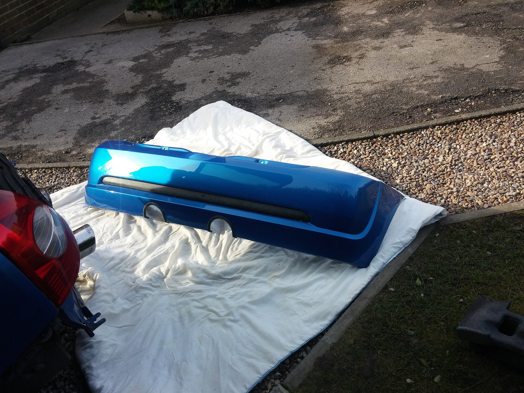

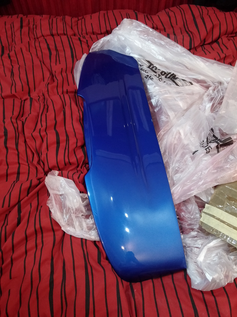

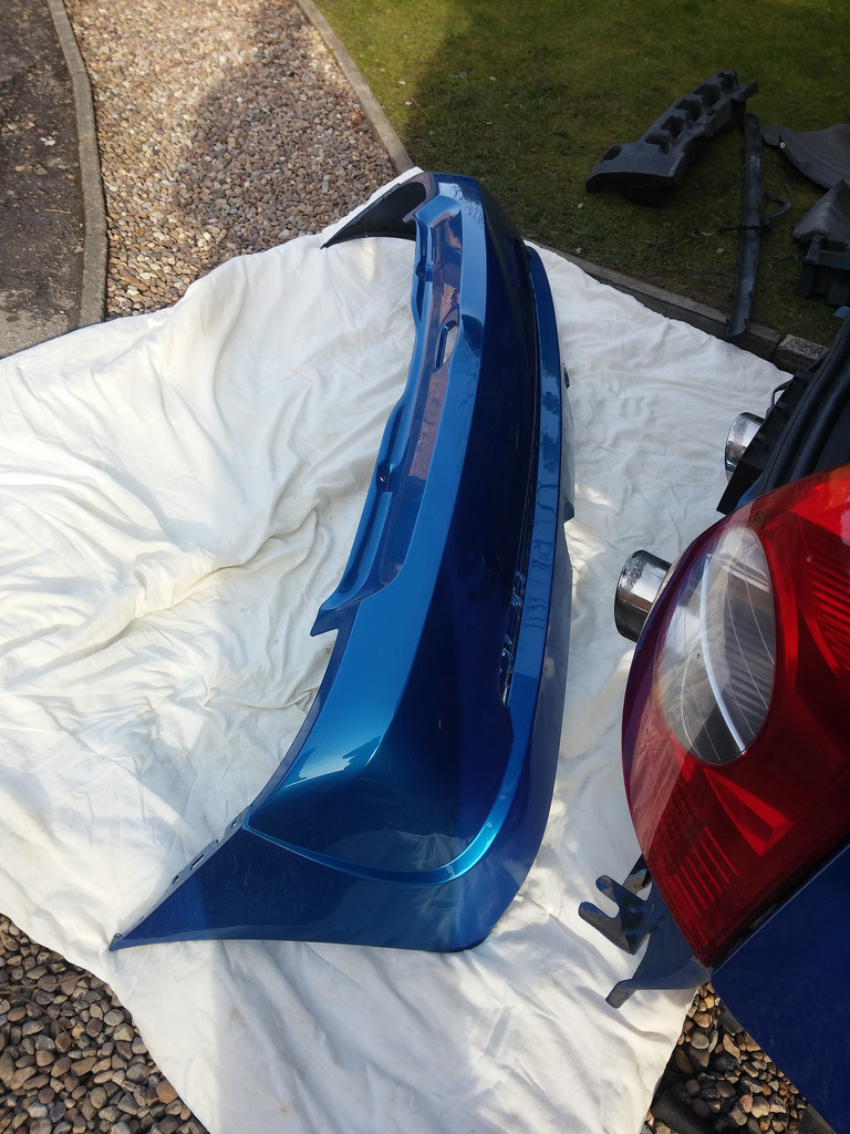

I had to take my bumper off though as the guy was picking it up for spraying at 7.30 this morning :hushed: Luckily it was only 0c, I thought it would have been colder!
I'm going to fit the spoiler before I head off to Manc today :D
Dicky Belly 3

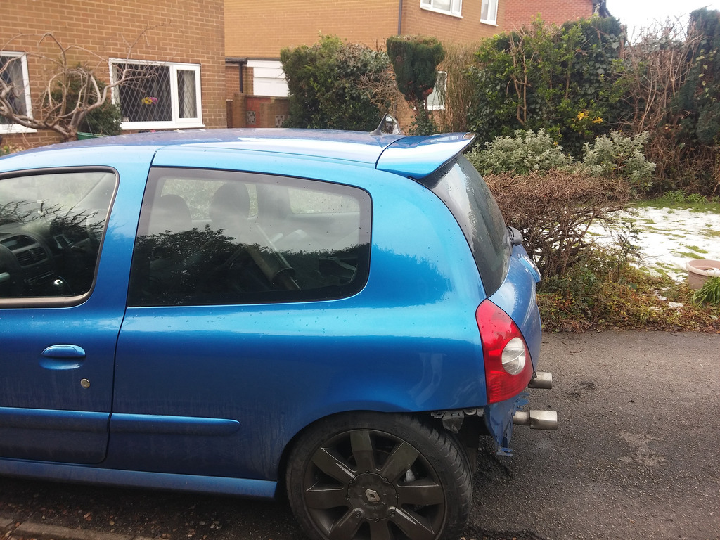

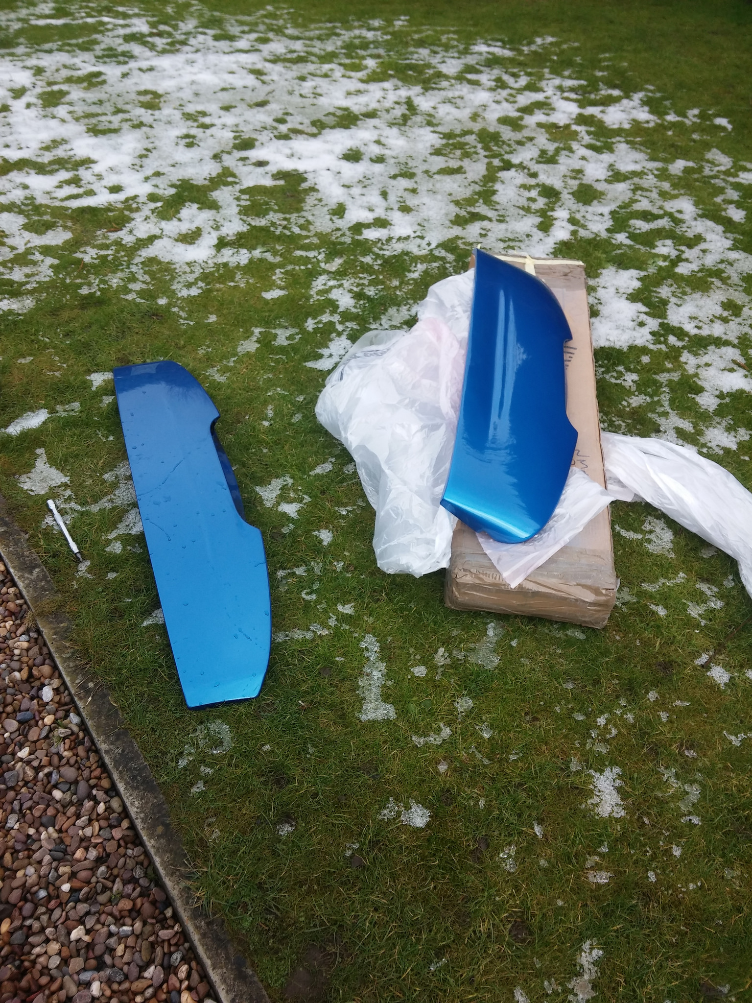

It's all on! Massively not happy with the fitting of it due to the threads in the spoiler. They just seem so weak and although it's on fairly sturdy, tightening them was sketchy as I didn't overtighten them as to not pull the helicoils out. For those who have this spoiler you'll know what I mean.
More pics of the car without the rear bumper on, it looks ridiculous haha car looks like it's got mad camber too even though all it has is rear spacers on.
20150131_111536 by dann2707, on Flickr
20150131_111541 by dann2707, on Flickr
20150131_111717 by dann2707, on Flickr

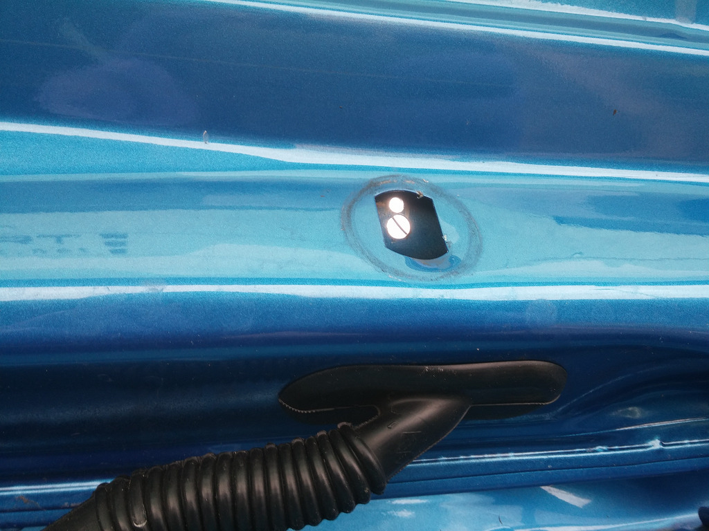

I had to drill some holes too as that's where it lined up. Pretty bad, I did widen the holes after this btw
20150131_112433 by dann2707, on Flickr
20150131_112436 by dann2707, on Flickr
Spoiler vs spoiler
20150131_112819 by dann2707, on Flickr
And all on :D

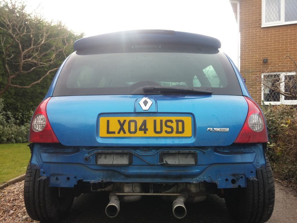

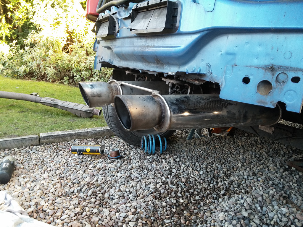

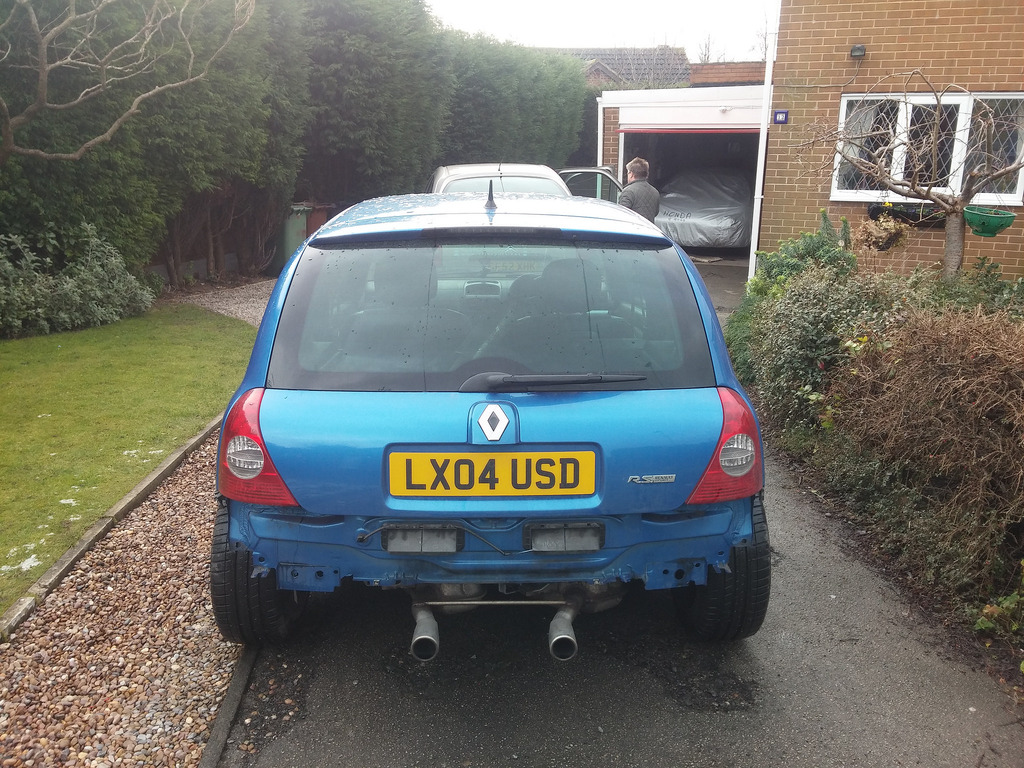

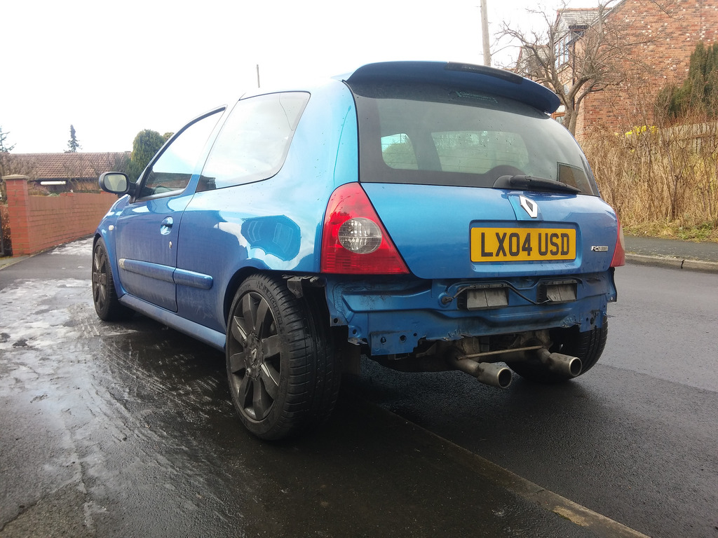

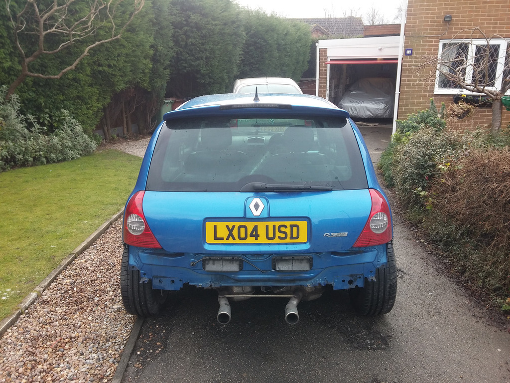

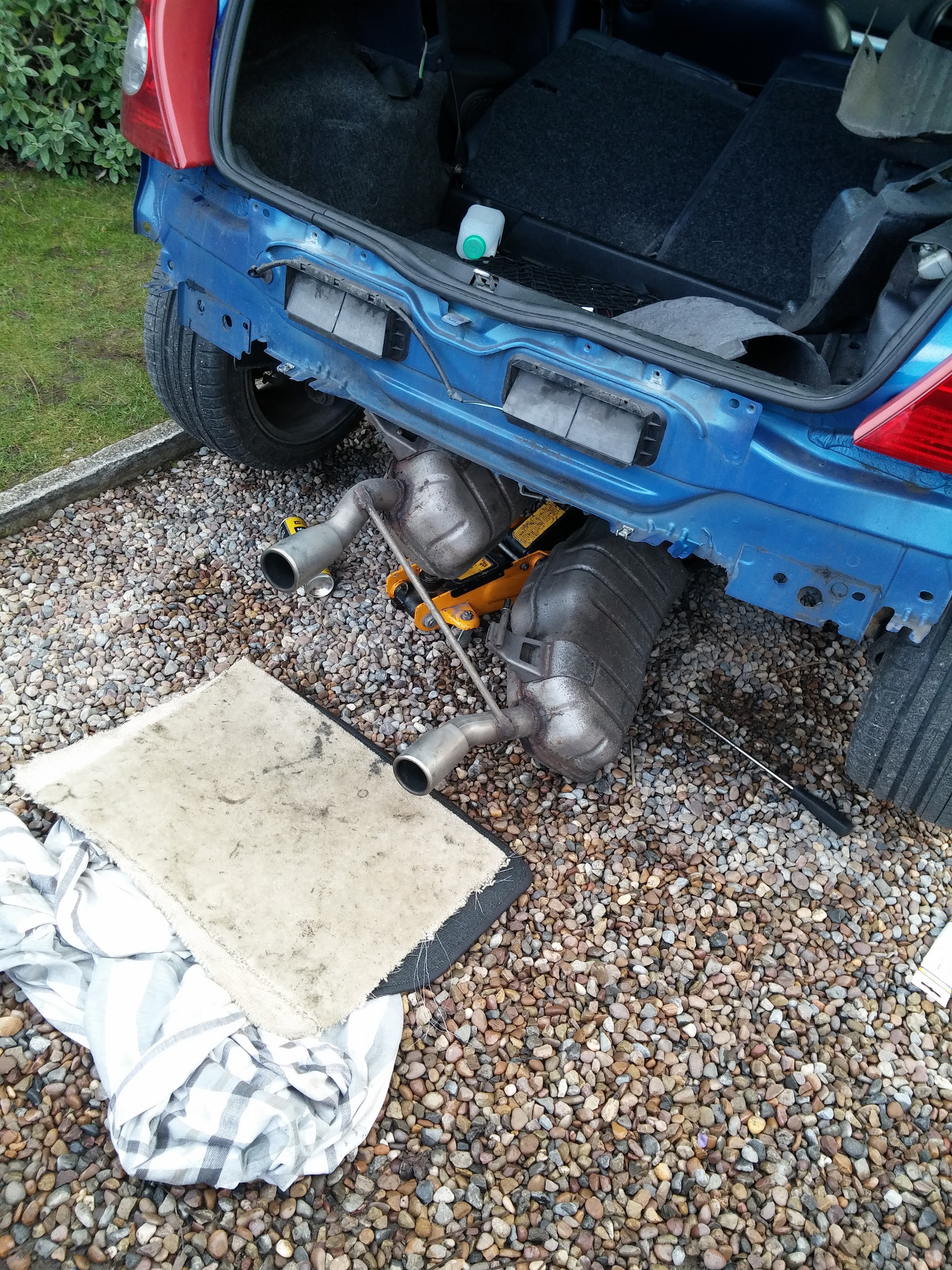

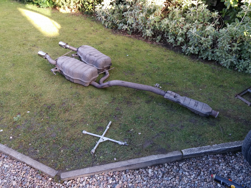

Today was fairly productive despite going out last night, i'm hungover to f**k so thought car stuff might sort me out but it hasn't I just want to curl up and fall asleep lol - got home at 1pm today so cracked on with the exhaust. Really easy to fit however the olive joint where it attaches to the cat is blowing slightly.

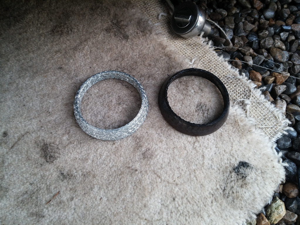

I will no doubt go down the welding a sleeve on it in the near future - just need to research it all first :)

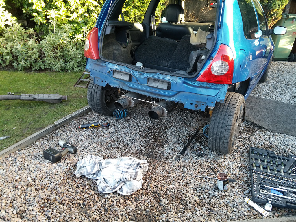

I jacked the car up and tried wiggling the original exhaust out but it's fairly tight in there so I dropped the rear beam which was easy enough.
20150201_133231 by dann2707, on Flickr

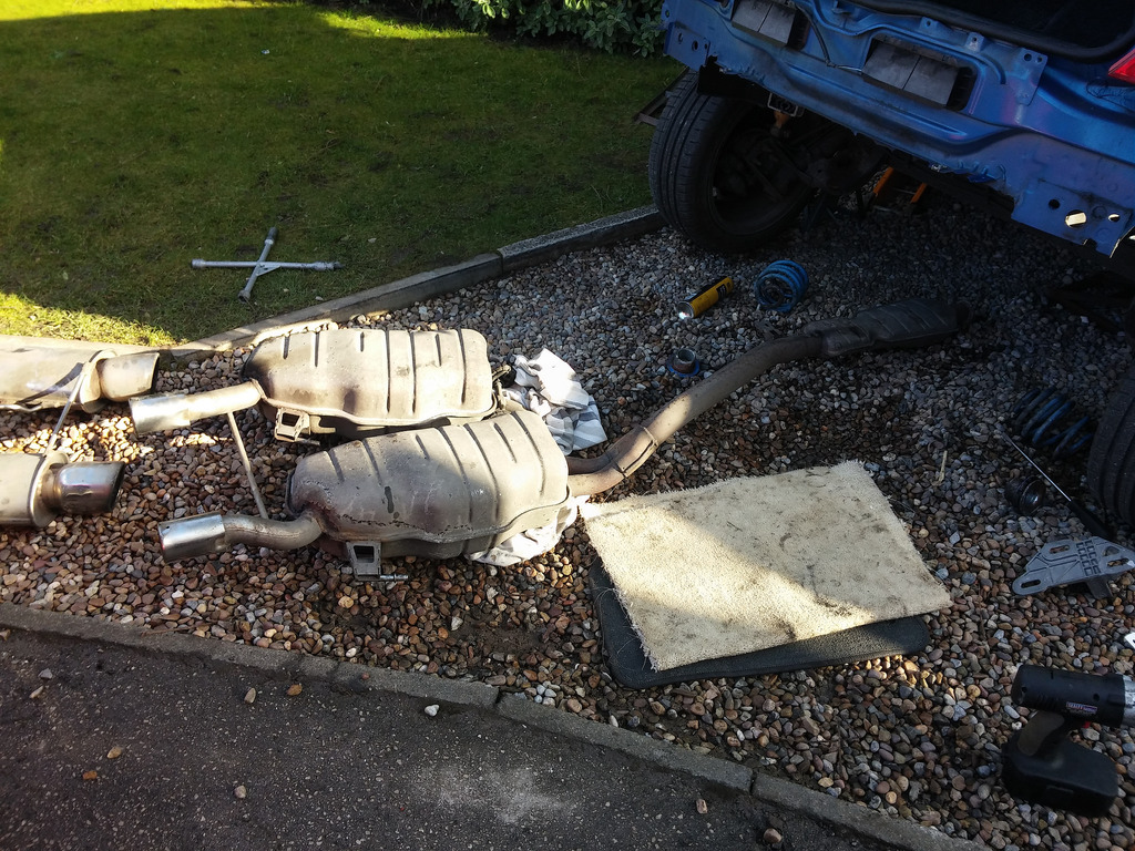

All off - it's actually in really decentish condition for the year funnily enough.
20150201_134845 by dann2707, on Flickr

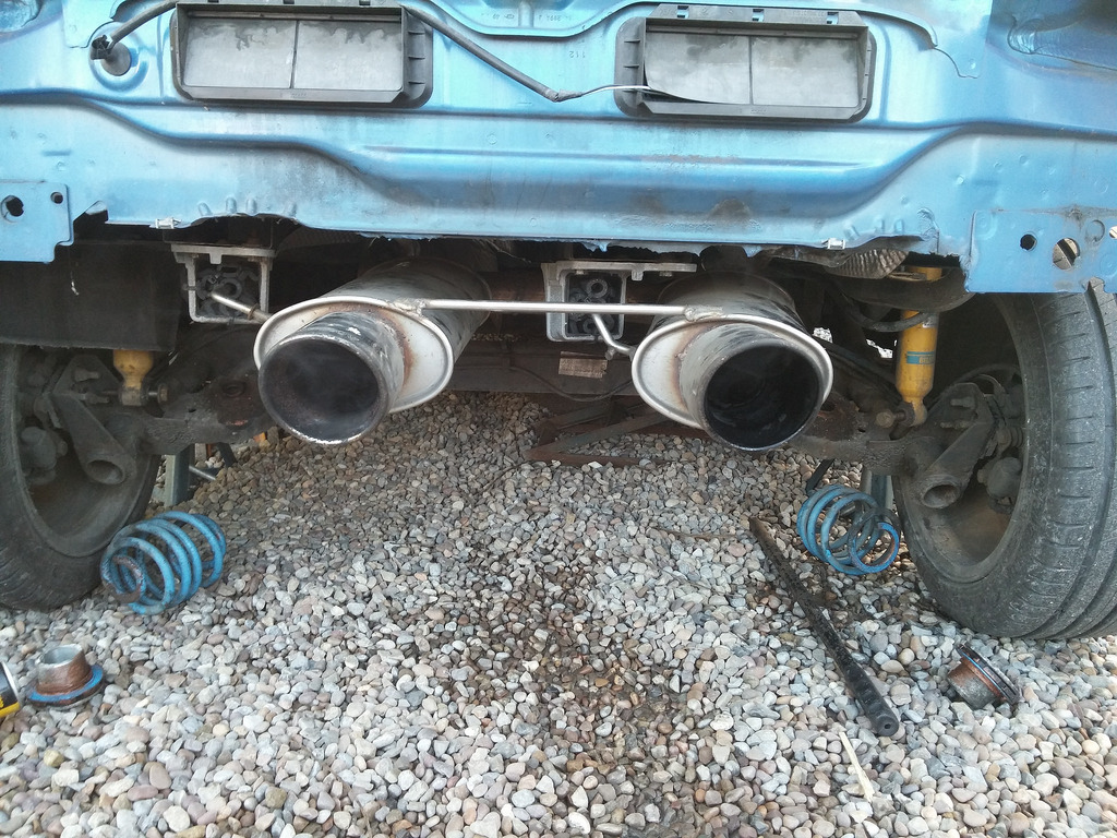

New one on!
20150201_145957 by dann2707, on Flickr

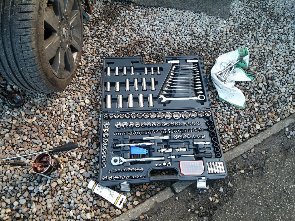

Christmas present being a saviour, this kit is so good for the money and it's helped quicken jobs so much as everything is nicely in order
20150201_150002 by dann2707, on Flickr
Old system
20150201_150005 by dann2707, on Flickr
20150201_150011 by dann2707, on Flickr

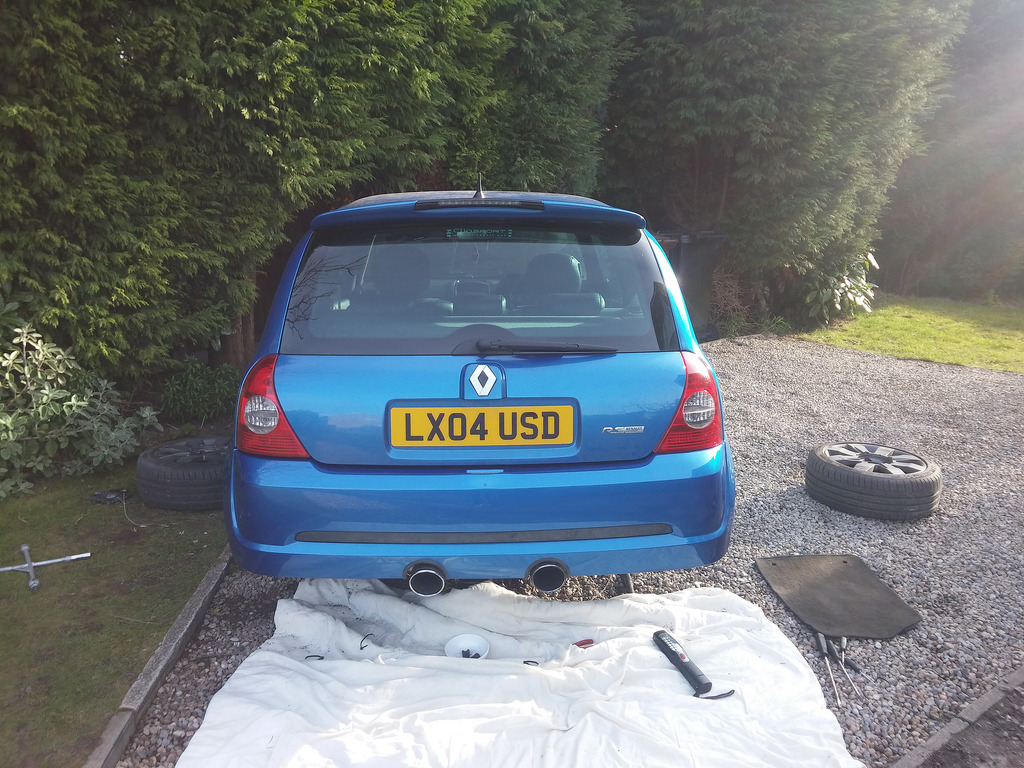

They will be polished in due time :D
20150201_150017 by dann2707, on Flickr

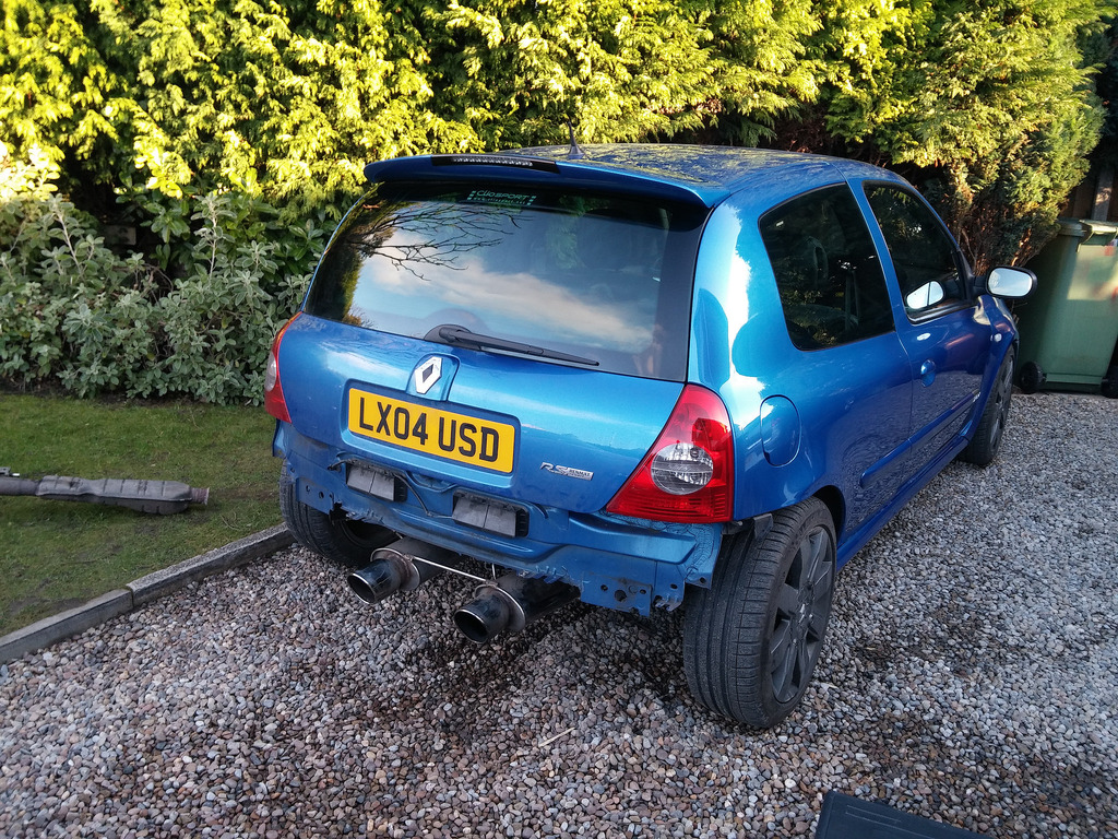

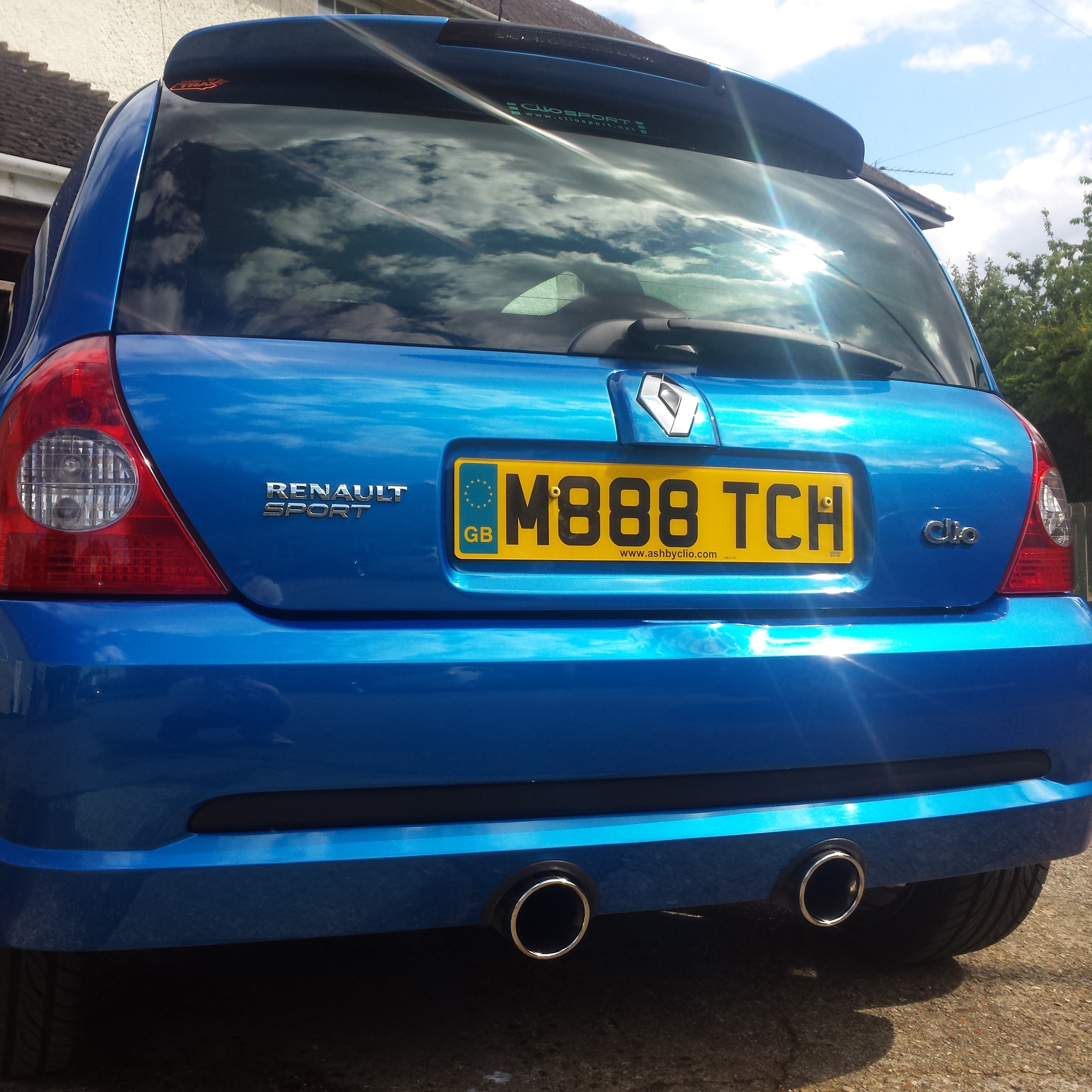

Back end is starting to look where I want it now! (just need a bumper lol)

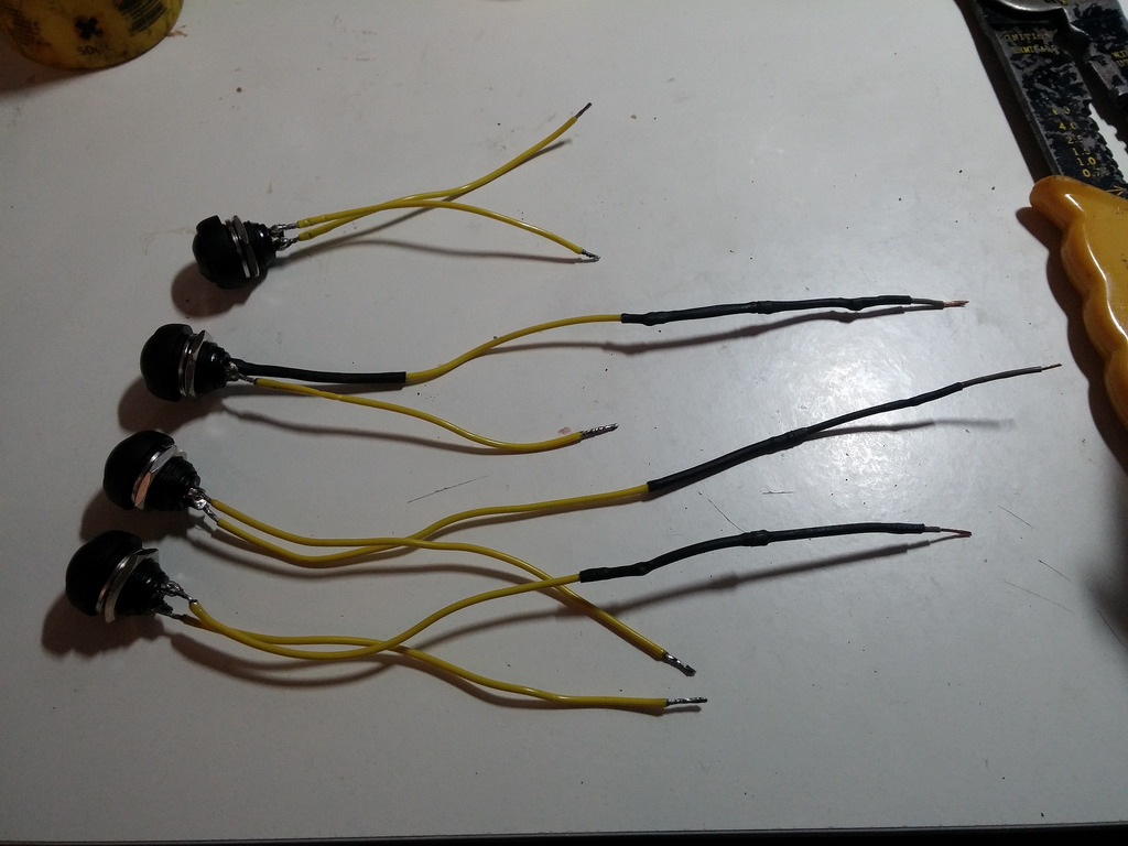

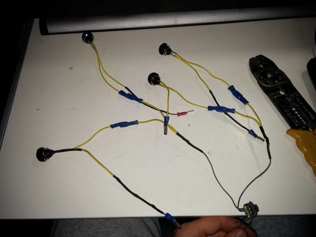

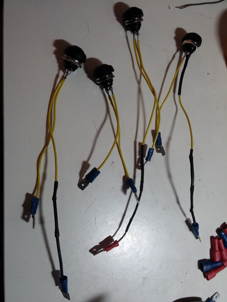

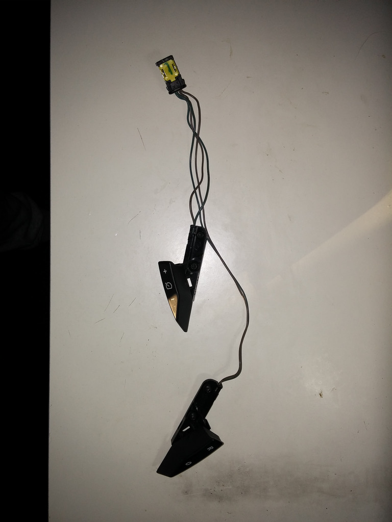

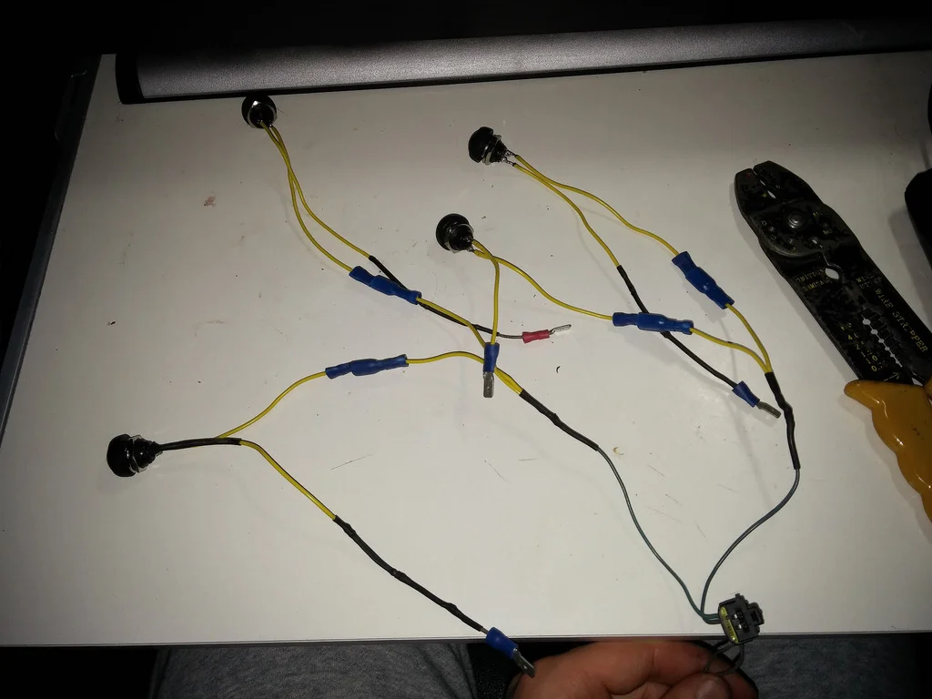

I then retired into the comfort of my bedroom to start on creating a wiring loom for the cruise control buttons, as I now have an after market steering wheel the buttons on the original wheel can't go neatly anywhere so my plan is, and totally copying @George182 's wheel i'm going to do the same! But to detract my blatant stealing of ideas i'm going to write up a guide for how the loom is created as hopefully it should help others in the situation I was in.
This is what i'll be doing:
Apologies if the pics are rubbish.

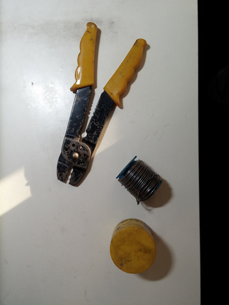

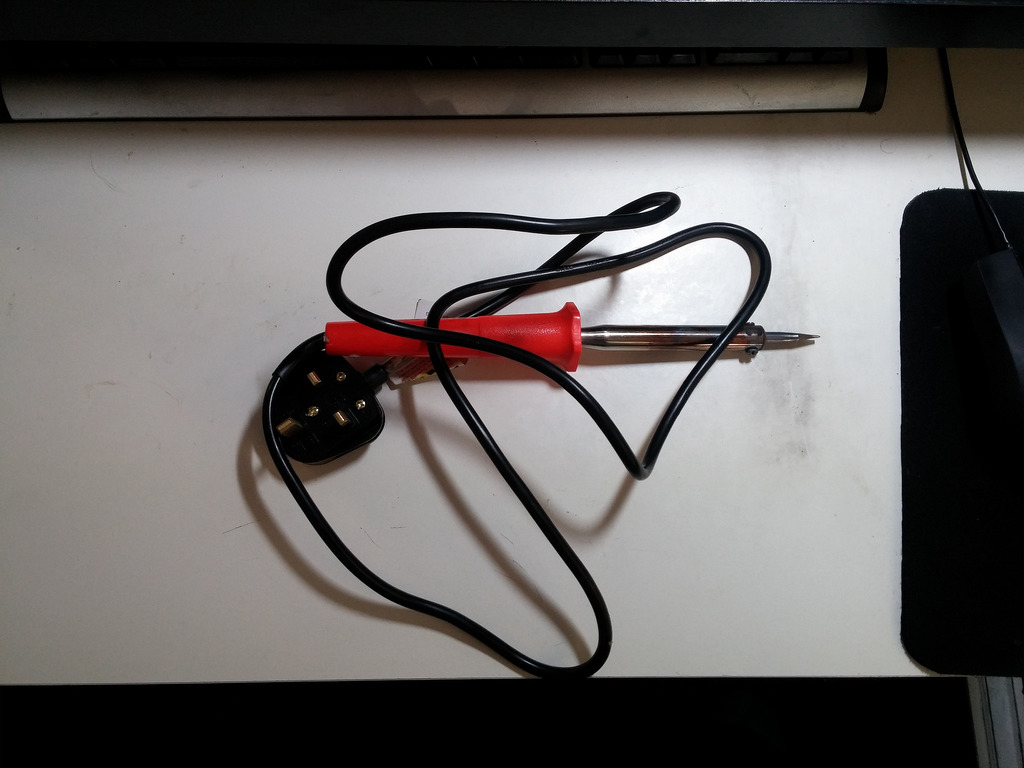

First things first - A little list of what you need:
A soldering iron.
20150201_154231 by dann2707, on Flickr
Some flux to clean up the connections (not really required), solder and some very worn crimping tools. You also need (not pictured) some slide terminals male and female (8 male 8 female)
20150201_154256 by dann2707, on Flickr

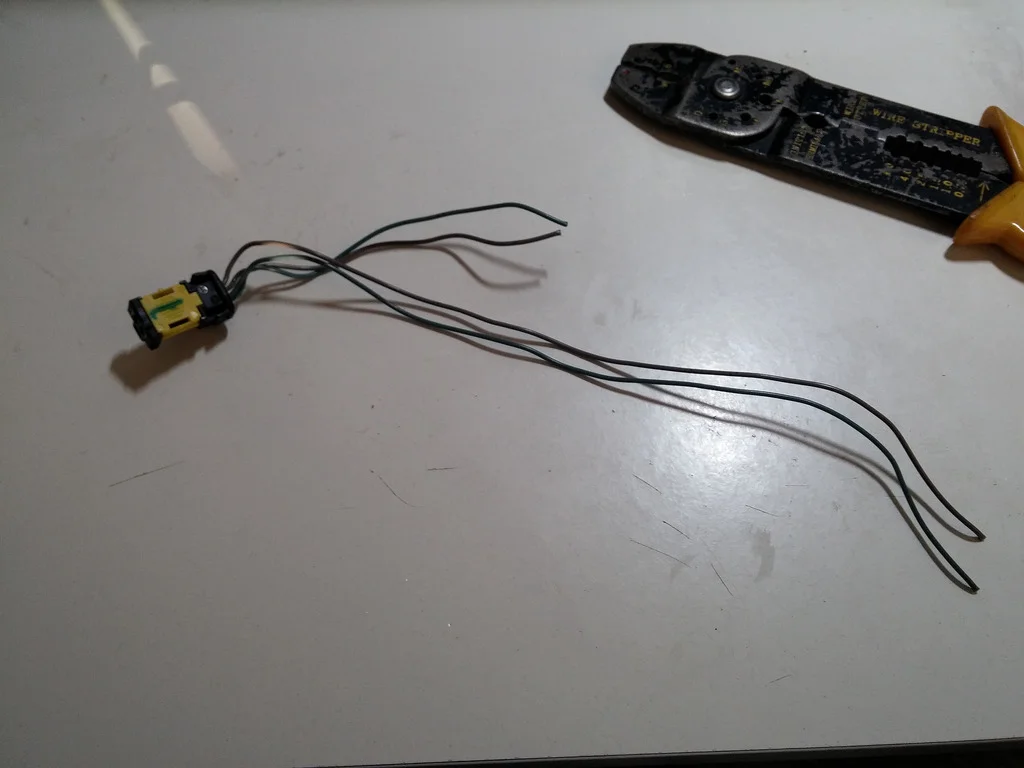

Your original loom from the cruise control buttons to the yellow connector.
20150201_154318 by dann2707, on Flickr

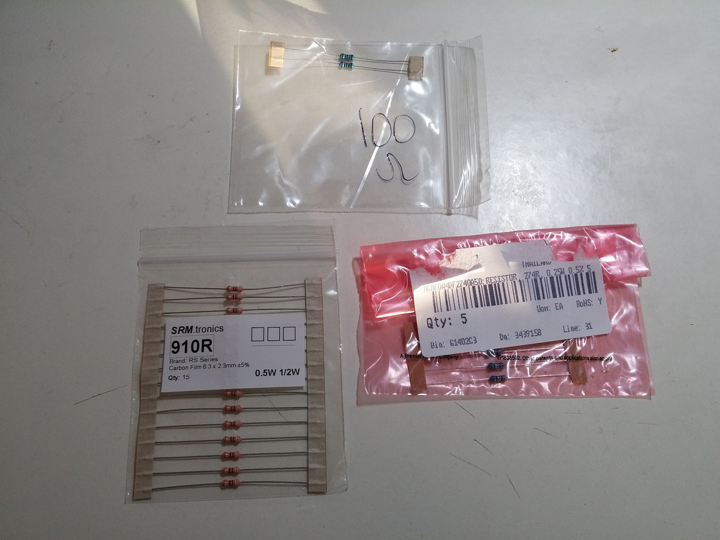

3 resistors. I have loads here as you had to buy so many at a time.
You need the values of:
910 ohms
100 ohms
274 ohms
These were all bought on eBay for a total of around £4
20150201_154341 by dann2707, on Flickr
Heatshrink - eBay again for £2 or so delivered
20150201_154356 by dann2707, on Flickr

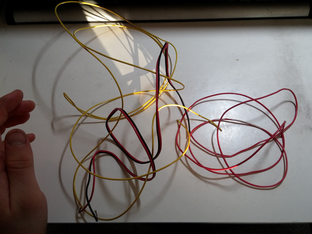

Loads of wire and a weird looking thumb
20150201_154406 by dann2707, on Flickr
A big ol' motherfucking cup of hangover beating liquid
20150201_154423 by dann2707, on Flickr

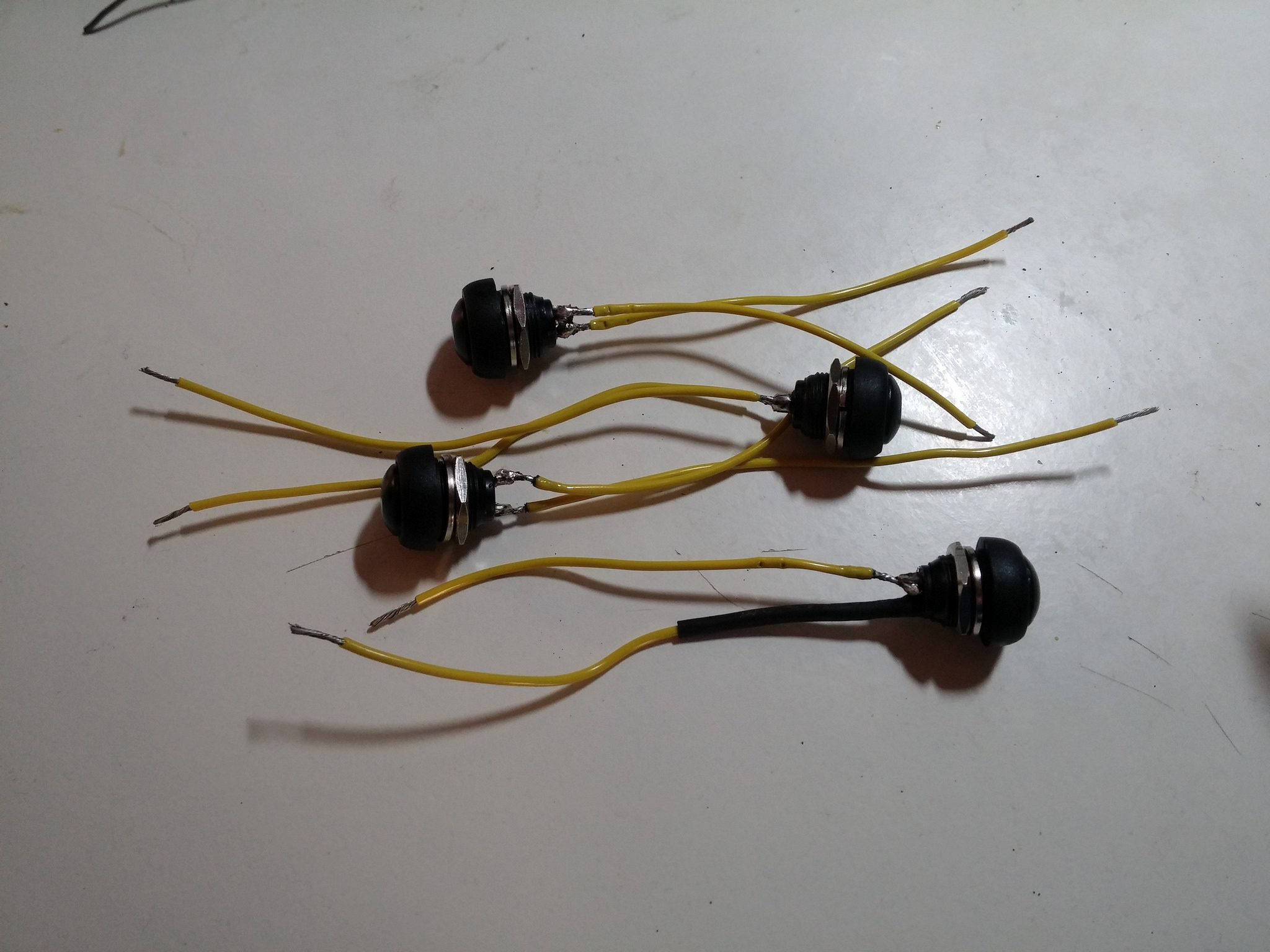

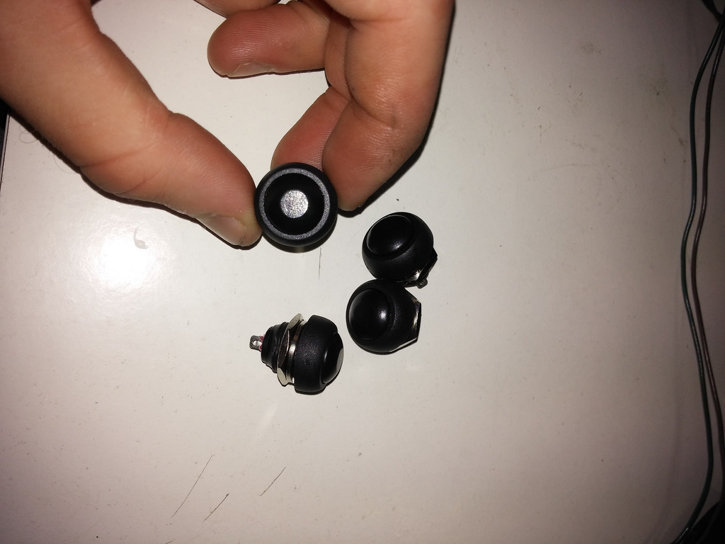

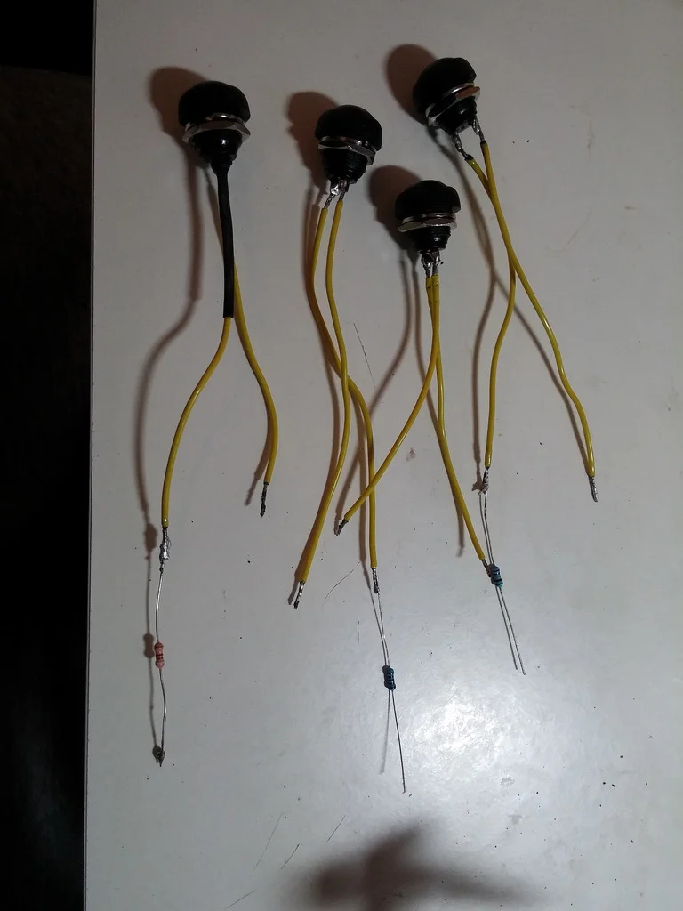

Some "push to make" buttons. I got these dimpled ones as they look much better imo. eBay again - £6. Buy f**king everything on eBay, we actually bought our conservatory on eBay hahaha not even joking.
20150201_154533 by dann2707, on Flickr

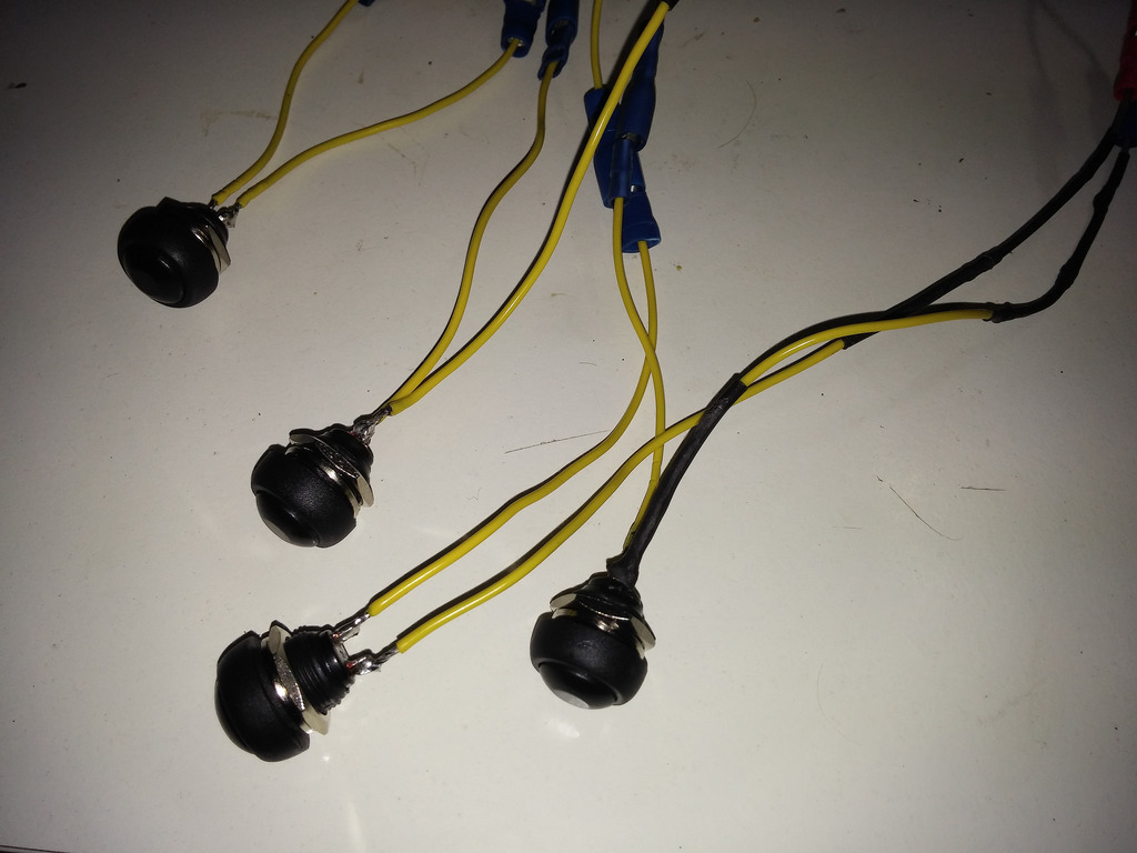

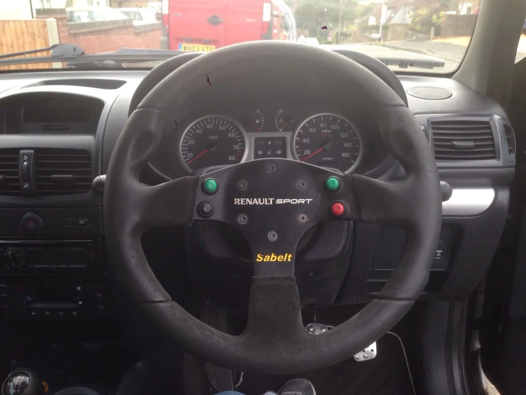

Thanks to @1812lsd for the pic. Basically this is how everything is going to be wired. The lines that are to the right of the resistors are the buttons.
First you want to cut off the original buttons leaving you the bare wires, you will then bare back the copper wires.
20150201_154511 by dann2707, on Flickr
Now cut off some wire - don't do too much or too little. You will want 8 pieces here not 4 as shown. That was just to show what size im cutting.
20150201_154955 by dann2707, on Flickr

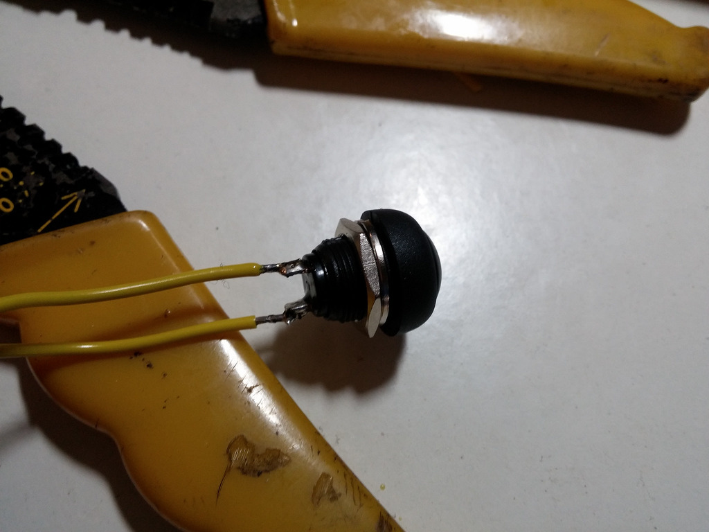

You have 8 wires, 2 for each button as shown here. Solder them onto the buttons now.
20150201_155941 by dann2707, on Flickr
20150201_161703 by dann2707, on Flickr

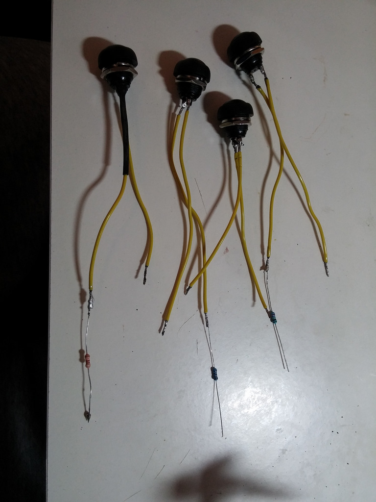

Now as per the original sketch further up, you need to solver a resistor to one leg of the buttons. One button doesn't actually require a resistor on it so just leave that. I then soldered 3 really small bits of wire after the resistor legs as shown further down. This is for the crimping connectors to grab onto something as it won't grab a thin resistor leg.
20150201_162442 by dann2707, on Flickr
Now heatshrink the resistors as shown.
20150201_163741 by dann2707, on Flickr

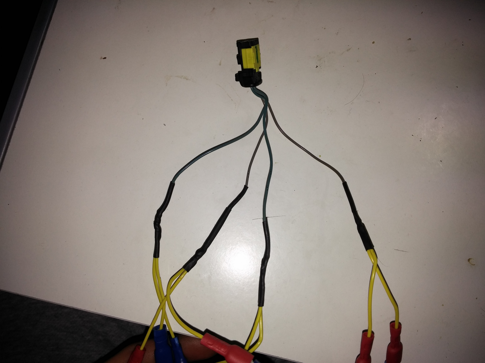

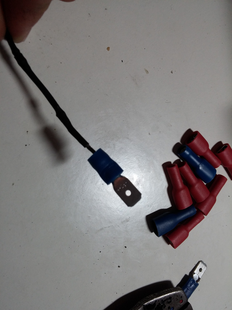

Now what you need to do is attach male or female connectors to every wire on this bit you've been working on. The reason behind this is so that they can be undone from the loom and fed through the holes i'm going to drill in the steering wheel. If they were permanently soldered you don't be able to do this.
20150201_164343 by dann2707, on Flickr
20150201_164348 by dann2707, on Flickr

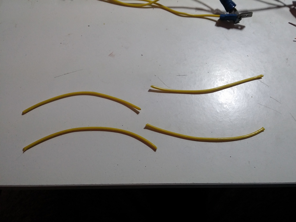

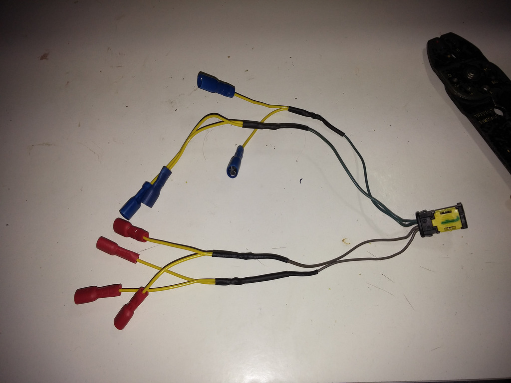

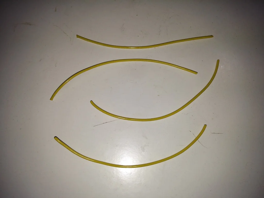

Now cut off more wire, around this size. You need 8 pieces
20150201_164511 by dann2707, on Flickr

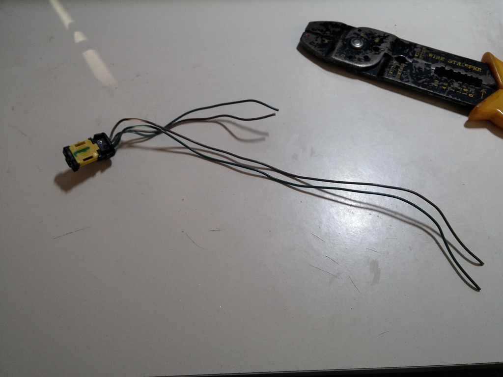

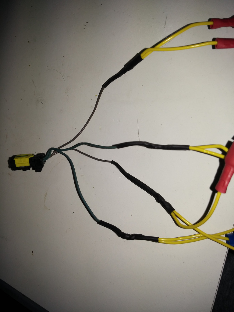

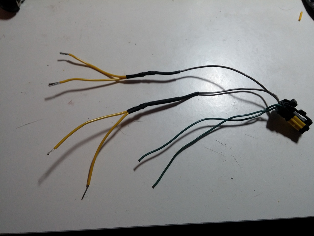

Now grab your original loom and get the 2 grey wires, bare them back, and solder the 4 pieces you just cut off to them. 2 pieces of yellow wire in my case to 1 grey strand so overall you have 4 pieces - in this step you are essentially turning 2 wires into 4 :)
20150201_165431 by dann2707, on Flickr
Now do the same with the green wire!! Extending it from 2 wires to 4 wires :) And crimp your other slide connectors to these wires!
20150201_170942 by dann2707, on Flickr

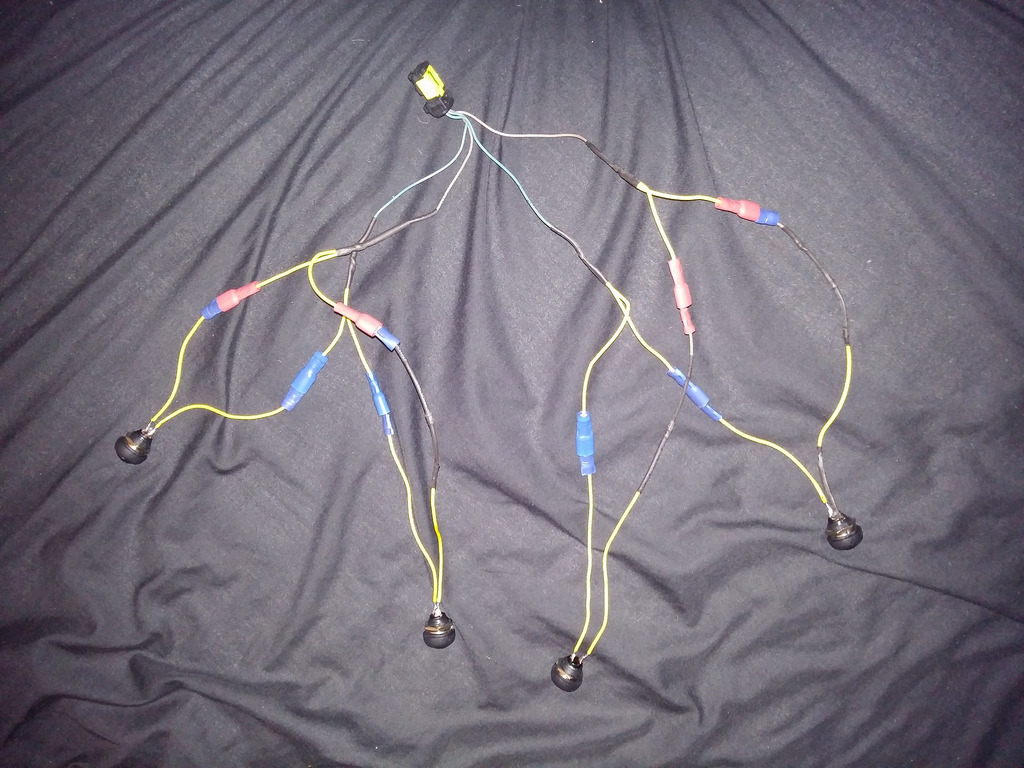

All done! now you simply need to hook up everything.
For each button - One grey wire goes to one button leg, one green wire goes to the other button leg.
20150201_171243 by dann2707, on Flickr
20150201_171421 by dann2707, on Flickr
Just some random pics
20150201_171524 by dann2707, on Flickr
20150201_171529 by dann2707, on Flickr
20150201_171542 by dann2707, on Flickr
Hope this helps anyone reading and I apologise if something I have done isn't orthadox in terms of soldering etc - I haven't properly soldered since year 11 at school which was 8-9 years ago!
There might be too much wire too but that can easily be sorted out when I go to fit it tomorrow. i'll update with more pics tomorrow when it's on the car.
One thing, I'm not actually sure which resistor does what in terms of cruise control so i'm going to have them loose and press them when on a run to distinguish which button does what.
I hope it works... lol

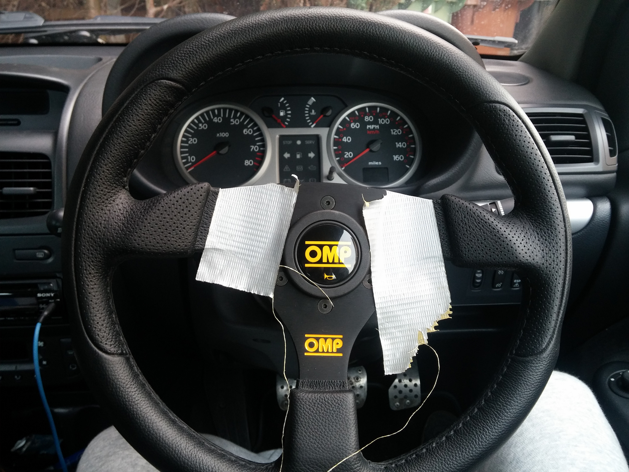

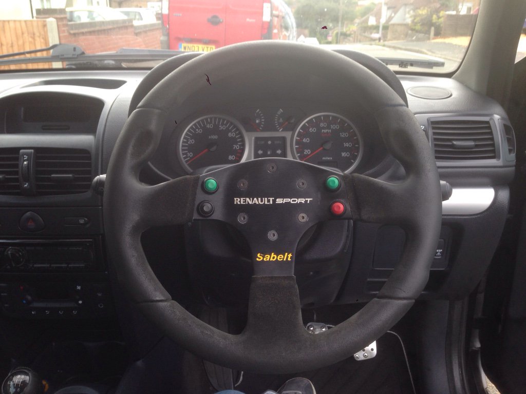

I'm going to be fitting them to the wheel by drilling 4 holes around the horn like what george has done above. That's today's job! Hopefully I can get them equally spaced by measuring 18 times before drilling haha

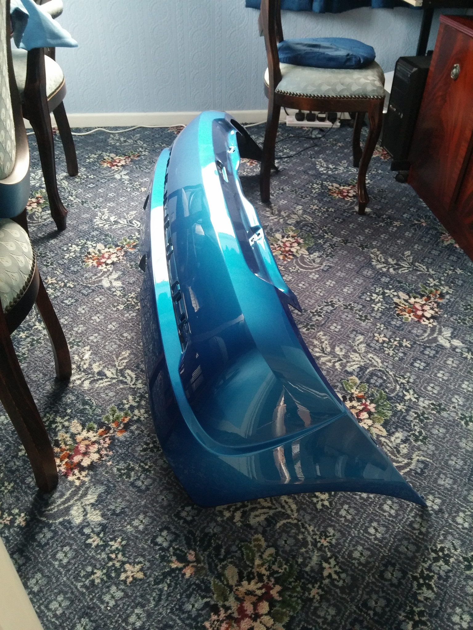

Should be getting my bumper back today too :) fingers crossed if it's gone to plan.

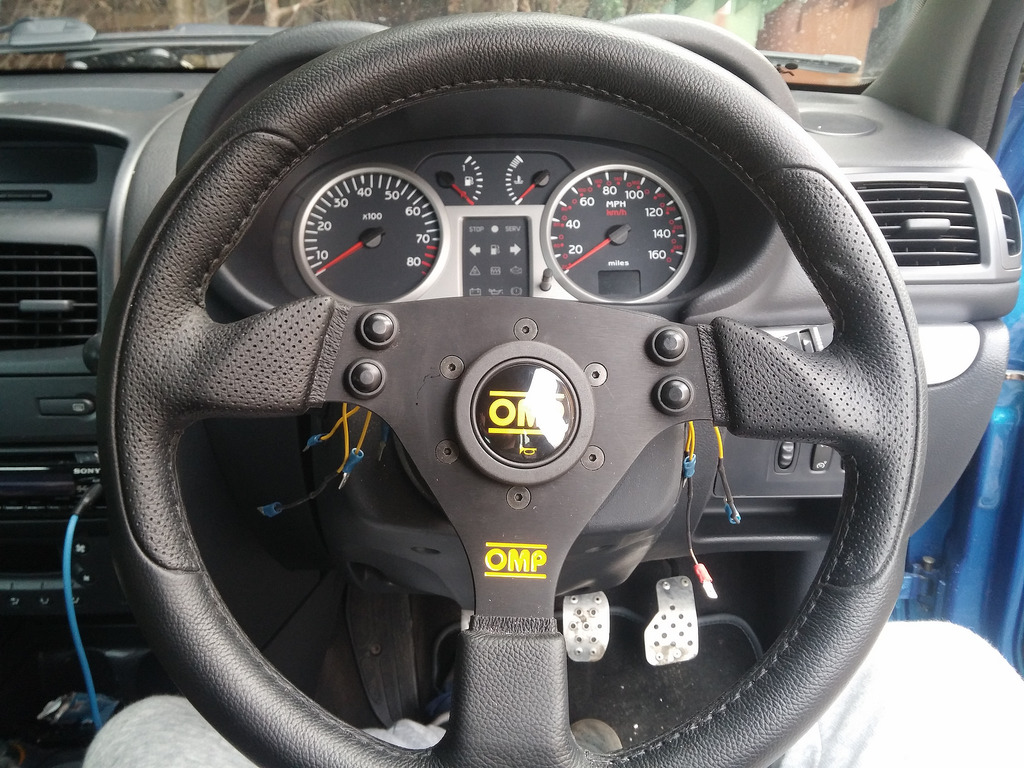

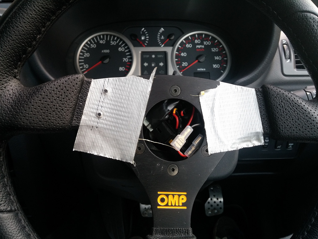

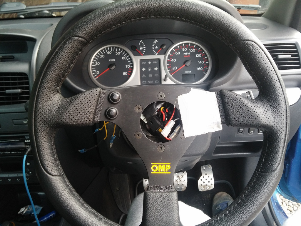

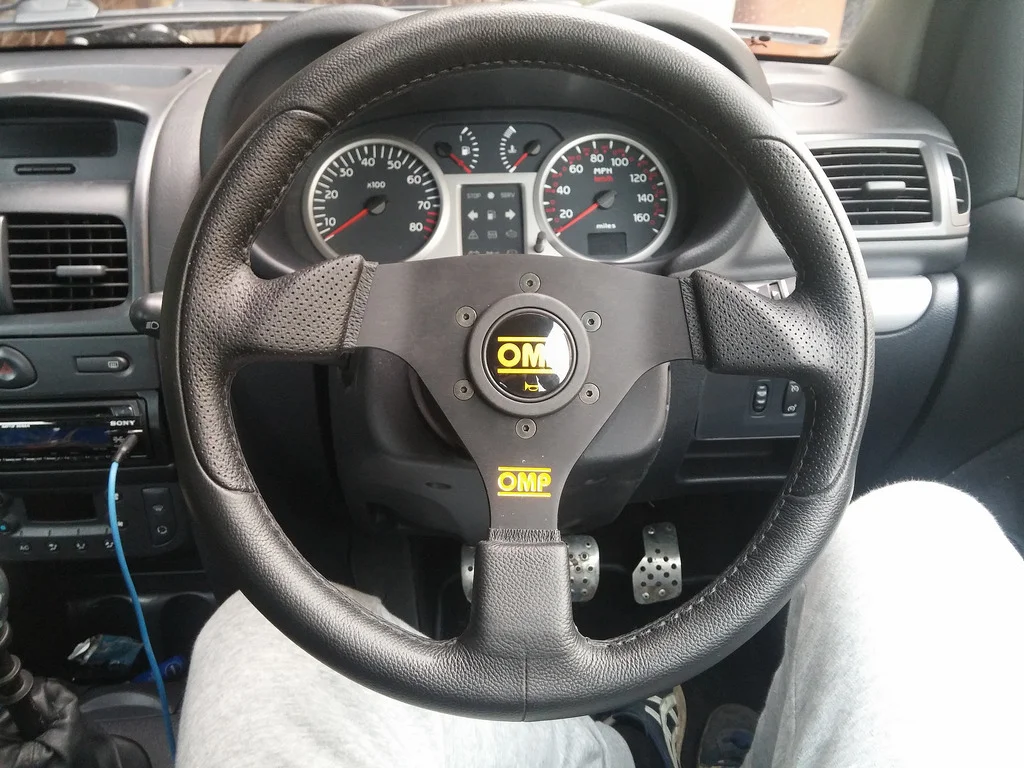

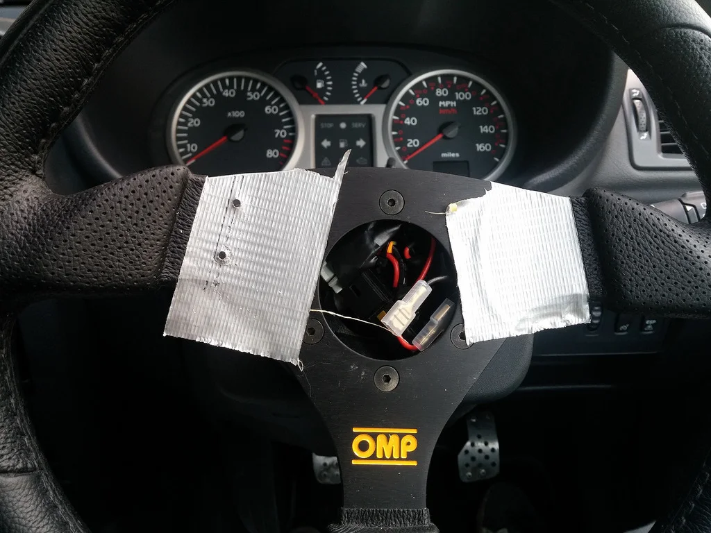

More progress. I haven't stopped today it's been madness!

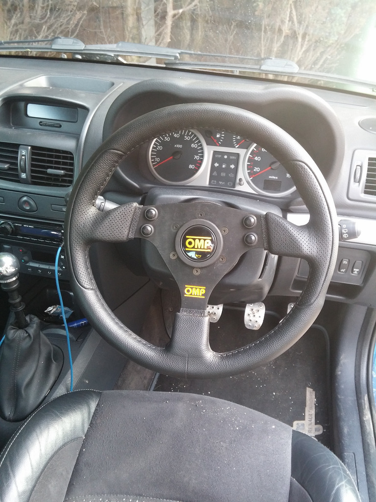

I started by doing the steering wheel controls :)
Here is the wheel, unmolested for the time being
20150202_111717 by dann2707, on Flickr

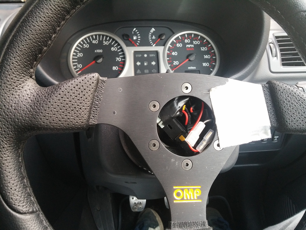

I then got some duct tape and went over the whel where i'm thinking of having the buttons. I put it nice and parallel with the stitching as you can see. Doing this means you can write on it, mark where you want to drill without doing it on the wheel itself. Seems so simple but it really works :)
20150202_112337 by dann2707, on Flickr
I then equally spaced two holes and drilled them lightly to make a mark
20150202_114835 by dann2707, on Flickr
Holes done, now onto the other side :D
20150202_114852 by dann2707, on Flickr
The buttons are now in. I really think i've fucked it up by having too large of a diameter button as i've taken a lot out of the wheel (not shown in the pics) but I think it might weaken it over time.
In hindsight I would have drilled the holes further to the centre of the wheel for strength so i've learnt from my mistake so hopefully you guys don't have to.
20150202_120447 by dann2707, on Flickr
But they're all on anyway :)
20150202_122254 by dann2707, on Flickr
20150202_130933 by dann2707, on Flickr
I then hooked it all up as per the loom yesterday. Sorted :D

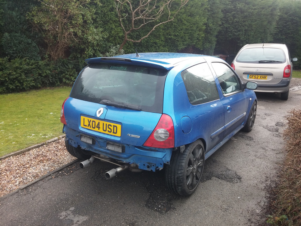

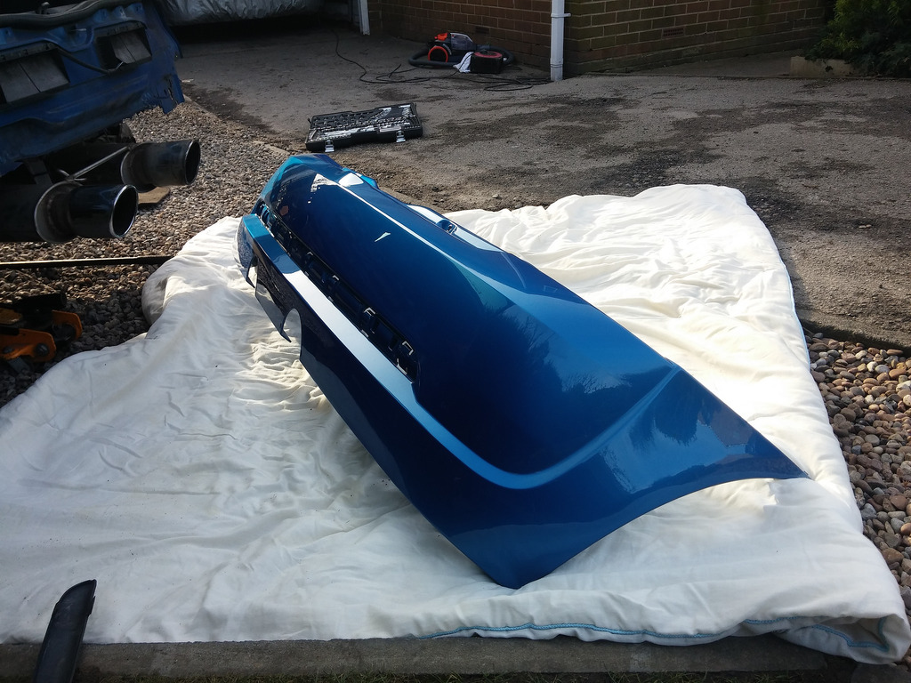

Whilst doing that I saw someone pull up to my drive - guess who it was and what was dropped off :D
20150202_114617 by dann2707, on Flickr
20150202_132330 by dann2707, on Flickr
20150202_132339 by dann2707, on Flickr
20150202_132713 by dann2707, on Flickr
20150202_132720 by dann2707, on Flickr

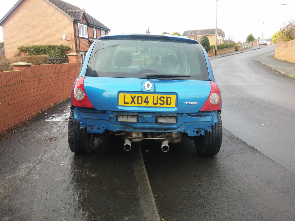

I can't believe it was only £120 for it all. The quality is absolutely incredible. This was the same guy who messed me around before.
Then fitted it. Really easy to put back on. It's finally all come together :D!!! haha
16428987305_74d3b3cbb0_b.jpg20150202_140115
I then jacked up the front and went to fit my washer blanks. Pics got a little bad here as I just cracked on. I will get more pics later after the gym
20150202_143354 by dann2707, on Flickr
Whilst the car was jacked up I started to remove the old ABS ring, so had to remove both ball joints, hub nut, hub knuckle bolts!
20150202_161331 by dann2707, on Flickr
20150202_161327 by dann2707, on Flickr
