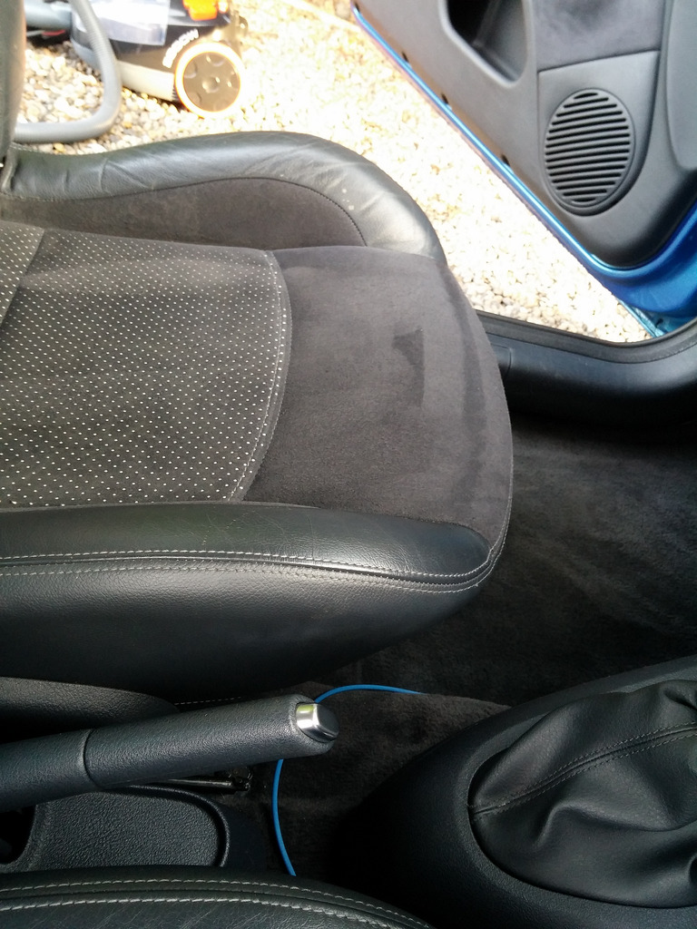

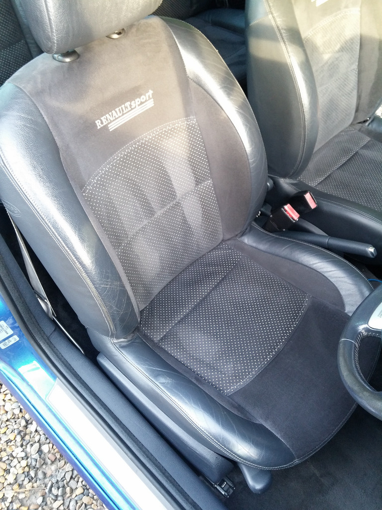

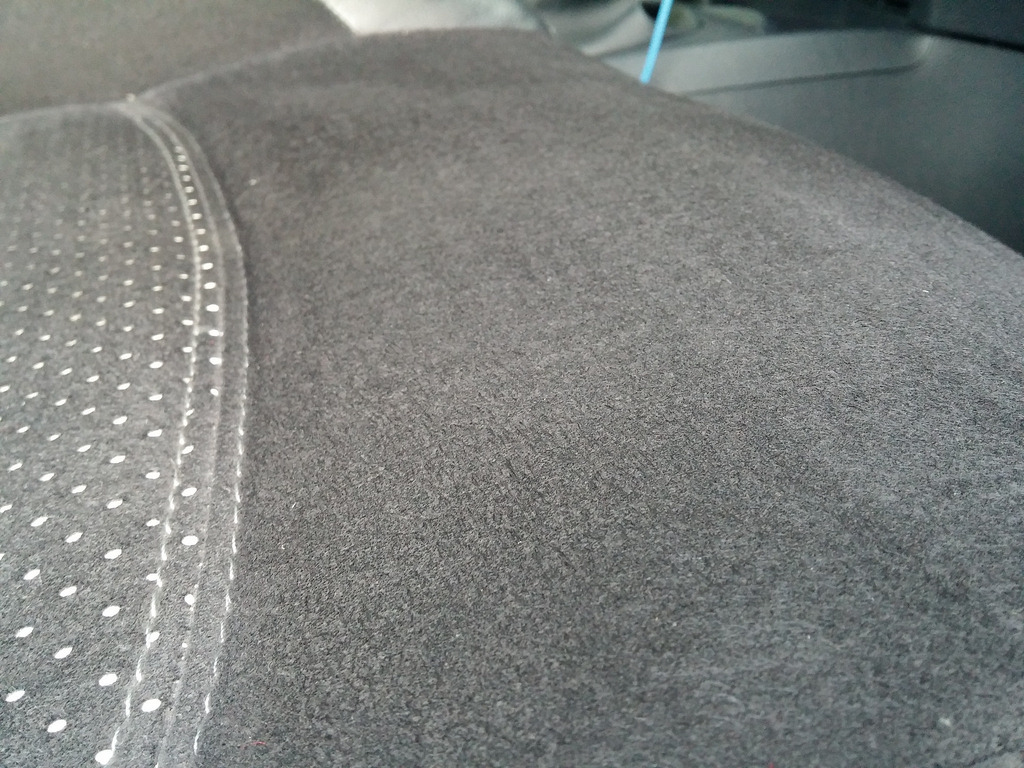

I had a go at debobbling the seats properly too! Really good for £4.50 delivered I think it was.
20141229_134643 by dann2707, on Flickr
20141229_134638 by dann2707, on Flickr
Nice and shaved, just how I love 'em ;)
20141229_134632 by dann2707, on Flickr
dann2707
Wrey, just debobbled mine the other day, makes such a difference. Did you ask for it for xmas or is that just me haha
It does doesn't it! Love the sound it makes too when it's removing the bobbles. I just spontaneously bought mine haha
debobbled lol.
i like that word. where can i get a debobbler for debobbleing for when my seats get bobbly?
Hahaha here ya go man :smiley:

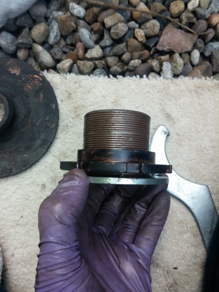

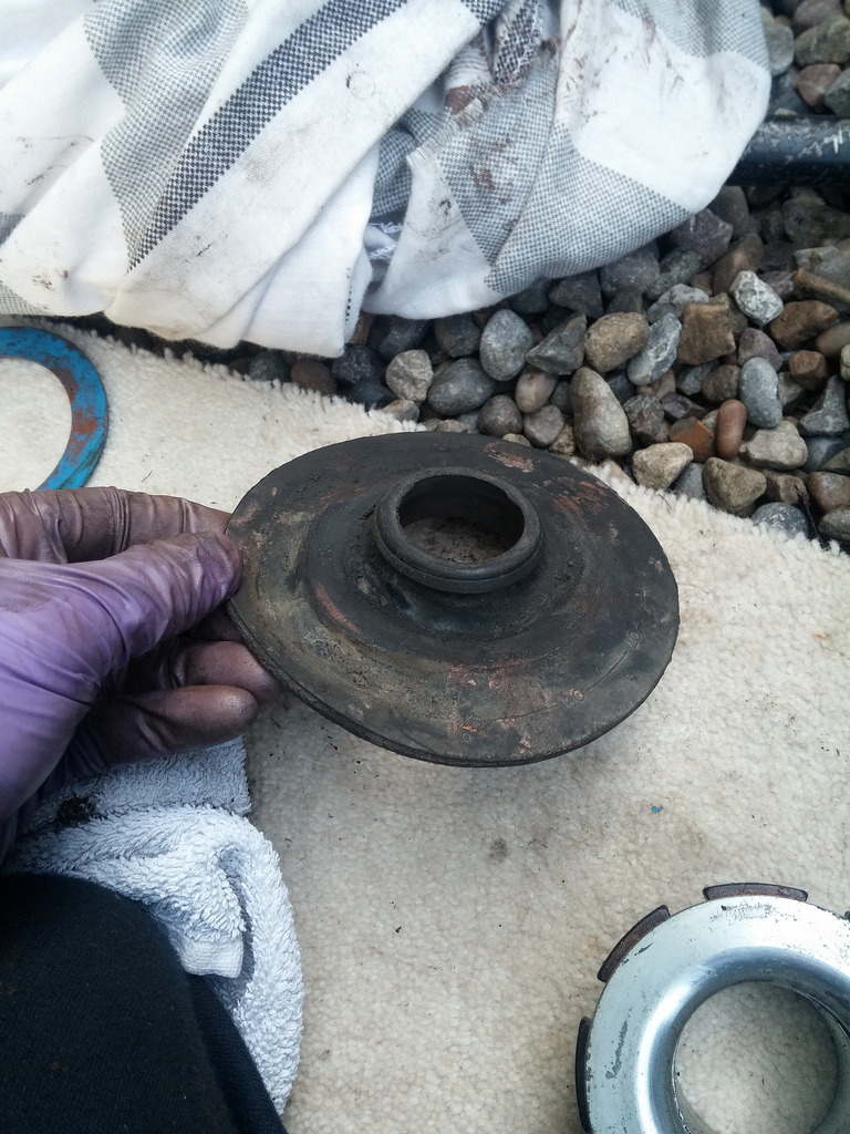

Today I removed these rubber shields for the rear as the rear is still fairly high up even though the adjusters are at the lowest they can go. I'm not sure if it will make much difference to the ride height but they are 6mm thick each (not sure how much that equates to when it's being compressed under the load of the car as it issssss rubber) :
20141230_134655 by dann2707, on Flickr
These are how they are, I don't really want to remove them as that kind of defeats the purpose of having coilovers :p Incy might have seen these pics before ;)
20141230_134710 by dann2707, on Flickr

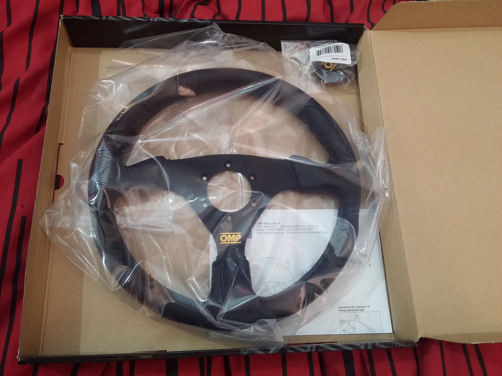

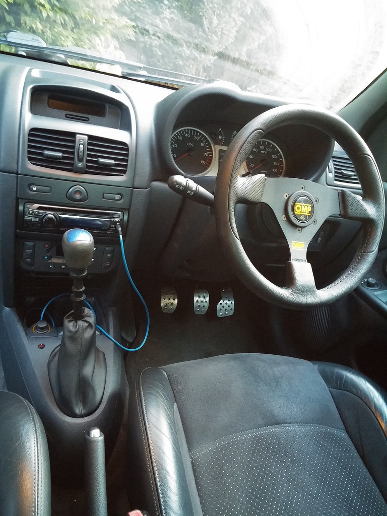

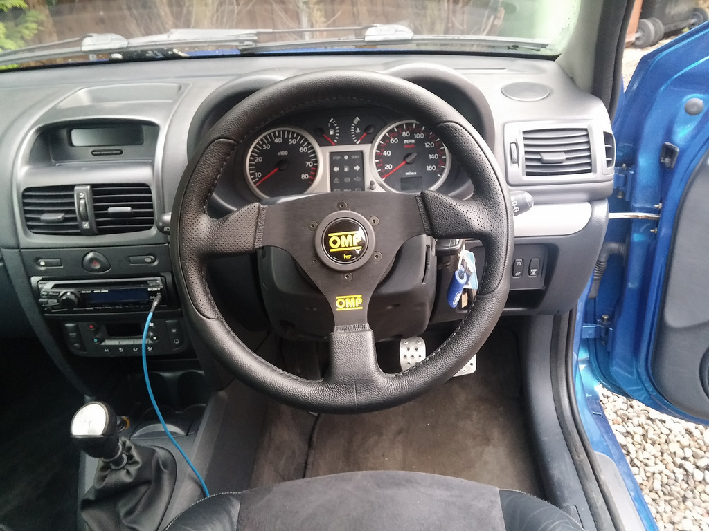

Today I received this :smiley: It's my one of many Christmas presents to myself lol
20141231_123346 by dann2707, on Flickr
20141231_123358 by dann2707, on Flickr
20141231_123416 by dann2707, on Flickr

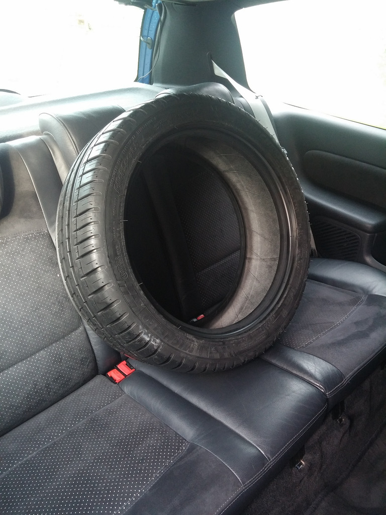

The new tyres arrived too. Michelin PS3's for the rear as I already have some on the front and really get on with them
20141231_124631 by dann2707, on Flickr

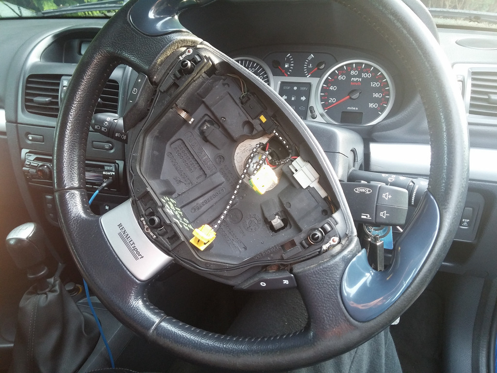

Started fitting the new wheel. This is the original, my god it's f**king hugeeeeee!
20141231_124937 by dann2707, on Flickr

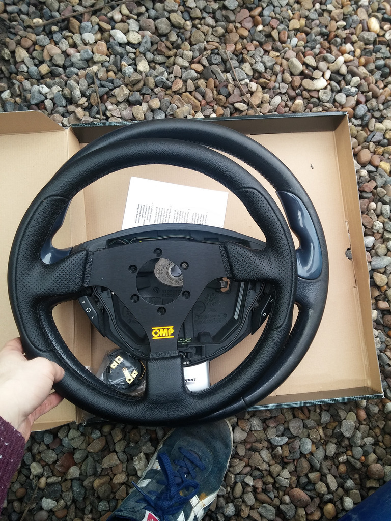

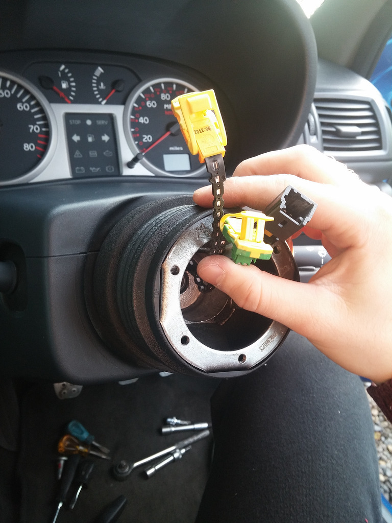

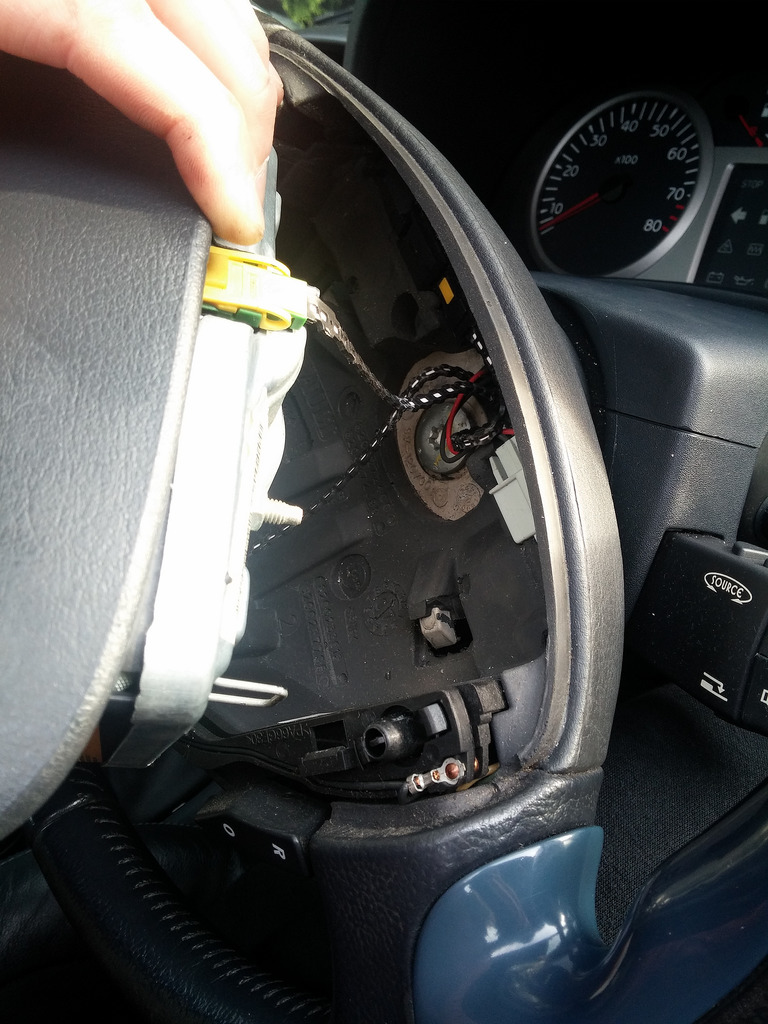

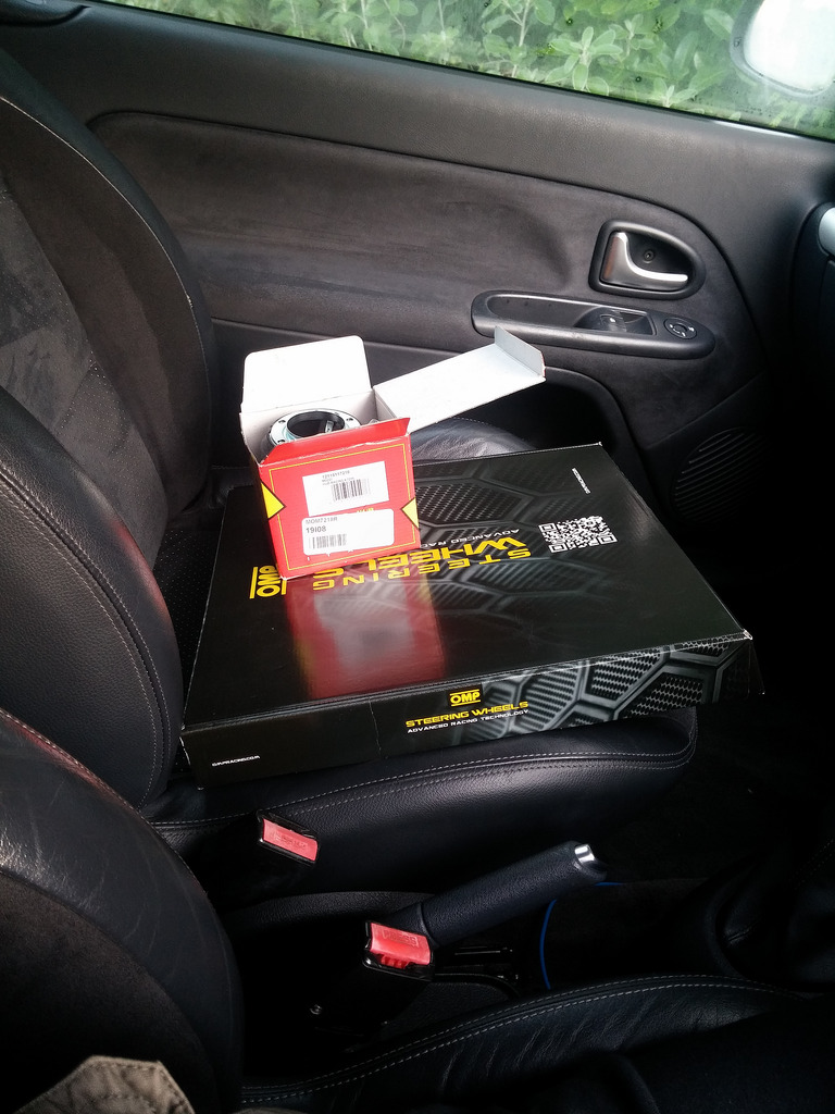

Shiny parts. Opted for a momo boss with it having the larger cut outs for all 4 plugs (2 airbags, 1 horn and 1 cruise control stalk) and also the self cancelling indicator tabs on the back.
20141231_124942 by dann2707, on Flickr

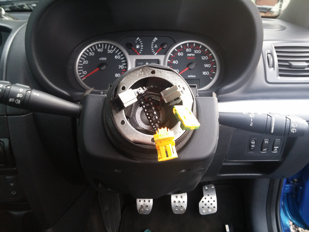

Unclipped the airbag.
20141231_130244 by dann2707, on Flickr
20141231_130341 by dann2707, on Flickr
Nice size difference between the old one and new one!
20141231_130901 by dann2707, on Flickr
Then fitted the new boss.
20141231_131429 by dann2707, on Flickr

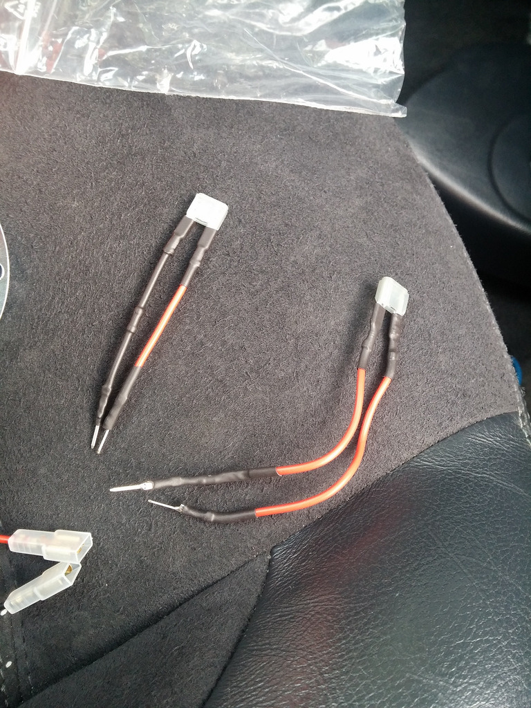

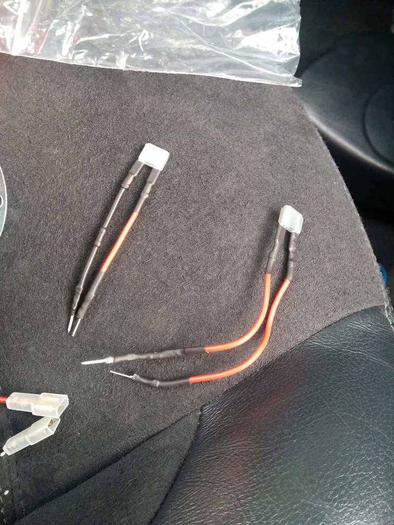

Ordered an airbag light cancelling kit too that comes with a fused resistor. Luckily the momo boss came with one anyway, as I needed two that was spot on!
20141231_131634 by dann2707, on Flickr
Fed it all through.
20141231_133119 by dann2707, on Flickr

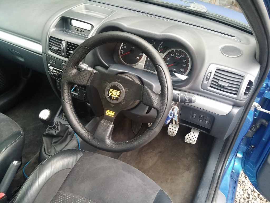

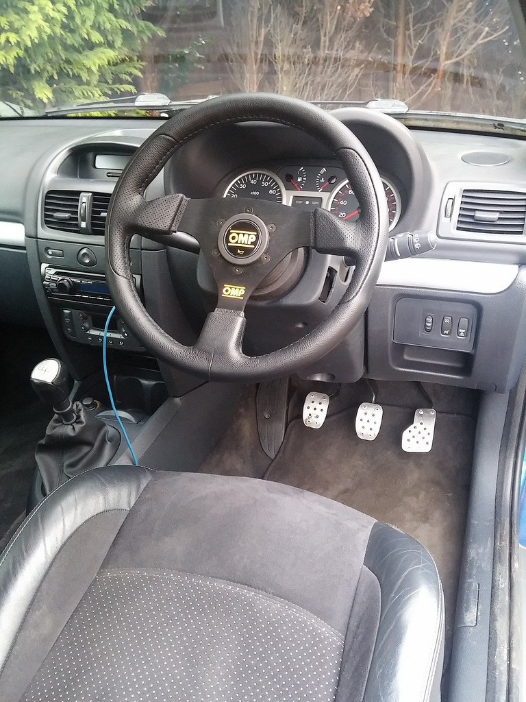

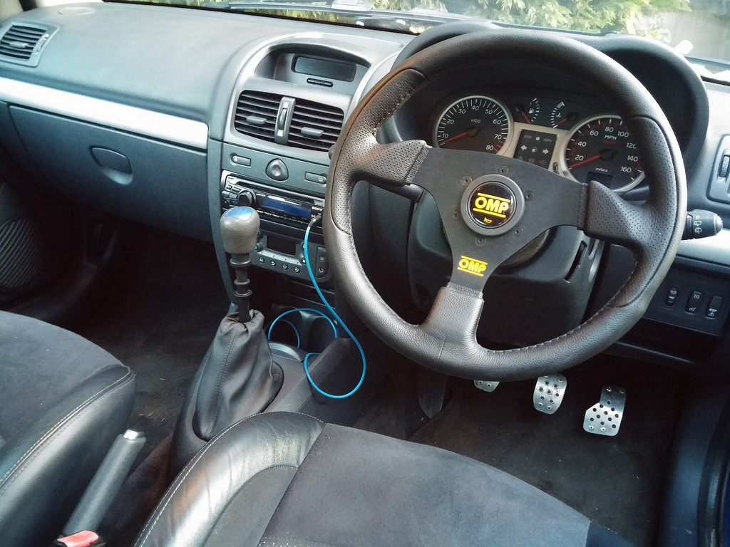

And all on. Really happy with the size (330mm), I couldn't imagine having the smaller 300mm one
20141231_143045 by dann2707, on Flickr
20141231_143049 by dann2707, on Flickr
IMG_20141231_143139 by dann2707, on Flickr

It was £74 for the wheel (it's a racing GP if you're on the lookout) and £60 for the boss!
They do an omp deal on eBay for £109 for it all but the omp boss won't cancel your indicators. Thought I'd do it properly first time around
Thats not too bad, i might get one instead of having my steering wheel re trimmed.
Whats the difference between yours and the one above?
Im not clue'd up at all on steering wheels lol.

You can leave them rubber bits out, it'll be fine mate. If anything you'll hear a few dings and dongs as the rear springs move, but it's nothing to worry about. Btw, 6mm thickness equates to around 10-12mm at the wheel arch mate. It's all about the spring location so I won't bother you with the boring details.
Rubber bits = f**k em off!
dann2707
I love the boring details :D If you've got time and can be bothered i'd genuinely like to know, always up for learning!
Guessing it's something to do with the ratios/ pivot point? As it's completely different to the fronts which are on a 1:1 ratio when you adjust the cups?
NorthloopCup
I love the boring details :smiley: If you've got time and can be bothered i'd genuinely like to know, always up for learning!
Yeah it's the motion ratio mate. They're about 1.7:1 on the rear beam when I calculated it.
So to put that into some sort of perspective a 250lb rear spring in the original position is only a 167lb spring by the time the wheel sees it. Make sense? The fronts are 1:1 so a 450lb spring is exactly the same rate at the wheel (well not quite as you've got to take into consideration the dampers not vertical so some of the spring effort is used to overcome this!) lol!
Next up is roll centres, but there's a big 27 odd page group buy thread about them so I'll leave you to have a look at that!

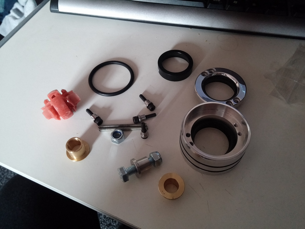

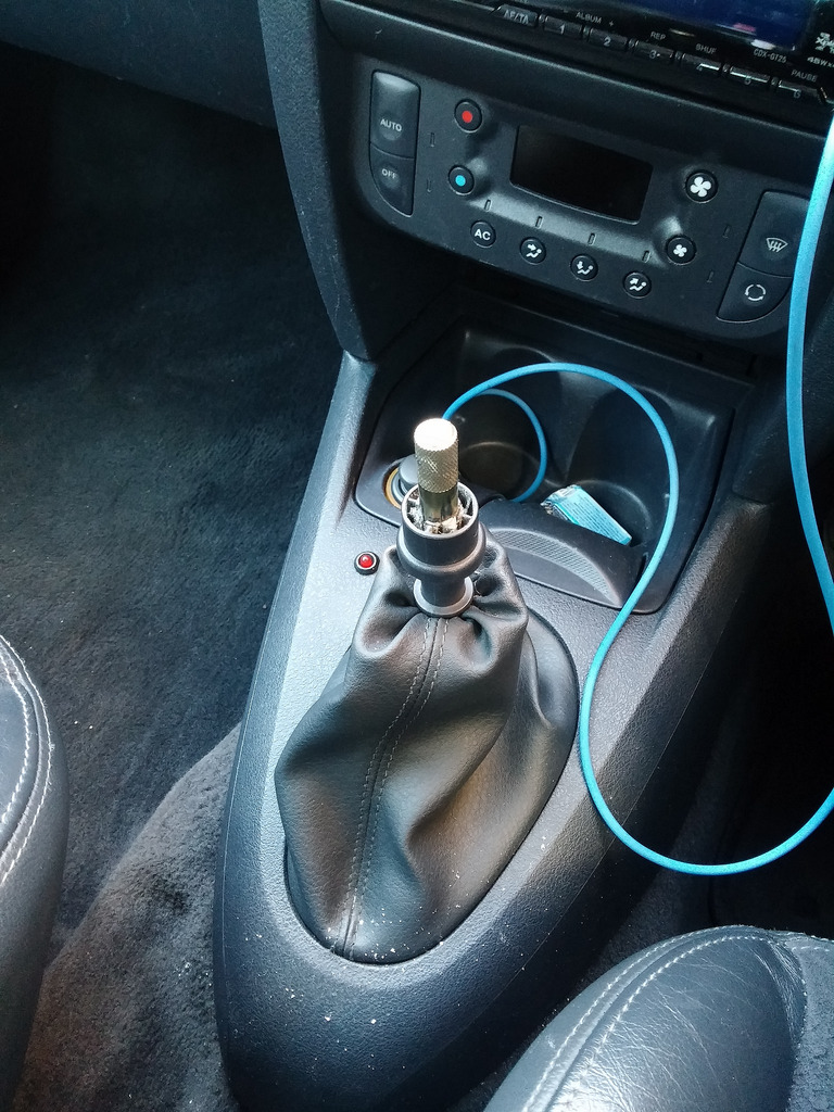

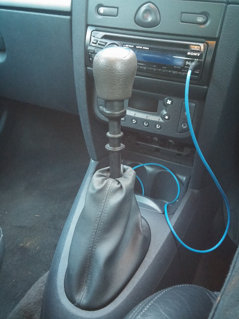

So my @Yanoo Stiff Shift 3.0 kit arrived :smiley: Which as I posted before I was planning on fitting to a Megane Scenic shifter as it's longer.
20150103_131109 by dann2707, on Flickr
Which is a good job really as last night I went bowling and whilst coming home this happened hahahah
20150104_130106 by dann2707, on Flickr

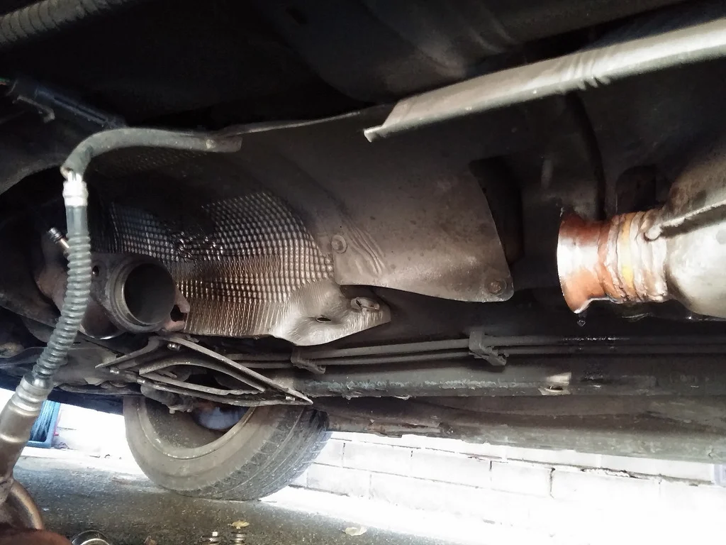

So anyway today I started fitting it. Fitting went fairly smoothly, I ended up snapping a tab that holds the lift up reverse cable to the actual shaft as I was fitting the kit, I was putting lots of pressure on it and it finally gave way and fitted into the gearstick housing and whilst doing so that's when one snapped. I fabricated a bracket though which works perfectly however for peace of mine I will just replace the lift up reverse bit on the shaft when I can.

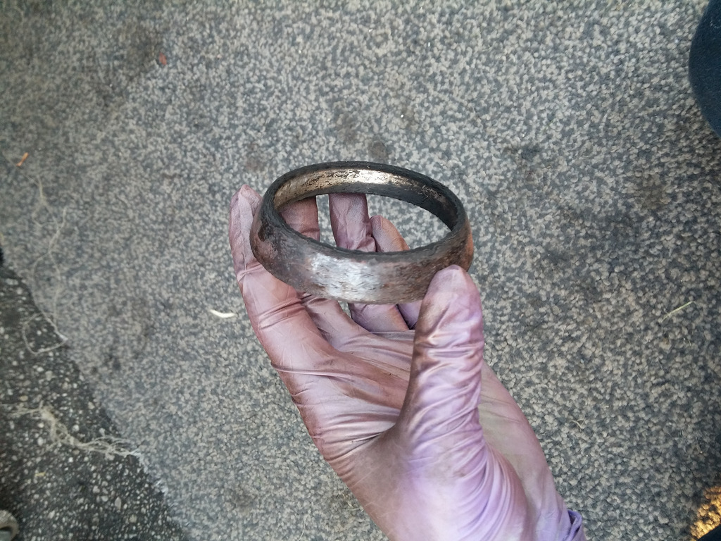

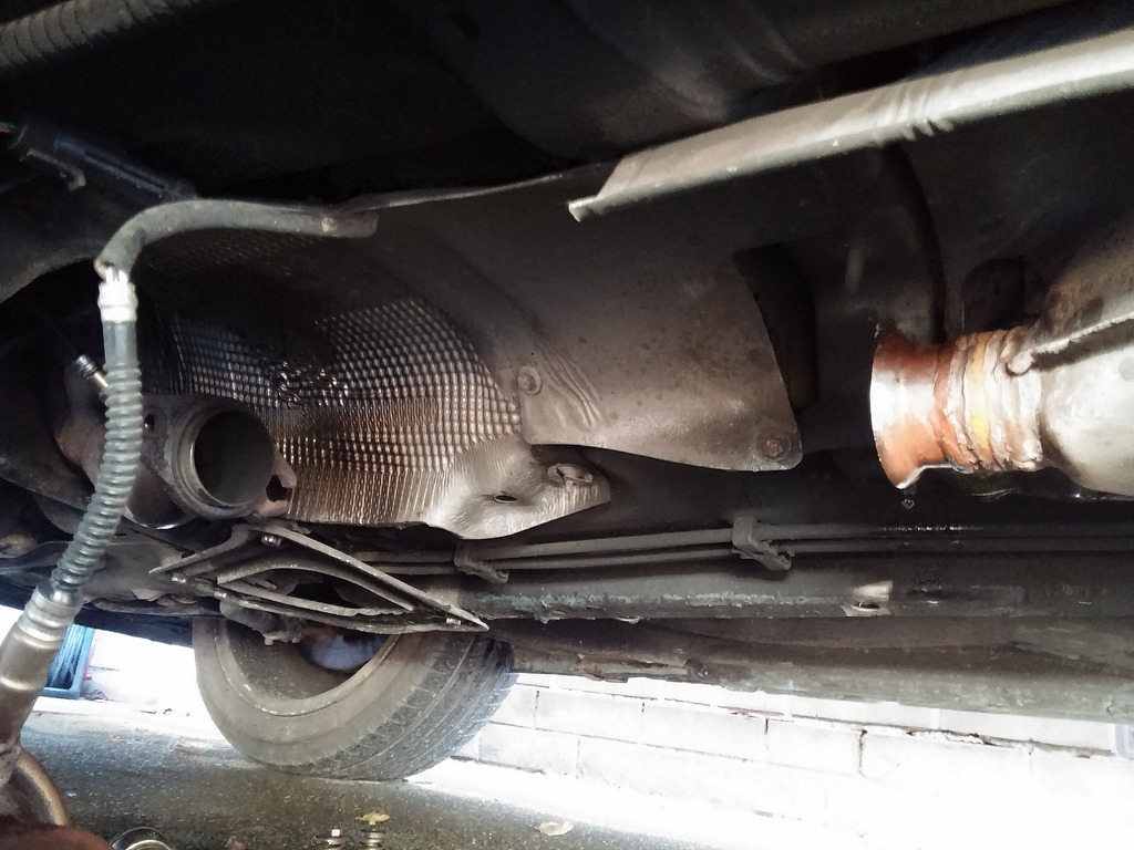

Anyway, started removing the cat. Can't believe how easy this came off to say how rusted it looked. No problems what so ever. The gasket looked a little, worn though?? haha
20150104_132100 by dann2707, on Flickr
Cat removed.
20150104_132111 by dann2707, on Flickr

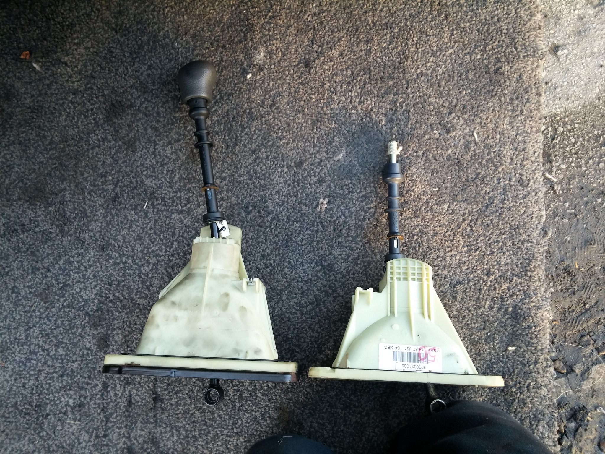

Then undid the heatshield bolts and the 4 bolts holding the gearstick housing to the car along etc etc. Pic shows the difference in length
20150104_132938 by dann2707, on Flickr
Then it's all in :smiley:
20150104_154740 by dann2707, on Flickr
20150104_154915 by dann2707, on Flickr
20150104_154927 by dann2707, on Flickr
20150104_154950 by dann2707, on Flickr

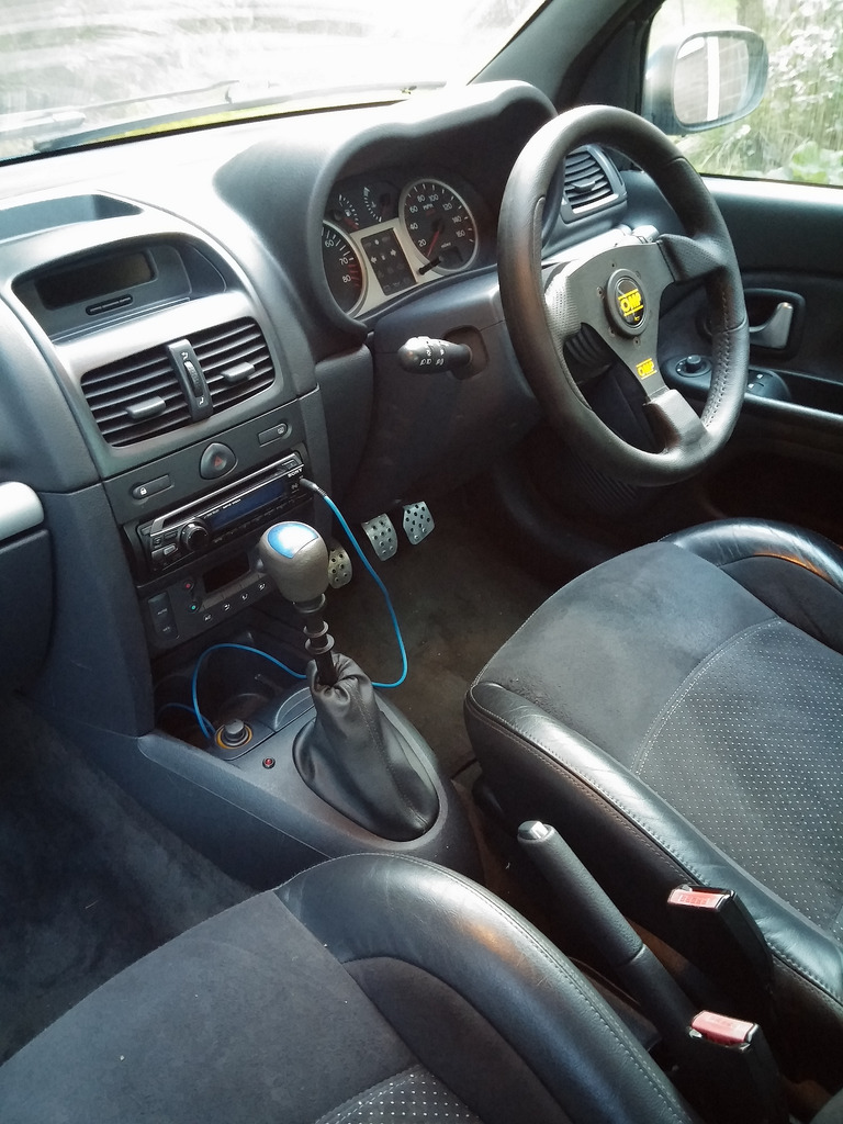

Went for a drive after and it feels amazing! Lovely and stiff but the best thing is that I can adjust how stiff I want the gear changes. Before, I could wobble the gearstick when it was in gear in every direction but now it barely moves at all. Very very happy! Just waiting on my gearknob now to finish it all off :smile:

Hi Dann just wondering does it worry you not having a drivers airbag? I've looked at aftermarket wheels but I like the idea of a safety feature such as an airbag and not sure I'd be happy without...
