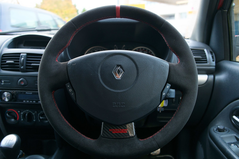

Like the new gearstick very nice. Lucky you have a 182 as the cats on a 172 are a pain in the ass in comparison.
Hi Dann just wondering does it worry you not having a drivers airbag? I've looked at aftermarket wheels but I like the idea of a safety feature such as an airbag and not sure I'd be happy without...
Im thinking the same. Does that OMP wheel have a horn? dont you need that for an MOT? Would love a smaller wheel but lack of airbag and cruise control kinda puts me off. Im going to copy this wheel instead but just have it all black.
@dann2707 I keep looking at your build and you are making me want to spend more money! Please stop!!!
Sorry mate!! I'd say don't give in whilst you have the sanity. I haven't regretted anything i've done to the car yet but I daren't tot up how much i've spent. But then again I think, it's a hobby! I don't go out anymore now that Uni has been and gone and the gf isn't one of those who expects me to pay for everything infact i'd say it's moreso the other way around 🙈
At first it did but then I thought if i'm going to have a crash it's going to hurt regardless haha stupid way of thinking I know but I can't articulate how well it has made driving the car now. No longer do I have this massive thing blocking my view, it's changed the handling too now when i'm wanting to change lanes etc all I have to do is a small turning input and i'm there, way more twitchy but for all the right reasons.
Cheers dude. I wasn't fully sold on it at first. It does come with a horn yeah, where the OMP is in the middle that's the horn. Have you fitted the coilys?

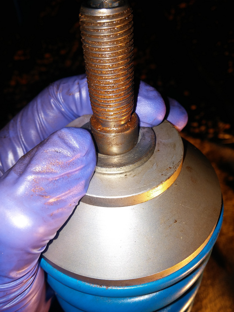

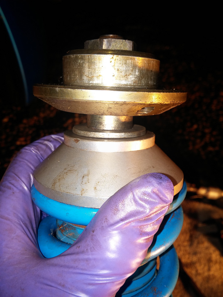

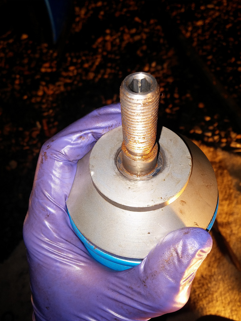

It turned out the washer provided was too small in I.D and needed a bigger one (M22). Pic shows why, hopefully it might help someone else if they're running Bilsteins with Solid top mounts!!
So the thicker part of the coilover that goes through the aluminium looking spring platform and protrudes is 22mm so that when the washer was on it was pressing against the coilover not the spring platform and that's where the wobble was coming from.
2015-01-05 19.48.33 by dann2707, on Flickr
This pic shows what the washer was doing, absolutely f**k all! Should be wider pressing against that platform not against the coilover like it's doing here.

New washer in, much better!!
2015-01-05 19.53.25 by dann2707, on Flickr
There's absolutely no rocking movement now when pressing down on the platform. Shame I could only find one of these washers though! Ordered some more though.

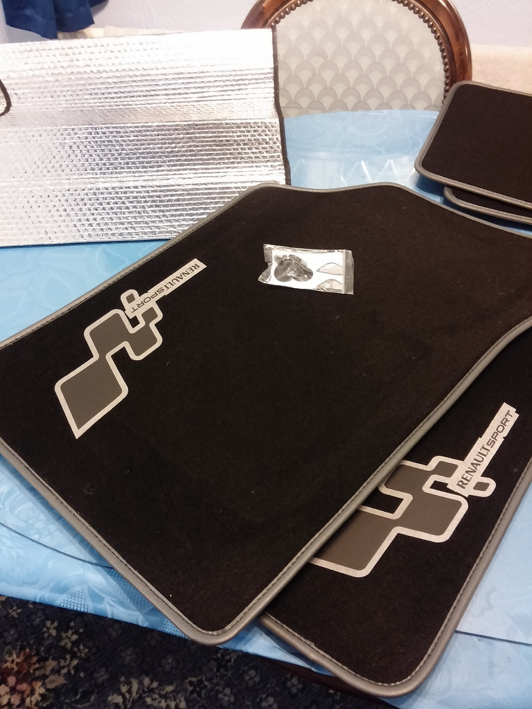

ooooh new mats came also.
2015-01-05 18.43.43 by dann2707, on Flickr
Hi Dan, That 400w light was a really good purchase. Like those mats .

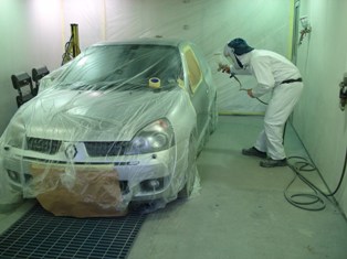

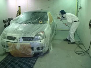

btw just had a look on his website and one of the pics, could this be your car?

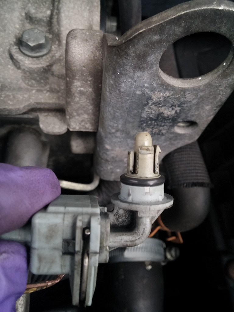

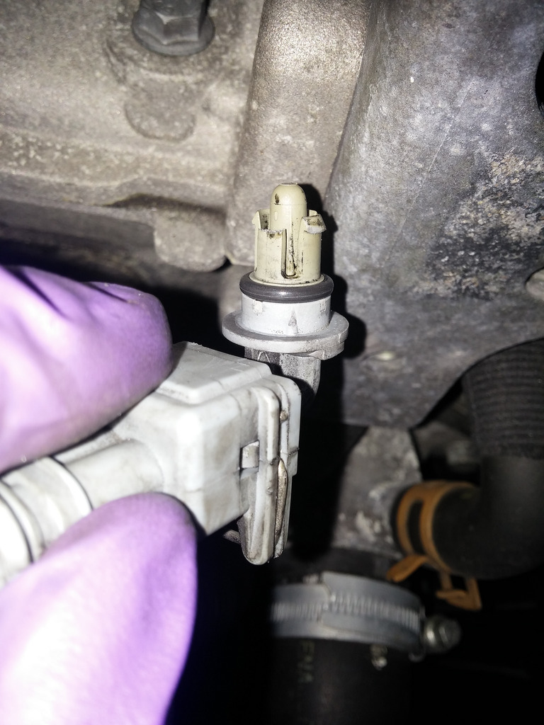

Tried changing the throttle body and cleaning the TDC sensor but to no avail however today my mate came over and we started looking at some of the sensors going into the inlet plenum. I'm hoping these are what's wrong and maybe causing a vacuum leak!
The AIT sensor has a clip broken on it so it's fairly loose, not sure if it's supposed to be loose-ish anyway

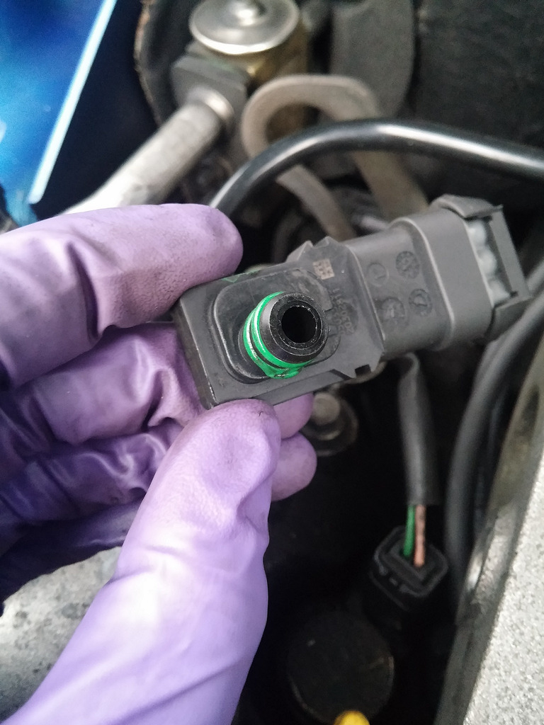

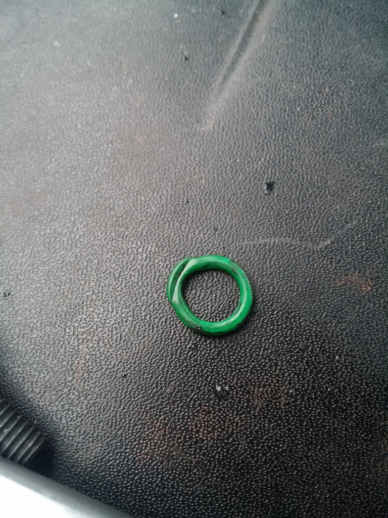

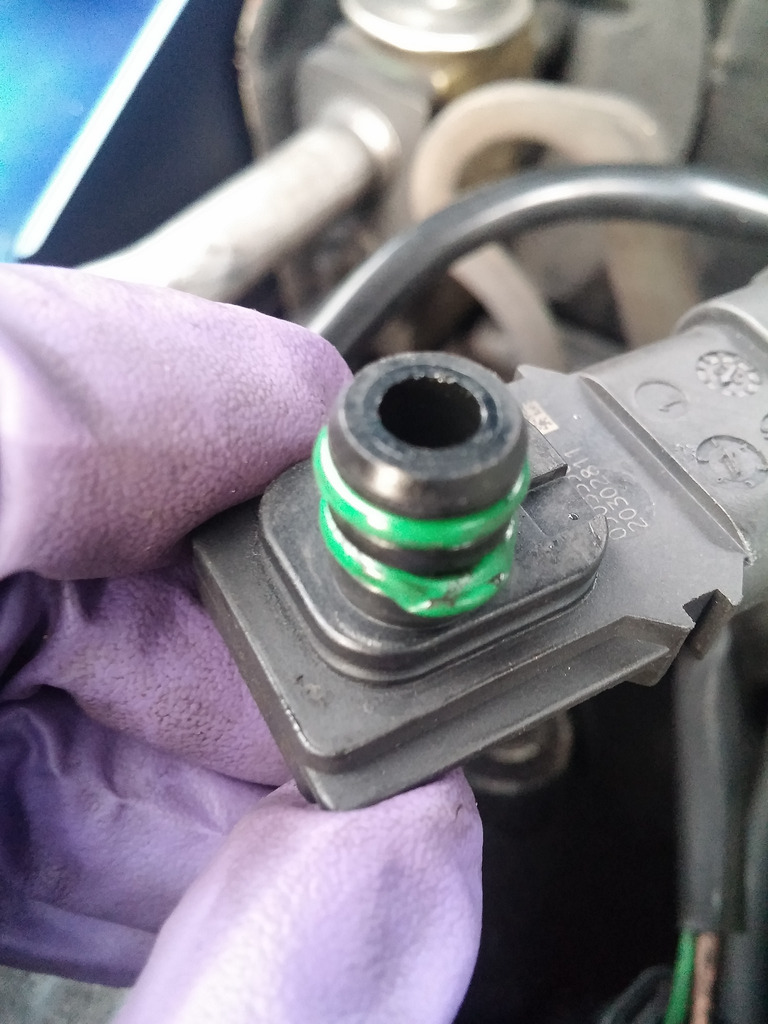

And the MAP sensor looks like this! Changed the seal to a new one now and about to go for a drive to see if it's doing it. The issue is is that it's intermittent so I can't tell straight away if it's solved it.

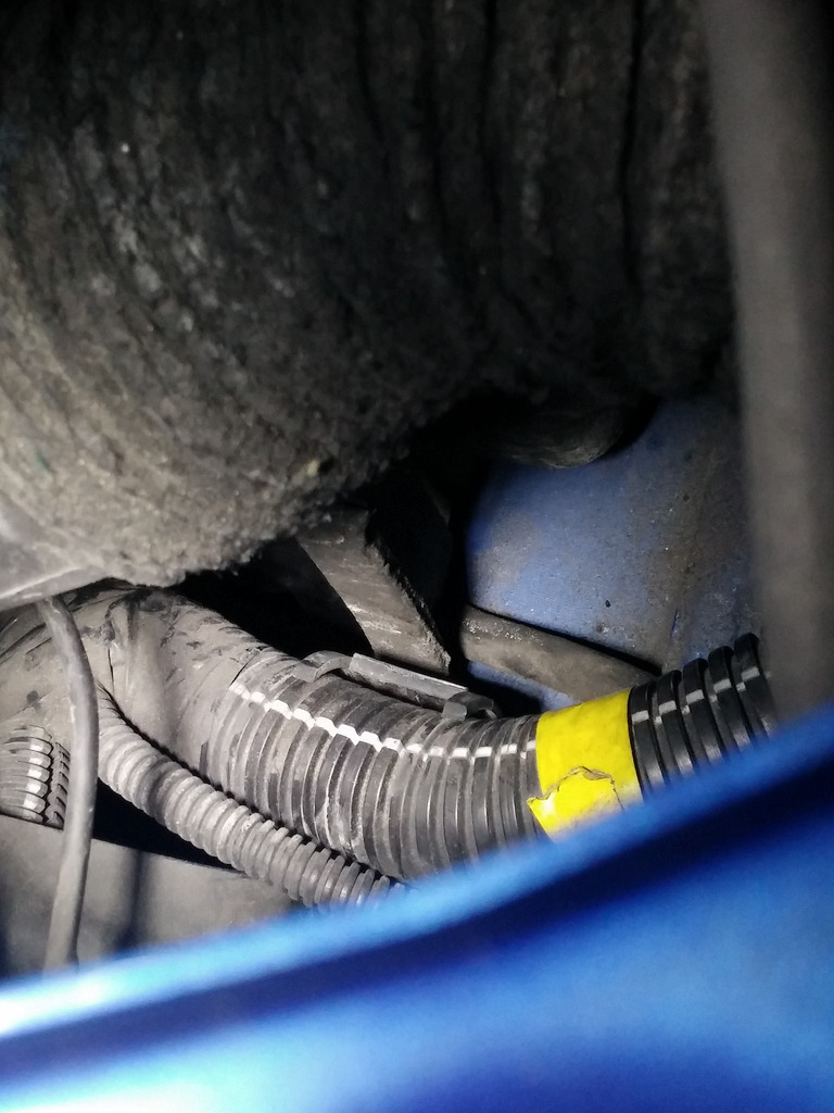

I noticed something in the corner of my eye that made me go HMMMMMMMMMM. Check out this.
20150113_204316 by dann2707, on Flickr

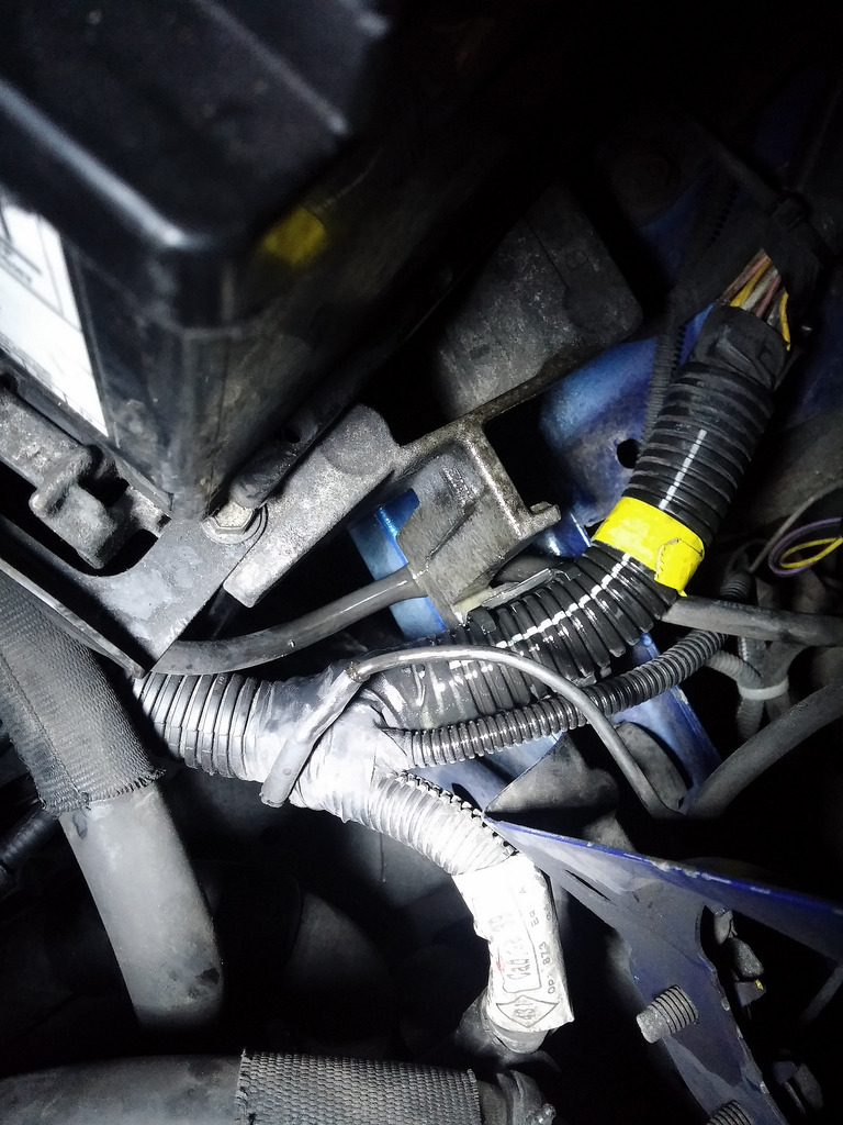

That pipe above the yellow bit is the pipe that goes to the acoustic valve (or a bolt in my case as I removed it yonks ago). And that pipe happens to be crushed under the engine. It's either from when the cambelt was done or the clutch but basically that pipe is trapped under a nice bit of thin metal.
This shows it better!
20150113_205215 by dann2707, on Flickr
So my initial thought is that's giving me a vacuum leak, it's got to be. So I started the engine up and sprayed that area with combustible maintenance spray expecting the engine revs to increase. Nothing :(
However my thought process is this, it's trapped when in gear and when i'm pressing the clutch (when the problem occurs) it's rocking the engine possibly moving this bracket/trapping of pipe and it's allowing a possible split pipe to suck in air if that makes sense? And might suggest why it's doing it intermittently.
What do we think?
I cut the pipe off above the trapped bit and bolted it up so time will tell tomorrow on the drive to work tomorrow!
Cheers Haz, driving to work today was certainly improved. Got the best time to test it too as there was so much traffic and I can definitely say it has stopped it by a lot and I mean a lot.
It used to do this issue around 85% of the time and now it's down to about 5% of the time which is a great! However the other 5% is still annoying that it's not entirely fixed. My last ditch effort is that it may be still doing it from the air intake temperature sensor that I showed before. Will be fitting a new one tonight.

Thats good news mate. Im sure you are right with the intake temperature sensor as I know when my car is cold and its cold outside the revs do jump a little. Have you got a bluetooth OBD2 unit and Torque on your phone? When I was testing out the Fatty induction kit I used this to check the intake temperature and compare the standard air unit to fattys kit. If you havent got one they are really handy to have. I have a few spare if you need one but they only work with android phones.

I'm just wondering if it's not clipped in properly @optical how loose is yours in the inlet plenum do you know? I'd say mine can move in and out around 1cm and can rock side to side really easily. I'll see if I can nab a cable tie from work to try and hold it to the inlet more.

Just had another thought. If the sensor isn't in properly not only will it be causing a vacuum leak to the inlet but also the cold air rushing in is going to be playing havoc with the sensors' readings. The MPG is still fairly decent though. Been averaging 35-36mpg lately. Got me thinking though this haha
Just checked my AIT sensor and it doesnt move at all really, there is a tiny tiny bit of wiggle but all in all its in solidly.
