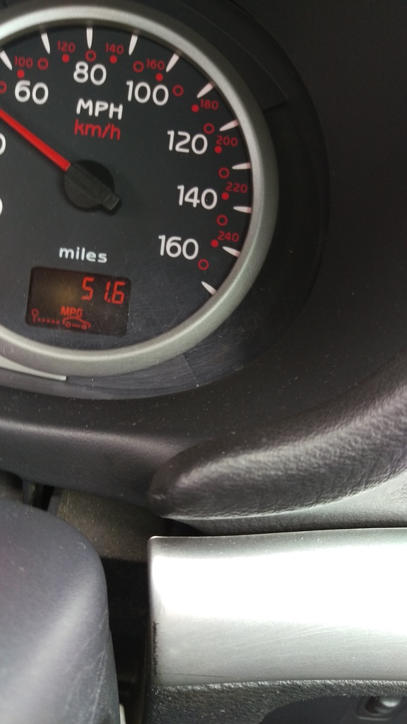

Also achieved this on my drive back from work. Cruise control <3

How the funk did you get that? I'm on 29.9 and can't get it to 30mpg to save my life haha.
Motorway and a very slow speed on cruise control, no traffic too!
That is decent!!

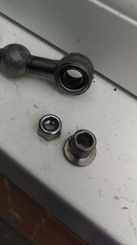

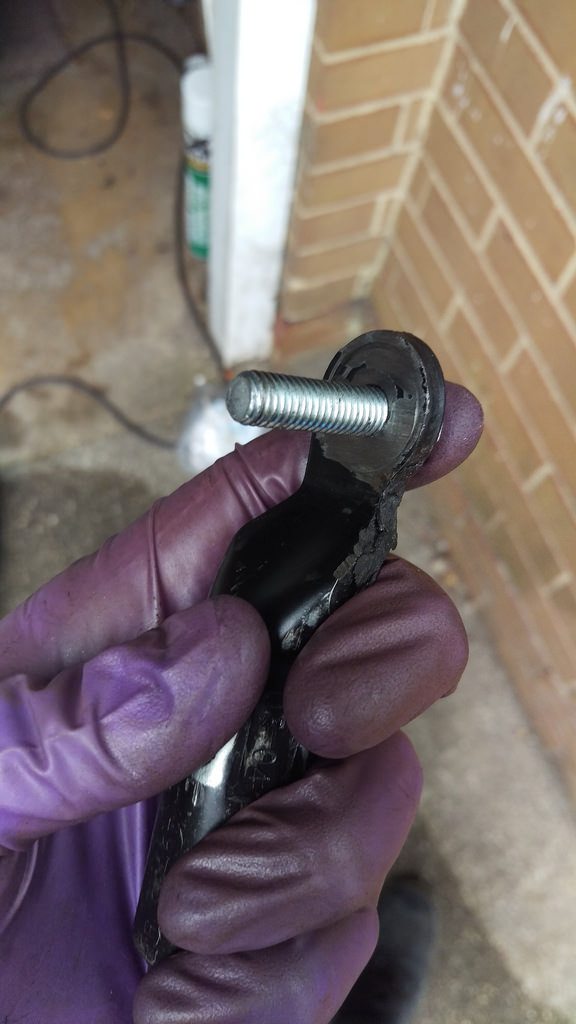

Slight bit of progress in terms of fitting parts, but no progress in terms of my issues :(

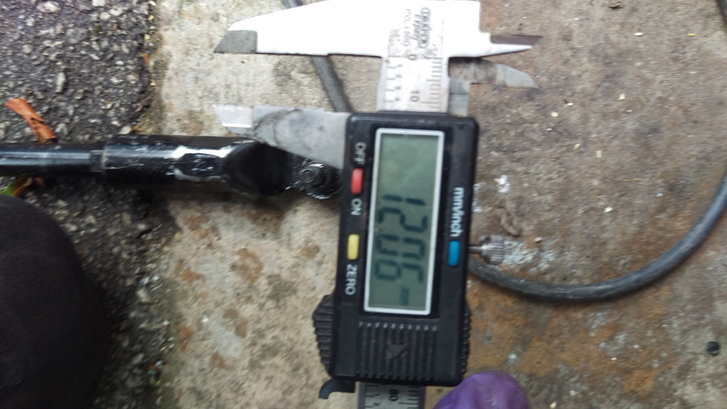

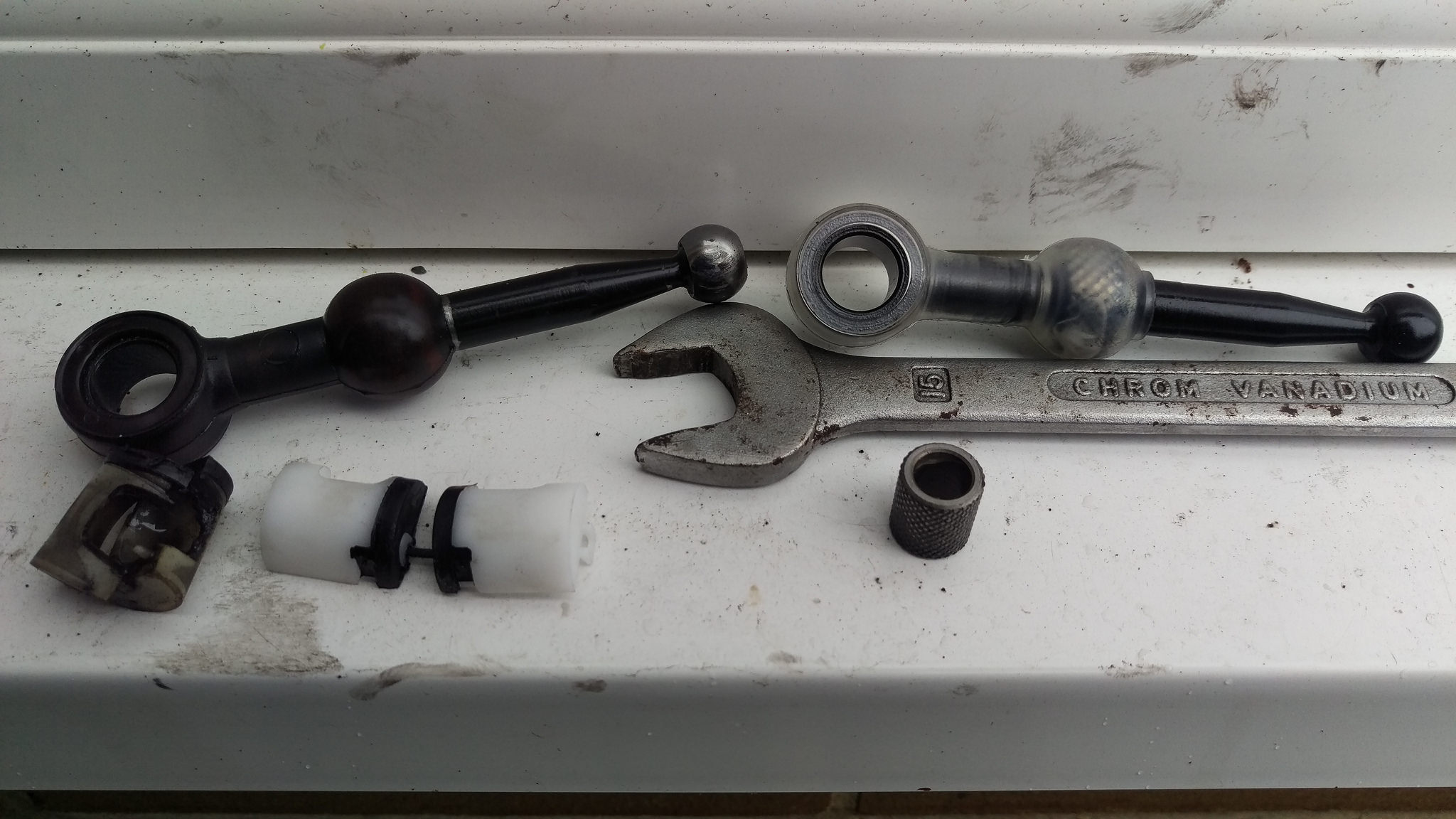

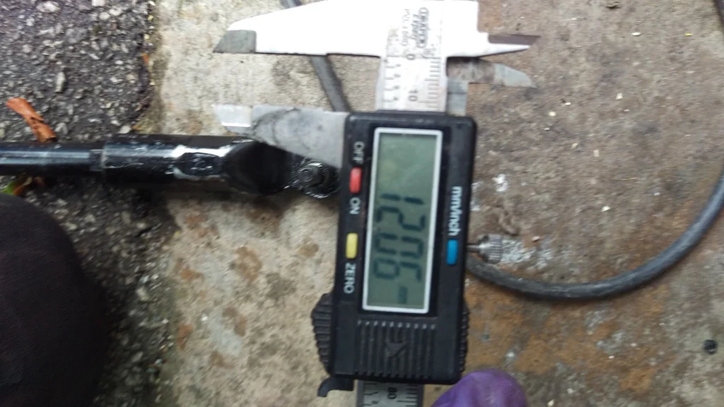

I've been having an issue of when i'm in gear, I can wobble the gearstick left and right by quite a lot which gives a horrible feeling :(

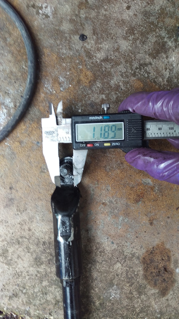

So I ordered a few replacement parts for the gearbox. I noticed that the conrod pictures below, was looseish and I could wobble it a bit so I ordered a new one. Along with the white bush that holds the ball end of the conrod
IMAG0290 by dann2707, on Flickr
I thought it was the conrod that was worn but after vernier calipering the other part @warwickstingray knows the name of this, it's a weird one! I noticed that mine was oval, as shown in the pics
IMAG0294 by dann2707, on Flickr
IMAG0299 by dann2707, on Flickr

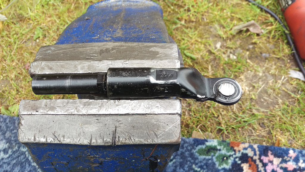

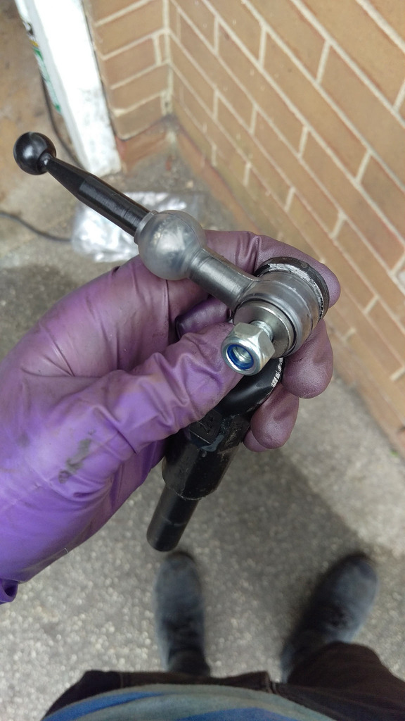

So I cut it off as I had a replacement part from yanoo, which was a solid bush as the pic below:
IMAG0302 by dann2707, on Flickr
I cut it off and drilled through it
IMAG0300 by dann2707, on Flickr
IMAG0301 by dann2707, on Flickr
Which allowed me to fit the new bush
IMAG0303 by dann2707, on Flickr
The bush actually goes the other way but now it's lovely and tight, no sloppiness at all. It didn't solve my issue with it going left and right whilst in gear though which is annoying but I have noticed it going into gear SO much nicer, it just glides in and i'm really happy with that transition.
Just need to try and find what is up with the lateral movement.
Massive thanks to @warwickstingray and @NorthloopCup for the parts codes and help with my stupid questions on that a few weeks ago :)
Dan, you should not have done that! You have converted the pivot-type long linkage end to a piece of sh..t. 😧 That will not work in long run. Strongly suggested to get a new linkage end! This weakened screw solution may cause accident! It is written in the fitting instruction that small bush is for fork type linkage. It is not suitable for pivot type linkage end!
The vid you sent me in PM cleary shows that left-right movement of the gear stick is coming from the gearbox. All JB/JC gearboxes have internal play. Some gearboxes have this play in 3rd or 5th, some have in 5th or 1st, 2nd.
The vid you sent me in PM cleary shows that left-right movement of the gear stick is coming from the gearbox. All JB/JC gearbox has internal play. Some has this play in 3rd or 5th, some has in 5th or 1st, 2nd.

Out of interest and not to question your knowledge obviously but where does the concern lay? Is it with the stresses on the bolt?! When I took it for a drive yesterday it felt sublime changing gear.
The bit as pictured in your vice Dan it's stuck fast in the linkage. I've devised a cunning plan but I'm going to stick some pictures up in my thread, I'll tag you in so you can offer your opinion as to whether it'll work lol.

Dan my linkage end is the similar yours (after you cut/drilled), it came from a Scenic- i don't know if it had been modified like yours or if they used a different linkage end on the scenics maybe? Anyway It has been absolutely fine ever since I fitted it a year ago, it was on another car for some time before this.
The one I took off and replaced looked like yours did before you cut and drilled it.
