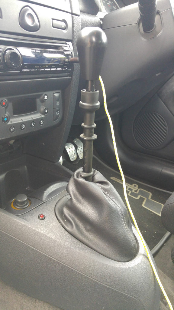

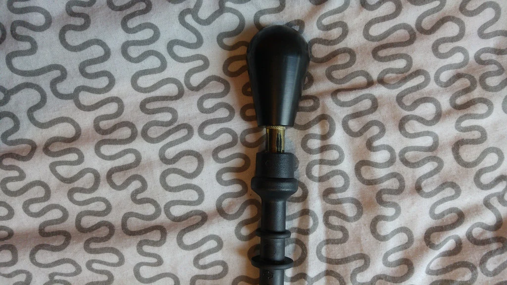

I thought I might aswell show what i'm doing with the gearstick part 2 as i'm ill and can't lay in bed doing absolutely nothing so this relaxes me.
I want to extend the gearstick length even more as I want it closer to the steering wheel further more. The current one I have is from a Renault Scenic which is extended already.

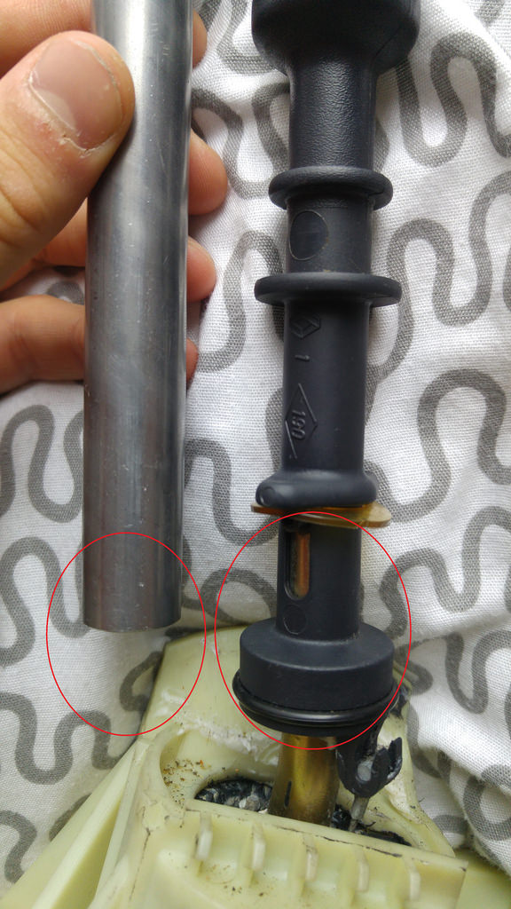

The best way to look at the gearstick is that it's made up of two pieces;
1) The inner rod - this connects to the pivot inside the housing and the bottom pivot bush to the gear linkage
2) The outer shaft - this is for the lift up reverse as it's attached to a collar that lifts up and allows you to get into reverse by lifting over a plastic junction.

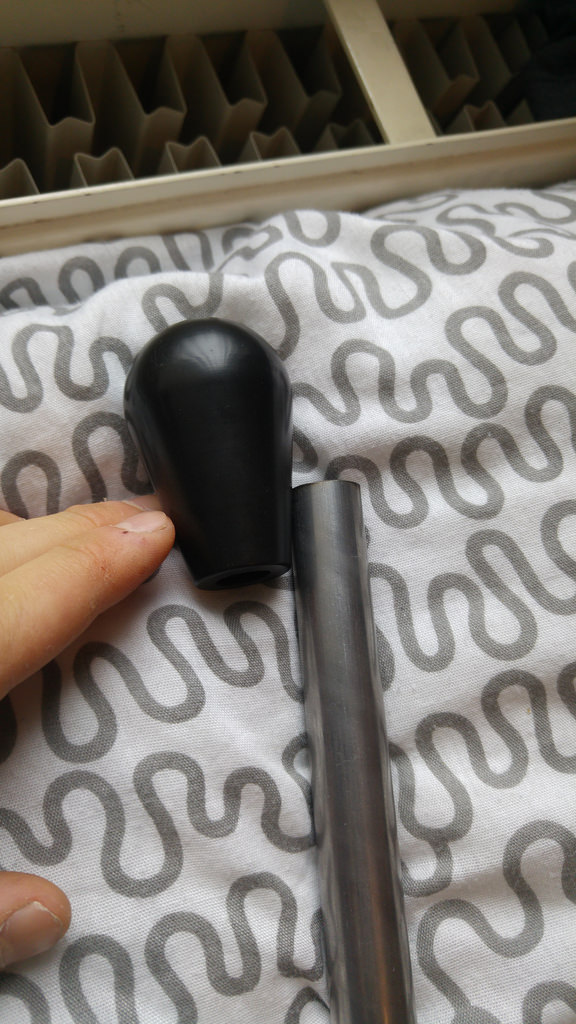

This is mine. The outer bit is plastic and has way too many ridges and doesn't look great. I'm also really not a fan of how you can see the inner rod (the bit inbetween the outer shaft and the gearknob) so I will be dealing with this later.
20160601_141135 by dann2707, on Flickr

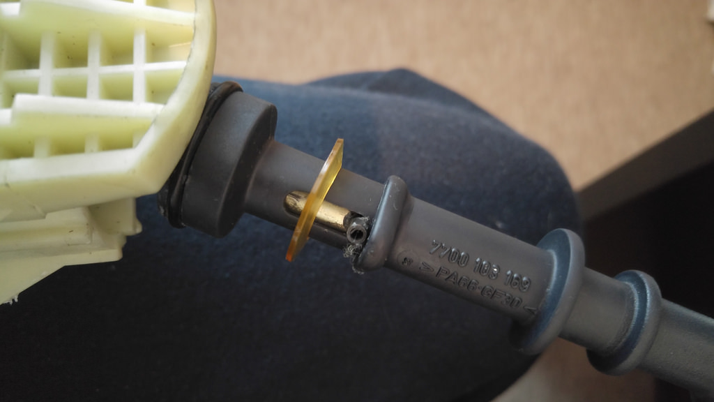

First of all i'm going to extend the inner rod. I'll do this by drilling the original inner rod from the top down and then tap an M5 thread in it. I'll then screw an M5 flat ended grub screw into that by 15mm, with loctite.
I've ordered some 12mm rod which I will also cut down (dependant on how much I want to extend it by) and also tap that to M5. This rod will then screw onto my inner shaft extending it. Done. Did a little pic to explain what I mean.
20160601_141220 by dann2707, on Flickr
This pic shows where I need to think of an idea on how to attach the lift up reverse collar at the bottom right with the cable attached to it, to my rod that I have. The OD of the plastic will fit in my ID of my rod, so maybe epoxy resin, but I don't like the idea of that I really want something more secure.
20160601_140917 by dann2707, on Flickr

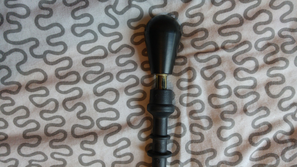

Now coming back to how the inner shaft is visible. You obviously cannot push the gearknob further down as the lift up reverse needs to... lift up and it will collide with the gearknob.
20160601_140820 by dann2707, on Flickr
So my plan is to have the rod inside the gearstick like this...
20160601_141015 by dann2707, on Flickr
I will drill out the bottom of the gearstick to 17mm (the metal tube i'm using is 16mm) so it will fit nicely inside.

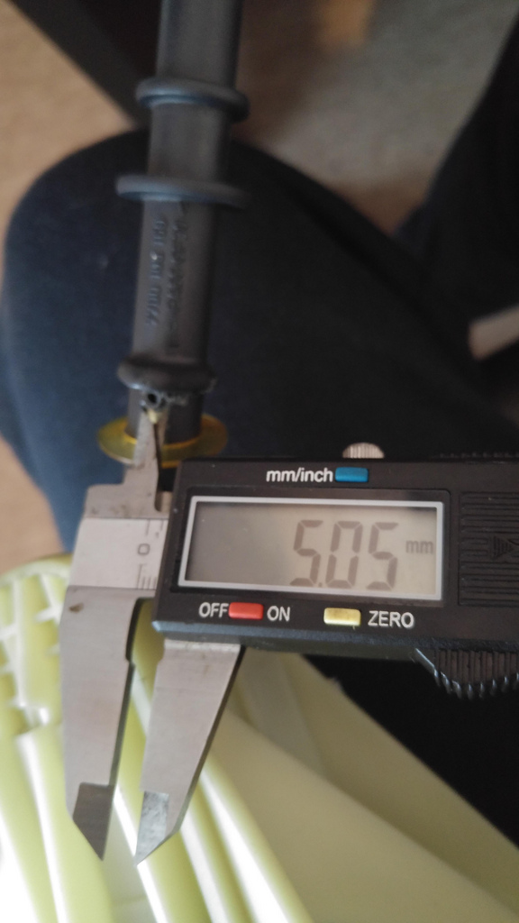

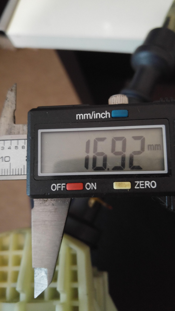

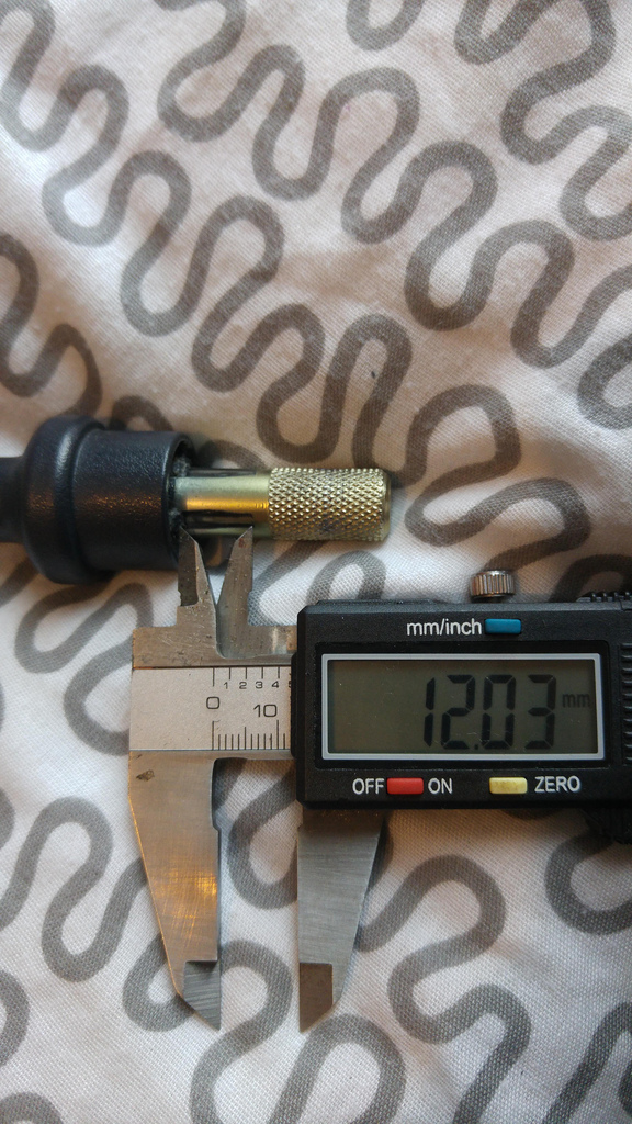

17mm.
And a little trick if you want to know the distance of two holes from each other.
Measure the diameter of the hole as shown here
20160601_142302 by dann2707, on Flickr
5mm
And take away that diameter from the distance. 17-5 = 12mm of travel.
Just to clarify that I looked at the top and you can see where it has scraped and measured that.
20160601_142345 by dann2707, on Flickr
So going back to this image, I now know I need to bore out 12mm of material from the gearknob for the travel of the lift up reverse to work if I want the outer shaft to be located inside my gearstick.

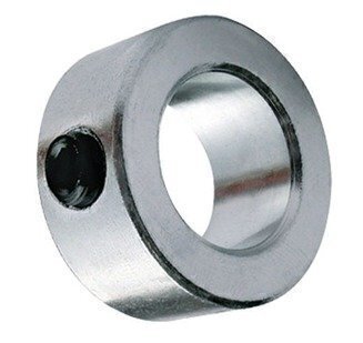

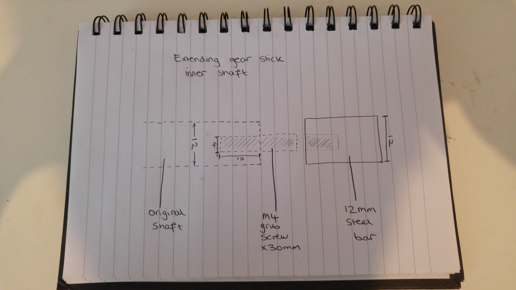

I then needed something to grab on the shaft for the lift up reverse for the drivers hand side of things, so got a 17mm shaft collar. 17mm ID, 28mm OD so plenty to grab hold of.
But yeah, I just need to somehow attach these parts together if anyone has any ideas?

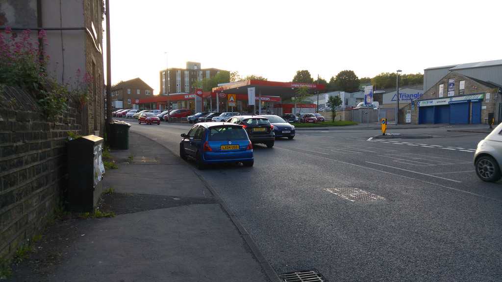

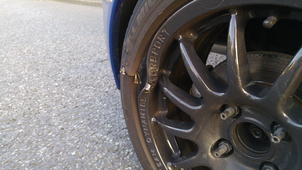

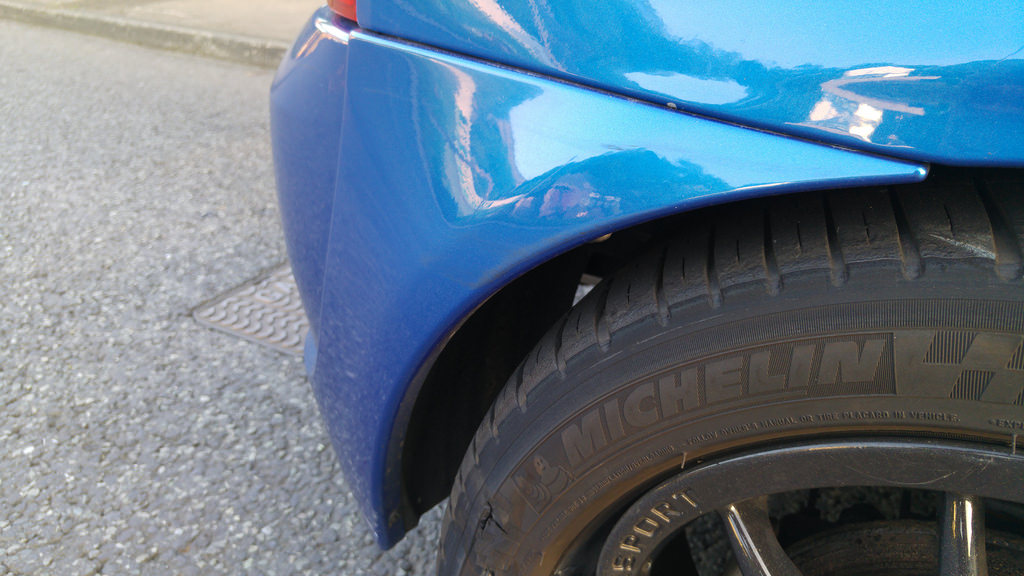

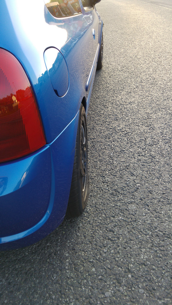

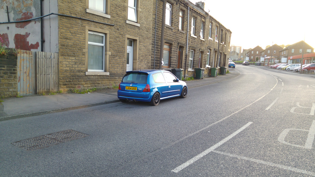

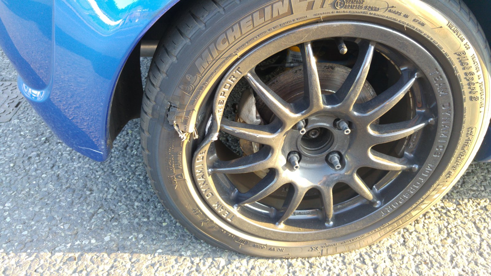

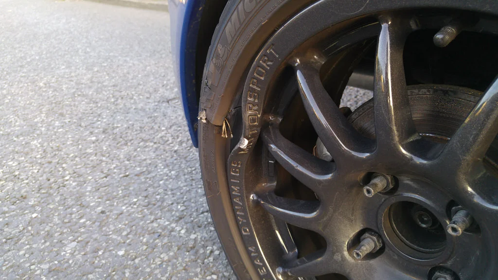

Just came home from Scotland (got the train) to be greeted by this.
Im absolutely f**king fuming. No note left or anything. Scuffs on the bumper too.
If people can kindly not claim it was me driving like what others are doing on csoc that would be f**king fantastic.
Im genuinely seeing red.

I think whats happened is what matty has said above, pics should hopefully give a better idea of whats happened.
Just a few c***s saying that I was driving and i've hit a pothole, or i've definitely caused it.
You tried any neighbours to find out if they see anything? I can't stand people who don't own up to stuff like this.
Hope you can get it all sorted, you've obviously put a lot of work into the car.
Yeah man, no ones heard anything 😧
can see the scuff on the bumper and the white scratch

Gutted to see, not what you want when you come home.
At least it's not done too much damage to the paintwork, everything else is hopefully just bolting new bits on although hopefully it's just the wheel. Fair old force gone into that though
That's pretty random. If it's a lorry probably didn't even realise it, you'd like to think anyway. If not then some people are just thoughtless c**nts.

Cars looking really good mate shame about what happened to your wheel :(
