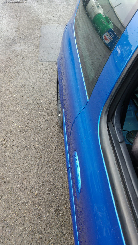

f**k!
Definitely a wagons tail end caught that.
Lol at supposedly causing such a huge buckle in a pot hole.
Thats seriously s**t mate. Especially on such a loved car...
Yeah I agree completely. it's a massive f**king ballache!
Gutted to see, not what you want when you come home.
At least it's not done too much damage to the paintwork, everything else is hopefully just bolting new bits on although hopefully it's just the wheel. Fair old force gone into that though
I was thinking that, I would be massively bummed if all the side of the car was scratched.
That's pretty random. If it's a lorry probably didn't even realise it, you'd like to think anyway. If not then some people are just thoughtless c**nts.

At least it's a cheap and easy fix mate, I'd rather replace a wheel/tyre than have some bodywork done!
Definitely!
Hopefully the rear beam, and the studs/nuts are all okay too mate
I think the rear beam or stub is bent :( man maths is kicking in already though and I will polybush the rear beam if I get a new one whilst it's all out.

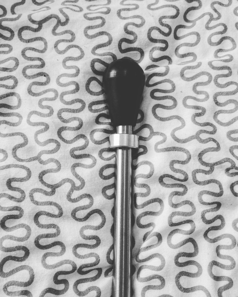

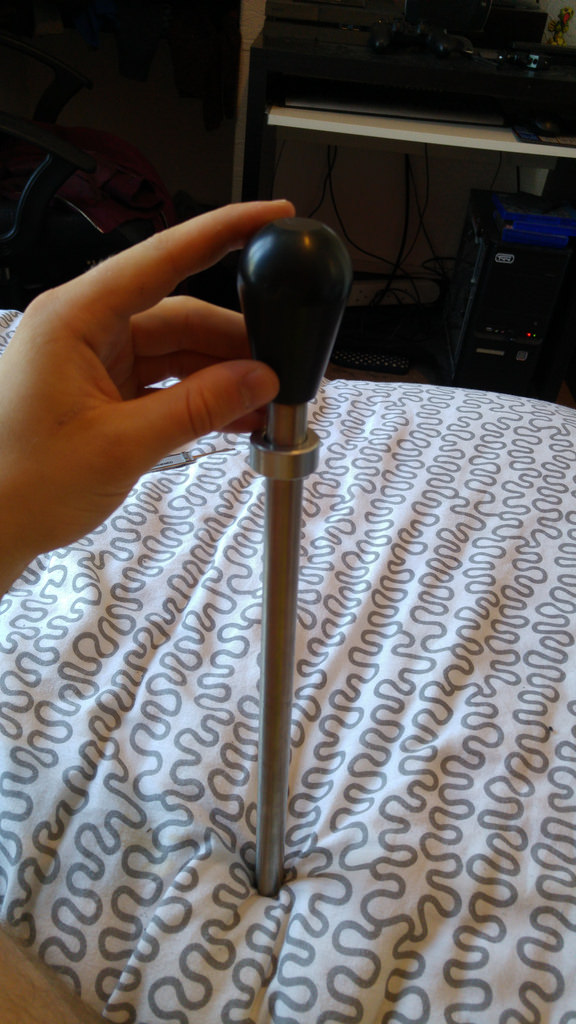

Also received my shaft for the gearstick mod. This is how it will look. 17mm shaft collar for the lift up reverse. Think it's going to look good, will probably powdercoat the shaft black or spray it.
20160606_112202 by dann2707, on Flickr
Going to use another shaft collar for the lift up reverse as it's very very similar diameter, just figuring out a way to attach the steel rope to the shaft collar.

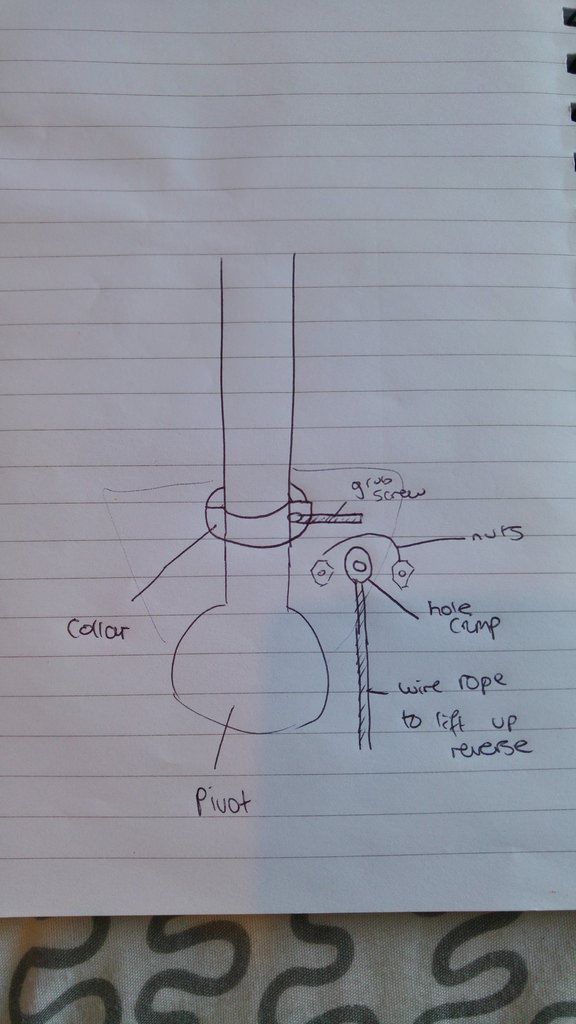

Going to get some more steel wire, with more of these connections for the bottom, but crimp the other side to a hole crimp, screw that onto the grub screw of the shaft collar.
Pic i've just drawn now should crudely show what I mean

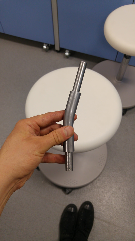

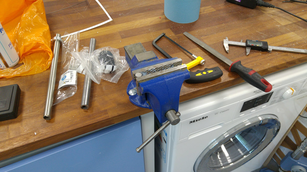

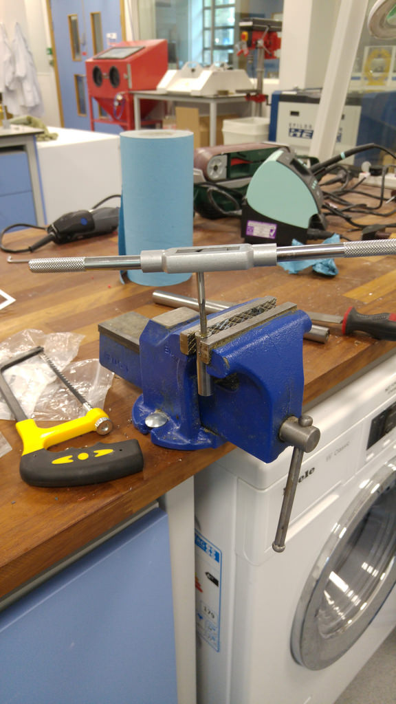

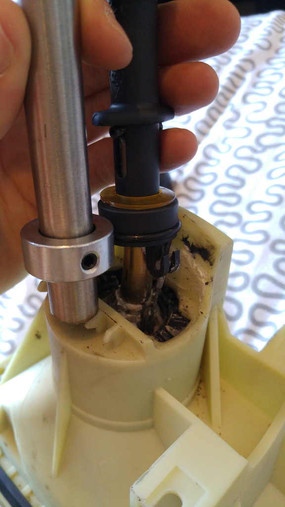

Made more progress tonight after work. Wish I had access to a lathe for making the holes concentric and for tapping.
Started with the inner shaft extension, 50mm longer part in a vice, drilled and tapped for a grub screw which is going to screw into my gearstick.
20160609_171825 by dann2707, on Flickr
20160609_175657 by dann2707, on Flickr

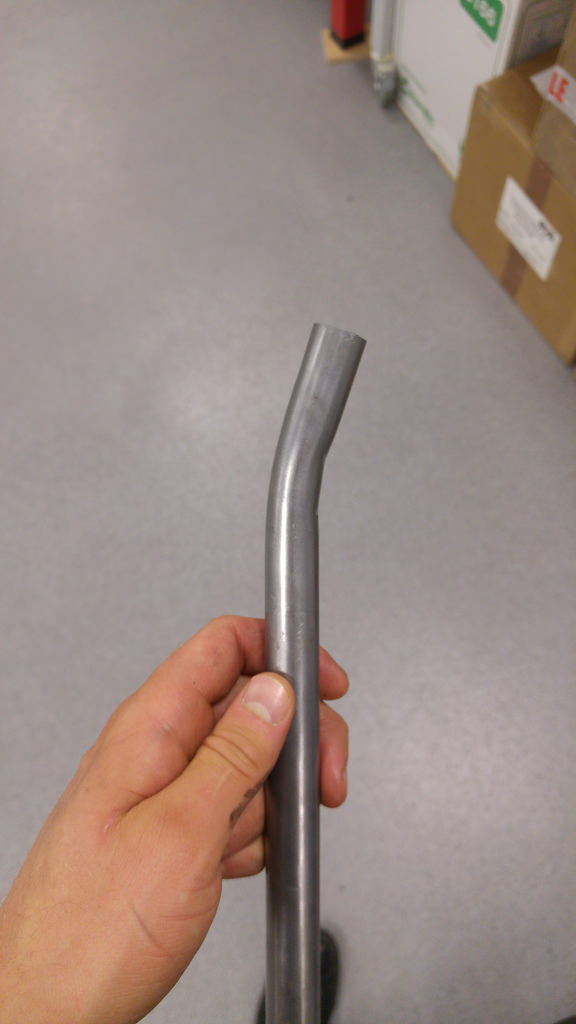

I then pressed the tube that's going under the pivot point in a press for the desired angle of the gearstick.

How it's going to look under the car.

I then drilled holes in it for it to attach to my original gearstick. I've decided i'm not going to be using a grub screw to hold it to my gearstick and instead im going to tap holes in the gearstick and simply bolt it instead. Seems more secure that way.

With the stick, was you going to be just tightening up the grub screw to keep it in place? As you say, drilling and tapping through both the gearstick and your extension, then bolting will be much more secure and stronger.

That first picture looks like you've put a vice in your kitchen, I'm thinking your landlords not going to like that that! Until I scrolled down.
Interested to see the finished gear stick, it's good to see someone trying to do something properly.

Yeah I was going to use four grub screws overall then using locking nylocs on them to hold it (also drilling a very small location hole in the gearstick) but i've always had it in the back of my head that it's going to work itself loose.
Going to tap the gearstick, put the bolt through and tighten that then have the bolt ever so slightly longer than the OD of the extension so I can then put a nut on it to keep it locked in place. Sounds much better do you think?
Just flicked back to your original paper drawing, to see about the grub screws. As you say, bolting will be a lot more secure and stronger. What size bolts you going with, M5 or...? Could also put "bond loc" on the threads of you really didn't want it going anywhere.
dann2707
Yeah I was thinking M5 and threadloc too! It should be complete next week.

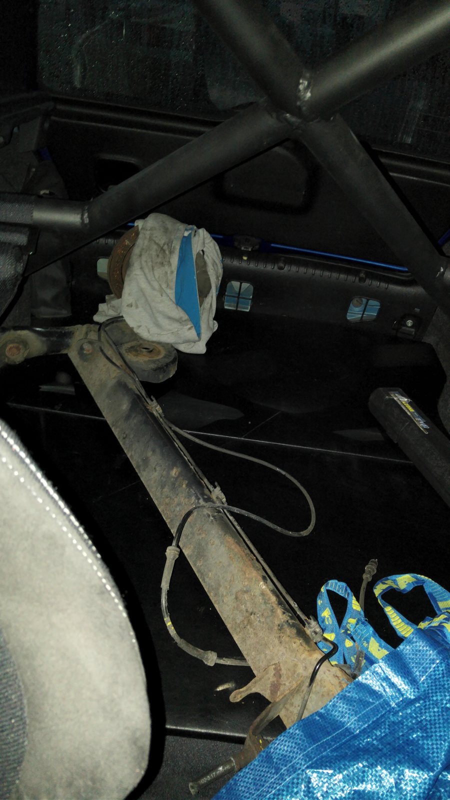

So @Louis' came around today to do me a massive favour as i'm borrowing his spare wheel. Cheers again mate
I was going to go to Newcastle to pick up the new wheels but my Dad has offered to go for me which saves me money and time. So instead i'm going to collect a rear beam as I may aswell replace mine as mine looks bent to book. It drives okay though. Noticed something new though, when setting off the car is juddering like the clutch is going (it won't be as its fairly new).

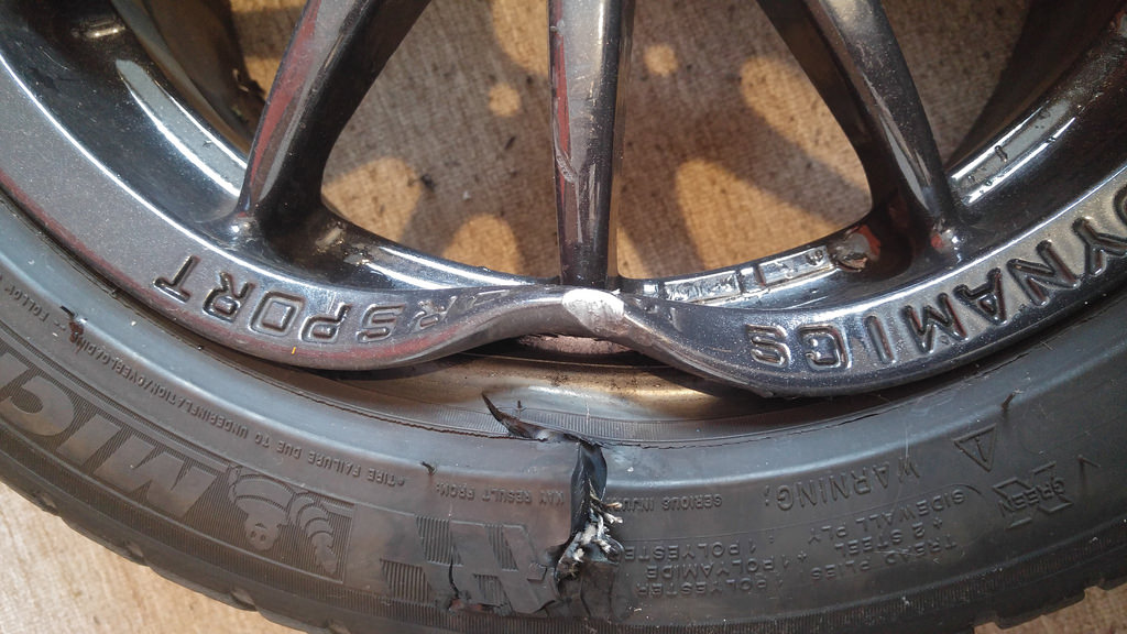

I'm thinking the shunt has damaged something inside the gearbox as I always leave my car in gear no matter what. If something's been forced then that aint gooooooood.
Can sort of see it pointing in there
2016-06-12_05-04-27 by dann2707, on Flickr

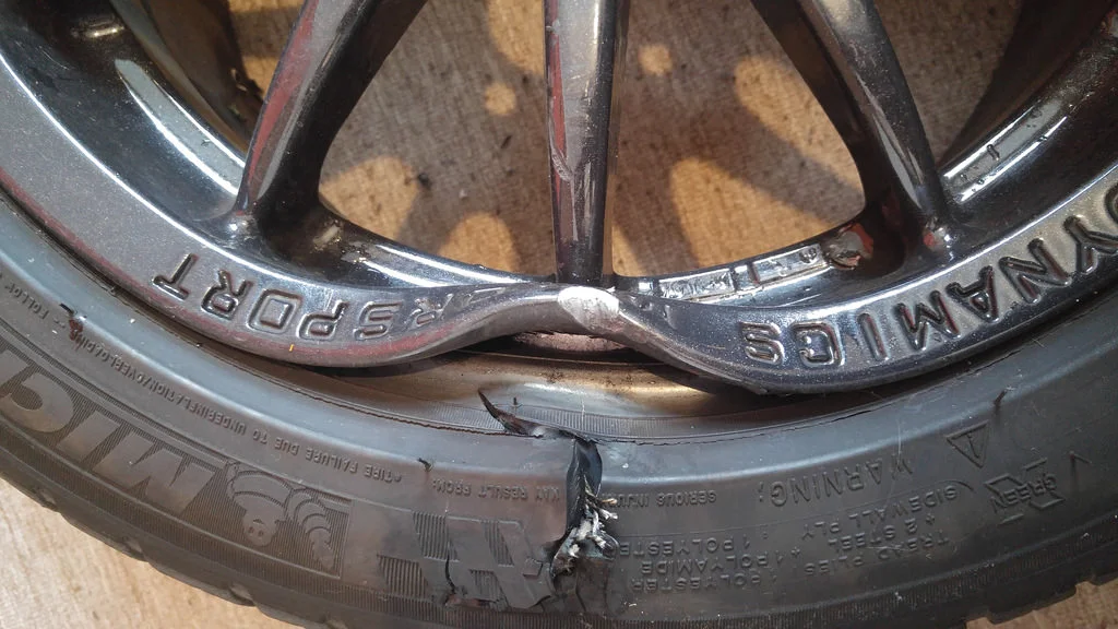

here is more of the damaged wheel, proper f**king awful like
20160612_175650 by dann2707, on Flickr

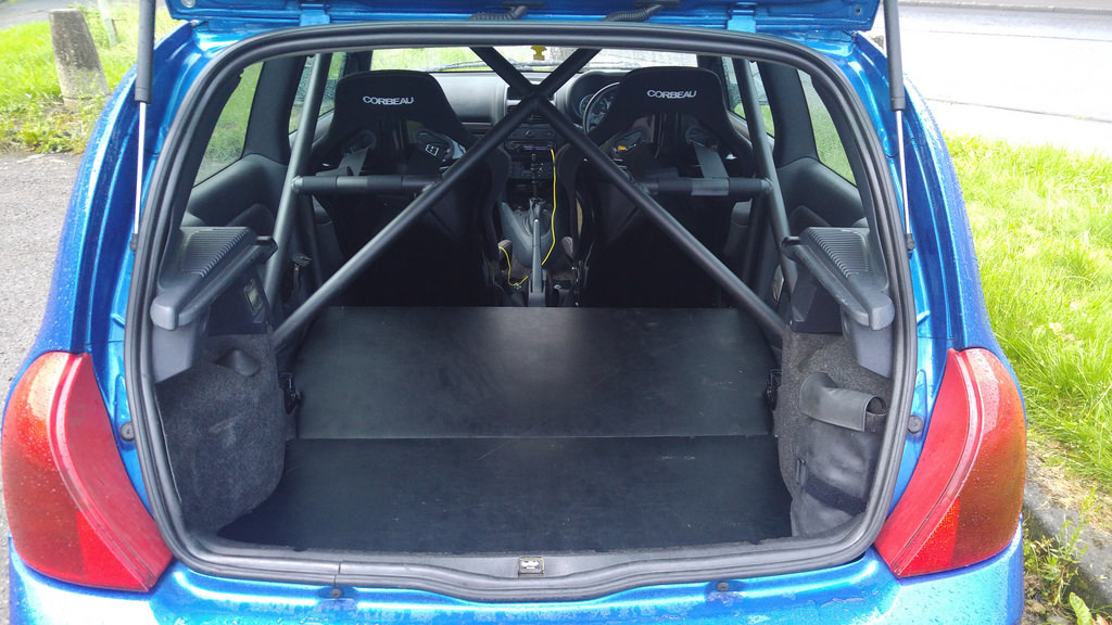

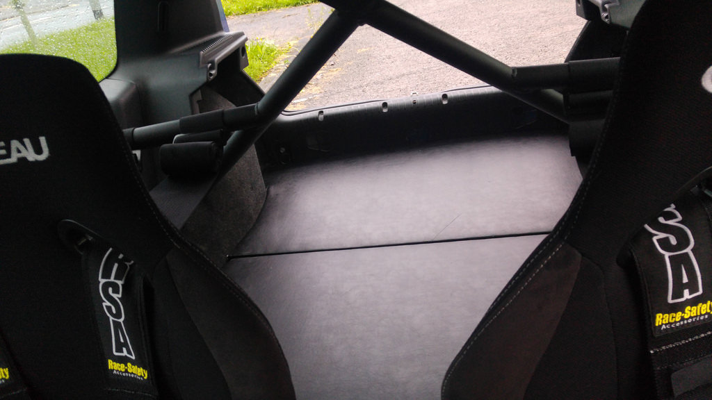

And now i've just fitted my false floors thanks to @debussetti I think they look great!
20160612_203150 by dann2707, on Flickr
20160612_203630 by dann2707, on Flickr

Floor looks good dude!
You going to CSF? I'm undecided but considering...
Thanks mate, managed to get it to fit in the end. The front panels I had to fit from teh front and slide them over the buckets. Pretty involving!

I would give it a lick of black or silver hammerite while its off, are there any more bushes you could change while its off too?
