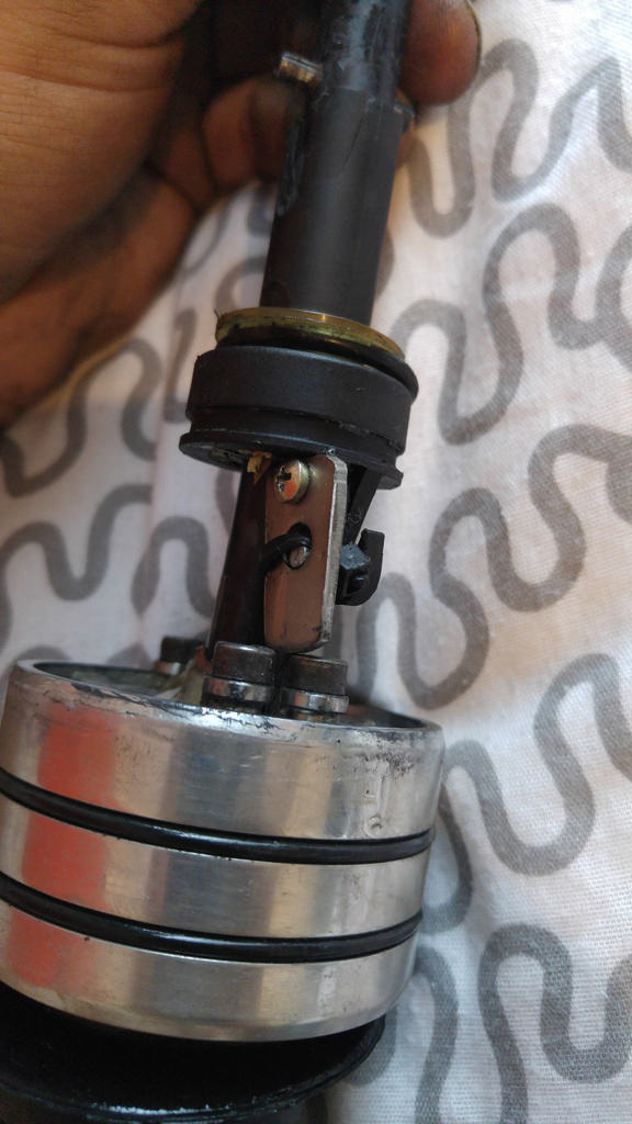

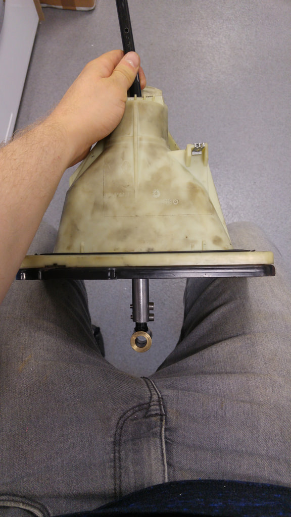

I then removed the internals
20160616_185815 by dann2707, on Flickr

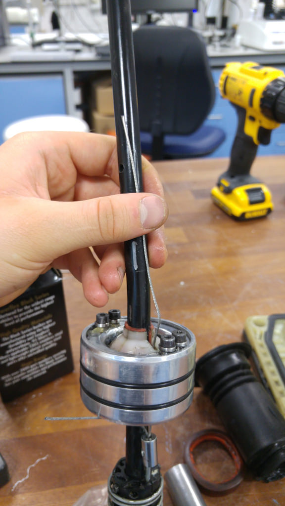

Please take a moment to admire my lift up reverse bodge bracket when I first fitted this as it snapped off haha
20160616_185827 by dann2707, on Flickr

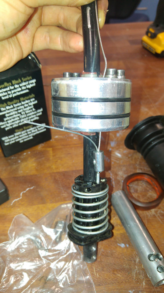

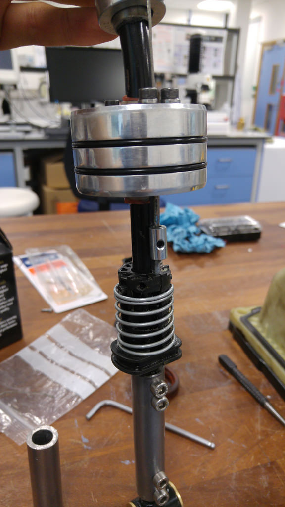

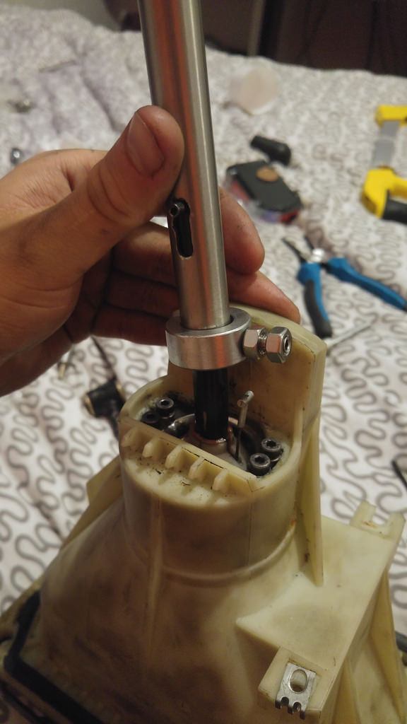

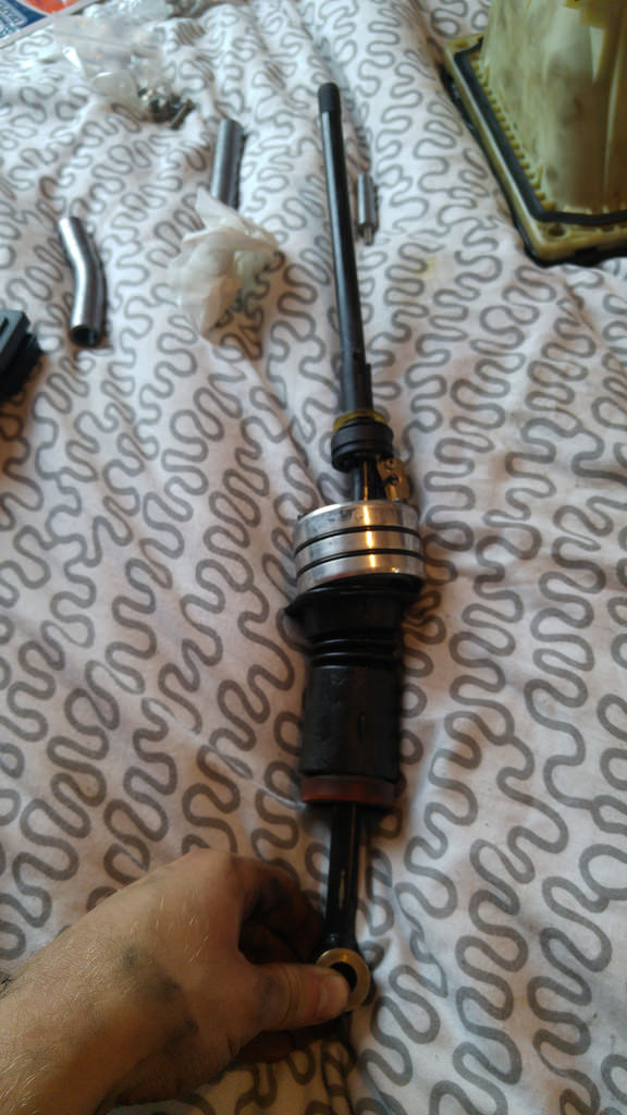

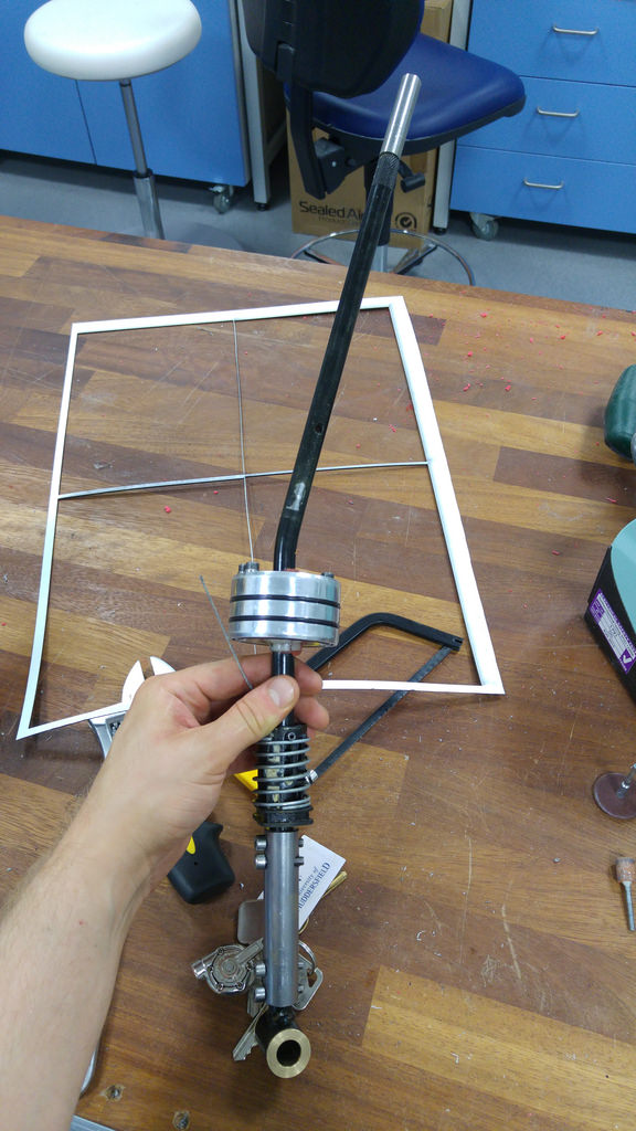

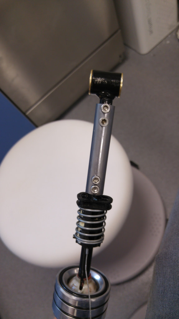

This is how i'm doing the lift up reverse now, using a 17mm bore bearing shaft collar, fitted an M6 grub screw long enough for two nuts, inbetween those two nuts is going to be my extended wire for the lift up reverse, joined by simply using a cable joiner. More pics of that tomorrow. Can also see my cut out for the pin on the silver shaft - not the neatest of jobs wish I had access to a milling machine.
20160616_220241 by dann2707, on Flickr

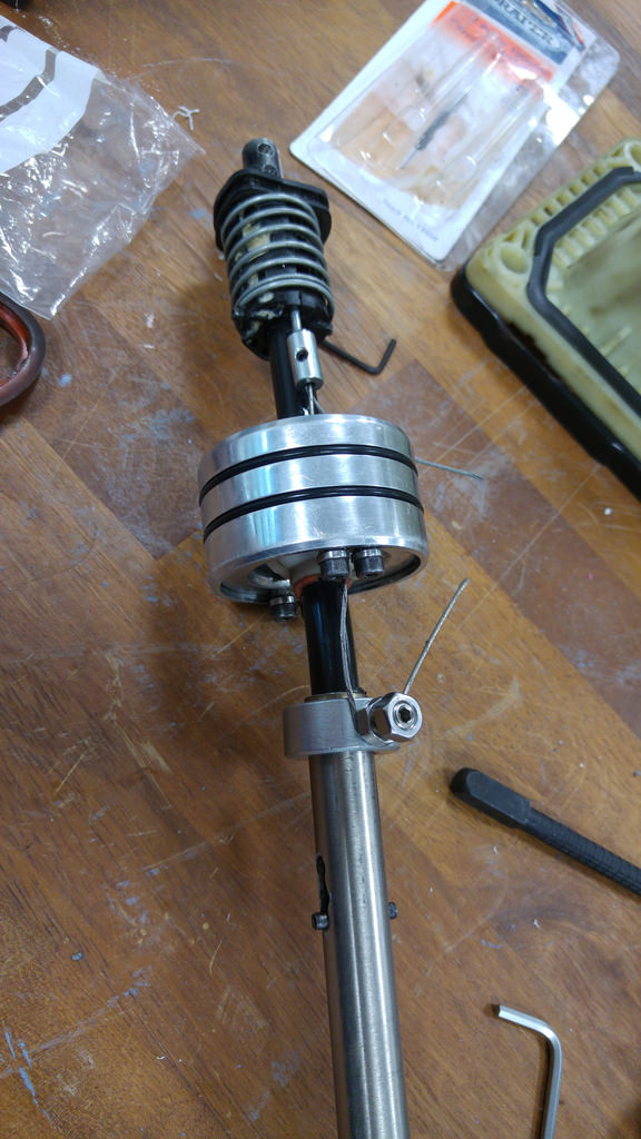

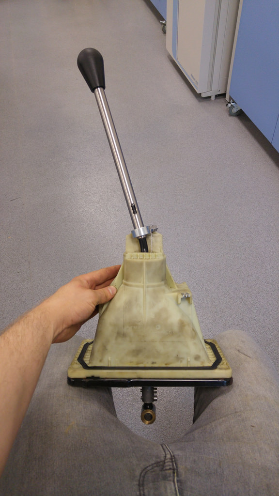

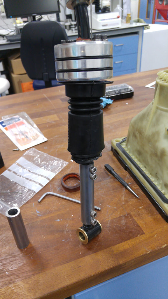

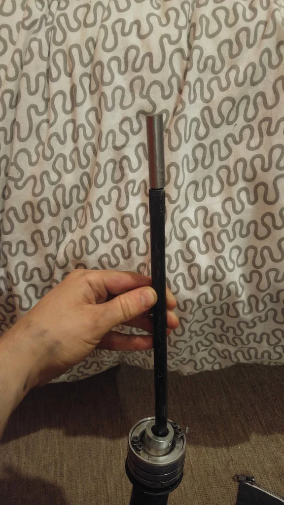

This is how i've extended the shaft overall, grub screw in the middle and tapped rod. Might have made it a little too big but i'll test it first before I make it shorter.
2016-06-16_10-33-04 by dann2707, on Flickr

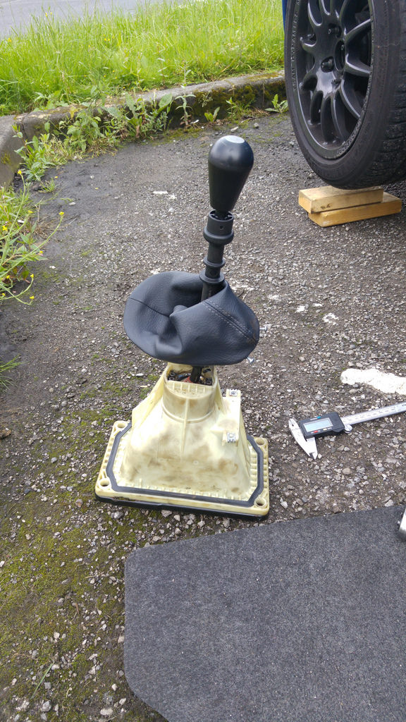

And altogether, just need a few little things doing tomorrow as I need some side cutting pliers.
20160616_220326 by dann2707, on Flickr
Pretty happy with it. Ordered another 17mm shaft collar for the lift up reverse bit for your fingers to grip. Will be spraying it black too.

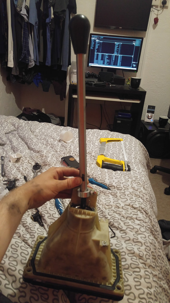

So, the gearstick!

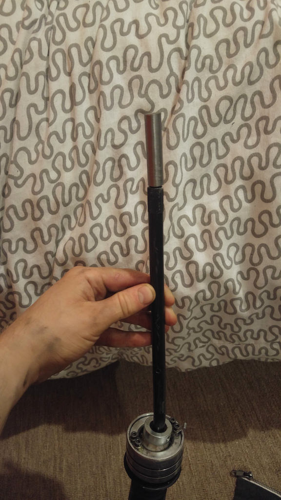

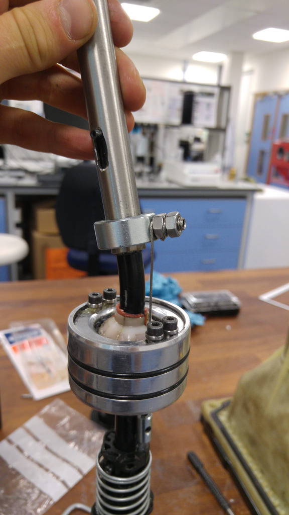

I needed to lengthen the lift up reverse cable so I'm using an adapter that uses a grub screw to hold two cables in, like so!
20160617_164406 by dann2707, on Flickr
Which feeds through the gearstick to the top:
20160617_164411 by dann2707, on Flickr
Then I'm using a screw with a nut to clamp the cable, probably going to put some washers on that a later date as at the moment it's purely just the nut. Sturdy as though
20160617_165226 by dann2707, on Flickr
I had a change in direction with the angled extension tube for the linkage side of things. Decided to just use a straight bar instead and bend the gearstick at the top end.
20160617_173849 by dann2707, on Flickr
One extended linkage!
20160617_173940 by dann2707, on Flickr
I then bent the rod a fair bit. You can see the difference here compared to the last pic
20160617_180227 by dann2707, on Flickr
The cable was then trimmed down
20160617_181706 by dann2707, on Flickr
And attached to my outer shaft giggity.
20160617_181709 by dann2707, on Flickr
Rubber cowling attached
20160617_181835 by dann2707, on Flickr
And finished. I'm just waiting on my shaft collar for the lift up reverse now. Then will spray it all black.
20160617_183212 by dann2707, on Flickr
Really happy with it now, think it looks pretty good to say it costed around £15-£20 overall. Just time and thinking energy that took the most resource I guess.

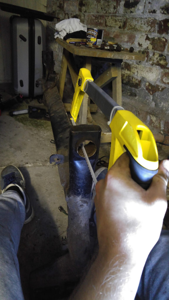

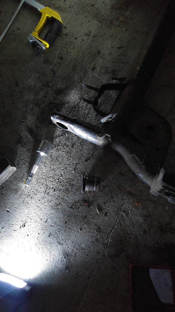

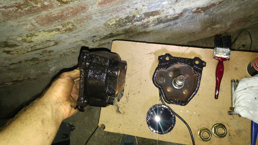

Got the old bushes out. Thanks to advice from @JP83 and @optical I drilled holes in the rubber bush, smashed out the metal insert, then hack sawed a line down the outershell then hit that out with a hammer.
20160617_214339 by dann2707, on Flickr
20160617_215154 by dann2707, on Flickr
The new outer shells went in ridiculously easy as I put them in the freezer for a few hours, simply slid in and required a little tap from the hammer
20160617_215920 by dann2707, on Flickr

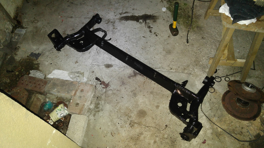

I then painted the rear beam and stub axles. Much better than what they were like before!
20160617_224517 by dann2707, on Flickr
20160617_224535 by dann2707, on Flickr

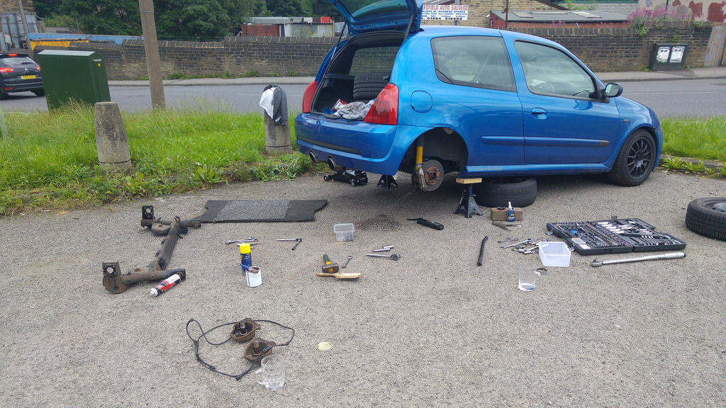

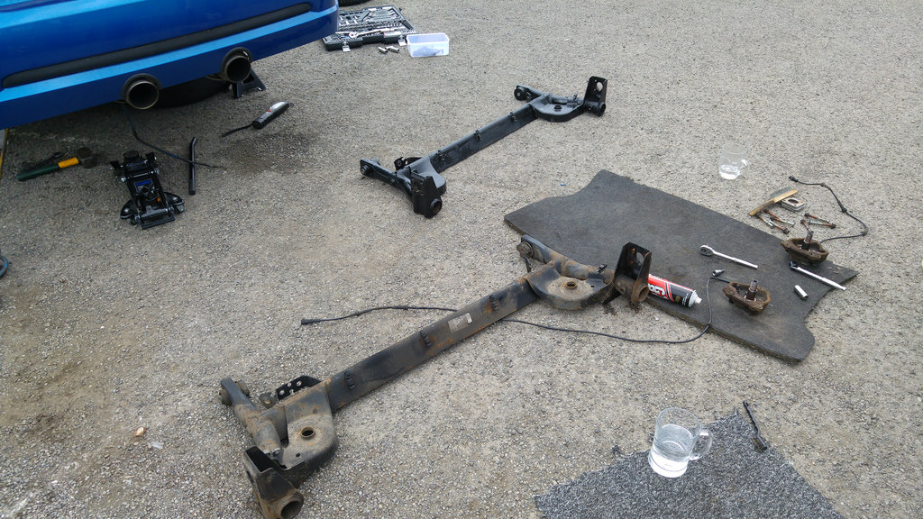

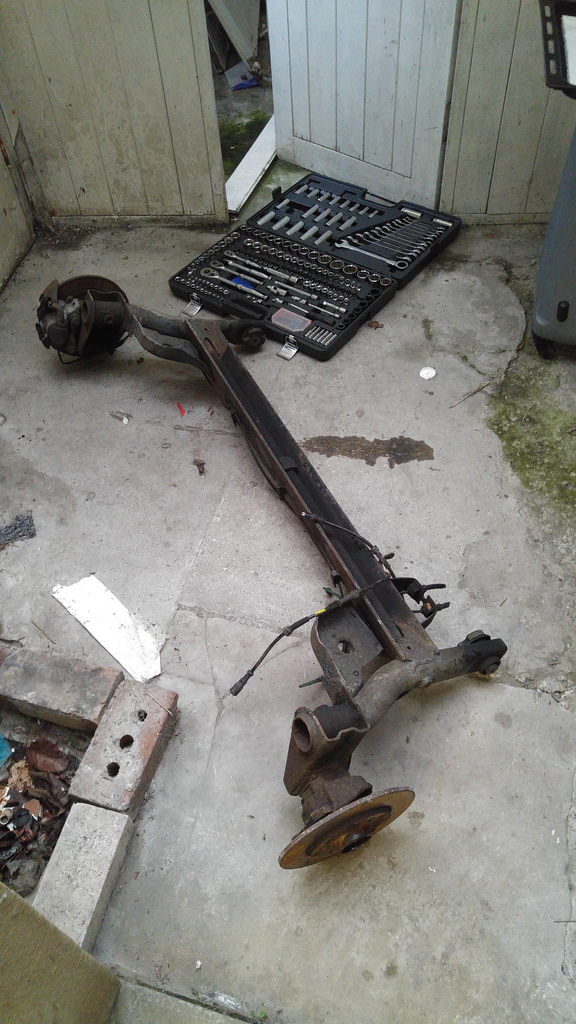

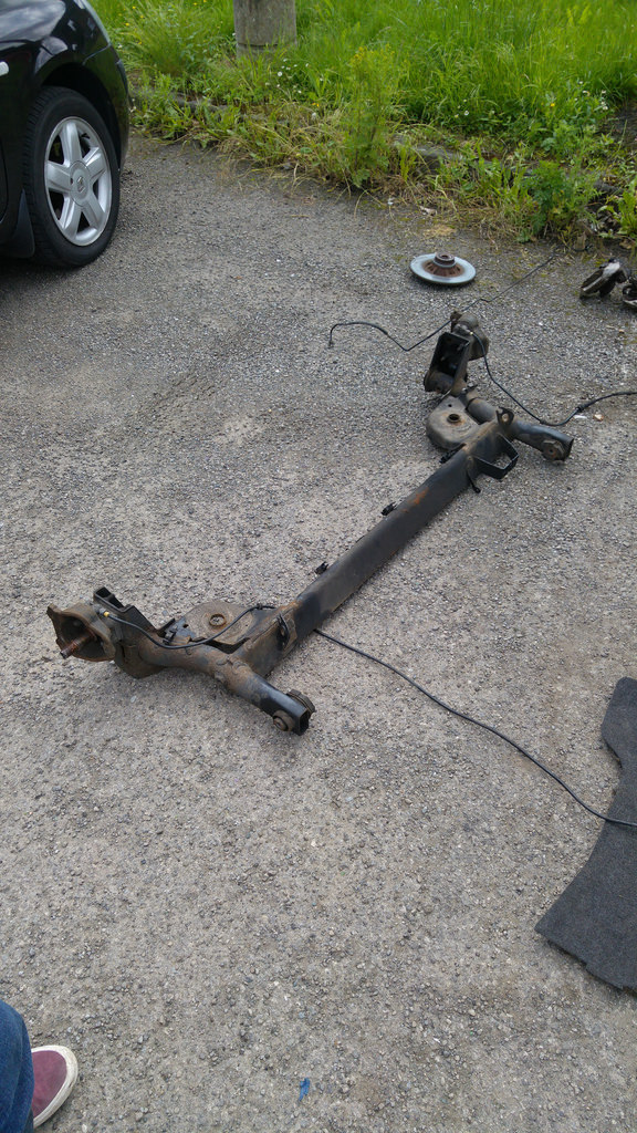

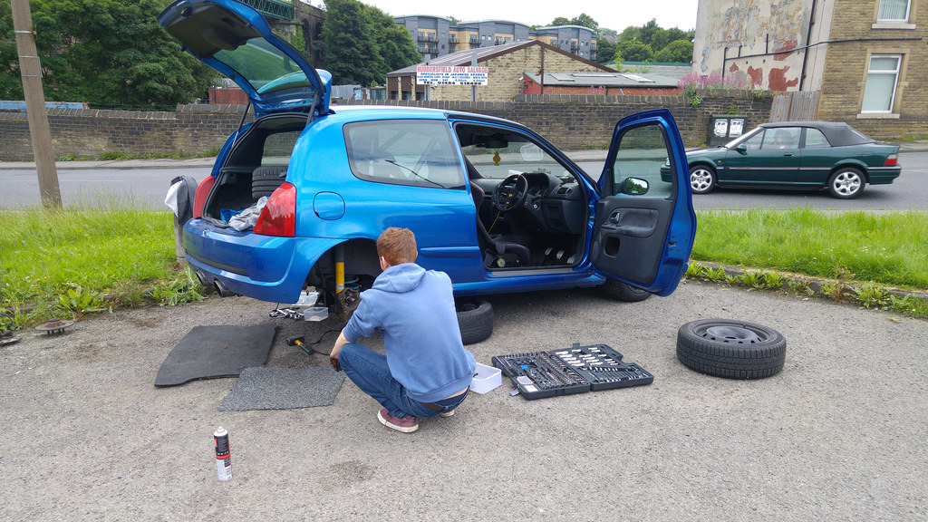

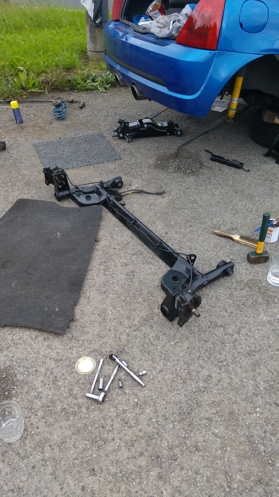

So today me and @Louis' tackled the rear beam. All went really well, bolts removed nicely.
If I can give any advice, if people are removing the rear beam or fitting rear beam bushes - LOWER THE FUEL TANK. Don't do what me and @Bear Head did when we fitted his arb and remove those 6 bolts for the rear beam carrier.
The fuel tank is held on by 4 13mm bolts that come off so easy and the fuel tank simply lowers allowing you to get the rear beam bolt out. So much easier.
Anyway, we cracked on removing the old beam

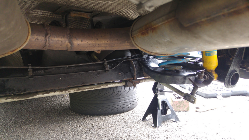

20160618_112936 by dann2707, on Flickr
And it's out. Really simply, disconnect a few brake lines, xenon sensor etc
20160618_121531 by dann2707, on Flickr
Empty
20160618_121539 by dann2707, on Flickr
Side by side
20160618_124153 by dann2707, on Flickr

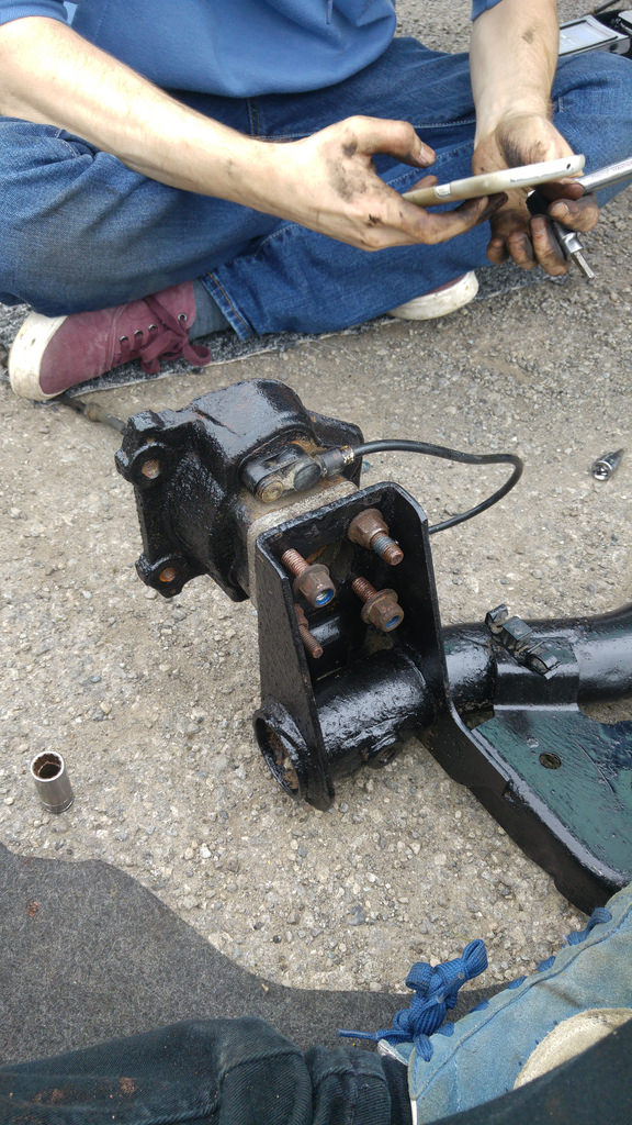

We then had a romantic stub axle fitting dinner date
20160618_132339 by dann2707, on Flickr
Ready to go in
20160618_132946 by dann2707, on Flickr

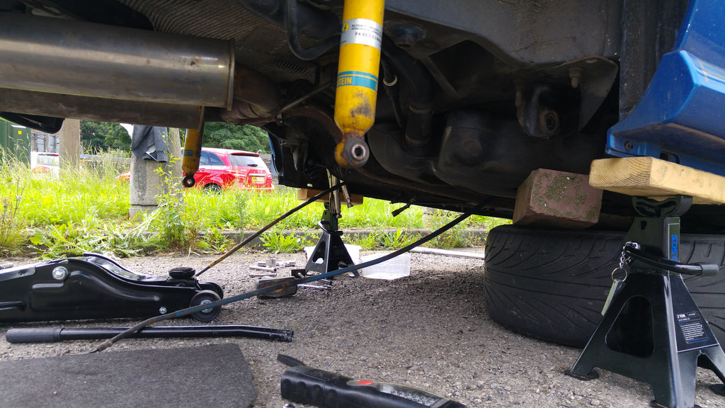

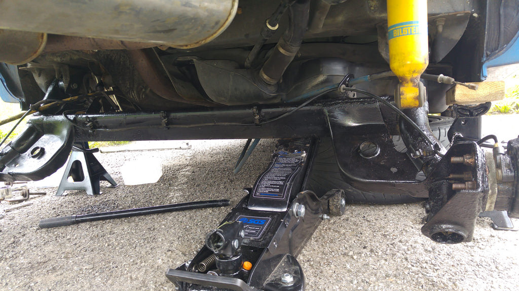

Used the jack to my advantage, raising the rear beam
20160618_134035 by dann2707, on Flickr

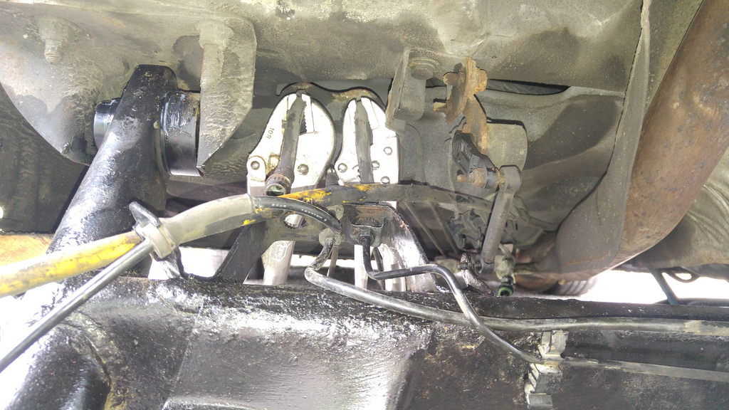

This is how I clamped my brake lines. Worked a treat as I saw the other day someone did the same swap and left air into their master cylinder - UH OHHHHHHH
20160618_140033 by dann2707, on Flickr
20160618_161253 by dann2707, on Flickr
New beam in, whiteline connected, new updated ARB bushes fitted also. From a suzuki swift 88 believe it or not
20160618_161307 by dann2707, on Flickr
20160618_161311 by dann2707, on Flickr
20160618_161326_HDR by dann2707, on Flickr
Now its all on but will get to the "problem" later on this post.

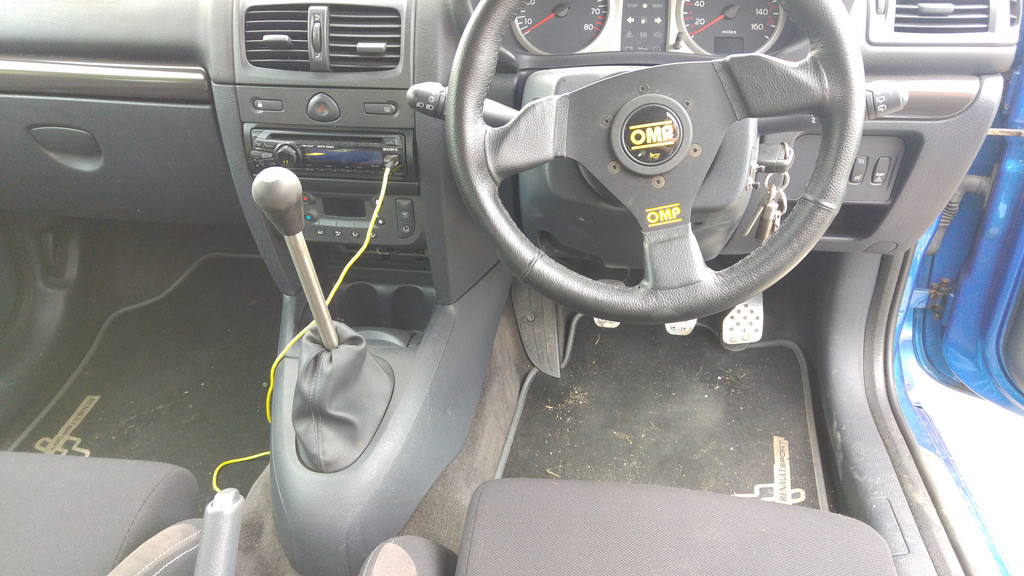

We then had enough time to fit the gearstick. Genuinely can't believe how it worked perfectly first time. Simply bolted in and every gear selects, reverse selects well too. Excuse the dirty car. My only gripe is that it's not angled enough towards me I don't think - as much as I'd like anyway. So I might remove it after a bit and bend it more. See how I get on.
20160618_184907 by dann2707, on Flickr
20160618_184939 by dann2707, on Flickr
20160618_201014 by dann2707, on Flickr
20160618_201314 by dann2707, on Flickr
Quick vid showing it.

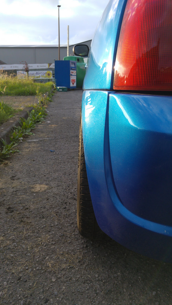

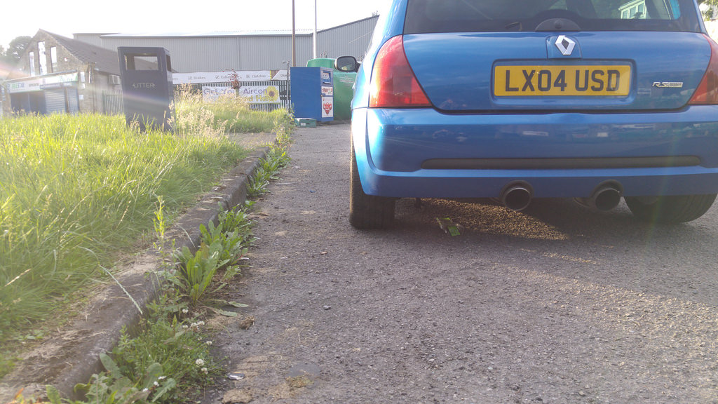

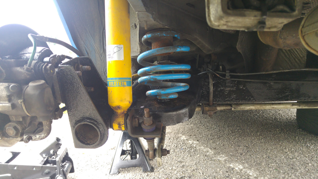

Now the problem. The right wheel sticks out a bit more than the left! It's only by about 1mm but we both noticed it. Quite annoying.
Swapped the wheels over and its still there so its not the wheels. Used the same stub axles as the one that was provided with the new beam. Stub axle spacers the same. The rear beam lined up perfectly with the carrier holes so don't think that's bent.
The ONLY thing that is different from left to right is I used the new beams disc on the right. And my old one on the left. Would a mismatched disc really have that different tolerances? Pics below. Hard to get pics of it.
20160618_201352 by dann2707, on Flickr
20160618_201343 by dann2707, on Flickr
20160618_201413 by dann2707, on Flickr
20160618_201404 by dann2707, on Flickr
Great work. I wouldn't worry about 1 mm! Lol.
My car was out on rear by around 5mm. I questioned it and read into it and there's often a discrepancy on the rear beam. Tony Hunter told me his was around 10mm out.
Car is looking great mate, glad it's all sorted now. Can't believe you've had to go through all that though, just from hitting a pothole [emoji6]
dann2707
Jesus that's quite bad haha! It's just a niggle in the back of my mind. It also looks like it's gonna scrub but im about to go for a drive soon to see what it's like.
My rear wheels are like that Dan.
Do you have a pic or anything mate? Just so I can compare?
Thanks Jack! I know haha I should really look out for those but it's hard when midget.

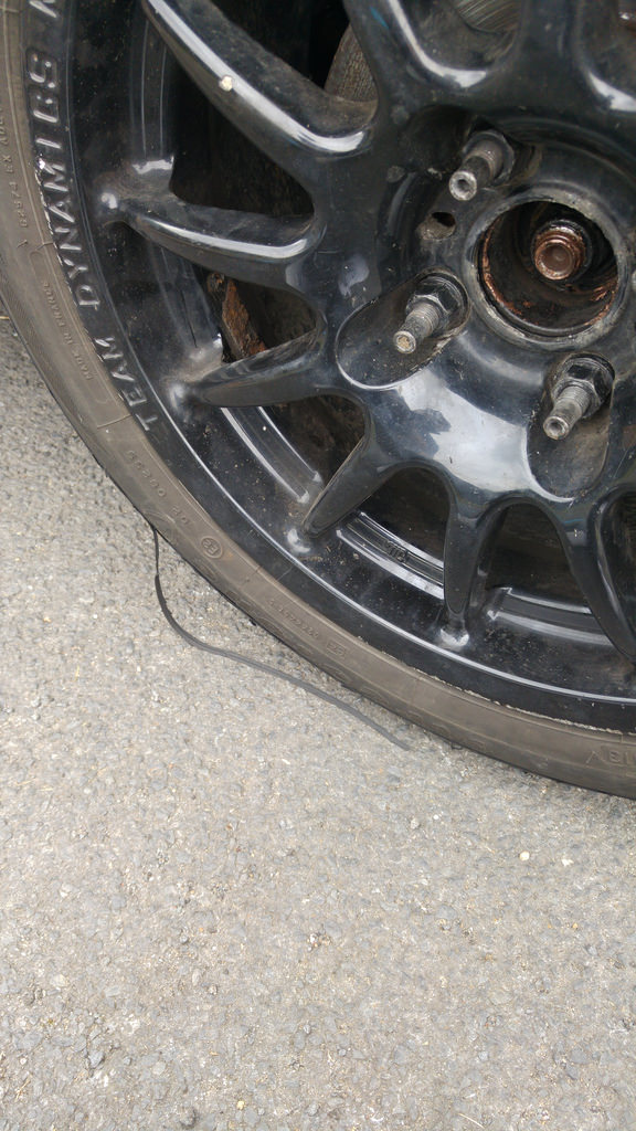

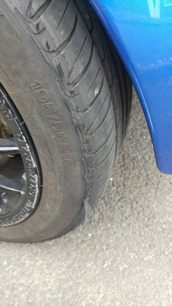

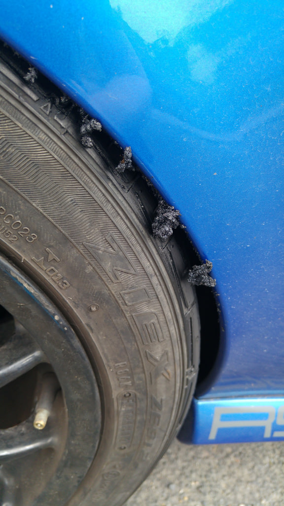

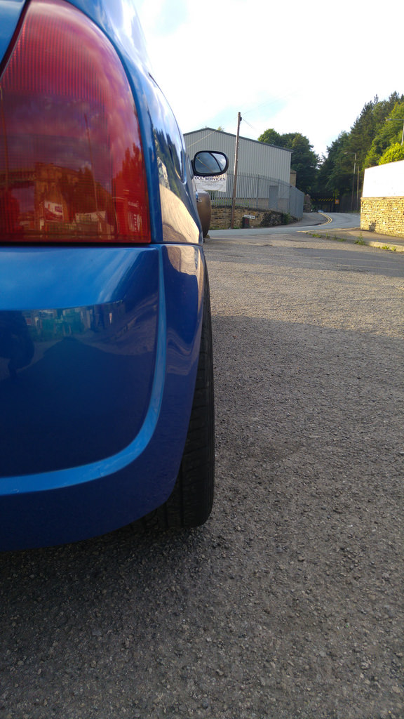

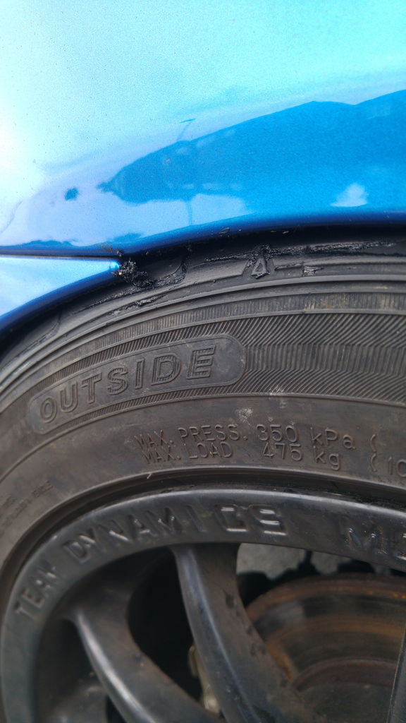

Well as you saw I fitted the new wheels to the back. Boris was catching a bit on the drive to my parents house but I didn't think it was this bad 😅😅😅😅😅😅😅😅
20160619_142521 by dann2707, on Flickr
20160619_142525 by dann2707, on Flickr
20160619_142545 by dann2707, on Flickr
20160619_142548 by dann2707, on Flickr
But as Elton John once said, "if you aint scrubbin', you aint dubbin'"

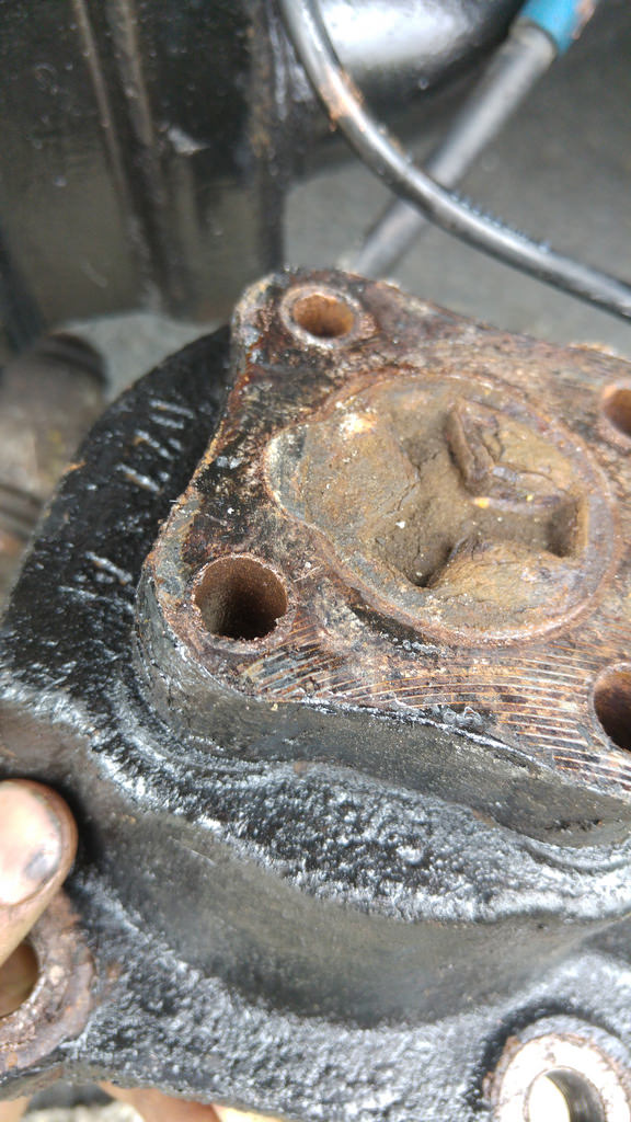

I measured them to be ET25 after seeing them like that not 35 as the seller told me! My current ones were ET40 so that's a 15mm difference on either side

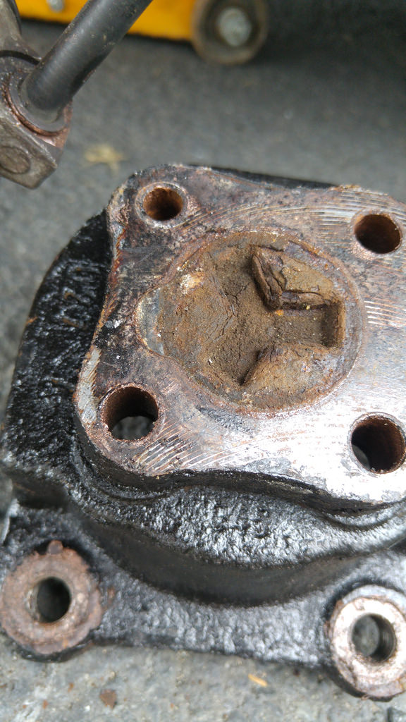

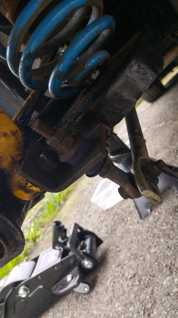

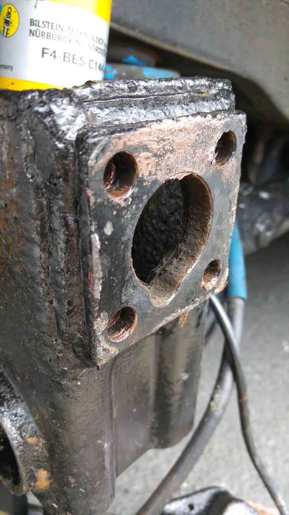

So looks like my stub axle spacers had to come off, which I did. Also used that time to check to see why the right is sticking out more. I noticed this and thought it might have been pushing the wheel out. So sanded it all flat and smooth.
20160619_162708 by dann2707, on Flickr
this has a little nubbing on it too which came off
20160619_162715 by dann2707, on Flickr
20160619_162730 by dann2707, on Flickr
Can see it's raised a bit there.

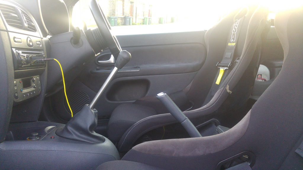

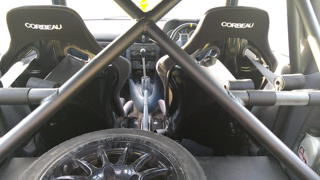

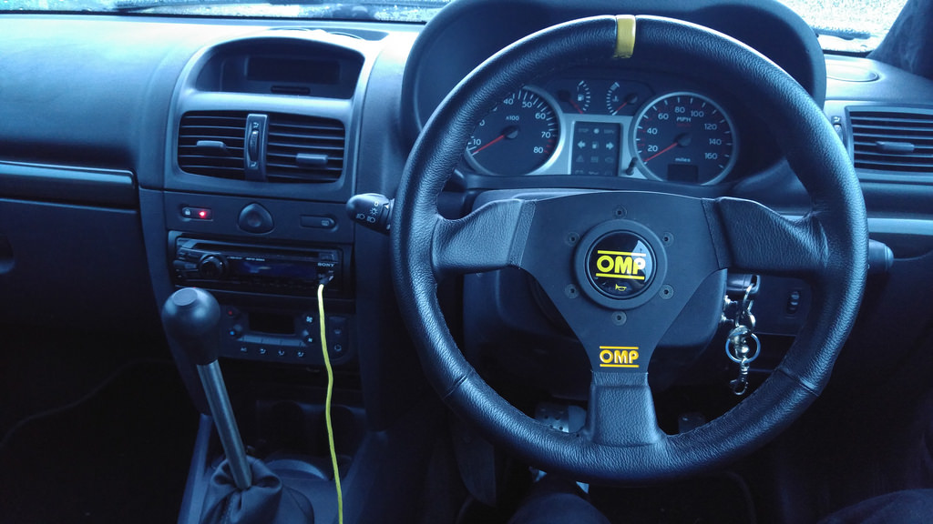

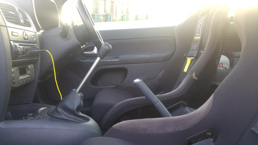

And one final pic of the cockpit/gearstick I promise! Will write up my drive home below.
20160619_213249 by dann2707, on Flickr
Well after removing the spacers and the car not catching I can write about how it drives. I feel it's sometimes very easy to fit uprated bushes and kinda forget about them and not give any feedback. Well after giving it a hoon with the black rear beam bushes it feels incredible, it just feels way more responsive and twitchy but not as in unstable. Twitchy as in more direct with the steering wheel. The best way I can describe it is if you were driving along and turn the steering wheel it almost feels like there is a lag of when the car turns and almost feels like its swaying a bit well from fitting these its a lot more flat - especially when going around corners at speed. Didn't it chance to give it heroic beans as it was raining. But its put a bigger smile on my face.

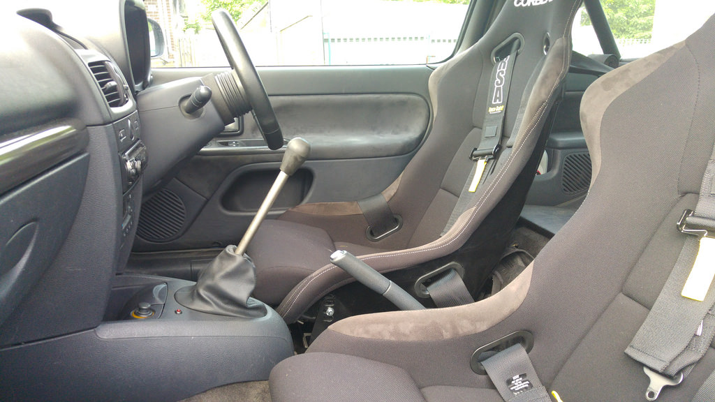

The gearstick also feels brilliant, as I raised it 50mm from the already lengthened scenic shifter its much closer to the steering wheel allowing for a shorter movement to the stick. Driving with it feels a lot better with it being ever so slightly shorter shift, 2nd to 3rd and 3rd to 4th feels great when accelerating. I'm so happy with it. Said to Ethan earlier I don't think i'm going to bother with the lift up reverse collar infact as it looks much cleaner. It lifts up easy enough. I do need to fettle with it a bit though as I want it angled even more to me.

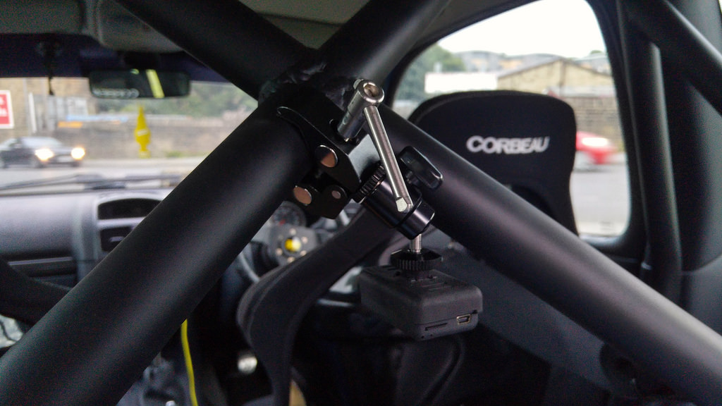

I'm going to set up my dashcam on my cage and have it permanently there so I can get some driving footage with it.

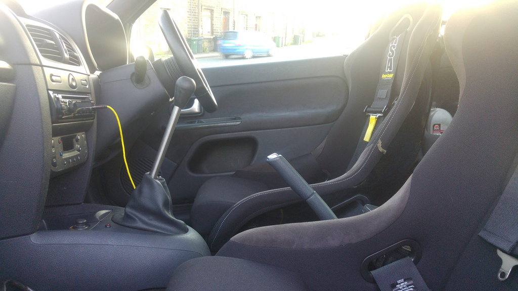

dann2707

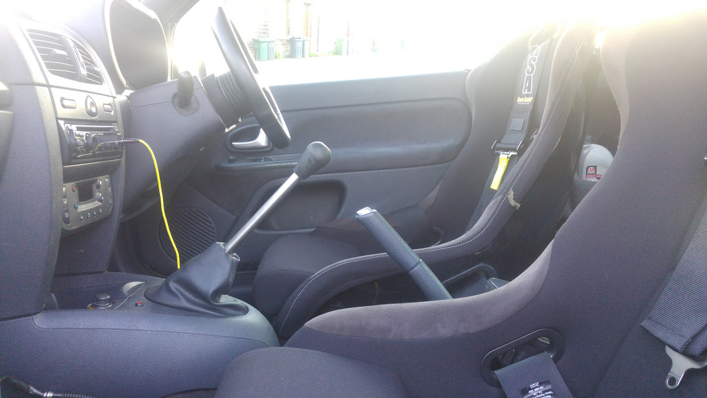

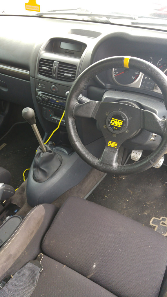

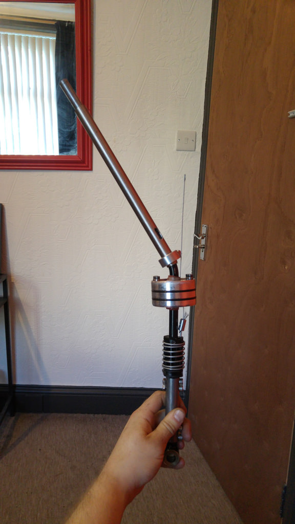

Busy busy tonight and it's finally there. I wasn't fully happy with the angle and I could have lived with it but as you know it's me and it's gotta be right or I get annoyed.
So I took it off and bent it some more.
20160620_201745 by dann2707, on Flickr
This is it now in neutral
20160620_205436 by dann2707, on Flickr
First
20160620_205442 by dann2707, on Flickr
And fourth
20160620_205450 by dann2707, on Flickr
I haven't been for a blast yet but after sitting in and changing gear it feels so much better. Can't wait to test it on track!
